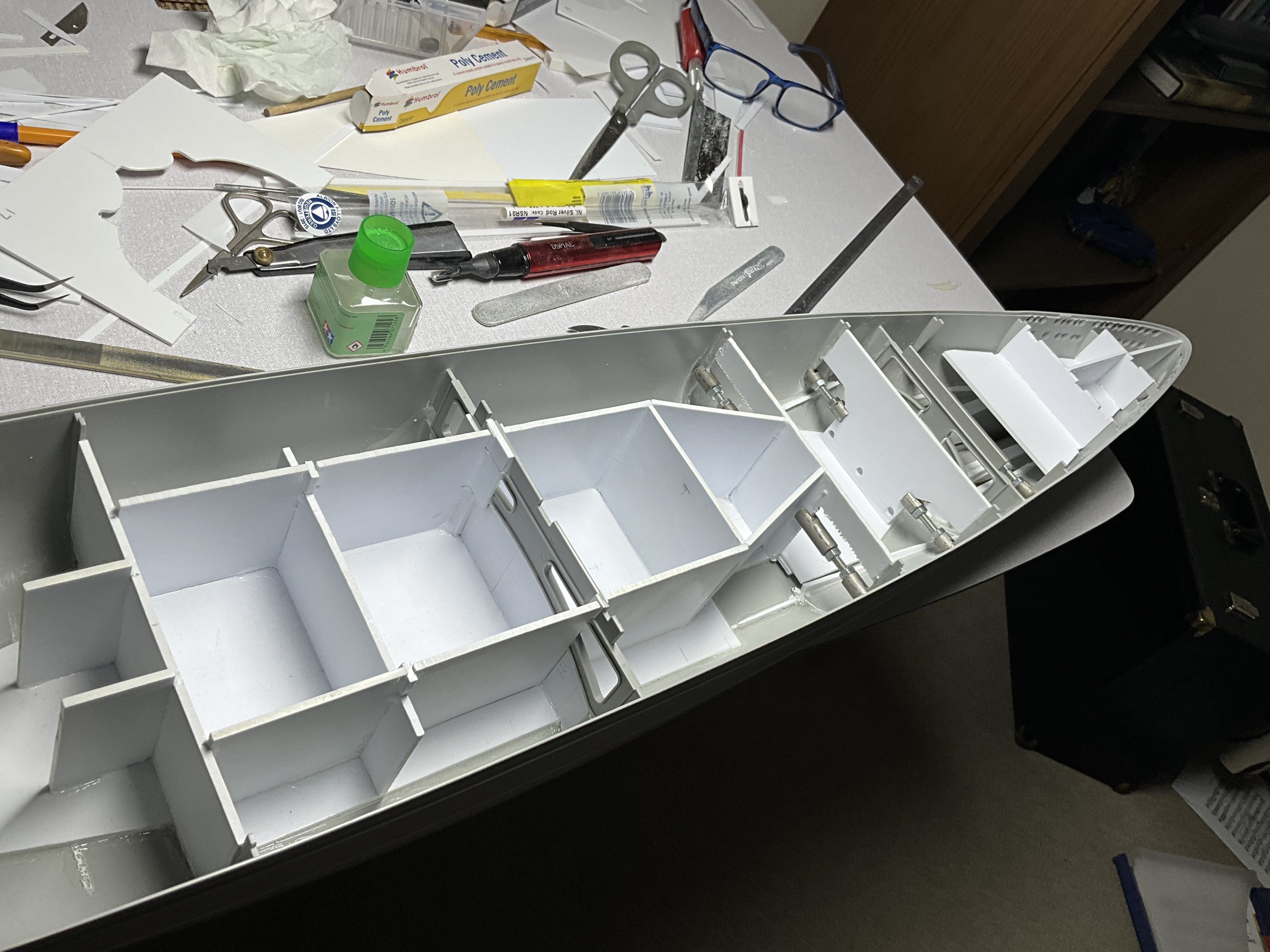

My solution to hull profile was splitting hull and forcing apart and building up outer profiles with styrene stock then dressing down the plastic till close to required shape, then when happy use thin styrene sheet to wrap on the outside of hull using liquid cement gradually forming around hull, then it’s down to filling and sanding, when satisfied  it’s back to lightly engraving hull detailing back onto hull, yip, this is going to take a while 👀 on a lighter note the degaussing strip on outside of hull, 1mm half round styrene strip fitted around hull, straight out of packet, perfect , what a doddle 😂

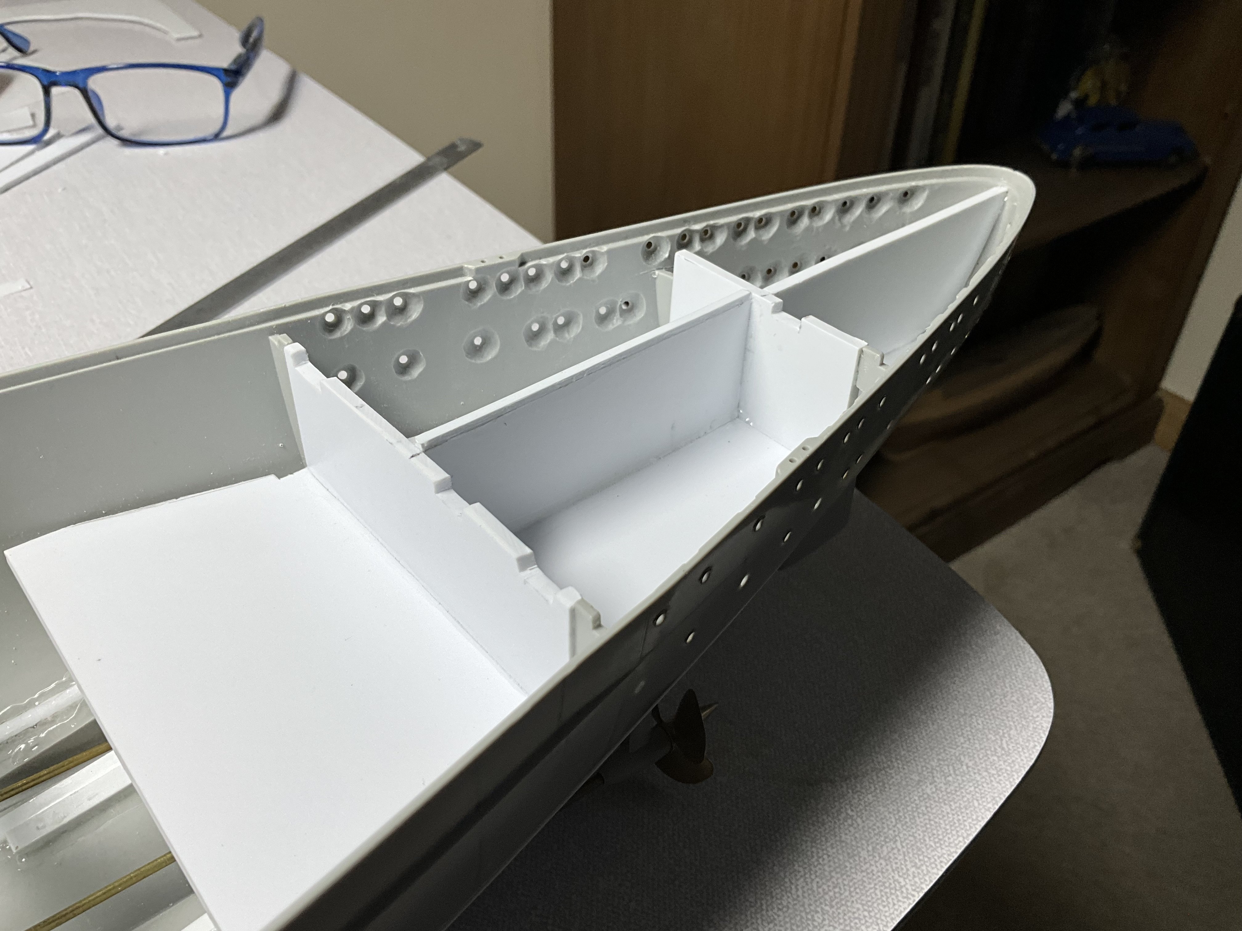

Another little solution for hull profile was this 5mm screwed rod and nuts with pipe to use as jacking system then glue in place when happy, think this shall help me as well, as it progresses, that’s me for now thanks, got a lot to be getting on with 😵‍💫👍

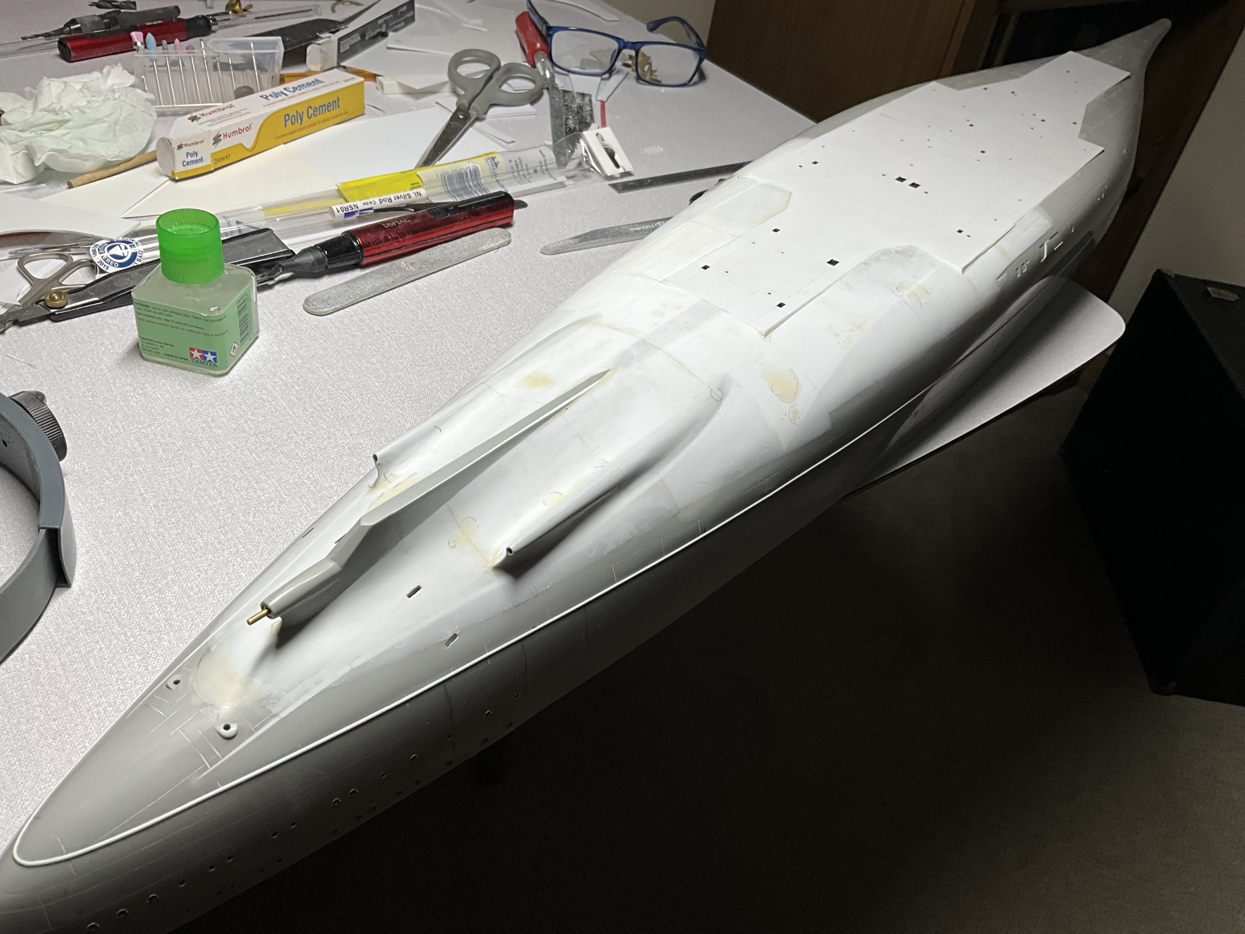

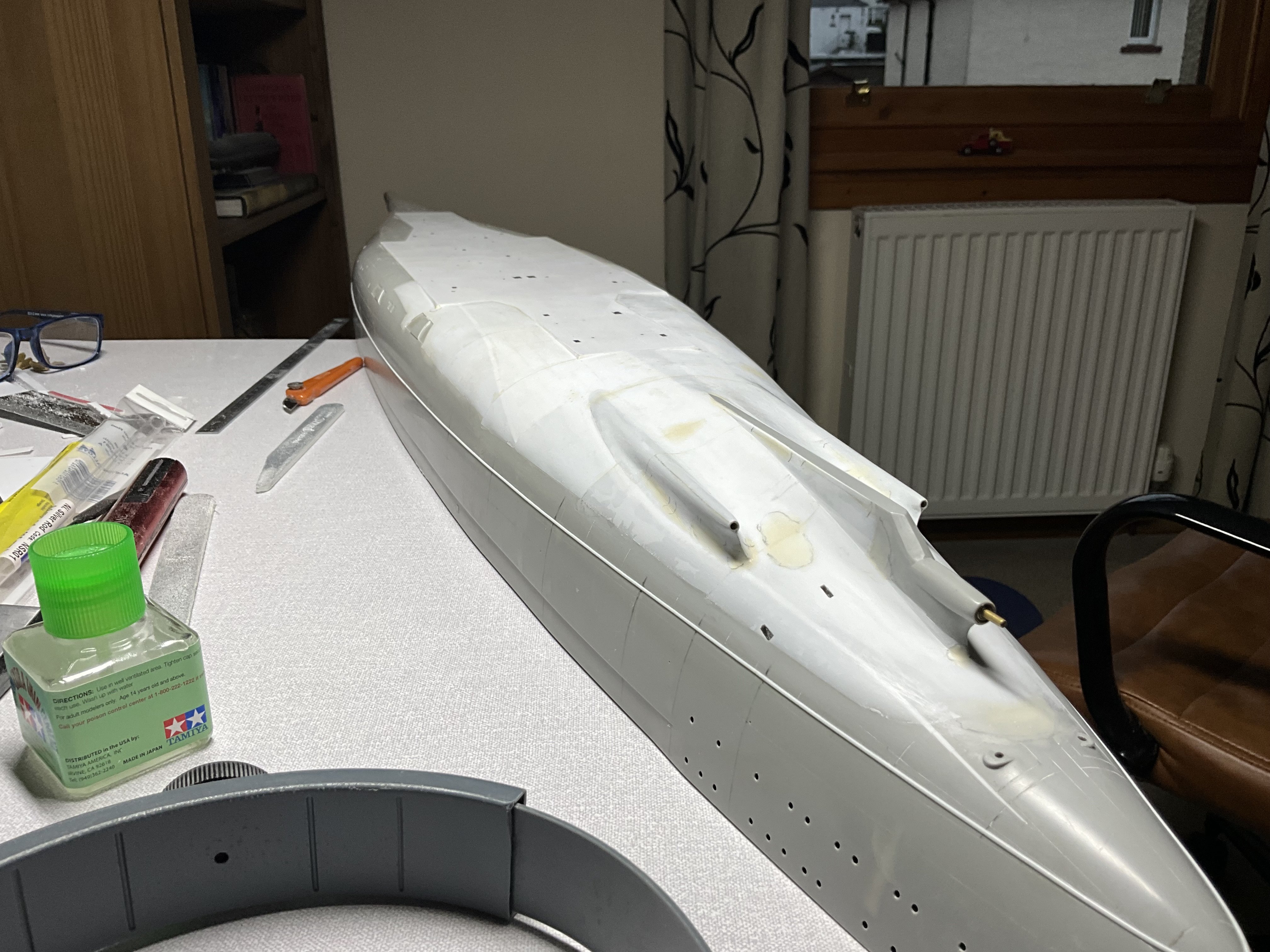

Hello again guys, know it’s been a little while since my last posting on this build so happy to at last reached a point off progress. Try to get this in right order. Decided to split the hull even more towards stern to help with easing it apart, you need all the flex you can get to allow for increasing the hull line on the horizontal plane, think l have increased the width of hull slightly over 4mm at some points on the aft part of hull. Doesn’t sound a lot but with this and filling out the hull profile some points as much as 5mm it actually makes a nice difference to the look of the hull, certainly got rid of the long run of on the keel, on the point of the keel l had tapered it down on either side like on drawings in Seffans book , only to stumble across a photo off Tirpitz lying upside down being scraped in 1948 so changed my mind and made it full width again, makes more sense this way with construction and displacement in mind. Put some photos up to showing this.
Filling out the hull between the stern keel and the outer port and starboard shaft housings is probably the hardest part of fixing the hull, theirs no quick or easy way here, you just have to build up the hull with strips of styrene and contour it till you think you’re happy, takes ages, am just about there now, shall be less difficult after this part, at least that’s what lm telling myself 😂 got some more thin styrene sheet grafted onto hull, can see it starting to change now, some more photos now.
One photo there is another person’s building and their fix on said problem of hull, this just shows how far out the hull actually is. Incidentally the small holes in the thin skin are me fixing air bubbles that have formed where liquid cement hasn’t quite caught the skin, just add a bit more cement through these holes and then fill and sand 👍 Also decided possibly to motorise propellers so have used 2mm brass rod for shafts and have purchased suitable bearings, shall put them in and take photo.

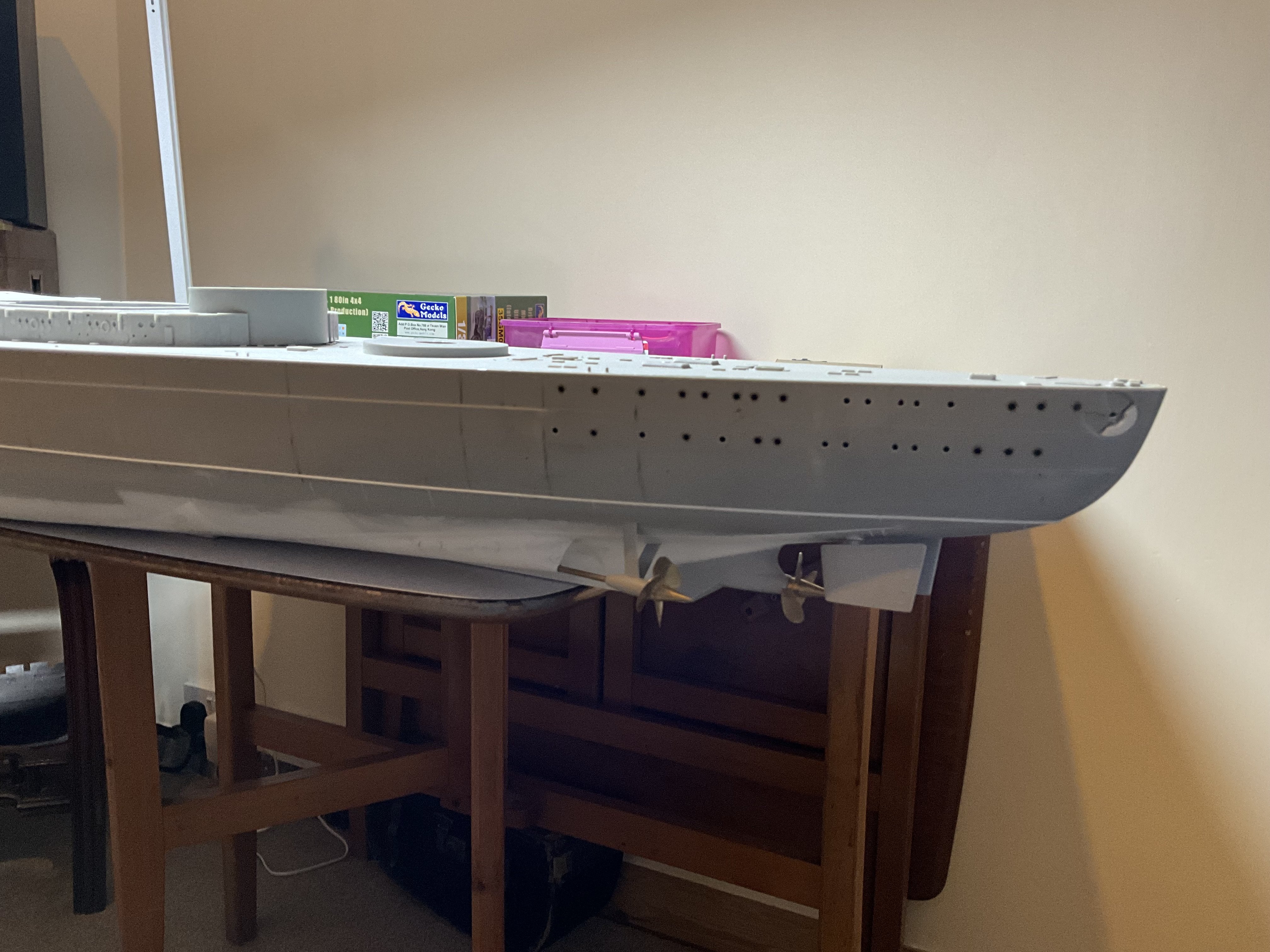

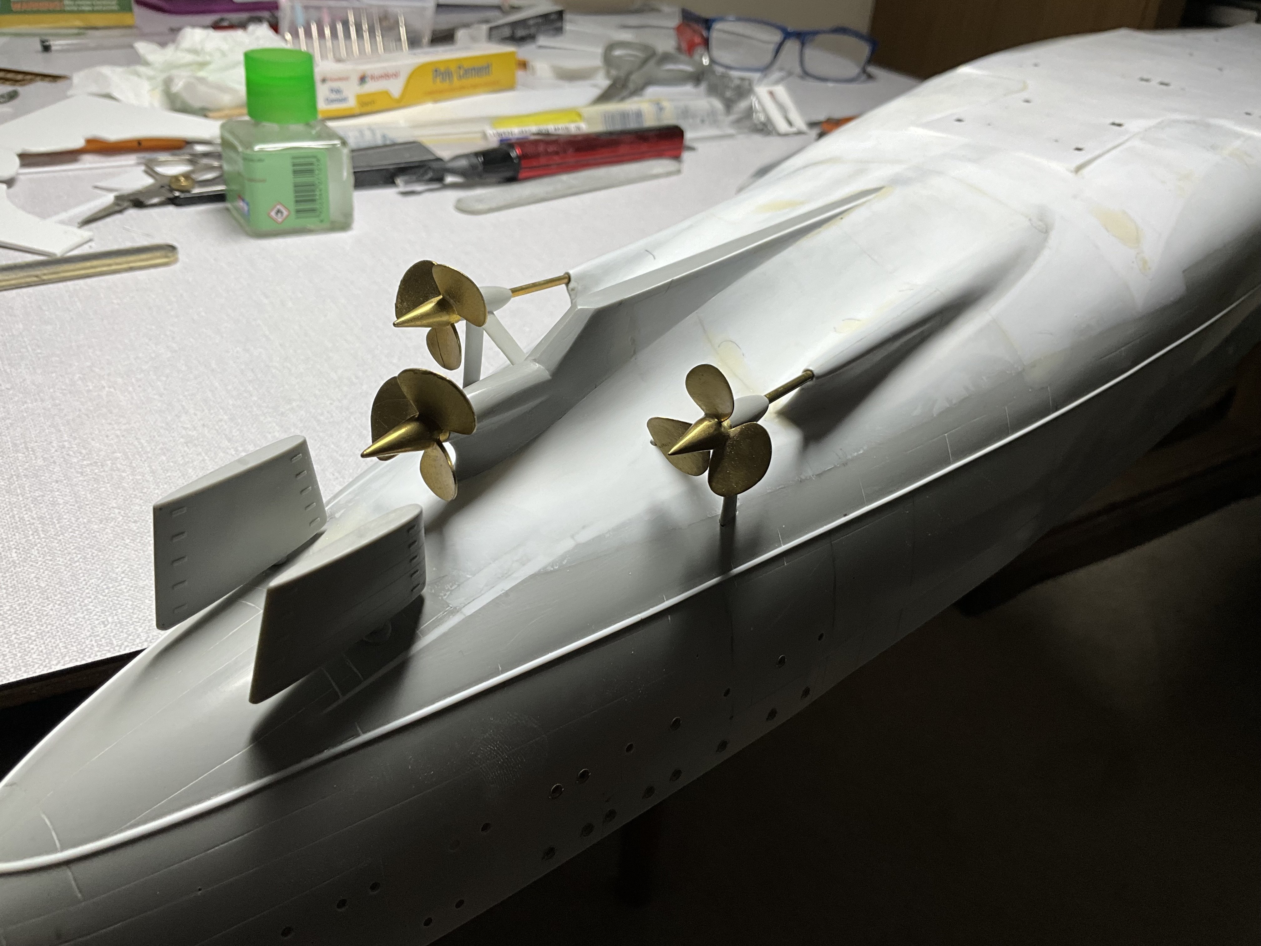

Hi guys, hope everyone is in good health and enjoying their modelling 👍 Hurray Summers over, back to the modelling, have to say this hulls taking me ages for what’s done, wasn’t till l looked back at my post, realised it’s quite a lot of work. Have completed the hull profile on aft section, which is the worst part for sure, just filling and dressing and filling and dressing till l think am happy, so it’s not far away, not much difference in the challenge just further down the road as they say, will put some photos up to show progress, l hope 🤞
Edited by Jeff59
Have also been purchasing bits and bobs for her further down the road. This company sells quite a selection that l’m sure some of you will find helpful distefano 3dprint.com  think a browse through this site would make a few interested. In process of purchasing some parts for Bismarck just now but have purchased these parts already
The anchors are an improvement on kit ones definitely, also noticed the area surrounding the stern anchor on the kit hull has too much clearance around the anchor, should be a lot neater fit than this, so in process of filling this in a bit. Oh and there’s a part there that is for the bow of my Yamato model, which is 1/96  so 8ft+ in length been in my garage for about 20 years 🙄 finally found a source for detailing it all up, for a small fortune though, this should cheer Jaqueline up 👀 also did a little more profiling on A frames and housings for propellers.
Edited by Jeff59
Has all been a slow process of picking through this a bit at a time, shall still need more time spent on it before try a little primer on it to highlight issues, there’s bound to be a few. Whilst doing that, think l will start making hull profiles for forward hull. This has got to be less problematic 🤞 that’ll be me for a year till next post, bad joke 🫣
