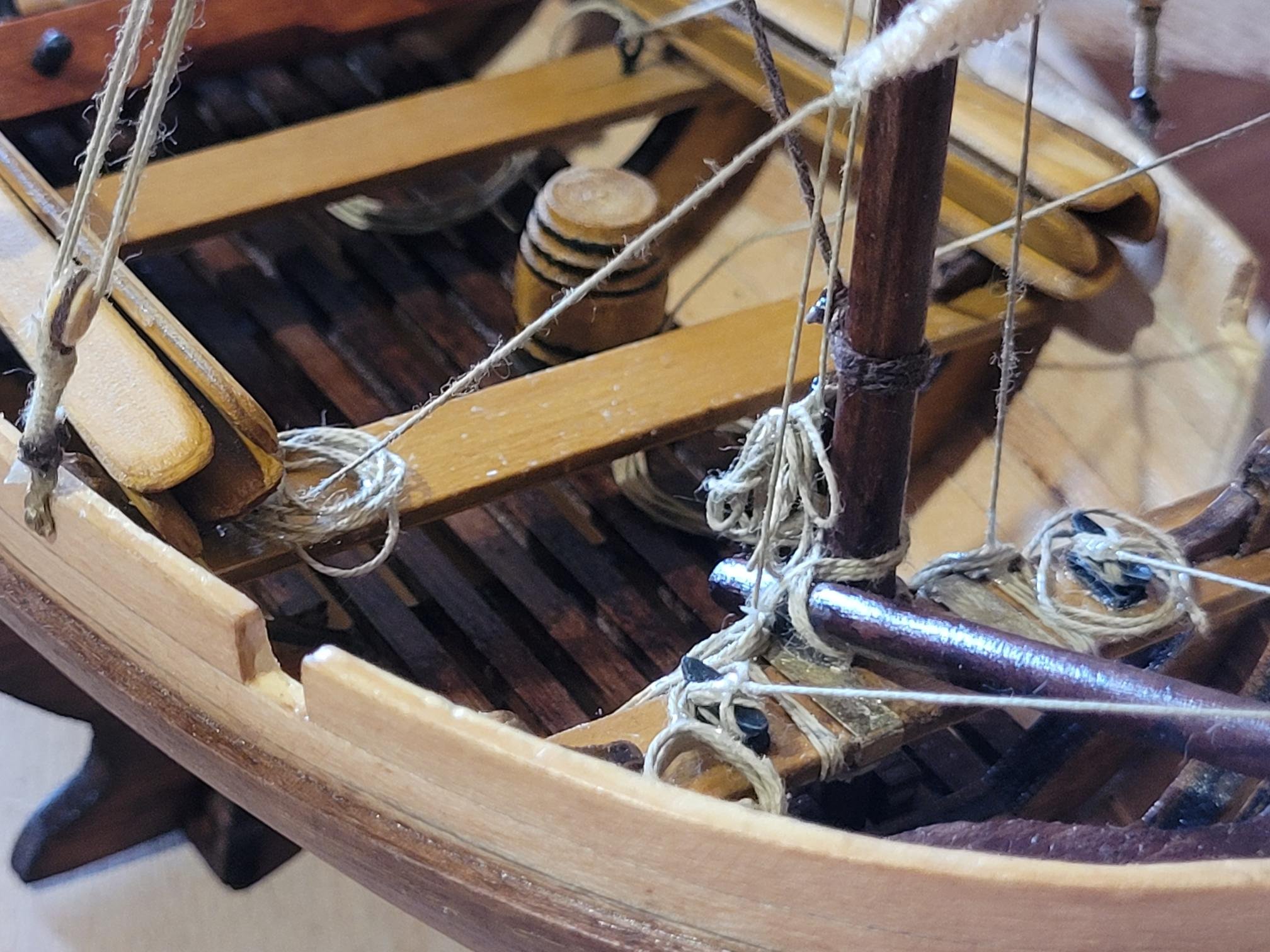

This oak colored part broke and, after trying to repair it, I decided to simply do a new one in balsa wood. I think the result wasn't too bad.
On the other hand, this one is also quite damaged, but I decided this one would be too much. It's probably the worst looking part on the boat.
One more thing in which I decided to not follow the instructions was on the rudder handle, which was golden and I painted black. The same on those two wheels and the rings on the benches. I wanted to actually blacken the brass but had no proper products, so for this model I simply painted.
Finally, the deadeyes are already attached. Was having a hard time preparing them until i got myself a handful third hand. They are not quite the same, but close enough for a first timer.

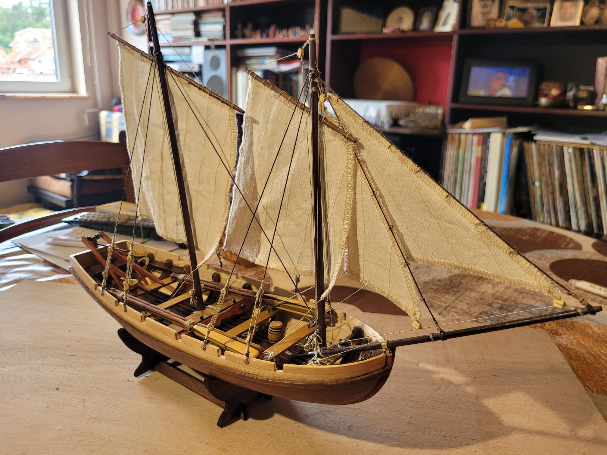

That's all for now, onwards to the masts! Thank you all for reading and, most of all, the helpful advice once in a while!
