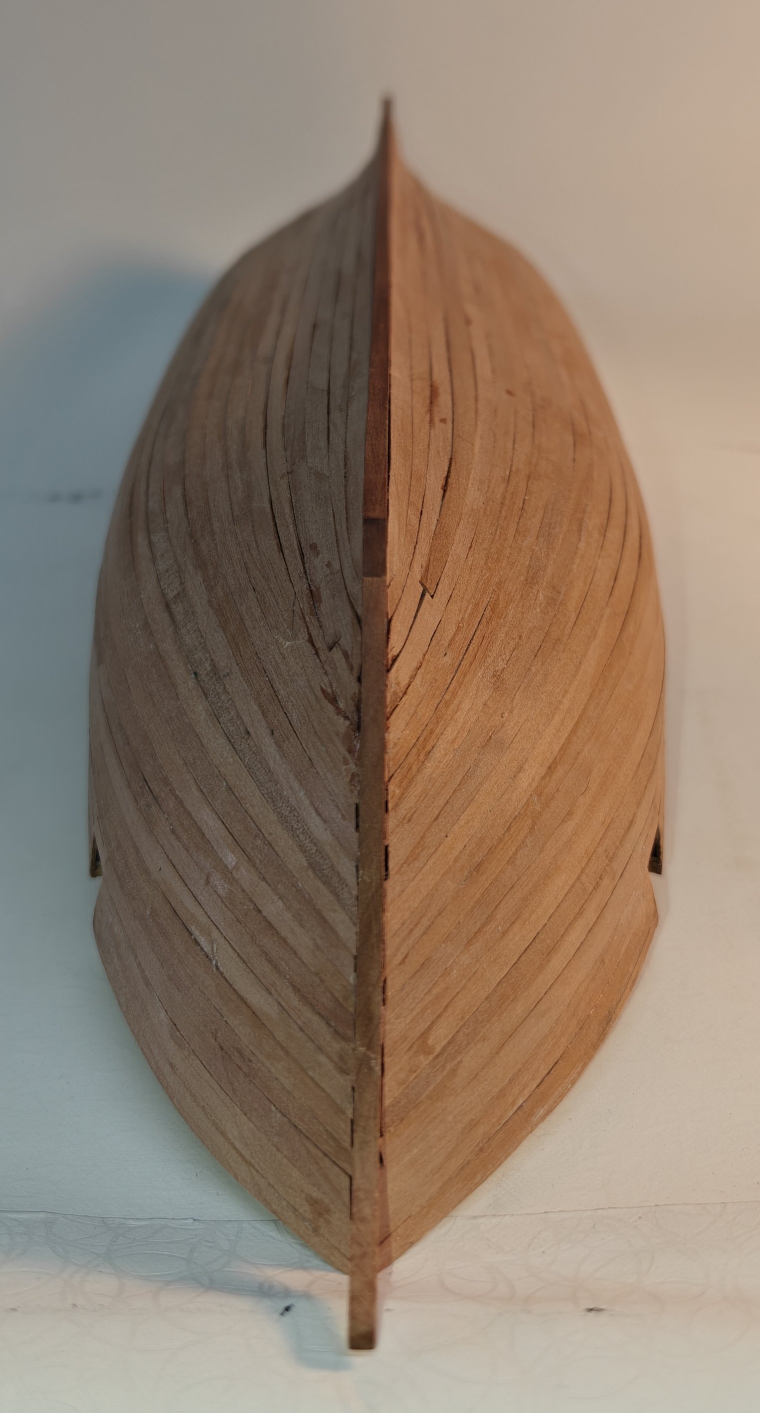

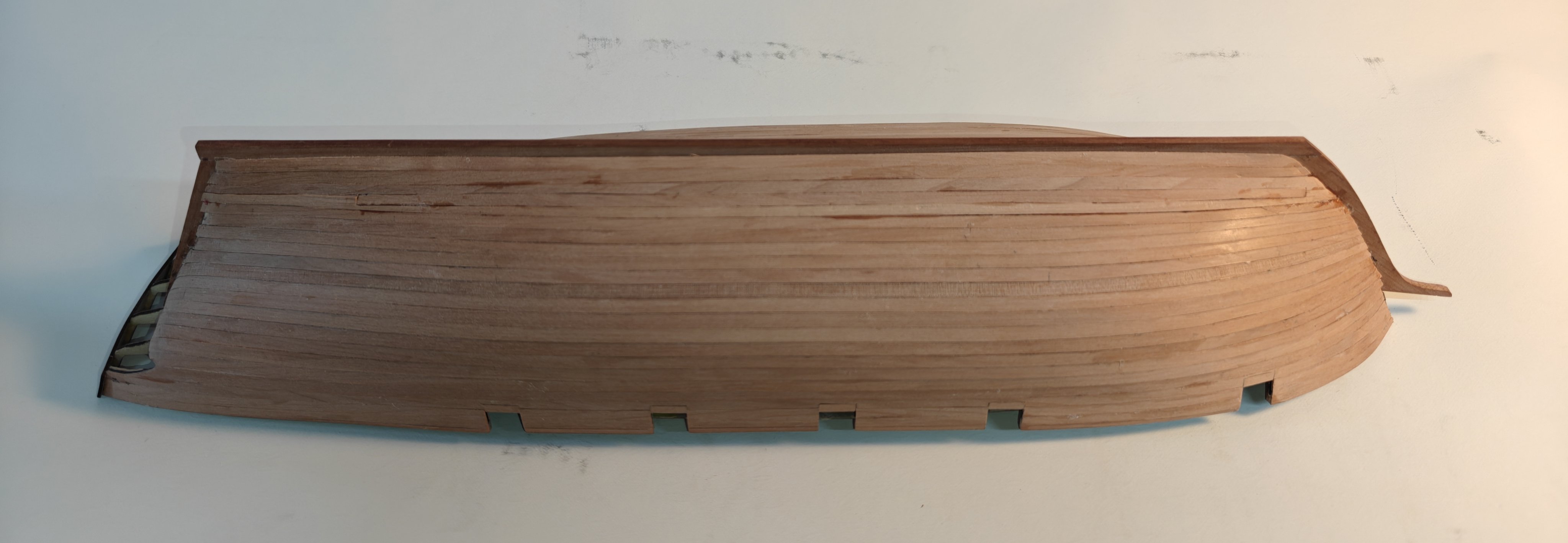

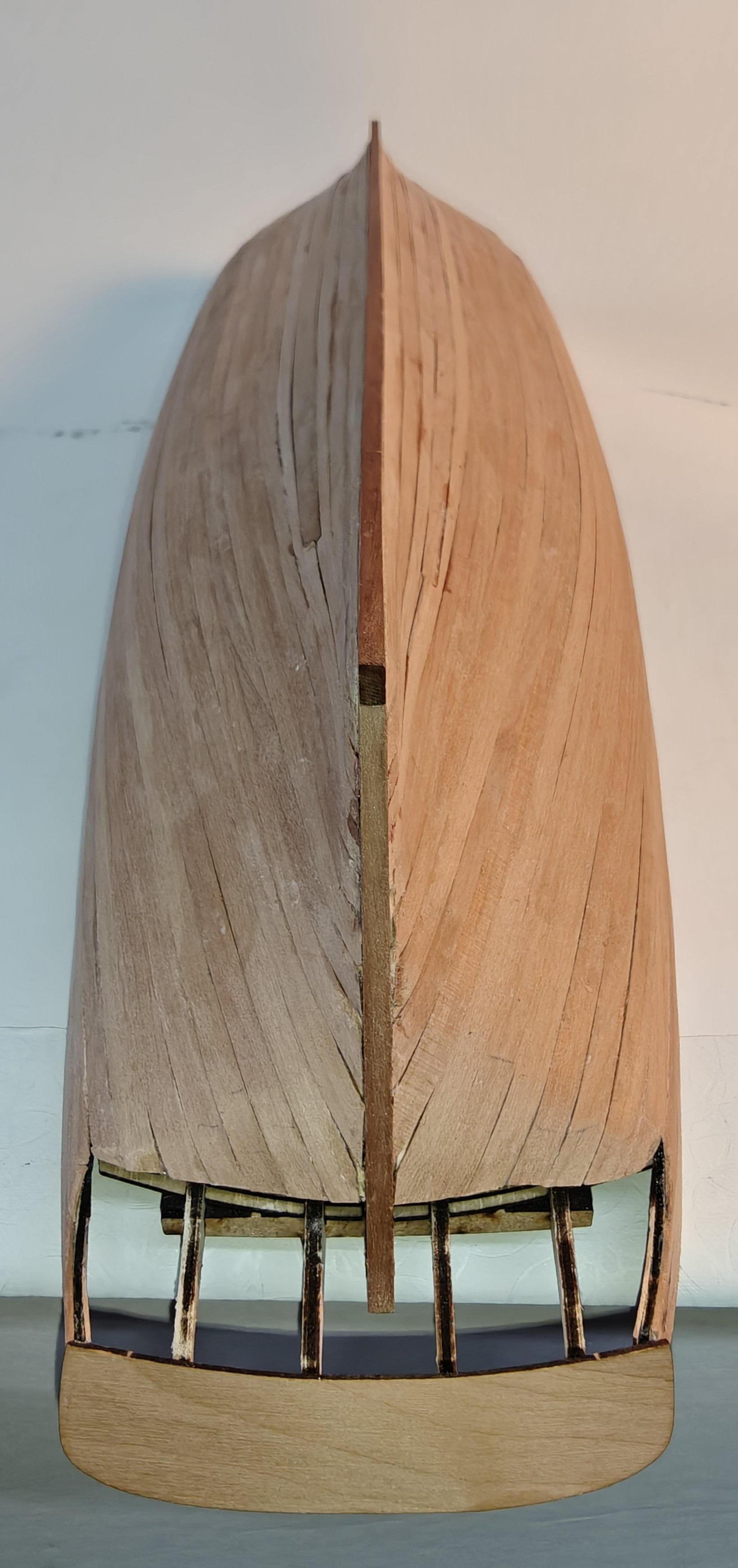

Log entry 6 - sanding, keel and start of second planking

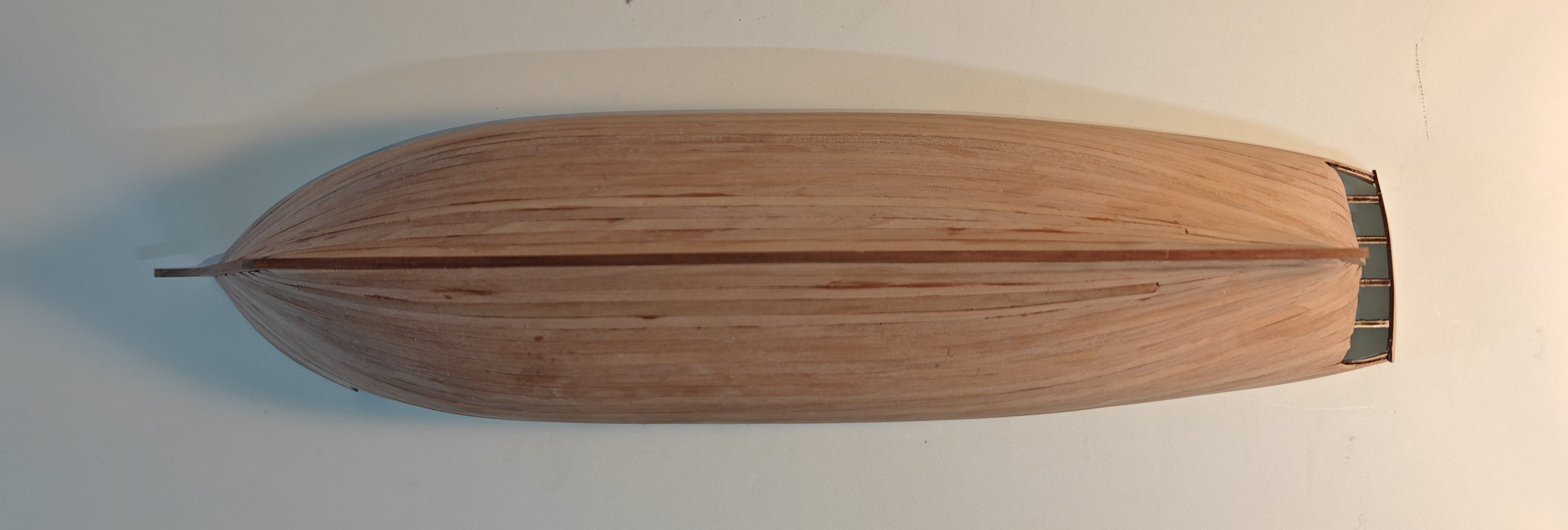

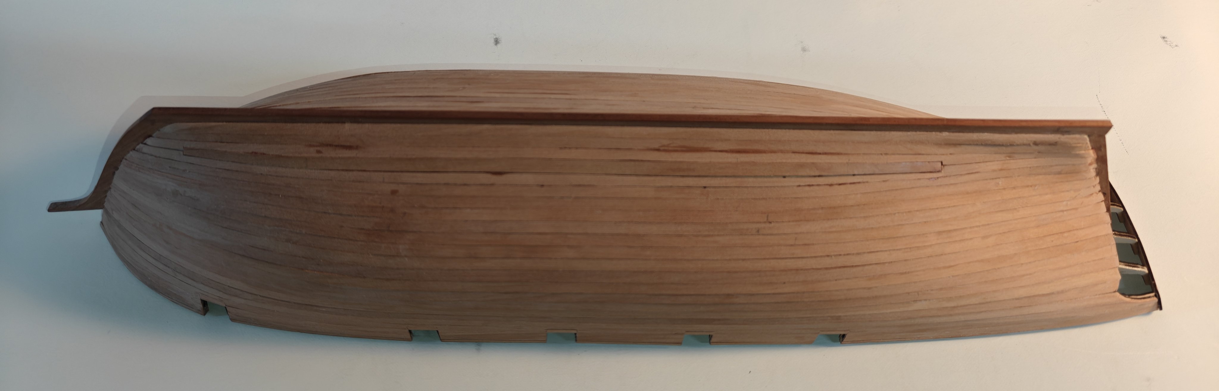

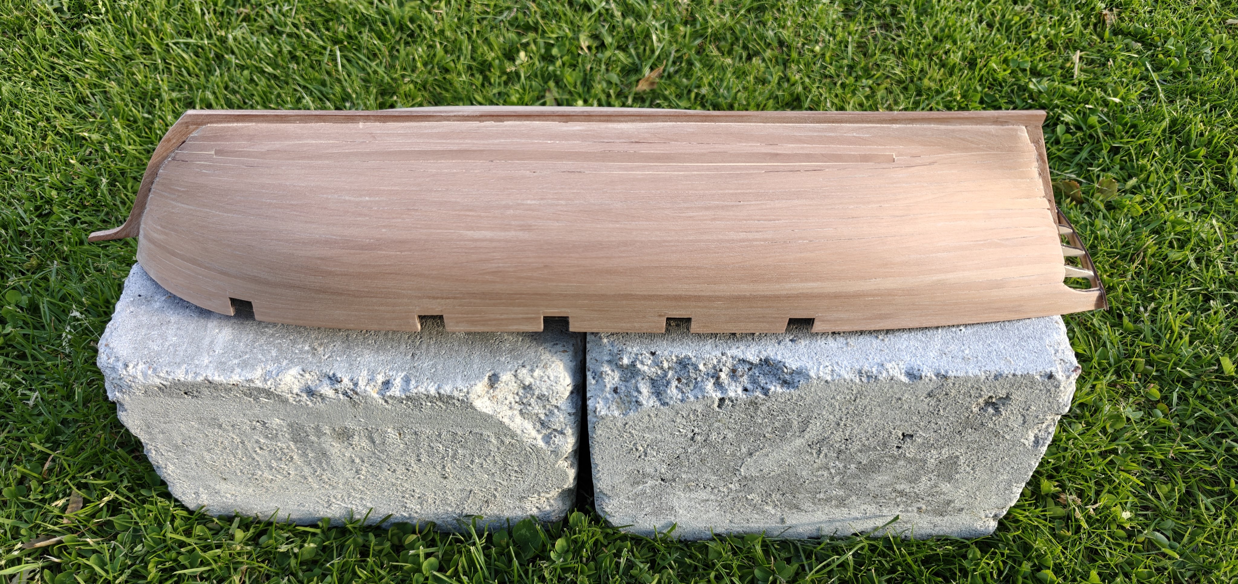

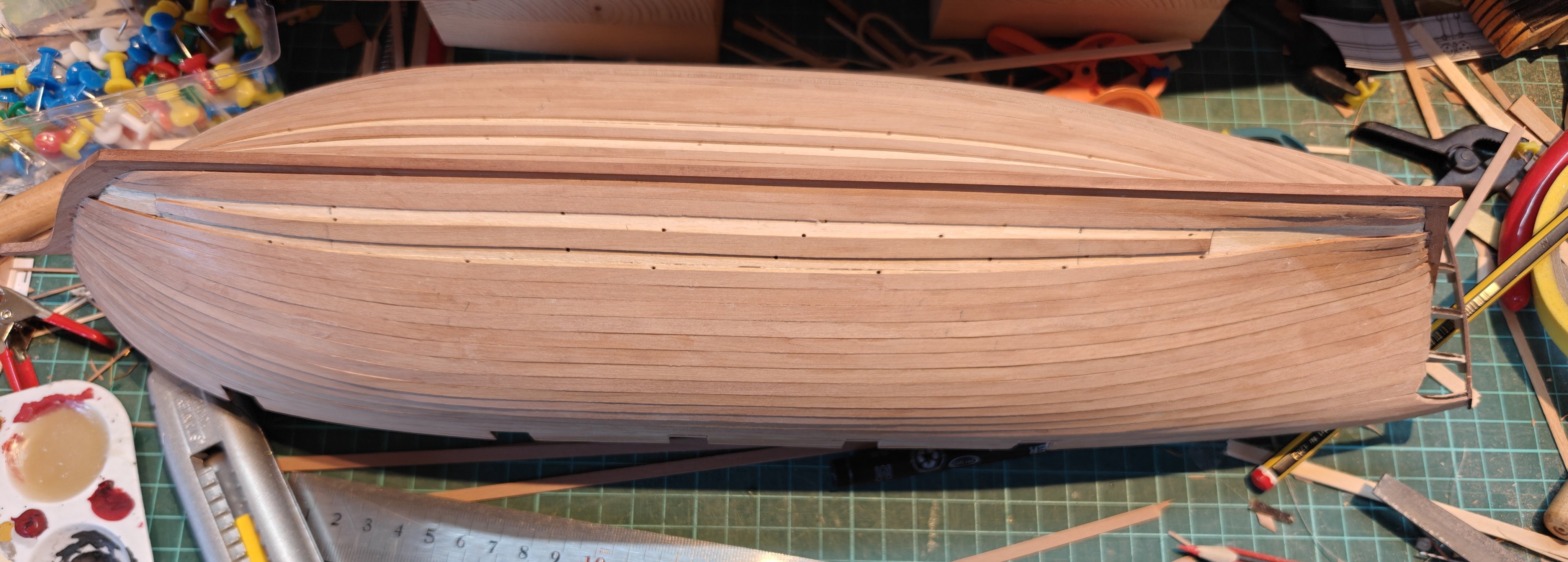

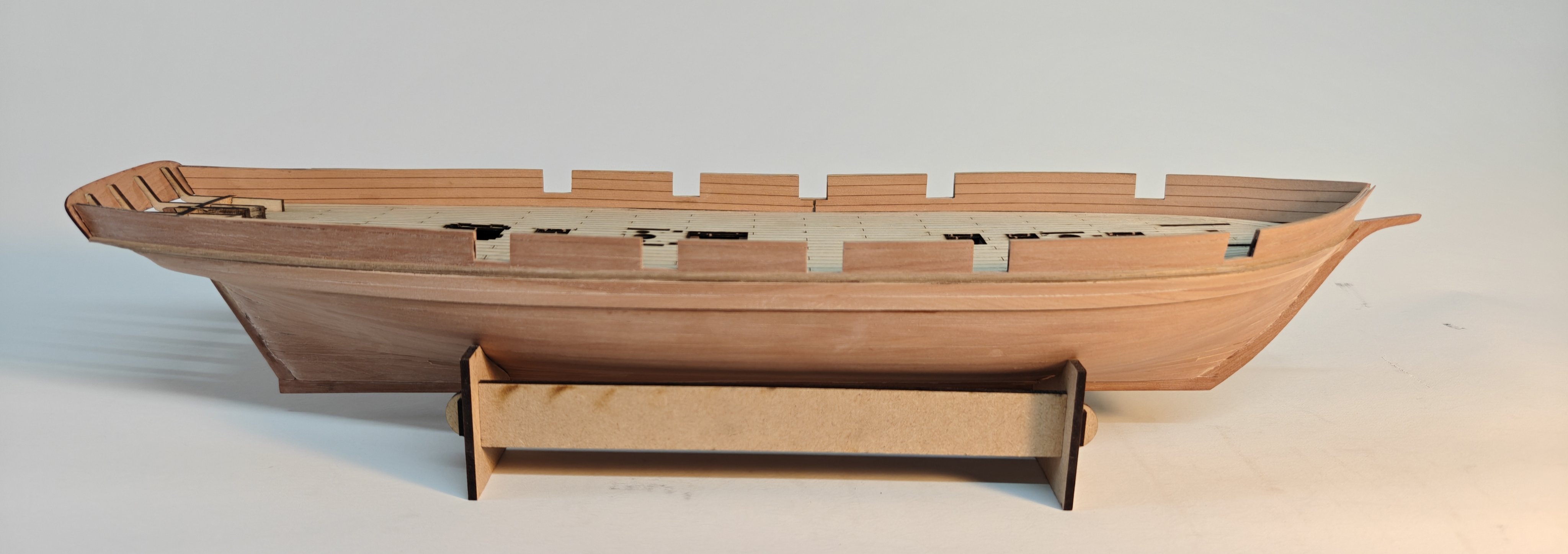

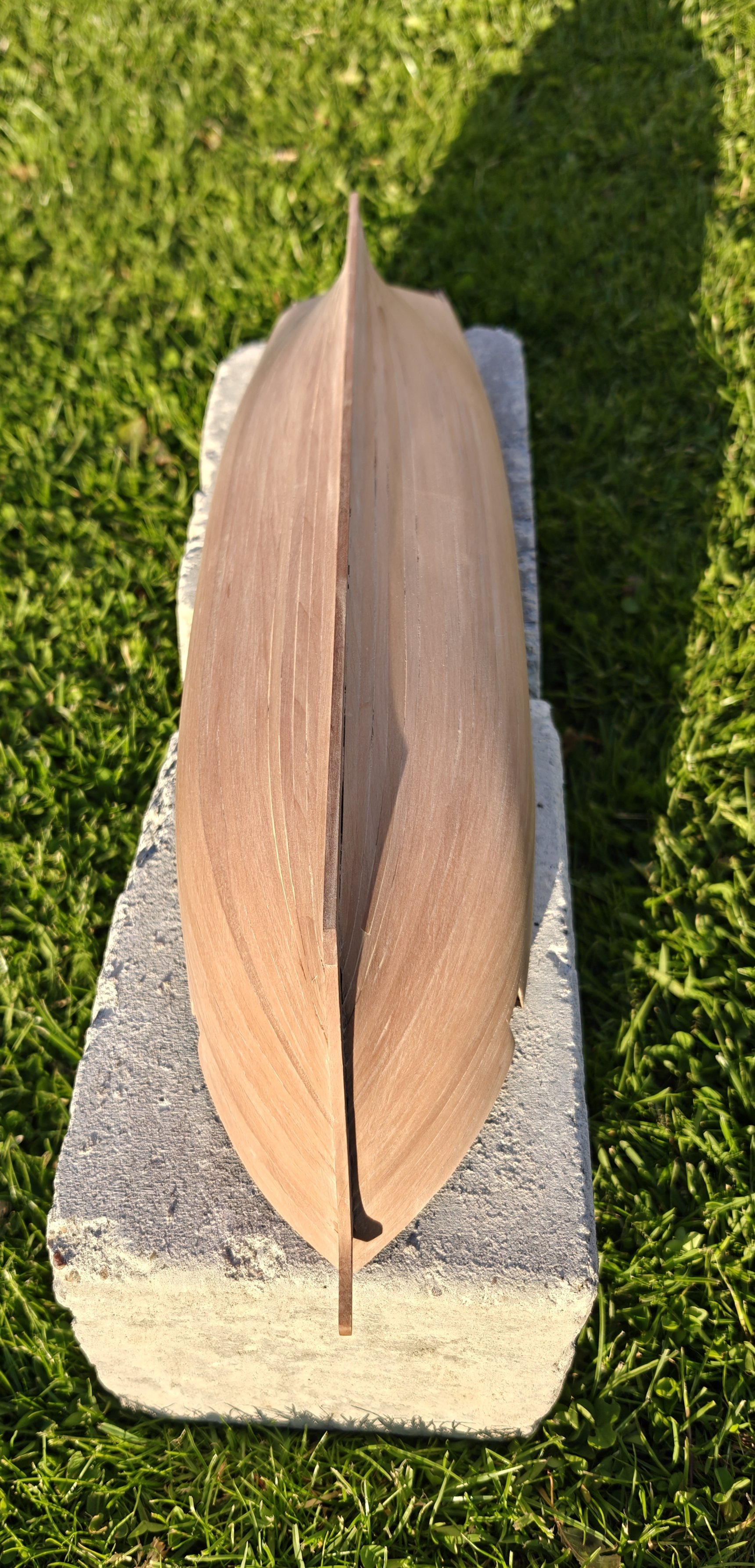

Sanding the hull went quickly and there were no weird areas that needed filler, which I was happy about, especially as I designed the frames myself.
There are a few hairline cracks between a few of the planks, but nothing that will be an issue when adding the second layer I deem.
Here is the state after sanding and gluing in the keel:

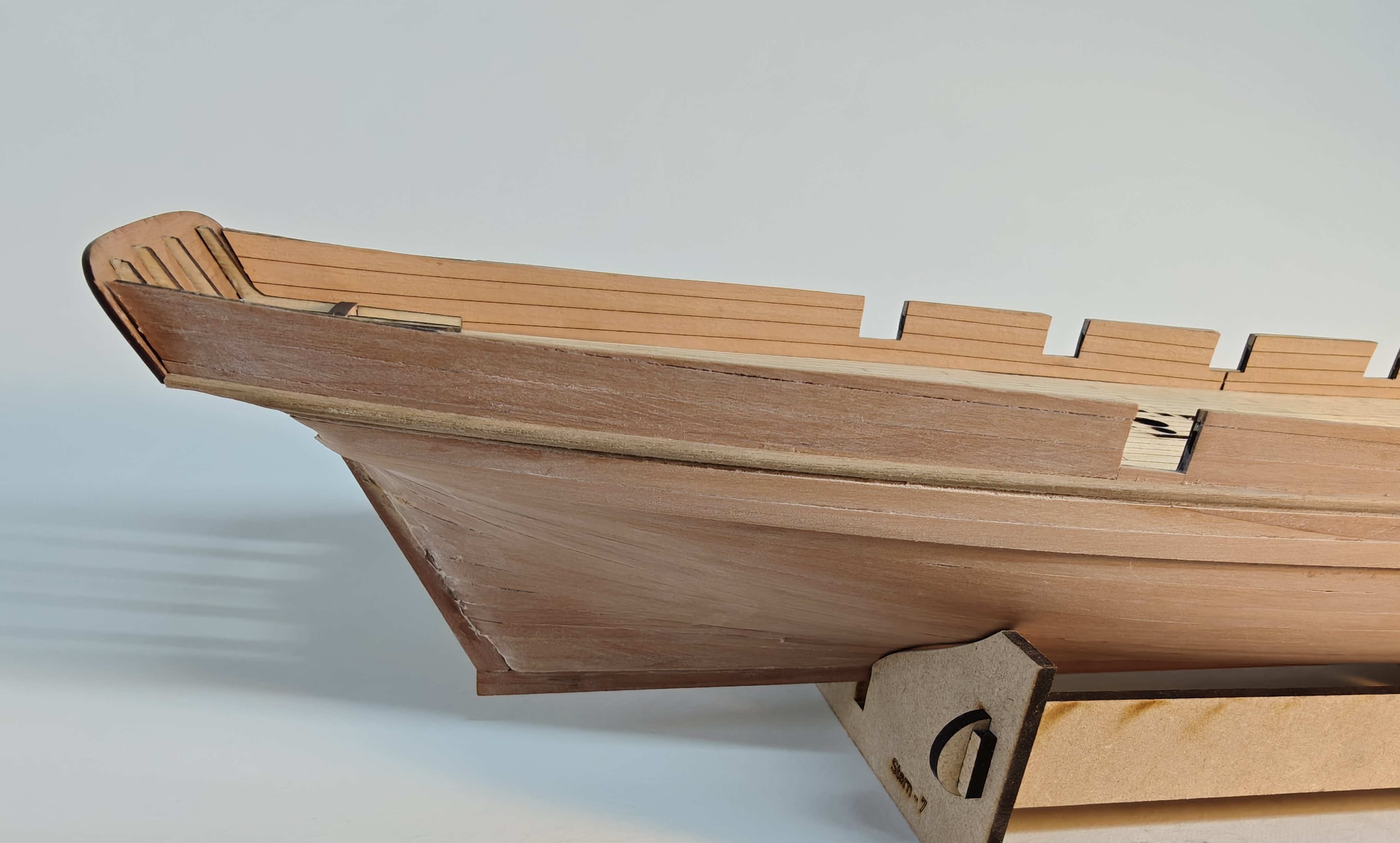

I went on and added the three first planks of the second layer and removed the upper parts of the bulkheads and the temporary braces.
I also tested the fit of the engraved deck, but as expected it needs a bit of tailoring both at the stern and the prow. I guess it was very optimistic to cut this to begin with with everything being modelled only in 2D CAD!
However, these images still give a good impression of what it will look like when a slightly better fitting version is added (which won't be until the second planking is completed).
I just need to redesign the deck - making the engraving fit will be a bit tedious, but a few hours should see it done and cut. I can do it while I re-print my canon in the correct size... 🤣.
The worst will be that I will need to re-design and re-cut the 2 mm pear edge and due to the shape it takes a whole 500x80 mm sheet so that was a bit of a waste. Anyways, that will teach me to be over confident and cut everything from the start just to have it all like a kit... 😅
On with the planking!

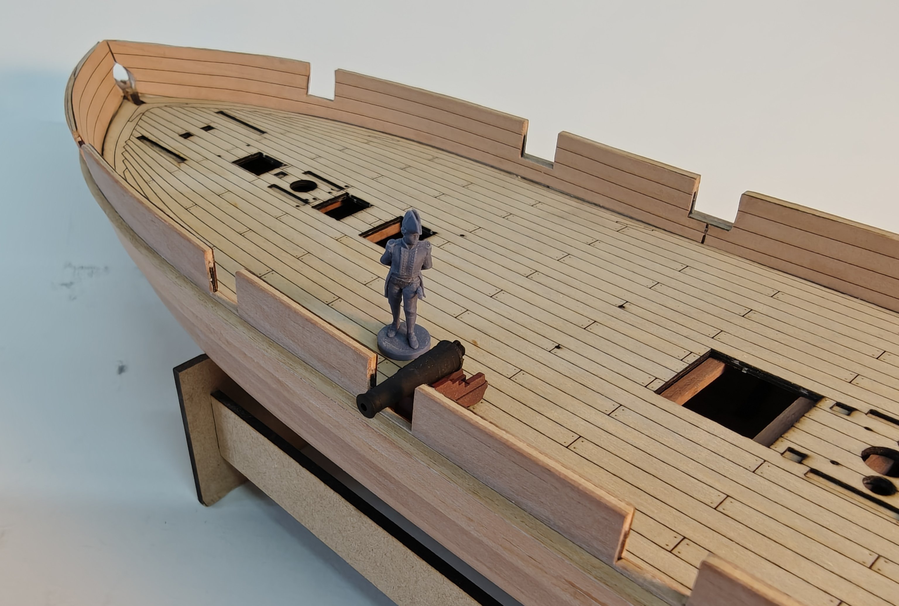

Log entry 7 - modified deck, re-printing cannon, fixing mistakes and inner bulwarks
This turned into a long post - quite a few things have happened in the past few days.
New engraved deck
As mentioned in the previous post, I needed a new deck with a better fit. I decided to keep the engraving and only change the outer shape to fit. This is because I actually drew the deck planking based on the original plans, so changing the engraving would be moving away from the historical sources. I took the advice I received a few posts back and made the nail engravings less deep - I like the new look. Here it is compared to the first version:
Cannon in the right size
I scaled down my 18 pdrs to 12 pdrs and re-printed them.
Here they are curing:
And here's a comparison to the 18 pdrs:
Even though they are only 13% smaller, they look significantly smaller side by side.
Problems...
This is where the trouble began. I naturally put the cannons on the deck and quickly realized I had an issue: the barrels were not at all in the middle of the gun ports.
I did a bunch of measurements on the model, on my CAD designs and on the original plans and I cane to the conclusion that two things had happened; I had used the wrong thickness of the two layer deck and therefore had the deck a bit too high, by about 0.8 mm and when applying the plywood bulwark patterns, the fit was good at the ends, but due to the curvature of the hull and less than perfect taper of the parts, they were sitting to low at the middle of the hull, by about 1.2-1.5 mm. A total of 2.0-2.2 mm.
A quick decision was made to build up the bulwarks to make up for the difference. This will only be adding the 0.8 mm that the deck sits too high at the middle, the rest is just compensating for the bad fit of the plywood bulwark.
It is not so pretty right now, but that fortunately does not matter, as the wales will entirely cover the repairs - it sits right under the gun ports.
Inner bulwark patterns
But as I now had the repair sitting on top of the bulwark, I decided to add the inner bulwarks to strengthen them, and therefore I needed to glue in the deck first!
I made a paper template on the model, scanned it (with a ruler...), drew it in CAD and laser cut it - it was quick work and only took around an hour total.
I made it in two parts to not waste the 0.5 mm material.
Here the last part being glue in with almost enough clamps...
And this is now the state of things:
I like the small, fat cannons and the carriages with no visible wheels (they do have two small wheels on the inside at the front).
Now, I can continue with the planking. I will protect the engraved deck with a cardboard cover while I work on the outside of the hull.

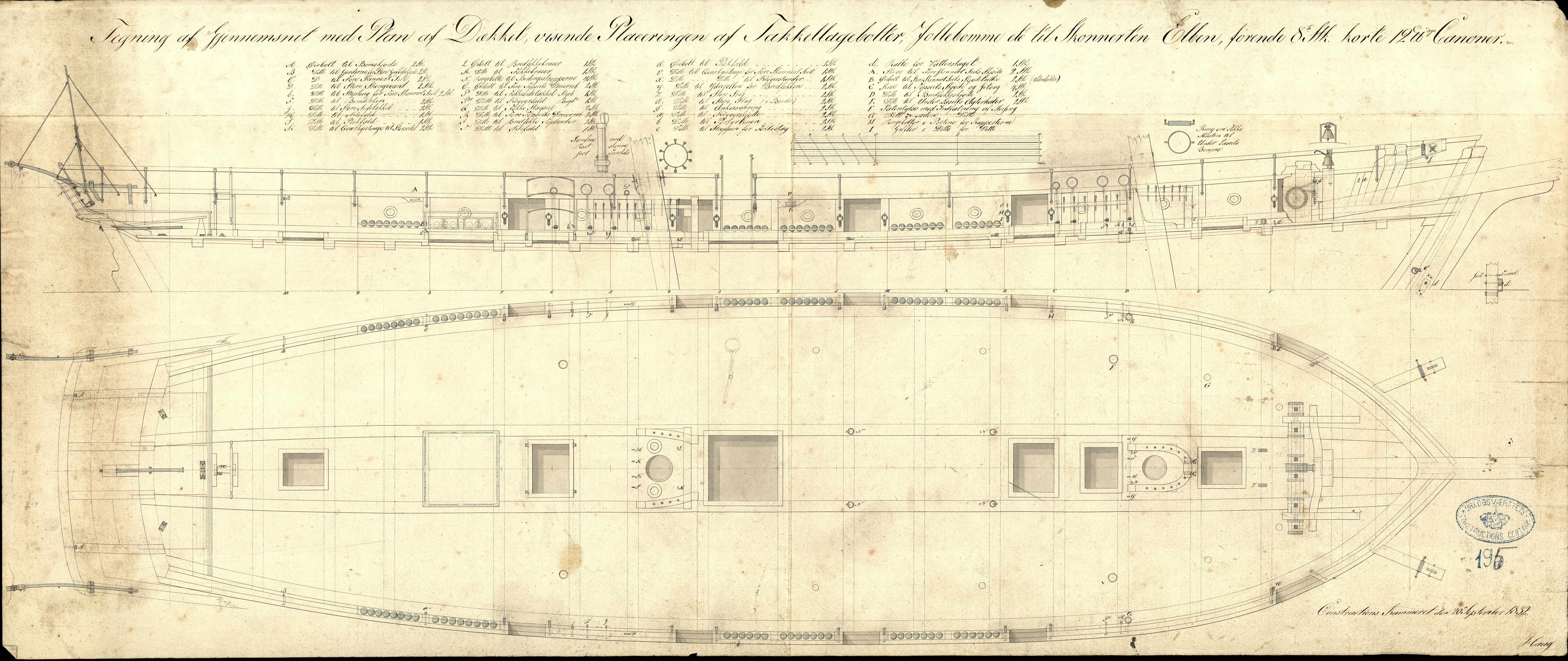

One detail puzzles me a bit, that the timbers that carry the transom are sitting on the deck. That seems to be a somewhat unusual arrangement. Normally, deck planking goes around any structural parts.
Ah, those will be covered by a raised deck right in front of the wheel. It will hide the rudder cables etc.
You can see the construction on these plans:
Screenshot_2025-04-07-06-32-54-58_965bbf4d18d205f782c6b8409c5773a4.thumb.jpg.d9e082a2961be5cd6b53ccf9fa3e9c24.jpg
Screenshot_2025-04-07-06-33-50-95_965bbf4d18d205f782c6b8409c5773a4.thumb.jpg.9733affb8f8aa06b80bced2d56e63b86.jpg
I just haven't gotten around to making that part yet 😁.
So those exposed mdf pieces are there for a structural purpose on my build and does not reflect how the original would have been made!

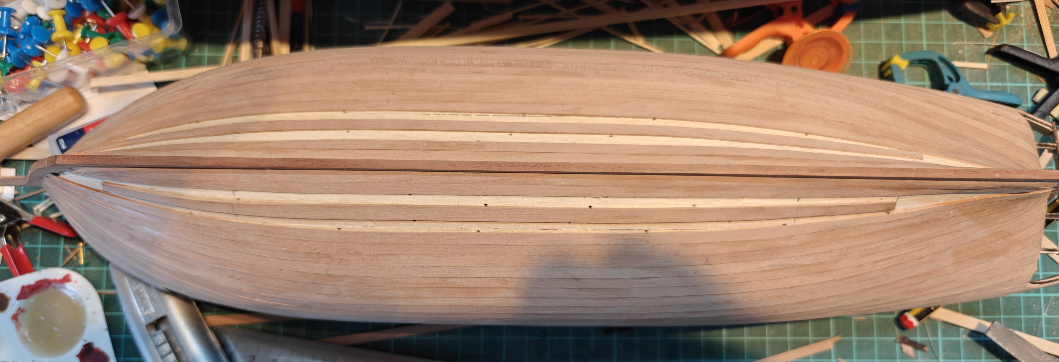

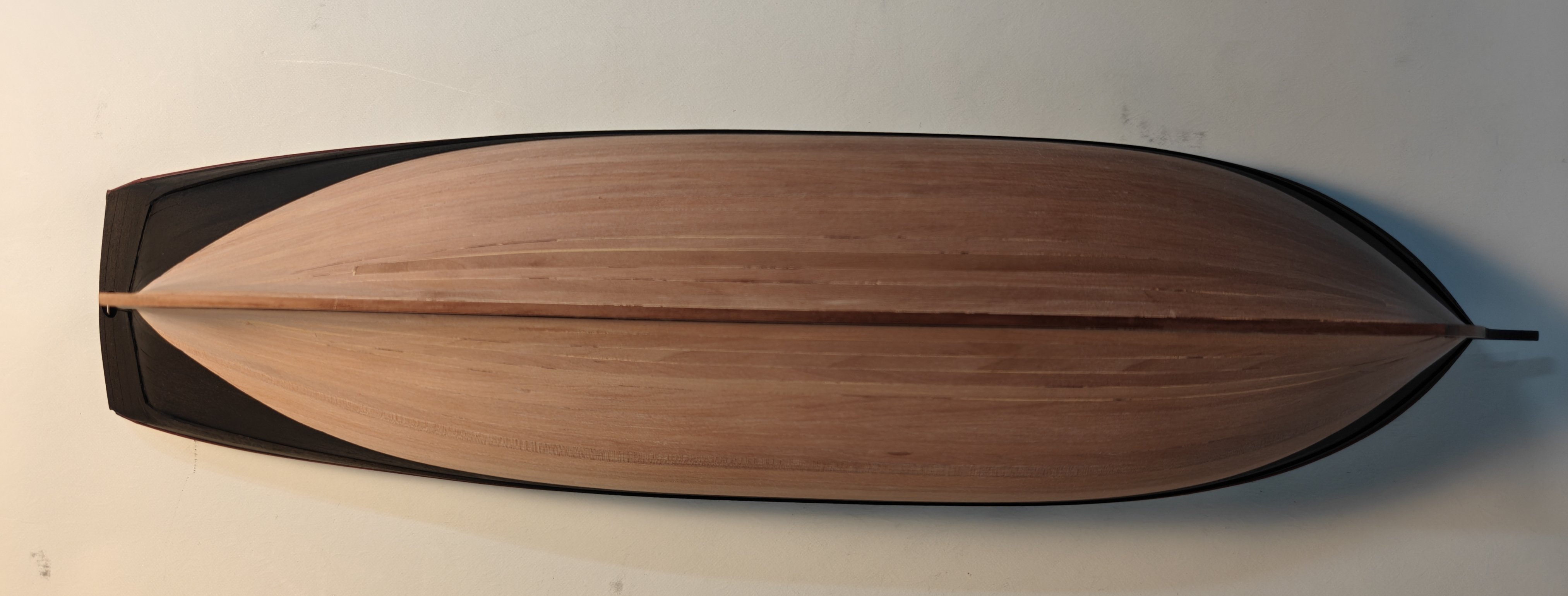

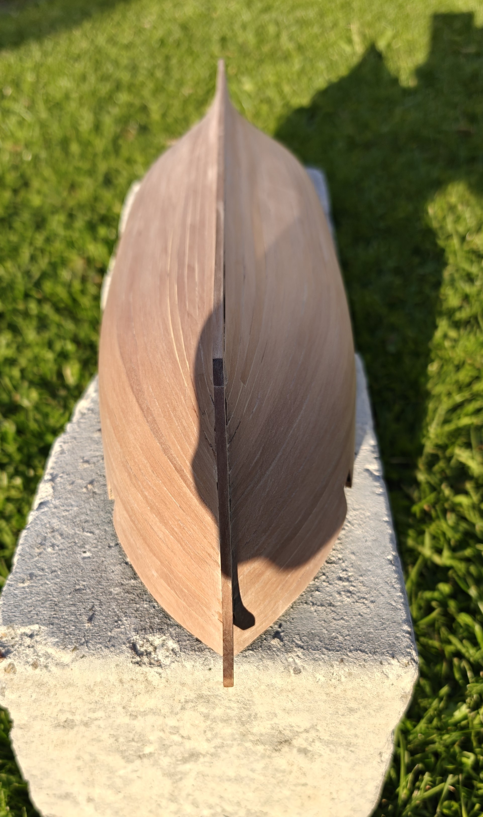

Log entry 8 - second planking completed!
It has been a while, but I finally have some solid progress to show.
I have completed the second planking, and it has turned out fine, in my opinion. Not at all perfect, but good enough.
Here are some images before the very last planks were added:
And here it is completed, but before sanding:
And then after initial sanding:
I am happy with the hull shape, but I need a bit of filler at the stern.
The hull is nice and smooth, but as mentioned, it is not visually perfect - that is ok, as it will be entirely covered by paint and copper plates.

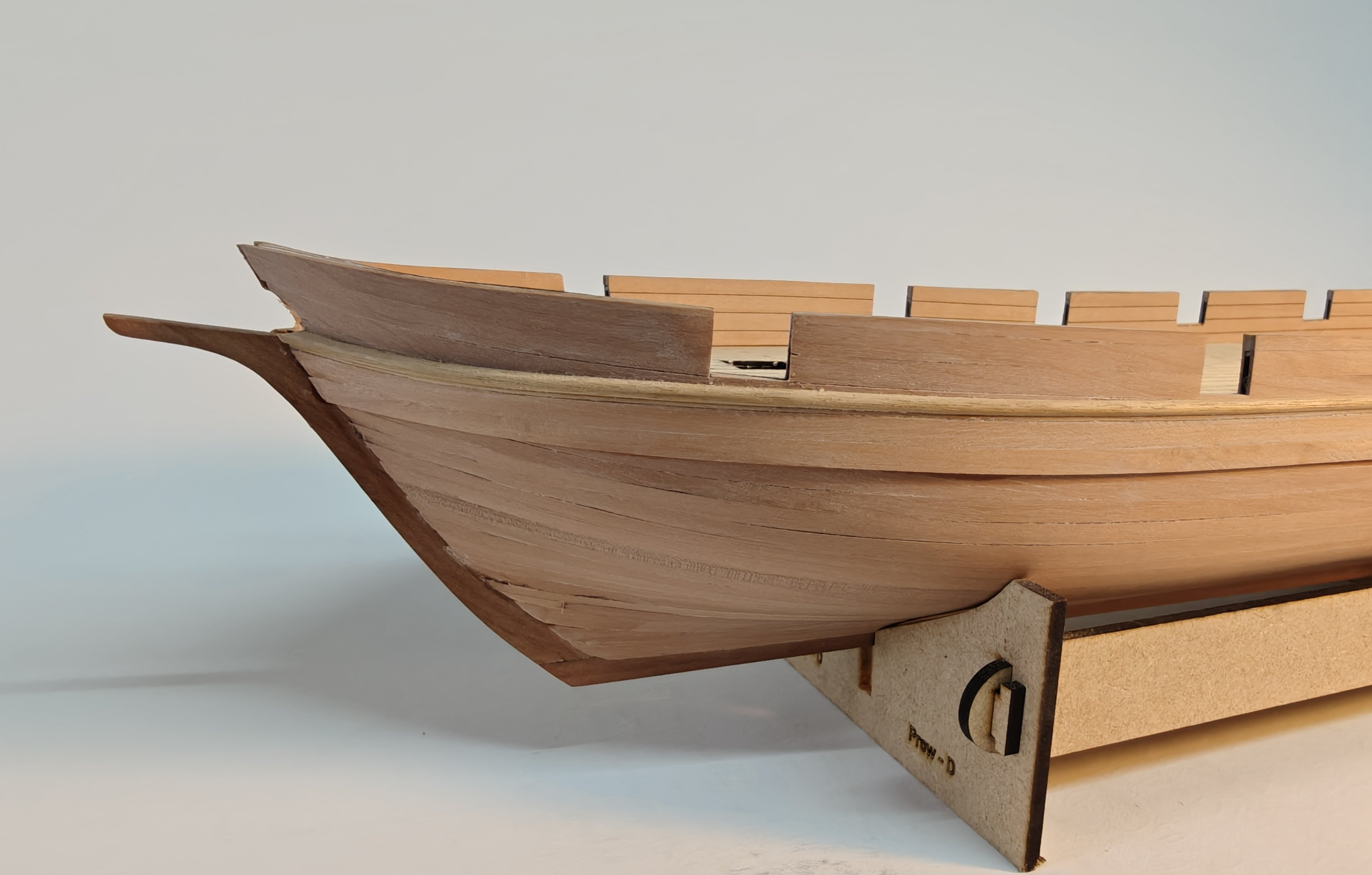

The next step is to add a molding that sits just below the gun port lower edges and the whale in connection to that. In total, it will be 11 mm wide, including the molding.
More to come soon, I hope!

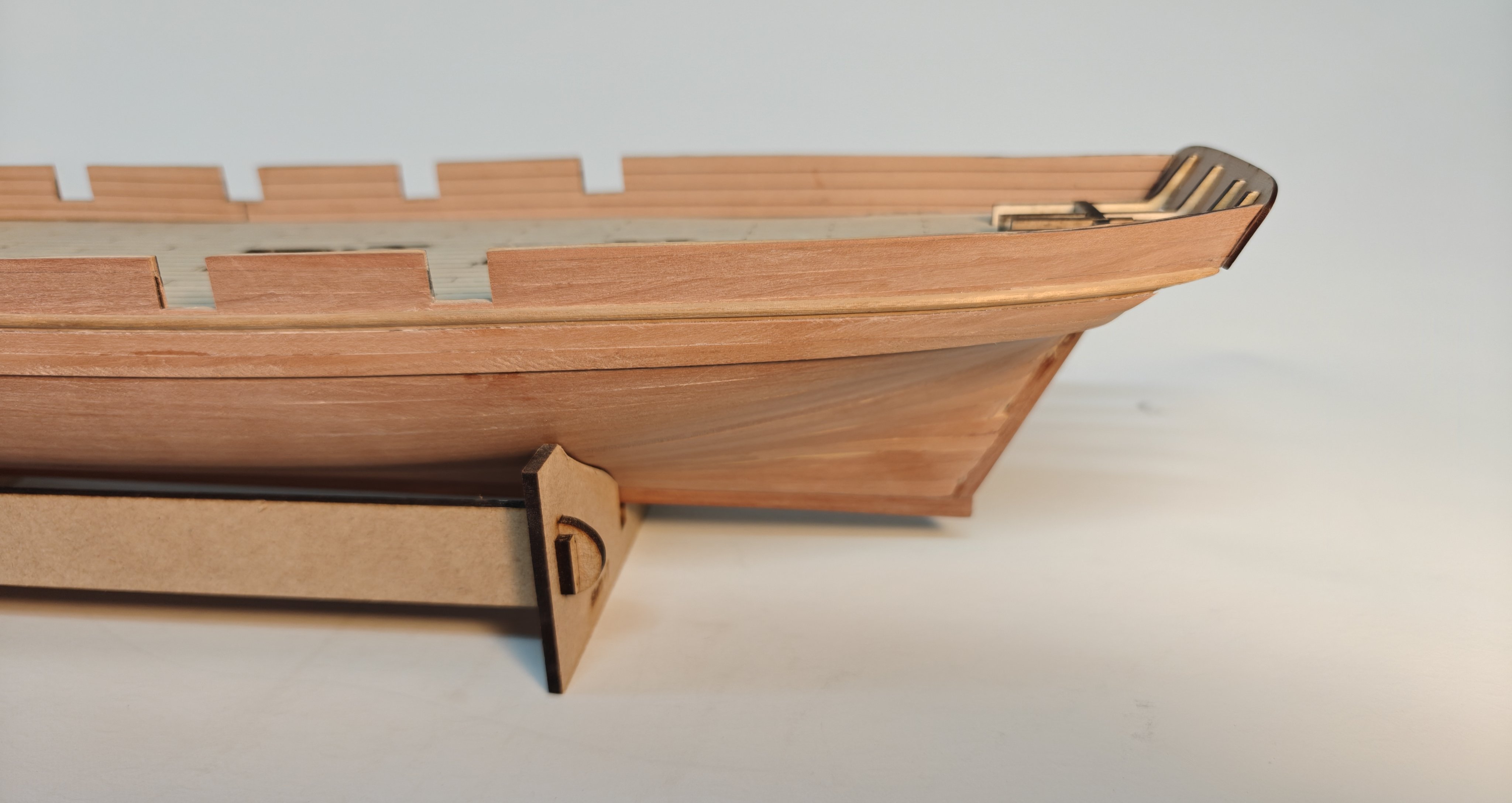

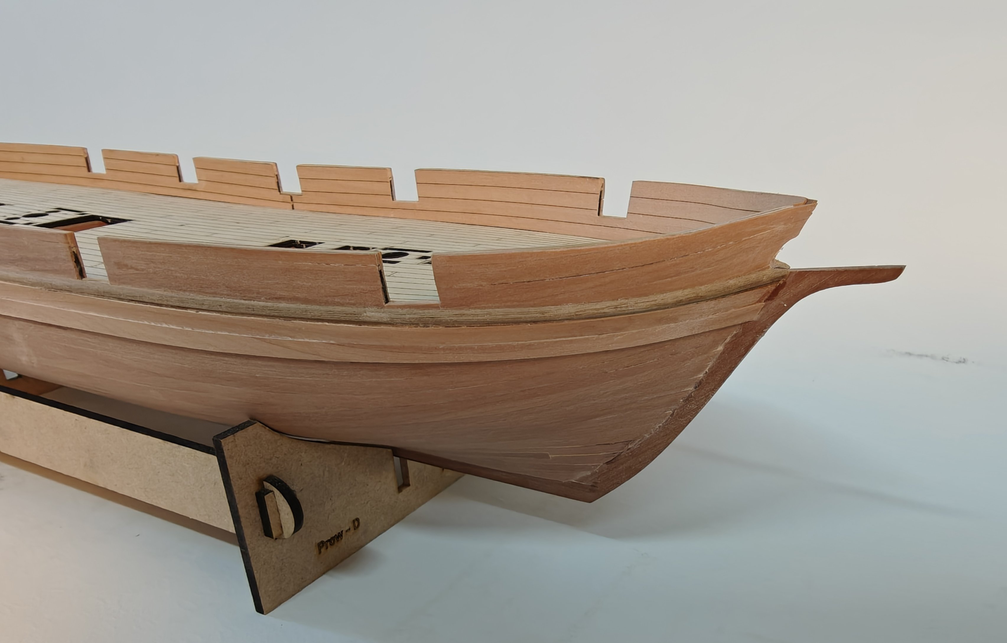

Log entry 9 - whales
I have now installed the molding and the wales:
The molding is from Amati and in walnut, hence the different colour of the wood compared to the pear planking. The moulding is a tad oversized compared to the drawing, but I still think it is preferable to a simple thinner strip.
Everything will soon be painted: white for inner bulwarks and outer bulwarks above the whales, black below. The molding itself will be red, as will the inside of the gunport lids.
This painting will happen after I add vertical strips on the inner bulwarks as per the drawings:data-2024-12-11T175605_189.thumb.jpeg.63056391b38351bb790b74349fda0a69.jpeg

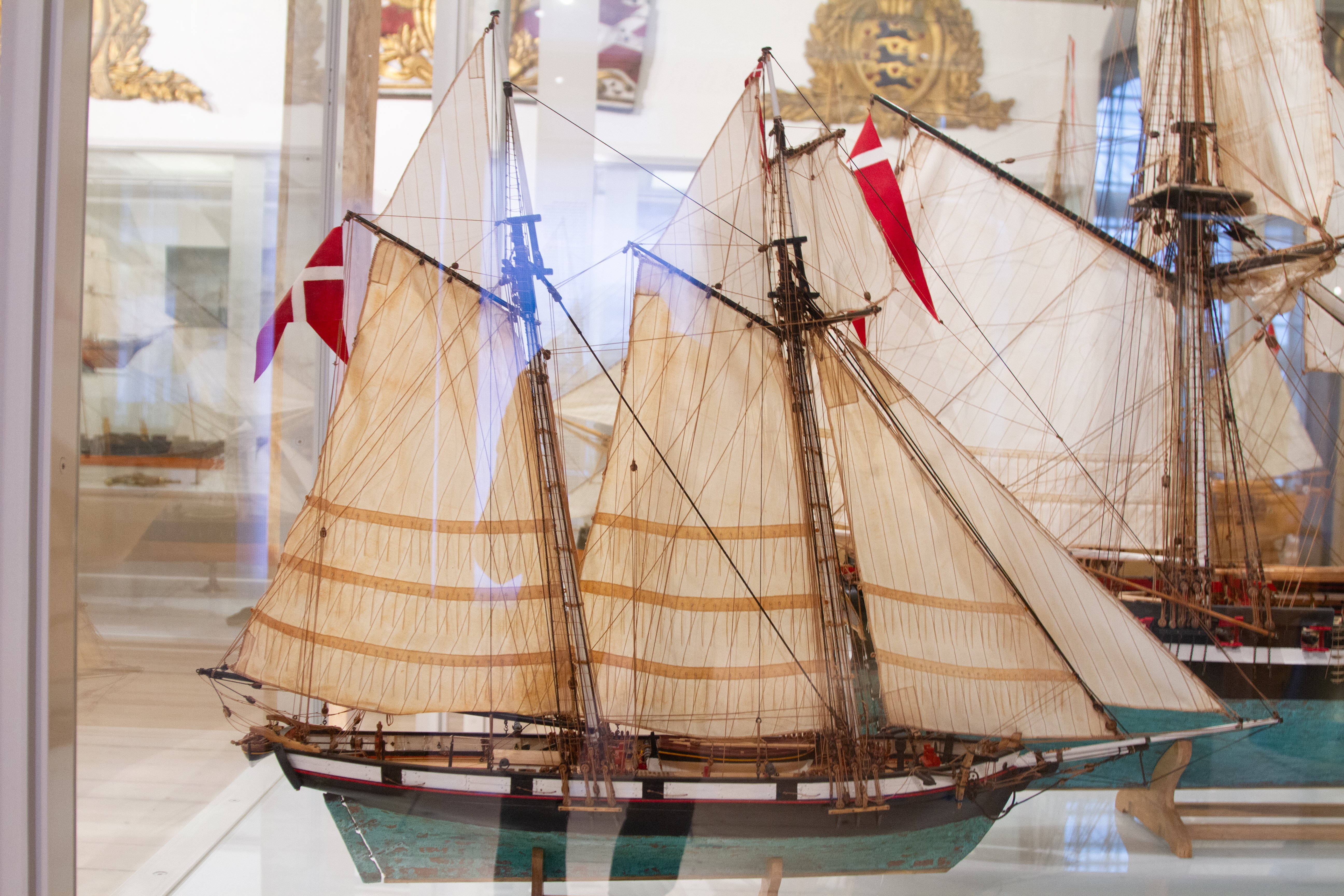

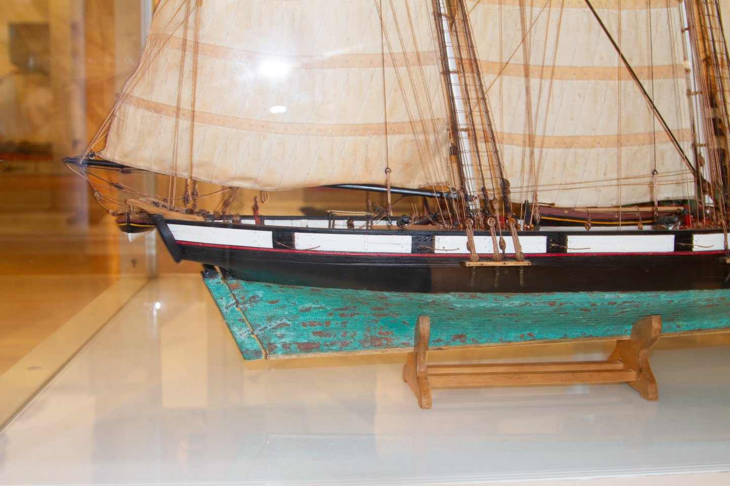

By the way, do you know this painting of Lüder Arenholt? Elben is the Schoner on the left side.die-schleswig-holsteinische-flottille-um-1850-gemalde-von-luder-arenhold-um-ca6bb6-1024.jpg.26569c9f50e037910ba5c8cfc8d2e187.jpg
This picture from Wikipedia you might know as well:
and there must be this model somewhere in Denmark.
These pictures by Julius Prömmel are interesting as well.
Unbekannt-ImperialFleetFlotilleSchleswig-Holstein-(MeisterDrucke-608014).jpg.ddc446750d4f89b877d55484a548aa40.jpg
Elben in the center of the painting.
Matthias
Edited by Beckmann

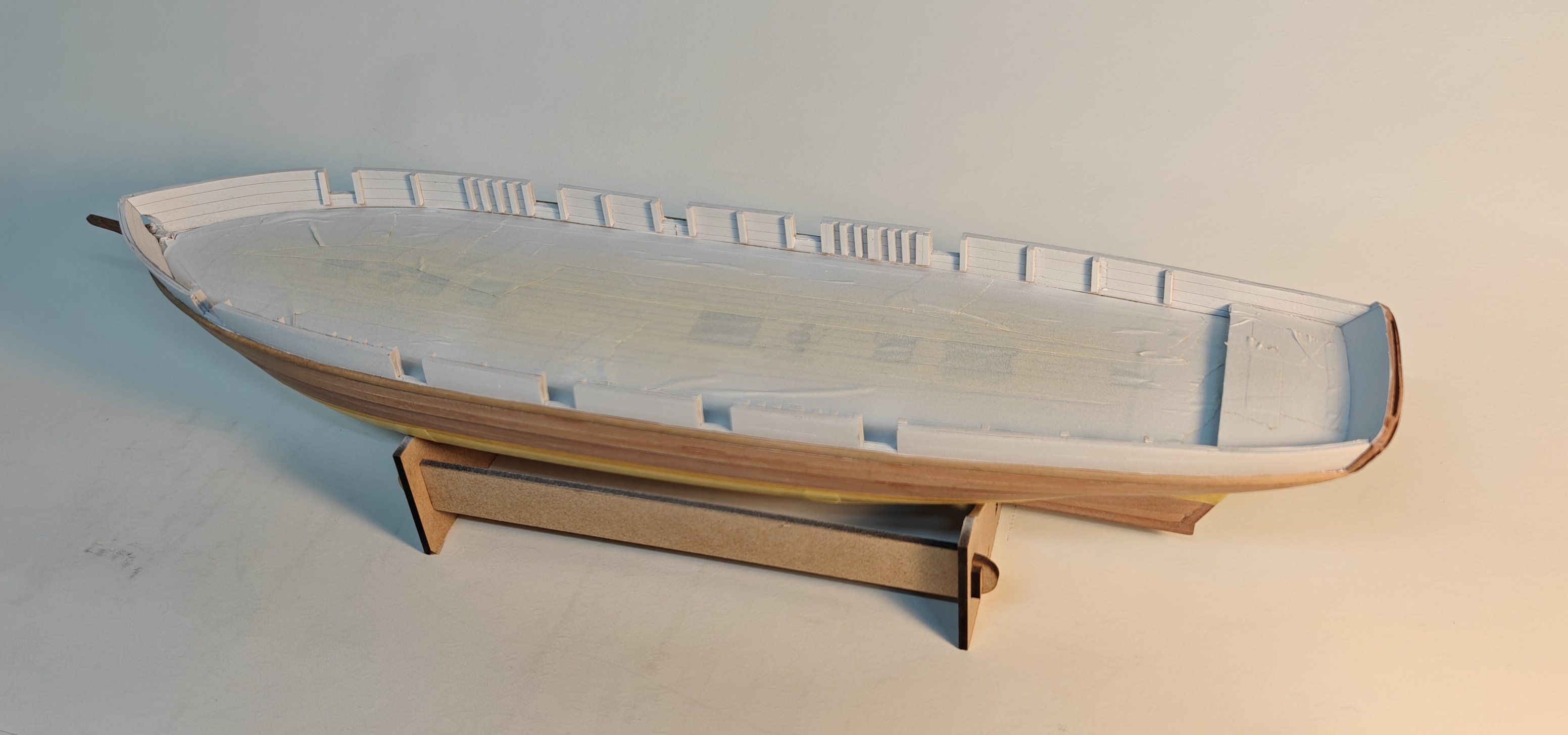

Log entry 10 - inner bulwarks pt. 2

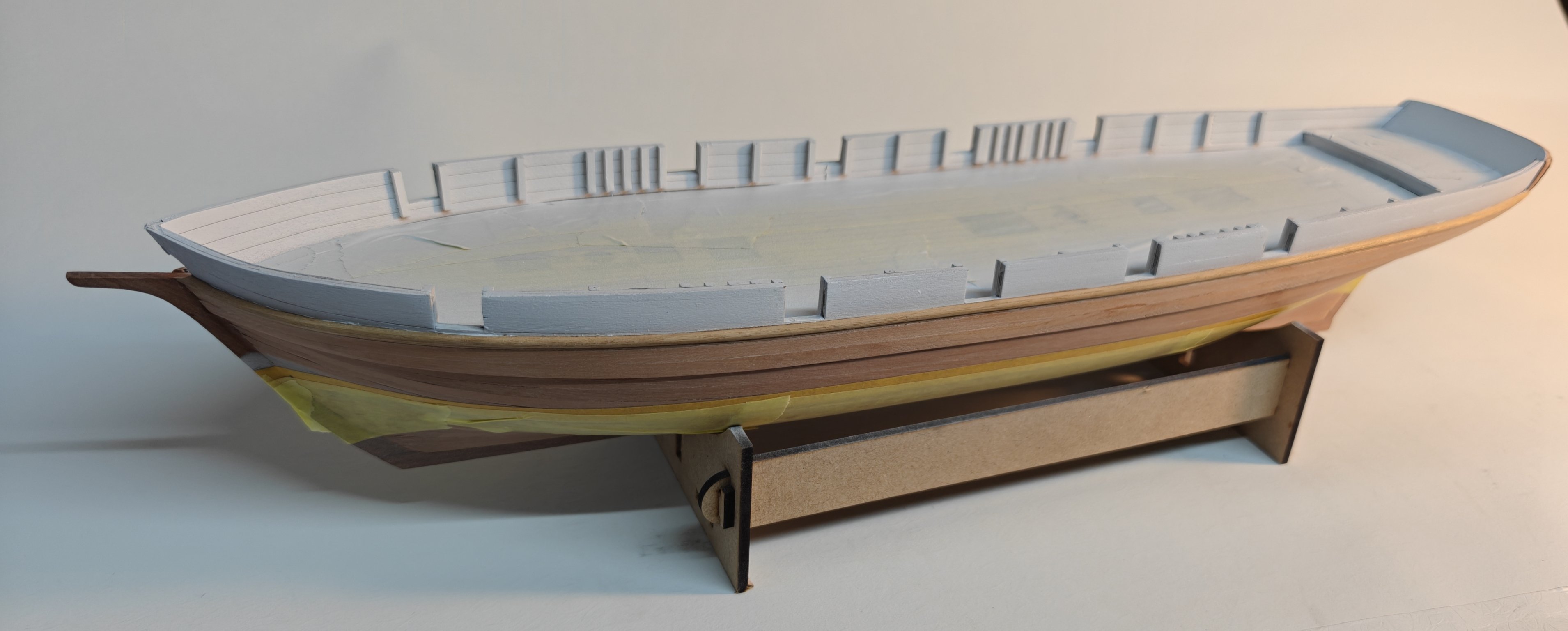

Returning now to give a bit of attention to the inner bulwarks. I have added all the vertical bulwark elements (is there a technical term?). They are simply made from 2x2 mm boxwood - I would have preferred pear to keep it consistent, but boxwood is what I had. And it really doesn't matter, as everything will be painted white anyway!
They are raised 2 mm above the deck to make space for the edge that will be installed after painting. I have also taken care with the spacing, which is a little inconsistent in the plans. I have used the shot garlands as templates to get the correct distances where I could.
At the stern you can also see a cardboard template for the raised deck section.
Now I will mark the waterline, mask everything off and get busy with the airbrush! After that, coppering will begin and I am both looking forward to that, and dreading it!

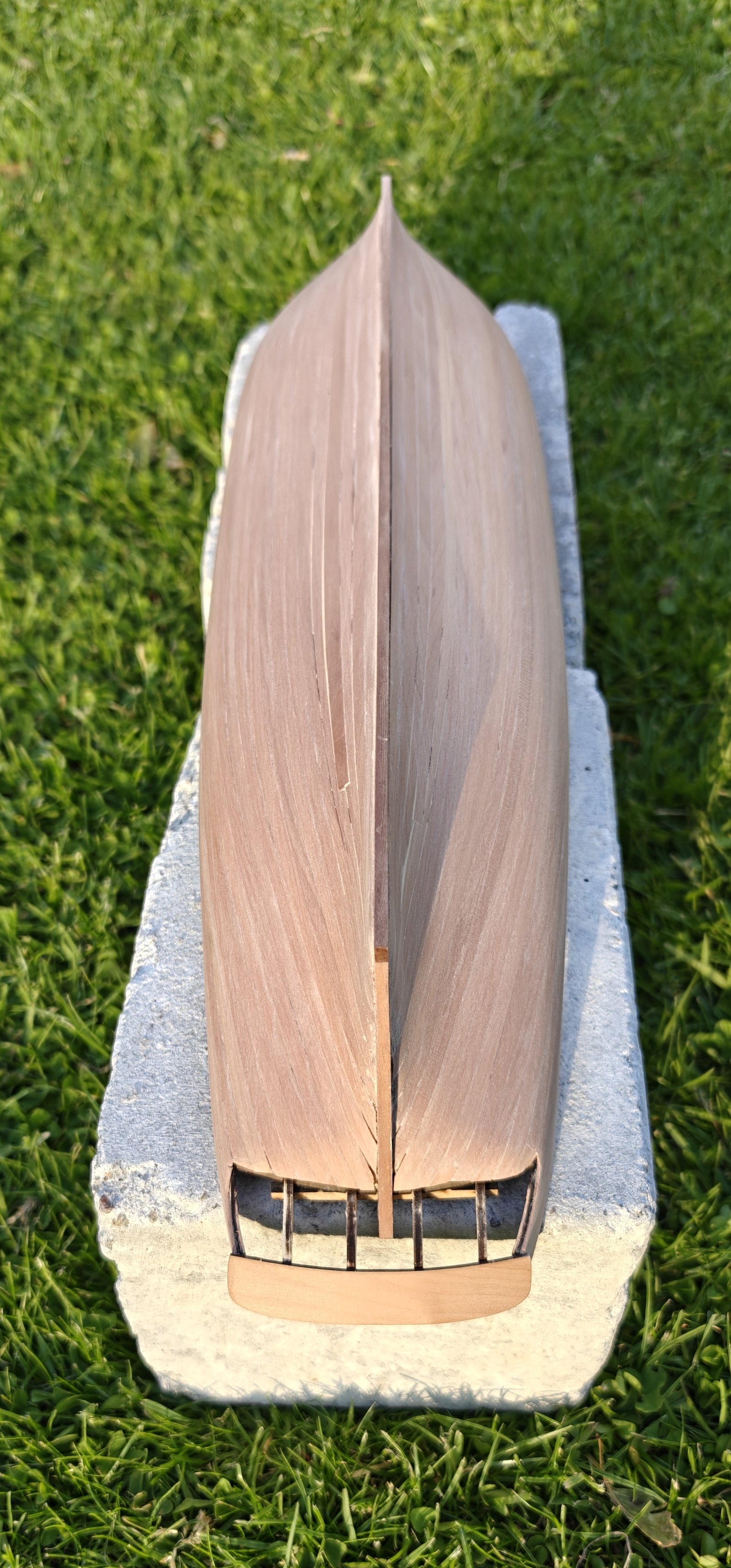

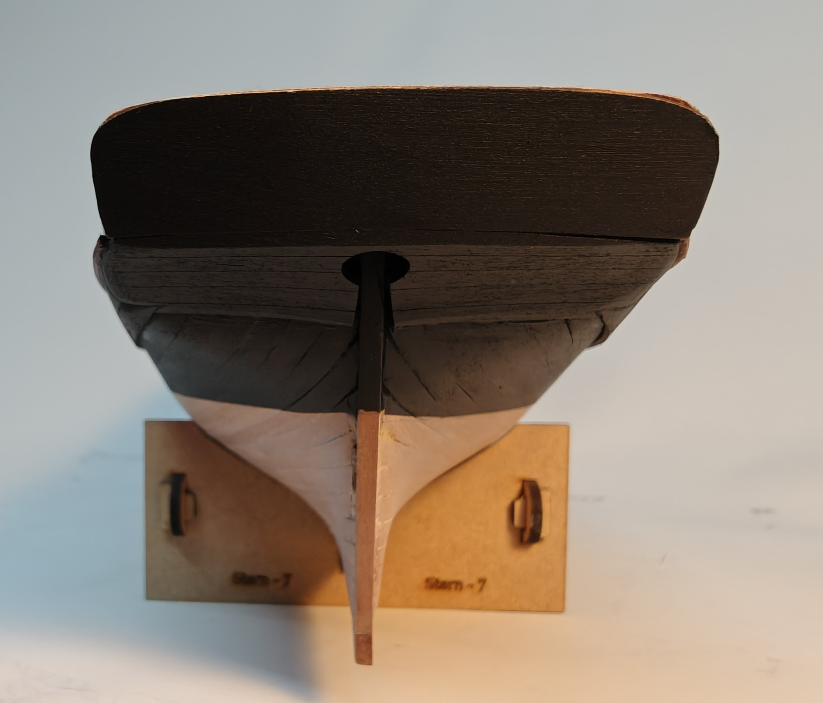

Log entry 11 - stern and raised deck
I had forgotten that I had to finish the lower stern before I can move on to painting!
So I have been working on that, cutting out paper templates, scanning, drawing in CAD, laser cutting and attaching. This is the result:
I had to use a bit of filler, but I think I need to get another kind. This one is a bit grainy and I won't sand as smooth as the surrounding wood. I think it won't be hodden enough under paint. So I will look for something smoother to use on top.
Before painting, I also need the raised deck st the stern installed, as the little vertical piece need to be white like the inner bulwarks.
I have drawn and cut the railing as well, as that is nicer to do map out on the unpainted hull. In these images, it is just loosely attached with a few pins, but it gives a good idea of the future appearance of the ship.
As you can see, they double as channels for the shroud rigging - an interesting arrangement and not one I have seen replicated in the few other models I have seen of these small Danish schooners (see examples a few posts back by me and Beckmann). But it is quite clear from the original plans.

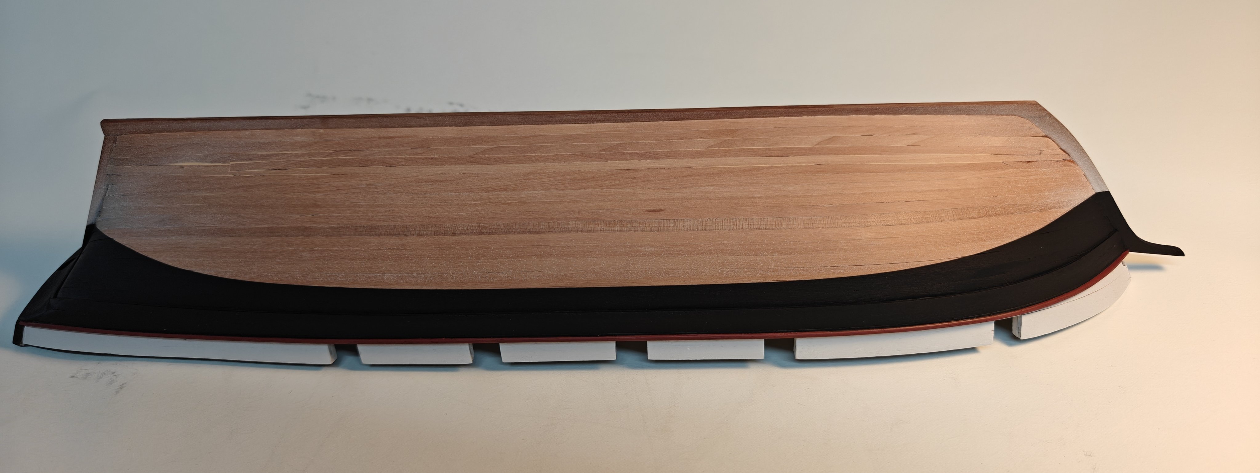

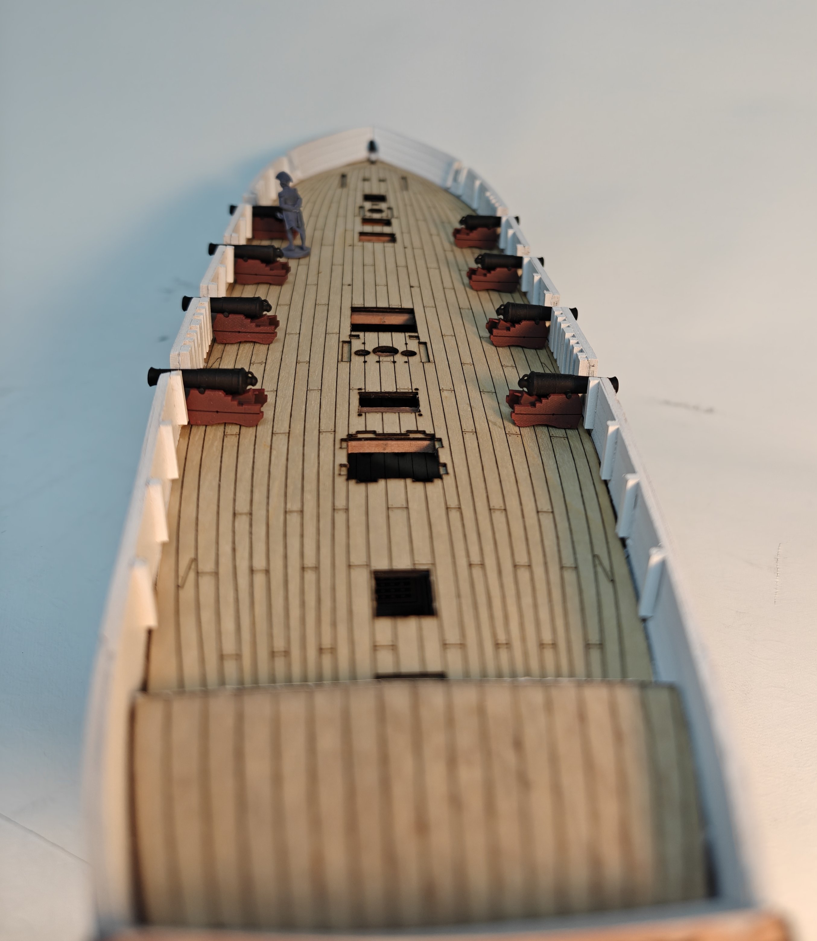

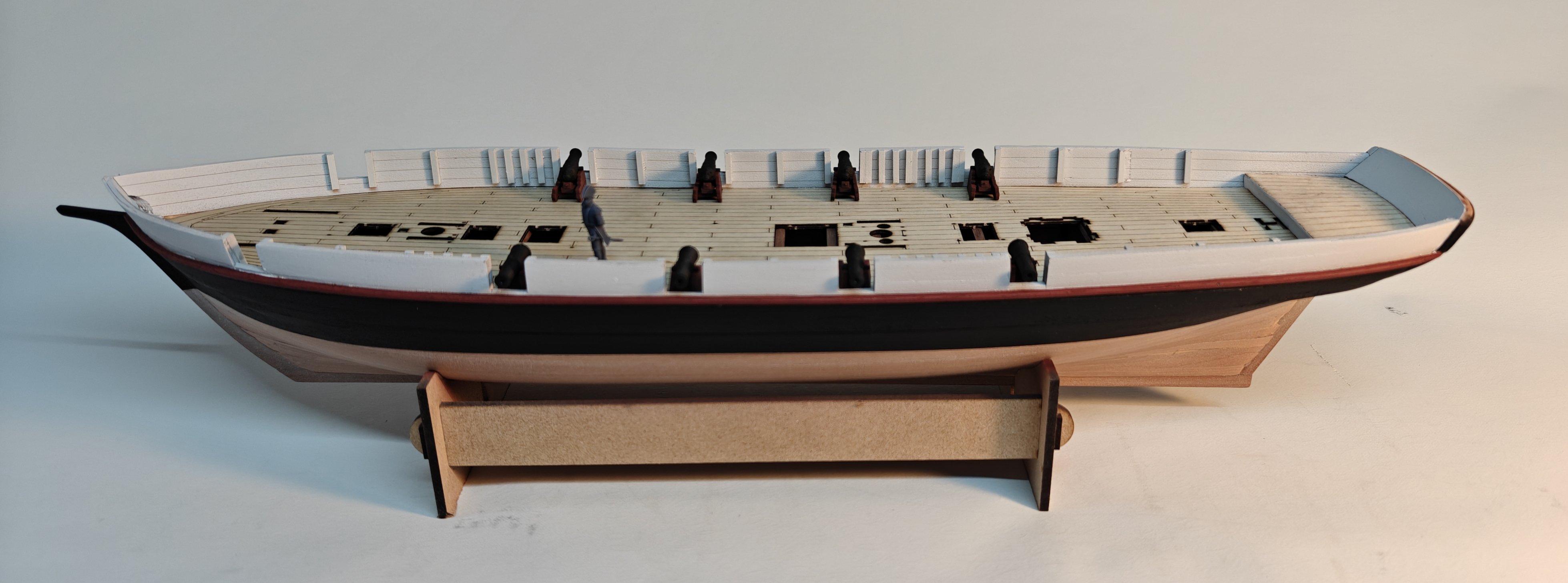

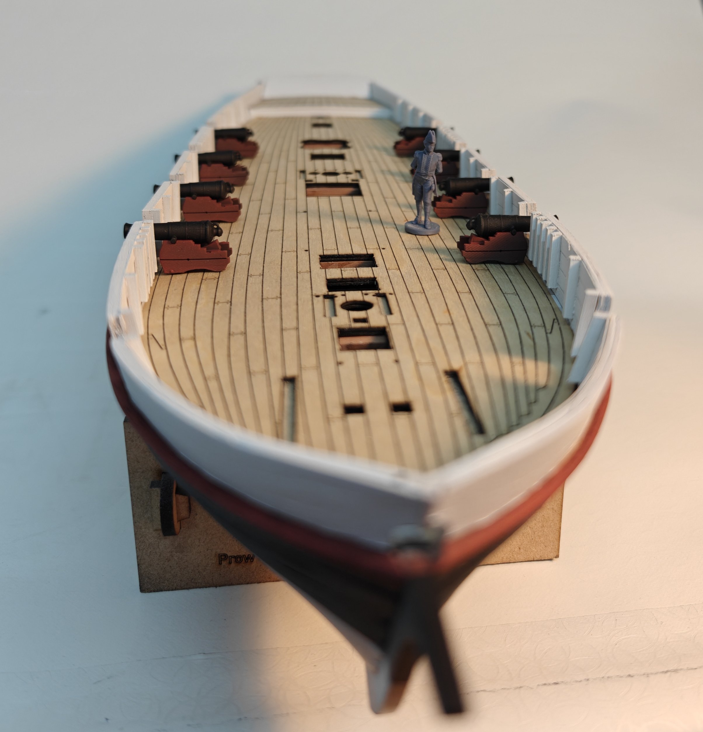

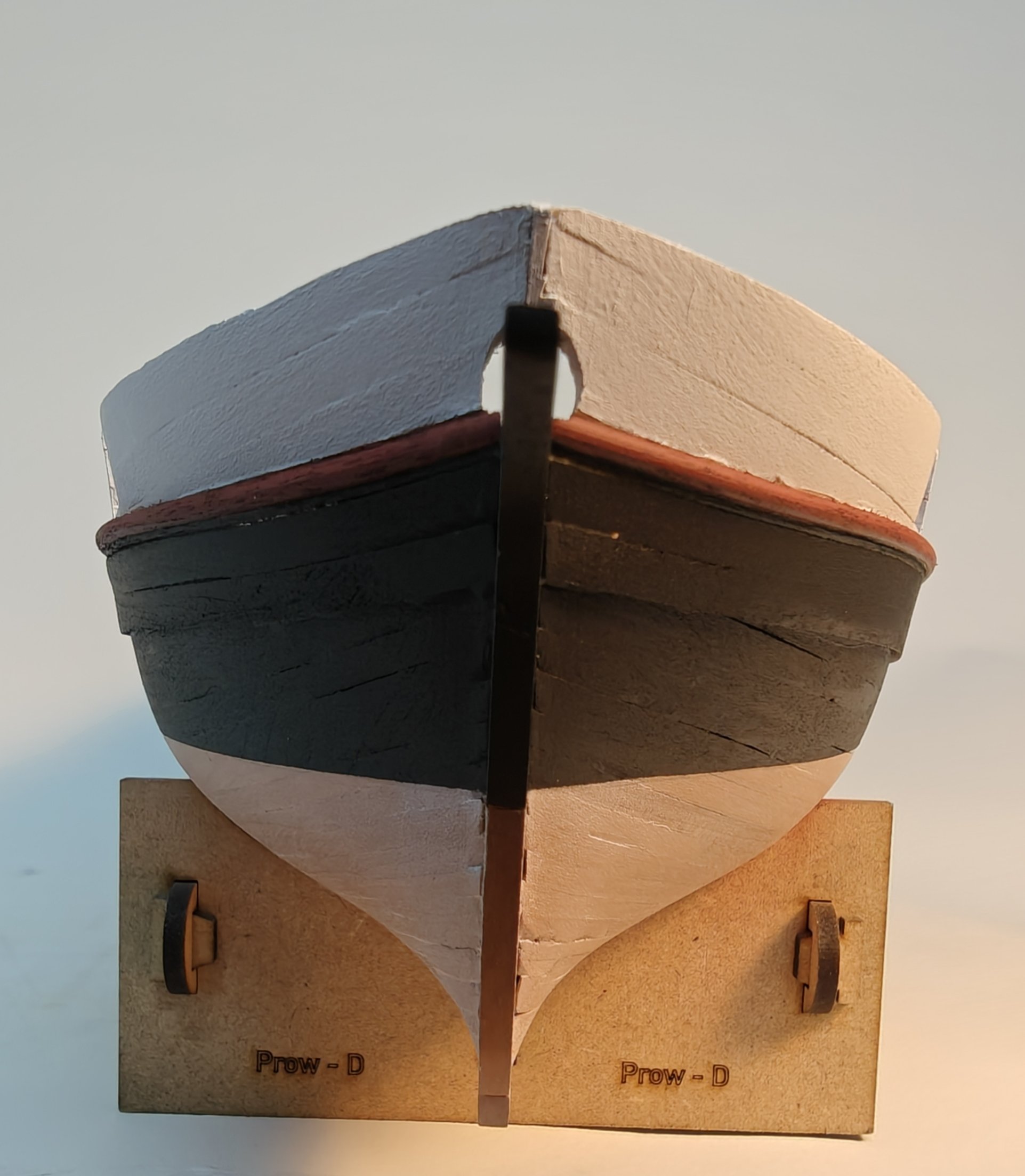

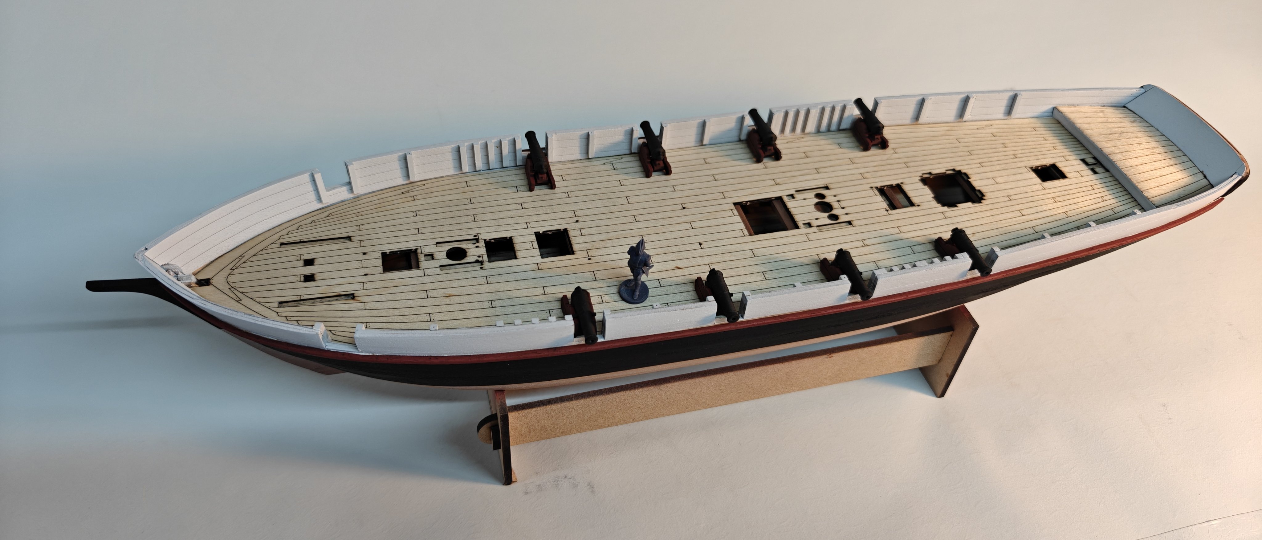

Log entry 12 - painting: white black and red
I have been looking forward to this since I began the build: painting the main colours. This is when you really get a god idea of how the final piece will appear at the end, even though there is much left to do.
I started masking of the deck and the whales and painted the outer and inner bulwarks white:
It is actually a light gray primer and then pure white on top, but only a light coat. So the end result is not completely white. This is preferable and allows for more details to be seen as well as create subtle shadows.

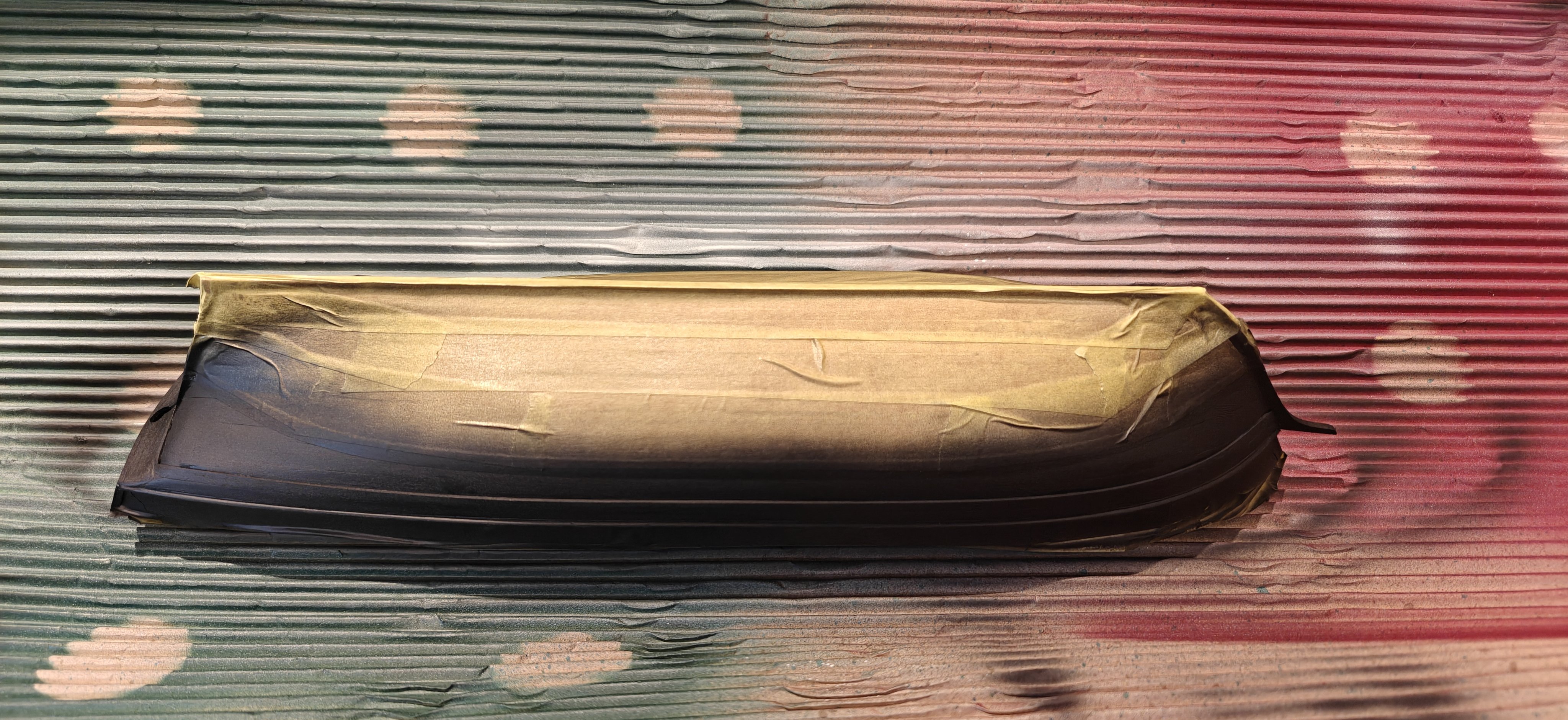

The next day, I masked off everything except from the bulwarks down to the waterline and painted that black:

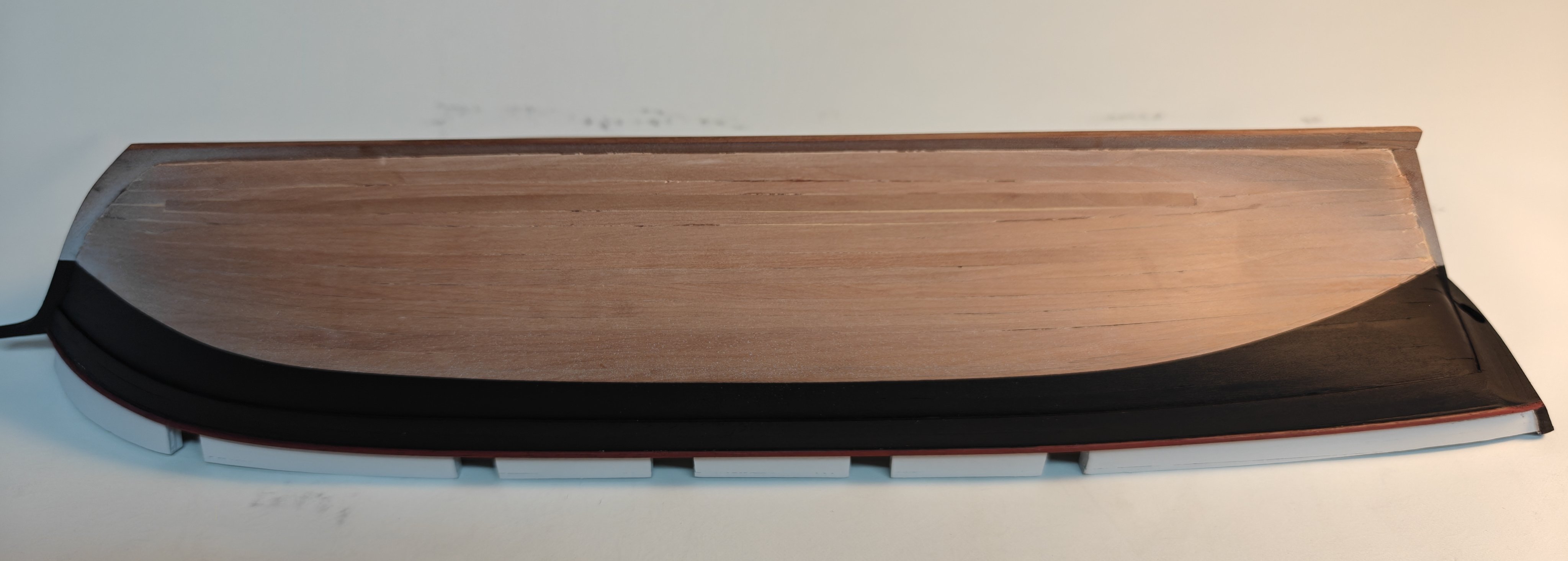

Lastly, I masked off everything but the trim stripe and painted that red, using three layers: light brown, dark red and the the final flat red (from Vallejo).
I was very excited when I pealed off all the layers of masking tape, and very pleased with the result! I had no bleed in any spots and in particular the waterline came out basically perfect.
It is almost a shame I will be coppering the hull below the waterline, I will definitely not be able to get close to such a nice line with the copper plates. But coppering was one of the main reasons for this subject, so I will continue with that plan.
Here's a few close-ups of the bow and stern:
It looks quite rough in these images, much more so than in real life! Macro shots are cruel... It looks ok from 30-50 cm away, and totally fine at 'normal' viewing distance. I may do a bit of filler and touch-ups in the worst places.

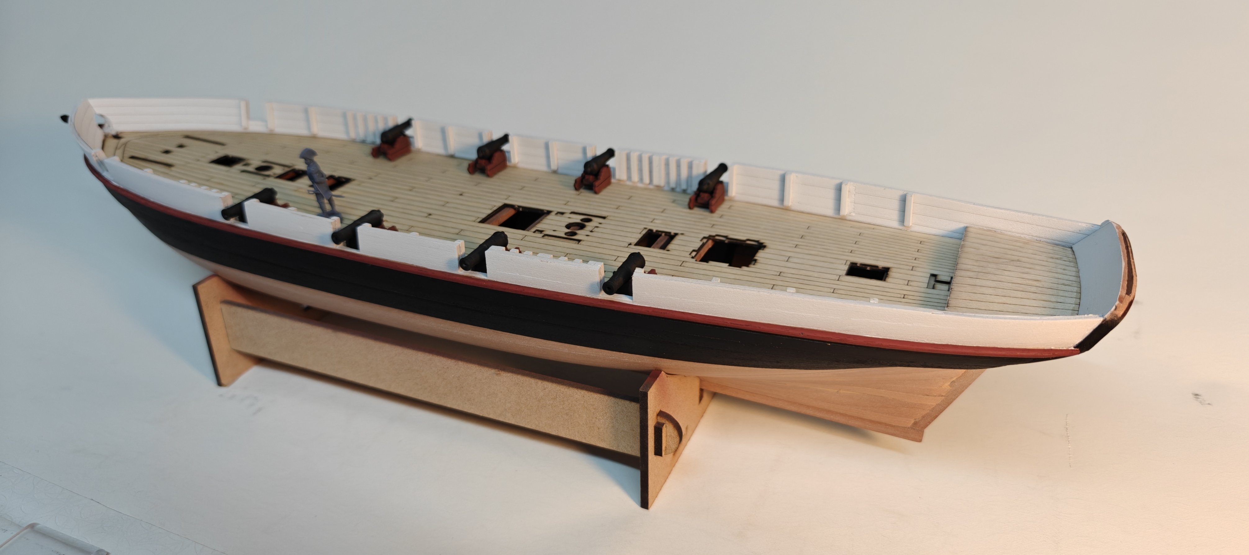

Here is a few overall shots of the current status (with cannons):
Alright, there will be a bit of a pause in the log as I am headed for vacation. But when I return, I will begin coppering.

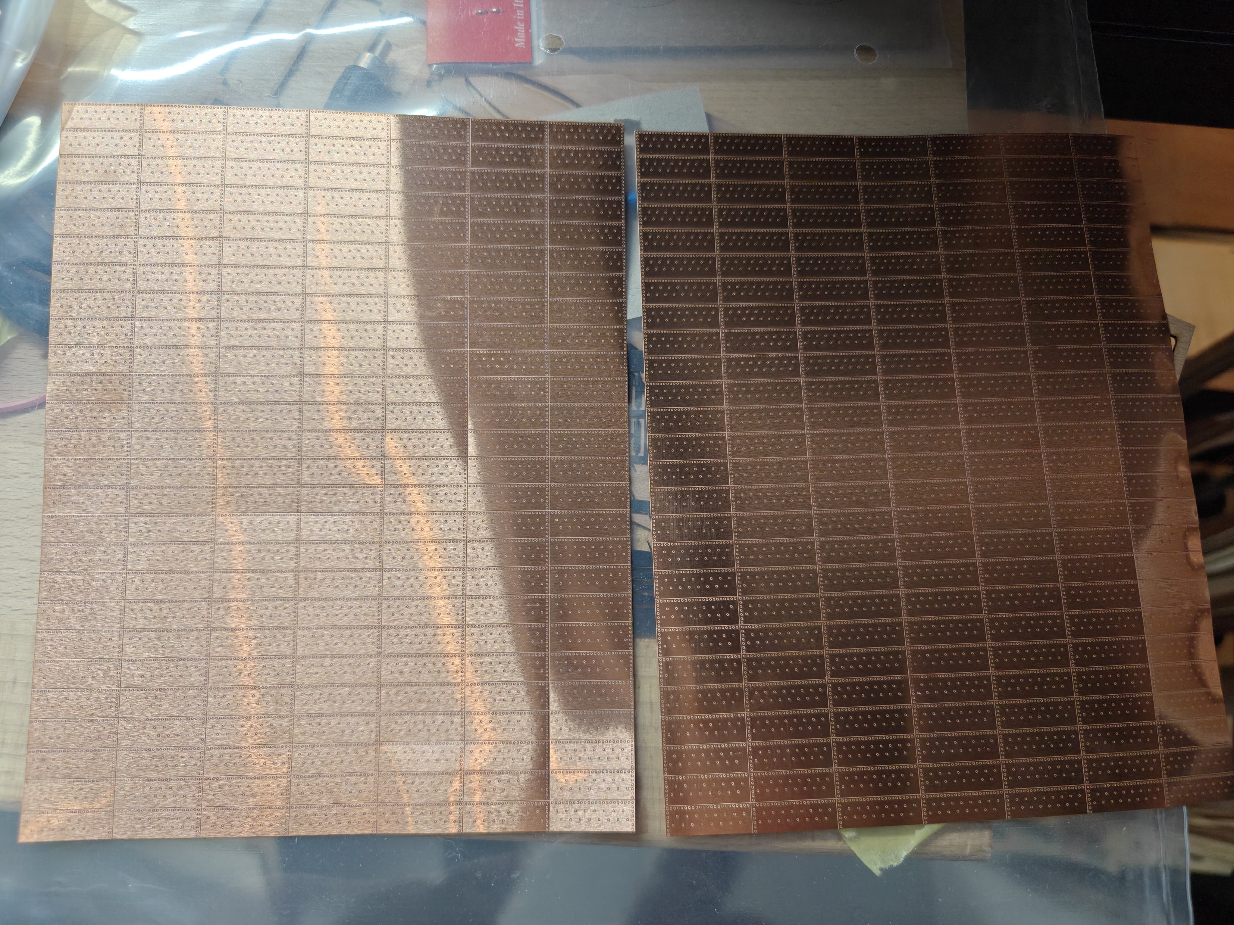

I have acquired some 1:64 copper plates from Amati (the ones used on their Mercury and Pegasus kits), and I know there is a right and a left sheet, but can anyone tell me which is which? (And why it is that way around...).

That will be a nice feature with the coppering plates. I don't know wich one is left and wich one is right.  The coppering of Fregatten Jylland is symmetric.
MatthiasScreenshot_20250704_212314_Chrome.thumb.jpg.29e5c3bdfee15e862ee3a85f7dca2fd9.jpg
Edited by Beckmann
I think they are asymmetric to simulate an overlap of the plates, but I am not sure why I need different patterns on left and right. Of course that is necessary if I have to have symmetry between the two sides of the ship, so perhaps it doesn't matter which I use for left and right, as long as I stick with a decision?
Edited by TJM
If you look carefully at the sheet provided by the supplier, you will notice that there are vertical lines separating the plates, these should probably face to the rear, as the 'tiling' would begin at the stern and continue forward with the plates overlapping each other a bit.
Similarly, the coppering would begin at the bottom and progress upward. Keel and sterm/stern would be done last, the rationale being that these areas would be most at risk and plates may need to be replaced more frequently.
There is also a significant amount of evidence to suggest that the false keel was not coppered (at least with regard to British ships).
Also some ships also had the uppermost layer of plates done after the fact running along the waterline to sort of finish off things.
It seems that the upper edge of the covering was covered by a wooden batten or possibly canvas, but there is very little said on it and specifics are hard to come by.

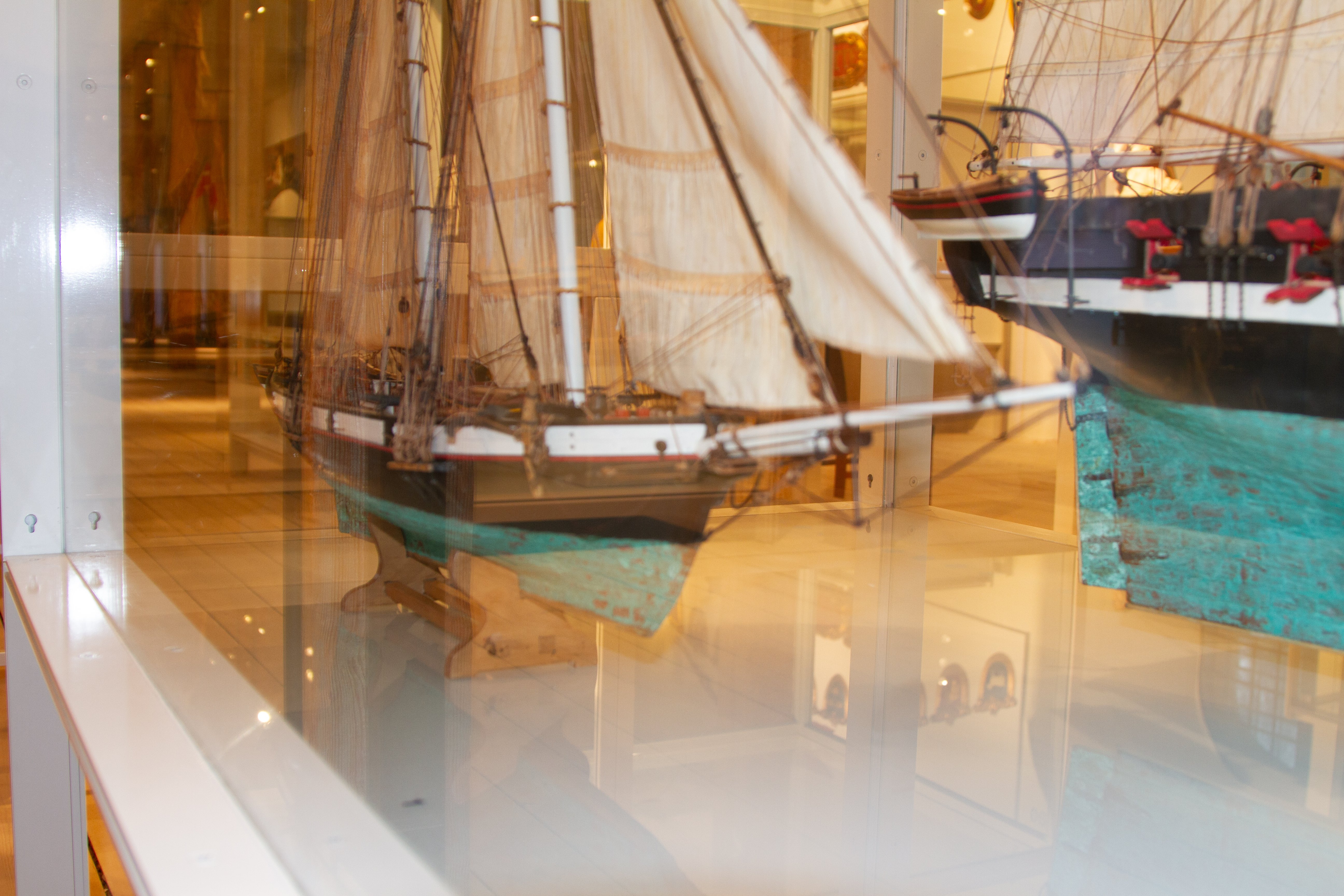

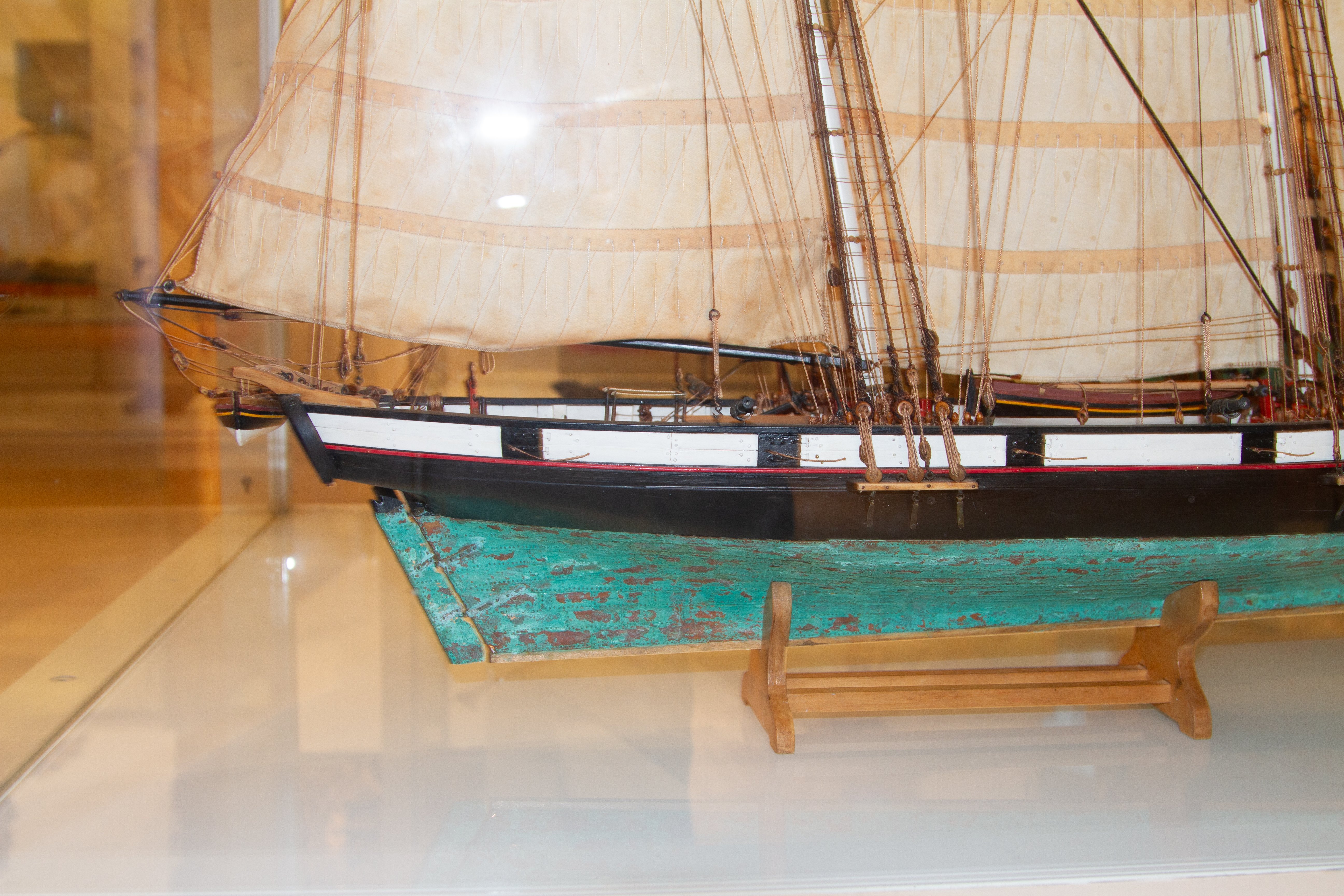

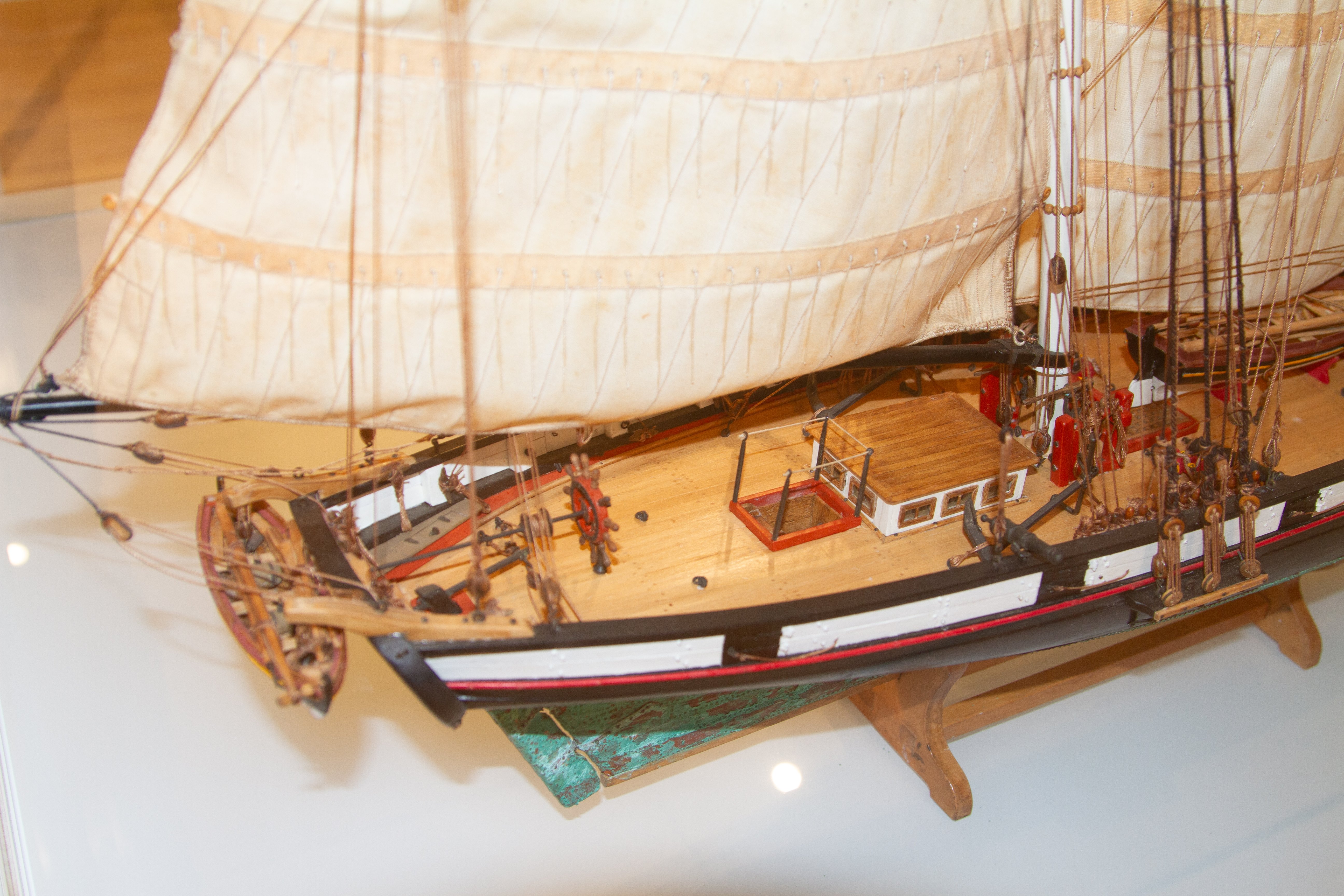

Think it would also make sense here in principle, as ELBE/ELBEN operated in strongly tidal waters, where touching sandbanks and the like may take place frequently.
Talking about that, I wonder, whether she was really coppered. Most vessels that would only operate in home waters around the North Sea and the Baltic did not need to be coppered, as Terredo navalis had not penetrated through the Channel yet. Today, the situation is different, with T. navalis being found around the Wadden Sea island already.
It does sound reasonable, but the little circumstantial evidence I have seen suggests that it may have been coppered. The model of the smaller sister ship Delphinen at the War Museum in Copenhagen is shown as coppered, and it was a guard ship at Nyborg, which is entirely within the 'home water' boundary. I don't know if the model builder Peter Maack had any hard evidence of the coppering of Delphinen, but I will go with it on this model as well.
I have the vague feeling that DELPHINEN spent also some time in the Danish Westindies (since 1917 US Virgin Islands), but I may be wrong. The Danish usually had a brig or schooner stationed there.
