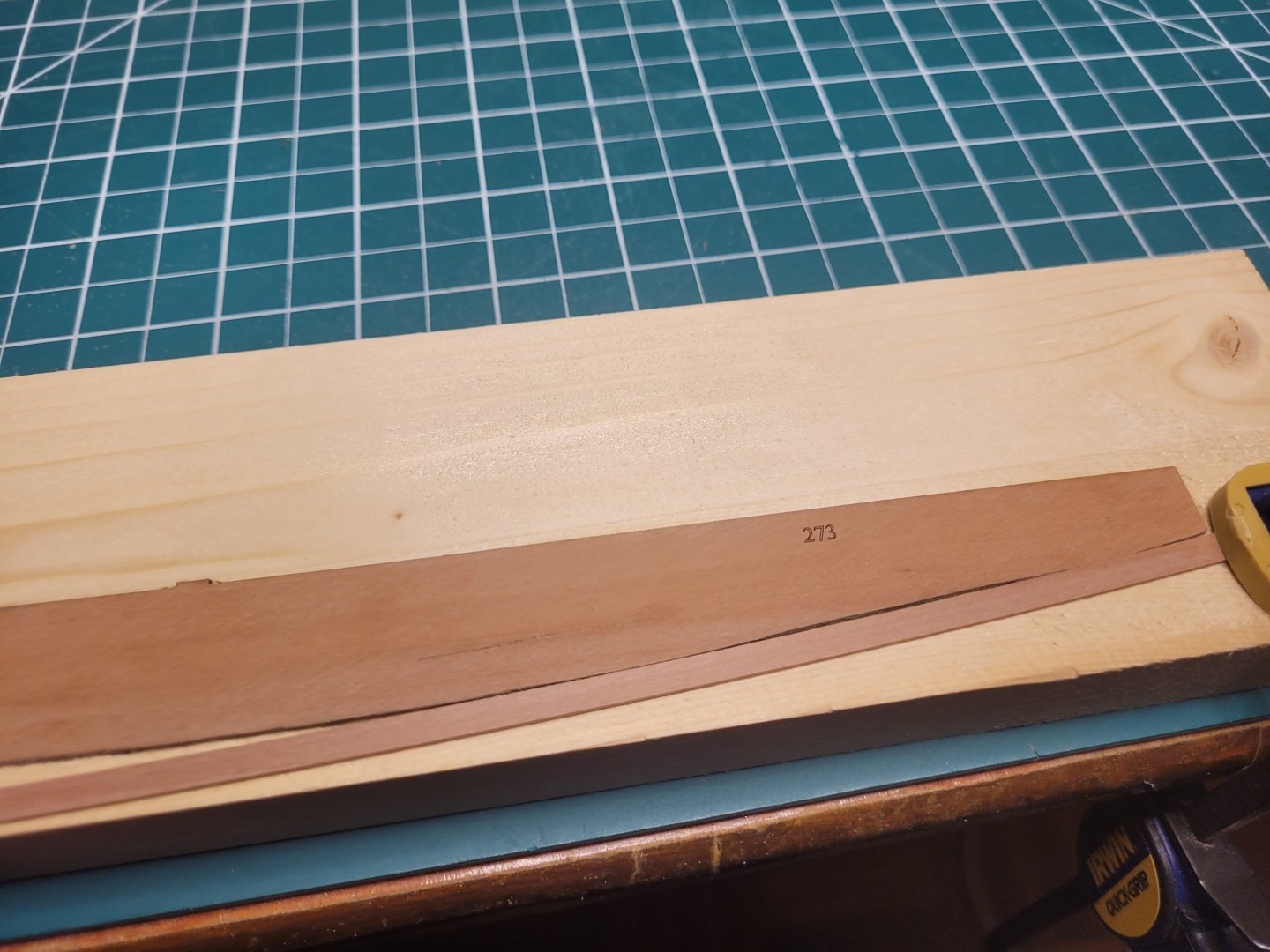

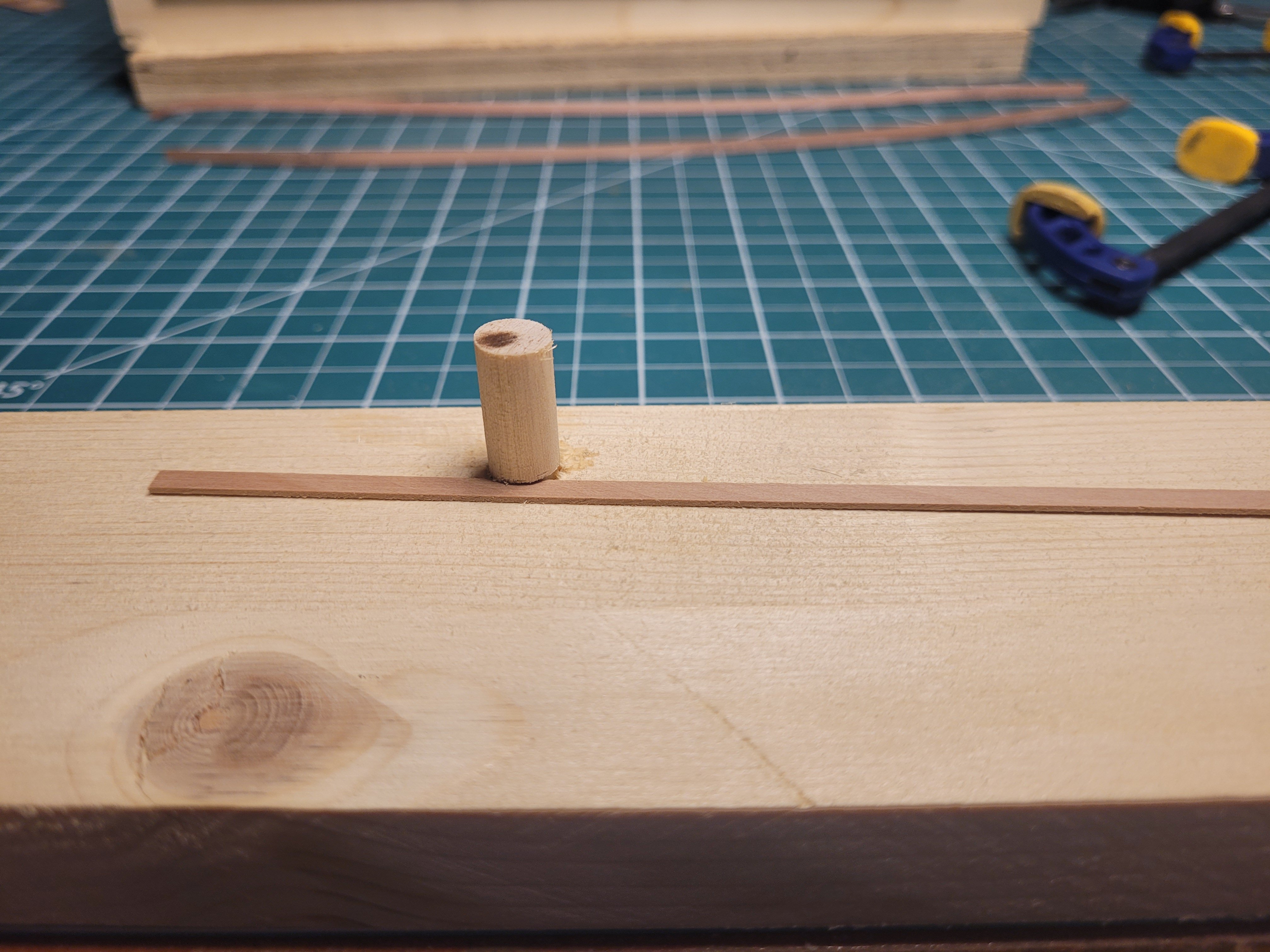

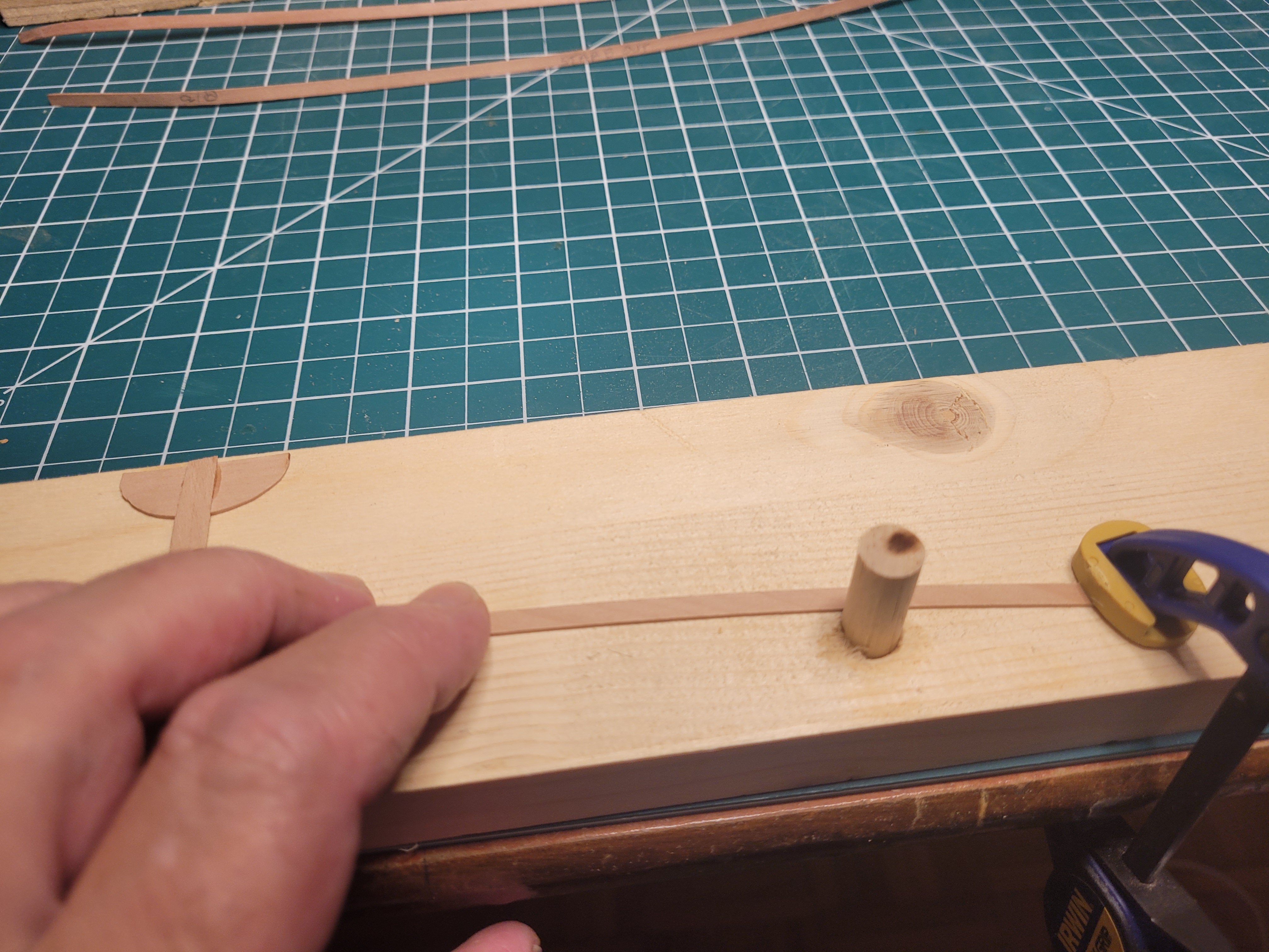

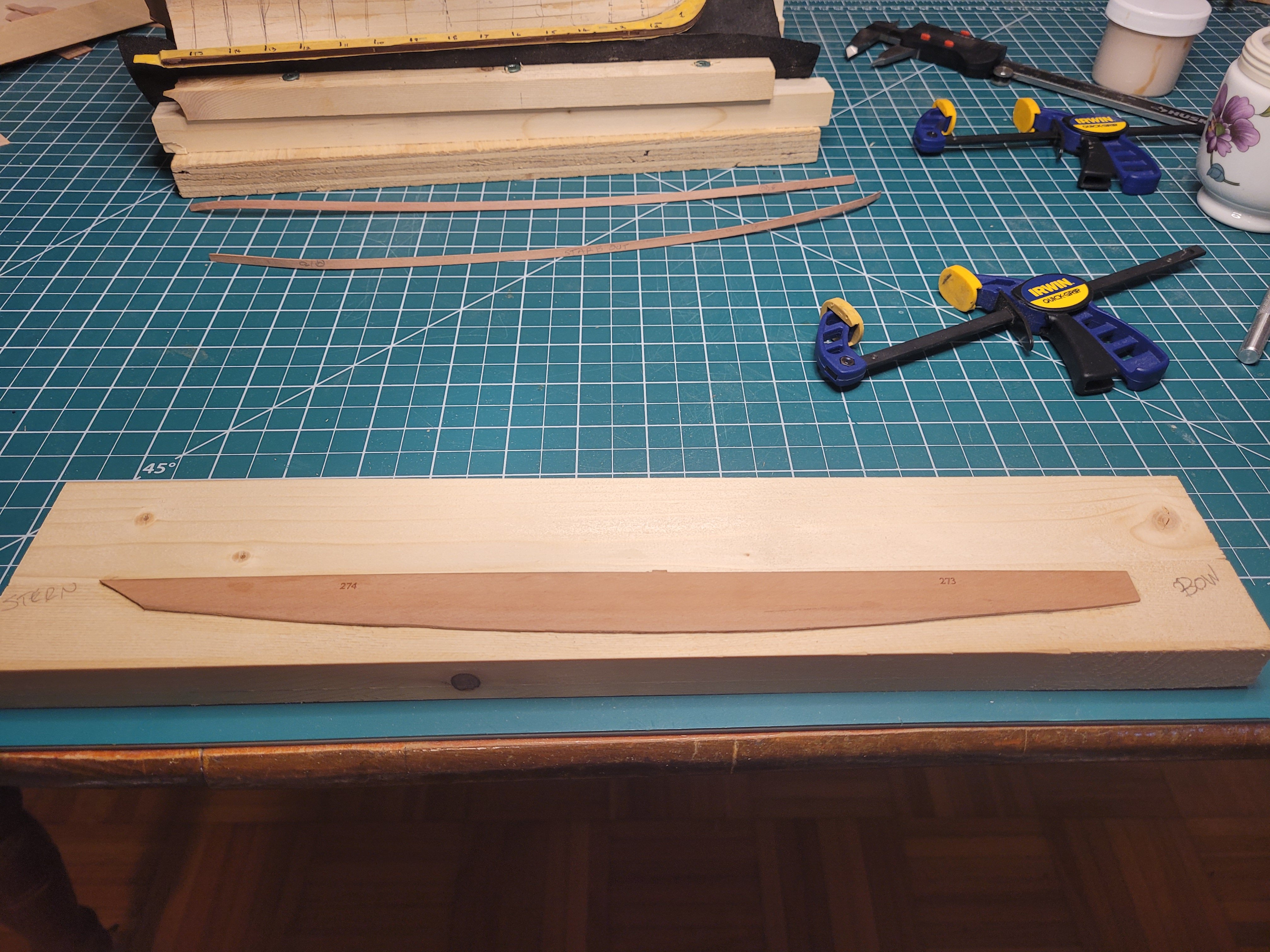

I started not long after my last post with a view to second planking.  I discovered it's a bit different from first planking because I'm way more fussed about gaps, clinker effect and so on.  And also trying to figure out edge bending.

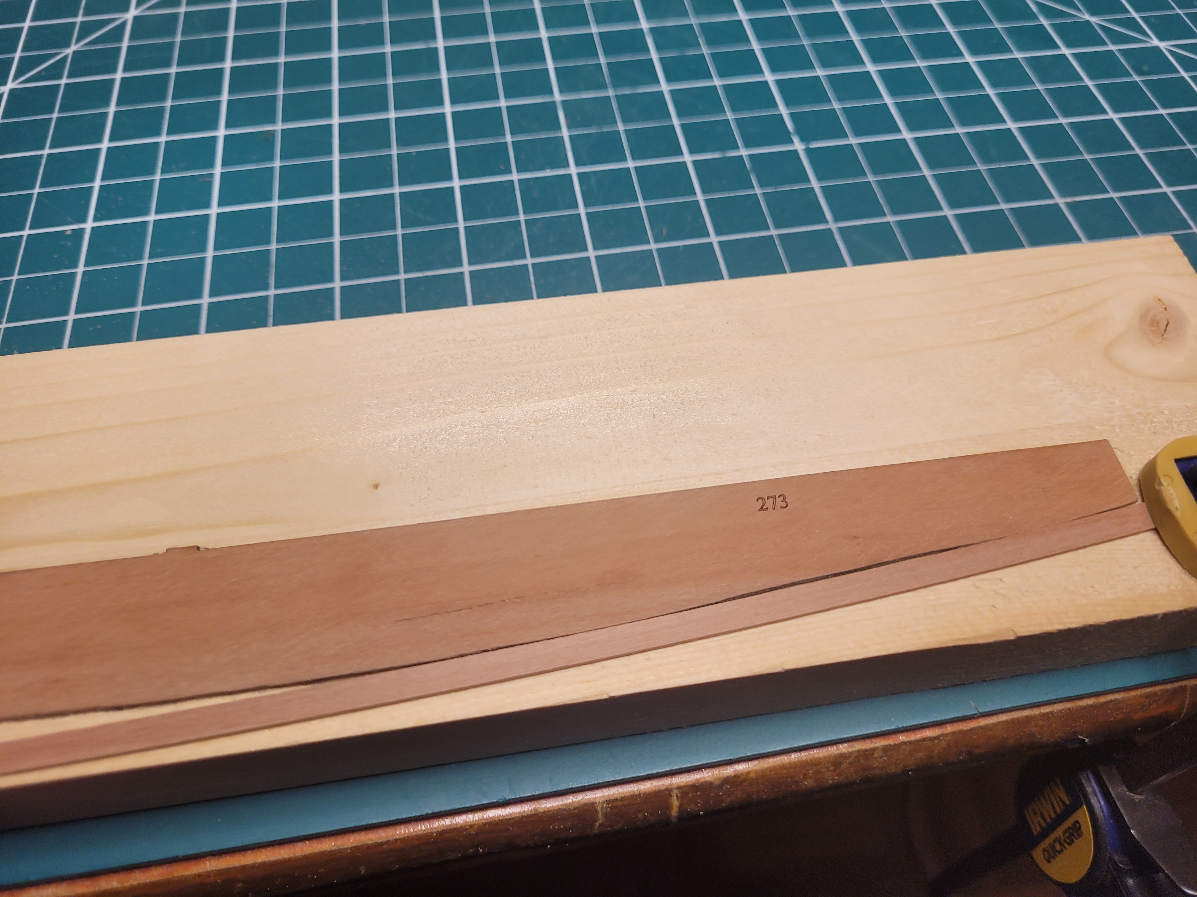

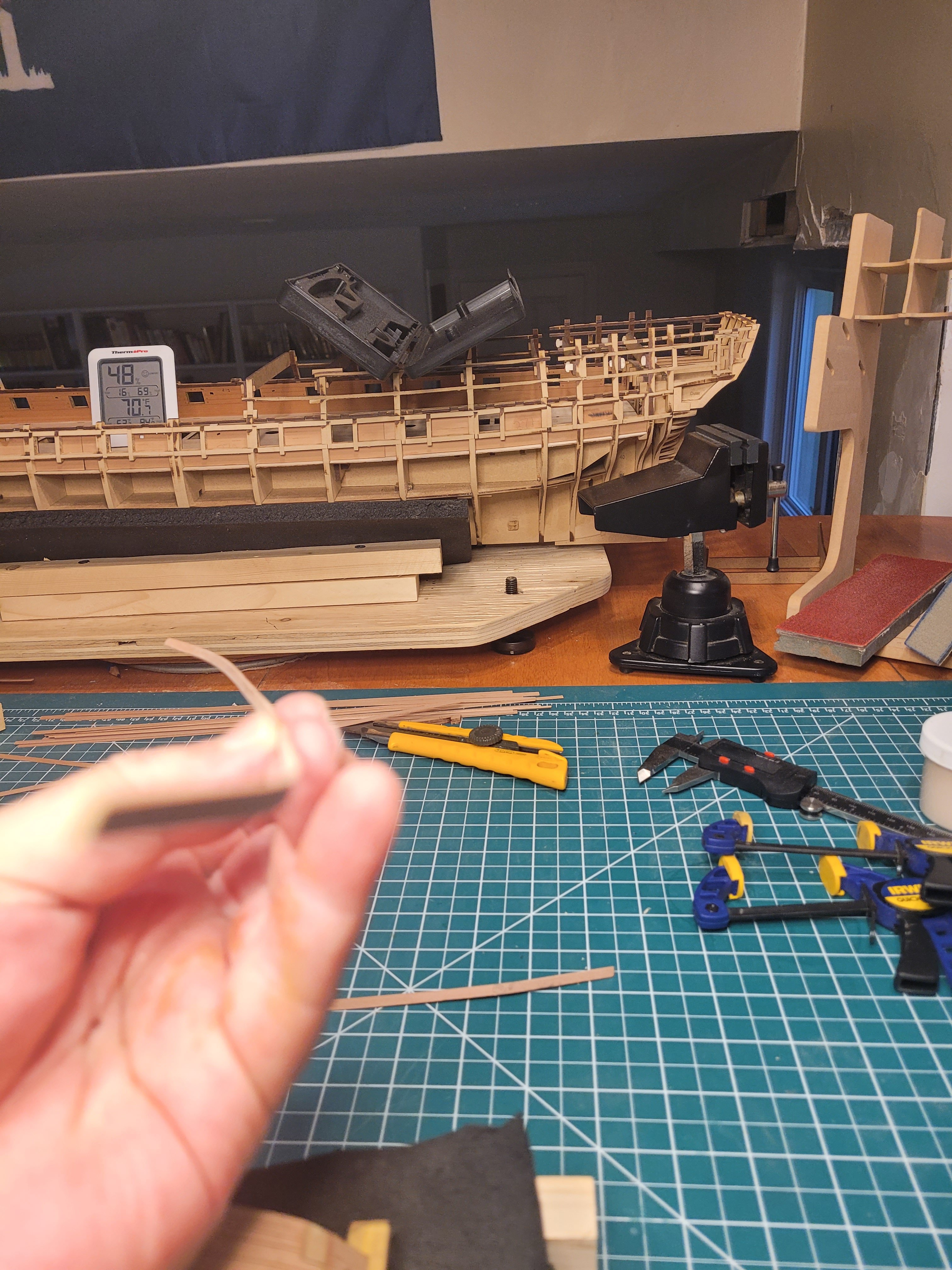

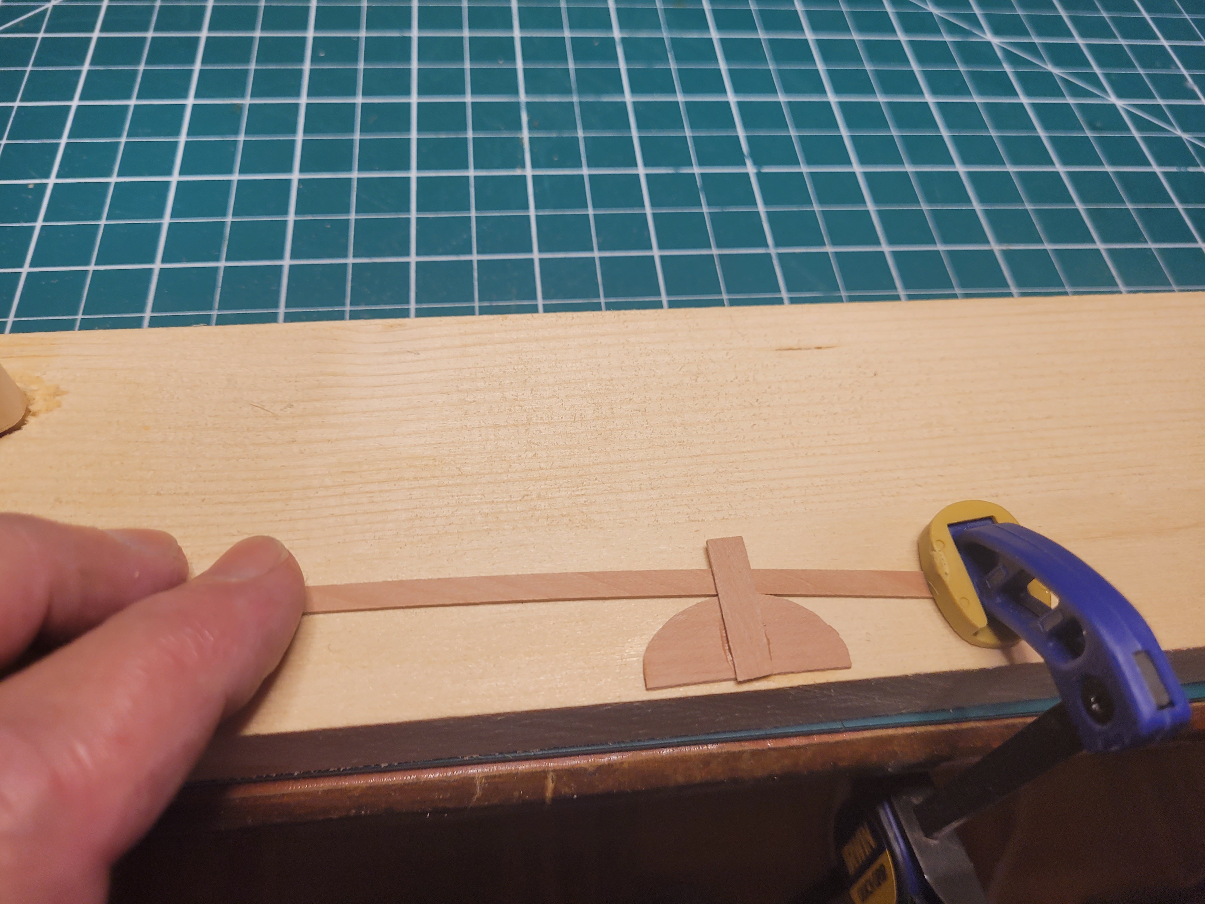

I've been through about three iterations of edge bending.  See the pics below; I still don't know how to intersperse pics with text.
First iteration. I started with the description from Chuck's videos.  That was good, but I wasn't being accurate enough.  I'd get e.g. too much of a bend in one area, have to correct it etc. And I had a hard time getting in with either the mini travel iron I bought or the electric plank bender.  I see now that if I'd persevered it probably would have been ok, but I'd moved on to the second iteration.
The second was a peg with a notch in it to keep the plank flat.  That was ok but accuracy was still a problem.
Then I went to the third iteration just today, and so far that's working a charm.  I cut out a template of the outer bulwark and glued it to a piece of junk pine.  Then I was able to clamp it at the bow end and bend it to conform to the outer bulwark shape.  I dabbed on some water over a section, and used the iron on it it, then went to the next section.  I had no problems with the plank wanting to jump up.  After a couple of passes, I had a good shape to match the outer bulwark; it's given me a nice compound curve all the way along.  I still had to work on getting it flush at the bow without a clinker effect.  I decided to try holding the plank in place, then dabbed it with water and worked the iron on it.  That's forced it down flush with virtually no clinker effect.  I think one or two more passes tomorrow will have it just right.  The pic looks like there are gaps, but it's shadow.
Nick

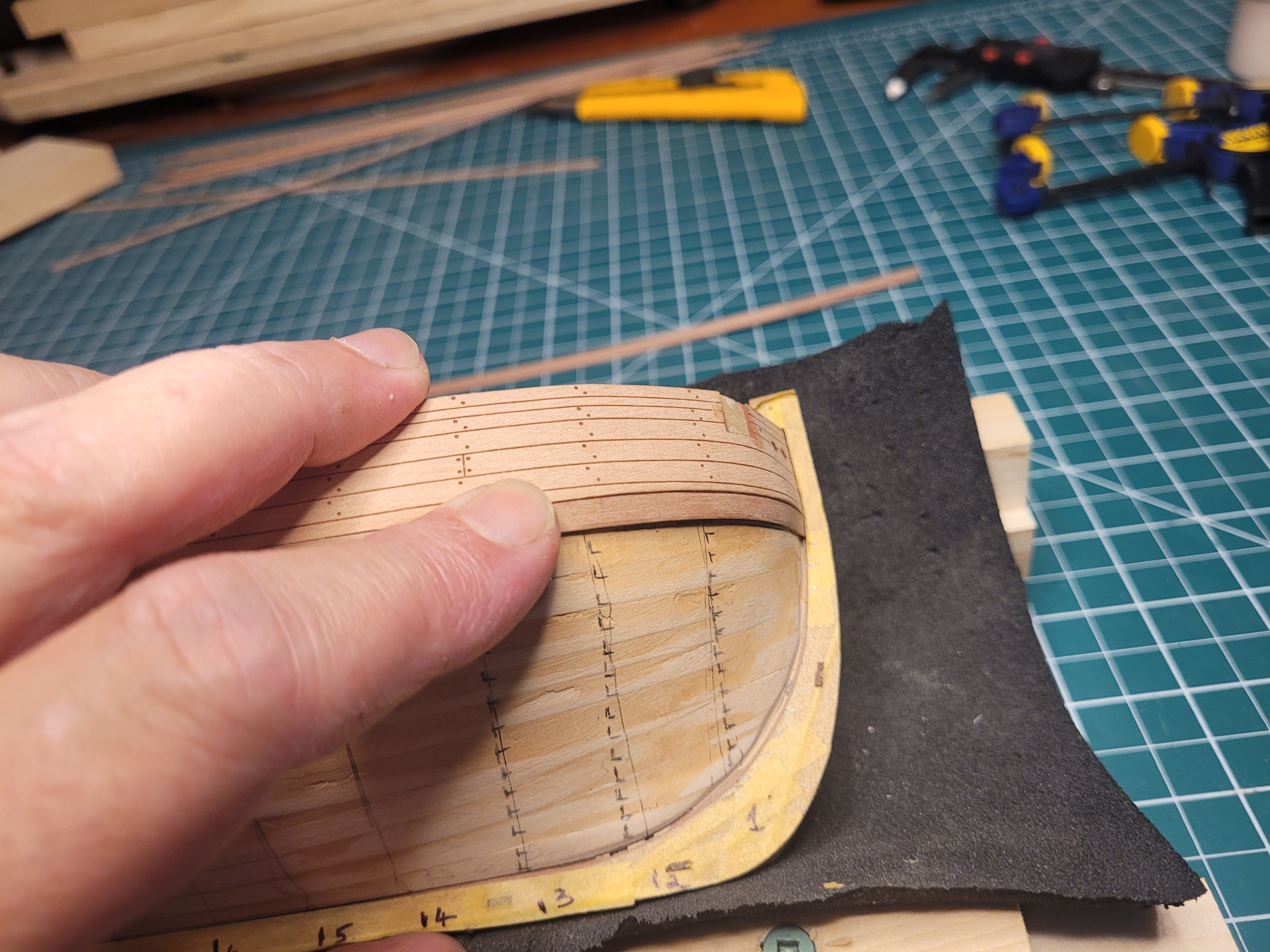

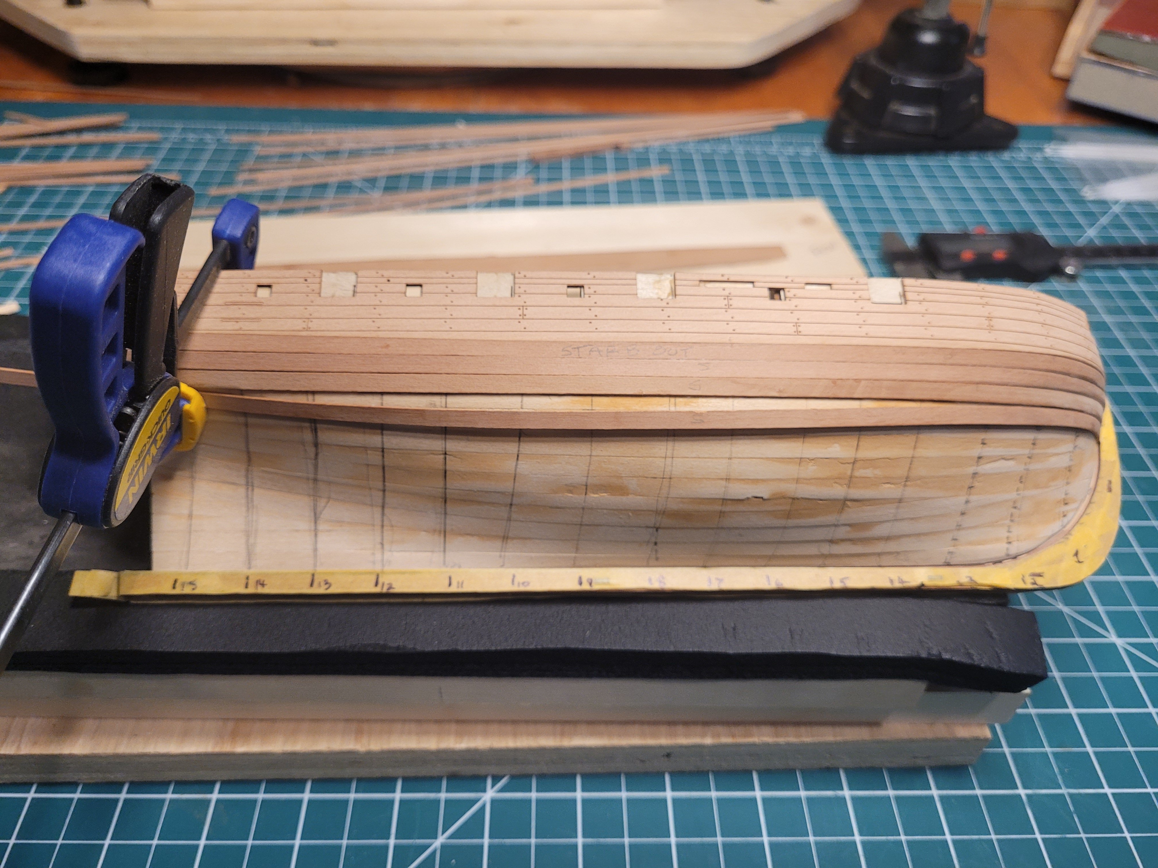

I'm cooking with gas now on second planking.  The system of edge bending and then dabbing some water on a section of plank and working that section with my travel iron, then going on to the next section, is working really well for me.  I only have two planks glued on at this point, one each side, but two more just about ready. I'm doing two at a time to match them up either side.  My steps (just what works for me):
  1. Nip the two planks to match the angle for the rabbet.
  2. Sand a bit on the rabbet end as needed.
  3. Mark one for the taper cut; double/line up with the other plank in the Dremel vice (metal jaws without the rubber covers).  Then it's easy to plane both planks at the same time.  The mini plane works great for this.
  4. Bevel the plank edges.
  5. Edge-bend the planks to the outer bulwark contour.  I clamp the end of the plank (first pic in my earlier post) and then just wet the plank in sections and work along with the mini iron.
  6. Then, one plank at a time, dab a bit of water on the section of plank nearest the rabbet, but without getting water on the rabbet insert, get it just wet but not dripping so as not to drip water on other planks/model.
  7. Insert the rabbet end and lay the plank in place.
  8. Work the wetted section with the mini iron.  The mini travel iron is working great, for the edge bending but also for this; I'm finding it heats up almost instantly versus the soldering-iron -type plank bender, and is way more manoeuverable and precise.  It only takes a few seconds to work the particular section.
  9. Repeat 8 as needed.
  10. Continue along the plank in other sections to get the bow curve, same as 8-9.  So far anyway, I don't need to work the middle section of the plank as the edge bending has done the job there.
  11. Work the stern section of the plank to bend and twist to fit.  Here I'm using steam from a kettle and bending with pliers.
  12. After a final fit check and any adjustment/repeat, it's ready to glue.
I'll have to adjust once I get further down towards the keel, but I think it will be much the same, with just garboard and it's neighbours a bit different.
Nick
Edited by Nick 843
incorrect sequence
Three planks a side on now.  Virtually no clinker effect, which I'm very happy with.  Just a bit of unevenness here and there which some light sanding should take care of.  I'm noticing that the change in contour is very subtle.  All of a sudden, after 3 planks (and the third didn't really need it), edge-bending on the outer bulwark form gives too much curvature in the plank.  I'm finding for now anyway that I can just "iron" the plank in as-is.
Nick

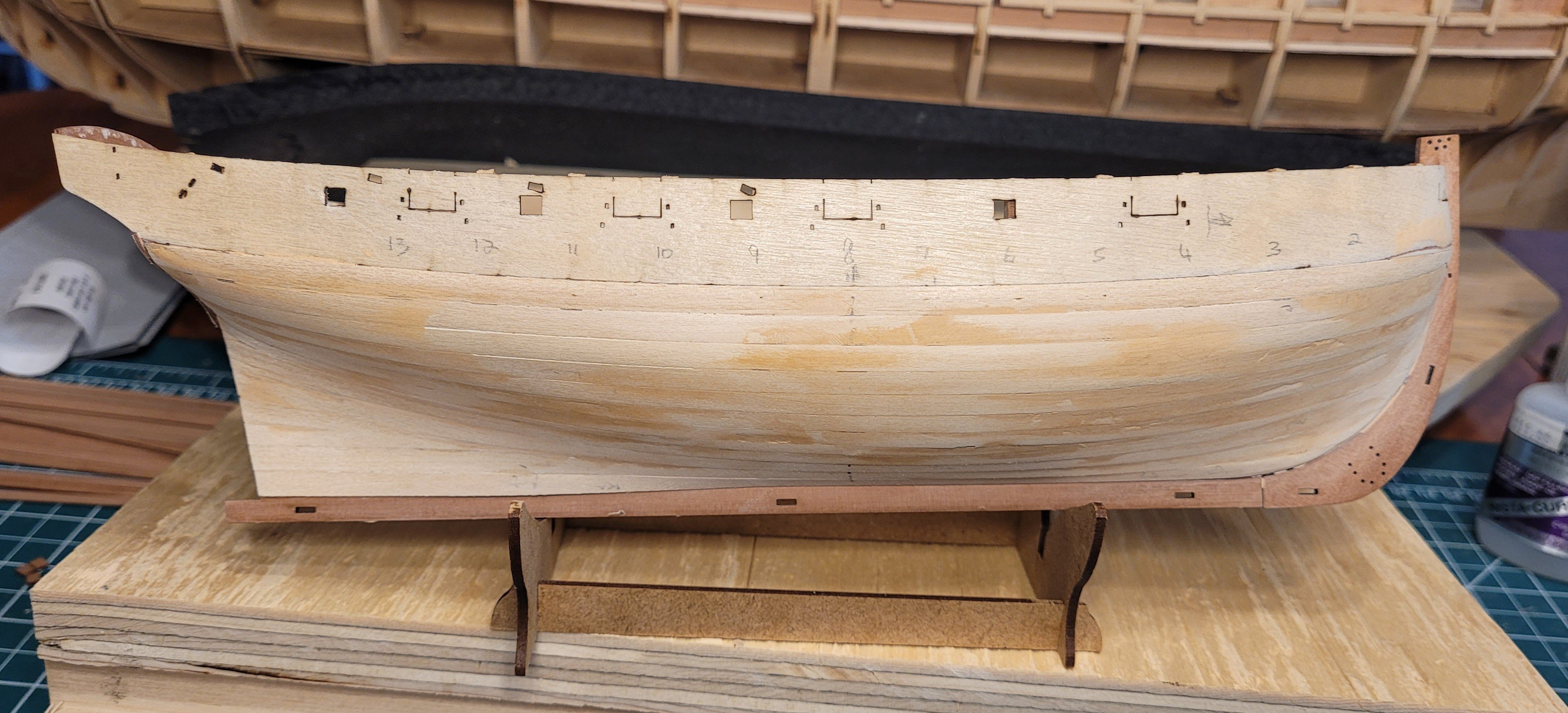

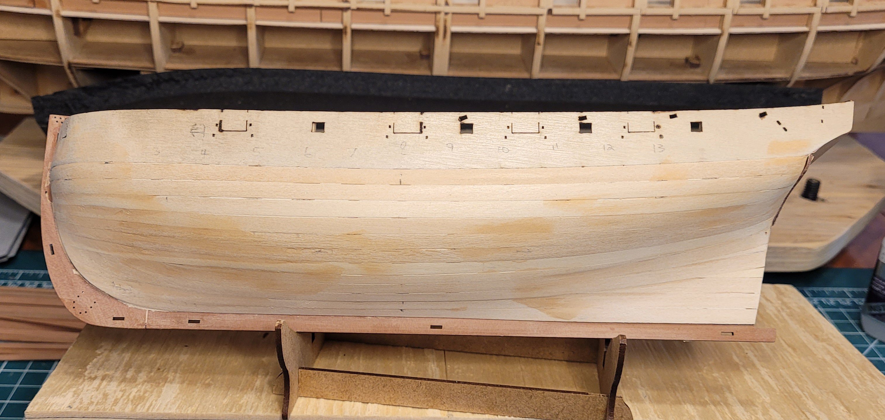

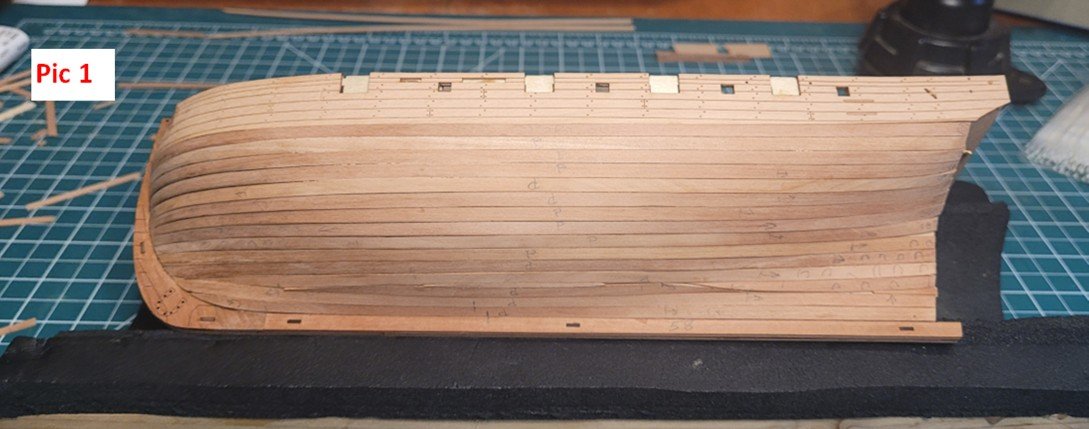

I've finished the second planking; it was slower than I expected with some fiddling needed, and more variance in plank treatment (tapering, bending, twisting and so on) from one to the next.  I'd get a couple that were basically the same, and then it could be quite different.  Amazing what a slight difference in curvature can do.
There are a few ugly areas; I'll add some notes later when I have time.
Now on to sanding and filling, although there shouldn't be too much filling (hoping).  I plan to try pear sawdust (I've collected a boxfull over time) mixed with white glue (since it dries clear).
Nick

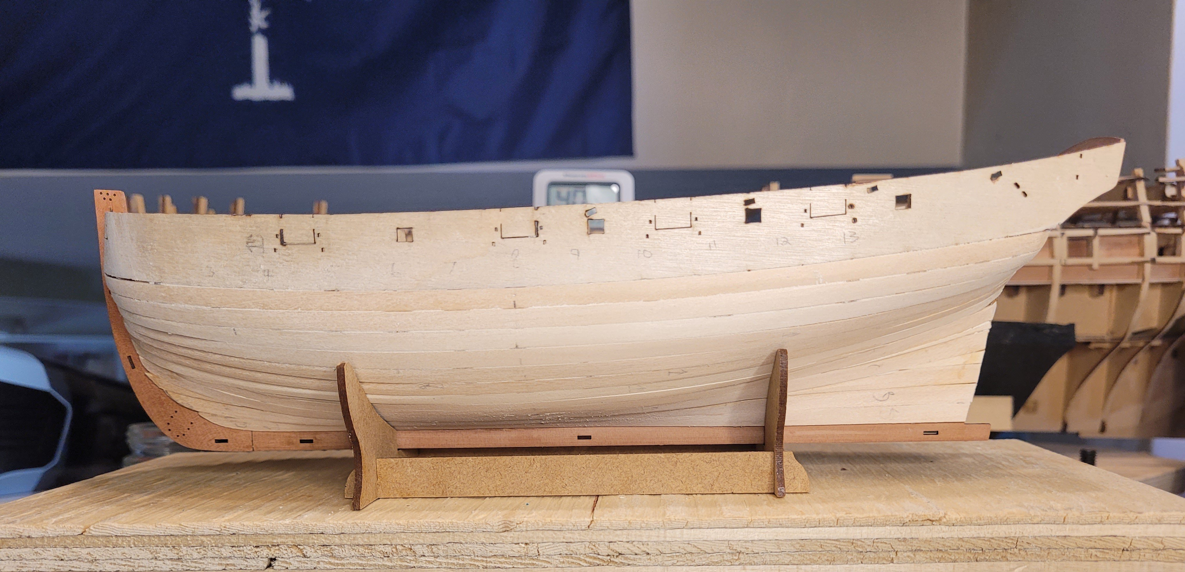

So I thought I'd do a few notes (a) in case they assist anyone, and (b) in case anyone would like to comment.
My overall takeaway is that I need to learn plank layout techniques to get a better result, although I'm generally very pleased with the result.  But here are some notes.
Finger stains.  It's amazing how planks get dirtied from your fingers, despite washing hands regularly LOL.  Of course, the answer is to use surgical gloves, but I hate wearing them for any length of time.  Most if not all stains will come off with sanding, and of course the hull will be painted, so I wasn't fussed about it.
Ugly areas:
Pic 3; the planking at the stern was a bit messy with some small gaps here and there.  Some of those at least were definitely due to me rushing things and not ensuring that the planks were butted up.
Pic 4; the same (rushing) produced a few gaps in the planking.
Pic 5; Not-so-great calculation of planks/widths led to these remaining gaps at the end, which I filled in with a variety of filler pieces, so not as elegant as I would have liked.  However the positive was that I'd planned for any of this to be under the turn of the bilge where they really won't be visible (and again painted anyway), and sanding should mitigate.
And just a final note.  You'll see that I chose to glue the outer bulwark in place prior to second planking.  I couldn't bear the thought, having taken a long time to clamp them into correct position, to take them off, even if they would be put back on up against the first plank.  I'm not fussed about paint bleed; I'll mask carefully, and anyway the wales will cover any minor bleed.
Nick
Nice work , I am also working on a Sherbourne I'm almost done with second planking as well. I permanently glued the upper bulwark for the same reason you stated. I however used medium CA to fix the in place Finnish planking and will fill with dry wall joint compound fare the lower hull. looking forward to future updates.
I also found the stern area to be a bit of a challenge. Thankfully, the final result in my built was painted, which could cover over many of the rough spots after some filler.
