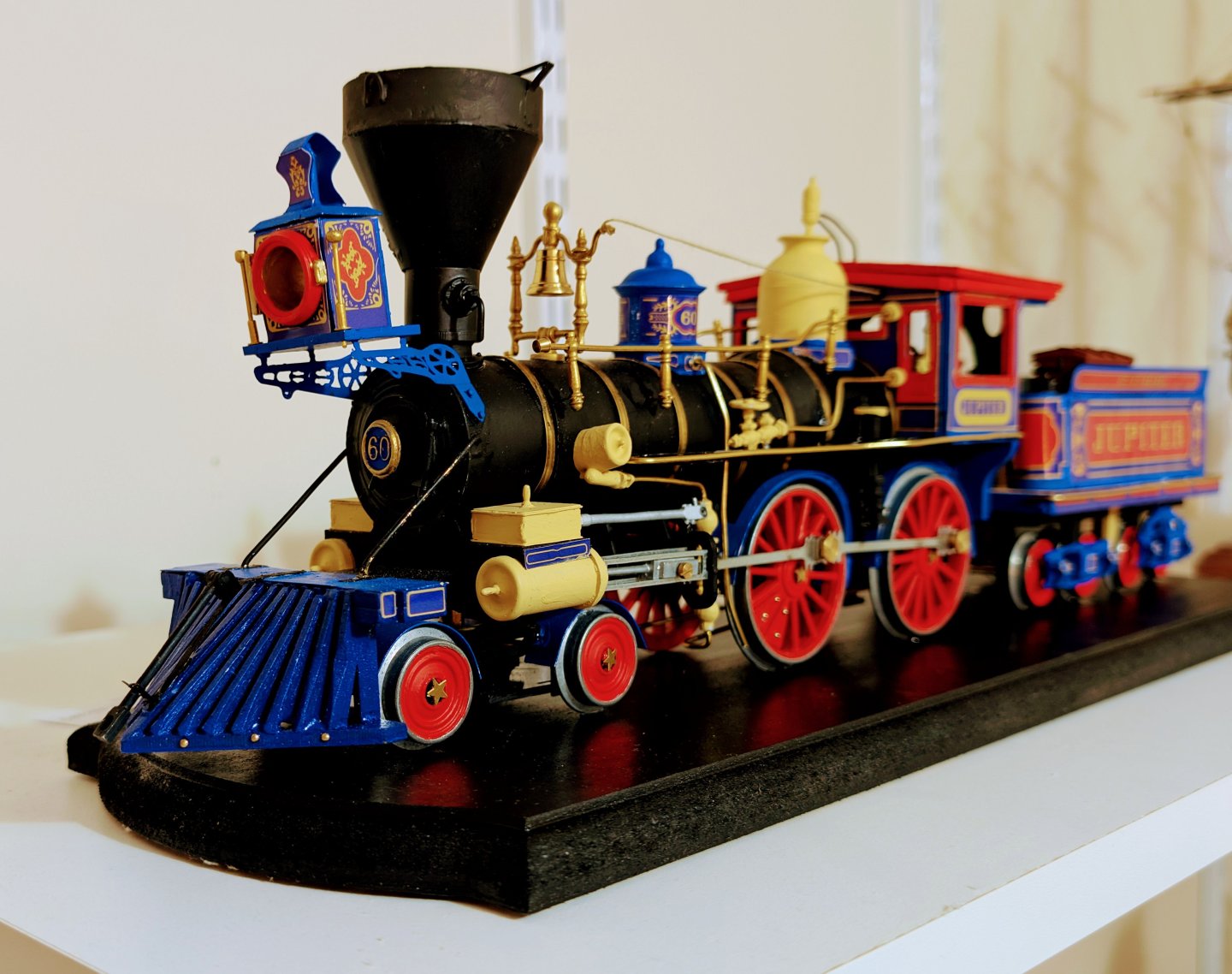

Are you sure that this is a steam-dome, that thing before the cab? To me it rather looks like the 'coffee-pot' housing for a double set of spring-loaded safety-valves that is seen on early locomotives (perhaps before the 1880s). this 'coffee-put' should be open on the top to let excess steam escape upwards.
The thingy on its top looks very much like a steam-bell, rather than a whistle.
Some early locomotives didn't actually have steam-domes, but the steam was taken from a high area of the boiler, which is why the boiler has a wider diameter near the cab - not a terribly good solution, as water might get into the steam-pipes on an incline.
It is interesting to see that the sandbox sits, where on more modern locomotives the steam-dome would be located, i.e. in the middle of the boiler, where the water level would change very much, regardless whether you were going downhill or uphill.
On the other hand, I have zero knowledge of US American steam locomotive practices ...

Quite confident. I know the structure that you are referring to, but I’m fairly certain that was introduced later as a method of keeping the steam from circulating in front of the cab.
And no doubt the “can” on top of the dome is the whistle. Very standard practice for the day.
Jupiter was built at the height of the brass age when railways wanted to show off their industrial advances in the finest style of the times. Lots of excessive and highly polished metal. Very different from locomotives that would be built less than twenty years later.

Added the smokestack.  This is difficult to build.  I had to putty the areas where the conical section joins, but that worked fine and painted fine.
The instructions (see diagram) suggest the most complex and difficult way to add the screening, but it's simpler to just use a circle, and that worked well and looks fine.
I didn't pay close enough attention to some of the alignments, so if you look closely you'll see that the crossbar on top of the smokestack isn't aligned front to back as it's supposed to be, but ah, well.
Final picture shows the stack mounted, and the bell rope rigged.   The engine is now completed, and it's on to the tender.

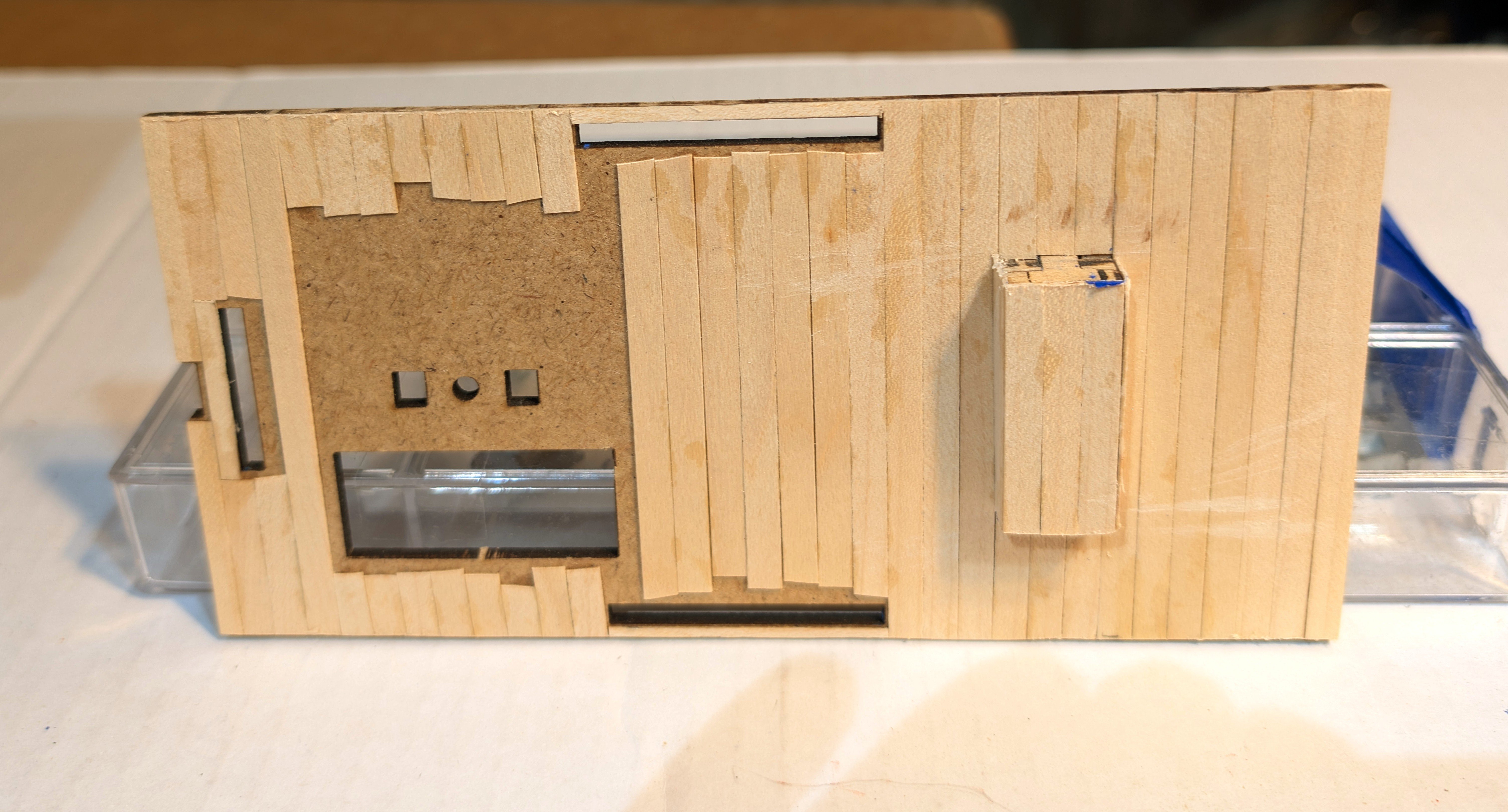

Started work on the tender.  Here's the first stage of the body frame.

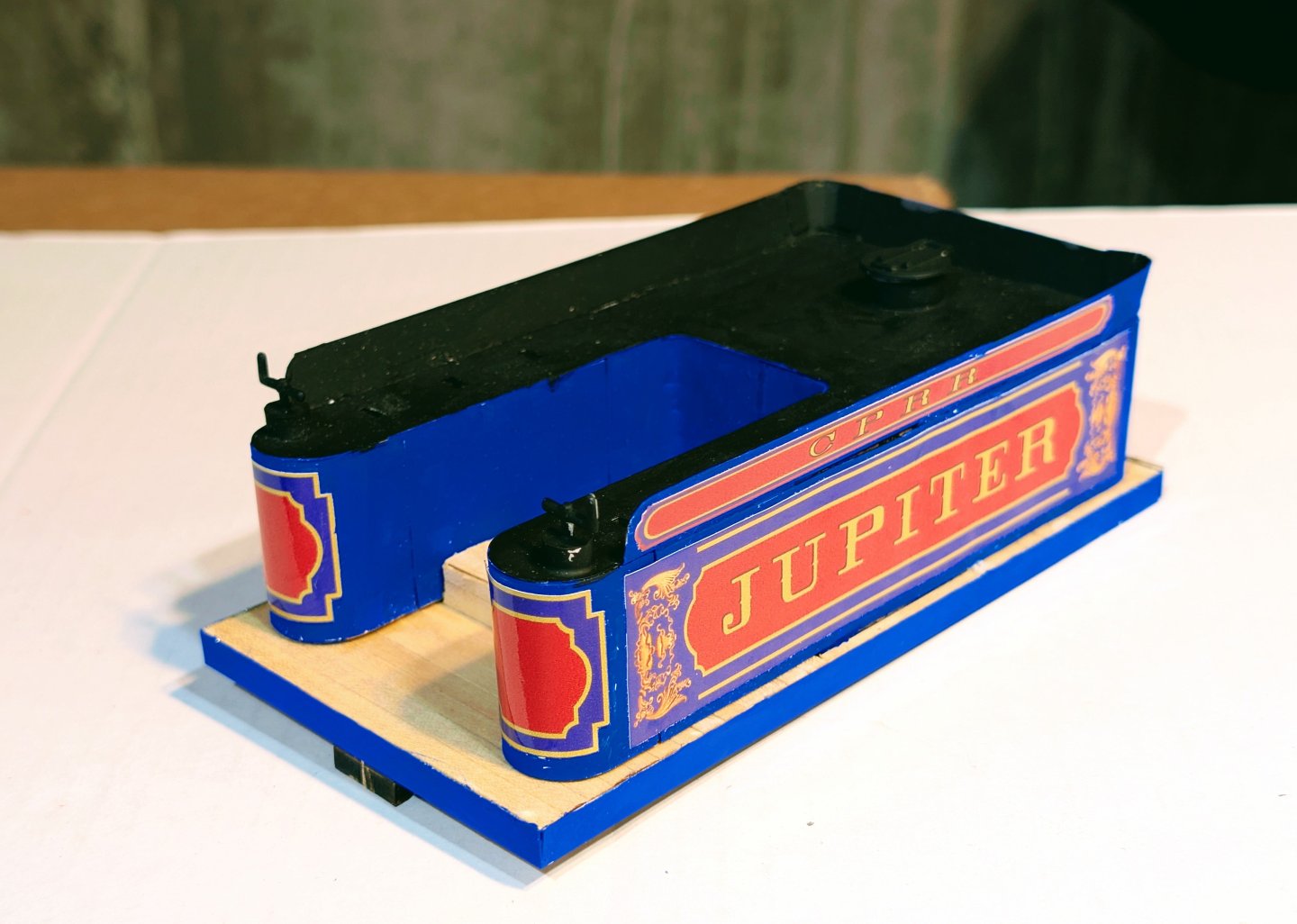

And here it is with the metal sides on.  I remembered to use my Dremel sanding drum to rough up the sides that are glued, so gluing set quickly.

Removable jigs determine the angle of the top flange of the tender.

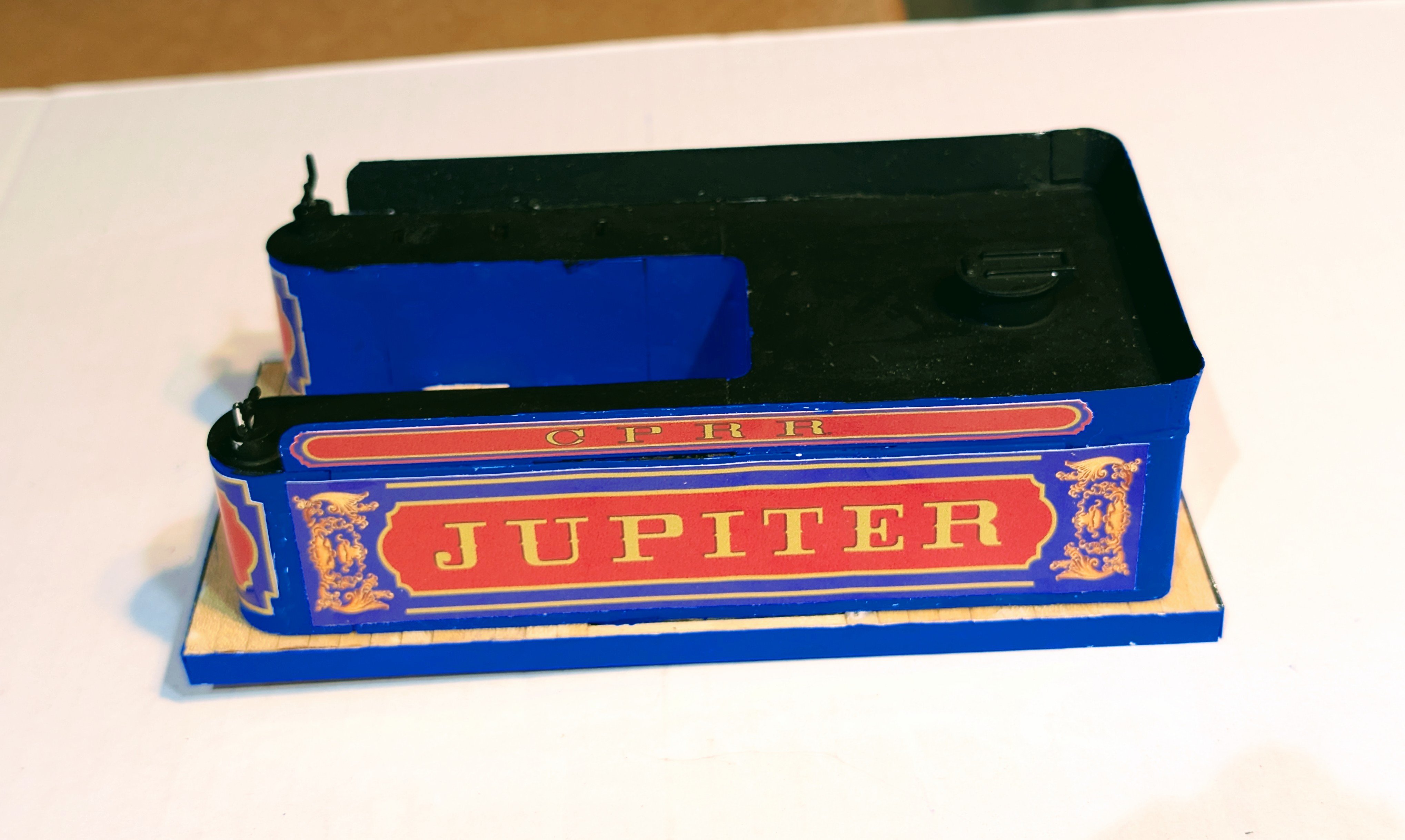

Painted the tender body.  Decals cover much of the sides and back, but you need to have enough blue to cover the areas where they don't meet.

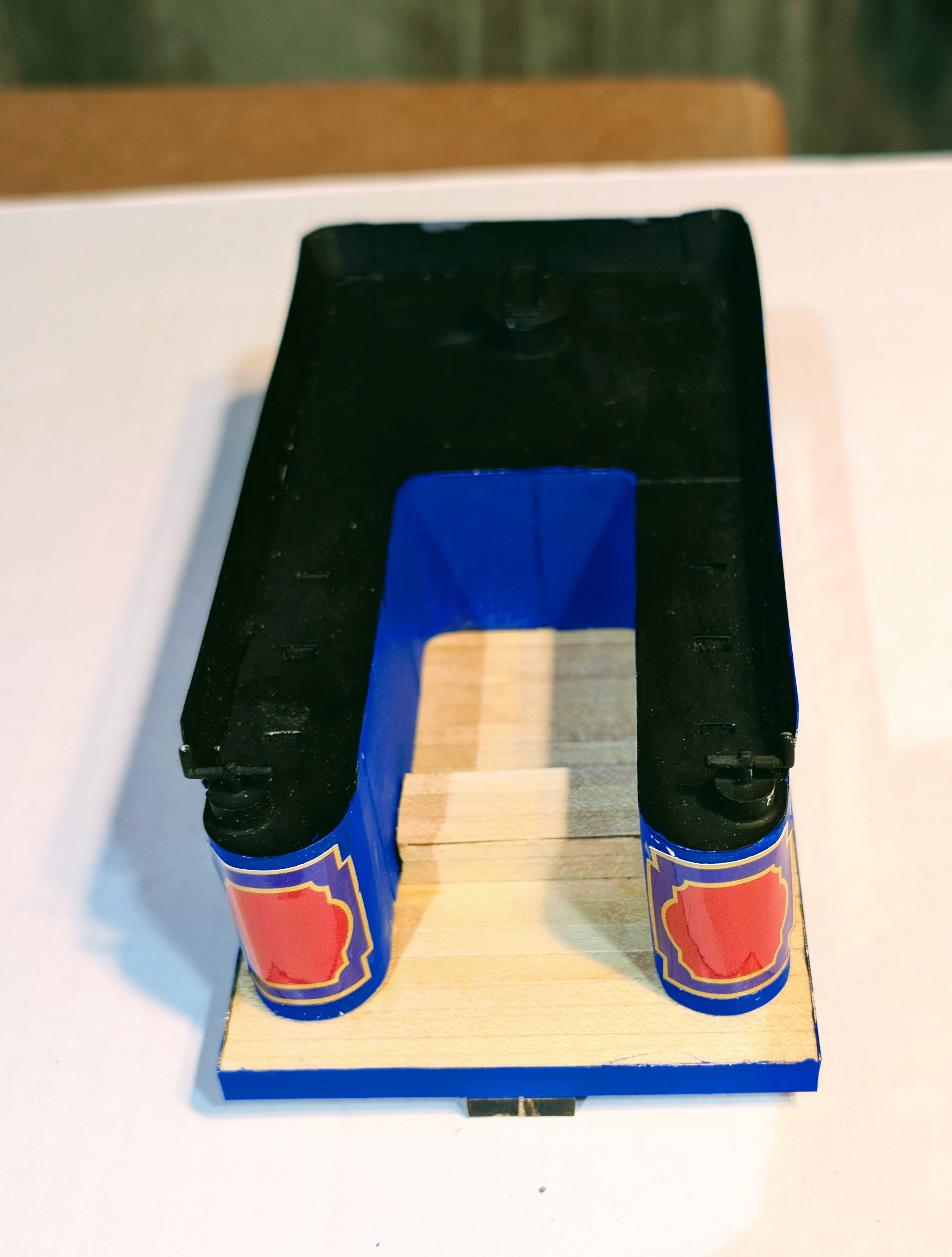

Planked the tender floor (I started to type "deck" out of habit, but this isn't a ship, is it?  😬).  While the instructions say to plank the whole surface, if you do that you will have to carve out the different slots and holes.  So I looked at where the tender body covers the floor and was able to hold off on planking across the holes and slots.  You can see that in the picture below.
Then some pics of the tender body with the floor mounted.

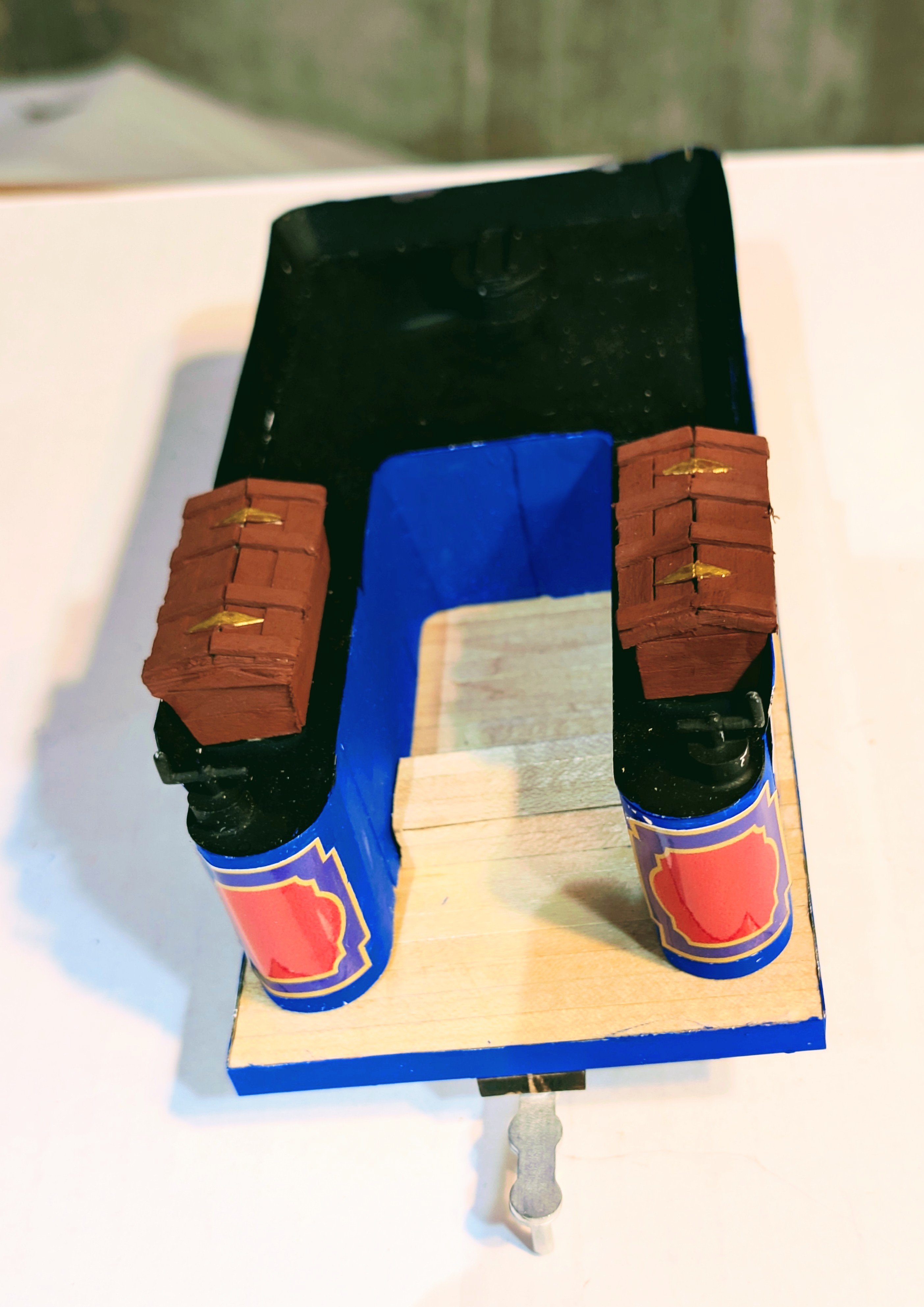

Tender body with storage boxes built, painted and mounted.  Coupler attached.

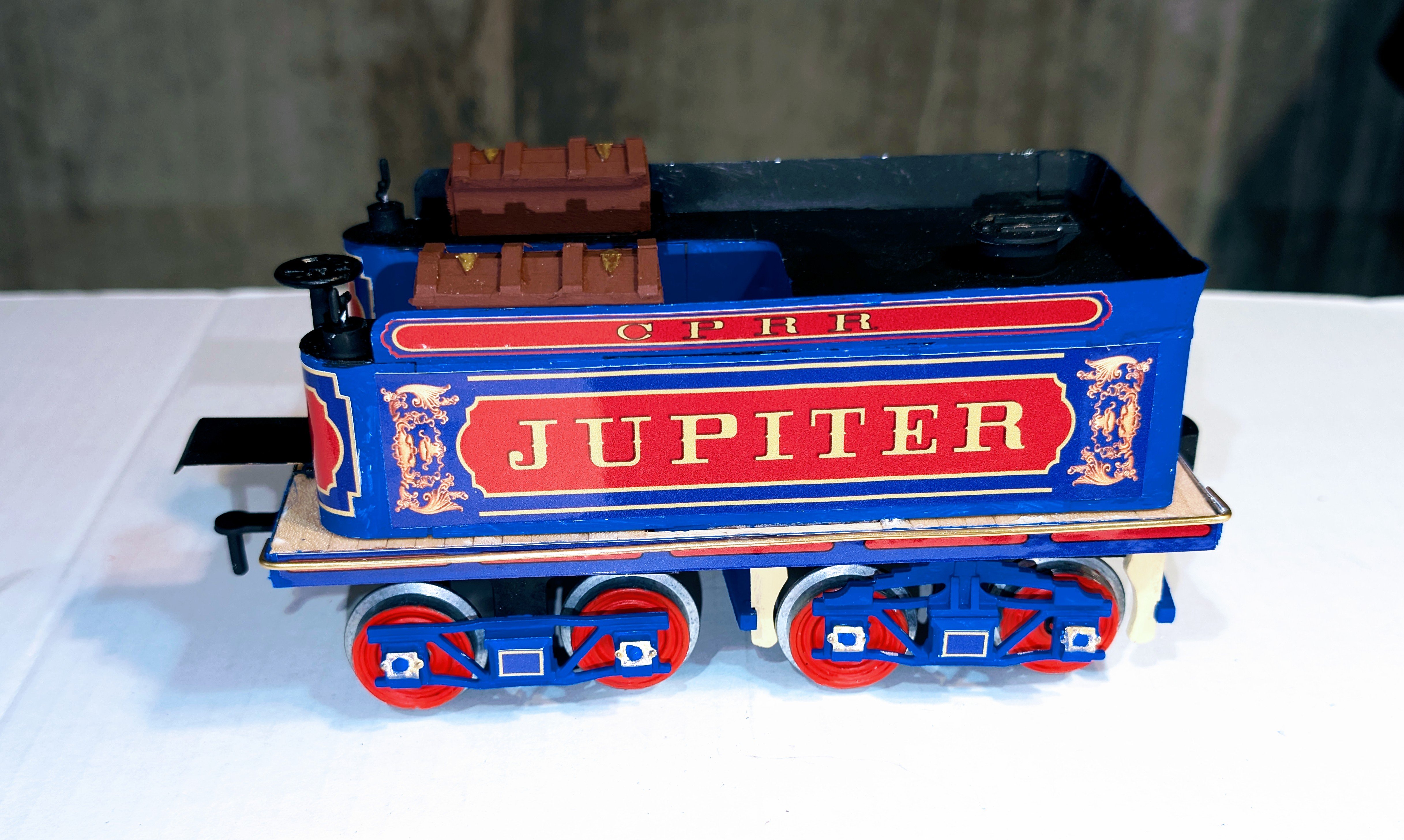

The forward truck assembly is complete, and mounted on the tender.

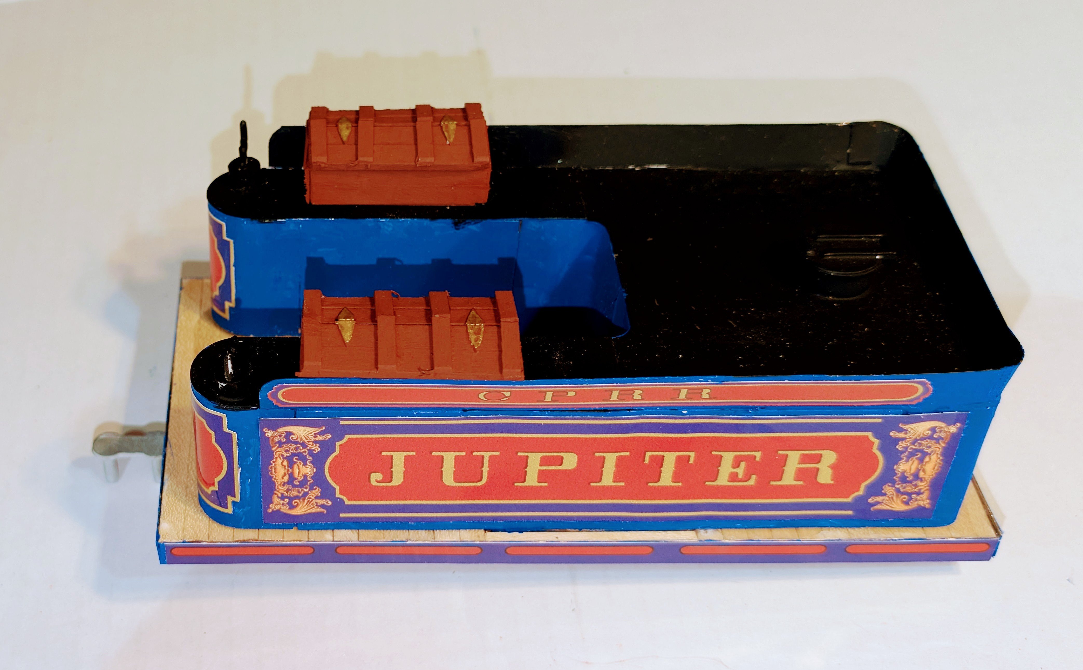

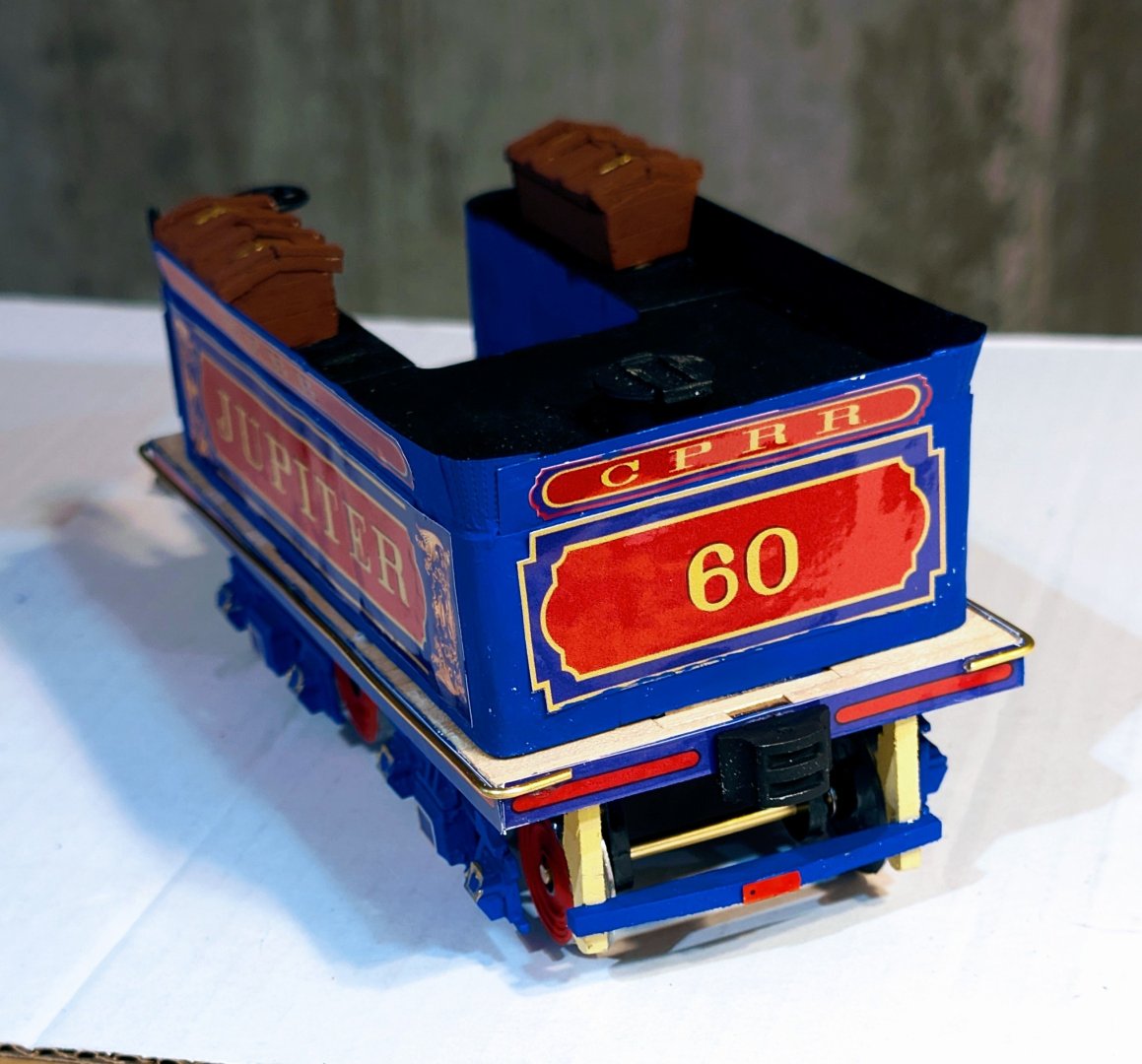

Finished the tender.  Now to do final touches and get it assembled on the baseboard.

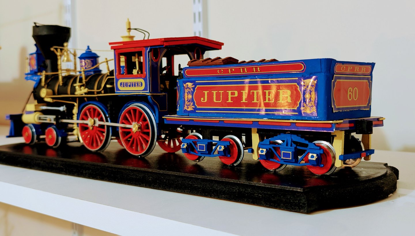

Jupiter is completed!
There doesn't seem to be a place in the Gallery for non-ship builds, so I have put my completion photos here.
This was a fun build.  A nice break from ships.
