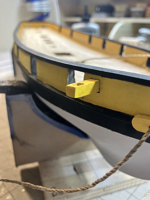

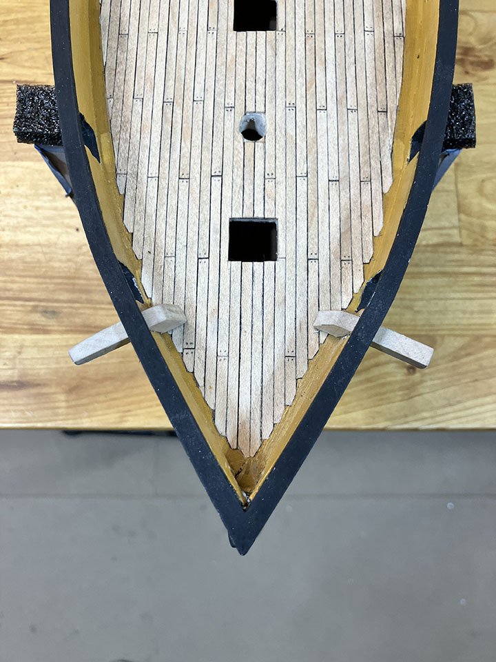

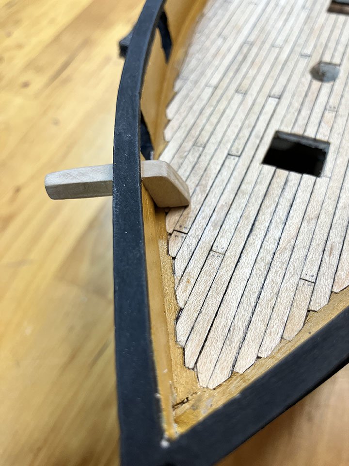

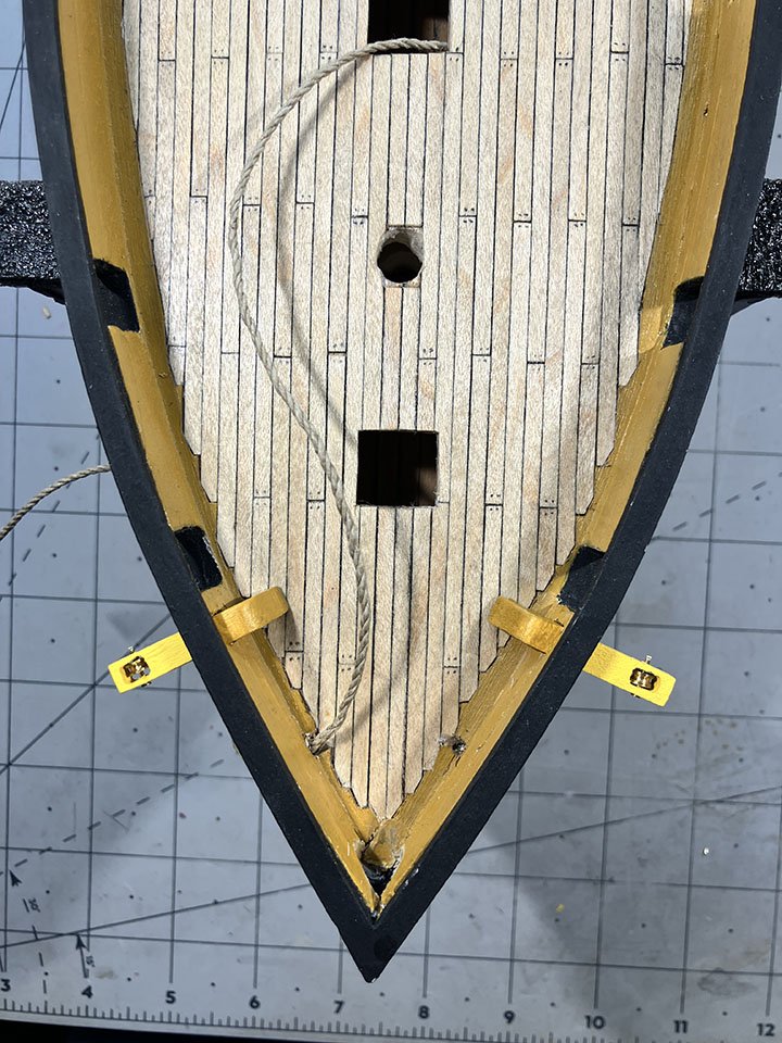

Today was the day to drill some more holes in my finished hull 🤔 I decided to install the catheads and the hawse hole covers. The catheads were first. I drilled a small hole and then filed it with a square pin file to match the catheads that I had made out of maple stock earlier on in the build:
Once dry fitted the procedure was then repeated on the other side:

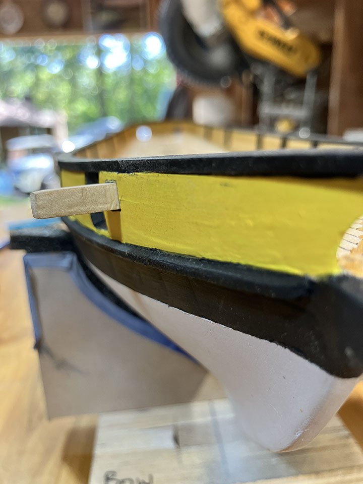

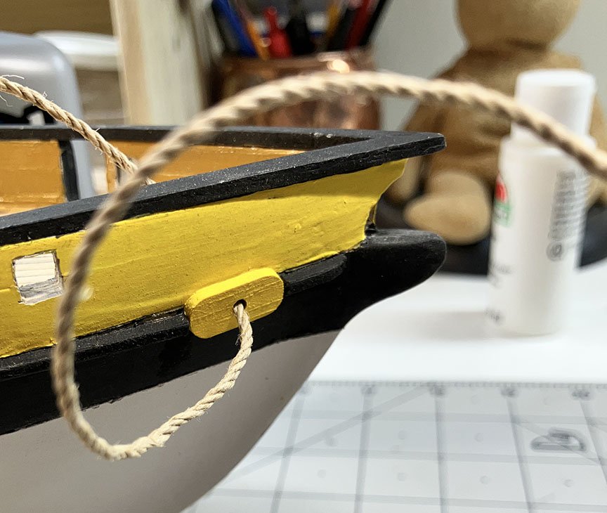

I removed them both and took them to my drill table to mill out the hole for the sheave. After drilling the hawse holes and making sure the anchor rope passed through them (at the time I took the pic only the starboard side hawse hole was done), I refitted both catsheads and glued them in place too (the sheave pins still need to be filed down - I was waiting for the spot of glue to dry first):
By the way, for the more astute readers, that is not the correct placement for the anchor rope and I know it :) It is merely "hanging around" there until I get the other holes in the deck done.

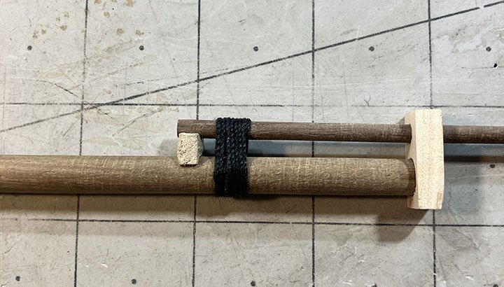

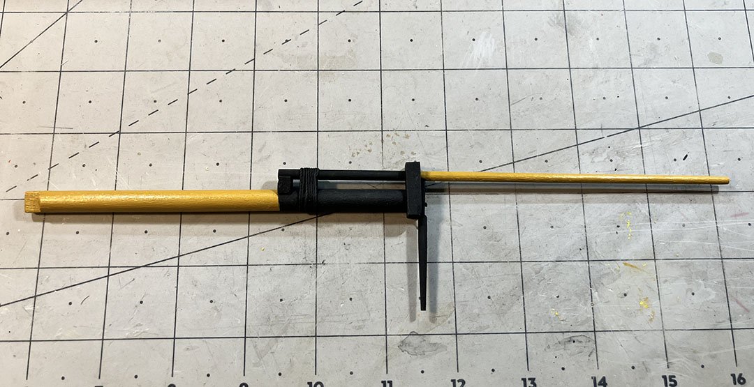

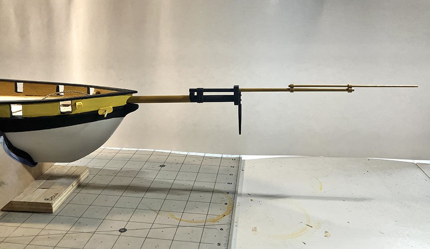

I still had some work to do on the bowsprit, it had not been assembled yet. I didn't get it quite finished today (the flying jib boom is still missing because I snapped it in half while I was sanding it down), but the assembly is coming along nicely. Here are the steps. I started by mounting the jib boom and securing it with the gammoning:
The Martingale was made from dowel stock and added. The whole thing was then given a primer coat and, once dry, a second layer of paint:
I hope to finish this work on the bow tomorrow but lately something always seems to come up that keeps me away :) As and when I guess, it is not a race :)

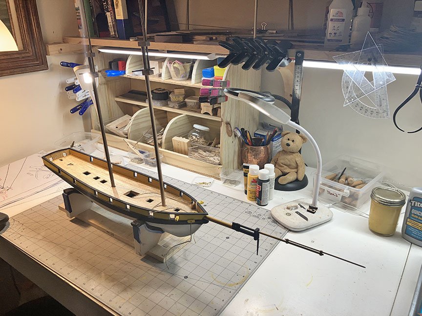

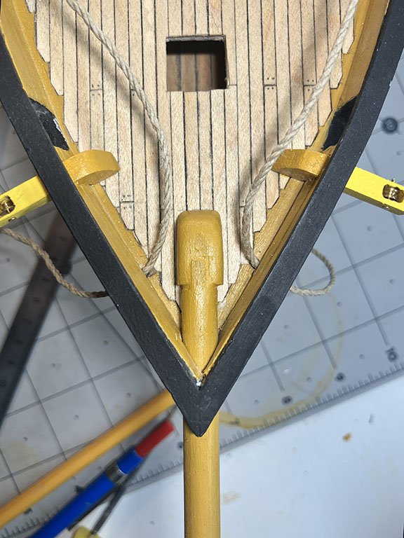

A small update on the build. I did a lot of fiddly work today, cleaning up a few things here and there. The cathead sheaves were filed down flush and the catheads were given another layer of paint:

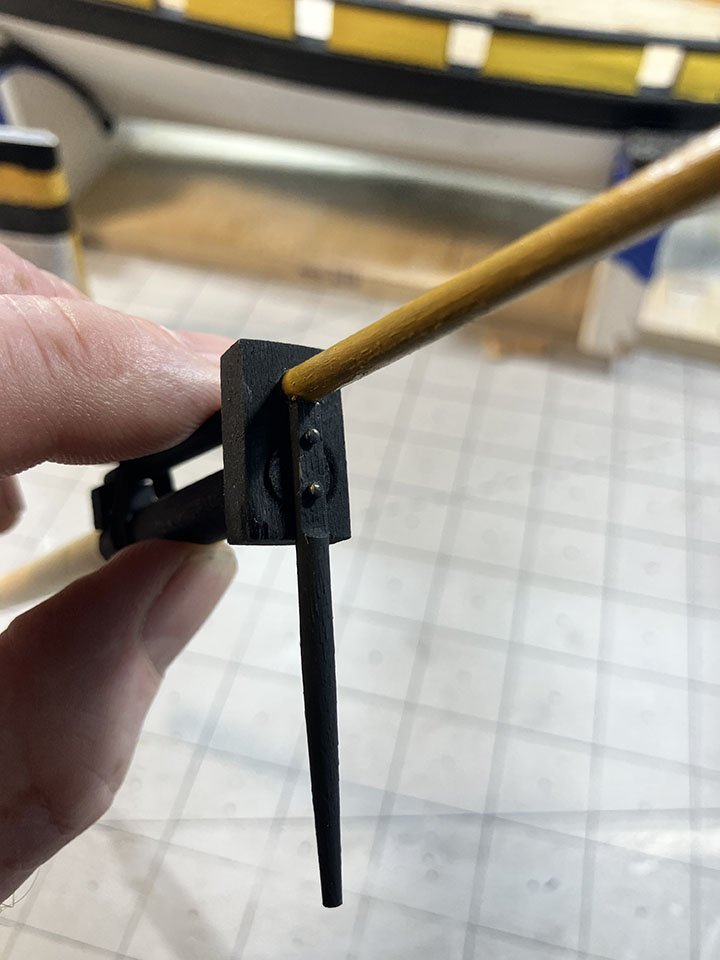

The bowsprit was finally placed and glued down. I cleaned up the butt joint and gave all that another final coat of paint. The strap will be added once the paint is nice and dry:

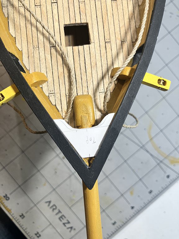

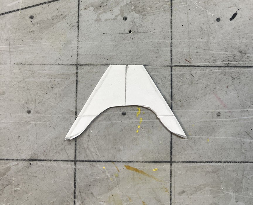

There is a "plate" that sits above the bowsprit butt joint. I am not sure what it is called (but I am certain someone here can tell me). The plywood kit supplied one was scrapped. I will be making one out of the maple I have used on this model before. I started by making a template out of card stock:
I will take this to the wood shop tomorrow and get it cut out on the scroll saw. With her bowsprit mounted she looks quite regal. I dry fitted the masts to get a good idea of how she will look. I am pleased with the progress thus far:
It’s called a breasthook!
