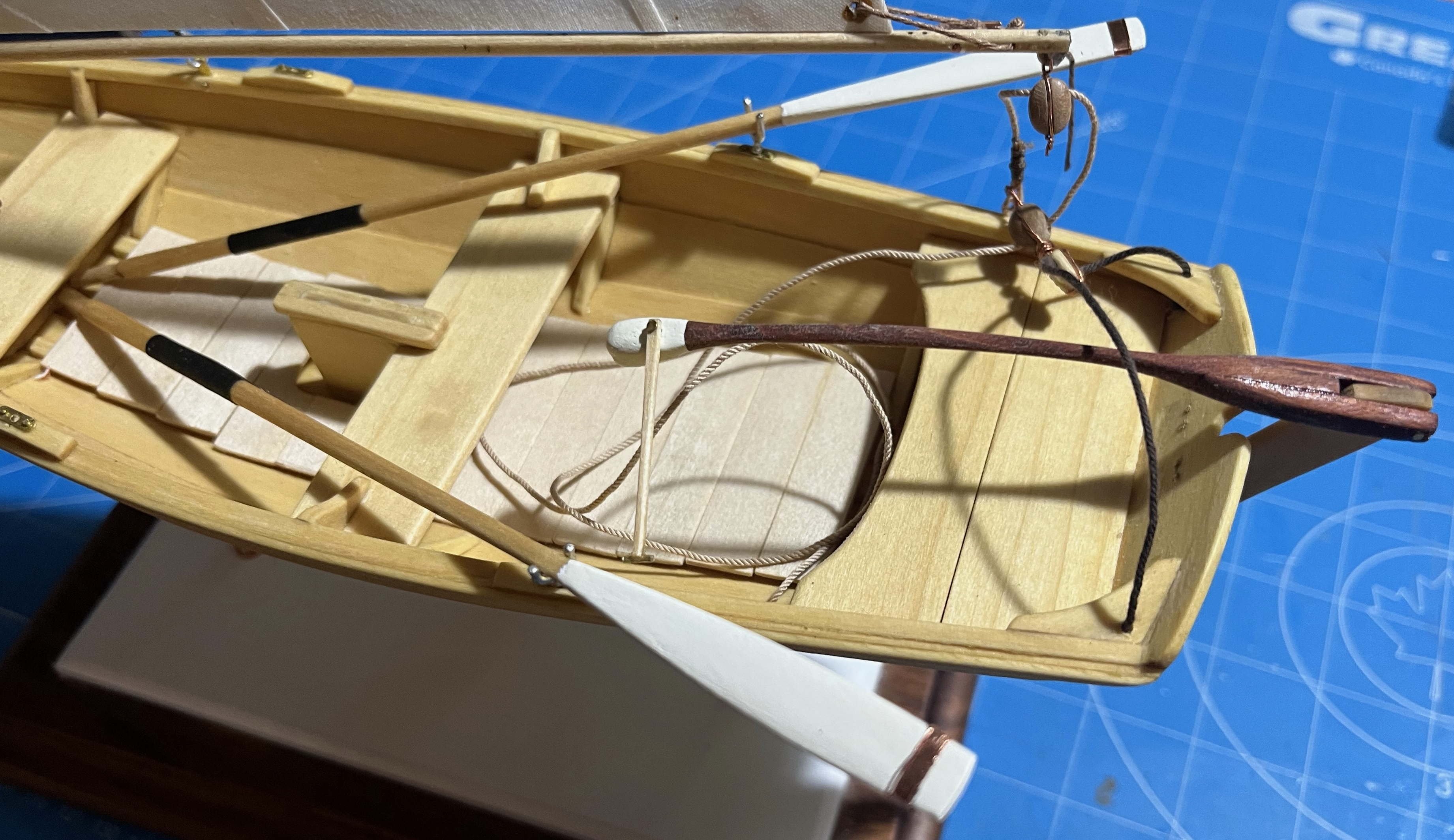

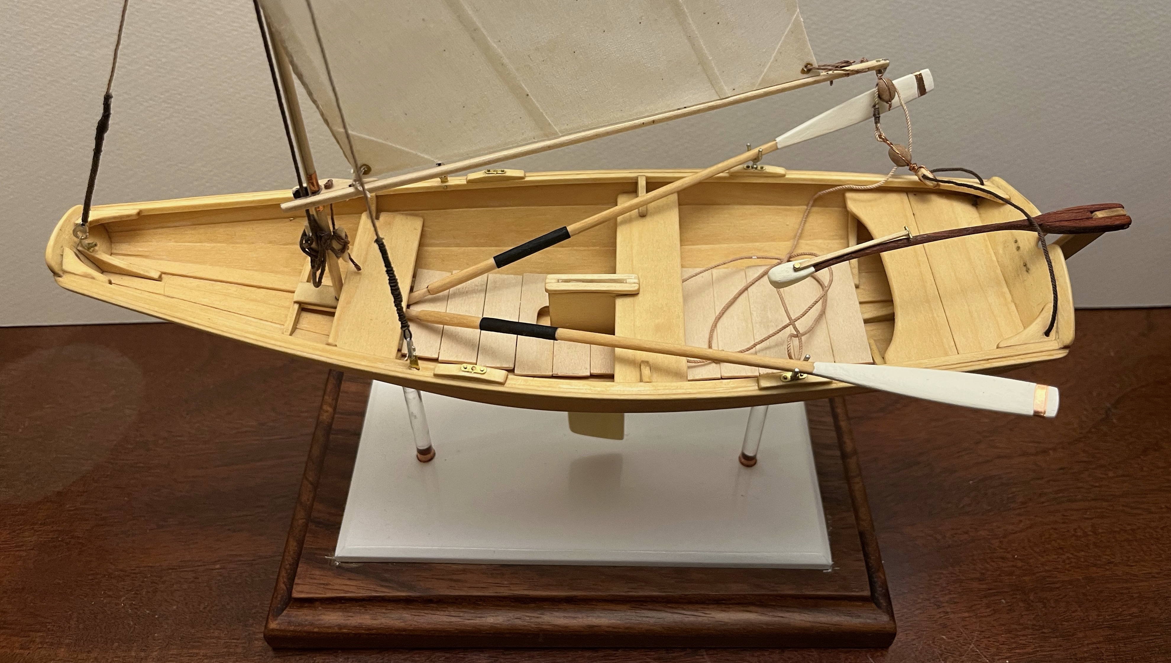

Oars and Rowing the Pram:
The pram is designed with two rowing positions, one for each thwart, and (many steps ago) I added the four wood-and-brass fittings for holding the rowlocks. (The latter are technically "crutches" but nobody remembers that!) The kit comes with four rowlocks and laser-cut blanks for four very elegant oars. However, I very much doubt that the full-size boat could be rowed by two people. Certainly, once the mast is stepped, an oarsman on the forward thwart would forced to sit ramrod straight, pulling with arm muscles but unable to use the power of his/her back. That would quickly prove exhausting. Even with the mast left ashore, two adults would have trouble: The one on the forward thwart would be forever hitting the back of the other, when leaning forward to bring the oars towards the bow to begin the next stroke. Maybe two small teenagers could row together but I see the pram as a boat for one oarsman -- one usually sat on the midships thwart but with the forward position available when going for a quiet evening row with a significant other draped across the sternsheets. (Politically correct here: I make no assumptions about the genders of the two!) With the weight of the decorative individual far aft, the oarsman would have to move to the forward thwart to maintain fore-and-aft trim.
So: Only one pair of oars aboard, usually used in the after rowing position (the one at the midships thwart).

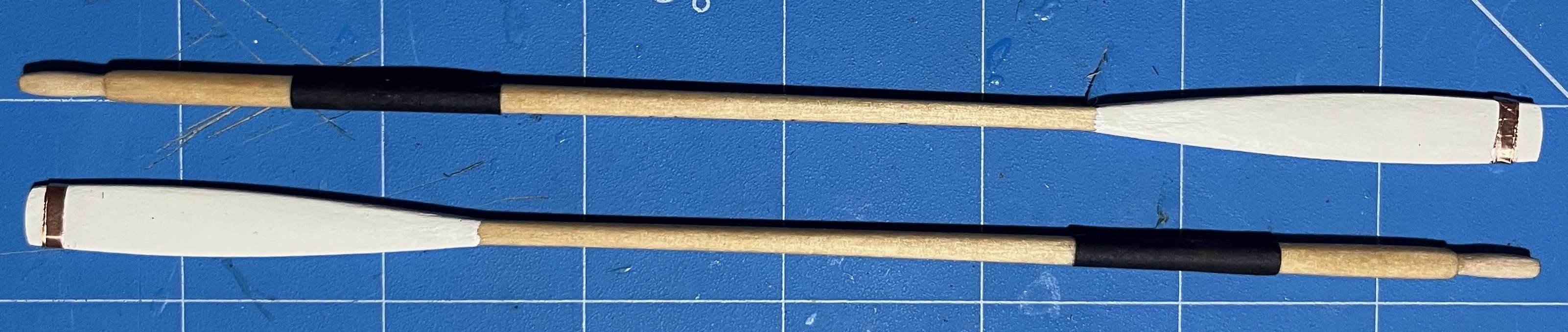

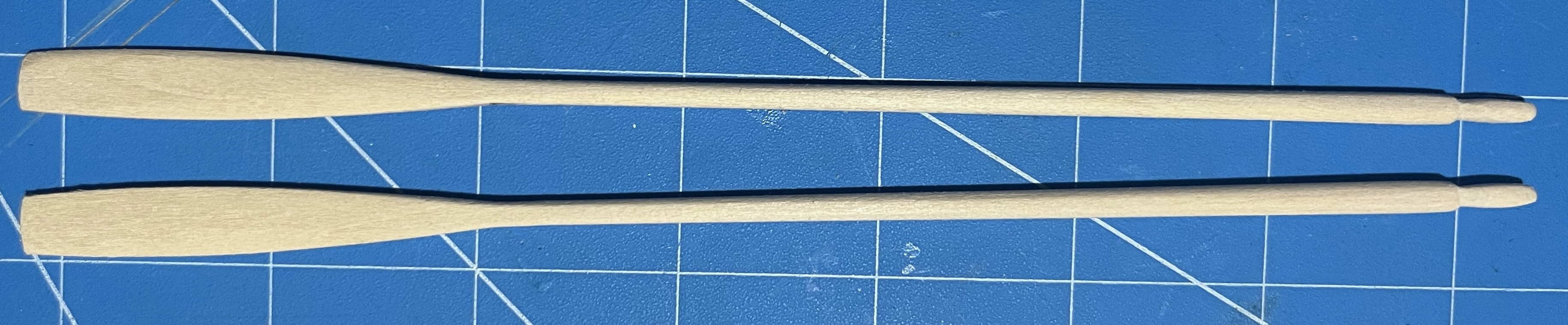

With that decided, preparing one pair of oars was straightforward and fully explained in the kit instructions, so no need for me to add much here. Mine turned out as:
Oar handles are supposed to be left as bare wood. (The idea is that your hands blister less. Mine get torn up anyway, so I wear padded weightlifter's gloves when rowing any serious distance!) To simulate bare spruce, I used the ModelExpo clear finish, as with my pram's floorboards.
The looms and shafts I did with tung oil, to simulate varnish -- as with the pram's hull. The blades I painted white, just for the visual effect on the finished model.
The leathers were placed as per the instructions, without trouble. I used 1-inch strips of the paper that I had dyed with leather die for "leathering" the boom jaws. The instructions call for raised "buttons" at the handle ends of the leathers. I did not deign to have anything of the kind on mine: Buttons are needed by racing oarsman, who have to concentrate on speed and power, so cannot spare thought for finesse. Otherwise, they are only needed by rubes who haven't learnt to row. So not on my pram, thank you 😀
Oars used to come from the manufacturer with a copper strip nailed just above the tip of the blade, supposedly to halt any splits that may start there. The kit instructions call for painting the tips to simulate the metal. However, Shaw & Tenney of Orono (https://www.shawandtenney.com) have deeper and wider knowledge of traditional oars than anyone else I know of, and they discourage the reinforcement. Not unreasonably, they advise that the nails holding the metal strip create more trouble than the strip prevents. (Having used the same pair of their oars for 20 years with no splitting, I cannot disagree.) My inclination, therefore, was to leave the pram's oar blades white. But I couldn't resist the visual effect of genuine shiny copper. So I sliced some adhesive copper tape in half lengthwise and stuck that on. Call it artistic license!
The remaining problem is what to do with the oars because, in truth, the kit ones are much too long for such a small boat. Even with the handles slightly crossed in front of the oarsman's chest, in the approved posture, so much of the oar would be outboard that the poor guy would wear himself out fighting the weight of the oar instead of working at pulling ahead. The trouble is even more acute with the sailing rig in use and the oars merely stowed (awaiting a need -- such as when the wind dies to a mirror calm and the sailor is called home for the family dinner). In fact, my choice for auxiliary power in such a boat would be a canoe paddle, rather than oars.  Still, it would be a shame not to display the pram in all the glory the kit can provide.
After some thought, I chose to show the one pair of oars in their rowlocks, with handles tucked under the mast thwart -- where they would be a nuisance while sailing but secure and ready to hand as the wind fails and the sail hangs like the flat board that the kits provides for. Rowlocks are glued in with CA, to avoid losing them, but the oars are loose.
So, my version is:
Now I just have to tidy up the running rigging.

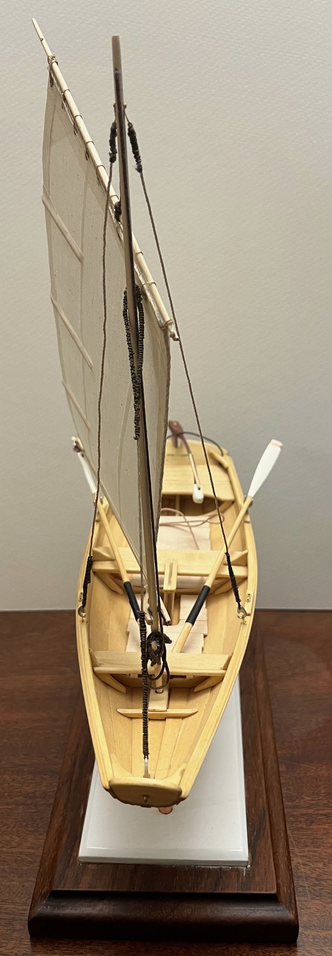

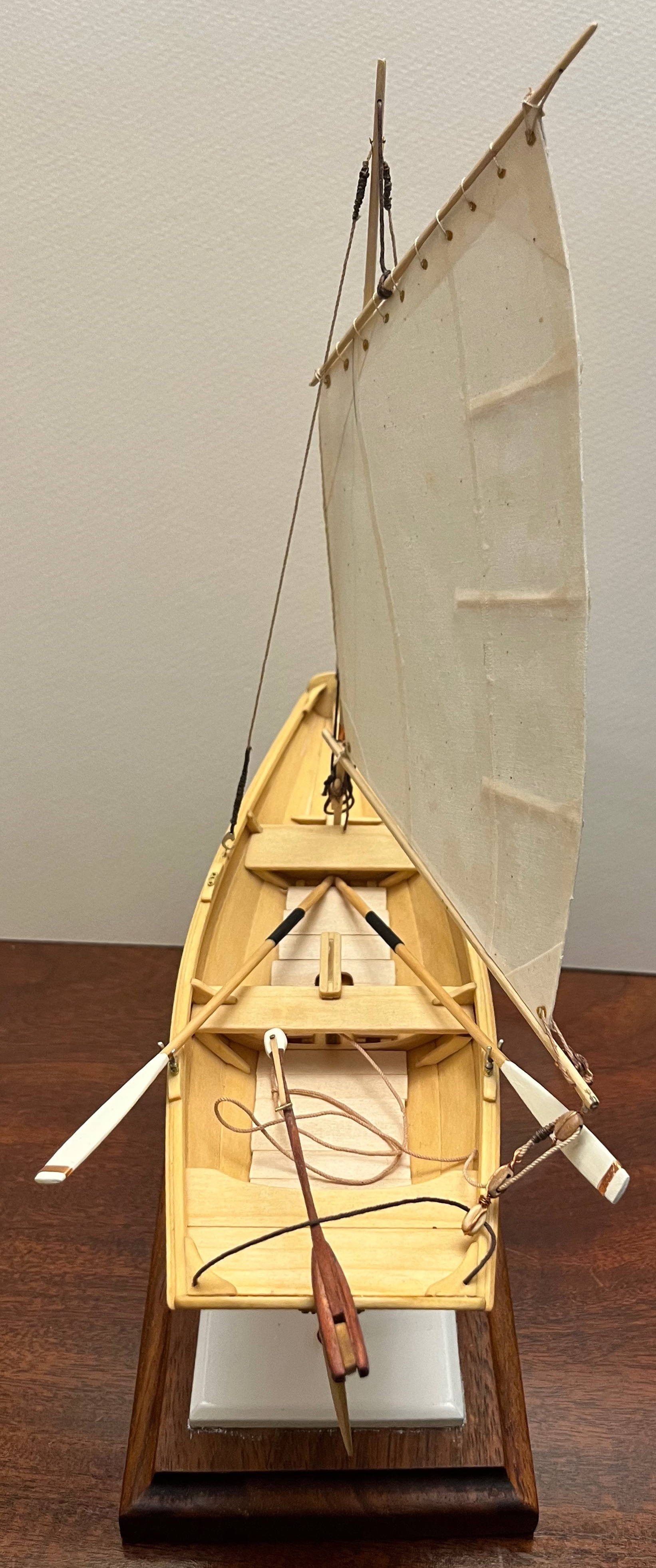

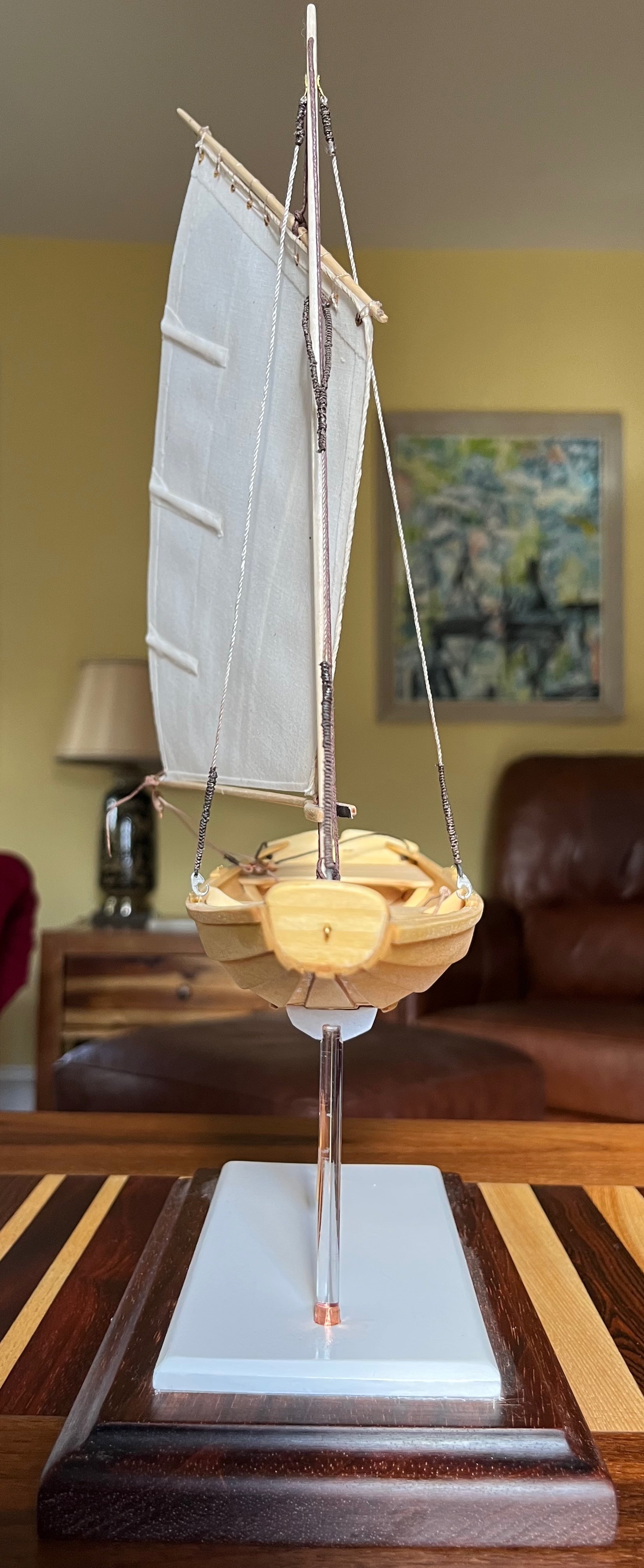

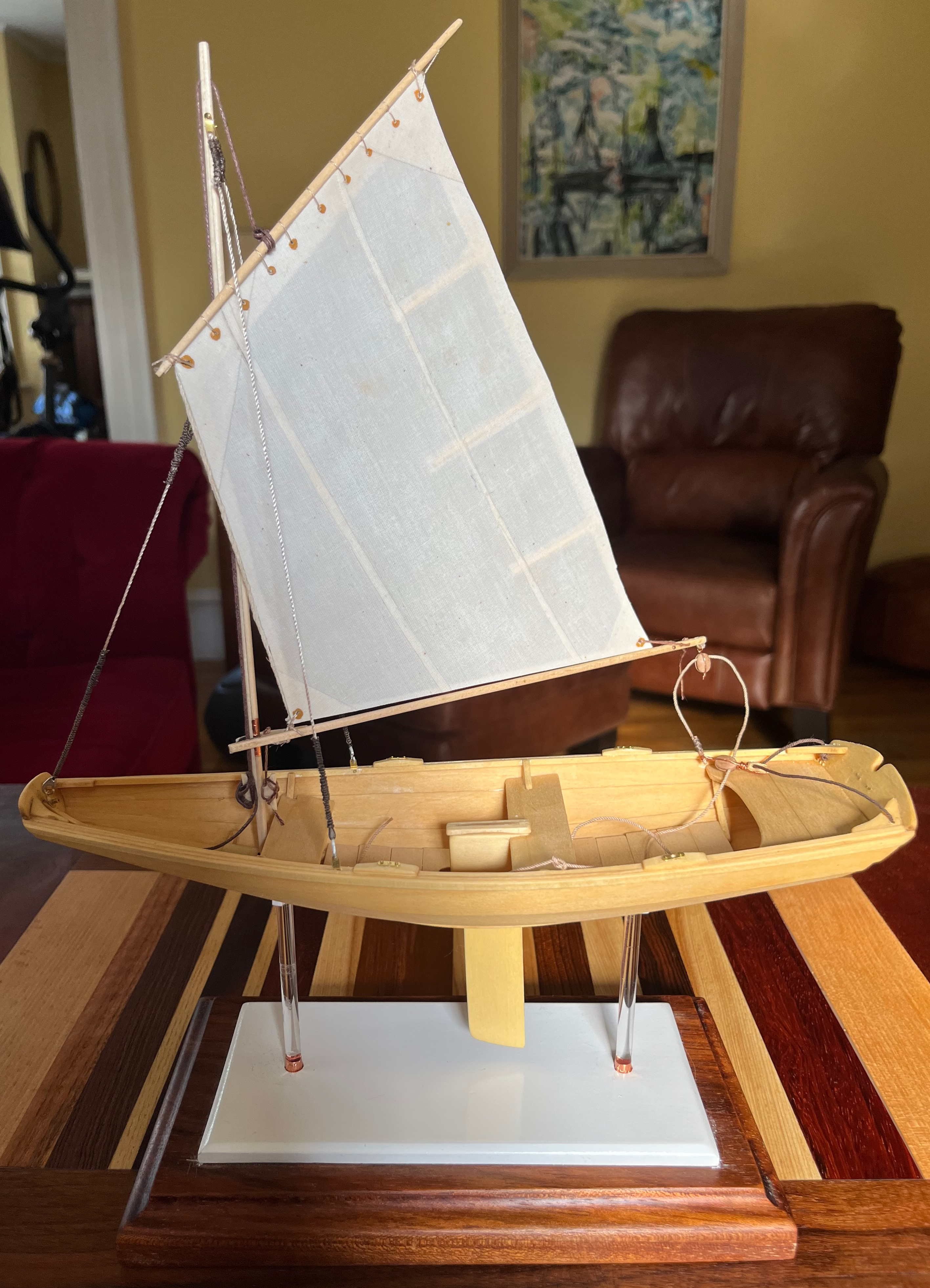

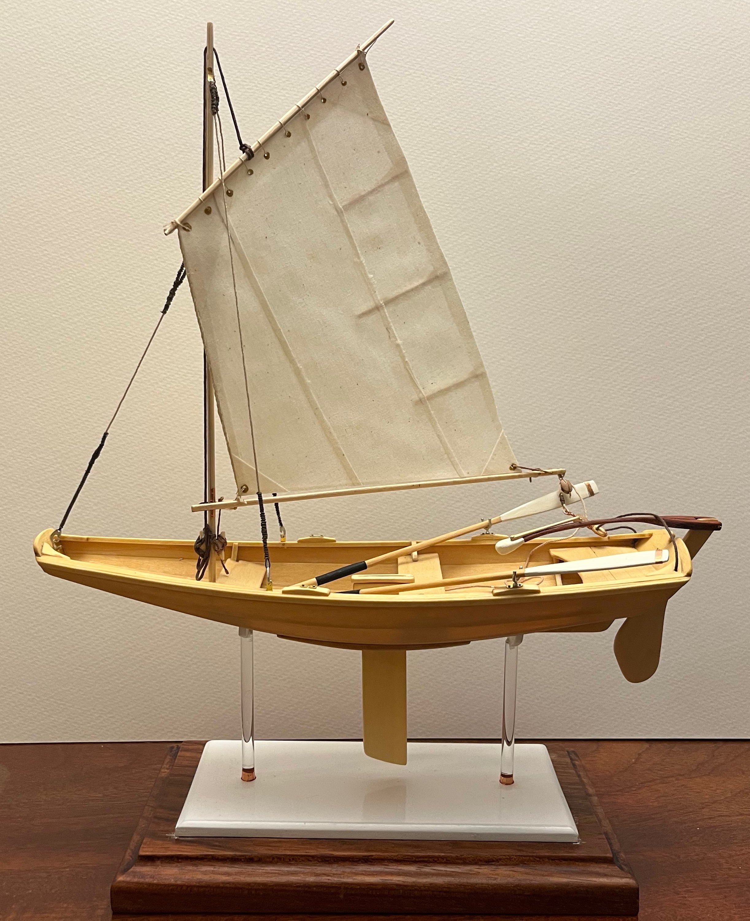

FINISHED
Or that's what I'm declaring anyway:
Finished1.thumb.jpg.62f6069dfd73b3ff101eb0765344952e.jpgFinished3.thumb.jpg.f19e22993c00870801fccb14520b67f6.jpg Finished4.thumb.jpg.ae25297e18160ec1f4746837e97b96c7.jpg
In truth, that mainsheet is refusing to lie quitly where it wa put, so  it will likely need more attention with white glue:
But I'm still calling the model "finished". This build log isn't quite done though. However, my final thoughts will have to wait for morning: The 7th game of the World Series is nearing its climax as I type!
Trevor
Congratulations, great work! You've added a lot of personality to the kit.
Great looking boat, Congratulations, :cheers:
