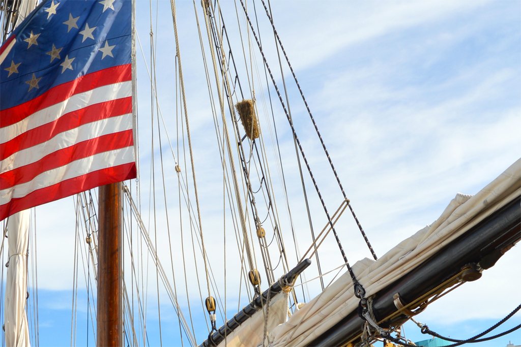

Chafing mats, also referred to as "service," were placed on ropes that rubbed against sails and caused wear on both the rope and sail. Here are some examples:
chafingmat1.jpg.17831045a5c1c17939e882d640cbffaa.jpgchafingmat2.jpg.e88d47d9941158e8ddfbe6f9b2479014.jpg
These photos are of the replica vessel Lynx.
Several sources indicate they were made up of bits of worn rope and canvas, sometimes called "baggy winkle."
I am looking for ideas for making representations of this stuff for scale models.

Three different things. Dr.PR's arrows point to baggywrinkle. "Service" is twine (usually tarred marline) wound very tightly around a larger rope. Chafing mats come in multiple forms but they are rope mats.
Ashley's shows them all.
Trevor

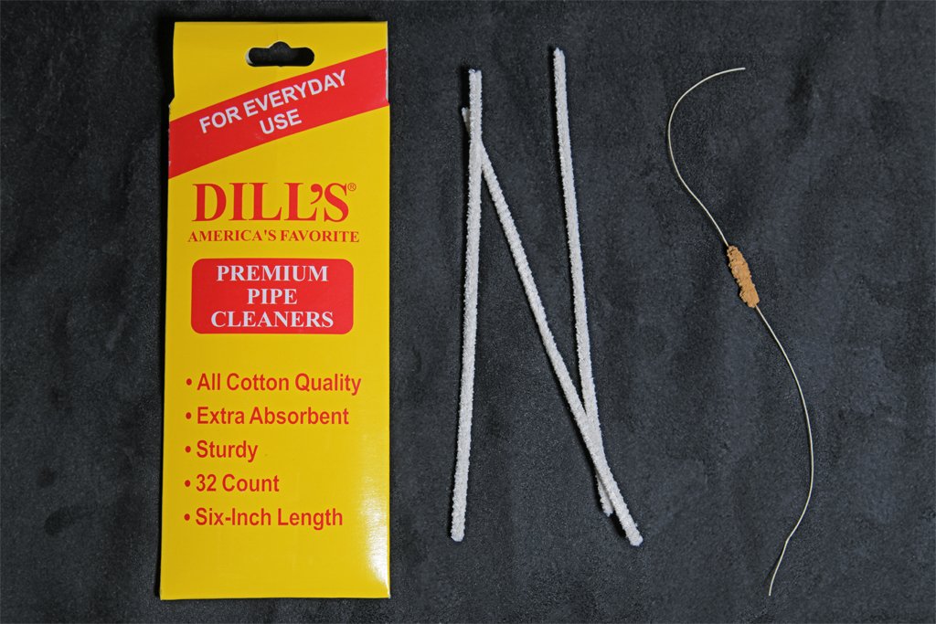

Then I got the idea to use one of my standard tools/building materials - pipe cleaners!
I don't smoke, but I have had this package of pipe cleaners in my modeling kit for decades. They are handy for cleaning out small orifices and such.

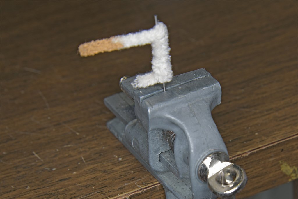

First I clamped a small drill bit into a vise. Then I wound the pipe cleaner around it tightly, leaving short "handles" at each end.
Here you can see I was also experimenting with coloring the mat. The pipe cleaner material is cotton, and cotton absorbs water. I dabbed on some acrylic paint to give it the color of "used rags." The paint soaked up nicely.

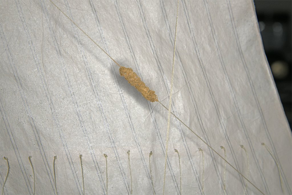

I am adding these after the boom lifts were already rigged. The trick here is to pull the spirals of the mat open. This allows the rope to be wrapped into the gap between spirals. But that means the rope must hang loose while you are wrapping it into the mat.
The standing part of the boom lift running tackle is hooked to a ring bolt on deck. The lift wasn't installed tightly so the hook came loose easily. This allowed the lift line to be wrapped around the mat.
After it was in place I cut off the "handles" and touched up the paint.

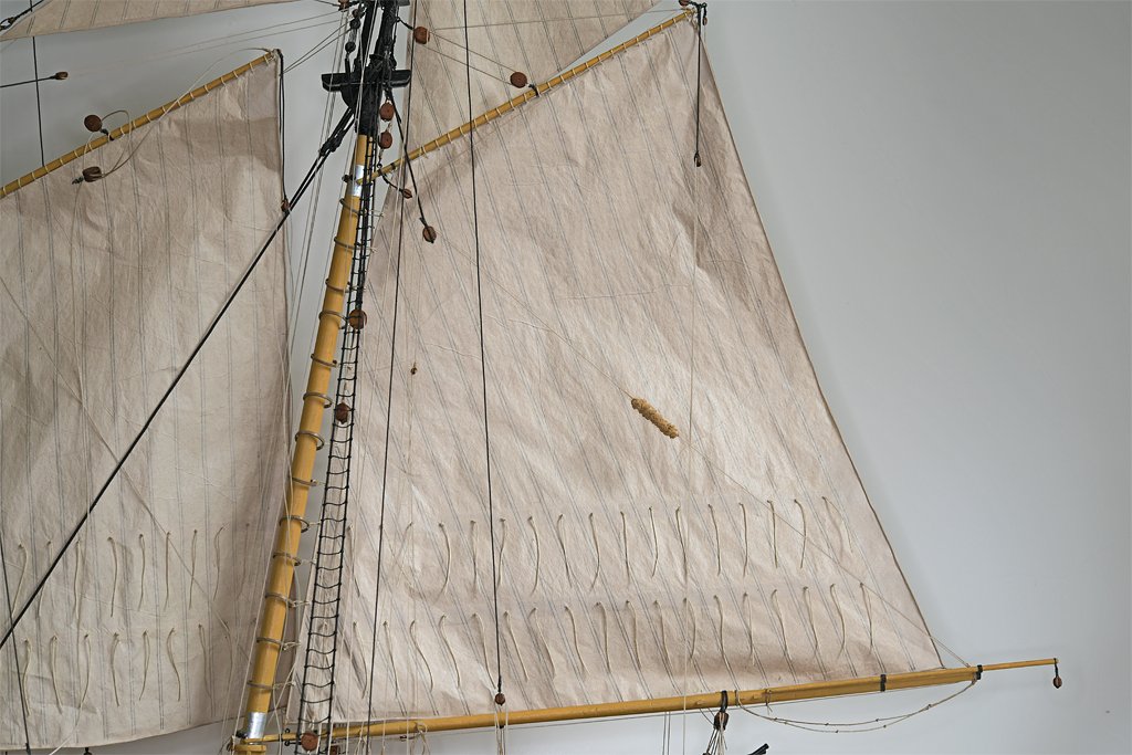

Here is a photo (left below) of the baggywrinkle on the model's boom lift. The photo on the right is a mat on the replica schooner Lynx.
Baggywrinkles4.jpg.021559fc4b75a9ccf206c4348125a7ad.jpgBaggywrinkles5.jpg.ad686ffcae38a3b160843637d7fc1dfc.jpg
