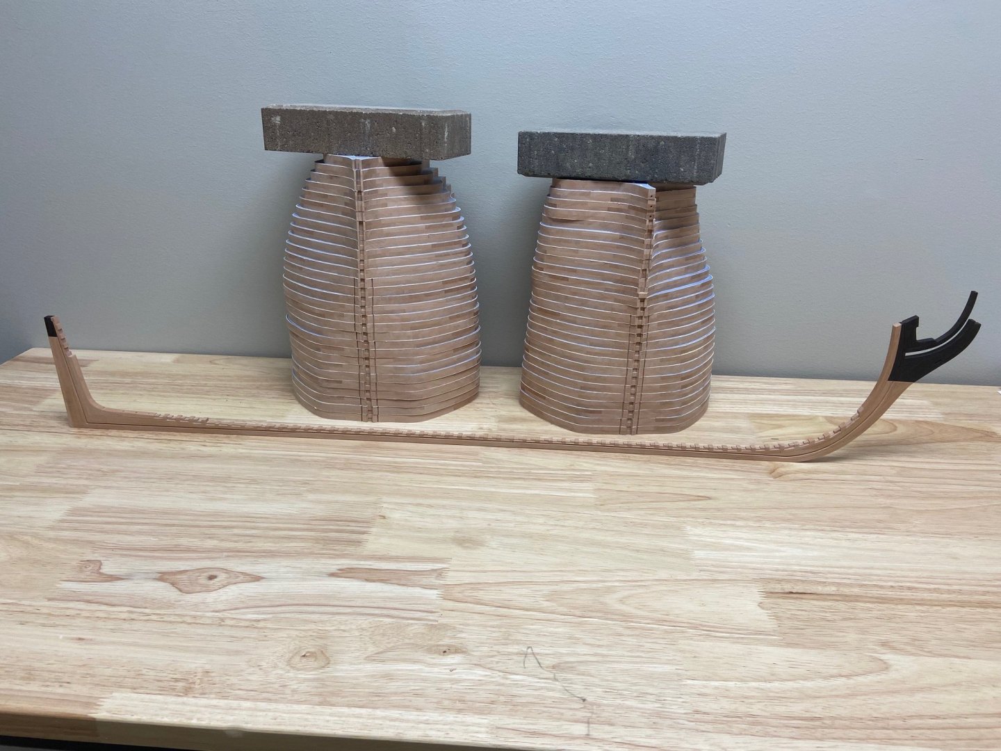

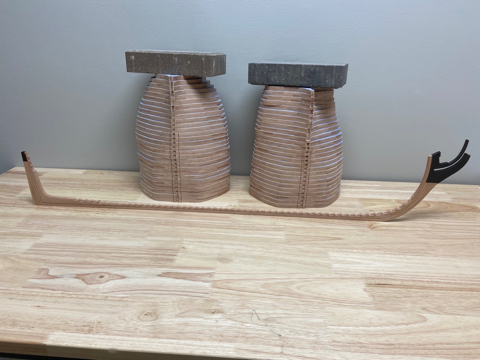

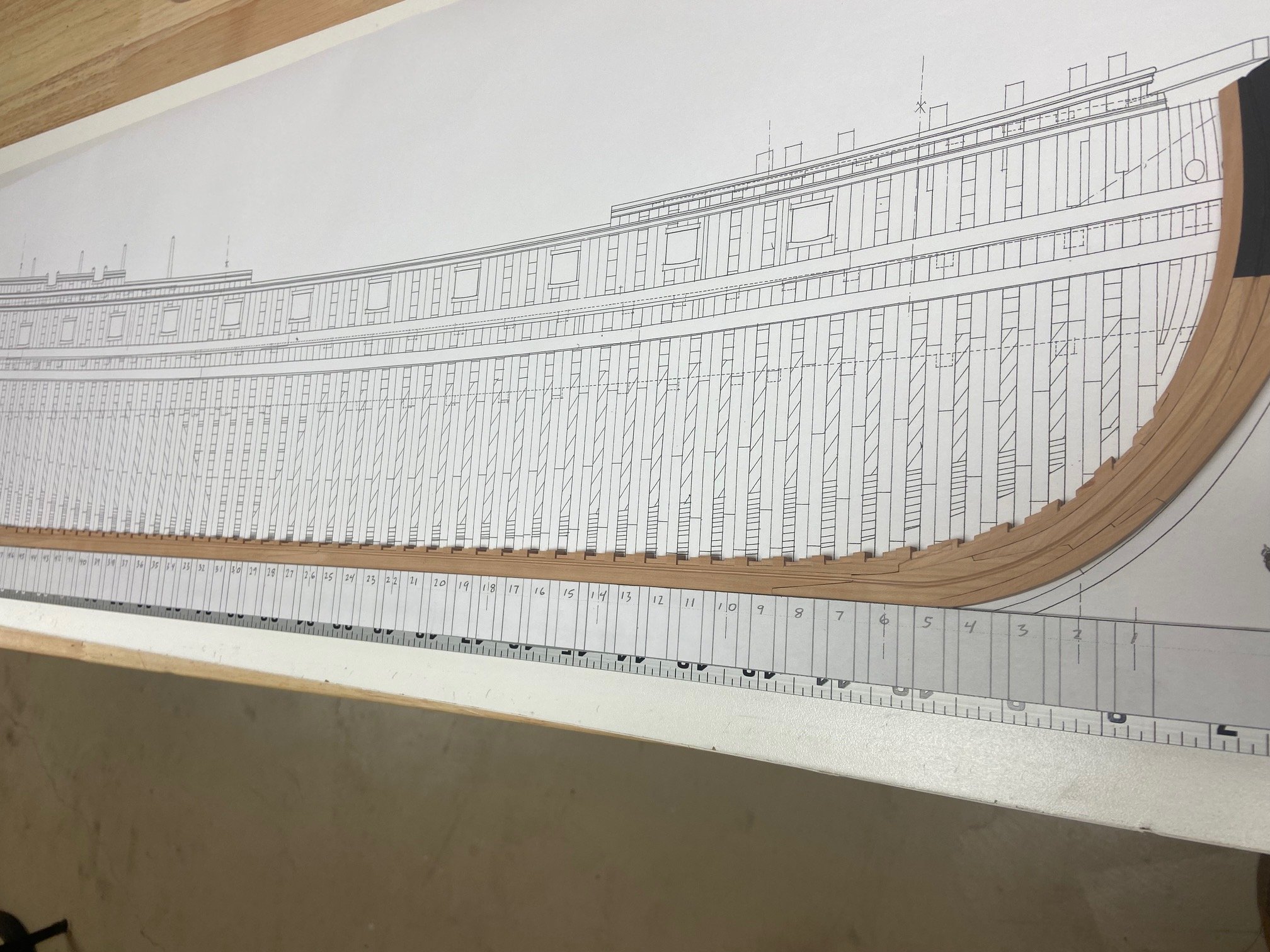

Those frames will never get away.... Seriously, that is a very nice keel assembly. Looking very good.

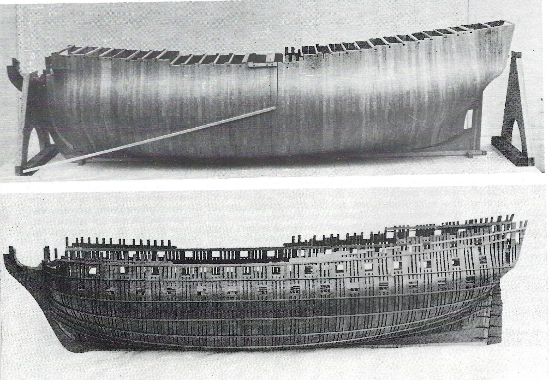

Great job Chris! It looks like those frames should fair in nicely. Your photograph reminds me of the famous Egmont model by John Franklin (Model Shipwright series) in which he assembles, fairs then separates the solid hull and reduces the frames to achieve the Navy Board appearance. His method is not commonly used (except by miniaturists) but seems to have many advantages over the way we currently build them.

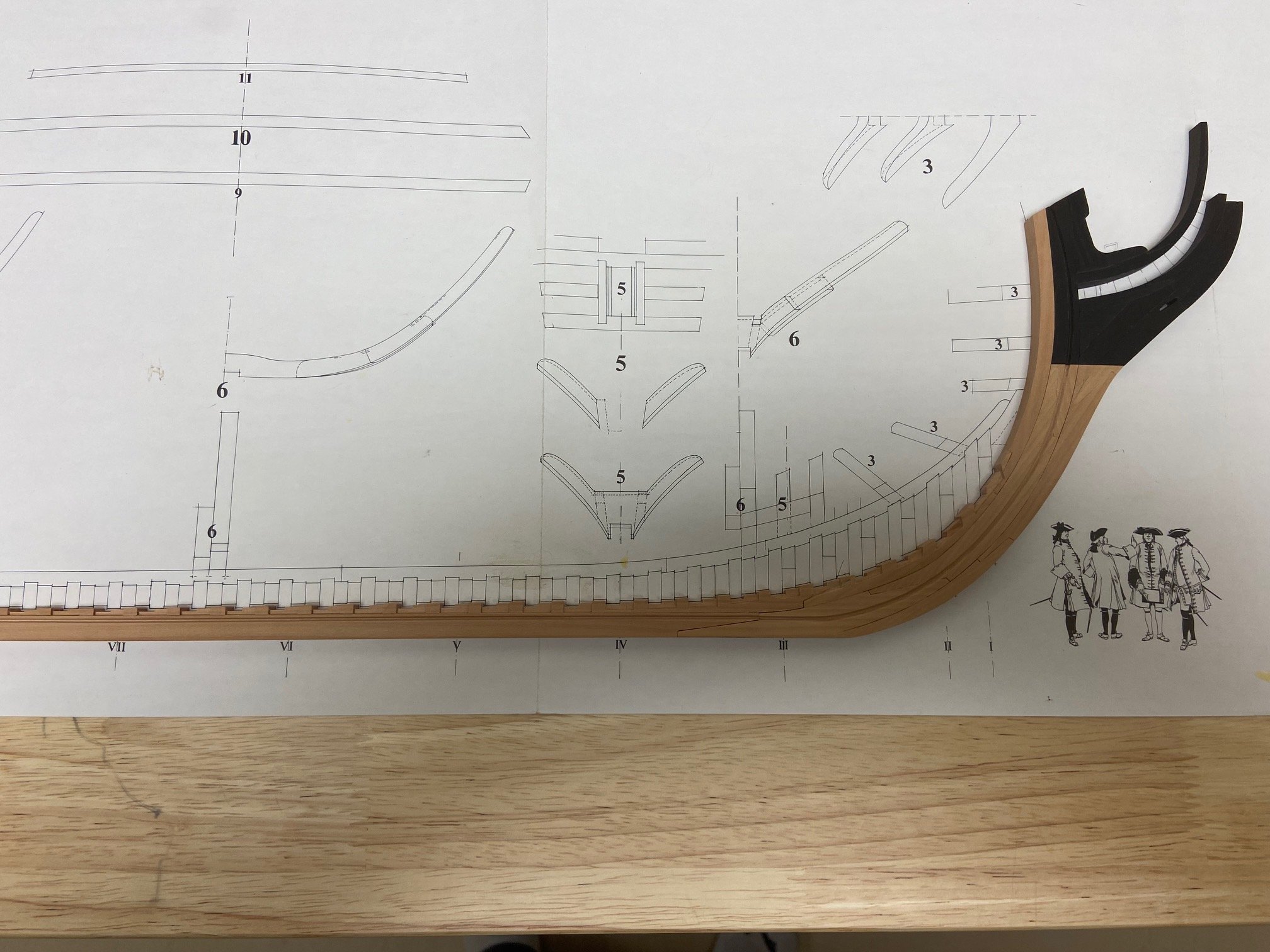

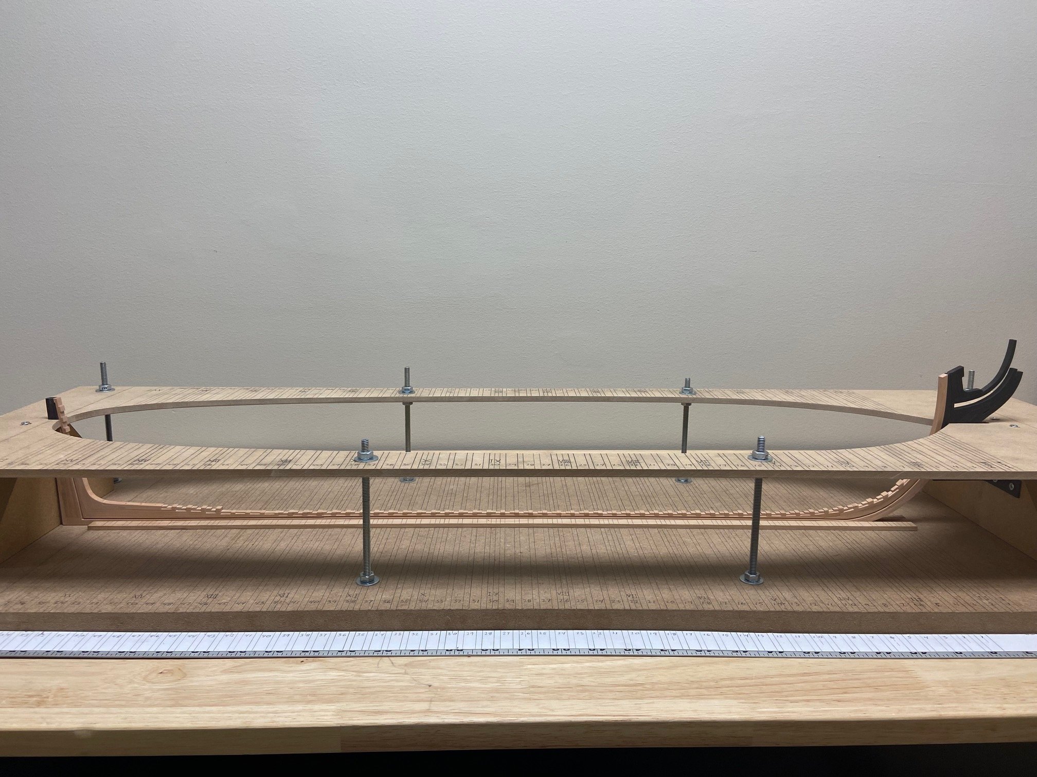

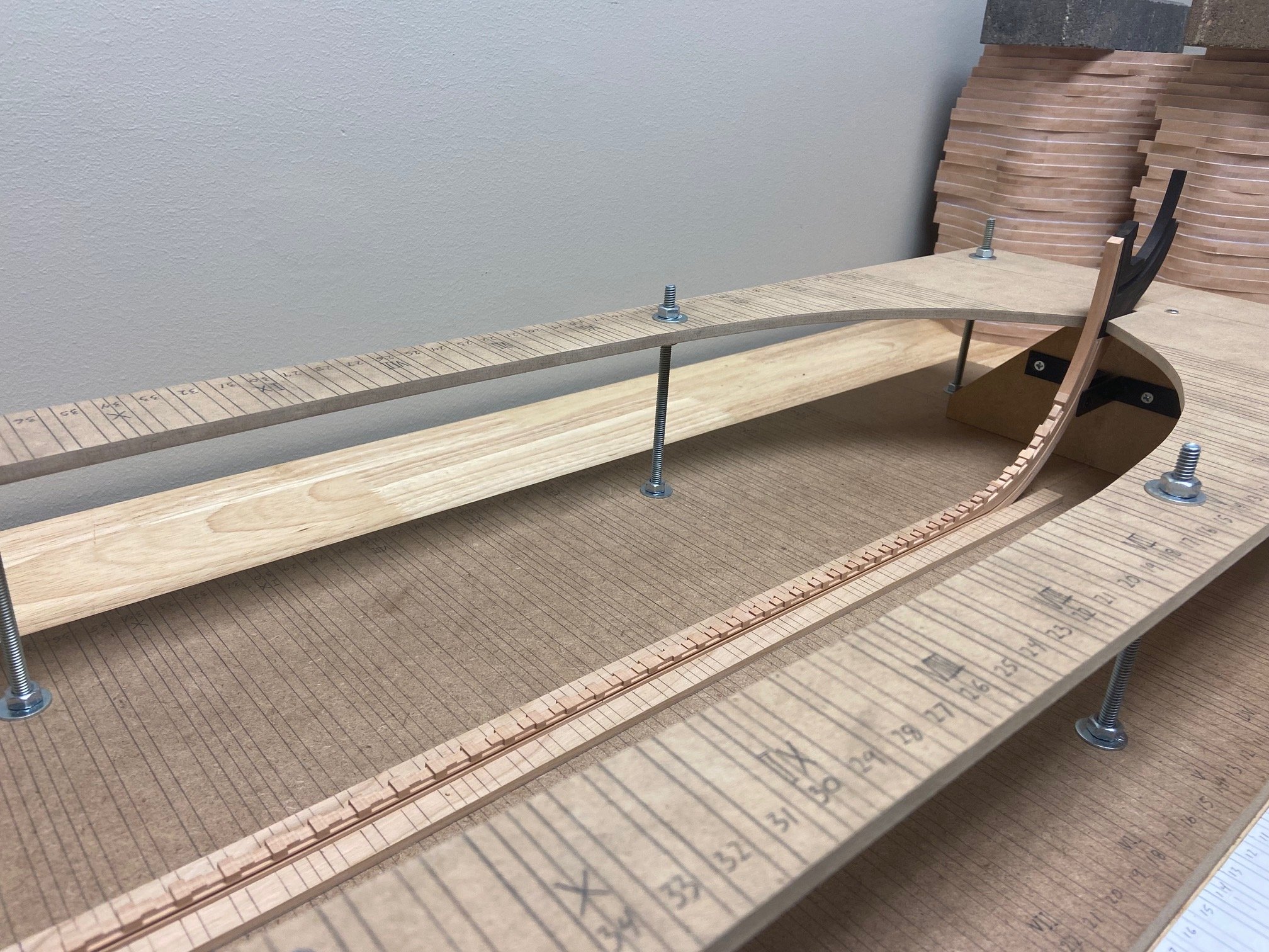

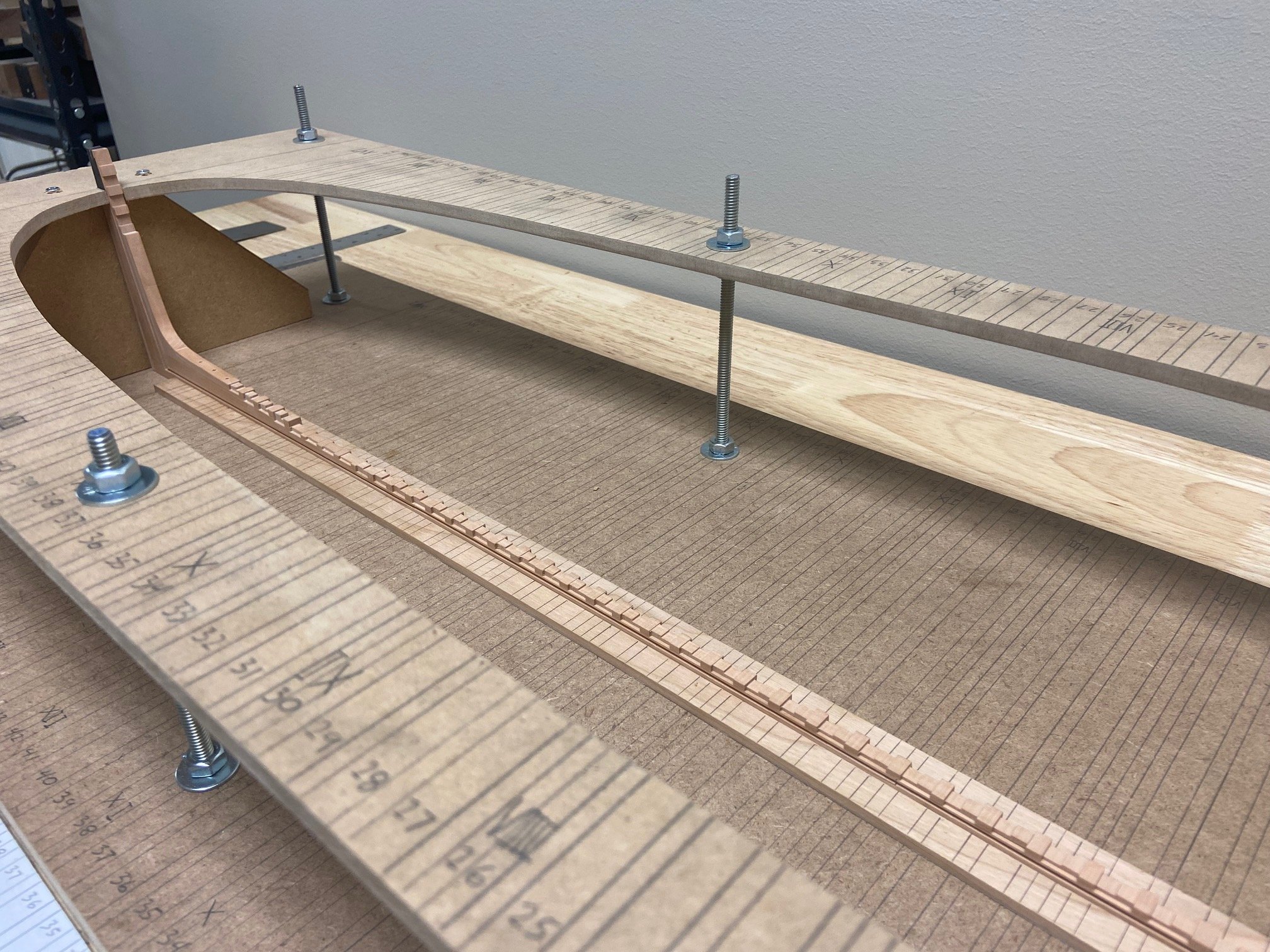

Thanks gentlemen !  Thats a really nice reference Greg.  I really took my time with these assemblies so I am hoping for a nicely faired hull.  I am about to proceed with the construction site and make sure its exact to give myself the best chance of success here.

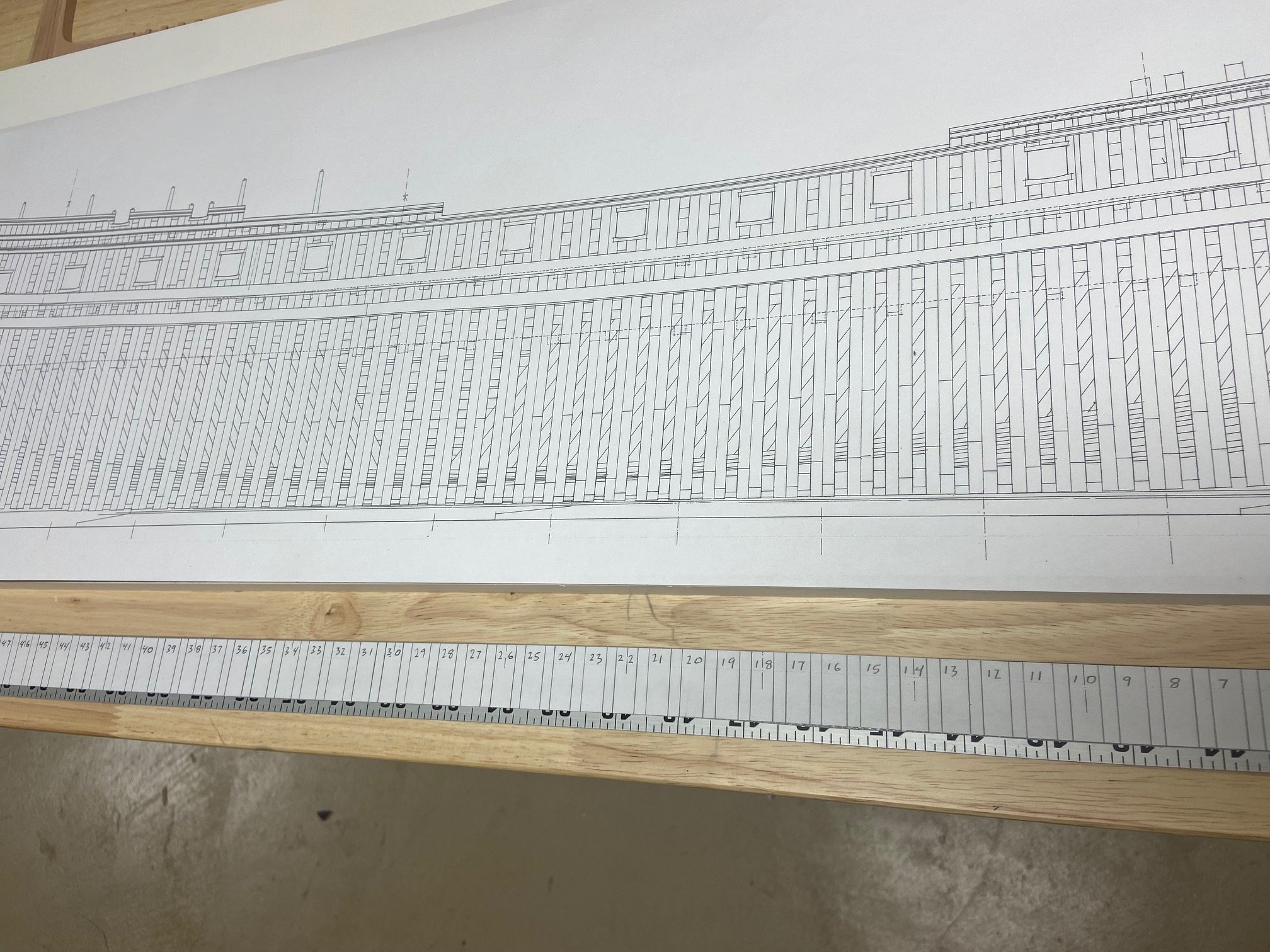

The principle of a tally stick or tick strip is an old and very reliable one for transferring measurements error-free. You will find this very useful in many applications while building a model, Chris. I have a small pile of paper and card strips that I use for the purpose.

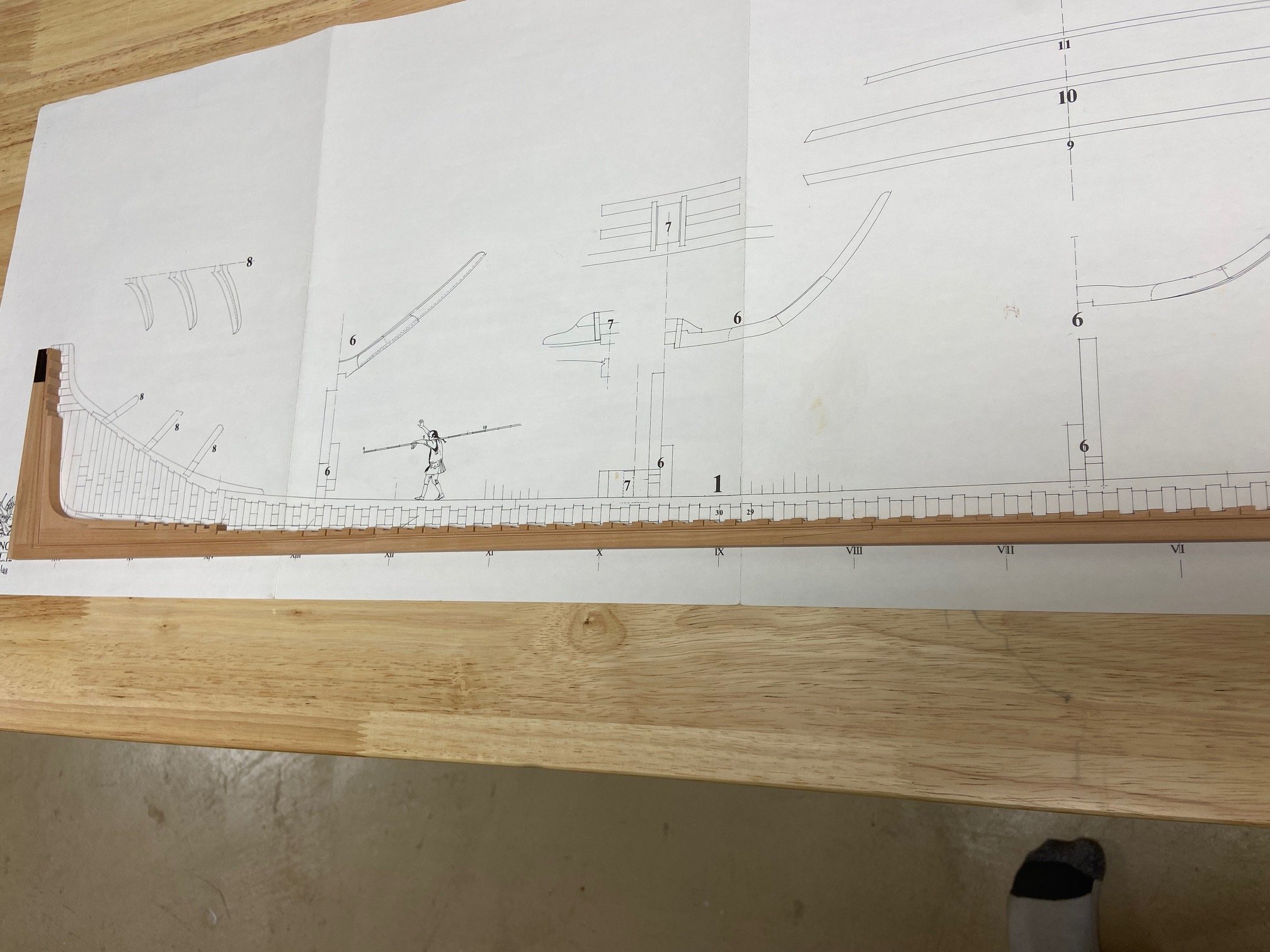

Would it be possible for you to describe / explain how you were able to part these rising wood pieces off? I have been struggling on how to tackle the corresponding parts on my L'Invention build.
Thanks,
Greg
Sure Greg,
I took a piece of 7mm by 8mm (same dimension as my keel) piece of pear and milled the horizontal notches on top - then flipped it to each side to complete the corresponding notches.  Lastly I used a chisel to i finish the notches where they rise above the cut line (Cut line being the bottom of the side notches that sits above the keel proper)  Then I severed the top piece using my Byrnes table saw.
Actually one of the easier operations so far on this build....

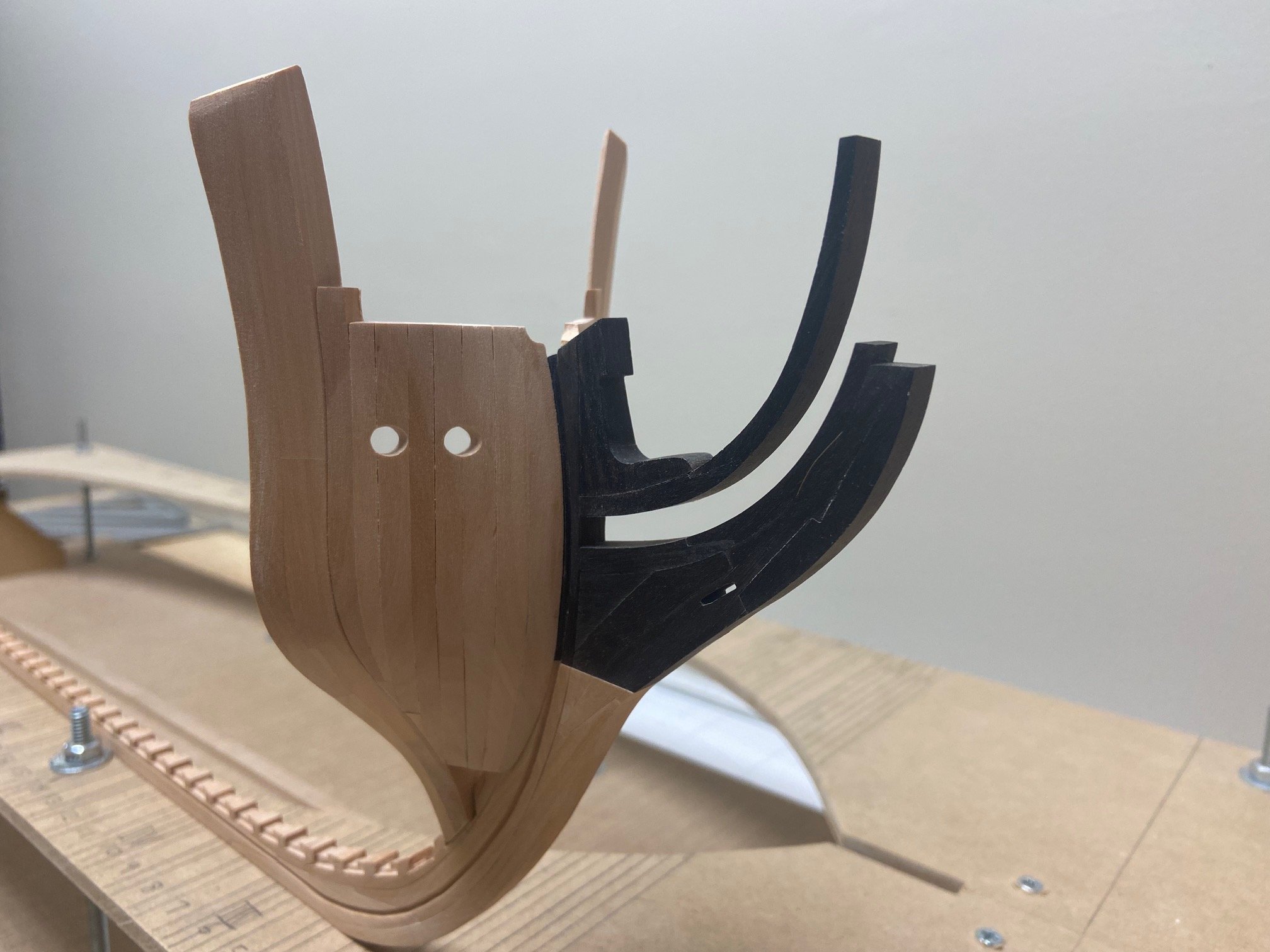

Plugging away at the hawse timbers - here they are after a few attempts.  Pencil marks are there for waterline reference.  I believe I need to install frame 1 first and then hope they will fit the keel and frame 1 after some adjustments - otherwise do them over yet again !
I am on the fence with nailing the frames with bolts simulated with 22 gauge square brass wire which is the most common way to do it.  I'm just not sure if I like the appearance.   I have still not decided whether or not the hull will have openings as the lines of this ship are so beautiful I may want to leave the frames intact which certainly is one reason not to bother with the bolts.  I could change my mind though.  Any opinions are welcome.

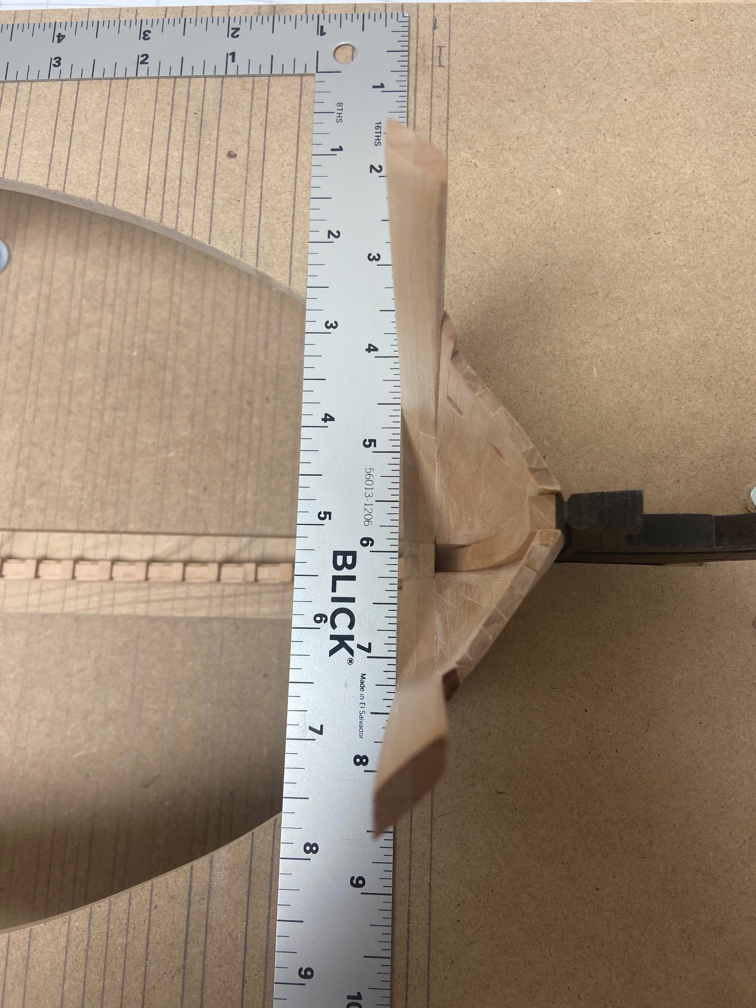

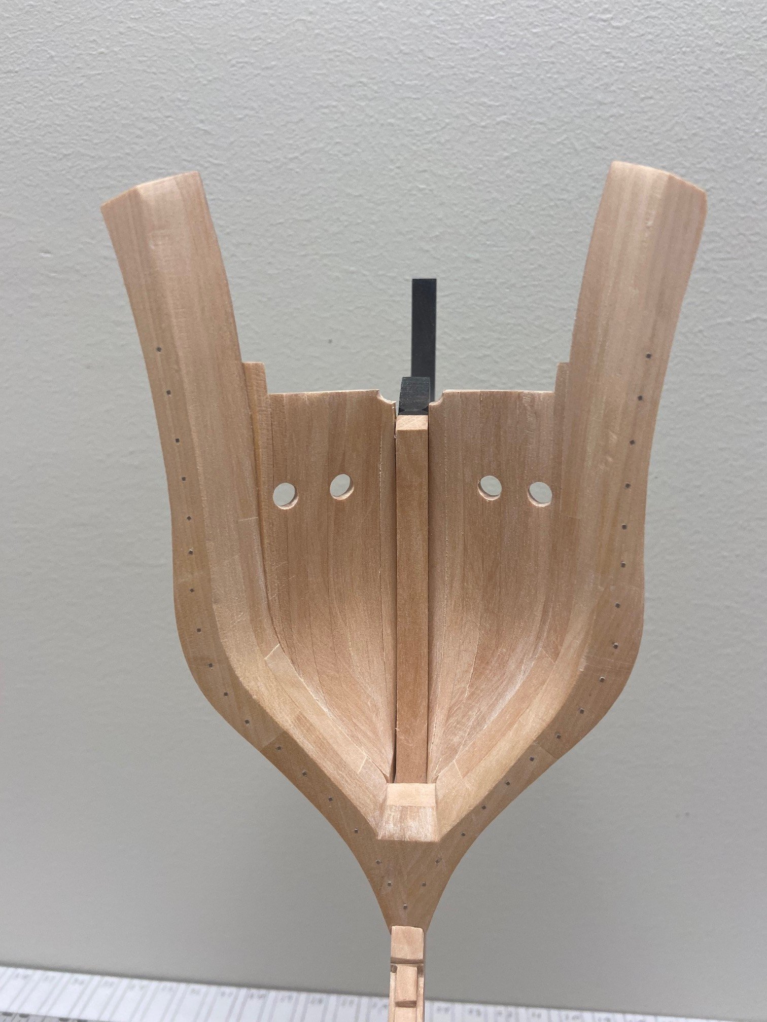

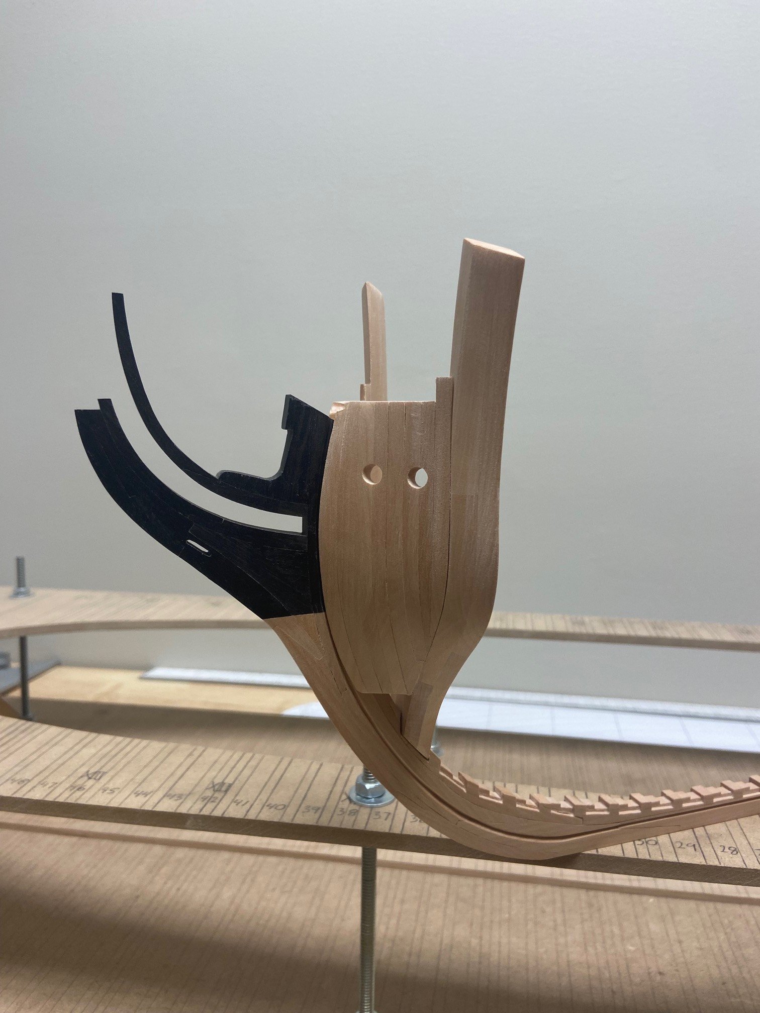

I still cant get these hawse timbers right after multiple attempts and working on the same assembly for two months.  I made sure to get frame one aligned properly and after installing the hawse timbers (which I can never get to mirror eachother perfectly) it thru off the first frame.  And after fairing the interior of the frame my electric file slipped.  I probably have no other choice but starting again for the umpteenth time on this frame and hawse timbers. Maybe some of it can be salvaged.  So frustrating.
Those are some of the hardest things on a fully framed model to make, I think my Pegasus ones had two or three attempts before I was happy to move on.
Try building some of the other stuff and come back to it with a fresher mind - I know that always helps me when I get frustrated.
Looking fantastic either way.
Sorry about the slip - one reason to not use power tools as they can so easily 'eat' one's work. If it's any consolation, I'm sure that real ships were not always 100% symmetrical.
Thanks D - its not even about appearance here but alignment.  Frame one sets up the rest of the frames.  I think Frame 1 is the culprit as I built the hawse timbers many times with the same alignment issues.  While I appreciate your suggestion Ben to move on to somewhere else I want to get this done by applying the lessons I have learned.  As boring as it can be to do the same assembly yet again, as least it will take half the time.
When in doubt, do it over. Took me three times to get my hawse timbers to where I was happy with them. But each version went quicker.
Having ruined a prior model with an electric sander I stopped using it. 80 grit paper will keep you from getting into trouble.

Sorry about the slip but things are looking really good and next attempt should be perfect!!
What looks asymmetrical by fractions of a mm can be sanded slightly.  When covered by planks it will be imperceptible.
I've been fairing parallel midbody frames for 3 weeks (no power tools...just sanding sticks).  A few spots are off by a sheet of paper.  In the right light, they stick out like a sore thumb but covered by planking, they will be perfectly faired.
Next, I'll be tackling the cant frames, and your trials and tribulations will help me immensely!

Thanks Brad and Greg.  I will still use my electric file - just on parts off the model...
I already disassembled the keel and hawse timbers and have built a new frame 1 - which I believe was the issue.  As you mentioned Greg, this time it will be much faster as I built these assemblies before.
