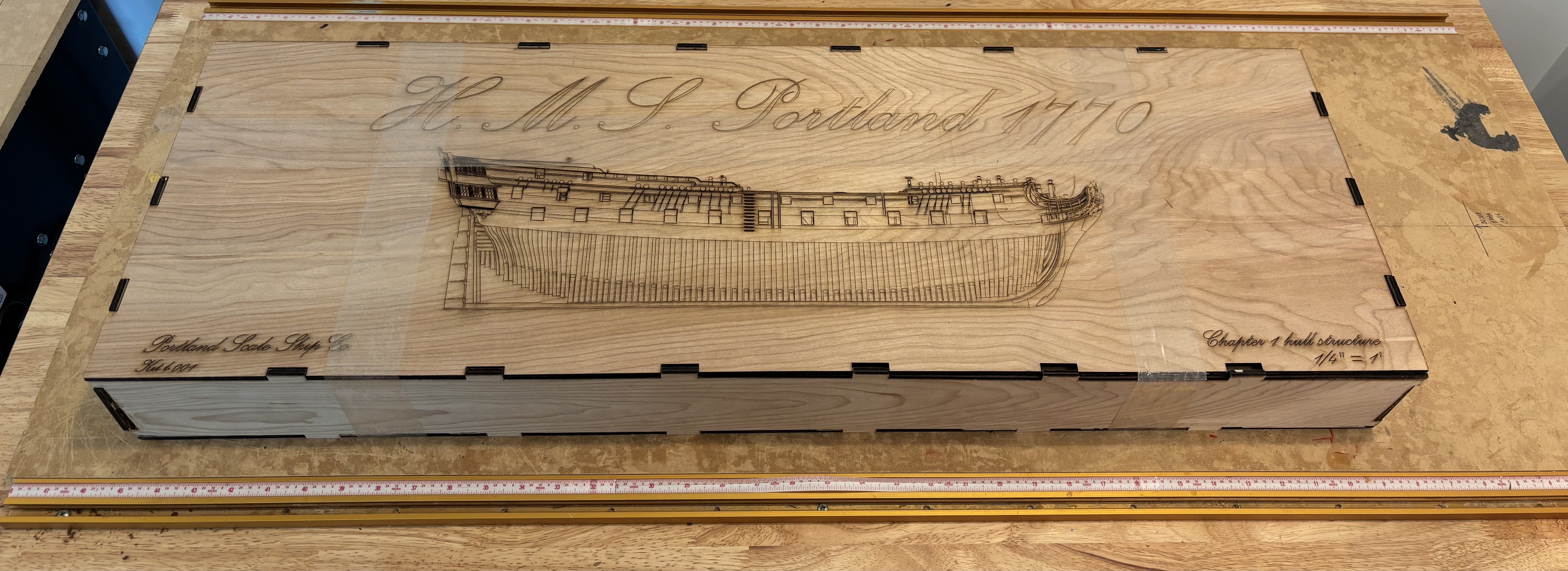

The box you see is laser etched with a drawing of the ship along with the serial number of the kit, my kit is B0001 as it’s a prototype.
This box contains Chapter 1 of the model which comprises  all of the main hull structure and jigs, the box weighed in at a hefty 29lbs, you can see more pics of some of the contents, also this kit will have  framing of Swiss pear and I will be planking in Boxwood ( planking material not included with the kit just like the Winnie ).
Everything is very well packed and protected and the quality of the materials and laser cutting is superb.

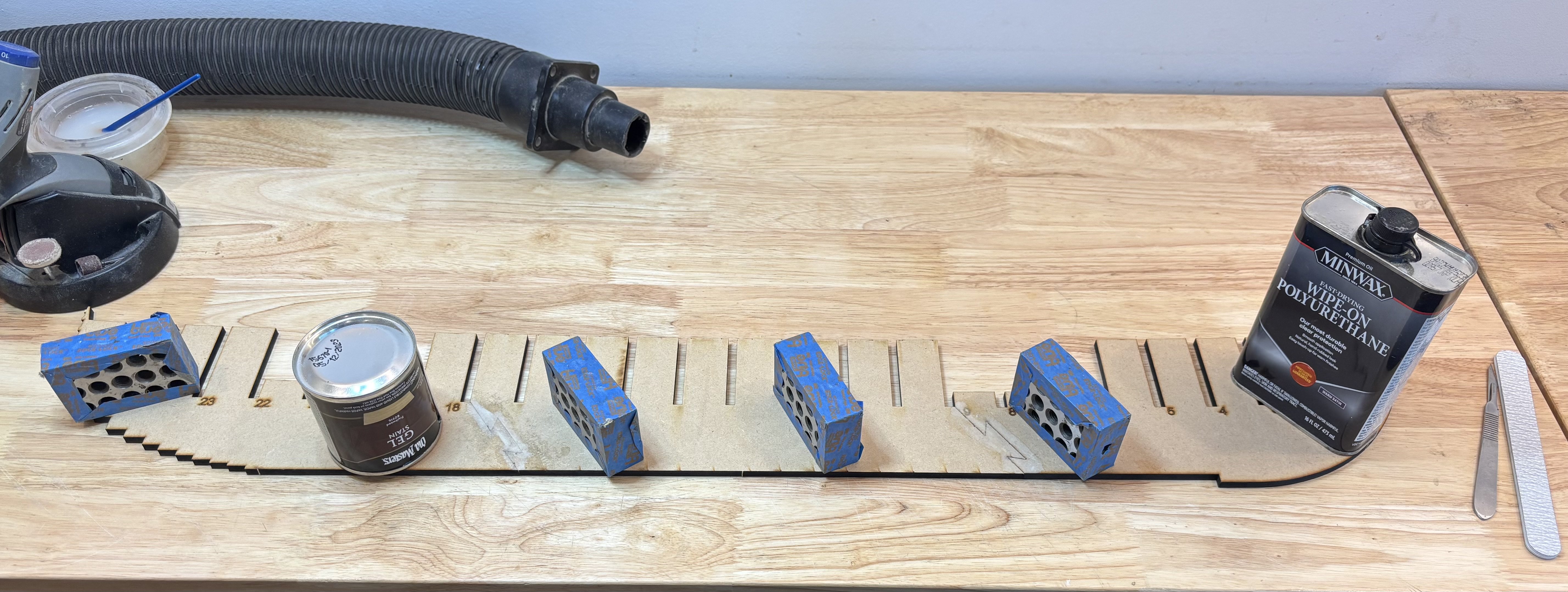

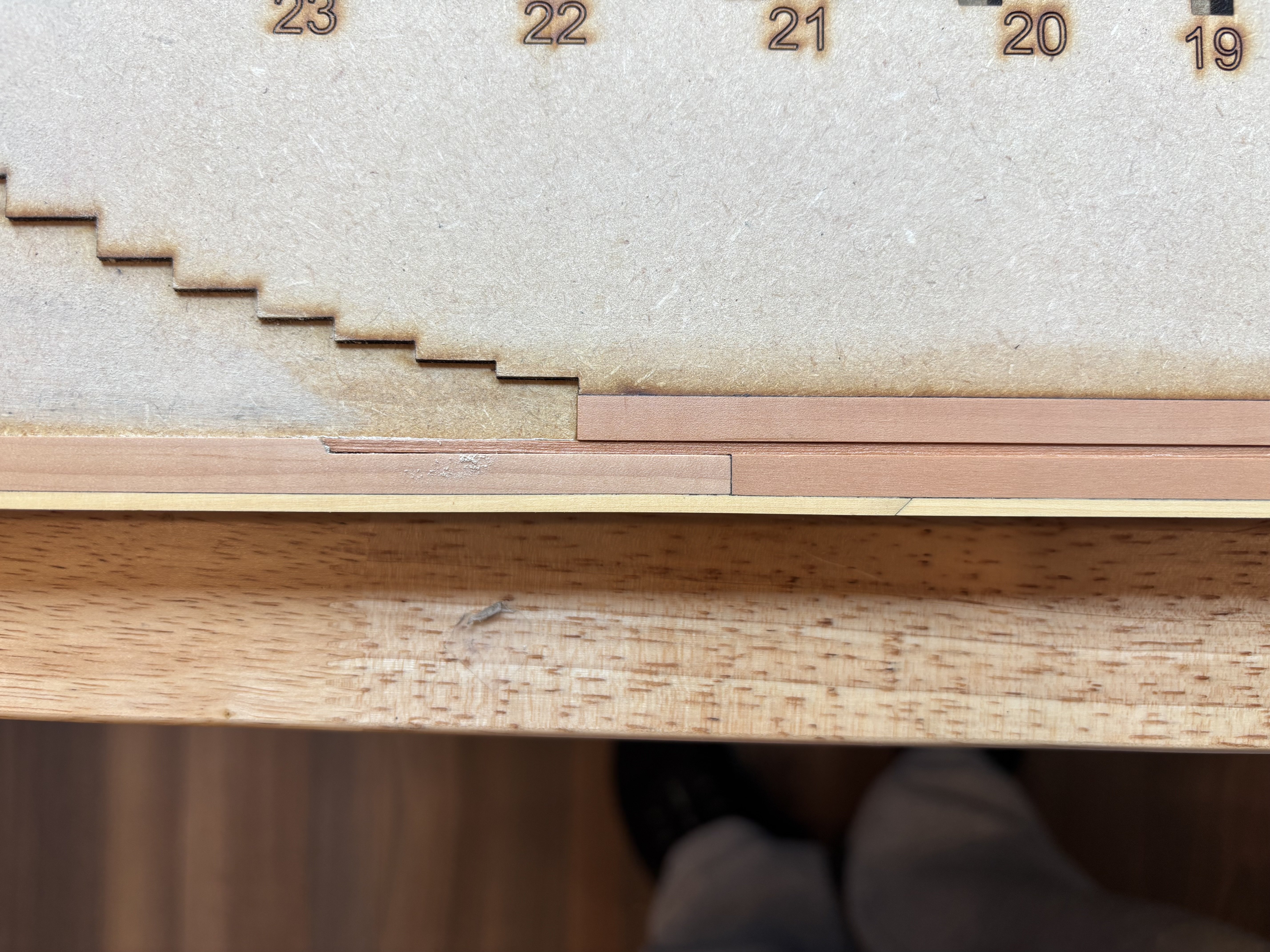

44 minutes ago, Desertanimal said:
Did you use anything to darken the seams?
Chris
Hi
yes, as usual on my models I use a 2B soft pencil on both edges, I don’t personally like it when it’s too stand out.

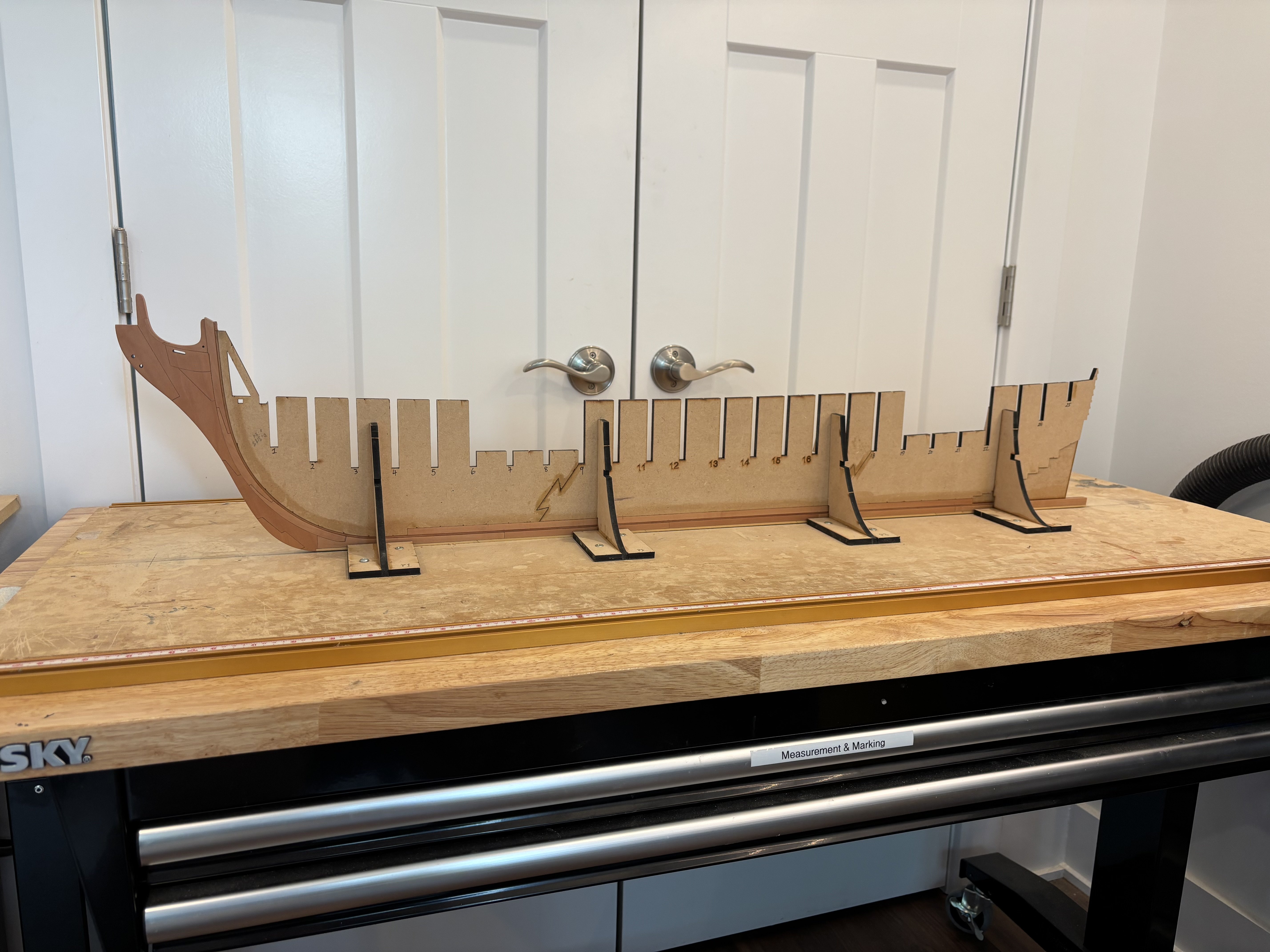

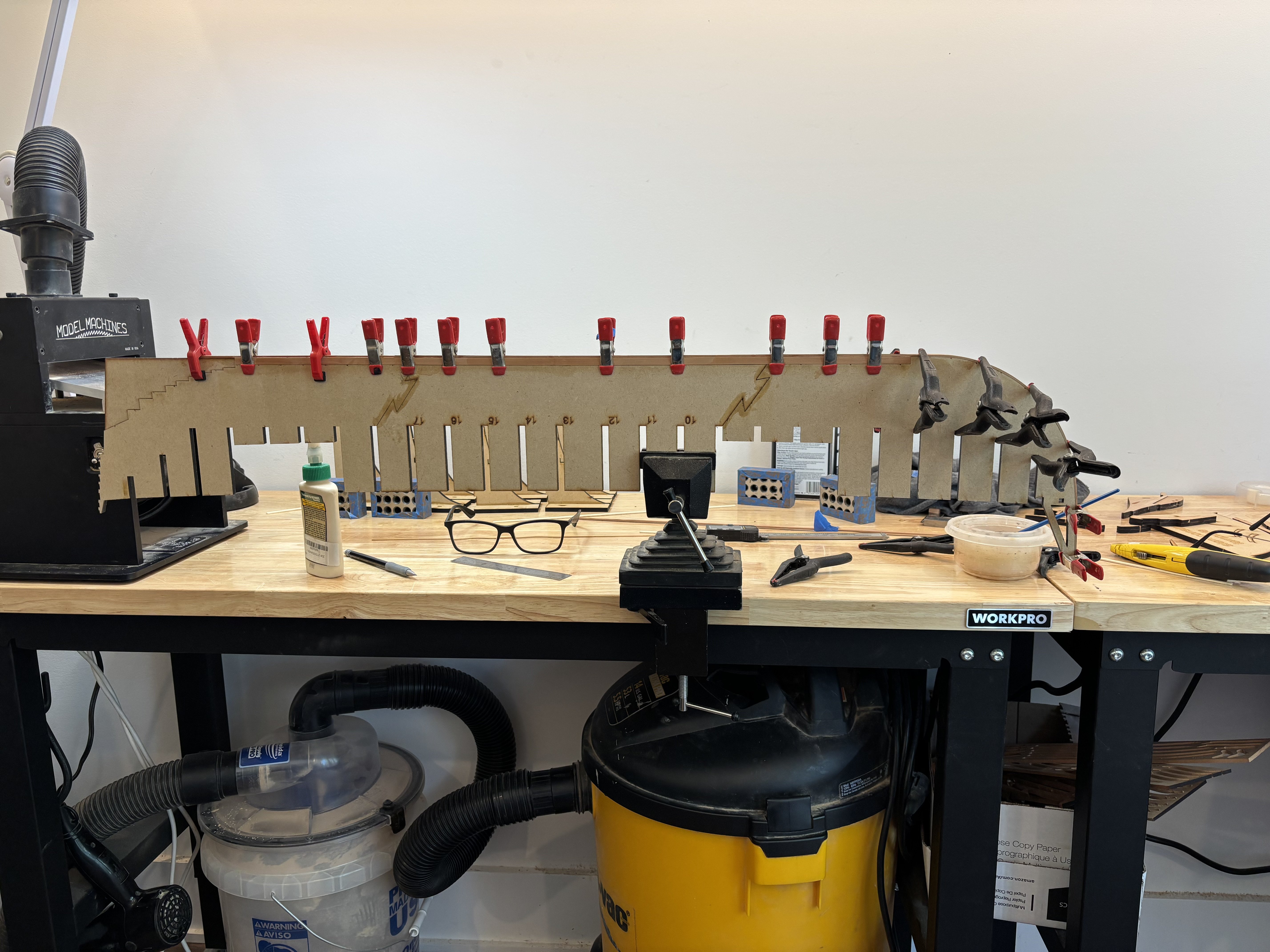

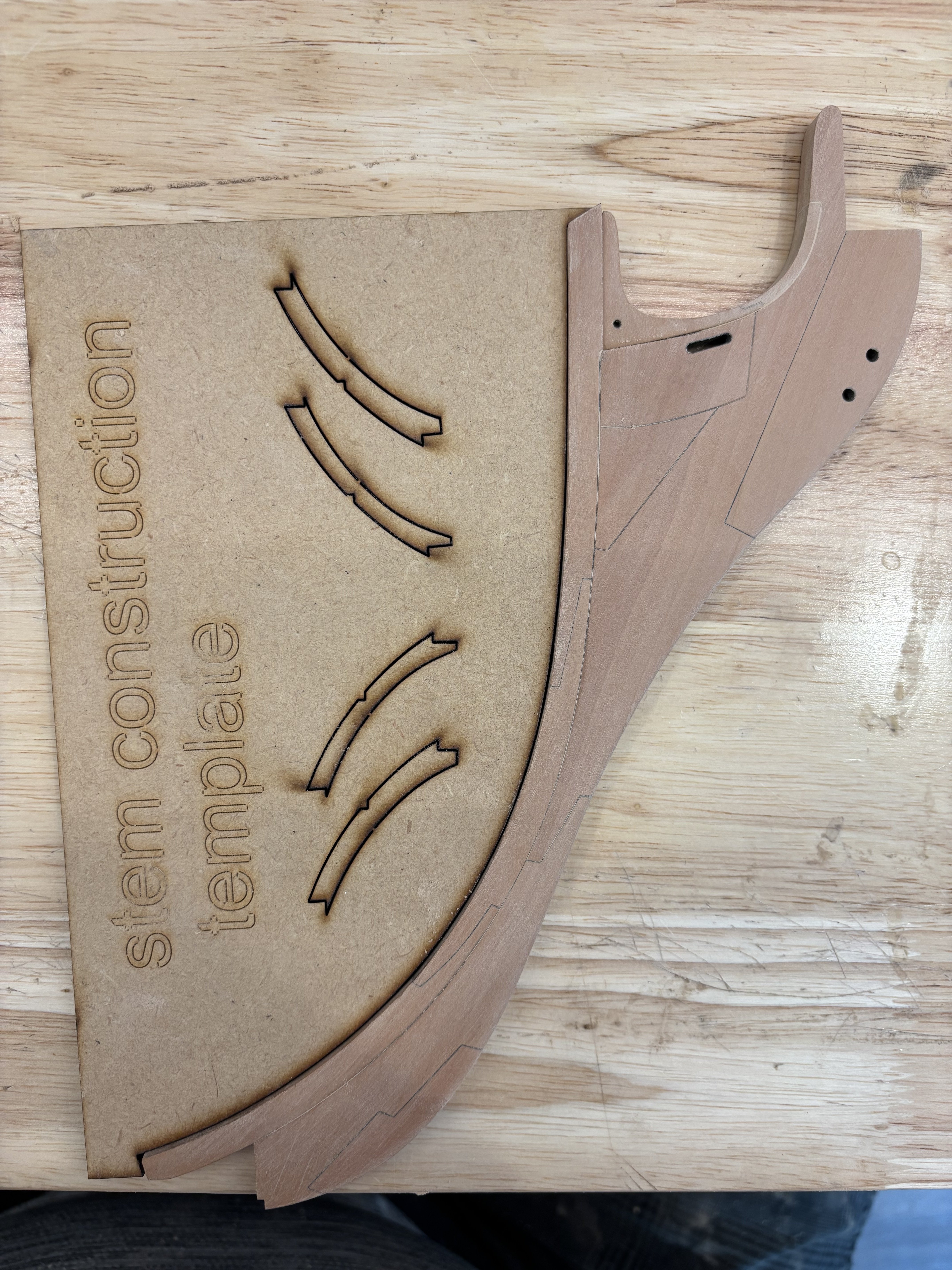

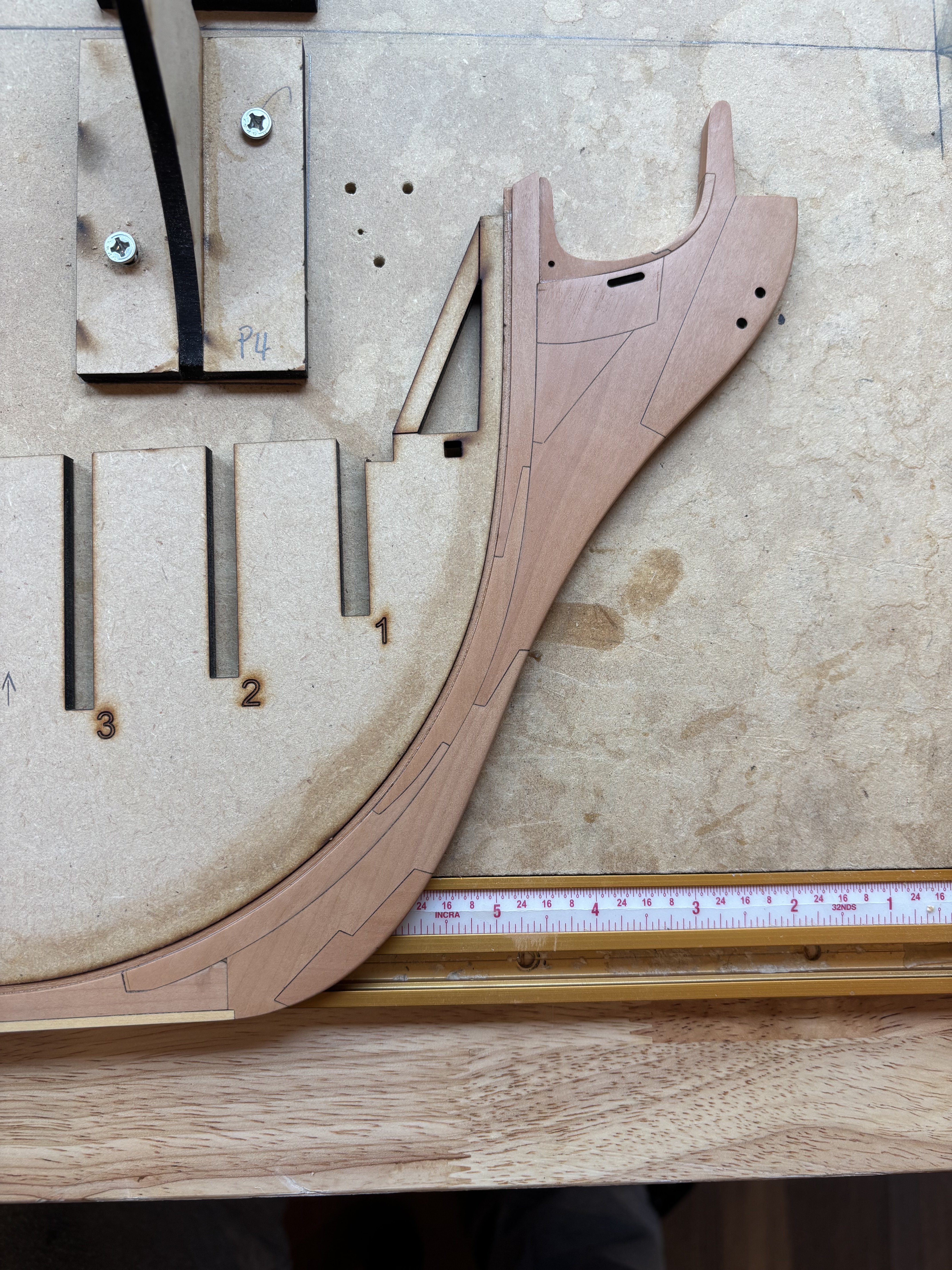

Final progress from this weekends work, the sanding of the Knee to its correct dimensions and then its installation onto the former along with the keel and false keel pieces.
Now she is on the build board ready to start testing the fitment of the bulkheads.

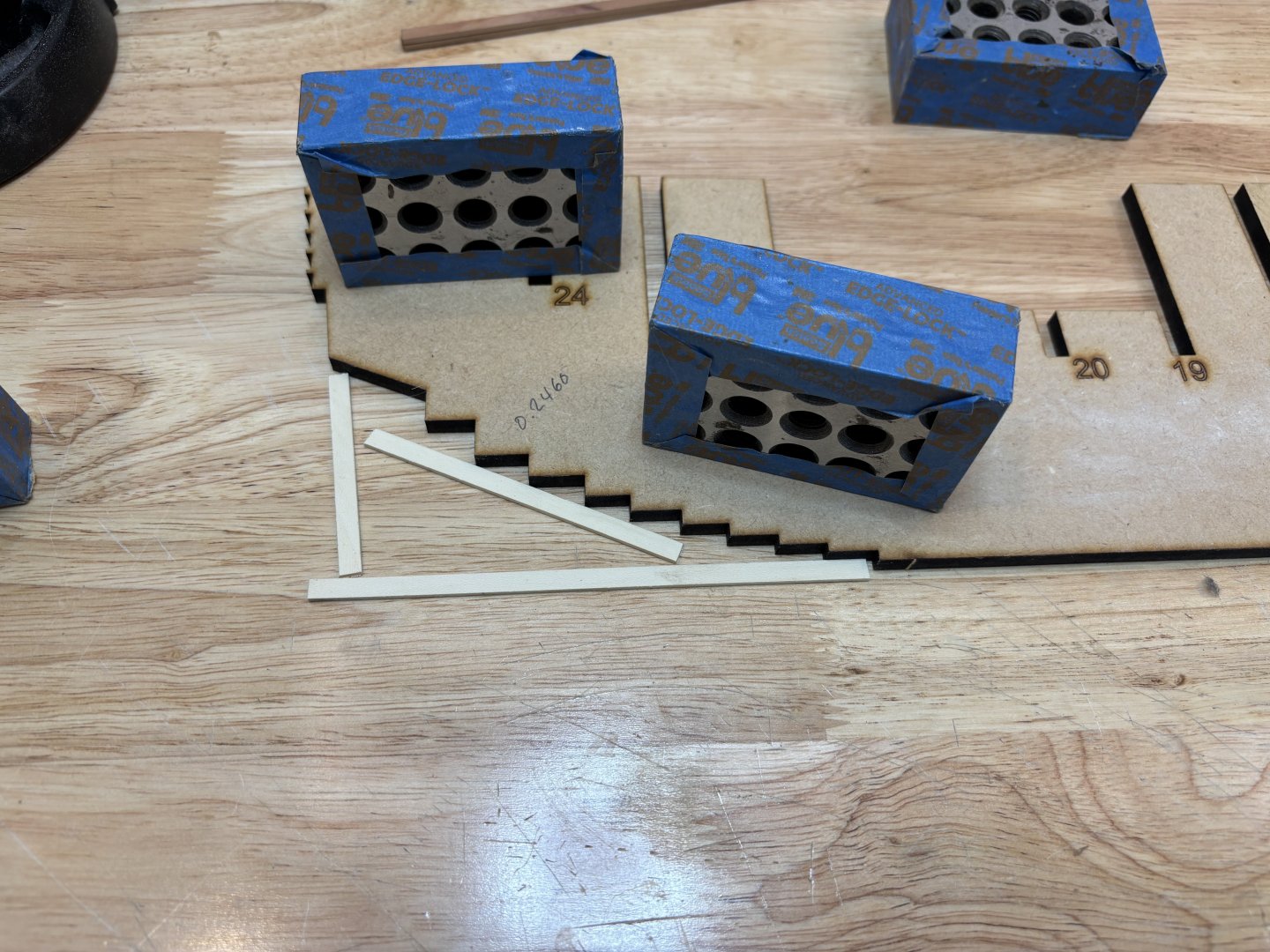

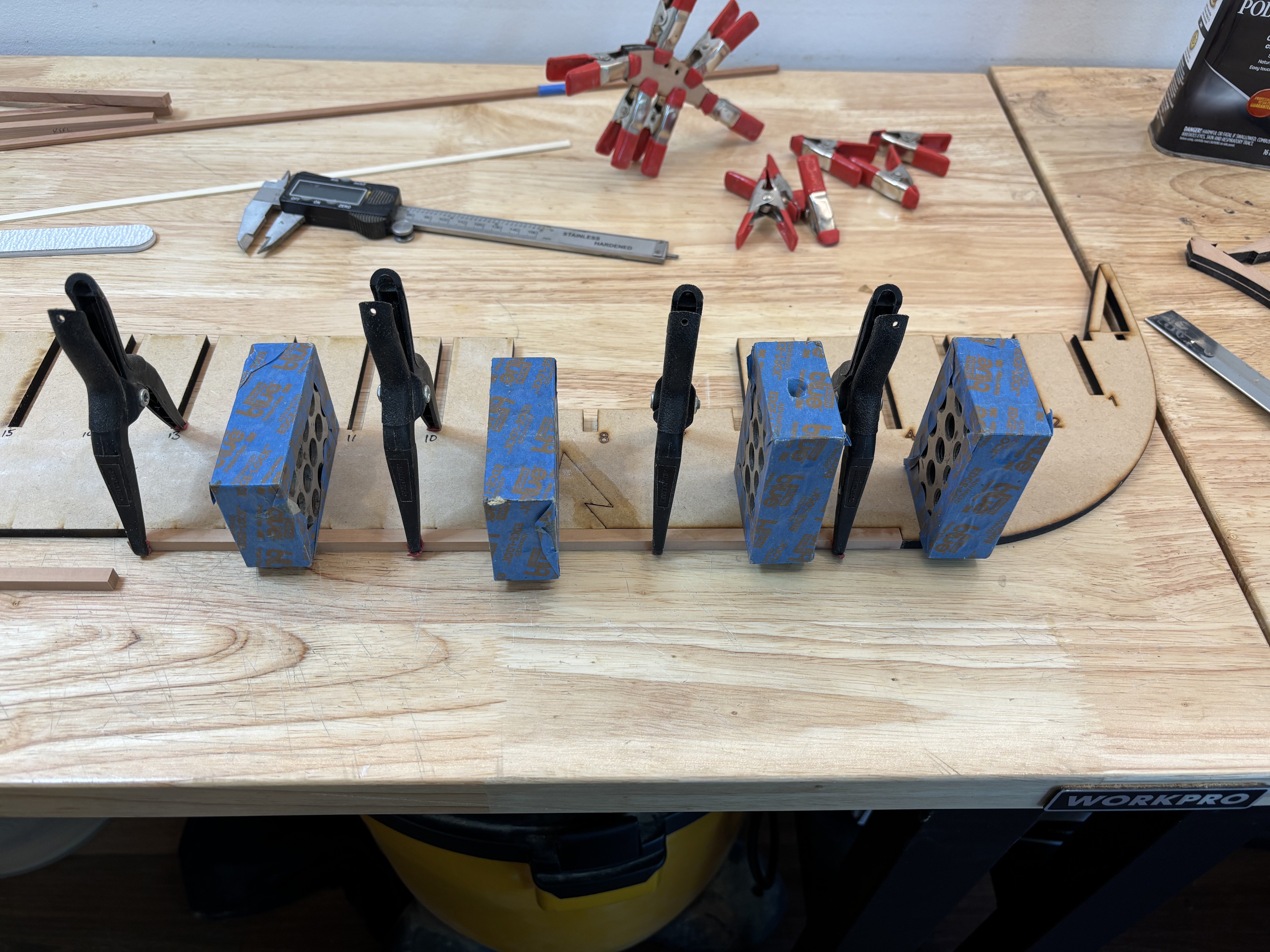

9 minutes ago, dvm27 said:
Do you need to deal with laser char between adjoining pieces?
Hi Greg
Yes, the knee parts are two sets of parts that get glued together to make a single thicker Knee, you have to deal with the char because of the kerf that the laser creates on the parts, so very careful sanding and fitting is needed to create tight joints on the outer surfaces.
