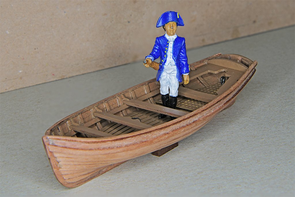

Boatwithfigure.jpg.0b9c86efbb1620e84ee0e79a1ae41f9b.jpgSteve's last post on his Prince build reminded me of the midshipman figure for my topsail schooner.
This is an Amati 35mm figure - about 5 1/2 feet (1.7 meters) with hat at 1:48 scale .
A 14 foot boat is pretty small!

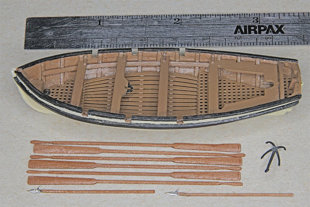

Rudderandtransom.jpg.d2a57f66416535bf588375605855c72f.jpgBoatandgear.jpg.90f478897827804bda136e94038e91f5.jpg
The oars were filed and sanded to make the handles round and taper the blades. The second photo shows the oars, rudder and anchor stowed in the boat temporarily. Things will have to be rearranged a bit to allow the boat tackle to hook to the eyebolts. I think the anchor should have a rope attached with the line coiled on the deck. And the boat should have a painter on the bow.
I am still trying to decide how to make wooden shafts for the boat hooks.
And I painted the boat, using the same paints that were used on the schooner model.

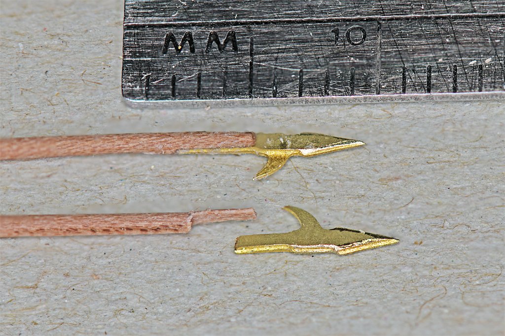

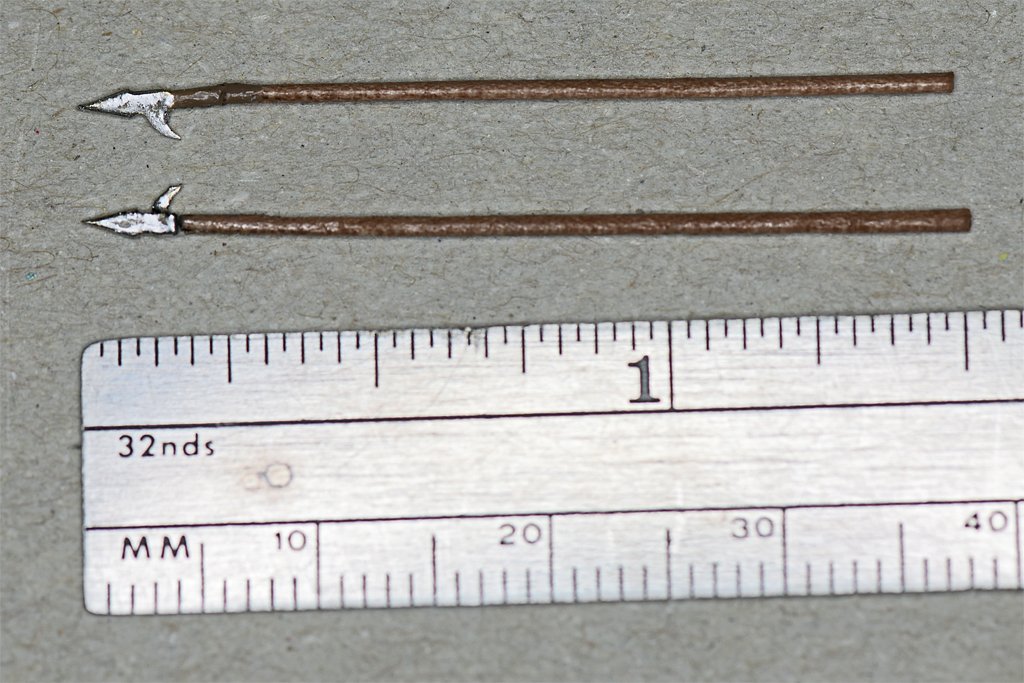

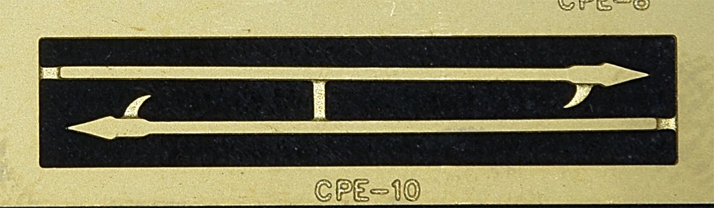

Boathooks3.jpg.bdf903a1b0f16f3e4bf0406bc95de949.jpgThe last detail is the boat hooks. These photo etched pieces would be good enough if you just painted the handles a brown wood color.
However, at 1:48 scale they were only about four feet (3.6 meters) long, and if I recall correctly from my sea going days they were really about 6 feet (2 meters) long.
I decided to try to make wooden handles and use just the photo etch tips. For this I cut some of the 0.6 mm pear "sprue" that was between the oars in the laser cut sheet. I carved, scraped filed and sanded them into cylindrical handles quite a bit longer than needed.
Boathools1.jpg.734591fcaaeecb595fcd00291ae006ee.jpgBoathools2.jpg.f1a29fa13369f1674a2a5146141a6ef7.jpg
The tips of the photo etch pieces were filed to make edges to the point. Then the tips were cut from the longer handle part. I filed one side of the wooden handle end flat and less than half the diameter of the handle. Then the tip of the photo etch piece was attached to the flat with CA gel. The parts were cut to a scale 6 feet (1.5 inches or 38 mm) and the wooden handle was coated with shellac. When that dried I painted the tips with silver/chrome paint. A bit of brown paint was applied to the brass piece below the tip on the opposite side from the wood to hide the brass "shank.".

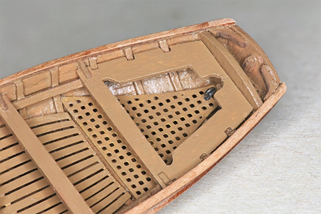

Although the kit build is finished there was one fiddly bit I just couldn't let pass. At the bow is a "chunky" box-like bit (red arrow in left photo) that just doesn't look right. It is the remnants of the MDF filler pieces that were glued to the stem to support the bow planking (right hand photo). I considered trying to remove them when I was removing the MDF bulkheads. But they are about all that supports the planks at the bow. Trying to carve them out seemed to be tempting fate (and Murphy), so I left them. But plans for ships' boats don't show this box at the bow.
Bowdeck1.jpg.34b7e0e961325954fe6cb31f61976cb4.jpgBowfillerblocks2.jpg.c450364ea74b2dc75c396b77fd5058df.jpg
Some boat plans do show a small deck at the bow. It is sometimes across the top of the planks, as an extension of the cap rail, and sometimes lower. I shaped a scrap piece of 0.012 inch (0.3 mm) plywood to fit the space and glued it in with Titebond Cement. Actually, I think the piece was a scrap of 1/64 inch (0.4 mm) plywood with one of the three layers removed. You can still see the aft face of the "box" beneath it if you look, but this seems to me to be more "prototypical" looking, if not actually accurate (the box certainly wasn't typical).
Bowdeck2.jpg.675e4efe9c3a4000ebf692ad1d815724.jpgBowdeck3.jpg.fef3ec1a5e0fc72ae4ff347f260b9446.jpg
