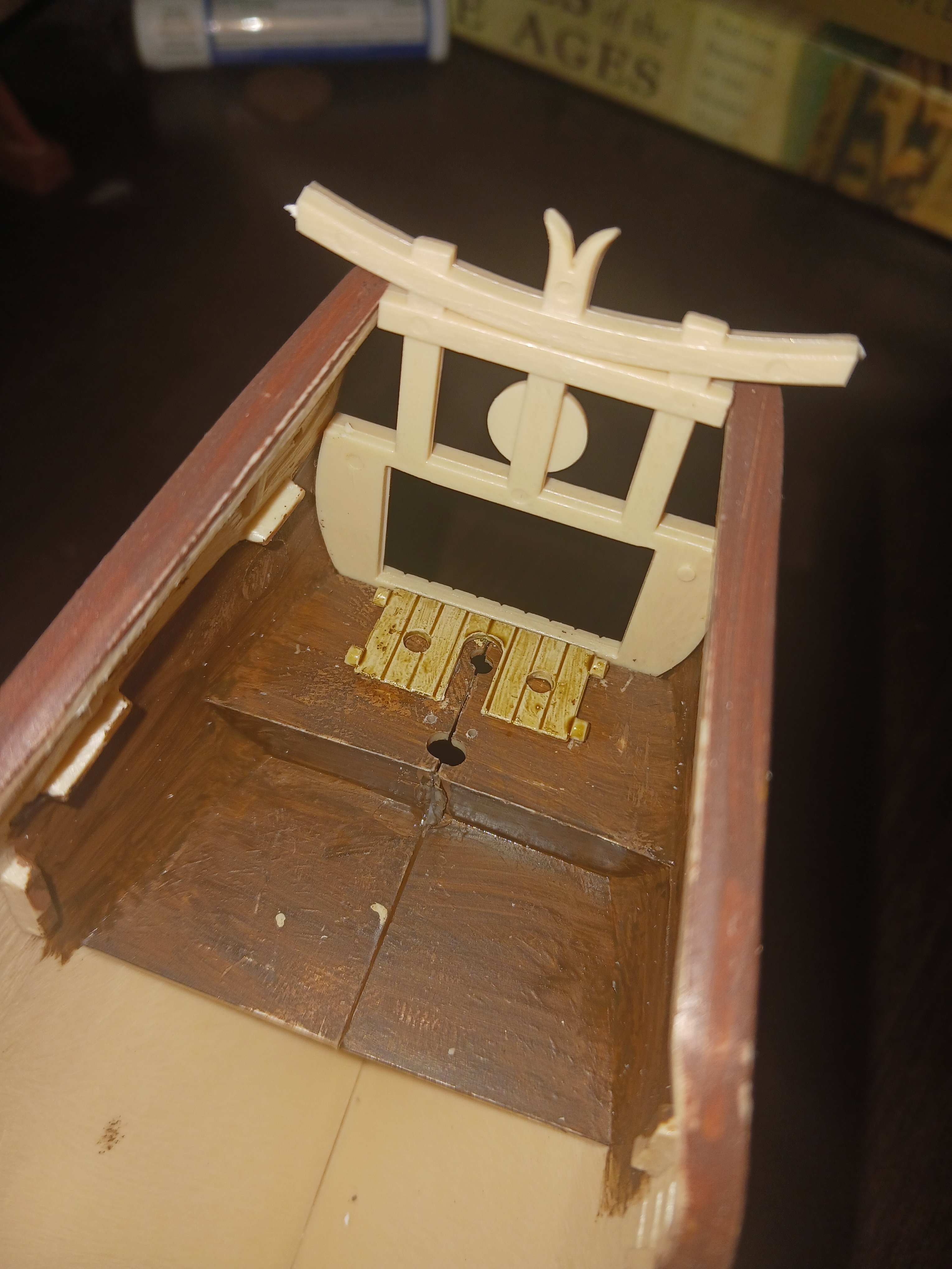

There is one more striking issue with the kit that is obvious in this photo, which is the extreme aft rake of the mast. I have already begun working on a solution for this as far as my model is concerned. I will also be using the ship's hull as a canvas for some pretty intricate paint-work, in order to make the ship look filthy and worn-out.

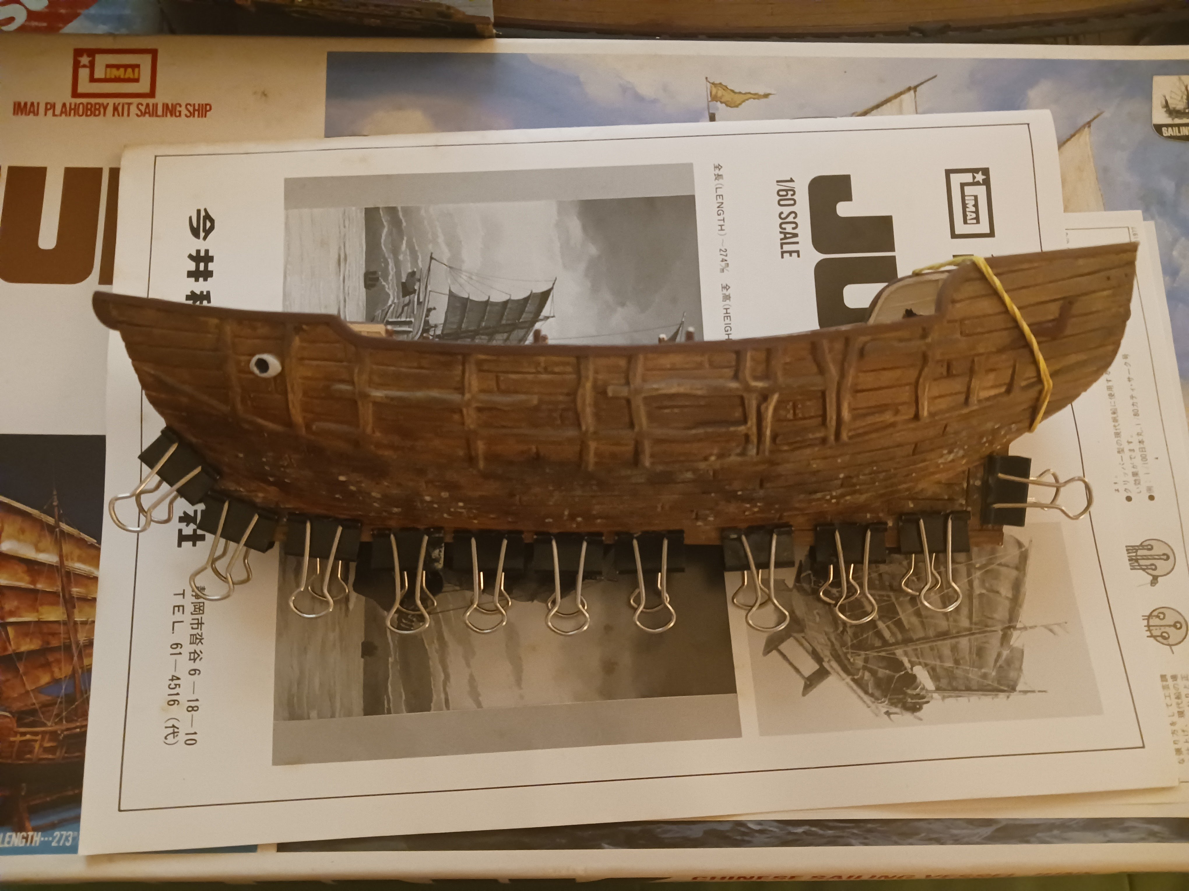

Here's the dry-fitted hull and deck:

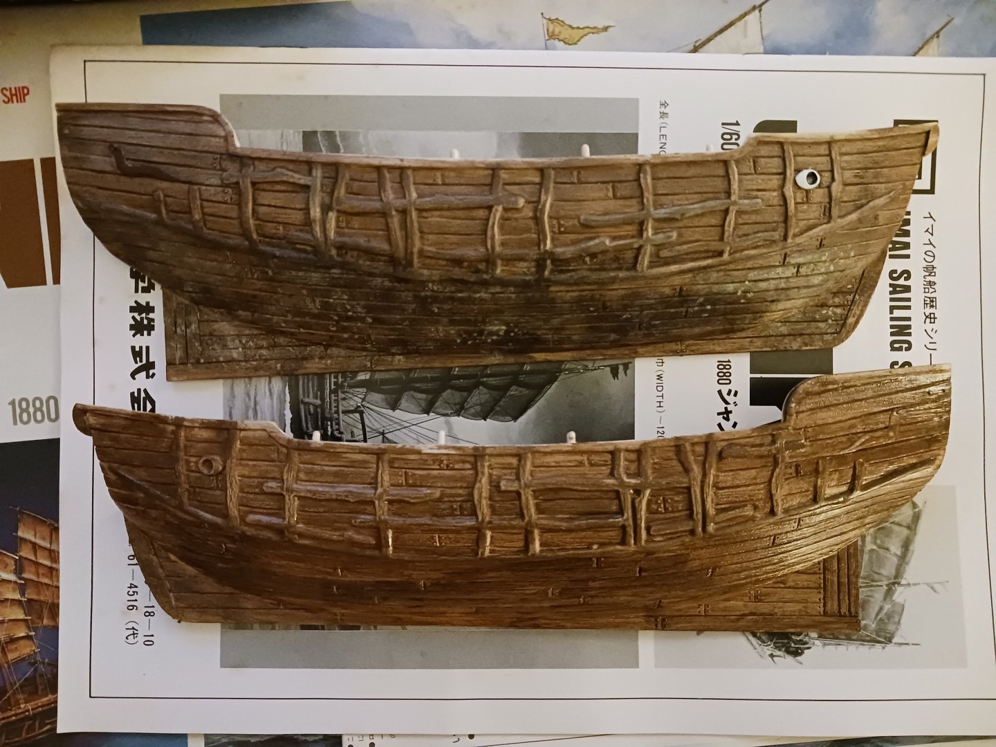

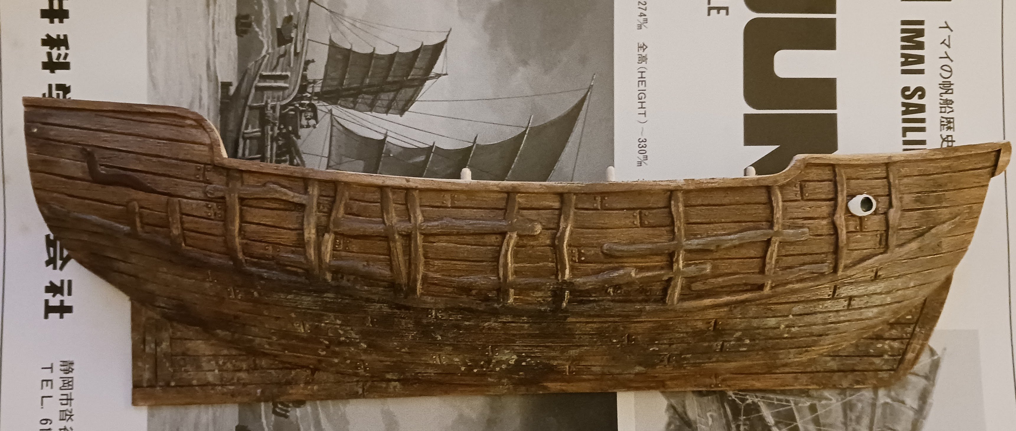

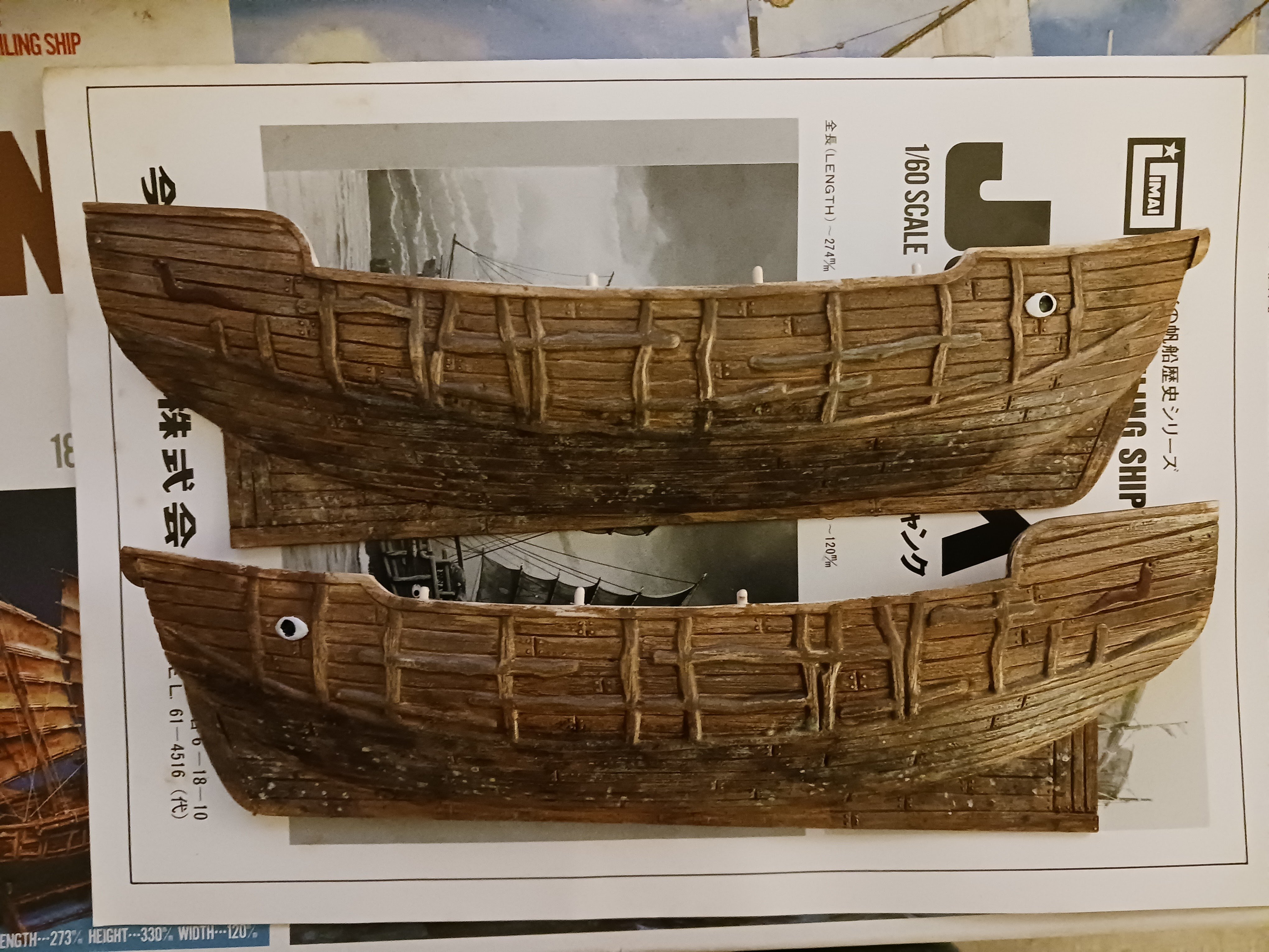

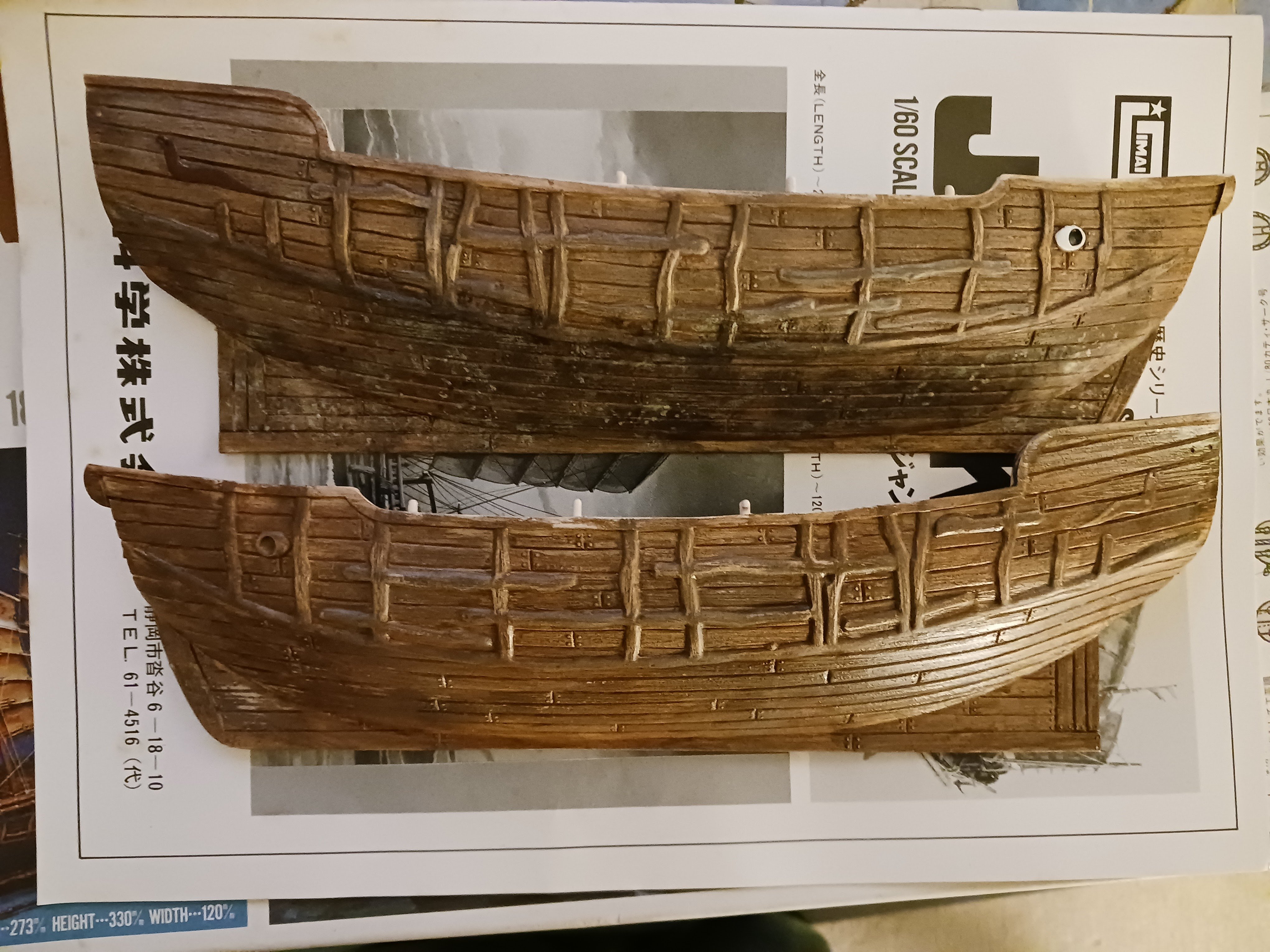

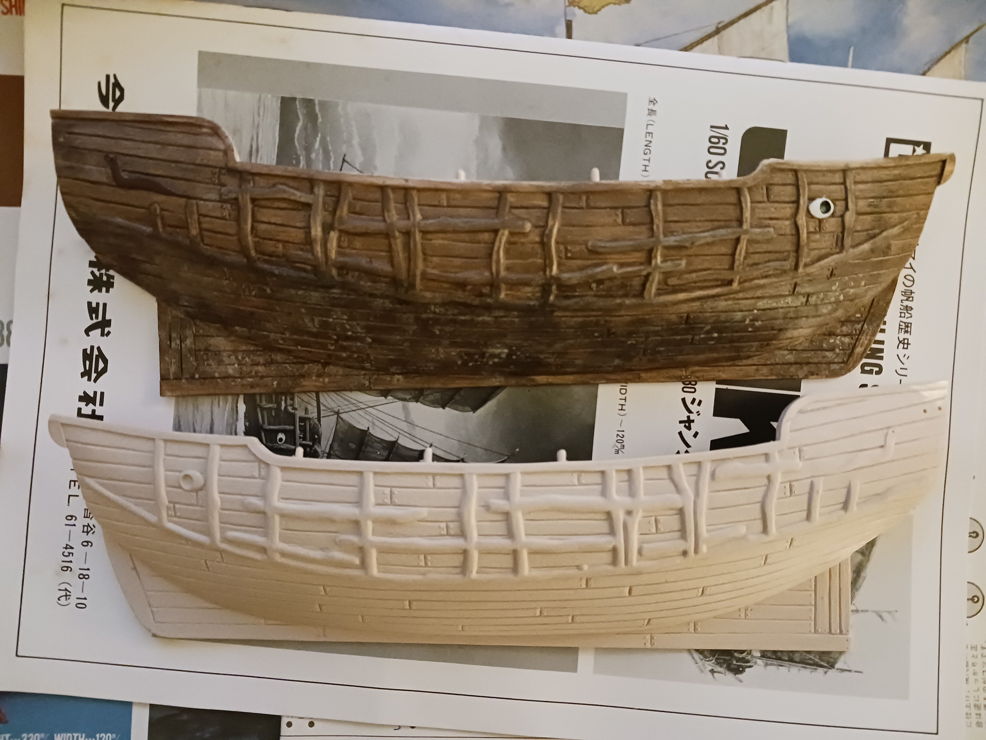

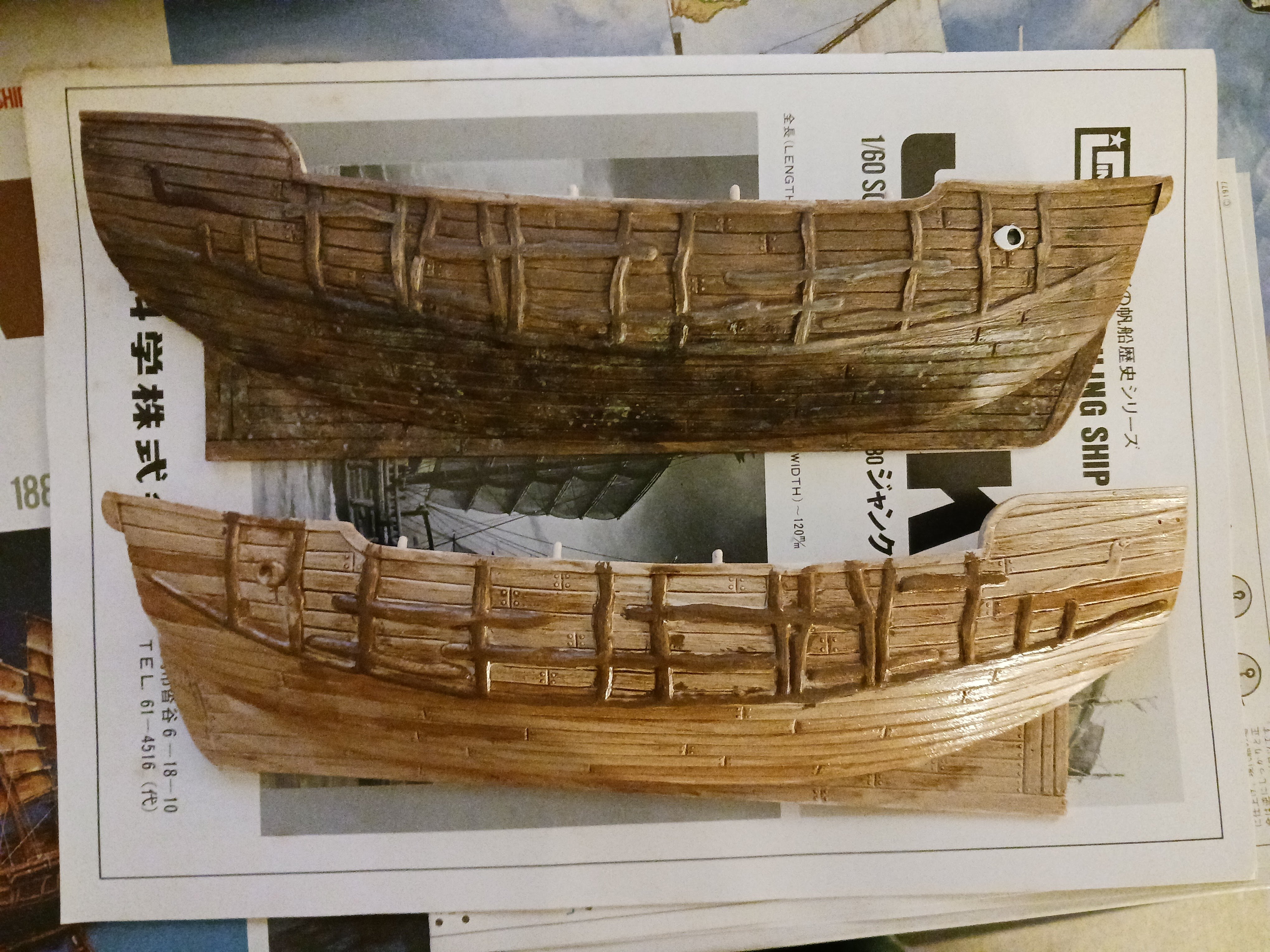

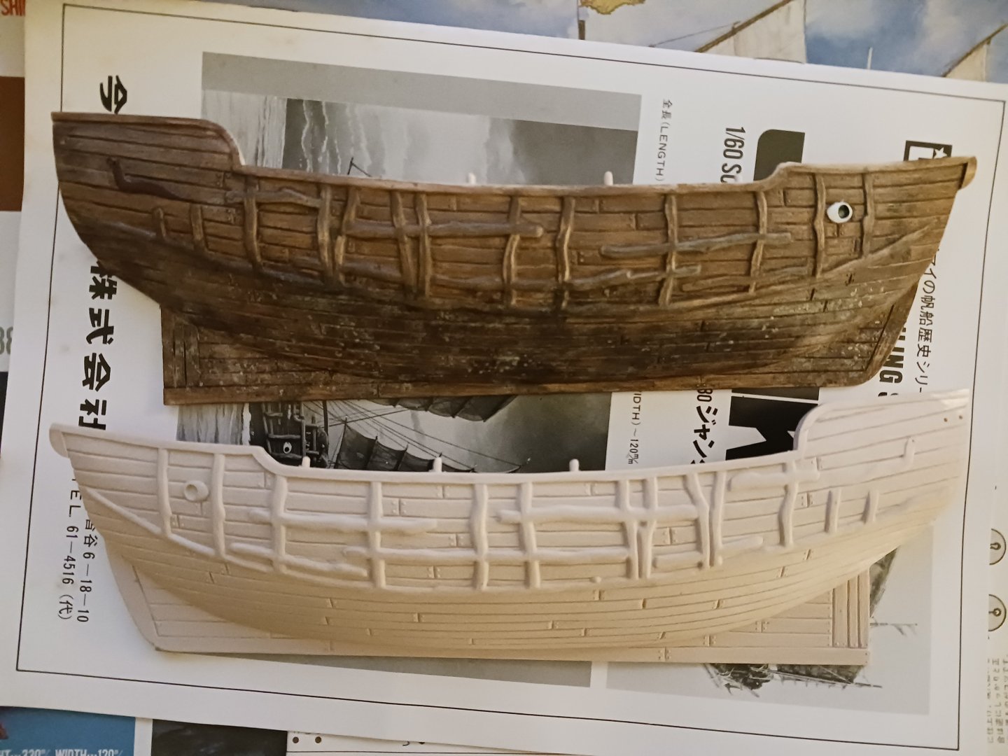

This is the paint job for one of the hull halves.
I made sure to attempt to accurately portray the way hot, wet climates beat up and destroy wood. Clearly, this junk has not been well taken care of. My decisions for this model's paint job were based primarily on this black-and-white photograph, which I have interpreted in color:
Let's see how we got there.

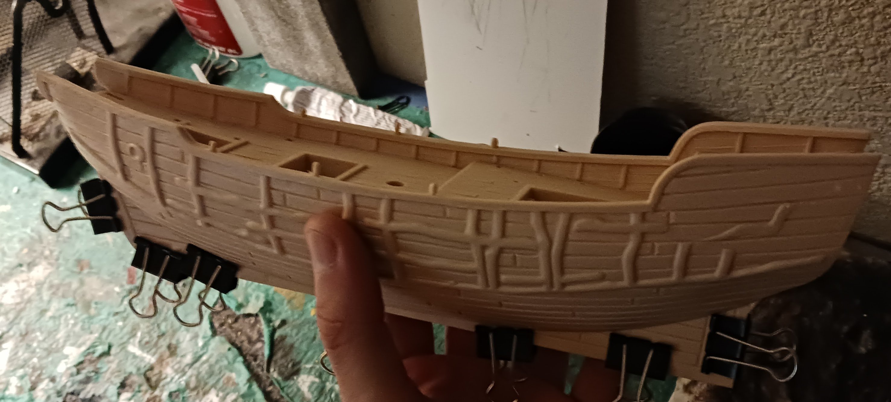

First, I applied a coat of cream colored paint, which was almost the same color as the plastic:
Then brown on the very organic-looking wales, and a creamy tan on some of the planks, which may have been replaced recently. I made sure to make it as messy and sloppy as possible, which will come in handy when weathering.
A healthy coat of a light brown shade:
A very heavy coat of antiquing medium, my favorite paint for the last two years:
I made sure to rub some of the paint off to add to the weathering effect. I also dry-brushed on a mixture of brown, white and grey, which you can barely see in photos:
I then added muck on the bottom, as well as barnacles and algae: 20250521_191212.thumb.jpg.fb4602a9c72504b6937cadd175ee3b67.jpg
Finally, the eye and serpent carvings were painted:
This is approximately how we will continue the paintwork throughout the construction of this model. We will pay special attention to weathering and shading, and spend as much effort as possible making this ship look like something that would have really existed in the South China Sea. You should be able to see a clear distinction between this and Aoshima's paint job, which looks toylike in comparison. We will paint the gunwale in a bit.

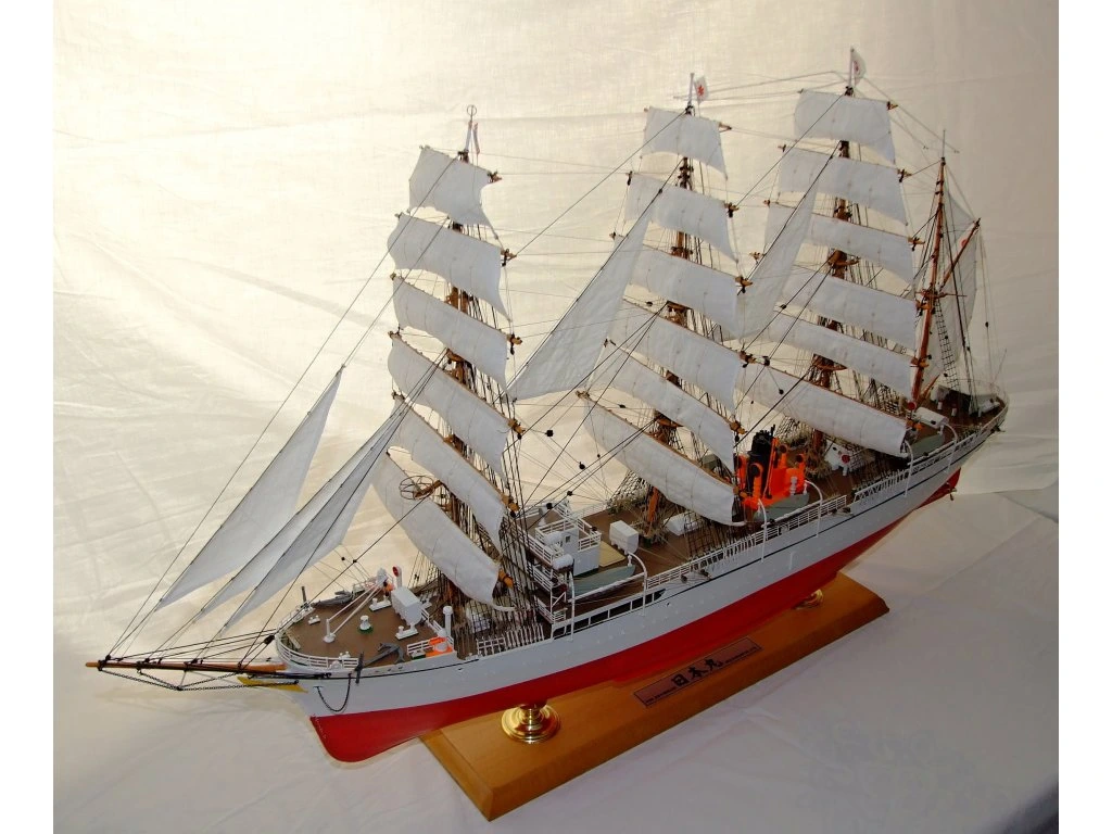

If I ever have the time, money, or display space, I would like to build Imai's Kaiwo Maru in 1/100 scale
Check out these offerings from Woody Joe: https://www.zootoyz.jp/contents/en-us/d2045761086_Japanese-Sailing-Ship-model.html

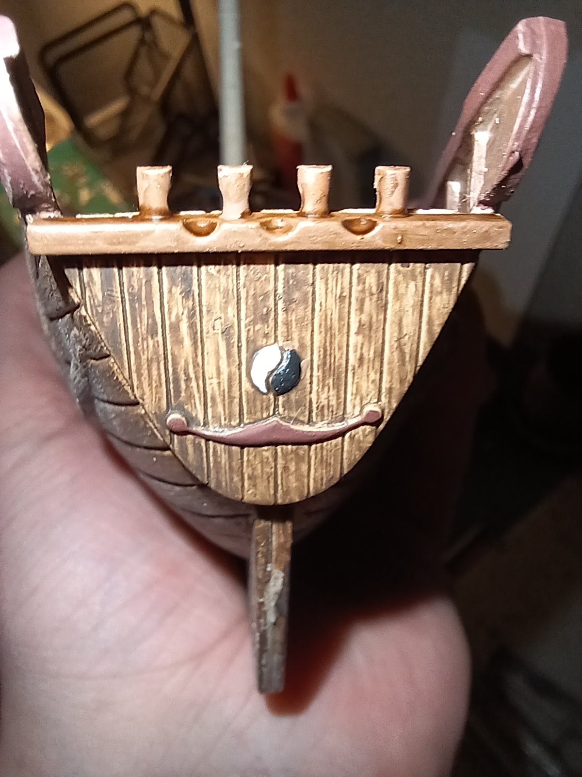

The next thing I'd like to get out of the way before we do the deck is the rudder.
Here is the ship's rudder and tiller:

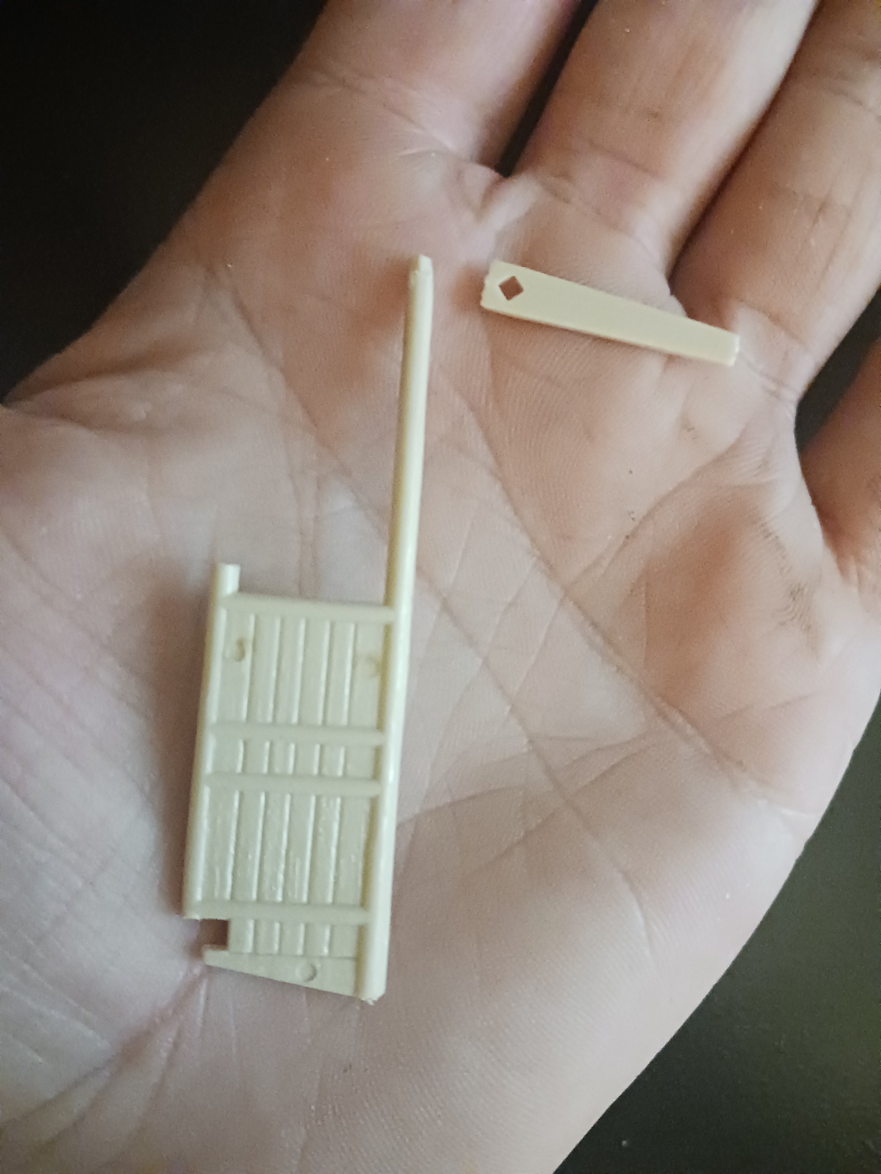

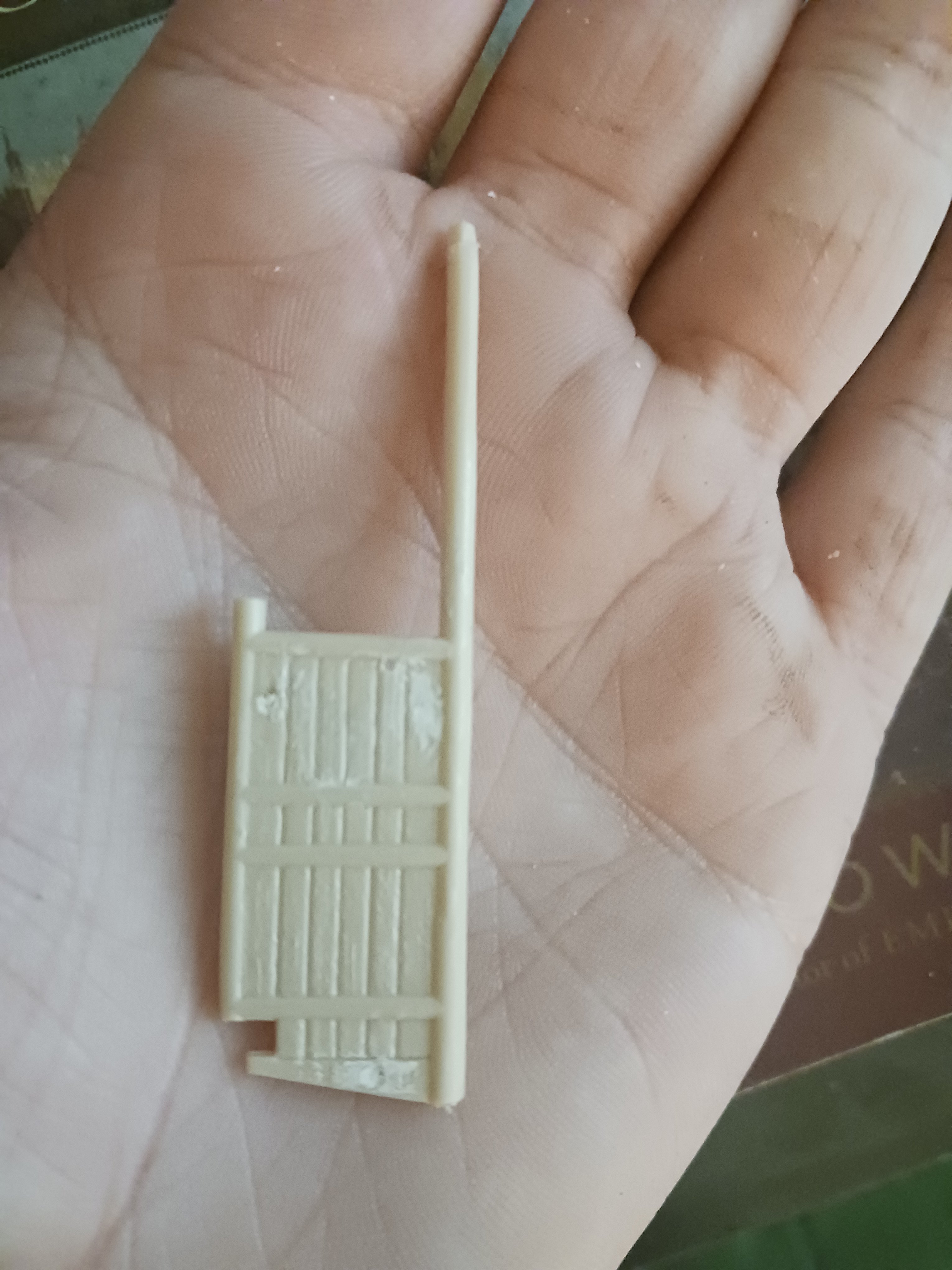

I have already done some modification to the rudder in preparation for mounting. The kit instructions say that you are to trap the rudder between the hull halves when you glue the hull together. I did not want to do that. I wanted to retain the rudder's freedom of rotation and, more practically, delay the installation of the rudder  until after the hull halves were glued. Originally, there was a ring that went around the top of the rudder's main post, and two pegs that joined into the sternpost at the aft of the ship. I have sanded both of those down. Rather unusually for Imai kits, there are three injector pin marks to fill with putty.
This is the rudder after I filled the injector pin marks. I have also drilled a hole with a pin vise near the top of the rudder fin. This will accept the rudder lift, which was an important feature on Chinese junks:
The stern of the ship. I have the unpainted transom resting on the back of the hull. The planked gun platform is glued in place and painted. There are two holes on the center-line of the stern. The forward hole is for the rudder, and the aft is the step for the mizzen mast. I have drilled two holes immediately aft of the rudder hole for the lift.
Some actual rudder designs:
Edited by Ferrus Manus

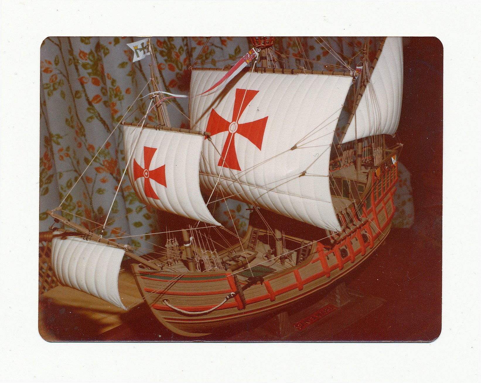

Great work, Ferrus. I built two Imai kits in the late '70's - the Santa Maria (photo attached) and the Catalan ship.
Thoroughly enjoyed building both, especially the Catalan ship. It's a shame the company went out of business.
I sold the Santa Maria model to an Italian restaurant in the Denver area and sometimes wonder if they still have
it. The Catalan ship went on a voyage to an unknown destination, so I hope it still exists.

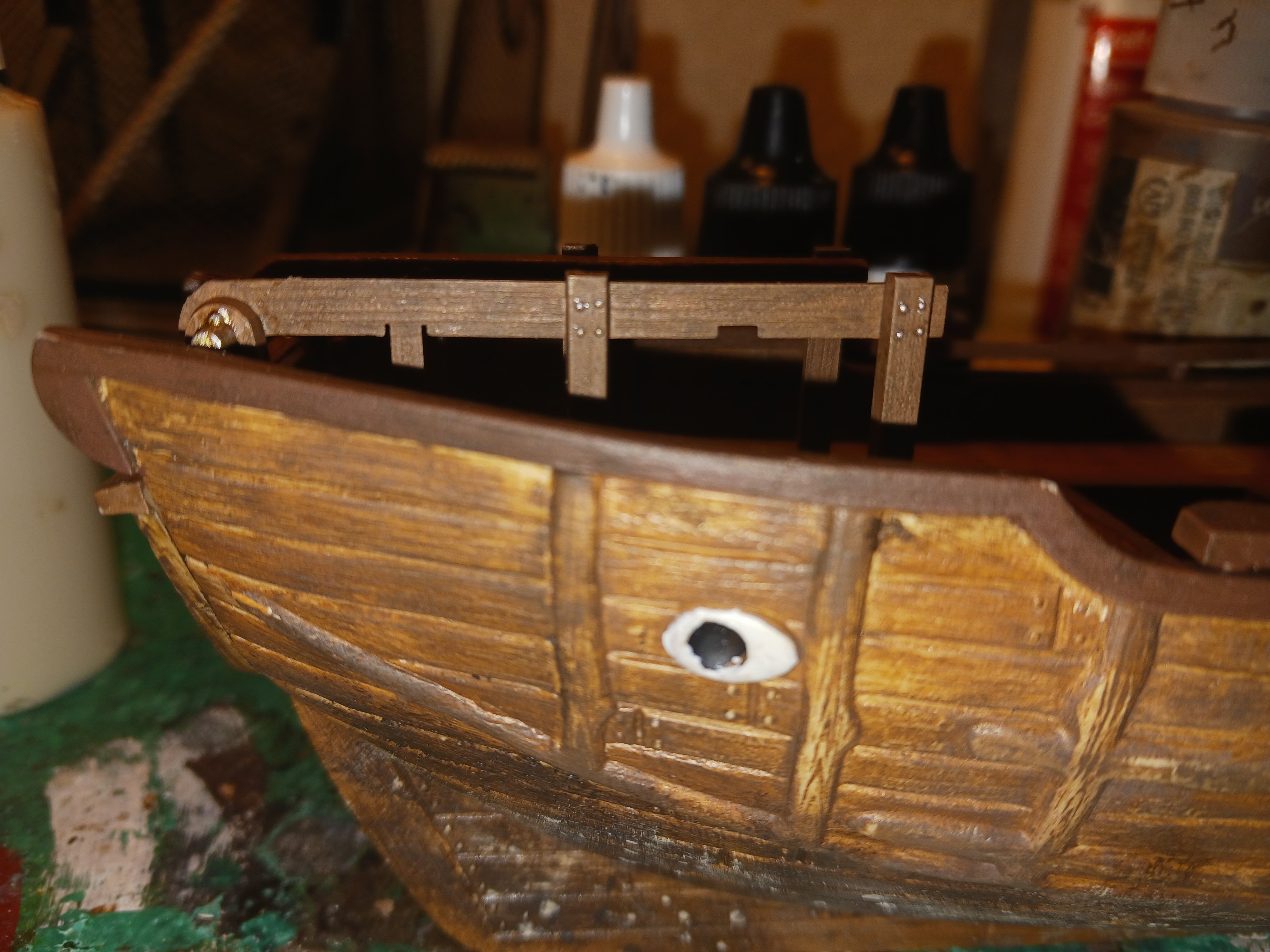

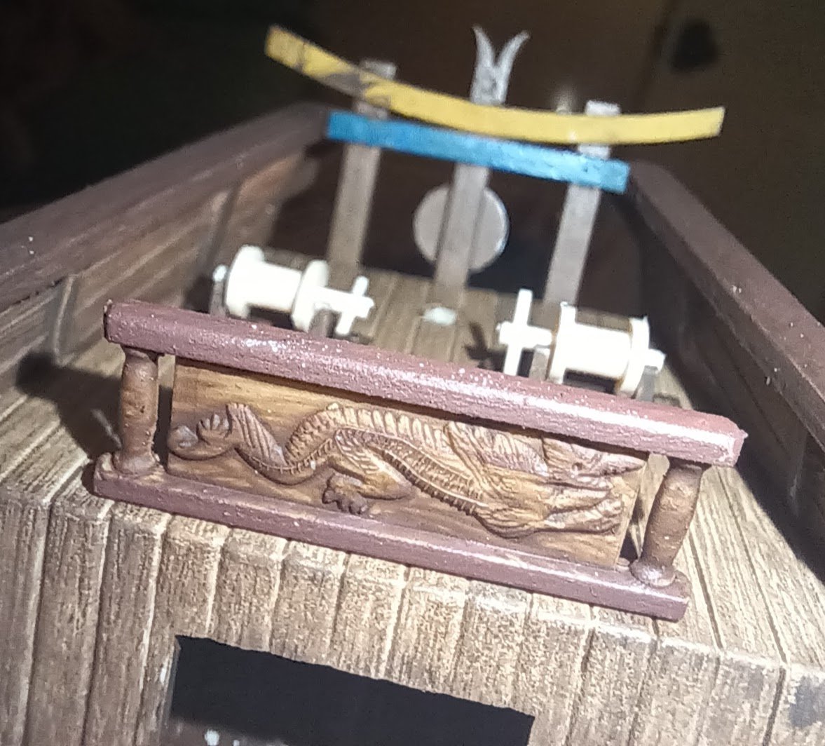

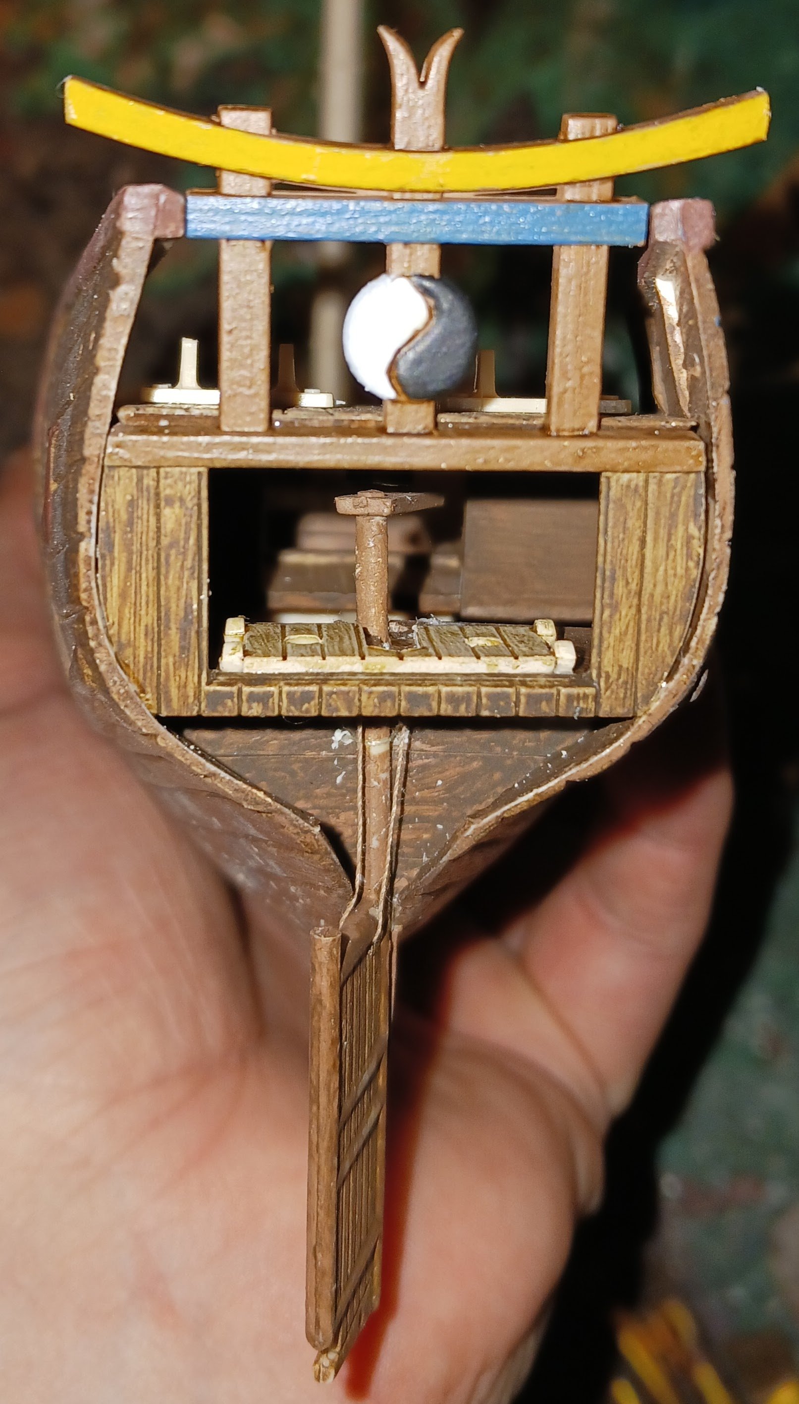

I've now completed the rudder assembly. There is a rope that wraps around the rudder post to prevent it from tilting aft, as well as the rudder lift. Here's what they look like from outside:
image.thumb.jpeg.073b664e7416aa56978a9403c01ba8db.jpegimage.thumb.jpeg.ccf2f2327a1ef0c4bfa07578a24fbb05.jpeg
And the rat's nest inside the ship, which will not be seen once the deck goes onto the ship: image.thumb.jpeg.025d7dad05a9b96a27d03950487765a3.jpeg
Two of the ship's guns will go into the interior section at the aft, which will further obscure this mess.

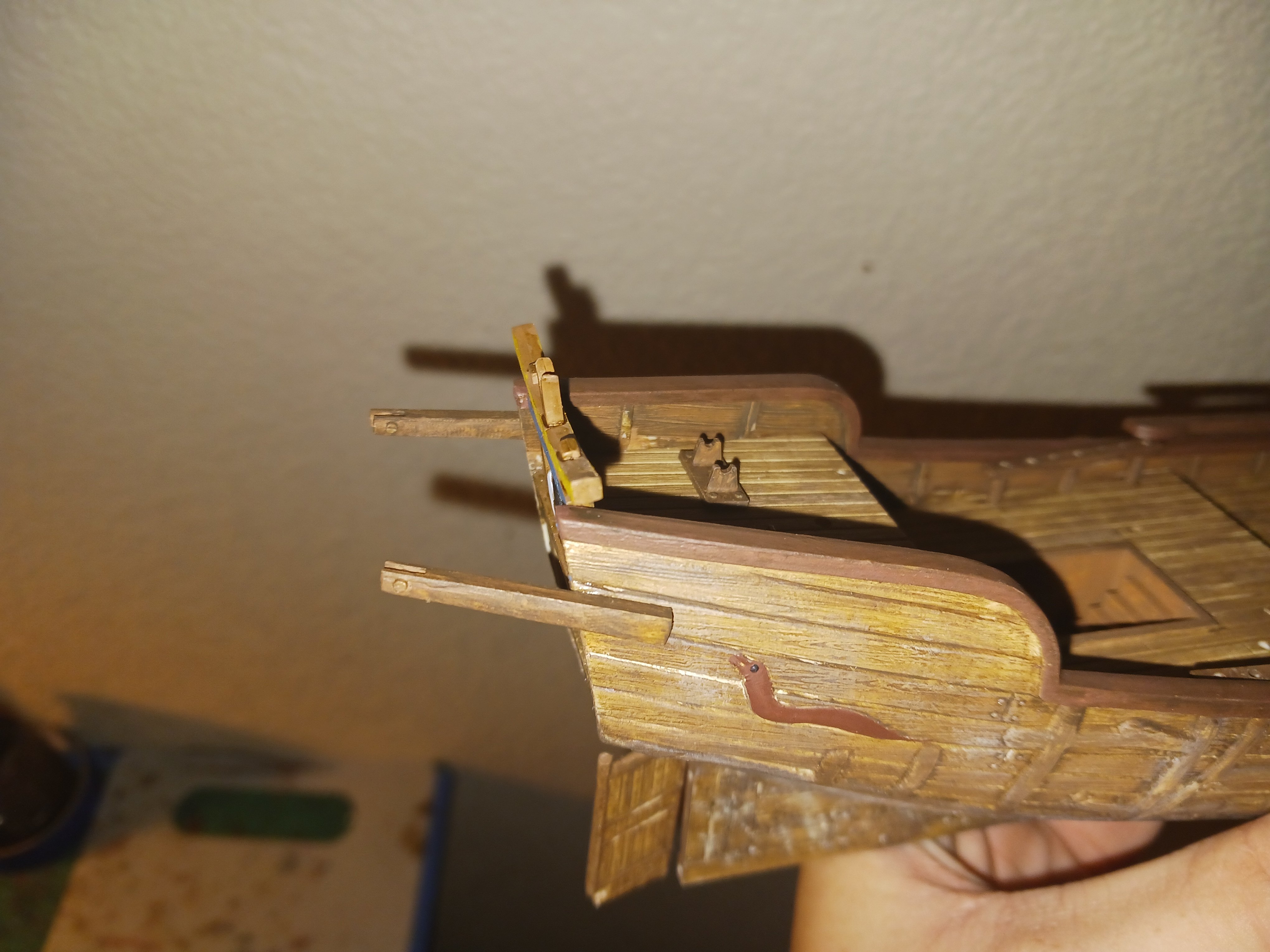

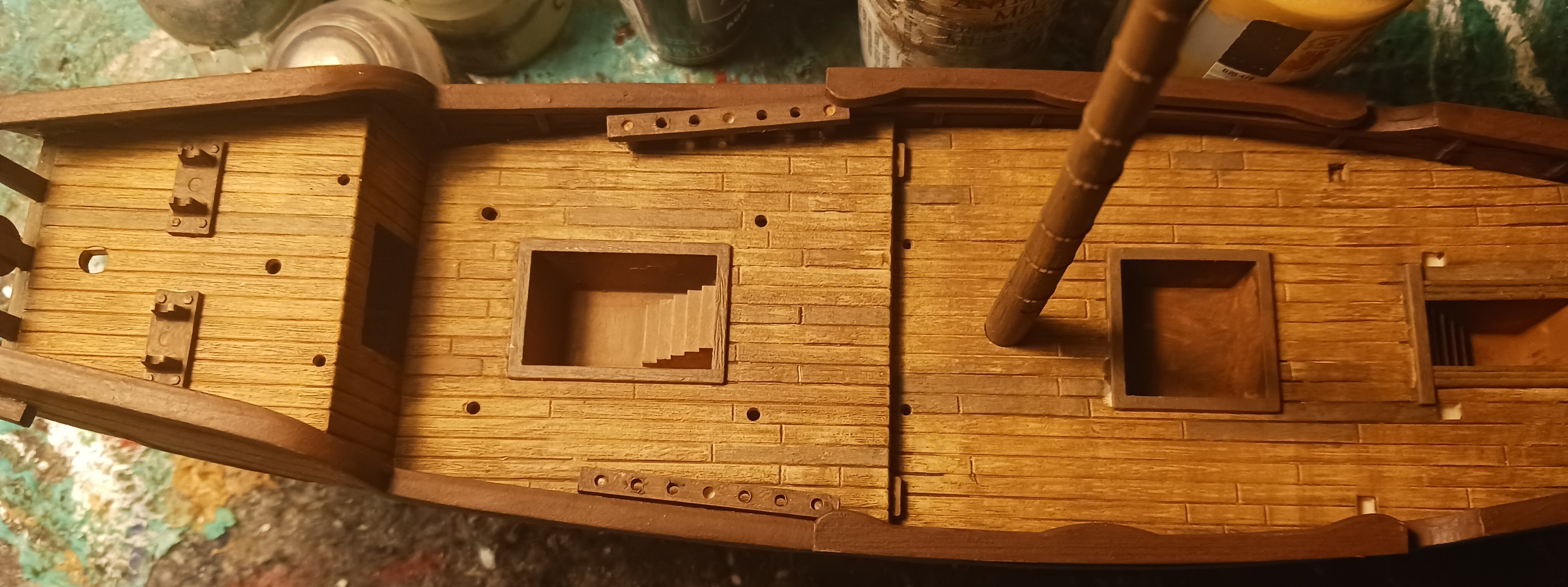

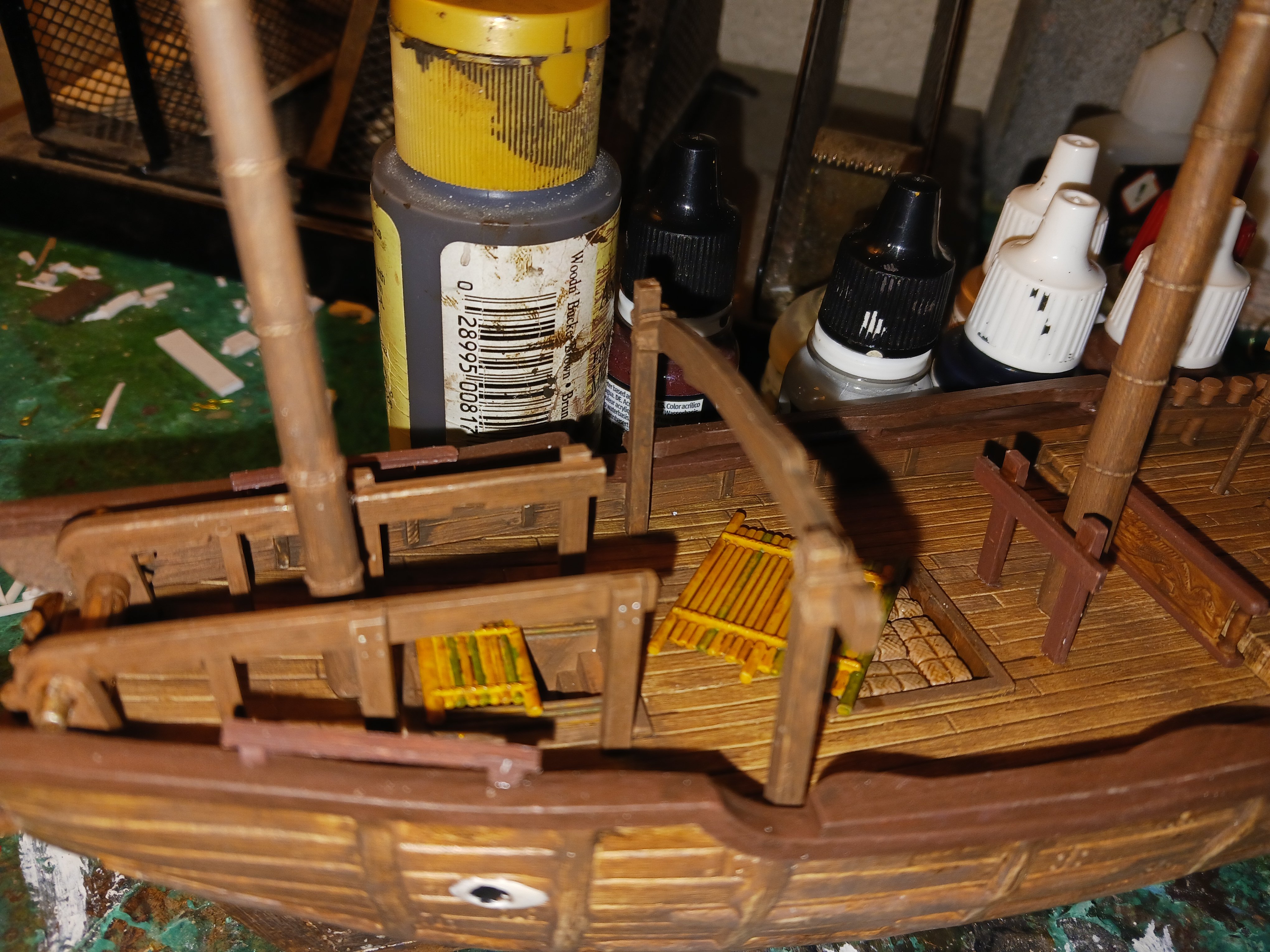

The fore, aft, and deck of the ship were all painted similarly to how I painted the hull. The deck is slightly lighter as I went easier on the weathering, but the technique is functionally the same.
image.thumb.jpeg.05d415c0b96f10ba35a328ebfc8a120e.jpegimage.thumb.jpeg.46bb8d76c00848c78e9a6f8f820bacf2.jpegimage.thumb.jpeg.efd473c69ad500c8cef6f7808968d3e9.jpeg

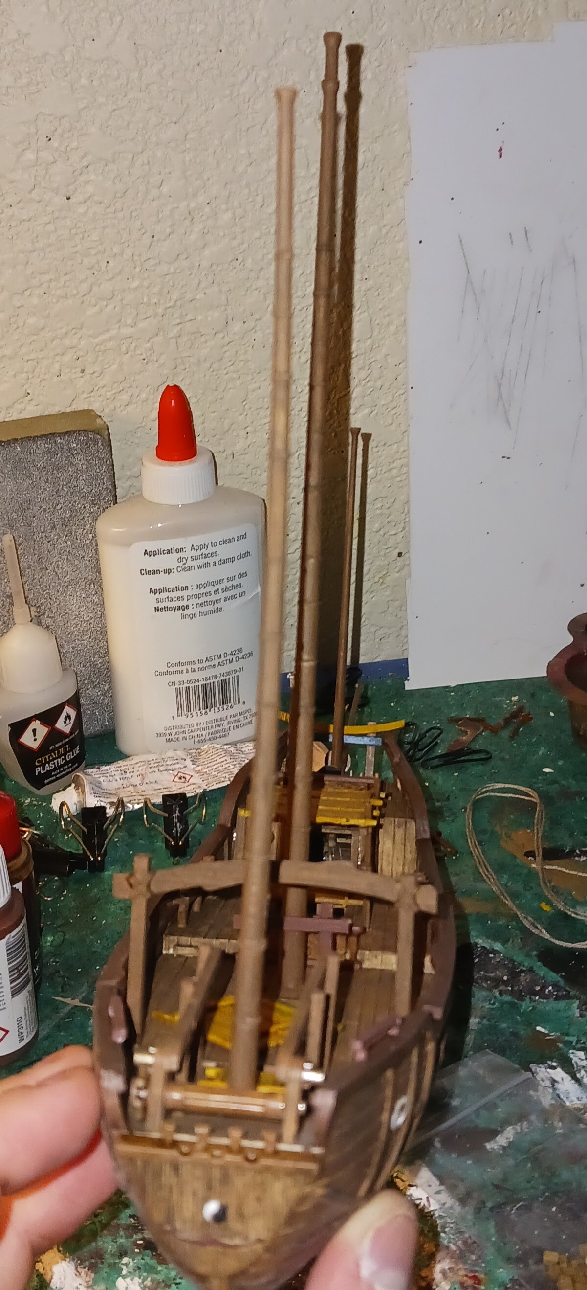

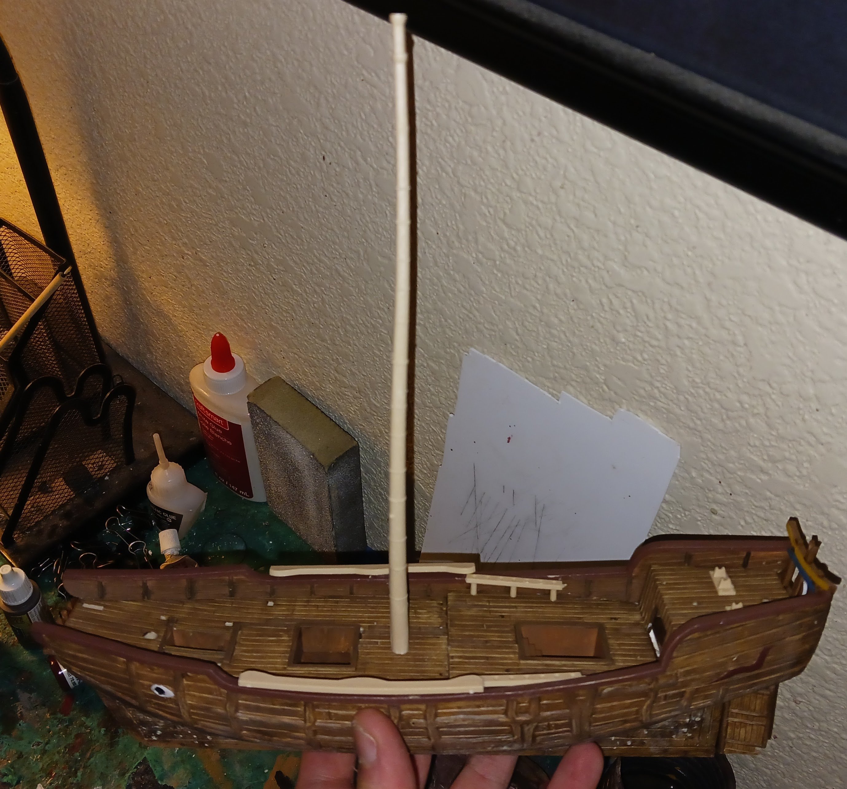

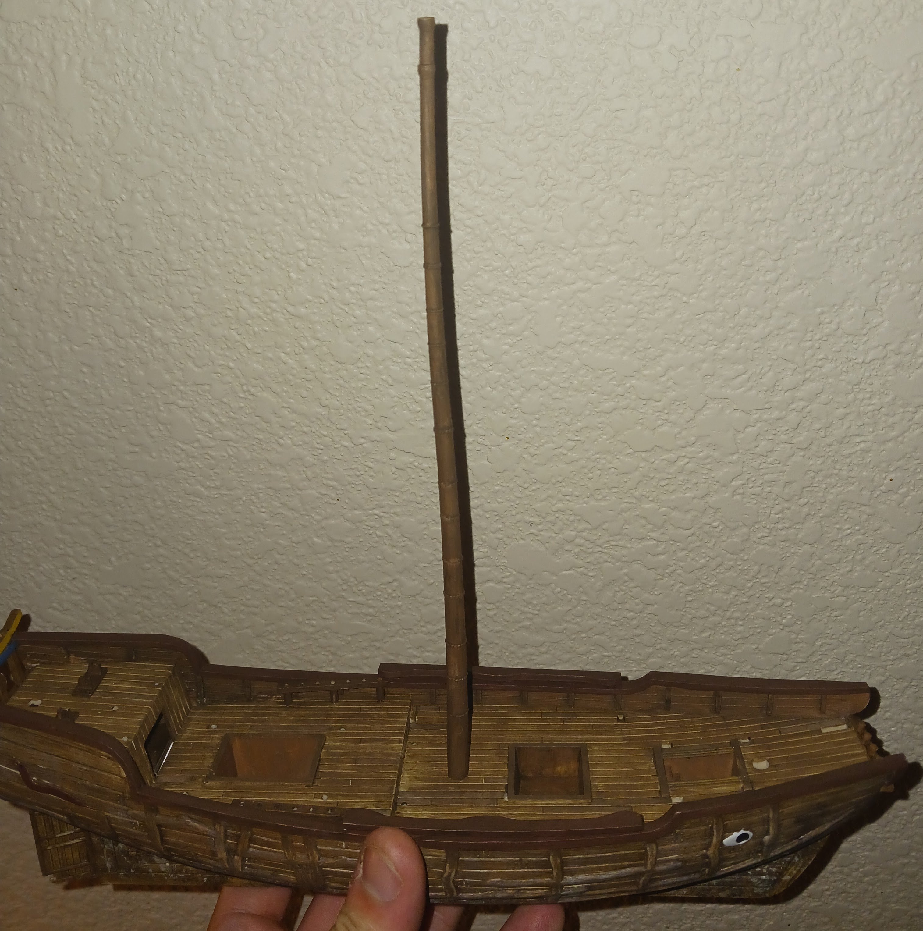

The boat winch housings, pinrails, main rails, and mast are currently dry-fitted into the hull. I rectified the aforementioned issue with the mast rake by doing some strategic sanding of the base of the mast. These will probably all be painted some shade of brown.
The parts that we dry-fitted on the deck have all been painted according to previously laid-out principles, and installed. It is wise to dry-fit every part prior to painting and installation. What I like to do is grab and prepare a few different parts in the order I want to install them, and proceed from there.
image.thumb.jpeg.53c0640d54bcc5c9218f6ae474c3e72d.jpegimage.thumb.jpeg.ca3384f5c72366a5e42ad27006ef2c27.jpegimage.thumb.jpeg.54f0f0a3e74e7329905b4570ba786875.jpeg

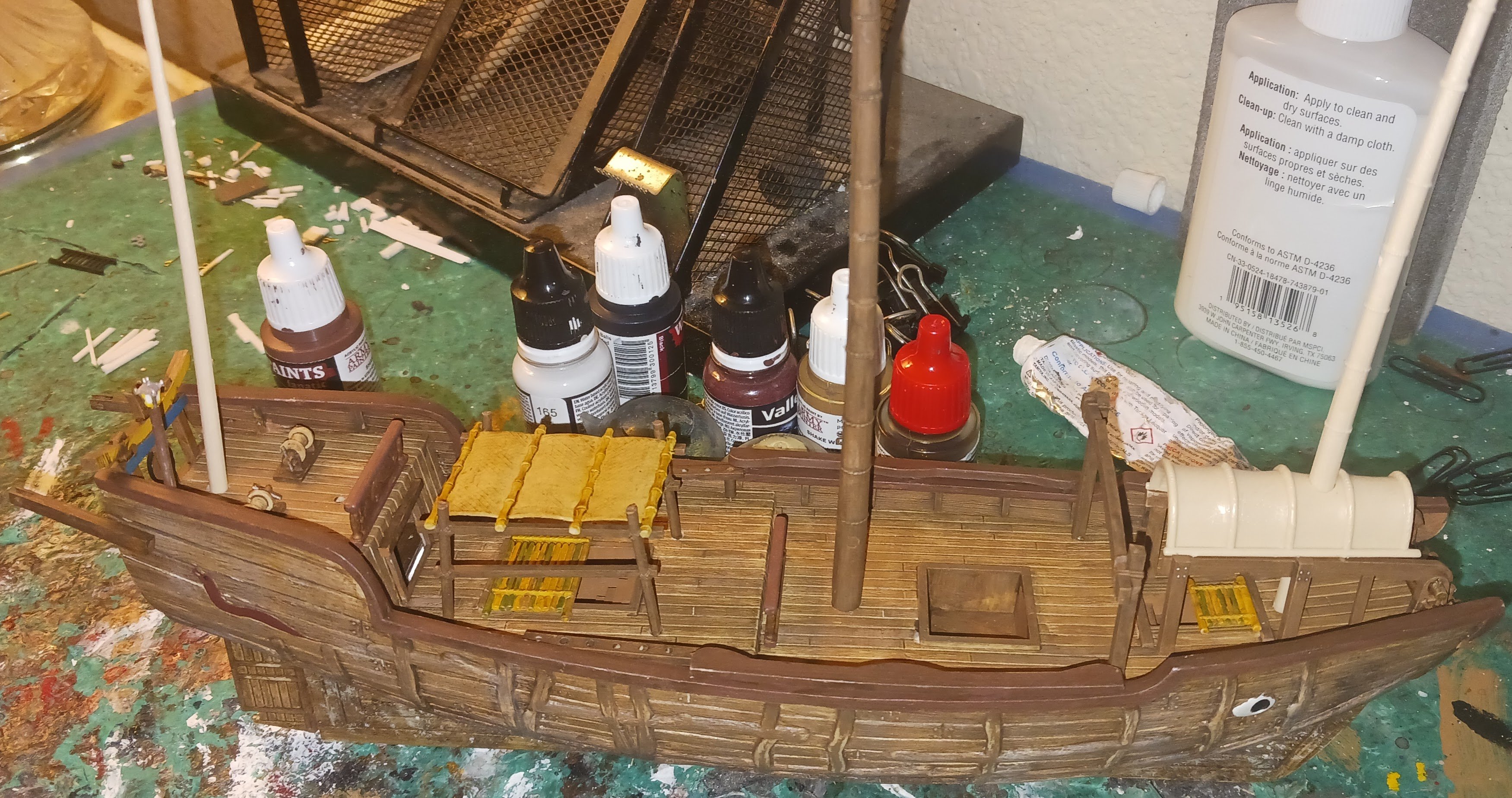

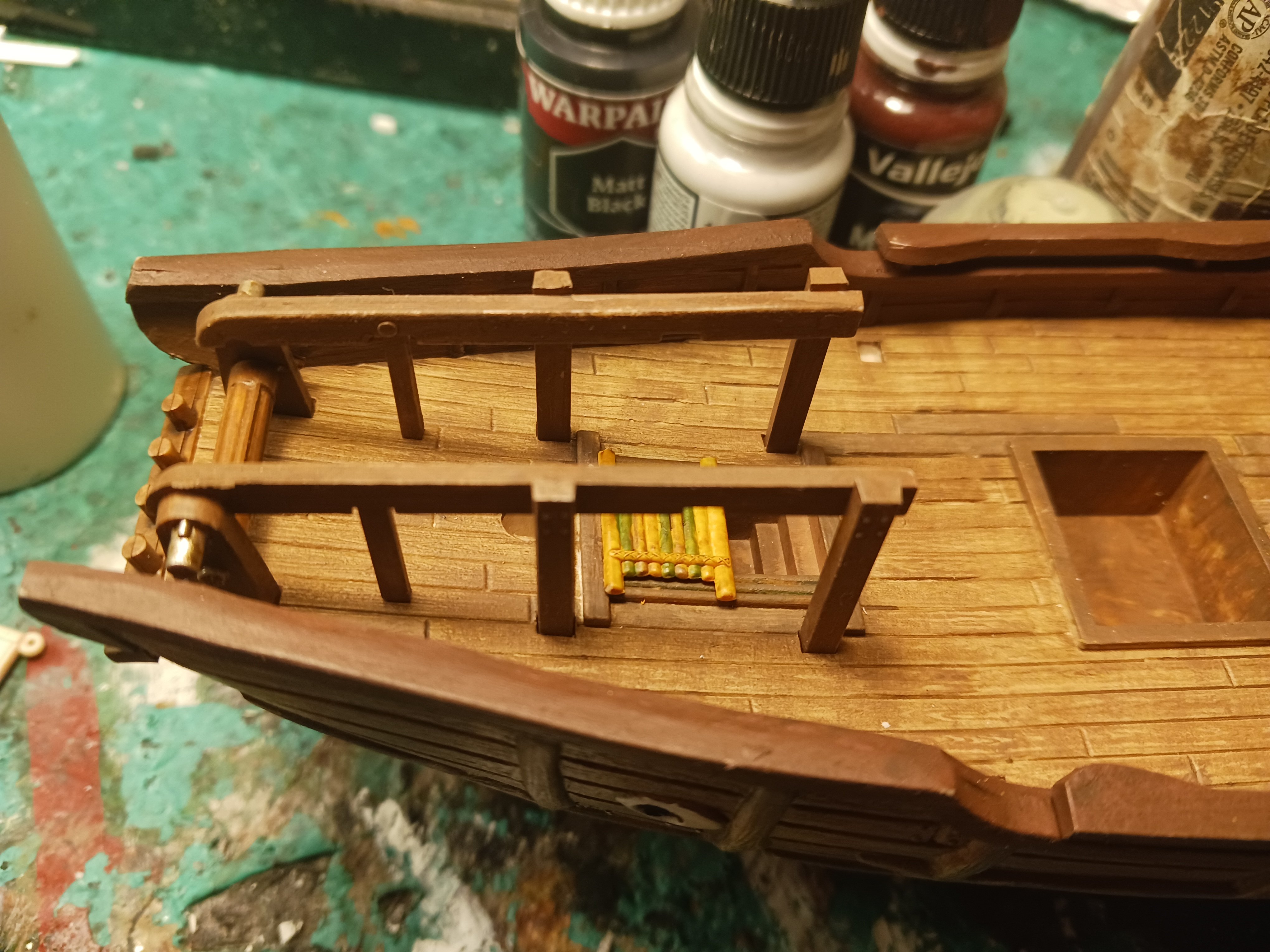

The next assembly will probably be some of the interior railings, hatch covers, and some other miscellaneous pieces.

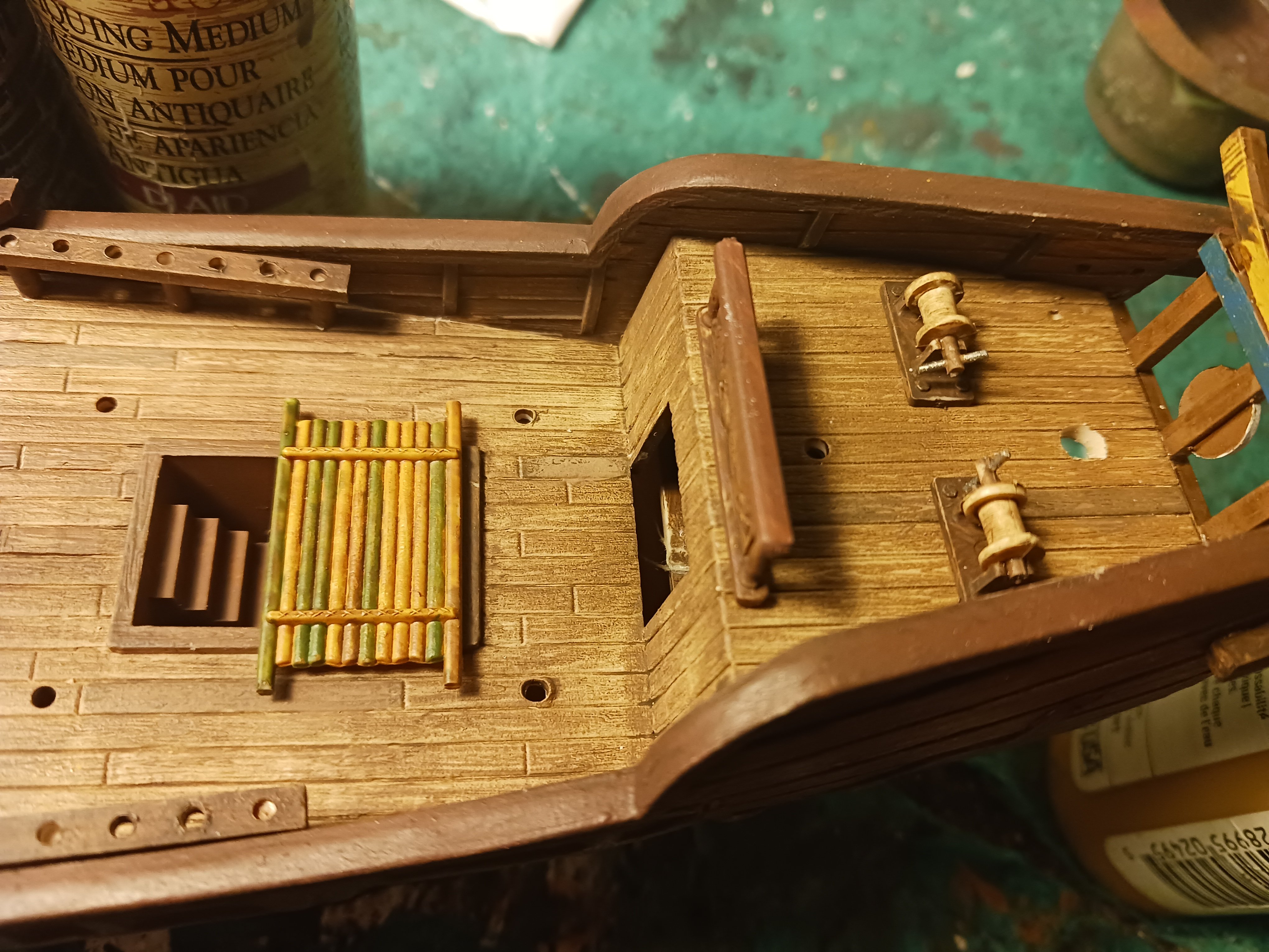

The railings were painted to look like unpainted wood, which is an effect that isn't easy to achieve with a plastic model. What I did was paint each railing with two coats of thinned brown paint, which was applied unevenly, and put a brown shade coat on top of that. I proceeded to paint the top and bottom a different color of brown.

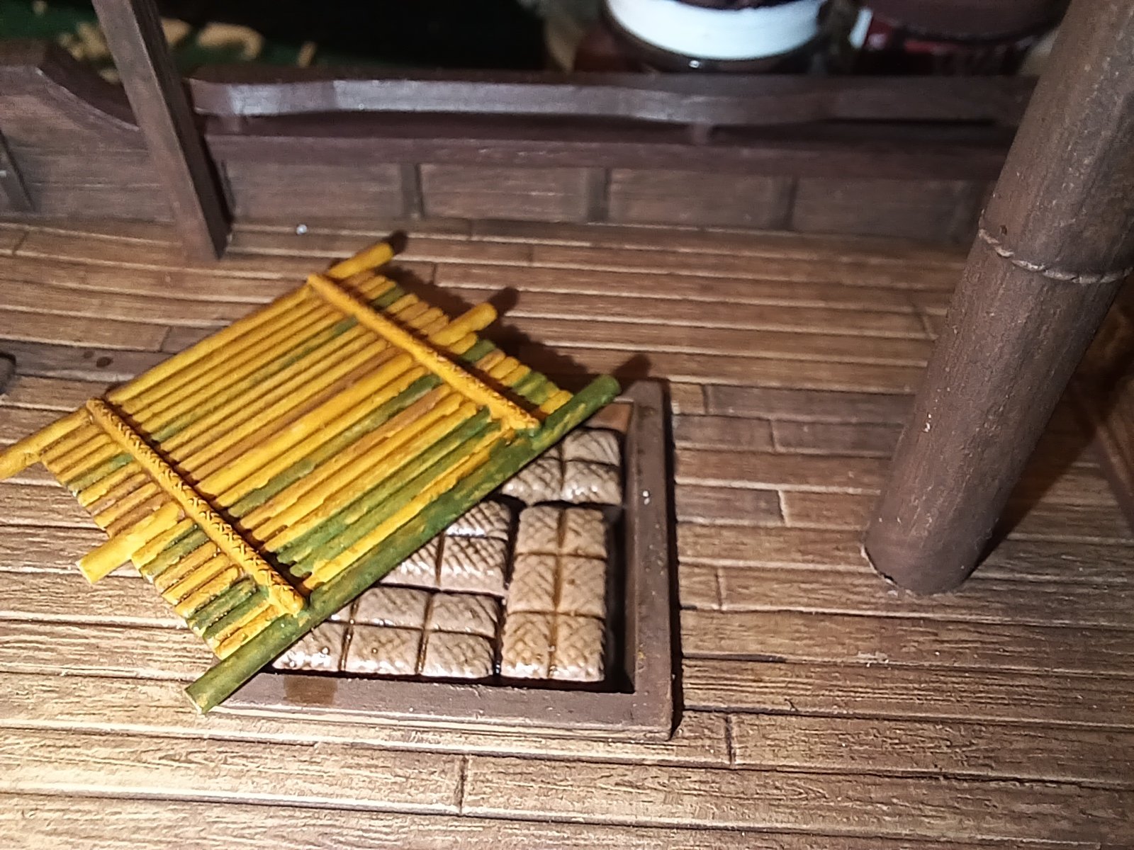

The bamboo hatch covers were painted using a brown-yellow paint as a base. After that, a mixture of yellow and green went over select bamboo poles to indicate newer bamboo. Older bamboo in need of replacement was painted yellow-brown.
image.thumb.jpeg.dd611aed6a7e1a5ca92e77b1a932ad79.jpegimage.thumb.jpeg.bb74d4c39a18893e8e2685cbe4de1548.jpegimage.thumb.jpeg.0bb71154400d1d532ce0114b2738c519.jpeg
The fore upper works were painted relatively normally, using a brown paint with shade on top. Metal elements were painted silver and shaded.

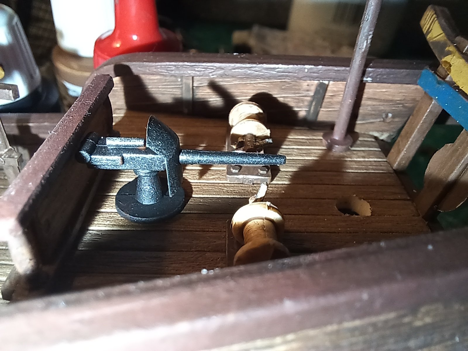

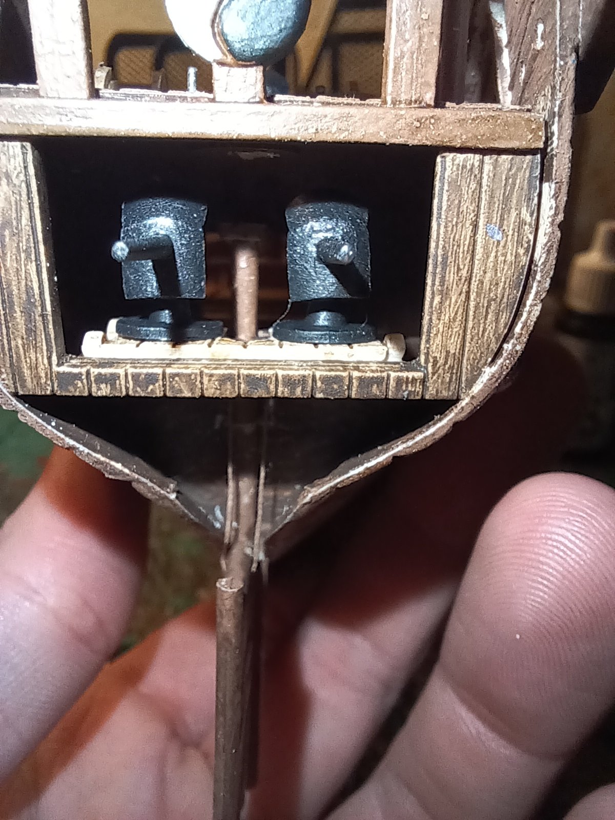

An interesting thing I found about this ship is that not only is it armed, but all three of its anti-ship guns point directly aft.
image.thumb.jpeg.5f5468a7a985754c2b5c382fcb90ff85.jpegimage.thumb.jpeg.b47a7defecde357247fe762a935ea233.jpeg
Unfortunately, these guns had barrels so tiny they wouldn't have been able to accept a pin vise bit. The anti-personnel pieces that will be added after the completion of the rigging are the same way. Either way, the crew of this ship is probably well familiar with the practice of running away from something while shooting at it. Perhaps something this ship is carrying puts it on the wrong side of the law.
Found it! In an attempt to conceal their criminal intent, a few members of the crew have partially covered their stash of highly illegal opium to sell on the black market in southern China. The sale and use of this addictive substance fueled two wars between Qing dynasty China and Britain in the mid-1800's, with the end result being a Chinese crackdown on the sale of the drug within their borders, citing social decay and the immorality of drug abuse. This was the original War on Drugs, and the crew of this smuggling ship is looking at a long prison stay if they're caught.

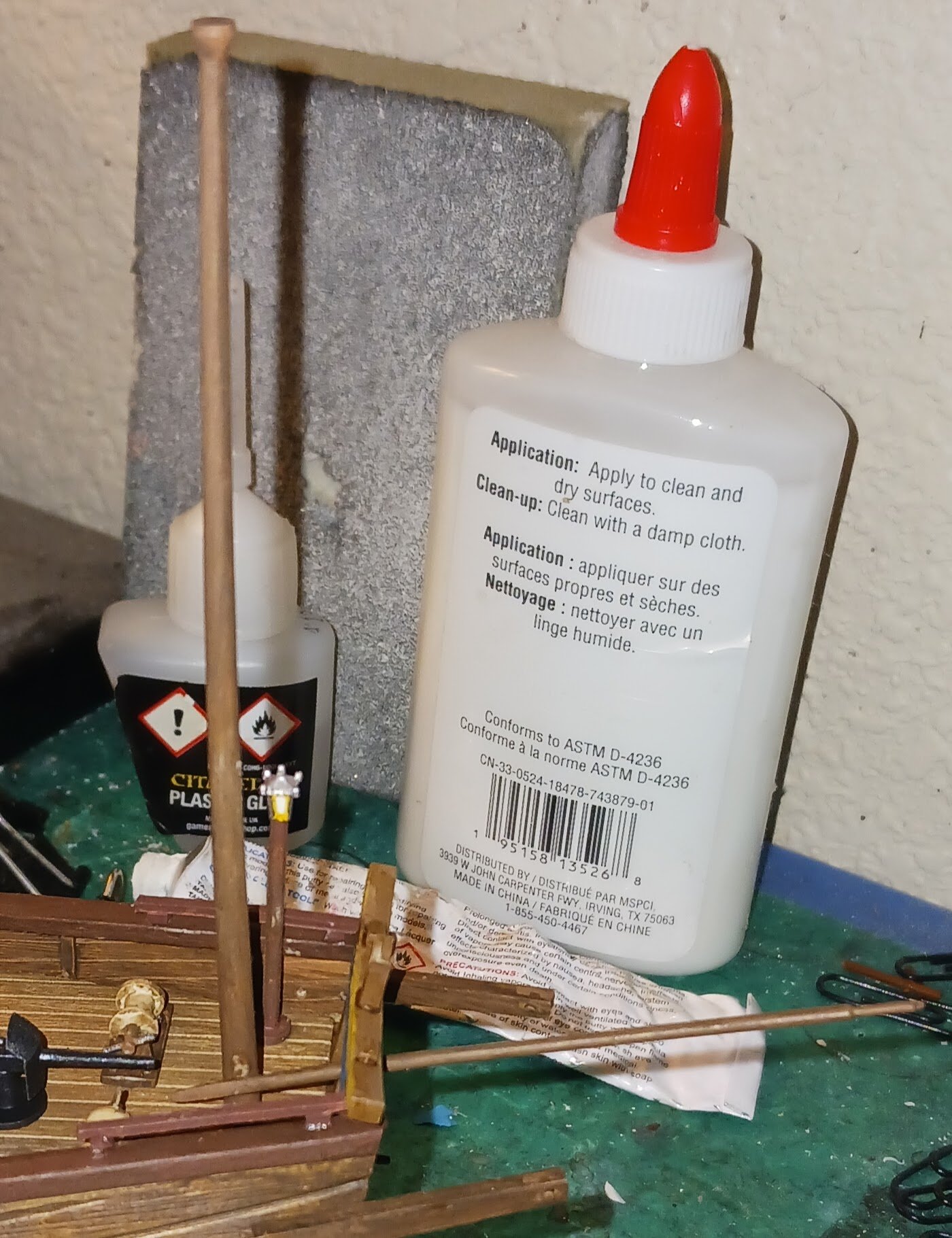

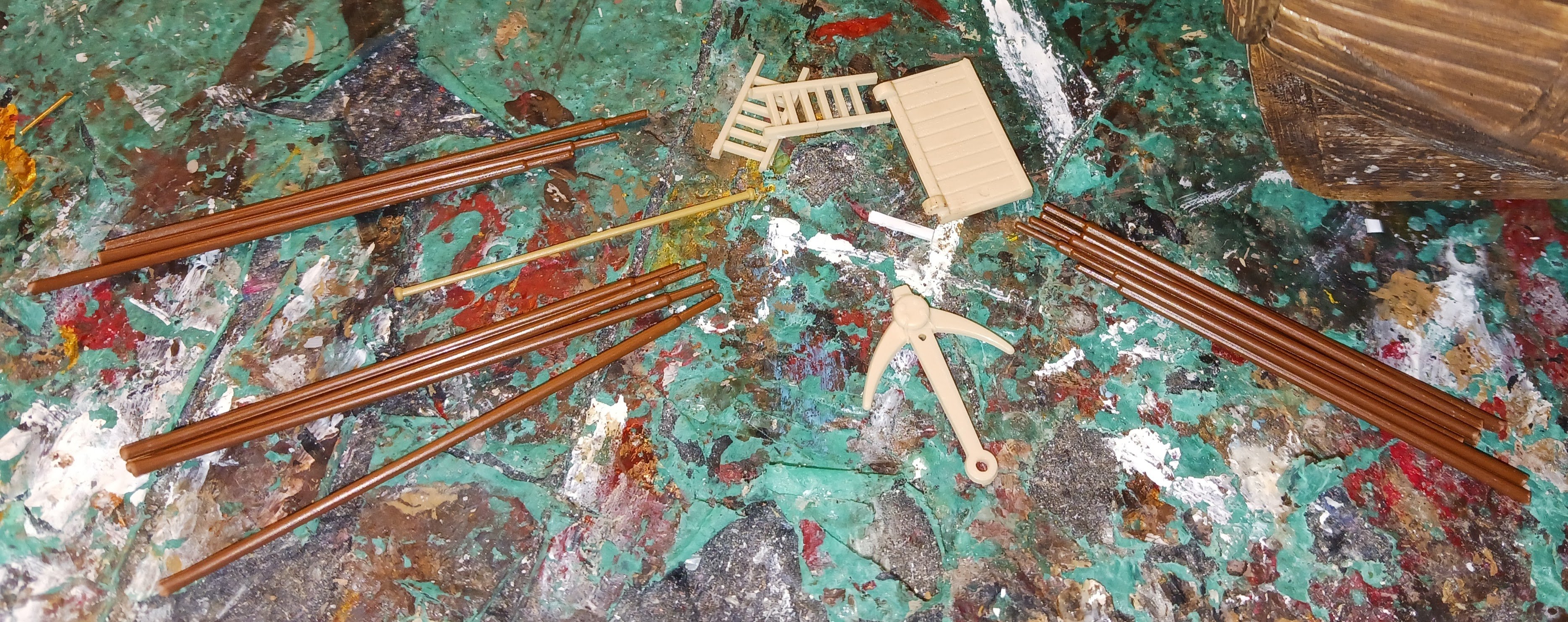

These are some of the elements so far for the sails and rigging. The gunport lid and ladders have since been painted and installed as of the creation of this post.

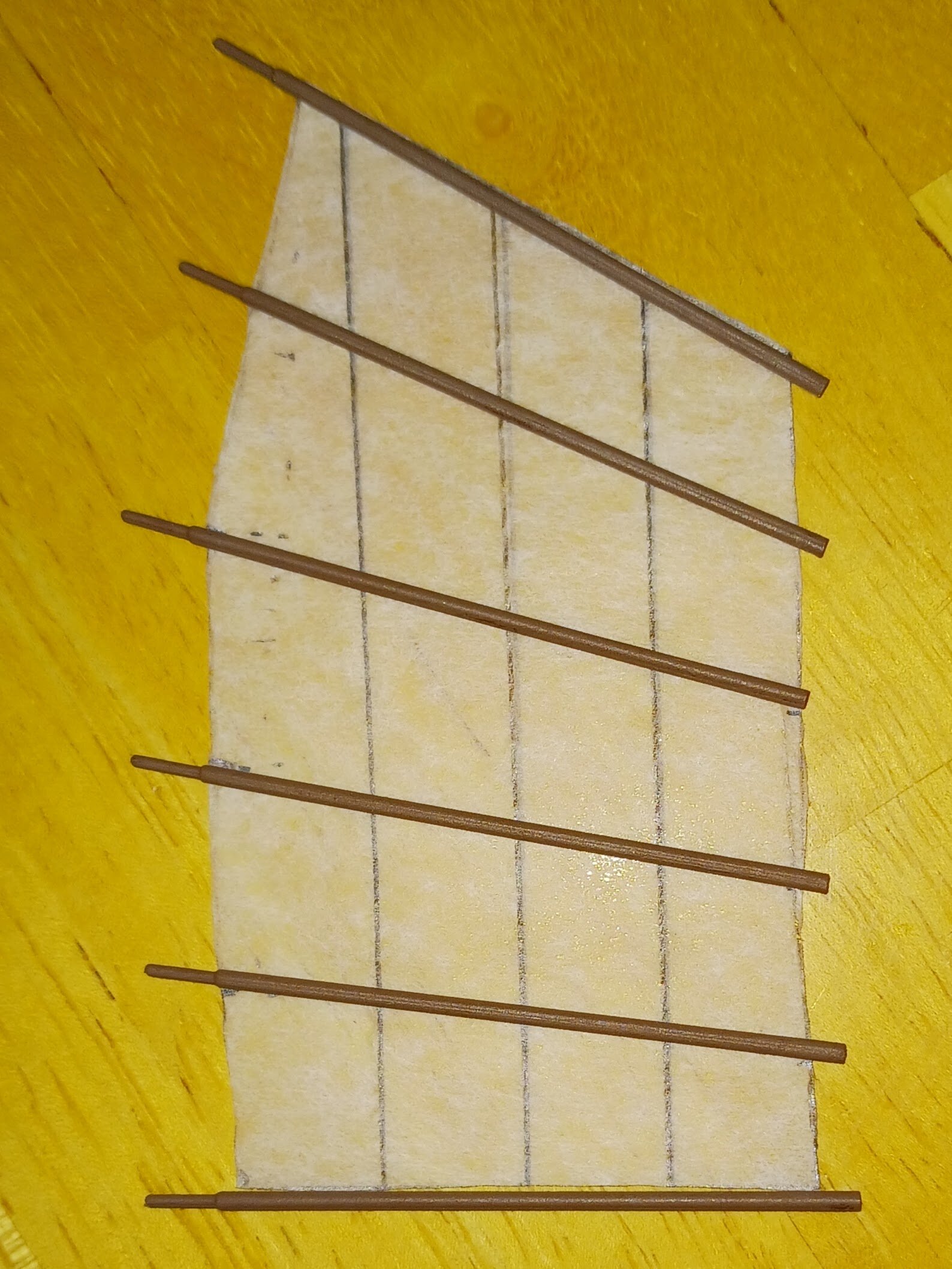

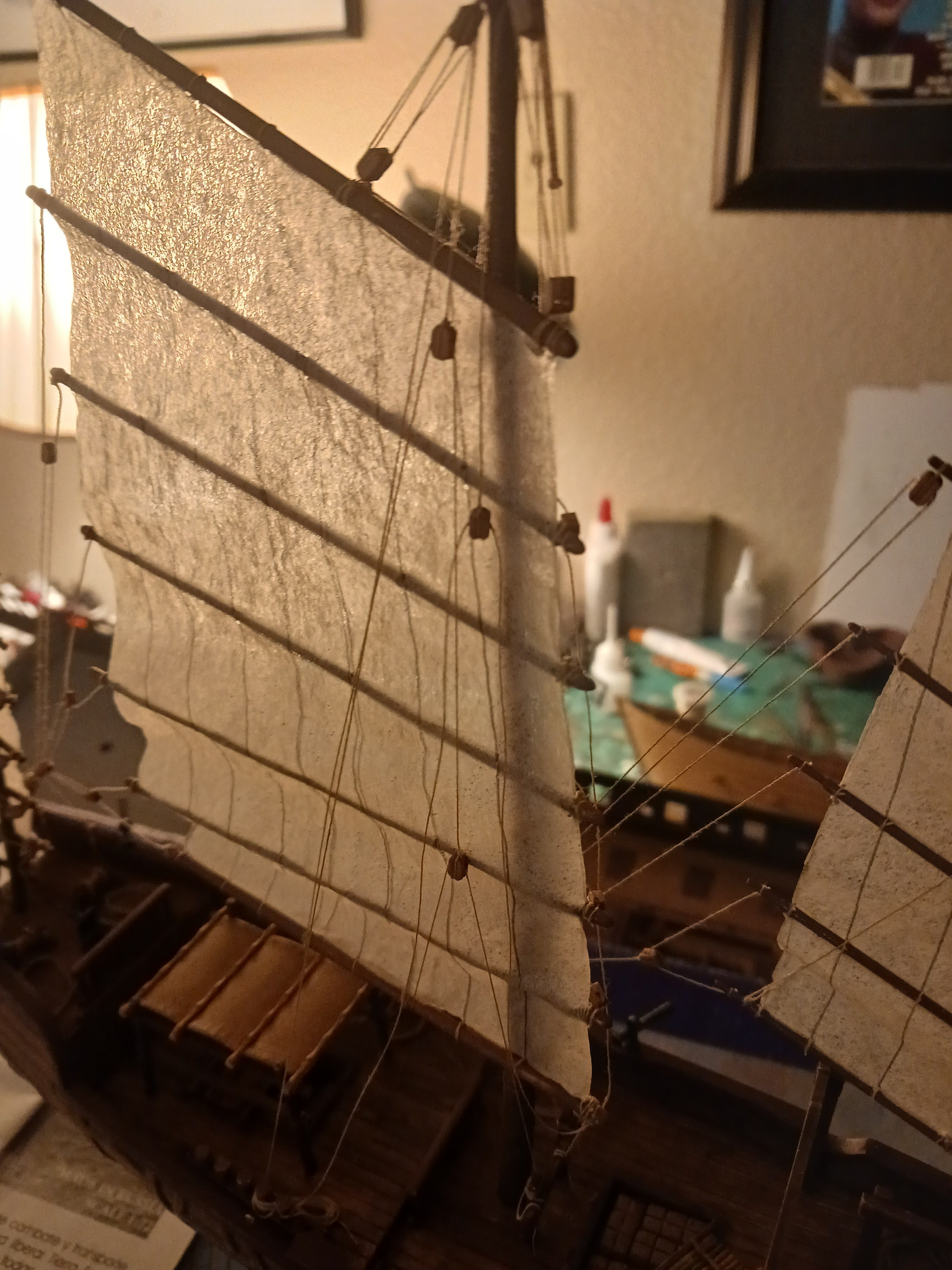

Let's go through the entire process of making and rigging a sail from scratch. If you're someone who wants to use the kit sails (and they are remarkably well-made for kit sails) then this post won't apply to you. Before you make any sail of any type, you must first familiarize yourself completely with the type of sail in question and how it is used. You should know every line, block, and other structure on the sail, and what it does. Failure to learn everything about the sail you are about to make could cause you to have to remake the sail in the future, which is a huge waste of time. Ideally, you should analyze both modern diagrams and pictures/paintings from the time in which the sail was used. You could even check out videos of people actively sailing the modern replicas that use the sail.
The Chinese junk sail (also known as the balance lug) is very unique in that it is an extremely complex sail for its size and use.

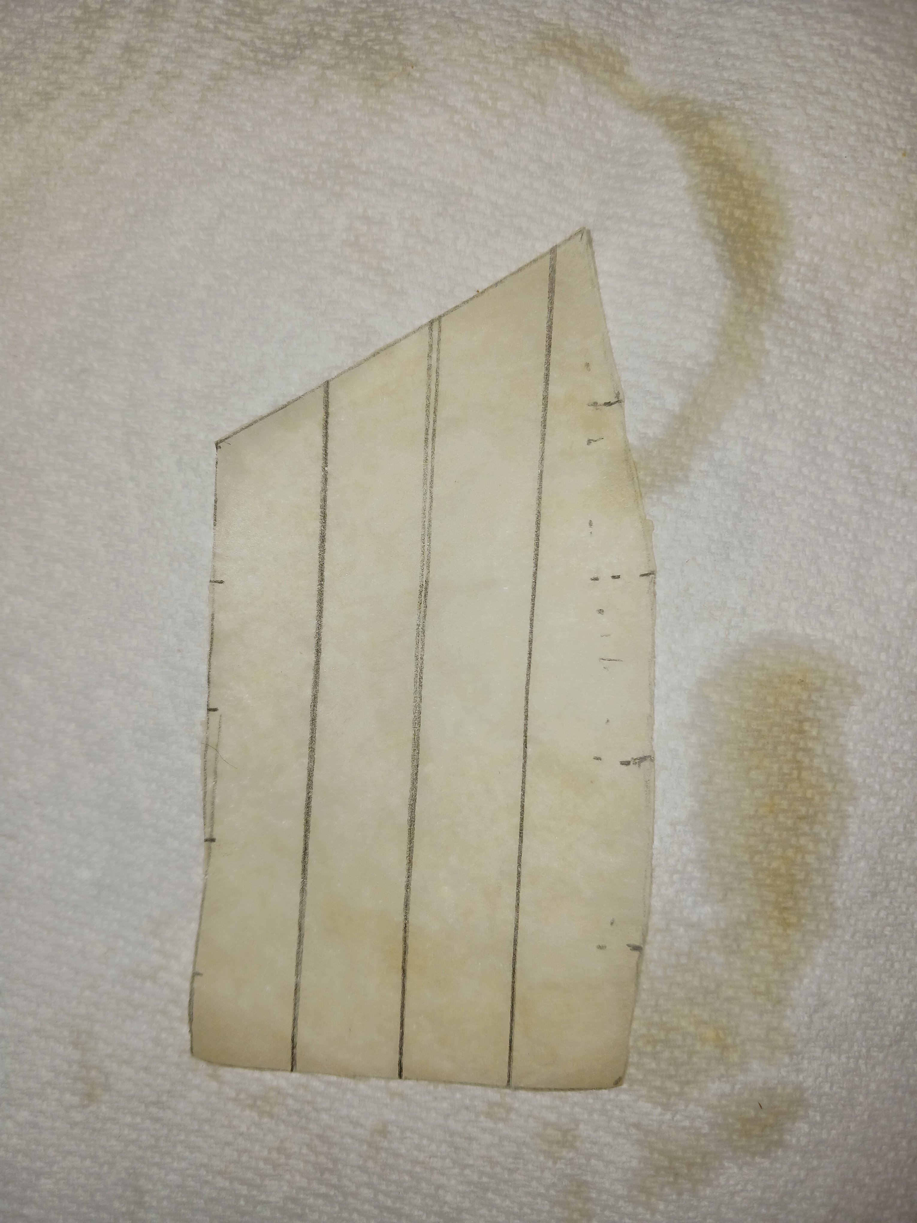

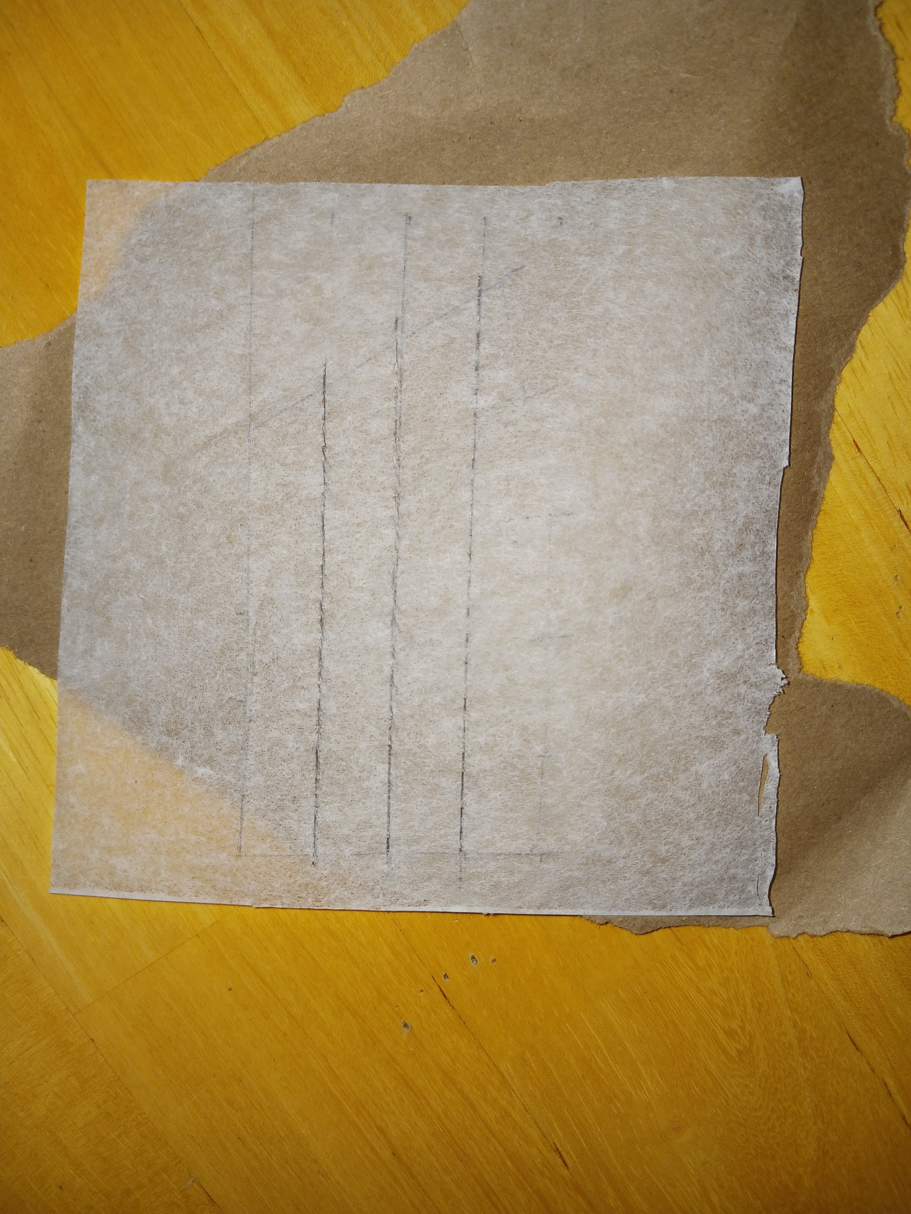

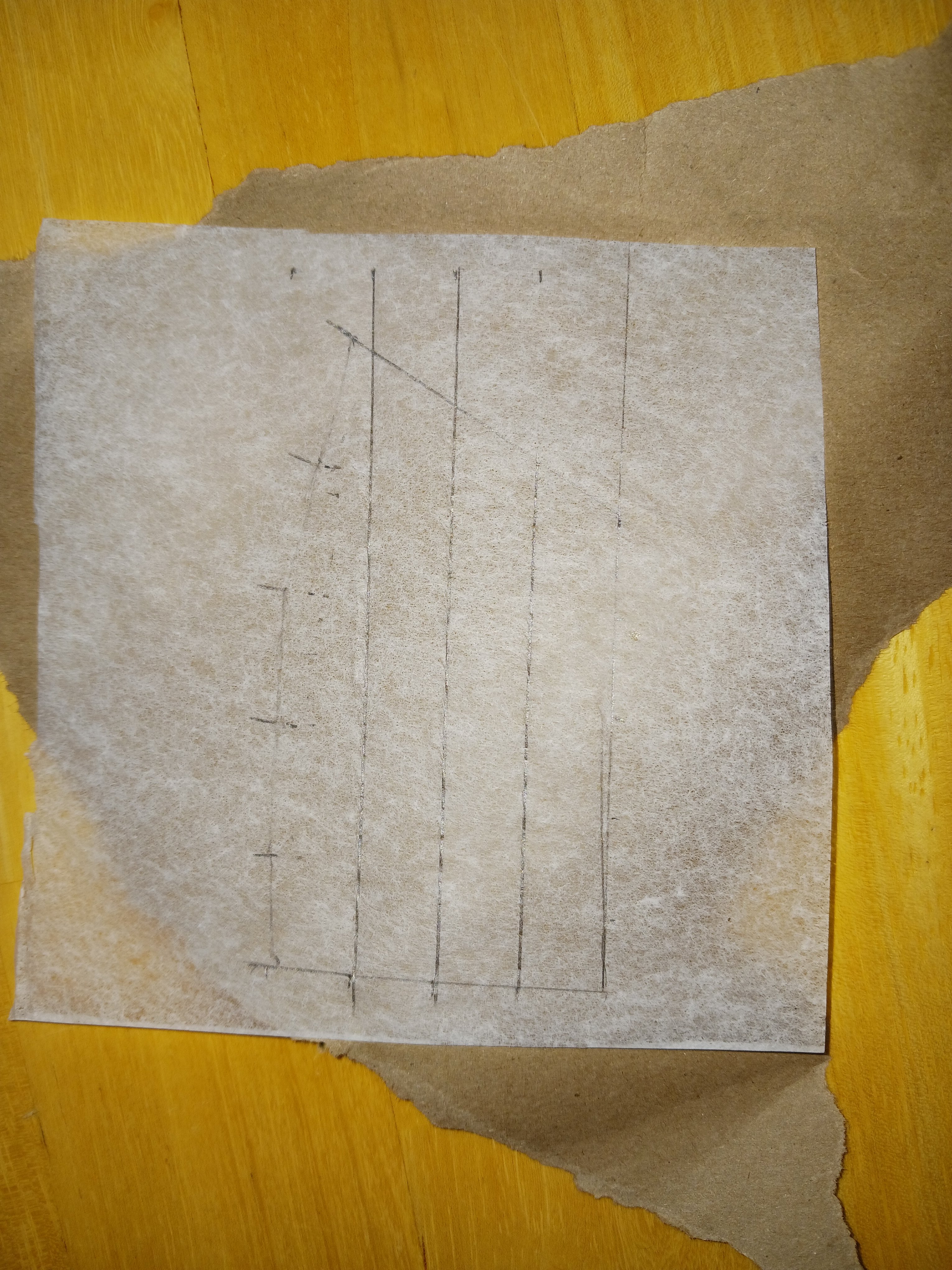

The material I use for sails is silkspan, which is basically a stronger form of tissue paper. I used some modified parts from a different kit as the battens and yards/booms, so that is also a non-issue. The line I used for this sail was tan sewing thread, as it was a good diameter for realistic rigging on this sail.

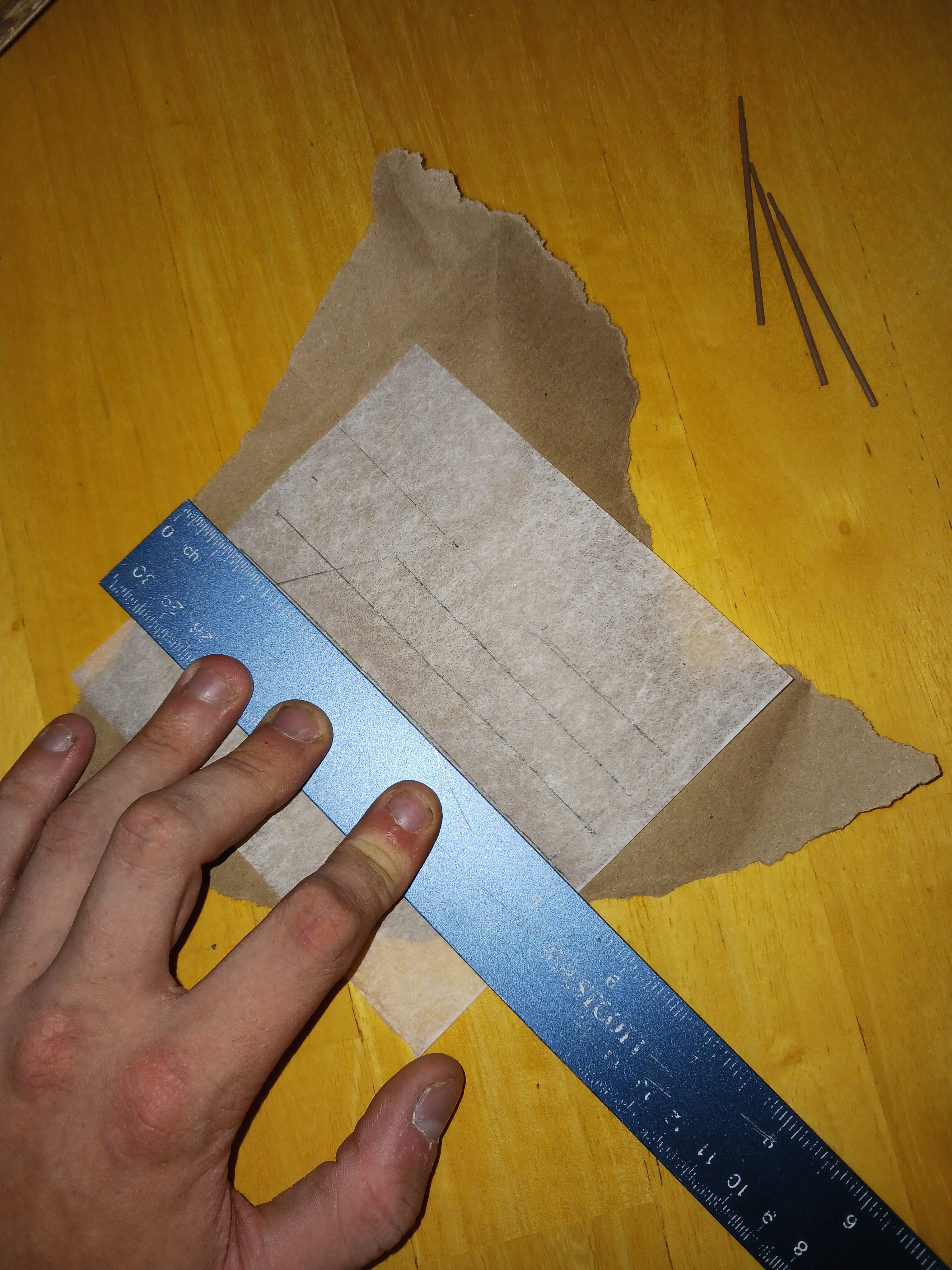

First, I measured and drew an outline of what the sail's size and general shape would be.
Then, I drew in the panel lines on both sides of the sail with a mechanical pencil.
 image.thumb.jpeg.4e2f9f3479a94e3124707034018faa6f.jpegimage.thumb.jpeg.f0bf491b7d4853baa6a2ccc84c33ac2e.jpeg

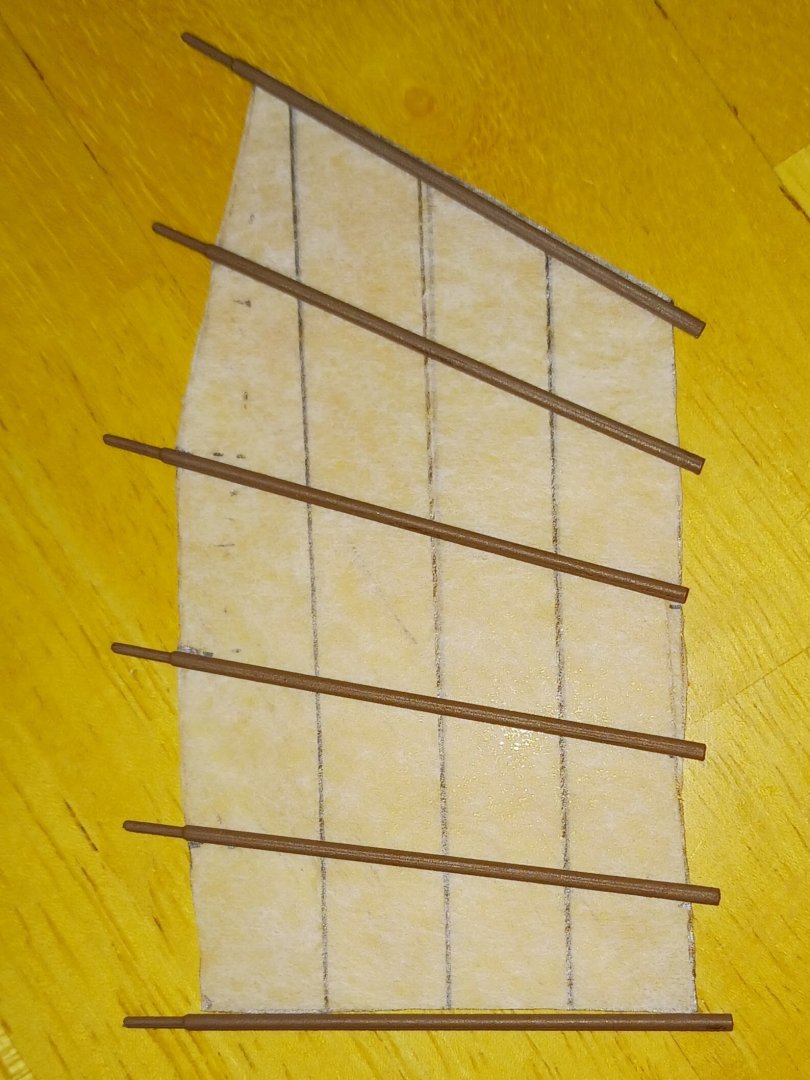

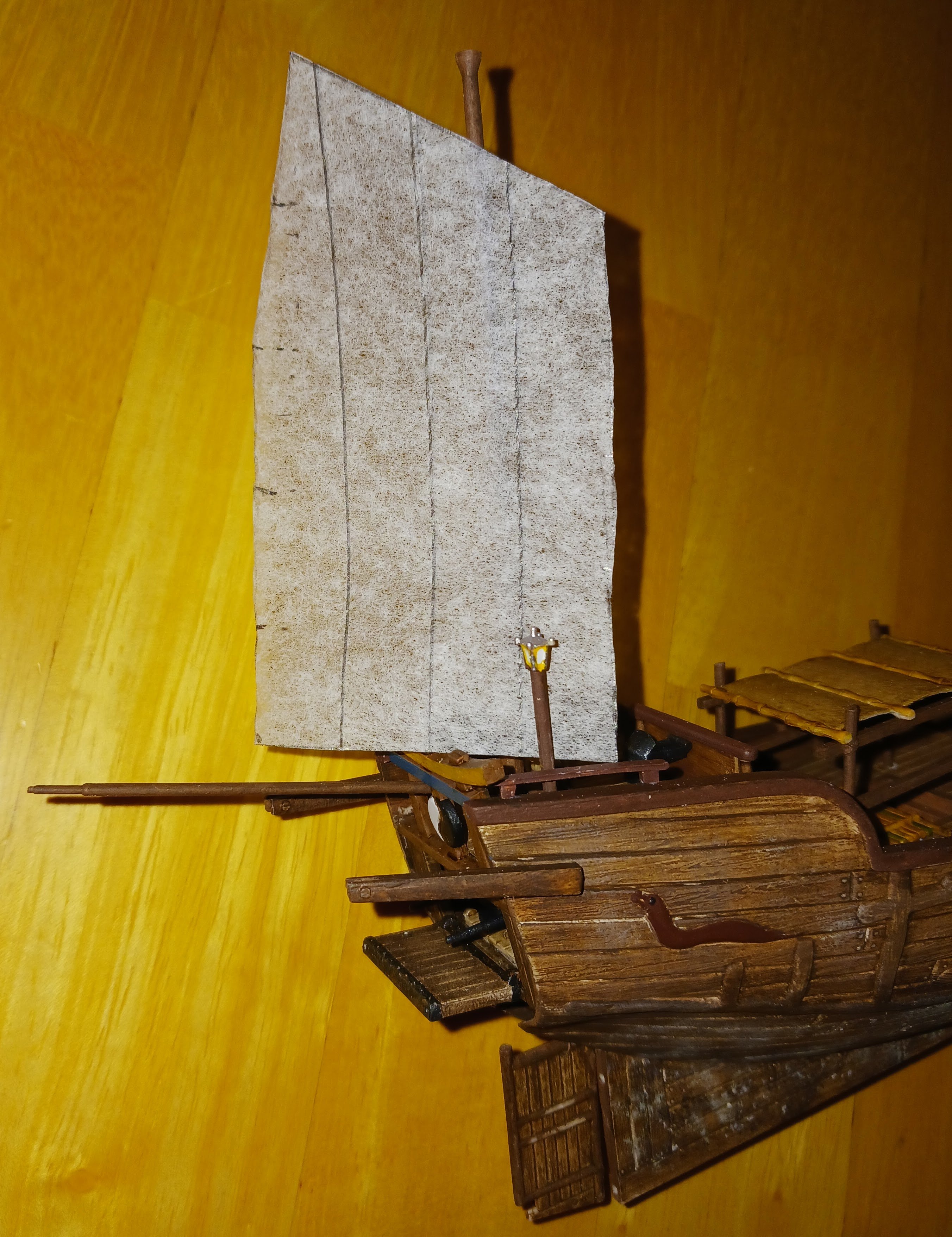

After cutting out the sail, I did a test fit to see how it would look on the mast and assess whether or not it needed adjustments.
Before I could commence with the rigging, I had to do a few more things to get the sail ready. The first was to test-fit the battens to the sail to see if any of them needed to be trimmed, which none did.
Afterwards, I soaked the sail in black coffee to give it a realistic stain. I dried the sail on a paper towel.
These are the materials and procedures I use with nearly every sail I make, and I have made dozens. Many modelers choose to do it differently, many with better results.

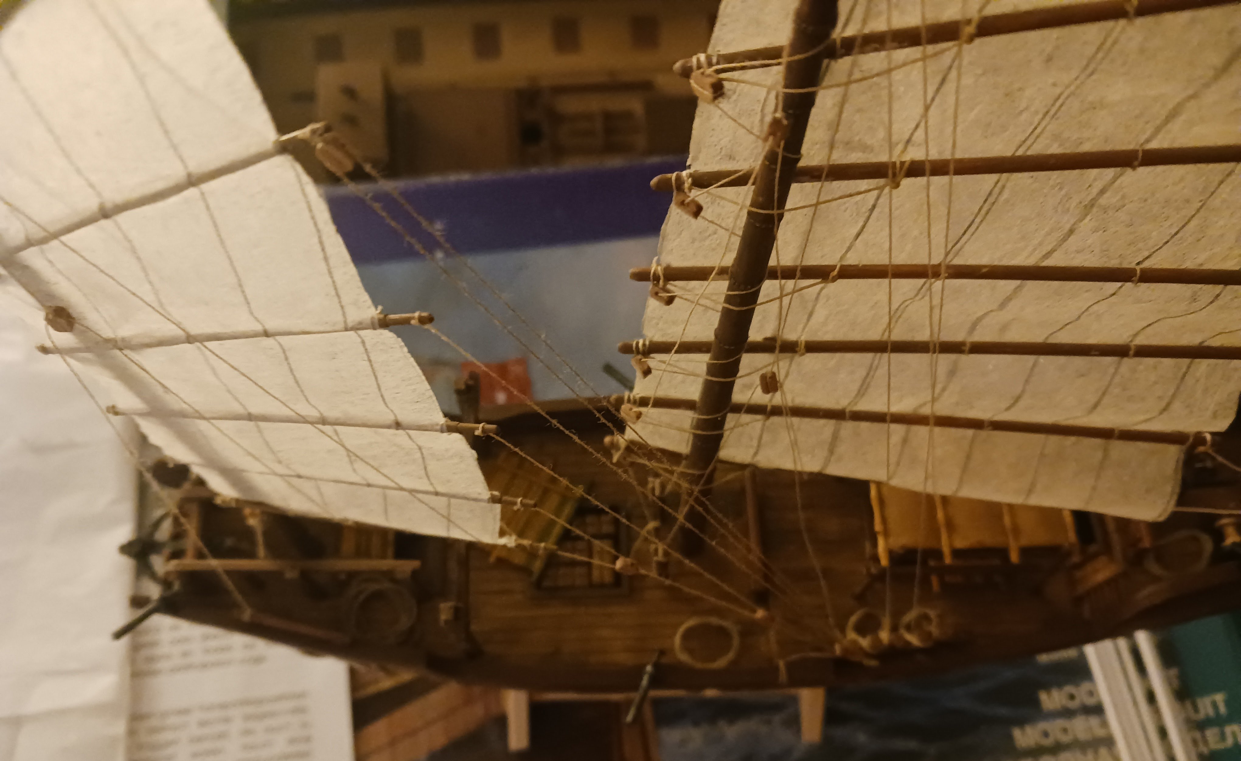

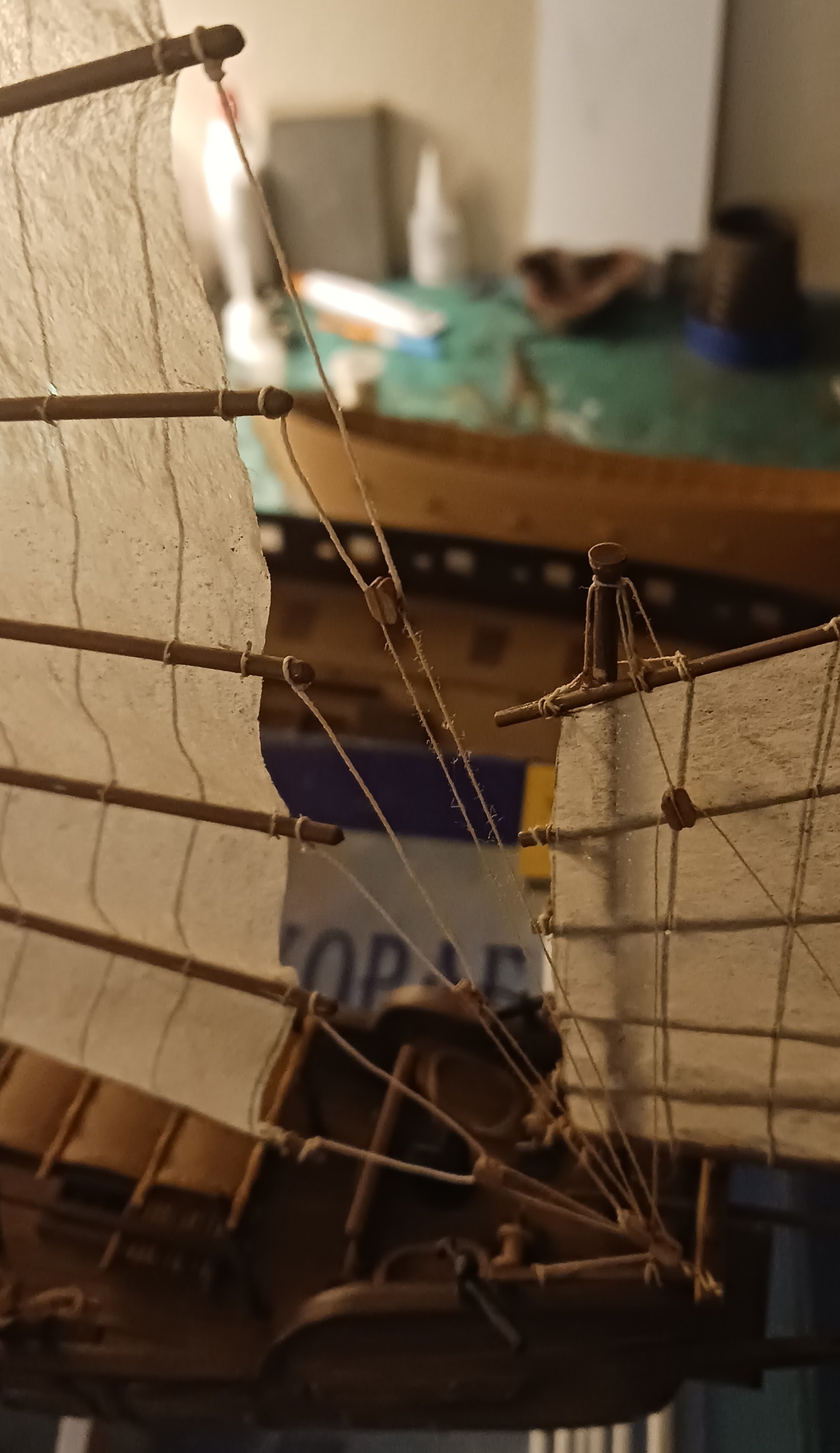

Now, on to the rigging.

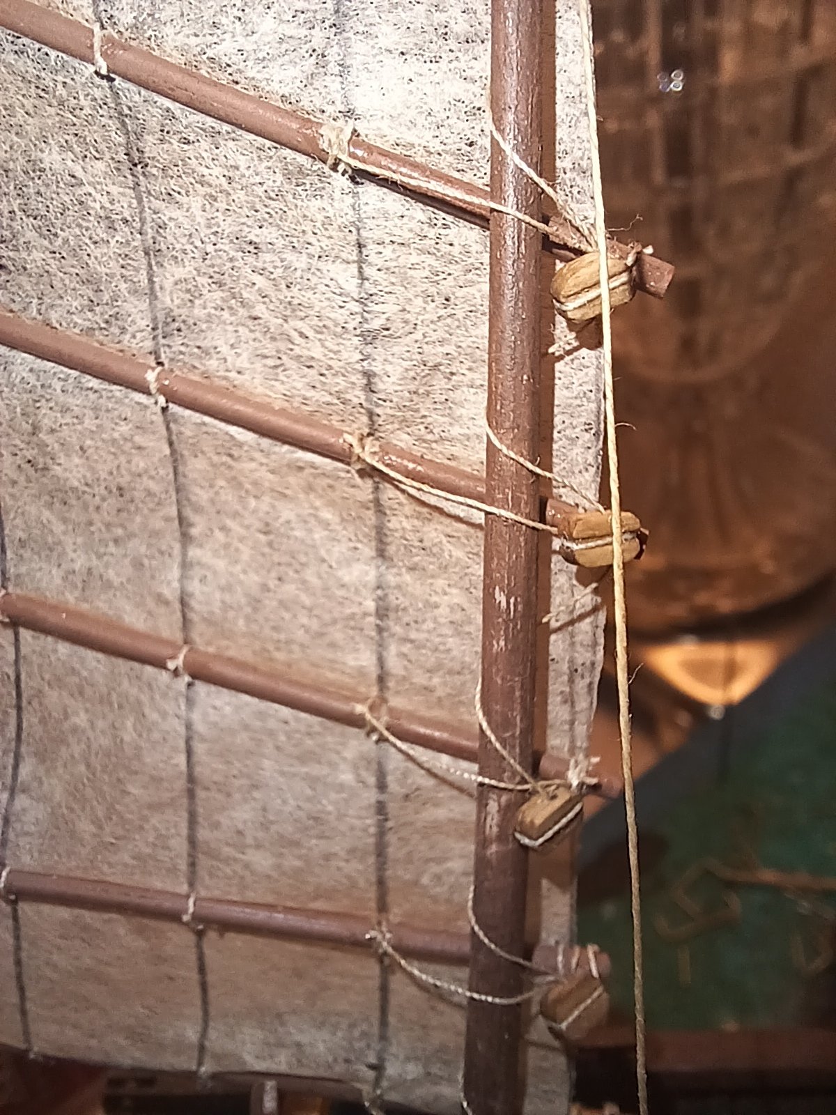

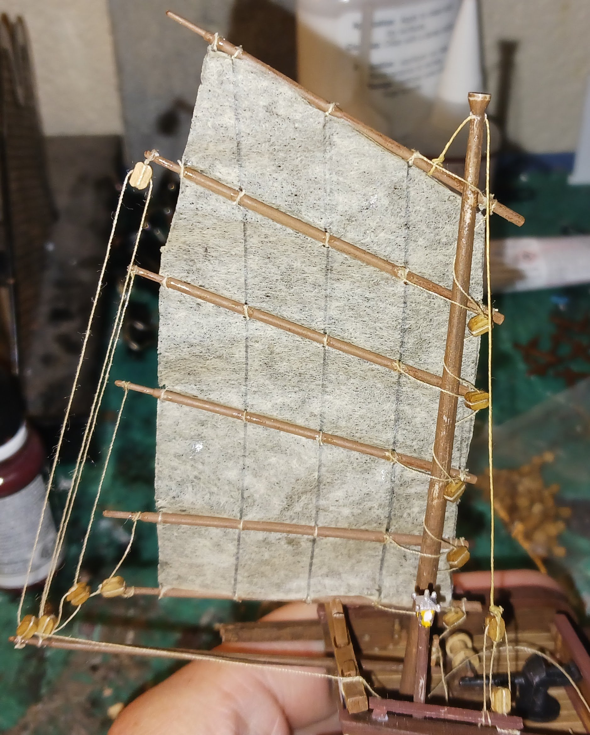

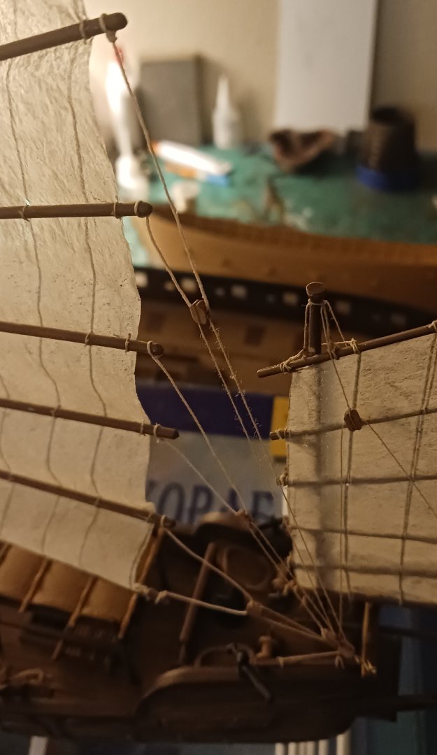

For the rigging of the sail, I followed the diagrams as closely as possible using the aforementioned sewing thread, which I stained a darker shade of tan using a wood tone paint. I had to modify some of the blocks to fit the design of the rig, but none of that was a big deal. The rigging was very simple, here is the finished sail:
image.thumb.jpeg.6101f76a6351a5adc796cd9c5dbc3937.jpegimage.thumb.jpeg.f839dc3837fdfb8625c5d5b9c9afc6ef.jpegimage.thumb.jpeg.2d3636119ed56abbd168a9b79ff03c05.jpegimage.thumb.jpeg.f6dabe945b6b125b1f059f5a421a2950.jpeg
While the hairy thread isn't that apparent in real life, if you want to remove it, just run the thread through beeswax a few times. This should at least help.

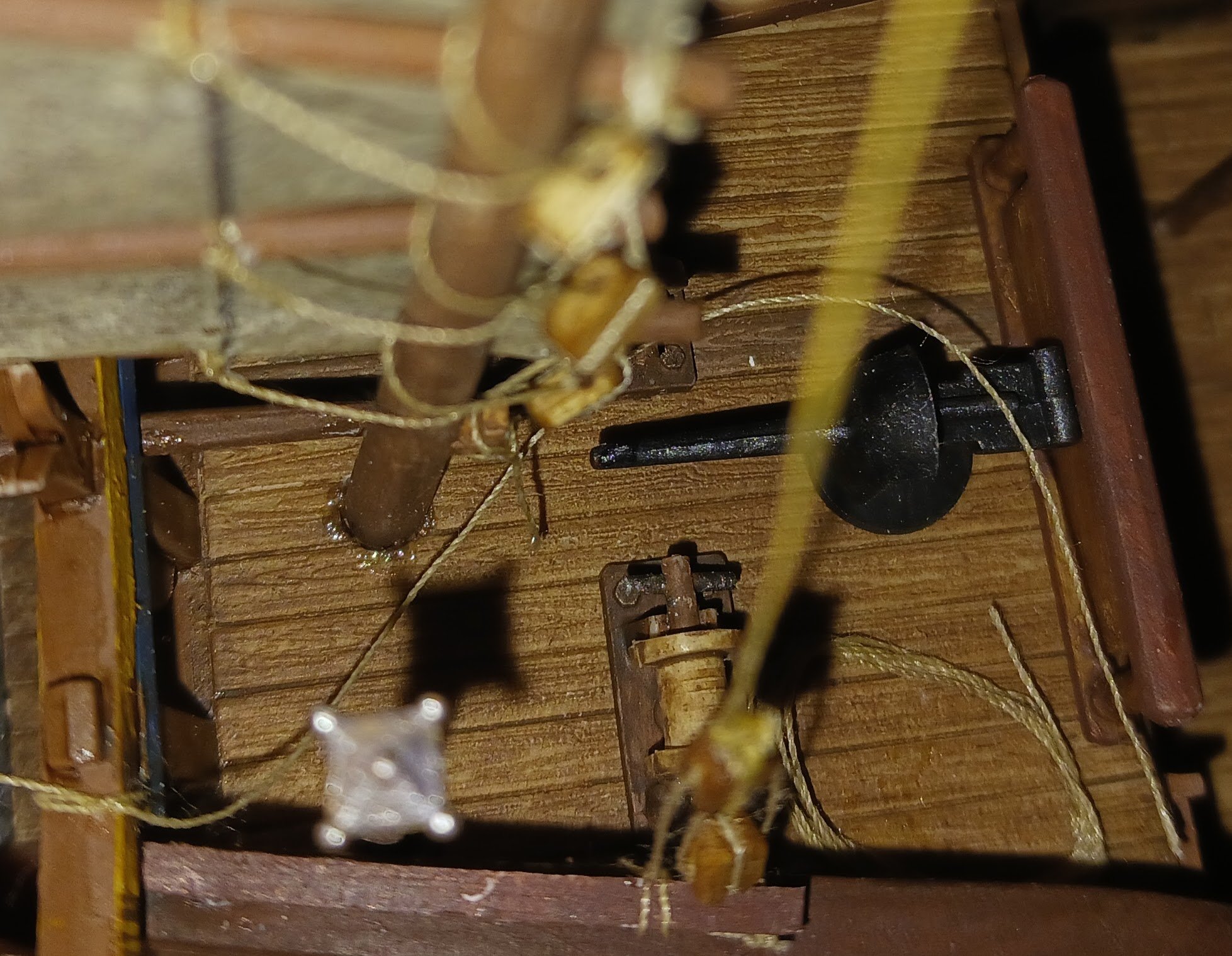

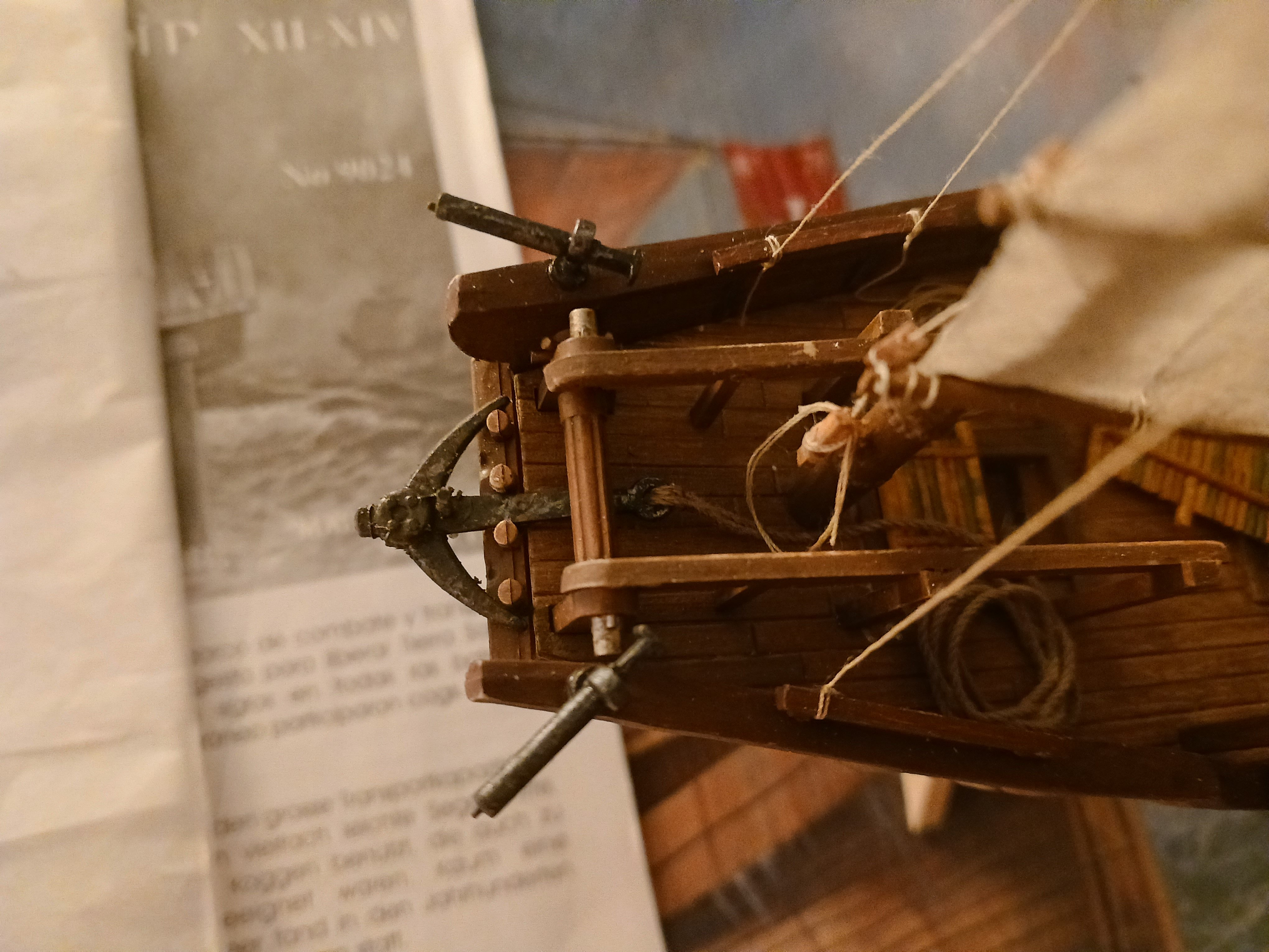

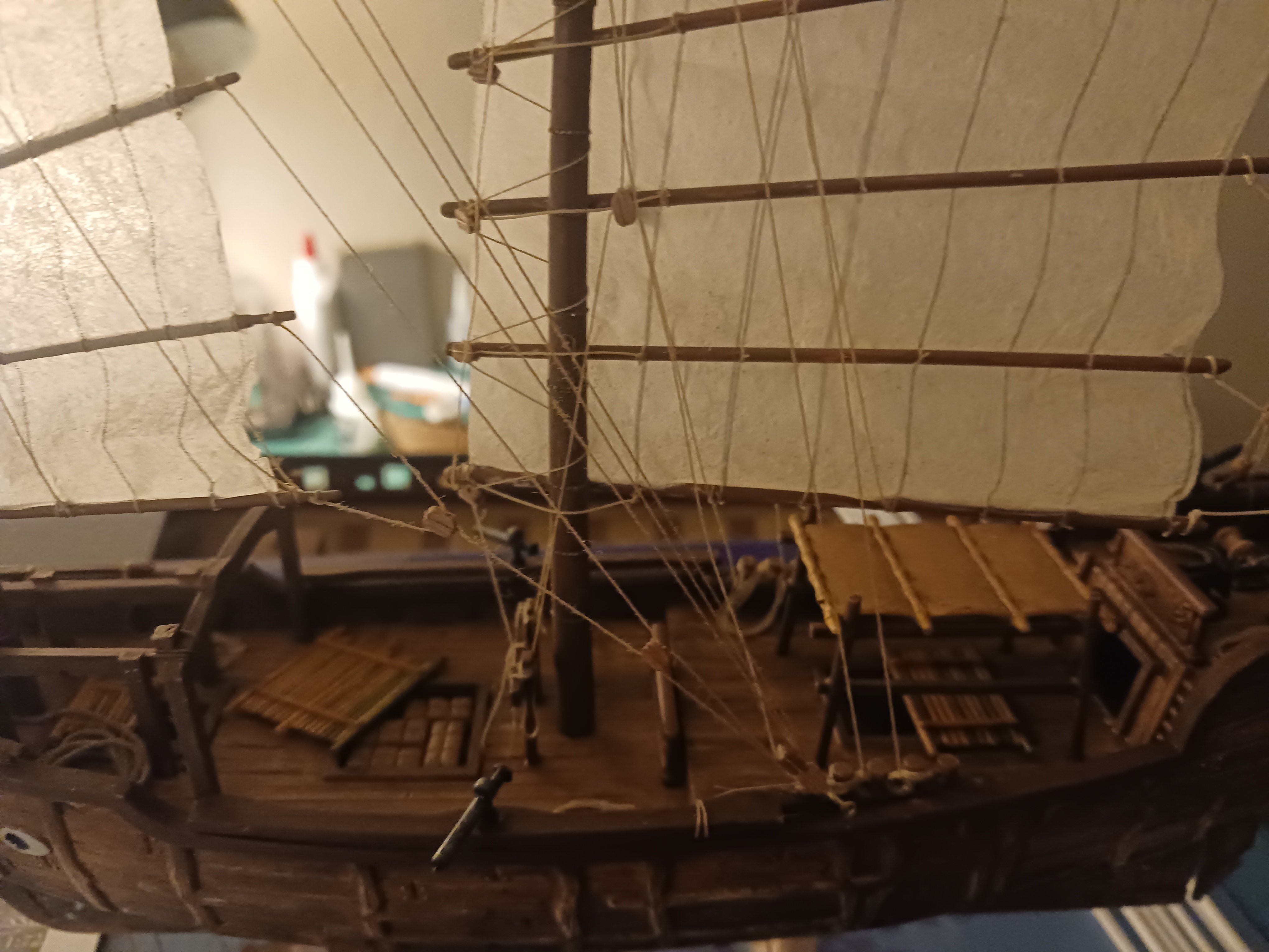

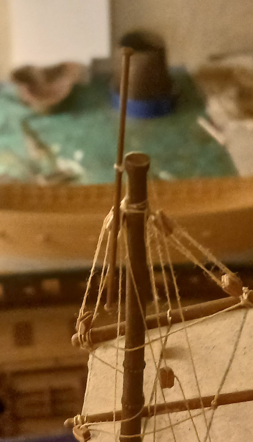

Quite a few things have happened with the Junk since the last post. Since then, I have fully armed the ship, finished the rigging, made the anchor, and made the stand.

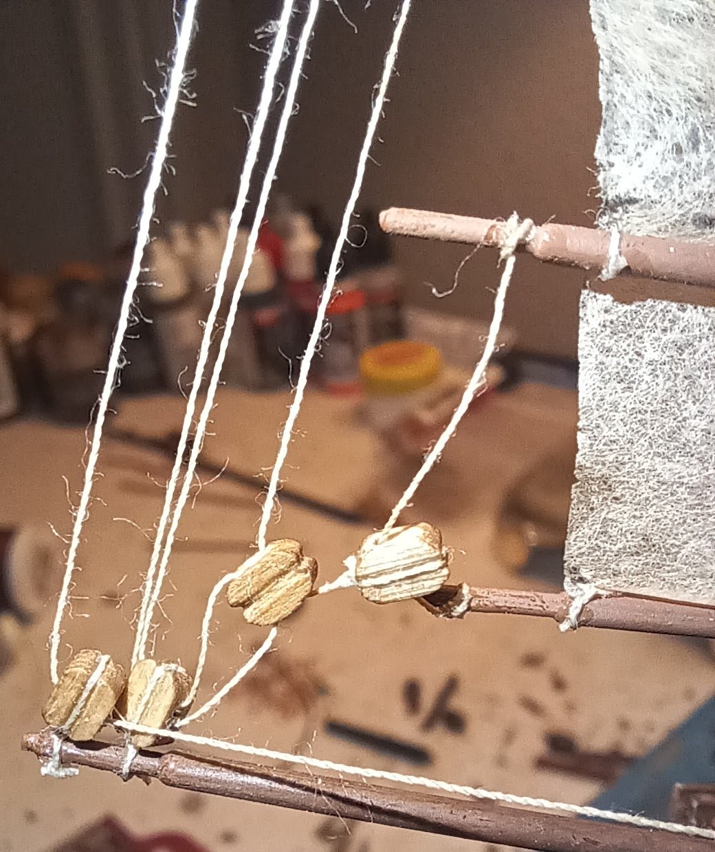

The rest of the rigging was pretty simple. I simply copied what I did on the mizzen mast, with small changes made to the main.
image.thumb.jpeg.f895b33cd9ae19eaf2d35a9b119fb5cd.jpegimage.thumb.jpeg.c54868de9602a4f9222b1a87eea9ee3c.jpegimage.thumb.jpeg.056a4d158dde4377d7b18681a351ac83.jpegimage.thumb.jpeg.0063762e195d940e9957a735f00ffb89.jpeg
Every line was stained with a brown shade. Three thicknesses of line were used in total for the entirety of the rigging. Rope coils are placed where necessary, and I tried to make them look realistic.

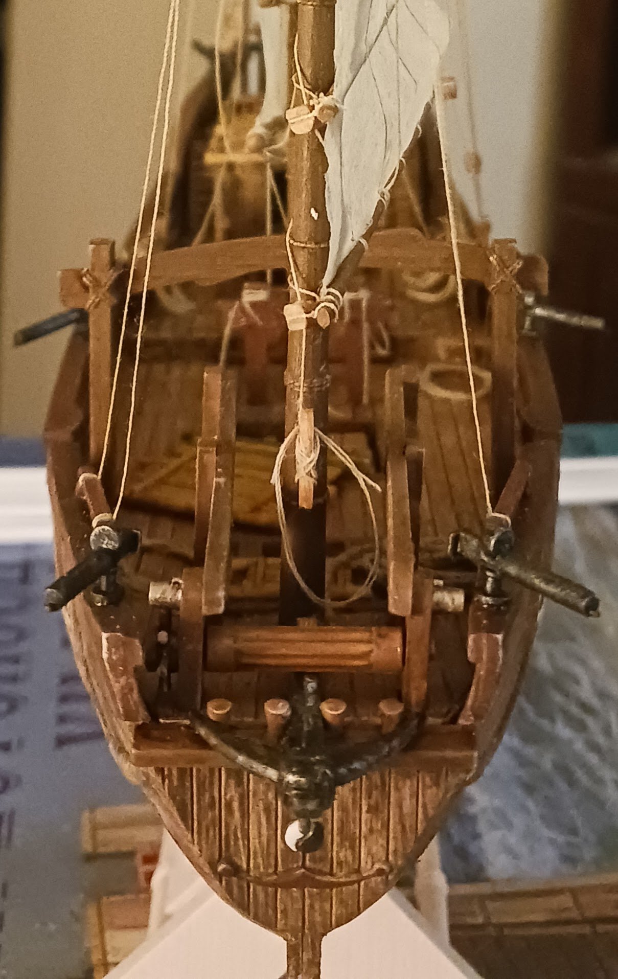

I slightly modified the anchor with a scratch-built "stock" which likely would have been part of the anchor itself. I chose this anchor setup based on photographs of junks from around this time period.
image.thumb.jpeg.ece0fa553c301feb36aa81ca5895871c.jpegimage.thumb.jpeg.fc755023484ec4123993d7e21d801841.jpeg
The ship also has a pig stick for the nonexistent flag:

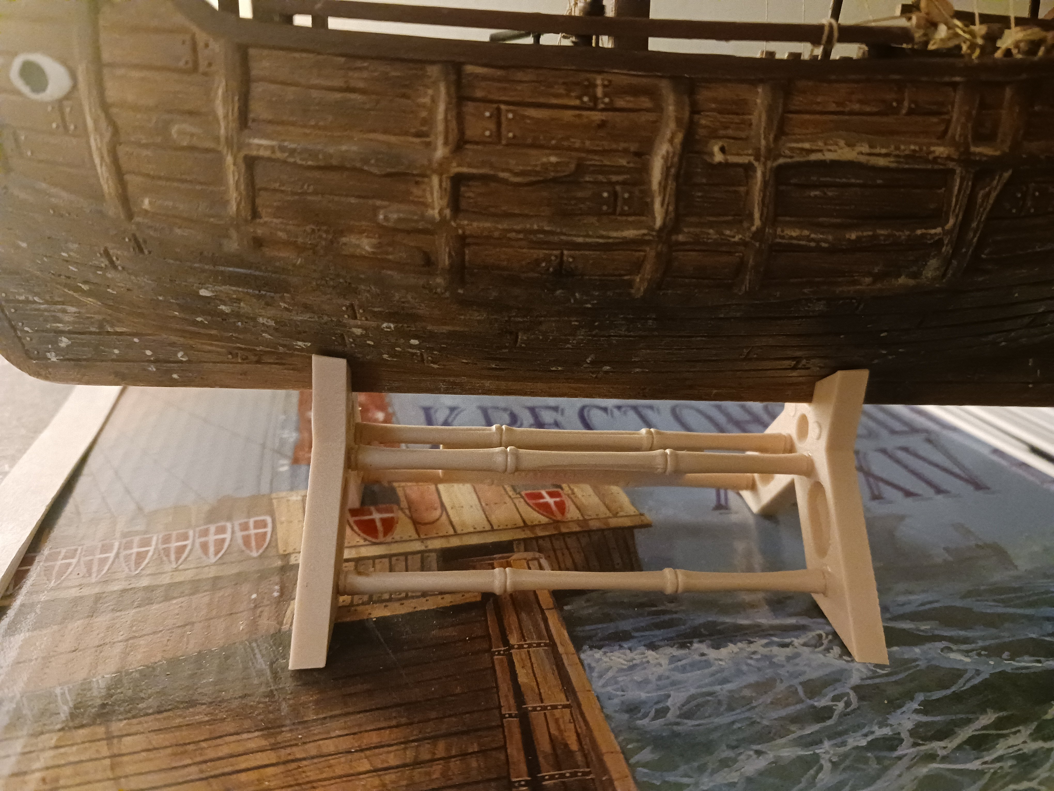

The ship's stand:

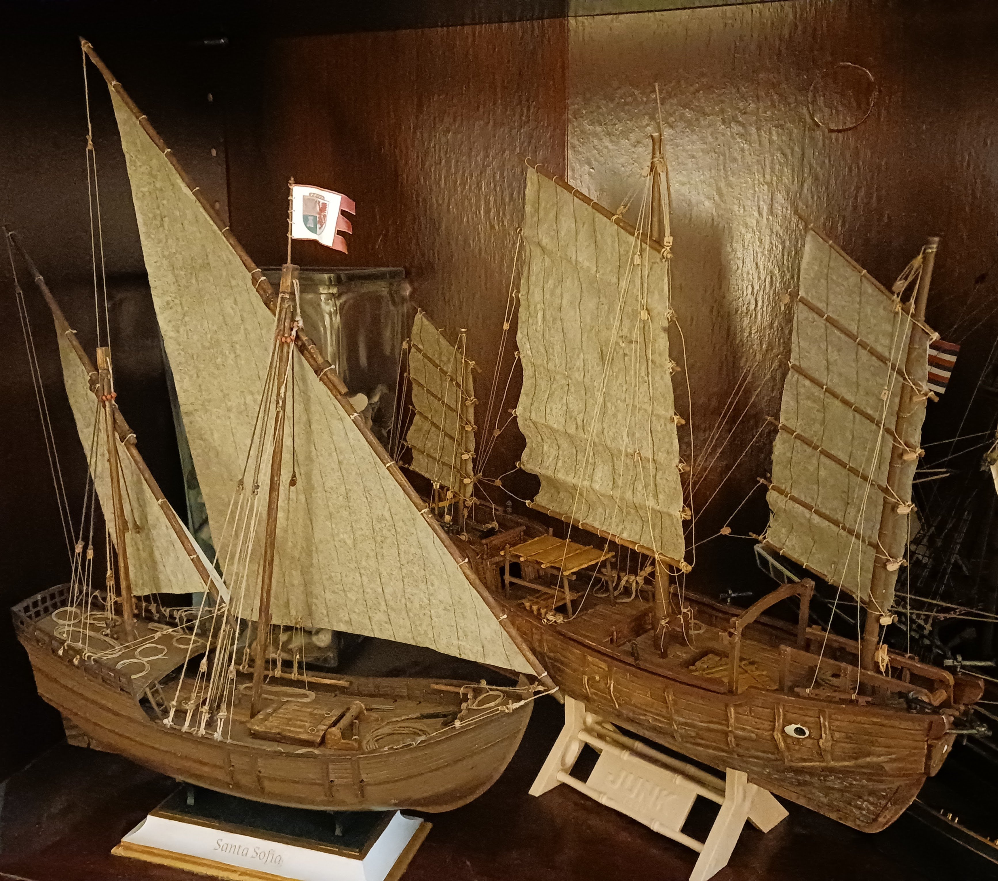

And finally, the Junk on display with the Santa Sofia:
