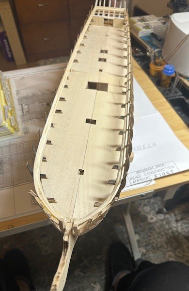

Another small update on my progress.  Working now on the waterways and planksheer.
The waterways and planksheer that I will be placing now will be on the spar deck, but it looks like I will also be doing some version of this on the gun deck once I get to that level.  The spar deck waterways will provide some “solidarity” to the bulwark extensions, though, when I get to the point coming up where I take out the existing spar deck framework in order to work on a detailed gun deck.
In beginning to work on the spar deck waterways, I followed the instructions as shown on Sheet 2 of the kit plans, but I also relied on suggestions made by Bob Hunt in his Practicum, as well as looking back at how a couple of my fellow shipbuilders handled this step, especially Tom @usedtosail and Jon @JSGerson.
For the waterways, I used the kit-supplied 5/16” x 5/32” strips.  Lengths were measured and cut from the stern to Bulkhead E.  The plans show various degrees of beveling that is required on the outer side of the waterways so that it fits snuggly against each of the bulkhead extensions, depending on which bulkhead the waterway is hitting.  The inner side of the waterway has a 45o cut measured 3/32” on each side.  I used a compass to measure and mark that distance, then used the Proxxon disc sander to get the 45o bevel correctly.  I simply used a palm sander to make the necessary bevels for the outer measurements.

Then secured and glued the long waterway strips on both port and starboard sides from the stern to Bulkhead E.  I used some temporary small square-dowel pieces on the outside of the bulkhead extensions in order to squeeze the waterway strips firmly against the bulkhead extensions without the risk of breaking those extensions.

Once the waterways were in place, the planksheers set on top of the waterways against the bulkhead extensions.  These came from the kit-supplied 3/32” squared strips.  One strip was placed from the stern to Bulkhead G, and another strip was joined at Bulkhead G moving forward.  To make the curve around the inside of the bow, I simply held the two sides’ strips under really hot running water for several minutes, which got them soft and pliable enough to make the bend.  I clipped them against the bulkheads to allow them to dry and hold their curves before securing and gluing them in place.
Here is a final picture with all of the waterways and planksheers in place.  Hope I’ve done everything correctly!  This will all be done again on the gun deck!

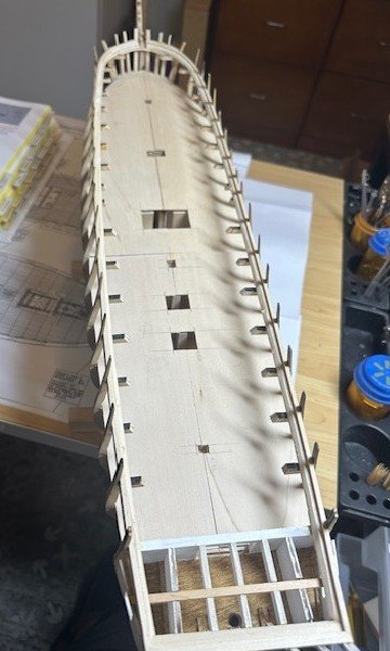

Well... I guess that "closer and closer" timeframe was closer than I realized!  I cut out the spar deck beams today.  Now the real work begins! Yikes!

Well, it looks like you jumped into the deep end of pool!!! Enjoy!!
Jon
53 minutes ago, Der Alte Rentner said:
Shall I throw you a life preserver?   😁
Ha! Not yet, Peter!  If necessary, though, I was always good at the back stroke... and dog paddling.  Horrible at the breaststroke, though!  Right now, I'm more concerned about snagging and snapping one of these bulwark extensions.  Having the spar deck waterways attached has helped secure them, though.  Working on fitting the gun deck's false decking now.  Keep that life preserver close by, though! Thanks for looking out, Peter! 👍🏊‍♂️
Gregg

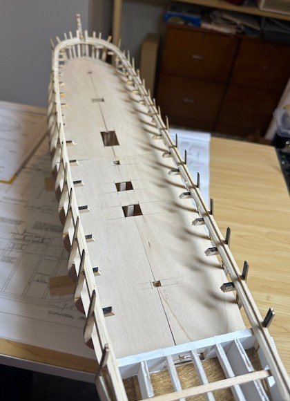

A little report on what I’ve been working on… and what I’ve been thinking about.

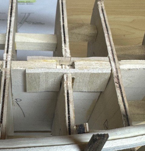

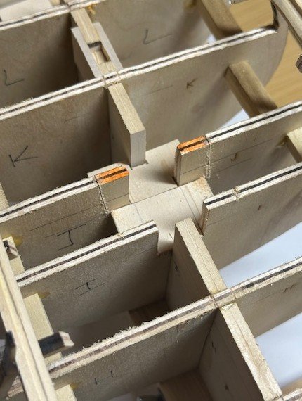

Before I firmly secure the false gun deck, I need to provide some additional support or reinforcement for the masts, as others have done at this stage.  For the mizzen mast and main mast reinforcements, it was simply a matter of placing some small 1/8” thick stock on either side of the bulkhead former.  Since the foremast location is right at where a bulkhead crosses, that reinforcement piece had to be notched in order to fit.  Took a few sanding efforts for it to slide in securely on either side.
251107a-FalseGunDeck.jpg.824b2df80247315f9214fb0fb19b0bc3.jpg     251107b-FalseGunDeck.jpg.89d27e3c100c8153b3be7b7e0d127add.jpg
Next task was to make the false gun deck using the gun deck template.  As I mentioned in my earlier post, I made these panels in four pieces in order to fit down on the gun deck level and get past what’s left of the spar deck support beams that were trimmed.
251107d-FalseGunDeck.jpg.2954433b88467f1050091ec24a035c05.jpg     251107e-FalseGunDeck.jpg.42a38d1d604f7f015e8b98a9578237ae.jpg
As you can see from the pictures above, I made the cuts in the false gun deck at the mast locations, as well as where the faux stairs going down to the berth deck will be located.  As I am writing up this build log after-the-fact, I do not recall which plans I was using to mark the necessary openings, but you will notice that the center stairs hatch opening is the same width (port to starboard) as the fore and aft hatches.  More on that in a bit.

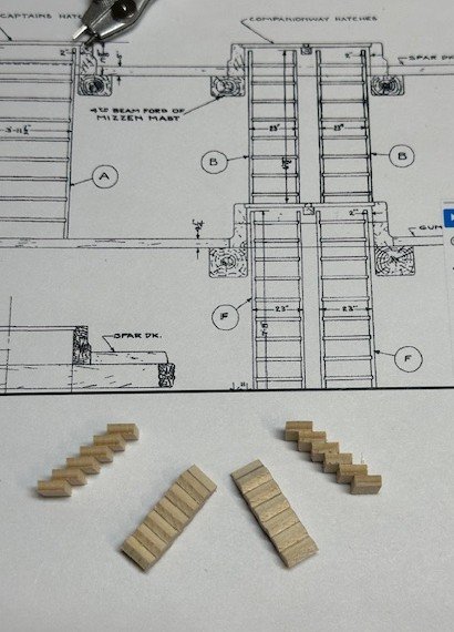

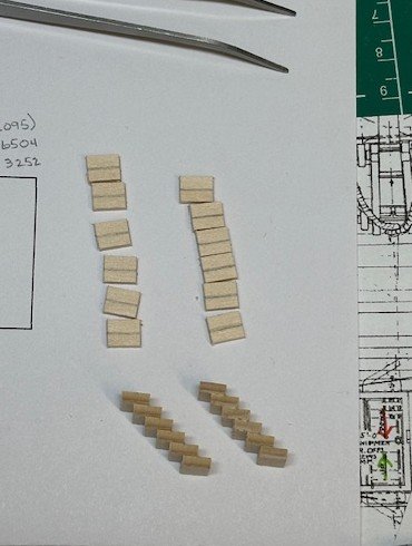

To replicate the stairs going from the gun deck to the berth deck, I used a simple technique that Mustafa used for these stairs.  Since they will not be able to be seen in intricate detail but just need to give a simple impression of stairs going to a lower level, I thought this was a great solution.  According to the USN plans, these stairs are 23” wide, which converts to 0.33” scale.
251107g-FalseGunDeck.jpg.189ec0649936a450993da00bc6779aff.jpg       251107h-FalseGunDeck.jpg.3dc460275c5ee5154d7aacf50592c208.jpg
After creating the stairs, I began work on the gun deck hatches that these stairs will be attached to.  These hatches were 1/8” tall, which converts to a “real” height of 9.6”.  However, after I made one complete hatch, I reviewed plans and pictures again, and I am going to redo the hatches using 1/4” high edges, which I think will look better.  They will have a step-up on the outside of the hatch stairs, as well, which is how the current hatches appear.
251107i-FalseGunDeck.jpg.693ee27e03787973bf3b76f87e7a2f6c.jpg         251107j-FalseGunDeck.jpg.05fc7102e5f36ca93c3192047dd80d86.jpg

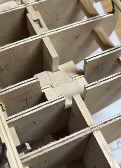

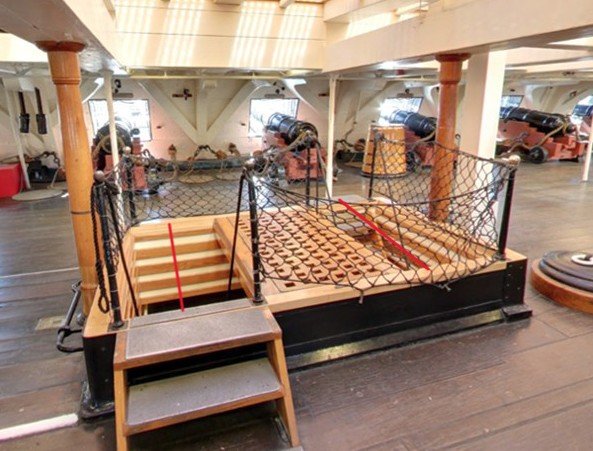

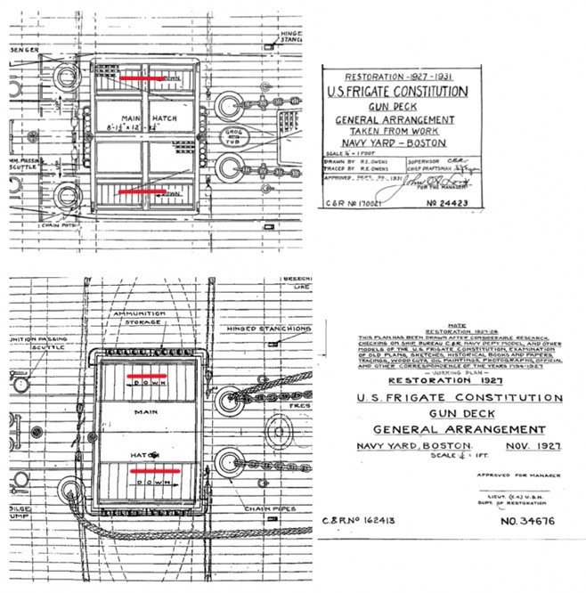

So, back to the center stairs issue.  As I have stated already several times in this build log, my intent is to replicate, as close as I can, the 1812-ish Commander Hull version of the Constitution.  As Jon Gerson so aptly described back in his Post #197 in March 2018, the gun deck’s center hatch configuration has changed multiple times, including the 1927 and 1931 restorations and its current appearance.
What I noted as differences between the above plans and how the Constitution currently looks is the direction of the ladders going from the gun deck to the berth deck.  While the current configuration has the ladders positioned “east-west” or port to starboard, the older plans show these ladders positioned “north-south” or bow to stern.  Interesting!
And I also learned that the Bluejacket plans, which are focused on the War of 1812 era configuration, have these ladders in the “north-south” position, as well.  So, that’s what I am going to do.
To do this, that center area needs to be widened to accommodate the stair repositioning.  So, the cuts I had initially made in Bulkhead J need to be made bigger.  One of my Zona saws made quick work of that and the Dremel cleaned up the bottom.
251107k-FalseGunDeck.jpg.ec53a419c9cfc6f7ace8f43919796243.jpg       251107l-FalseGunDeck.jpg.c97870f7bc2943f415f4f5eef67bb0e3.jpg
I then re-cut the two forward false gun deck panels with the larger center hatch area.  Everything seemed to fit well and looked good.
251107m-FalseGunDeck.jpg.7d263a6e54ebbf13eaaa7766a8b183cd.jpg         251107n-FalseGunDeck.jpg.87e74b9b91c1504c7f13f679719b7fd2.jpg

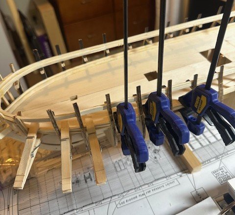

After making the changes in the main hatch position, I was now ready to secure the false gun deck to the bulkheads before beginning the additional work on the gun deck itself.  A fairly easy and straight-forward process of gluing each of the four individual false deck pieces in place and, using some spare square dowels and longer rubber bands to hold the false deck in place while the glue dried, the false deck was secured.
The pair of aft hatches that are located on either side of the capstan were the simplest to build, as there was no grating involved.  Simply two sets of stairways with the ladders facing athwartship (I learned a new nautical term!).  With all of these hatchways, I am using 3/32” x 1/4” basswood stock for the frames.  In a previous post, I described how I built the lower ladders that go from the gun deck down to the berth deck.  Since these will be difficult to see details, these stairs are simply small blocks glued together in a stairstep fashion.

In my last build log post, I mentioned how I was switching, or pivoting, the position of the main hatch so that the ladders were in a forward/aft direction rather than side/side direction (or athwartship, as I learned a new nautical term!).  As others have previously indicated, there are several plan interpretations of how the main hatch looked.  One configuration that I recall Jon mentioning is the US Navy’s 1927 restoration work Plan #24423.
But… is that the way the main hatch looked back in its 1812-1815 days?  The plans from Bluejacket Shipcrafters are presented based on Larry Arnot’s research during this 1812-1815 period.  What the heck, let’s use that configuration.  They look pretty close to one another.

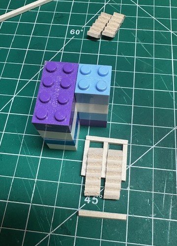

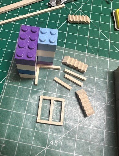

I had also mentioned in my last build log post that I was going to use Mustafa’s process in creating the criss-cross hatch grating work.  After that comment, I found some flat pearwood grating strips on Dry-Dock Model’s website.  They were advertised as being 1:72 scale, so they are close in scale to our 1:76.8 scale.  Their grating slat spaces are only 1mm in size, which is closer than what I was planning on doing on the mill at 1.4mm.  A 1mm opening converts at our 1:76.8 scale to just a smidge above 3 inches, which is probably a more accurate hatch grating size, anyways.  So, I went with these grating strips.
Using the aforementioned Bluejacket plans, I wrote up a sizing plan for my Constitution’s gun deck main hatch, which helped me keep things organized while cutting each of the grating pieces to their accurate size, along with the stairs in each corner.
And, of course, I have to include a couple of my magnetic box and Lego building pictures…
251201l-HatchMagnetLegos1.jpg.9bcd3923ce54e0c7641564365b704ab0.jpg   251201m-HatchMagnetLegos2.jpg.e51c7b2b1a3a33c007063514aea35974.jpg

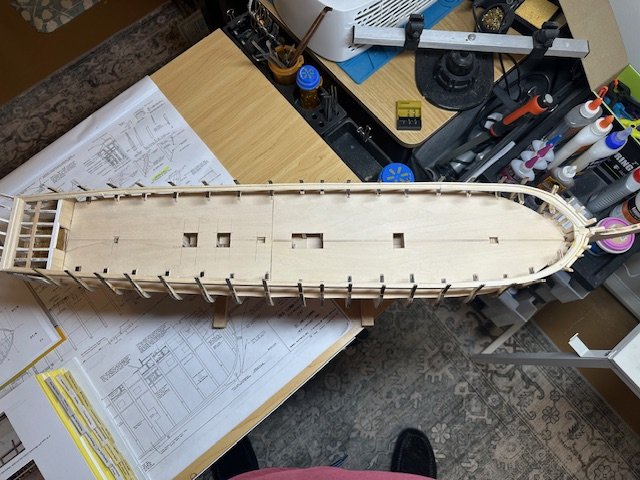

Although none of these hatches have been firmly secured yet to the false gun deck, I placed them all in position to see how they were going to look.  First, a quick peek at how the ladders look under the false gun deck (noted with the drawn red line)…
And a shot of the full false gun deck with each hatch in place…
A close-up of the forward gun deck hatch…
A close-up of the main mid-ship gun deck hatch…
And, finally, a close-up of the aft gun deck hatch, where the capstan will be placed in between…
I am happy with how the hatches (and gratings) came out on this gun deck.  I’ll decide in due time whether to use these same Dry-Dock gratings on the spar deck or attempt to make my own.  What I need to work on now, though, are the gun deck waterways.

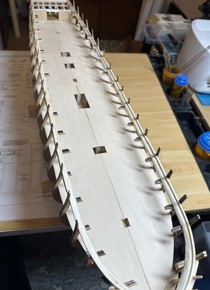

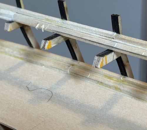

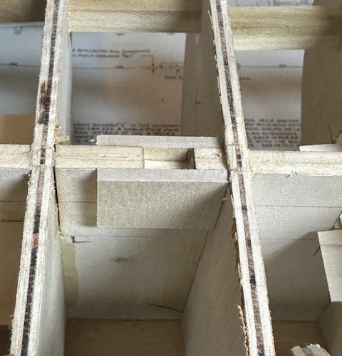

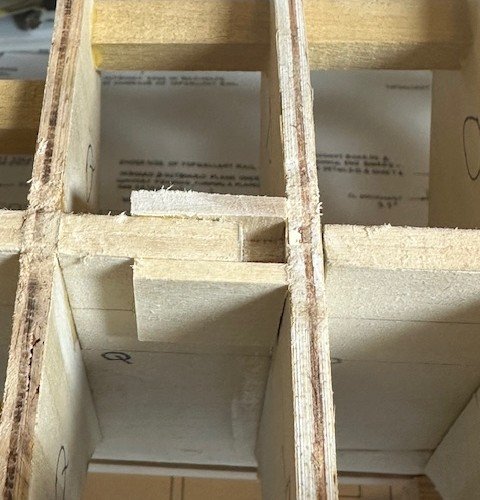

Completed a few other things, so another quick update.  The gun deck waterways and planksheers placement didn’t take too long to complete.  It was pretty much and “rinse & repeat” process from what I had done previously for the spar deck waterways and planksheer.  For the gun deck waterways, I did not have any 5/16” x 5/32” strips handy, so that gave me an opportunity to cut a few strips on my Byrnes saw from a 5/32” sheet.  I then used the same process I did on the spar deck waterways, trimming a 45-degree bevel into one side 3/32” deep using my disk sander.  Longer strips were placed from the stern bulkheads up to Bulkhead F.  A curved waterway piece was then measured and cut for the sharper bend from Bulkhead F up to the bow.
The planksheer joint was made at Bulkhead G and, again as I did with the spar deck pieces, I was able to bend the forward planksheer strips by simply holding them under running hot water for a minute or so.  All in all, no issues, especially since I had done the same process earlier for the spar deck.
251207a-GDWaterways.jpg.eb41bc93cf4b3f2b0c4dd8c2075a0928.jpg    251207b-Waterways.jpg.23da5cd6fafabc98205d81977cbb8929.jpg
The closeup pictures of the waterways and planksheers also reminded me that I need to give everything a nice bit of sanding, too, before painting them!
I’ve been wavering a bit on what to do next… either the gun port framing on the gun deck or the planking on the gun deck.  I believe the gun port framing will be next, though.  I also need to do some more work back in the Commodore’s Cabin area, which will affect the planking, as well, so… onward to lots of gun port framing!

3 hours ago, mtbediz said:
Hi Greg. Are you planning to fully plank the spar deck, or will you leave it partially planked like Jon and I did, so that the gun deck remains visible? If the spar deck beams are going to stay exposed, let me remind you that if you intend to reattach the beams you cut back into their original positions, some of them will not align correctly with the hatchways on the spar deck.
I recommend that you plan your approach in advance, because the spar deck beams must also be aligned with the hatchways and other details on the gun deck.
Hi Mustafa!  Thank you so much for peeking in with your advice and recommendations.  I cannot adequately express how much veteran advice from gentlemen like you mean to me in this build process.  We are so lucky to have you guys around.
With that said, yes, my plan is to expose the gun deck similarly to what you and Jon have so successfully done.  You had given me the reminder about the spar deck beam replacement concern back in October on Post #73, and I have not forgotten that reminder!  When I cut those old beams, I cut them back to a point where, whether new beams are attached back directly to them or if they are just left as stumps because of new beam positioning, the old stump portions would be "hidden" under the spar deck edge decking that will be in place for the carronade guns and carriages.
I am wondering now if accurate placement of the gun deck knees (directly under the spar deck) will be affected by any of these stubs.  Perhaps those stubs affected will need to be cut back farther against the bulwarks.  Since yours was a complete scratch build, of course, you didn't have the old beam stubs to be concerned about.  I will, though, look back and see again how Jon handled all of this in his kit-bashing.  In your reminder post on Post #73, you provided a build log location on Jon's log where he raised his concerns.  Time to go back and study this all in greater detail and, as you stated above, Mustafa, plan my approach in advance!  Once again, I appreciate ALL of you gentlemen that preceded us in these early steps!
Gregg
If you plan to add horizontal, vertical, and diagonal knees as I did, these stubs and even the spar deck waterways will seriously bother you and may even block your progress. I wish you had cut those stubs off completely at the start and avoided adding the spar deck waterways at this stage. Unfortunately, since there is quite a long gap between your updates, we see that you have already completed many steps, which leaves us without the chance to give timely advice.
Edited by mtbediz
I appreciate the feedback, Mustafa!  As I was preparing for this Constitution build and researching other completed and ongoing build logs, I was trying to determine the best approach to this kit bashing and the removal of the spar deck beams in order to expose the gun deck.  Obviously, in your scratch build, you were able to avoid the spar beam issues and you added the new spar beams in an orderly sequence, after the horizontal, vertical and diagonal knees were created and placed on the ship.
The two “bashed kits” that I reviewed that had removed their spar deck beams fairly early in the process and subsequently added at least some version of knees were from Tom (usedtosail) and Jon, and so I’ve been trying to follow their tails as best as I can through their spar beam removal processes.  As I said at the time, adding the spar deck waterways when I did added some strength and support to the bulwark extensions.
One difference I have noted, though, between what Jon did, as a for-instance, and what I did is that he cut off his spar deck beams right up against the waterways.  I had left mine sticking out a bit for now, subject to determining where the new beams would be located.  As a part of that new “plan my approach in advance” strategy I am employing, now is the time to make those spar deck beam location determinations, so that the knees locations can also be best planned.
And, to your point, Mustafa, regarding gaps in my updates, including too many steps in each update, and not allowing you veterans an opportunity to provide timely advice, I will do better in keeping future updates more concise.  Again, I appreciate your input and advice, fellas!  Thanks!
Gregg
