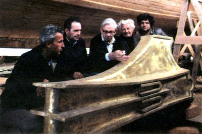

This is what I need to make, its at 1:24th scale for my model of this Trireme ("Olympias") which makes its total length about 50mm. It fits over the wooden ram structure and will be about 0.5mm thick. Quite a challenge to fabricate, with a lot of joints...
That is an interesting assembly! Looks like the main body could be one large piece wrapped around at the front, with top and bottom pieces added. Then you would just need to add the "fins" and "C" pieces on the sides.
If you are worried about the solder stain around joints you could just flow solder over all of the surfaces. Then everything would be "stained."
That would give the model an impressive golden ram. But it would use a lot more expensive solder.
Phil
Current build: USS Cape MSI-2
Silver solder on brass really needs tight joints to get a good joint.  By the time it's been filed or sanded down it's almost invisible anyway.  Jewellers use silver solder on gold and you cannot see the joint so I guess the secret is to take your time and have as little silver filler in the joint as possible

These seem to melt at 900 C, whereas silver solder paste is between 600 - 700 C. To my experience, to reach such high temp a larger heat source is needed risking melting the actual piece. I actually had this happen a couple of times.
a pen torch would be more than adaquate for such a small piece.
but it seems by the conversation here, color is more important than heat.
yes, silver solder would be fine, but some of the color matching sugestions are like killing mosquetos with a hammer. at the scale and size of the piece, the weld would appear insignificant. an eopxy fix would be more than sufficient but it's just too simple a solution.
