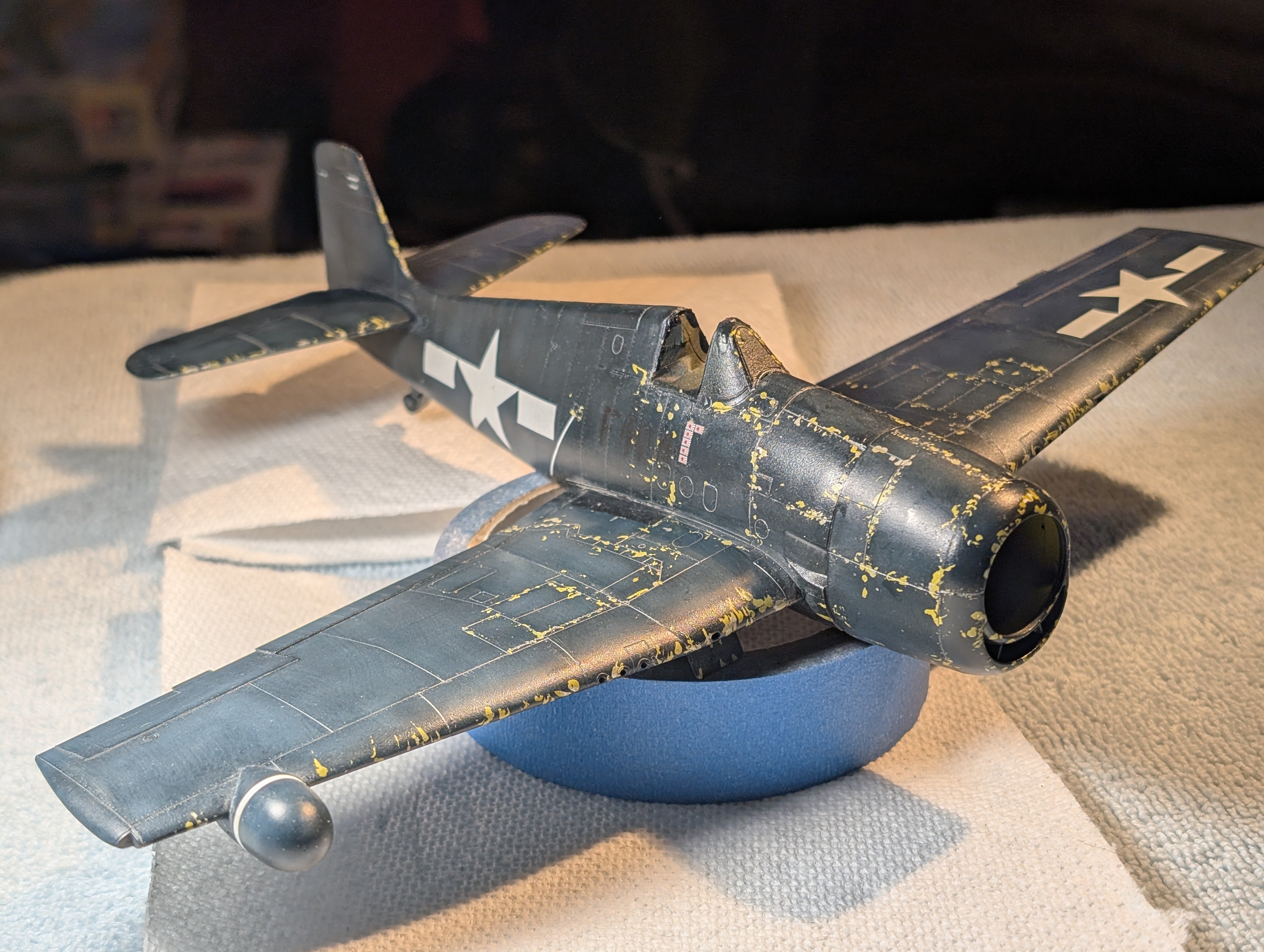

I started with an airplane model first, which is in the final stages of construction.  Eduard 1/48 F6F-5N Hellcat:
I then quickly realized that the majority of airplane modeling was spent during the finishing process. Fun, but I also really like the planning, design, and building portions of the process.  The ship models on the shelf moved from the sell pile to the keep....

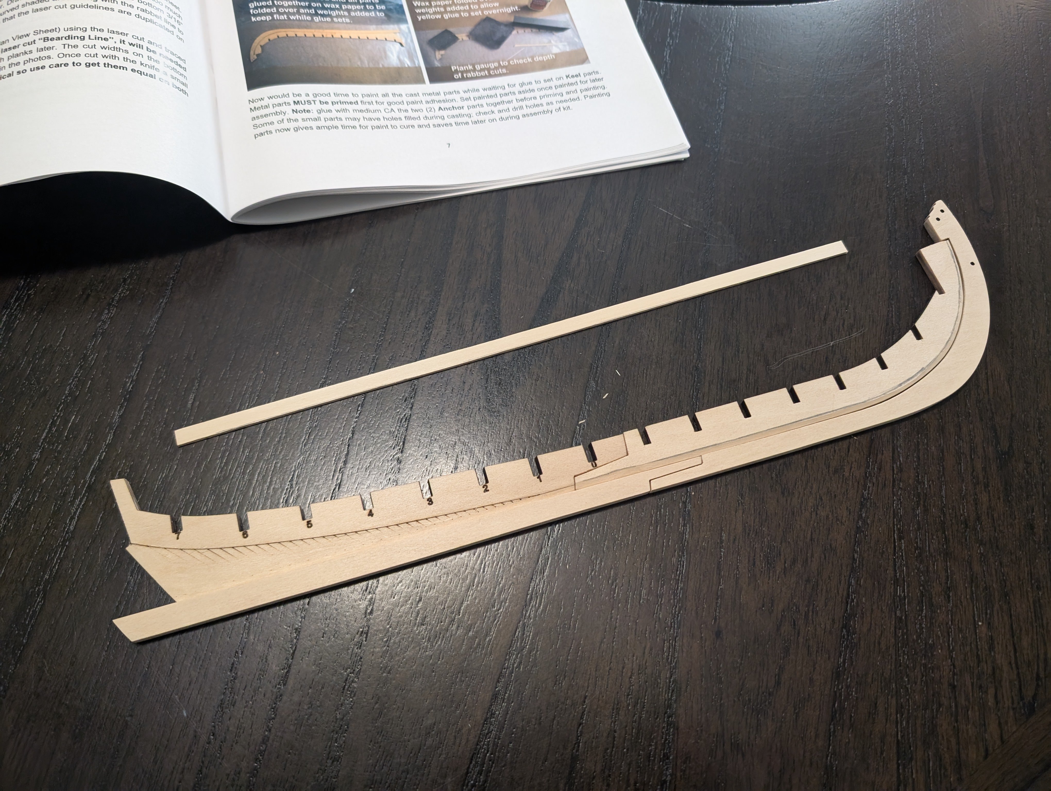

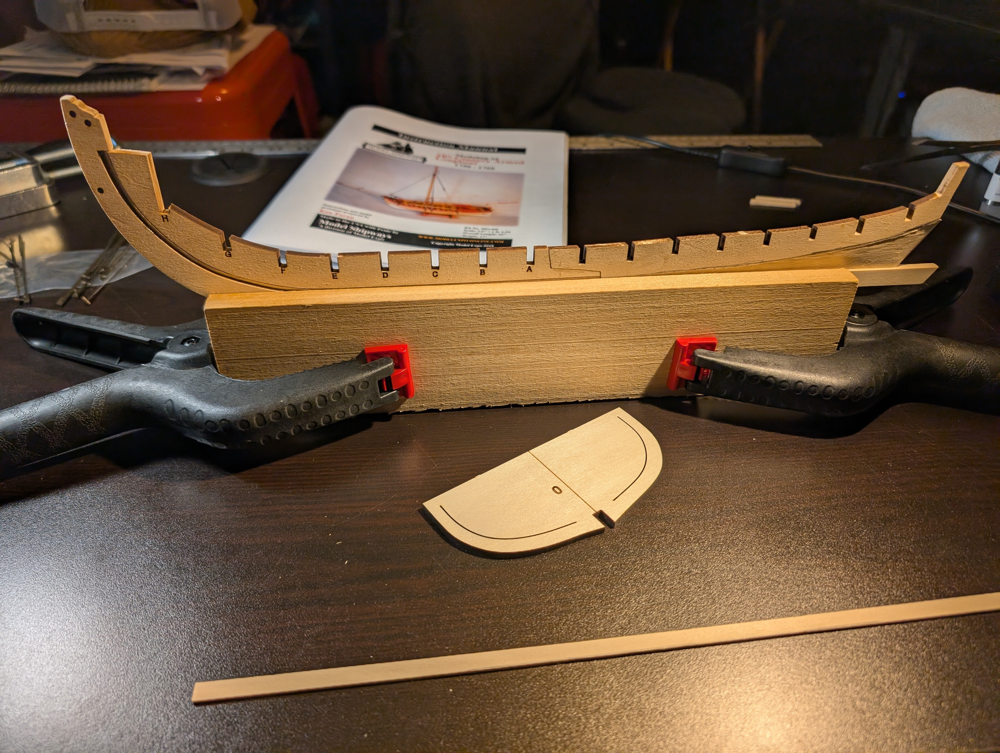

I received the kit last weekend, and when I returned from the lake, I opened the kit to get started right away.

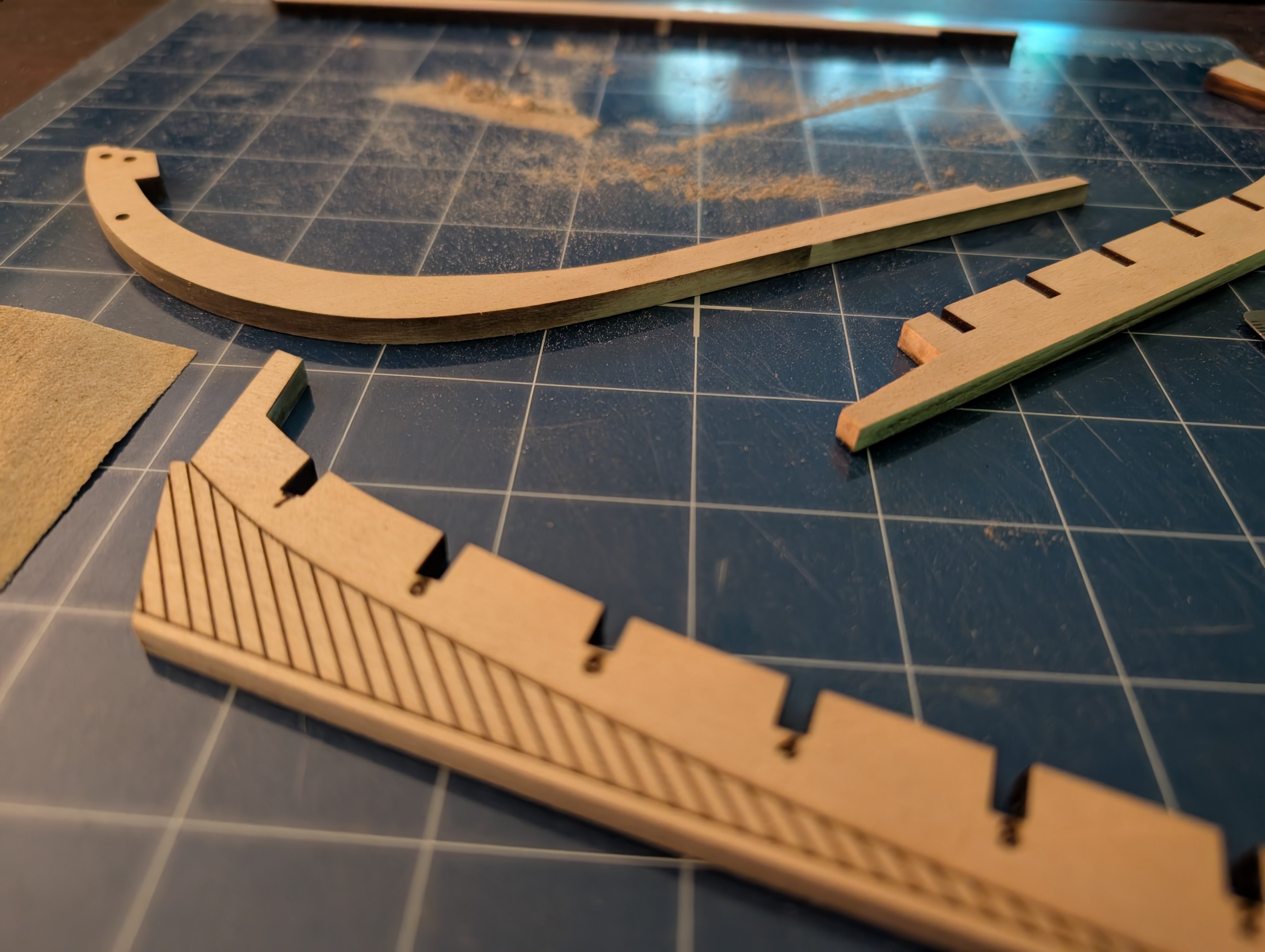

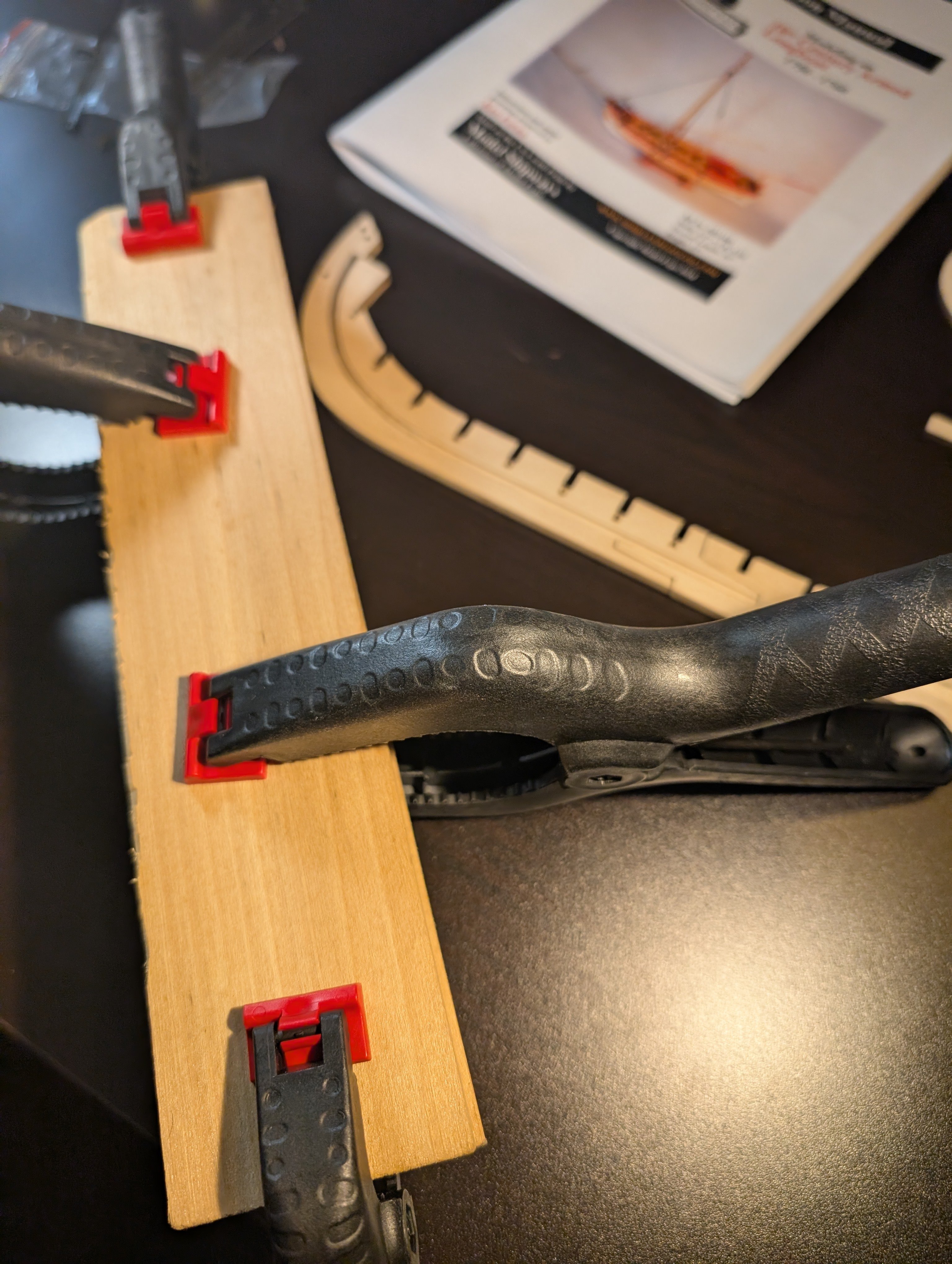

Monday night, I started by removing the false keel and keel parts, then cleaning those up.

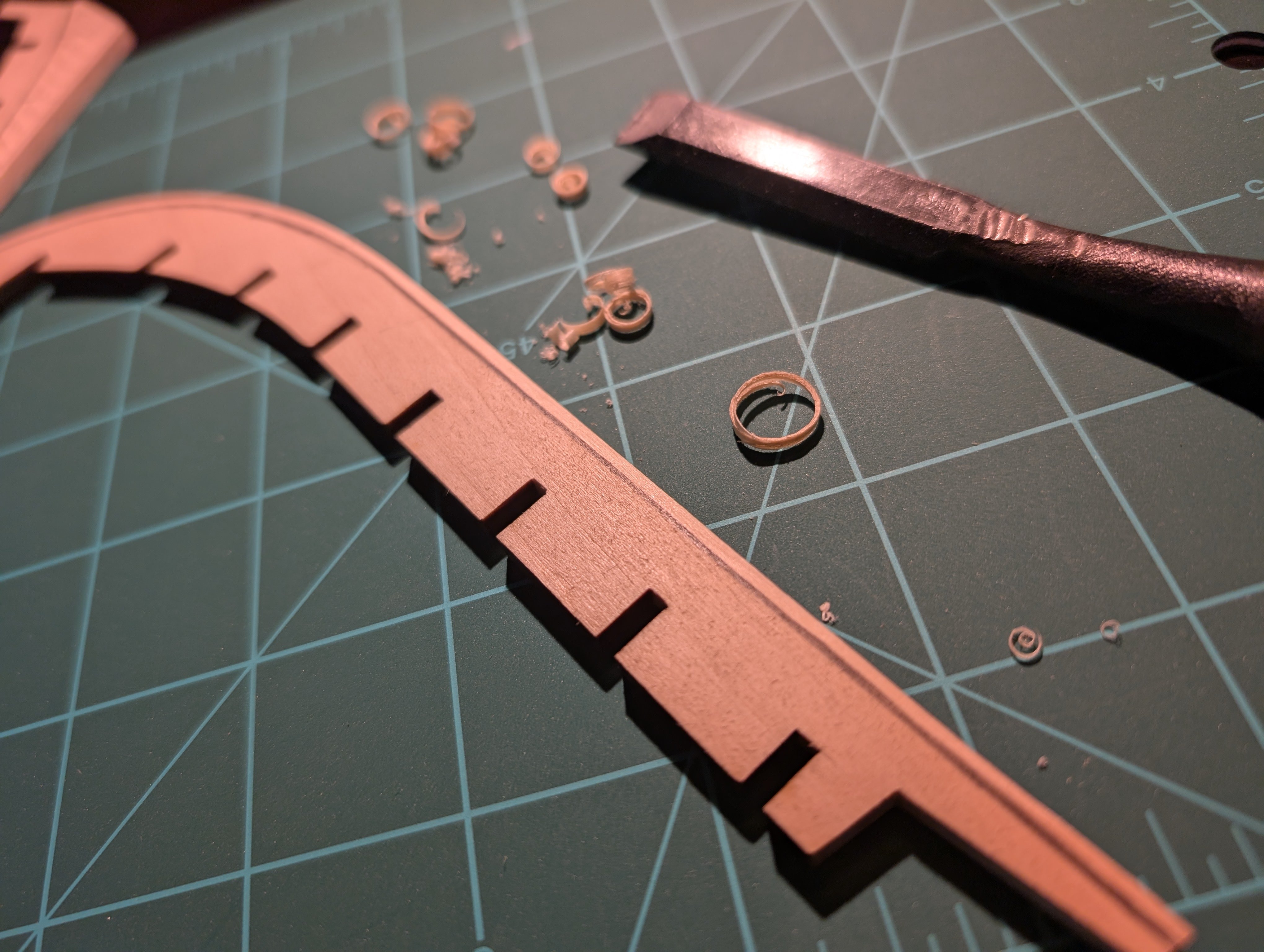

The last several days have been spent chiseling the rabbit, gluing the keel parts to the false keel, and using some water and heat to get the bend the pieces had out of the box in the bow area.

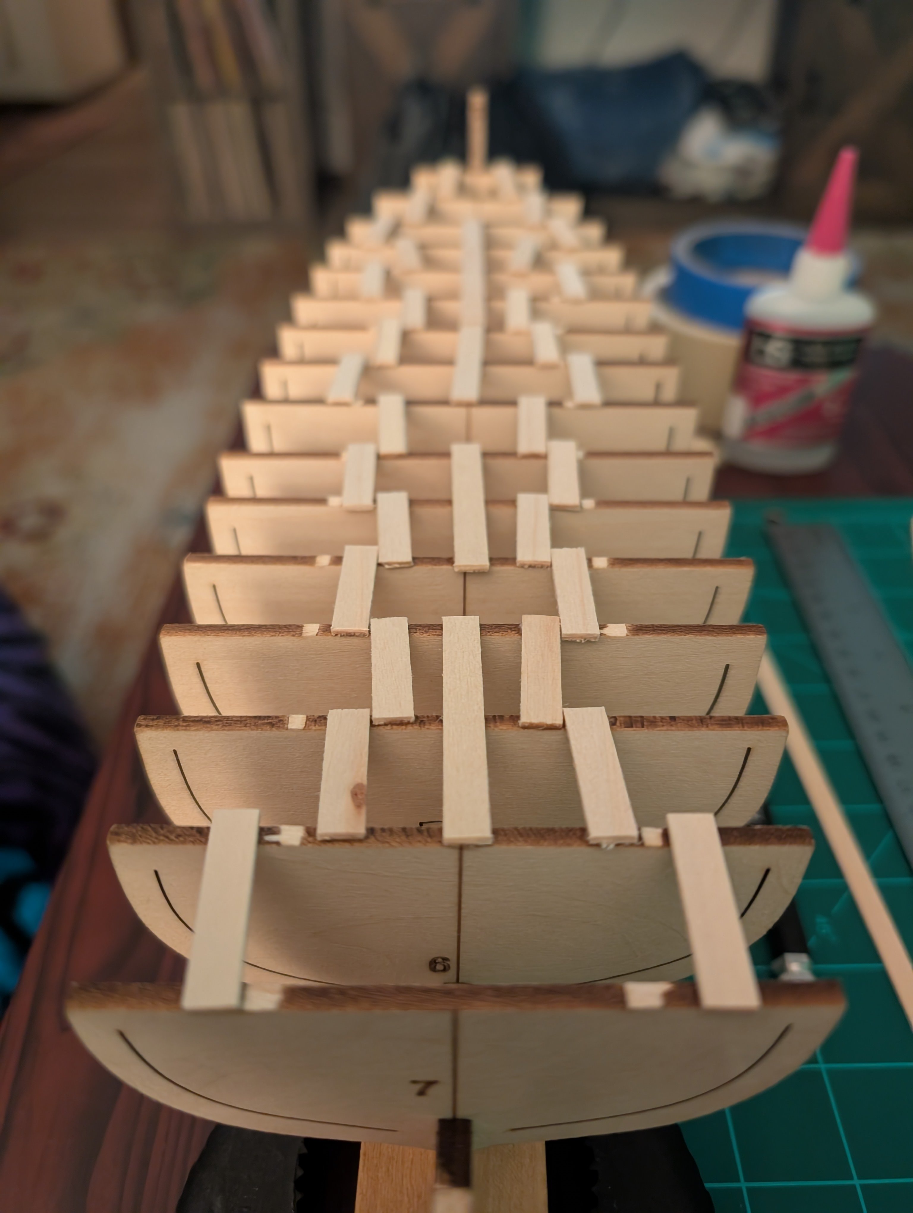

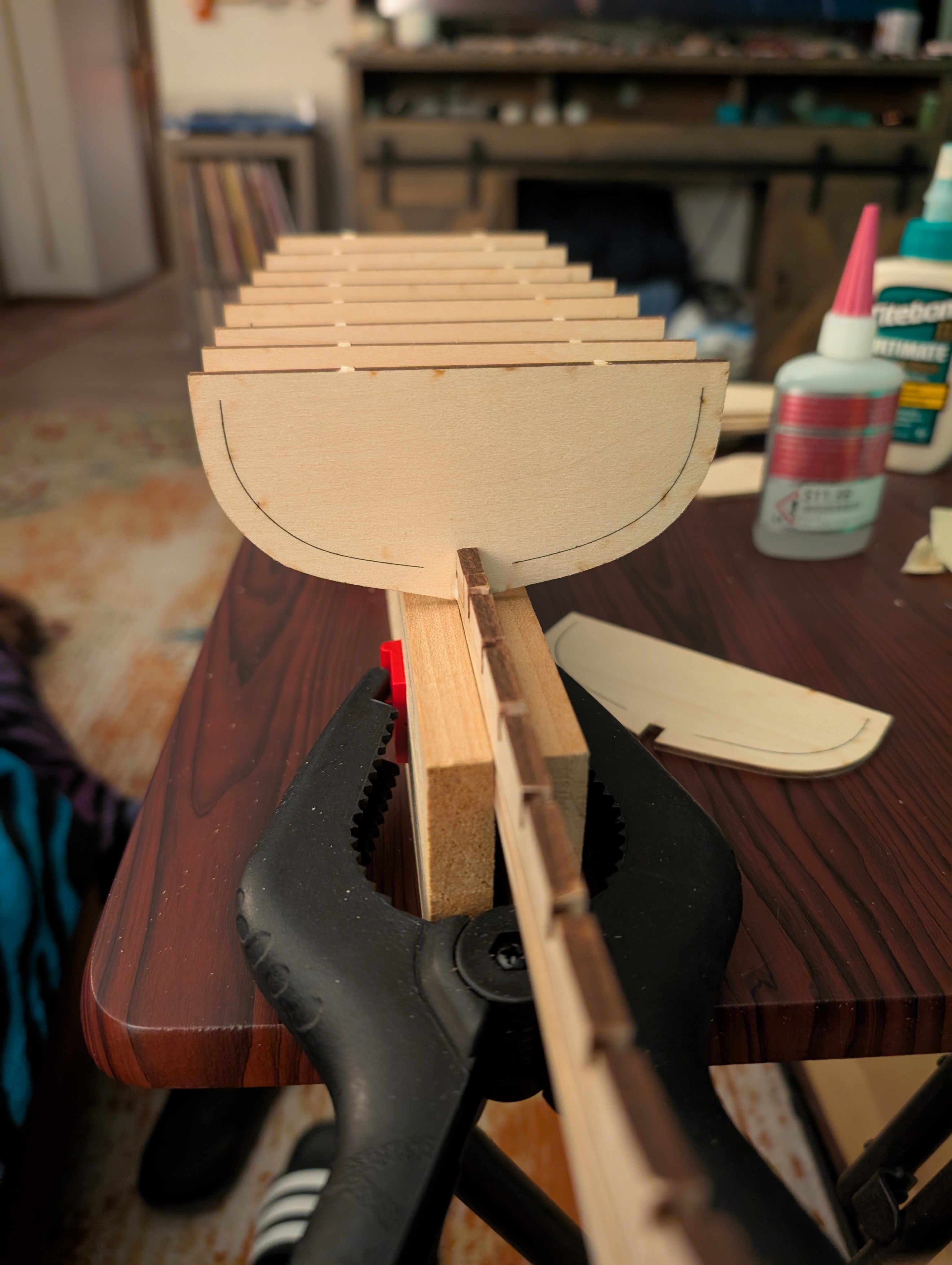

I ordered a bit more 1/16 x 1/4 planking for creating more temporary supports along the false bulkheads as I move down the keel to keep everything straight.  Overkill, probably, but I would rather limit any deviation from square during the planking process.

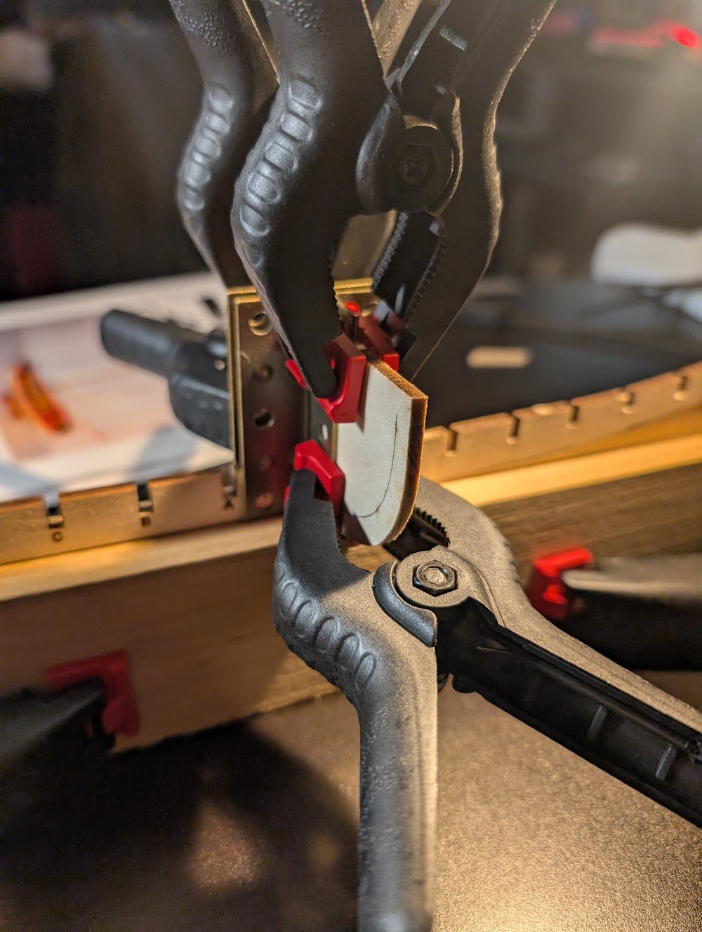

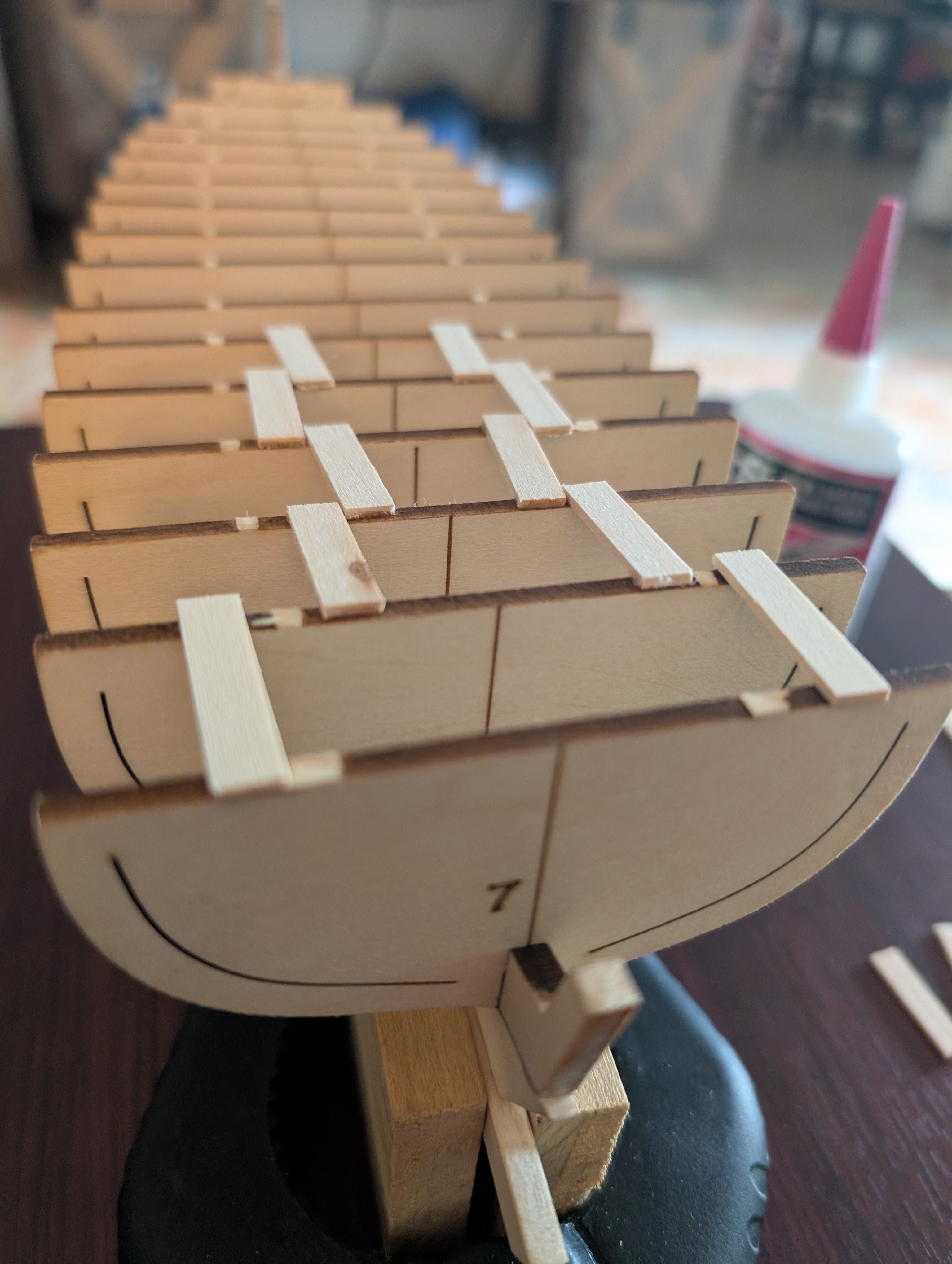

0 through 7 glued in place, A through H in progress.  Using a drop of thick CA with Tightbond III, holding in place manually as there is wiggle and clamping was giving me less accuracy than holding them in place until the CA sets.

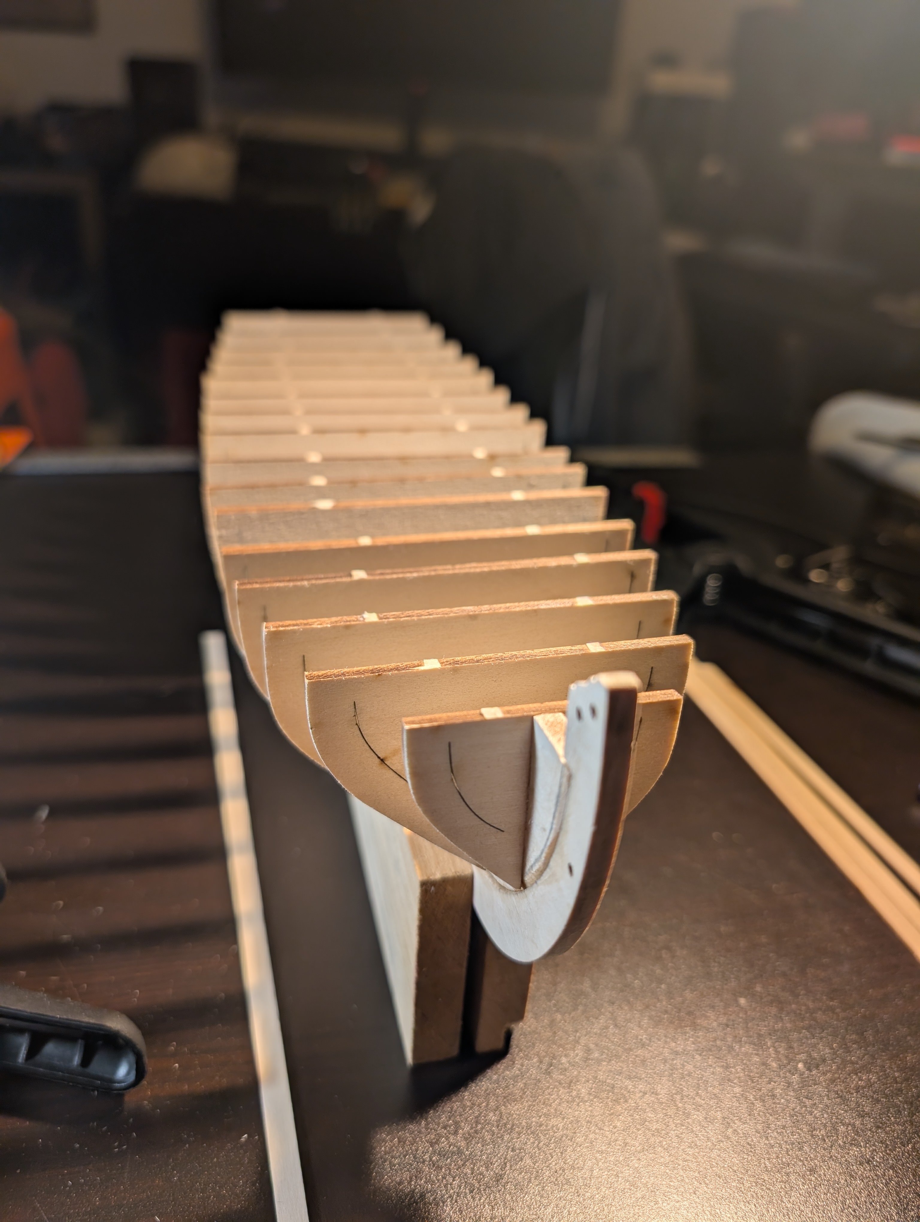

A through H glued, now braces and stern.  I may plank the stern as I don't plan on doing the photo etch decorative elements, and will probably do natural / stained wood sans paint

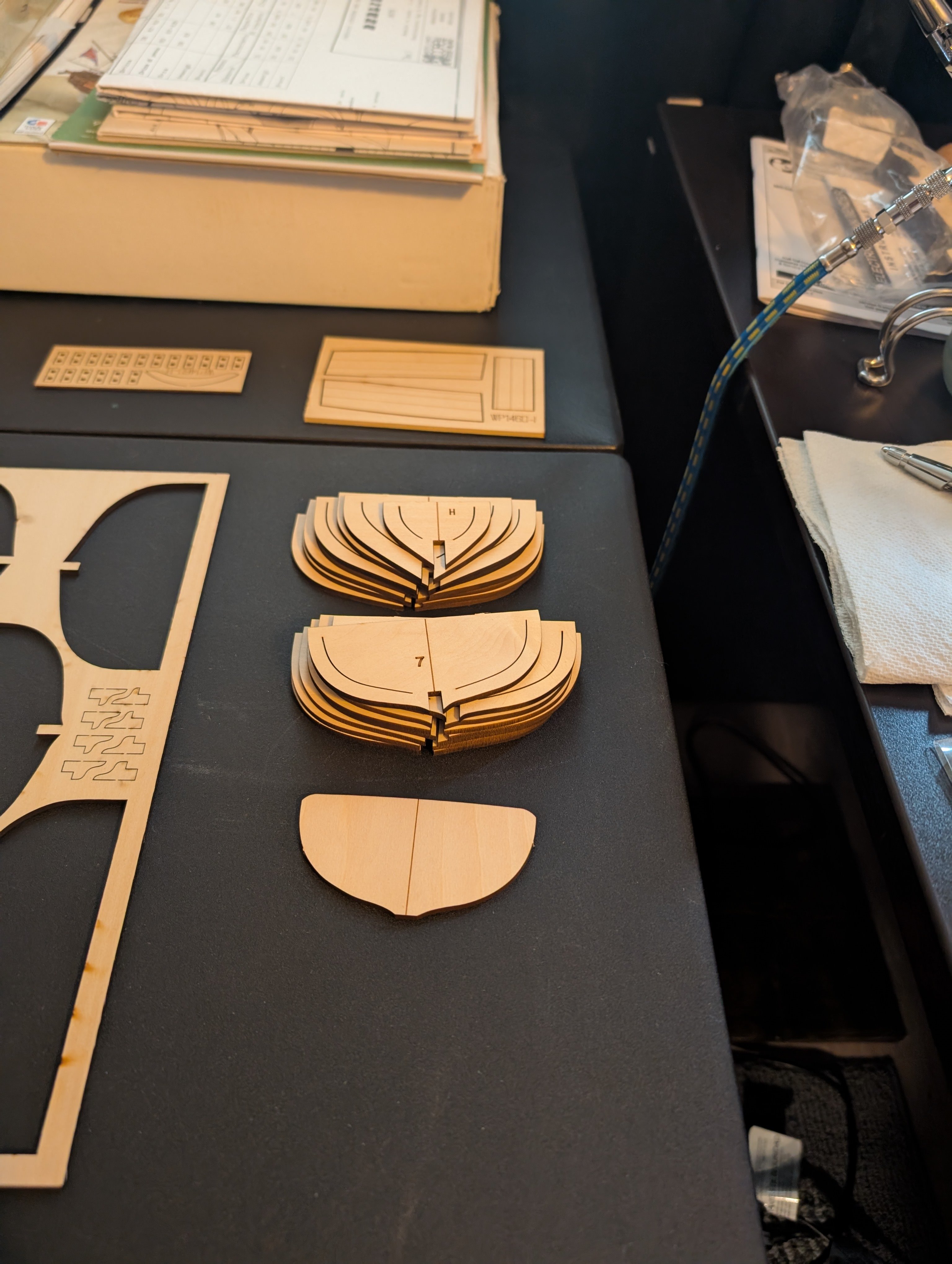

I ordered the AVG from Model Expo as it's on super sale right now, not sure if Corel Berlin or it will be next.   This build is moving along swiftly, and since the planking will be slower, having the next one starting to be built up will be a good idea.  I didn't want to start with the more complex Berlin first, and picked this particular kit based on it being single plank.
I will say this kit is very well designed.  I do feel as if the laser cut parts have some weird angles, and it made the frame to false keel assembly tougher than it needed to be.  I don't have any other kits with those parts laser cut as a reference, and the AVG is the same brand.

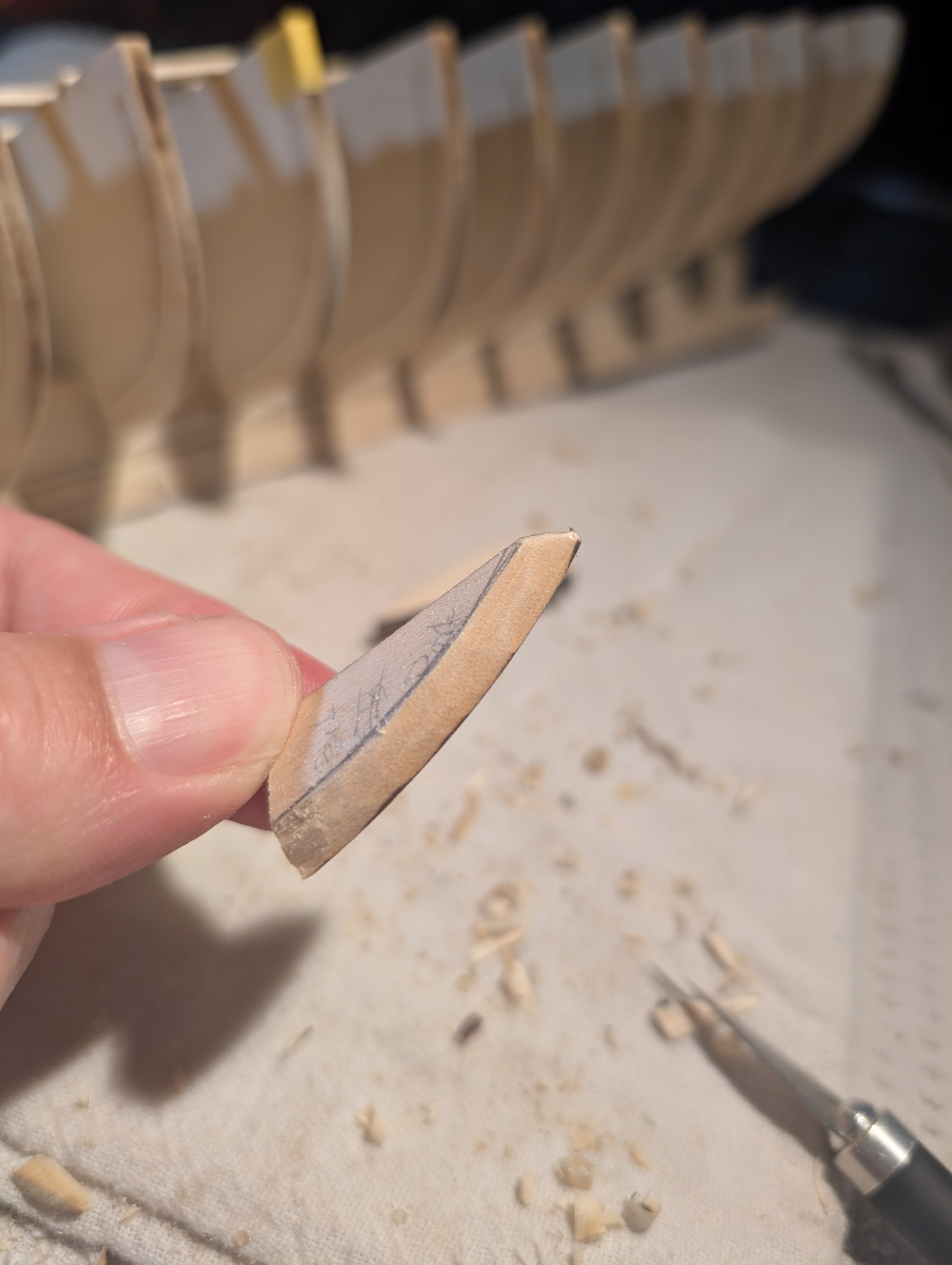

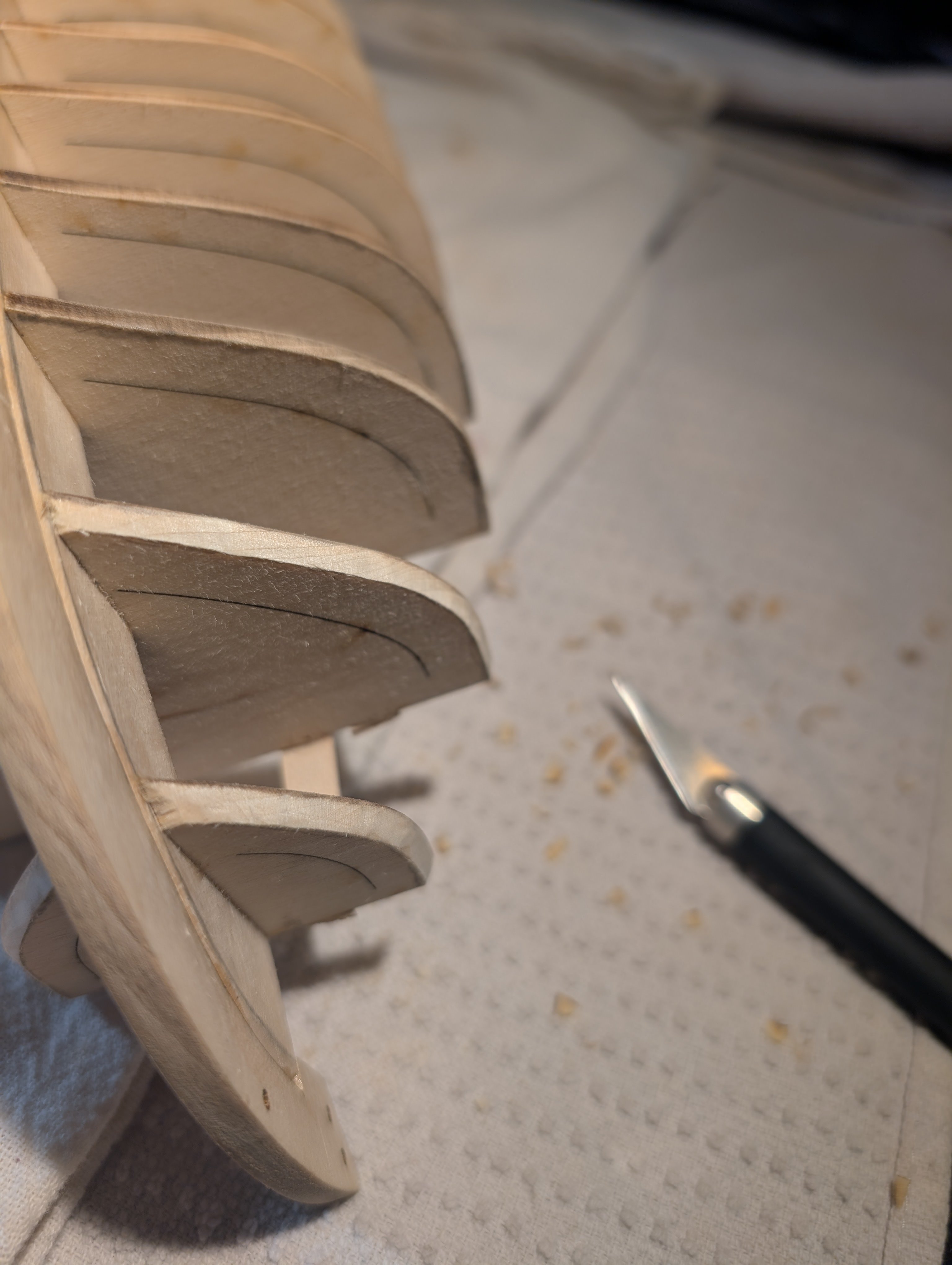

Fairing the bow frames.  I have found using a fresh hobby knife blade to be the best here. The basswood is pretty soft so sanding or filing the majority of the shape just seemed like it would introduce more errors.

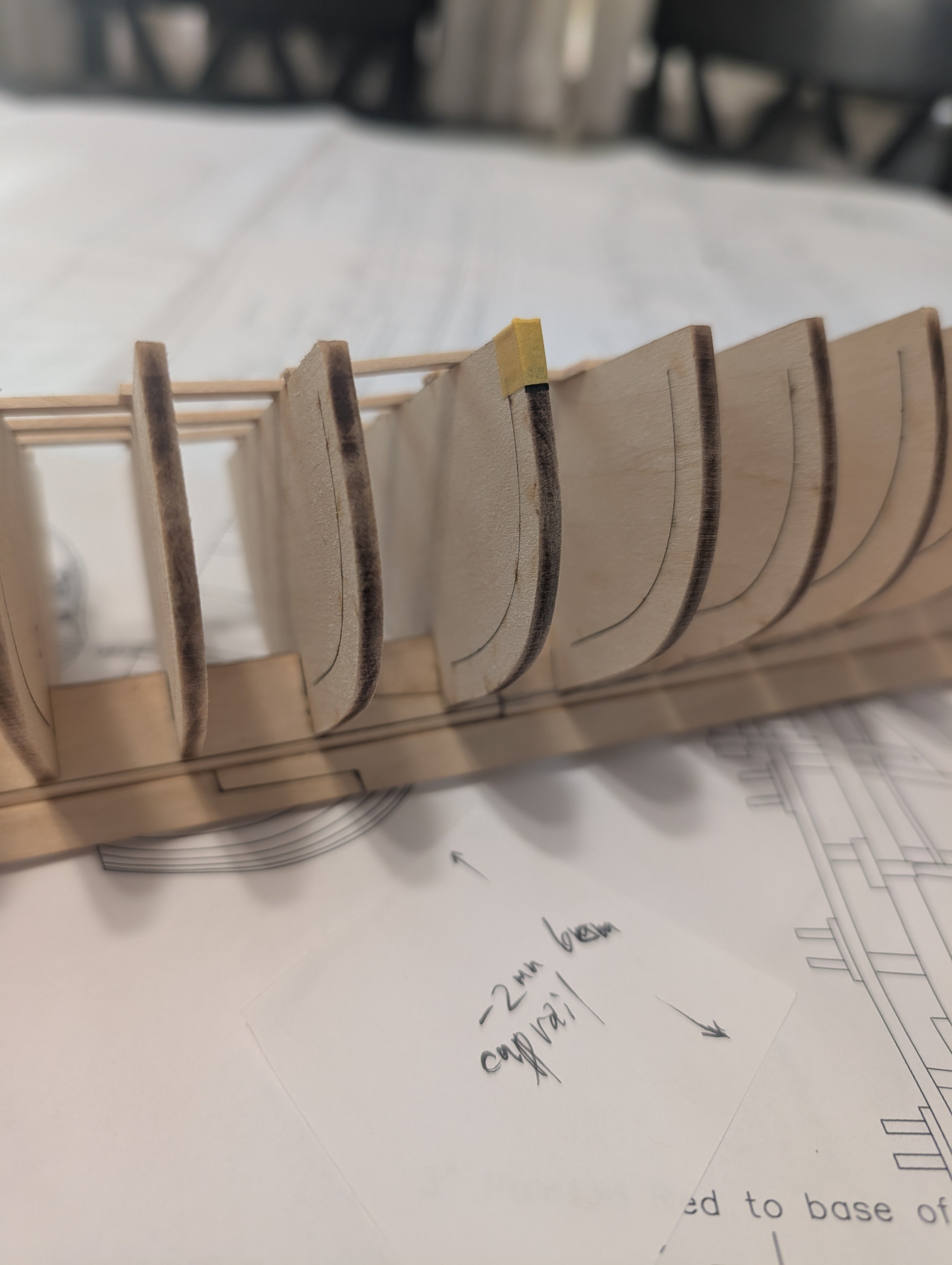

Here is the bottom of the cap to the keel measurements off of the plans for each frame, a good reference for anyone doing the kit and getting ready to plank (top edge of uppermost strake).
0 - 57 mm
1 - 57 mm
2 - 57.5 mm
3 - 58.5 mm
4 - 60 mm
5 - 61.5 mm
6 - 63 mm
7 - 65 mm
Stern - 68 mm
A - 57 mm
B - 57 mm
C - 58.5 mm
D - 59.5 mm
E - 60.5 mm
F - 62 mm
G - 64 mm
H - 67 mm
Bow - 69 mm

Fairing is coming along nicely, and I am to the last several frames toward the stern.  I will probably have to shim a few of the frames, as they will create issues with the lines of the hull if I don't.

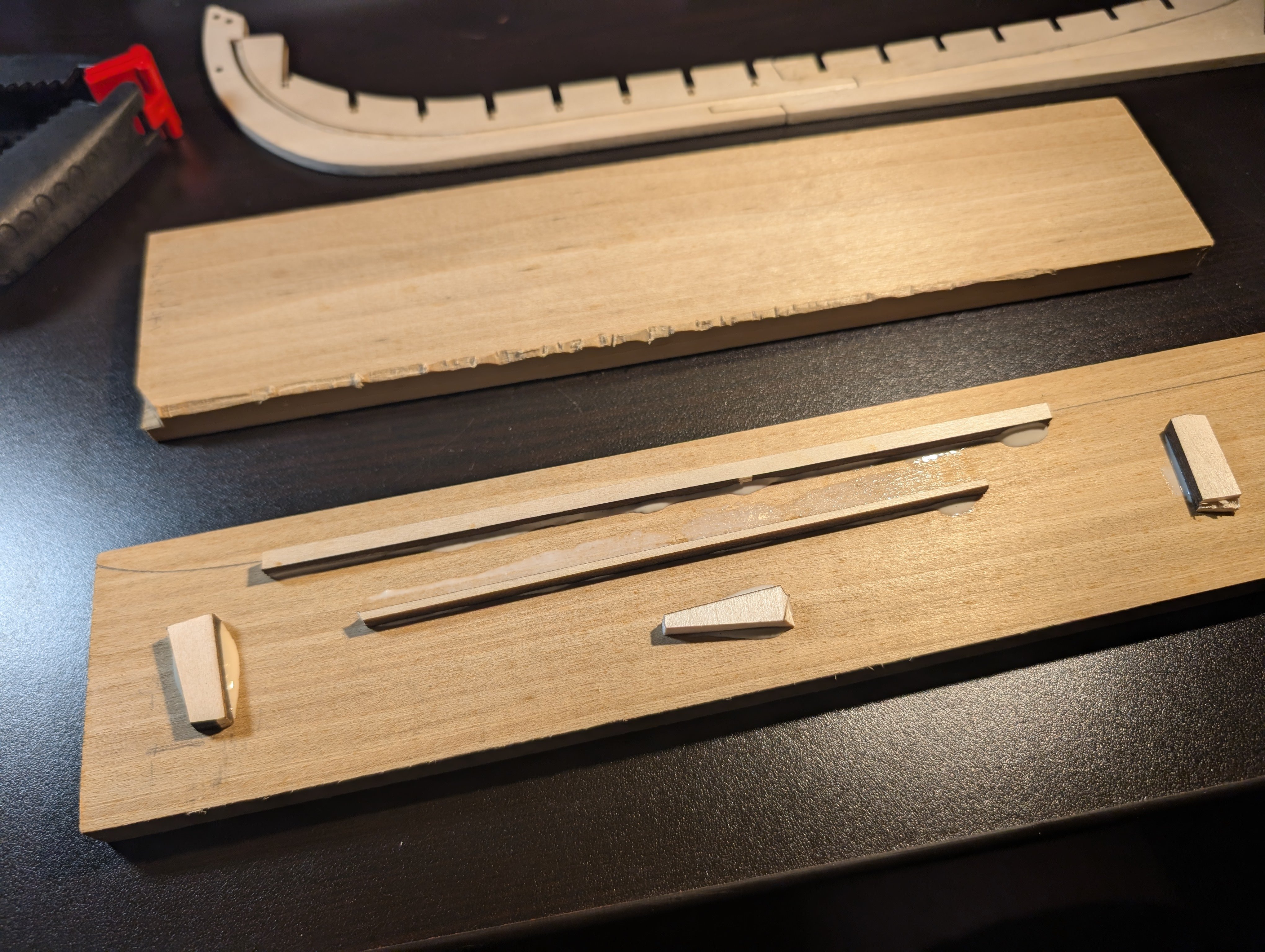

#3 strakes on both sides installed.  I started with Chuck's method of planking with a jig and a clothes iron.  I feel that this method is nice to get the edge curve, and the wood is ready to lay down after the shape is bent in.  I don't think I would have had an issue with #2 strake having a slight bit of pinch had I used this method for #2.   Stern is out of alignment now, mostly because the false keel cracked underneath, so some minor surgery was needed to repair it.
