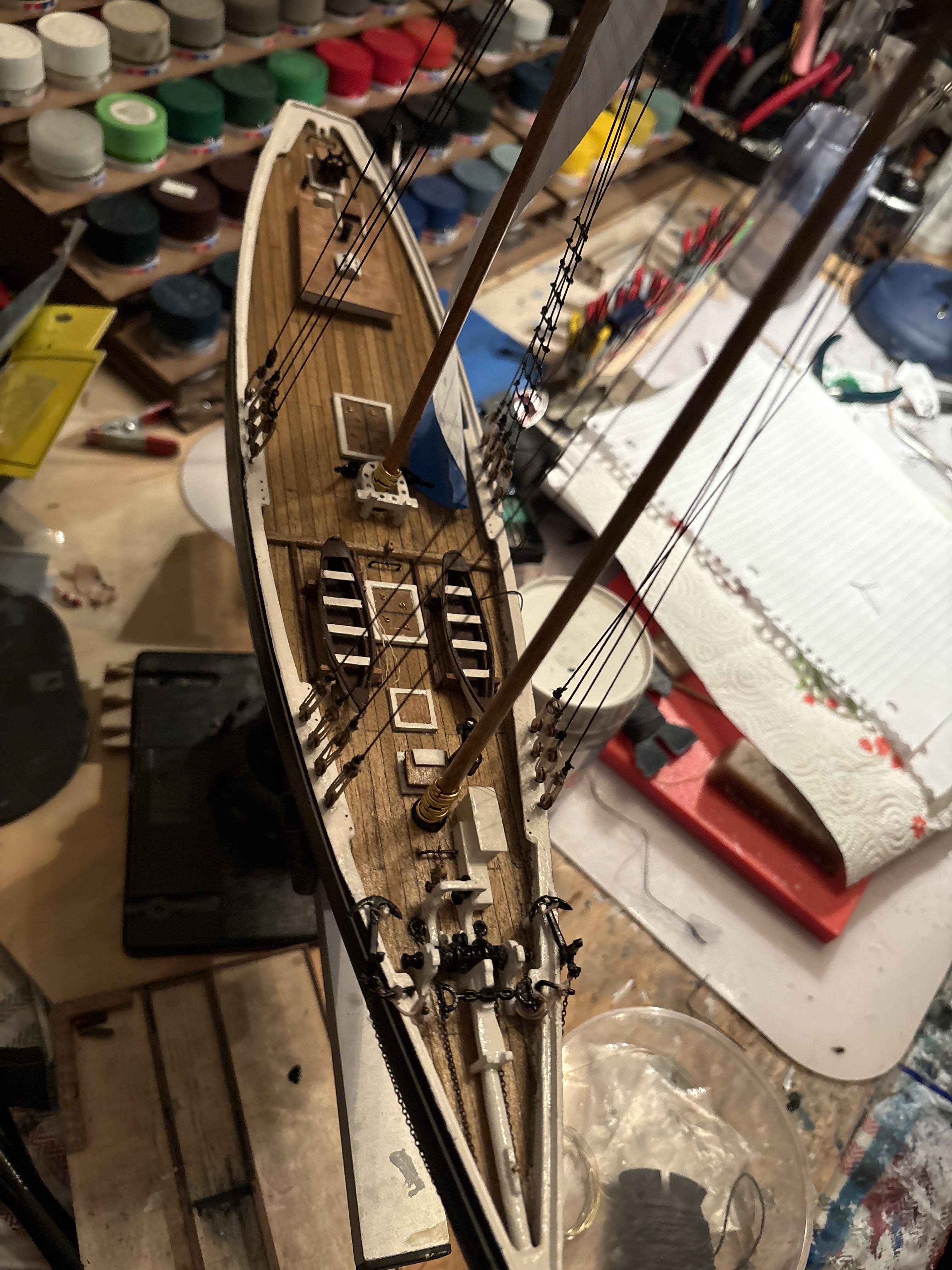

The planking is done! It was a fun part of the project. But good to be on the completed side of it.
Next up is the so called monkey railing then some railing paint. Paint the hull first? Or plank the deck?  🤔  I'll have to give it some thought.
Some notable faux pas along the way:
-Set the xacto knife down on the bench and it rolls off and stabs my foot.
-Both hands busy with the model, set a tool down right into a puddle of freshly squeezed glue.
-Set a tool down and it magically disappears.

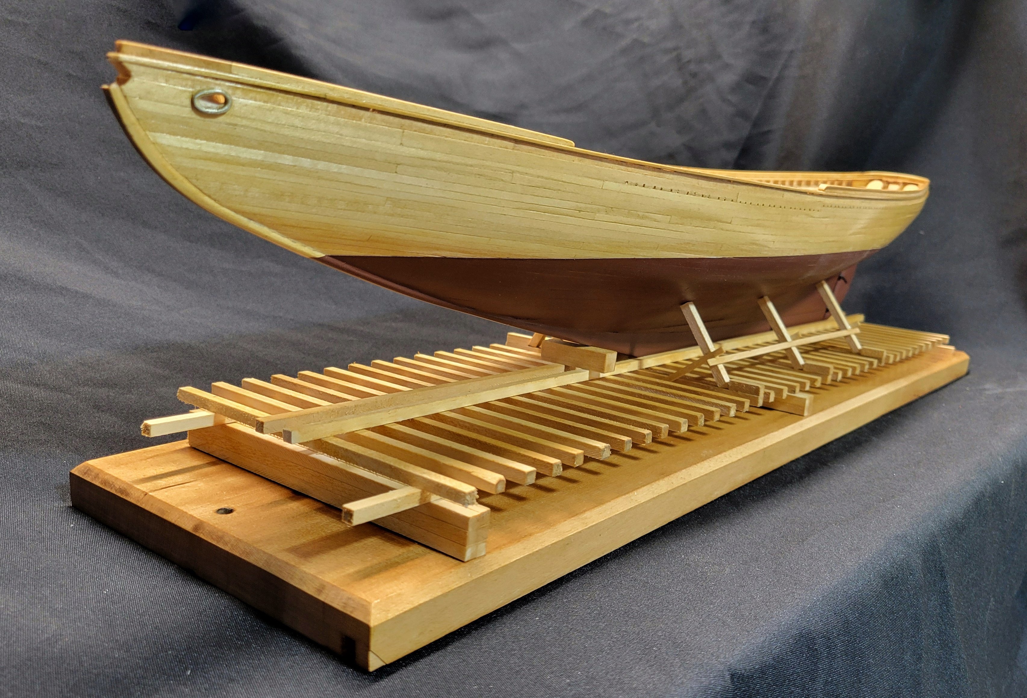

-Finished the deck planking
-Added what they call the buffalo and monkey rails to the top of the mainrails.
-I wasn't happy with brass strips supplied for the rudder gudgeons. And there was no brass rod for the pintles. Should have done a kit inventory? Nahhh! I used staples soldered to wire brads instead. Had that stuff in my shop.
-I added the so called fashion pieces the stern sides.
-Added the hawse hole trim rings.
-I coated everything in home mixed shellac to seal the wood prior to paint, except for the deck. That I coated with Tru-oil for the final deck finish.  The Tru-oil looked a bit better than the shellac on test scrap pieces.
The deck will be carefully masked off for paint.
So.. I believe that completes the hull!  Woohoo!!!  What a ride!

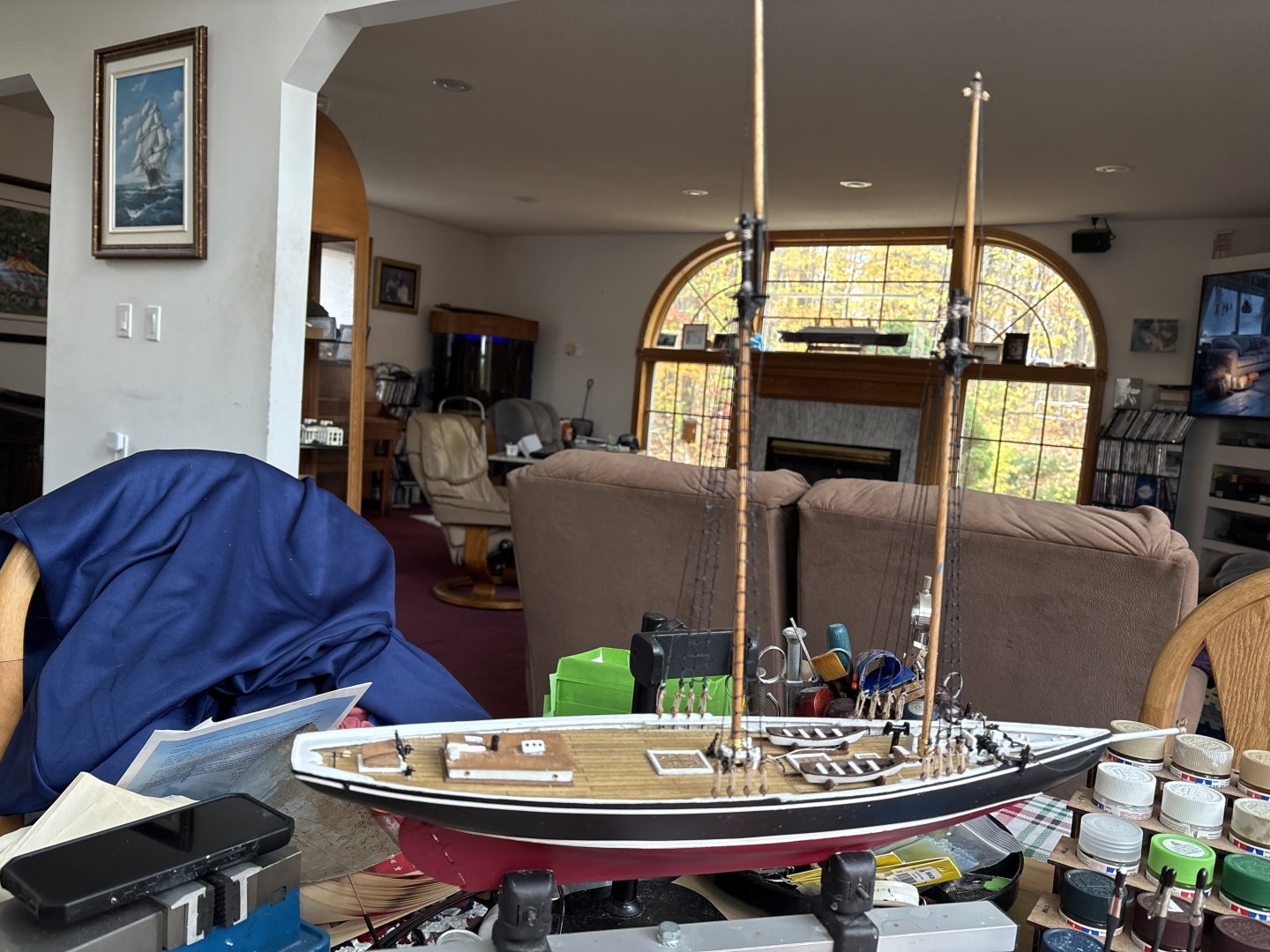

Terry you are up to painting. When I painted my Bluenose I tested many colors to find the right hull bottom
color. The color I picked was as right under my nose. I checked a bunch of Tamiya and model expo colors and none really matched. The I went back and checked out Liquitex Basic Acrylic Fluid colors. I first tried Cadmium red deep Hue, a no go. The second one I tried matched almost 100% ( Alizarin Crimson Hue). Take a look at it and see what you think if you are looking for a burgandy. Best RickIMG_3217.thumb.png.029c45cb8286cb8d9e7122a3c96314ac.png
color...  I went back and checked out Liquitex Basic Acrylic Fluid colors... The second one I tried matched almost 100% ( Alizarin Crimson Hue).
That's the exact brand and Alizarin Crimson Hue color I used on my lower hull, with the Liquitex Basics Acrylic Mars Black as my choice for the black portion.  I am not a good spray painter, and these colors brushed on really nice for me.  Also, if you haven't already prepared for it, I highly recommend using Tamiya masking tape to help create the sharp lines between colors.
Nice hull work on your Bluenose, Terry! Carry on, sir!
Gregg
I indeed have been looking for a deep burgundy. I want to match my Midwest Lobster Smack.  Not accurate for Bluenose but I really like the color. Unfortunately I used Floquil on the model when I built it 35 plus years ago. Floquil is long gone. I have no idea what the color is. In pics I saw,  I thought Model Expo's Copper Red acrylic looked pretty close so I bought some. Not quite as deep as I had hoped but I suppose it will do. it's supposed to be an accurate color for the Bluenose so I'll probably use it. I'll have to thin it for my airbrush. If I hadn't already bought some I'd look into the one you used. Looks great. I still may search for deeper.
Thanks

Greg and Terry if you want crisp water lines I stay away from hobby brands. I use 3M fine line tape
for painting pinstripes ( I restored cars and had a full shop at my house).it comes in varying widths 1/16” 1/8”1/4” etc.  To get fine Llnes first paint your stripe color then lay the tape in the width the line you need. Then burnish the tape then paint the stripe color over it to seal it. Then paint your hull colors over the last stripe color layer and let them dry. When you pull the fine line tape you will have a very crisp water line or stripe you want. Try it first on a piece of primed basswood. Also Liquitex Gesso is great primer ( cheaper and better than hobby primers around $13 for 8oz and sands perfectly smooth). All professional paints.
Best Rick
By the way Greg the black I used was the Liquitex Basic Acrylic Fluid- Ivory Black a satin black color)

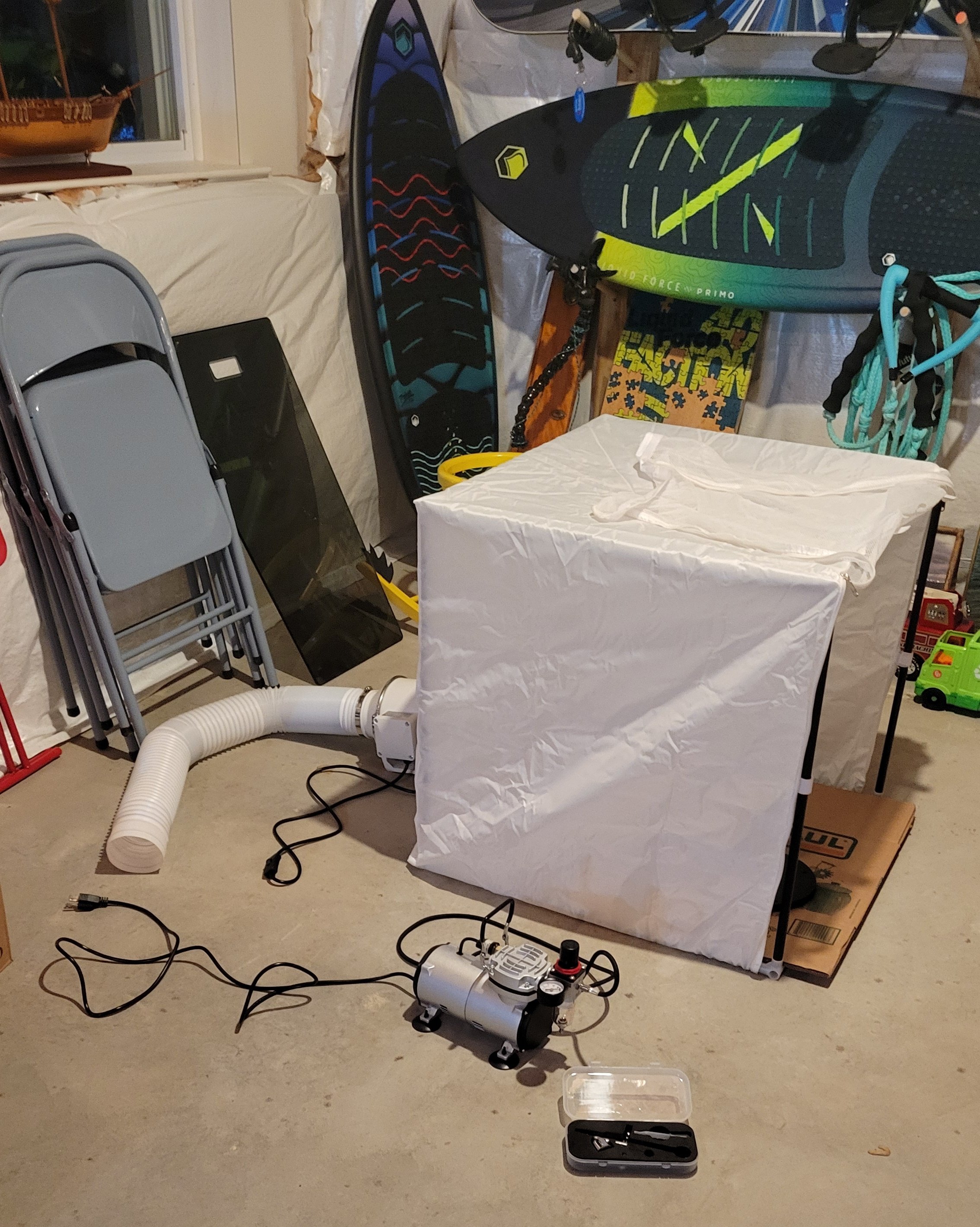

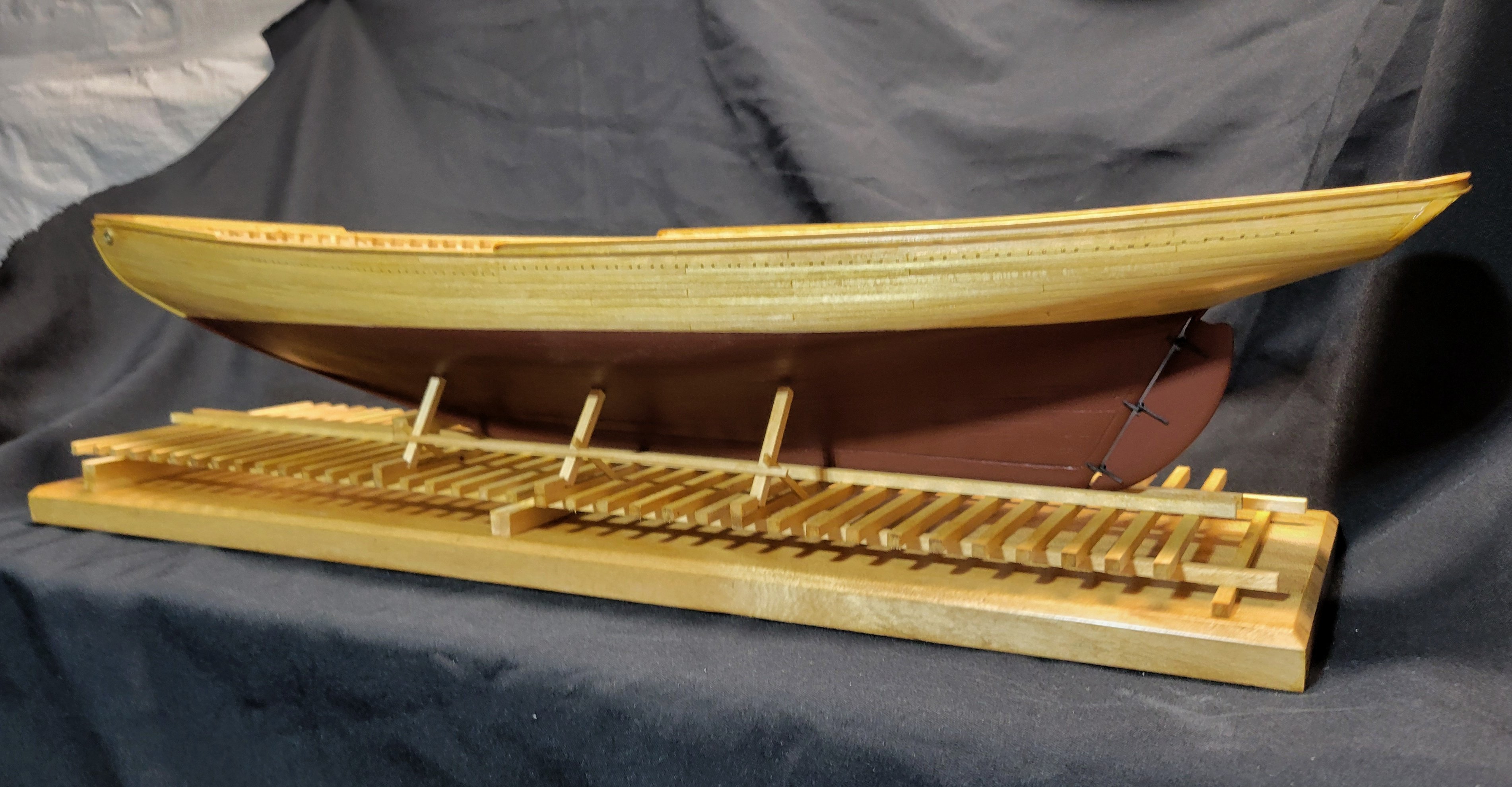

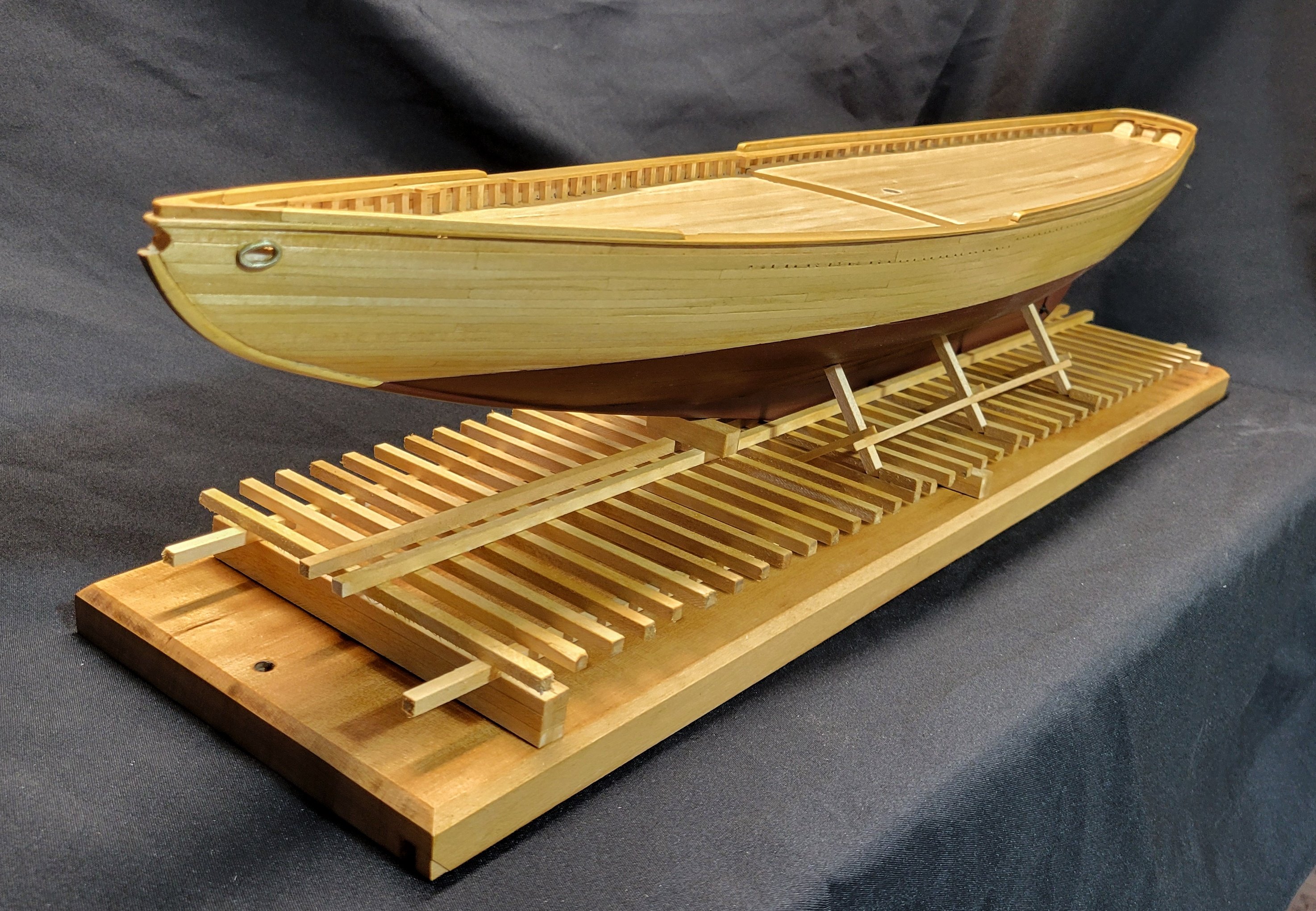

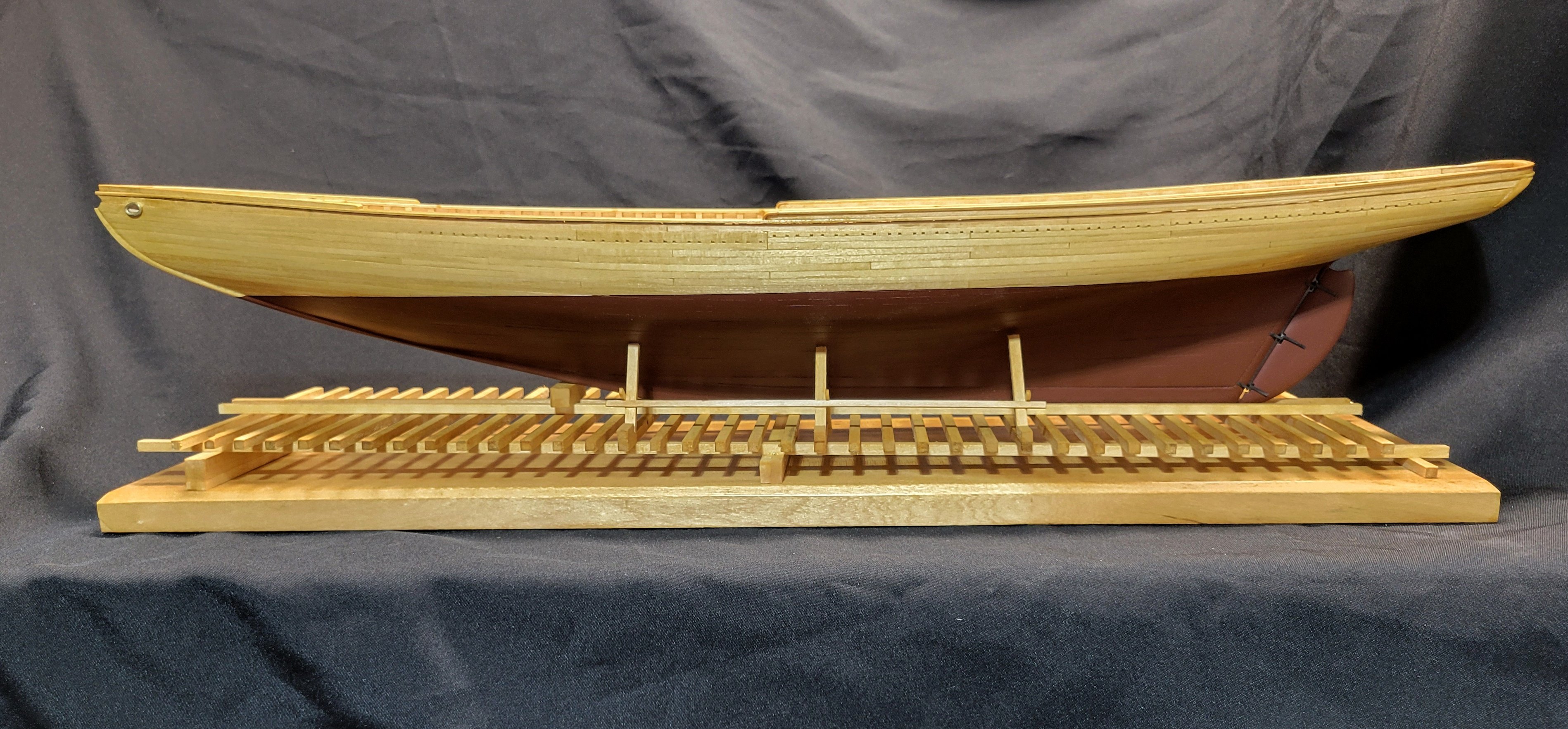

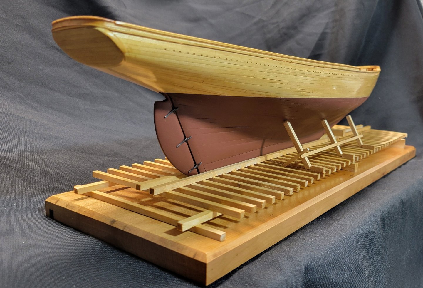

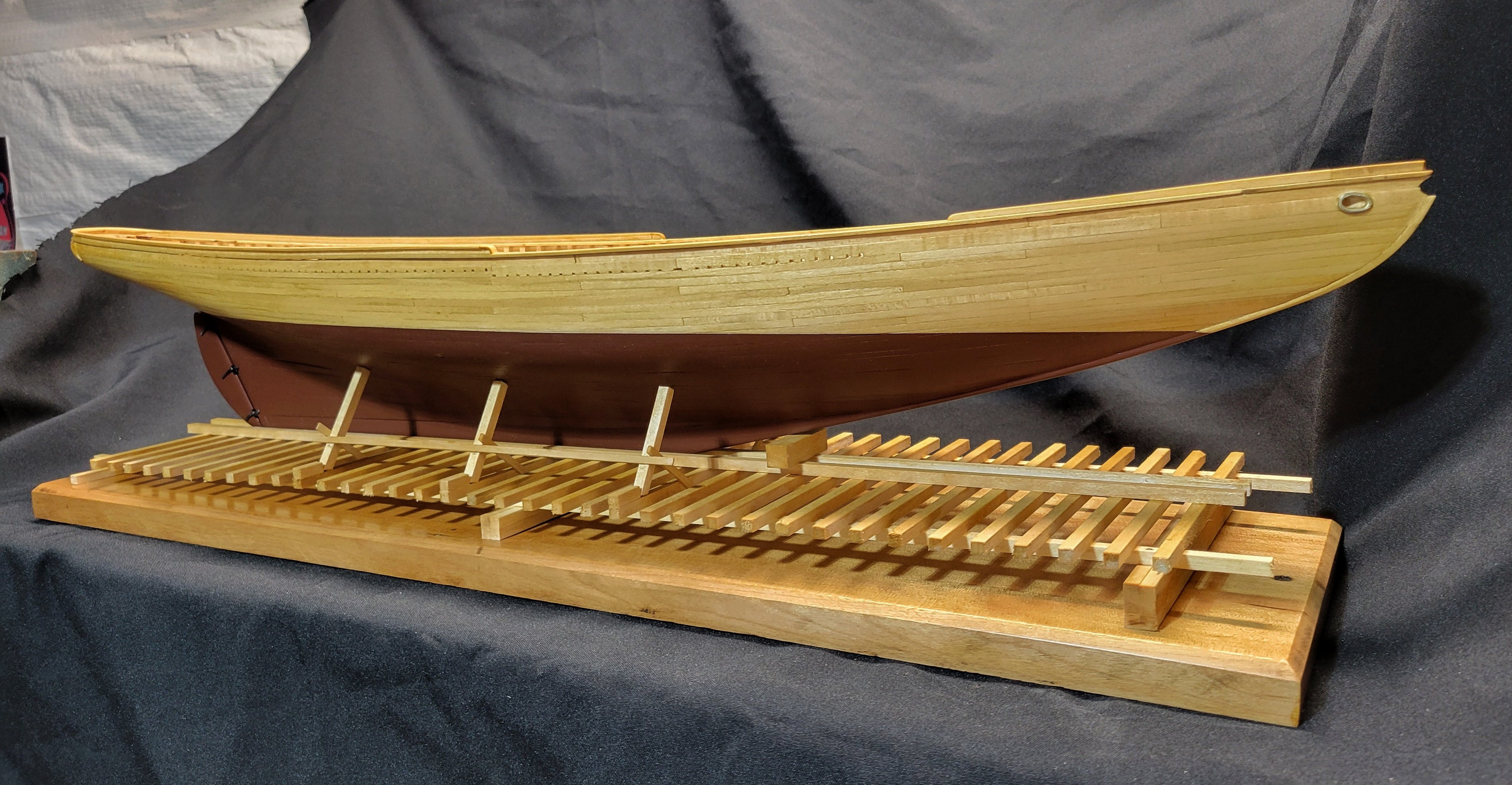

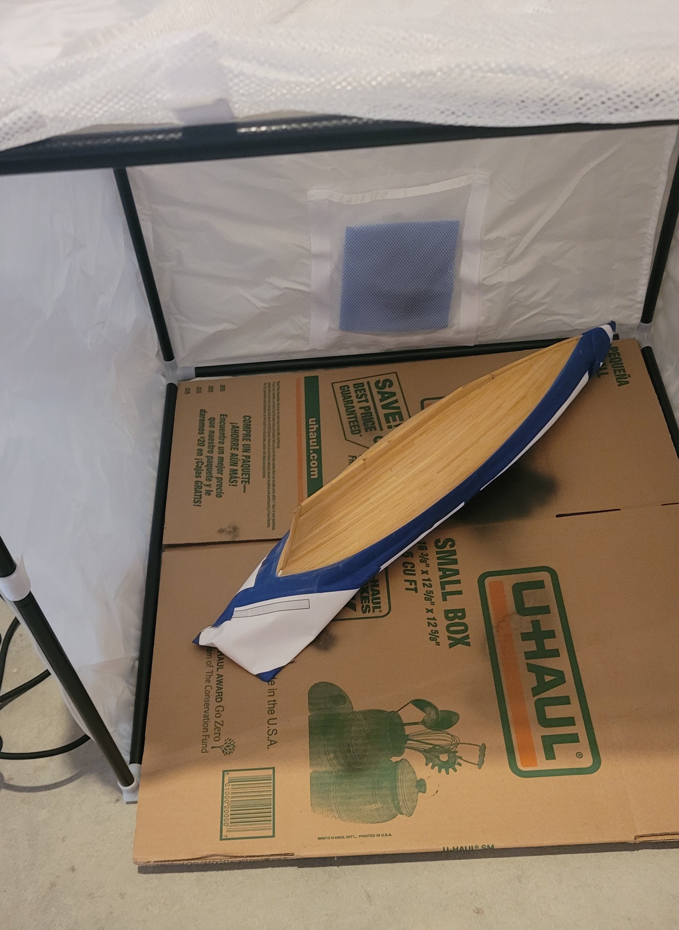

The "paint shop"
Getting ready to get ready.

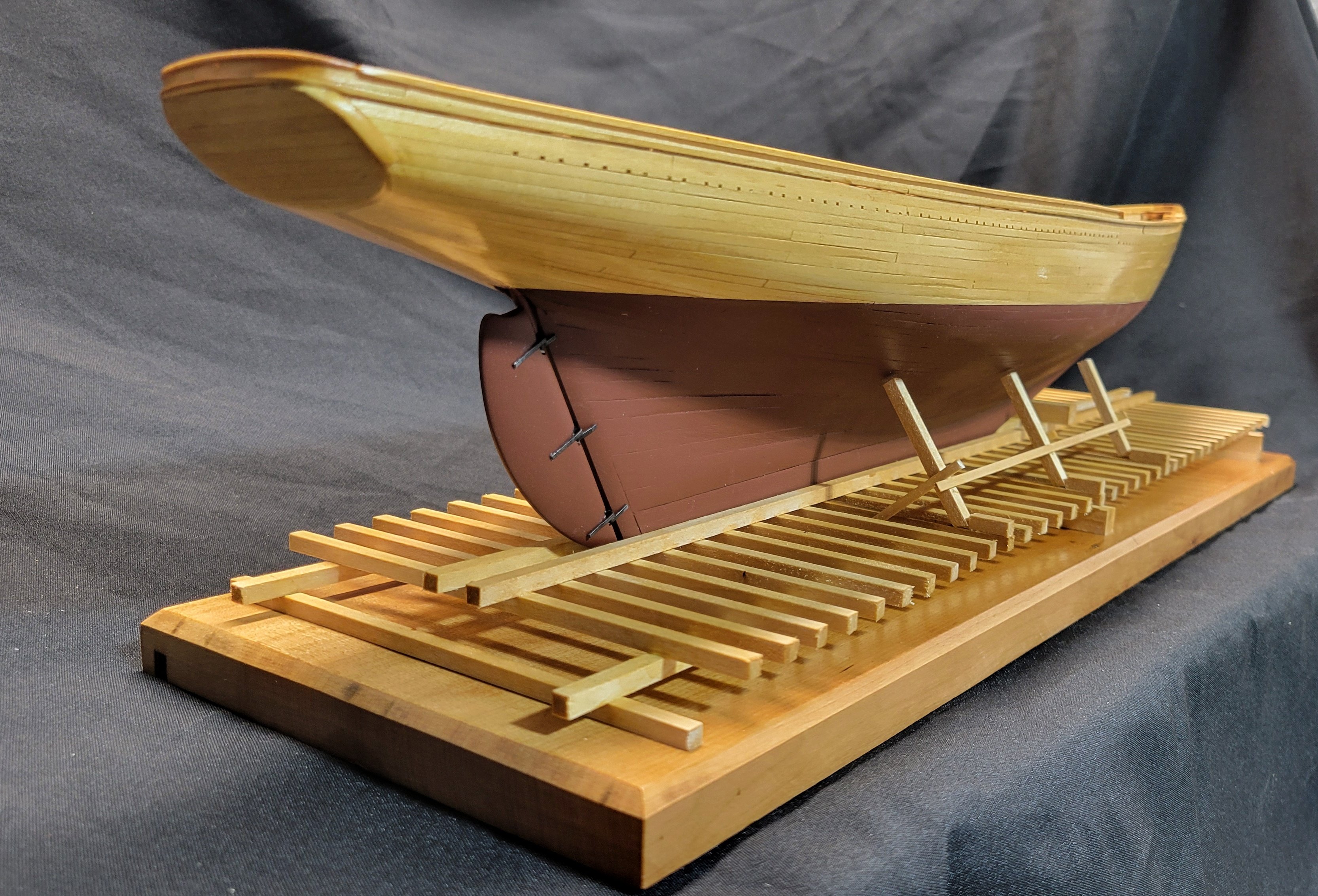

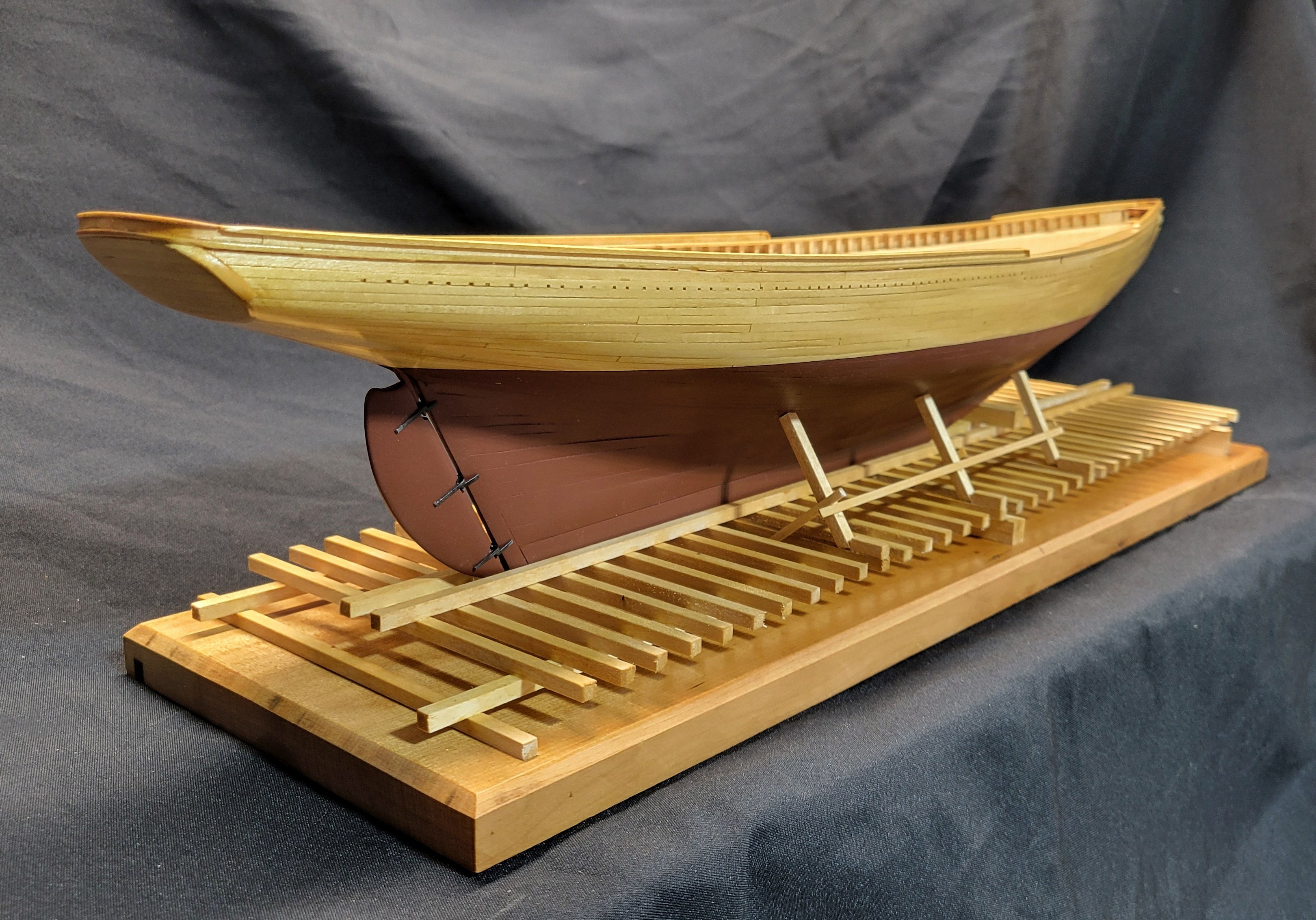

-Painted the bottom.
-Launch way in progress.
This is my first experience with water based acrylic paints and I have to say I'm a new fan! There are no nasty solvents involved and no nauseating smell.. It's like spitting daisies when spraying.  I am very comfortable spraying in my basement. I know I'm not going to explode when the furnace kicks on. The little spray booth has a filter at the input of the blower unit to collect over spray. I use a respirator to be sure.
The acrylics spray well with my airbrush.  They have great coverage with a nice matte finish. They brush well with very little brush strokes showing.
All for now.
Edited by TerryPat
Terry I love the hull bottom color and the launch way came out great. Was all the timber for the launch way bought as the $19 kit from Model Expo. You know what I believe the ship looks a hell of a lot better on a launch way than on 2 brass pedestals and gives more detail and attraction to look over the ship build.
Best as always to you Rick
Thanks Rick!
The bottom color is Model Expo copper red with a little black acrylic added to make it less red.

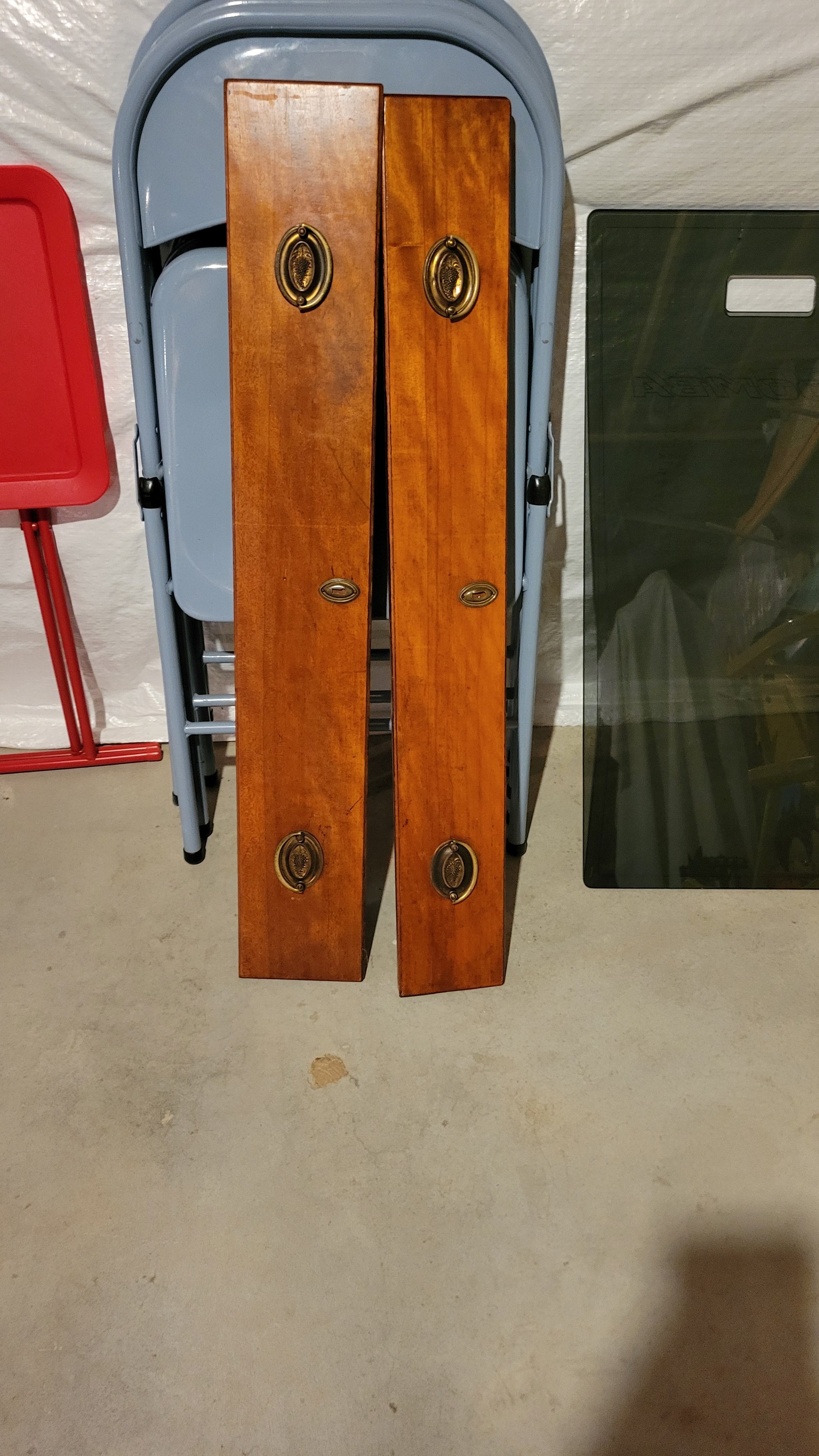

No. The launch way is about $12.00 for a bunch of 3/16 inch square sticks from Model Expo. Do they still offer the kit? I didn't see it. I didn't look very hard either.. lol
The base I made from solid cherry drawer faces from an antique dresser I busted up and savd the wood. I have two drawer faces left.
Edited by TerryPat
