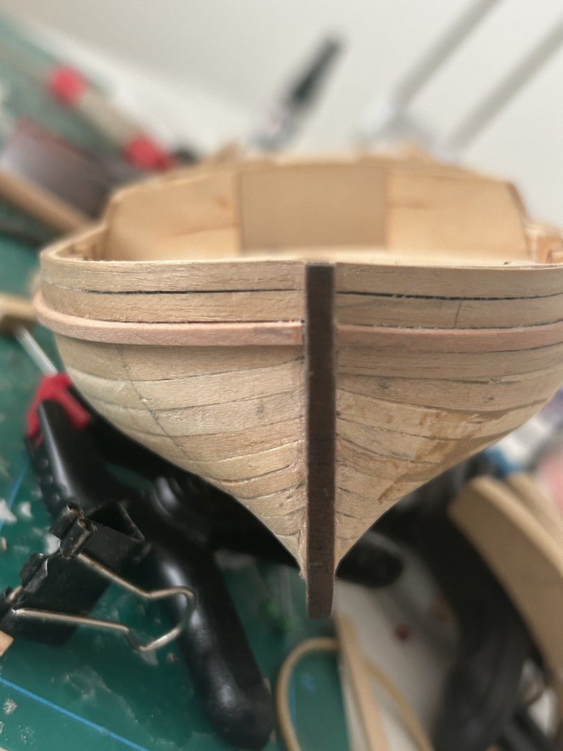

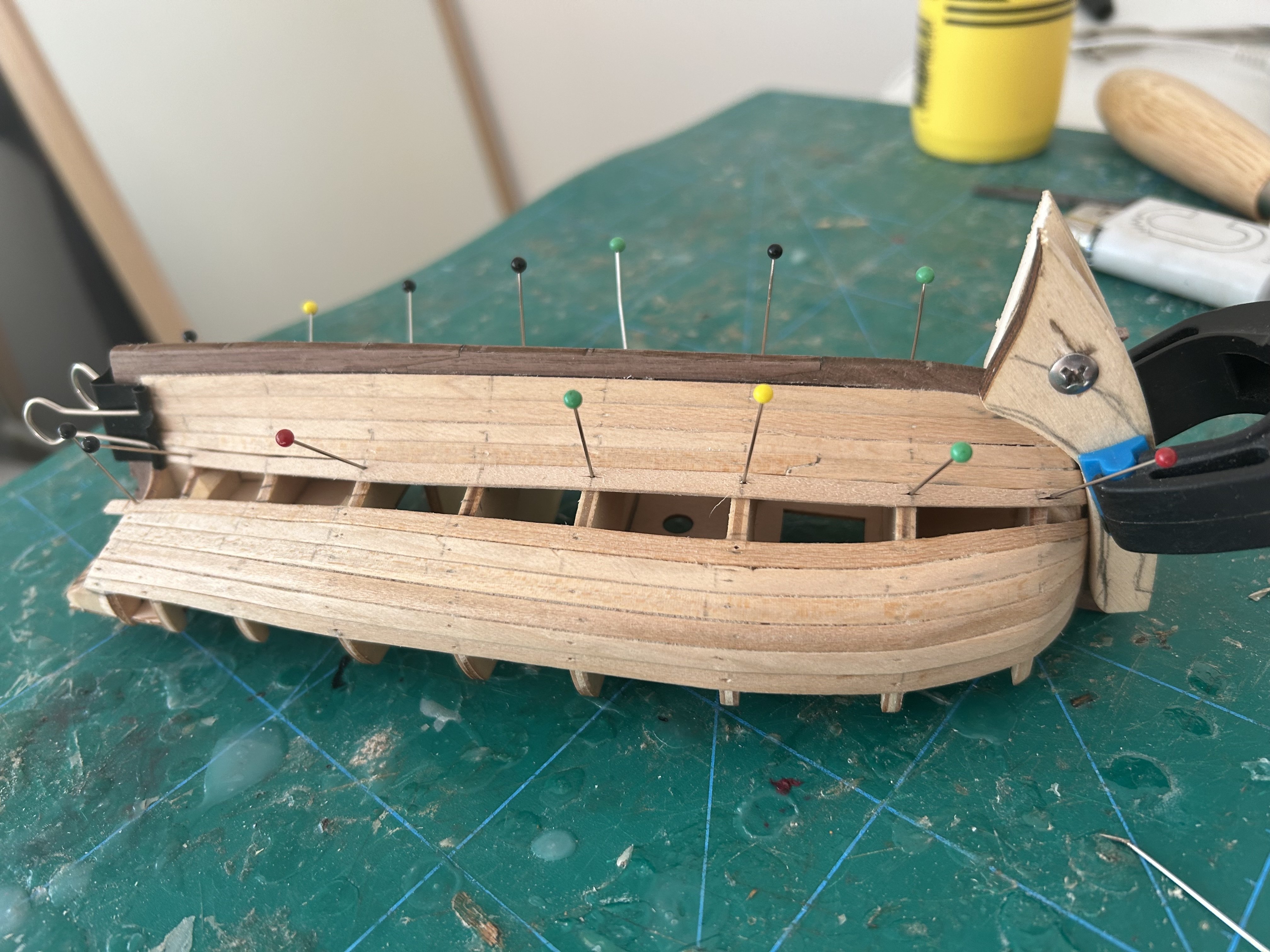

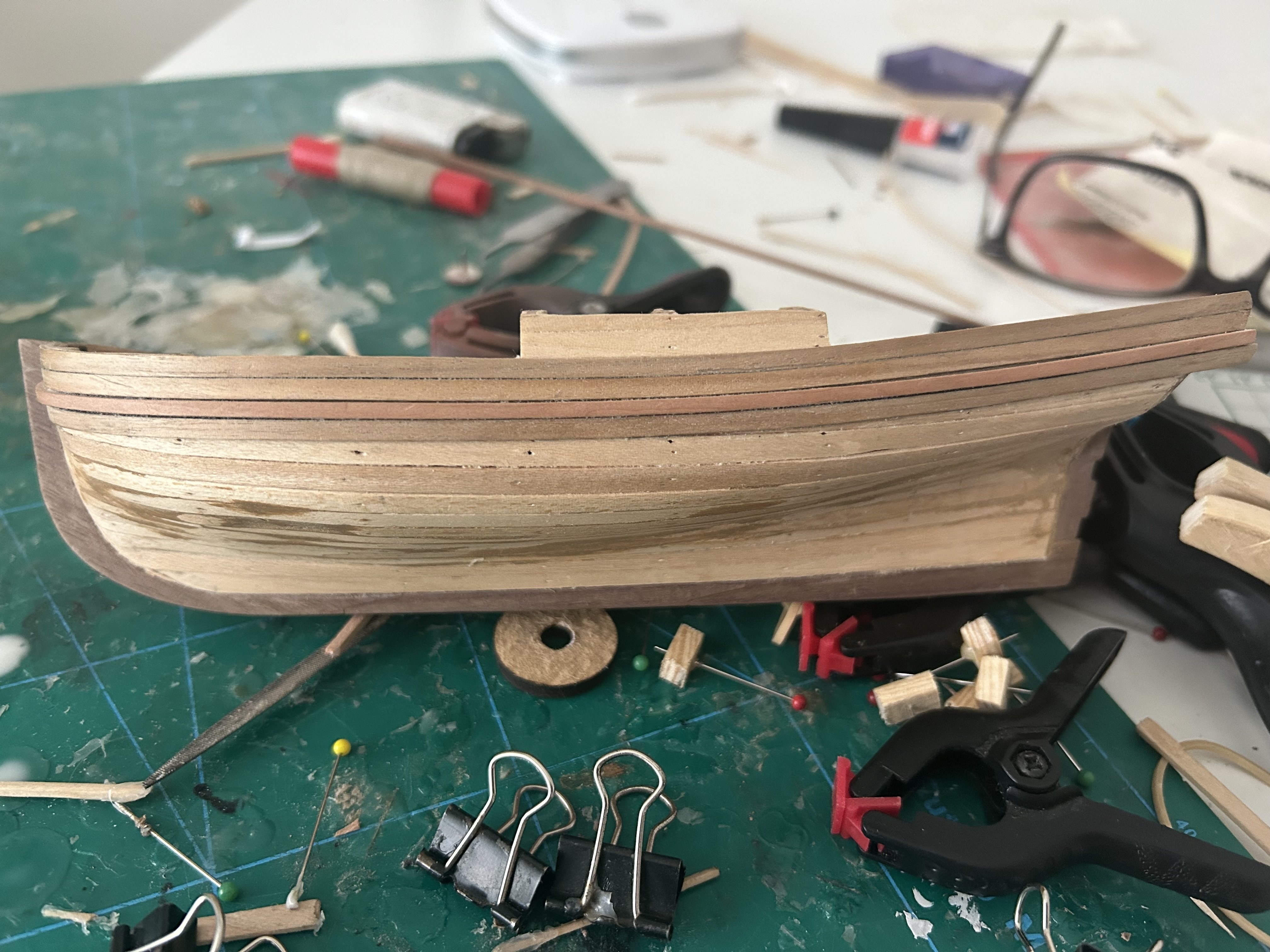

So, Gretel. Here’s her current state: the first layer of planks is almost finished. This time I decided to do everything like a real model builder — calculated, marked, and trimmed each plank. In previous attempts, I skipped this black magic, and my Duyfken and Lady Nelson were more the result of inspiration and happy coincidences than of careful calculation. This time it’s different. Well, I almost nailed it. No, even more than that! I know exactly where I went wrong. That’s important! :)
She’s a funny one, though. A little bit like a tiny flounder.

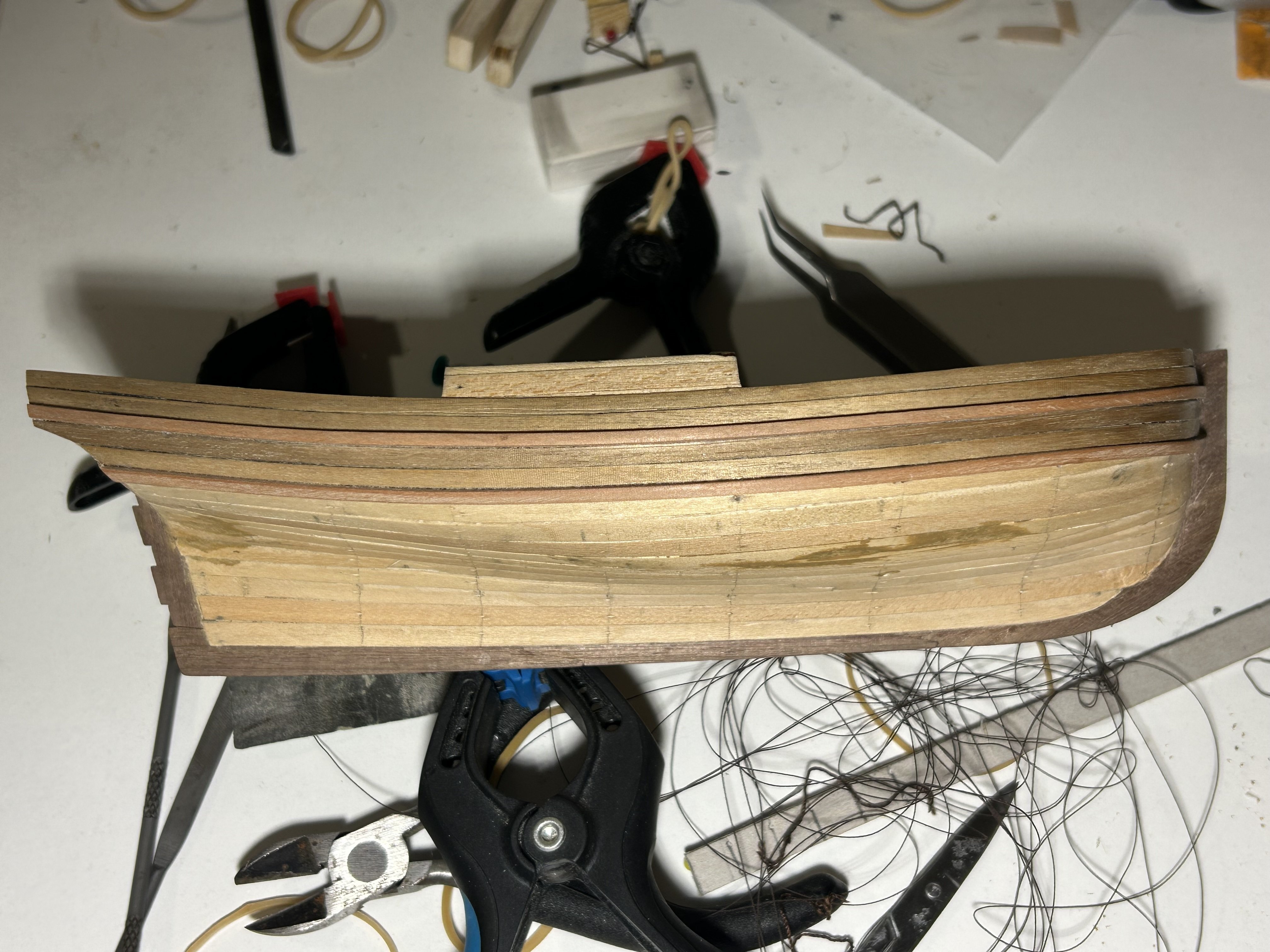

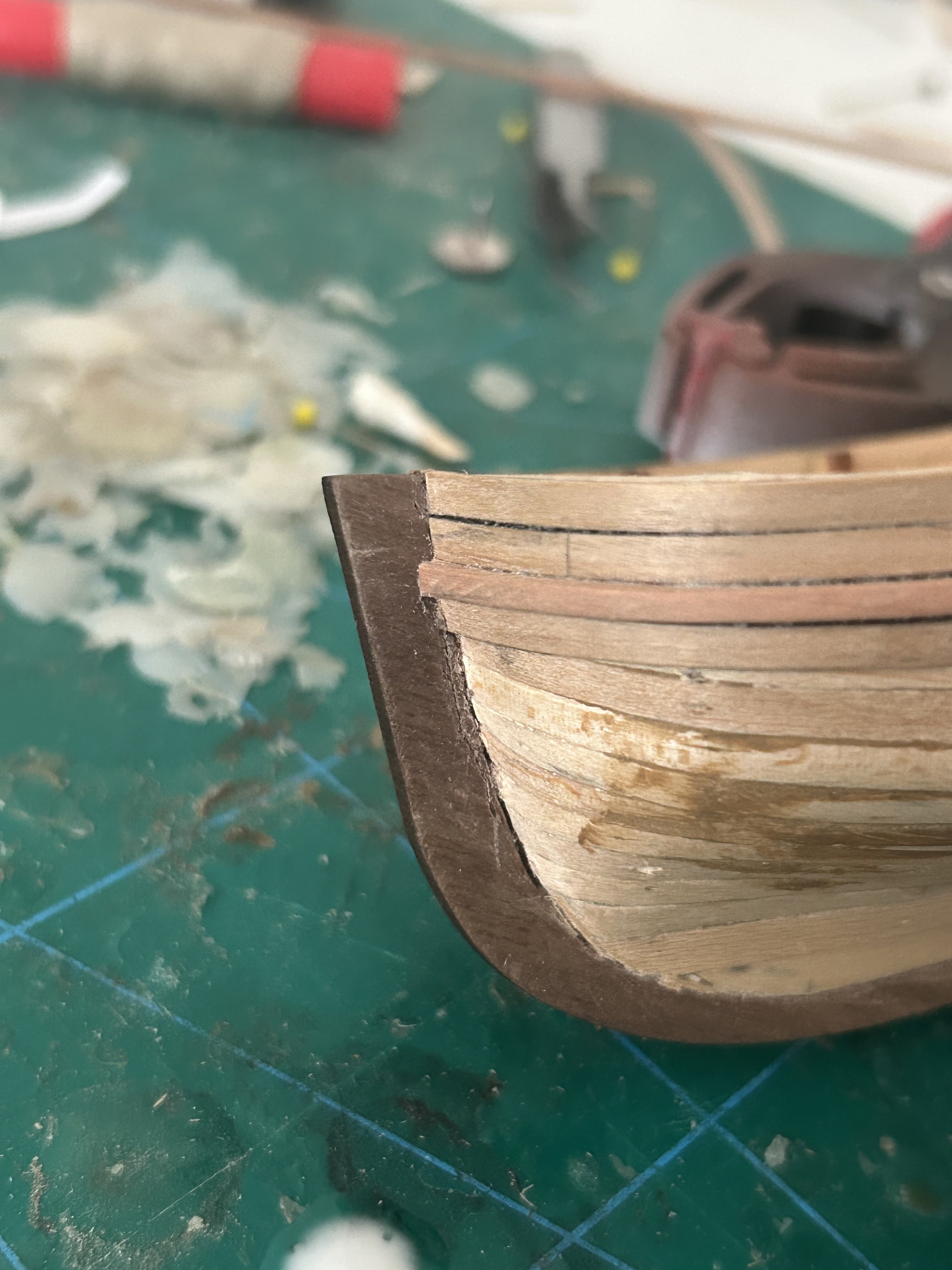

In progress. The last belt remains. Heh, the soldering iron'n'pipe definitely wins the Best Tool for Ship Modellingaward this year. How did I ever live without it?
And yes, I cheat: the 4x0.5 mm walnut strips supplied with the kit are extremely brittle — even when soaked, they just break at the slightest attempt to bend them in-plane. So I switched to 5x0.5 mm walnut strips from Massivholz. I’m not an expert in wood, but maybe there’s some ancient Germanic magic at play — because these strips bend without the slightest problem.
When the Lord likes your hobby, He always gives you an extra plank.

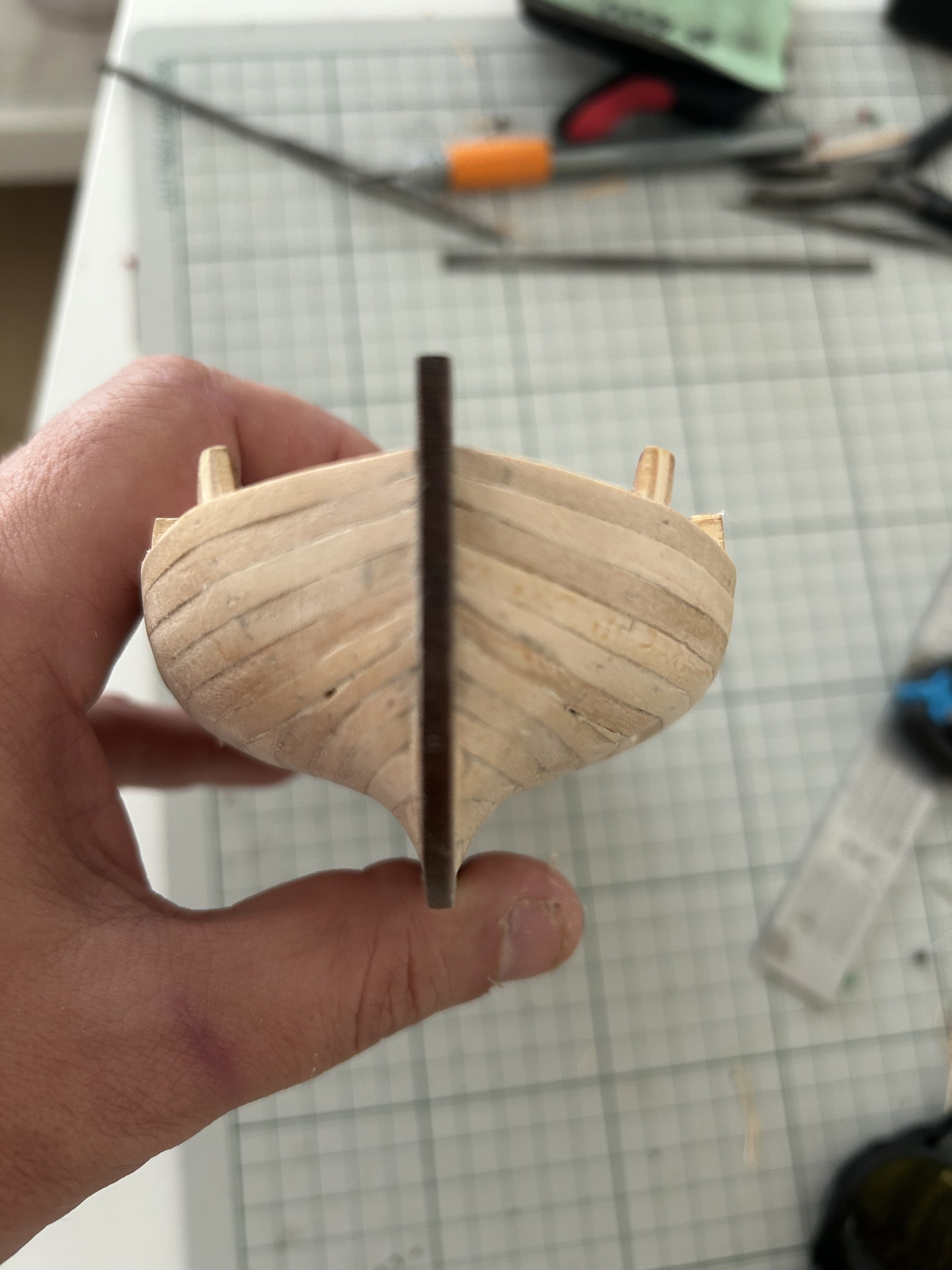

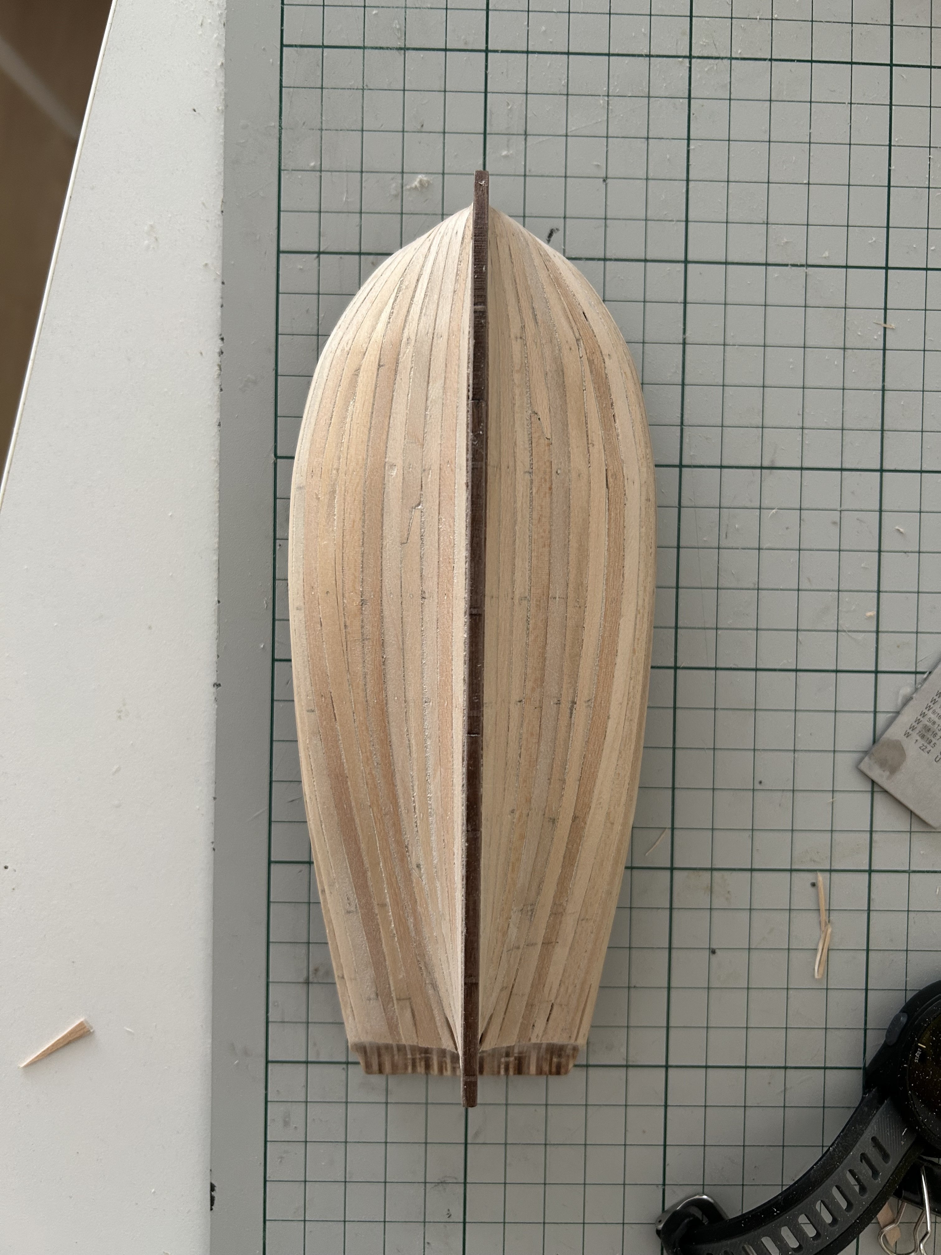

I found one more German plank and finished the main planking

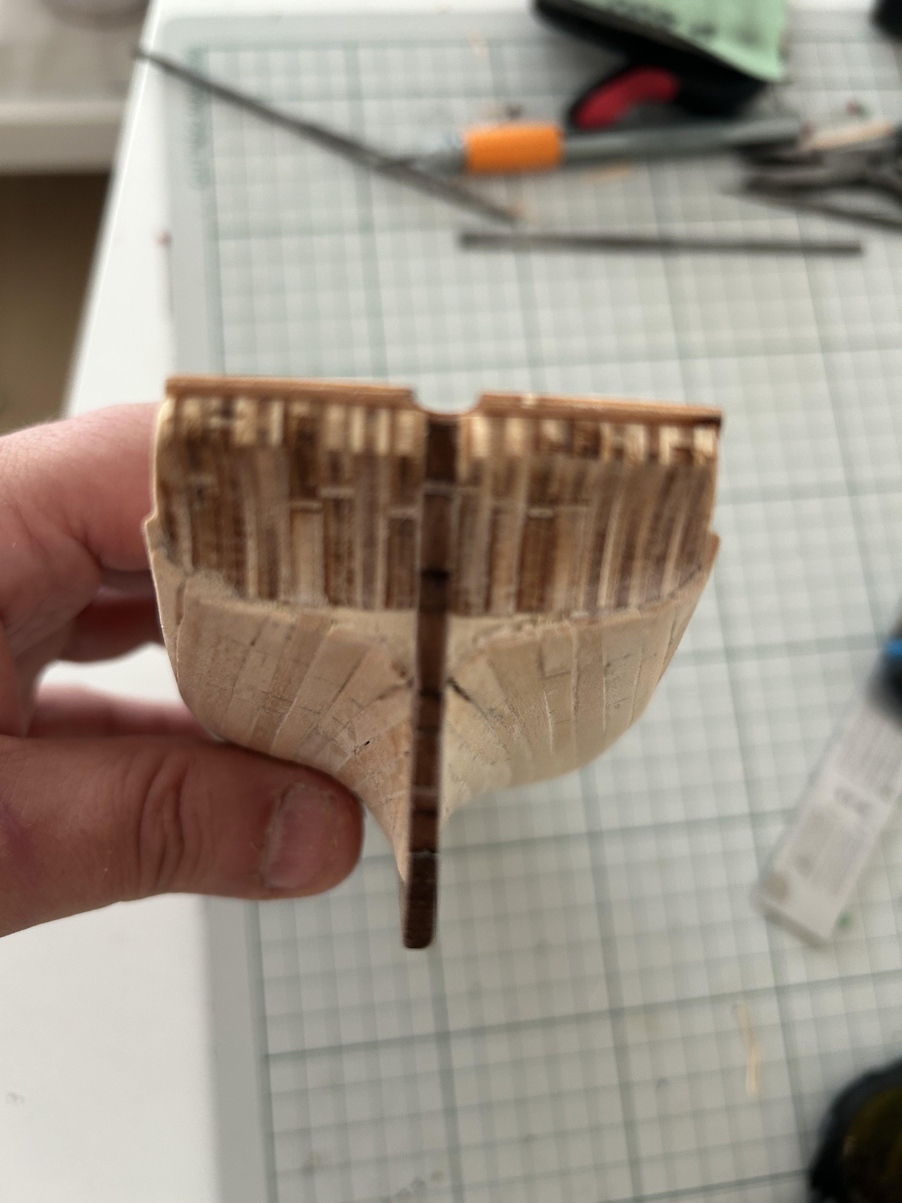

Conclusion.

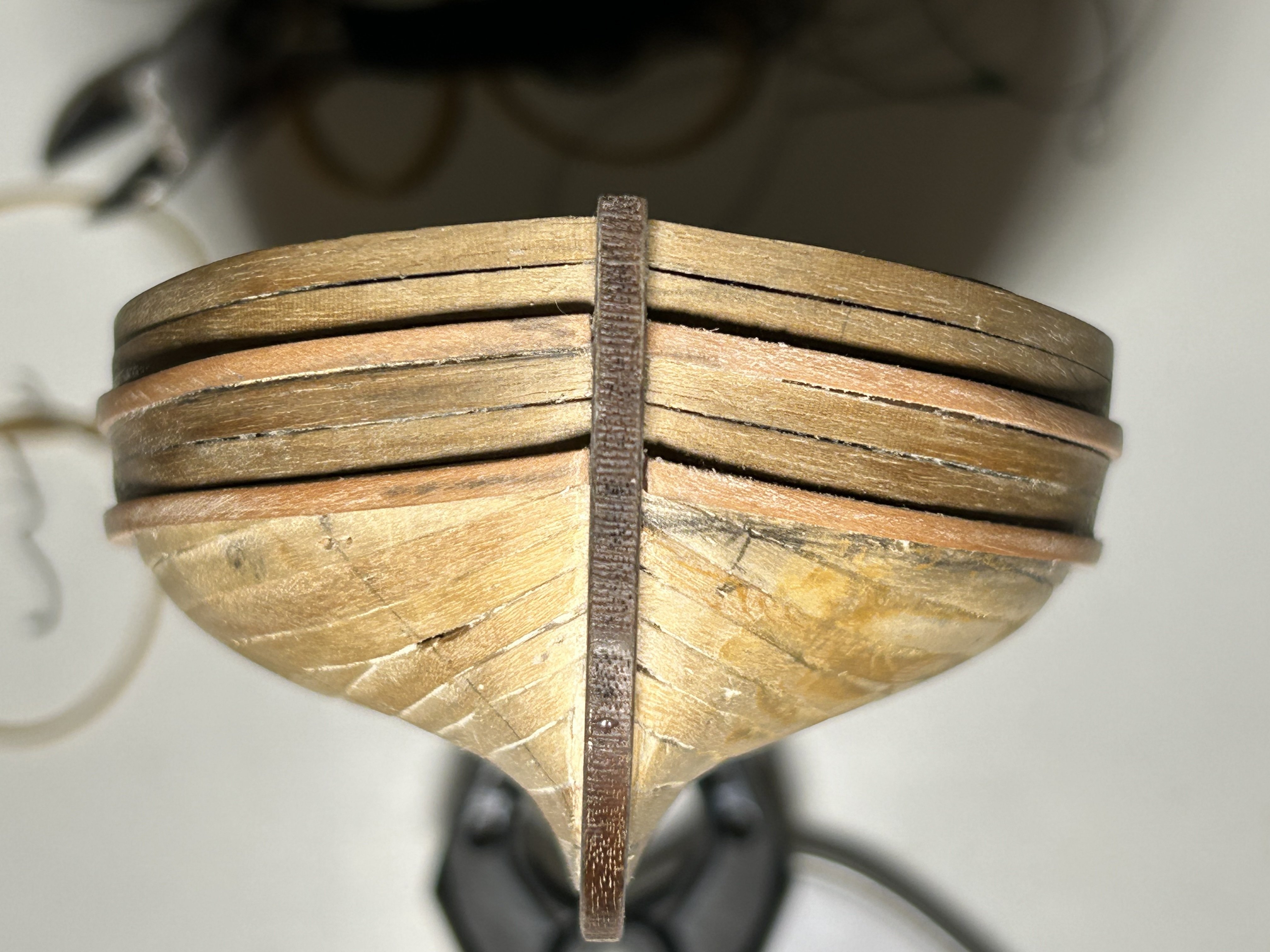

Now I finally understand what those curves mean and why it makes sense to bend the planks in plane before putting them on the hull.
I’ve learned both the good and the bad sides of the soldering iron'n'pipe magic.
And I’m still terrible at shaping forms.
Task for next time: buy some balsa and fill at least two forward sections.

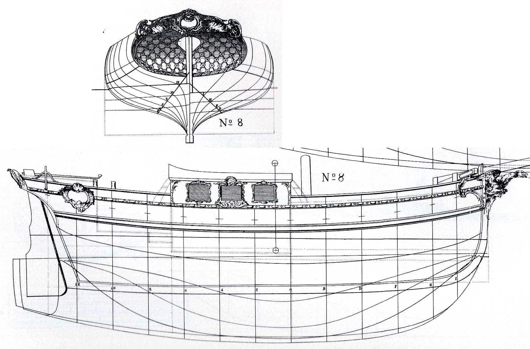

Bob, this is another part of Swedish history....

Are you familiar with the Chapman drawings Gretel is based on?

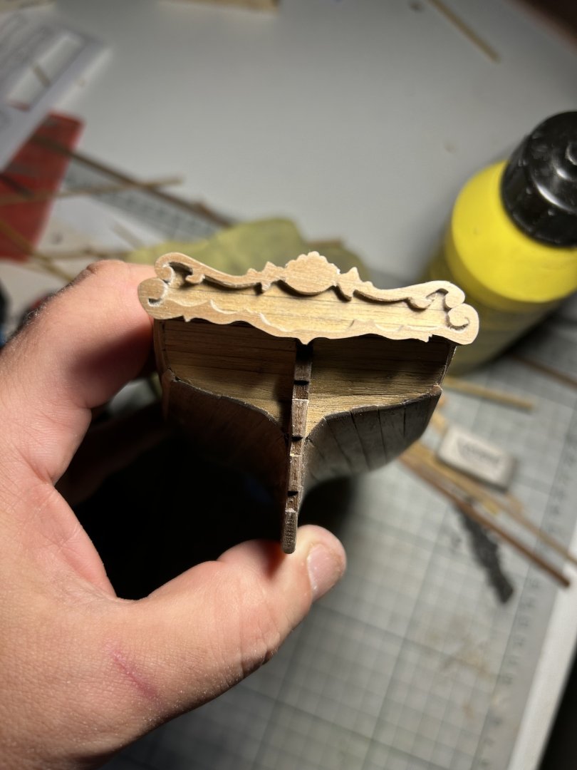

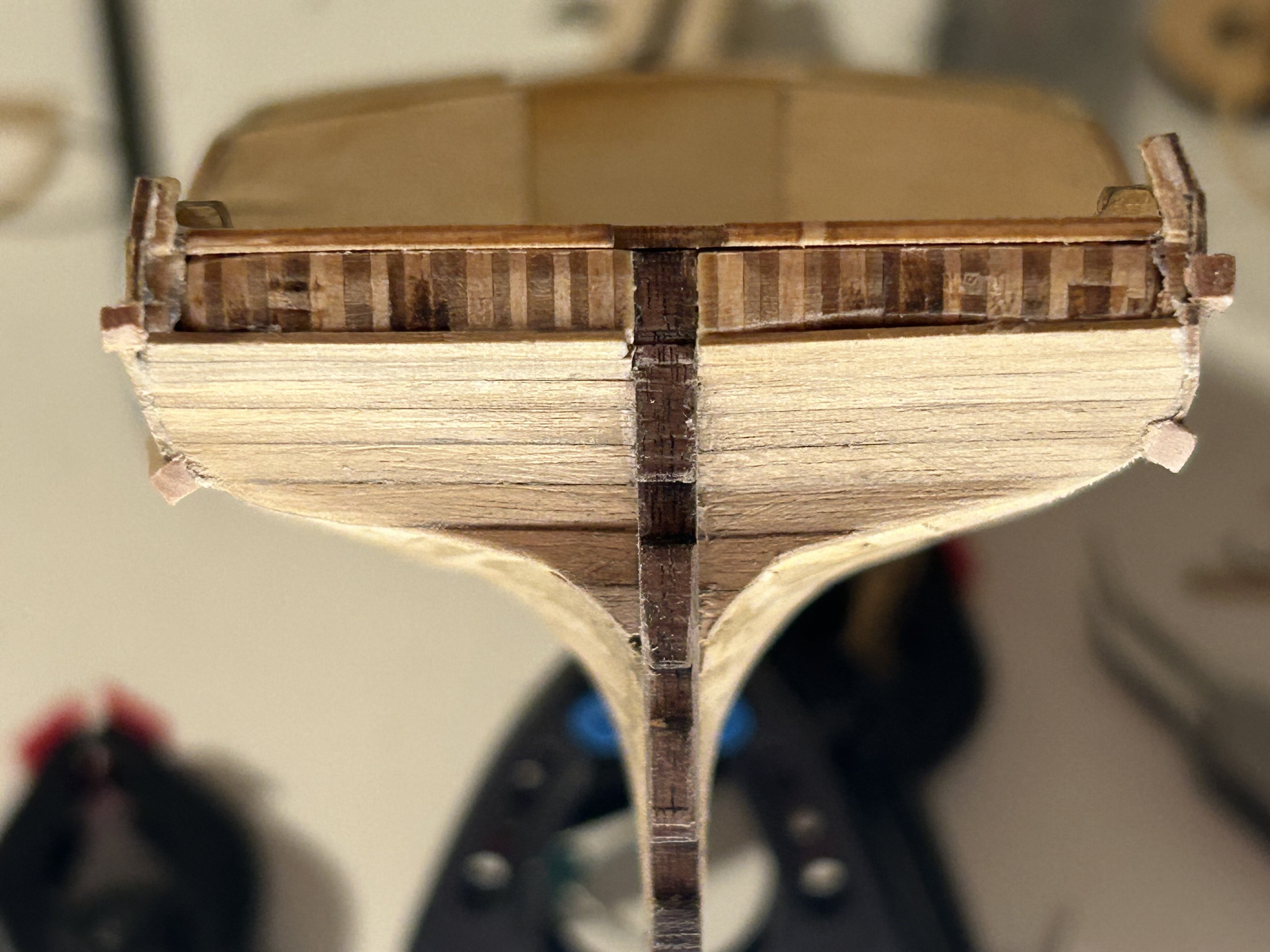

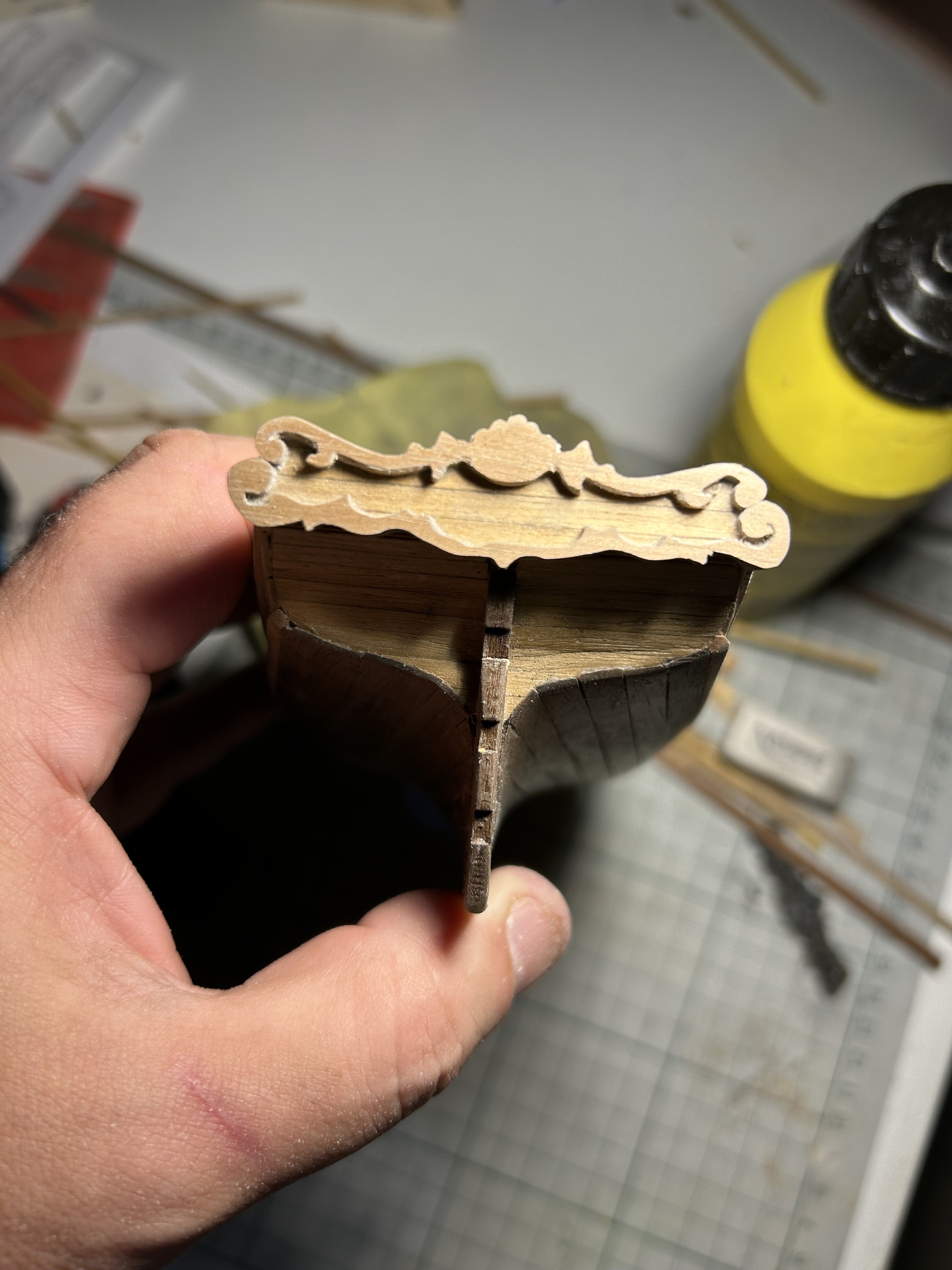

There's a stern for you.
One little tip for that Mamoli casting.  It's way too thick.  It can be sanded way down without breaking into the carving.
