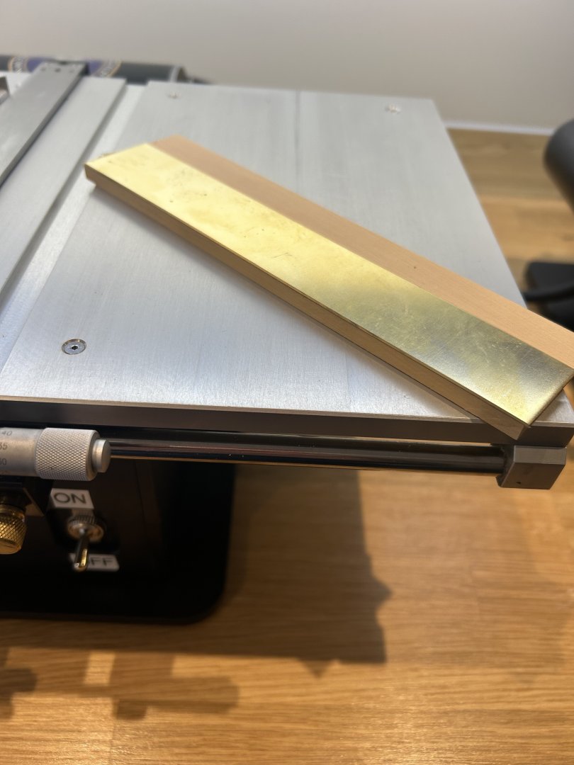

Hi Mark I too have found this problem so I now cut my own through my table saw.  I'm currently using 2.3mm width x 1mm thickness brass and the only way I could achieve this was by cutting it myself
Fine-toothed HSS, the thinner the stock, the thinner the saw-blade should be to avoid 'hooking'. It sounds strange, but sometimes running the blade the wrong way around gives better results with thin stock (same for piercing saws).
It can be also a good idea to stick sheet-metal to thin plywood or thick cardboard to reduce bending and hooking.

 Ken, you can use 2-sided tape for this. The wood is only used as a backing to help keep the saw blade from distorting the edges of the brass along the cut edge. You don't need any 'adhesive'. That might make it difficult to easily remove the brass from the wood. FWIW, the hardness of the brass is kind of important to. You want something semi-hard to hard. Dead soft brass will likely roll its edges along the cut even if backed by wood.

tmj has hit the nail on the head I use a reinforced double sided tape.  The problem is getting the tape off of the back of the freshly cut brass without bending or twisting it.  I found that if I put the complete cut (the thin strip of brass still attached to the wood) into a saucer of alcohol  - not whiskey ;) but IPA it just melts the adhesive and the 3 components separate very easily.
