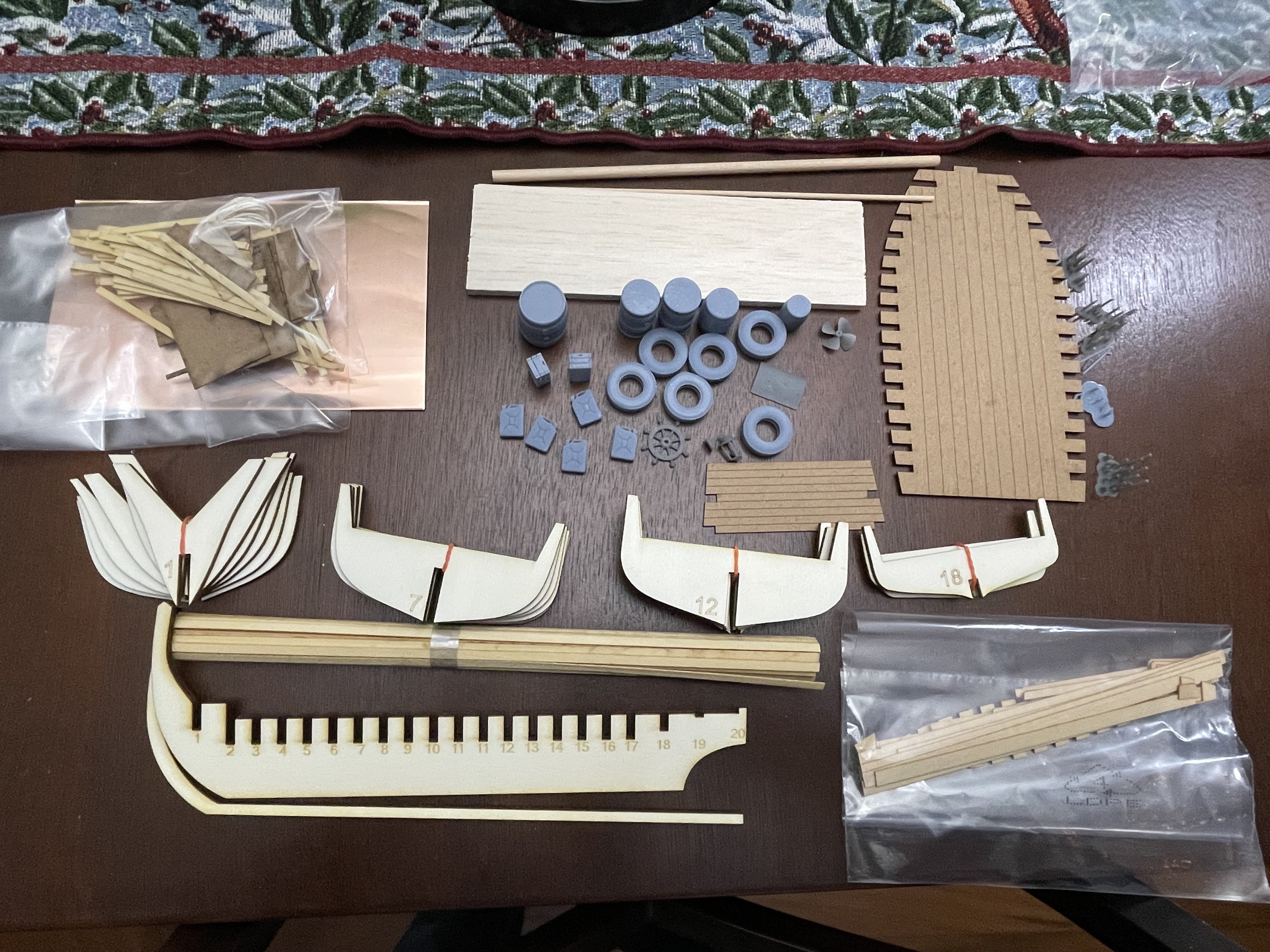

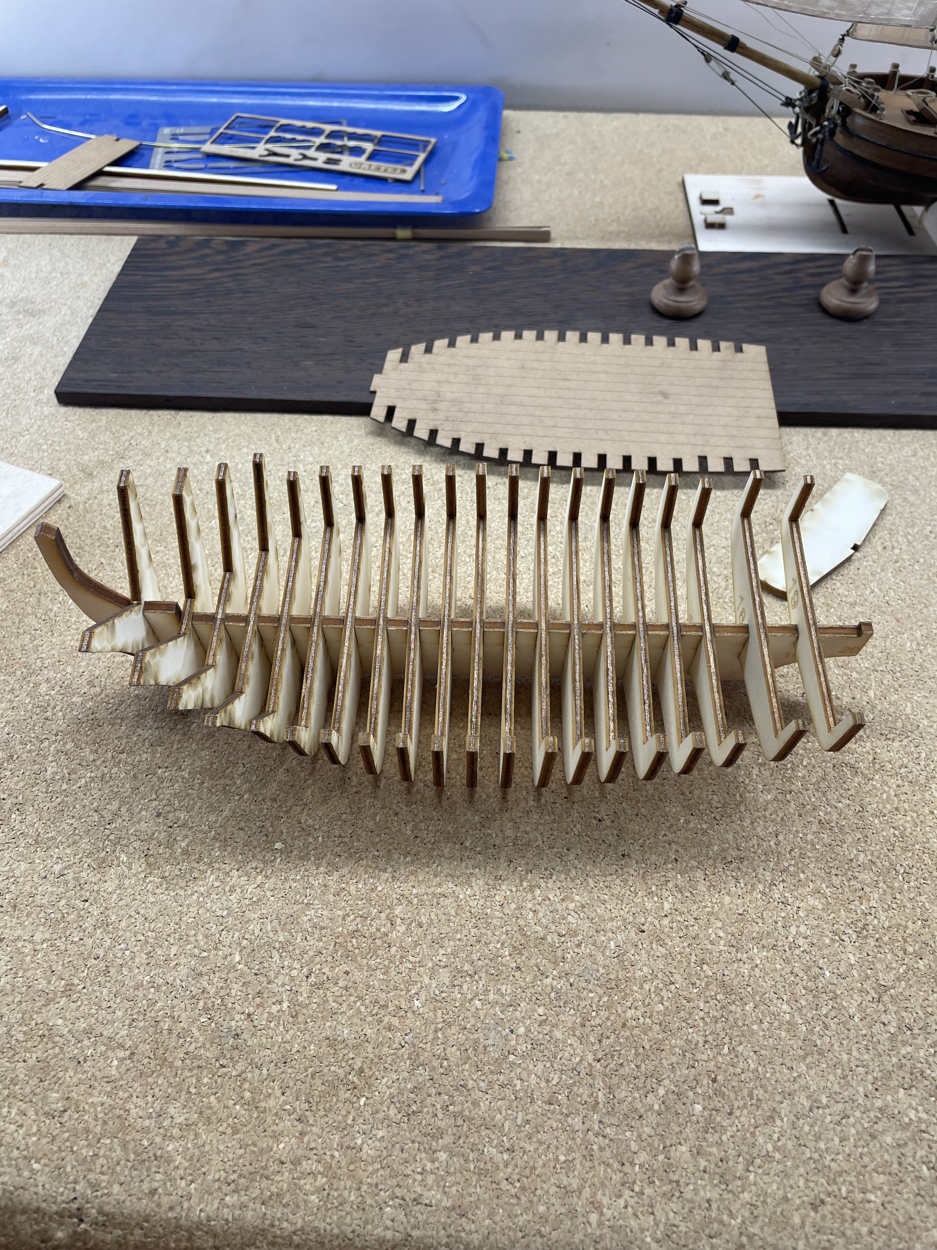

This I believe is a mid 1900 German fishing boat. Skills of their trade were passed down through generations. This kit is a part of a diorama that I don’t intend to build. Hopefully I can furnish it with proper equipment. I would like to try the weathered look.
The frames and spine are plywood. The planking seems to be .5 mm basswood, the was laser cut. It has 3d printed tires, drums, fuel containers and small crates. The captains wheel, rudder and light are also printed.

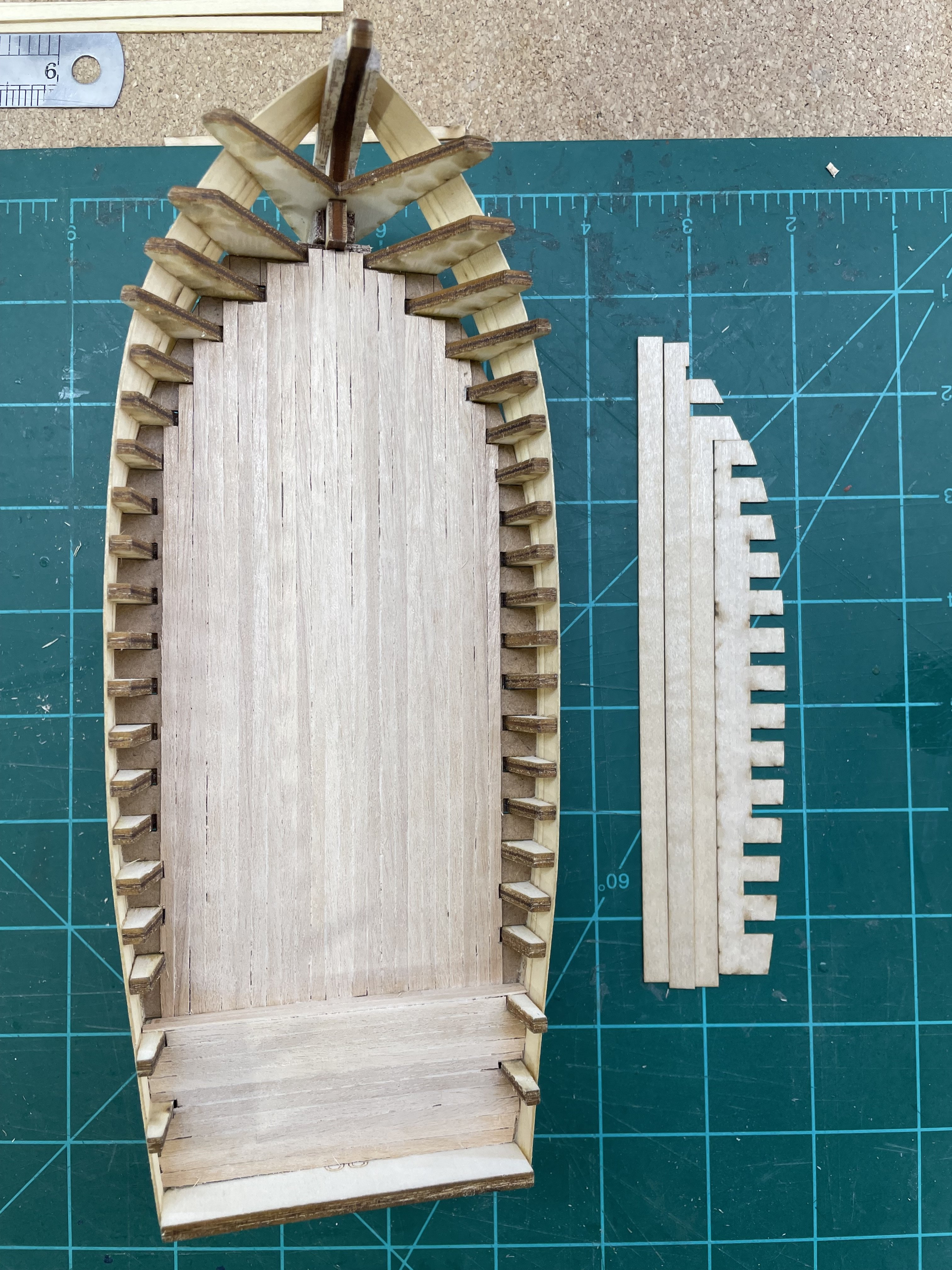

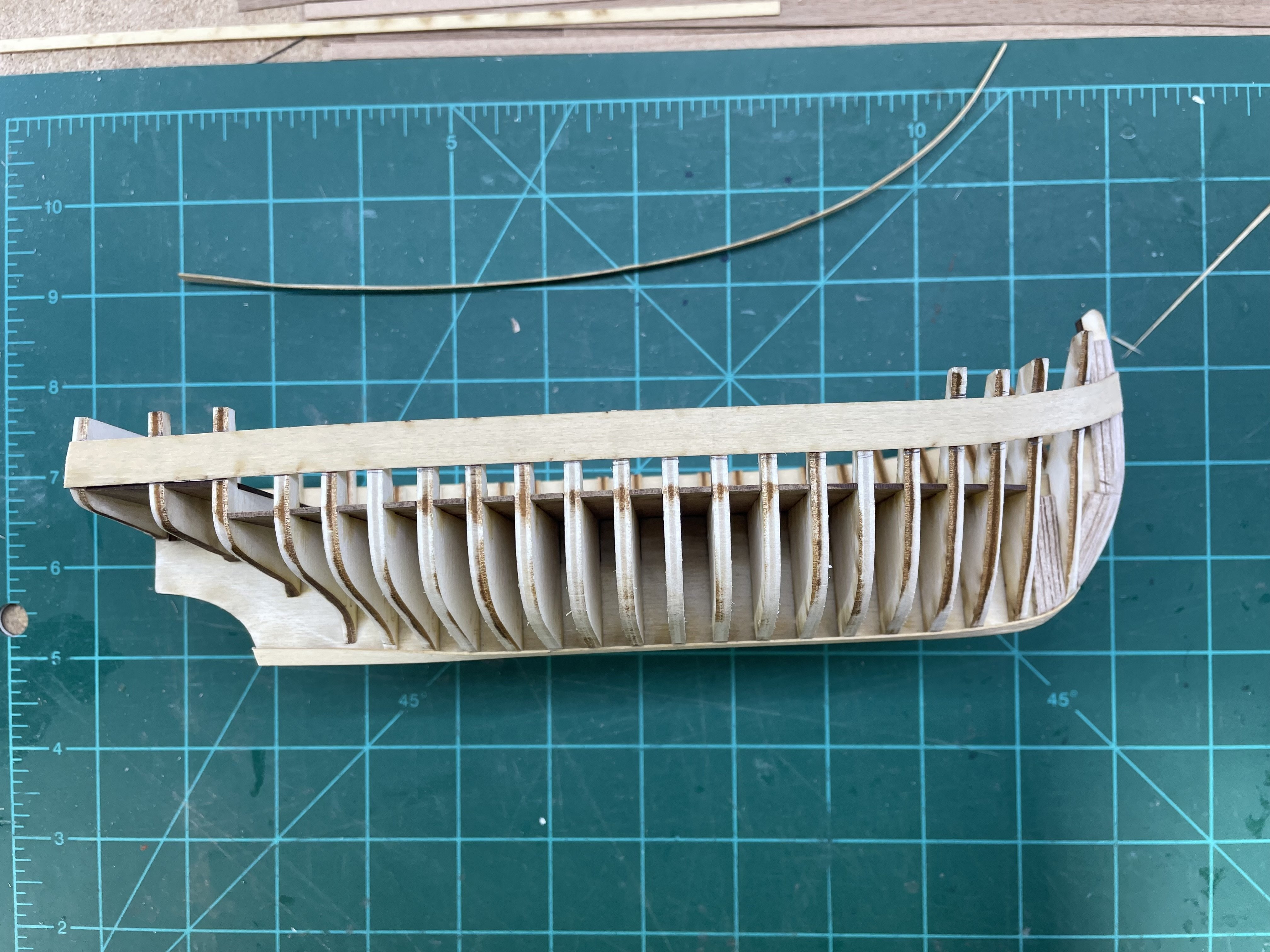

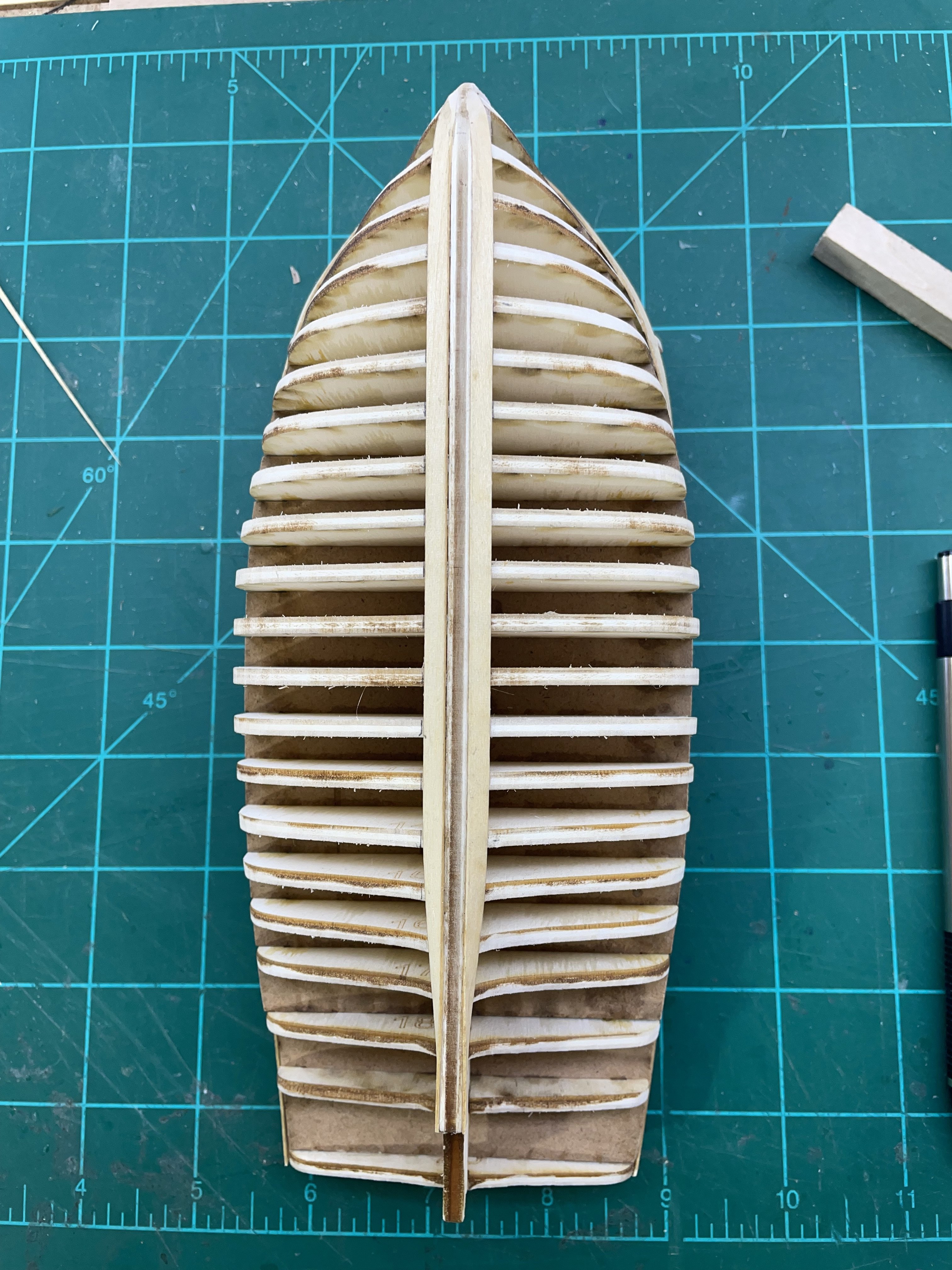

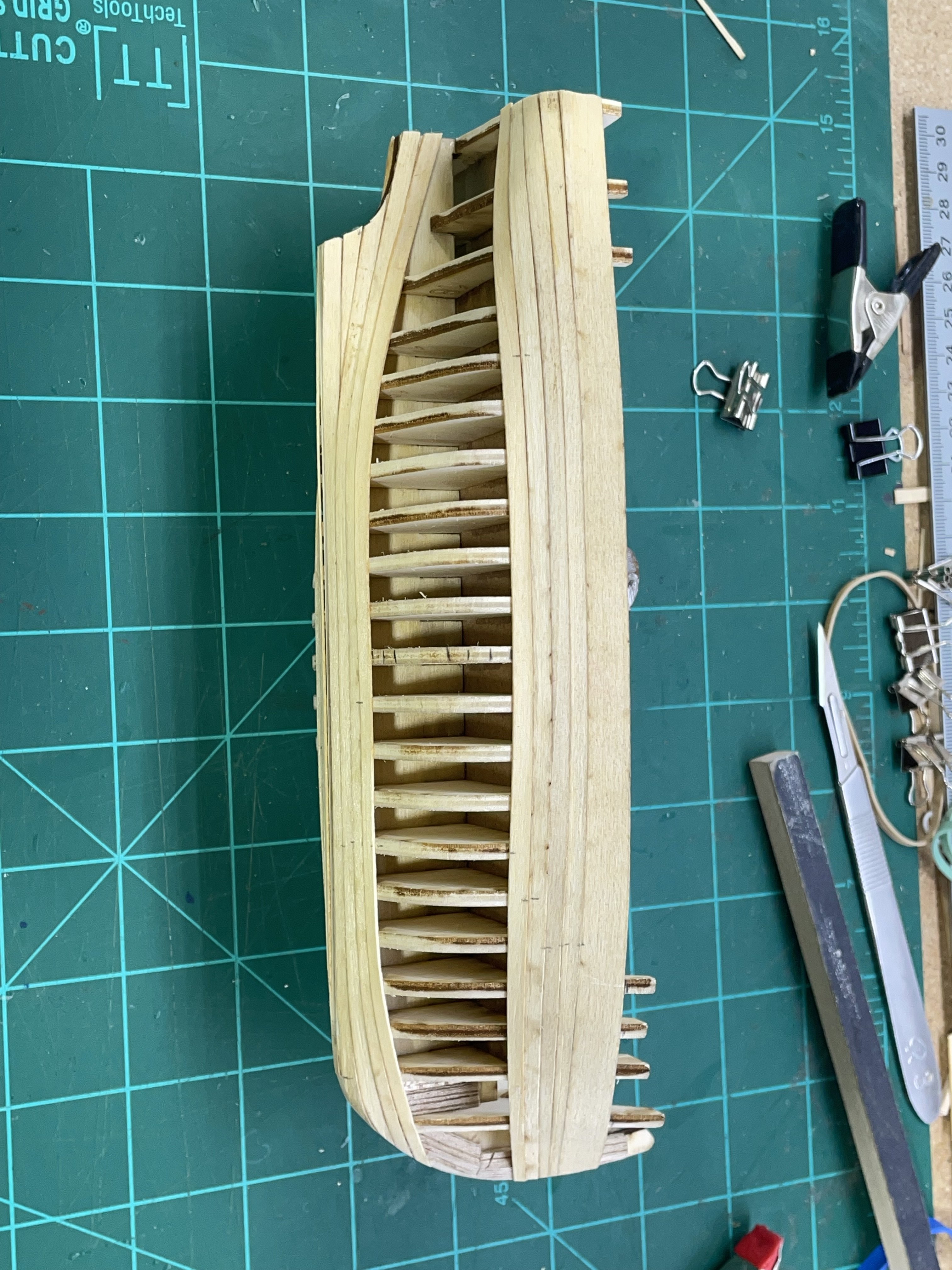

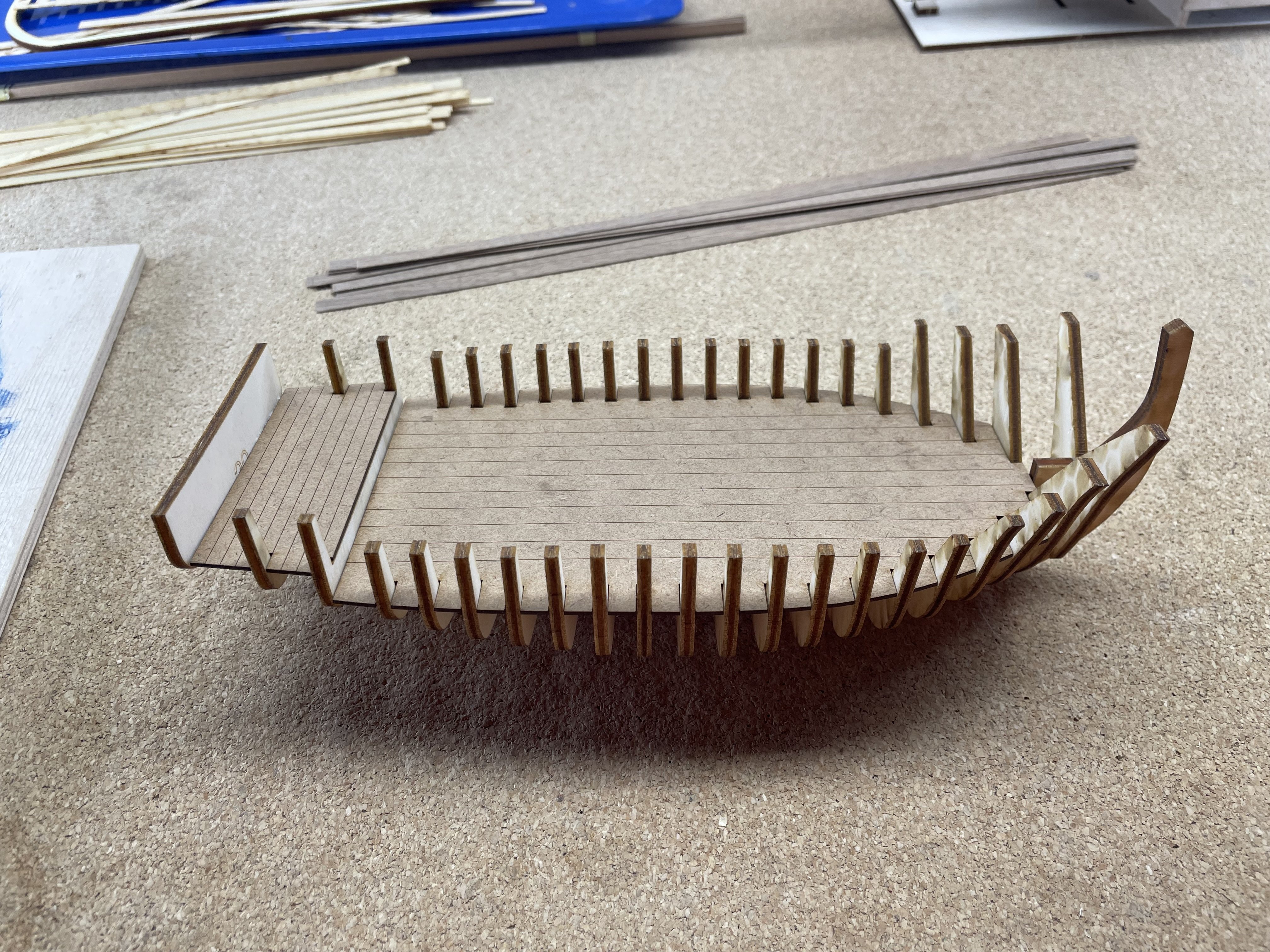

The planking has begun. On my last build I glued the false keel on before I faired the hull. Resulting with sanded down areas of the keel. Which may it harder to fit a pedestal on it. This time I left it off. I built up the bow to give a little more gluing surface.
With just these four planks on it may look like I know what I’m doing. But now the guess work begins. I’m going to try to do a little math but that doesn’t mean I’ll listen to it.
Nice start!
How big is the model? It looks like it's around 10 inches long? The large number of closely-spaced bulkheads is nice, too often you see so few widely-spaced ones that planking can be a challenge.
Thanks Jacques, It’s 8 1/2” long. And yeah the close bulkheads are nice. The planks are going on easy but because they are so thin there will be little room for error. I can already see through them before sandpaper even hits them.

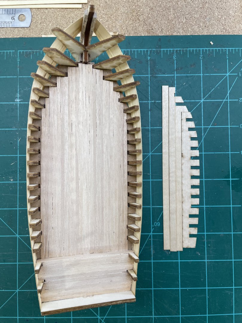

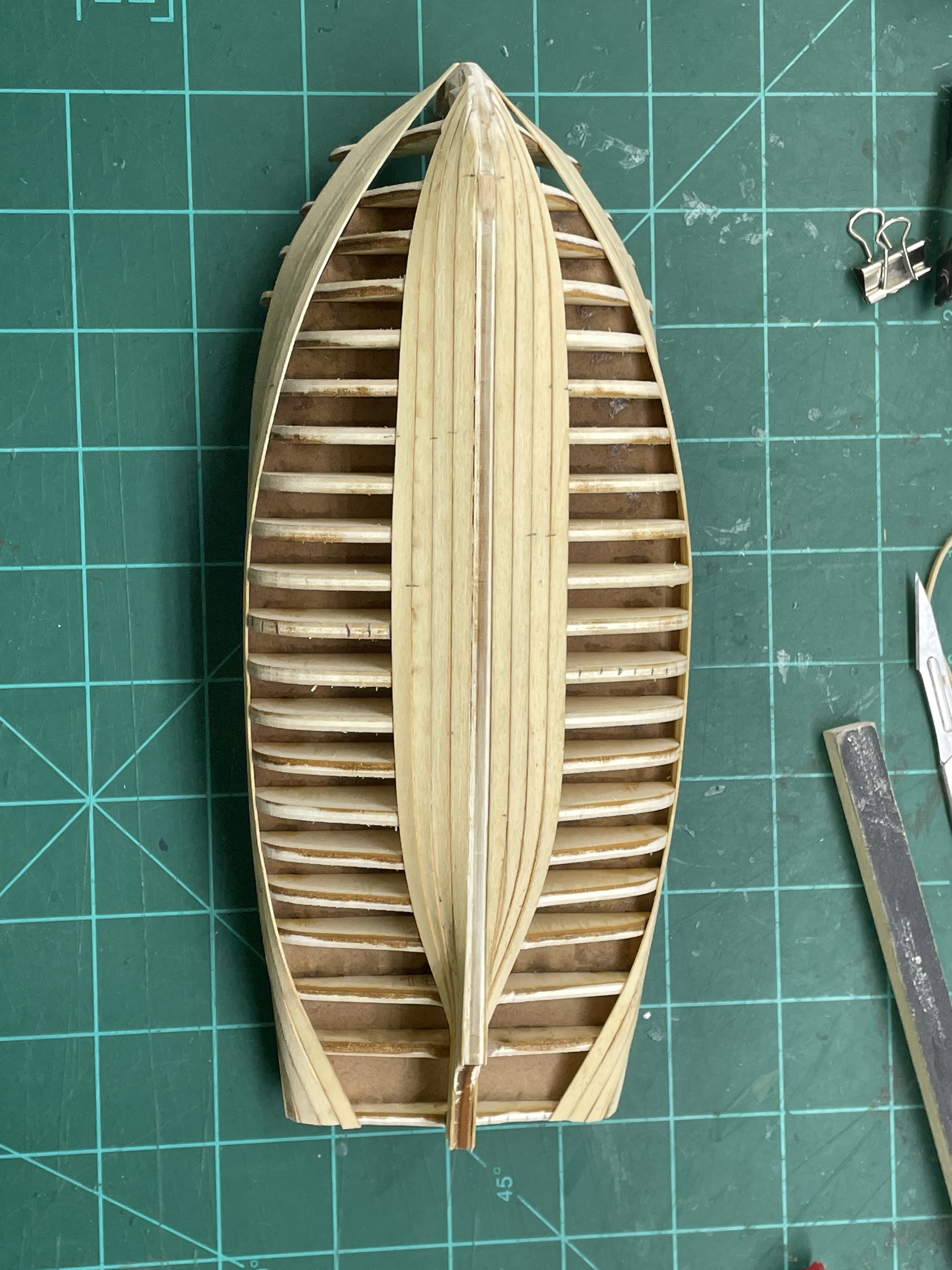

Besides working on the planking I laid the planks on the deck. I decided to use a smaller width than what was provided with the kit. That’s some of it on the right.

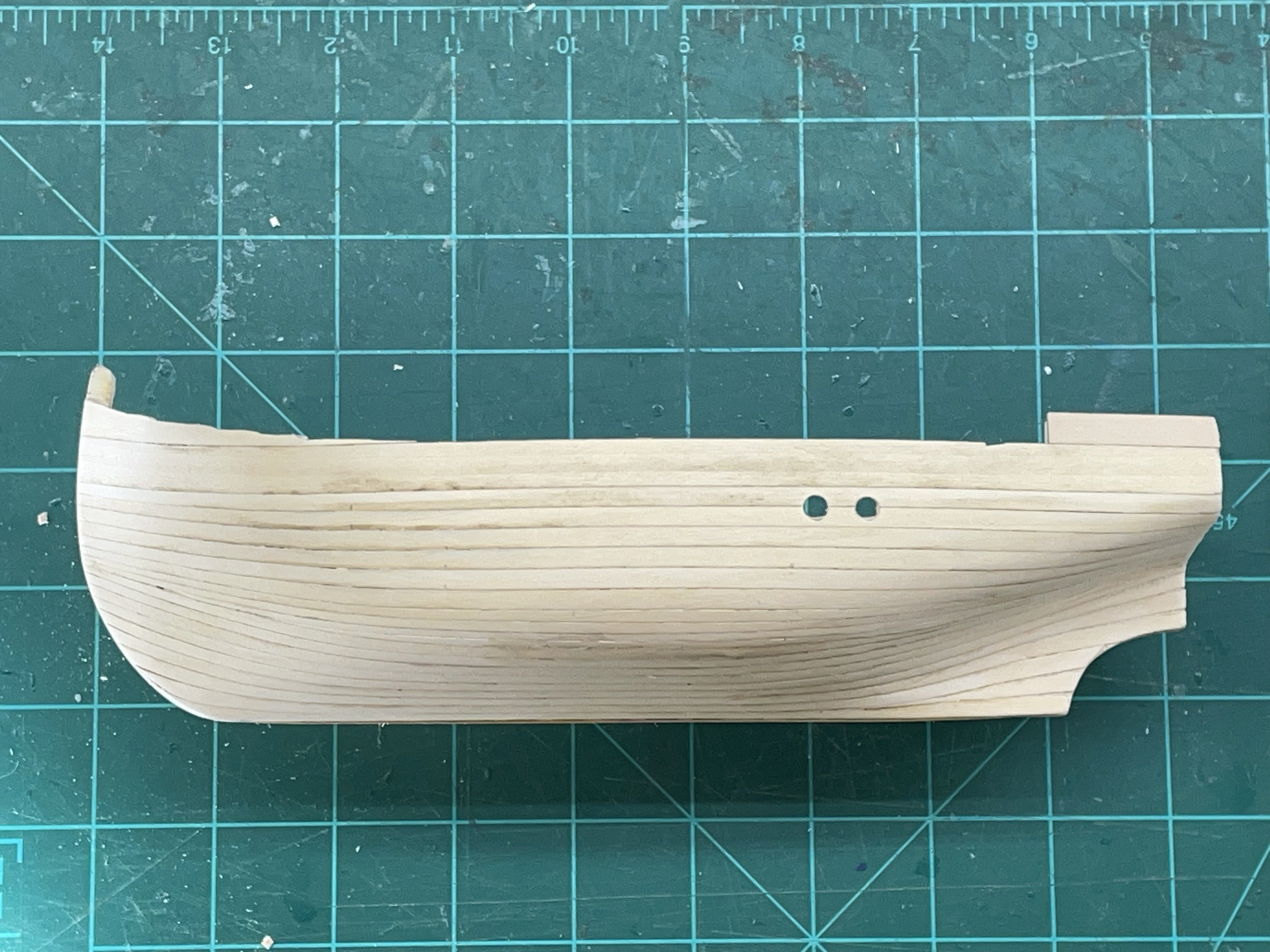

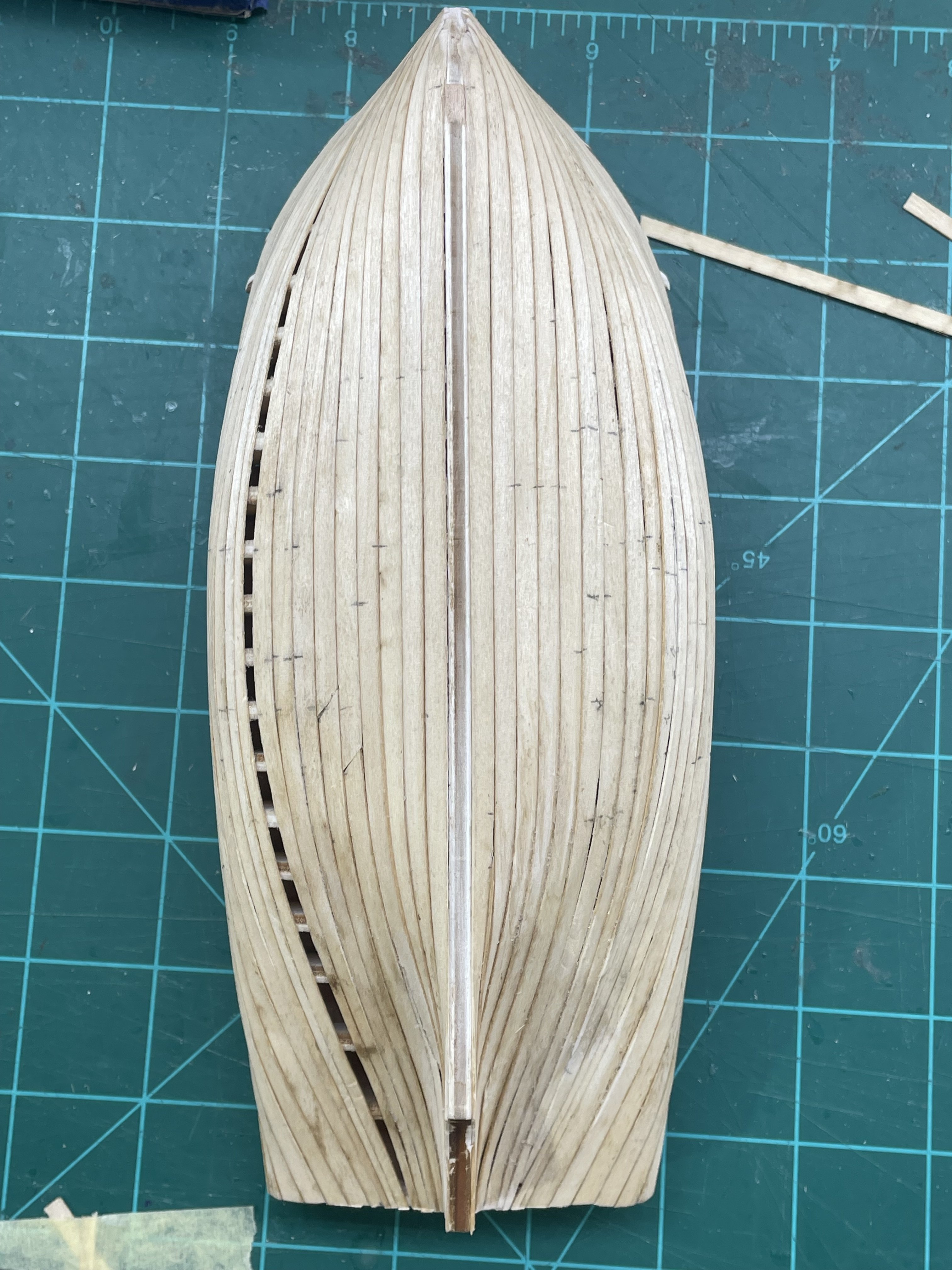

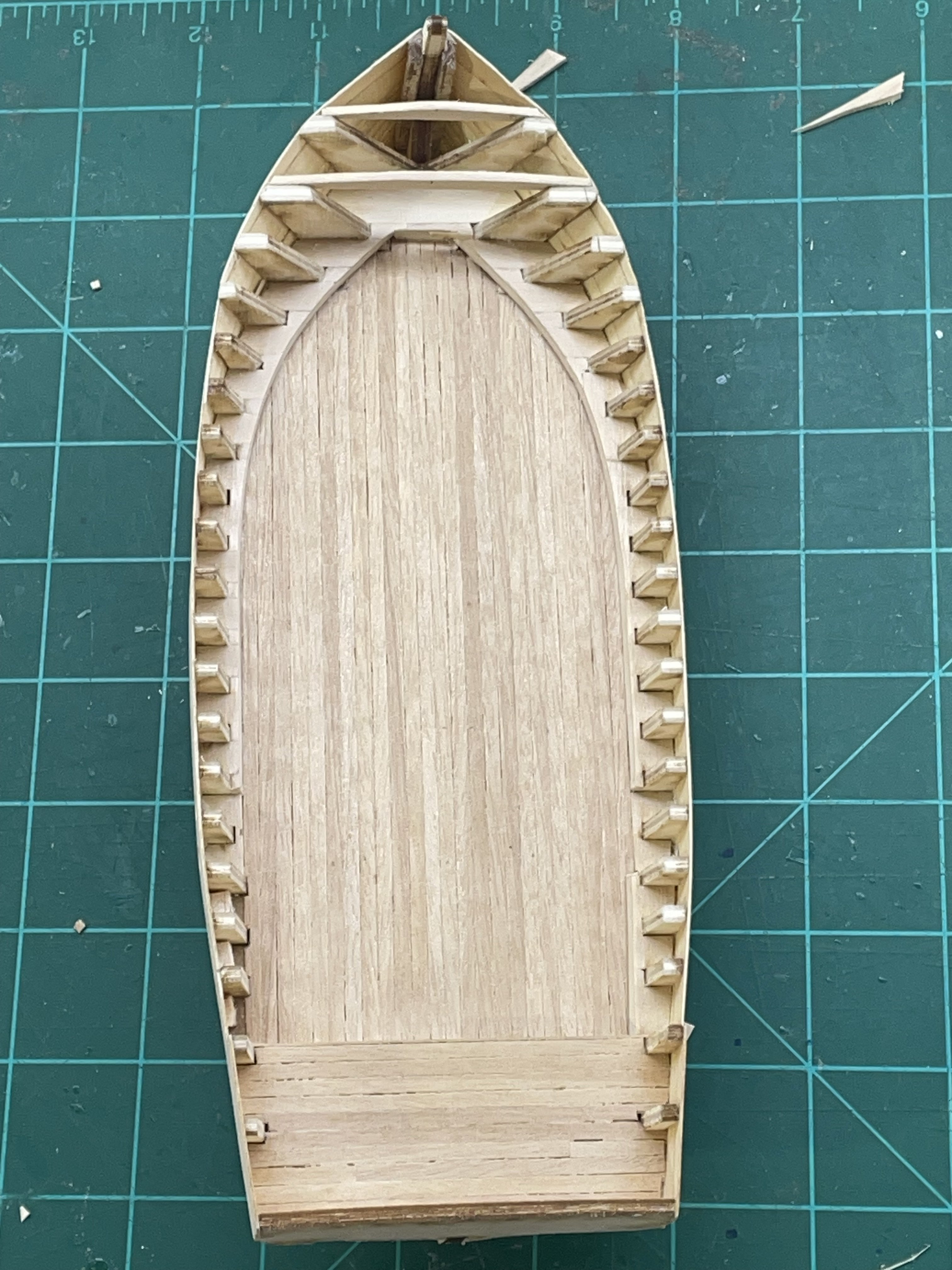

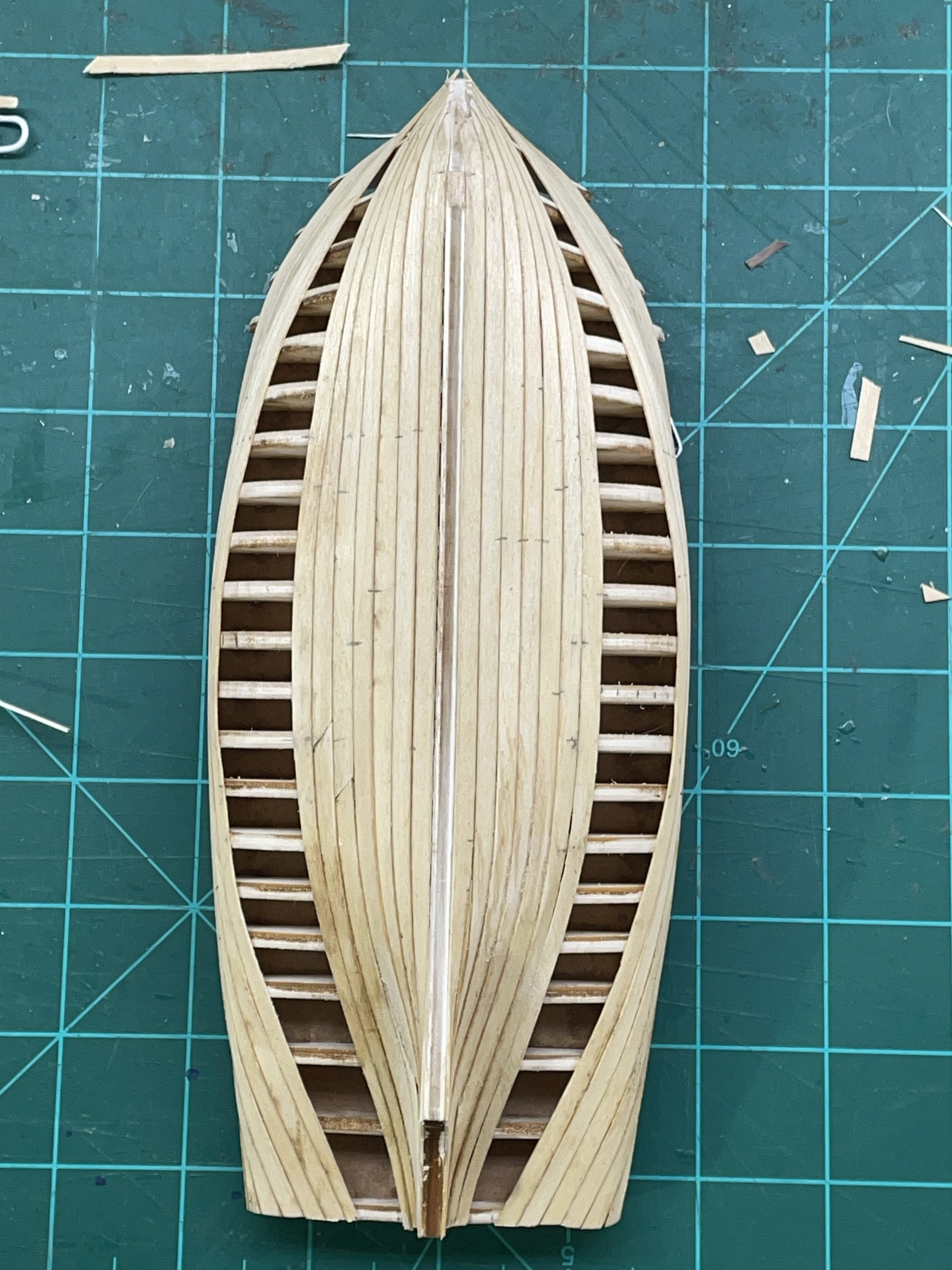

I’m about halfway completed on the planking.
The way I chose to plank , it can’t be the best way. But it only uses second grade math. Of course, it’s not done yet. I just measure the longest bulkhead and divide it by 4, (my plank width ). Take that number, that I round to whole and divide it into the measurement of the first bulkhead at the bow. And that’s what I cut the taper at the bow end. I’ve ended the taper starting. #5 but the last few I went to #6. At the bottom, about the third plank, ( when it went past the first bulkhead and landed on the bow stem) I started tapering them also. It’s probably just this hull but it has stayed pretty consistent. There will be 4 or 5 planks with both ends pointy.
Looks really good Bryan! Keep an eye on how those port and starboard planks align with each other at the bow and the stern. Your math seems to be working well, however. You also sometimes have to ditch the math and go by eye alone! Math is perfect, but our human hand crafting methods... 'not so much'! If it were 'me', I'd put the next 'port' upper plank on first, then ditch the math for the starboard side. Make 'em look even on both sides and then proceed with the math again until things once again start to get out of alignment, then revert to the ol' eyeball once more.
Keep up the good work! You're doing a great job!
No arm bending needed here:-) That’s what I’m going to do. Thanks so much for the advice!

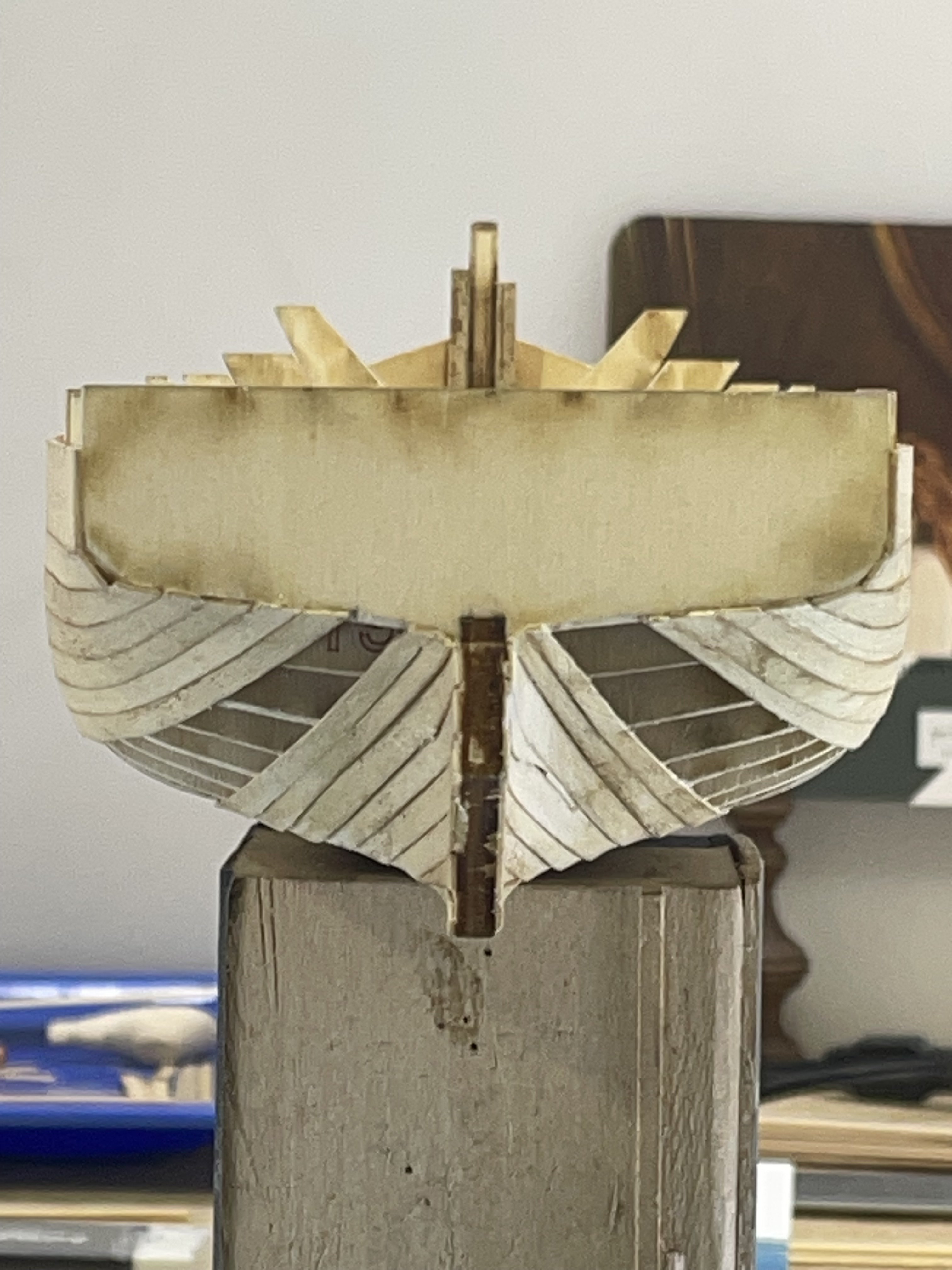

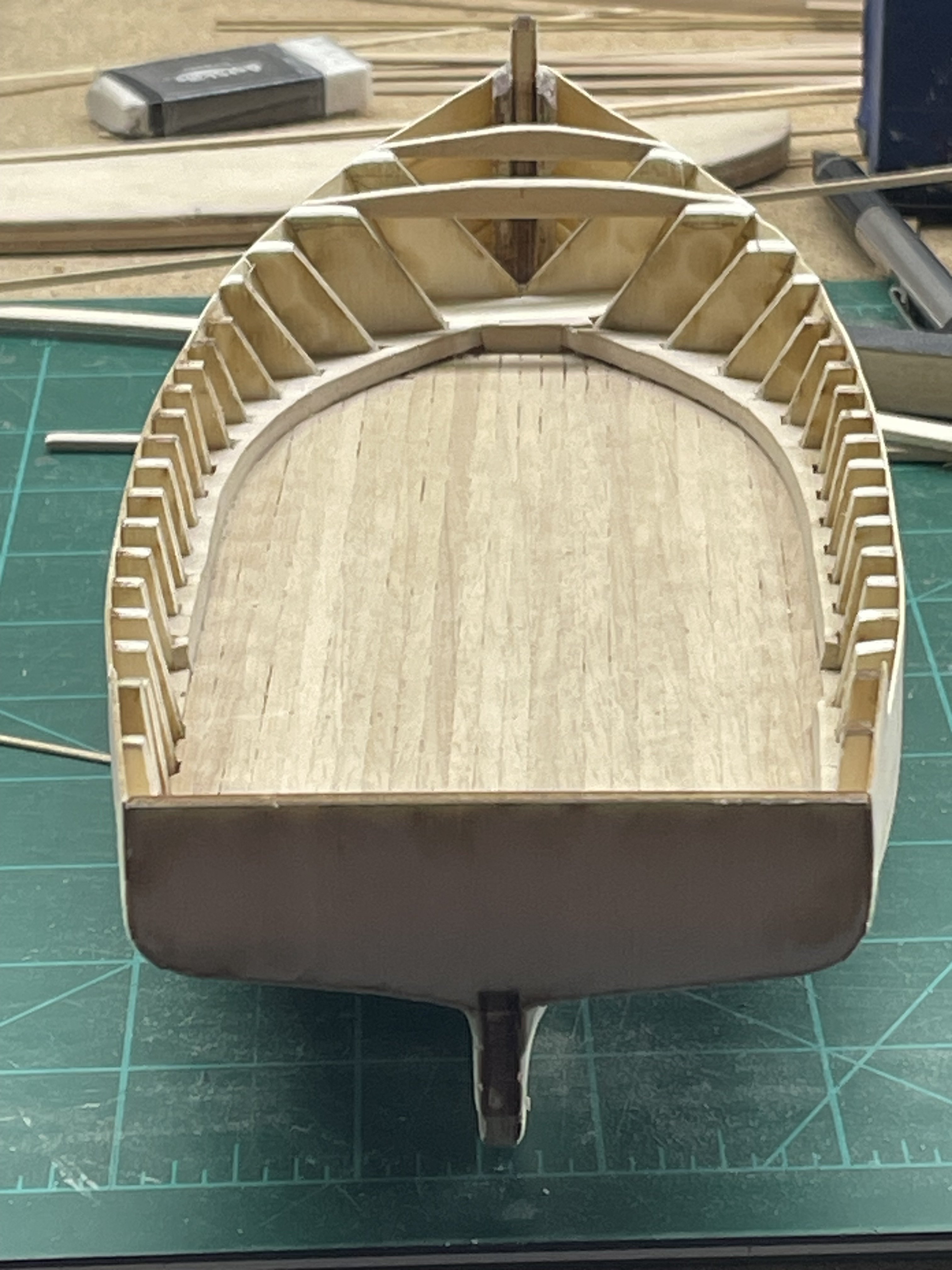

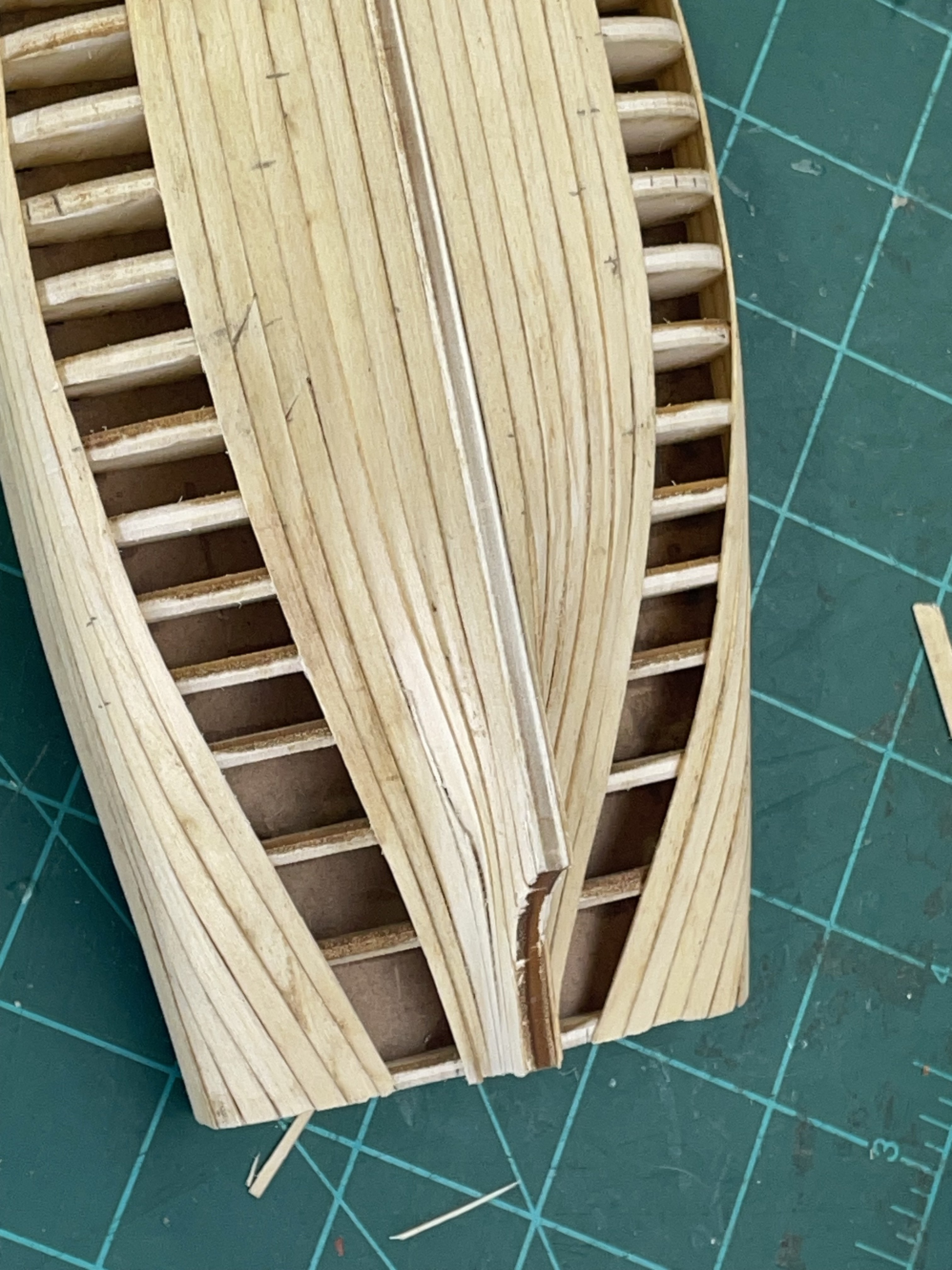

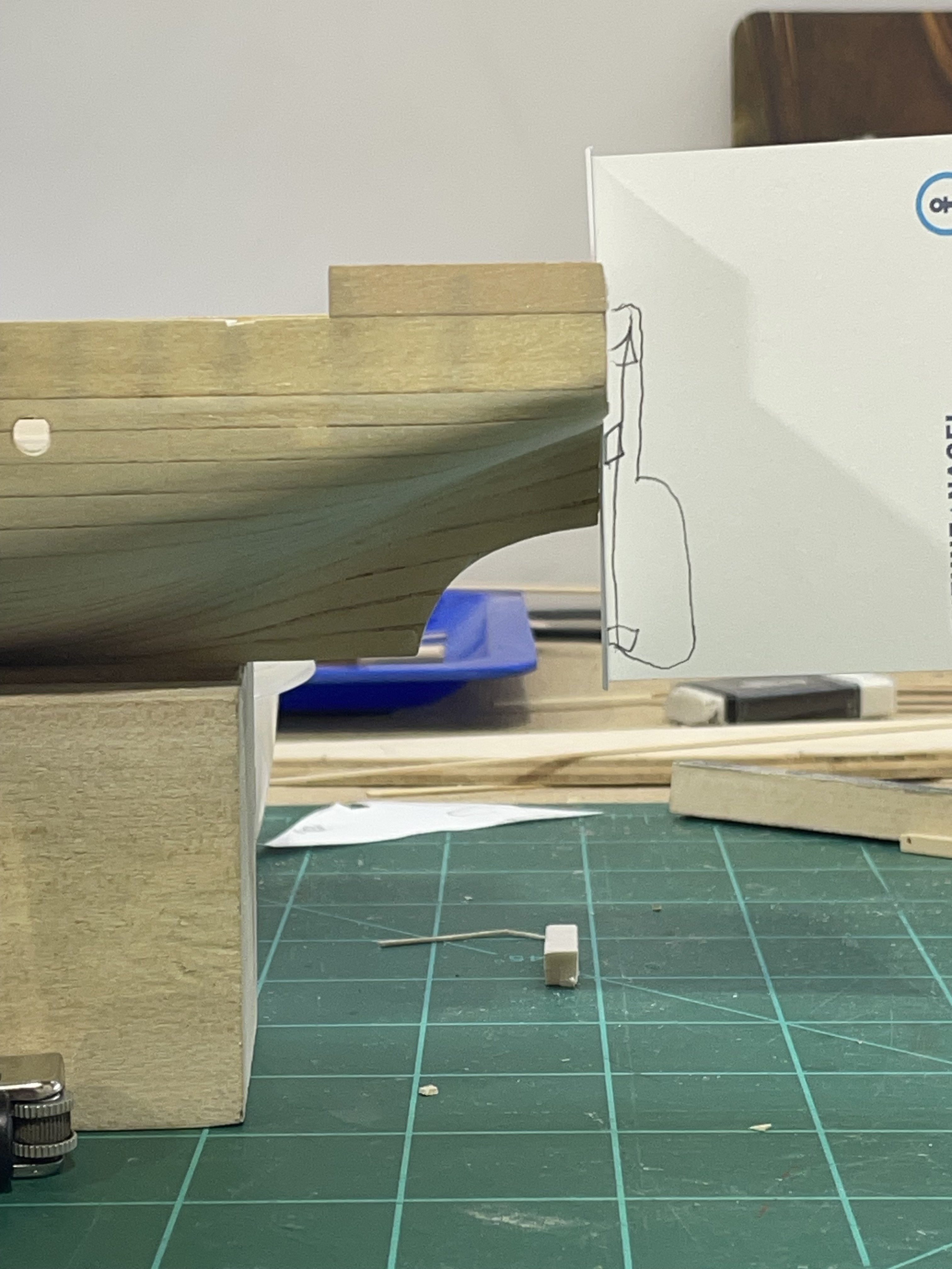

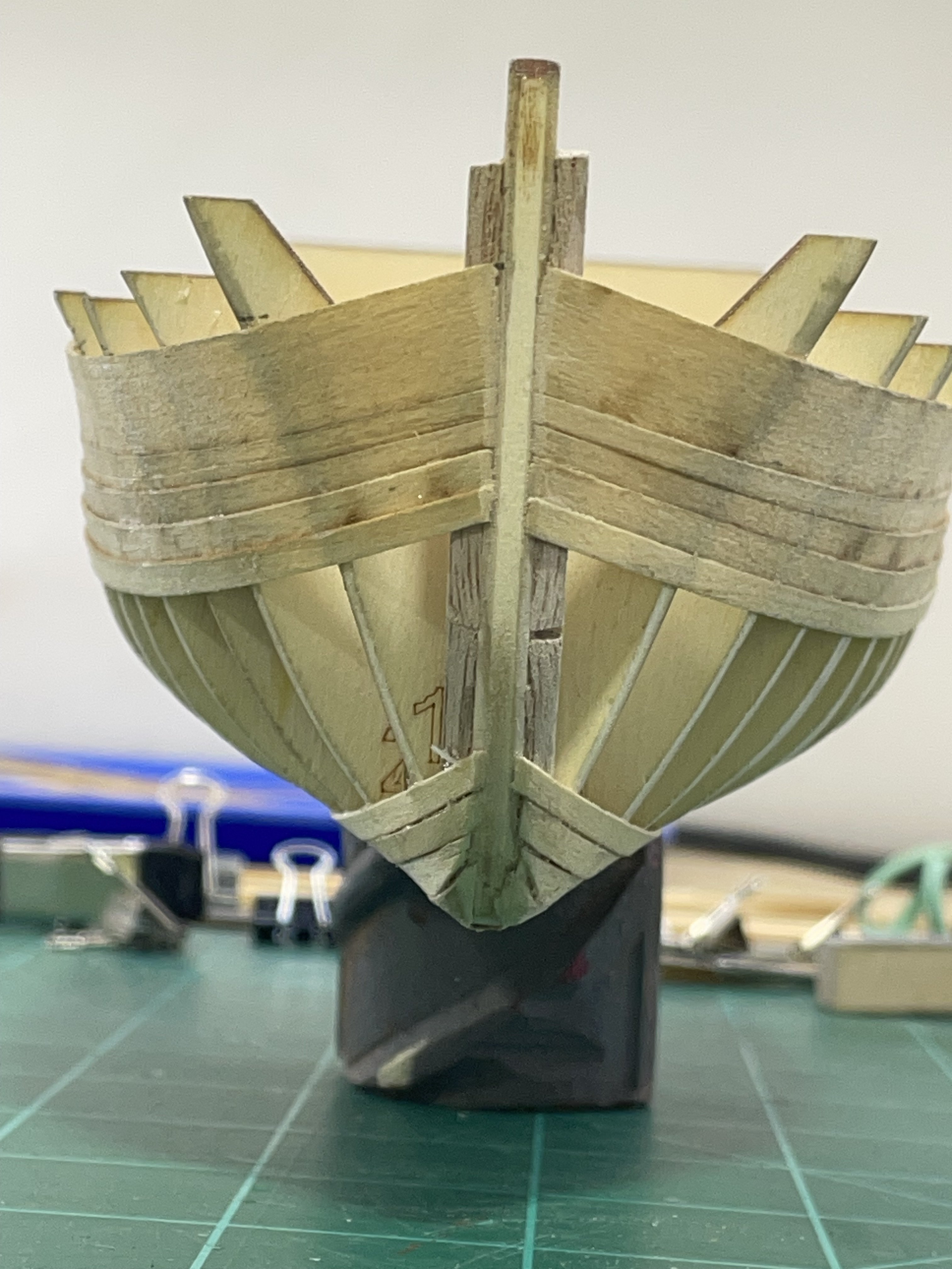

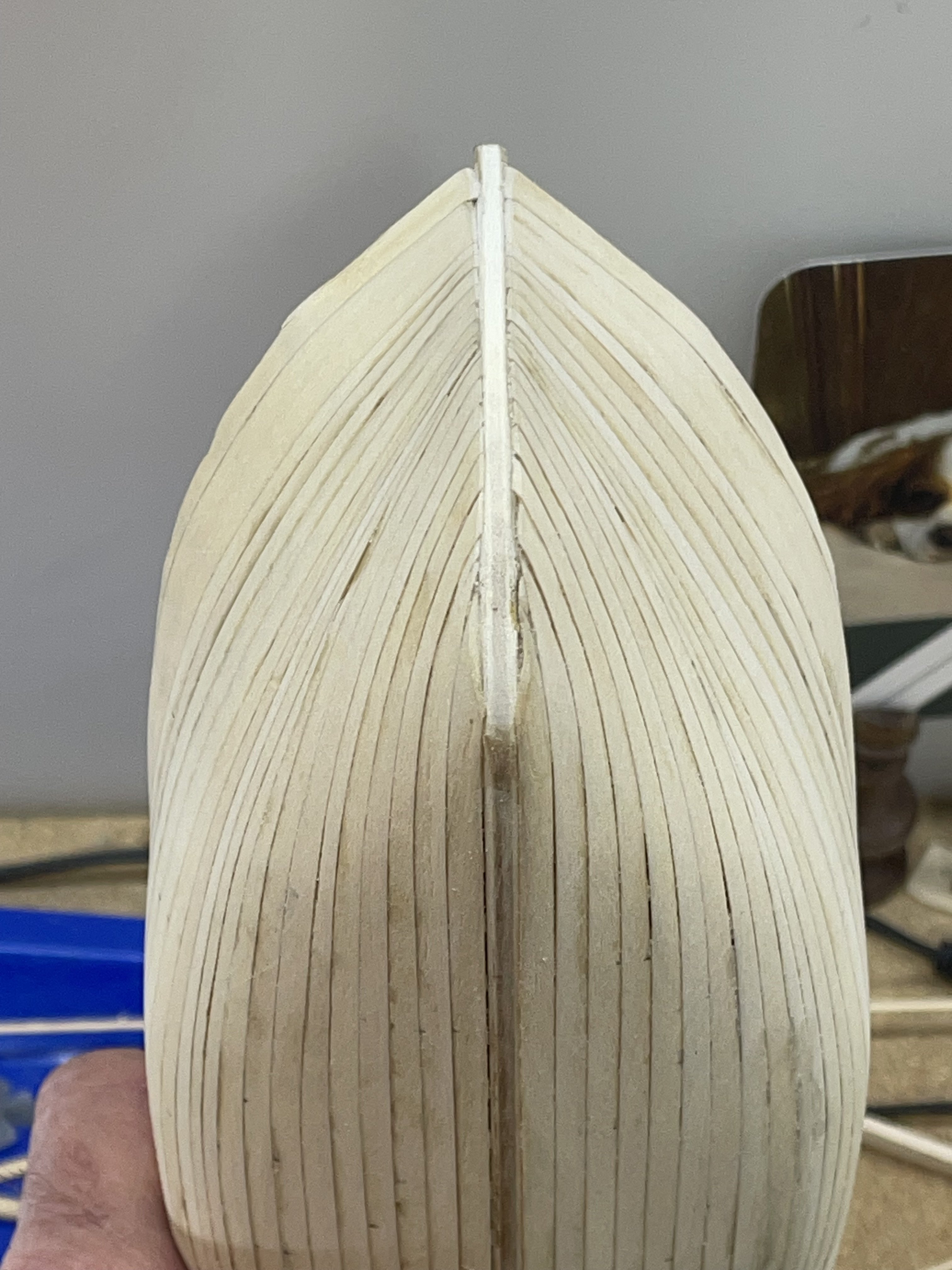

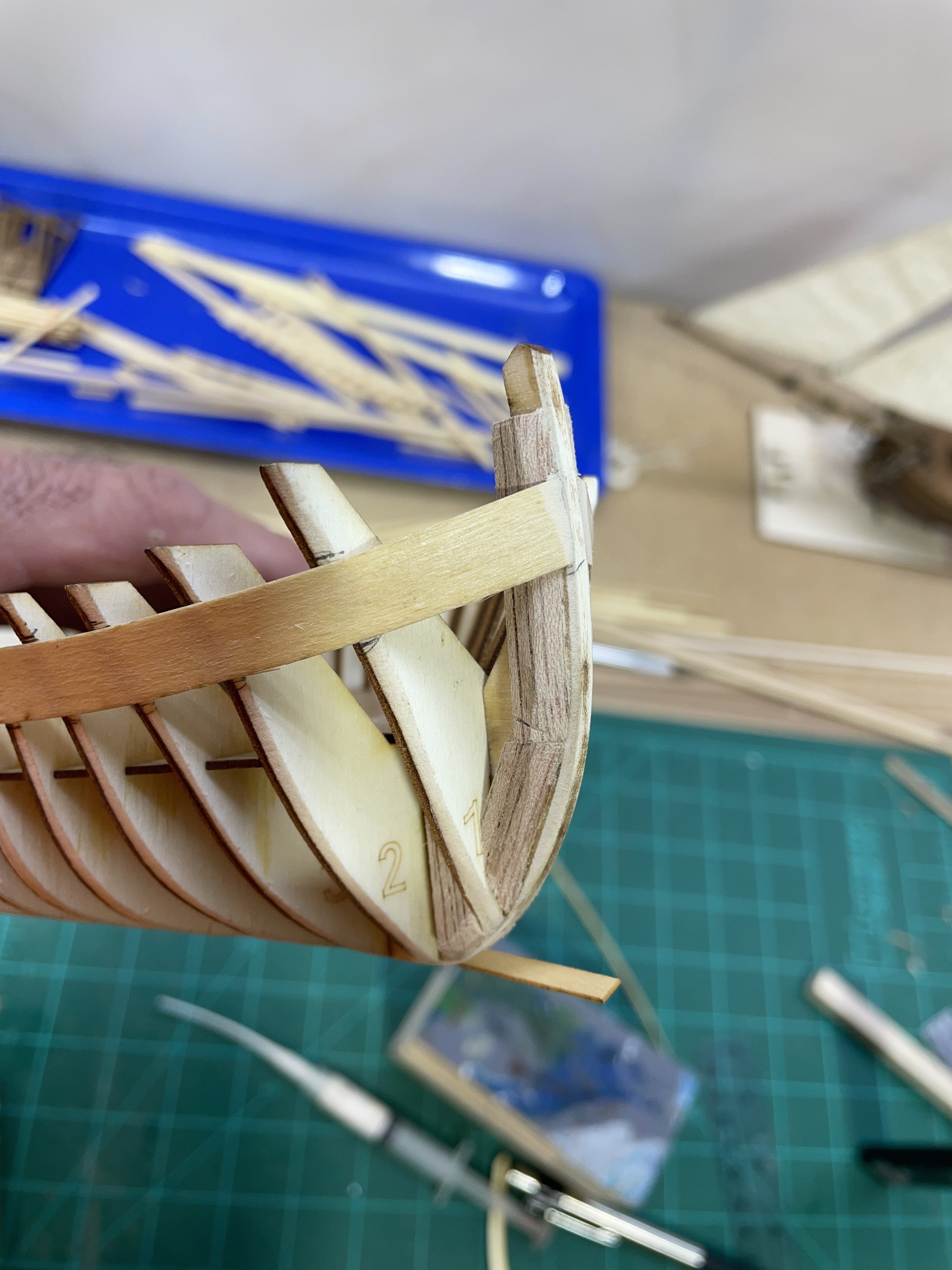

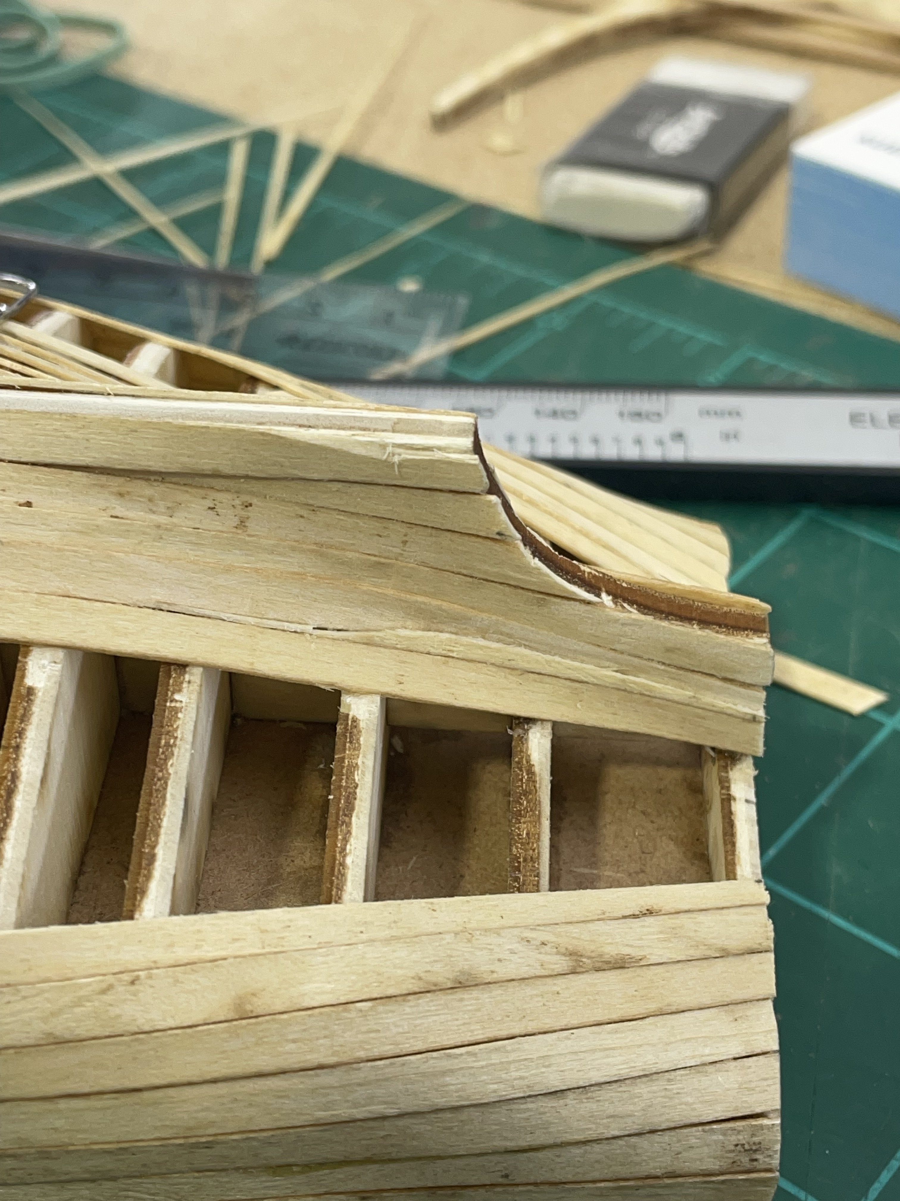

Last week I had a major distraction and I when to the Fischkutter to try to keep my mind off of it. Well, days later I was looking it over and saw my mind wasn’t on Fischkutter. I cut two planks off at the stern where I had clamped the plank on the deadwood too far up. In the YouTube video they  don’t plank the deadwood so the last few bulkheads just right angles with the spine. I would have glued some wood on these if I noticed it earlier before I faired the hull.IMG_6468.thumb.jpeg.9da7a909e6fd61126f2236c27425f39a.jpeg
This still left a sunken spot.
I just filled it the best I could with a splitter and called it unique:-)

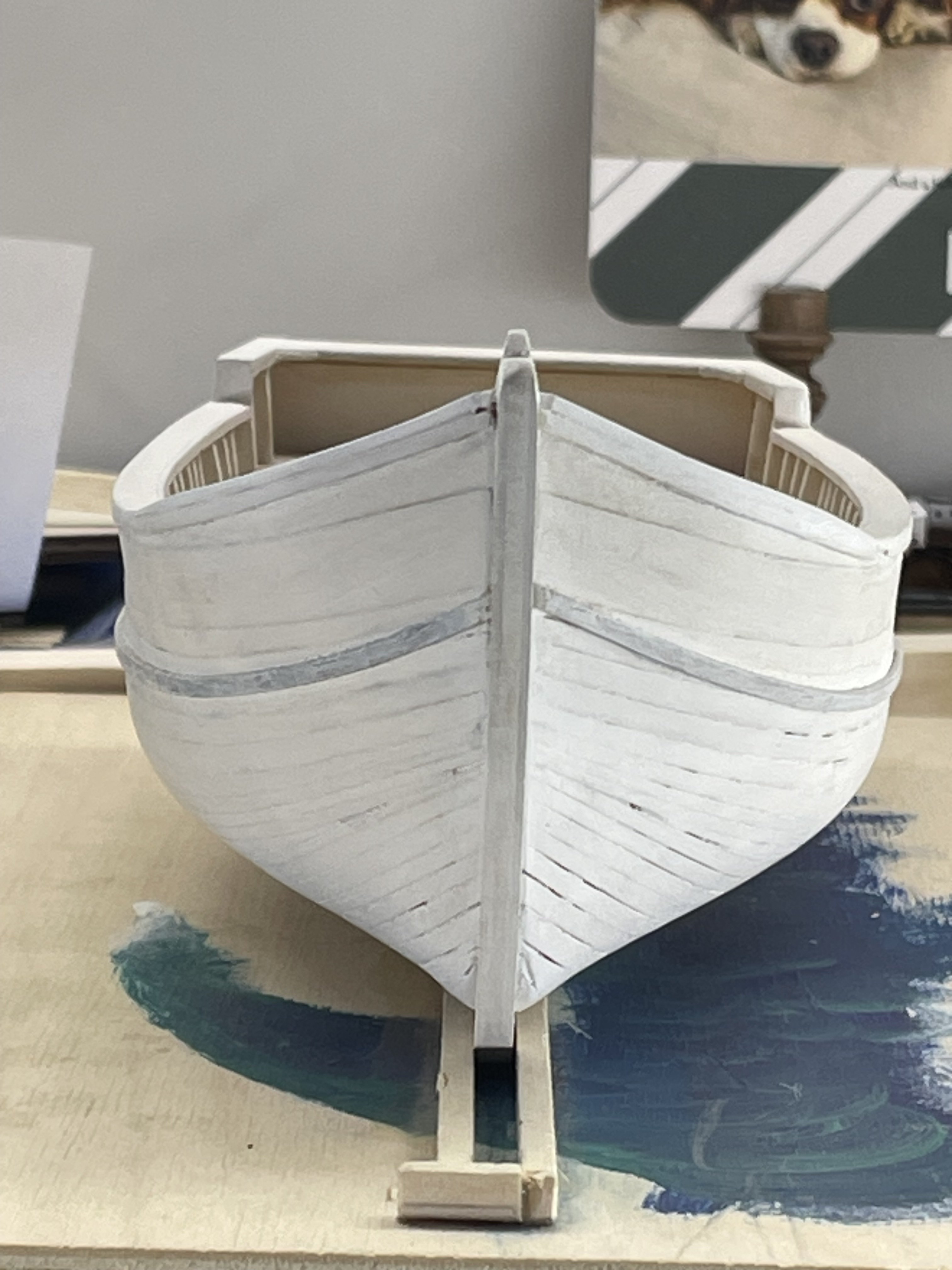

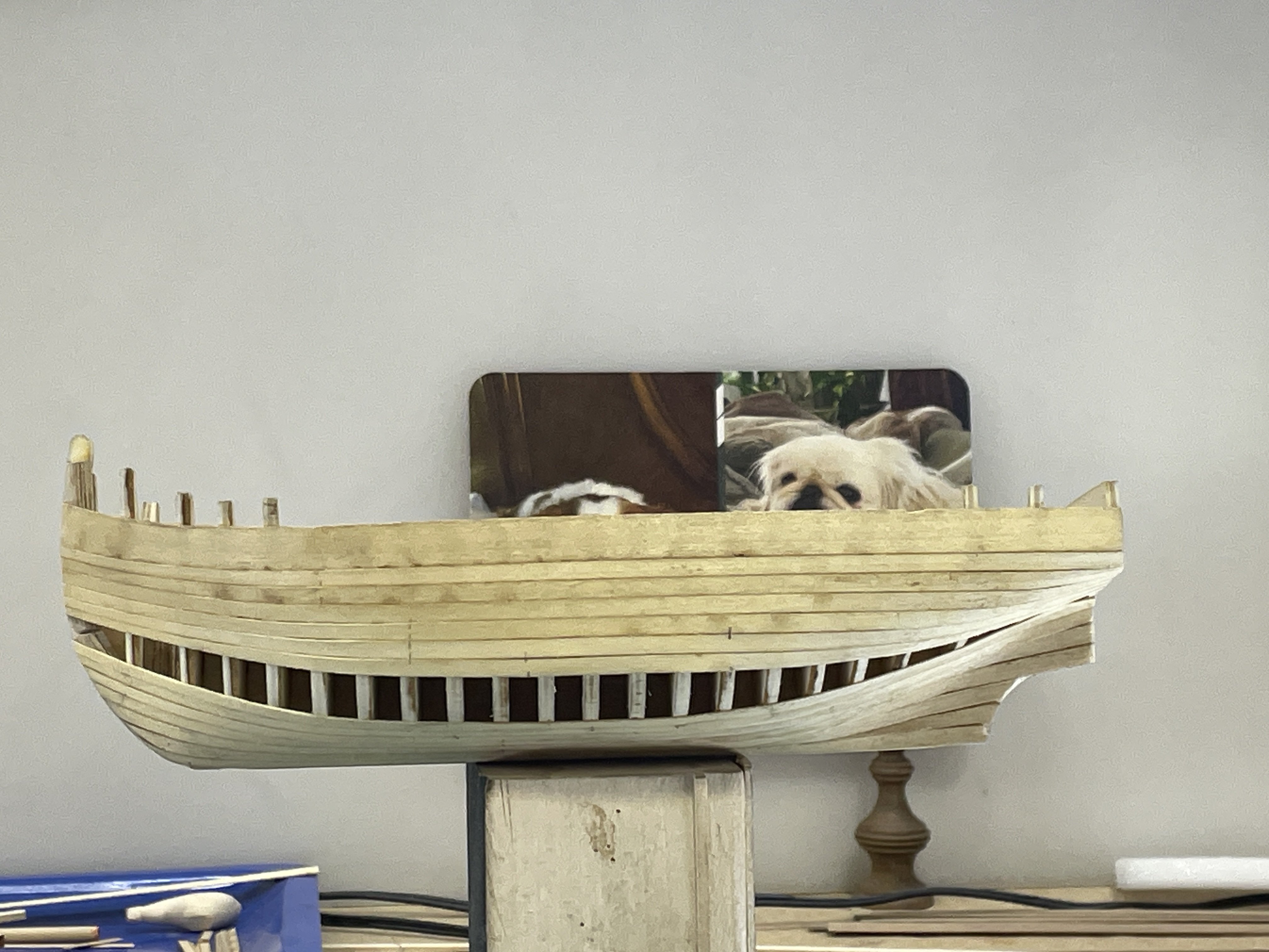

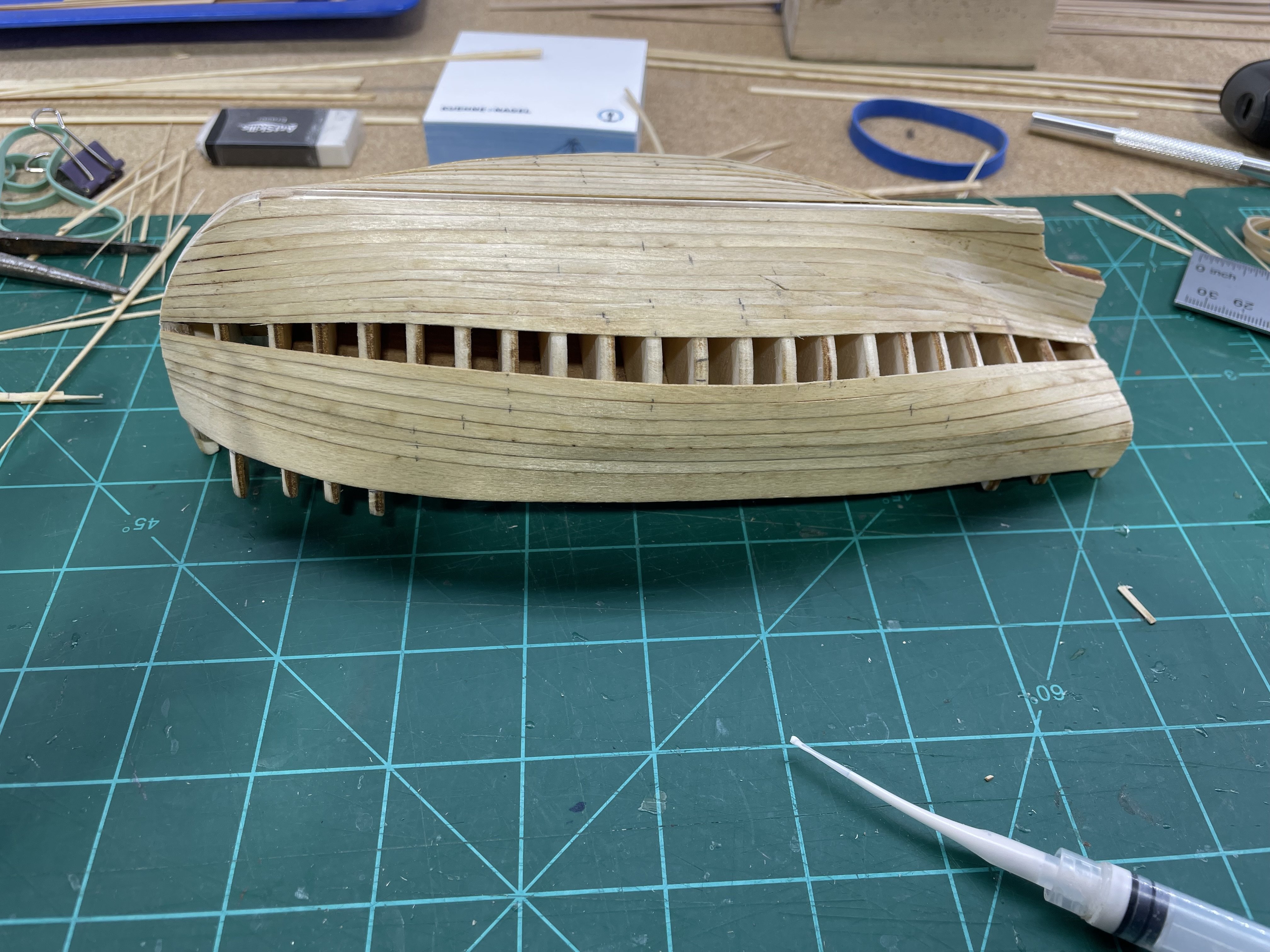

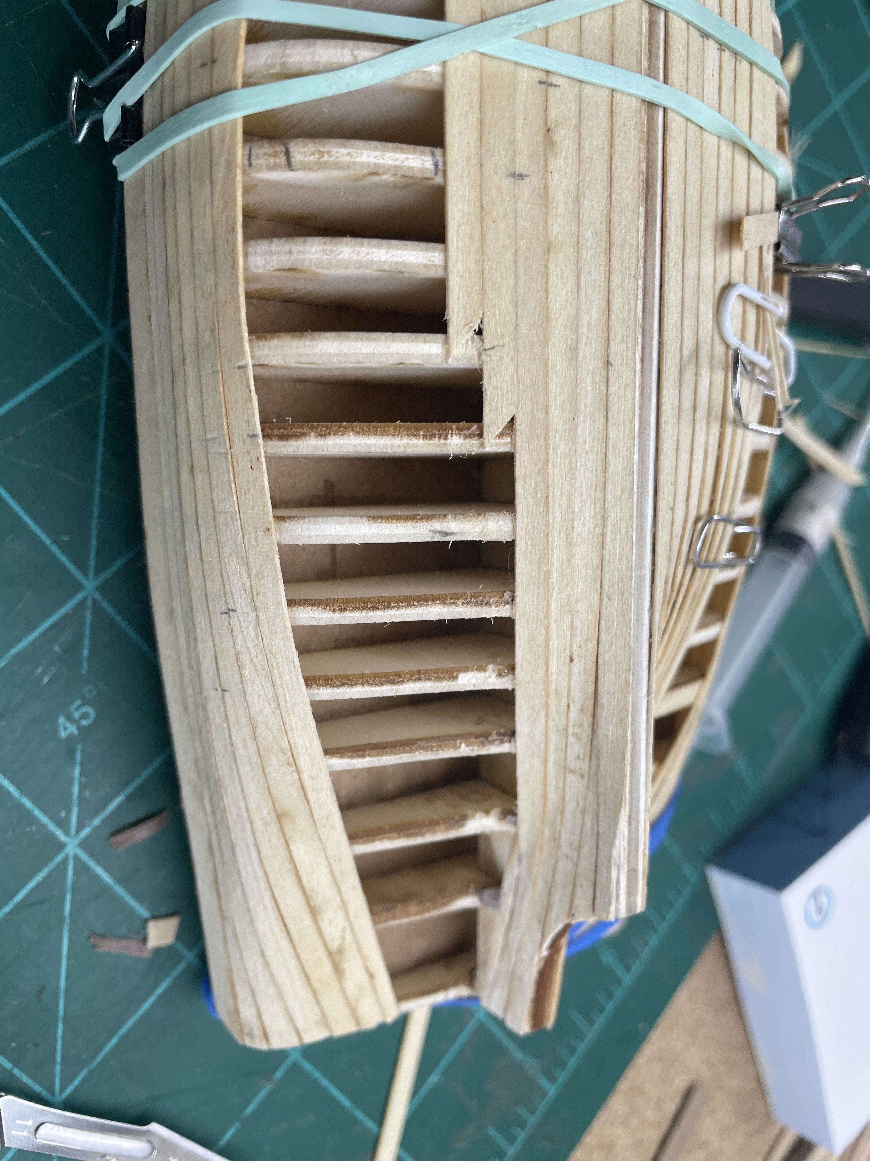

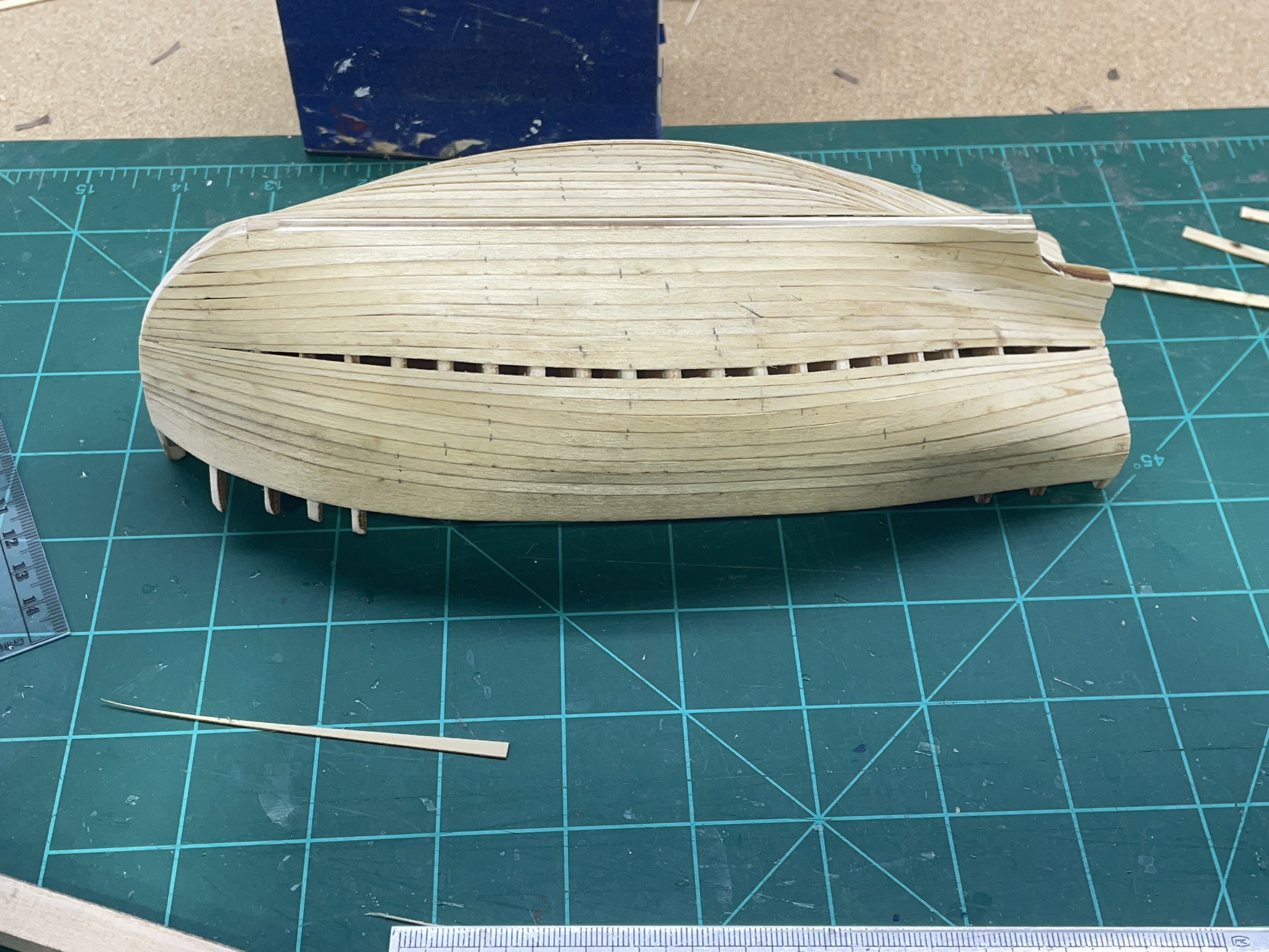

I’m down to just 4 planks on either side. They aren’t being as cooperative as the first. I’ve been using PVA and after shaping them to fit the hull. I just been mainly using rubber bands while it sets up. The last two planks I could only glue 2-4 bulkheads at a time without raising an edge of the plank.
Above is the area of repair.
Here where I’m at.

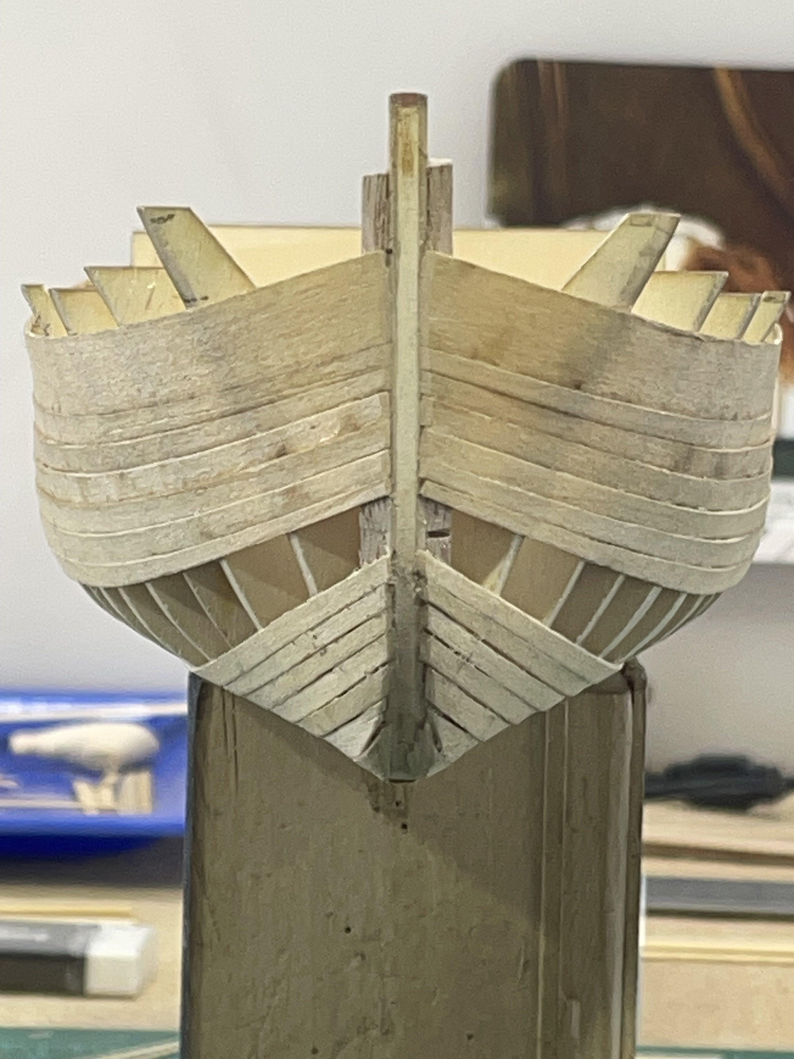

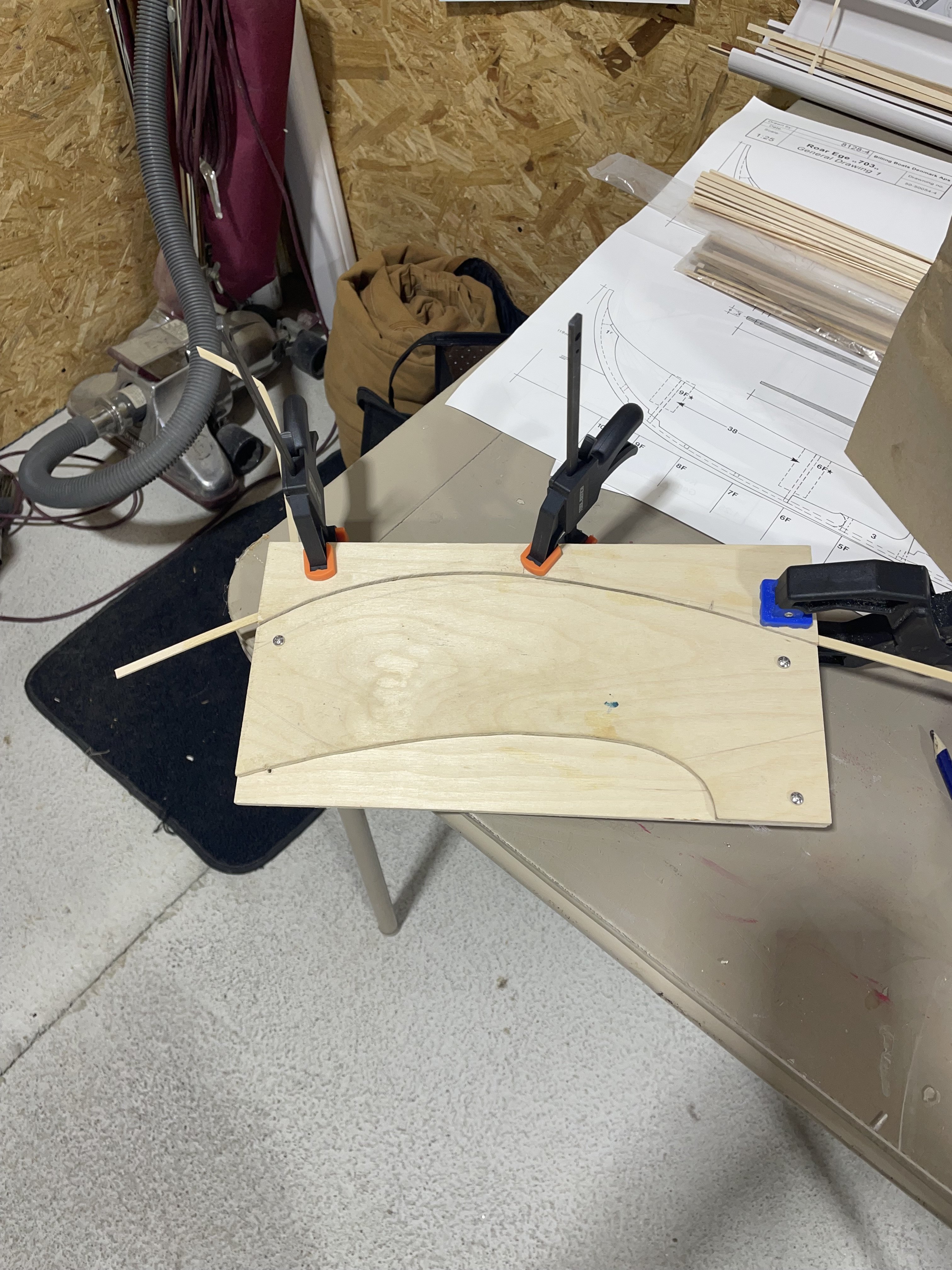

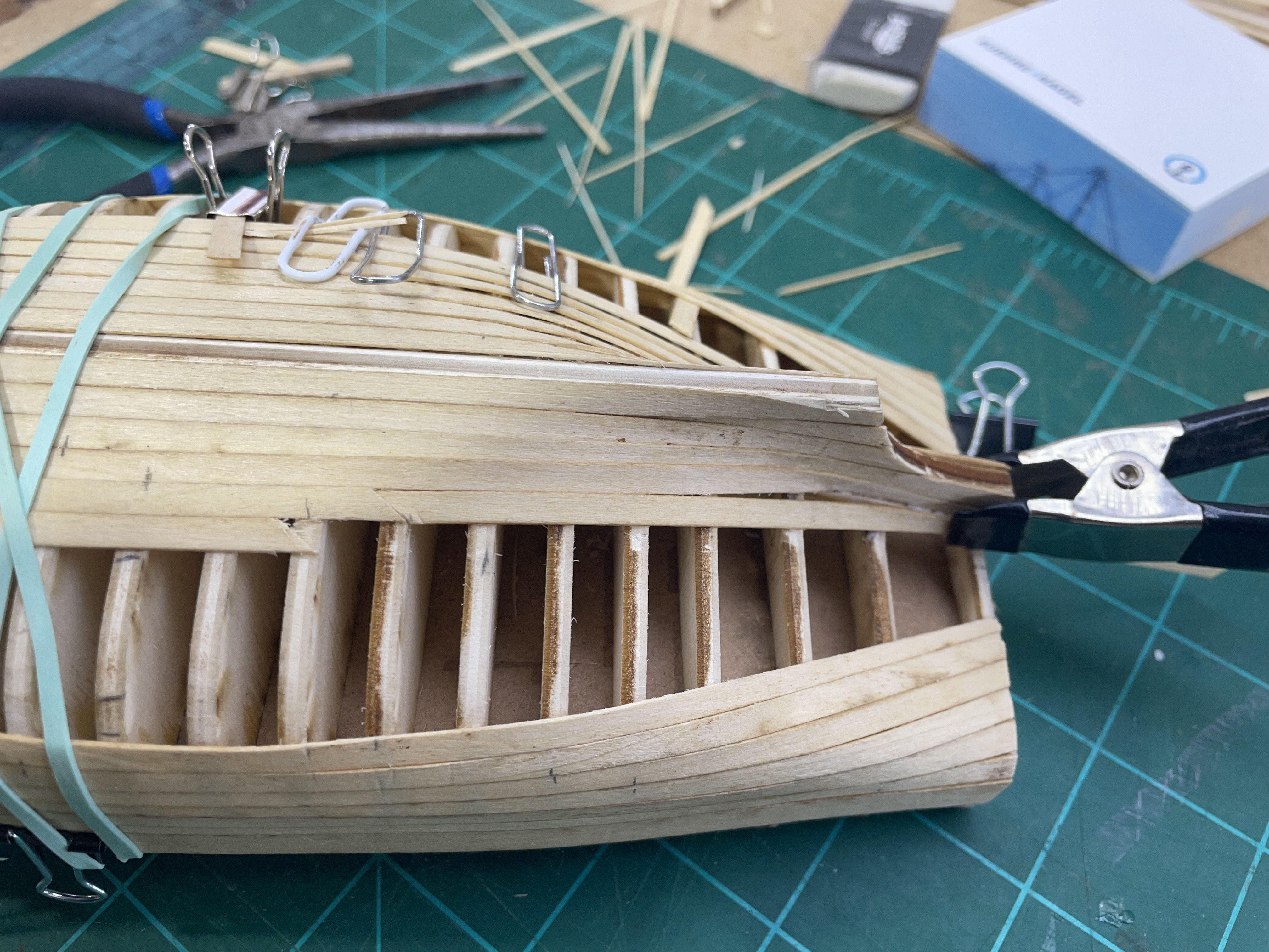

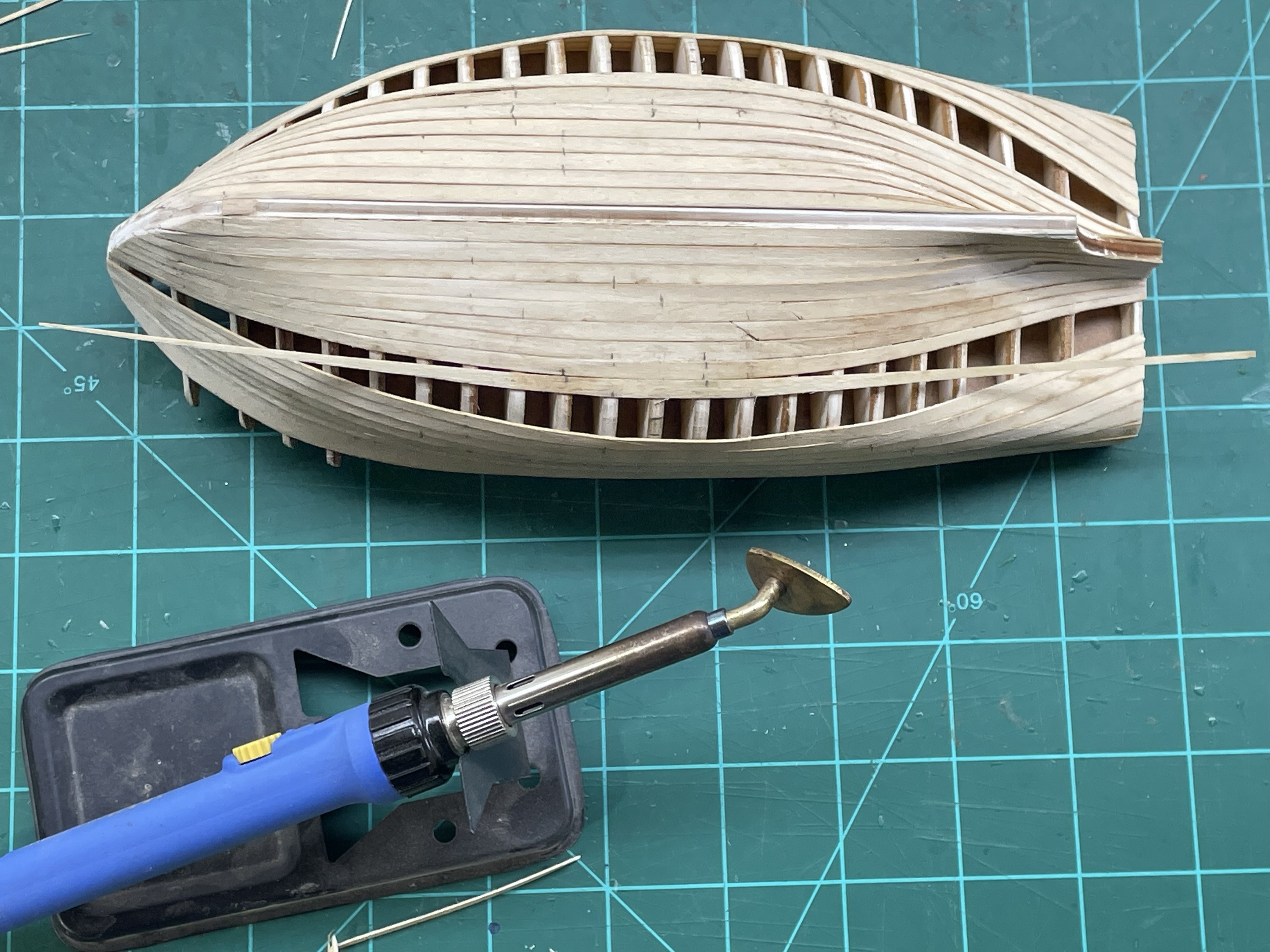

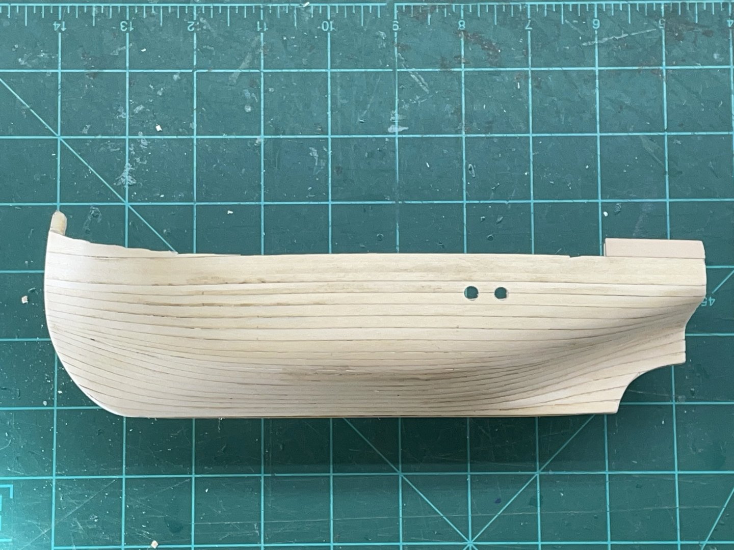

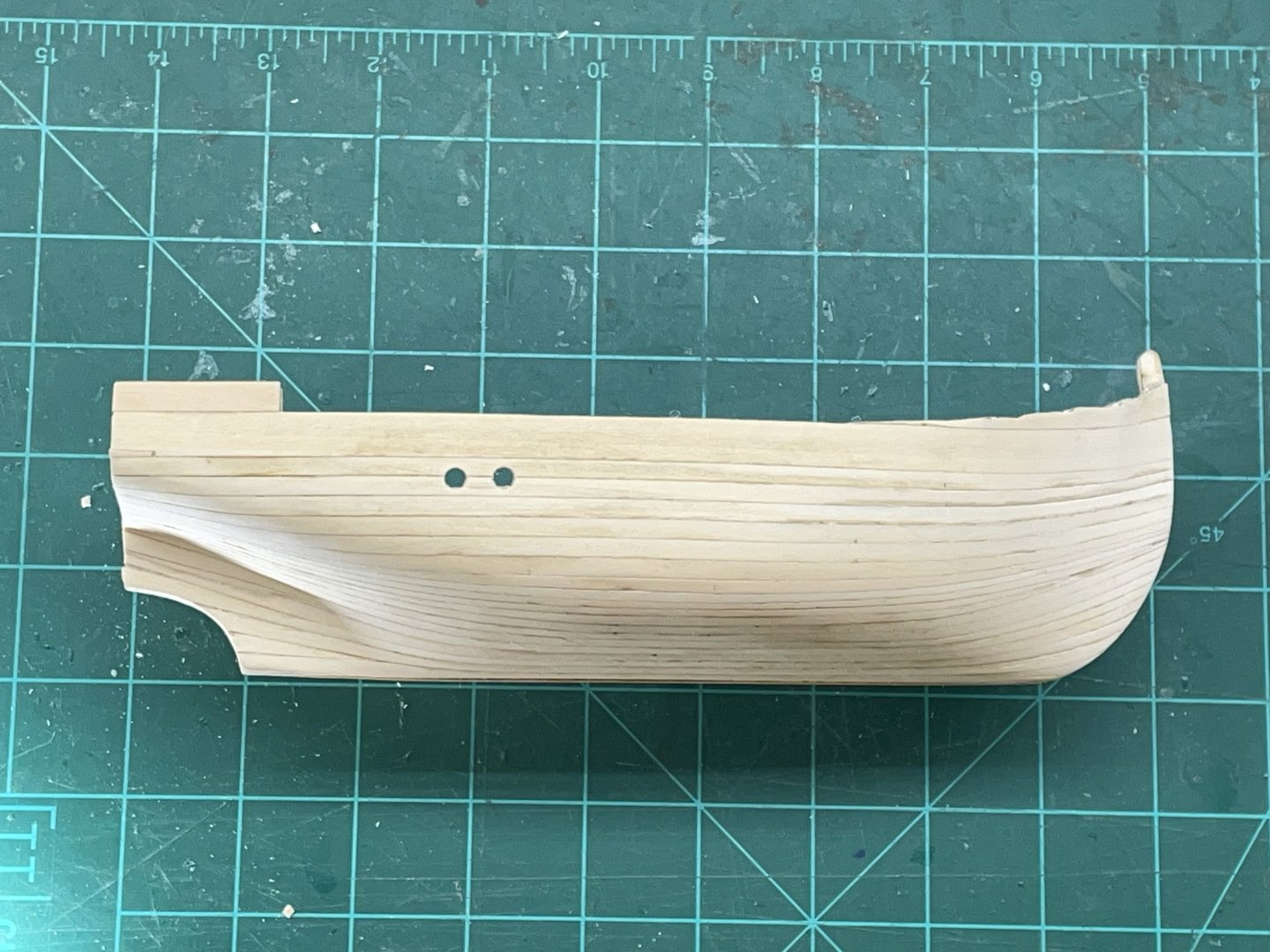

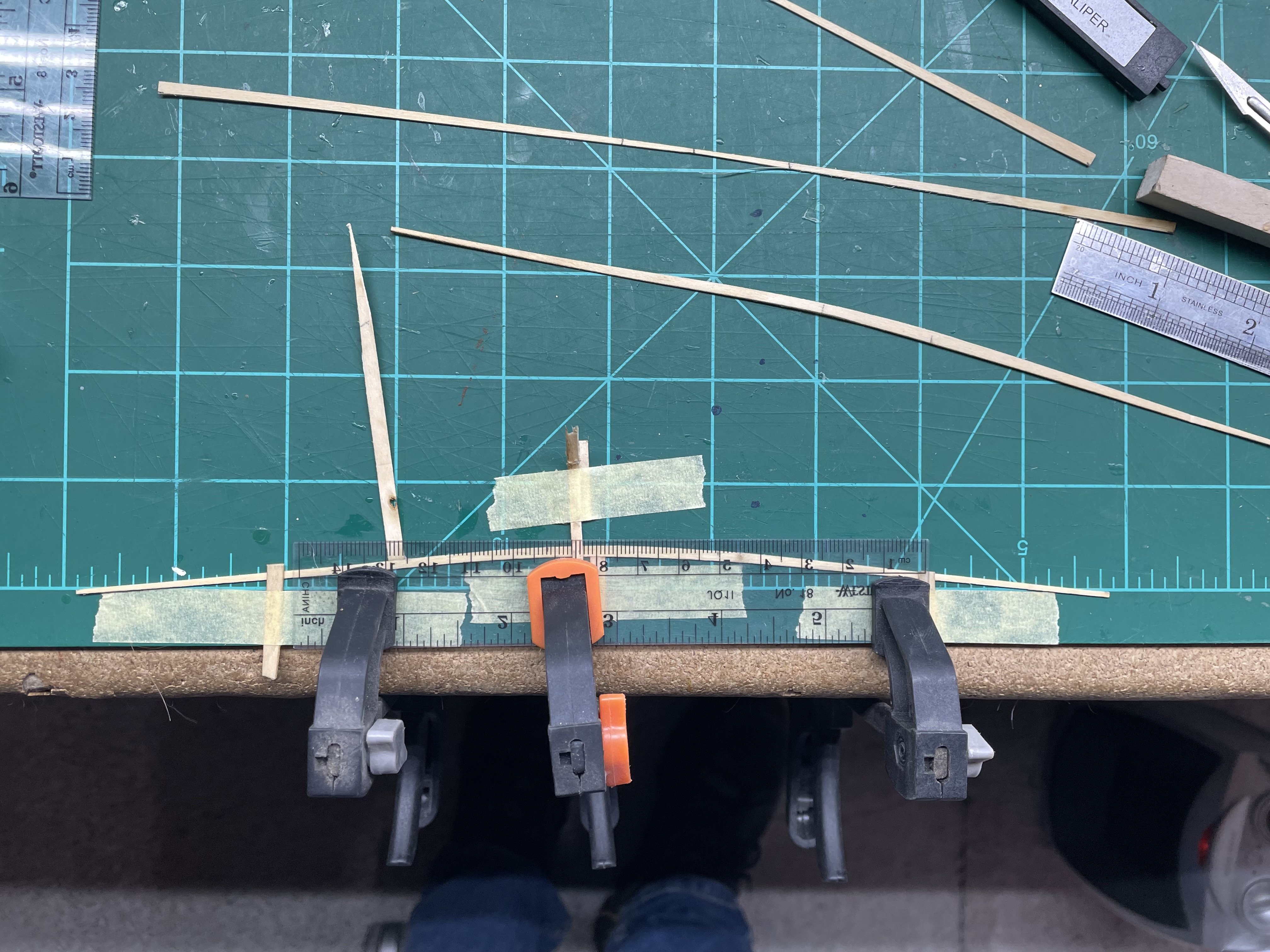

As planking continued, I realized I should have been paying closer attention to the stern and not just the bow. I started tapering both ends and made a simple jig to edge bend the fragile planks.
Clamping wasn’t even an option. I glued about 4 bulkheads at a time while applying heat.
It went as easy as using CA.

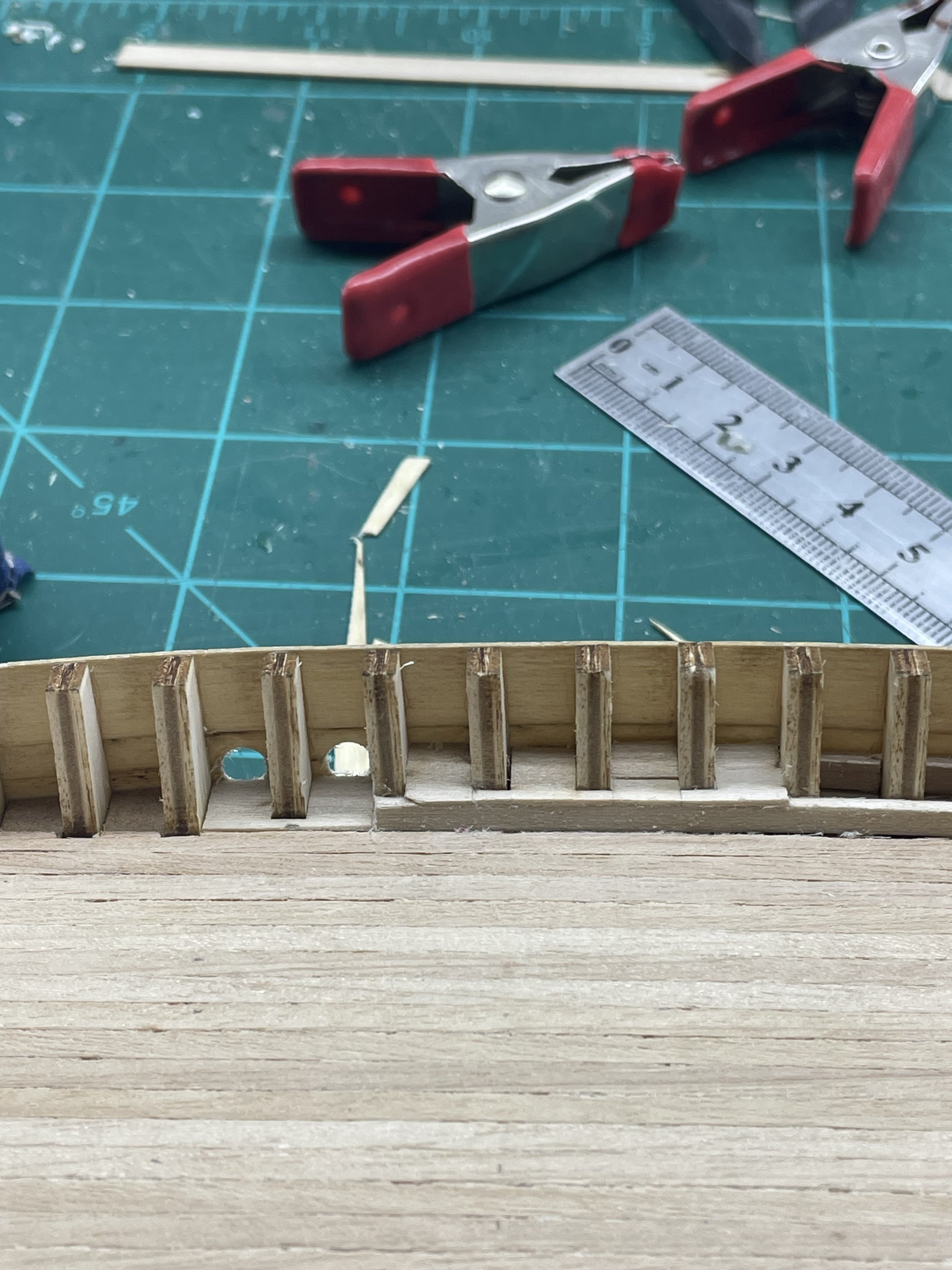

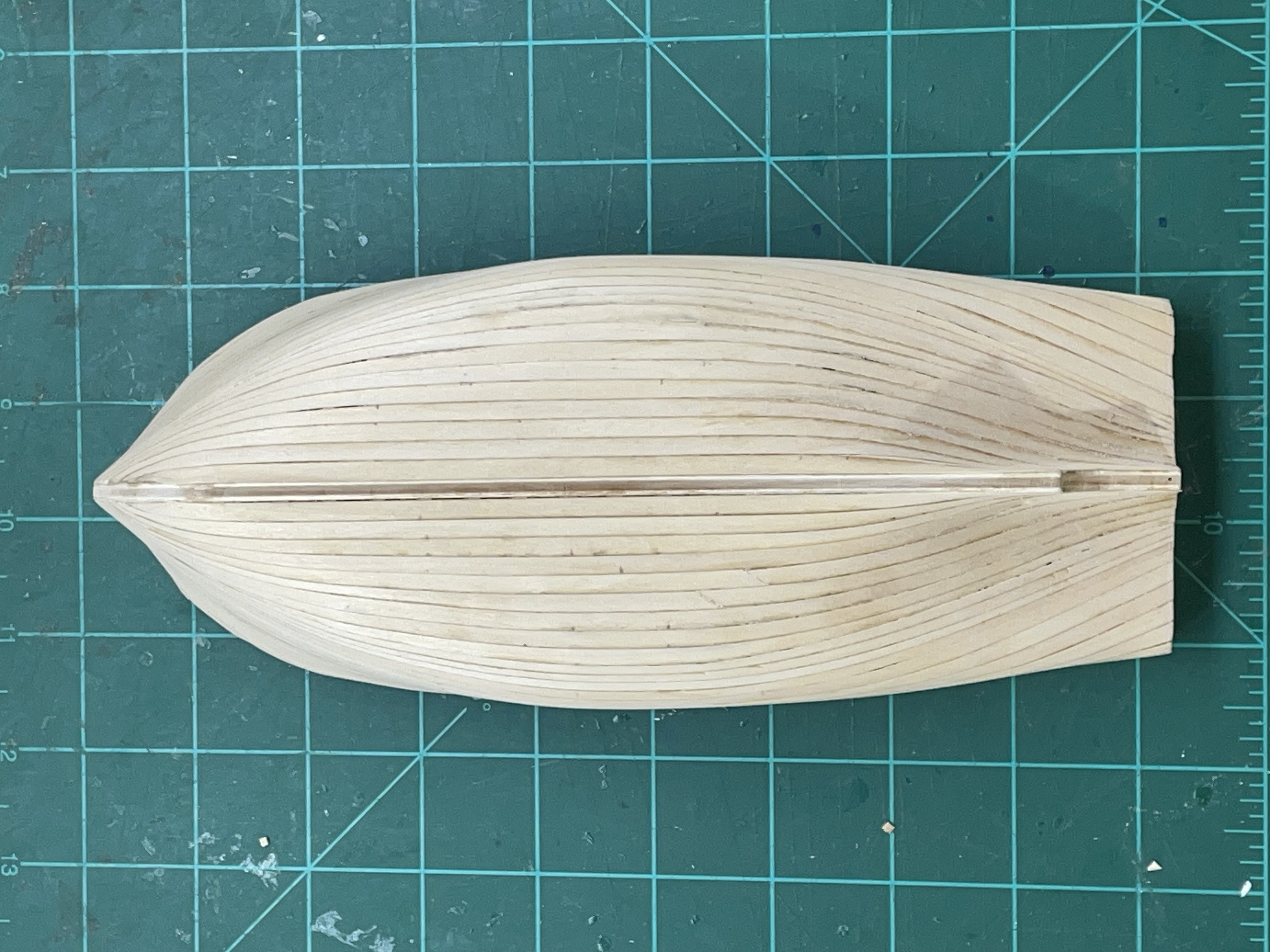

I’m down to just one space to fill. It’s 3mm wide. I’m going to fit two small strips in so it doesn’t edge up on me so bad.

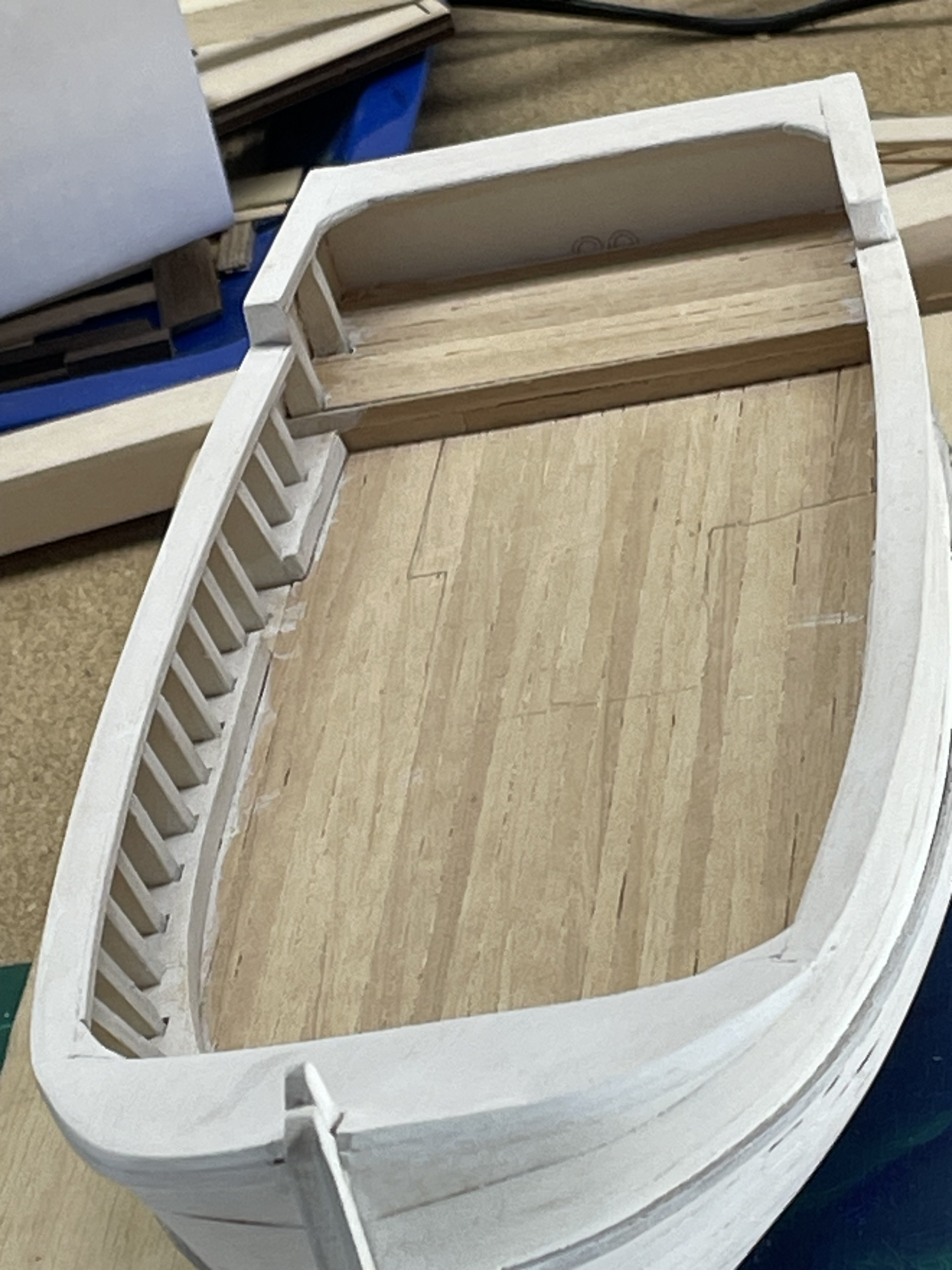

Next I’ll sand it down a bit, put the false keel on. I’m thinking I’m going to put a toe board around the inside.
