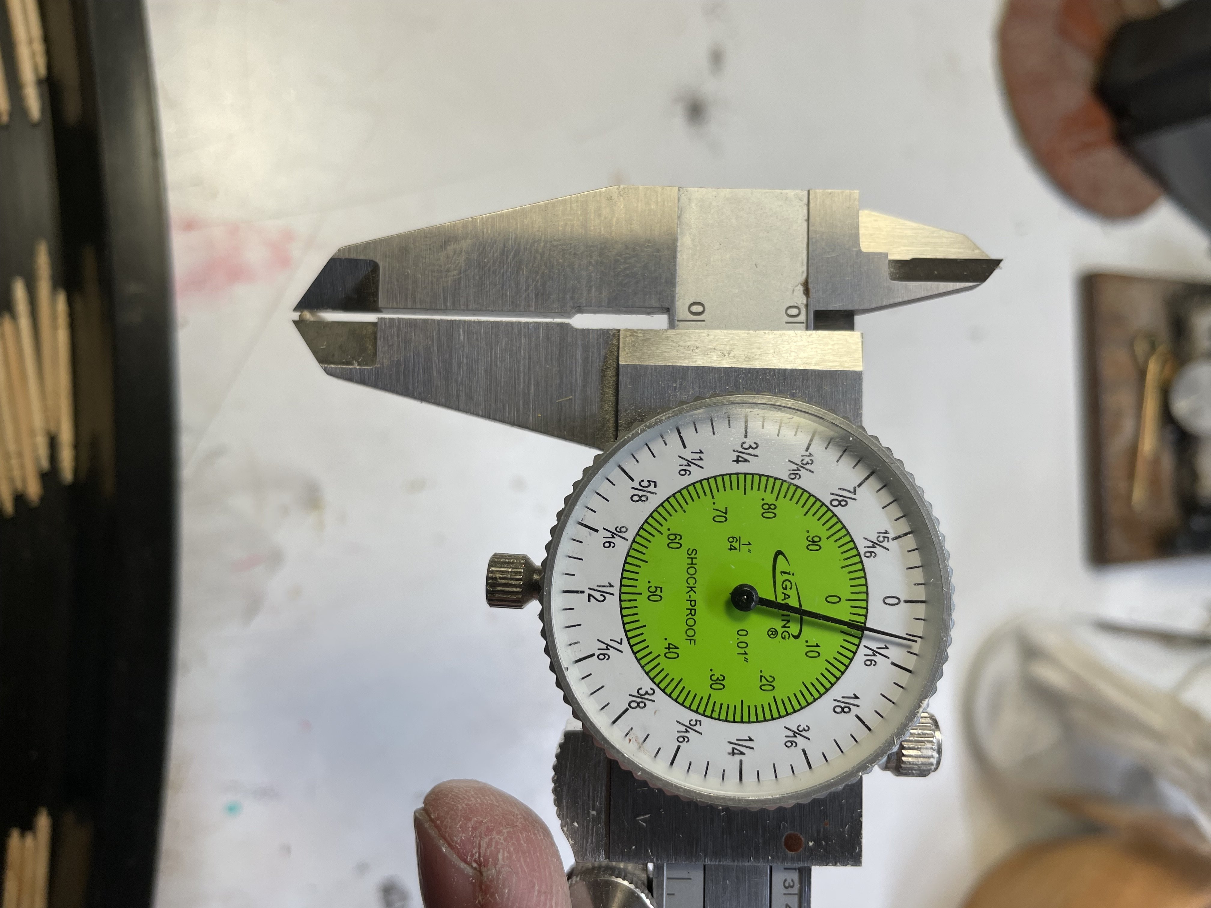

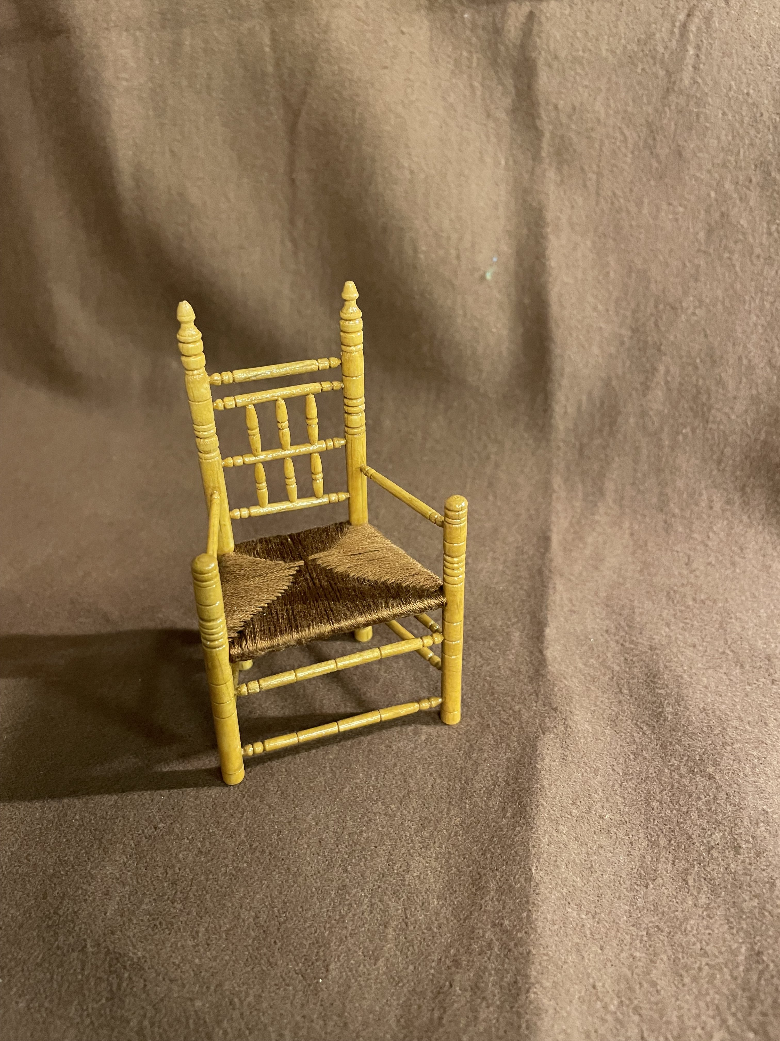

Maybe a little late here but I own a taig lathe and am very happy with the results I get with it.
 I’ve turned metal and wood on it and works well for both.
 The smallest I’ve turned - see picture below
chair I turned all on taig lathe and it’s 1/12 th scale.
Edited by kgstakes

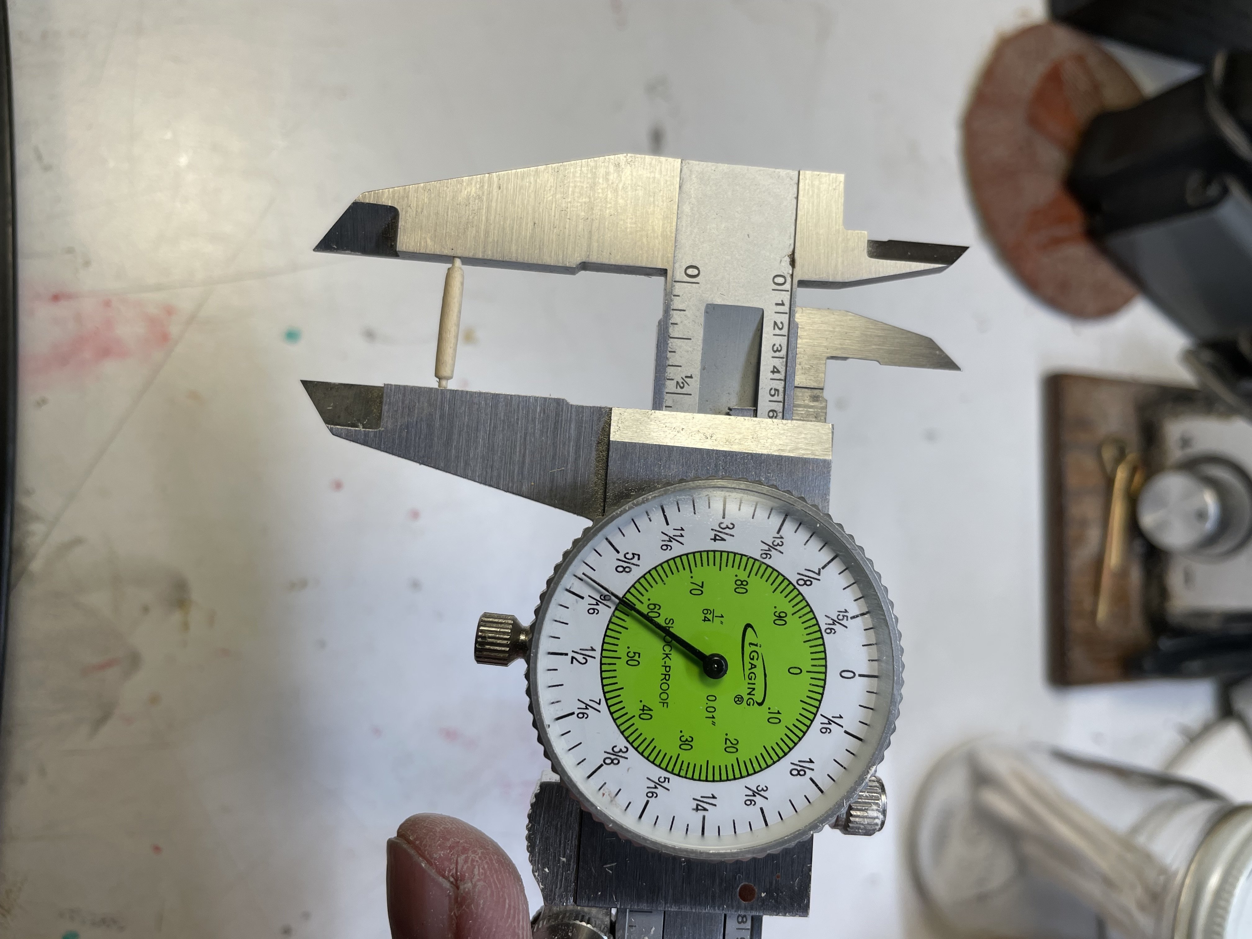

That is some fab work you are doing. Very impressive.
If you haven’t tried this you might want to give it a go if you need very small turned diameters. It’s an old machinist’s method where you start with a larger sturdier diameter, one that won’t noticeably flex when you make the cut. I can’t vouch for wood as I never machined it professionally but I could take a .500 brass bar and machine a .020 diameter by 1 inch long. The tooling has to be geometrically correct, and of course it has to be on centre. You also have to hit the required finished diameter on the first cut as you certainly cannot take a second cut. I suspect with wood, you would need to take the grain into account.
I have made myself adjustable stops for the slides. Once you hit the desired diameter on a short length, you set the stop and then cut to the stop in subsequent steps.
