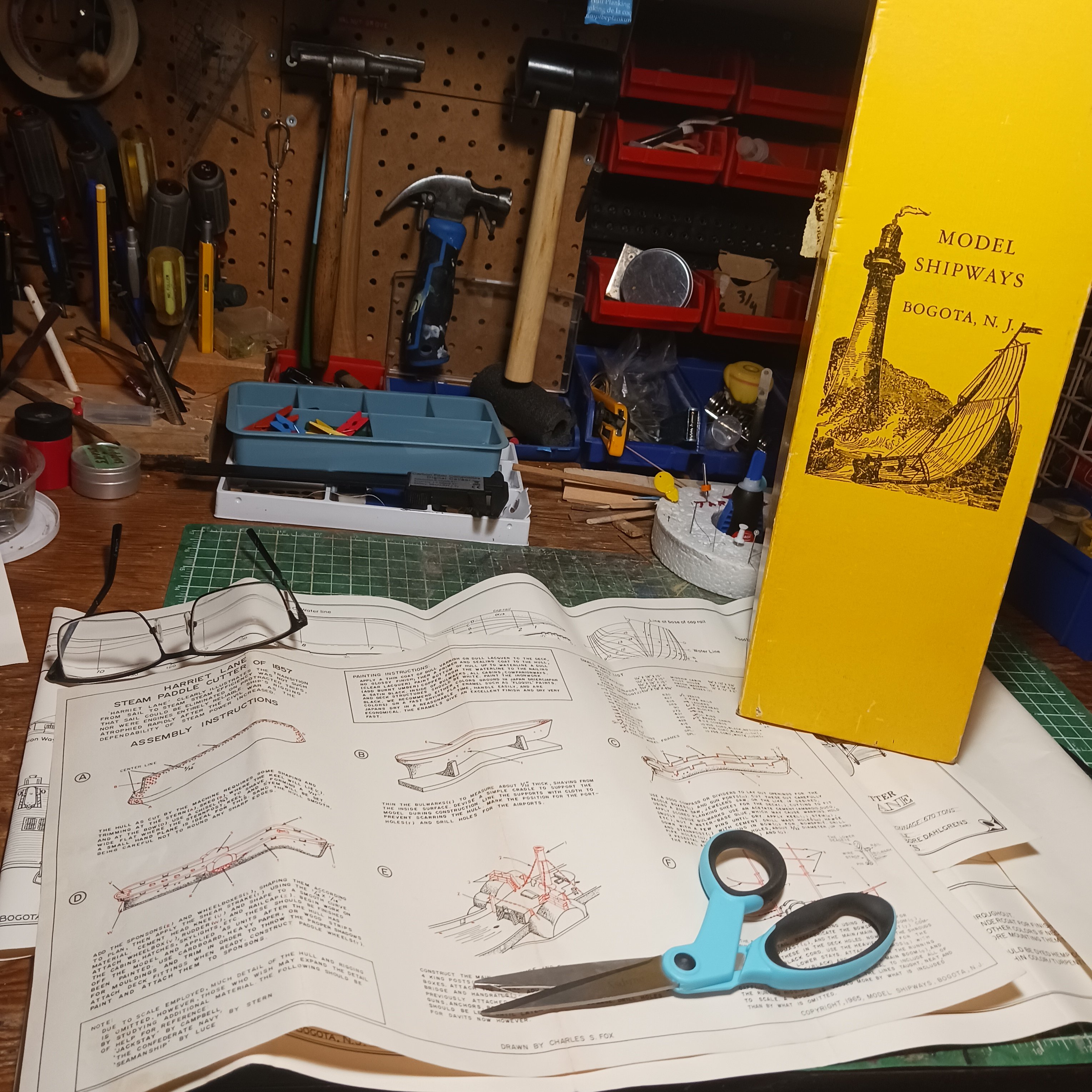

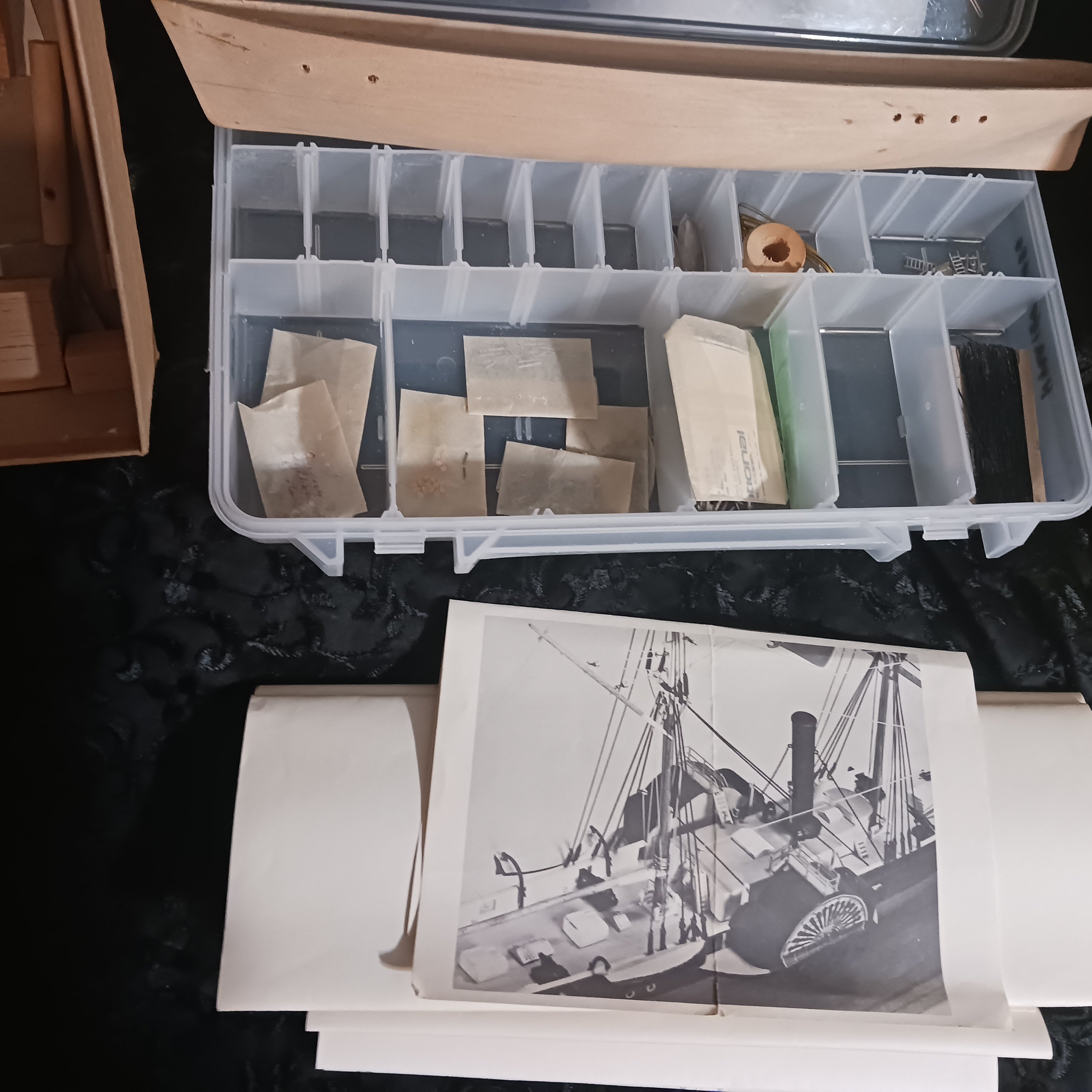

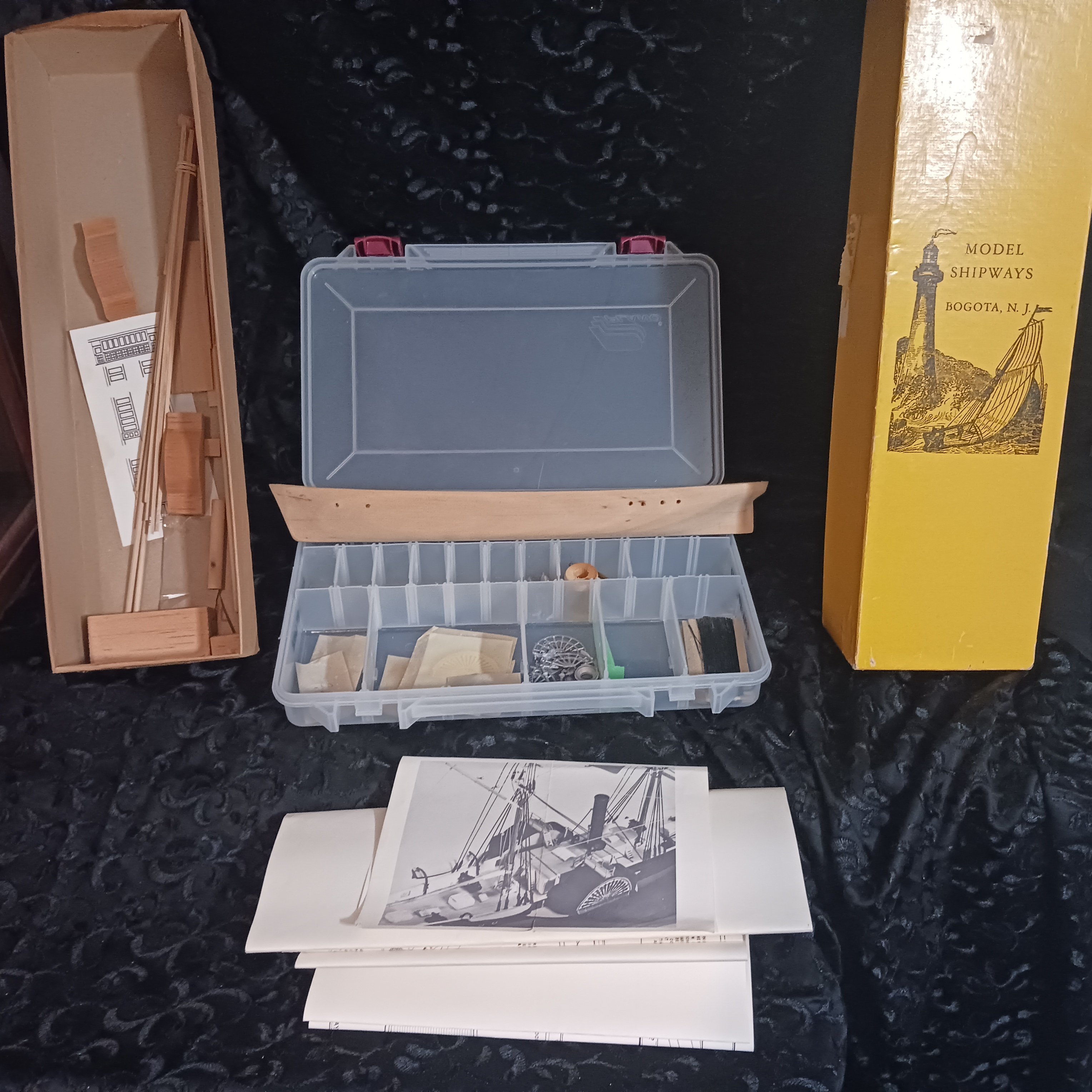

I  put all the packages  into a plastic  container and left the wood in the box.
They is a pile of little  parts, that will need magnification,  holy they are small.
It is a very nice looking boat,  the Instructions say  it is clearly illustrates the transition from sail to Steam.  I will do some more research  on this boat before getting  going, lots of logs for this boat here so I should be good to go. I won't start  right away, taking  a break, cleaning the shop getting ready for Christmas,  that sort of thing.  Maybe Monday I jump in to it lol.

  When you can can get a good buy on an older kit, that's one way to beat inflation.  I queried for the scale of all Model Shipways versions of the Harriet Lane and wondered which one you got.  A search result is pasted below:
Model Shipways has offered the Harriet Lane in multiple scales, but the current main kit is 1:96 scale, a larger plank-on-bulkhead version, while older solid hull kits were available in 1:120, 1:128, and 1:144 scales.
Key Scales & Kits:
  • 1:96 (Current): A plank-on-bulkhead kit with laser-cut parts and detailed fittings, designed by David Antscherl and available from Model Shipways.
  • 1:128 (Older): A solid hull kit with machine-carved hull, often found on resale sites.
  • 1:144 (Older): Another solid hull version mentioned in forums.
  • 1:120 (Very Old): An even earlier version of the solid hull kit.
When buying, always check the product description for the specific scale, as Model Shipways offers versions from different eras.
@GrandpaPhil , I looked on the plans no David, there are three sheets of plans, two draw by James F. Berge and one from Charles S. Fox.
 @Snug Harbor Johnny the scale is 1/12=1 foot, , 1965 copyright, Bogota N. J.
so what ever that works out to,  I am still looking . Guessing I would say an old 1:44 scale, but no good at that sort of thing lol.
 The parts are really tiny , so I am going with the smallest  one. I will  find out. Research, research, research 😪  lol

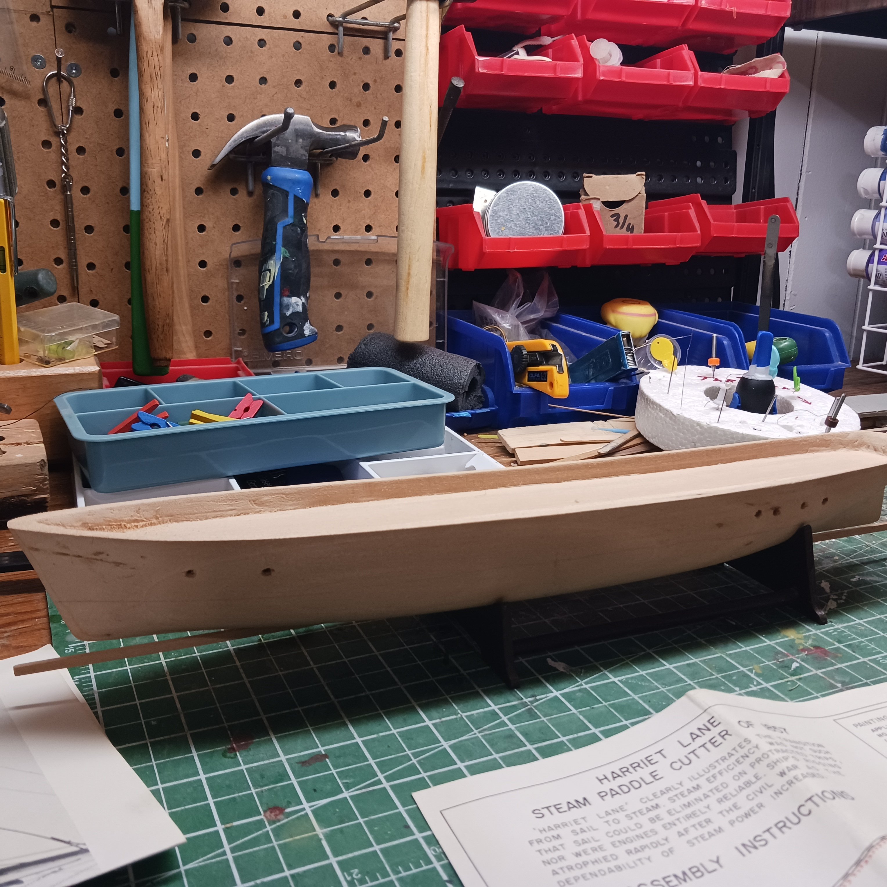

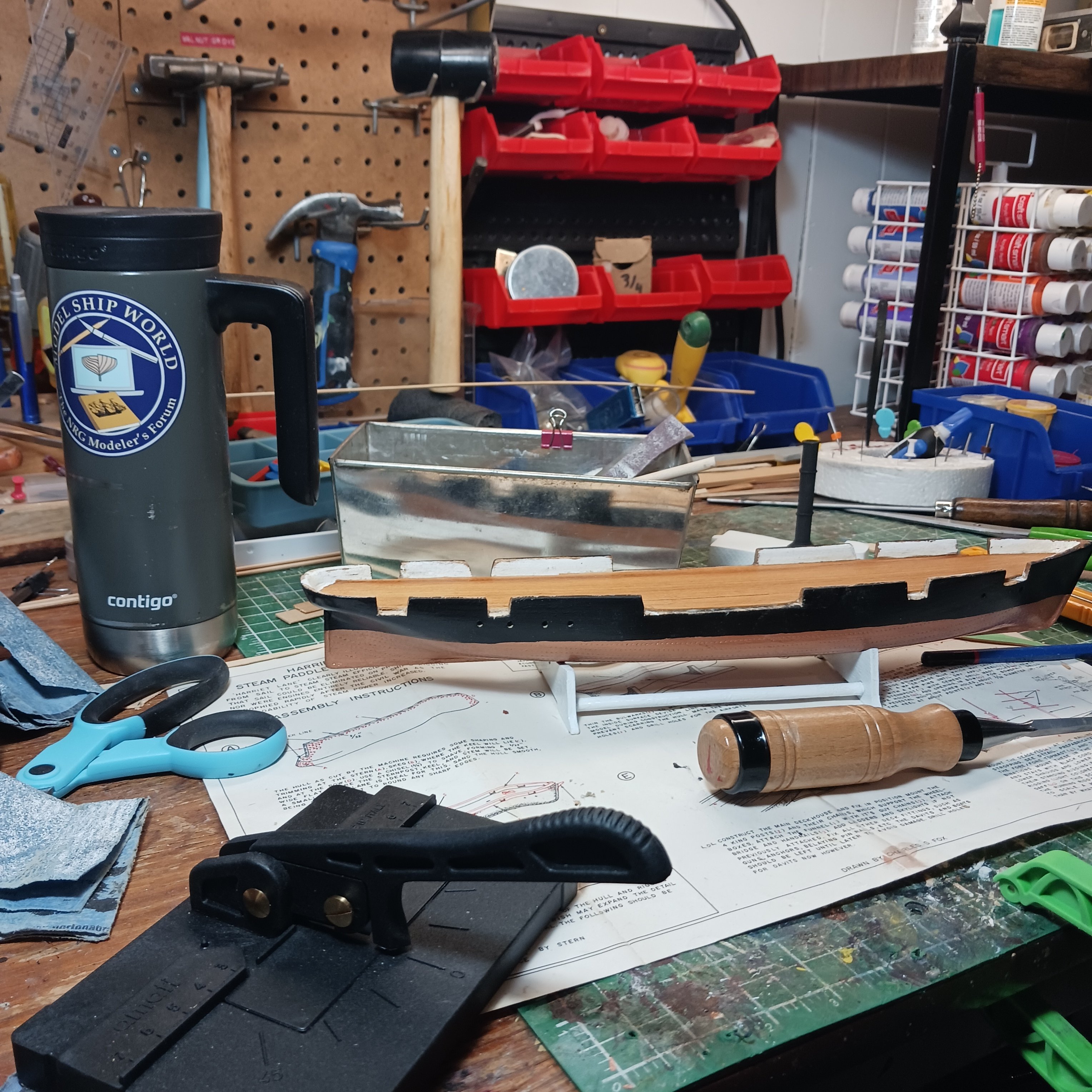

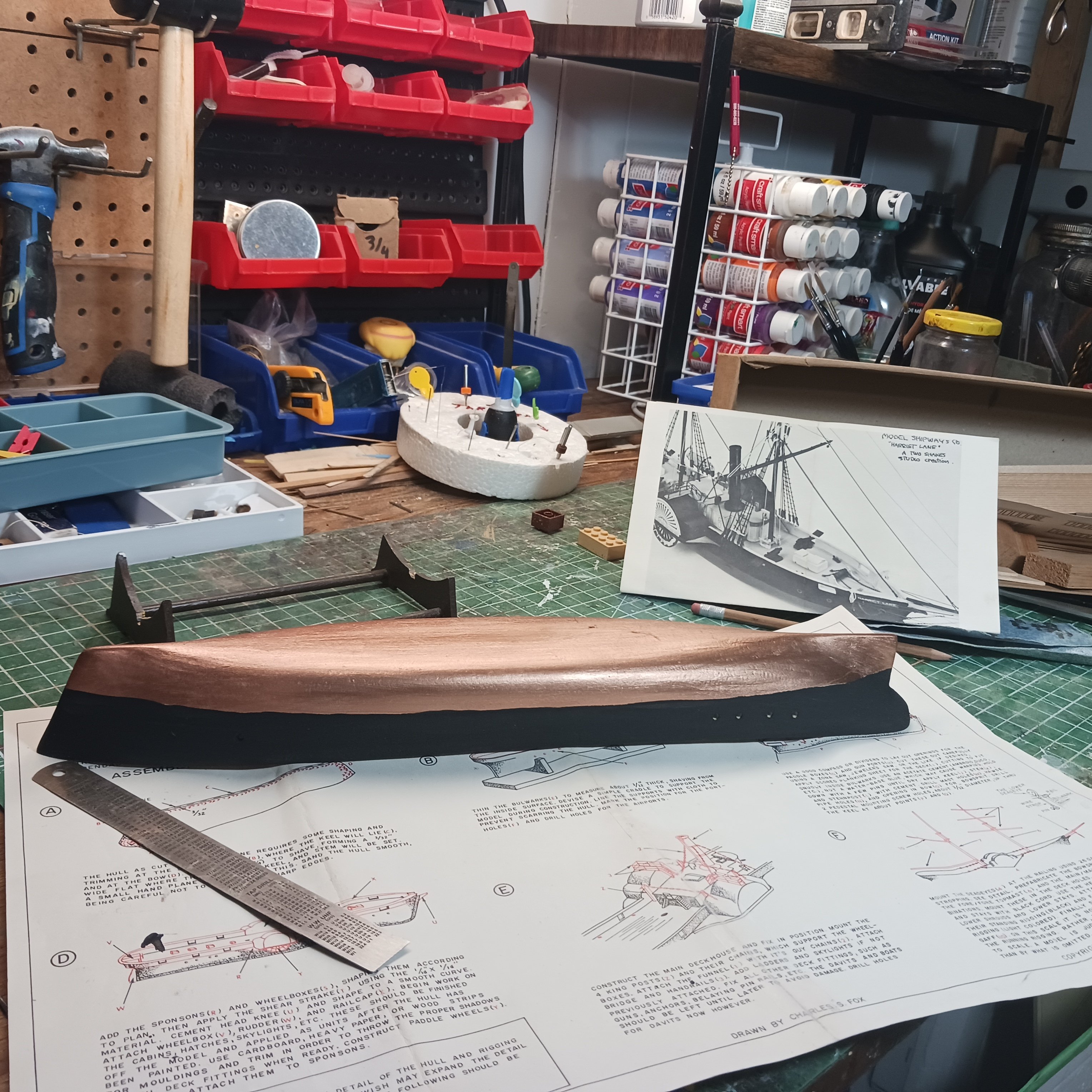

Oh this is going to be fun, thanks @Literalman for  this, we are having  fun. So this will be my version of  the USCG Harriet  Lane,  thank moderators for changing the name.

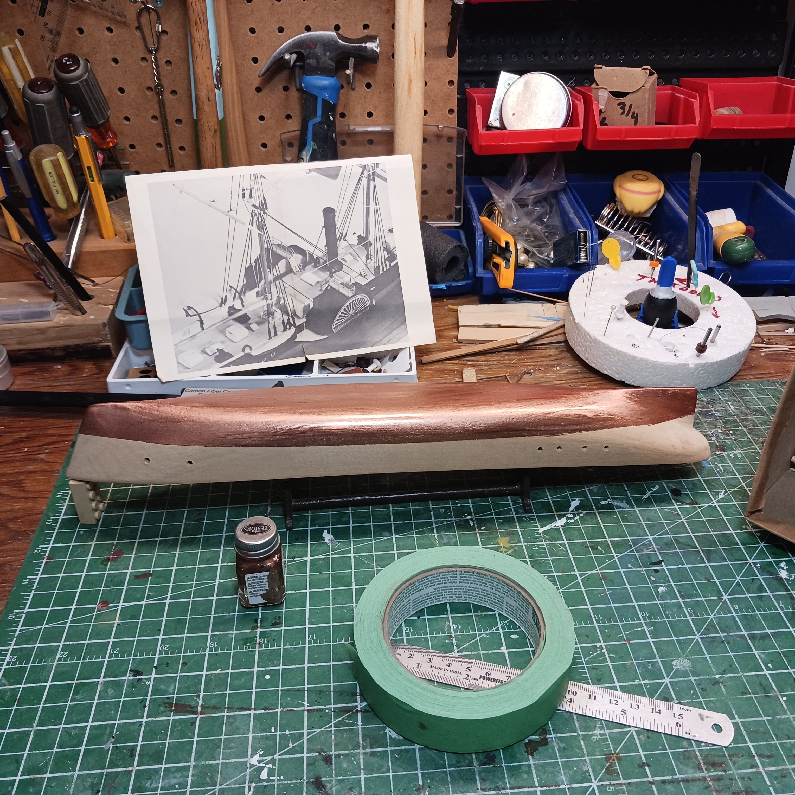

Stev had started  the ship and has drawn  the water line, and drilled the port holes.
The plan just says make up the wheel box and wheel house and put them on the ship. Little else in the way of help, but thats the beauty of modeling,  and this will be another  beautiful ship. I feel it. Lol.

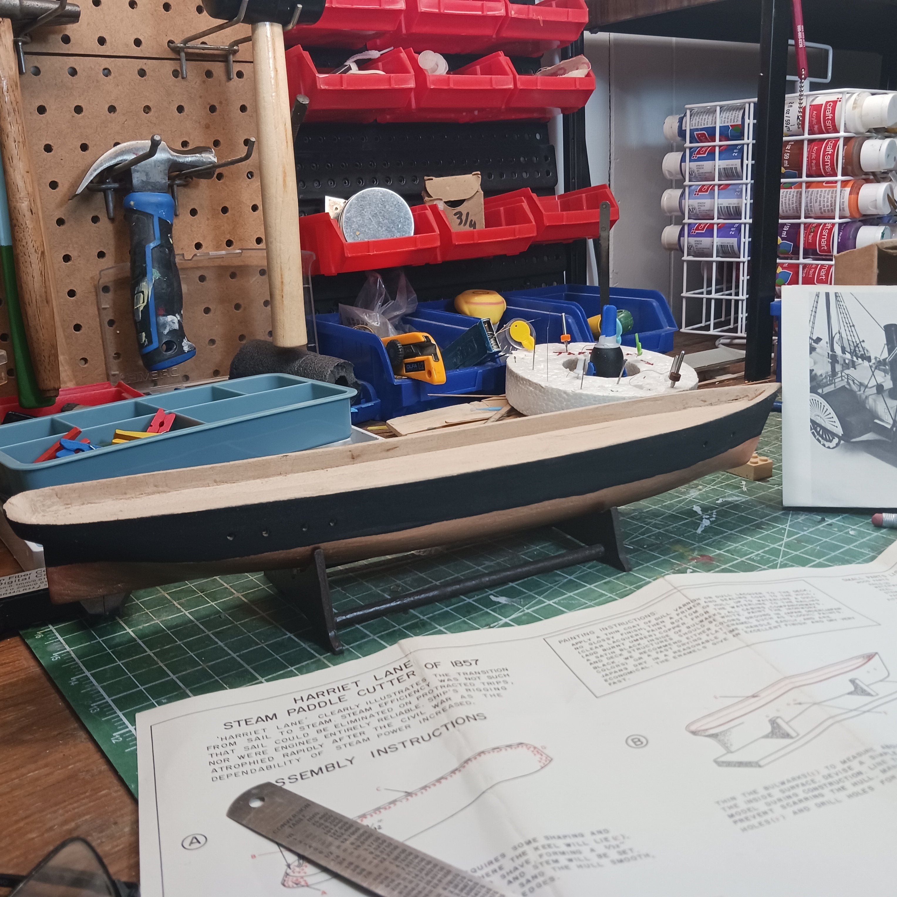

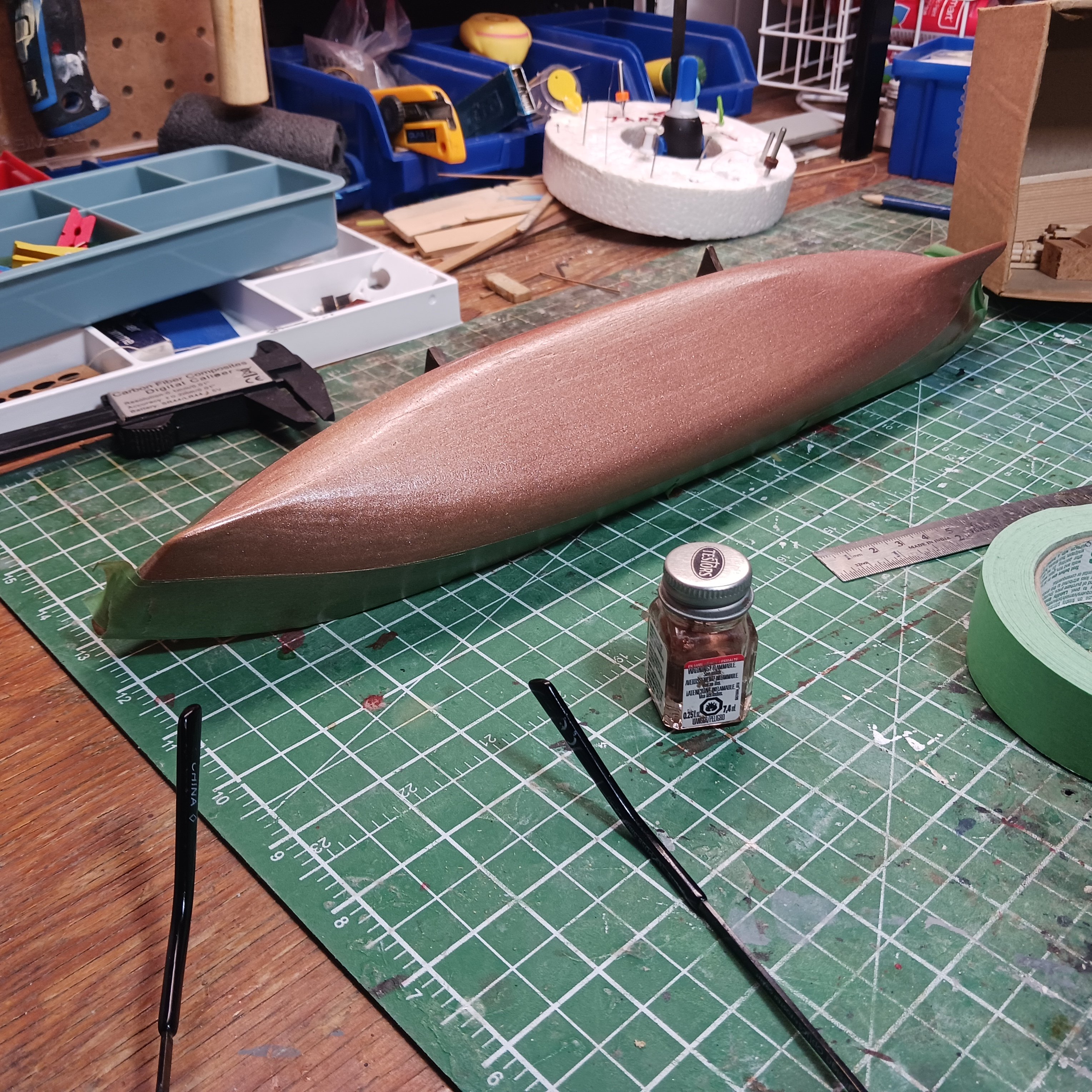

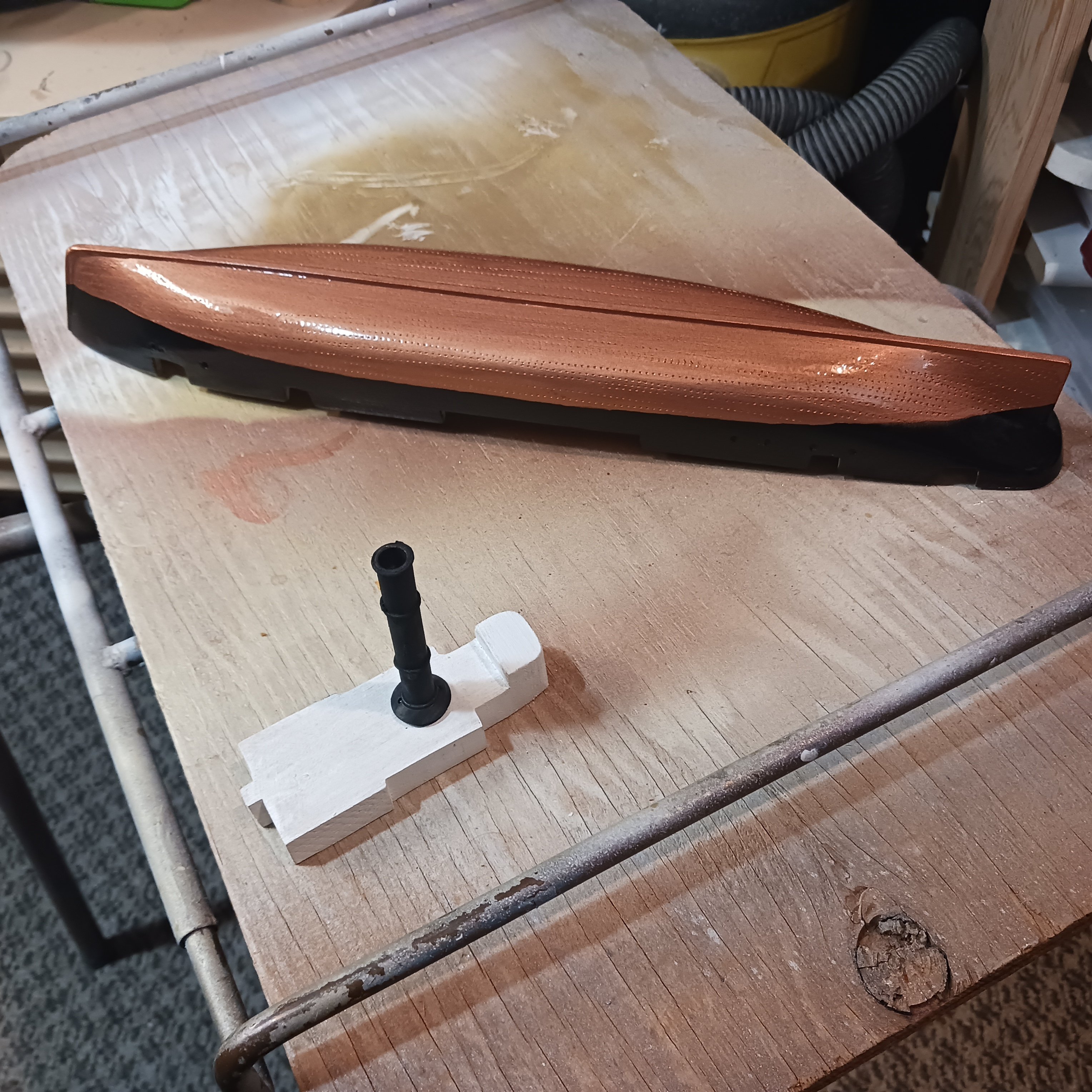

I was going to buy copper  plates for the hull , but due to economic reasons,  paint it is.

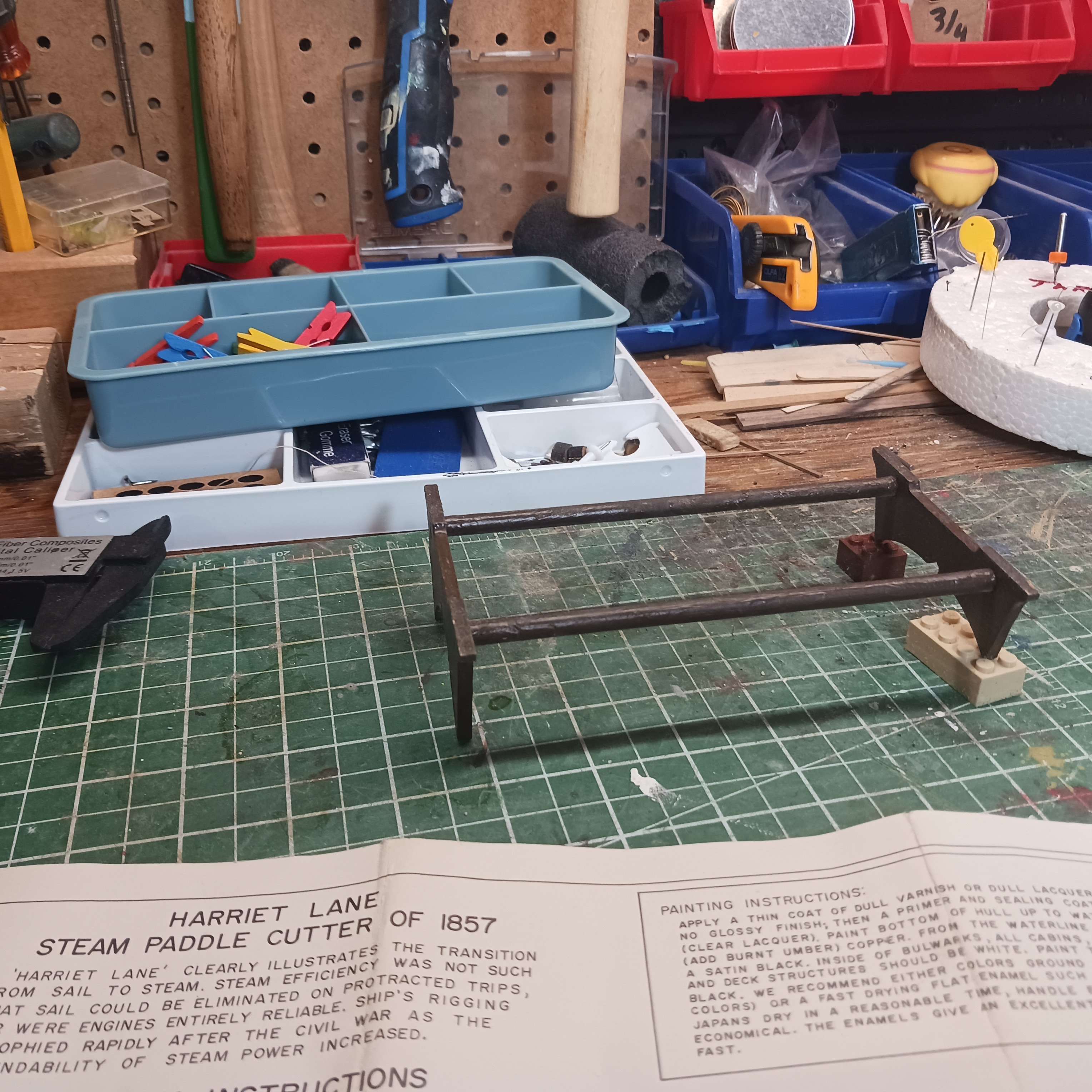

I  going to modify the working stand from my La Nina build to the stand for the HL.
Taking advantage of Steve's water line I brushed the copper  and the black free hand, I will straighten them out on the final coat.
I  well have to let this dry up over night , before I start cutting holes in her. Lol.

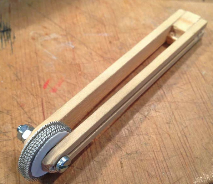

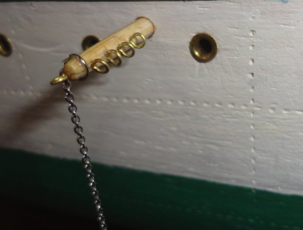

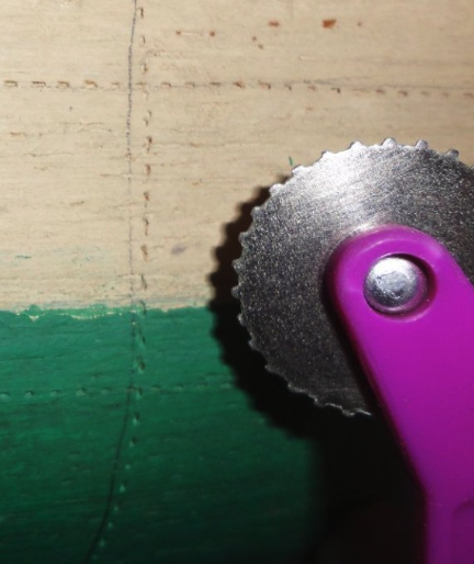

  I rolled divots with a modified (hand filed) pattern wheel to represent steel hull plates on a project (over existing paint), and they looked OK after a re-painting.
image.png.131ad2c48b6a6e83f508121c2bfd9af4.pngimage.png.c7244629008865e93857b135f33d1cac.png
  Someone on MSW recently used wheels from a dermal roller to make tiny divots in a copper bottomed model.  I suspect that a combination of light ruled horizontal scribe lines (with vertical divisions), followed by the dermal roller done over the base coat, would 'telegraph' through the final coat enough to resemble laboriously applied copper plates ... with random tacks in the the plates themselves.
Thanks @Snug Harbor Johnny, I had that in mind, the First Mate has one for her sewing, befor I put the final coat of paint on I will do that. It is a pretty small surface  so it should look good to all who see it lol.

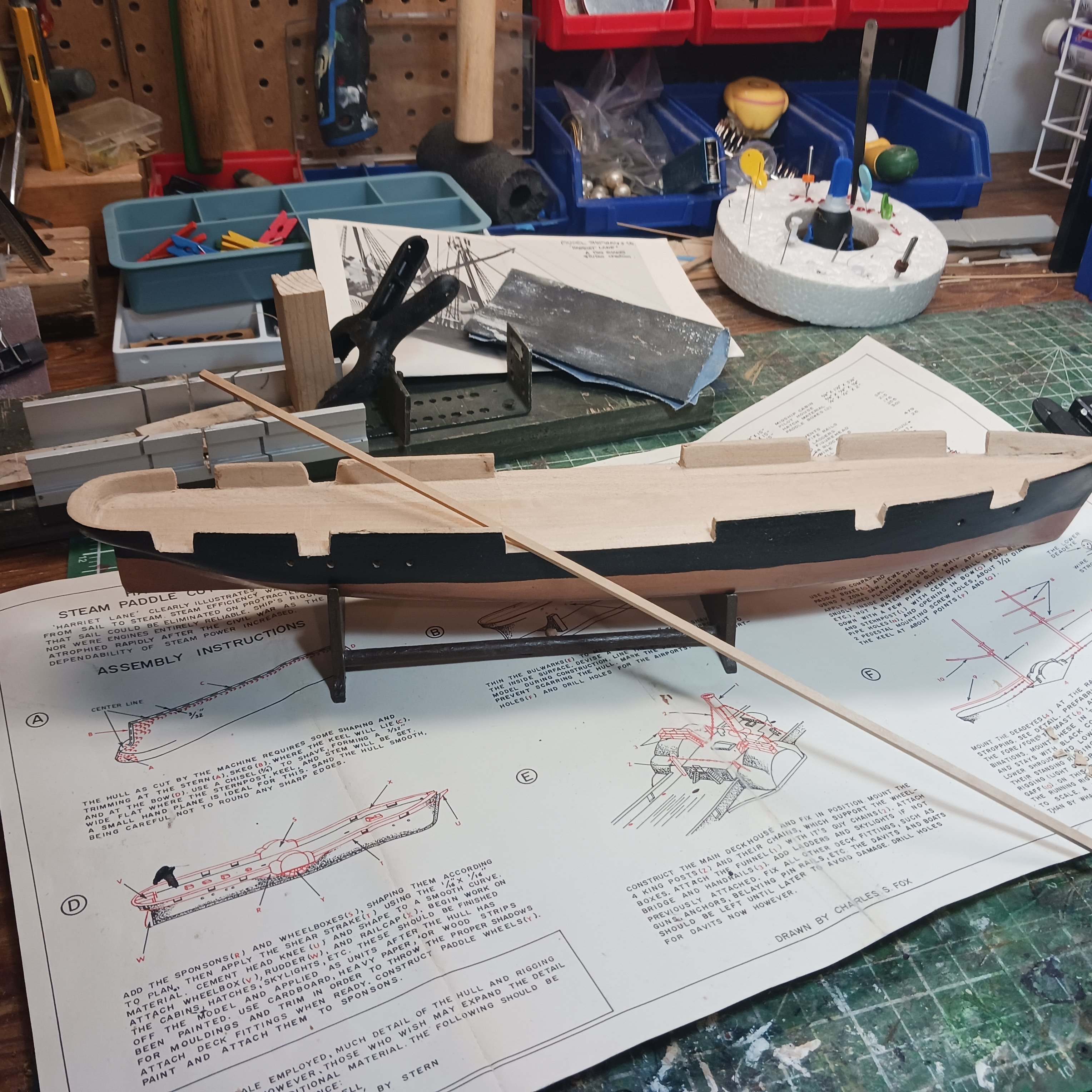

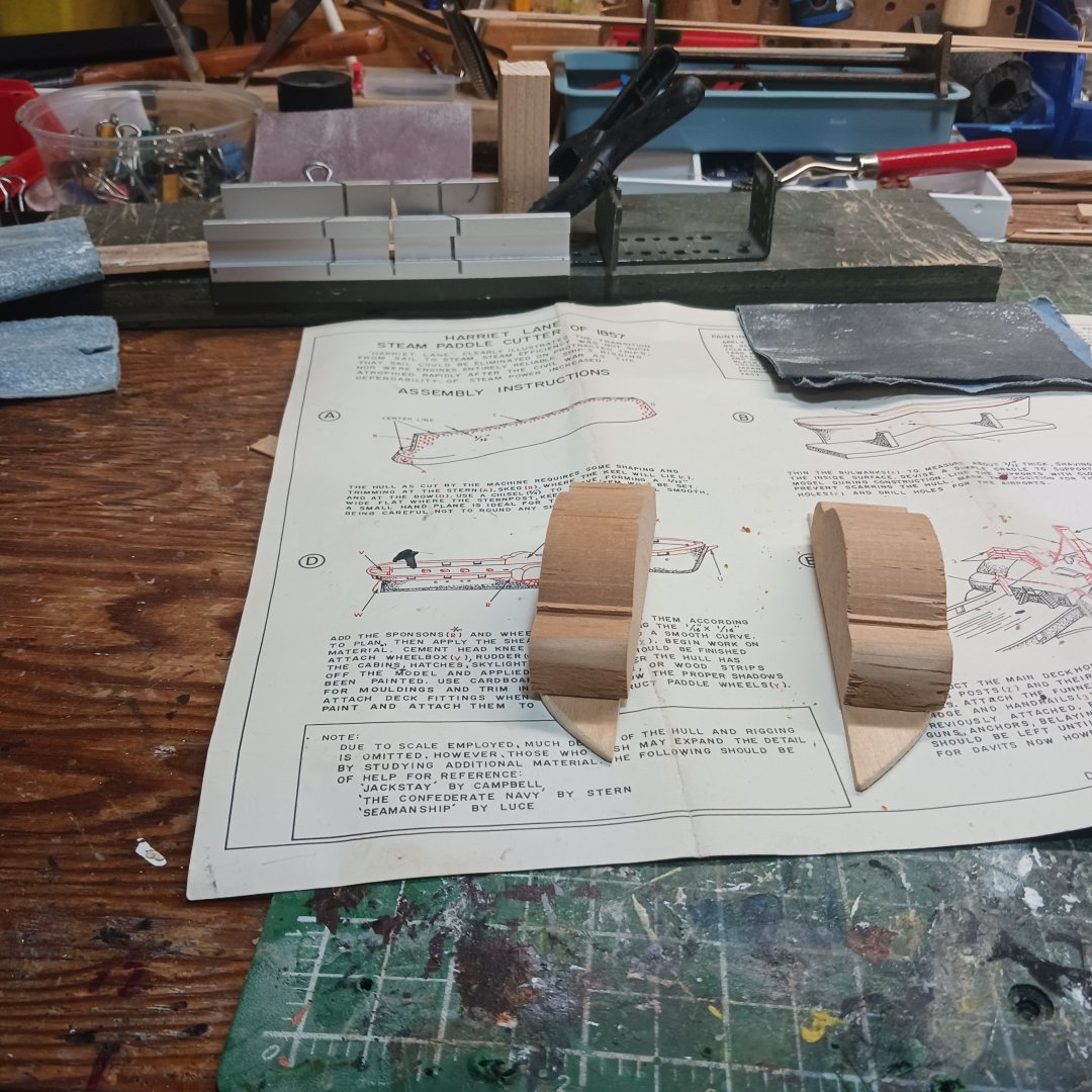

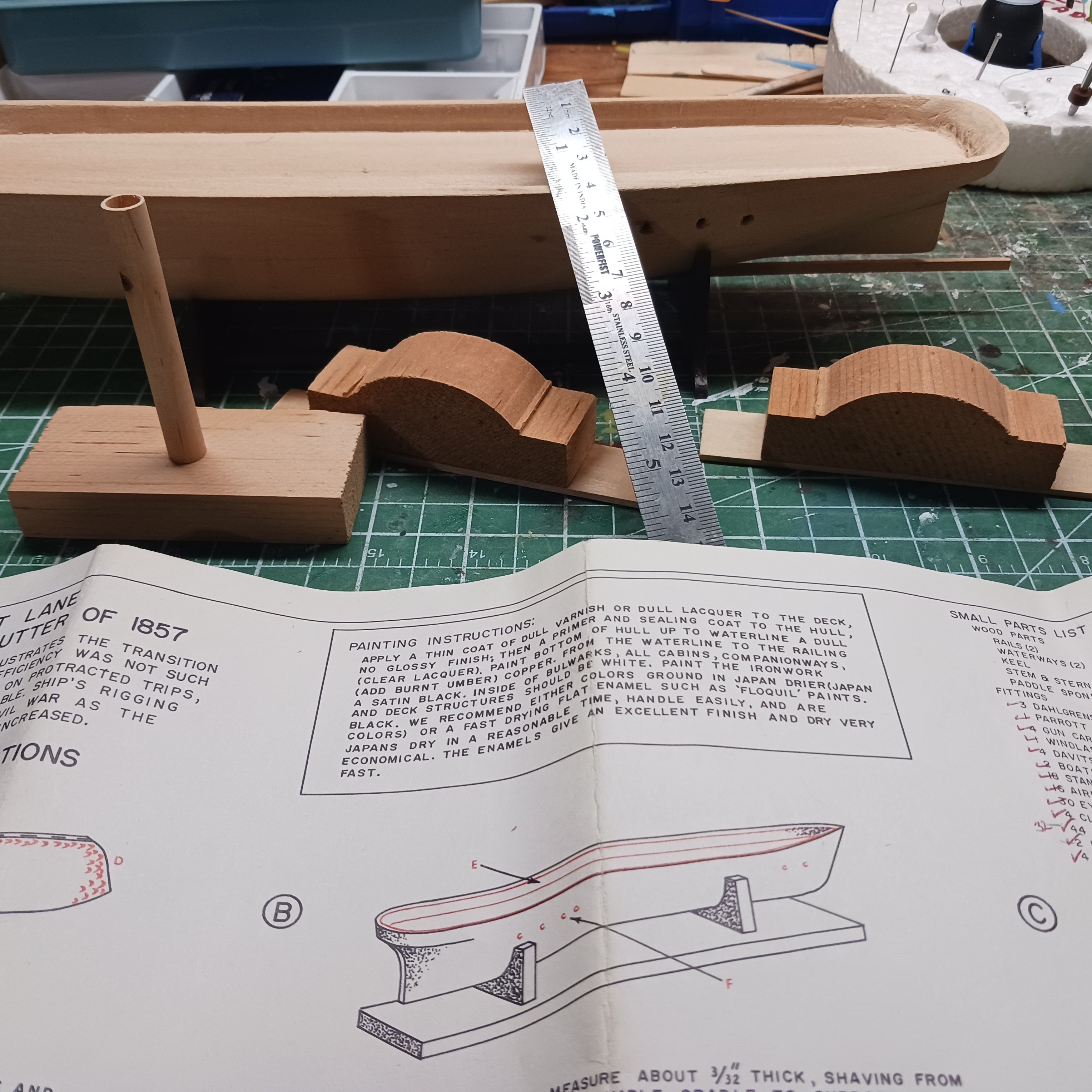

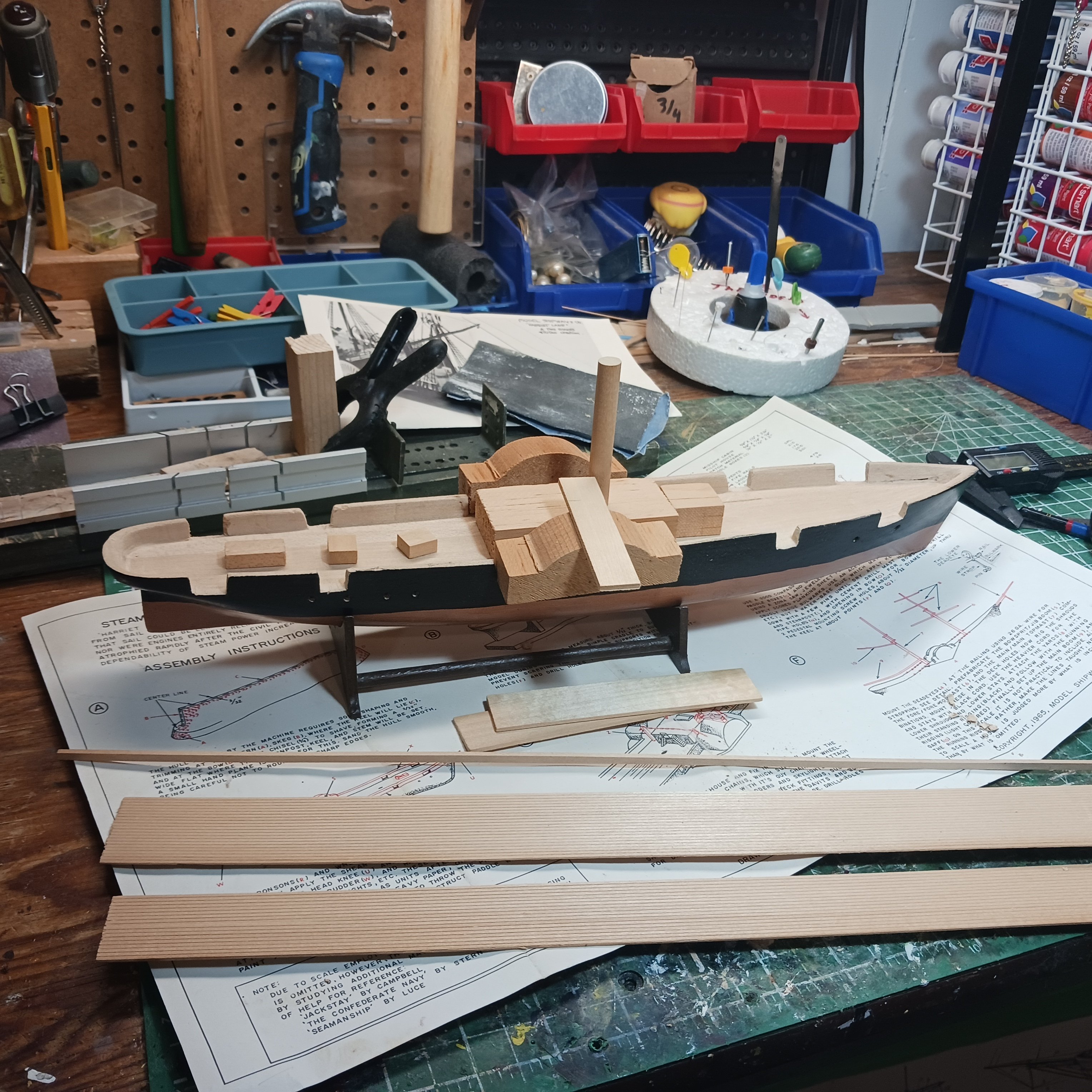

Taking the measurements off the plan I hope they are in the right stop, I cut it all.

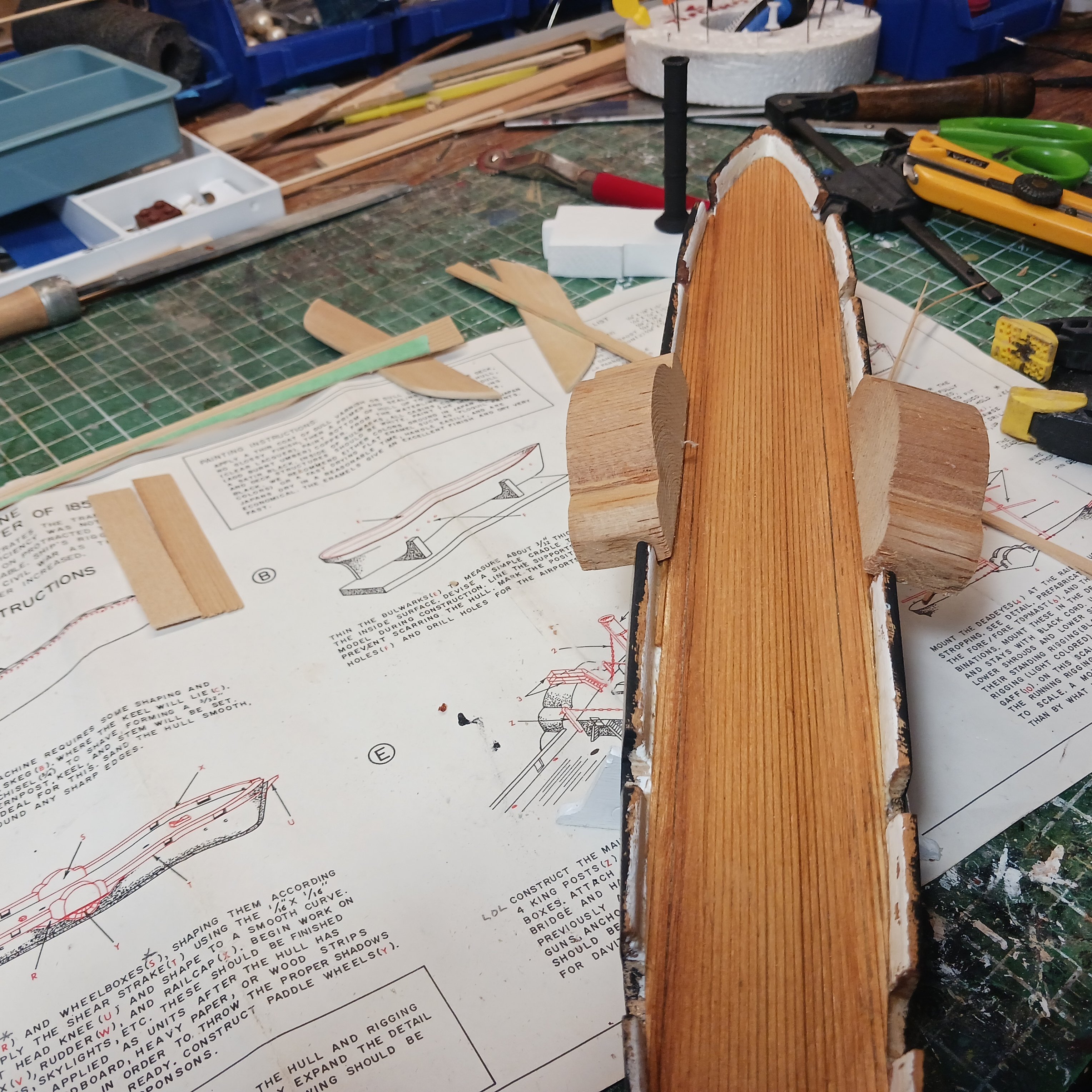

Now its time to install  the keel, then I will work on the  wheel box and the pilot house and the stack, thats it on top of the wheel house lol.
The decks look ok , I have a plan for the decks but I need to check some logs first  to see ifI can do that.
 Research,  the HL, was 180 feet length and 30 feet wide. It had three 9 inches cannons  and a 30 lbs Rifle. Also it was black and white.  The USCG  used this ship in its first formation of the coast gaurds, I think, 🤔,  more research needed  lol.
 Having  way to much fun in the ship yard today, it must be the Christmas season,  or the 300 clove hitches the USCG Harriet Lane  has, :D
Sponson , wheel box up next.

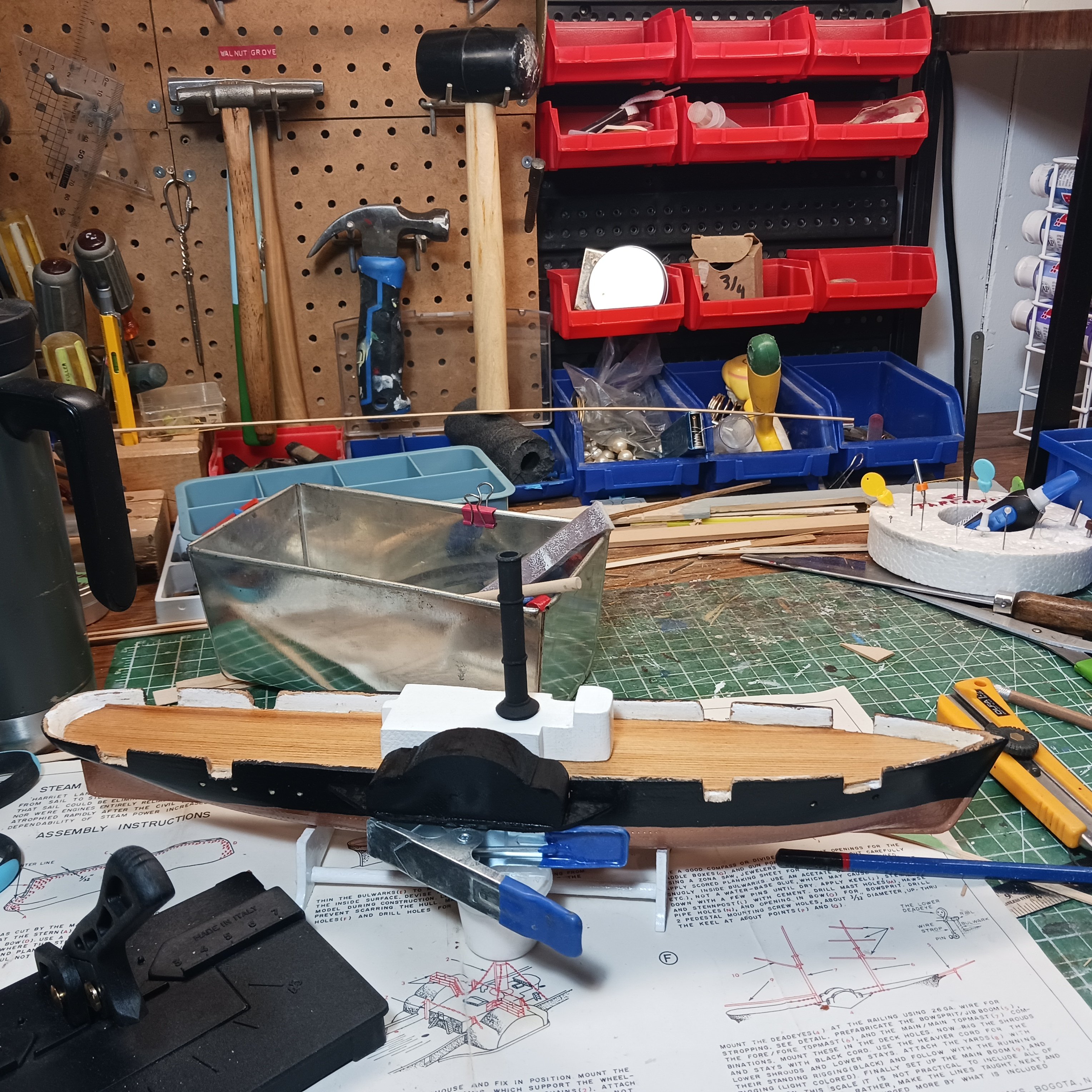

All the openings are cut, time for the keel.20251208_190254.thumb.jpg.4771ead09c54b80b8653c31701ebc193.jpg
First coat on the pilot house,  and final coat on the hull. An attempt at riveting was made , I  will see what it looks like when dryed and in place. I  have to wait till tomorrow to install the wheel box, they need to fitted to the hull before I paint them.20251208_190326.thumb.jpg.4c8f07866664d8be714493402a72d80f.jpg
Tomorrow I will make the butterflies,  paddle wheels lol. @Keith Black are your paddles all the way around, mine only  get glued to the bottom,  lol only half a butterfbutterflie ?
Going to put a second  coat of white on the wheel house and call it a night.

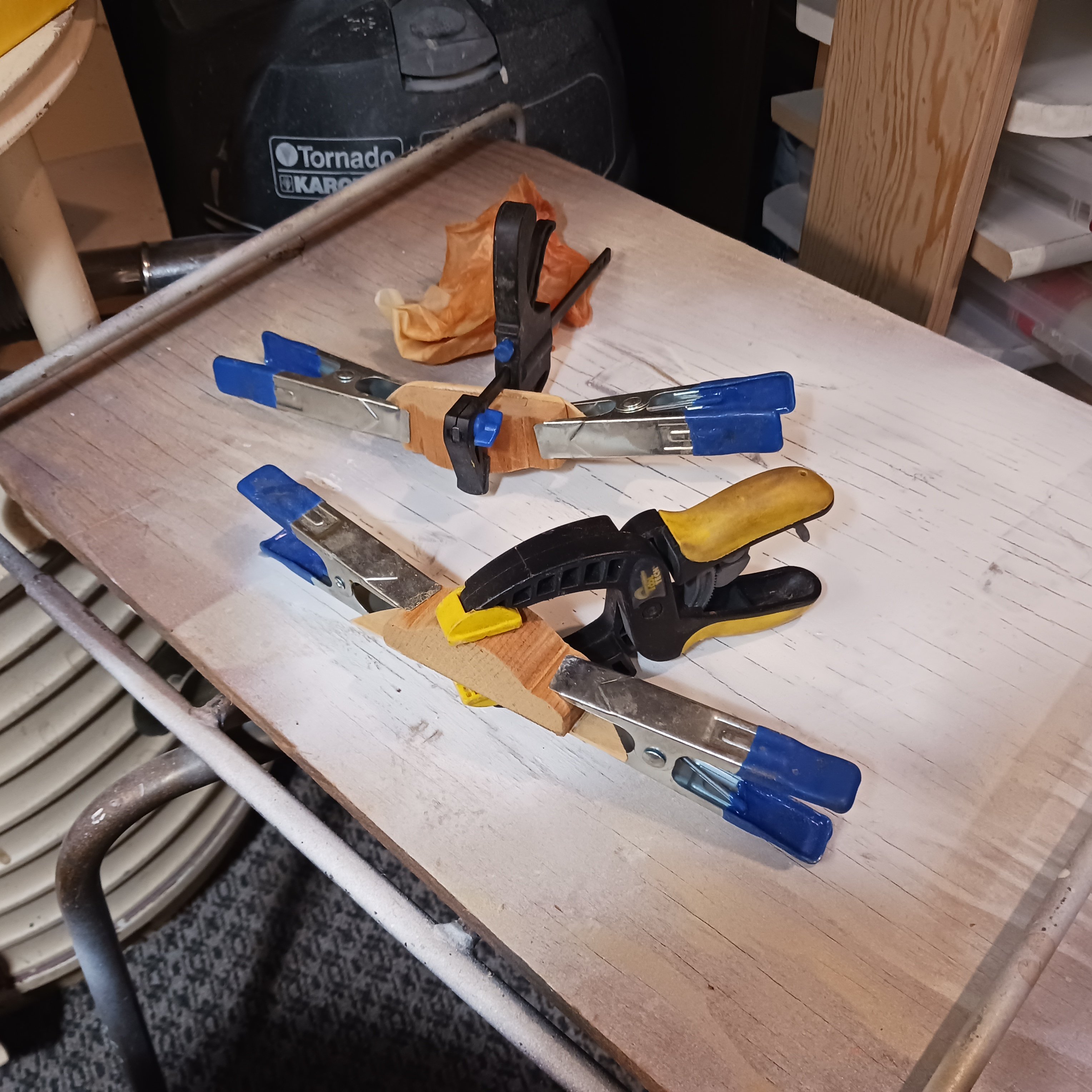

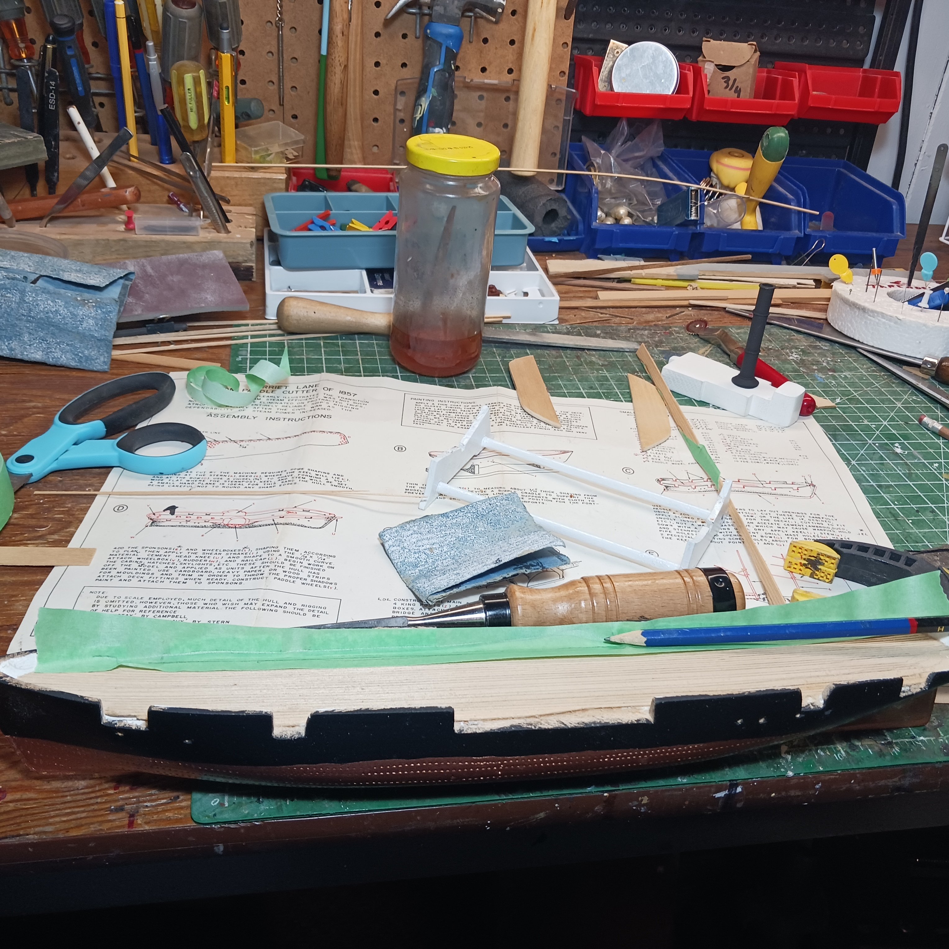

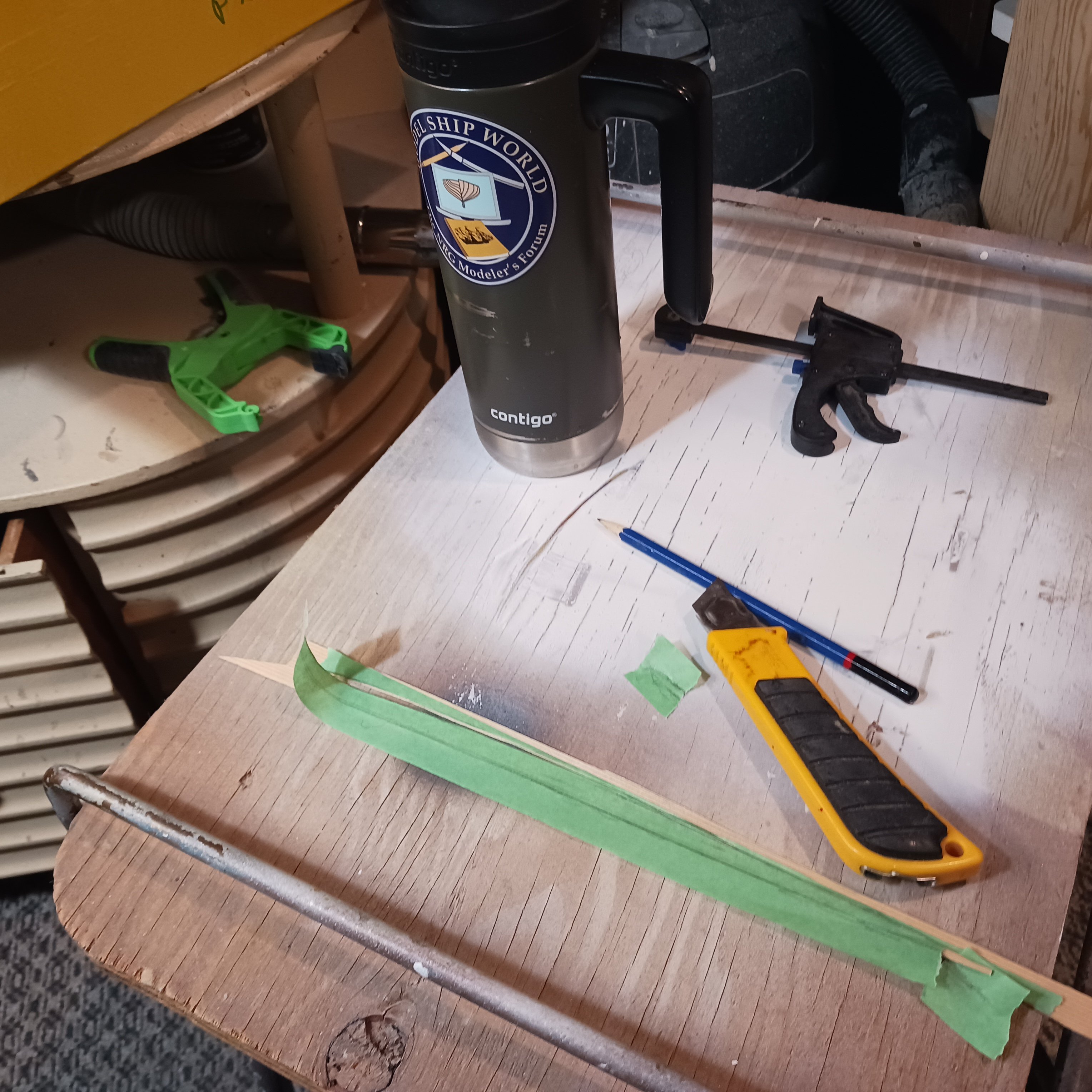

 I installed  the deck this morning,  I  laid a piece  down the center,  and made tape copy for the side cut them glued them on.
On to the wings, oh yes, I stained  the deck, Honey maple and gave it two coats of shellac,  I love shellac  it drys fast , paint you got to wait, and watch it dry lol.
I like the chopper I got from Amati,  it sure saves time and my cuts are nicer, lol.
Once the glue drys, paint. 😆

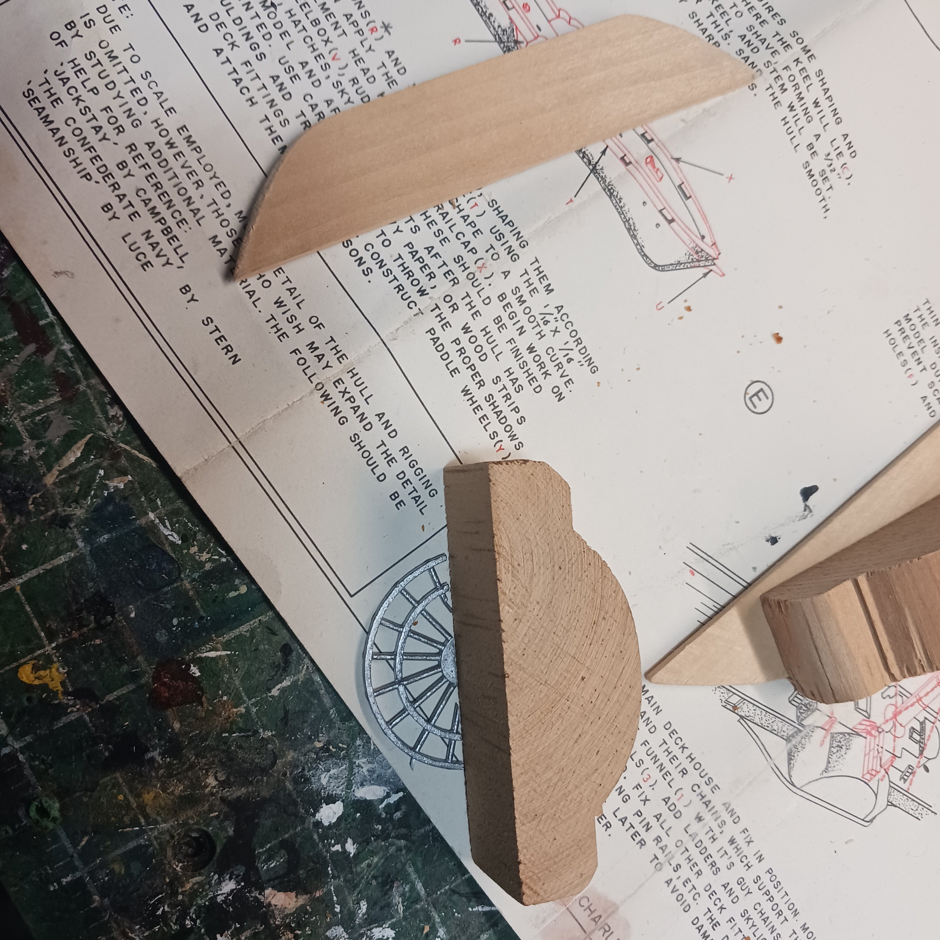

 The kit pilot house plans are not so good,  I looked at all the logs for the Harriet Lane  and found everyone made there own,  I will have to see what I come up with, as I don't like the paper decals the kit has. UP grade lol.

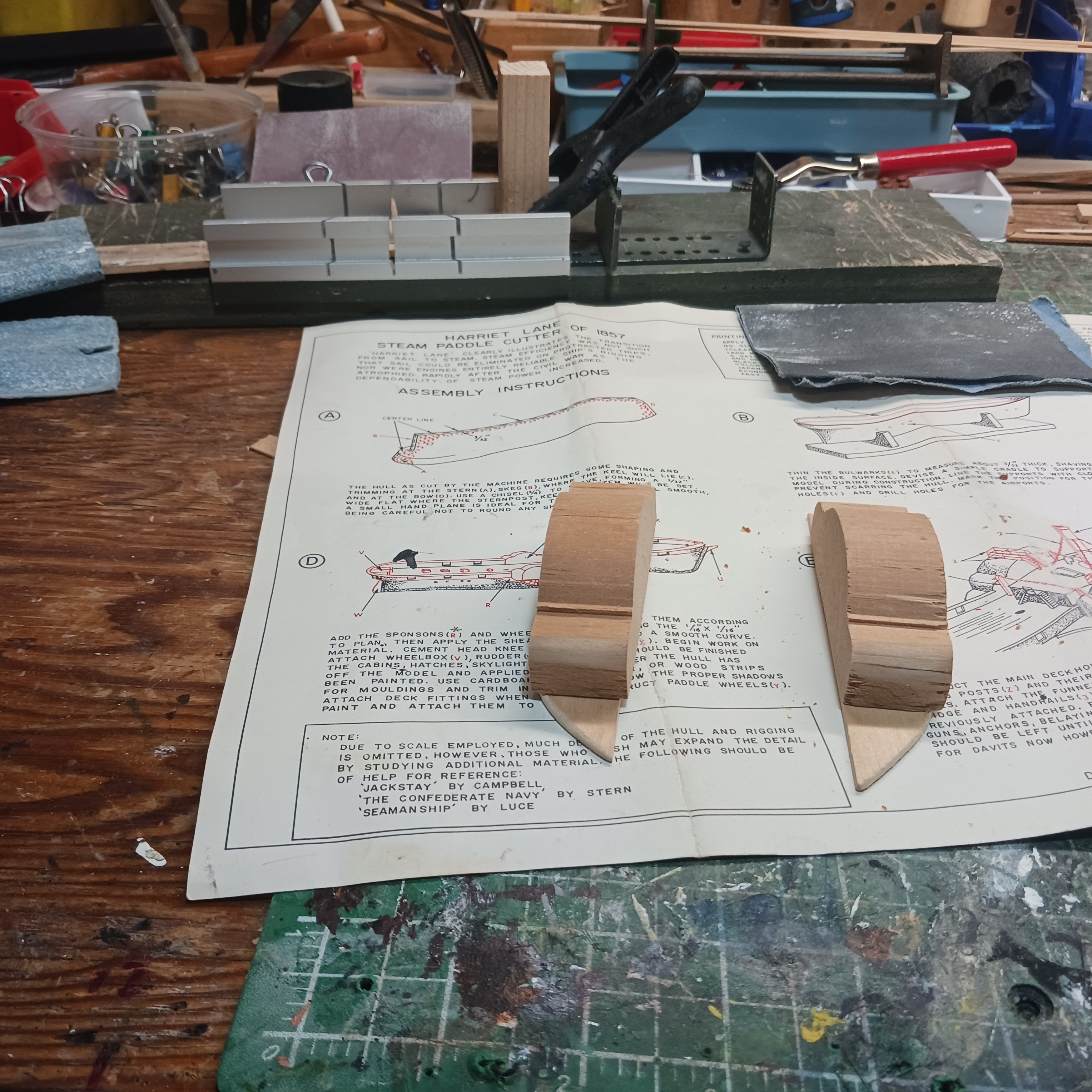

This is Captain Steve, he will be along for the journey.  He will be placed on the bridge when completed.
We started of making the paddle wheels
Materials were gathered and the first wing was on. Time for the decal, poop, They were to old and just floated up in pieces,  I could only watch as they slowly  disintegrate in front of my eyes. Oh well I hope Modele Shipways have more, got to find out.
With the decals destroyed, that took the wind out of my sails, oh well luckily 😉  the Harriet Lane has an engine and sails ,so time to fire up the steam engine and carry on.
But first off to find new decal, 😔
Even with one wing on she looks great.
