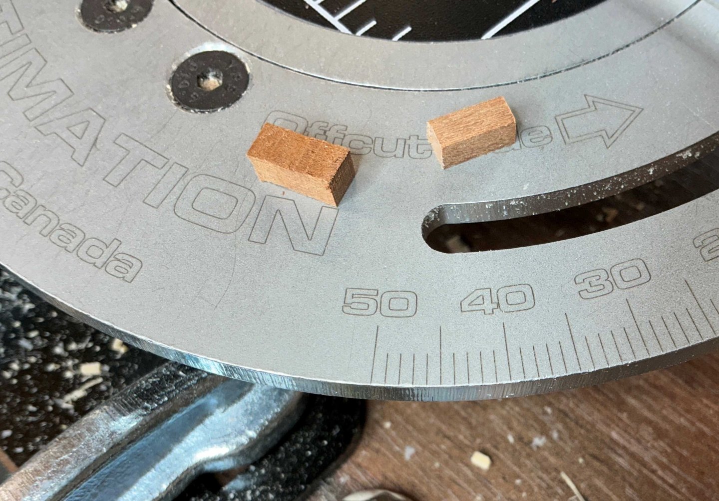

The  piece on the left is 5/32"x 5/32" pear and the piece on the right is 1/8"x 1/8" cherry.  It cut okay but I wouldn't want to try anything larger. I agree with @RossR's evaluation.
Best Regards……..Paul
