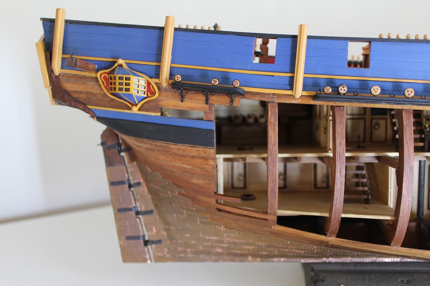

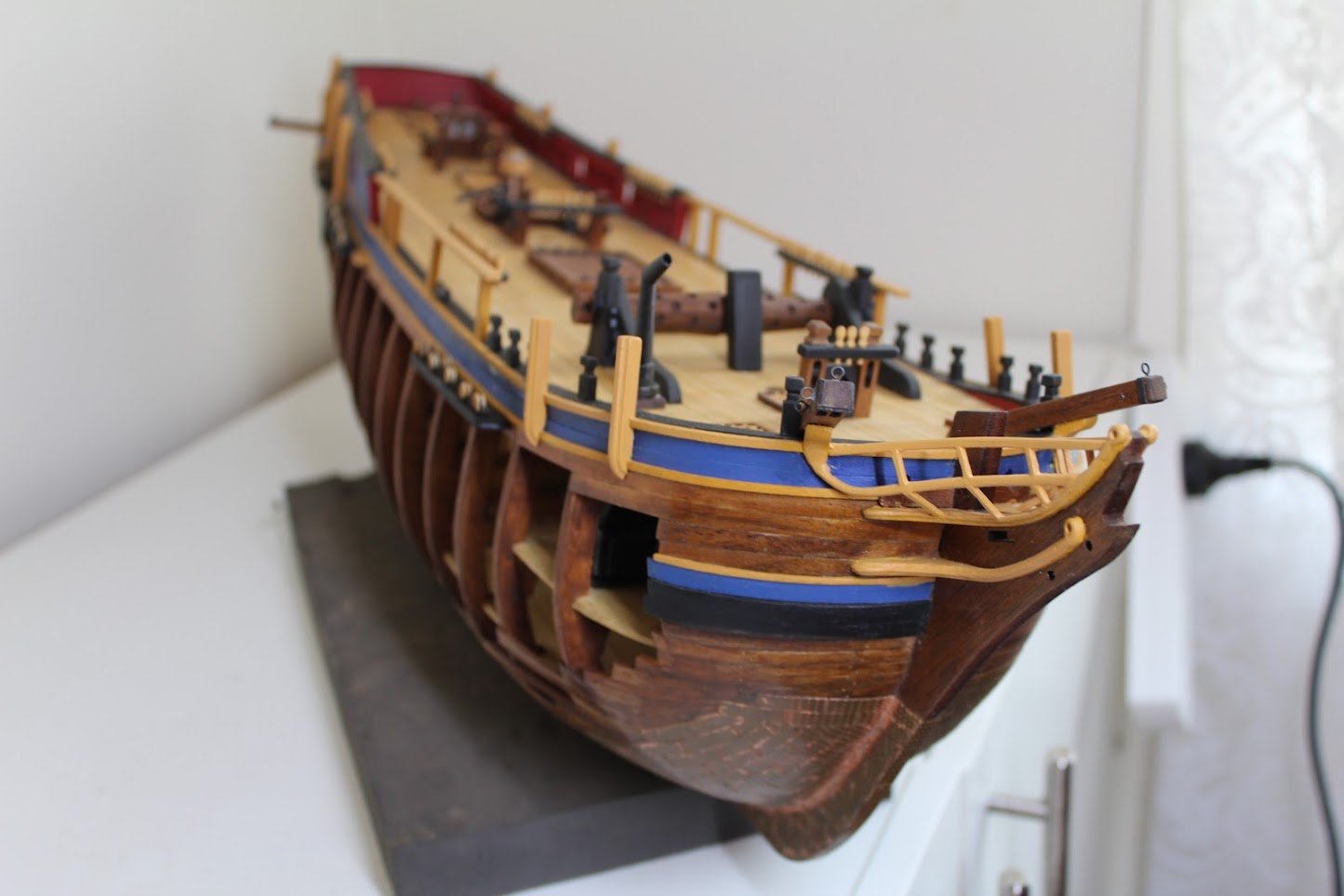

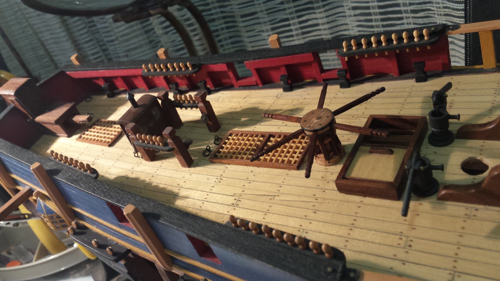

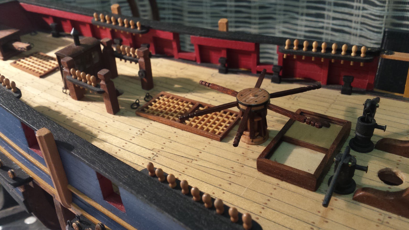

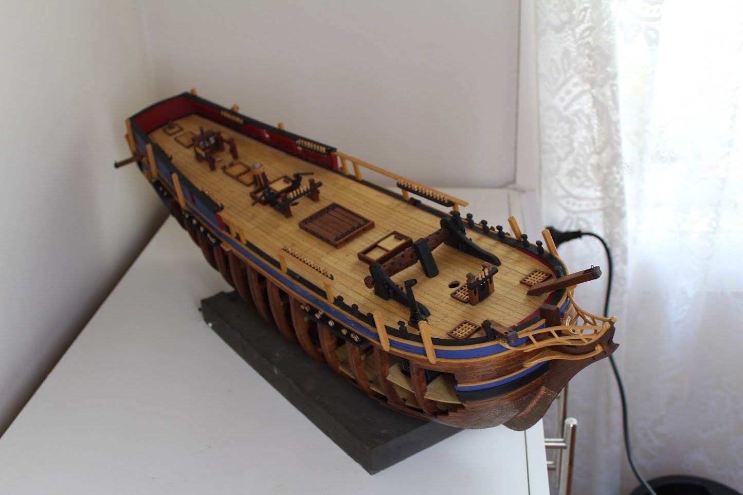

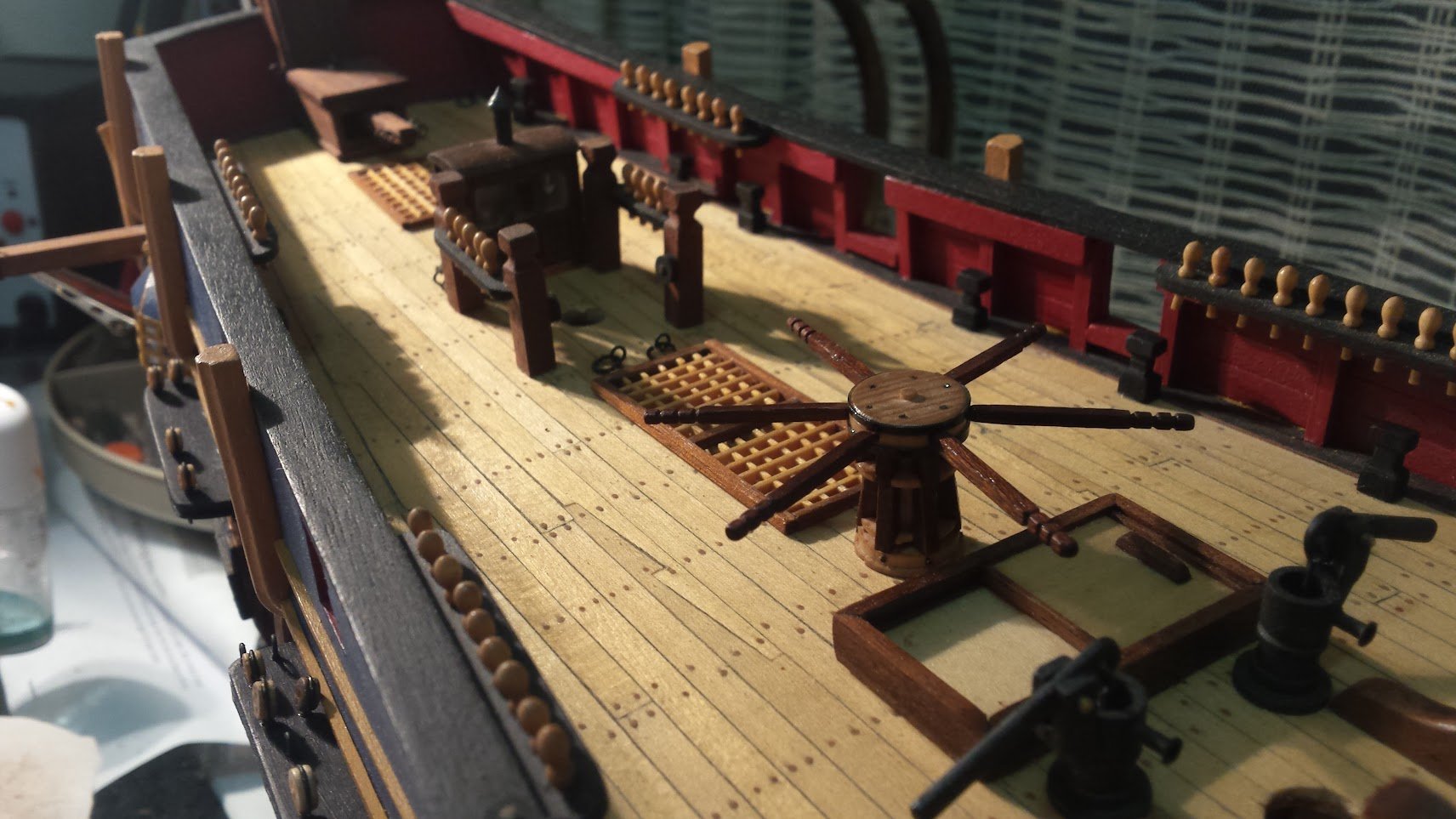

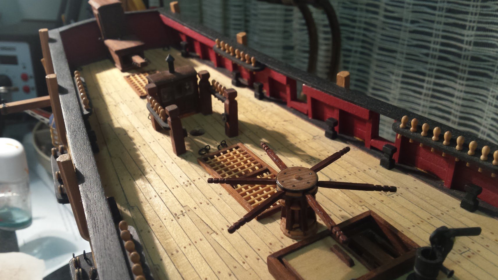

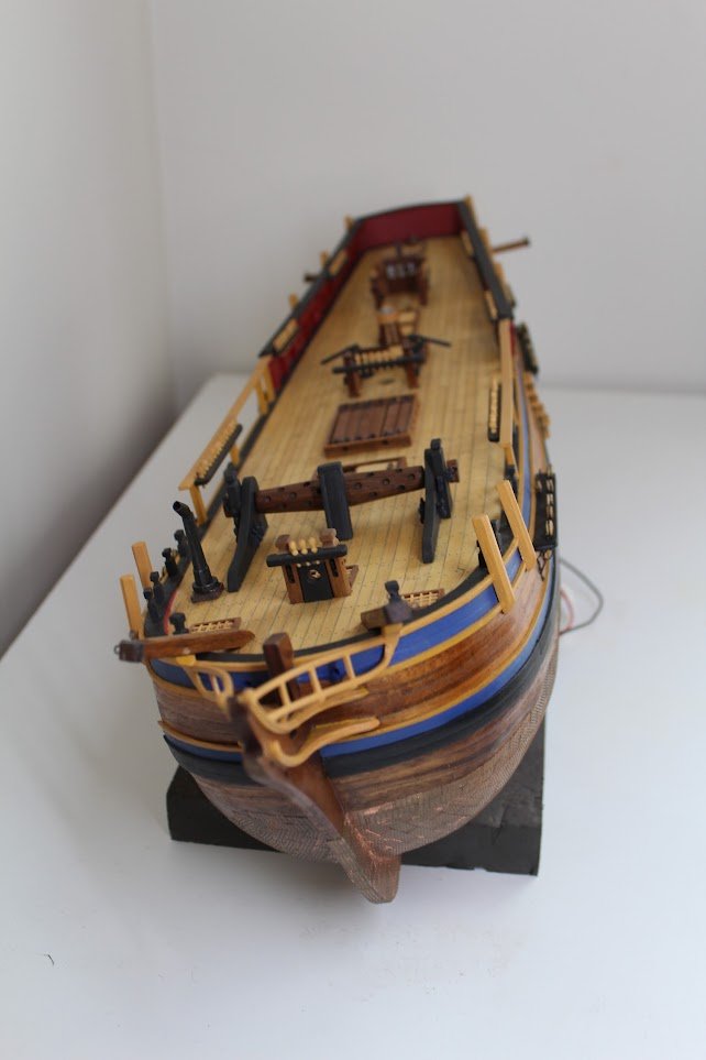

  1. I havn't shown these images anywhere (yet!) but I started this kit around 15 years ago. It was my first model ship, halfway through I got frustrated with the poor accuracy of the kit and the extent to which I was having to kit bash. I moved on to another model which took almost 10 years but it is done now, so the Bounty is back on the table and I -will- finish it, despite now being able to see the mistakes I struggled with all the questions you have posted. I tried to answer them all as best I could and build as accurately as I could within the reasonable constraints of what I could do with the kit. I can't tell you the exact numbers (long replaced by nother numbers in my head) but maybe you can get some ideas from the photos. I tried to get the planking pattern, plank widths and details as accurate as I could find out would have been used in the period. Actual numbers on the Bounty (as far as I could find) do not exist. You should be able to take any information from period ships of similar kind and shipyards and expect it to be 'pretty close'. Some details to note; - Planking pattern - Plank widths (non standard don't match the original kit) - Wider perimieter plank - Planks taper towards front of the ship and bend inwards (not just straight) - Scarfed joints These photos are from ~2017 after I finished the deck. The model is largely complete now up to the rigging...just held up by me needing to learn to tie knots better. Maybe if anyone else sees this old post and is asking the same questions I can feed off their energy and get it done.

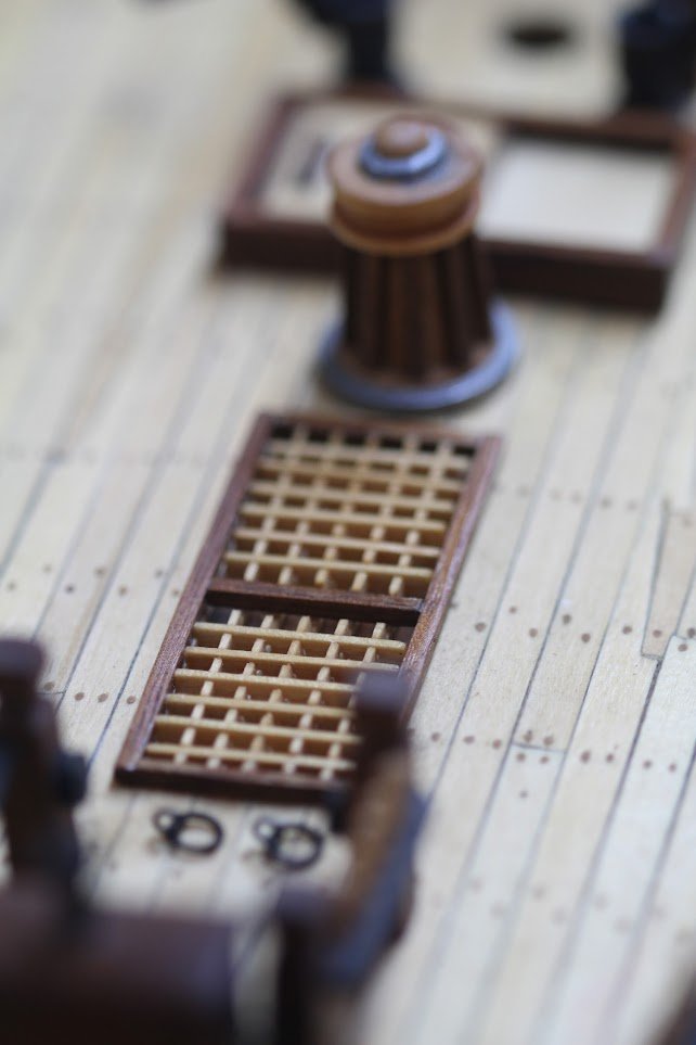

  15. I drill a hole less than 0.5mm and shove a tooth pick in it, snip off and sand. Very quick. Here are some pics (i'm certainly no master, this was my first build...so it is very easy to do!)
