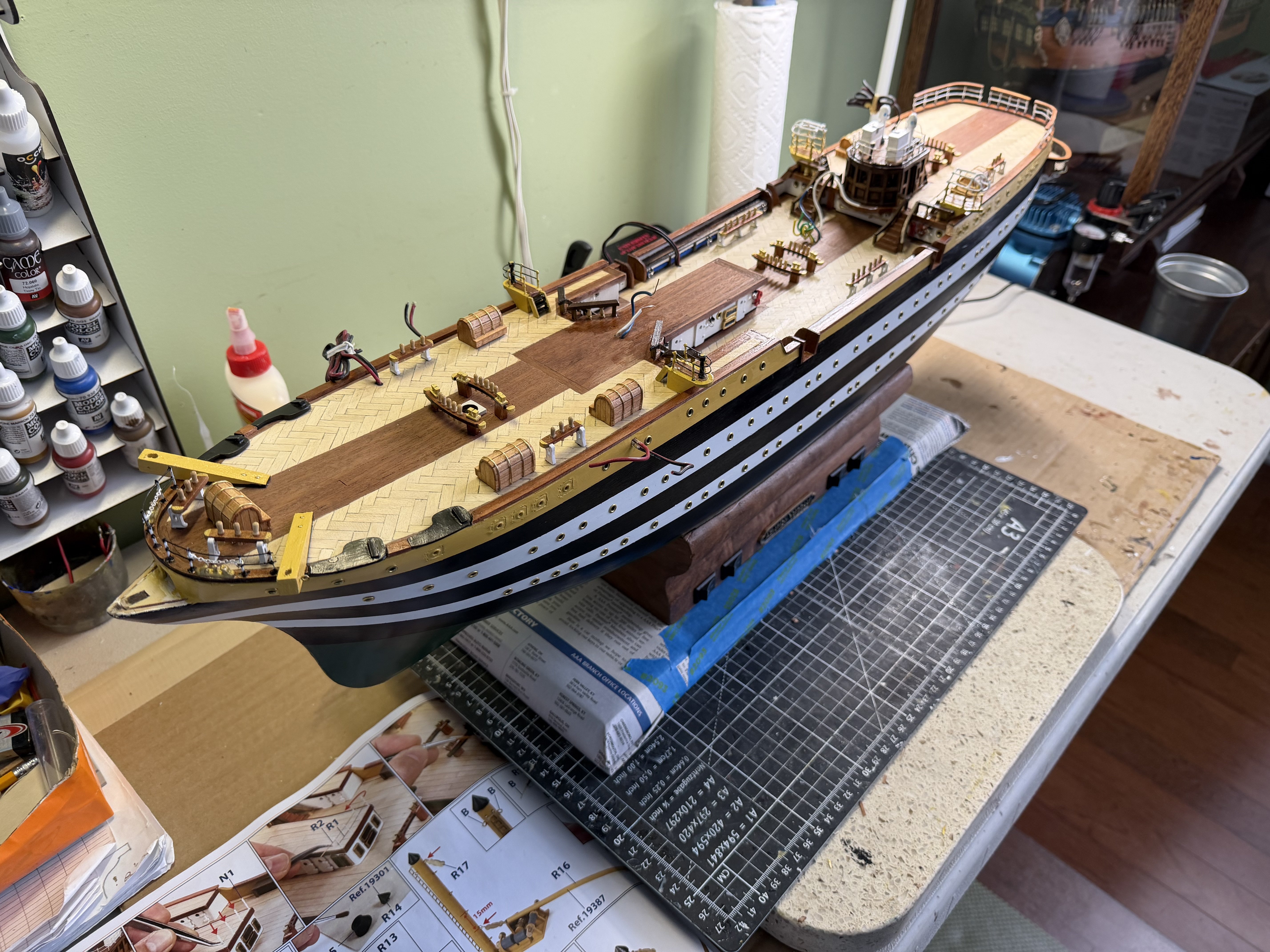

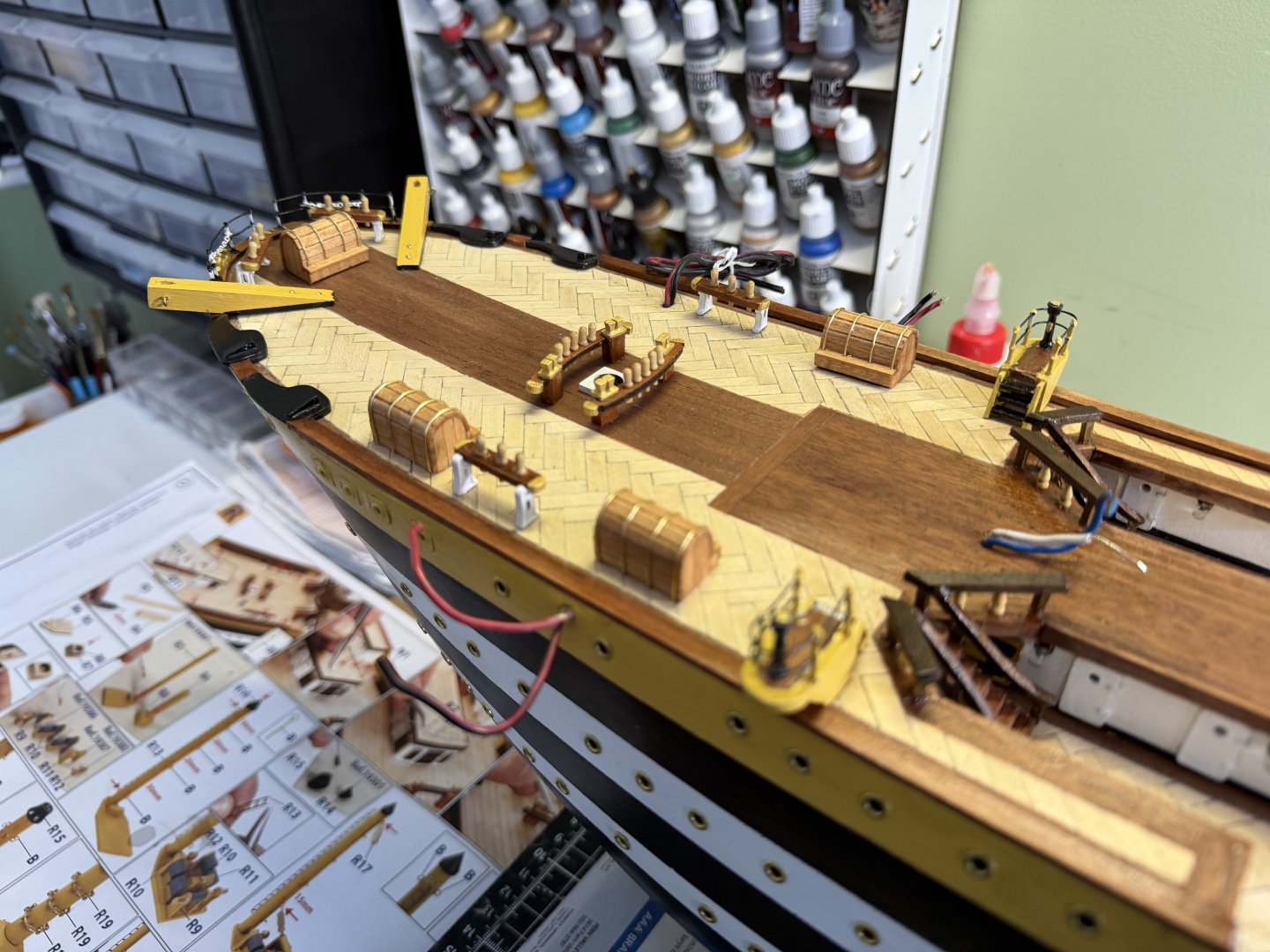

  16. Daniel I made an interesting discovery. LED lights are brighter viewed from the top rather than the side. I researched this a little and found it is definitely true. This will add a degree of complexity to my lighting plan if I want uniform brightness. My plan for the side portholes is to mount the LEDs horizontally close to where the port hole will be. This will give maximum brightness through the port hole. However for the deck structure interior lights, that will be on the same circuit(s) using diodes, my plan was to mount them vertical in the deck inside the structures. This plan results in dimmer light shining through the windows and portholes compared to what eventually will shine through the hull portholes. So if I want uniform brightness I will need to mount them horizontal as well
