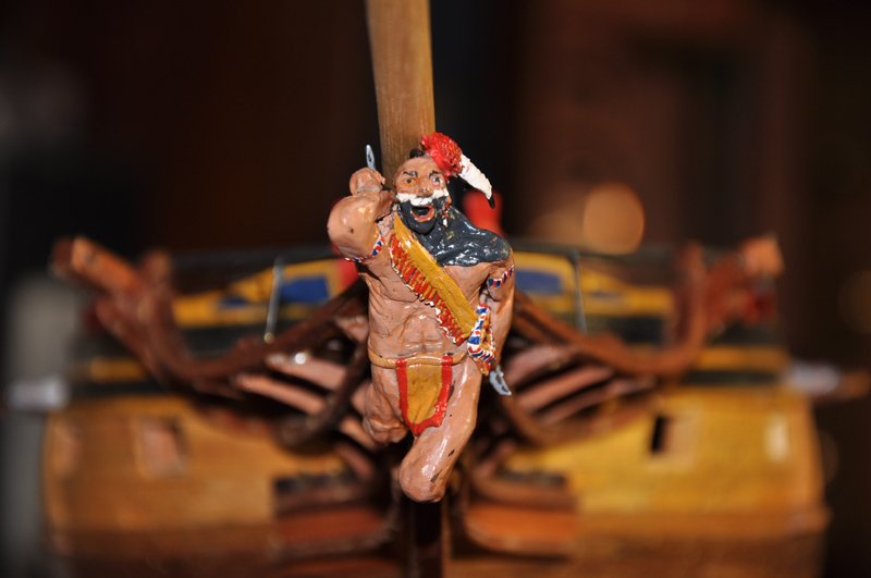

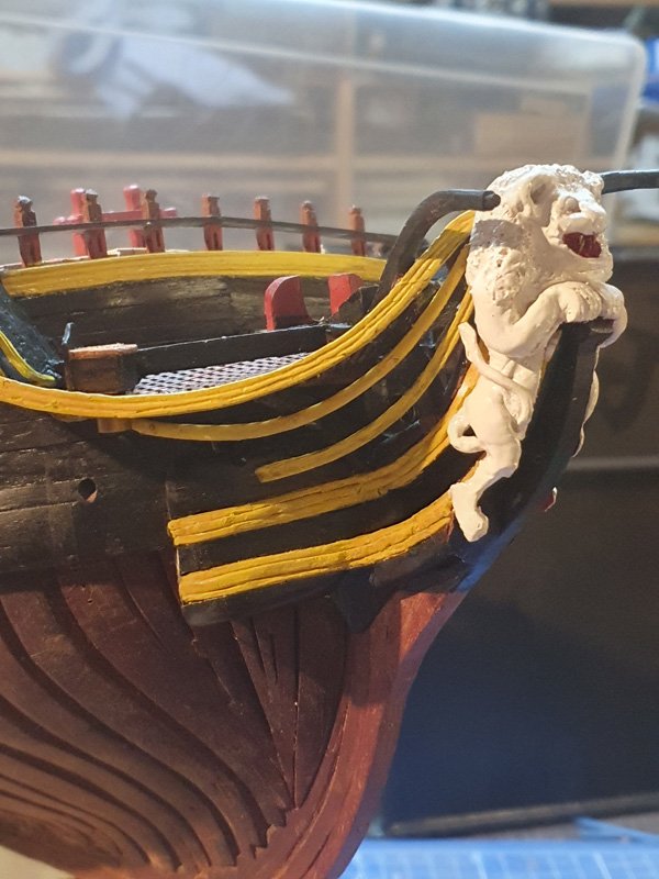

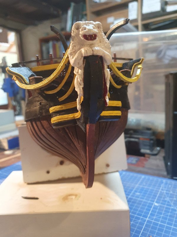

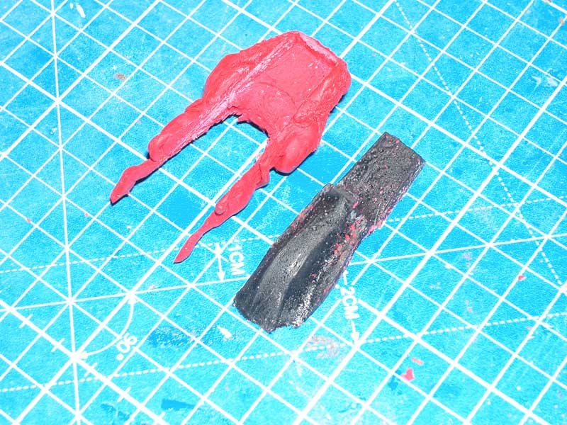

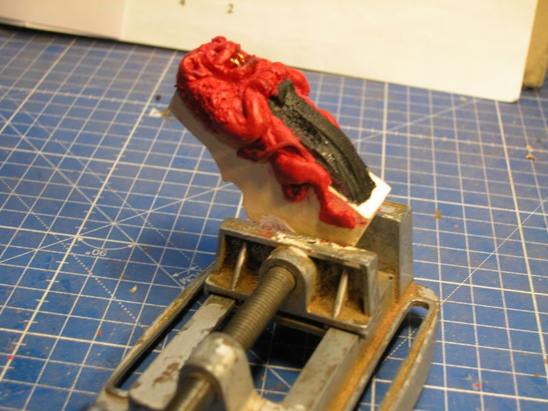

I had a rush of blood to the head and tackled the Lion and I won. I am no woodcarver but have used Sculpy to make decorations and figureheads before. Here is a fierce murderin' Mohawk from my Essex To make the lion figurehead I took a plasticine mold from the cutwater and head rails and cast it in resin. I then molded Sculpy around the cast and shaped according to plans. The Sculpy was cured with a hot air gun and painted off white. I think it looks more like a lion than a teddy bear. Cheers Dick
