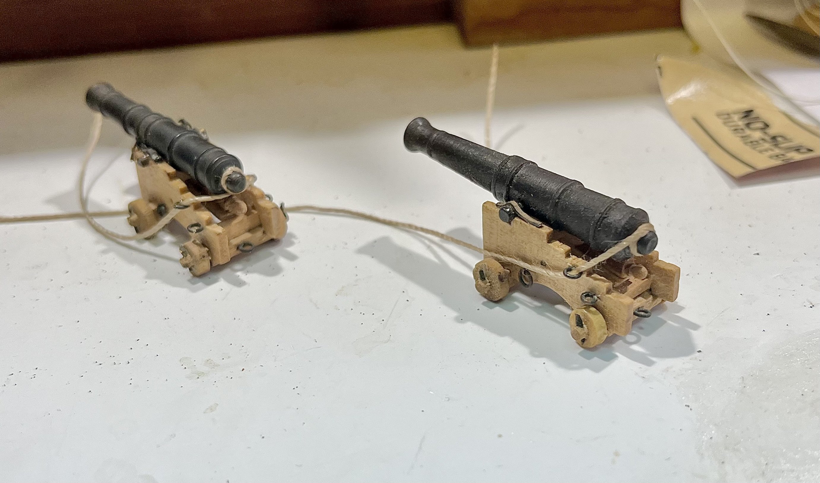

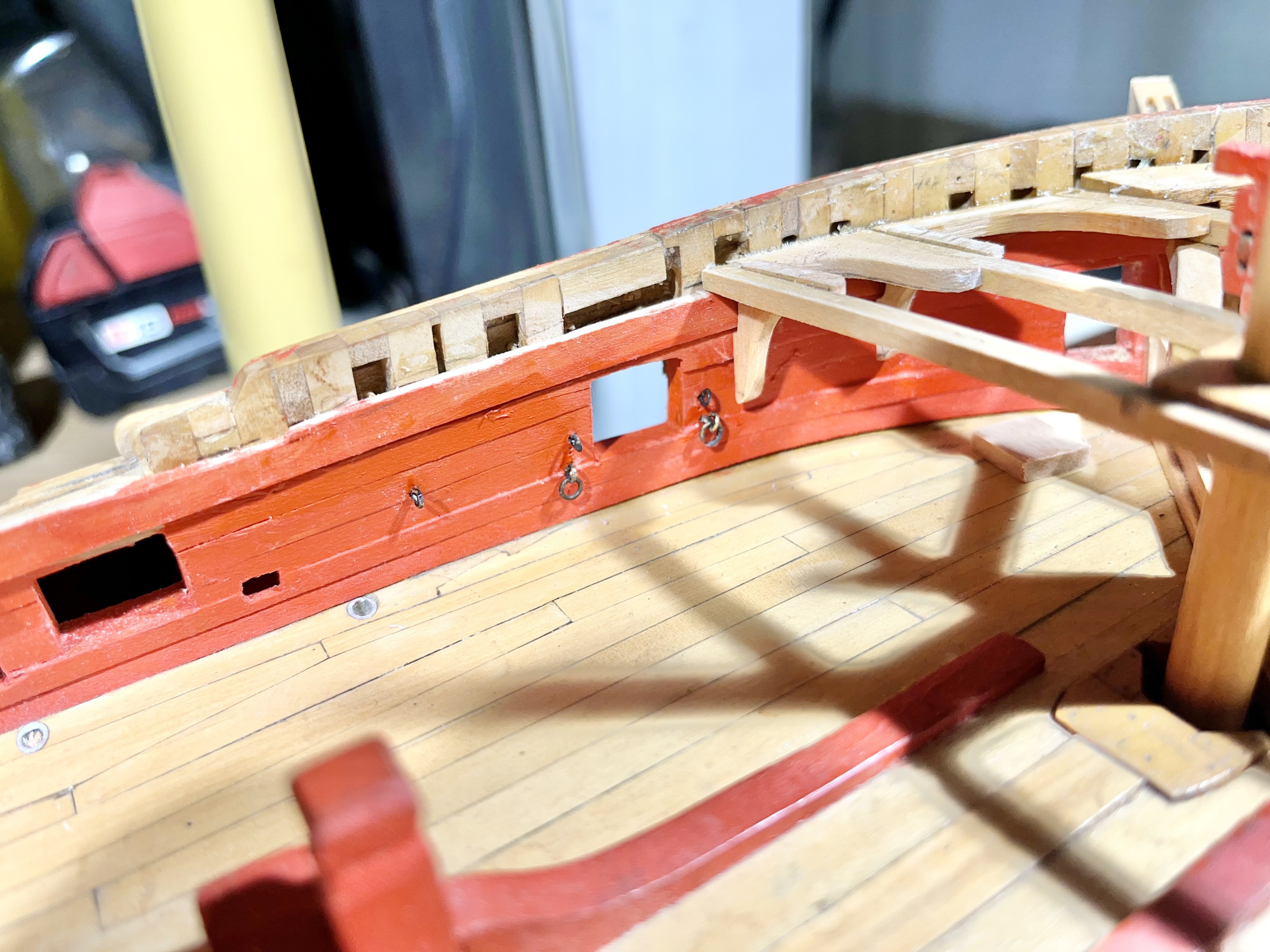

I may be seeing things wrong but it seems the eyebolt in the deck is too close as the gun doesn't look like it can be haul back.
Alan O'Neill

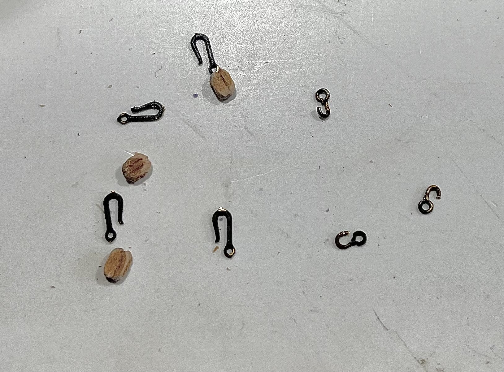

You are right and wrong. I wanted to install the cannon back from the gun port. That turned out to be an error as  the aft train tackle ended up  to close to the eye  on the center of the deck. This was caused by the blocks being too long. I have now been able to reduce the hook down to about 5” while in real life it was probably 3” in length. I just cant make it smaller than this and even this method  is a bit of a cheat as i had to remove the eye at the end of the hook. It will be better on the port side. In any case this will all be sealed up and no one will be able to see it, just you and me.
