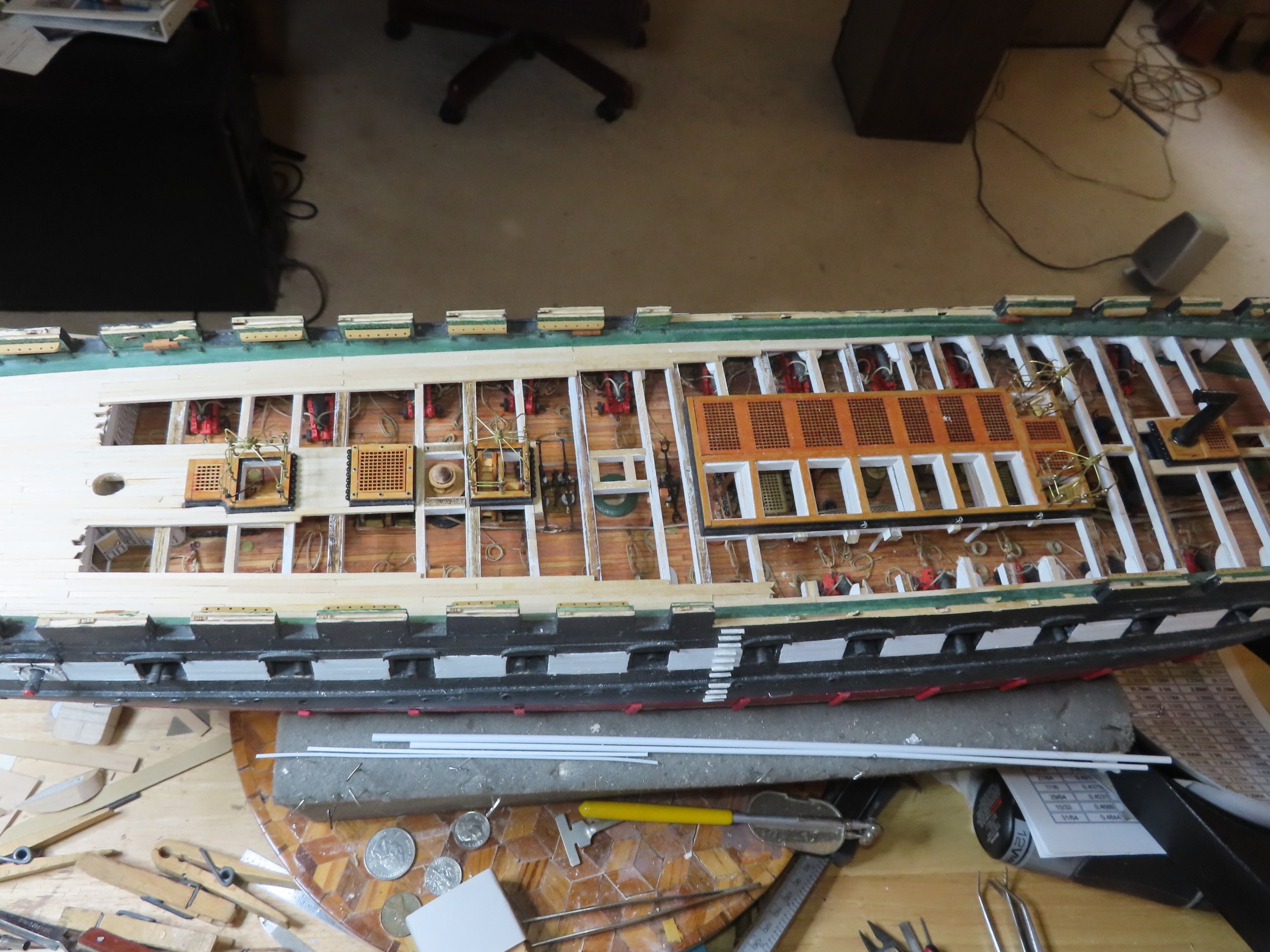

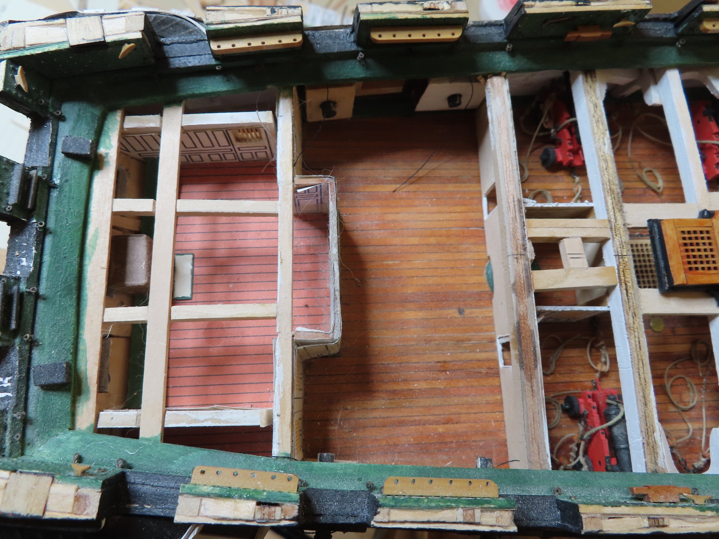

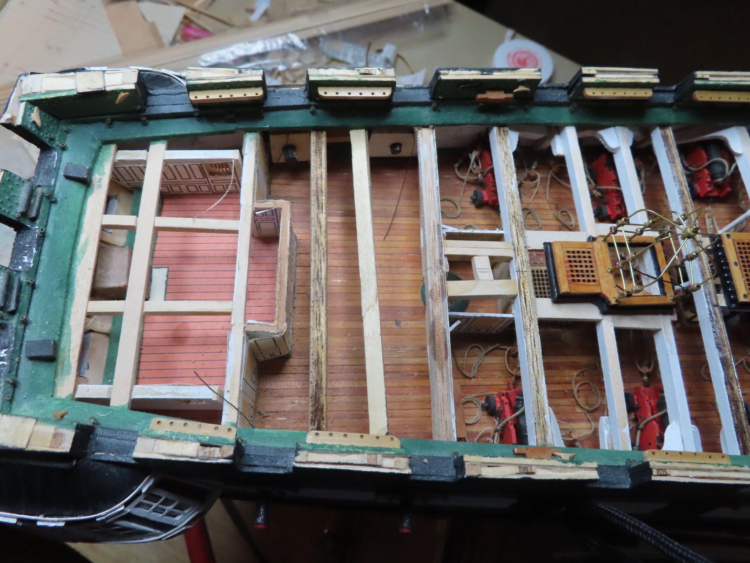

In order to install the captain’s skylight and its railing, requires that I start planking the aft section of the spar deck. It’s been a while since I last planked the gun deck, so I reviewed the practicum on deck planking. It reminded me that I had to stagger the planking joints about ¾” apart in the adjacent rows. And where the two planks butt up against each other requires that there be a support beam below the joint. It was then that I realized I had a big support gap above the dining room area. I originally left this area devoid of beams because it wouldn’t be seen as it was to be completely covered with planking. However, it turns out that I did need them to support the butt joints.

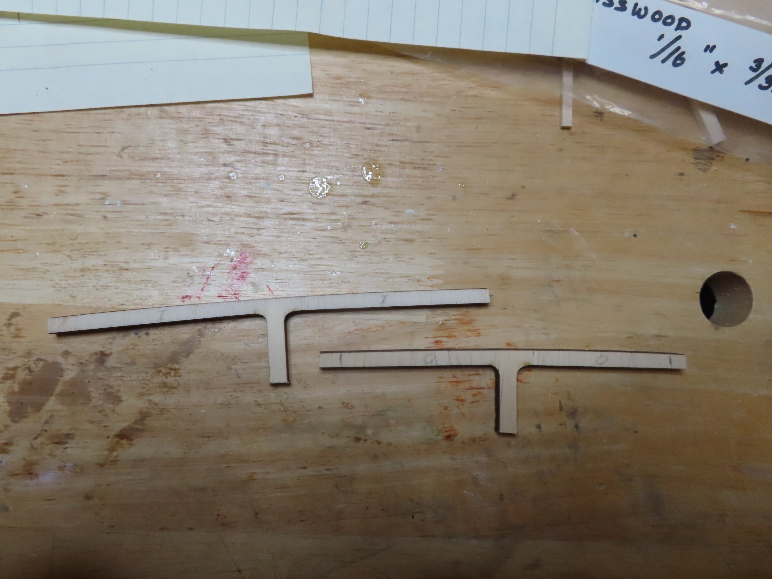

I don’t throw anything away while building a model. I still had the last two remaining support beams I originally cut off the bulkheads way back when. I needed these because they had the deck camber I needed. To use them, the vertical support was cut off and the width adjusted to fit under the spar deck waterway. I just had enough room to maneuver them into position and glued them into place with WellBond.
The MS plans show the planks tapering towards the stern on the spar deck, with the planks from 3/32” wide to the transom at 1/16” wide. The model’s far aft area of the stern is to be fully planked. I started the taper of the planks per the practicum, from the most aft hatchway.
Unlike the gun deck, the spar deck does not have a plywood sub-surface for planks to rest and adhered to. If I had not opted to create the gun deck, it would have. Still, the planking is relatively easy to do although I had to make minor adjustments as the support beams were not always at the proper height as I thought they should be. Also, in order to provide as much viewing space to the gun deck below as possible, I wanted to plank the minimum number of strakes to support the carronades. To determine that, I finally took out one set of 3-D printed 1812 styled USS Constitution carronades I bought from Model Monkey a number of years ago to use as a measuring stick. These are the vertical angle, screw adjustment, type. Just to reiterate, because the 1927 restoration version (with the wedge adjustment) on the actual ship are known to be historically incorrect, all the carronades on my model are to be of the more accurate 1812 style.

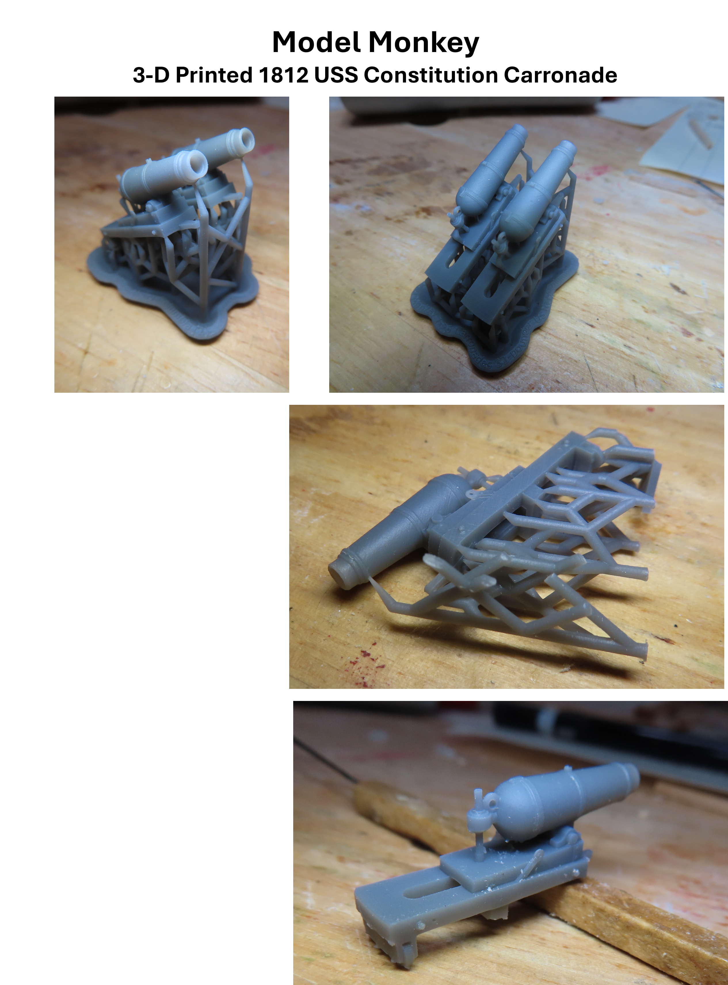

After I removed the excess spruce from the raw 3-D printed carronade, something didn’t look right. Looking at the available US Navy plans for the 1812 carronade and carriage which matched the few 1812 style carronades on the actual ship, there were some glaring differences to the Model Monkey versions. The sled (the part that slides back and forth on the skid) was perfect. The skid, however, was much narrower. Also, the pivot base on the nose of the skid was fastened to the bottom of the skid. According to Karl Heinz Marquardt’s book “The 44-Gun Frigate USS Constitution ‘Old Ironsides,” their diagram matched the Model Monkey’s version with one exception. The pivot plate was fastened to the top of the skid, to rest on the sill of the gun port (which the actual ship’s carronades do). No way was this lower pivot plate going to work on my model. So, there are three separate versions of what is supposed to be the 1812 carronade:
  • 1812 version carronades installed on the actual ship now
  • Marquardt’s, diagram
  • Model Monkey 3-D printed version
and this doesn’t include the carronades installed during the 1927 restoration. Is everything clear as mud!!?? So, the conclusion is: NOBODY knows for certain what the carronades looked like in 1812! Therefore, as Captain of this might ship, I’m going to make the Command Decision to use the carronades I purchased from Model Monkey and modified the pivoting base…unless I change my mind. Now back to planking.

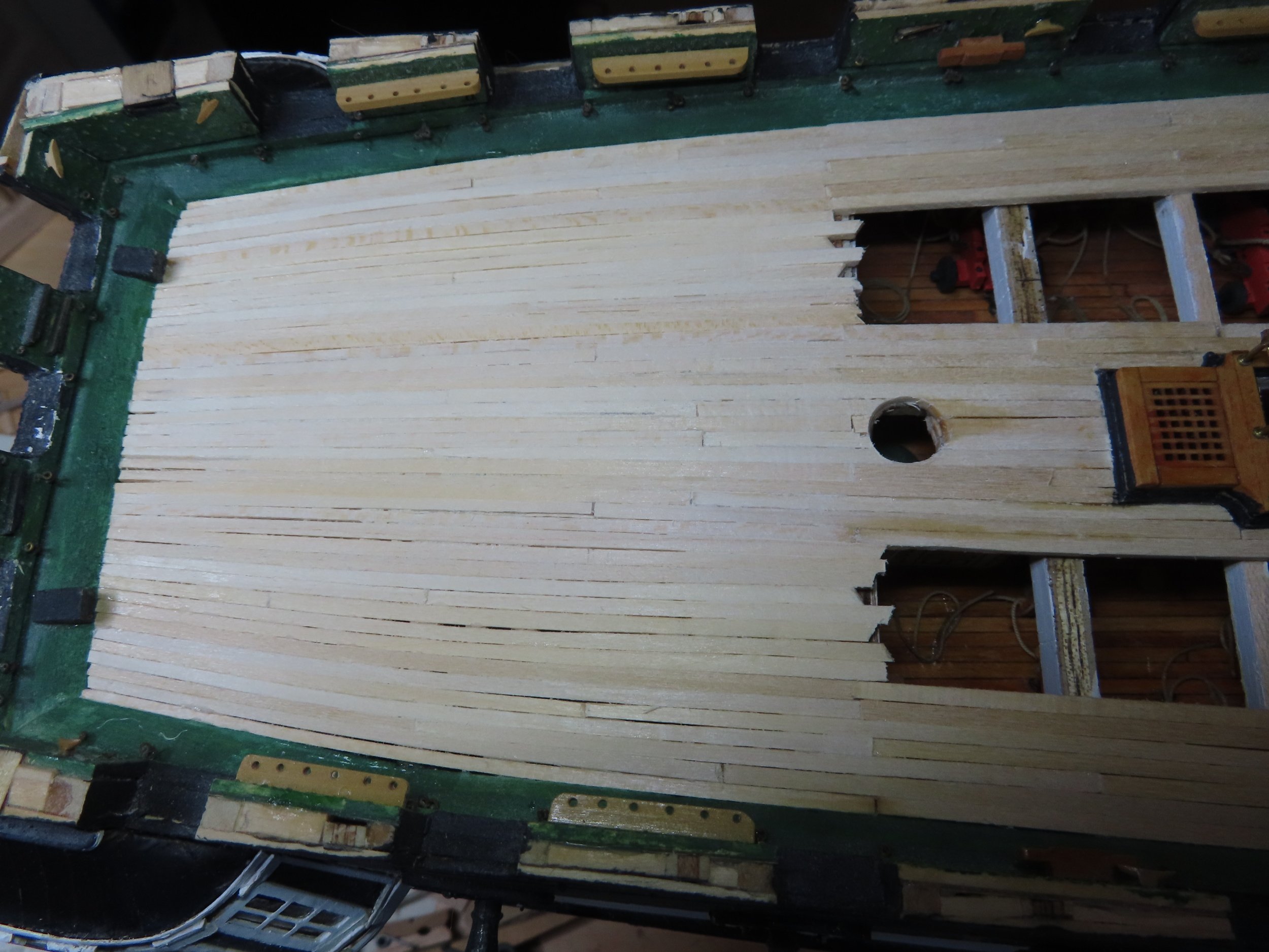

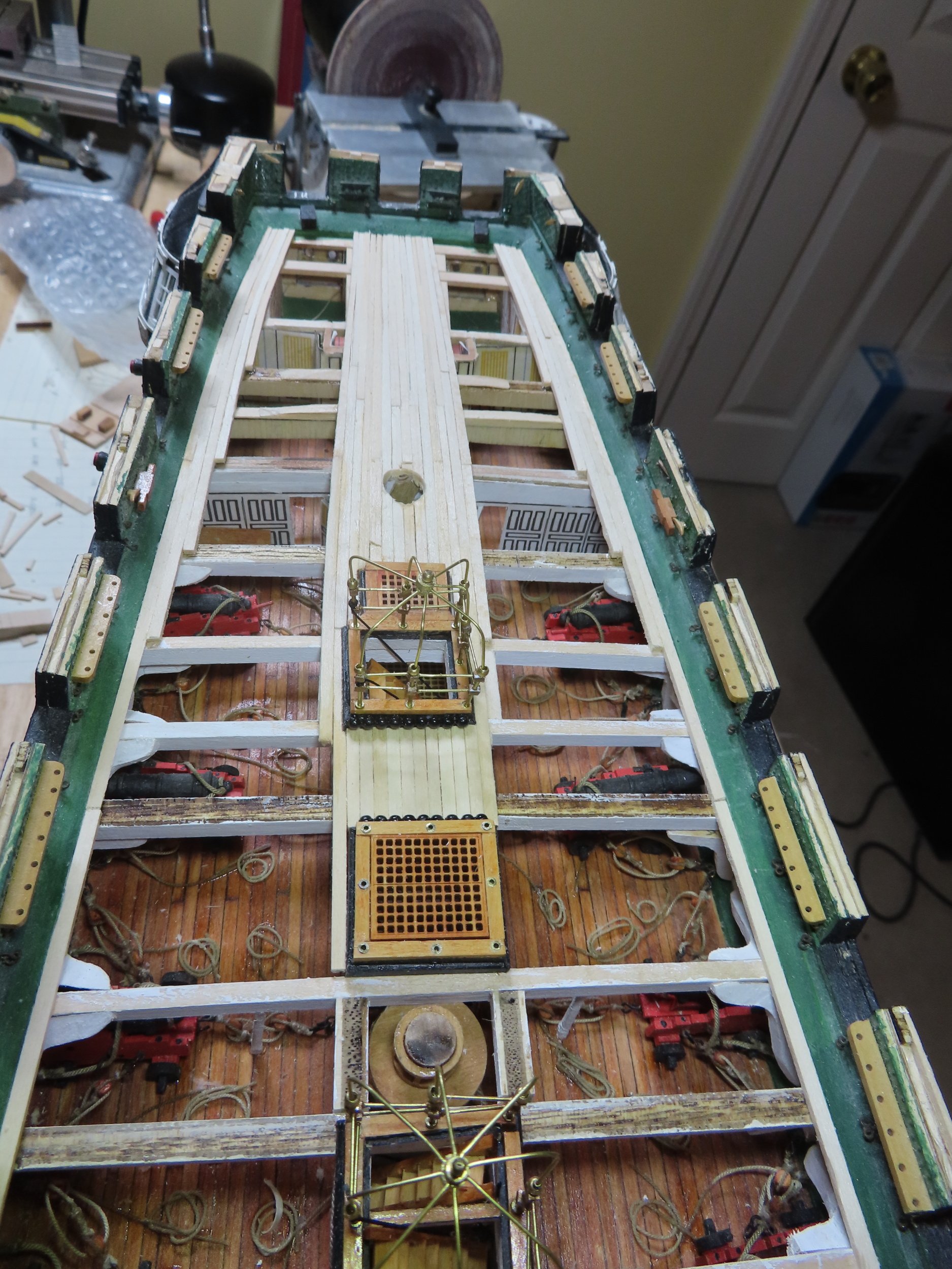

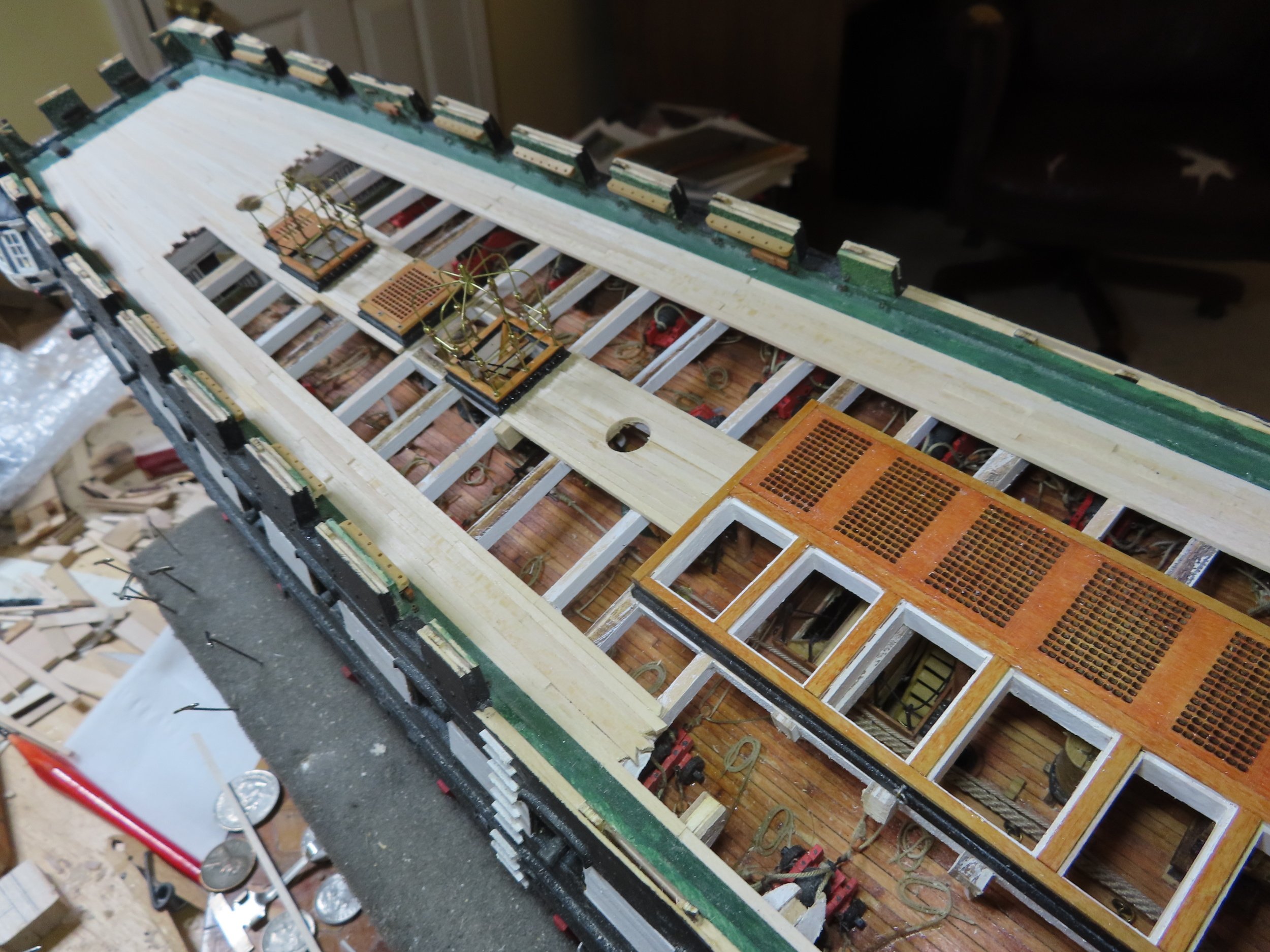

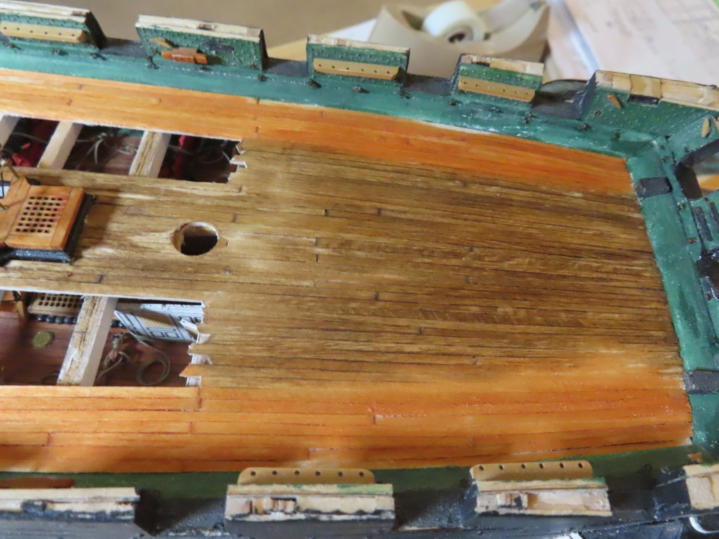

I started planking the center of the spar deck, starting from the capstan opening and working my way back to the stern until it filled in to the width of the hatchways. Then I applied the planks against the waterways, starting from the stern and working forward. The stern was fully planked to just forward of the captain’s dining area, then the plank voids will allow the gun deck to be visible. The forward areas are yet to be planked.
In your leaving the spa deck open to permit viewing the the gun deck below, is the intention to leave the planking, and I apologize for not having a better word for this, ragged?
As far as the carronades are concerned,  the beauty of the selection you made is that you bypass the obstacle of the overly wide waterways. Unlike mine, your guns will actually poke through the gun ports.
Good choice!

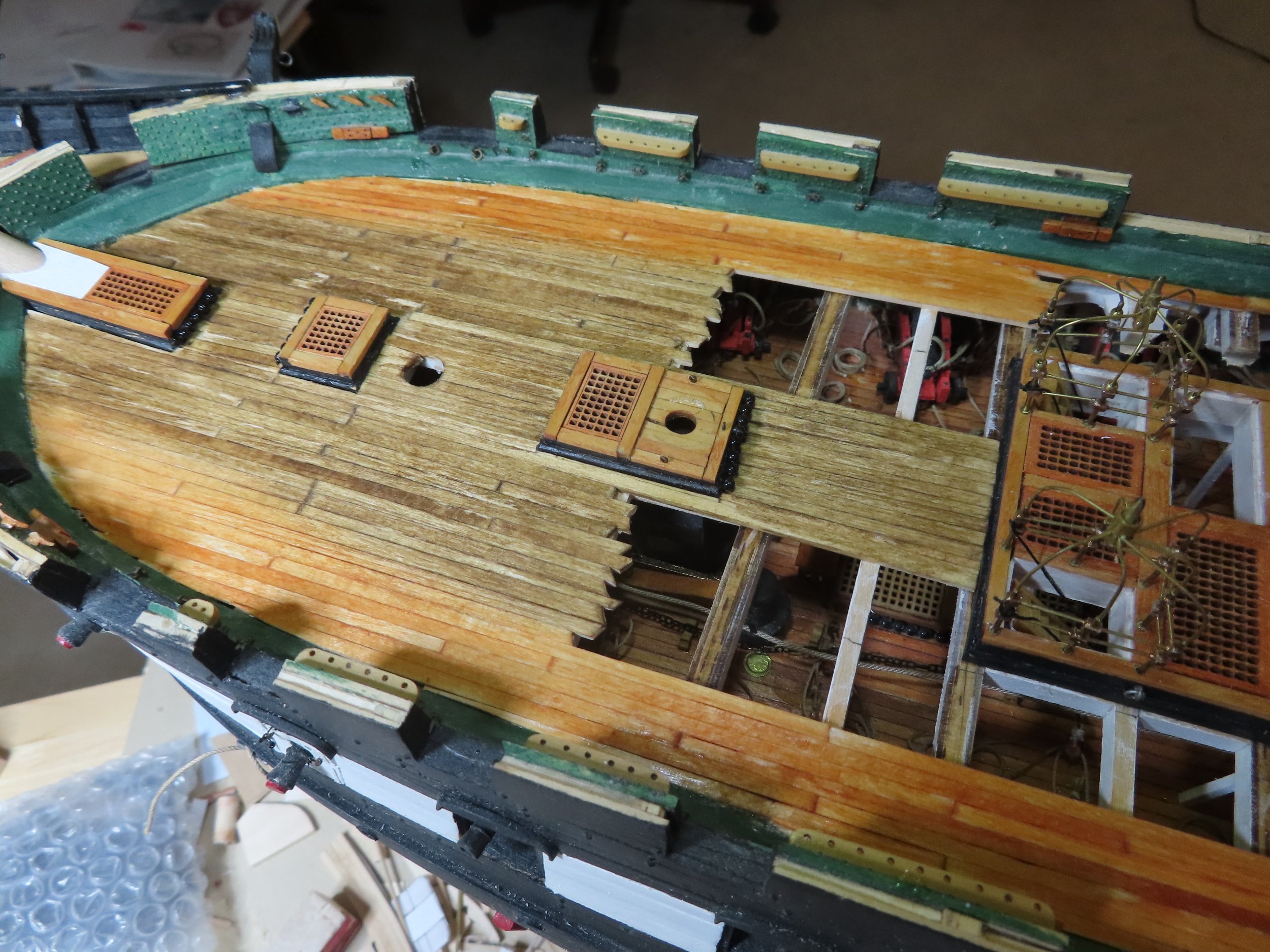

Hey, Jon!  Your aft planking is looking great!  It is interesting to see how you gentlemen are planking the spar deck in order to best expose the details of the gun deck.  And I am also very interested in how you are using your Model Monkey carronades.  I recall the conversation we were having back in January on Peter's build log regarding these Model Monkey 3-D carronades (starting at Post #427, FYI).  At the time, we were discussing the possibility of cutting/separating the cannon and screw adjustment mechanism part from the carriage base, so that the carriage base would be made from wood.  I even purchased a half dozen of the 3-D printed carronades to examine ahead of time.  But it sounds like you are just going to use the full 3-D printed carronade piece on your ship?  Anxious to see how it comes out!  Thanks for the update, Jon!
Gregg

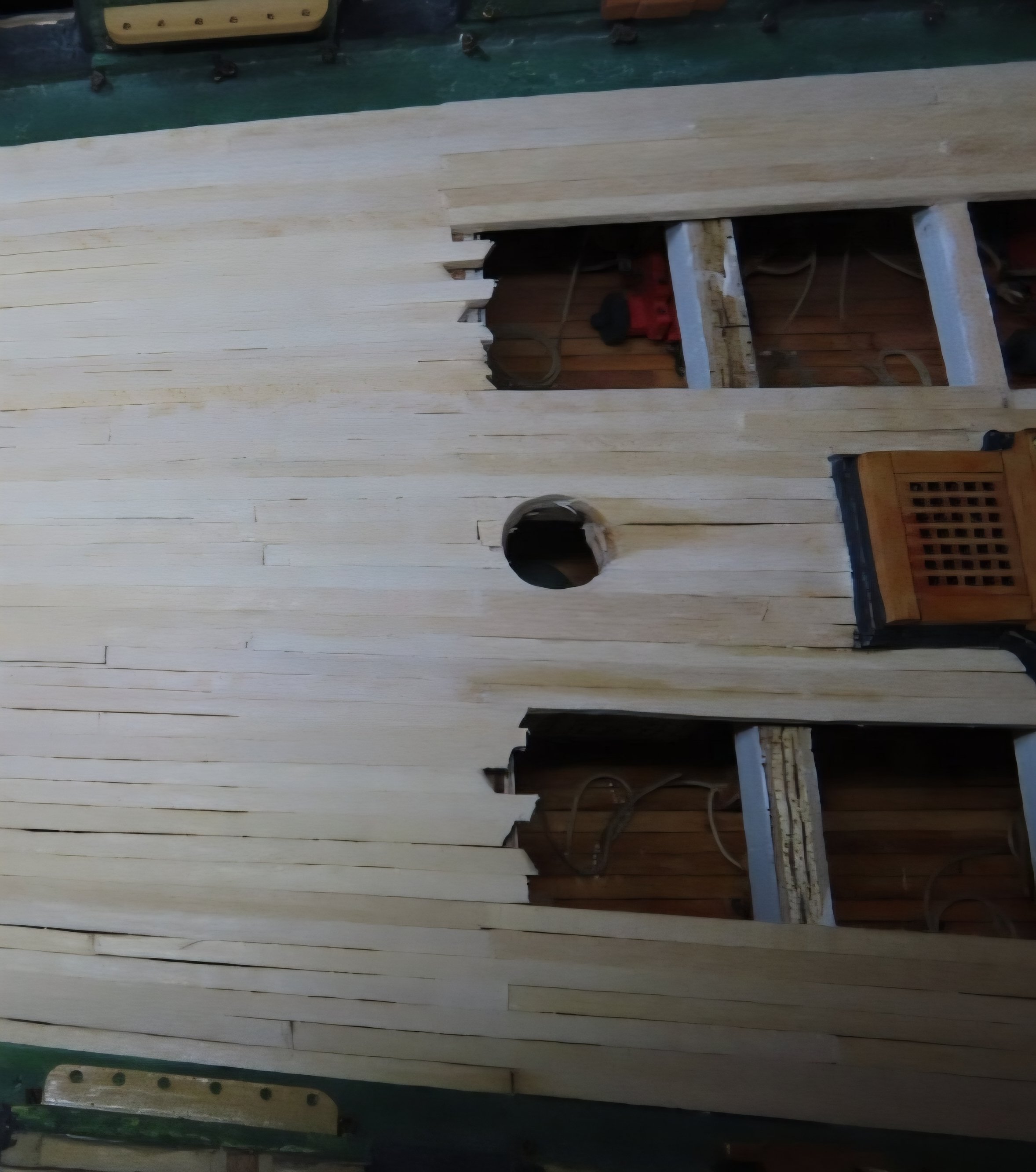

Peter, raggedness of the planks is deliberate. If I made clean cuts, it may look like the clean cut openings were part of the design of the ship to an ignorant (read "lack of knowledge," not "intelligence") layman. By making them ragged, I wanted to give the illusion that the deck was broken open to see inside. You may also seen that I did the same thing with the cut beams on the starboard side waist.
Gregg, the jury is still out as to whether or not I fabricate the carriages. My heart says make the wooden carriages, but the practical side of me just paint the carronade and maybe get a better effect. I think I have one or two extra carronade to experiment with. In either case I still have to rig them. Maybe one or the other is easier to do, I don't know yet.
Jon
38 minutes ago, JSGerson said:
Peter, raggedness of the planks is deliberate.... I wanted to give the illusion that the deck was broken open to see inside.
Gregg, the jury is still out as to whether or not I fabricate the carriages.... I think I have one or two extra carronade to experiment with.... I don't know yet.
Jon, I love that display technique!! Very unique way to expose the details on the gun deck!
Yeah, the intent of buying a handful from Model Monkey to start with was to experiment with dissection.  So, I'll mess with them sometime.  I have plenty of time before I get to that point.  I will. of course, being watching your process with great interest.  Carry on, sir! 👍🏆
Gregg
Yes, this is the right approach. In my Essex model, I frequently encountered this question: "Well, didn't the sailors fall through these gaps?" :)

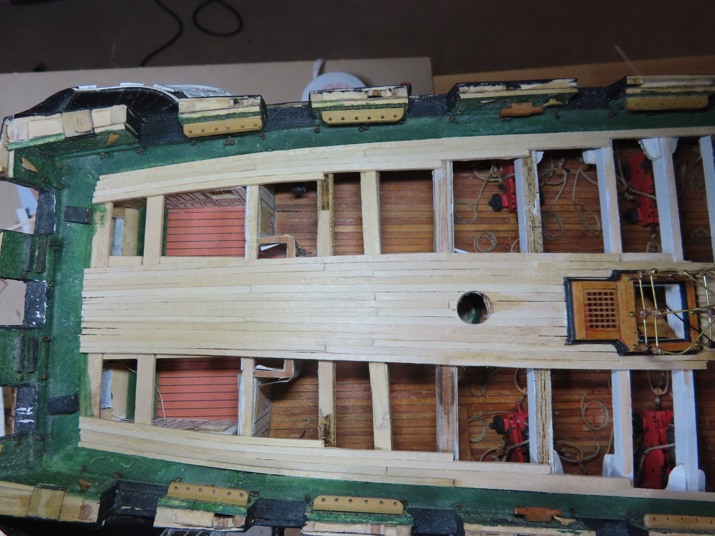

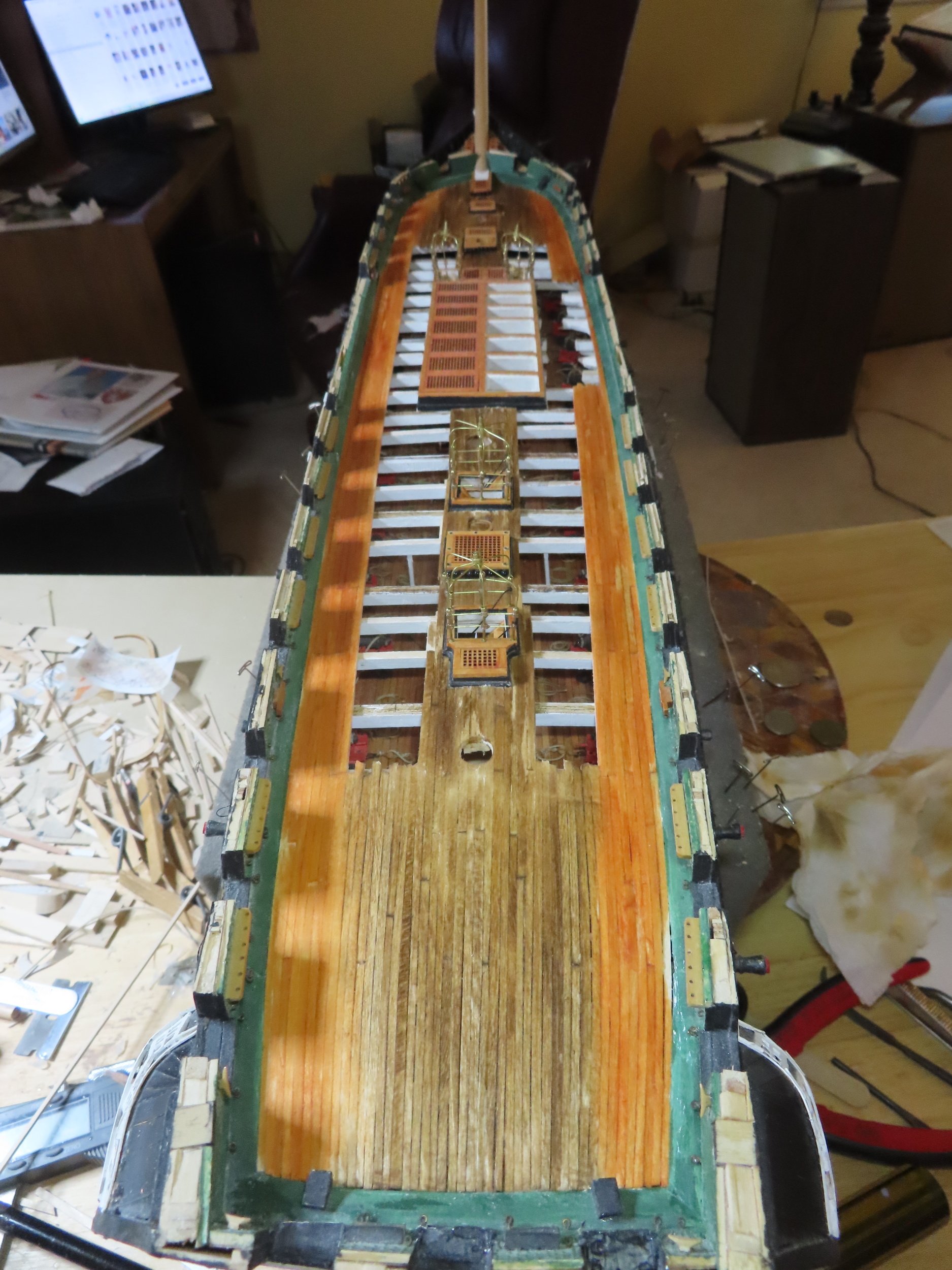

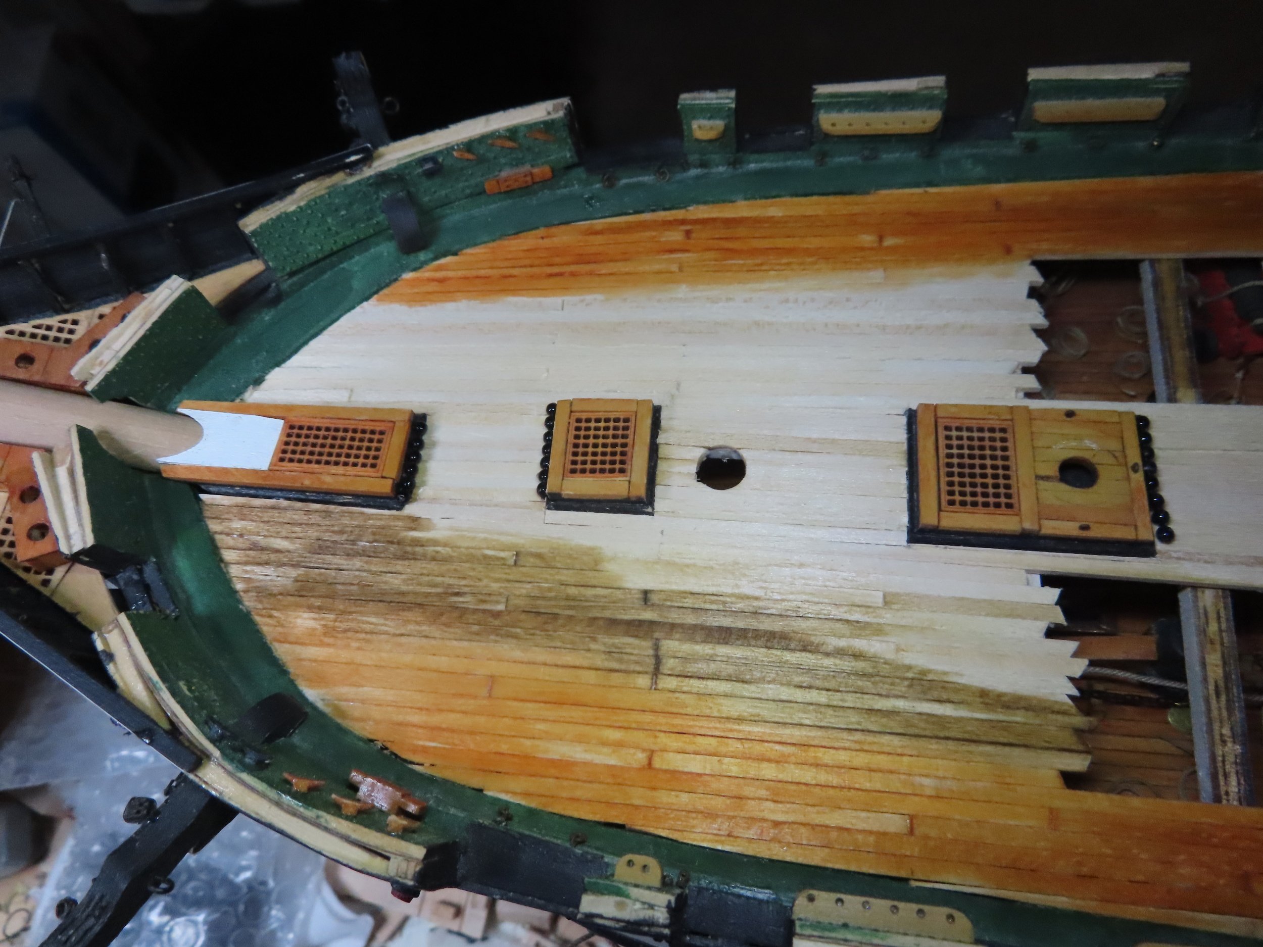

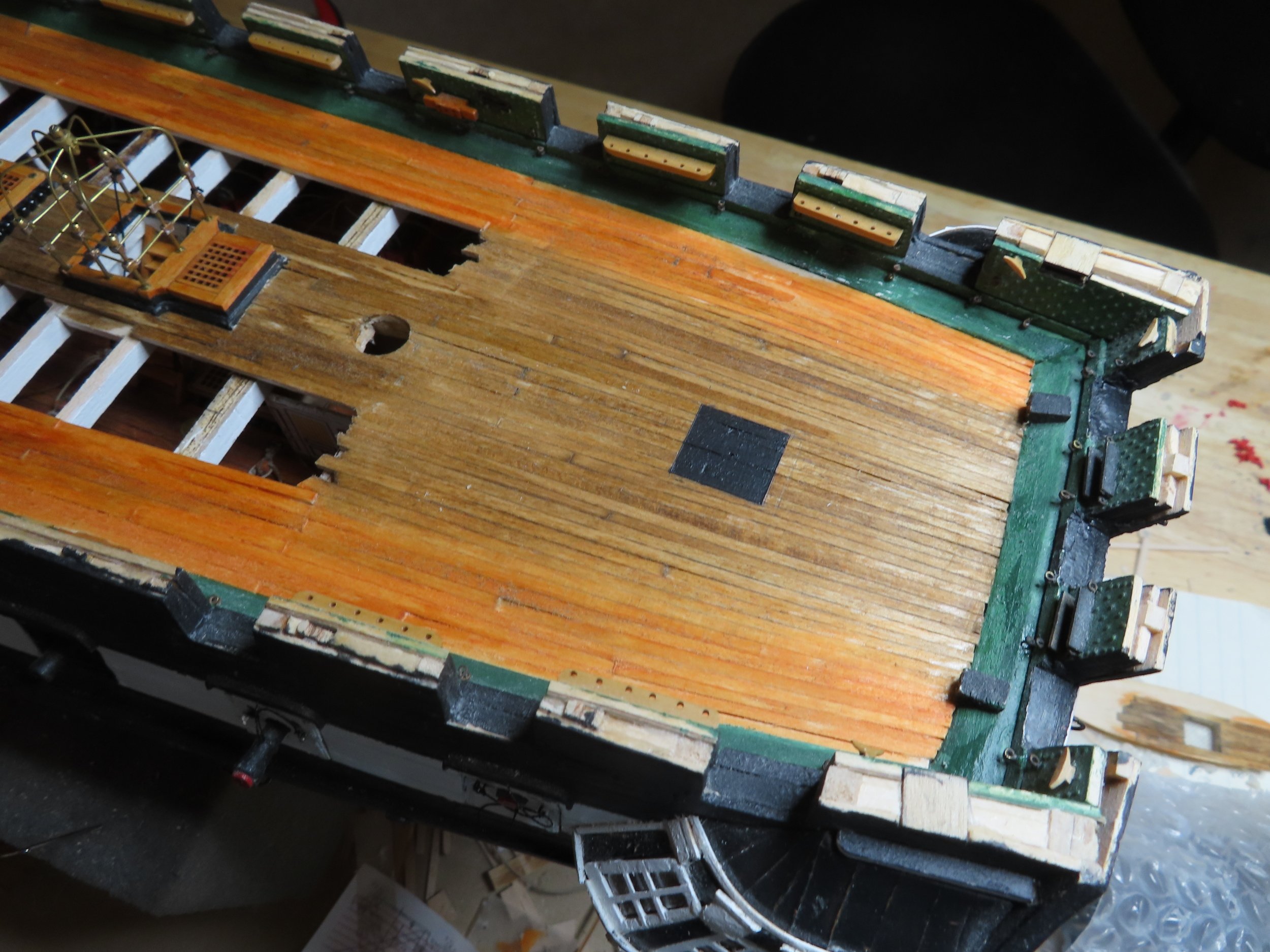

Unlike the stern, the 3/32” x 1/32” planks are not tapered as they approach the bow. The planks remain straight and those bordering the waterways were customed fitted into the curving bow. I planked the bow in the same manner as I did the stern, from the waterways inward and from the center outward. It did not surprise me, as the planking approached each other and as open space narrowed, I had to taper the widths a bit of some of the planks to ensure a proper fit when they merged.
As I mentioned in an earlier post, the reason I had to plank the spar deck at this point was so I could install the captain’s skylight. Well, that will have to wait a bit more as I must sand and stain the spar deck first. And this brings up the question: What color is the spar deck? Well, it depends on several factors like whether the deck is dry or wet, was it sunny or cloudy when the photo was taken, is it a high foot traffic area (think tourists) or not. The main thing I noticed is there are two distinct color zones

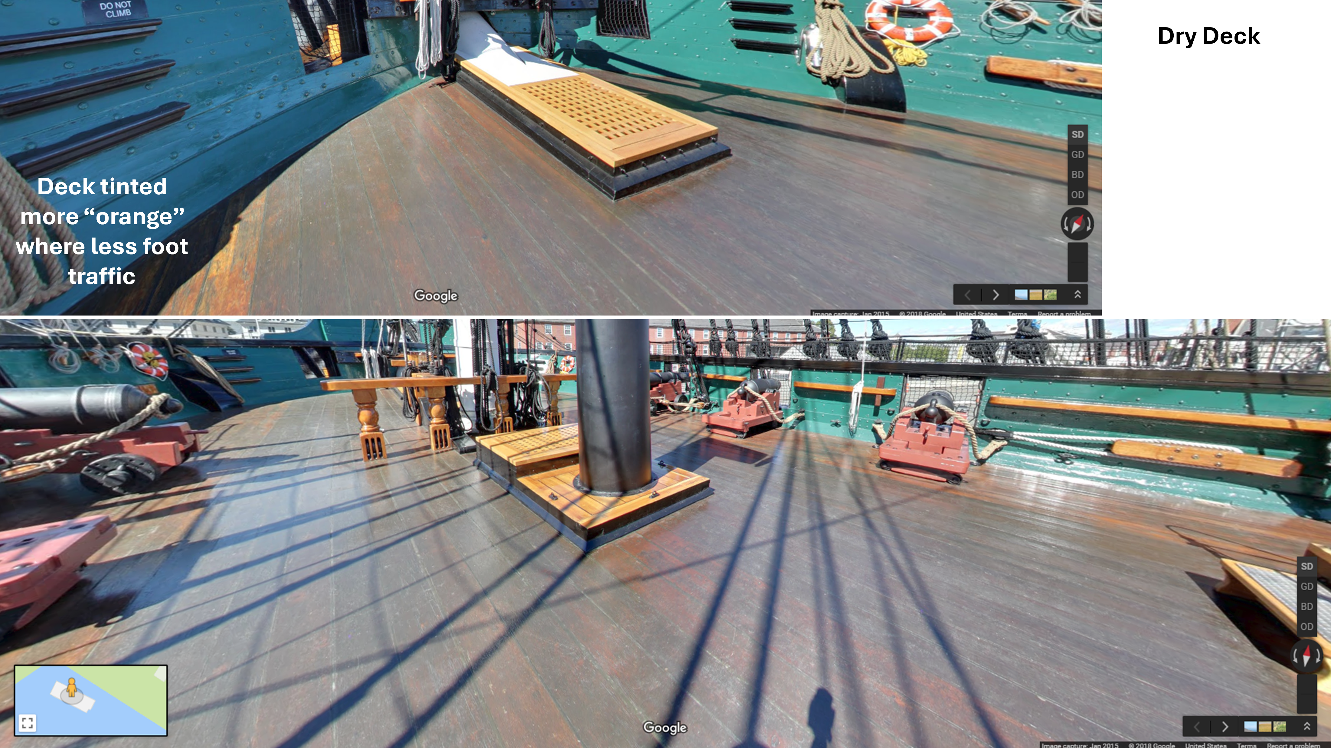

  • Low traffic orange tint - The area of the guns from the waterway to the end of the gun carriage and some spots along the centerline of the deck
  • High traffic brown/gray - The public area for tourists. They tend to deposit dirt from their footwear, soiling up the walked area of the deck.
Obviously, my color scheme will be based on a dry deck. On a working ship, however, I would assume the deck would look different because the sailors would periodically swab the deck and scrub with holystones, saltwater and sand. Also, because of the cut away areas coincides within the high traffic areas, a lot of the brownish gray areas won’t be shown on the model.

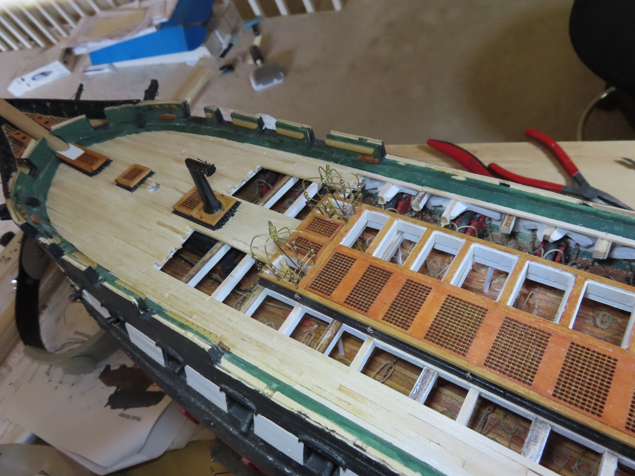

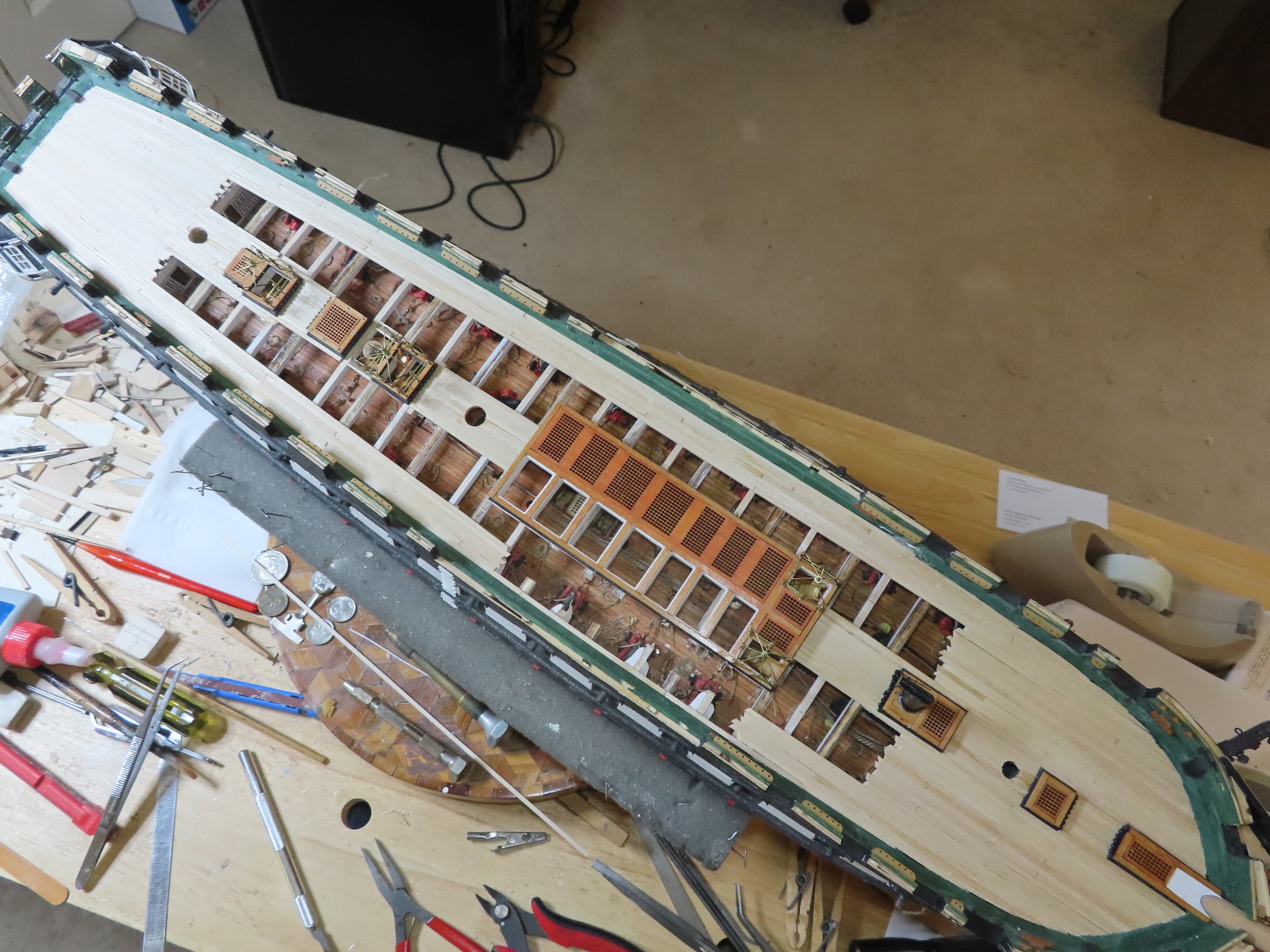

There is one last area that still needs to be planked, the small area around the spar deck capstan. I left that open till I at least fabricate the capstan base. I don’t know yet if I need to plank around the base or if I can plank under it. So, in keeping true with one of Murphy’s Laws, “No matter what you have to do, you must do something else first,” before I can install the captain’s skylight, I must at least sand the planks, prepare for the capstan, and stain the deck.

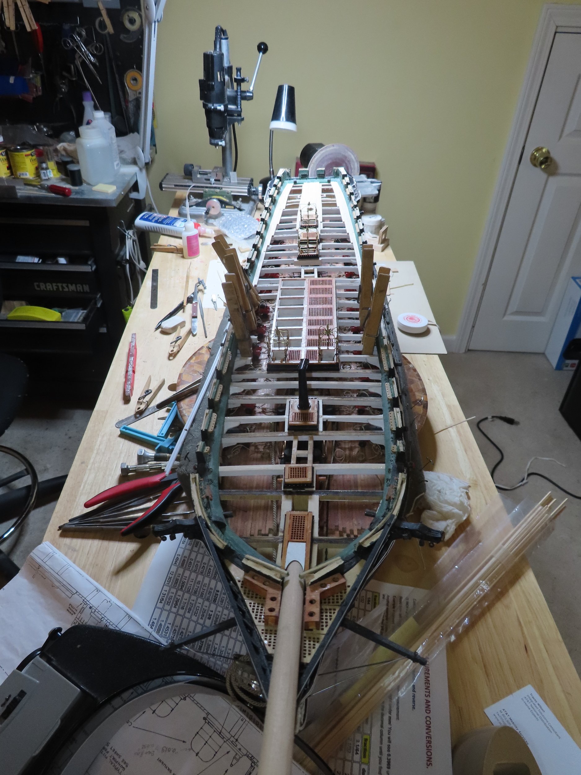

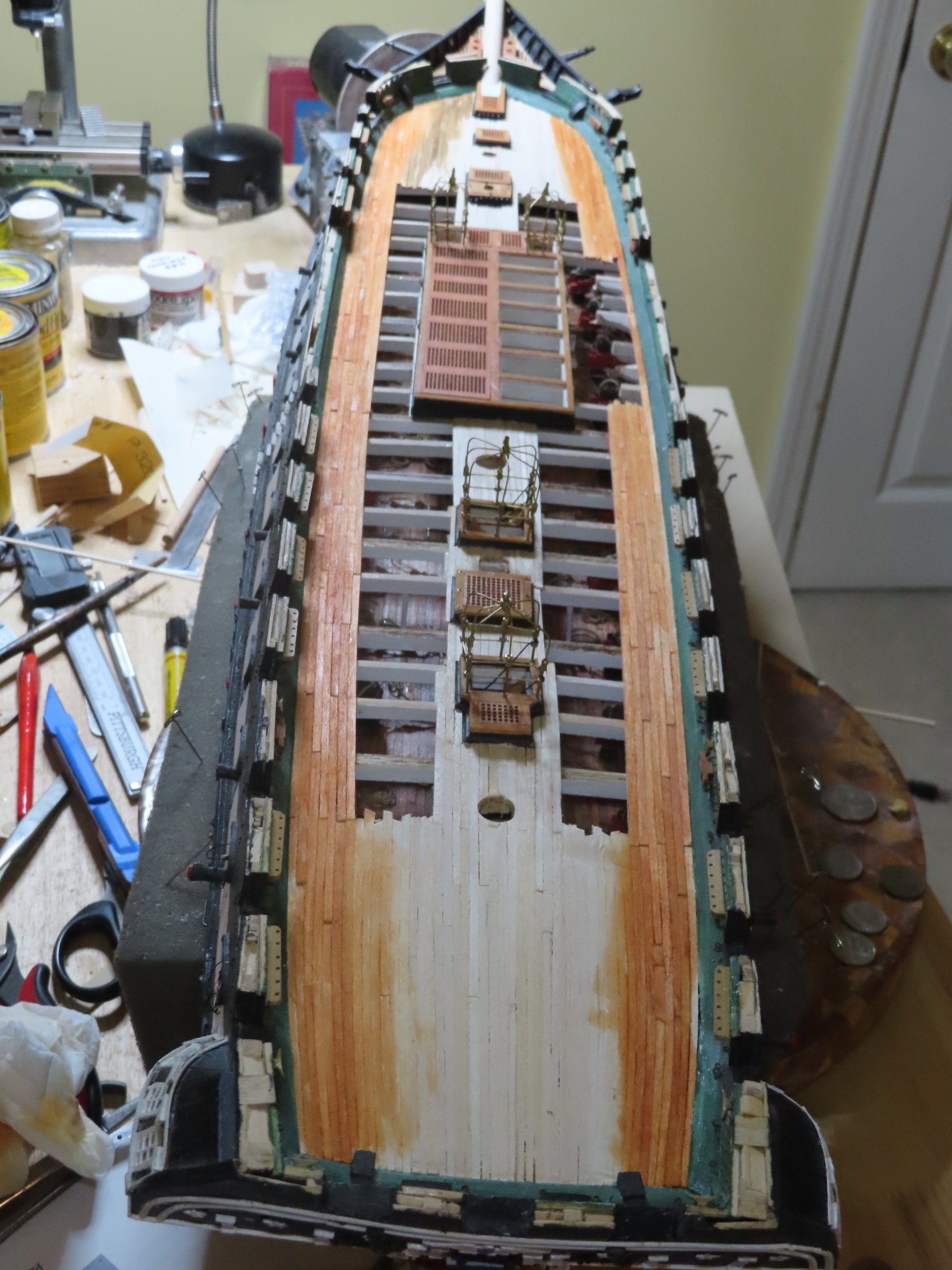

That seems to me to be quite unconventional.  Is there a reason you chose the "meet in the middle" approach?   Did you use tick marks and math?  or just eye-ball it?
Hey Jon!  As I have been looking some more at your spar deck planking pictures again, another question came to mind, and I apologize if I have missed something in your previous work, but... had you already done the necessary shaping/tapering of the bowsprit in preparation of its eventual rigging prior to installing it?
Prior to your planking in the bow area, it would be easier to remove and replace the bowsprit into its keyhole slot with no spar deck planking.  With it all planked now, MUCH more difficult!  Perhaps you did all that work when you were working on the bowsprit hatch and I've just skimmed over that section of your build log (so far!) and missed that completed work.  Thought I would ask the question, though.  Interested in seeing how you finish the deck staining!
Gregg
Peter: When I planked the gun deck, I started from the center and worked to the edges because I wanted to ensure the planking to look symmetrical. Any inconsistences would be at the waterways and would not be visible due the guns and visual access. On the spar deck, I also started from the center for the same reasons. However, at the stern, the planks taper to match the narrowing at the transom and curve following the shape of the bulwarks. I wanted clean looking planks especially at the waterways due to their high visibility, so I also planked from the water waters inward. Following the method from the practicum, the planks were tapered from full width from the last hatchway to half their width at the transom. That worked pretty well. As the two planked areas approached each other, I had to make some minor adjustments due to my workmanship and subtle differences in the supplied plank widths.
For the bow, once more, I started from the center to ensure symmetry. This time the planks did not taper, but the planks bordering on the waterway had to be custom fitted as they intersected the bow curve. Once more for their visibility, I started the planking from the waterways inward to ensure proper fit. As the two planking areas approached each other, I could see that some planks had to be narrowed a bit to ensure the last plank to fill the gap between the two areas was the proper width.
Gregg: The bowsprit dowel has not been shaped other than the base to fit into the square hole in the bulkhead. It is not glued into place. It does however slide into its seat easier enough when I move it in and out of the model. All the mast holes have been tested to accept their respective dowel pieces at their proper rake angles. The mast seating and rake angles were set when I was adding the structure elements to support the spar deck.
As for staining the deck, I’ve made some initial tests of different stains and combinations but have not yet taken the plunge and committed myself yet.
Jon

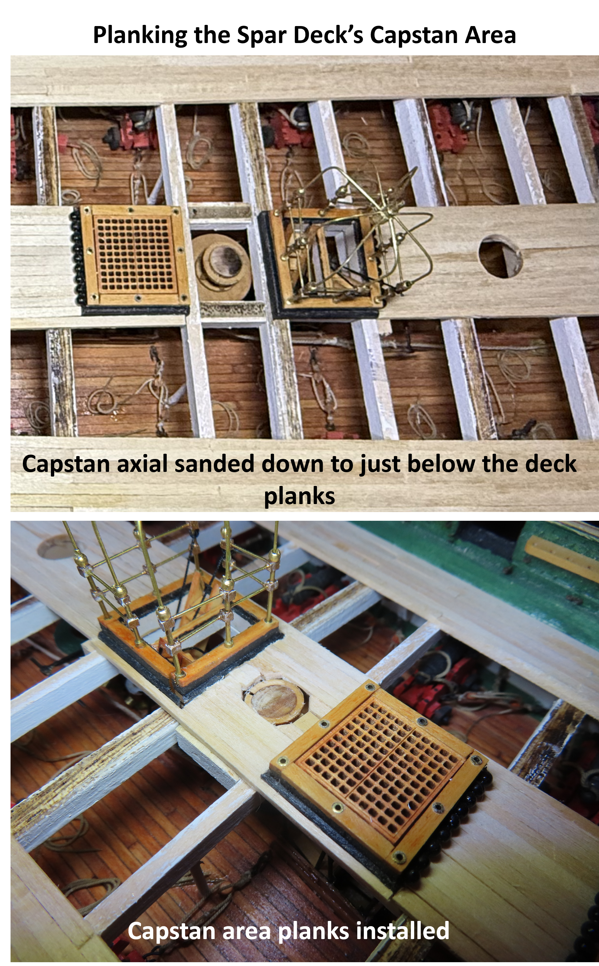

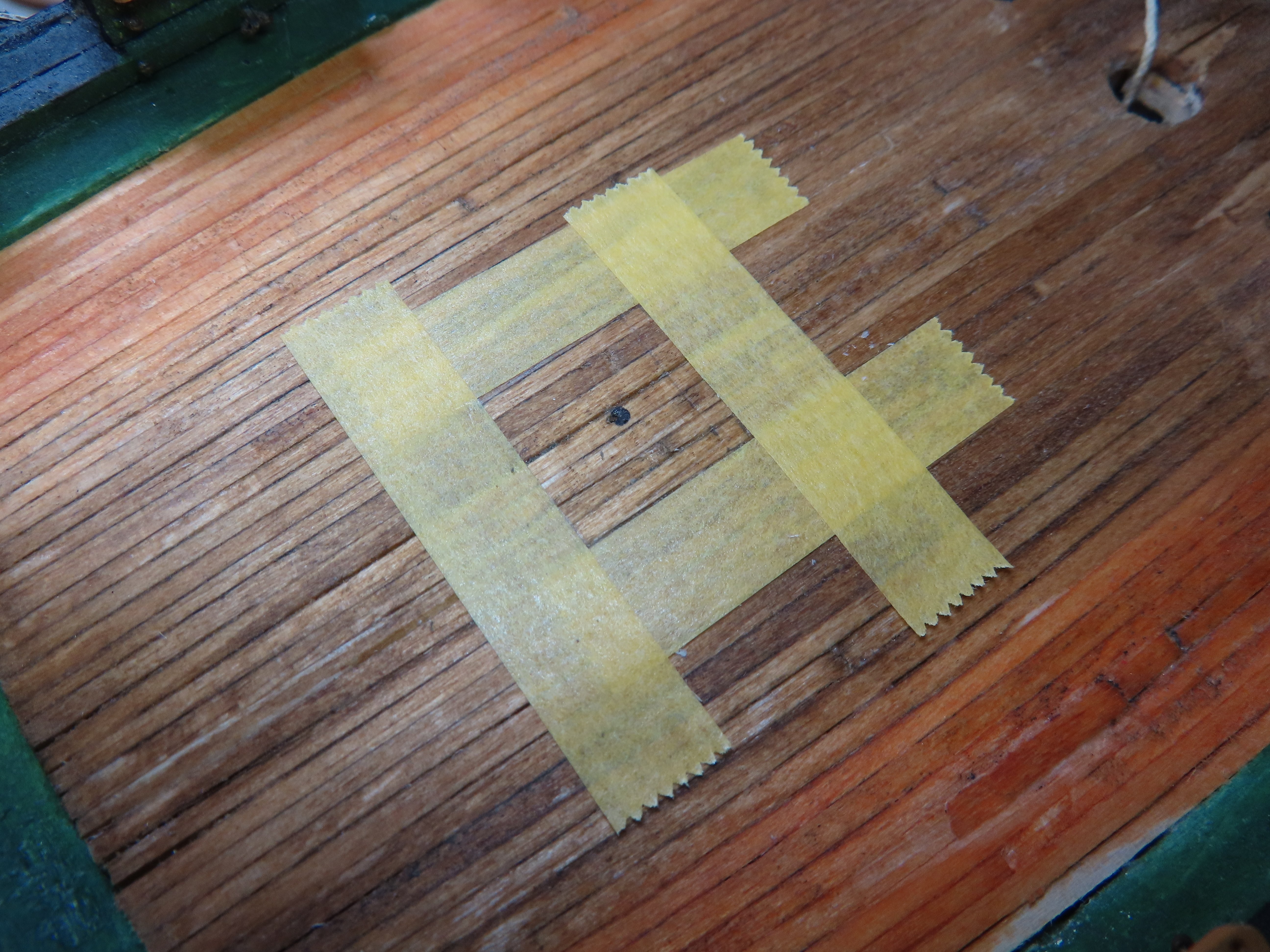

As I examine the capstan location, I realize that I made the gun deck capstan protrude about a 1/16” above the spar deck. At the time, I was thinking that I would extend the axial of the capstan into the spar deck capstan. As it turned out, there was no reason to extend the axial. First, attempting to get a perfect alignment would be tedious and second, it wouldn’t be seen. I sanded the protruding axial so that its top was just below the surface of the planking. Now I simply planked around the spindle. The area left open will be covered by the spar deck capstan. In the end, it won’t be obvious what method was used to install the spar deck capstan as it will all be hidden.

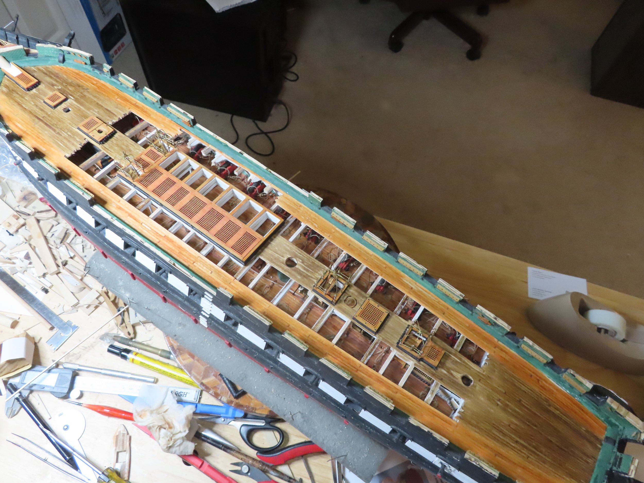

Now there are numerous items that need to be installed on the spar deck including the captain’s skylight. However, before any of that can be done, the spar deck must be stained first. This gave me some trepidation. As mentioned earlier, unlike the gun deck, the spar deck is open to the elements and weathers differently depending on the foot traffic around all the items on the deck, I must get the stain done right and done right the first time. Area
According to the practicum, Mr. Hunt had an elaborate process to accomplish this. Unfortunately, some of the products he used are no longer available, specifically Floquil Grimy Black and Floquil Roof Brown or any Floquil product for that matter. He would have you sand, apply paint, wipe off the paint, and scrape. I really didn’t like the idea of using paint in lieu of stains and physically scraping the wood. Other builders used different methods and color stains to get their weathered look, resulting in effects different from each other. The one thing I noticed was that all the spar decks were stained monotone, that is, no one area on the spar deck looked different than another. Yet, if you look at the images I posted earlier, there are color shifts. My model does not have a fully planked deck, so a lot of the dark areas shown in the photos will not exist. The area where the carronades are located, appear to have a more orange tint, while the foot traffic aeras along the center, bow and stern (on my model) are more brownish-black. This is what I will attempt to emulate.
I did some tests with the stains I had available on scrap pieces of wood. I tried straight staining and various over lapping combinations. Based on those results I bought some more stains and experimented again. I think I came up with a simple scheme to get the desired results.
I held my breath and took the plunge. The first coat consisted of two stains: Along the bulwarks where the carronades are, I used Minwax Gunstock 231. This has an orange tone. In the center area I used Minwax Early American 230 which is brownish tone. At the border where the two colors met, they overlapped each other slightly. Once the stains dried, the deck was lightly sanded. This time I streaked some dark tones with Varathane Espresso . This somewhat emulated Mr. Hunt’s colors of black and brown. Like it or not, it’s done, but I think it will work.

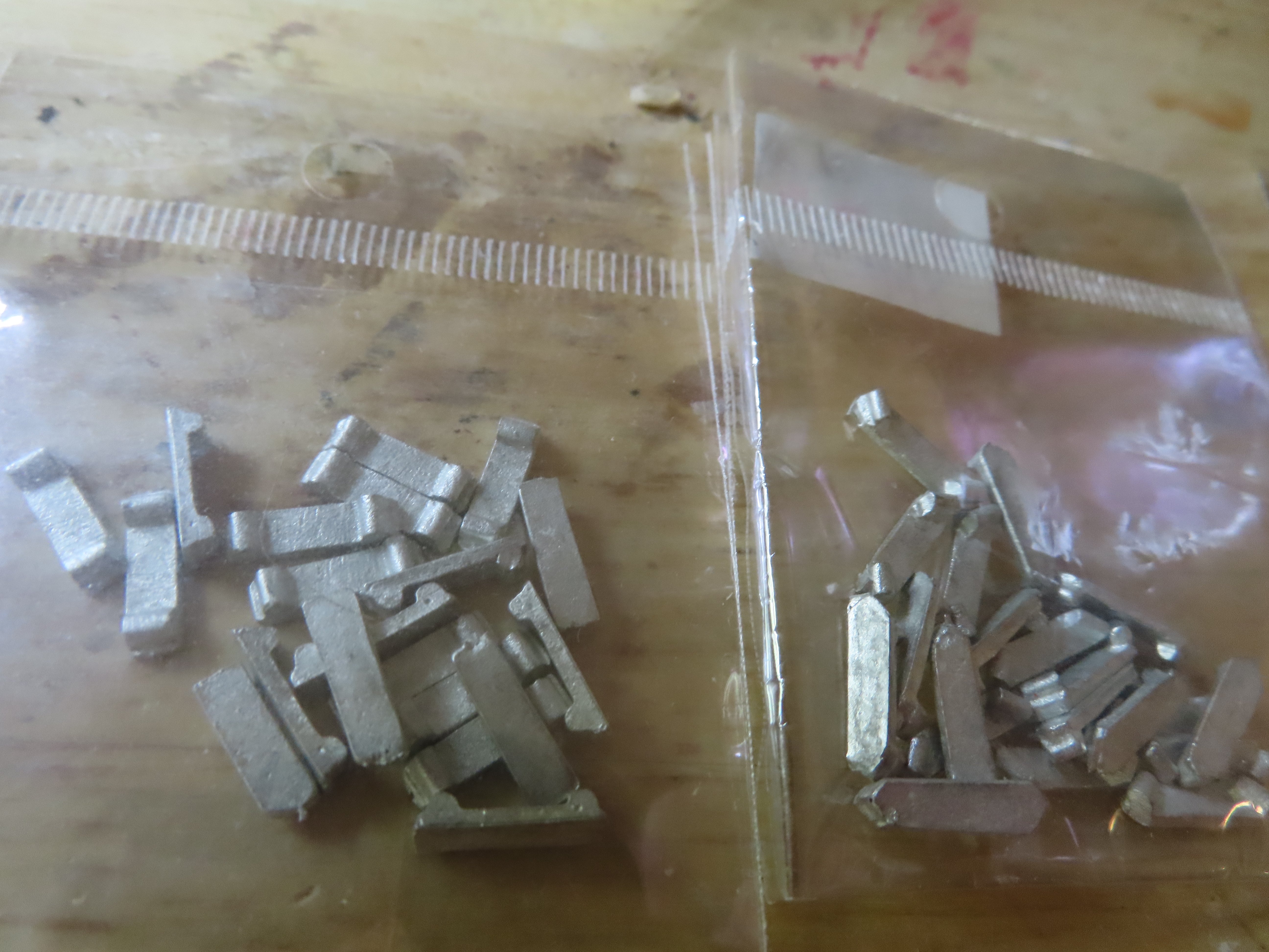

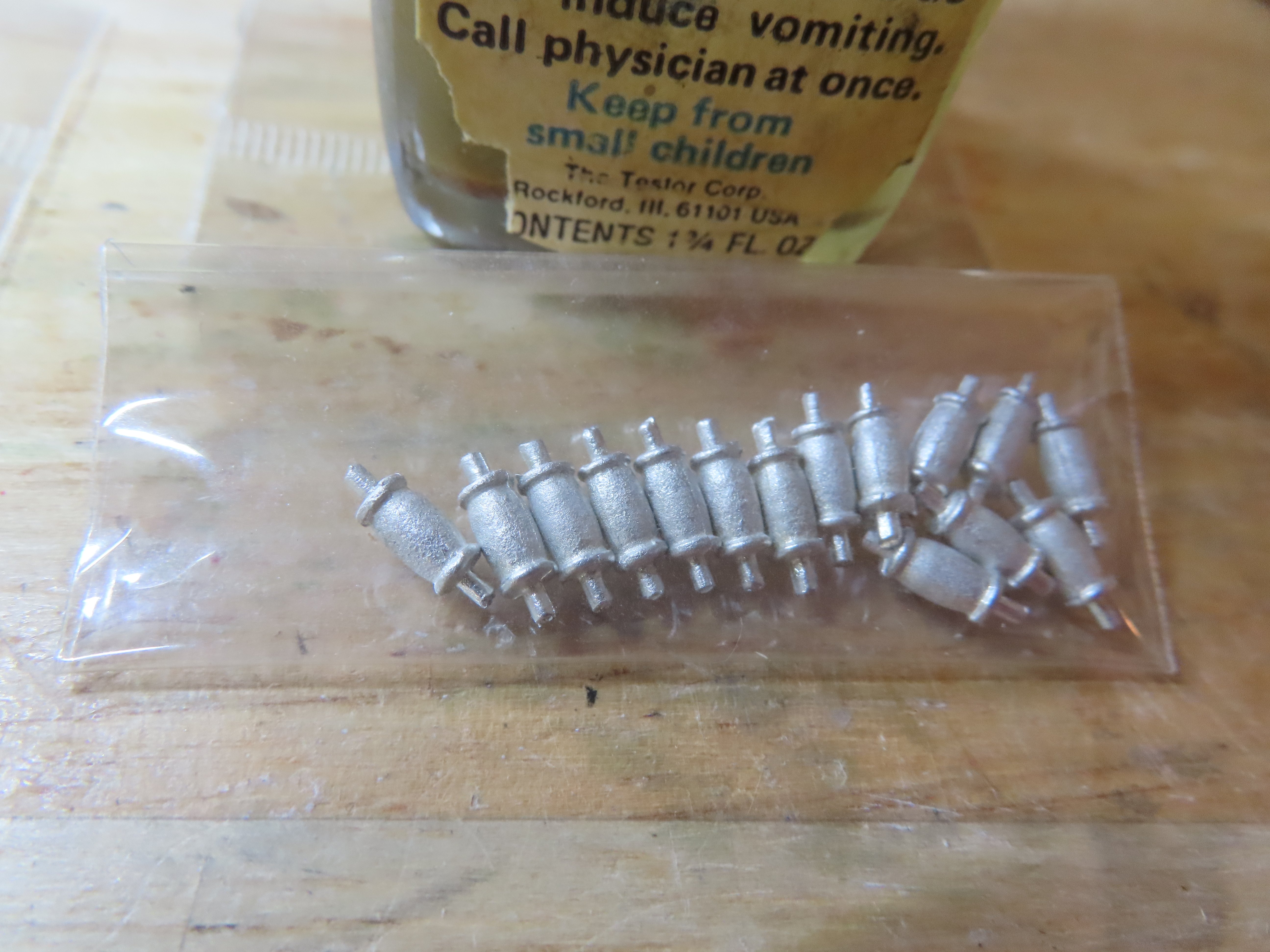

I've got a mystery, which I hope some of you MS Constitution kit builders have already solved. I've got three bags of Britannia Metal accessories. I have no idea what they are or where or when they are supposed to be used (or should have been used). The image of the left shows a bag of something like rolling pins and the image on the right show two bags of something, but of slightly different sizes.
Can someone please identify them...please🤷‍♂️
Mustafa is correct about the latter items being the truckles for the carronade carriages.  I don't know what the rolling pins are for either.  When I've found myself trying to figure out what's what with the kit, I consult the list of the kit's contents.  This is a three or more page document that lists your kit's parts by material.  Look up the Brittania components and by process of elimination, you should be able to figure this out.  Were I at the shop right now, I'd check myself.
Before I sent out the "mystery"post I did go looking for the parts list. It was not in the kit box. It's probably buried in the piles of paper I've generated of notes, instructions, conversion charts, etc. I've accumulated over the years. I did have the foresight to scan the paper work I received with the kit. I finally found it in a file on the computer. I had a hunch, and you guys matched it about the  carronade trucks. They were the front and back trucks, in separate bags. The rolling pins turned out to be fife rail stanchions "round portion only." Thanks for the quick reply.
Jon

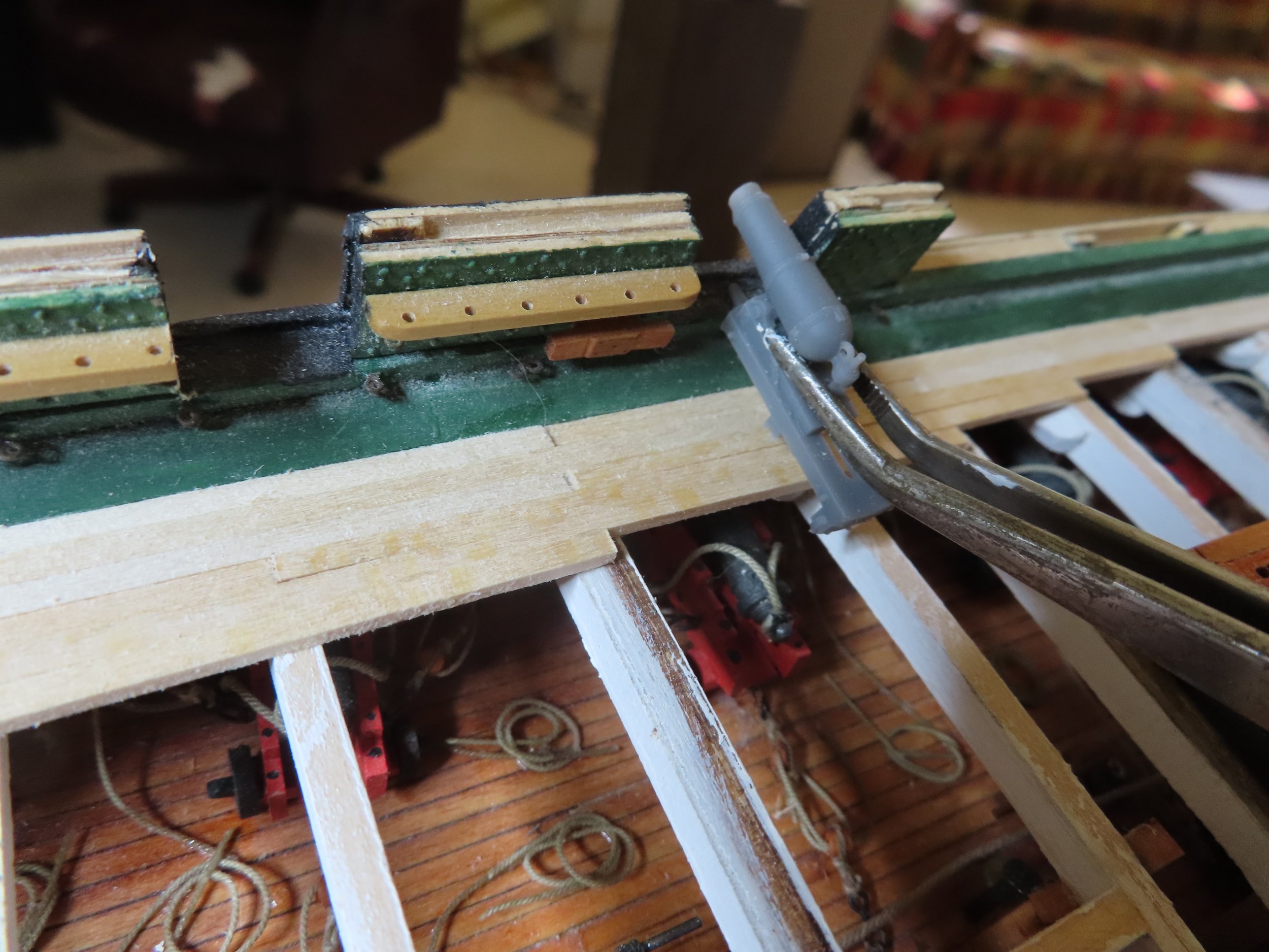

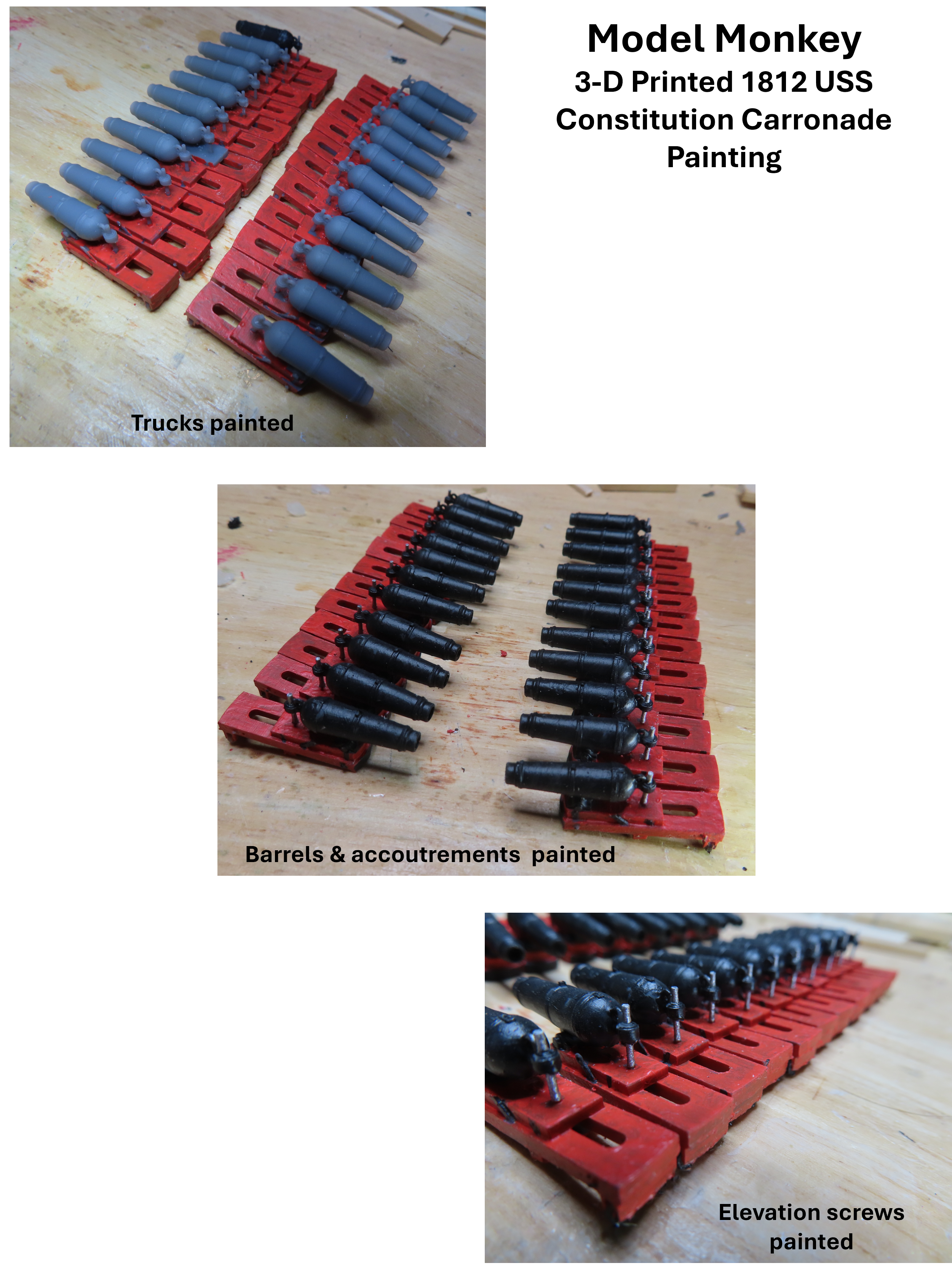

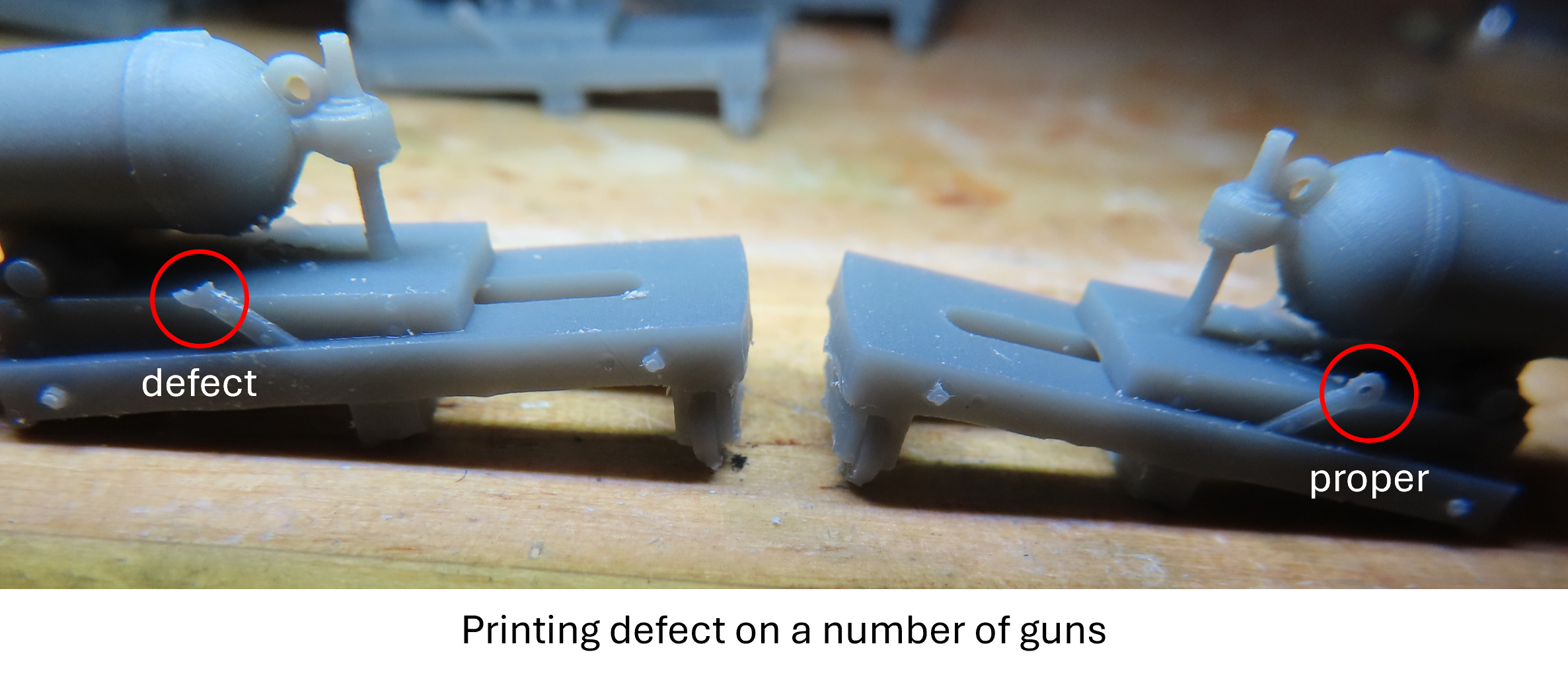

Now for the carronades. I wanted to fabricate the carronades like I did the gun deck, guns. However, as I have mentioned preciously, I purchased 3-D printed carronades because they matched quite closely the carronades depicted in Marquardt’s book. The amount of work it would have taken to separate the gun barrels and mounts from the trucks without damaging anything, just so I could make my own trucks resulting in no appreciable difference, did not seem worth the effort. So, I swallowed my pride and decided to the printed guns.
Removing the spruce trees from 22 guns was slow, delicate, and tedious, and unfortunately revealed one persistent defect. Several guns had one or more deformed eye bolts, required for rigging the guns. I have some ideas for a repair in the near future. In the meanwhile, painting the guns is next.
Painting was also a tedious endeavor because I was painting a complete model…22 times. Painting individual parts before assembling is a lot easier. These were complete guns with attached trucks. First, I painted the trucks Model Expo acrylic orange/red. Then I painted the  gun barrels, mounts, and small accoutrements on the trucks, Model Expo acrylic black. Getting all the nooks and crannies covered with paint was not simple as I kept missing spots and had to keep going back to cover those surfaces while trying not to touch previous painted areas…but I did. When I fixed those, I reintroduced additional painting errors…etc. Finally, all I had left was the screw mechanism for adjusting the barrel elevation which I painted Testors enamel steel, which I already had.
2 hours ago, JSGerson said:
...I purchased 3-D printed carronades because they matched quite closely the carronades depicted in Marquardt’s book...  So, I swallowed my pride and decided to the printed guns.
Hey Jon!  Great to see you tackle these carronades!  I think I had mentioned on somebody's build log that I had purchased a small handful of the Model Monkey screw-adjustment-style carronades in order to practice working with them before deciding how to prepare them and finish them for the spar deck.  Interesting that you are taking this approach and, frankly, not surprising.  Although I haven't done anything with them yet, a close inspection of them when I first received them made me think that separating the "cannon parts" from the "mounting and base parts" would be challenging to do without damaging some critical piece of the fixture as a whole... and then doing it successfully 21 more times.
Although it is disappointing to see some of the "misprint" possibilities, it looks, from your pictures, like this process will come out very nice.  Looking forward to seeing them completed, rigged and placed on your spar deck.  Awesome work, sir!
