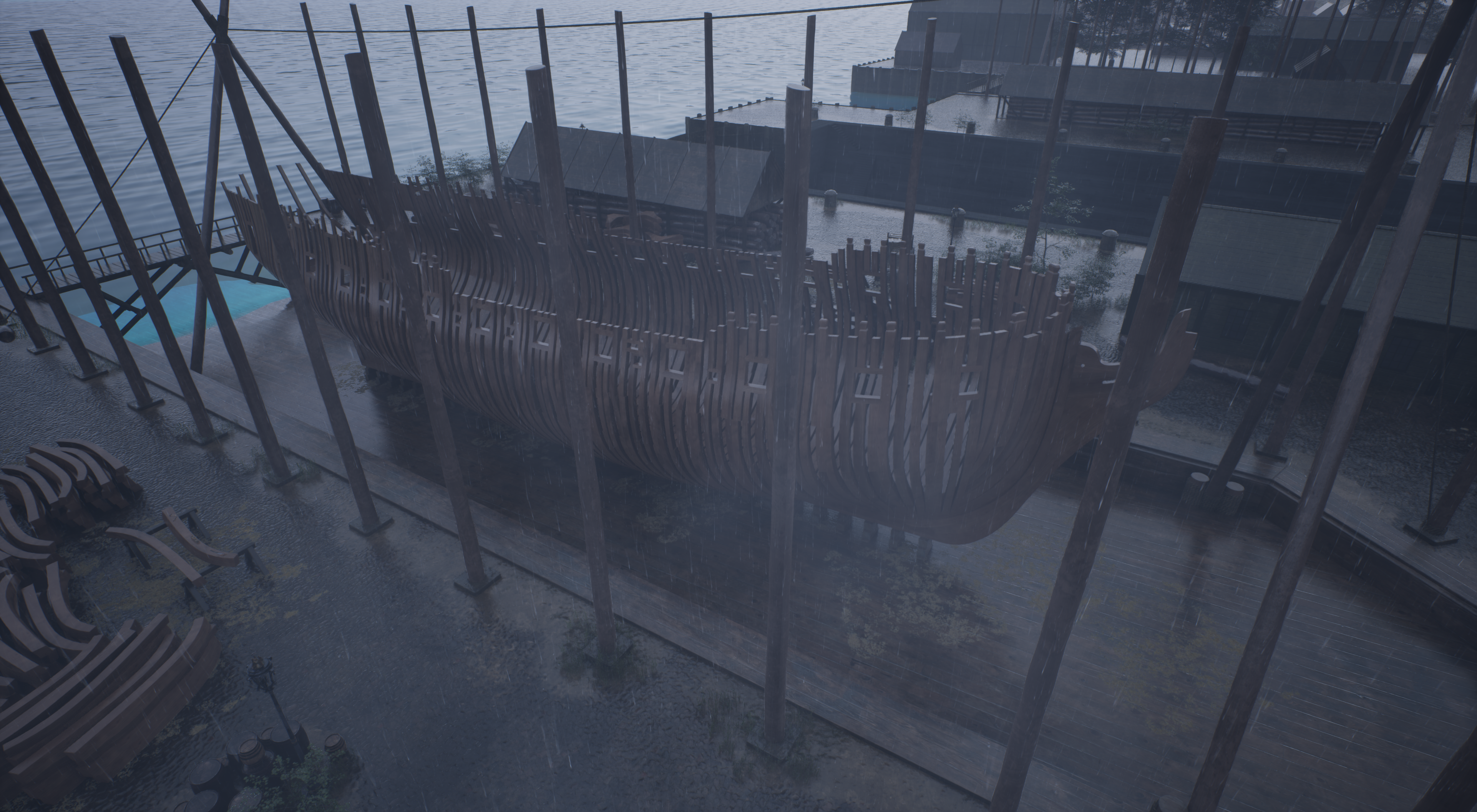

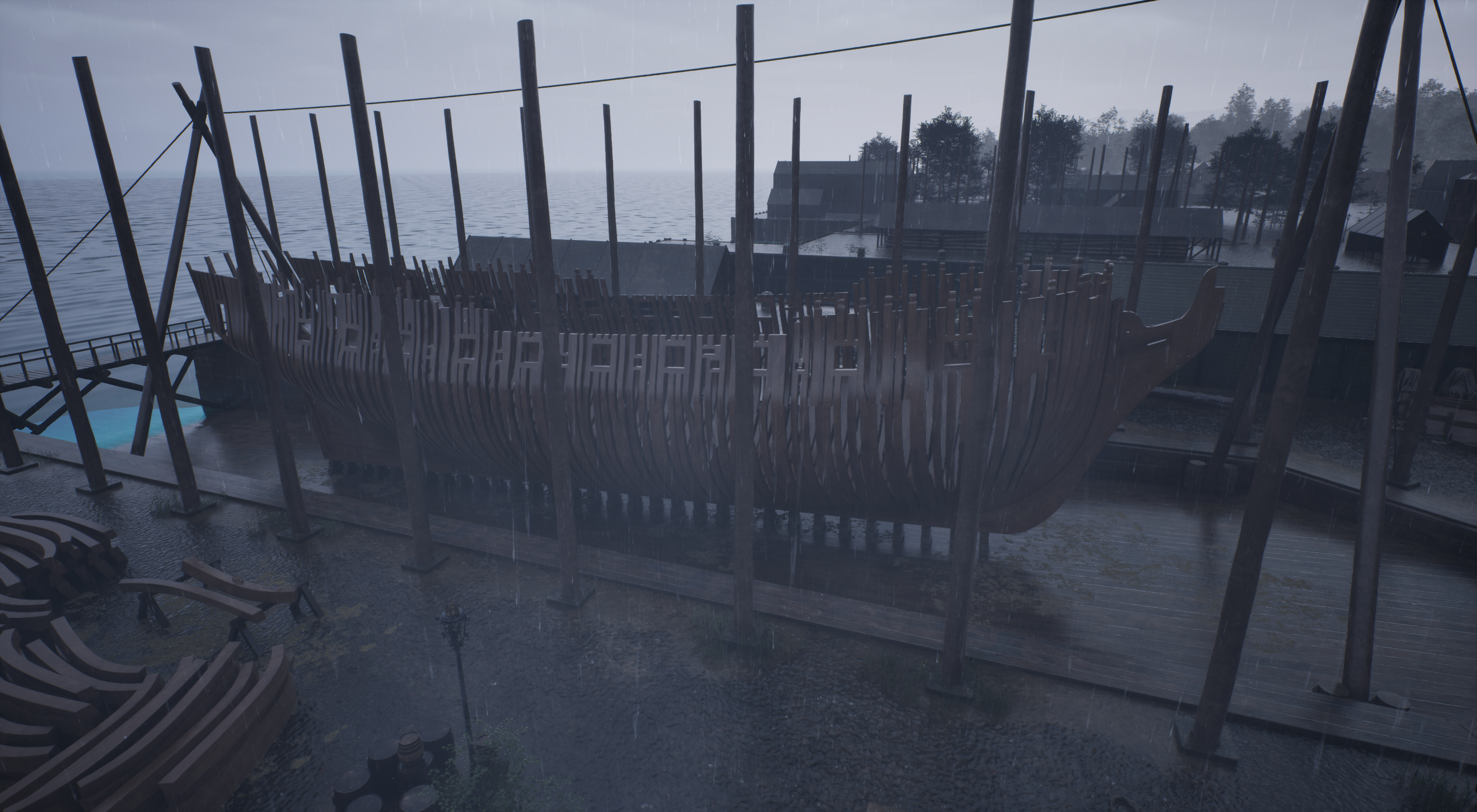

hello, guys. not much progress this time. fore square frames up to dead flat are done... and I've removed support rods, they were starting to get in the way and were a pain to setup. good thing digital frames can stand on their own... 😁

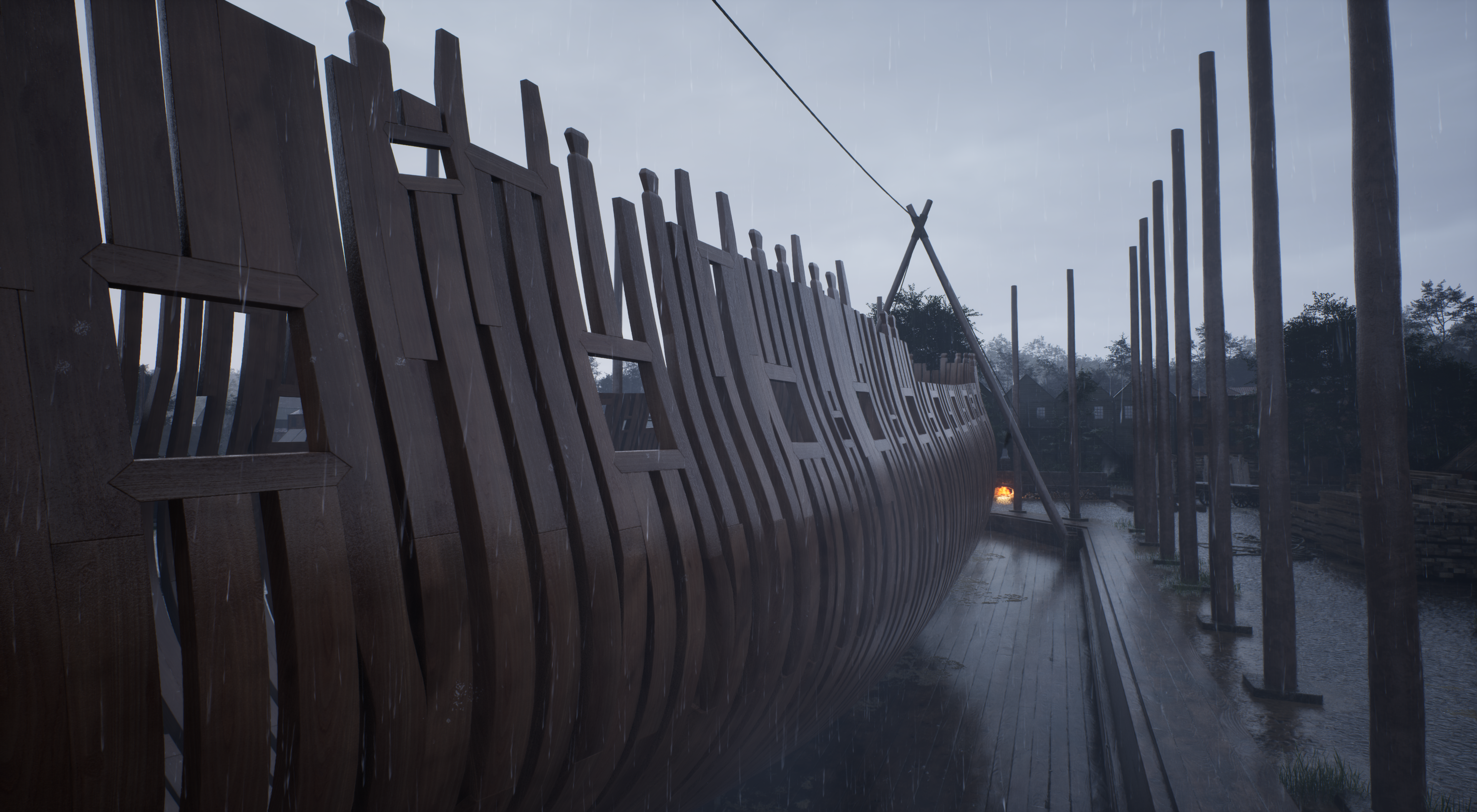

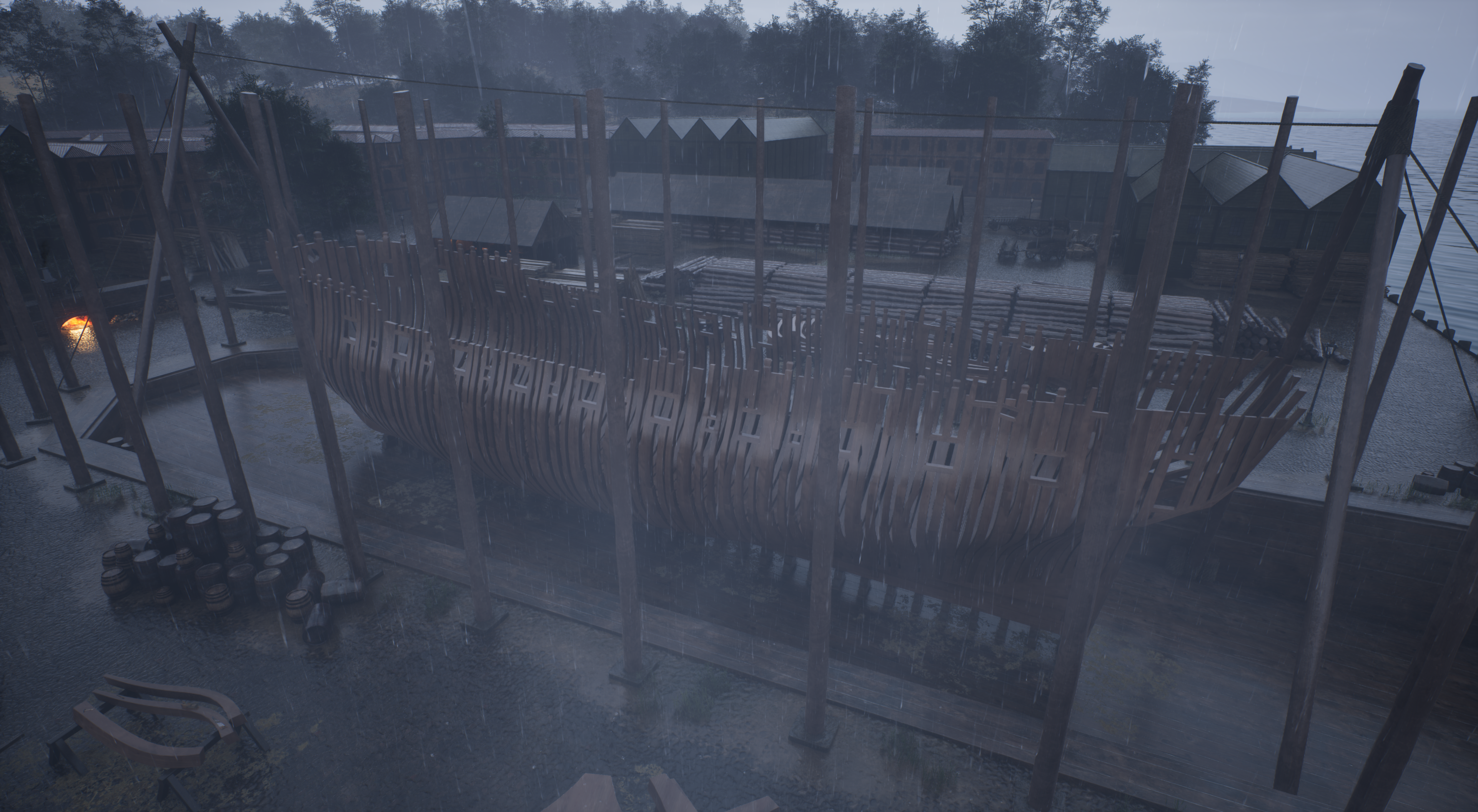

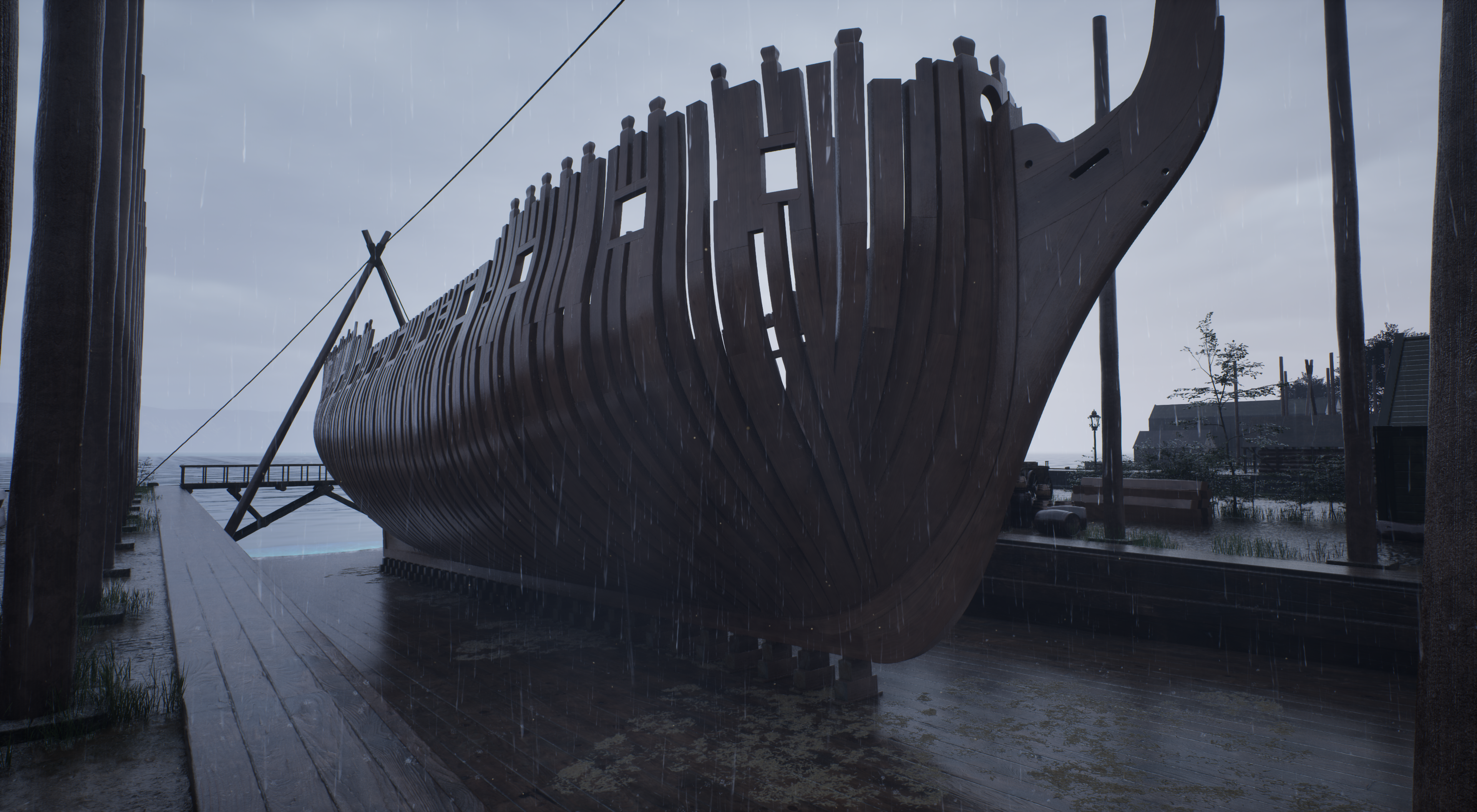

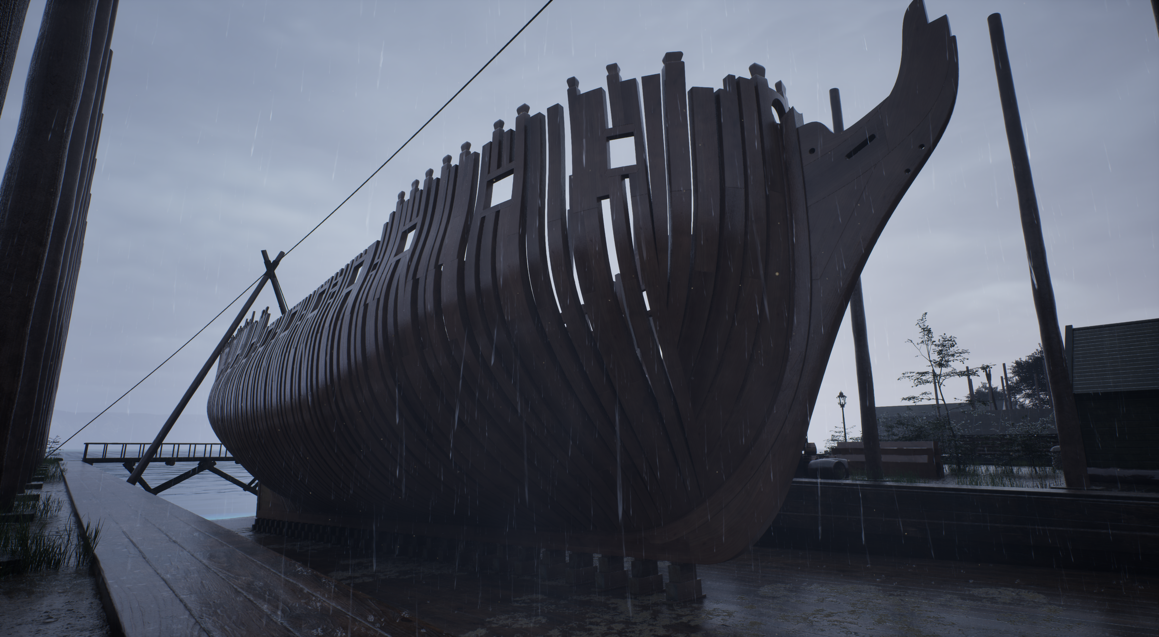

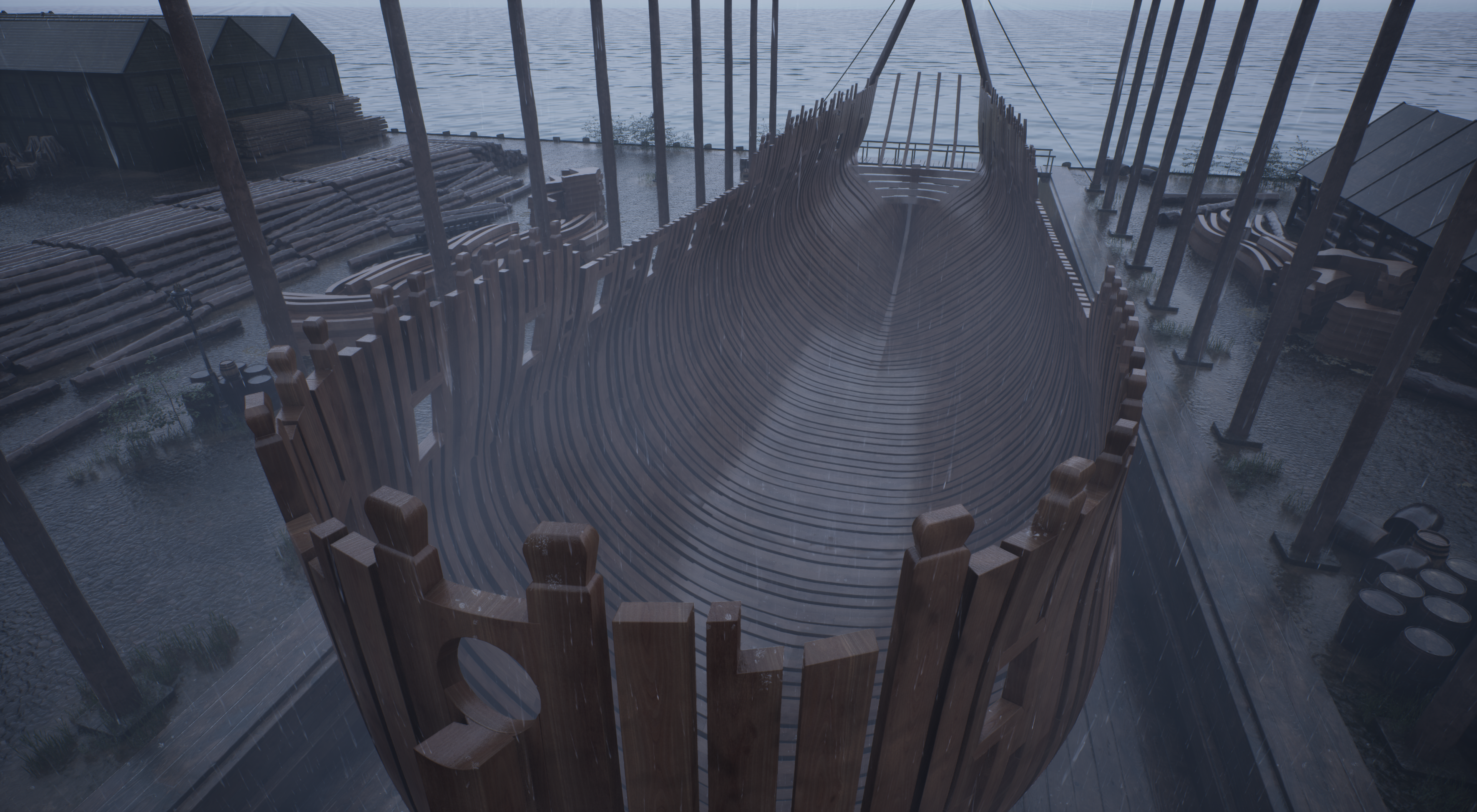

finally, the frames are done. like Nate said, interesting little buggers to make, they were nice exercise in patience for a lot of things to come, lol... oh, and it was really bad weather today, so my workers split home earlier again. it's like they're actively avoiding to be photographed...HighresScreenshot00008.thumb.png.a30a0334c45381cc6d1217852c425778.png

Denis, it is just a little rain, nothing to cry over - get your men back! 😄
Very nice rendering and continuation.
Respectfully

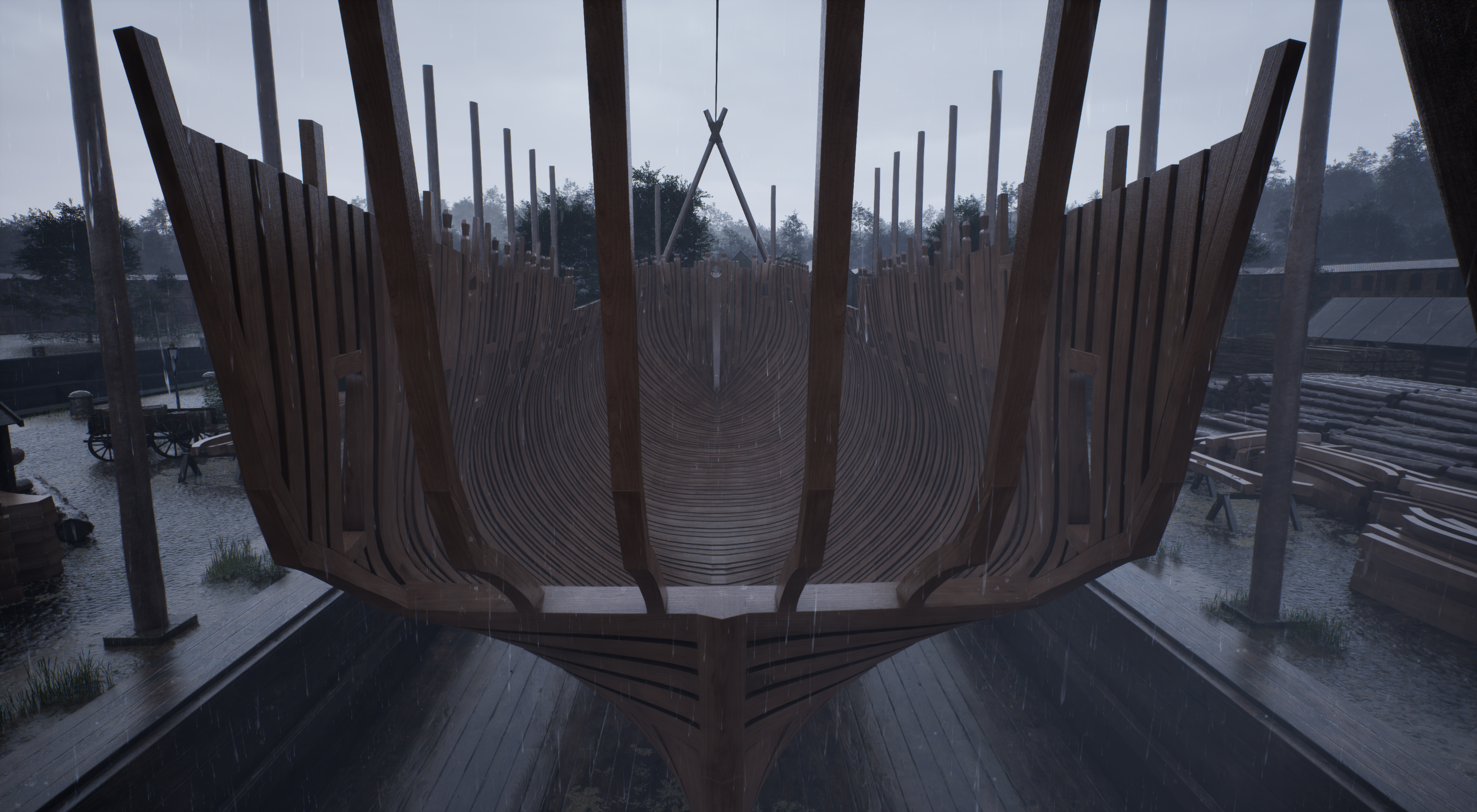

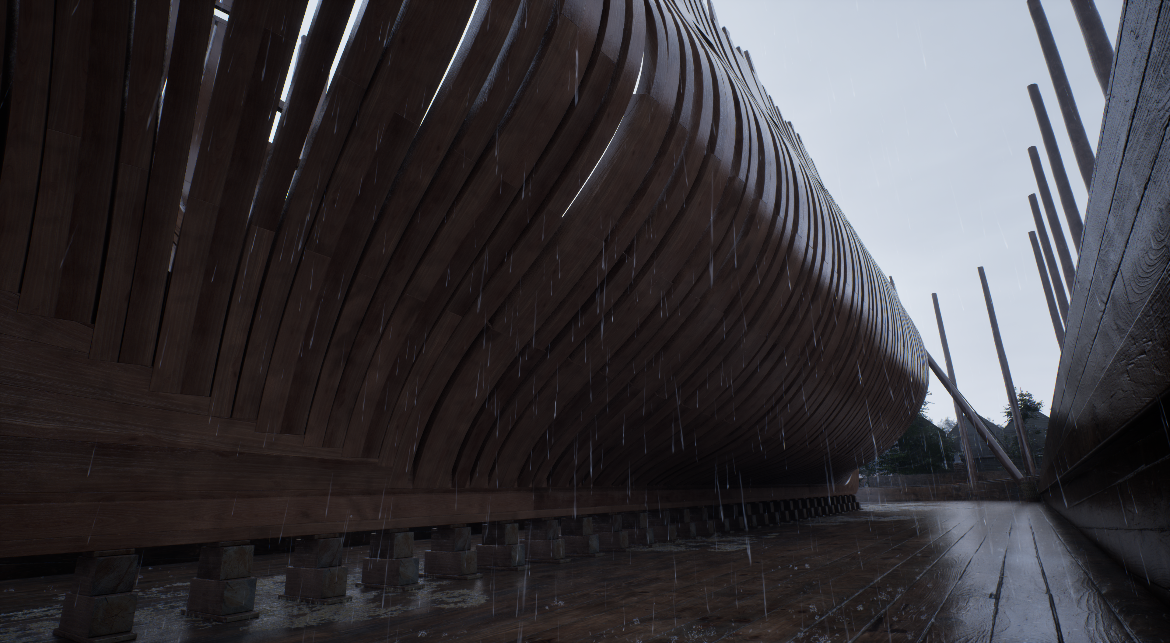

making progress with internal planking. I've been struggling quite a bit with it, since the drawings don't quite fit scantlings in "Elements and practices..." book. hope it turns out OK... -ish....

making progress in the hold area. almost done, just a few things left to take care of. right now, I'm concentrating only on construction. fitting out the space will come after I finish the hull... or in between burn outs, lol...
