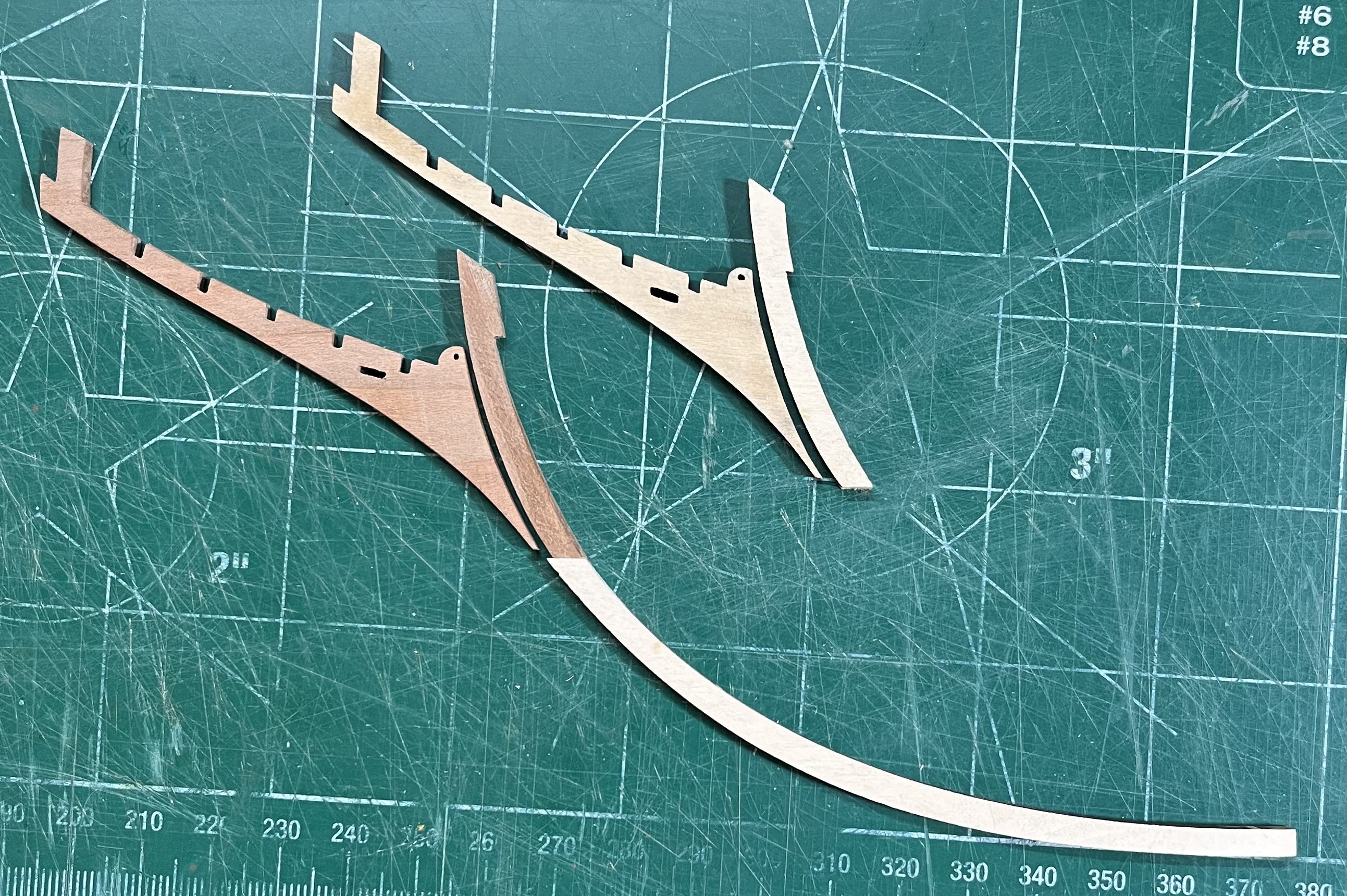

Over a month of fiddling with creating these bow pieces. I used Stuntflyer’s advice of soaking in hot water to create the severe curves. A couple rounds of bending were required. A hairdryer was used as well. Glad to move on from here!

Been working on the stem parts for a while. I used my scroll saw finally. Definitely have a lot to learn. Took a while to sand the edges to the correct shape. I used a 1/16” x 3/32” strip to check the size of the notches. They will need to fit these strips later on in the project.

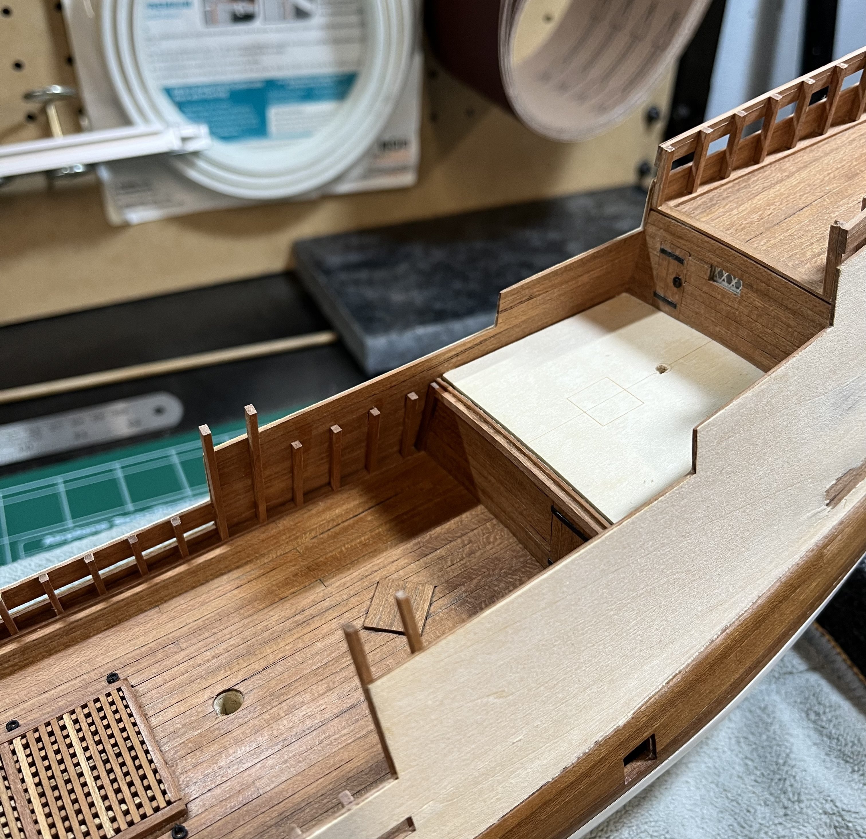

The stem, keel, and stern post have been installed. Some wood filler was added after these were installed to seal any gaps. Before working on the bulwark stanchions, I added the waterways along the sides of the forecastle, poop deck, and upper deck. I will photograph the waterways after I compete the stanchions.
Steve

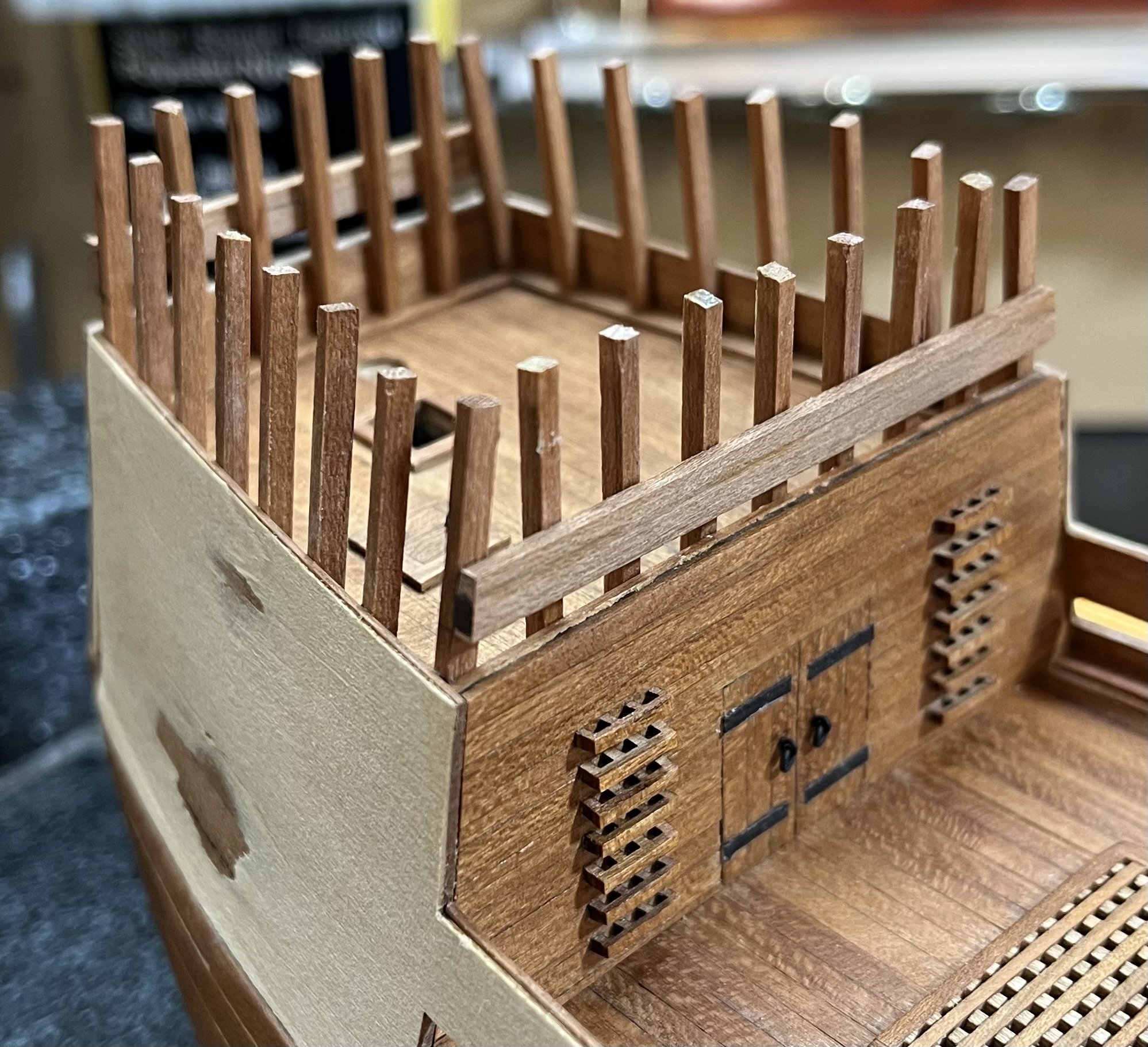

Completing the forecastle stanchions and pre-planking was tedious and required planning and concentration. I’ll outline what I did to assist those few building this kit. I started by sanding and applying Wipe On Poly to the 1/16” x 3/32” strips. I measured 1” sections and cut them using the mini chop saw that I used earlier in this project.
The corner stanchions were installed first so I could plan the spacing of the rest of the stanchions. I created tick-strips out of scrap basswood to mark even spacing for the appropriate number of stanchions as shown on the plans. Make sure you check the plans carefully here. Pin rails will be mounted later to specific stanchions.
I taped the tick-strips to the deck so I had visible reference points while installing. This was absolutely necessary to line up the stanchions. Using spacers did not work for me here so I adjusted them by eye. I remounted several along the way. It took several days to figure out this method.

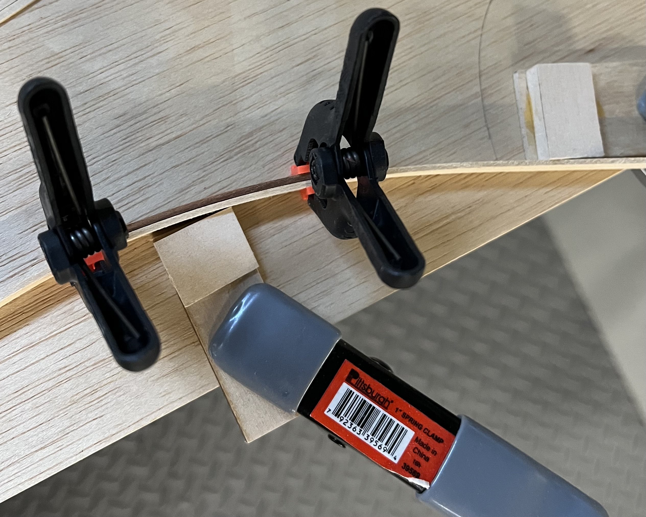

The pre-planking was prepared and sanded before cutting to length. These were not treated with WOP as they will be painted later on. I installed the fore and aft pieces first. This helped when mounting the side pieces. See photos for this and the method I used to bend these pieces. Hot water then bending as shown.
Excess lengths were cut using a sprue cutter. I tried a rotary tool first, but this was a mistake. Sanding sticks were used to polish the rest. I will round the stanchions after the rest are installed on the poop and upper deck. I hope these methods provide useful to others.

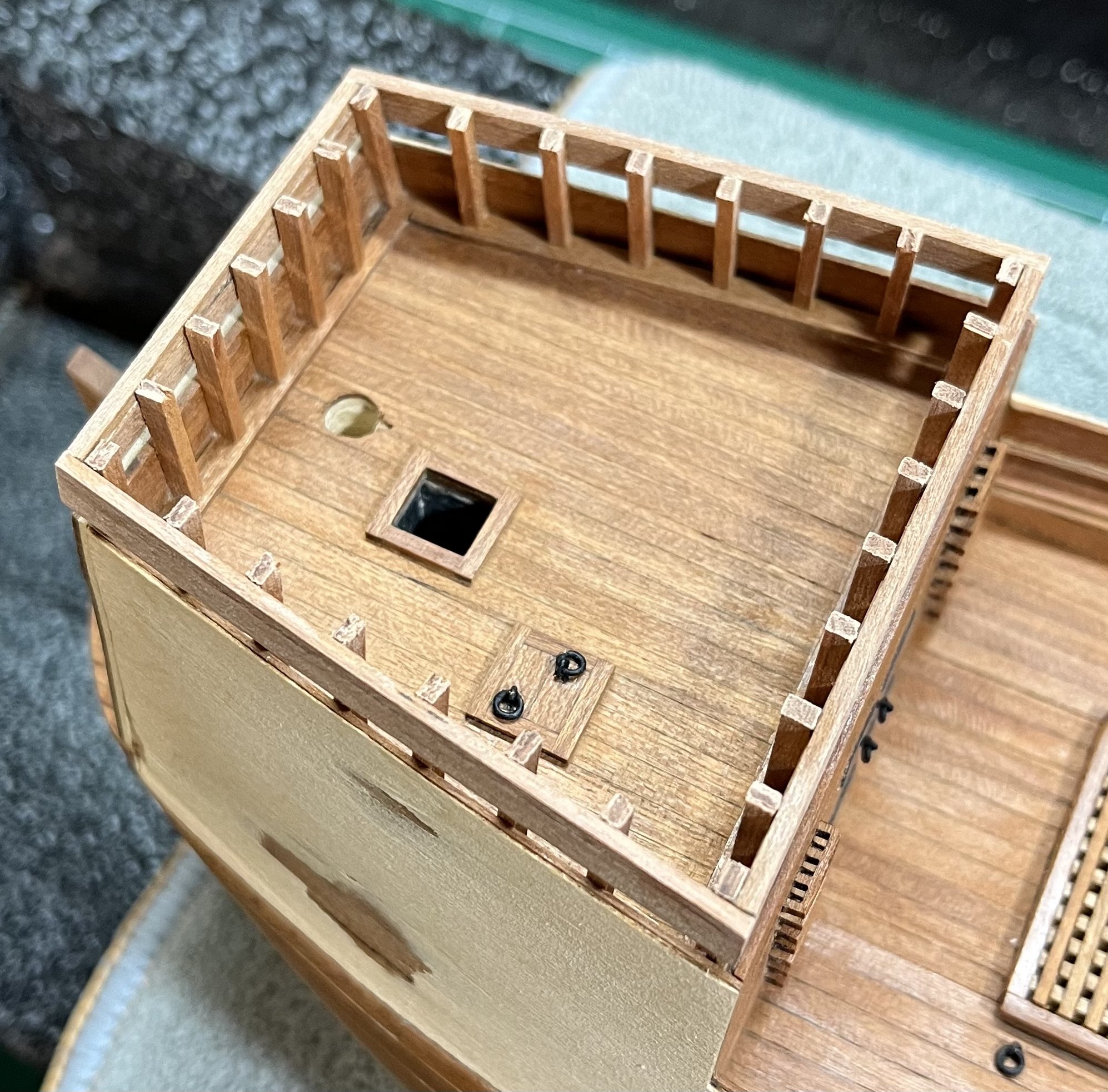

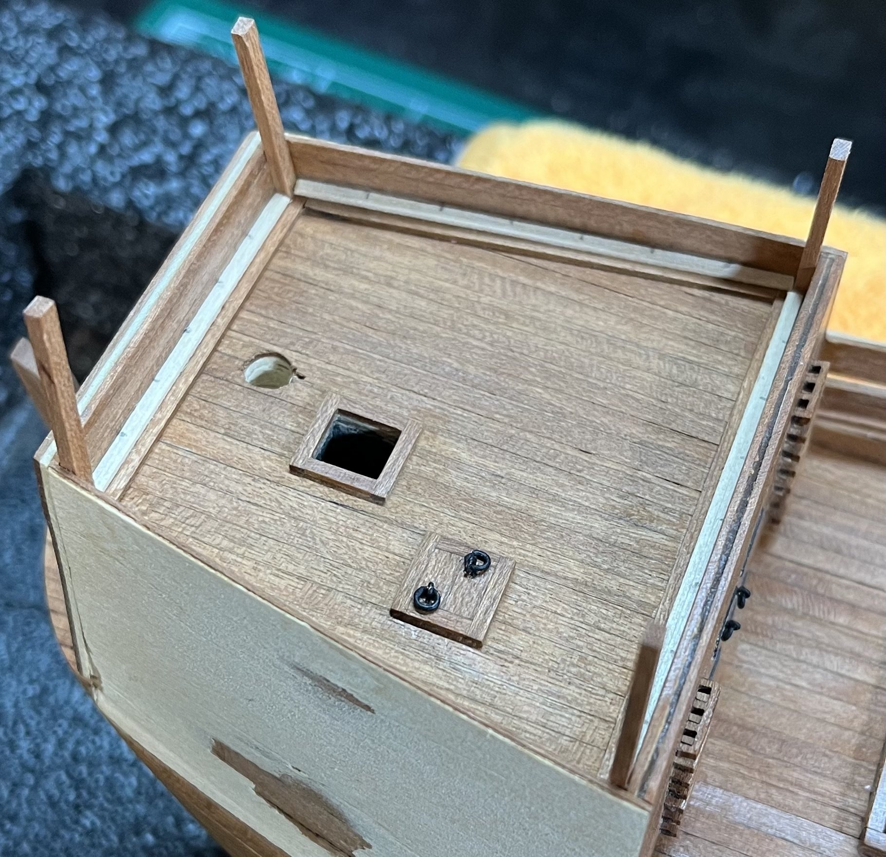

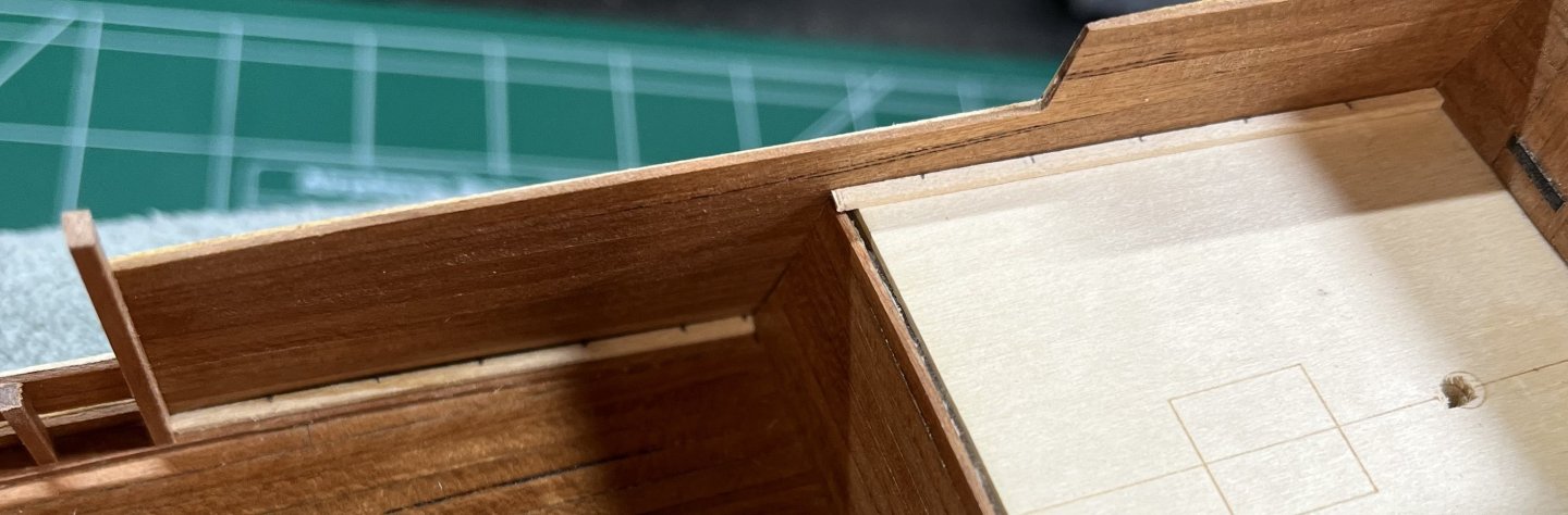

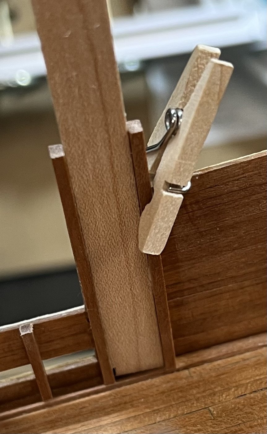

Poop deck stanchions complete. Same procedure as with the forecastle. The transom did need to be raised about 1/16” to accommodate the pre-planking. I noticed in Mike’s log that he had to do the same. More sanding was done on the bulwark templates to get them to 1/32” thick. One photo shows how I measured the thickness.
The smaller pre-planking pieces were custom shaped. 1/8” x 1/16” strips did not fit the space proper. One photo points to this area. Just like with the forecastle, there were many redos on this part. Forward progress still outweighs the setbacks.

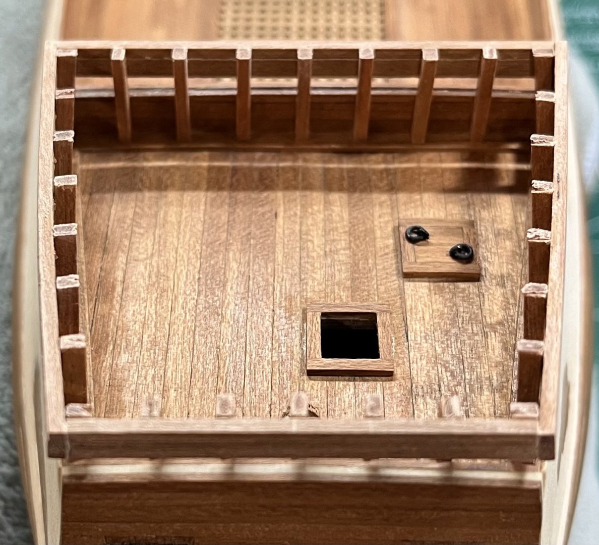

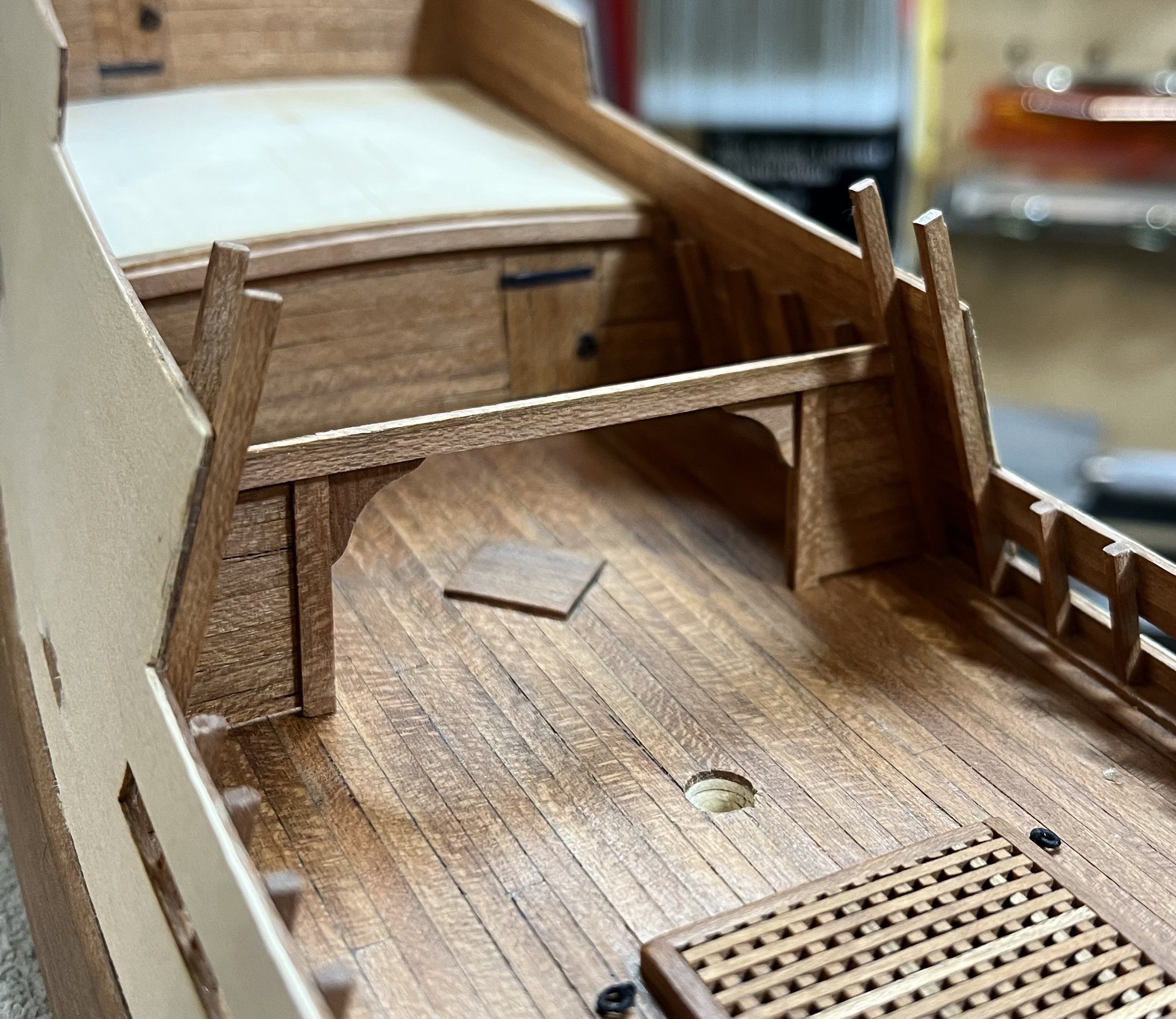

Below quarter deck stanchions complete. These were spaced with a 5/16” strip. I also installed the first beam across the great cabin bulkhead. I am constructing the stanchions in two parts, above and below the quarter deck, to avoid having to notch the waterways. (Yes, another “hack” from Stuntflyer!)
Steve

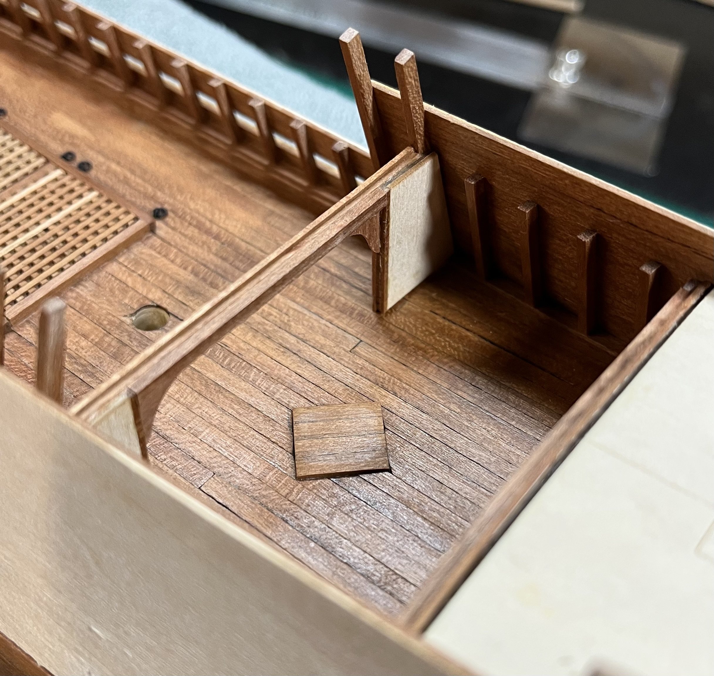

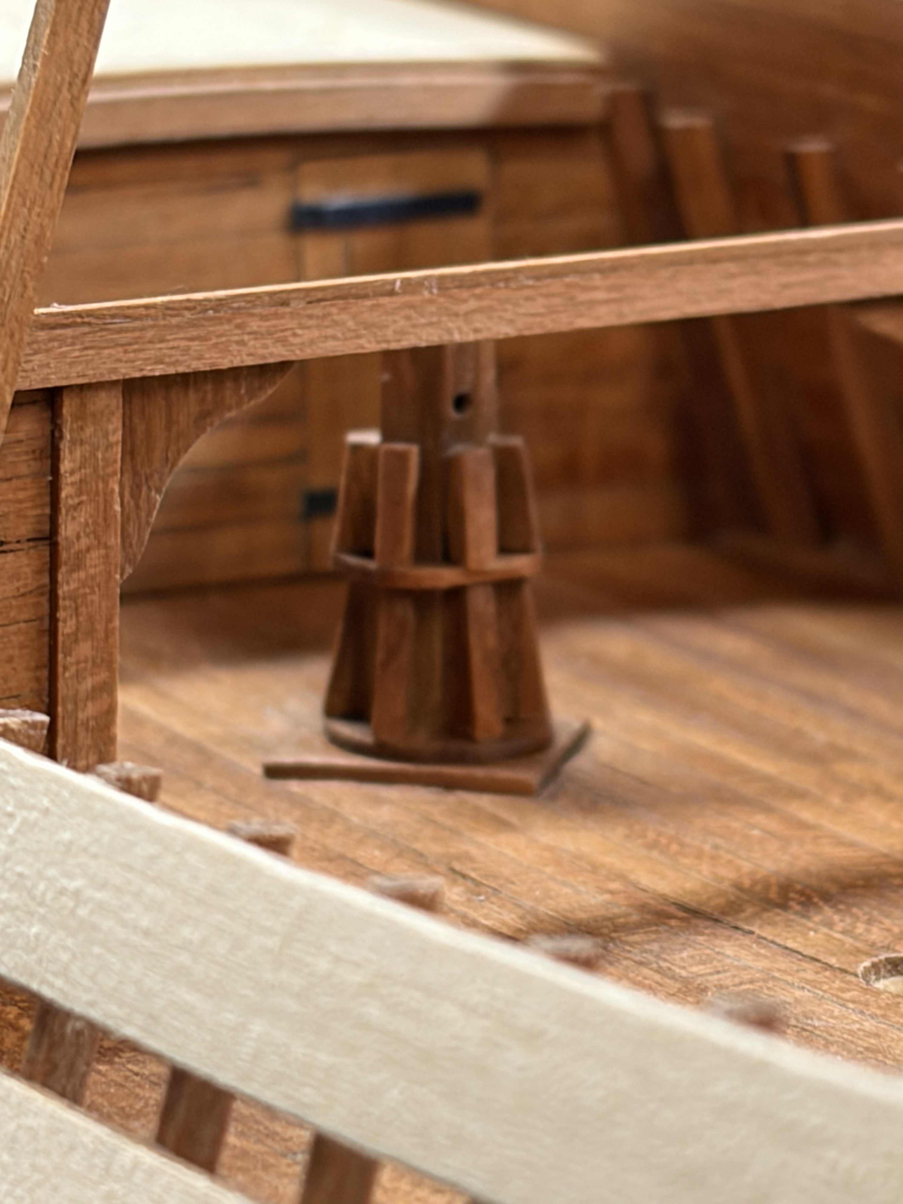

Construction under the half deck is complete minus the capstan. Beams are installed between the planked “j” templates. The decorative knees and columns are also added. You’ll notice a 1/32”x1/32” strip installed over the beam. This will sit flush with the deck when it’s added to create a smooth transition with the cherry deck planking. More sanding of the bulwarks and capstan construction is next.
For those of you following- thank you for all the likes!
Steve
Edited by Tigersteve

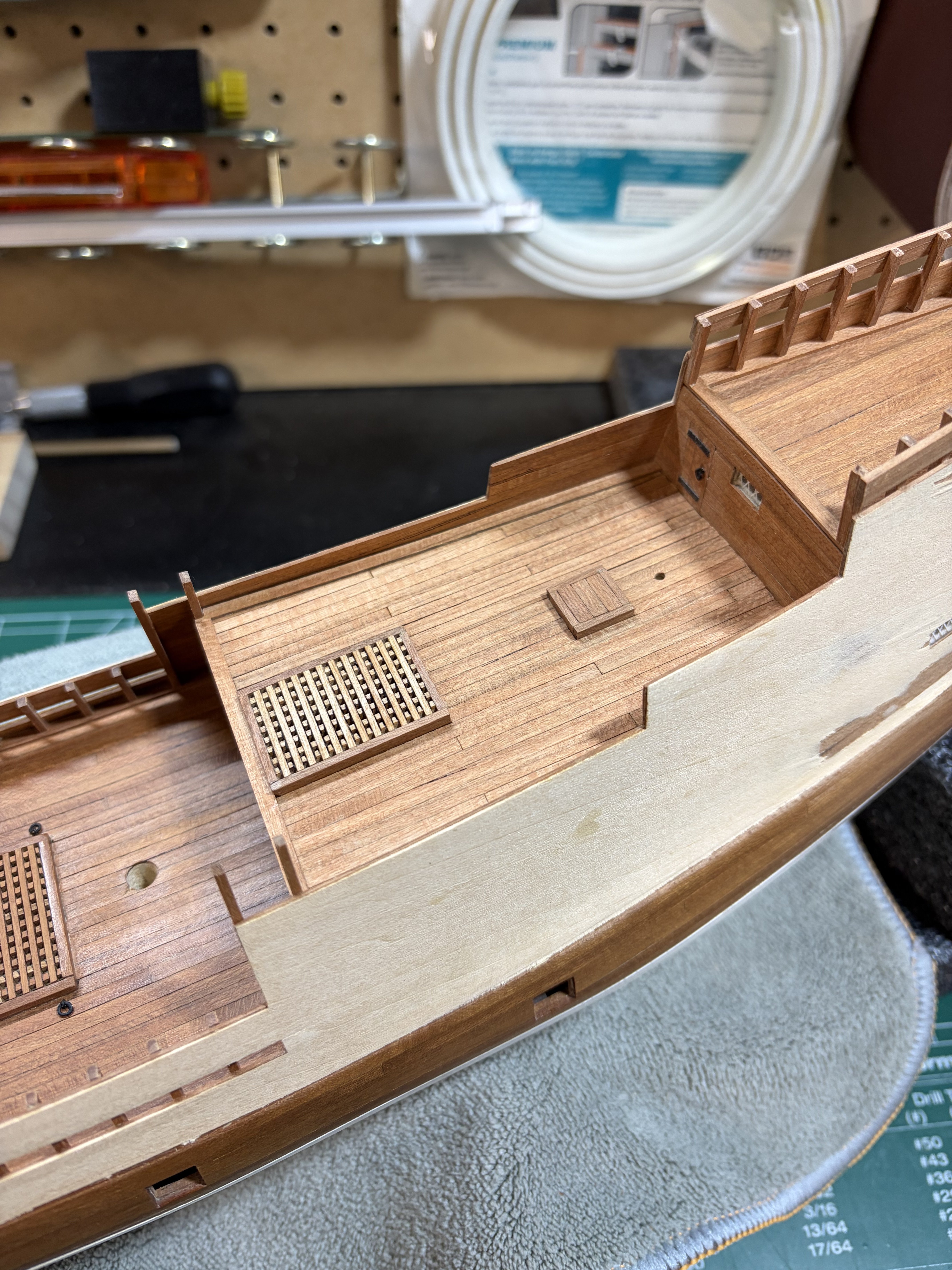

Good day Steve,
Nice , clean wood work!
some minor remark, eye catcher -the top bars of the gratings should,  as a rule :) , be located along the center plane, not across...
Vasa's deck as example ....
All the best and M-Xmass!
Kirill
Hi Kirill-
You are two years late on this information! I will keep it in mind for future. Not sure why I missed this. I have two more gratings to make for this ship. I’ll have to decide if I want to match the main gratings already constructed at this point.
Steve
Good day Steve !
 Oh! two years late !
Sorry! It just caught my eye when I looking throug pictures of Your build , consider  delay with my comment it is mostly theoretical question now , of course it’s better not to change anything here and place the remaining gratings in the same way as those already installed... just consider this information into account for the future, by the way, yesterday I started looking for additional information on this issue... and while looking at the photos of the replica, Mayflower 2 noticed that these gratings were not installed there according to the classic way, so to speak!
 But this is a replica  and it is quite likely that the builders considered this point not at all important  but in general, as far as I can judge from the literature, or photos of  original Vasa , or photographs of old original models - the battens of the deck's gratings are always located along the deck center line ... and placed above of the transverse elements (ledges) which lay perpendicular to the center line of the vessel.
Wish You all the Best and good luck with completion of this nice model!
