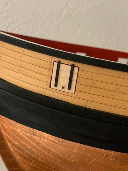

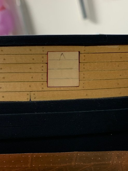

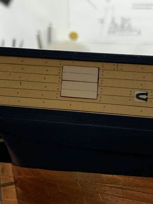

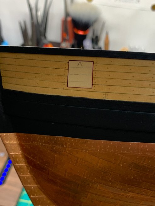

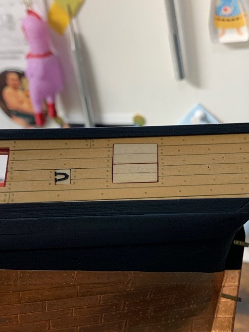

Sooooo…gun port doors. Chuck’s practicum has about 2 sentences on mounting these suckers. In short, I’ve been struggling on how to Mount them so they don’t look askew or show the hole you need to drill into the side of the ship to mount them.
Also, the idea of trying to put those tiny 1.4mm hinges on AFTER I’ve mounted them terrifies me.
I opted for putting on the tiny hinges first. Then made a faux window sill with a foam board to see where best to drill the holes and ensure they look clean. Theoretically, this means once I’ve got them drilled and prefit, I can store them until I need to mount them.  I see myself ripping these off by accident multiple times in the future.
Hey…in theory this should work. Looks ok with the practice piece.  🙏🏼
Gratuitous pics below.

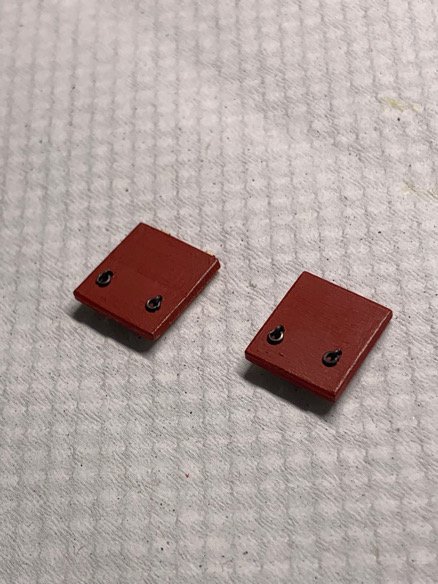

Before I start trying to drill holes for the gun port doors, I realized I needed to remake the doors nearest the bow and stern, as well as the transom doors. What sucks is they still don’t fit perfectly, but I’m tired of messing with the doors and they’re close enough. So, I’m going with them. The paint isn’t a perfect match either…but what the hell.
:dancetl6:

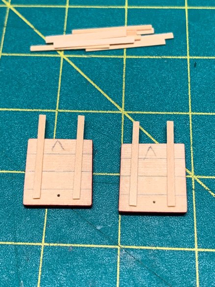

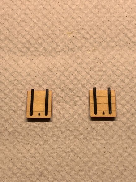

Ran into a snag. The bridle port doors nearest the bow are single piece doors  that SHOULD have a longer hinge strap (photo etched).  But, my kit either didn’t come with them or I lost them. It would not look right with the smaller hinge straps…and I did check but it seems off.
I was going to try to create some out of brass when I thought I could use thin boxwood strips I made to create the shingles for the gallery roofs I made earlier. (Doesn’t hurt to not throw away anything sometimes!)
A quick coat of paint and Waa-La!  Easy bypass and they look pretty good. I can trim the strap lengths easily and add on the hinges after I’ve glued them on the ship.
5E777B65-24F7-45A7-BE4B-810B53A2E148-29800-000002FC2A8C9638.jpeg.49ea7f7b09e3ae16ceca2d6dc819591f.jpeg
633DA597-1D69-4D79-9722-6F6CDAF1ADC9-29800-000002FC2B4446A1.jpeg.d445e767945da6a7a2bd849fc7e9d8d8.jpeg
DAC3B2D2-3CFE-4D8F-9998-F828C14864A2-29800-000002FC2B9DF02D.jpeg.b3d477f5d744b11bd2ef16486e899283.jpeg
FC2031BA-AEDF-481A-8A00-F9251DF927FE-29800-000002FC2AF83B90.jpeg.aeb29c525e0b176779041397fa0f858d.jpeg
