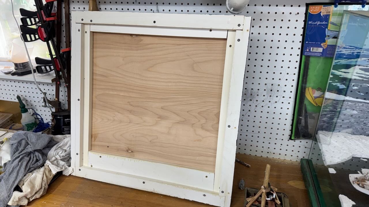

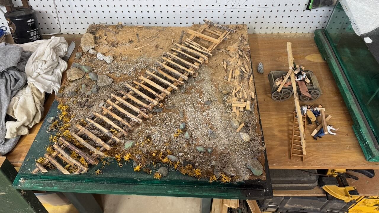

I paid a lot for the glass box that covers Bowdoin.   I wanted to try to make my own box this time.   I made a silly mistake on day one of this project.  I had a perfect 24” by 24” piece of plywood for the base.   I should had cut it down to 23.5” by 23.5”  but was not thinking about a cover at that time.   If you go to Lowes/H depot everything is for 24 inches.  I needed four sides at or just under 24.5 and a square top at 24.5 both ways.
While at Lowes, a nice guy helped me out.  He had a left-over piece of acrylic at 44 by 28 that we cut into two-piece 24.5 square and 16 by 28.   He then said only Lexan comes 36 by 48.  We cut it into three strips of 16 inch so I could make the other three sides
No if you think about this there is a problem if you want to connect parts by solvent welding.    How do you connect Lexan to acrylic?     We talked about it, and I read some about it and settled on a tube of Loctite super glue.  Before we get there, we have few more steps to follow
  • 2761965115569_sup276CCC_3065.jpg.a87e0a4dab702f22ac3a07048e65b4e9.jpg I needed a seat to receive the box, so another trim piece is added to the bottom
  • 277 508823757_sup277CCC_3066.jpg.cc6bfc988befc55e2b86f9e6608126ac.jpgthat new section needs to be painted out to black for underground or blue green for water.

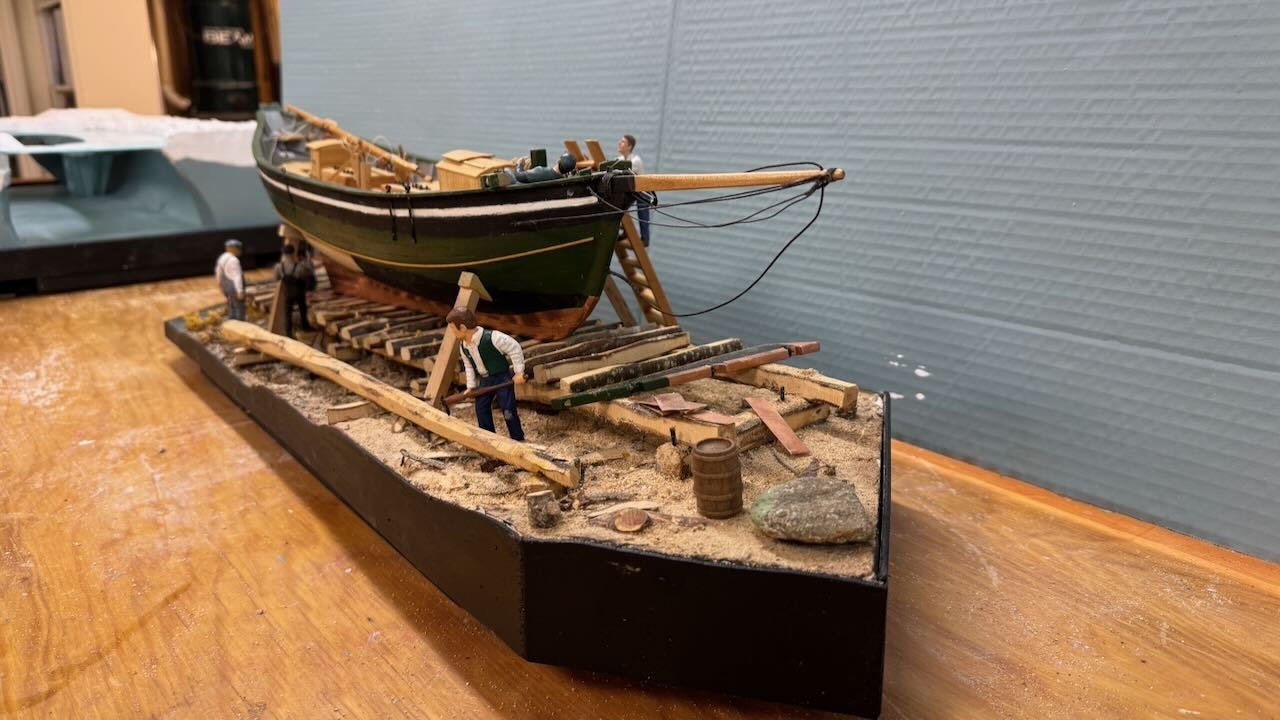

Fix the crew
  • 278 8401929_sup278DSC_0475.jpg.9b5a56df55cf9ce3f7e76be5a5bdf3b3.jpgone of our guys lost his hand.  I drilled and put in a wire frame
  • 279 1072190665_sup279DSC_0476.jpg.eae67cda6d0e2f9c5f8982d6146826be.jpgI shaped a new hand in sculpy.  I did not think it wise to put this guy in the oven, so I coated it with very thin AC
  • 280 742503522_sup280DSC_0482.jpg.5ea1757dfd0706e371259fa5fca1c98c.jpgafter a little peach paint we are all good
  • 281324129473_sup281DSC_0479.jpg.286eb68391f287ef9836a47044593881.jpg our painter needs a bucket.   I chose to machine out a dowel, like I made gas barrels before.
  • 2821101512731_sup282DSC_0481.jpg.3352418b2bed485faee0405bf326975b.jpg here the little bucket of black paint and a paint brush complete the scene.
  • 283 1535382406_sup283DSC_0483.jpg.01718acf0d94e729f153e10e21cf6eb1.jpgfinally we need an adze for the spar maker. I put a thin brass rod into his hands, stuck on a flat end for the tool. I then wrapped the brass with tape to get the right thickness.   What is fun is making all this up as we go. also I see in this photo I need top be sure I painted the blue tape.
Now the box

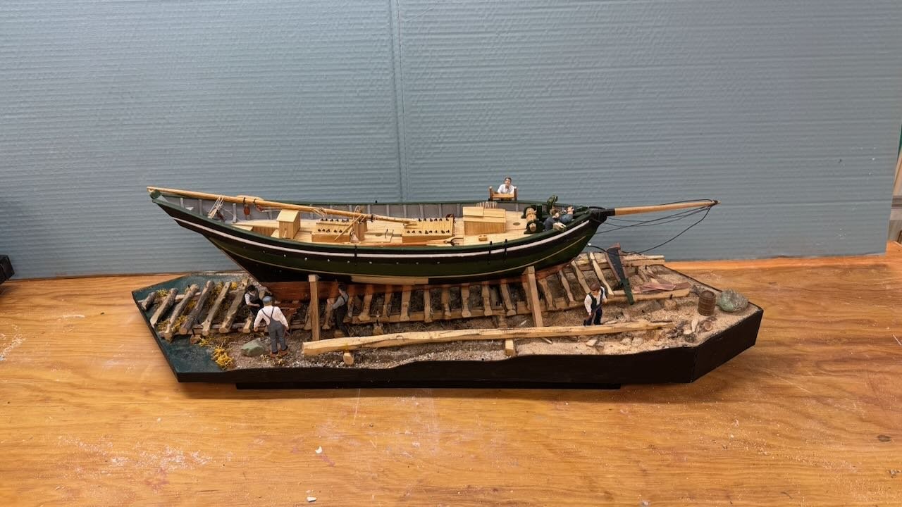

  • 284 494431544_sup284CCC_3083.jpg.71772b0f5f2dd39b503d0a97c3d2d4c6.jpghere we are gluing it up.  After using a concrete block to hold the sides vertical with the first application of super glue, I came back and ran a fillet on the inside of each joint.  This stuff is only about 1/8” thick and a bit flexible.  We’ll see how it goes. At least it won’t hurt anyone if they hit it.
  • 285  746727771_sup285.jpg.a6c580c2bab1018437afe877de0dc0f2.jpg here we are…amazing it fits
  • 286  1300767596_sup286CCC_3085.jpg.a1d96a277d653d12d8a12c4eea6405f5.jpgI should have asked for help as things fell over .  now it is shaky to take if off.  I will wait till be are closer to the showing before removing all the protection.

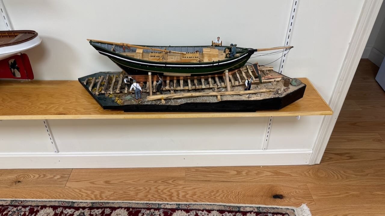

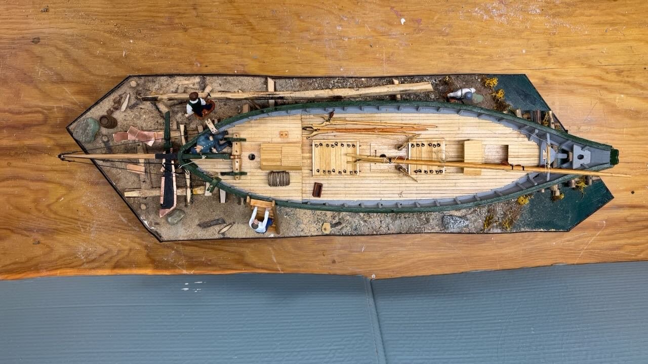

I just wanted to conclude this story with a picture in the Windjammer's Emporium museum store in Boothbay Harbor Maine . She is sitting beside last year's project of the 1924 Bowdoin diorama we built last year. come see them
