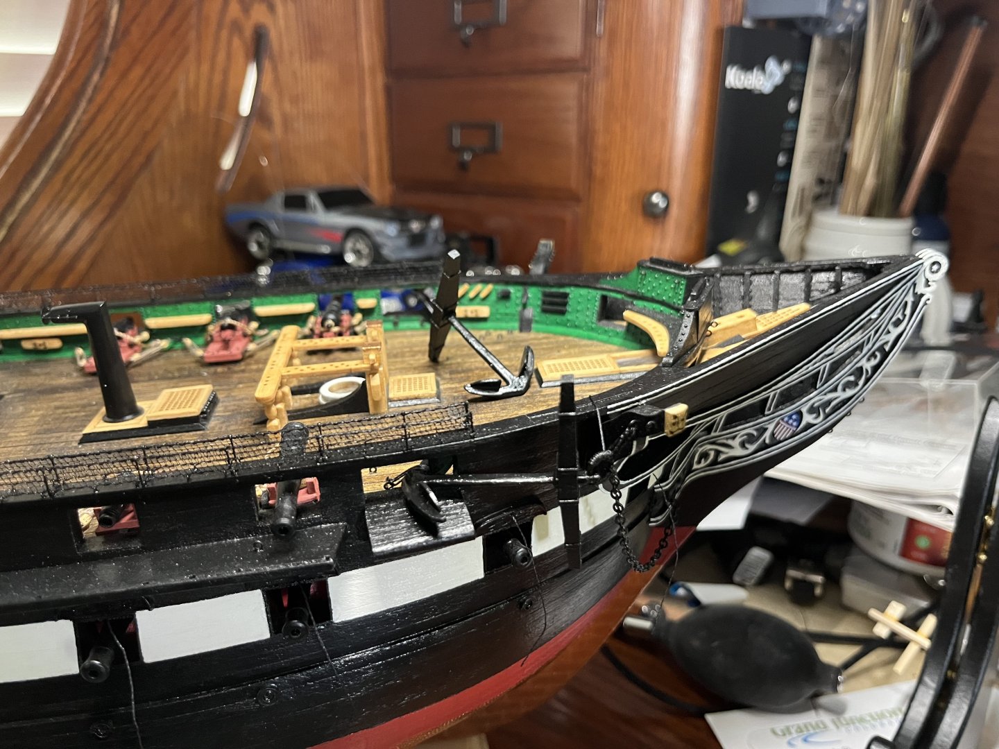

1 hour ago, mtbediz said:

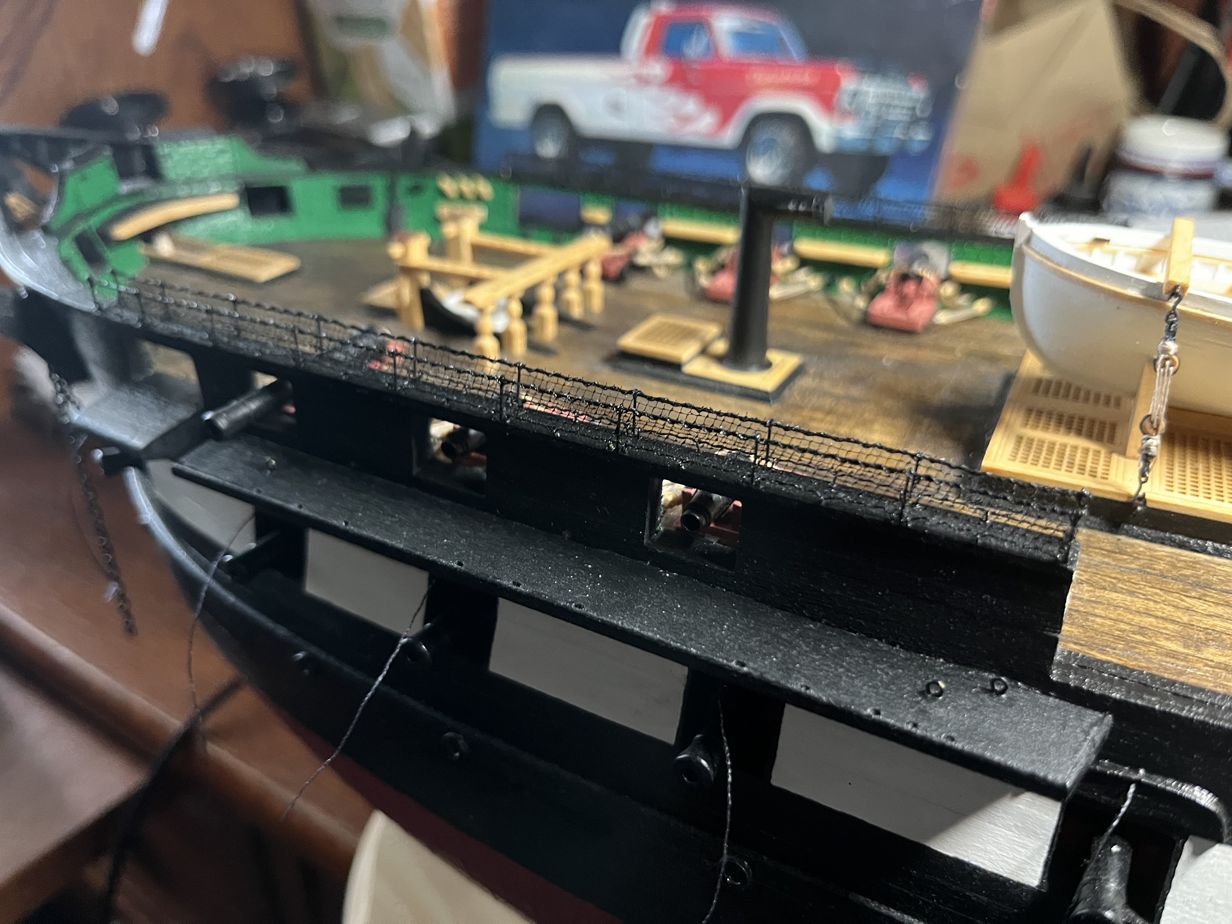

Hi Thomas, how did you make the white stripes on the rails on the bow? It's been a long time, I hope you remember :) By the way, the ship's boats look great!
That’s ok I still remember! I just wish I had a new cool technique to share, but I just hand painted them.
I painted all the black first. Then I went back and painted the white stripes. This way allowed me paint from the sides and have a little touch up in some of the black areas.
I just remember something!! At the hobby stores you can get polystyrene strips and sheets. They are extremely flexible and come in a ton of different sizes and they are already white. I’ve used them mostly to make cooling fins for my planes!IMG_3425.thumb.jpeg.e4284c690ee8e223a0eb9573bf3a0132.jpeg
Thanks a lot Thomas, I make them from brass wire. I was just wondering how you did it. I tried to paint them like you did but I didn't succeed. You have a scale modeling background so you are much better at painting than I am.
The styrene solution is the one employed in the Hunt practicum. It's a fairly easy material to work with and may have been an easier route for you to take, Mustafa.
But yours is definitely an out of the box  alternative solution.
And, the more I look at Unegawahya's work, the more I'm impressed.
Cheers

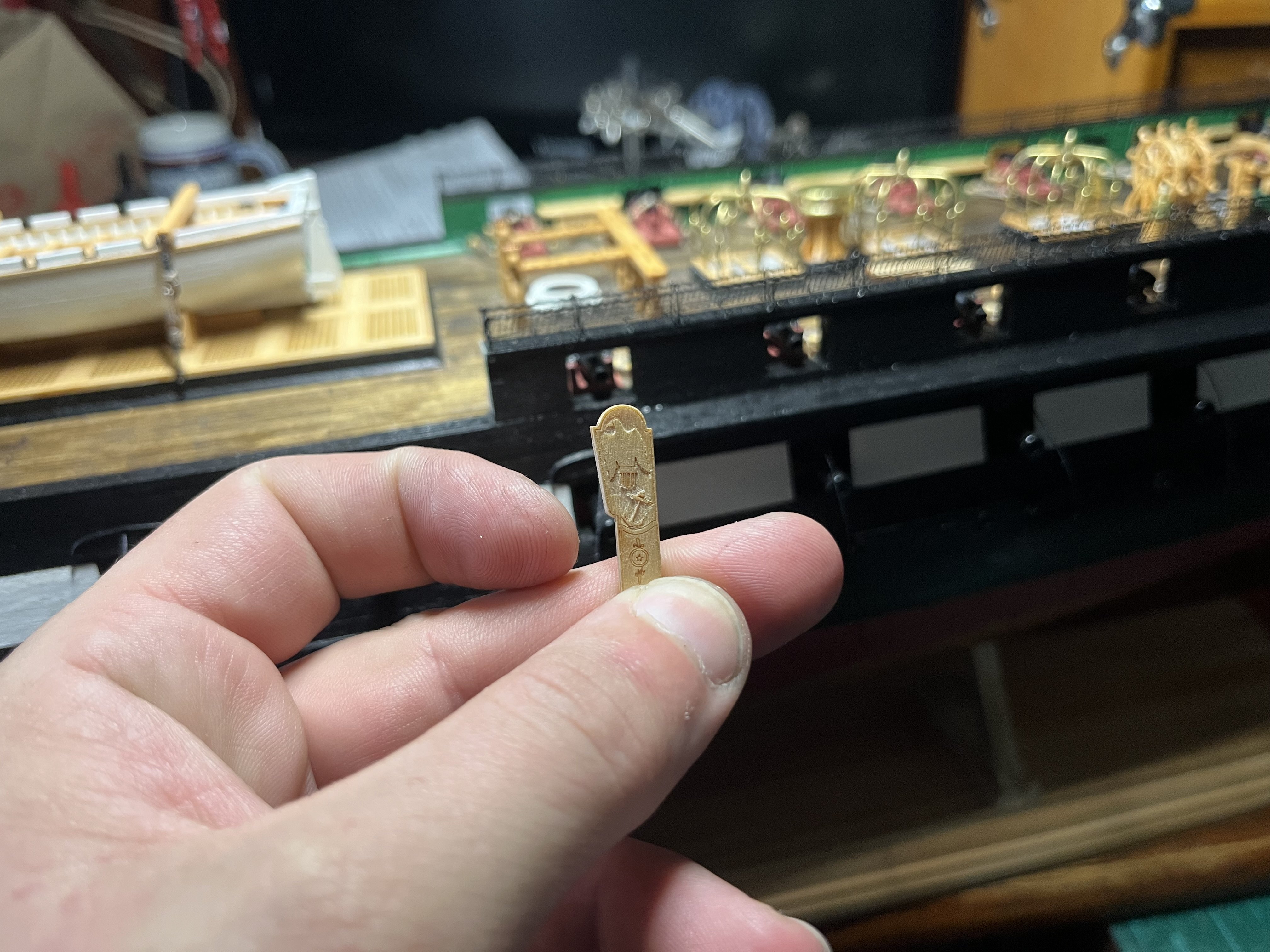

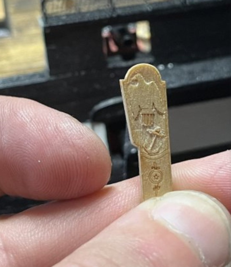

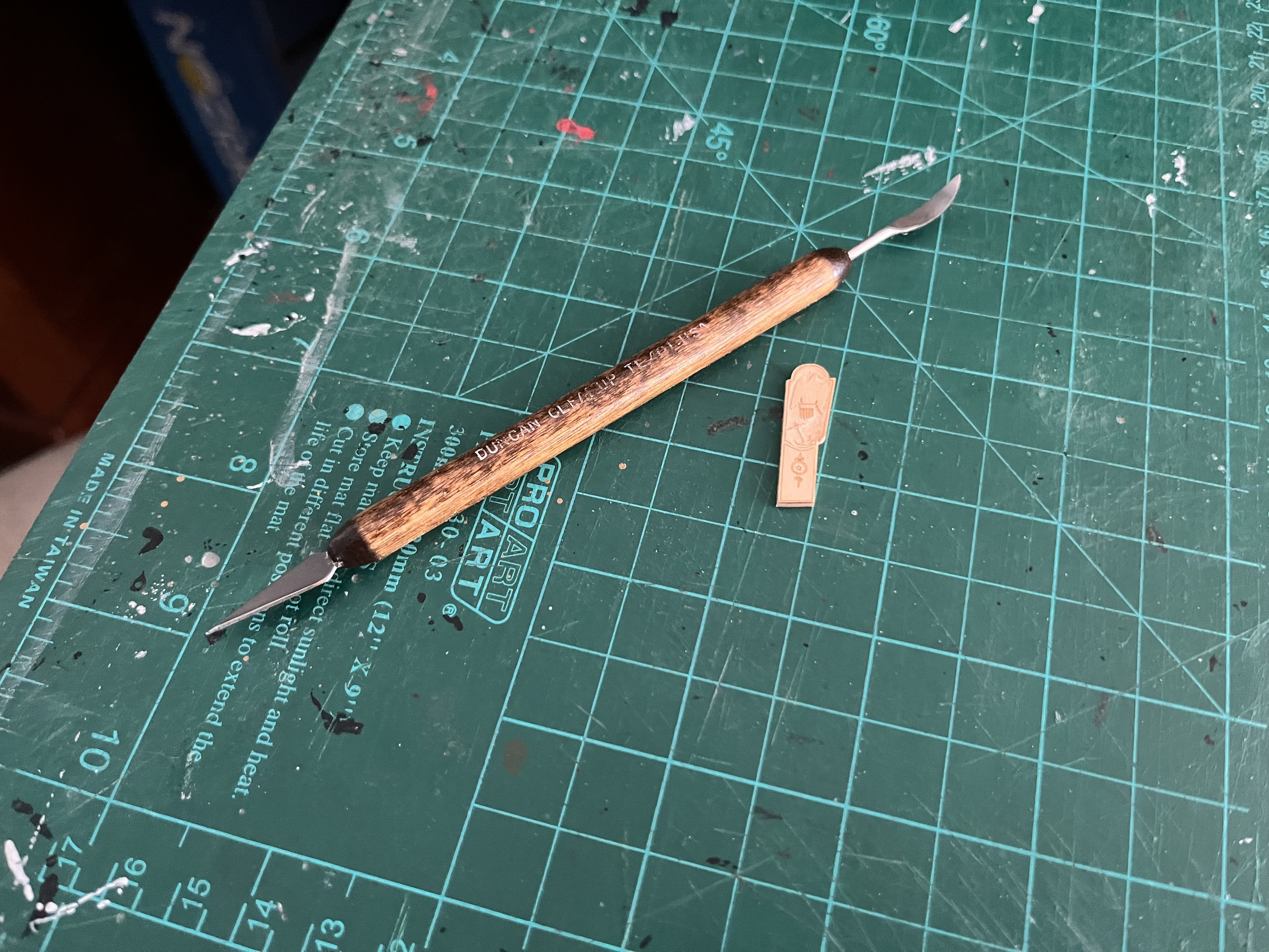

I’ve finally finished stitching my hammock netting on! IMG_9007.thumb.jpeg.4ce219da82cd33d458fa1cecd888de5e.jpegIMG_9008.thumb.jpeg.01ba046ee0d1dbeee9e0df3c5e32e46c.jpegI’ve started carefully scratching out the background on my gangway boards. I’m using a curved scraping tool that I’ve had for long enough that I don’t even remember where I got it.IMG_9009.thumb.jpeg.608c2adb845d6d6fa6ff9bf838be8114.jpeg
That gangway board carving is gorgeous! You mentioned you used a "curved scraping tool." can you show us a picture of what it looks like?
Jon
IMG_9010.thumb.jpeg.fc62588c94b575235357fea8516bd715.jpegSorry.
This is what I’ve been using. I’ve had it so long that I had to hone the blades. I’ve been carefully using it to gently scrape away the borders in the carving on the laser cut supplied parts.
That tool looks like it's from a tool set for sculpting clay. Nice job repurposing it.
Jon
Jon
I believe that’s where I got it! I just don’t remember.

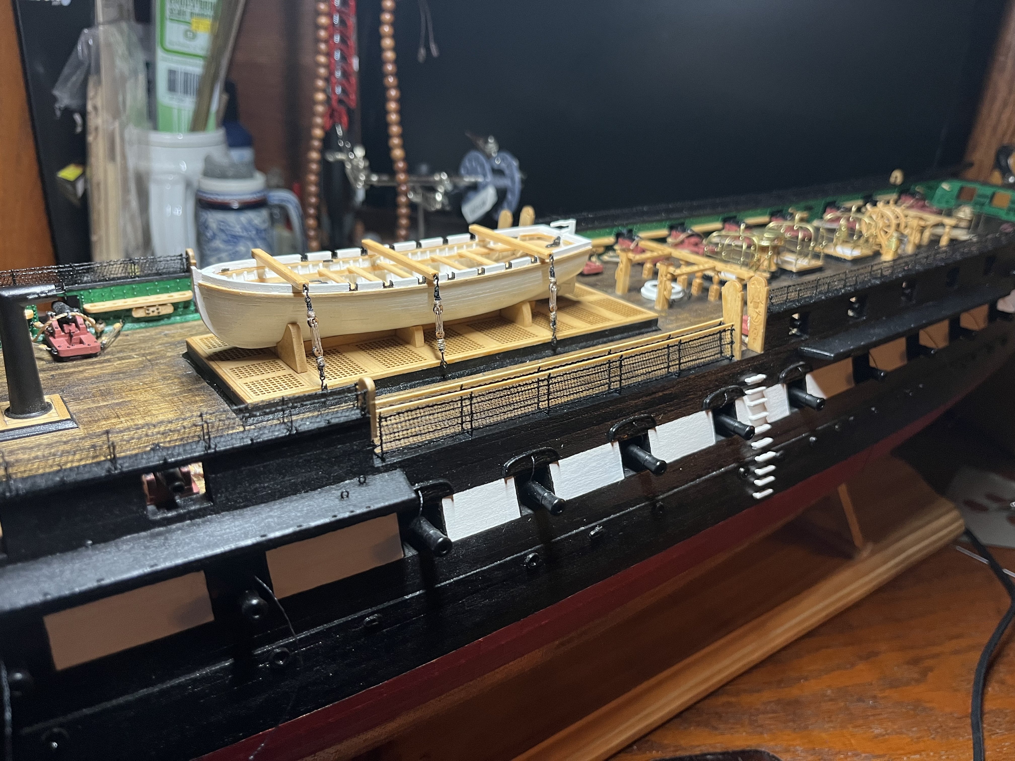

My fist two gangway boars are installed and I’ve mapped out where my sea steps are going to be located.IMG_9029.thumb.jpeg.6d07296770ed69b62e2b1b316e9a915d.jpegAfter doing some research, it seems that when the bulwarks on the waste where removed it looks like the placement of the sea stairs where changed and one was removed. IMG_9021.thumb.png.76ef2845656762a264509f74d48e9523.pngI’m borrowing mtbediz’s method for making the sea stairs and made a jig for the top 7 for each side. My first one is done. Now I have 19 more to make.IMG_9032.thumb.jpeg.b0228a6f6c309ed34f592313c7fa931e.jpegIMG_9031.thumb.jpeg.6344a18b6642d87f80f7bbfabfb2014e.jpeg

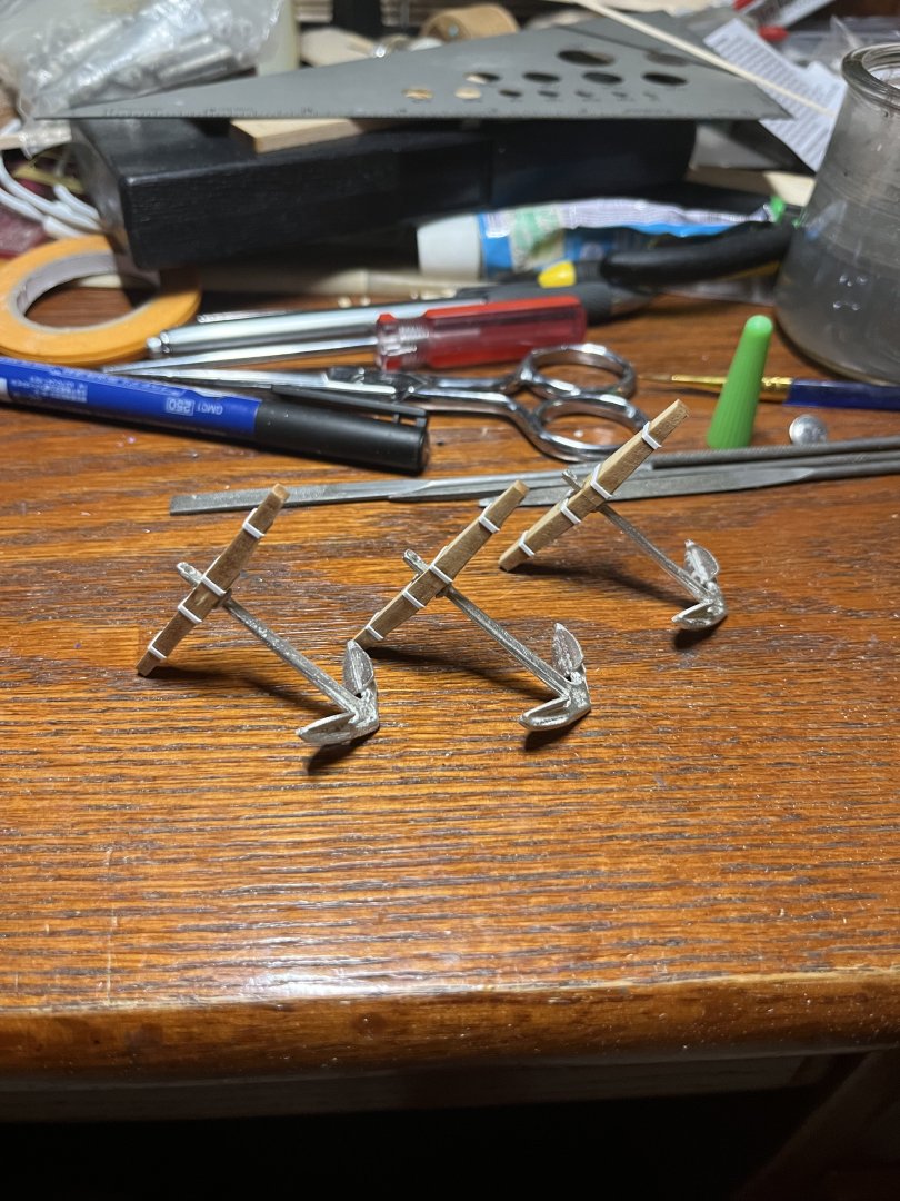

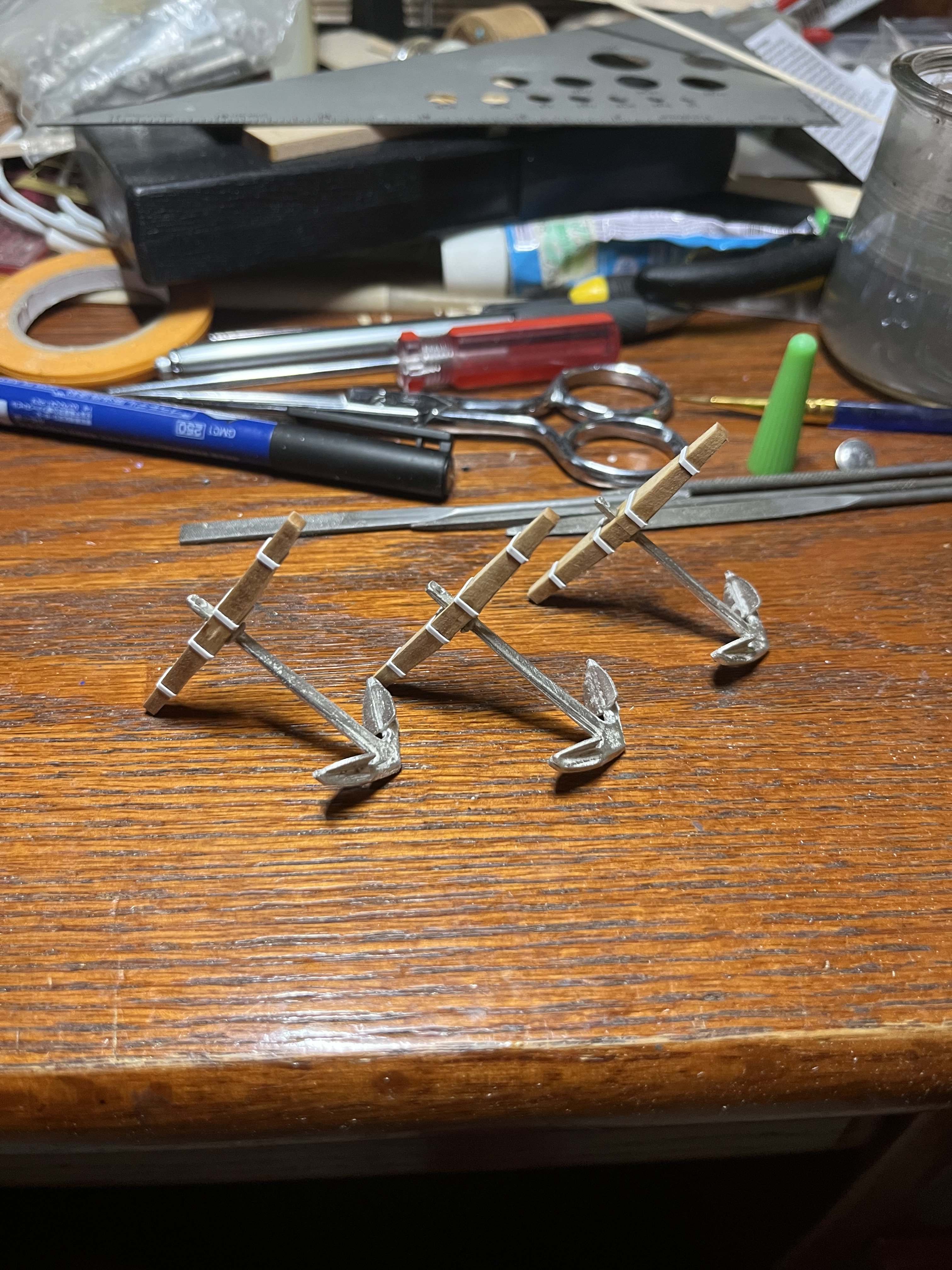

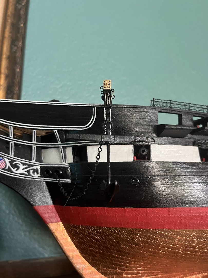

I’m waiting on some supplies to photo etch my midship hammock stanchions. So in the meanwhile I’ve been working on my anchors.
For a change, I’ve used the kit supplied parts for the anchor and the stock. The bands on the stock are .010 x .040 Polystyrene strips. The ring is a brass rod that I formed into shape.IMG_9095.thumb.jpeg.b7127f2a745034be6d5a6e05719d1e7f.jpegLooking at a lot of pictures, it looks like they would wrap the ring on two sides to keep the chain and shaft separate.IMG_9113.thumb.png.b838da7079816c51d41563d2f57bf2fb.pngUsing my forceps and soldering holder to hold everything I got all three wrapped and painted.IMG_9104.thumb.jpeg.00e66d26eba97638b0ec02a895b1341d.jpegI ultimately decided to have the starboard stowed with the chain attached and the port anchor will be hanging from the cathead.IMG_9112.thumb.jpeg.7b883f70b9b4500145e8370e5a427740.jpegAnother thing I found that is extremely useful, is using 50/50 Easy Dope with water to help give a look of weight. When I first had the rope from the top of the anchor to the cathead, the rope wanted to stay in more of a loop. After I had everything tied off I used a brush to put some Easy Dope to the rope. Then I placed a pair of pliers on top to hold the top of the anchor down. Once the dope was dry, the rope stayed exactly where I wanted it!

Your anchors and anchor rigging all looks really good, Unegawahya!  Sharp construction!
I'm glad to see you got some value out of the kit's components.  Looking sharp there.

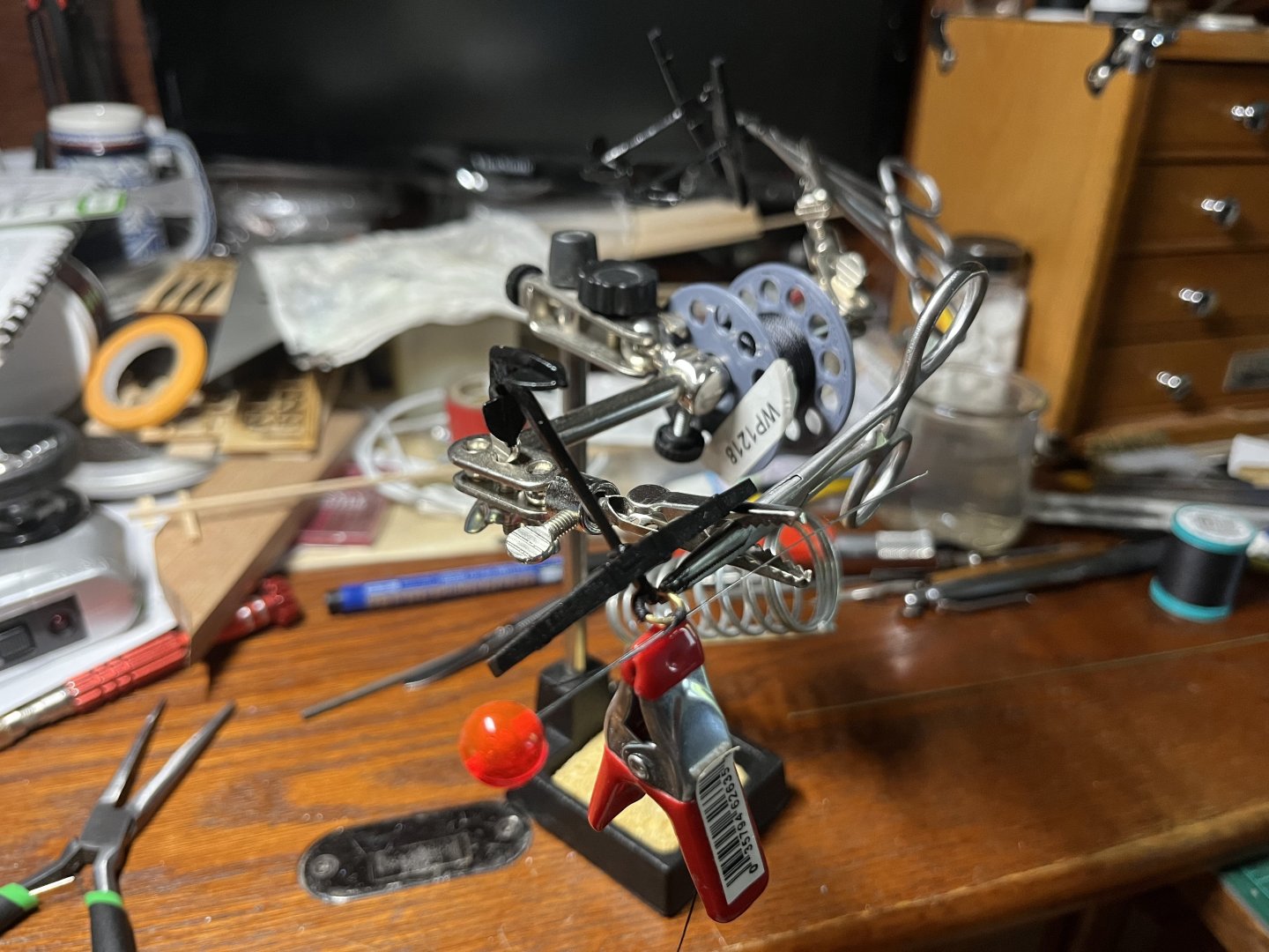

Um, what's the pin(?) with the red ball at the end, and what's it used for?
Edited by Der Alte Rentner
That is a threader that I got from our fly fishing store. When I wrap anything with a sting or rope I’ll add the threader. Then when I’m done I’ll stick the tail in the end of the threader and pull it through!

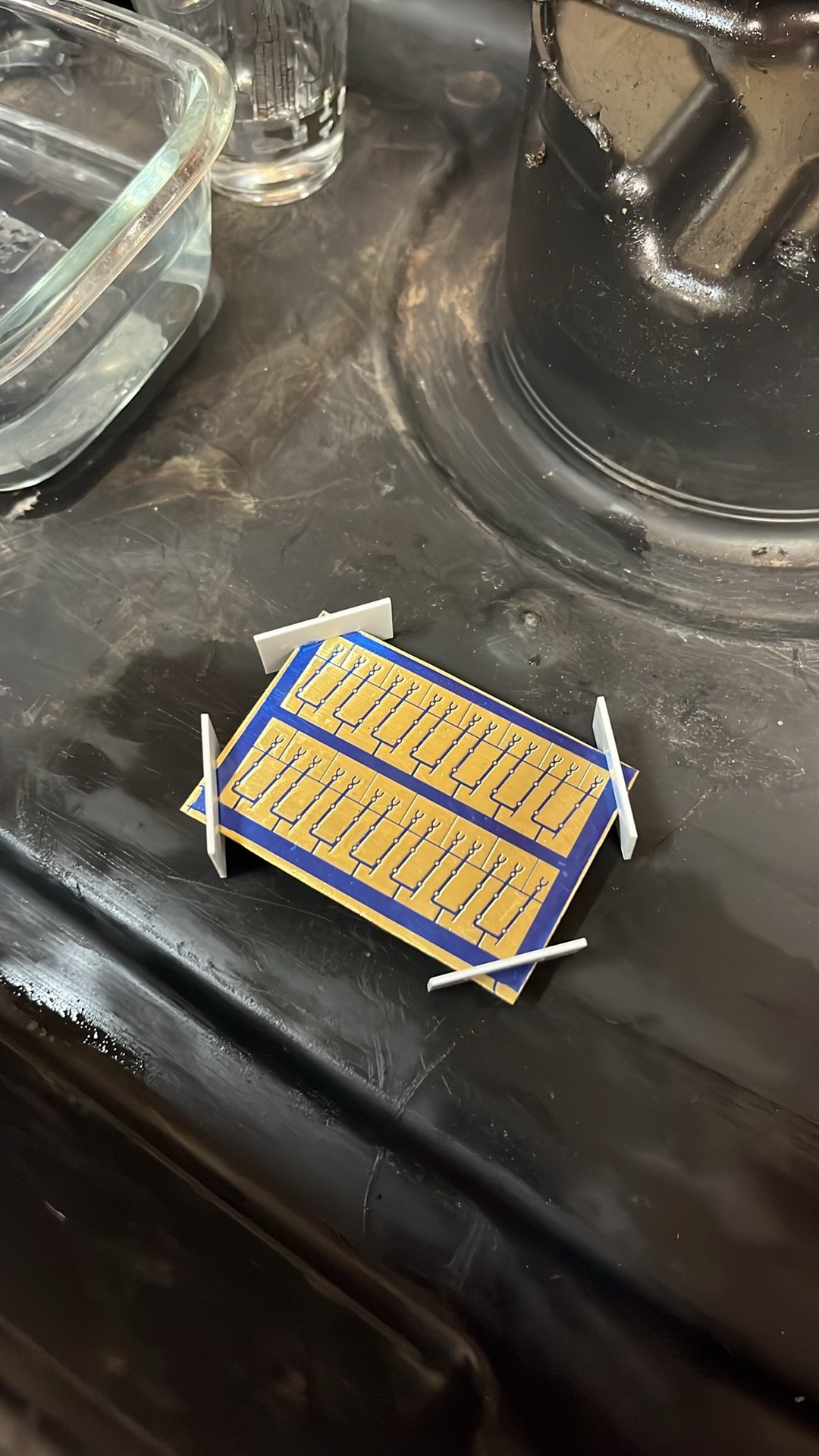

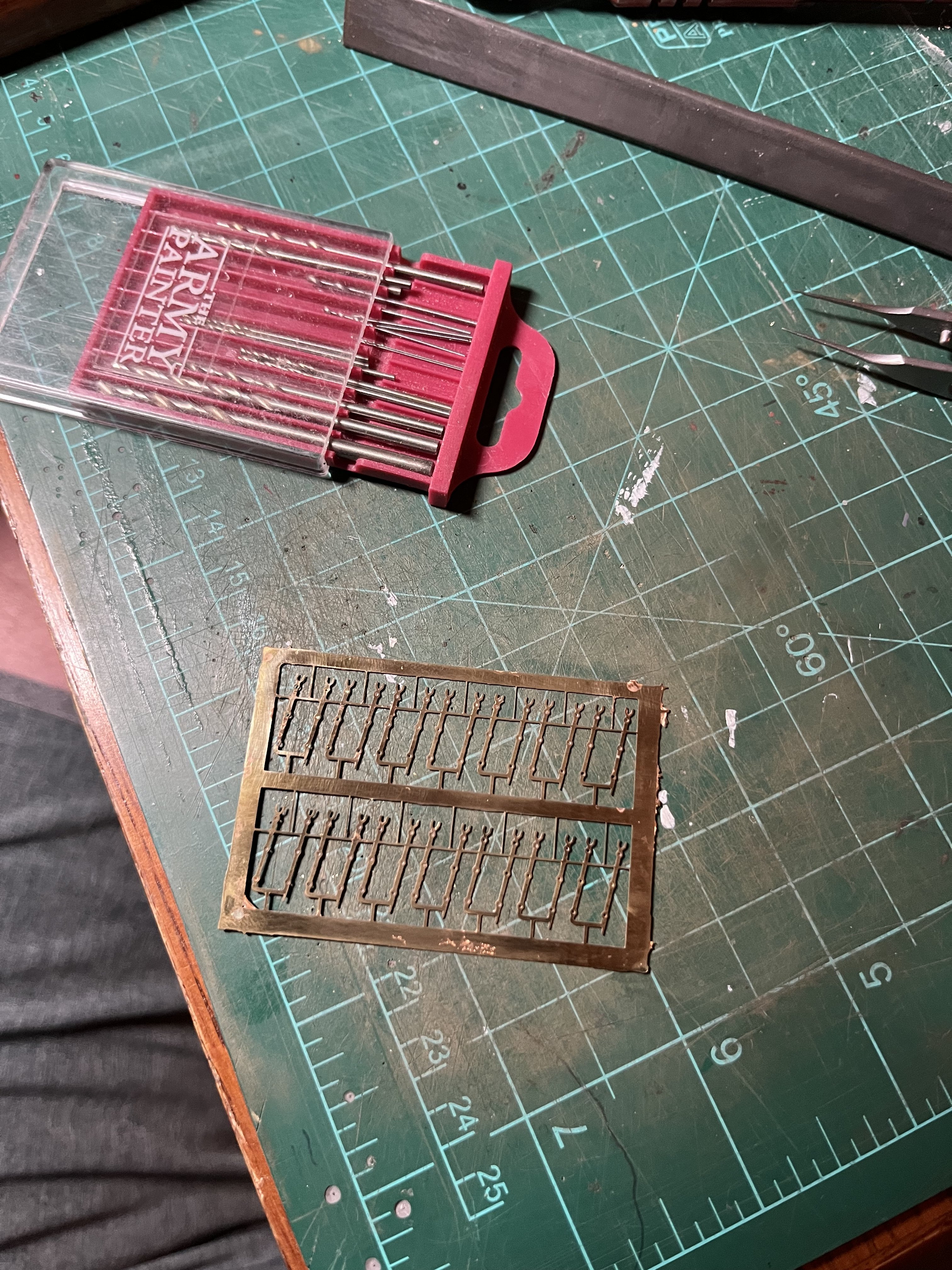

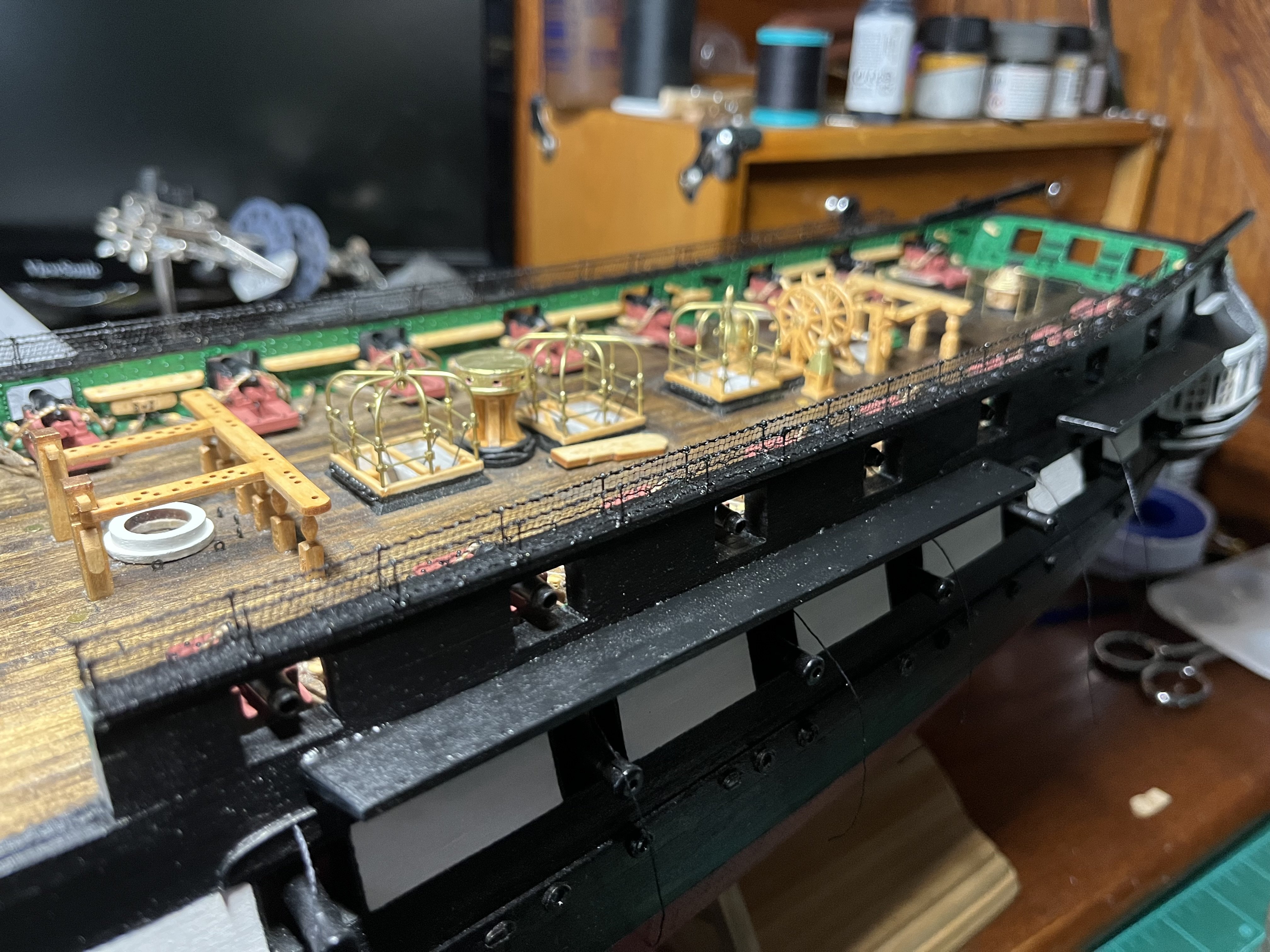

I needed midship hammock stanchions for my 2015 build and after three etching attempts, I think I finally did it!
I designed the template on my computer from the Navy plans and finally got some good results. I do need to clean up the rope holes but I’m really pleased with the final result!IMG_9230.thumb.jpeg.cda1335d62345db989508de9bf520c12.jpeg
You achieved very good results Thomas. How is this etching application done? Is it done with a machine or something? Thanks.
I used the etching photo resist masking from Model Expo that sets with UV light and I etched the brass with a 2-1 mixture of hydrogen peroxide and muriatic acid. IMG_9221.thumb.jpeg.aa5164cc65c3d1736ffe9e7bce15474b.jpegThis was my second attempt. I didn’t get the photo resist applied correctly on the other side and it started peeling off.

My first set of custom hammock stanchions on the port side are done! It did seem to take me a wile to get the design set up and the materials together to photo etch the stanchions. But I really think it was definitely worth it!
Now I just need to get started on the starboard side.IMG_9280.thumb.jpeg.61ab8401306985675da075c7e01b0e83.jpeg
