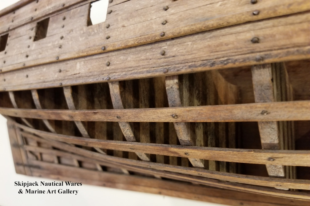

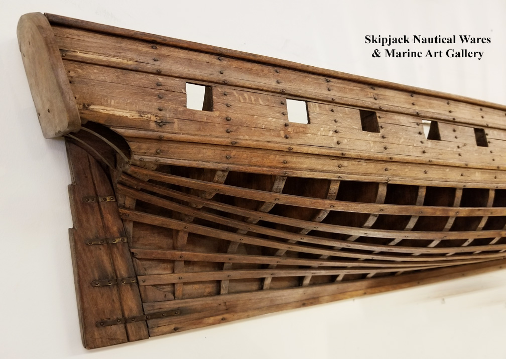

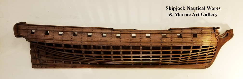

Another method is the "basket method," which can be found described in the seminal works of Charles Davis and Harold Underhill.  If following the full-size practice of boat building, as opposed to ship building, and is more suited to modeling. This method is similar to what you are attempting right now, except that the battens are extended the length of the hull on both sided, bent over a few widely spaced molds or frames, if your frames are strong enough. (Often, all that is required is a mold at the broadest beam point and one or two forward and aft of that. Your transom and/or stern post forms the landing for the battens aft and the stem rabbet the landing forward. If your molds are accurately set up, the battens (pieces of strip wood the length of the model at various heights) are temporarily fastened to the molds (just as you have done with wire ties) and these battens form a "basket" to hold the frames in position. (The frames in the way of the molds are set up after the rest of the hull is planked up.) Once the framing is complete, planking commences with the wales first and then the rest of the planking fastened to the frames. As the planking progresses, the battens are removed and replaced with planking until all the battens are gone. Then the molds are removed and the remaining frames placed where the molds had been.
The below photos of a half-model displayed on a board demonstrate the technique, although in this instance the battens are permanently fastened on what appear to actually be solid molds or "bulkheads," rather than actual frames, and the opening permits the interior construction to be seen when the model is displayed. This method is also a time-saver when it comes to planking if you run your battens such that they define the run of your planking. In that way, they save the intermediate step of lining out your planking using tape or string. The battens are already there doing that for you. Planking is much easier off of a building board (IMHO) and the battens and previously hung plank maintains a very rigid structure throughout the planking process.
