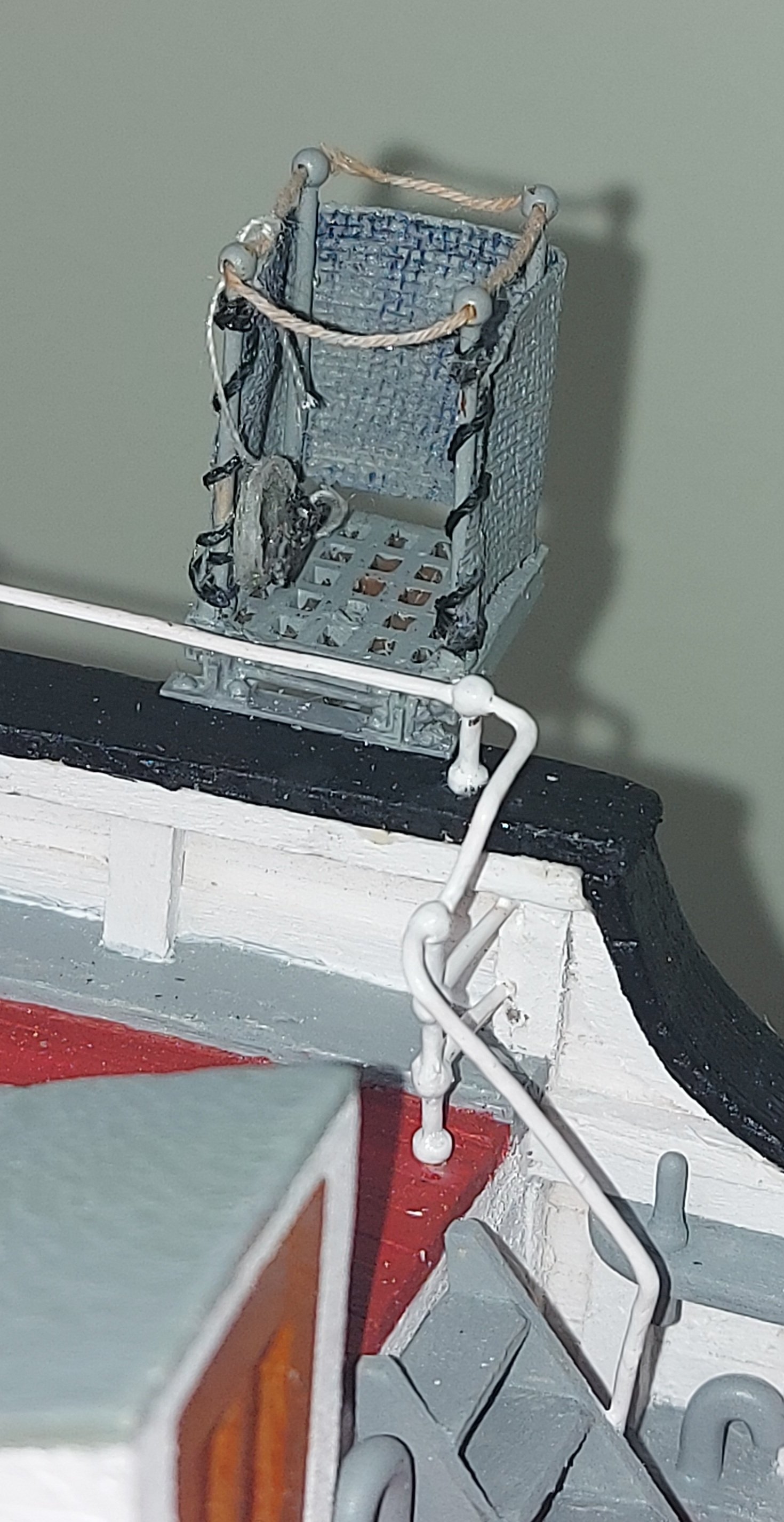

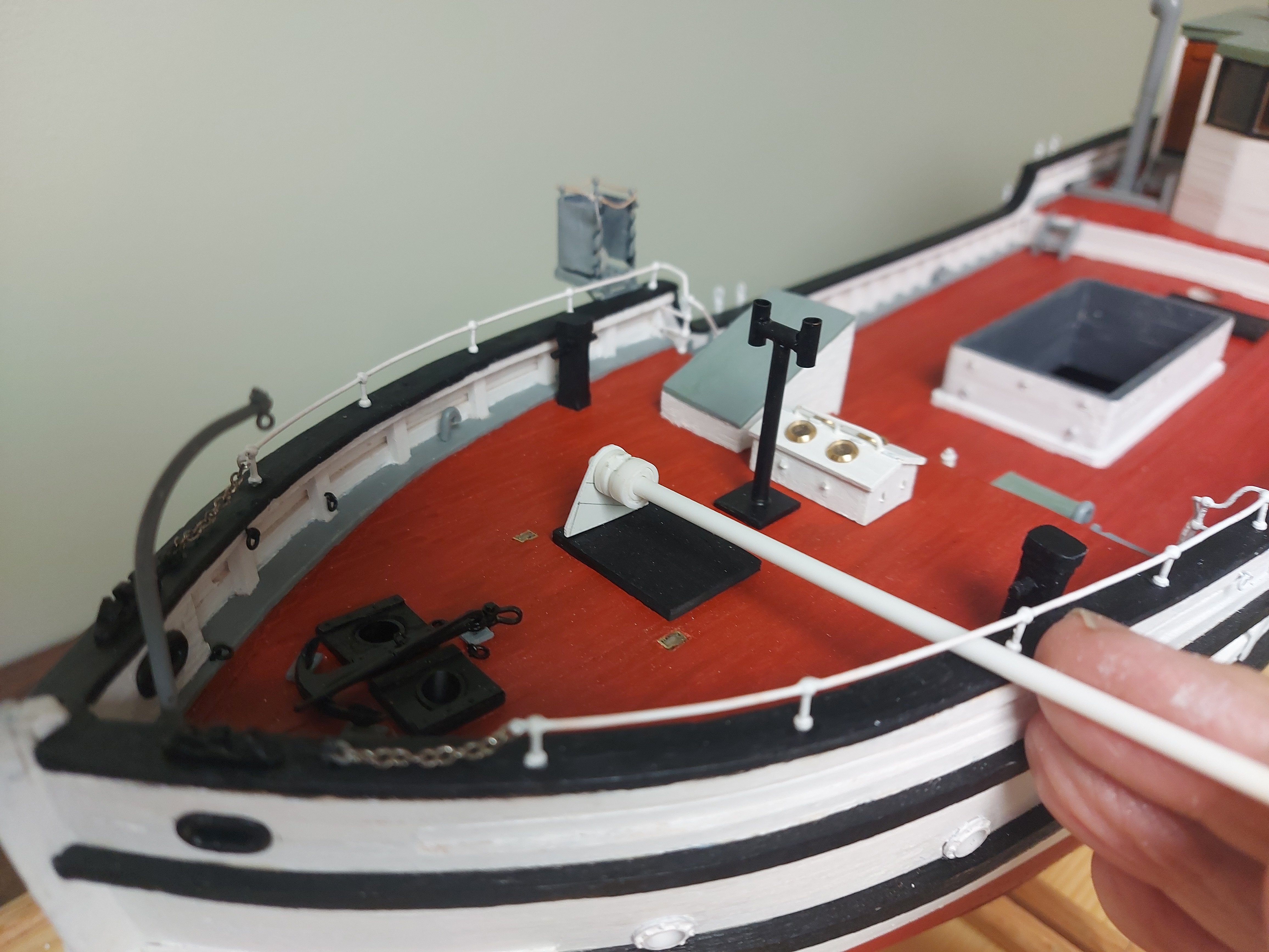

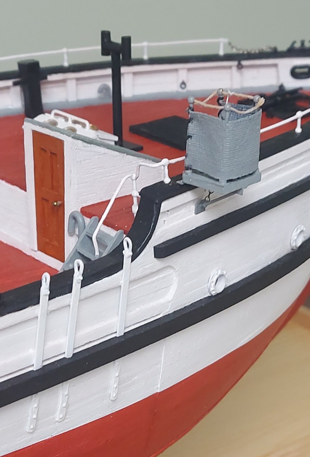

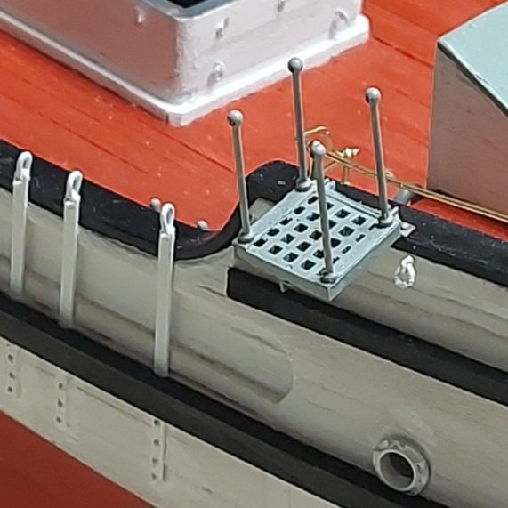

First up is to build the small platform that extends out from the starboard fo'c's'le. Photos show this was added by the crew in 1929 during St. Roch's maiden voyage. She spent much of her career sailing through uncharted shoal waters, and Captain Larsen wanted a place from which to swing the lead and communicate easily with the wheelhouse.
Design plans show a sounding machine on the poop deck, but there is no information that it was ever installed. Larsen makes no mention of using it, and I am sure he would have found the location unsuitable for reporting soundings. I am not including it.

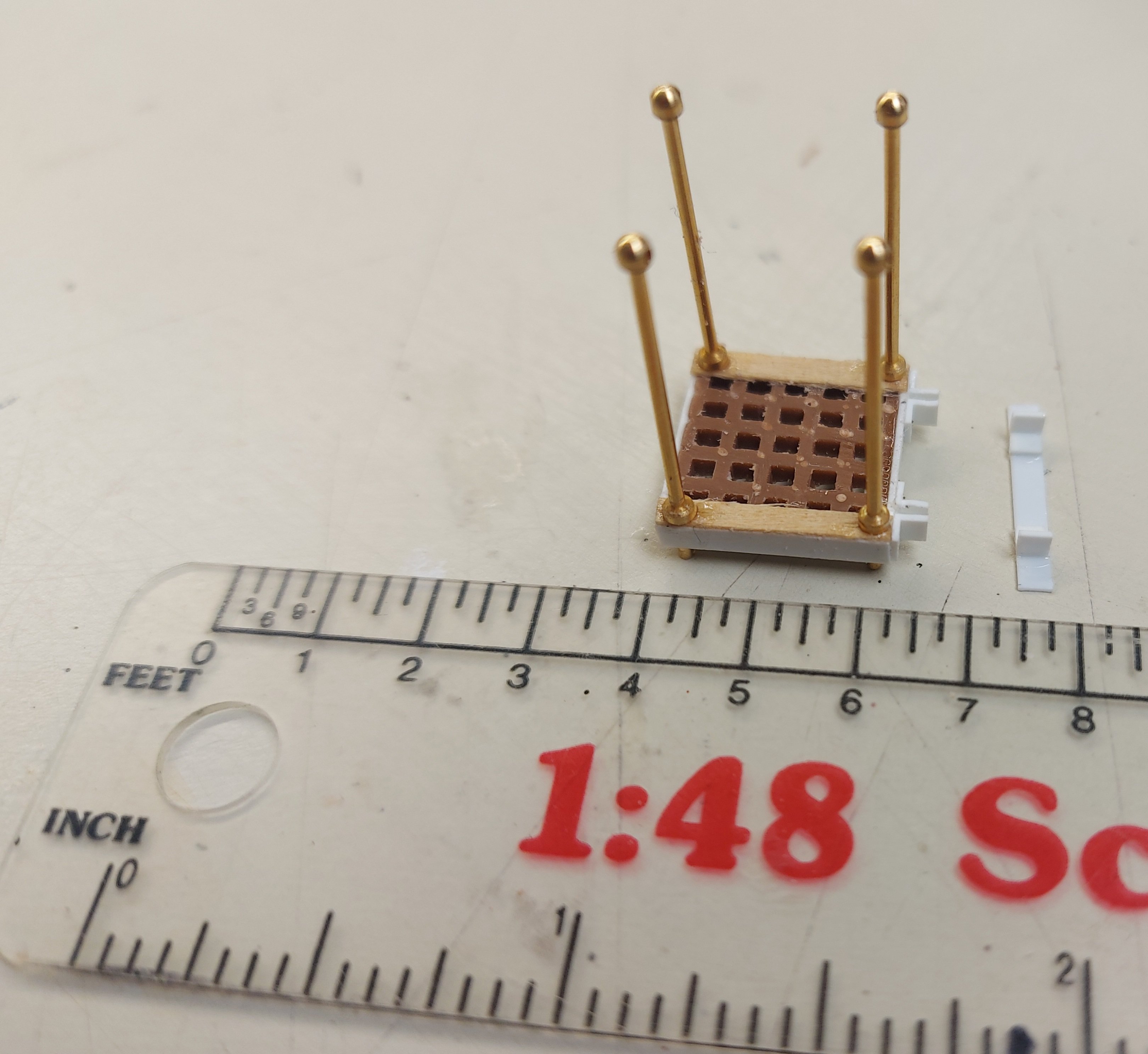

The first photos show the sounding platform being roughed out on my bench, then trial fitted on the ship...
The platform is hinged to the hull and there is a chain holding a brace in place underneath.
The last photo shows the platform complete with the lead line...

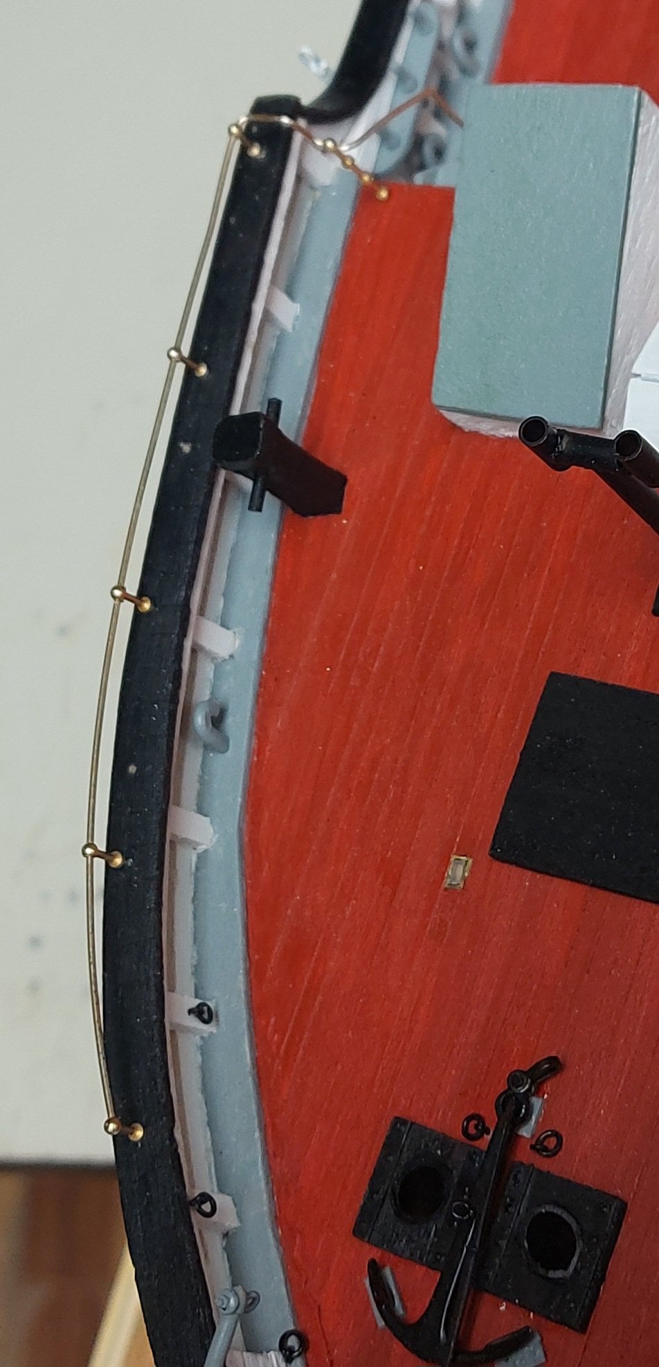

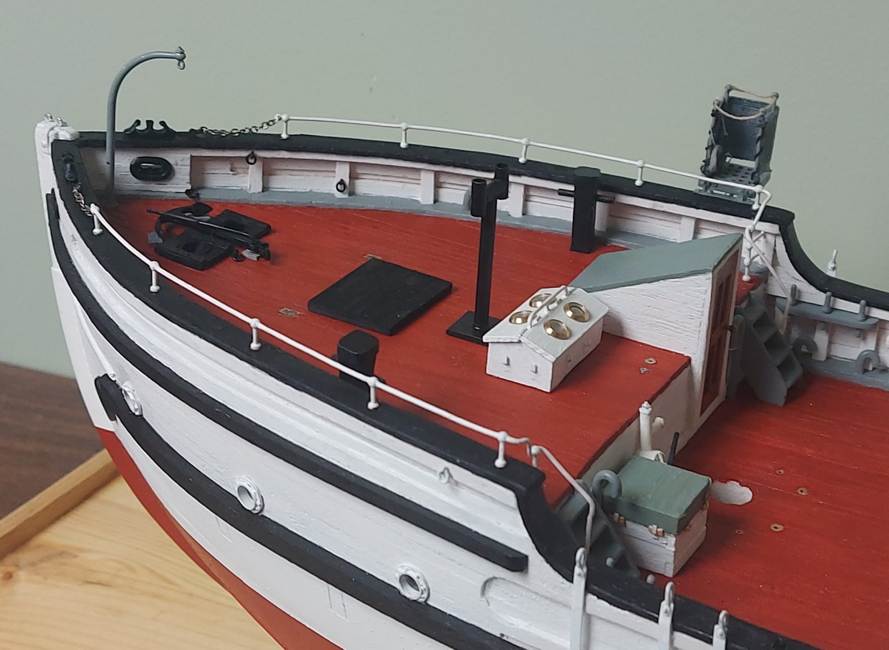

The fo'c's'le railings are visible in some of the previous pictures, this next photo shows the starboard rail being formed...
Finally, here is an overview of the fo'c's'le deck with the rails and platform.
The rails are not painted white today, but period photos from 1930 to 1934, while b&w, show a very light colour, so I painted mine white.

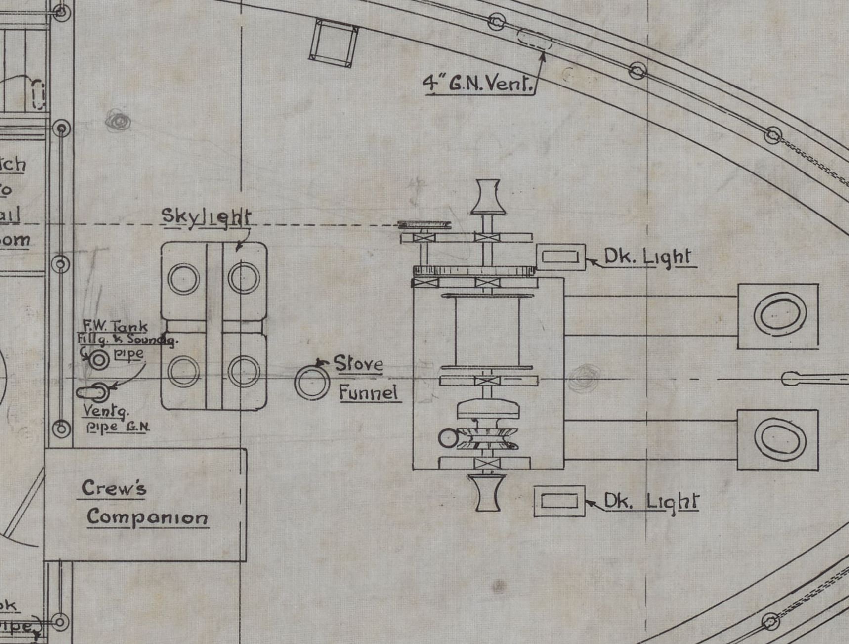

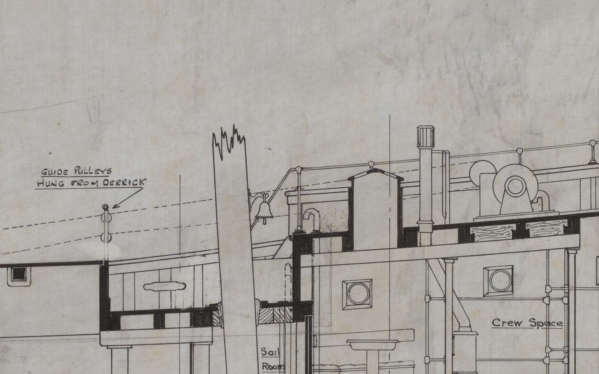

Building the anchor winch is going to be very interesting, because there are no plans or photos of it in existence! The attached portions of the 1928 designer's plan give a side view and a plan view of what was envisaged: a winch having a chain gypsy on the starboard anchor, a cable spool on the port anchor, and a mechanical gearing that drove the winch from a power take-off on the main engine, via the cargo winch at the foot of the main mast.
After the maiden voyage Captain Larsen complained that the winch was under powered, and it was replaced in 1930. It was replaced again in 1944 by the one on the ship today.
Here is the plan view, it shows the driving gears off the winch base on a separate support... but was the same arrangement kept in 1930? Who knows!?Windlassplanview.thumb.jpg.aa215bb985e5191aa101dbe37b61339a.jpg
Here is the side view, showing a drive chain or belt to operate the anchor winch from the cargo winch, and a pulley set slung from the cargo derrick to guide the drive.
I decided to follow the plan view more or less as presented, because the 1930 winch was still mechanically driven, and to keep the drive clear of the cargo hatch it would have to be extended to port with a separate support as shown on the plan.

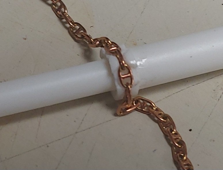

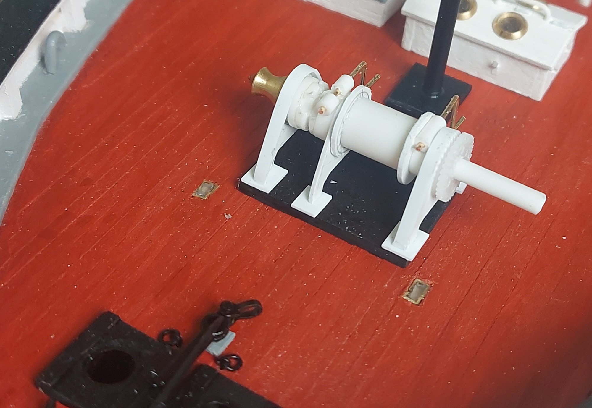

I am using stud link chain by Krick for the anchor... expensive but the look of the stud links goes, in my opinion, a long way to completing the finish in this scale. Starting with the chain, the first thing to make is the gypsy...

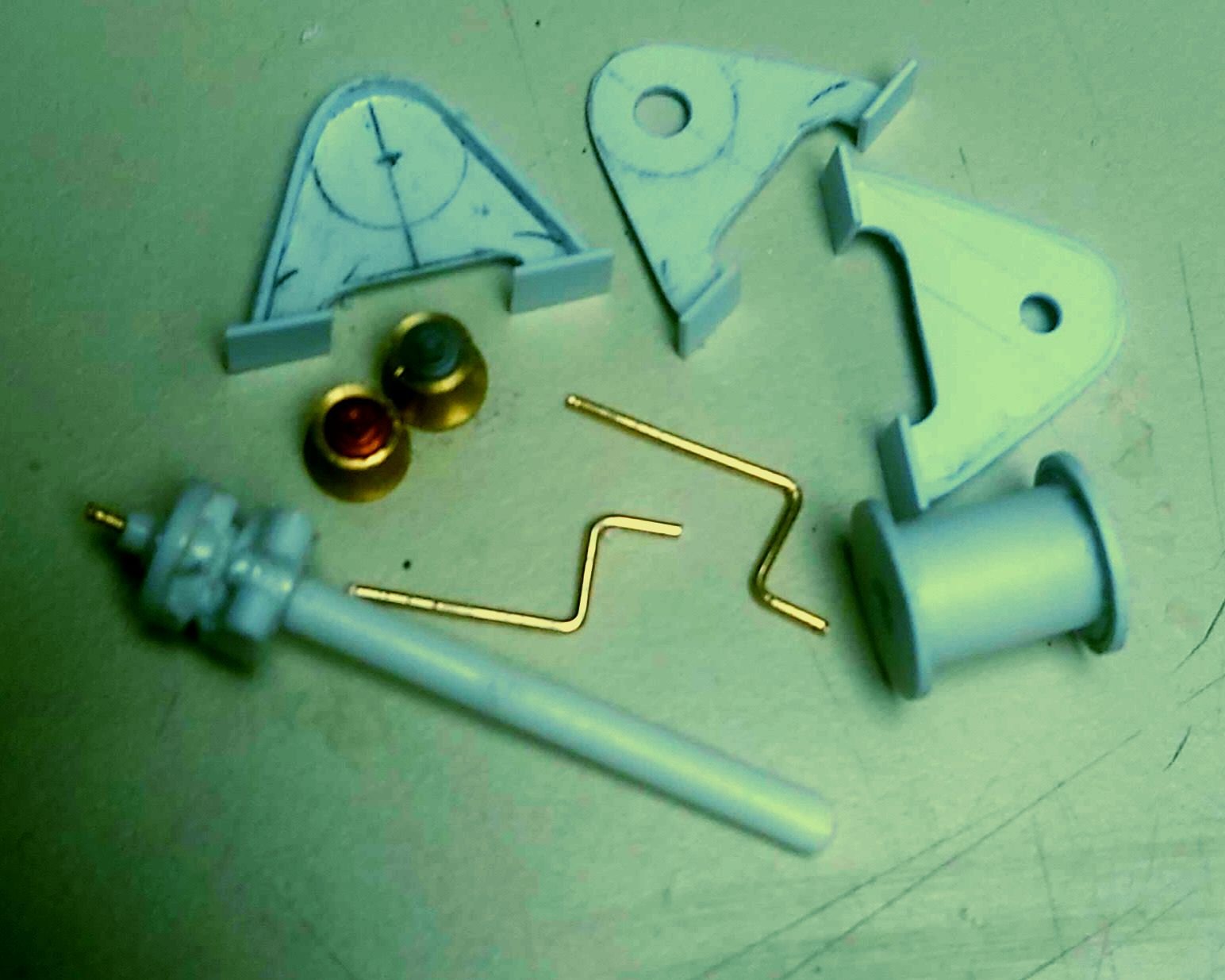

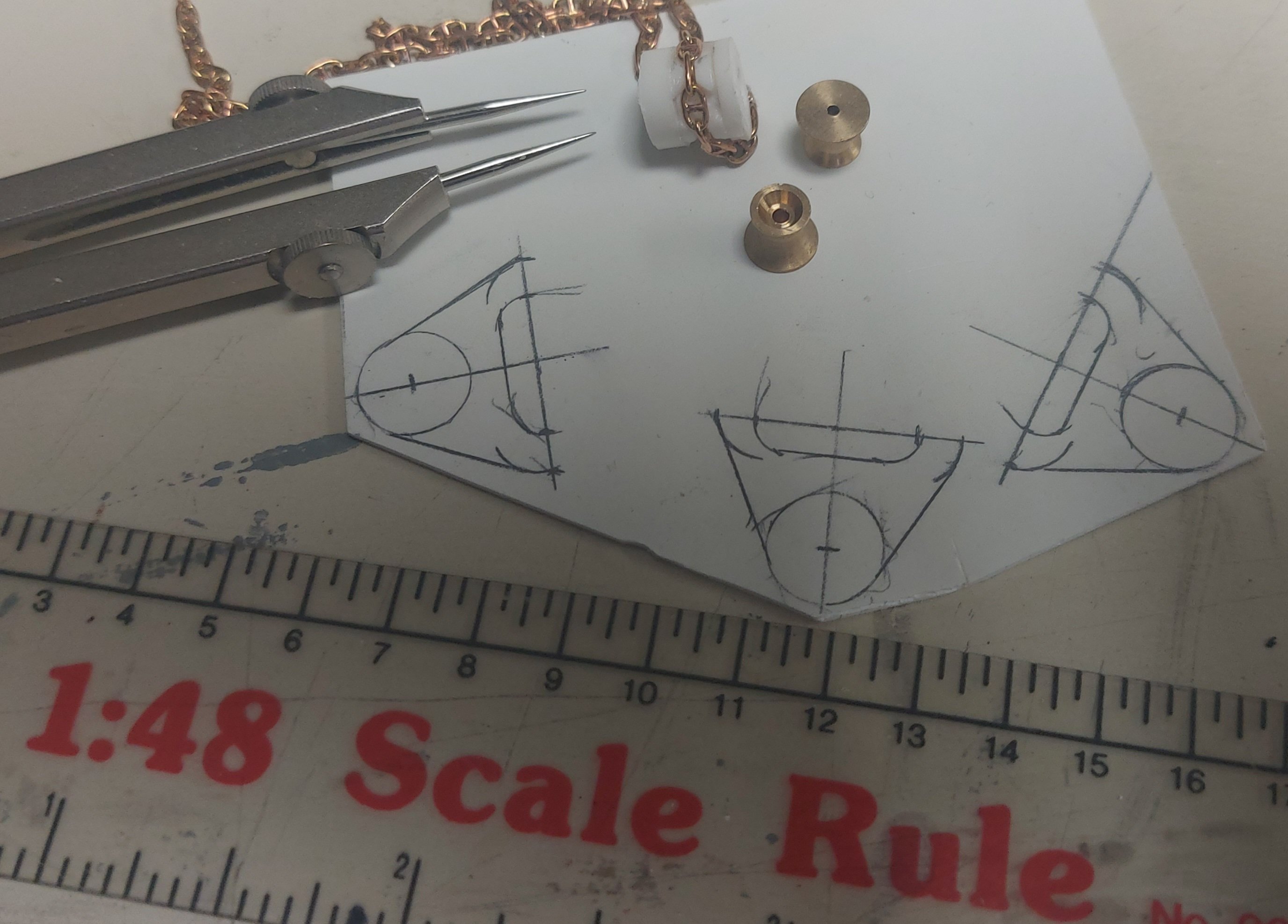

I used three sizes of nested styrene tube, cutting away whatever did not look like a gypsy until I was satisfied...
From the final size of the gypsy I scaled three winch supporting frames onto a piece of scrap styrene...
And test fit to the ship. I am checking here for size... does it look right in the absence of plans or photos?

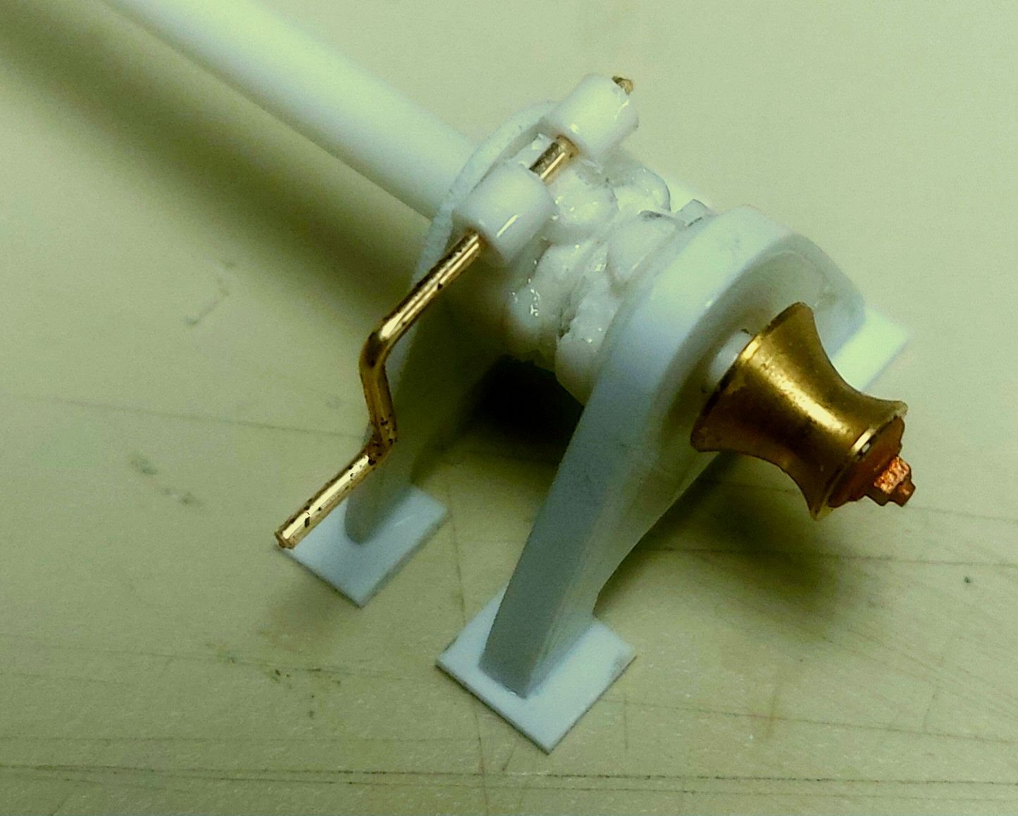

I will thin down the gypsy on one side, the wider side will become the brake band. The warping drums are by Billings Boats, they are correct for size so it was easier to buy the four I will need as opposed to turning them myself.
Here are the parts so far, test fitted onto the winch shaft...
You can see the brake band and crank, and the warping drum is finished with scale hardware from Grandt Line. The frame on the end has a flange for strength. Details like this are my conjecture, in the absence of plans or photos of St. Roch's winch...
Now I turned my attention to making the remaining end frame and the cable spool. I had to be careful here to ensure the winch was not going to outgrow the base, which is already mounted on the deck!
The cable spool gets its' own brake band. It is time to go to my stash of old RC servo gears and find some that would look proper to make the drive assembly...
This last picture shows everything so far, test fitted together on the ship, with the drive gear on the end of the shaft.
There are some adjustments needed to fit the base, then it will be time for paint and assembly. I am thinking of black overall, with gun metal on the rotating parts for contrast, and maybe a rust wash on the cable and chain, again for contrast rather that weathering purposes.
I still have to make the final gear drive and pulley assembly, and am trying to think good thoughts about how to include a dog clutch, or whether it would be better to leave it off??
Thoughts, comments, and critiques are always appreciated, especially as I am making a lot of it up as I go along!

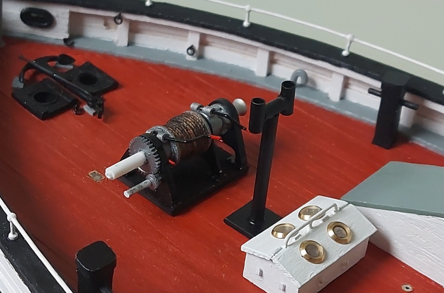

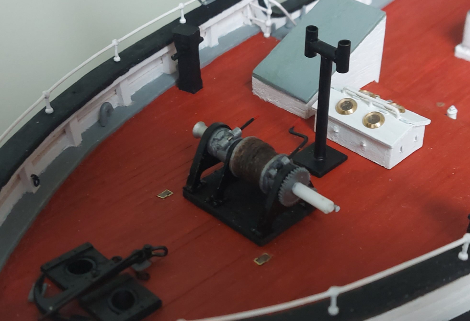

Nearly there... as per my earlier thoughts, I painted the rotating parts gun metal. The warping drums are flat aluminum. I wrapped the cable spool with suitably sized rigging thread from my stash to serve as the port anchor hawser, then I dry brushed Tamiya X-1 gloss black, followed by Vallejo rust, and lastly Tamiya XF-1 flat black. I think I achieved the look of wire rope??
The drive gear shaft extends out so the drive clears the hatch on the main deck... I have to make a supporting frame and pulley for that. My 1928 plans sketch shows the port warping drum also extending on the winch shaft... not sure if I will do that yet. It will depend on if there is room to wrap and unwrap lines once the drive pulley is on.

I lashed down the stream anchor and completed the anchor and winch installation... there are 86 individual parts making up the winch not including the anchor cable and chain!
From all the pictures I was able to find (thanks AON!) I figured that the winch was manufactured as a unit and the mechanical drive added later to suit the ship. Other than the drive coming from the cargo winch on the main deck there is no other information extant. It could have been a chain, or a belt. The overall looped length would be 80 feet (25m). Similar belts were used at that time to drive agricultural machinery from traction engines, so I think this is a real possibility.
Also, I do have two pictures showing the port side of the cargo winch... there is a warping drum, but no gear or pulley, therefore I made my anchor winch drive pulley to be able to take a belt.
My decision to own and defend!
The anchors are not glued to the hull, but hang on their chain or cable. I made the pelican hook and cable gripper by modifying miniature turnbuckles and adding eye bolt and wing nut details.
