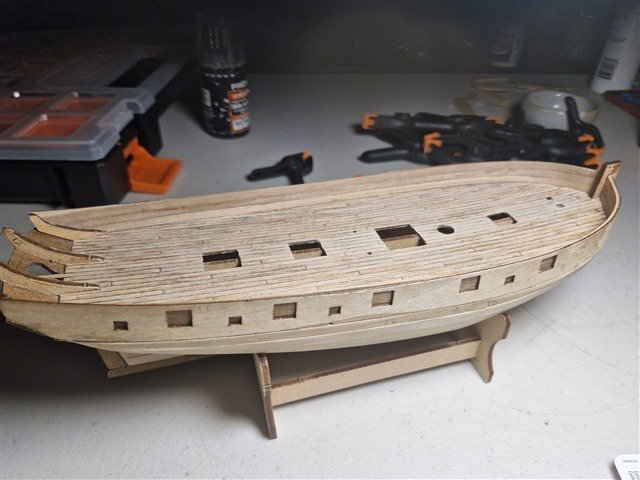

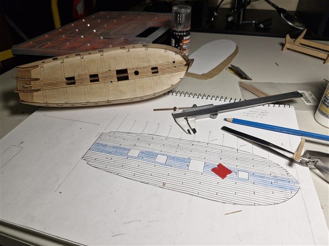

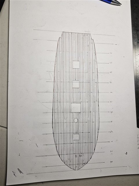

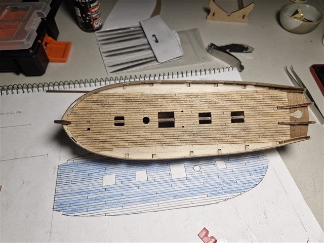

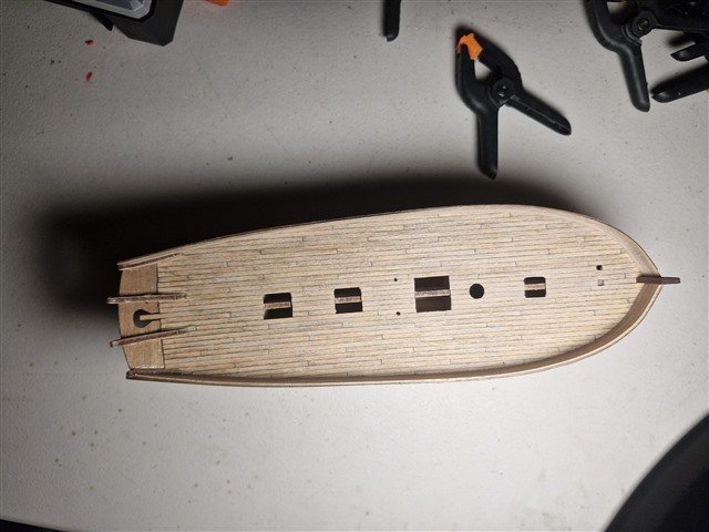

I finished up the deck. I'm glad I took the time to to a 'real' butt shift pattern, cutting my planks to size and laying them individually,  instead of just drawing it on after. I really enjoyed the process I think it came out looking pretty good. Could have been better, but I learned a lot along the way, I have some good ideas of how to really make a deck look good next time I give one a go. The end result looks a little dirty though, it might just need more sanding but i think the glue and graphite kind of worked its way into the grain of the wood.
I made a template and coloured it in as I went, it was super helpful.
20250917_214207_1280.jpg.05e53a89936e4ea081c624636ea92bfd.jpg20250926_123829_1280.jpg.61eaca2152496d8c3e7678ccfddcb4c0.jpg

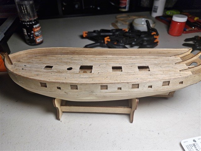

I also started to plank the inside of the bulwarks. I hadn't realised until now that one side is slightly higher then the other, so I guess the play is to just sand down the taller one. If i didn't know it was higher this whole time, i doubt it would be obvious that its a bit shorter when I have a completed model.
(Bulwark template slightly higher towards the bow)
(level across the bulwark excluding the stern)
This last pic also show a bit better what i meant about the deck being a bit dirty/blotchy, if anyone has advice on how to clean it up a bit, besides more sanding (which it will get when i finish the small bits of plank that will be required at the stern of the bulwarks, id like to hear it.
Anyway, slowly bit surely, it progresses.
