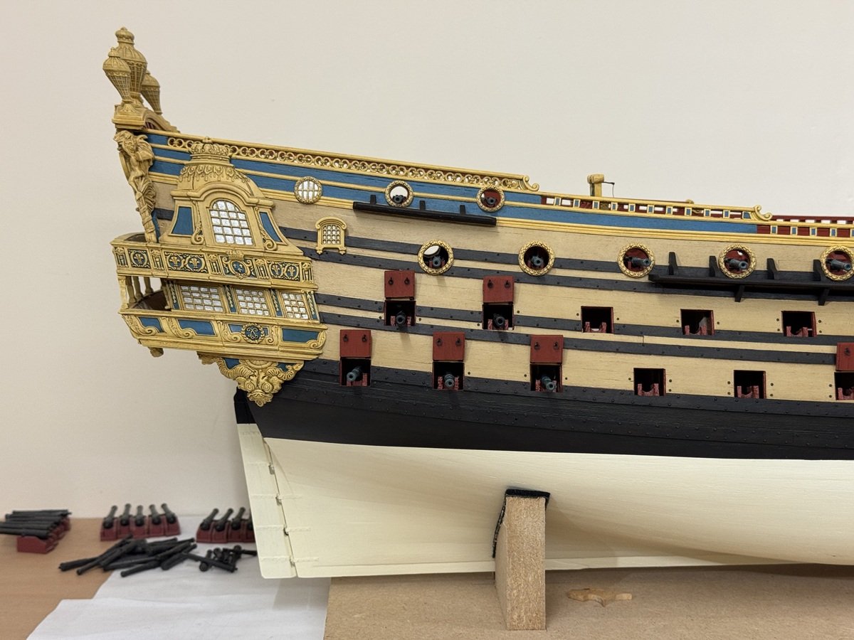

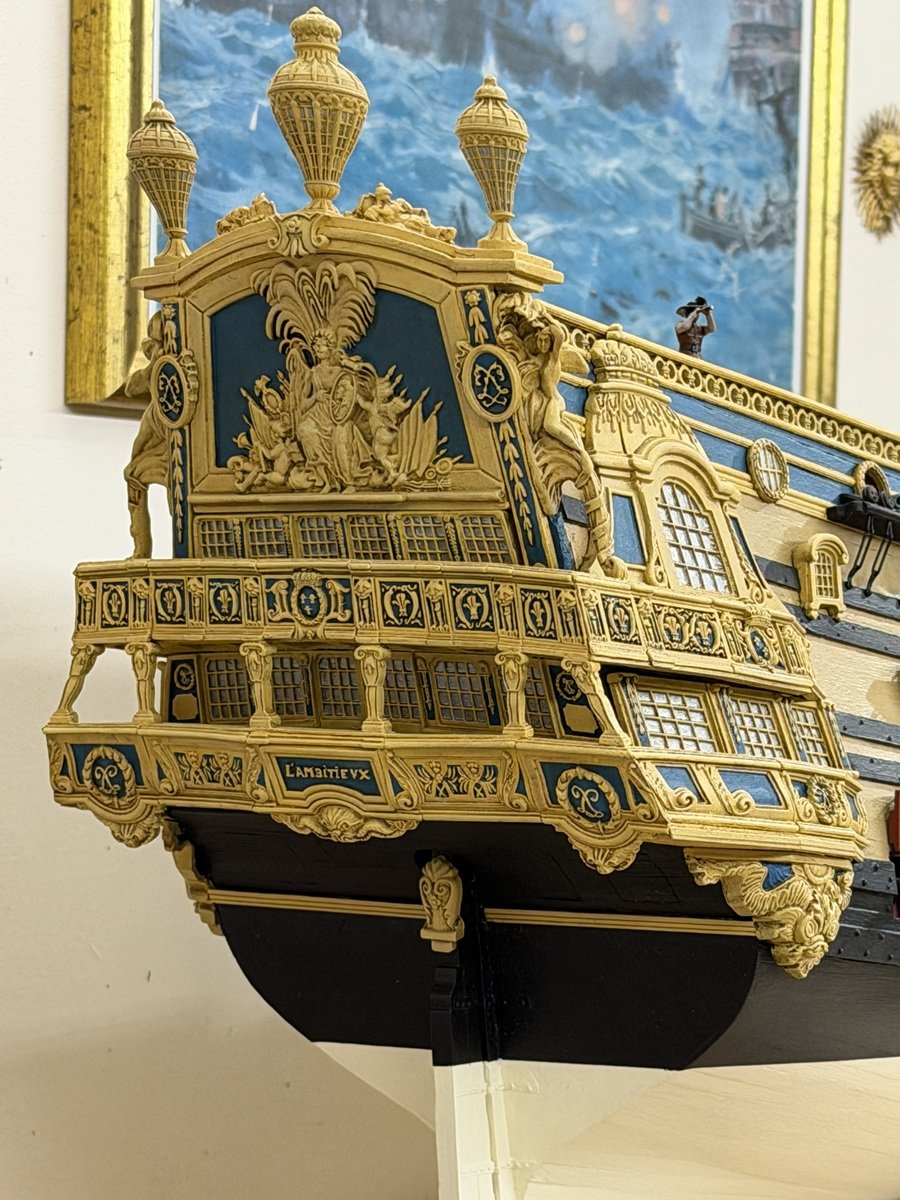

a friend of mine came home a few days ago and we took some nice shots of L'Ambitieux. It's not as advanced as I hoped to show you, but they are still nice photos so I share them with you. Not that bad for a kit made by Altaya ! The designers of the kit really made a good job.
The goal is to finish the hull of this one before I go back to the Soleil Royal. Let's hope it will be soon...! 😅
Anyway thank you very wuch for the "likes" and the kind words, it means a lot to me.
This all looks exquisite and super tidy, Marc.  I don't think paint can be done better, and the light shading of the ornamental works really brings out their details.  I know you have done quite a lot to upgrade the kit, but the lines and overall basis of the Altaya design are really very good.  She would be the envy of anyone's home fleet!

Yes, I immediatly knew there was something to do with these great carvings when I saw the add at the time. The kit didn't disappoint, of course there was a big amount of work to assemble the pieces together correctly but it was worth it !
Beautiful, I like it. I have only one question - where did the quarter gallery  go and where do the officers go to the toilet now?
Igor
I love the "Joy" wire sculpture, Vic.  We've been talking, so you know how I feel about all of your sculpture work, but I haven't seen your wire work until now.  That really made me feel as intended.

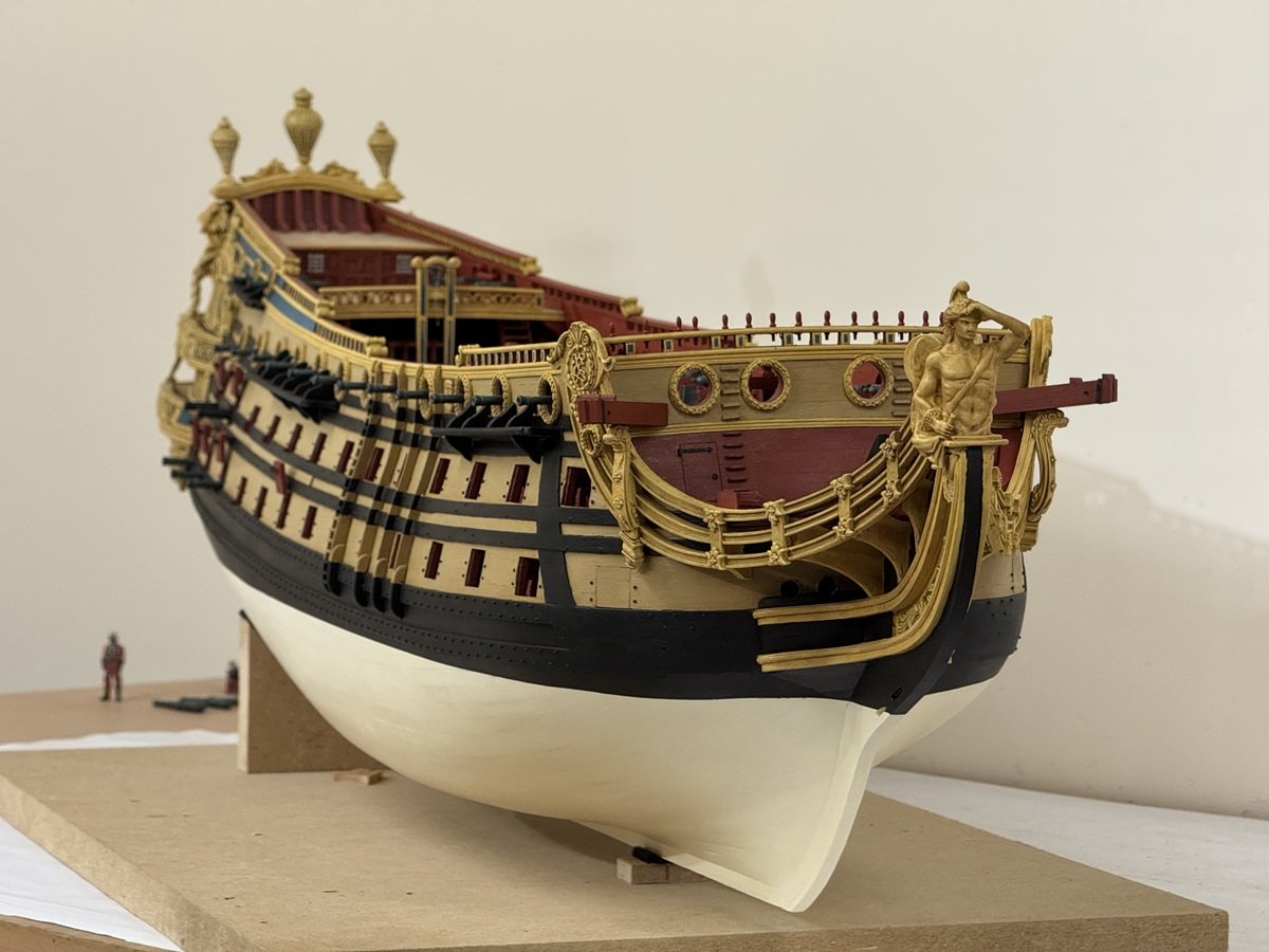

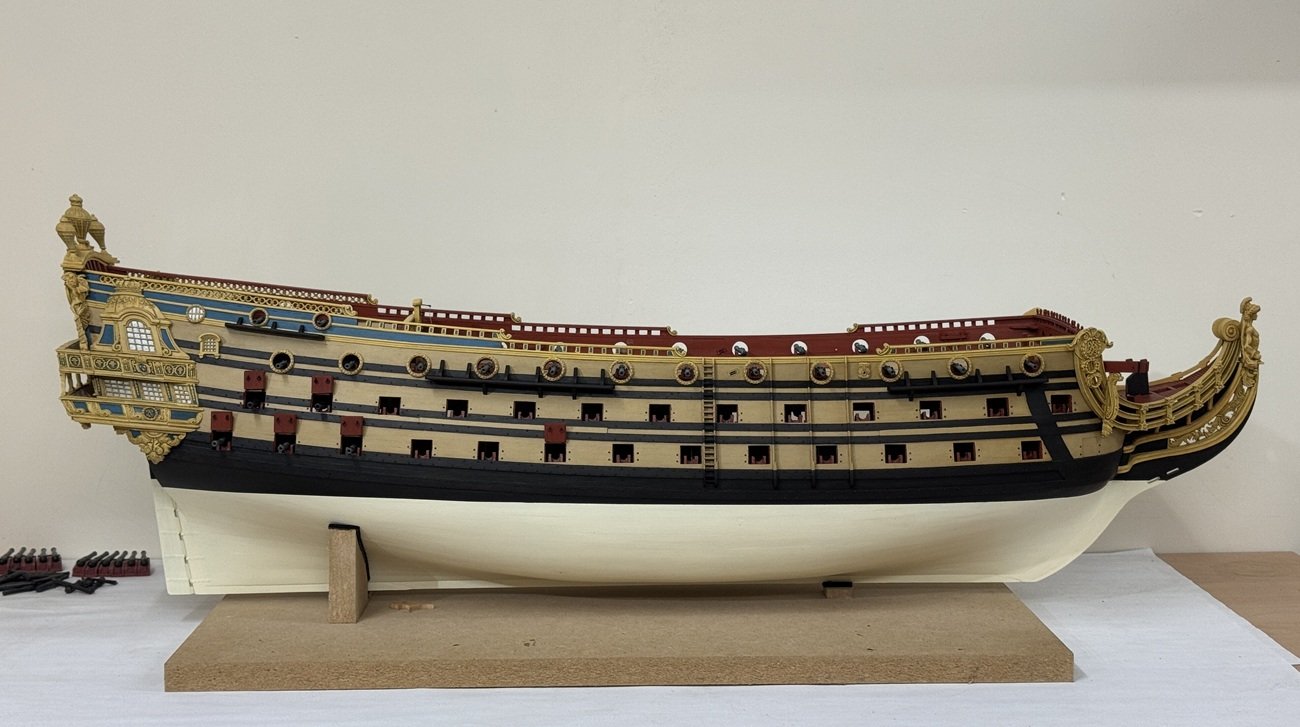

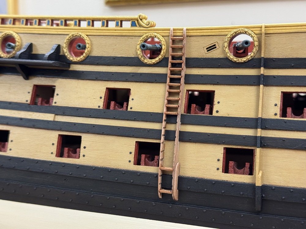

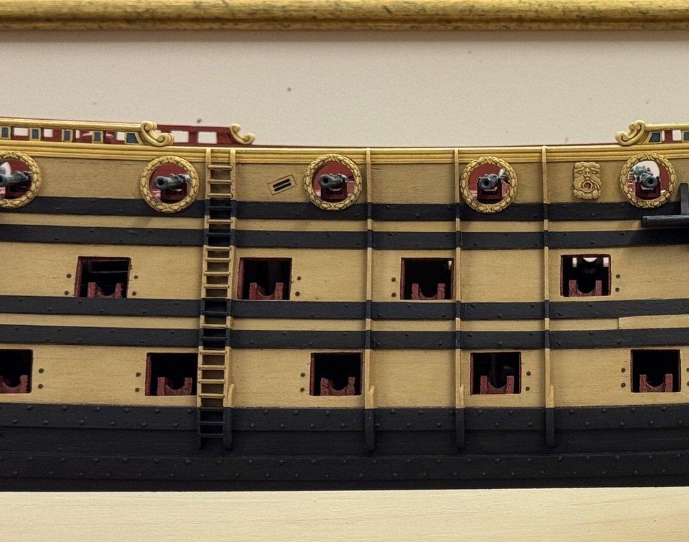

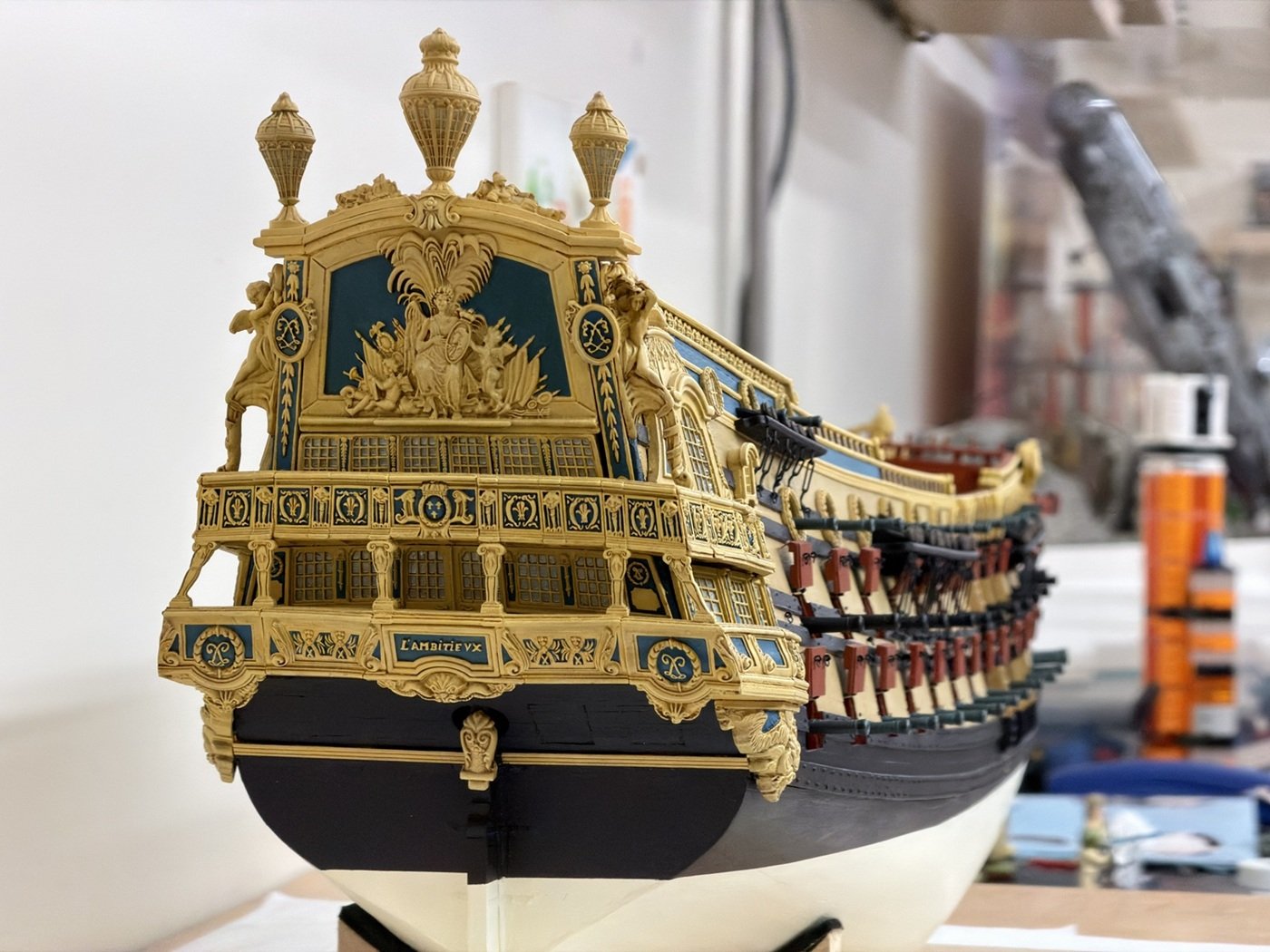

I'm still here ! I'm just struggling with the global organisation of my familiy, my job, my sport, but I've fixed a lot of things and life is much easier now than a few years back. Here are some news of L'Ambitieux, I quite like the general shape of the hull. The colors are very saturated in the pictures, in real the red is duller, and the yellow is lighter.
It's a small progression but the build still goes on.
Edited by Nek0
This is all extremely satisfying to see.  Your attention to surface-prep for the paint work can’t be missed.  It is all excellent - so happy to see you at it, again!
Best,
Marc

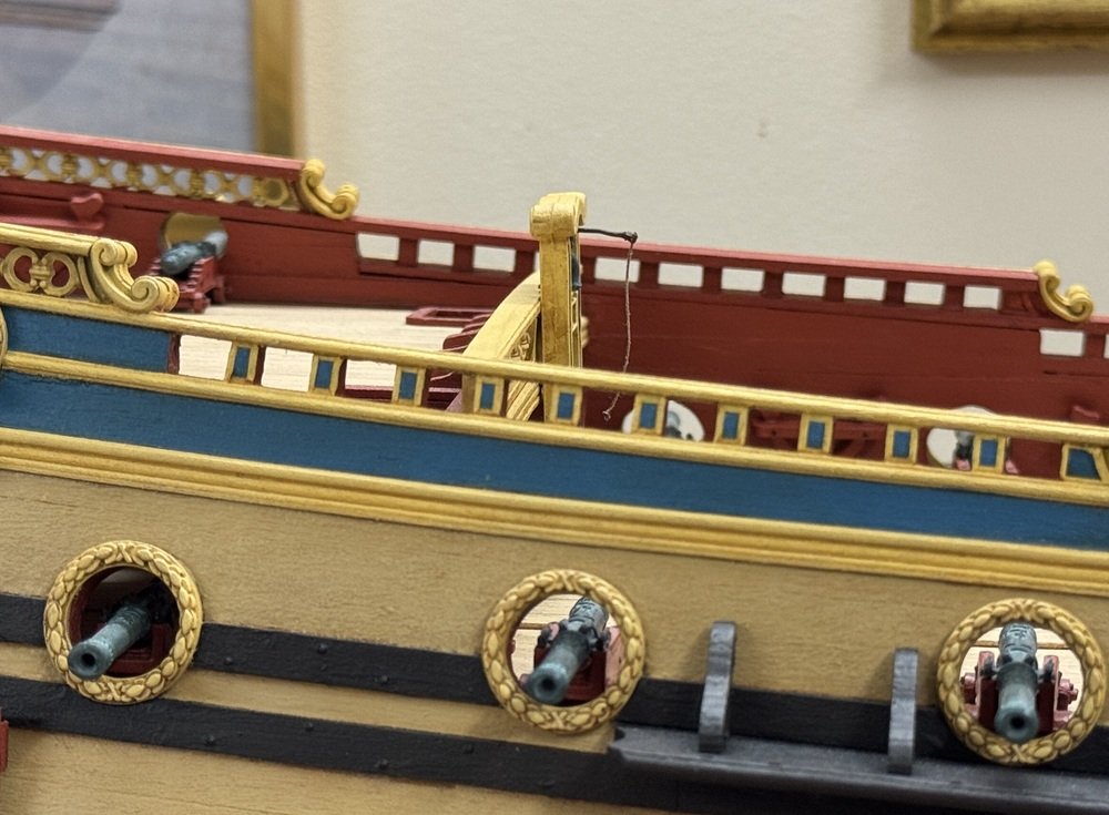

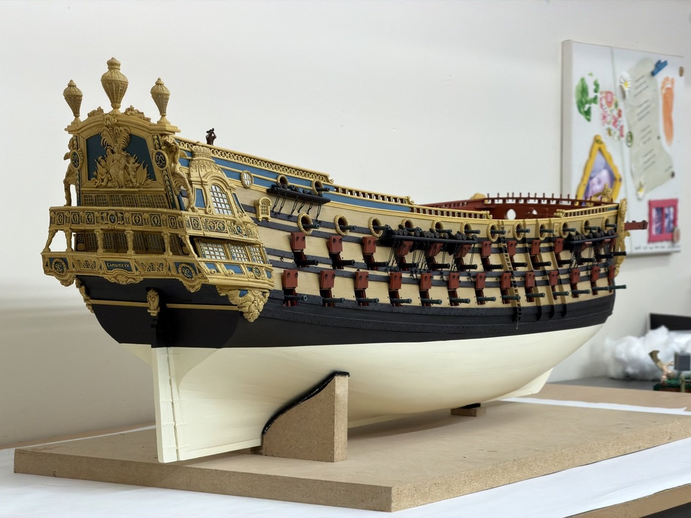

Hello dear friends !

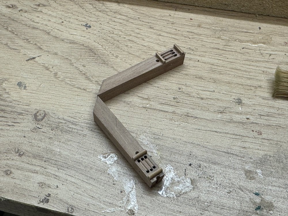

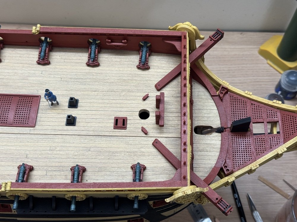

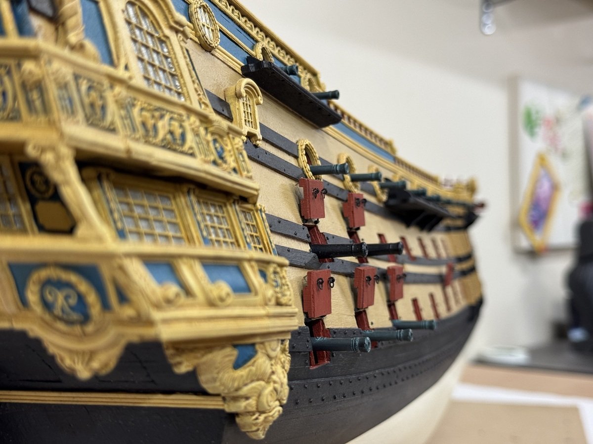

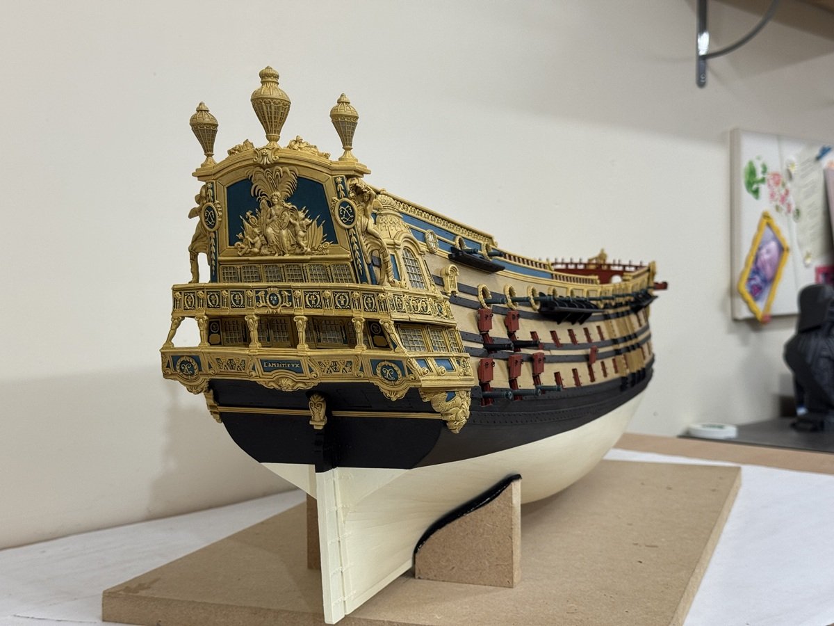

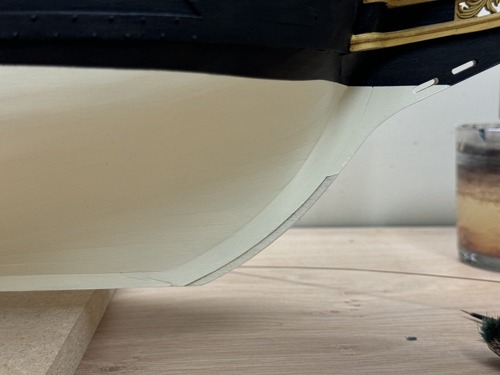

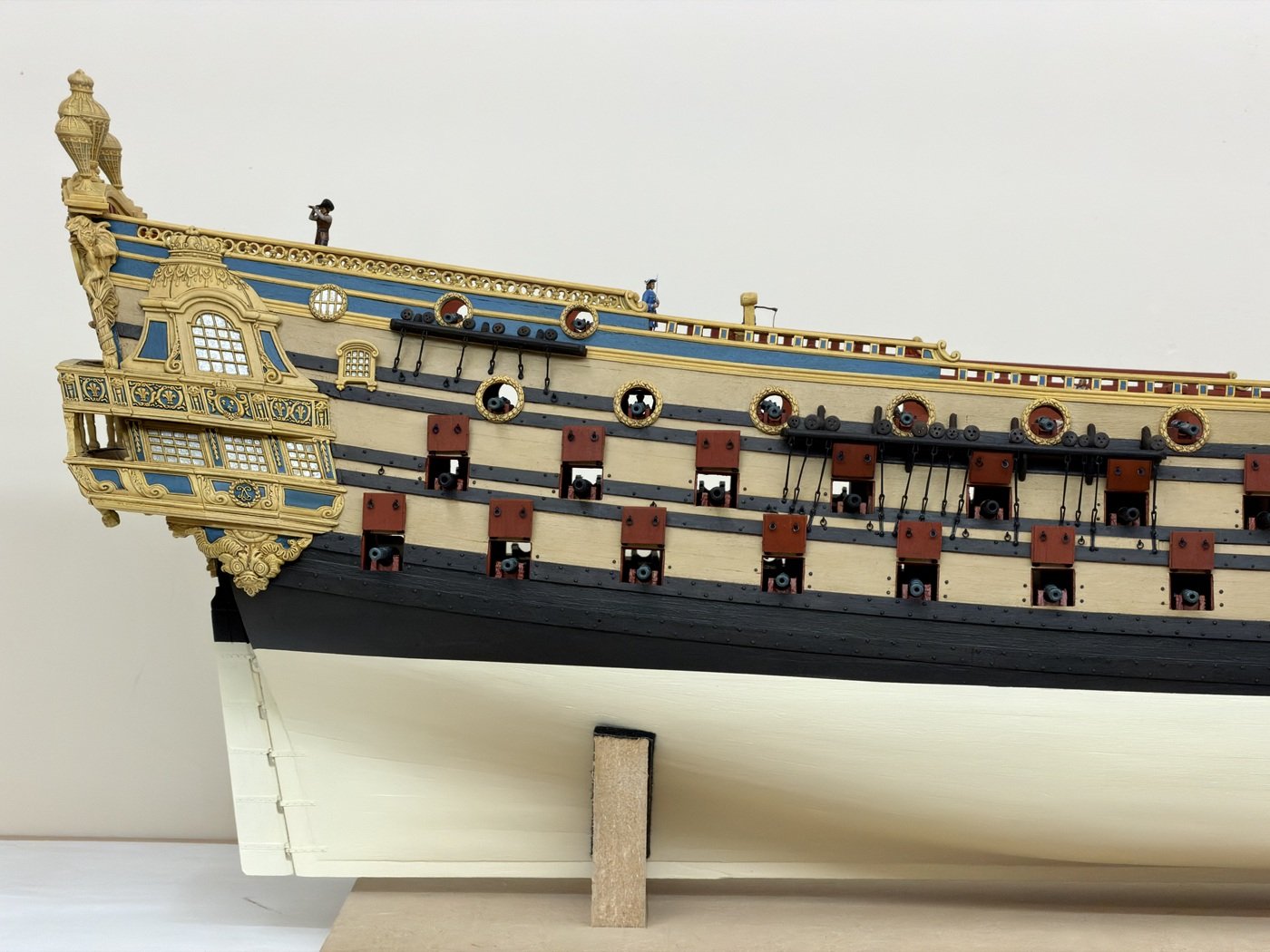

L'Ambitieux is still going on, at his pace. I did a few things these last couple of weeks. At first I corrected the shape of the bow.

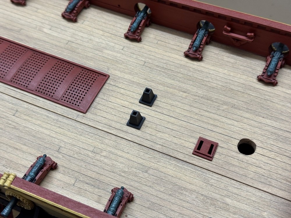

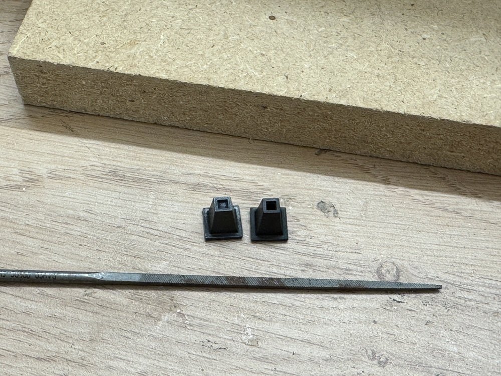

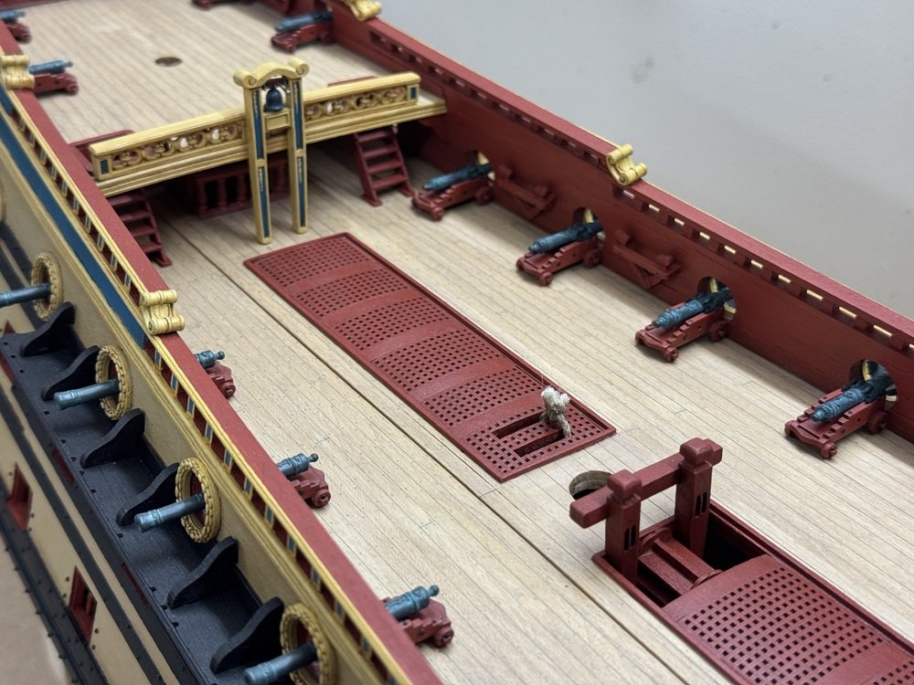

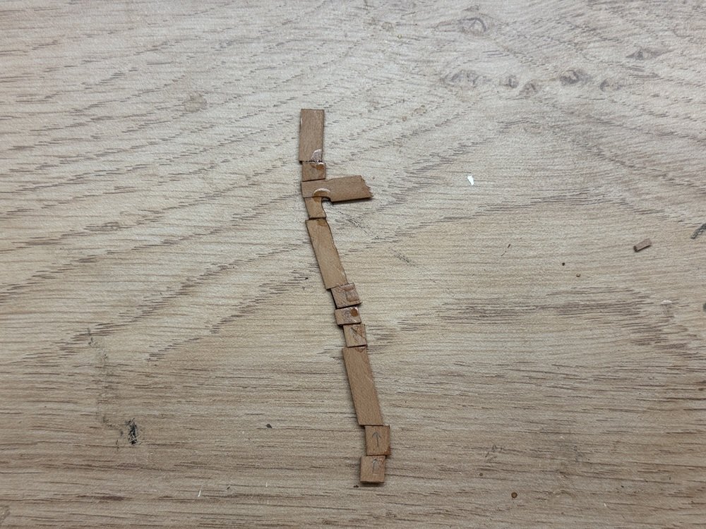

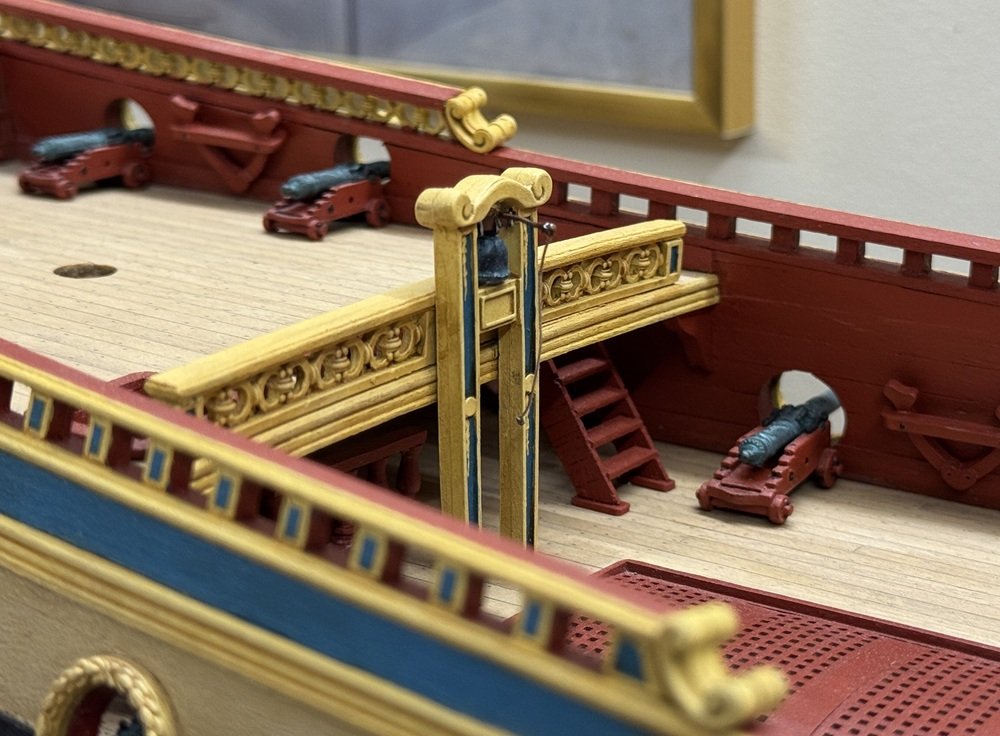

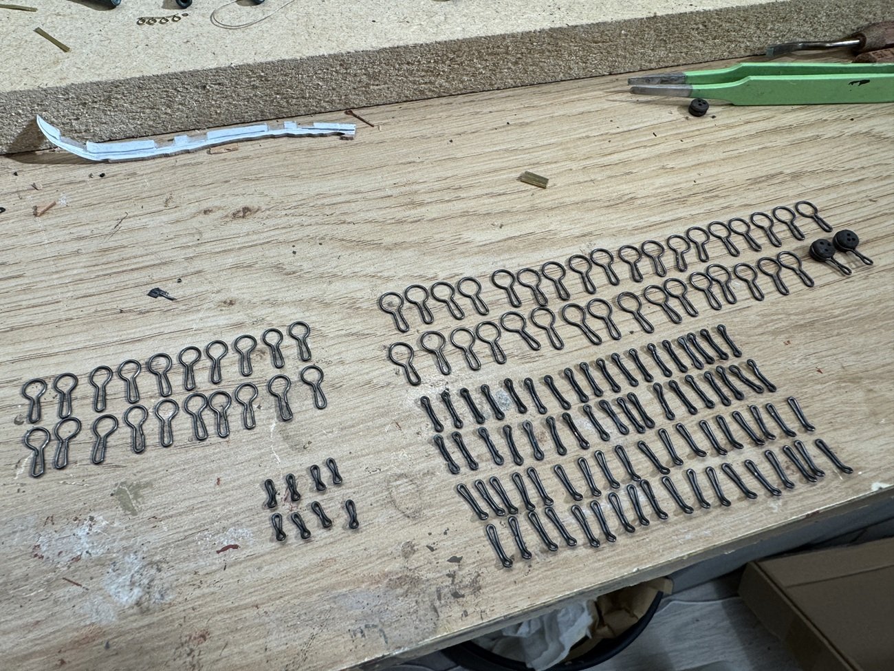

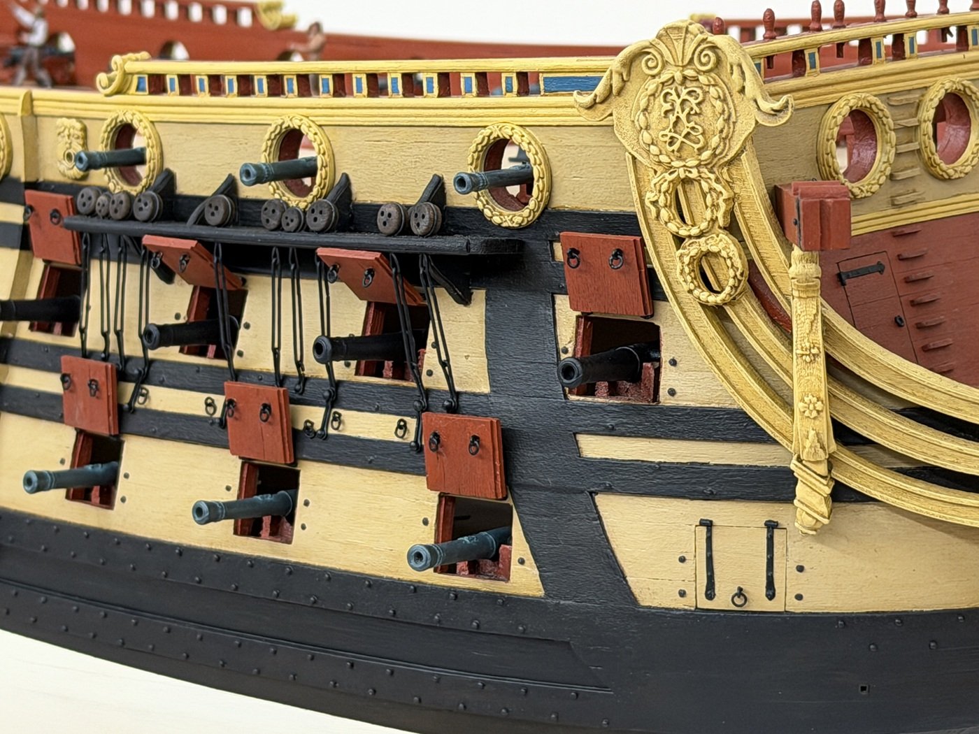

Then I installed the "porte-haubans", maybe the word is "stay shelf" in english ? I made various superstructure elements ont the third deck: some ladders ("echelle des gaillards" and the ladder of the crew), "bitton de grand hunier" and "bitton de petit hunier", the "bossoirs de capon" (the horns at the front of the ship), the chemneys. Concerning the chemneys, those of the kit were very acceptable, I only had to drew a real hole and treat them with "tourmaline". (a product that oxyde and blacked the metal) I also installed the bell, made the ladder and the protections for the outside hull, and now, I'm installing all the gunport mantlets.
I try not to dive too deep into detail, it's really a different work compared to my SR but it's very rewarding to see the model progress, and I really like the overall look. The purpose is not to have an educational model but a good rendering of the image of what a great ship of this time should have looked like, at sea.
As always, I'm very thankful for the "likes" and comments, it really pushes me forward !
1.JPG.f67b5cc14f7d1d1d2863db5e39a379d5.JPGimage.jpeg.84abca3f274acaa59f94a17b03707c91.jpegimage.jpeg.5ea6d10c13aa08fa3a202700f60c7de6.jpegimage.jpeg.729db01a7e34e97da4d222a8ae075ff2.jpegimage.jpeg.41401994ef286b95e1300d345c054d91.jpegimage.jpeg.fc70f1600a9198ee40f7bf33dc241ed8.jpegimage.jpeg.994d9450a99e45d8b9276362343f369f.jpegimage.jpeg.ac8d148b357fac74a10ed3ebc1d51d71.jpegimage.jpeg.1e6007b21dcb74274e0f38ff240e73dd.jpegimage.jpeg.0b3cb2fef95e46ab12aebace12f1ce2e.jpegimage.jpeg.29a54aebe2ee608155f02a630d64614e.jpegimage.jpeg.4d56669ddbde3c9c052d1d470809348e.jpegimage.jpeg.ae3714c3ec263af0b79730915a8fa0af.jpegimage.jpeg.be5edcb92fd2bc708792d7100f03f705.jpegimage.jpeg.5037ef582db0b0bbe51ac9057890dbac.jpegimage.jpeg.af84f2c451f1964d9792839aa85307db.jpegimage.jpeg.b9b26a48d6cccac54305217cc8b7154a.jpegimage.jpeg.7e857b398ac4dcce8686ad085b6f33e2.jpegimage.jpeg.911911ce22ae1b32075142b817101b32.jpegimage.jpeg.55e5af0ea38a2544487e34d3fe09b07b.jpeg
Your correction at the cutwater as something I was wondering about.  It would not have detracted from the model, if you had left it as-is, but it is a nice improvement, nonetheless.
Thank you for posting such good chimney pics.  They are really helpful.  While you may feel that you aren’t going too overboard on the details, I think you have added so much to this kit, and corrected quite a number of its fundamental flaws.
So much with sailing ships has to do with the lines, and the lines of your ship ring so true!

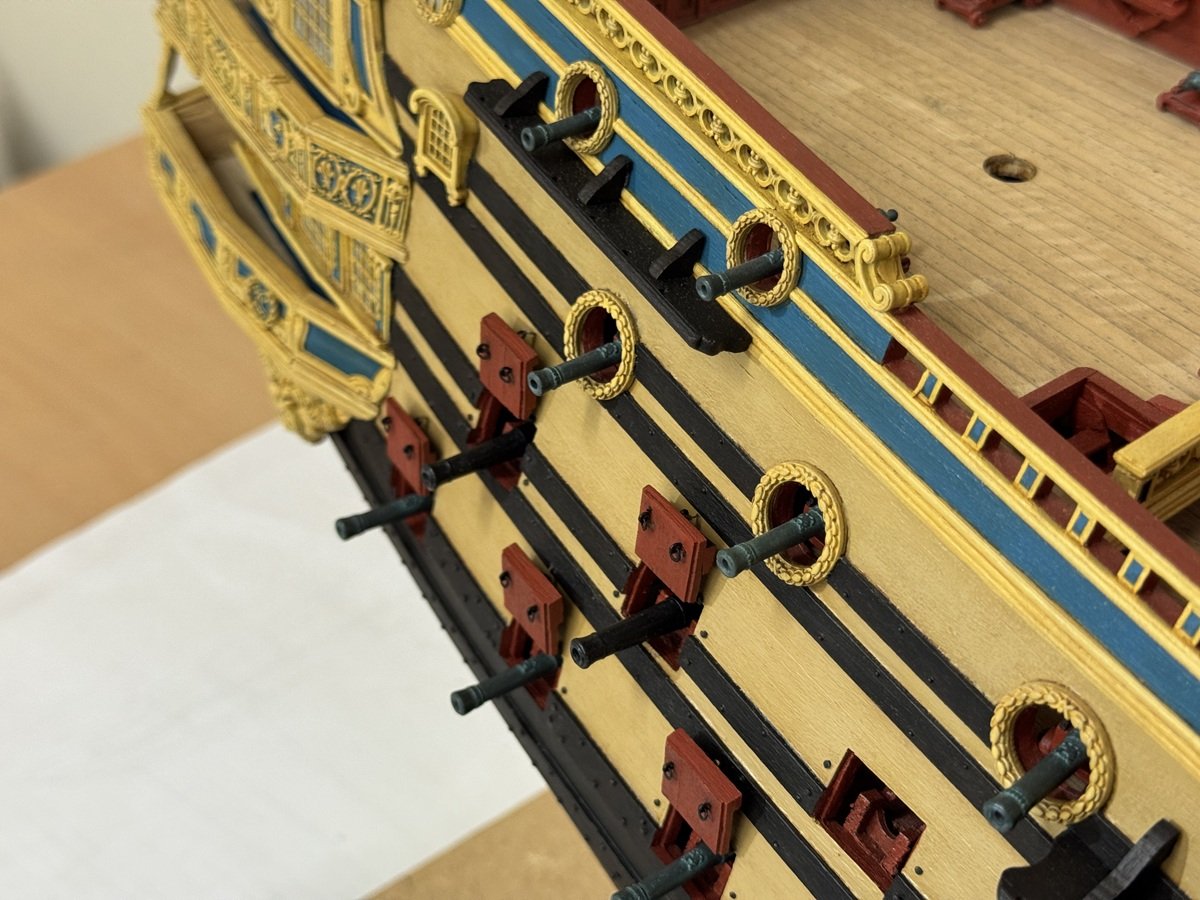

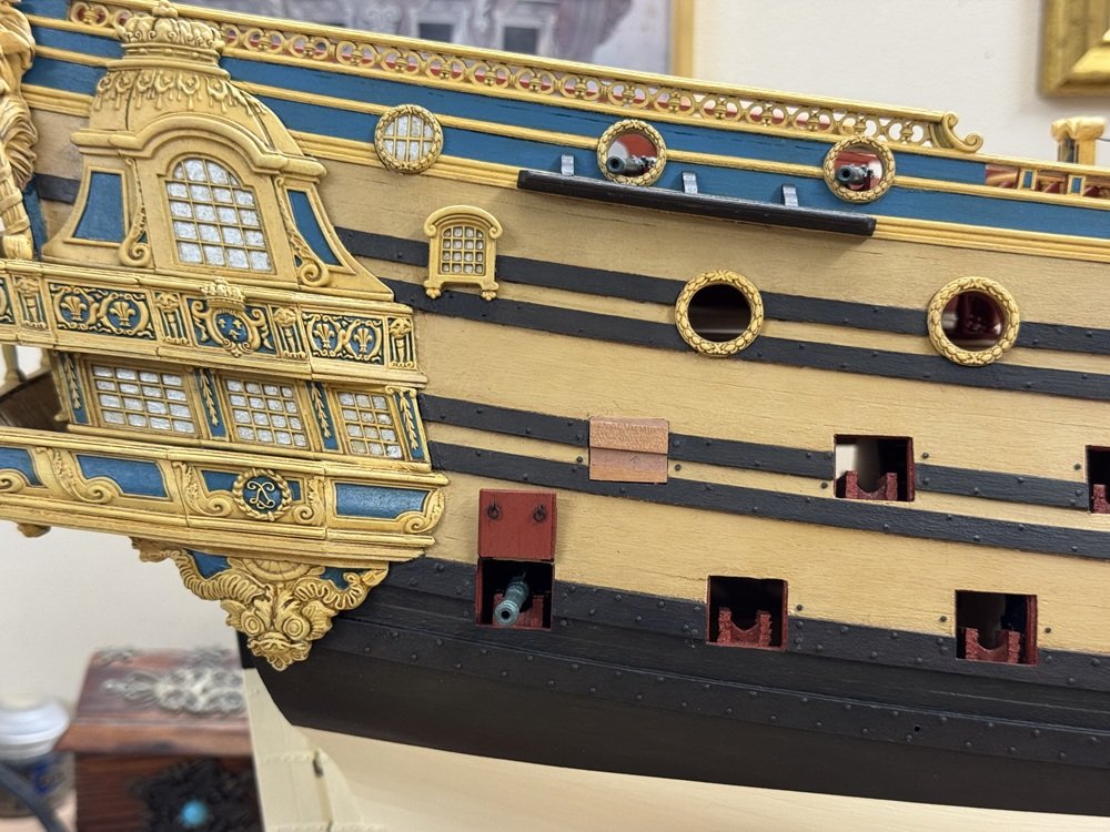

Thanks for the nice comments. Indeed I spent a lot of time pre-studying the color palette. It's something very important to me, as well as the lines, to give this strong good first impression when you look at a model. If the details are extraordinary but the colors don't feel true and the lines are too stiff I will not appreciate the model. I always try to bring the colors down a bit, because when you look at a real 1/1 thing versus when you look at a model, let's say 1/72, at one meter, it's like you look at the real thing at 72 meter. Because of the density of the air, the colors won't be as shiny and bright as the real ones.
Anyway here are the last achievements, there are a little mantlets left to pose.
Edited by Nek0

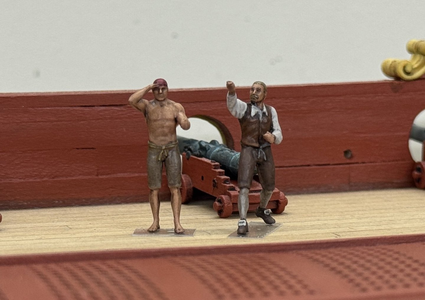

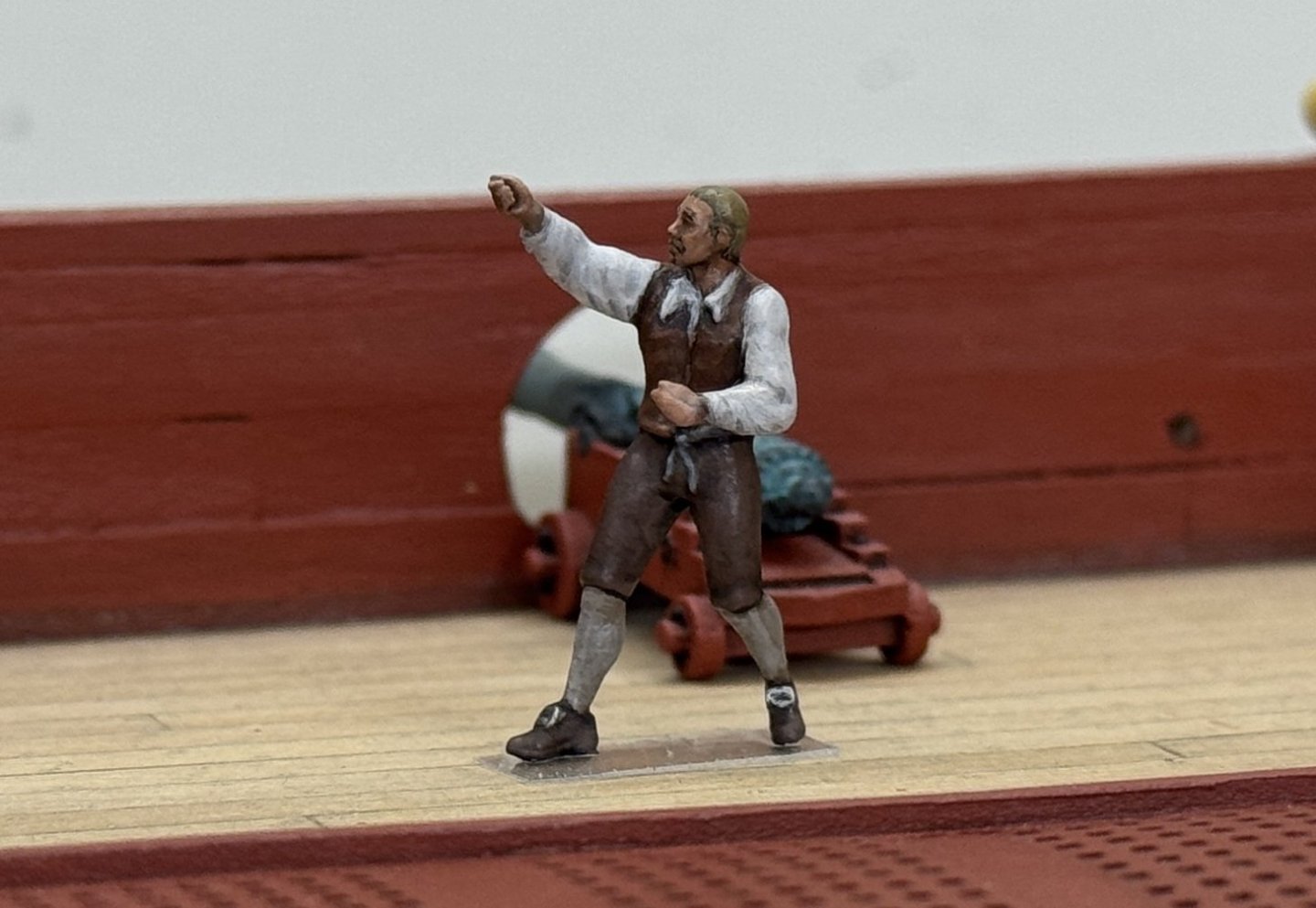

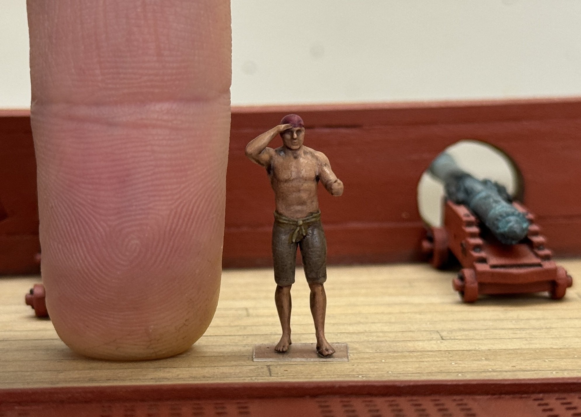

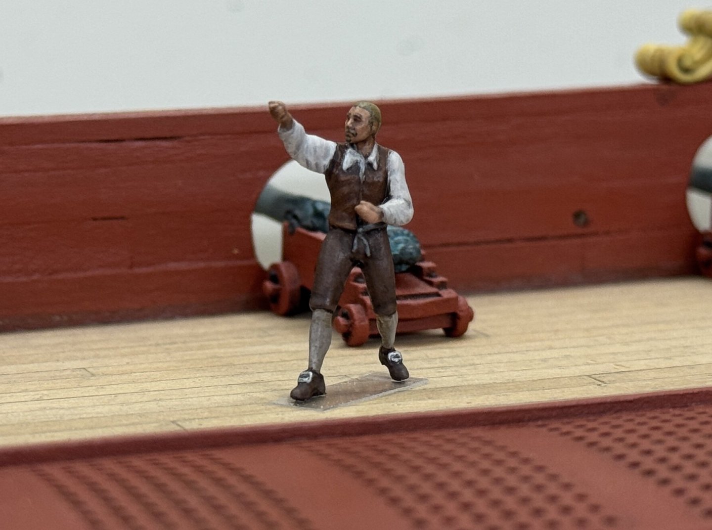

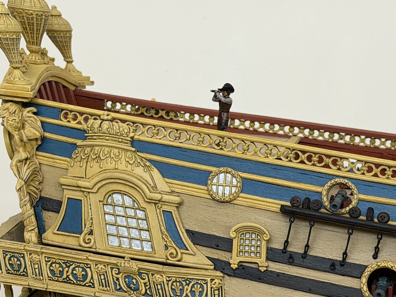

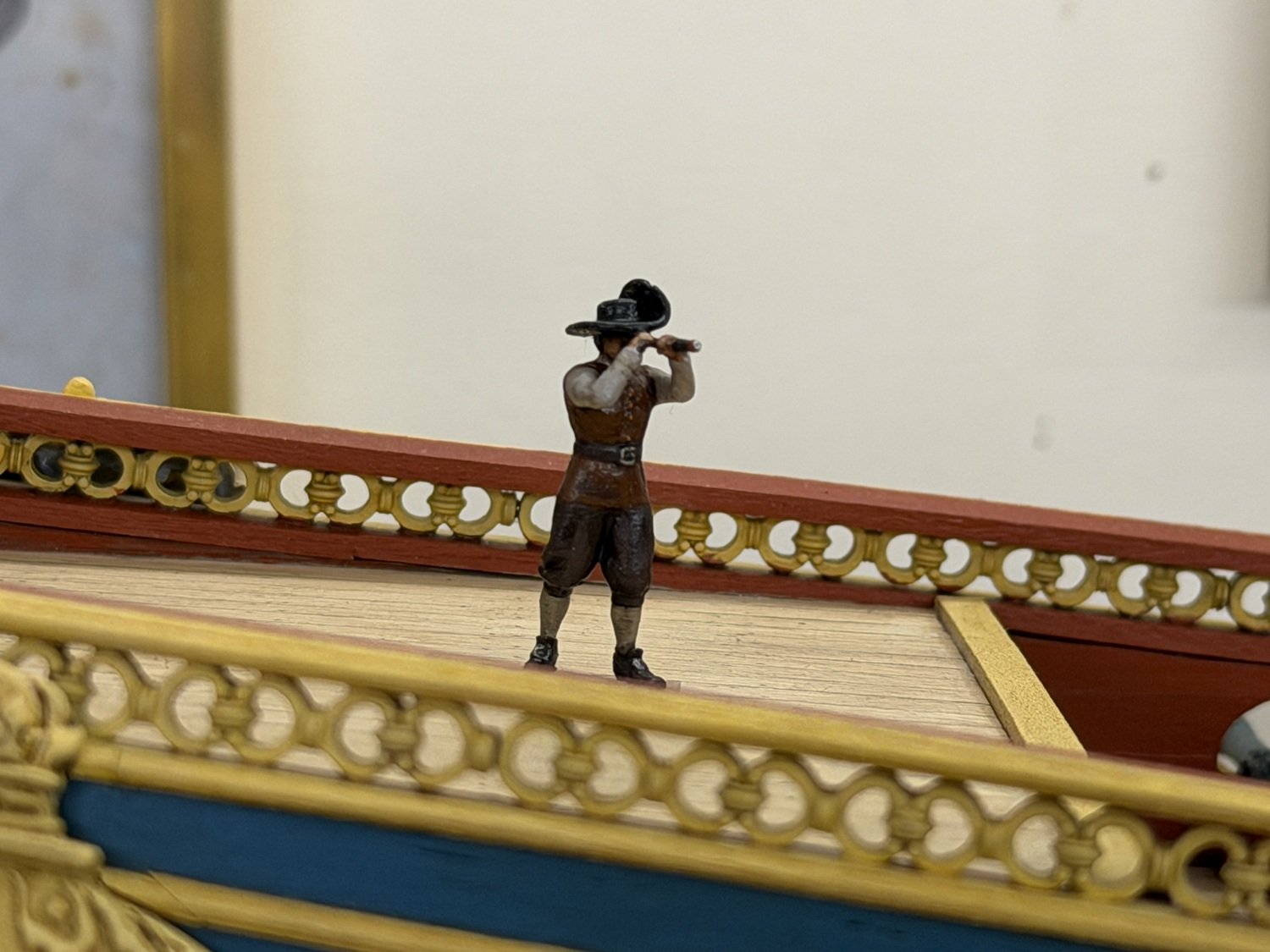

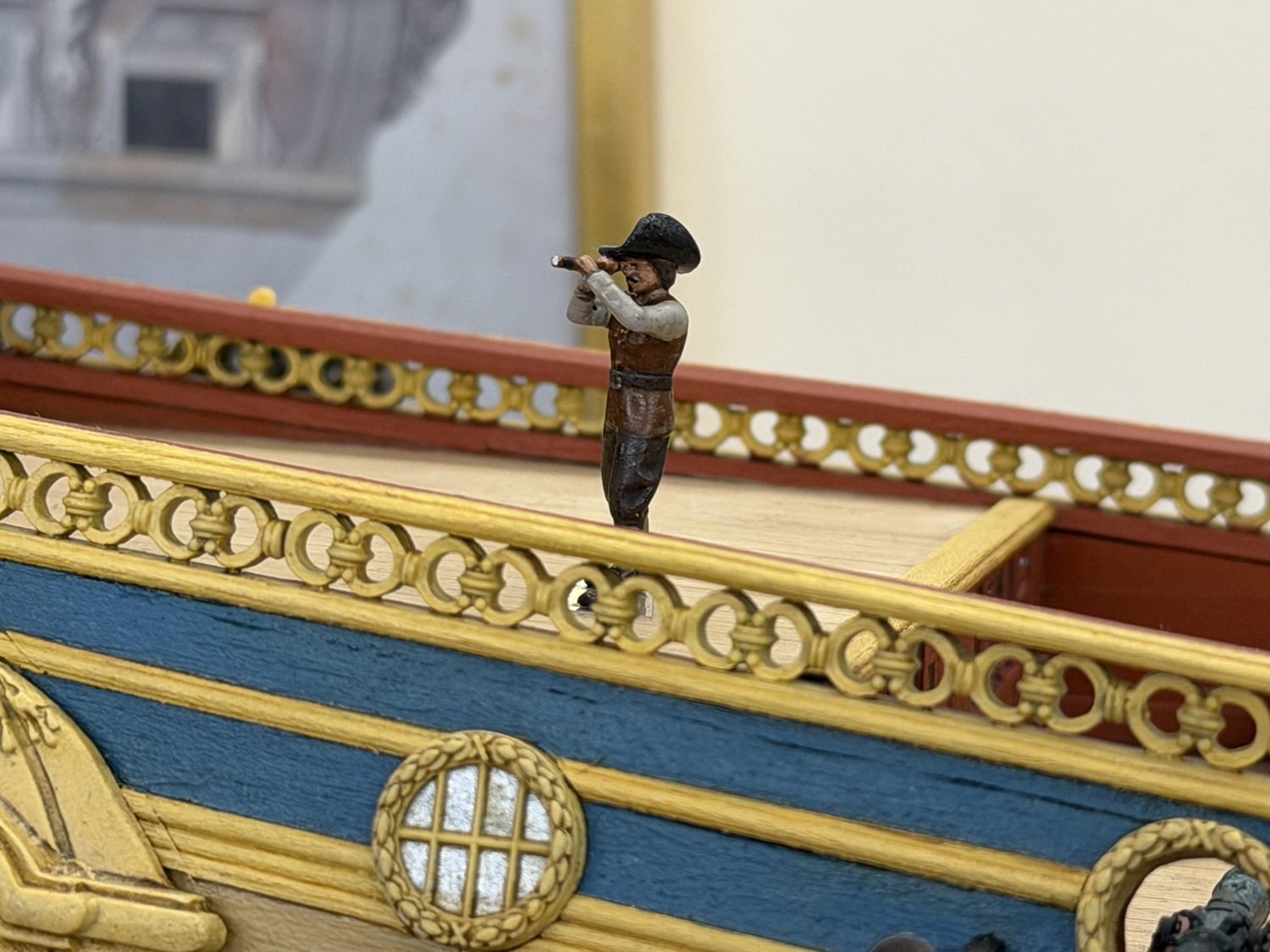

Another thing, I bought some small 1/72 sailor figurines on an website a few days ago (I don't know if I can name it), the result is great! I've painted two for the moment, they will keep company with the officer I previously did ! And they will help, in different places of the ship, to give the feeling of scale of certain elements. (pulleys, yards, bitts...) (the one in the second photo is working on the sails normally, but there aren't any on my Ambitious yet)
:D
Hello,

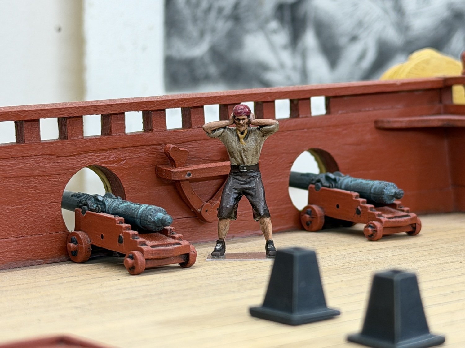

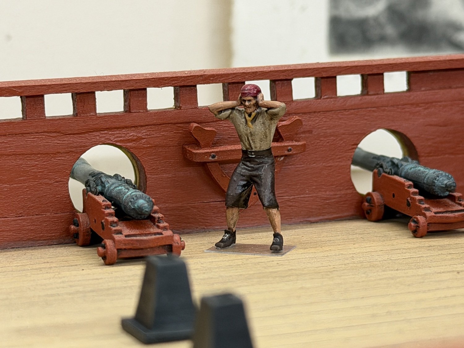

Thanks for the comments !! You're right Vic, I asked myself the same question. The belaying pins are indeed a bit off scale, (too bigs), but the height of the "wall" is correct and the figures are approx 1,75M at scale.
Here are two more figures, by another brand. They are less detailed, made with some sticky stuff and not very pleasant to paint, but the poses are cool.

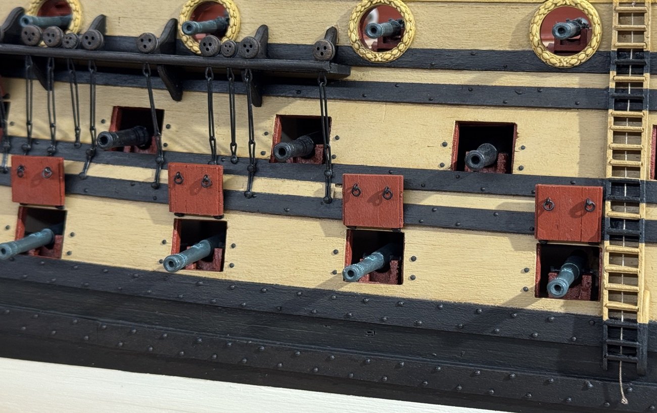

Here are some last photos of l'Ambitieux with all the mantlets posed.
