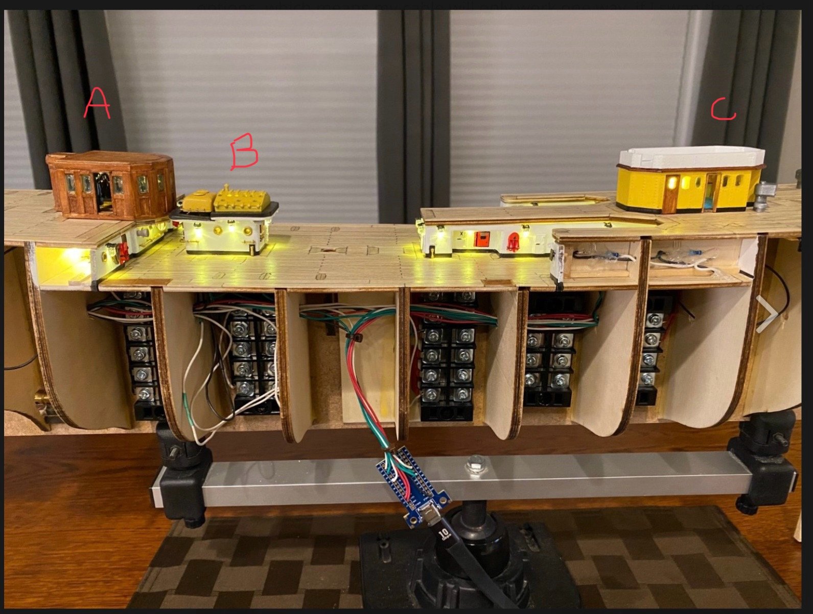

Daniel I want to pick your brain a bit if you don’t mind too much. Again I am coping your work I am so impressed with. My curiosity deals with your lighting of the three structures I show as A, B, and C in the photo. The electrical logistics I have no problem with. I am just trying to figure out which lights are on which circuit?
Structure A, You put LEDs in the ceiling. Is it on one of the two port hole circuits?
Structure B:  You have LEDs on the outside. I suspect you have those on the main deck light circuit. Which circuit do you have the interior lights?
Structure C: I read in your building you separated the lighting into two separate circuits. One for the chart room and one for the storage room?

Hi Bill, let me see if I can remember…I believe the structures you labeled A and C and the exterior lights on B are all part of the deck lighting circuit. Well almost that is. The fore part of the structure C is the chart room and that is a part of the deck lights while the rear storage compartment of the same structure is, well on a special circuit as is the interior light of structure B. I used a diode on each the port hole circuits to create a “third” circuit. The goal is this, when one port hole circuit is on and the other off, the internal lights of Structure B and the storage compartment of structure C are on. If you switch the port hole circuits with the second one on and the first one off, opposite the set above, the internal lights of structures B and the storage compartment of structure C are also on. And of course, if both port hole circuits are on, so are the internal lights of B and the storage compartment light. This adds a level of complexity to the lighting that is unexpected yet very easy to do, giving the model a more authentic look. You are the first person to either notice or question this. Good job!

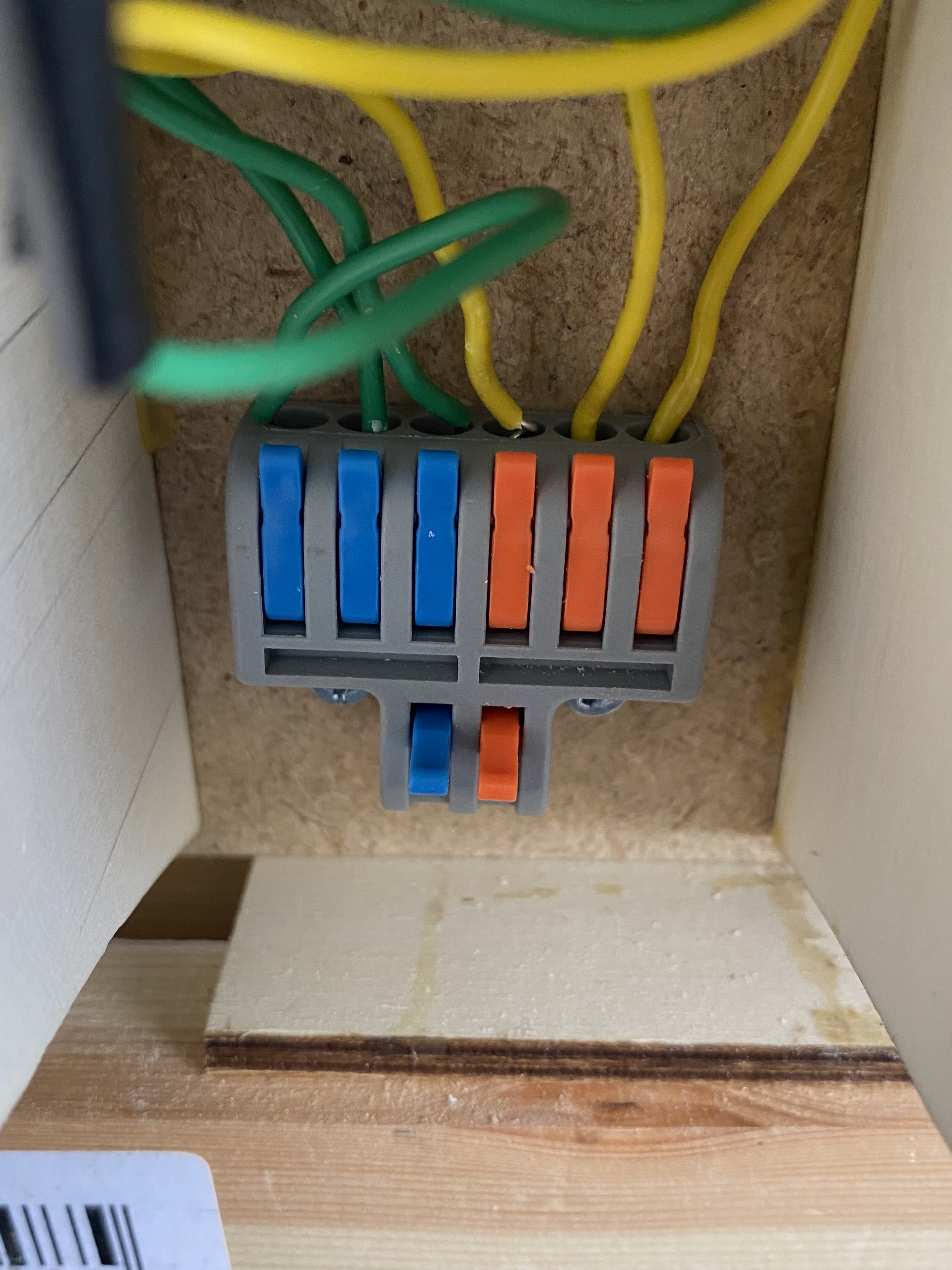

On a side note Daniel, I found these handy little things on Amazon for making a sort of bus for my circuits. With these I can introduce one line (+/-) in and have 3 come out.
Edited by Bill97

I saw these and went a different route as I needed more than three out. Also, once you have everything working and before you seal up the hull, run a bead of hot glue across the switches to glue them shut. I have heard that these have a habit of popping open and if that happens after you close up the hull, you are screwed.

Yes, you could have a separate circuit, but for me it was the only two LEDs on that circuit and I wanted the OR situation. Diodes are cheep, less than a $1 for like 5 of them and can be setup inside the hull so less wires heading into the hull from the control panel. But this is just me…you build your however you like.

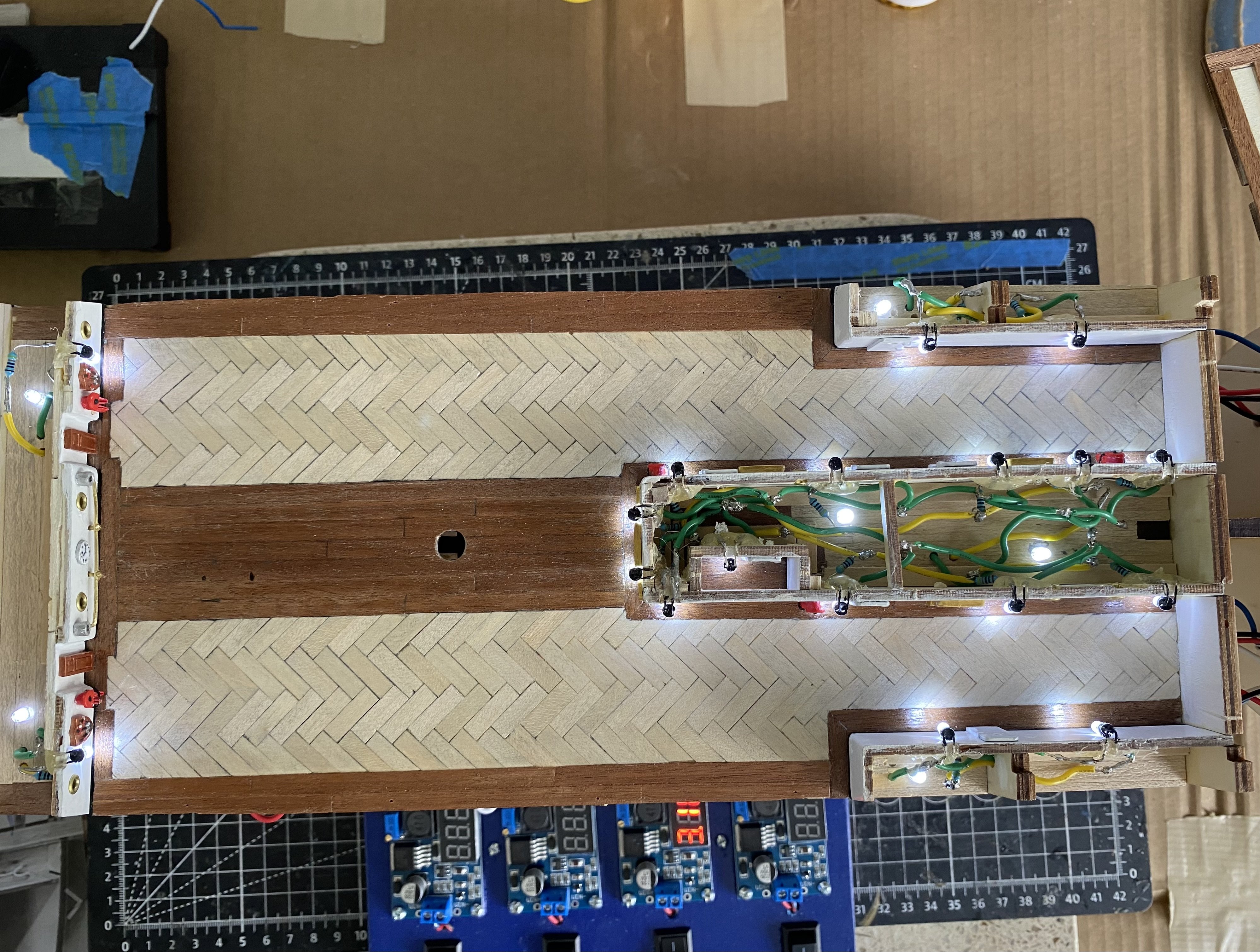

Ok Daniel here is another curiosity I wonder if you experienced. I have installed and provided current to the 6 LEDs inside the structures on the main deck (stern end well, fire control room, and the two rooms on the side). These lights are on the same circuit as the deck lights on the outside if the structures. I think this is the same way you wired them. All 4 of these structures have port holes or holes in the doors. When the lights are on the exterior lights visually over power any light coming from the port holes. Basically my eyes can’t adjust to seeing both. I could put the interior lights on these structures, as well as the future structures A,B,C on a separate circuit but realistically I don’t think you would have the interior lights on and the exterior lights off.  I am just scratching my head as to seeing light shine out the port holes on the deck structures. How is it on your’s?  I am reading about the diode idea for OR and think what I would like to do is set up my circuits to have all the deck structure interior lights come on with either port hole circuit. Somewhat similar to what you talked about above for structure B, but for all the interior lights. Watching YouTube videos to try to understand how it is wired. Still confused.

Daniel I spend a lot of time perusing your build to get inspiration and ideas. I am curious, maybe fascinated, by this floor. What did you do to make it?  Looks so similar to the original on the ship.
