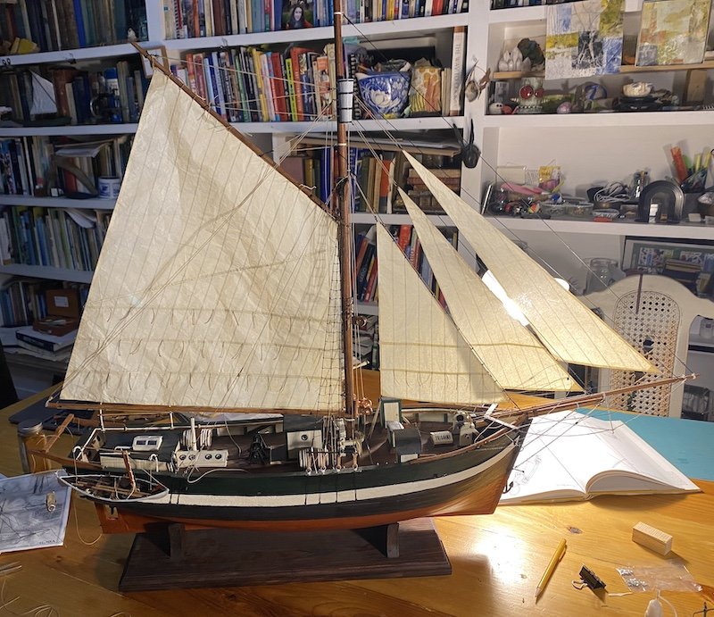

A week-long window of free access to the dining room table has just opened!  The model is 40" from tip of the bowsprit to the tender on stern davits-- my "official" model work bench is 41" wide, so this is a rare chance to get some serious work done, with access to both sides. The main goal is to get the main sail on.
The last four mast hoops are on-- I did not thread them onto the mast before attaching all the foresail rigging, crow's nest, shrouds, etc., so I cut them open and then glued them back together around the mast. The boom and gaff are already fitted out with blocks, cleats, etc. I also got the parral beads on the gaff and have rigged it into temporary position with the throat halyard and peak halyard.  Also, the rope ladder for the crow's nest is ready to hang.

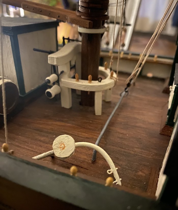

Also, I've fitted those puzzling Ørefiken thingies-- shown below, though not rigged-up yet, nor properly attached (will be lashed further).  Special thanks again to Steggin, who shared the source that provided the answer of how the Ørefiken was set-up (see .pdf he links to at bottom page 3 here).
With luck, I'll be attaching the mainsail tomorrow or so; still have to get the topping lift set up.

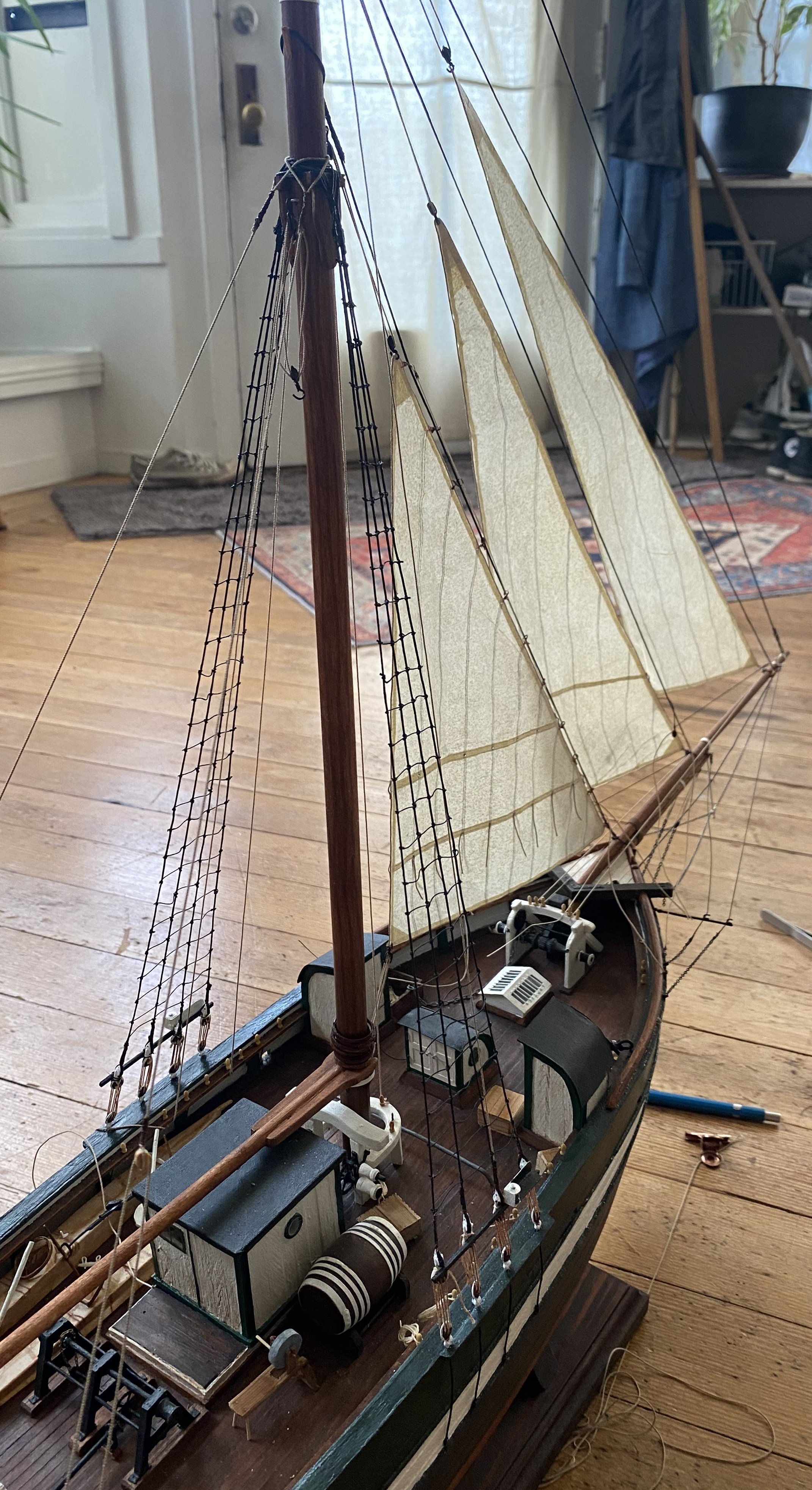

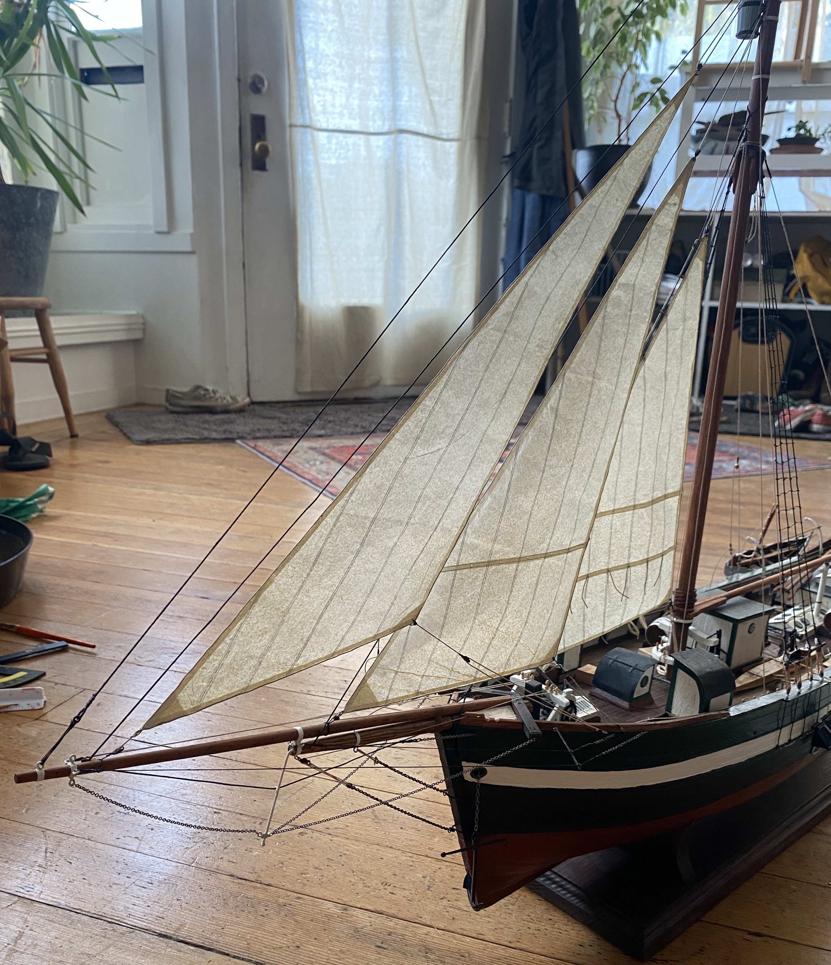

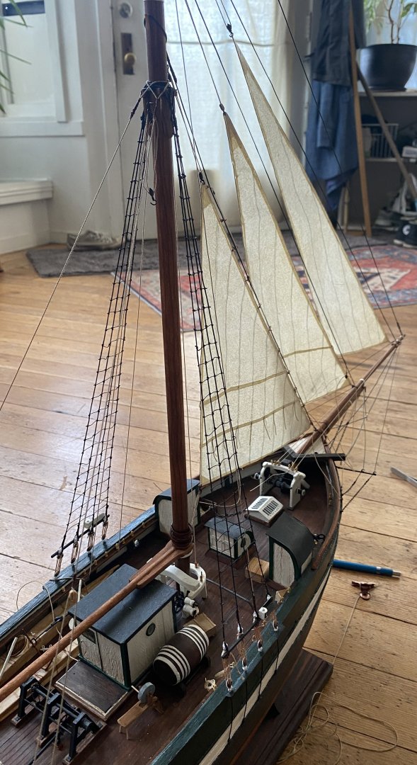

The mainsail is up! Looking like only minimal adjustments will be needed, mostly just tightening thing up as the boom and gaff hang nicely. Just one hoop glued so far, and just a few robands tied. Peak, Tack, and Clew temporarily fastened and the throat temporarily pinned.  Feels nearly done, but a lot more to tend to: matte-ing out glue spots, gluing down falls and attaching hanks to pins, securing both anchors, hanging the rope ladder, tying off the boat lines, adding the main-sheet, and I still have to see about whether or not this ship had a rudder. . .

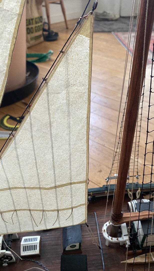

Almost time to relinquish the dining room table-- I got a lot done though! I'm so pleased with how the sails turned out that I decided to go all out with the rig, so the square, square topsail, and the sprit topsail will be set; Gjøa will be in full bloom by spring!  One little hitch discovered this morning. . . I set up the mast's pinrail like how she is in the museum today, but there are apparently a number of pins missing. The old Model Shipways plans shows many more (and their functions), AND I ran out of pins (ordered, though). So, back to the shelf for a while.

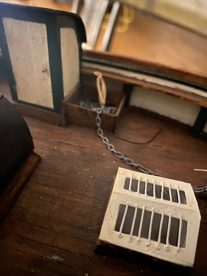

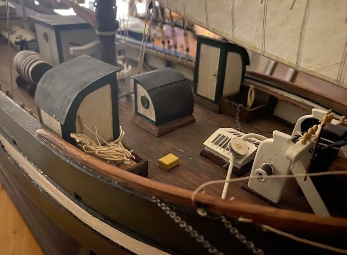

This evening I fixed the mast's pin-rail situation-- my model had half the number of belaying pins she should have had (as per the old Model Shipways plans); the Gjøa in the museum as she is today seems to have been short five, having just five (This is just on the horse-shoe shaped rail around the mast). Sounds easy enough, however ...
The handle-ends of the pins I ordered didn't match the five I had in these positions, so I had to swap out others here and there to get ten matching pins. I had to re-space several of the extant pins so they would accommodate the doubling and look properly spaced. Also, the pins are not long enough to project through the bottom of the rail, so each 'lower-end' is a dummy of bamboo, inserted from below and glued. Old unused holes were plugged and painted.  All of this done while she is nearly fully rigged, which is of course when I realized more belaying pins are needed-- made for some tight work, though nothing was damaged. Anyhow, an in-process shot, and a completed shot, with the foresail halyard replaced.
Now I can finally begin to hitch off all the loose ends and tighten things up!
