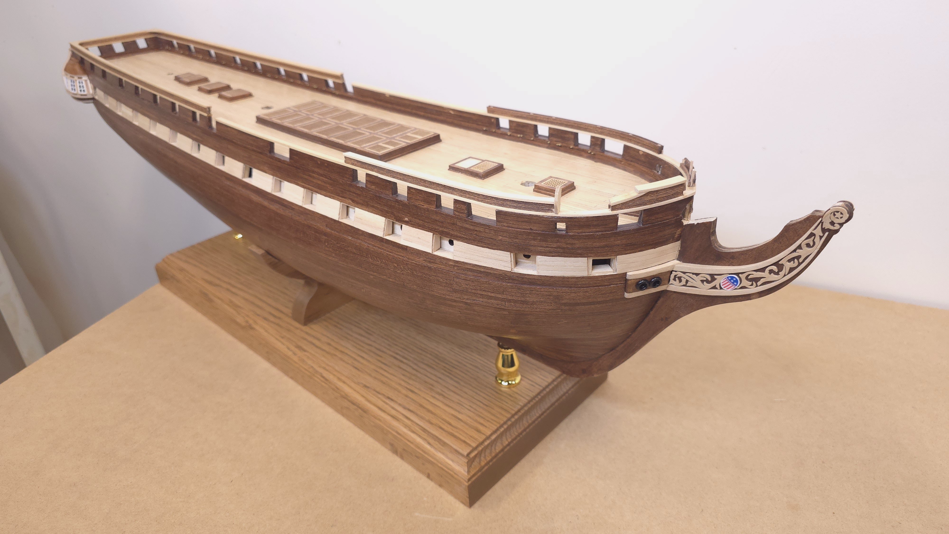

Having said that, after pretty much an entire day at the shipyards, I got to my first coat of poly on the top gallant rails and went back to dealing with the cat heads.
I need 24 hours for the stain to dry, then I'll coat it them with poly. I don't think I will install them or the gangway boards until I'm about ready to do the rigging.
Excellent work, Peter!  Love the contour on the top gallant rails and the catheads came out looking great.  👍🏆
Gregg
3 hours ago, Der Alte Rentner said:
I'm ready for a twelve step plan to deal with that addiction..
Everything is looking wonderful!
I also didn’t install my cat heads till I had the bulwarks done and I came to regret not installing them before I planked the hull.
There are also pinstripes and supports under the cat heads that may be more difficult to do later. IMG_6425.thumb.png.43ce791a700538492efd6b9d9590a889.pngI’ve also found that once they’re installed they are extremely sturdy.
Its always exciting to see your build!
You might want to add all of the eyebolts, blocks, and carvings now, off ship while it's easier to do before, installing the catheads to the hull.
