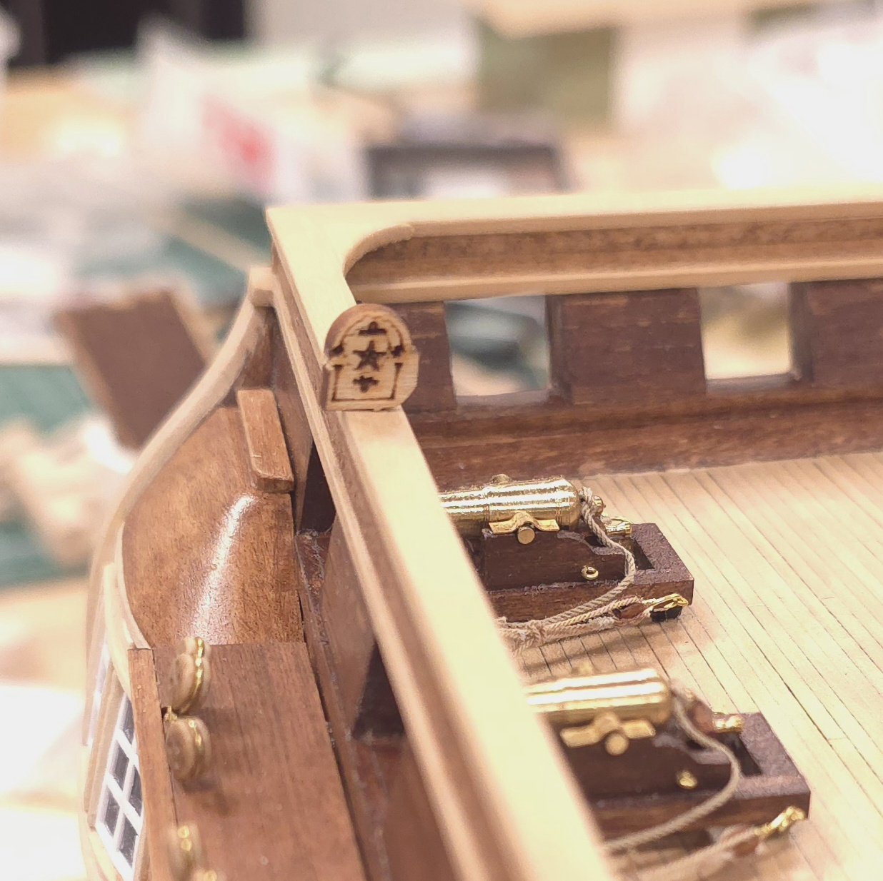

Hi Peter, if I were you, I’d mount the cleat in line with the cathead, just as it appears on the actual ship in the reference photo, and secure the free end of the rope to that cleat. The idea of the rope passing over the top rail doesn’t seem very logical to me.
Edited by mtbediz
I thought the exact same thing, but that's the way that Bob Hunt rigged it, so I assumed there was some good reason for this. Also, I have the top gallant rails, where you do not. It makes less sense to route the anchor line just forward of the rail. I tried that first.
I think in a previous post, I asked myself whether I should remove the top gallant rails, since they were not  present on the current day Constitution.  For good or ill, I chose to follow (for the most part) the Hunt method. If I ever build another one, the lessons I've learned on this one will go a long way..
Thank you.
By the way, I just looked at your build log again, you continue to amaze.
Edited by Der Alte Rentner

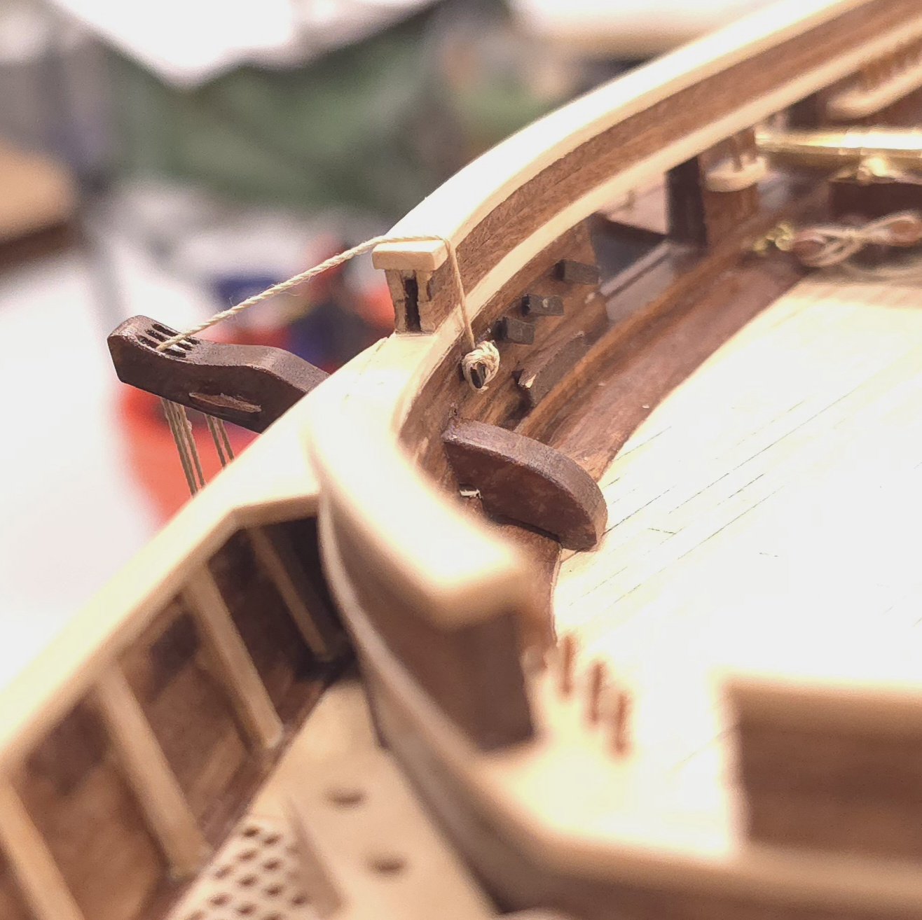

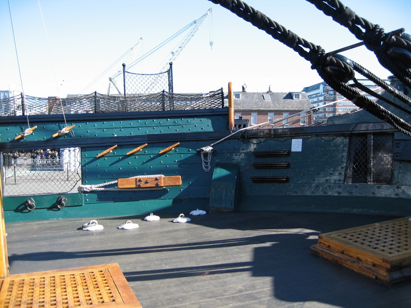

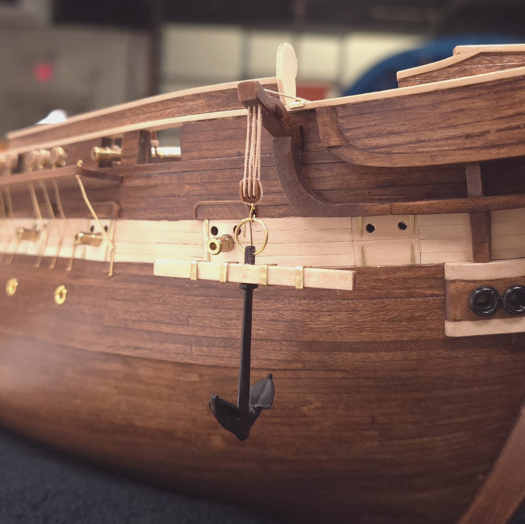

Here is a view of the cleat with the topgallant rail, albeit not being used for the cathead, but a clear picture never the less.
Jon
Of course, it's your model, and you have the right to build it however you feel happiest; I do the same.

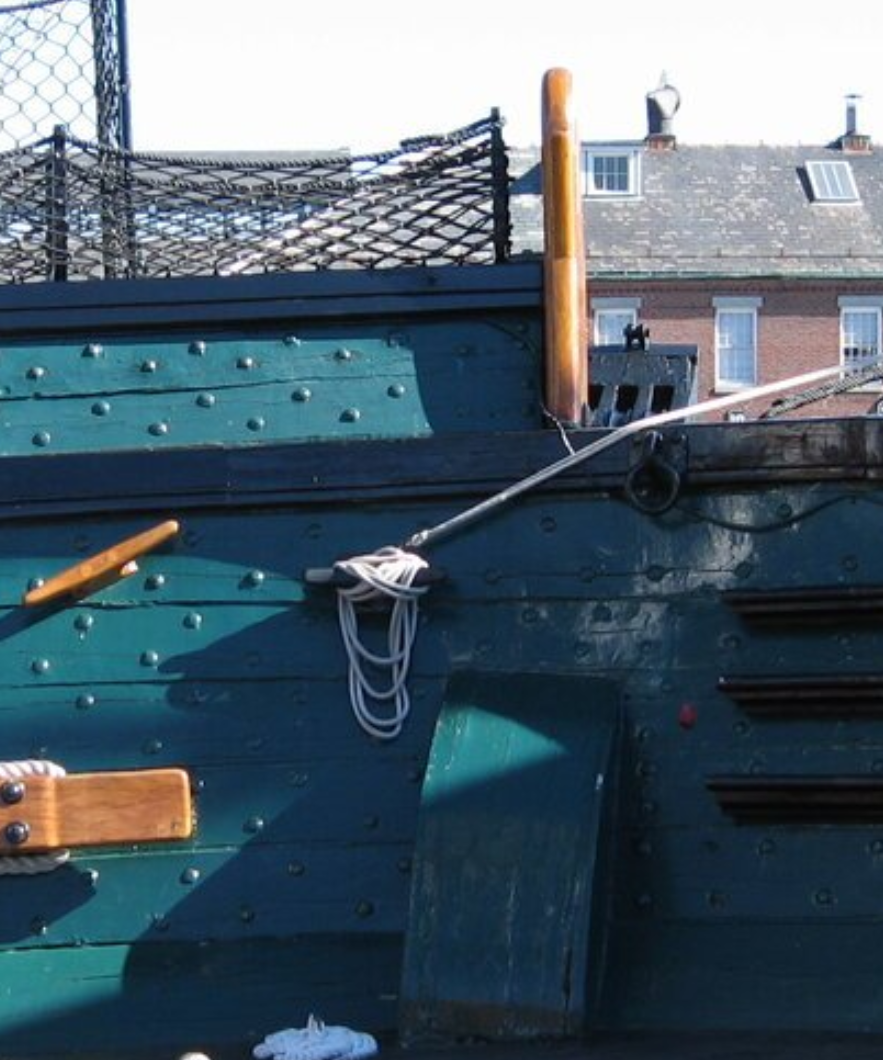

Looking at Mr. Hunt's model, his topgalant rail seems to go further than yours, blocking the cathead, so he must have passed the rope over it.
I'd also like to point out that, although you didn't add it, there's normally hammock net on the topgalant rail, and it's impossible for the rope to pass over that. Again, I apologize, my intention isn't to bother you, I'm just trying to contribute to your model. :)

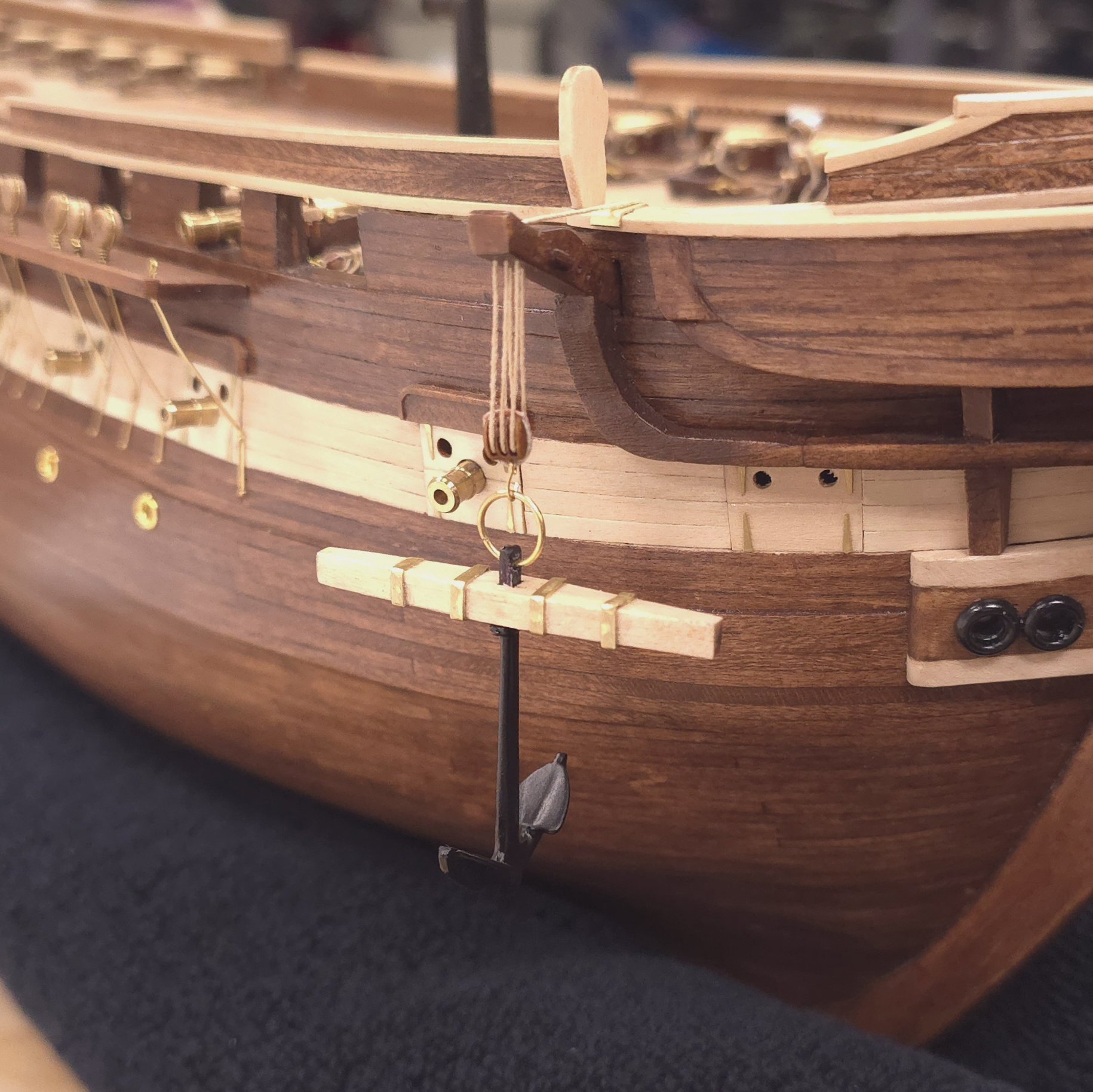

Jon, and Mustafa,
Thanks for your invaluable comments and feedback.  I went back to have a second look at where the end of my topgallant rail was in relationship to the plan and compared that to where Hunt ended his.  You are 100% correct, Mustafa, to point out Hunt's extends well forward of the cathead.  Mine actually conform to the plans and coincide with the photo Jon contributed to the conversation above, as do the placement of my cleats - despite the fact that the scale is waaaaaaay off.  But they came with the kit (though, evidently not the metal one that the anchor line is supposed to be secured to), so I used what I had.

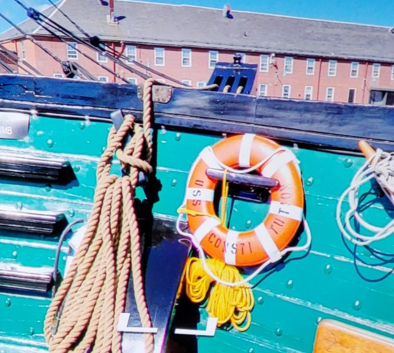

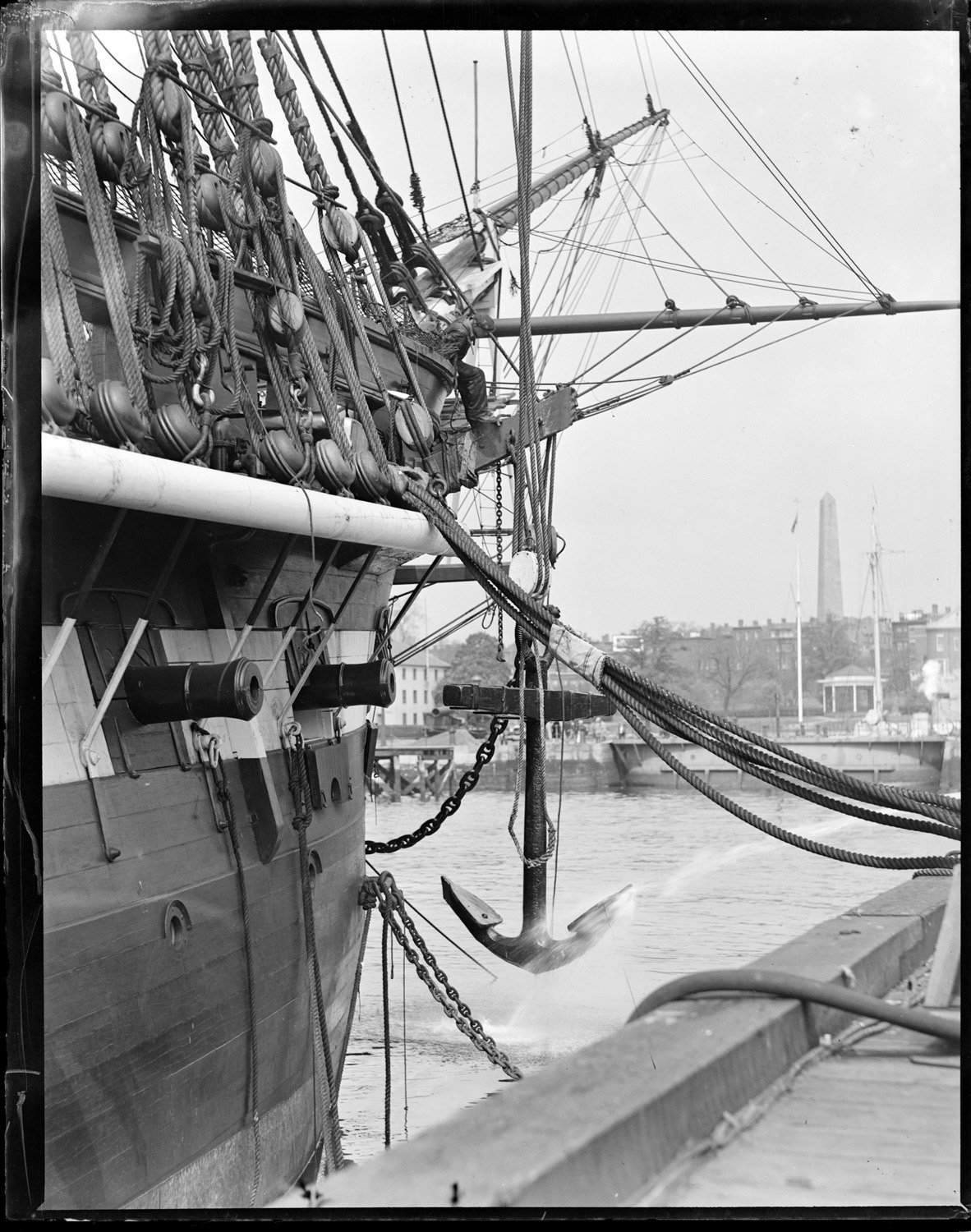

Looking at this photo (Photo 1) from Jon, I'm wondering how the anchor line should run from the cathead to the cleat.  Mustafa rightly points out that, in this case, the hammock net would interfere with the line coming over the top of the topgallant rail.  Even allowing that the gap just forward of the hammock net might provide a path for the line, it seems the angle from that gap to the cleat is a tad extreme.  There doesn't seem to be a plate in that gap, where one would expect the line to rest on, were the anchor line routed that way.   I won't be adding the hammock nets, so this could render the point academic.
The angle is even more extreme if the line were to run forward of the rail cap (end?) to the cleat.   That option simply can't be correct.
Notice that there's no cleat directly above the inboard part of the cathead!

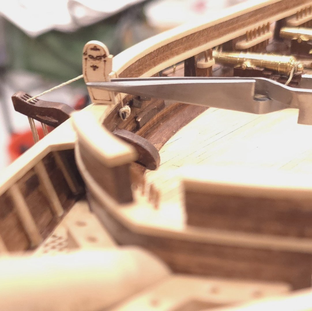

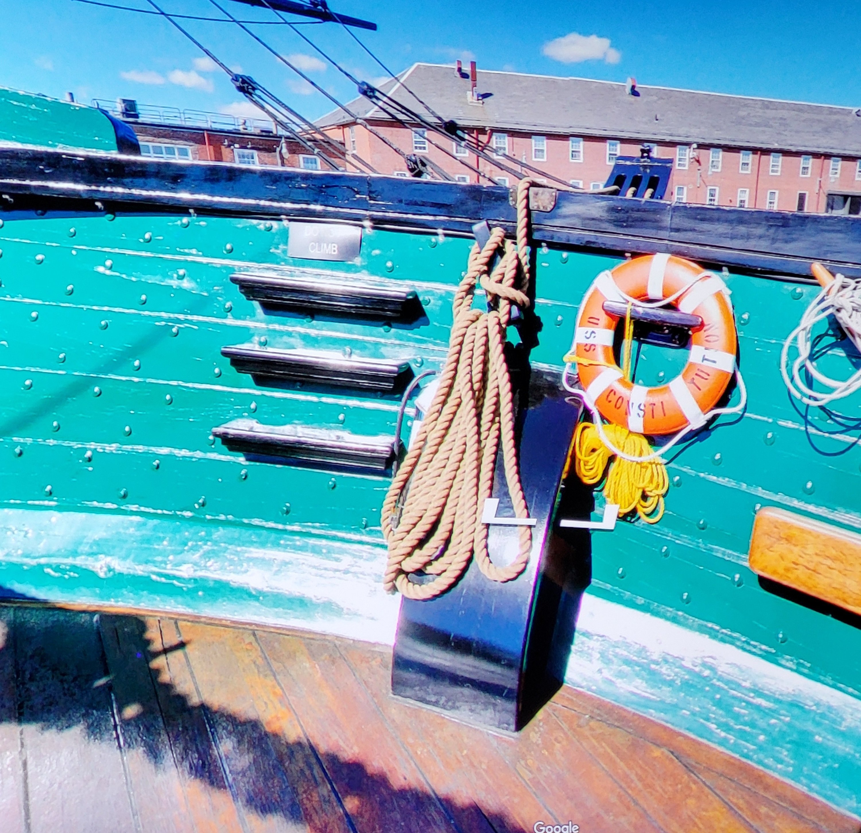

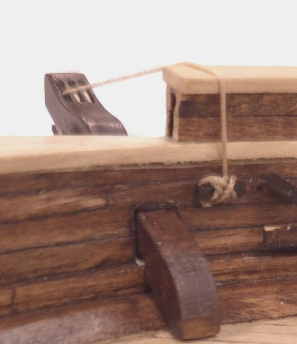

In this photo (Photo 2), supplied by Mustafa, there's an extra cleat!  and a metal plate for the anchor line to rest on.  But no topgallant rail and no hammock net.

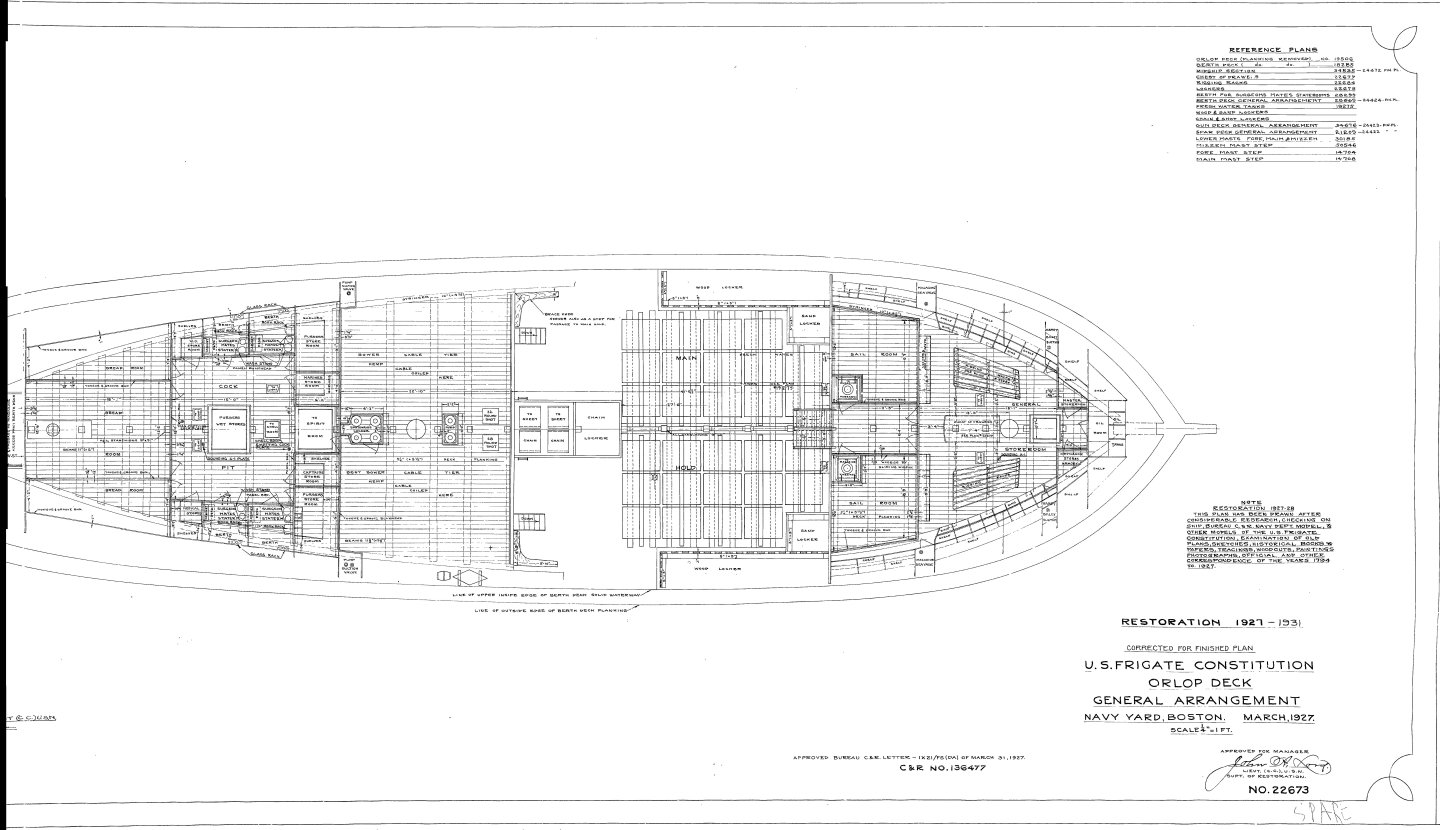

Looking back at the photo of my build (Photo 3), It appears that I do have the room to add that extra cleat, exactly where it appears in photo 2.
Of course then I'd have to add a metal plate to protect the main rail.

and that includes figuring out how to rig the anchor line as it appears in Photo 2.

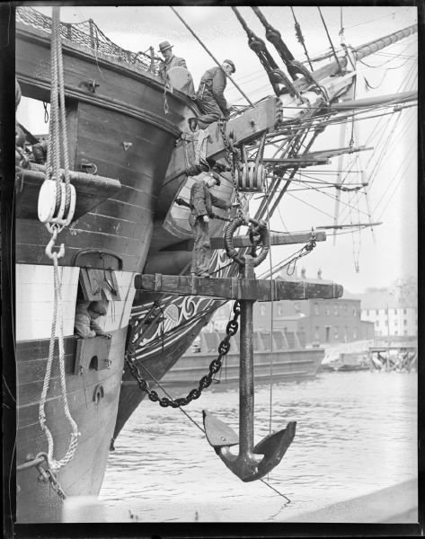

I decided to dig a little further so explored the the last time the anchors were in use which was 1930s. I hoping to find how the cathead rigging was used and tied off. I had no luck from the spar deck, but I did get a clue from 1931 photos looking at the anchor hanging from the cathead. Note there is a line coming from the cathead running by the man kneeling on the cathead, rising up to somewhere in the mast rigging, bypassing the cleats on the bulwark.
Jon
All of this is giving me a headache..  I suppose I could simply not dangle the anchor, securing it to the spar deck as shown elsewhere.  I had hoped to be back at the shipyard today, but to add insult to injury, I literally do have a headache, along with a bunch of other cold/flu symptoms, so I'll have a few more days of rumination before me before choosing between the options.  Absent even a hint of where in the mast rigging the anchor could be fastened, I'm going with the option Mustafa recommended at the top of the page.

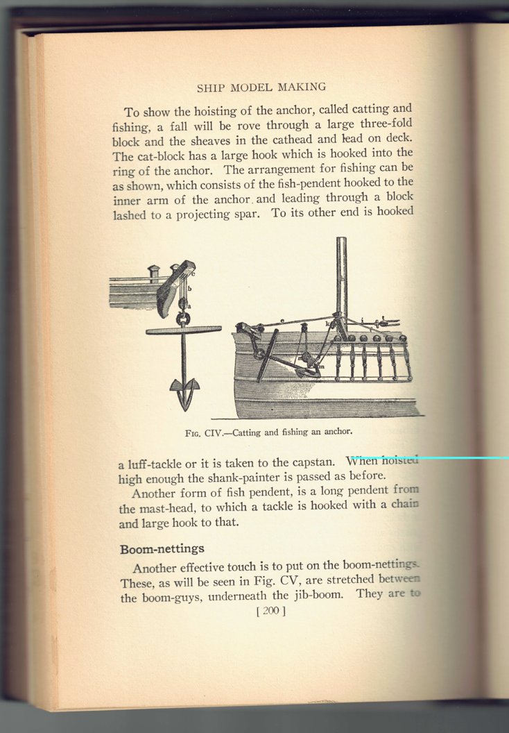

I checked a number of books I have, and this one had an explanation and diagram of what may have been going on in the two photos I previously sent you. This may relieve your headache or regrettable make it worse. I hope for the former.
Jon
Unfortunately, it's the latter.  I need to refer to my nautical Funk and Wagnalls to decipher the lingo.
Frankly, the angles involved in this solution seem as bad as what I've got now. But I still have a couple of days to ruminate over this, we'll see what the new year brings. Thank you Jon.

I have this book, as well, Jon!  The book shows its age, as the pages are stiff and a bit brittle, but it does have good info in it.  I am looking forward to using it multiple times in my build.
The terminology always causes me to pause a bit every time, too, Peter.  I am slowly recognizing and understanding some of the lingo, but I am also frequently still doing an internet search on "what does this mean?!?"

Does anyone want to venture a guess as to how much anchor rope the Constitution carries per anchor? Where is this rope stowed? And how is this anchor deployed? Looking at the picture that Mustafa provided, I don't see how this anchor could possibly be used effectively given the scant amount of rope evidenced in the photo.
That 'scant' amount of rope is only used to hold the anchor up. You can see the actual anchor chain going into the hawse hole, below deck, to where the rope, capstan and rope storage would be.

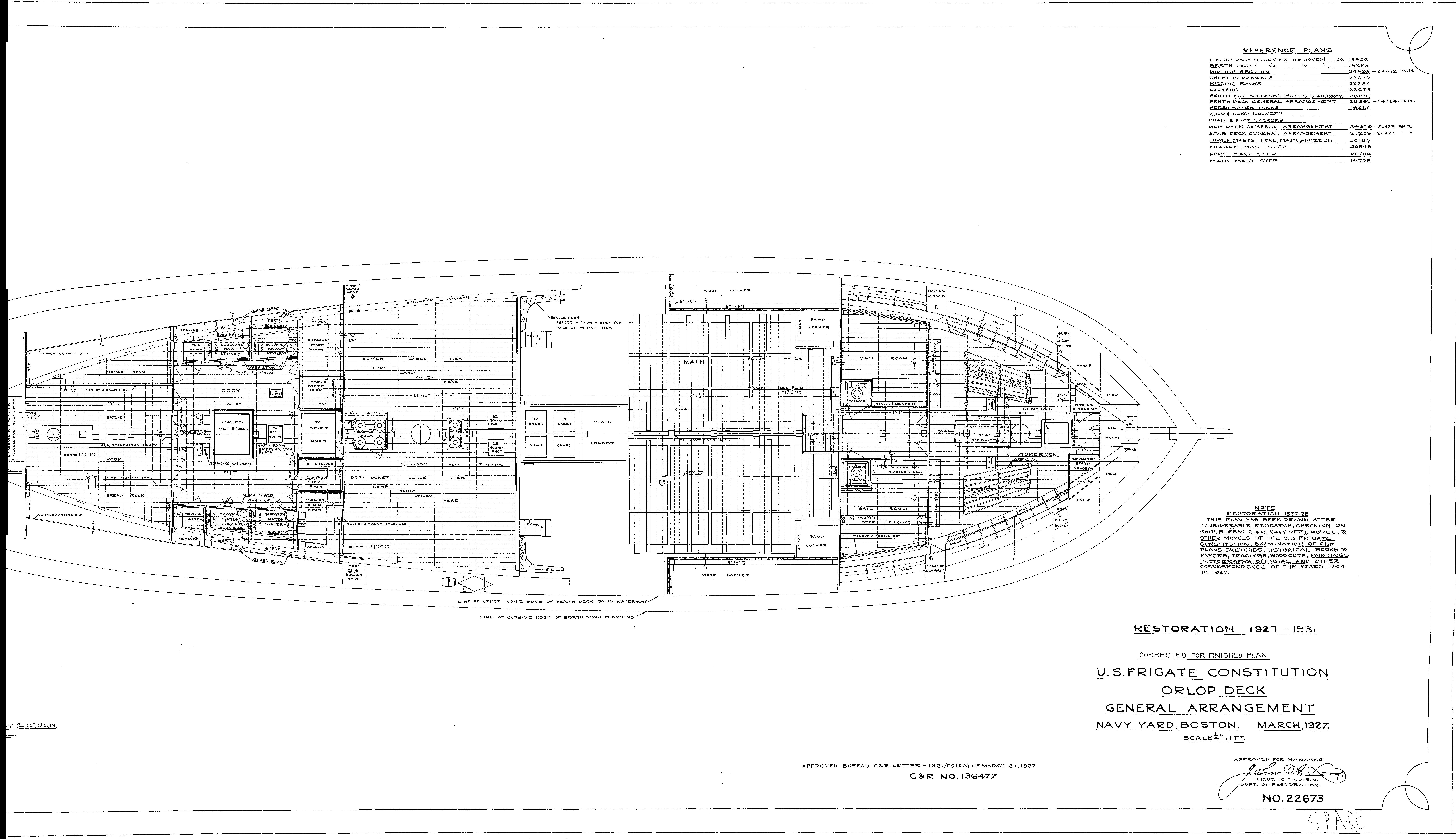

Heavy anchor chains were stored in the chain locker, located beneath the orlop deck (the lowest deck) and forward of the mainmast, in the bow section where the anchor chains would run down and coil when brought aboard. The rope cable or chains length varied but were about several hundred feet long. See attached plan.
On my model, I have both a cable and a chain traveling from the hawsers along the gun deck and down into pipes leading down into the chain locker.
Jon

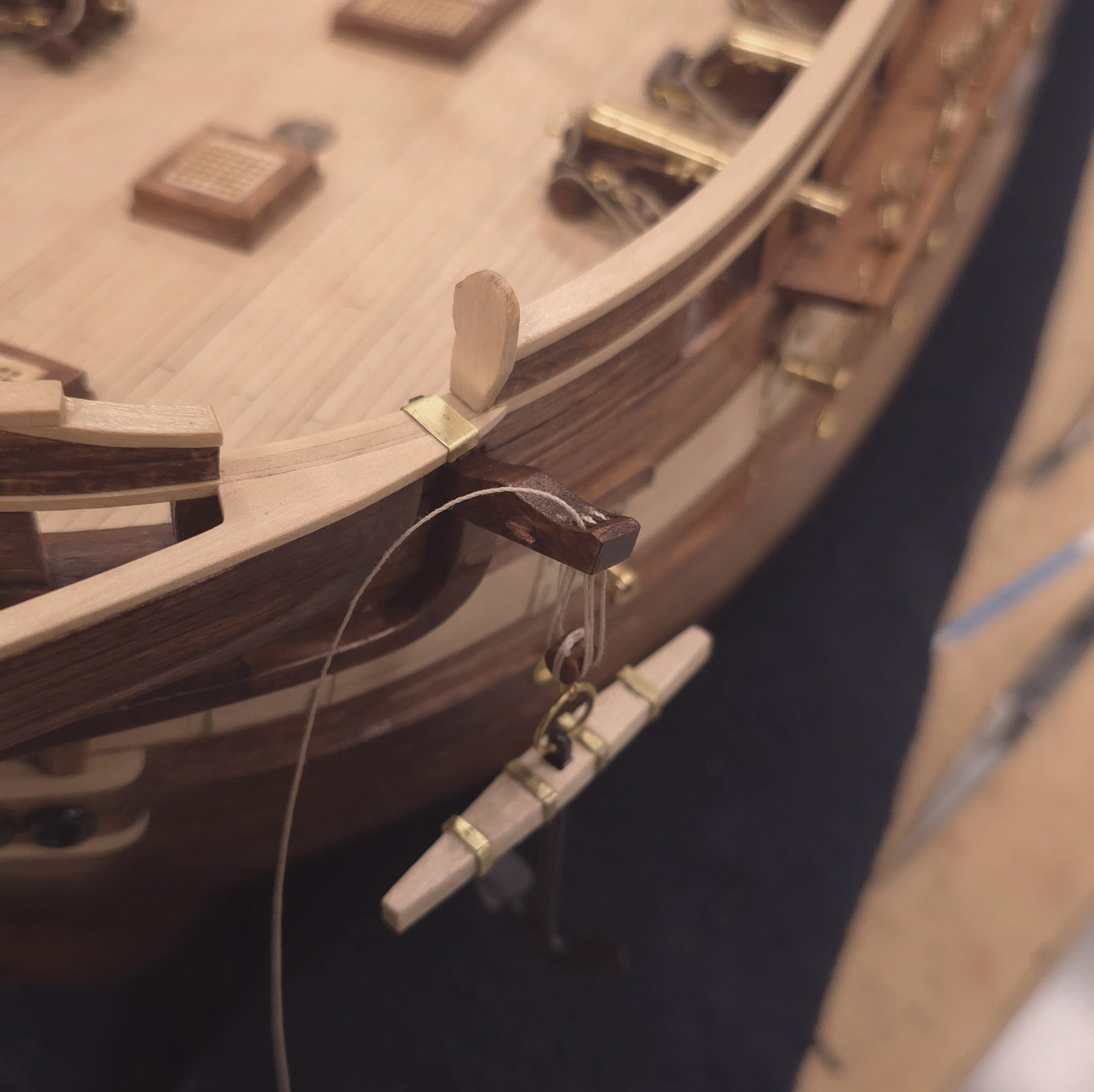

Thank you gentlemen. Unfortunately, I don't think the video explains why Bob Hunt rigged the anchor in his practicum the way he did, or why the anchor rope in the photo of Connie today is tied off on the cleat above the cathead.
Perhaps this is just meant to show the anchor in an intermediate state after pulling but before stowing.  Pull the anchor chain in until it's along side and ready to "fish".  Then use the rope to temporarily hold the anchor in position until it can be secured in the anchor port on the spar deck.
I'm not that much of a stickler for authenticity, and I do like the way the anchor looks with the cathead and triple block arrangement, so I may just keep it and hope noone asks.
