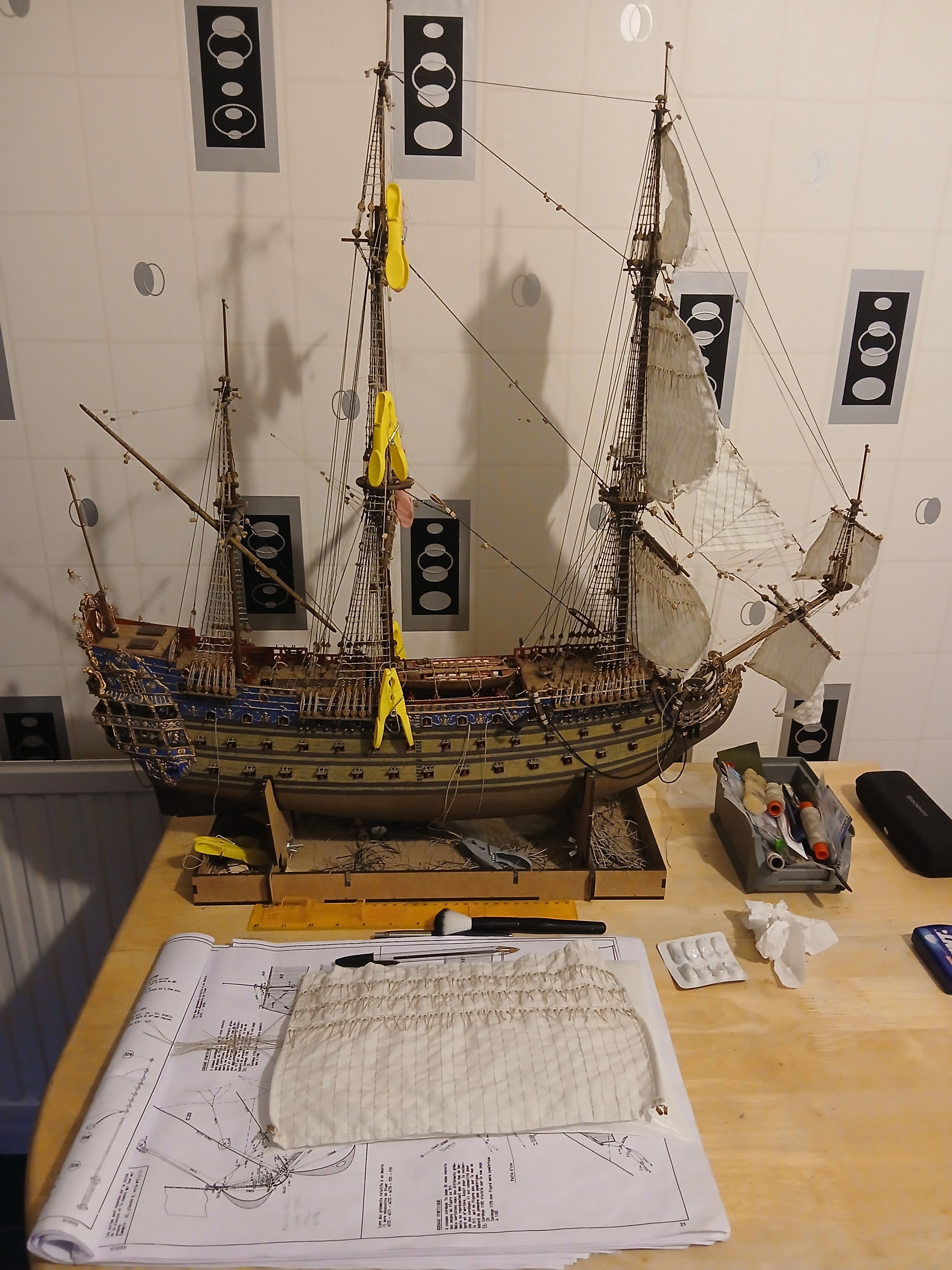

Its been a while since my last update due to other circumstances. All the Futtock Shrouds and Ratlines are now complete as is all the backstays on my Soleil Royal and the rigging to a point. Next up is measuring and drawing the sails on to cloth, after which is hand sewing all the detail on to them. Roughly 14 sails to do as I won't be adding the studding sails as this would make the width too much for where I want to display the ship when finished.
Still a good 3-4 months work involved in hand sewing the sails as well as adding reef points.
Edited by Robert Taylor
Photo update
Well that's the 14 Sails measured, drawn up and cut out next step is the long process of Hand sewing all the detailed lines etc.. I've also made the flagstaff out of wood with only a little aid of the plastic support, as well as 2 brass halves of Fleur de lys bonded together, next will be a little paint and weather for the support and staining of the wood.

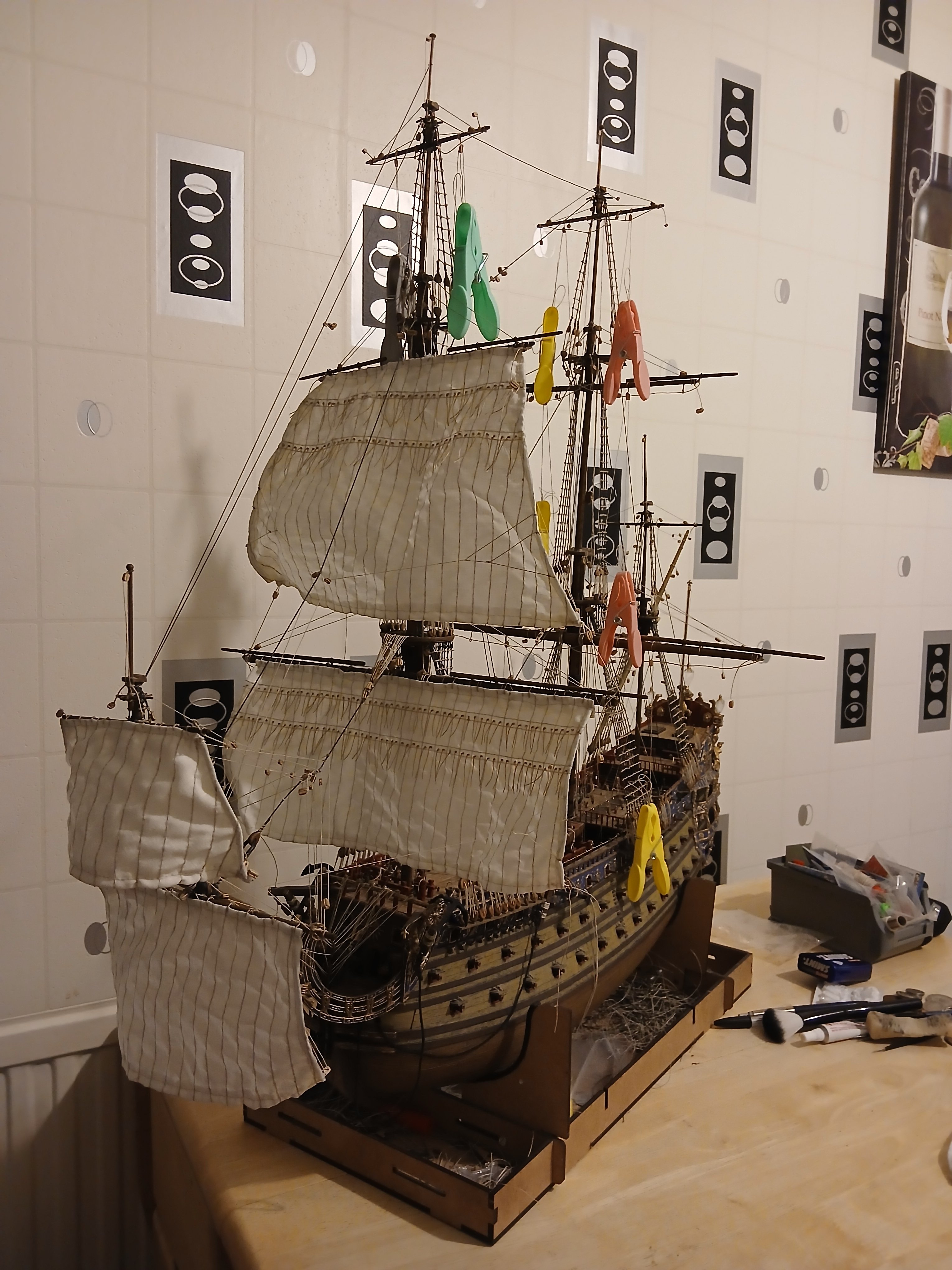

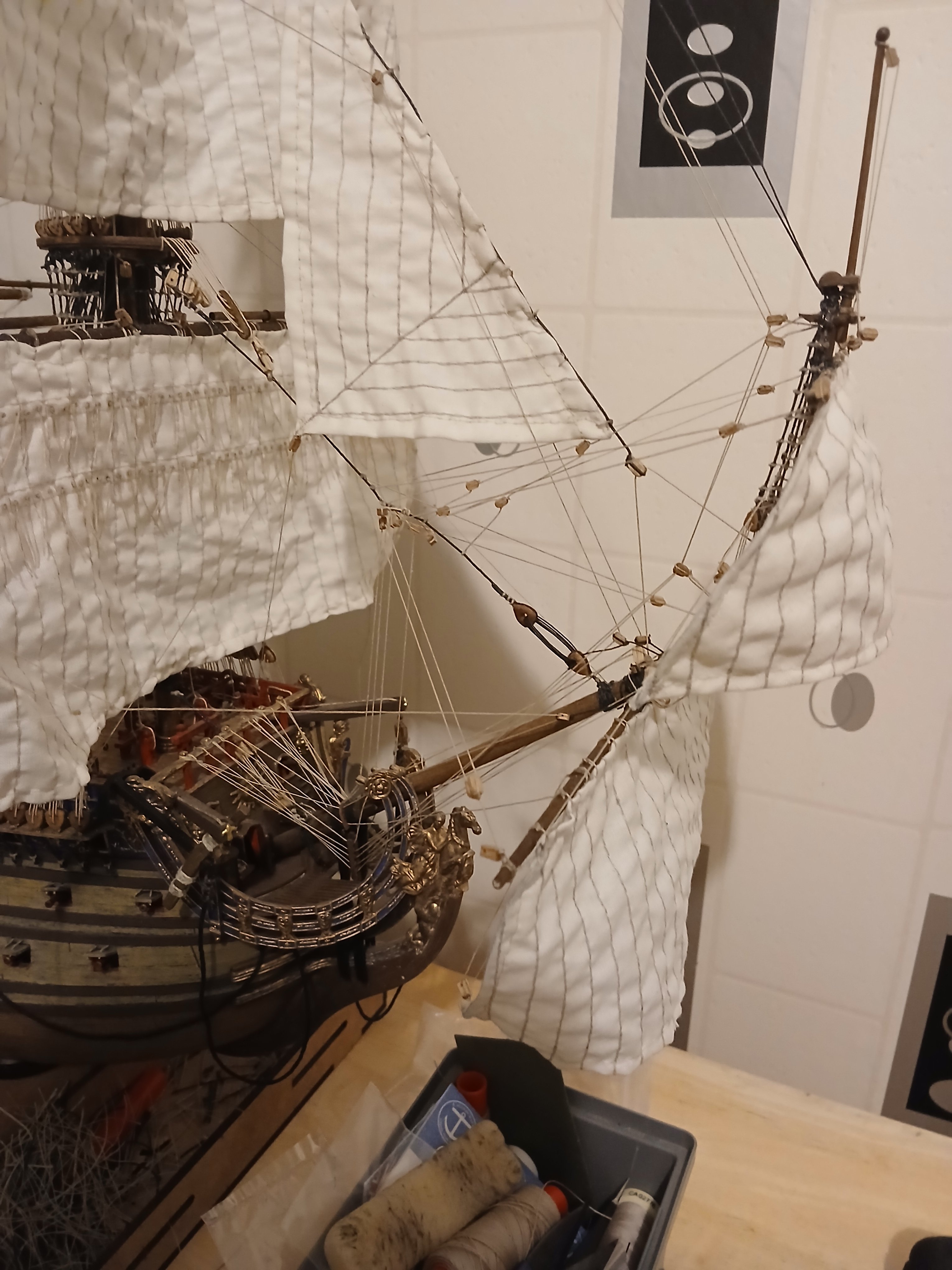

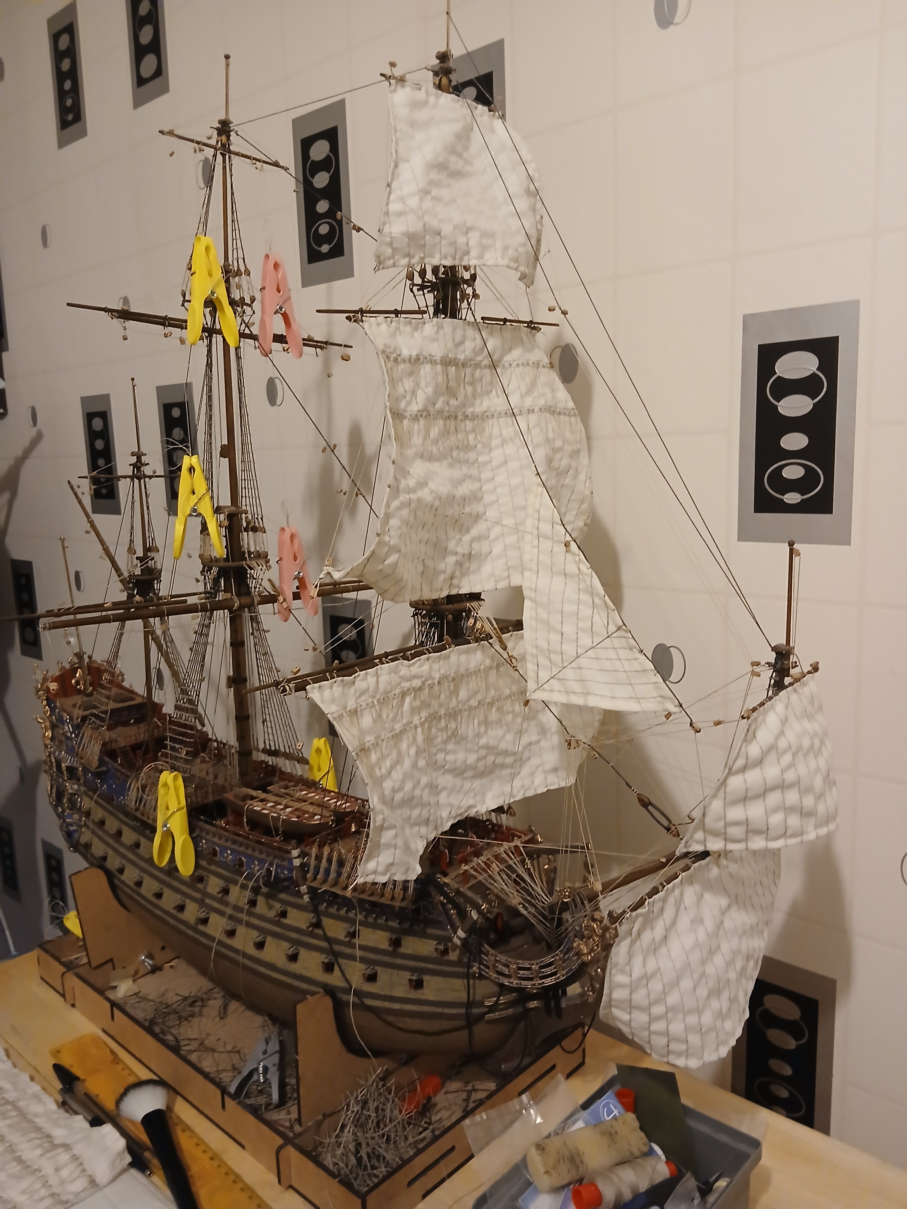

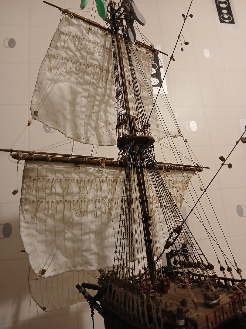

All the Soleil Royal sails have been hand sewn, now in the process of rigging them up, a bit of tight time schedule due to the the fact that the model show exhibition I've been asked to display at is in just under 3 weeks time, still confident enough this ship and other stuff will be ready for her maiden voyage.
On 8/29/2025 at 9:29 AM, phoscar said:
A superb achievement. Thank you for your photographs, they are a great help to me in understanding some of the subtleties of the rigging.
Thank you very much, the ship will be finally finished in the next couple of days, just some small bits of rigging and flags  to finish and mounting her on her stand. All the sails have been  rigged up as well as adding in the black n tackle for lifting and lowering the lifeboats.

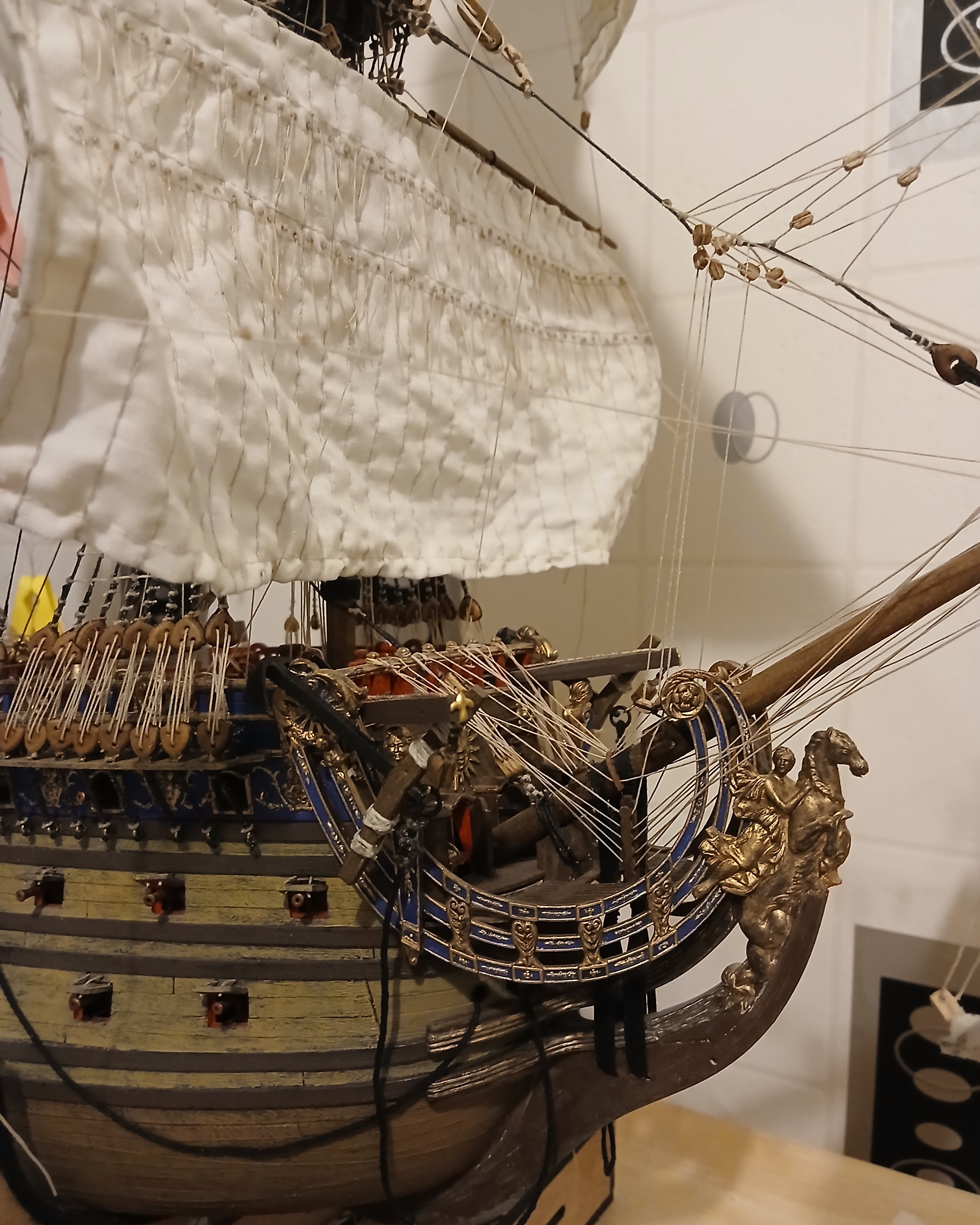

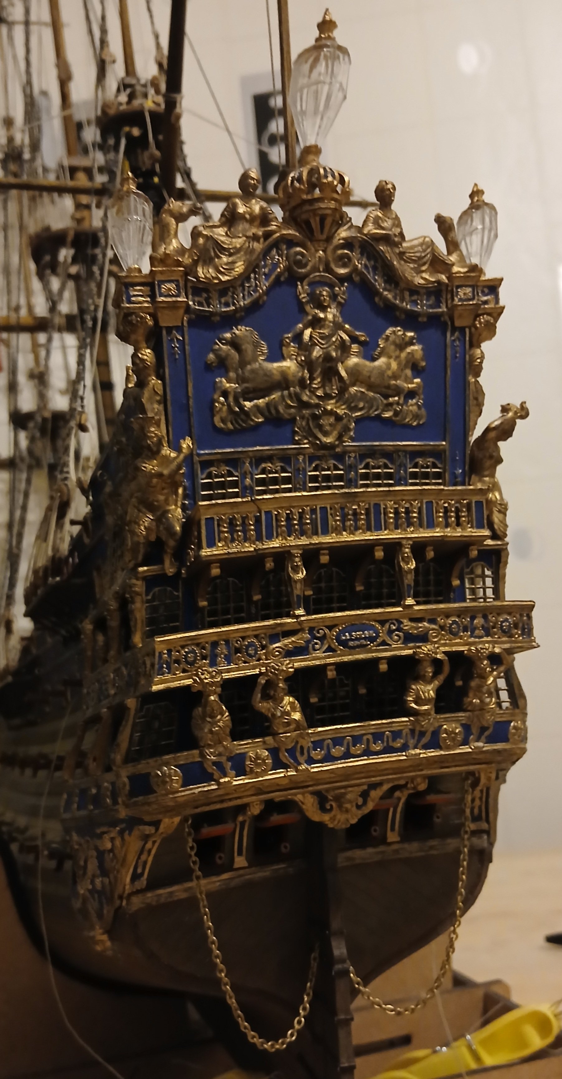

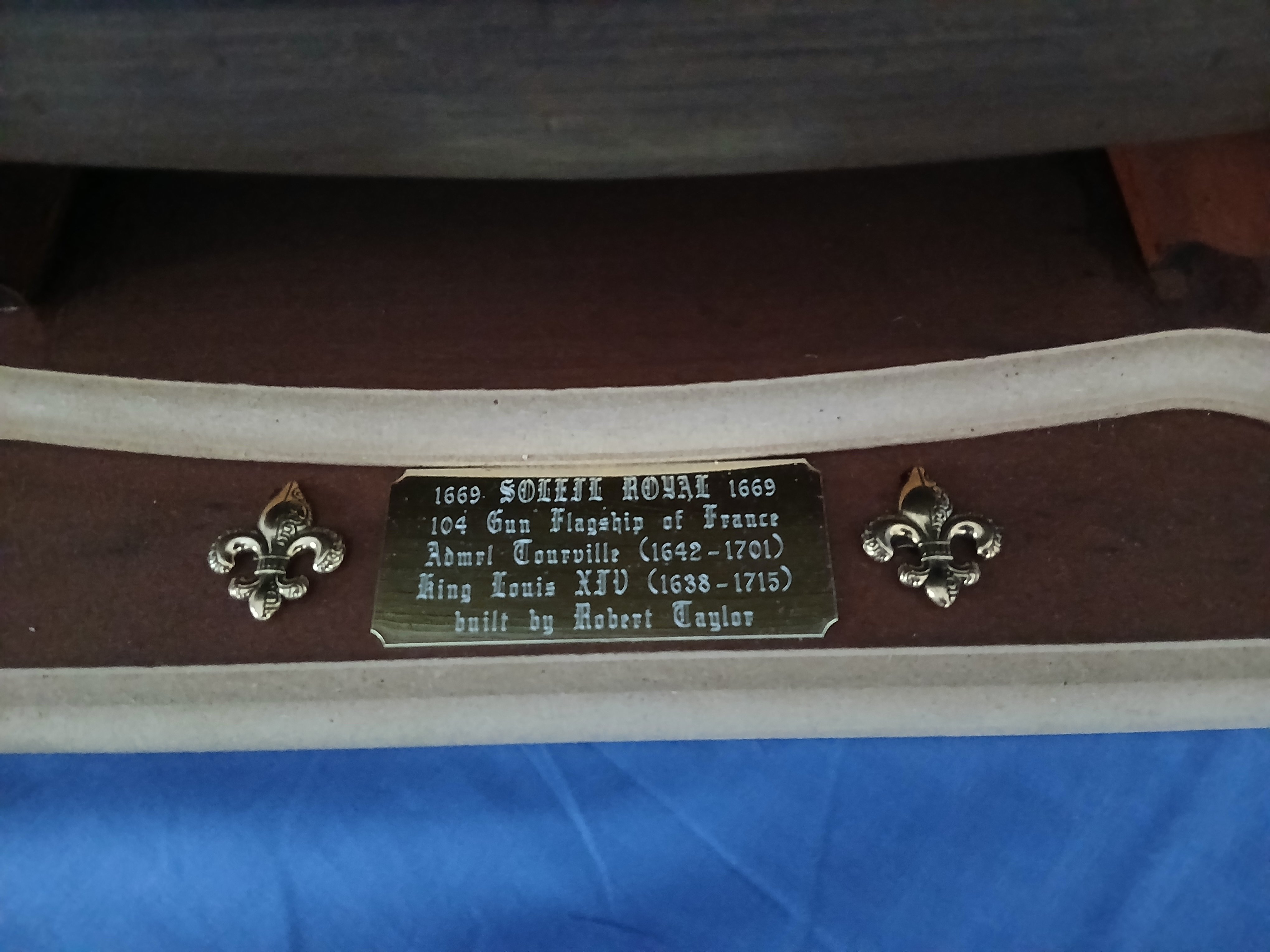

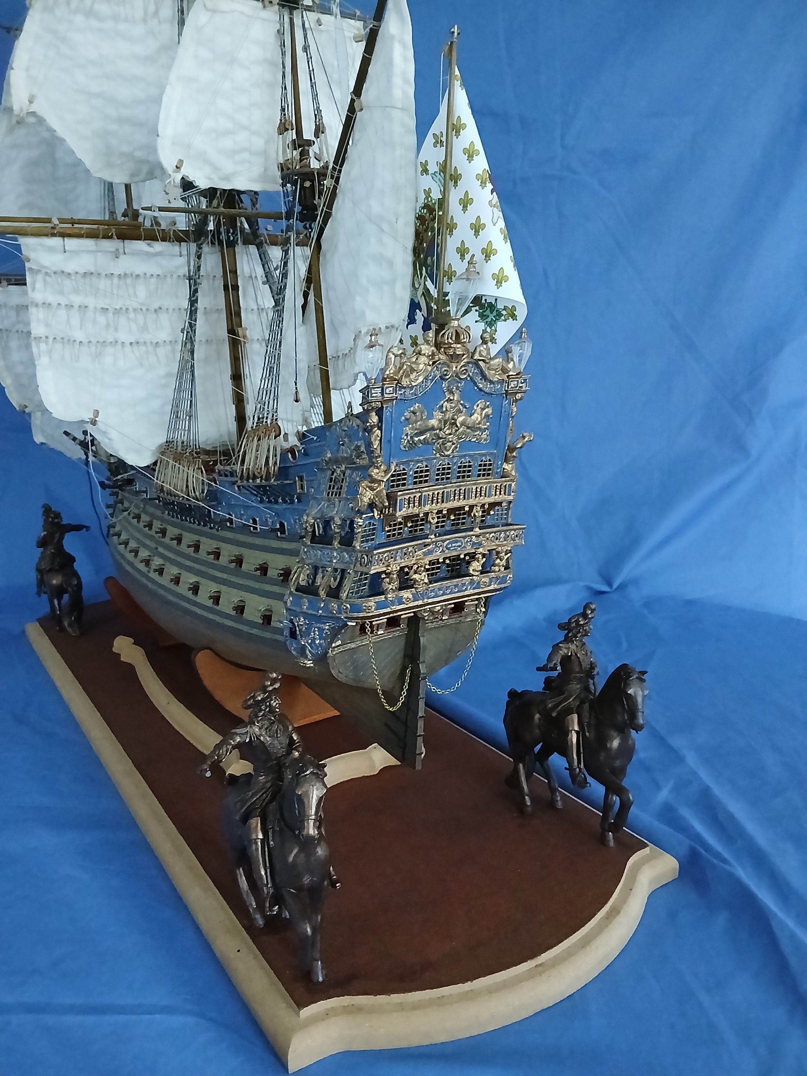

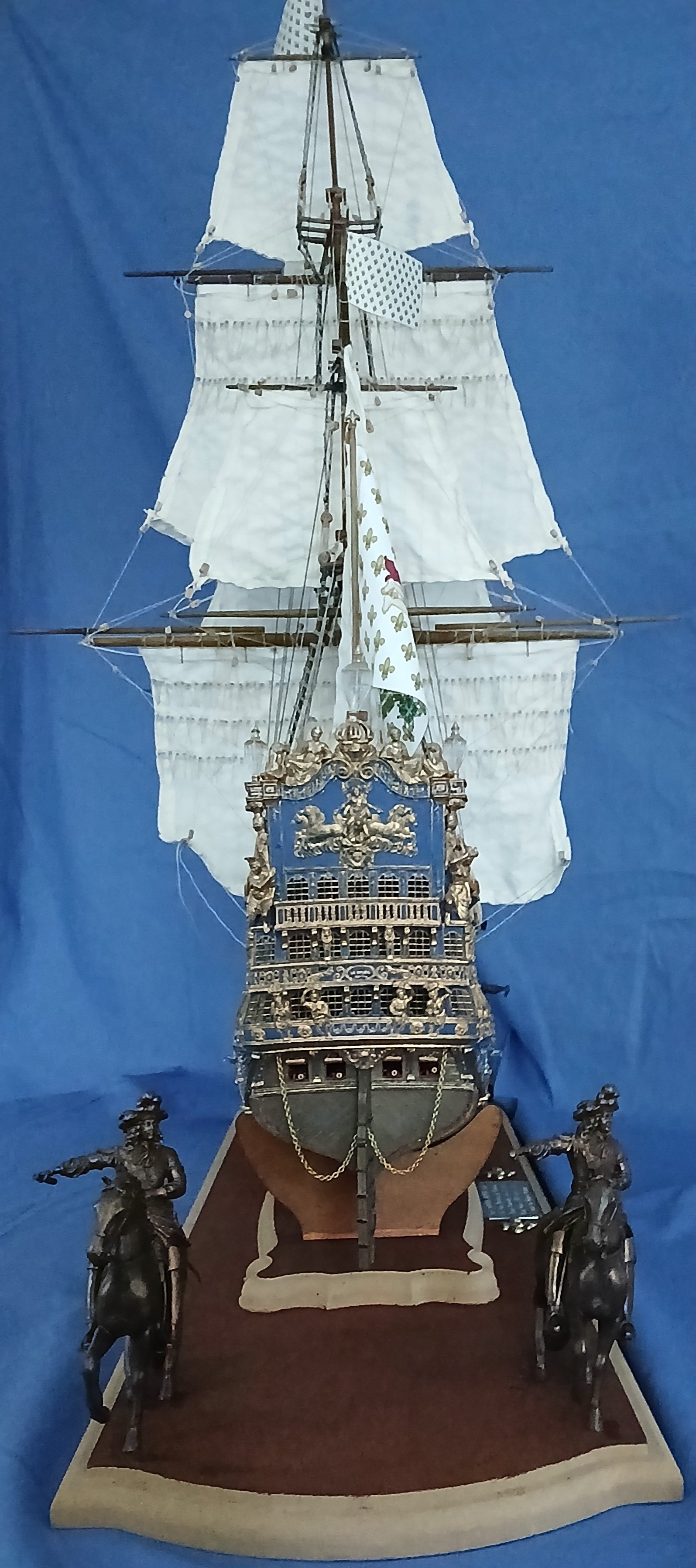

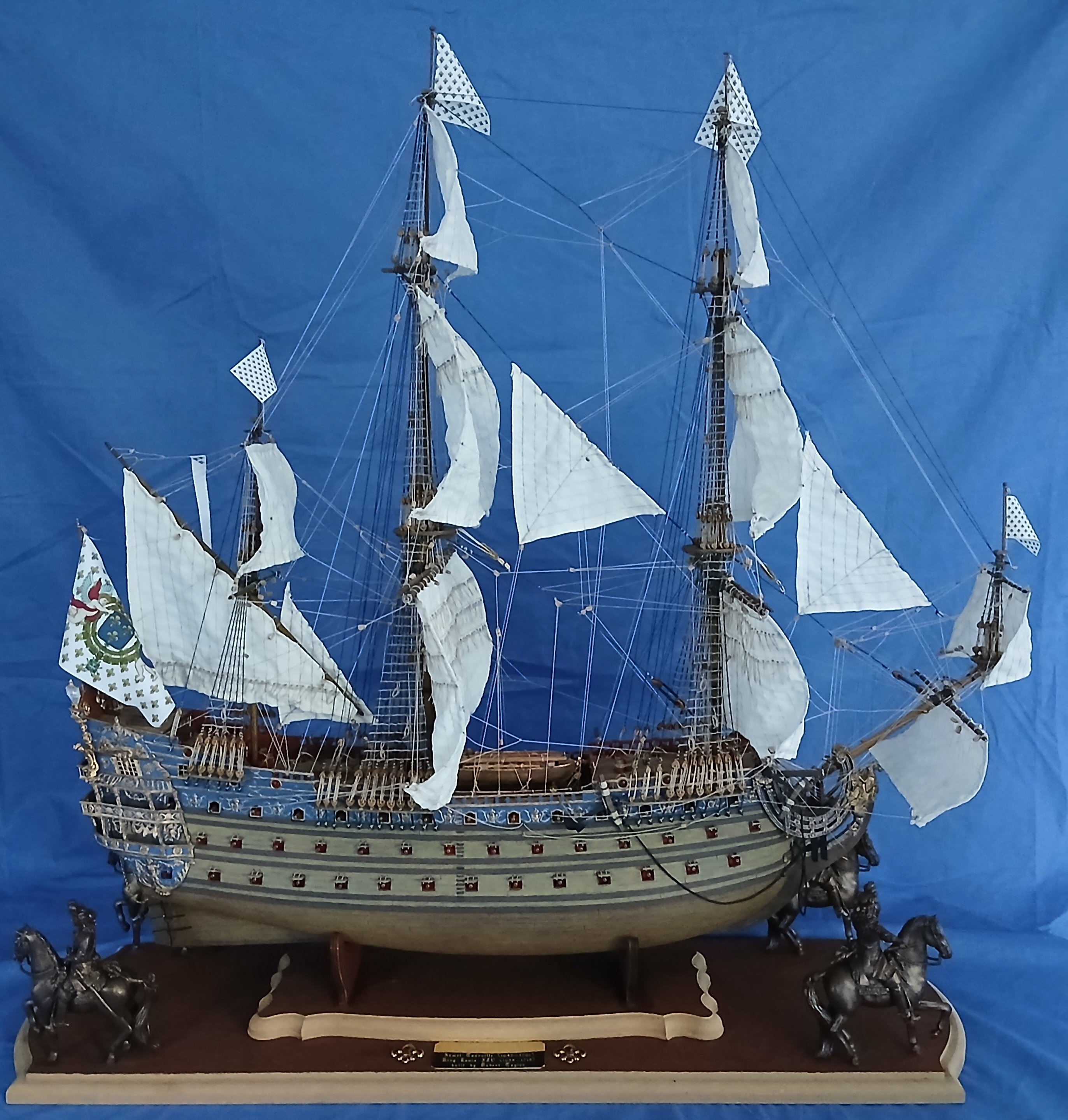

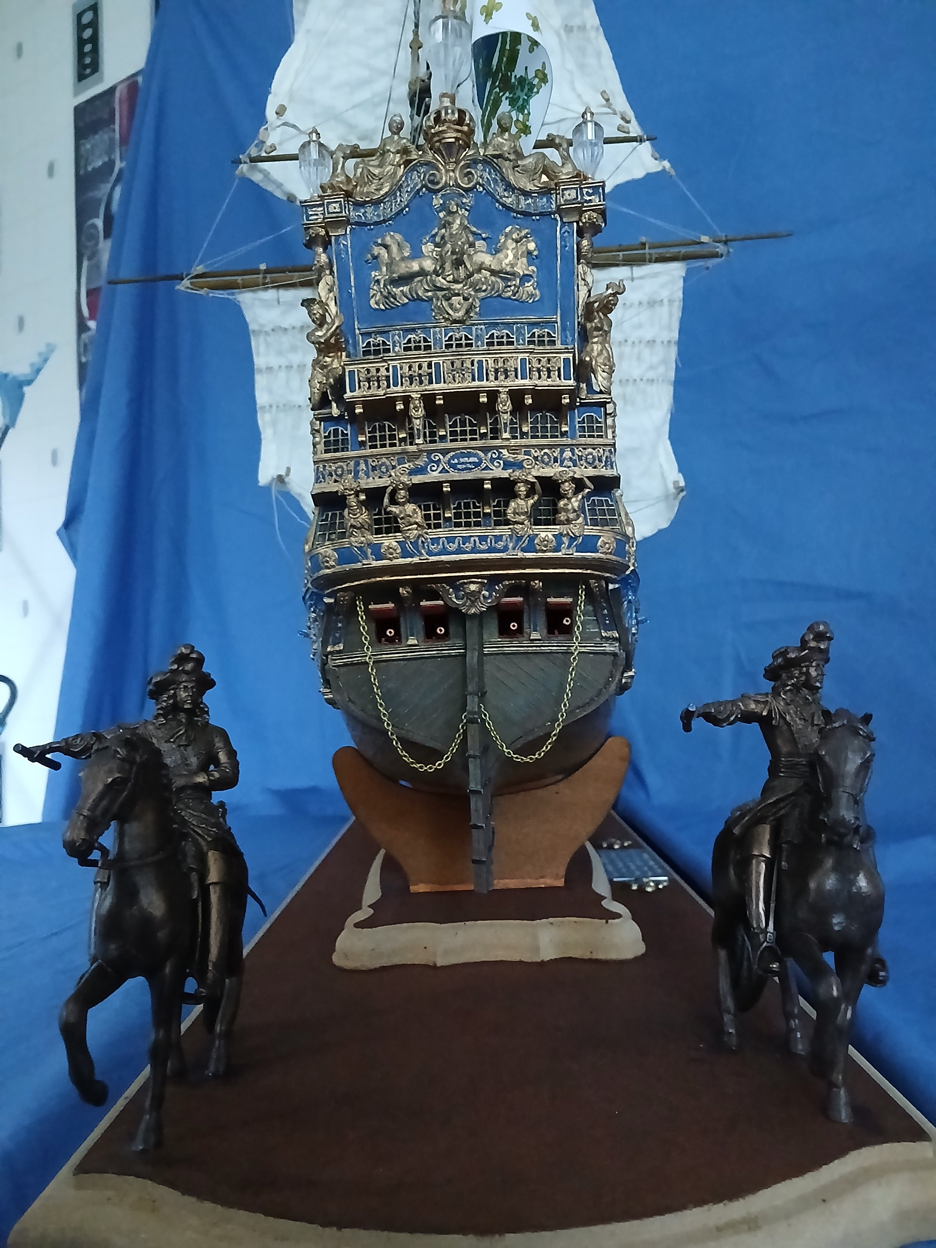

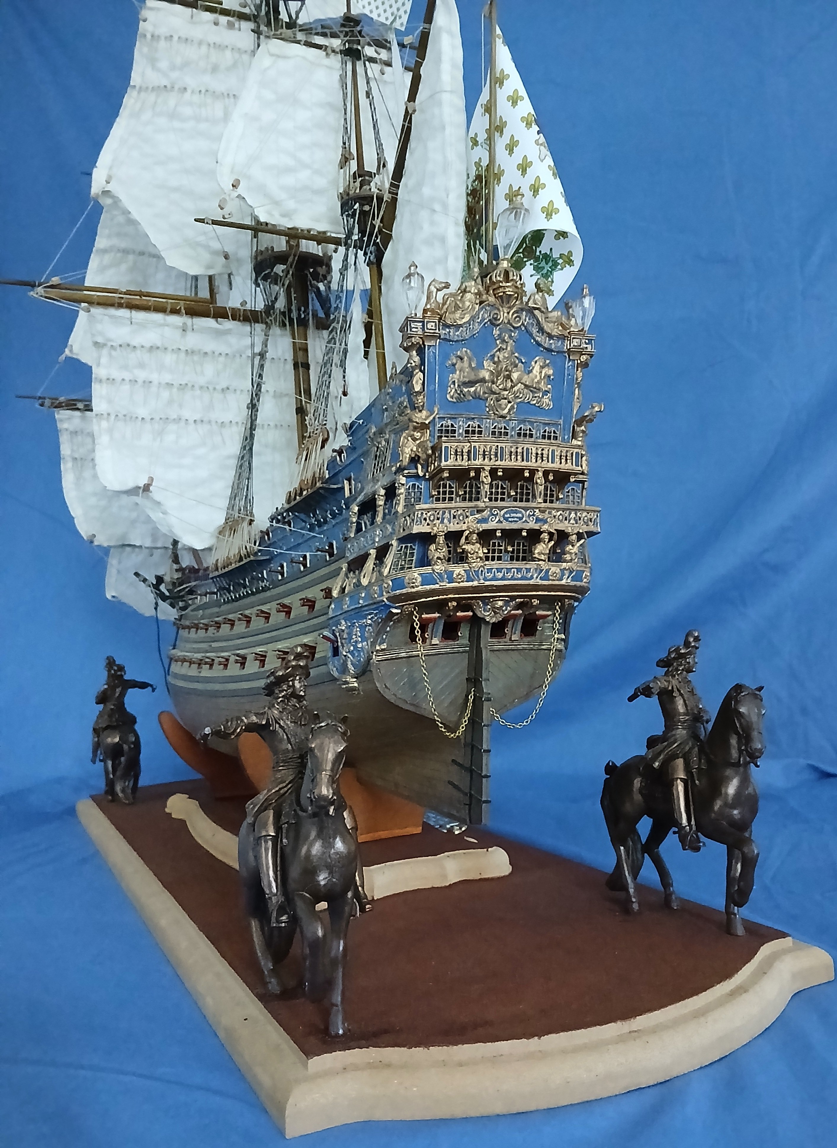

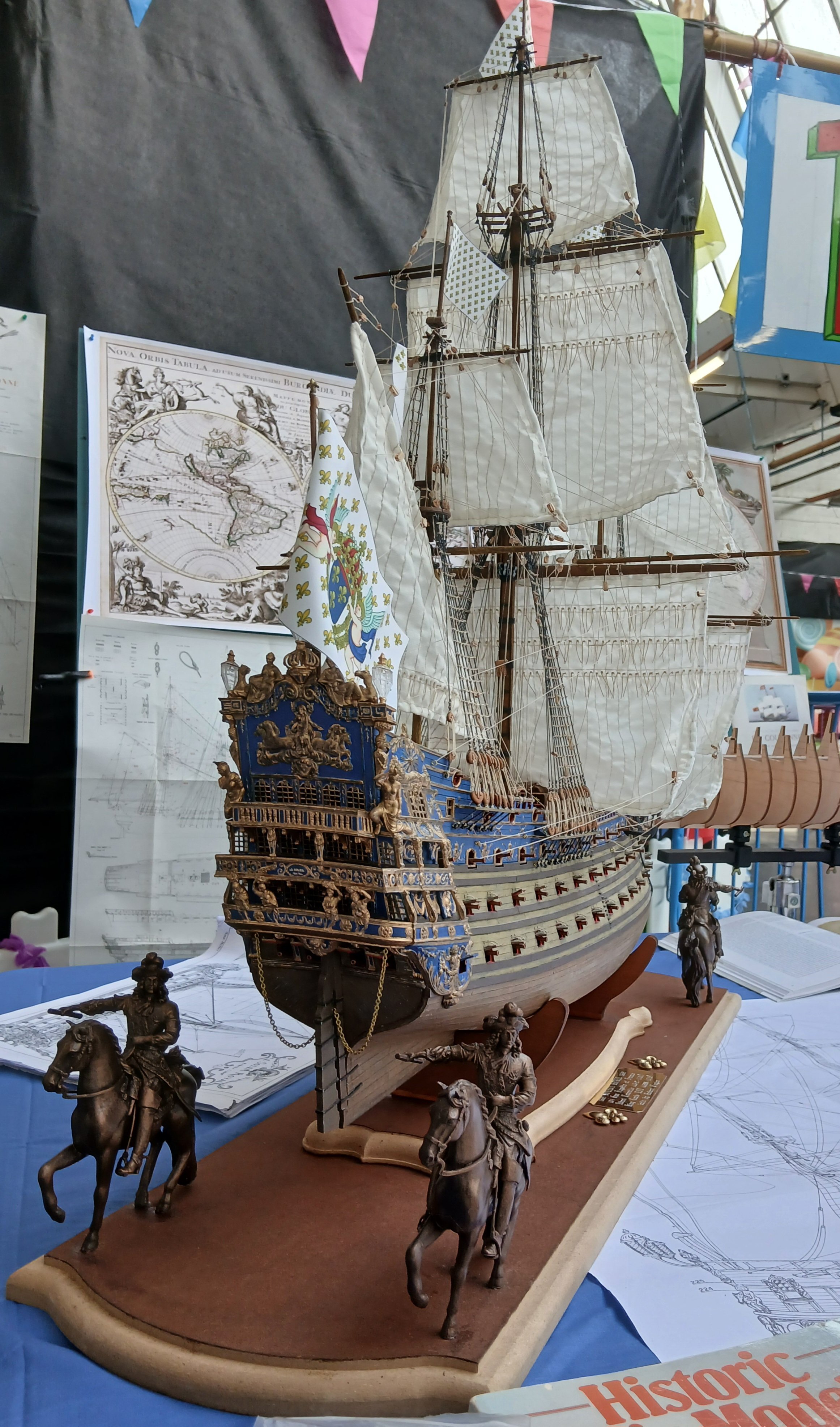

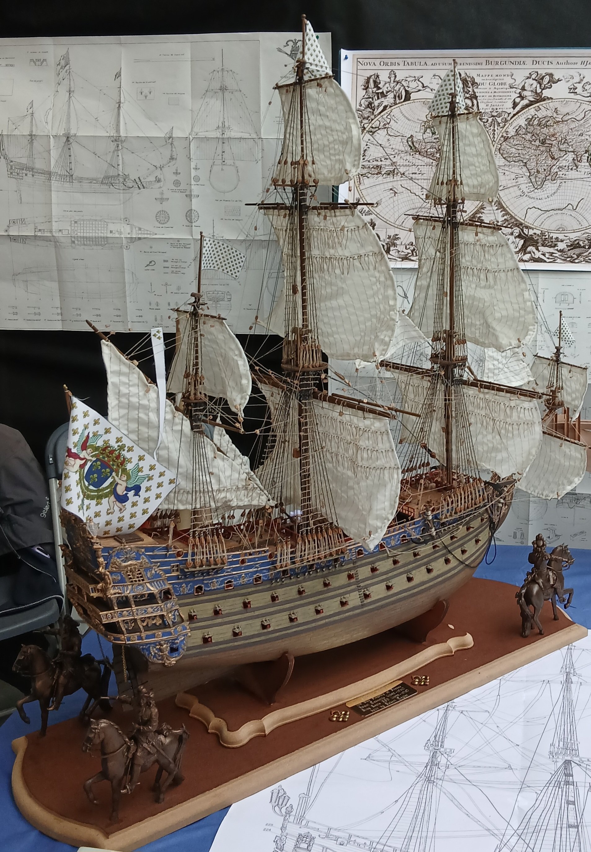

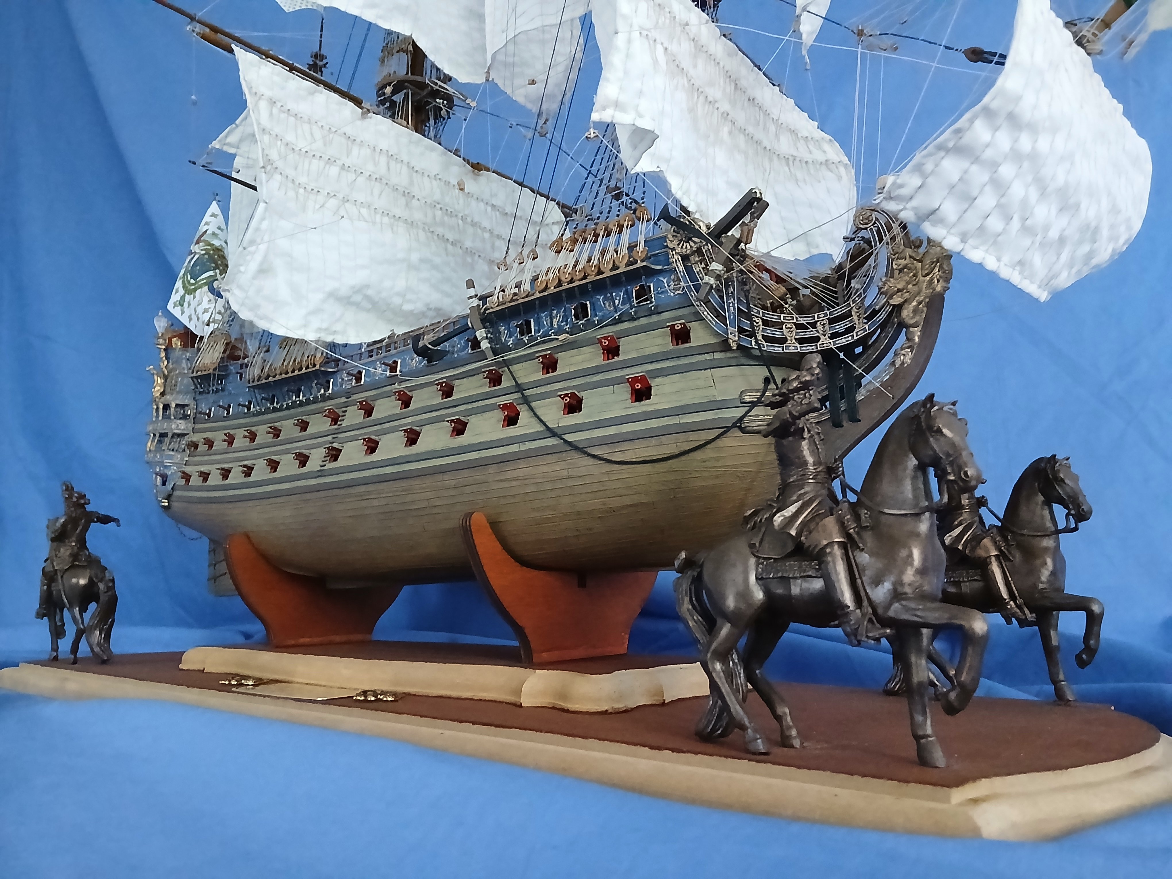

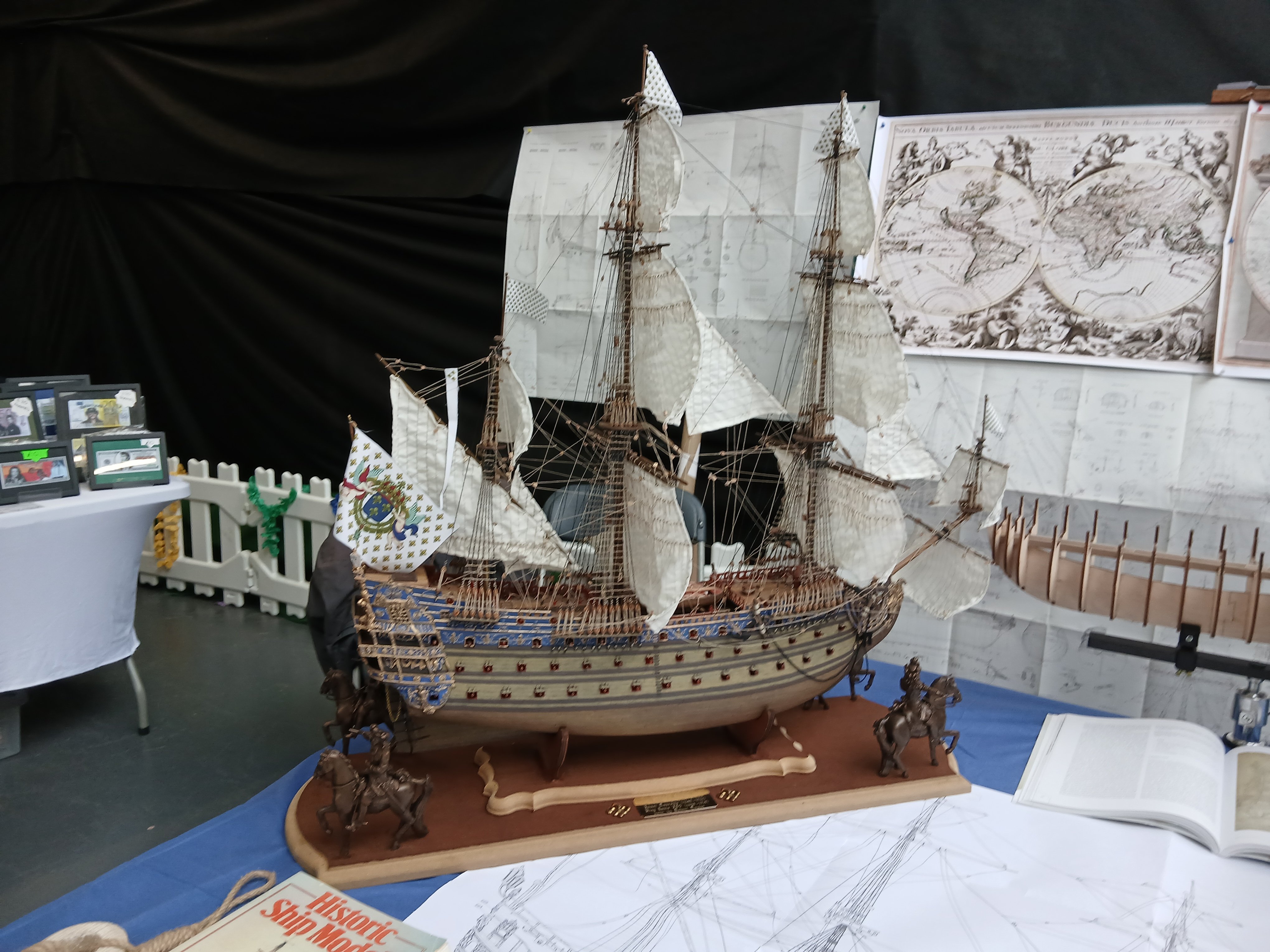

After 2 1/2 years some a lot of which I had to deal with heartbreaking circumstances my Soleil Royal is finally  finished. Originally the Heller kit but I heavily  improvised  her giving her wooden decks, masts, yards, Deadeyes, rigging blocks etc.. while adding a lot more deck detail rigging  up all 104 Cannons, 1,864 clove hitches, approx 500 reef points, 520 Cannon balls as well as Barrels and rope hanks not to mention  miles of Amati rigging thread in various  sizes.
Without  the personal circumstances I've had to endure she has been  a labour of Love.
I'm  not a craftsman by any manner of means and don't have any ambitions to be one either. I just build these ships for the Beauty and historical aspect that each one has.

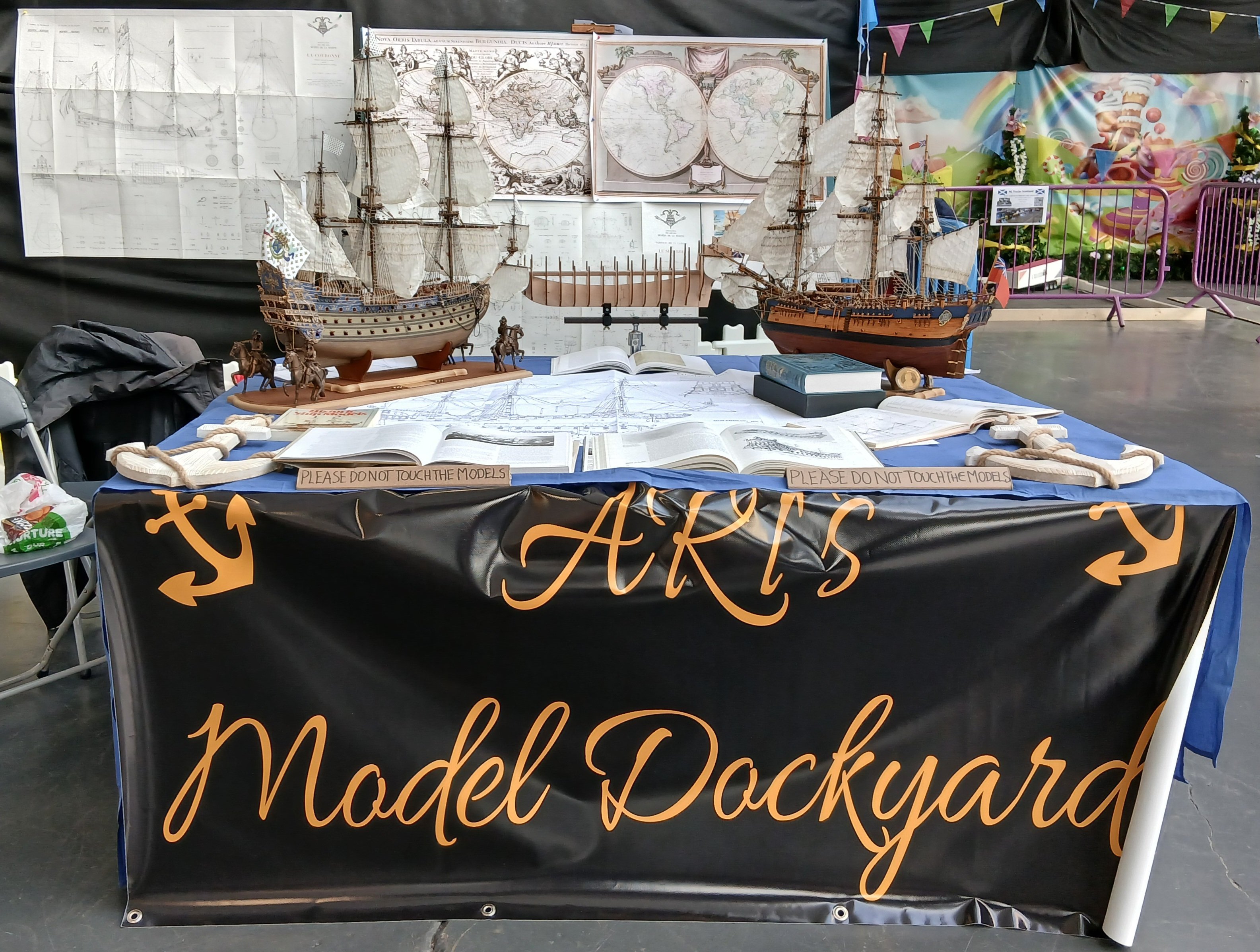

Some of the photos you will see were taken at a recent Model Show in Scotland i was asked to display at.
I hope you like it as much as I enjoyed building her.
