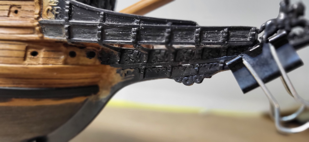

In case anyone was curious about how this mess will be attached, here's a few pics of the assembled one-piece unit, the glue points will be at the base of the simulated keel/stem, along the leading edge of the deck and the rear bulkhead piece where it mates against the inside of the hull, in theory it should work. Thanks for looking.

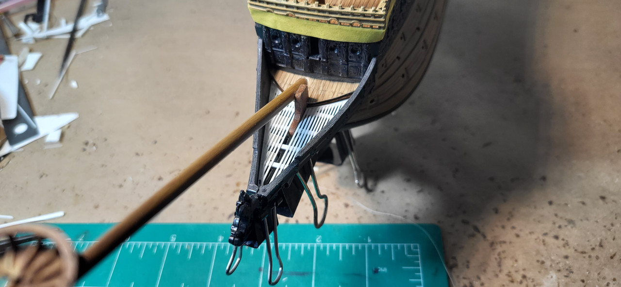

The exercise the last couple of days has been fabricating the grating for the beakhead, this took a few tries but I'm satisfied with the result, the slats are made with .015"x.020" styrene, I also angled the bowsprit to the centerline and made the cut outs for the gammoning in the trailboard.

Oh no WAY! For reference, i have those exact same clips and use them on models, and they are about 3/4 inch in length. Now, compare that to the deadeyes he is using.
My question then becomes how do you make deadeyes so small, much less rig them? What sort of magnification do you use?
