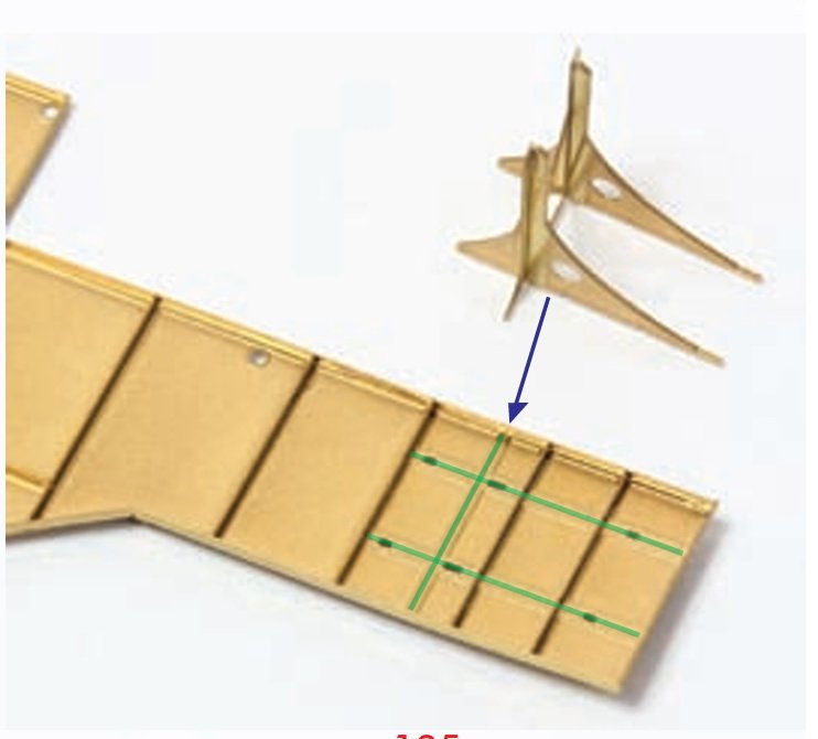

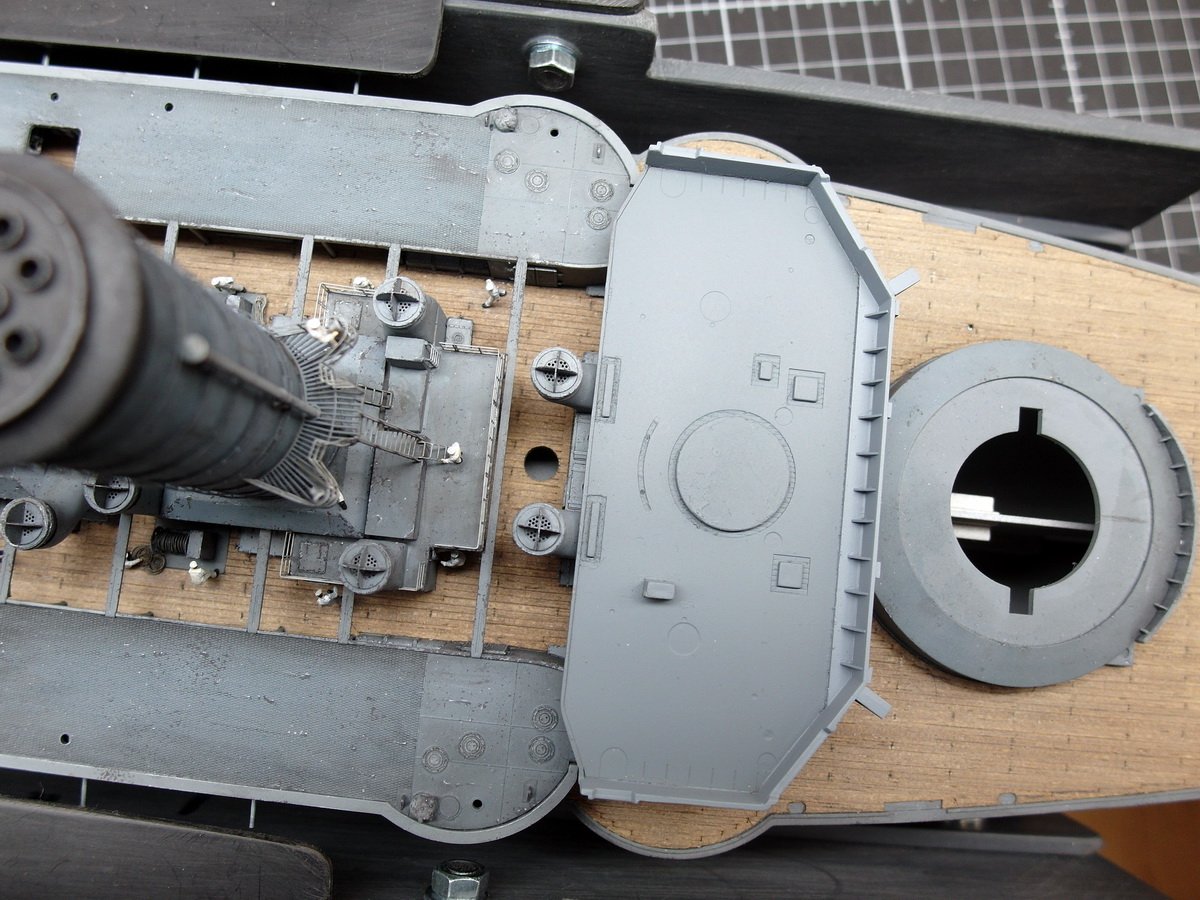

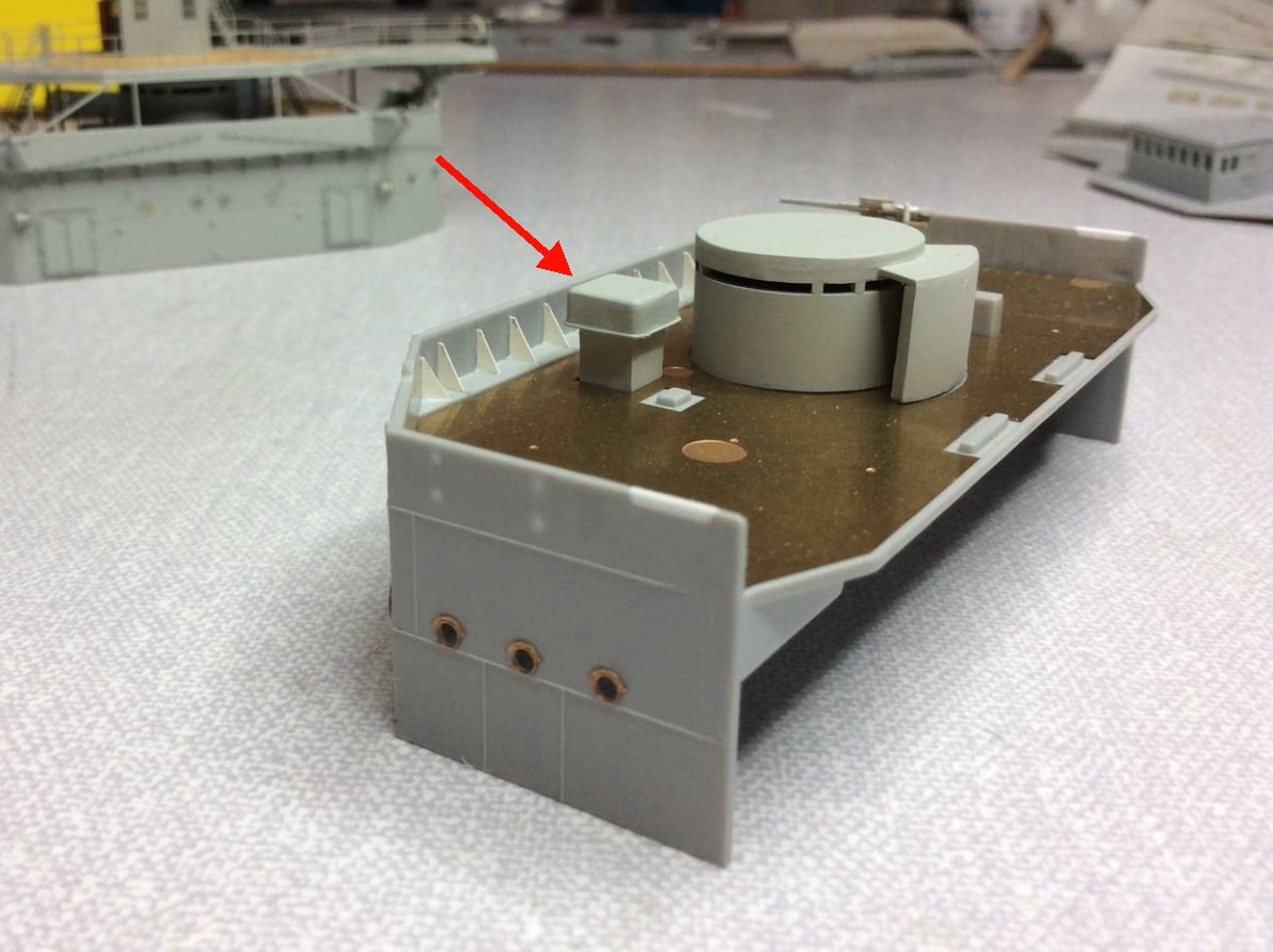

Let’s move on to the support structures that connect the boat deck and the internal superstructure.
I soldered these to ensure maximum strength for these delicate T-beams.
After testing it, everything seems to be fine.
Only this connection needs to be slightly adjusted. It’s only provided by Pontos; it’s simply missing from the original kit, and it would create a large gap. Therefore, there’s no offset for it in the model, and the length of the component needs to be exactly right to ensure proper attachment.

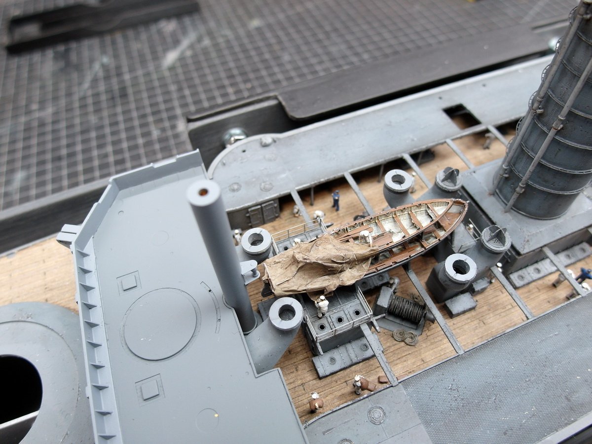

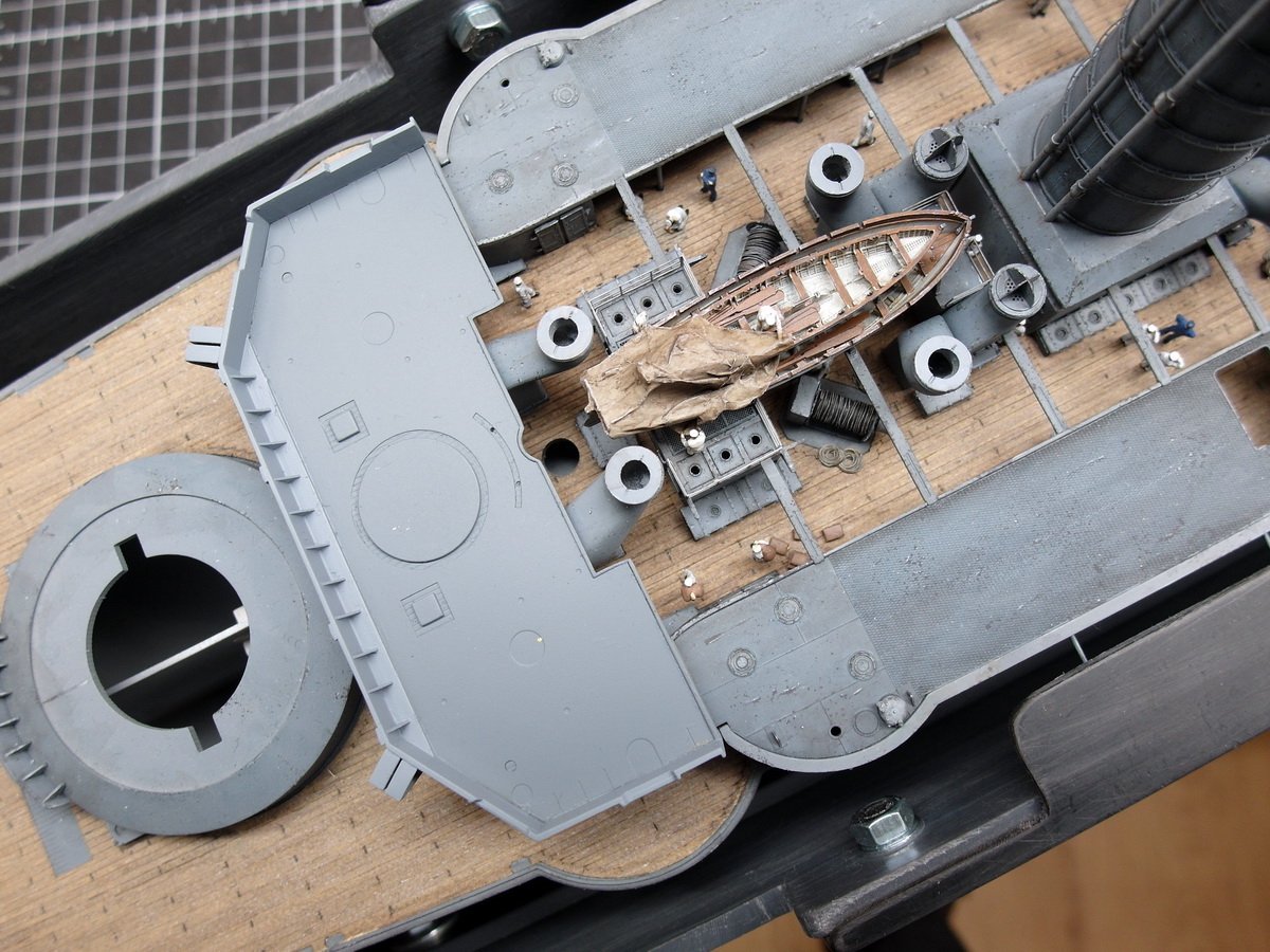

Hello everyone.
The EME is behind me and the falcon is back in its home. Time to get back to work on my boat.
To warm up, I turned my attention to the two dinghies.
It was clear that I didn’t want to cover them completely. So I designed a little scene to get around that.
I made a tarpaulin out of tissue paper and diluted wood glue. It took me a few tries.
Then guys made to cover the boat.
Add the railing and rudder blades.
Nice extra income, I don’t have to tie down the cutter anymore.
And the first railing was also installed.
A few spots are still shiny, so I need to apply another coat of clear coat.
I’m pretty happy with the way it is, and now I can move on to the funnels.
Greetings from Germany, Joelle.
modellmarine

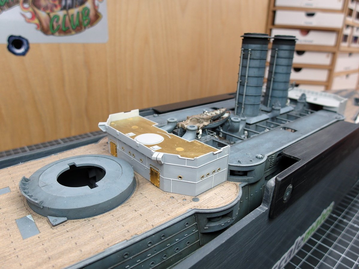

Let’s get to another mini-update today.
It cost me a lot of nerves and the whole weekend. But first things first.
I was once again spoiled for choice between Pontos and KA for the funnel surface.
Pontos offers riveted struts, KA rings that run around the funnel.
So, I once again rummaged through my archives of the original ship and looked at conflicting pictures. Of course, often of rather poor quality.
The deciding factor was once again the quite good picture from Vladivostok, which I believe shows rings.
And since it’s one of the last photos of the intact ship, I chose that one. I like it better anyway.

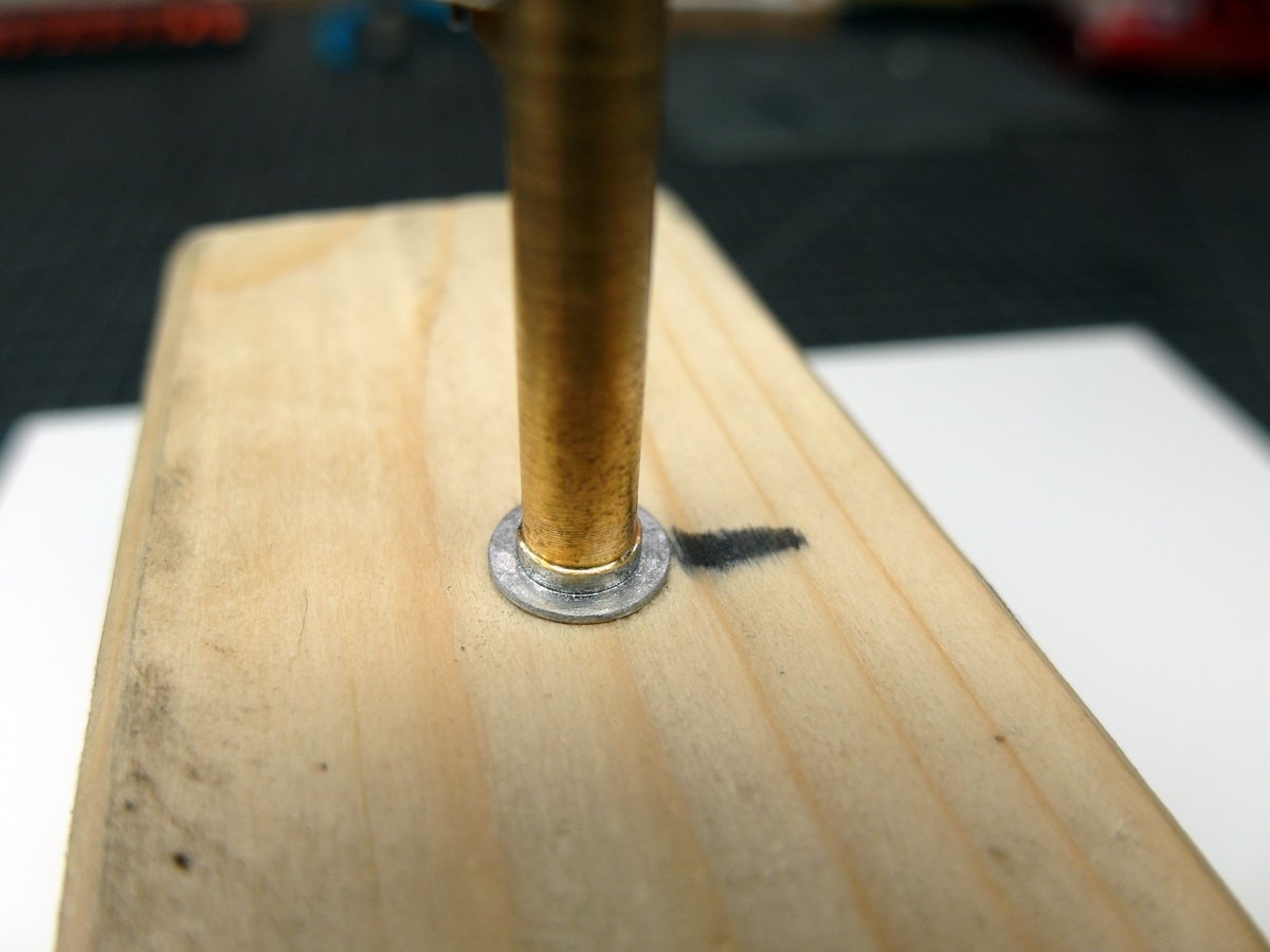

So first I cut the components out of the circuit boards.
And again, KA Model wins.
My enthusiasm was dampened slightly when attaching the rings. They were a little too big. That’s why they were touching on one side, leaving an unsightly gap on the other.
I took them off again, sanded them cleanly, and then primed them thoroughly. Another attempt with the blue BluTack putty. This allowed me to keep the rings centered.
It works. And since I’m using Mig’s acrylic adhesive, there’s no mess like with superglue. Diluted and applied with a fine brush, it flows wonderfully evenly into the gap thanks to capillary action.
Excess glue can then be easily removed with a brush.
Ring by ring it continues downwards.
It’s nice that I managed to solve it cleanly after all, since the funnels are in a rather prominent spot. So I set them up for a test. They look great with the rings.

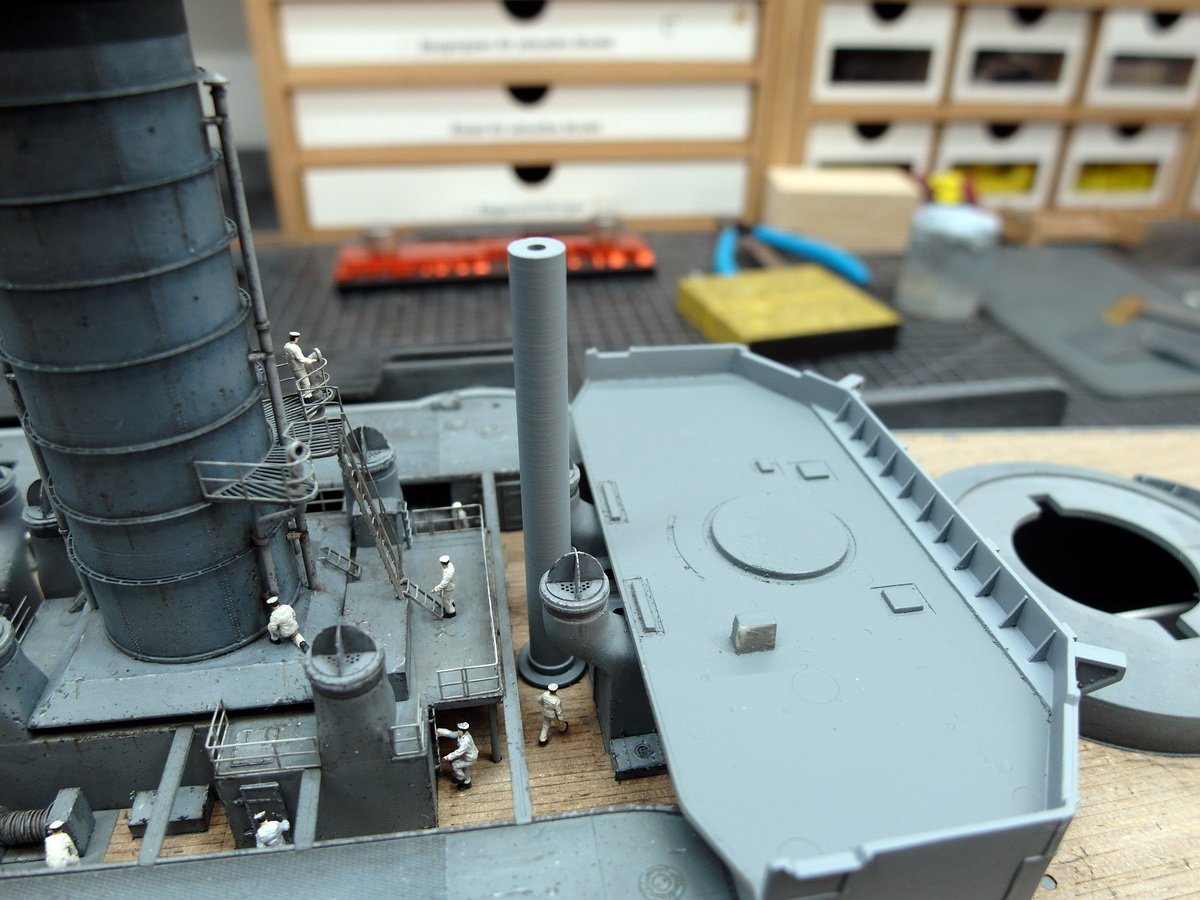

I'm saving the caps on the funnels until last. I don't want to bend them before then. I'll let you know if they've driven me crazy, too. 😅

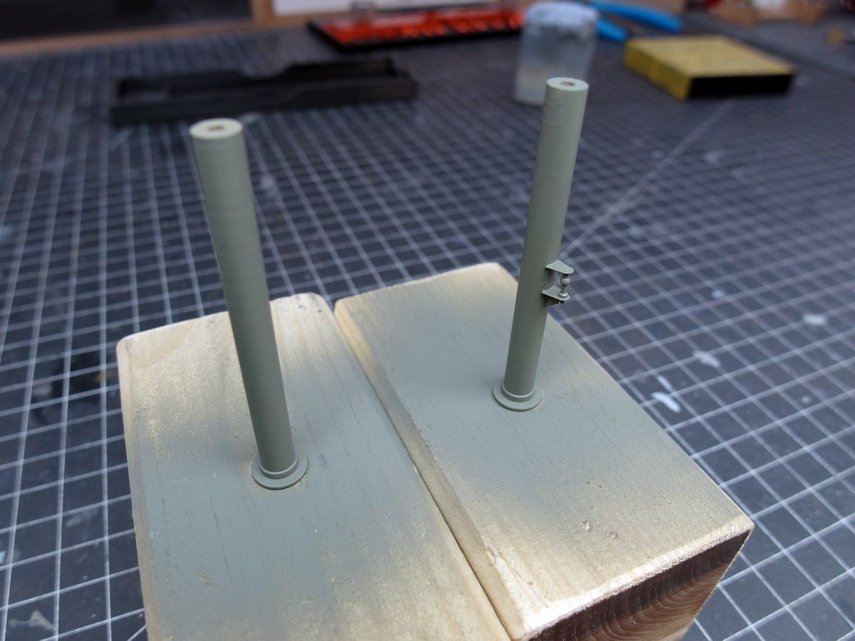

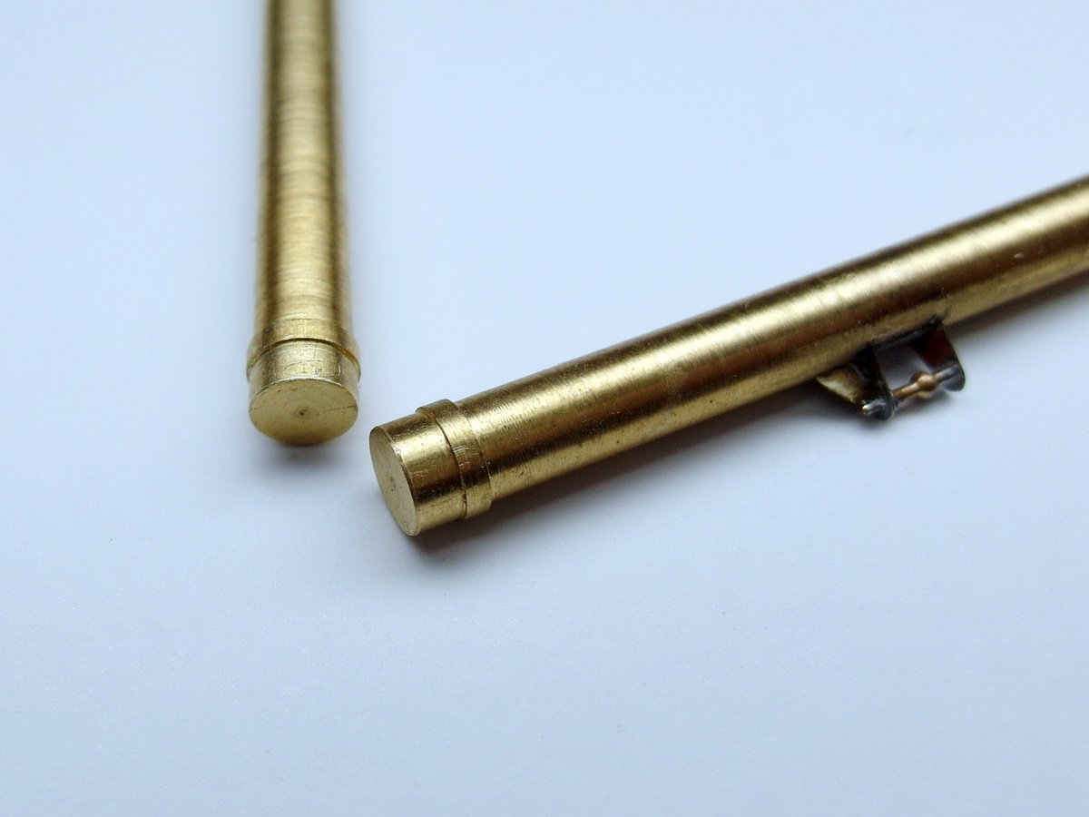

Let’s continue with the funnel.
I had to remove all the structures from the chimneys, otherwise I wouldn’t have been able to fit the rings onto the cylinders. Now they’re installed, and I’ve recreated them with styrene profiles. Like this ledge at the bottom of the funnel.
I got resin rivets on decal sheets from Eduard to make the surface more interesting.
The same thing in a vertical orientation. I had to do a little trickery here to get them nice and straight and parallel. I applied them, let them dry, and then cut them with my sharp scalpel.
Fits.
It looks good after the initial aging. It’s a bit annoying that I can still see traces of the rings’ original texture. I wasn’t paying attention.😒
But afterwards they hardly matter anymore.

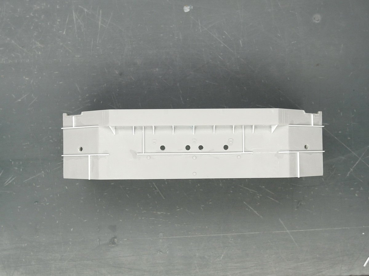

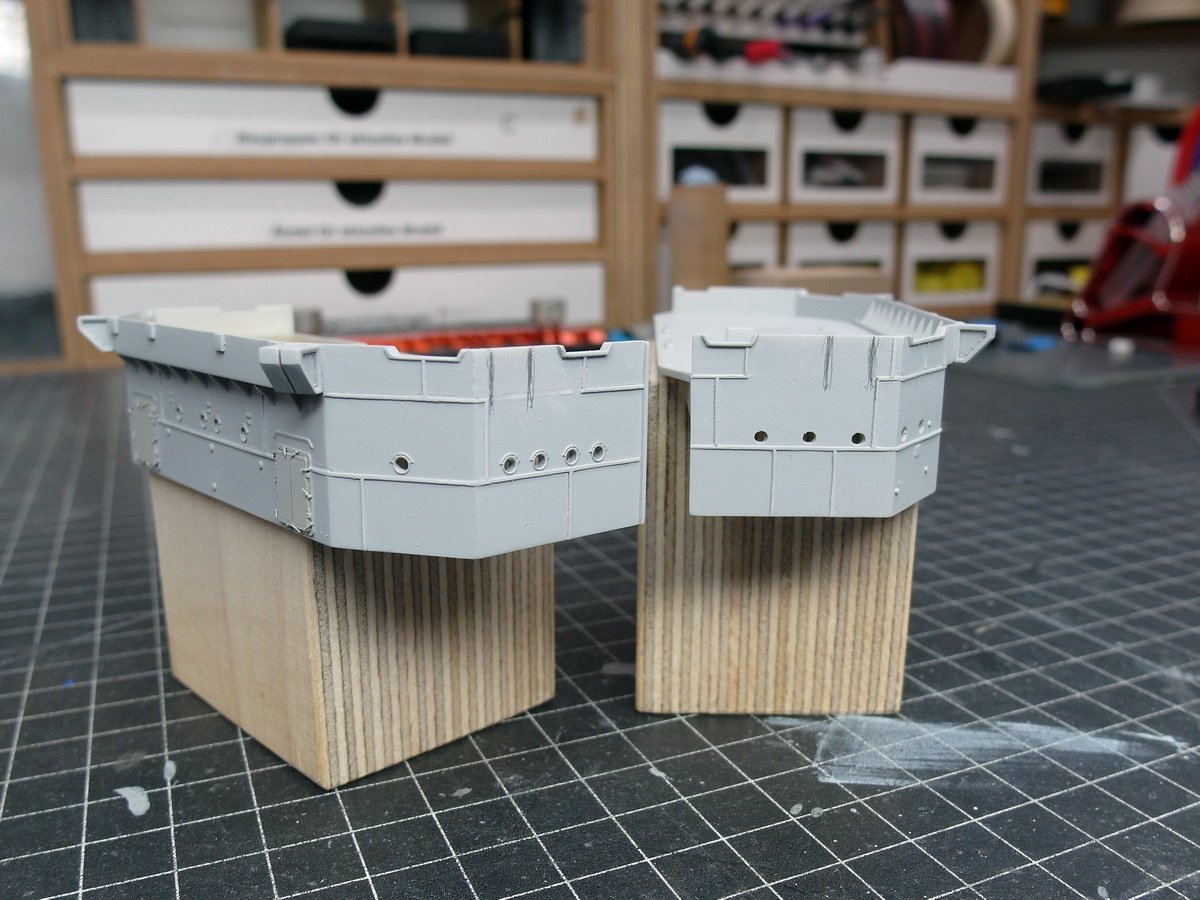

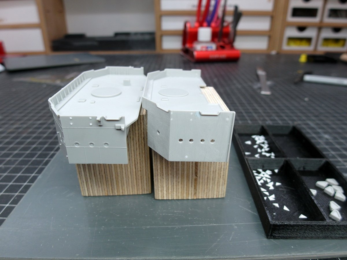

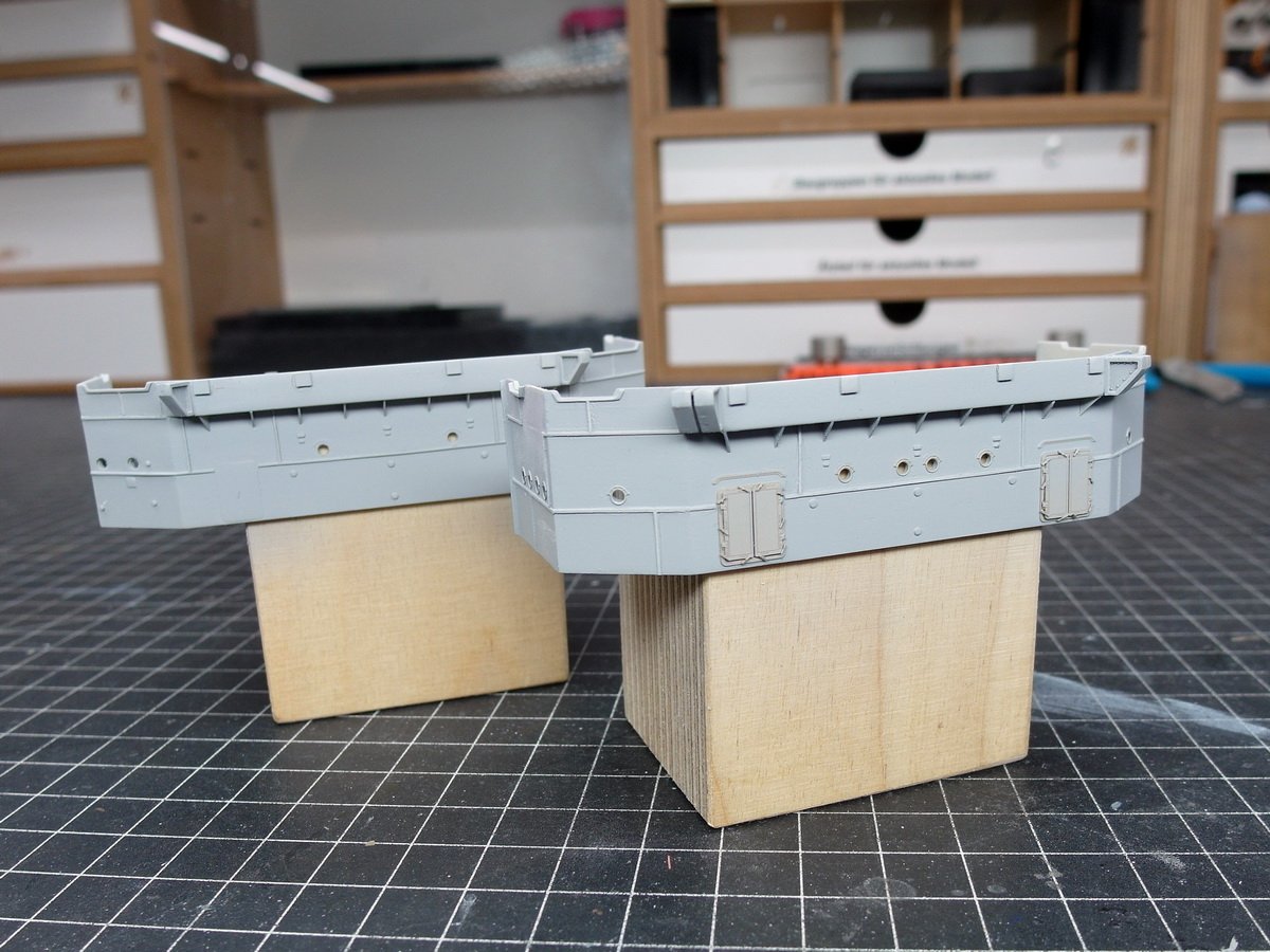

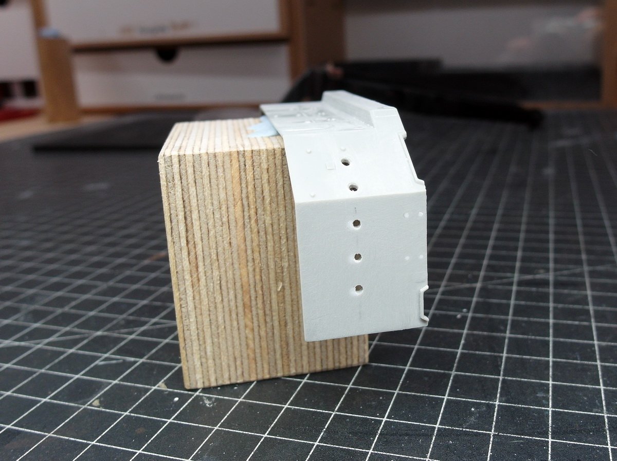

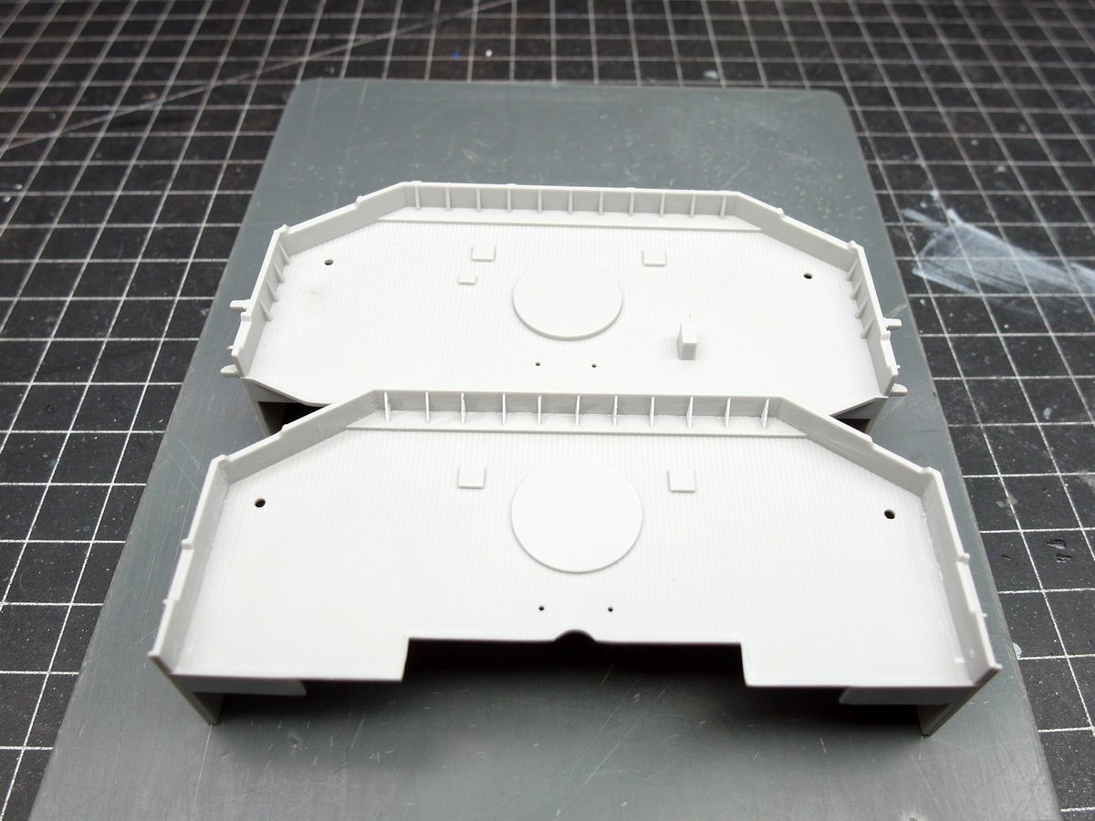

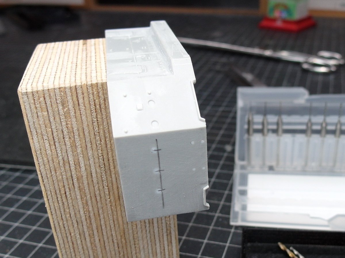

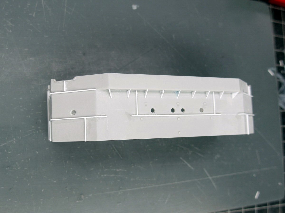

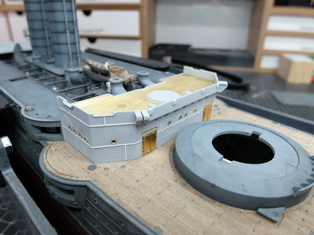

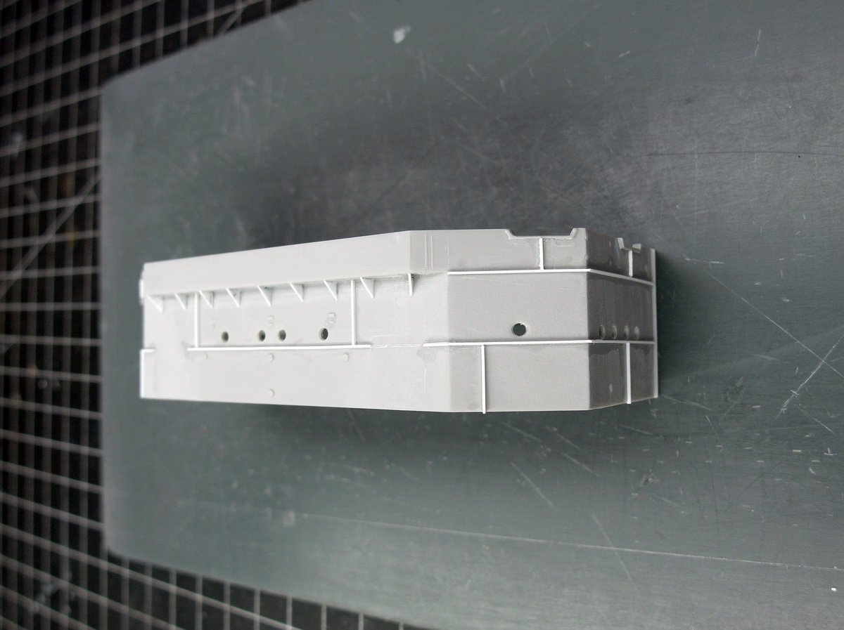

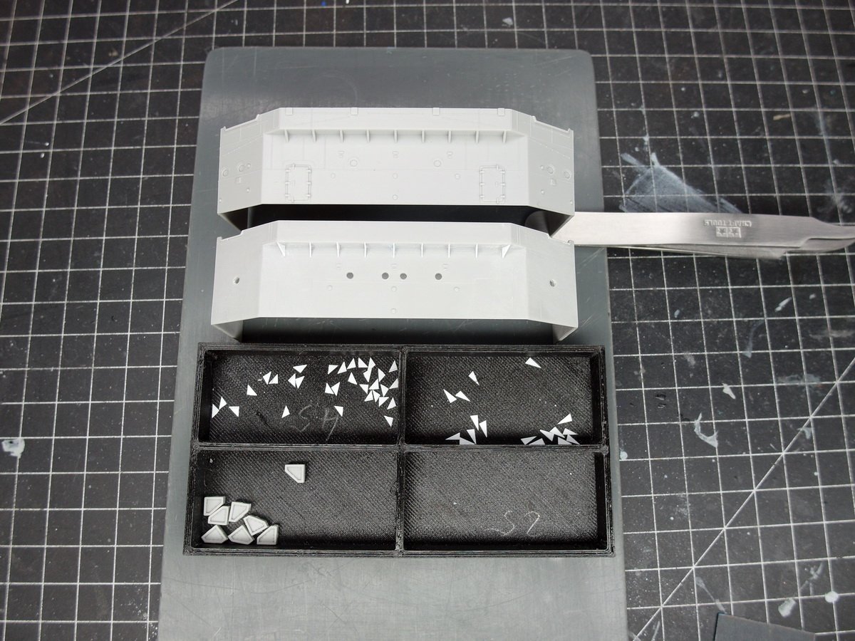

Once again, the details are sanded down, portholes drilled out, and holes filled in to replace and re-clad everything with beautiful brass.
First, the rear bridge house.
The gusset plates are too thick for me and will be replaced with 0.25 mm thick styrene.
And again on the deck.
Now the same with the bridge house on the bow side.
modellmarine

Watch out for the hatches on these bridge structures, don’t think they are what Pontos or kit parts supply, l think they are ventilation ducts, did my aft bridge as instructed only to change my mind when doing forward bridge. When you look at the ship today you notice these parts are much taller than deck hatches 👍
@Jeff59

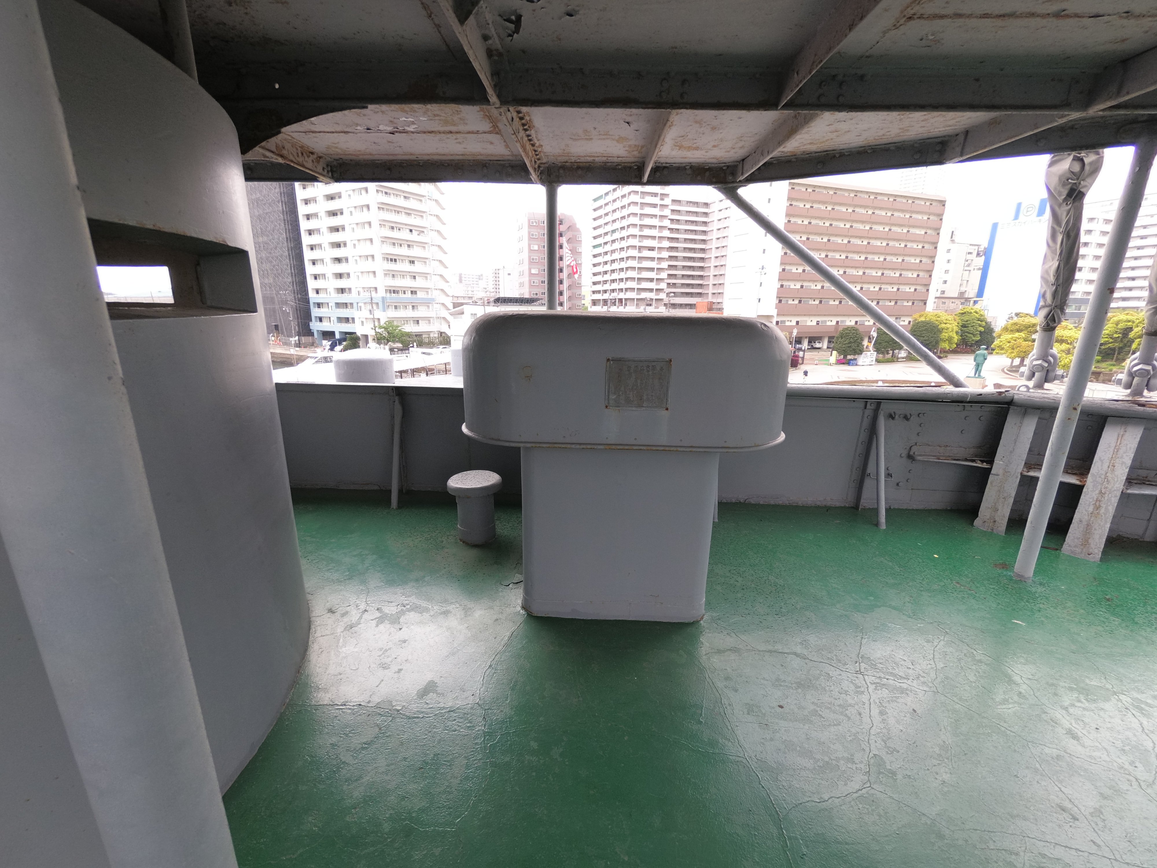

Good morning, Jeff.
I'm not sure which hatch you're talking about, but I think you mean this one....
You raised it higher and left out the handwheel, as you can clearly see on the museum ship.

And now we continue with the application of the profiles.
I used the same ones on the bridge house as on the hull, only this time I glued them on the short side.
I thought they should look narrower on the smaller superstructures. That’s why they were sanded down quite a bit afterward.
But today is the end of it for now, the whole thing needs to dry properly overnight before I sand it.
Now I can repeat the whole thing at the front bridge house.
modellmarine
A first coat of primer to check the profile height. Then I sanded it down further and adjusted it.
Now I’m satisfied.
The rain deflectors for the portholes are neatly lined up, and the door looks great. Pontos, in fact.
The height of the portholes on the front bridgehouse is completely wrong; they are positioned much too low. So, they were filled with styrene round material and re-marked.
Drilled and better…

Hello together.
It’s fun to put your own stamp on a model that’s produced in large numbers. However, you should be aware that sometimes things won’t work out as you hoped. That’s what happened with the last construction phase.
Cost me a sleepless night, but first things first.
A new coat of primer was applied very thinly to check the profile height and build quality.
I quite liked it.
As I considered how to proceed with the bridgehouse, I encountered a problem. I have to say that building this ship is considerably more challenging than, for example, the Bismarck, with its rather simple, straightforward superstructure.
Everything on this old ship of the line is so delicate and intricate that you really have to think carefully about the order in which you assemble the model. The mast is another thing I’m racking my brains over, but that will come later.
Now back to the bridgehouse and the culprit that made my life difficult.
This one:
This is the external connection from the bridge house to the deck above. The supporting structure is once again extremely detailed by Pontos and simply beautiful to behold.
The problem is that this outer bracket on the bridge house extends very low and could conflict with my profiles. So, to be on the safe side, I removed parts of it and rearranged them.
Believe me, that really bothered me. But I think I solved it quite well. Less is sometimes more.
It was a bit frustrating to remove the profiles at this point, but I wanted to play it safe. With such delicate structures, I felt it would be too risky to just keep going, only to find out at the end that it wouldn’t fit together.

Which brings us to the masts. I've thought long and hard about the best way to approach this.
I've decided to first attach only the lowest part of the masts to the deck. I'm also concerned about the weak attachment of the masts; the adhesive surface is tiny. I'm therefore going to increase the contact surface by soldering a small perforated disc to the bottom of the brass masts. This will increase the adhesive surface and simplify alignment at right angles. We'll get to that in the next construction phase.
Probably this weekend.
Then let's see if I can get out of this tricky situation, as you describe, without any injuries, Jeff. 😉

Okay, let’s move on to the masts and pause for a moment with the bridge houses.
I noticed the really tight space in which the masts have to be installed.
Once the ladders leading from the bridge house to the deck are installed, there’s hardly any room left to properly secure and align the masts.
There’s even less space toward the stern.
That’s why I decided to attach the lower part of the masts in front of the bridgehouses. It’s nice that the lower mast is then split in two, so it won’t be a problem in terms of height.
I also noticed the very limited surface area where the mast connects to the deck. I consider this a problem. Especially since I’d like to take this model to one or two exhibitions. A little more adhesive surface would be helpful.
So I decided to make it larger. This was done using an M4 washer. I drilled it out to the appropriate size and reduced its thickness. I then soldered it to the bottom of the mast.
Primed…
…and painted and placed in the holes on the deck for testing.
I quite like this so far. This should significantly increase the strength of the masts on deck and make aligning them at right angles easier.
