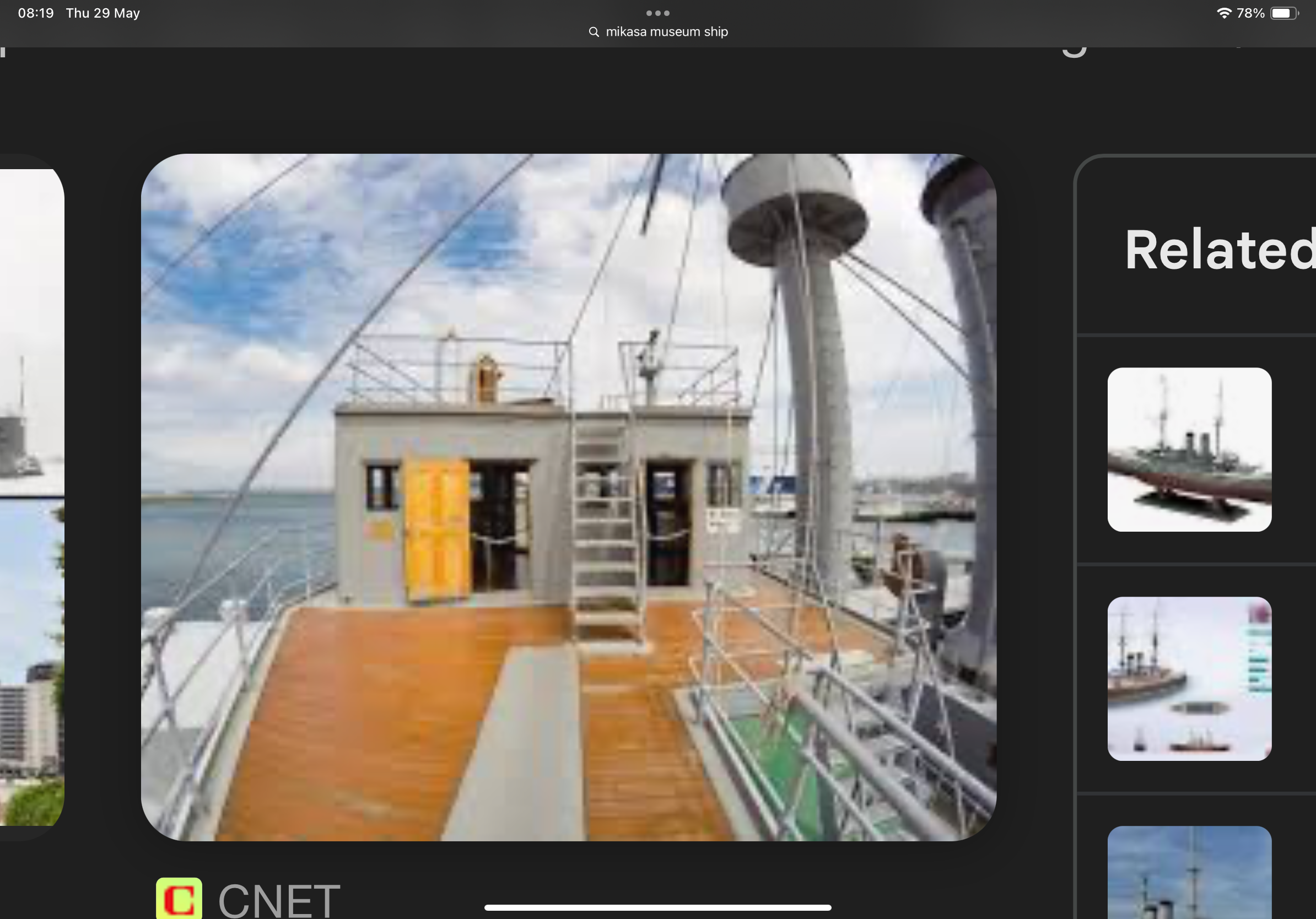

Good morning everyone. Another question for Jeff.
You left out the small handwheel on the square mushroom structures and changed the height. I also think it's a ventilation duct and not a hatch.
0660573A-EF50-4C05-AB28-B2D4B1290FAC.thumb.jpeg.1cc5a7512aed45f0d1cb9645d8a94f62(1).jpeg.b6a60606d7ecdd381340a7f16c1f2c5b.jpeg
You took the height of the ventilation duct from the picture of the museum ship. However, there it's also positioned a bit further forward.
CB2AE29F-D94B-4599-ABF0-CB70CAC78560.thumb.png.eab5b324956623f18b4d926dc60c8017.png.3d07a5e85a484ff5cf53a3b9fdcacde8.png
And now to my thoughts. I found an original photo where the bridge houses are clearly visible and brightened it up a bit. However, I can't see these structures at all in the photos. Whereas the wheelhouse is quite clearly visible.
Could it be that the height of the ventilation ducts on the museum ship was only subsequently changed?
Otherwise they must be visible from the front view of the bridge house, like here, again on the museum ship.
And another question that occurs to me, Jeff.
Where did you get the information that these cable drums were installed on the bridge houses?
53B05B19-B689-4EEE-972F-990A523346D1.thumb.jpeg.b3694f9614c5c0e94b44d8e0e761aaa2.jpeg.9a970e67caa8cec3efbf872674c57848.jpeg
I've carefully reviewed all my photos of the original ship, but I can't find her on any of them. 🤔

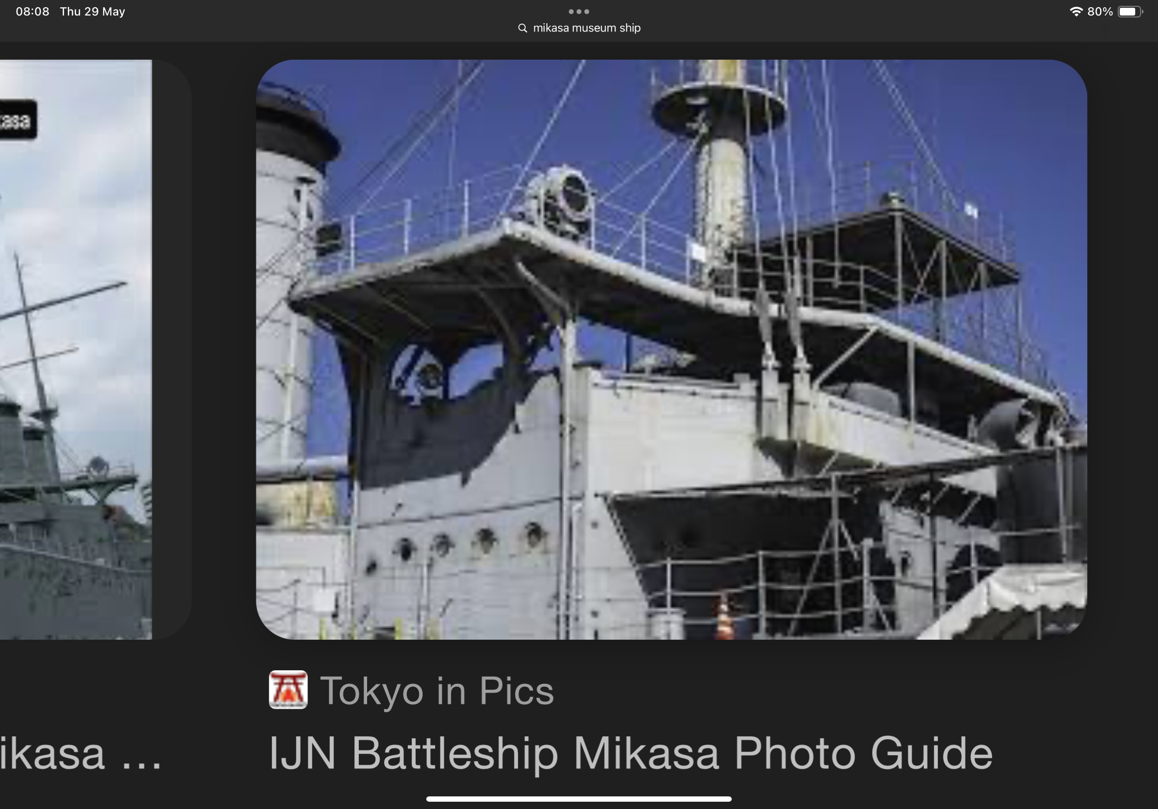

Hi Jeff, it's me again.
I discovered something else interesting about the pretty good and well-known picture of the Mikasa at the Vickers shipyard shortly before its completion.
I enlarged the bridgehouse and discovered the gratings of the accommodation ladder. See green arrows.
Since I want to show the ship at full speed, I need them stowed. What I can't find, however, are the drainpipes you added. Is it possible that these were also added to the museum ship later?
To prevent tourists from slipping when its rain? 😁

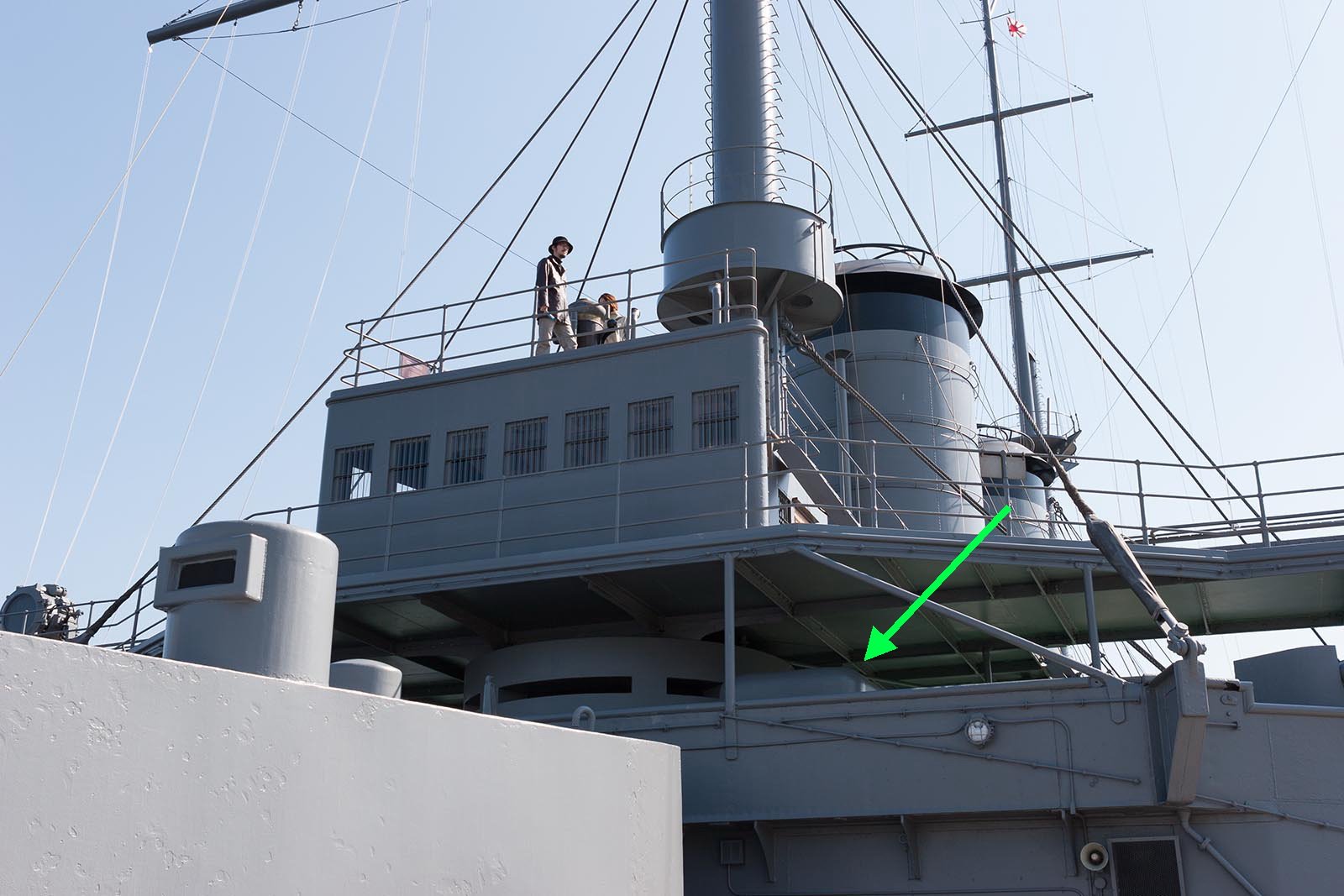

Now that the lower part of the masts is firmly anchored to the deck, I can turn my attention back to the bridgehouses. First, I soldered more attachment points for the rigging. It simply holds best.
As mentioned in the previous post, I noticed two dark squares. I believe these can only be the gratings of the  accommodation ladder. Since I'll be showing my ship at full speed, as usual, they'll have to be stowed there as well on this model. But that won't happen until after I've attached the bridgehouses to the deck.
What I'm already doing is attaching the corresponding davits. I've identified them in the following pictures. Rear bridgehouse....
And the implementation by me.
And at the front. Strangely, my image editing program didn’t allow a green arrow. So a white arrow points to the davit.
Note that the davits point to the right and left.

Hi Jolle, been a little while since l last looked at this, busy working on my shed come workshop, l did say summer weather slows up modelling a tad, mines has stopped for weeks now 😂 you’re models looking brilliant, no surprises there 🤛 that last photo you put up of Mikasas Bridge is the after Bridge, you can tell by the position of mast into the deck on Bridge structure, this also shows that the ventilation trunking was here as well, definitely closer to the edge. l didn’t move this cause the etch deck was already notched out to suit kit. There’s also a round ventilation duct just behind this ? But lm afraid it’s extremely difficult to define at what period this is relevant to, it’s just a minefield trying to decide on the right direction 👀 The cable drums on Bridge structure beside the doors just picked from some coloured cad drawings of ship in her early days found on Museum website when browsing, shall see if l can find them and post them 🤛 oh and watch out for Bridge wing clashing against the after mast, think l ended up notching a little bit out of mast to get it sitting vertical. It’s only when building this model you realise how hard it is to do without solid evidence, very difficult trying to do the early 1902 version, photos at Vickers the only source, even the Bridge wing is slightly different when you look at the supports at the edge of Bridge wing. Have to say your doing a great job with d difficult task. Shall get back to you on those images, away back to my shed just now. 🤛
Had a Quick Look at lots of images on Mikasa Meuseum web site Jolle, you can spend many hours browsing , l know l did , always scanning the images looking for details. The drain pipes you mentioned, have found some older photos of ship that show them there, and one showing Bridge spaced in middle of Bridge wing 👍as l have said before a dedicated book on Mikasa is sorely needed.
Hope this is off help to you Jolle, on that Bridge wing on after supper structure it’s the back of the Bridge wing and etch that clashed with my model, maybe it was just a mistake on my part, but worth checking. That photo you showed of Mikasa at Vickers might be the same one l used to correct the bracing on the flag staff, it’s definitely not symmetrical, you’ll see what l mean.  Glad to help 🤛

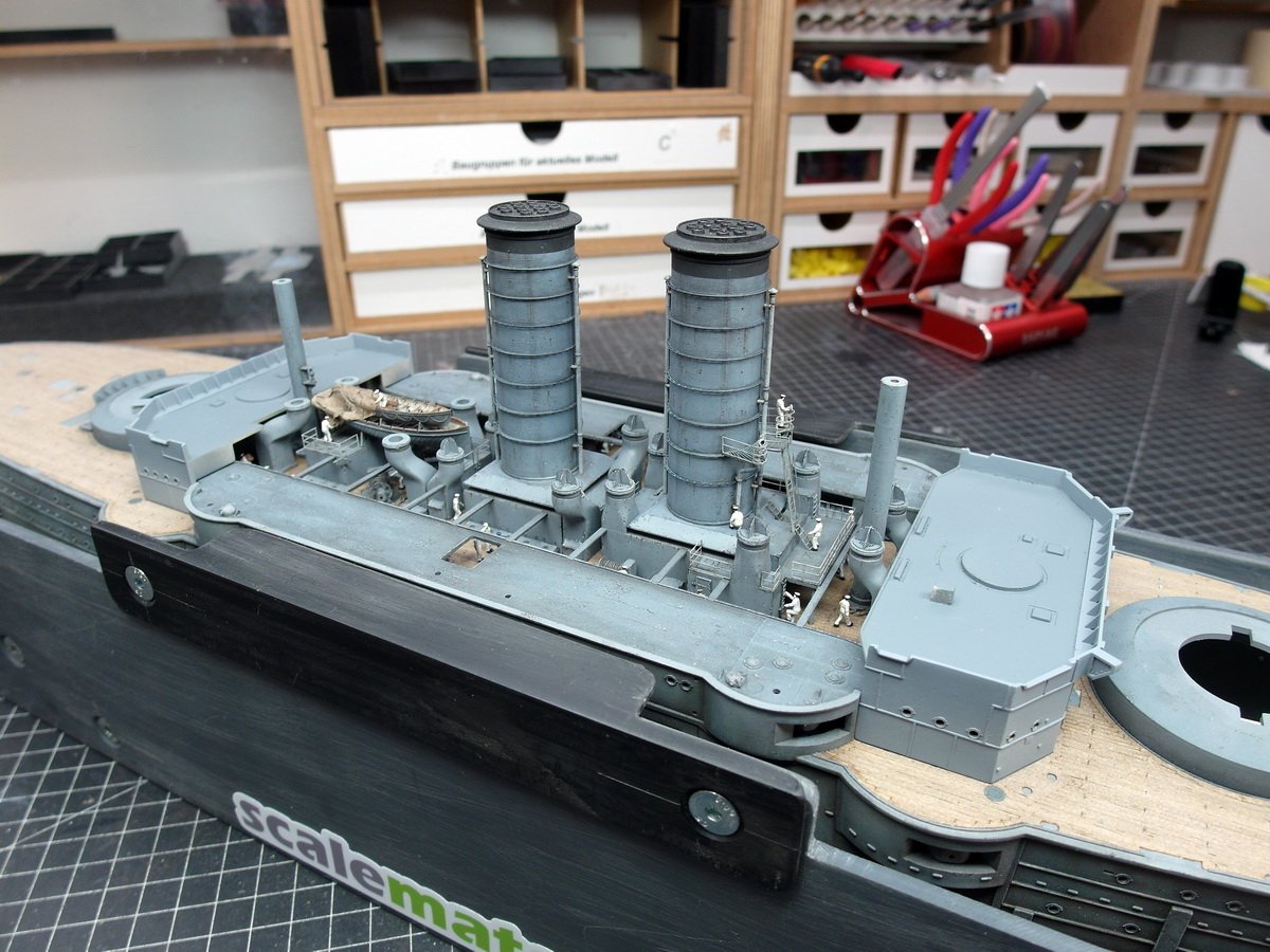

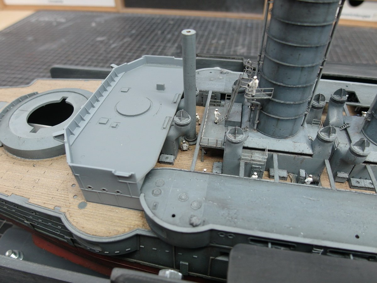

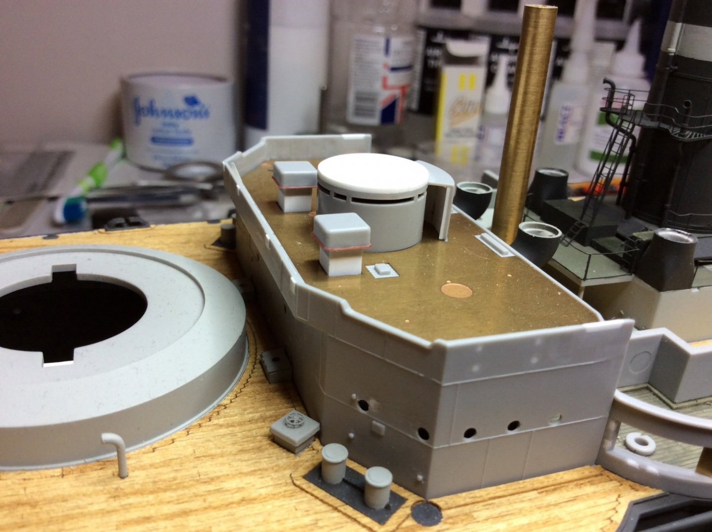

After a short break, I’m continuing.
The lower bridge houses are finished weathering and can be put on the deck for a test run.
Now I have to think about the most logical way to proceed.
I think the rear bridge house is not glued to the deck yet.
Because directly behind it the steam pinasses come onto their cradles.
It’s probably better to have a little more room for my fat fingers.
For the armored control center, I lined the entrance with a profile. It was clearly too thin.
And there isn’t much space in front of the bridge houses up to the tower.
So I’ve already fitted the lower parts of the tower into their barbettes and made them move freely. They were practically impossible to move.
And I’ve also prepared the lower ladders that belong on the mast.

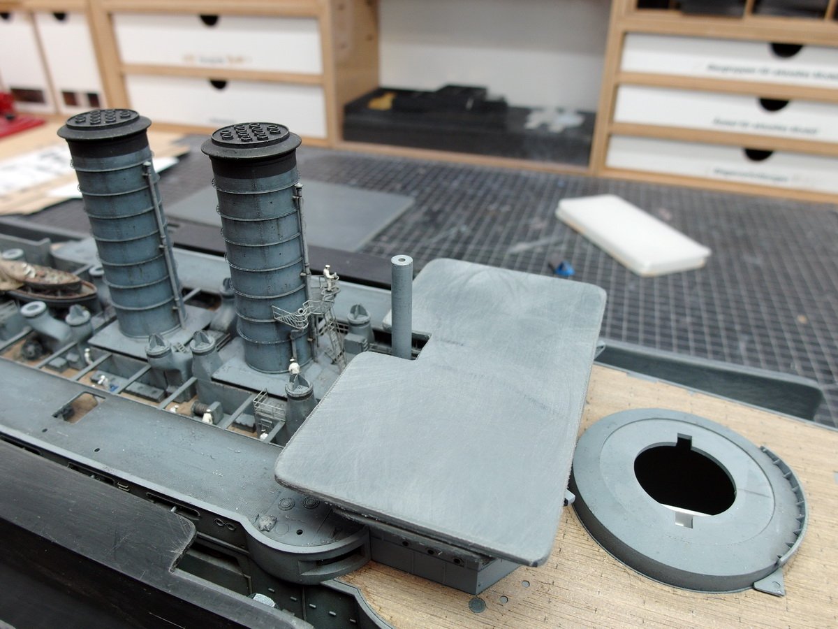

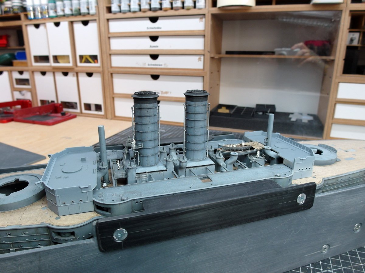

Just another small update that I had to do before moving further toward the bow.
I was still missing the bollards and other small items that would go directly in front of the bridge houses.
These are now also attached to the deck.
This had to be done so that I could install the companionways that lead to the main deck.
This means the inner area is almost complete.
And so the bridgehouse was glued in front of the steam pinnaces towards the stern. Otherwise, it would have been difficult to install the companionways behind the pinnaces.
Now I can start with the anchor area at the bow and have cut everything I need out of the boards.

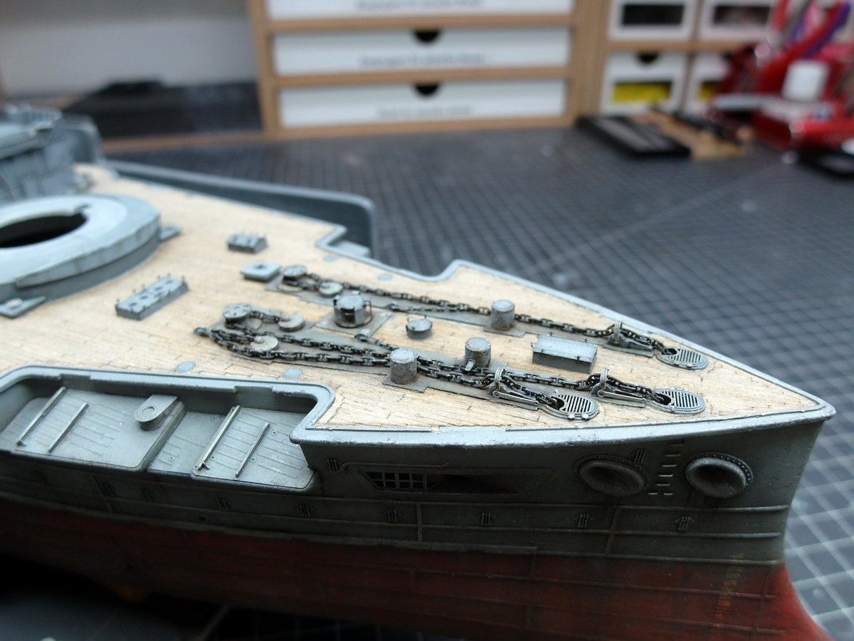

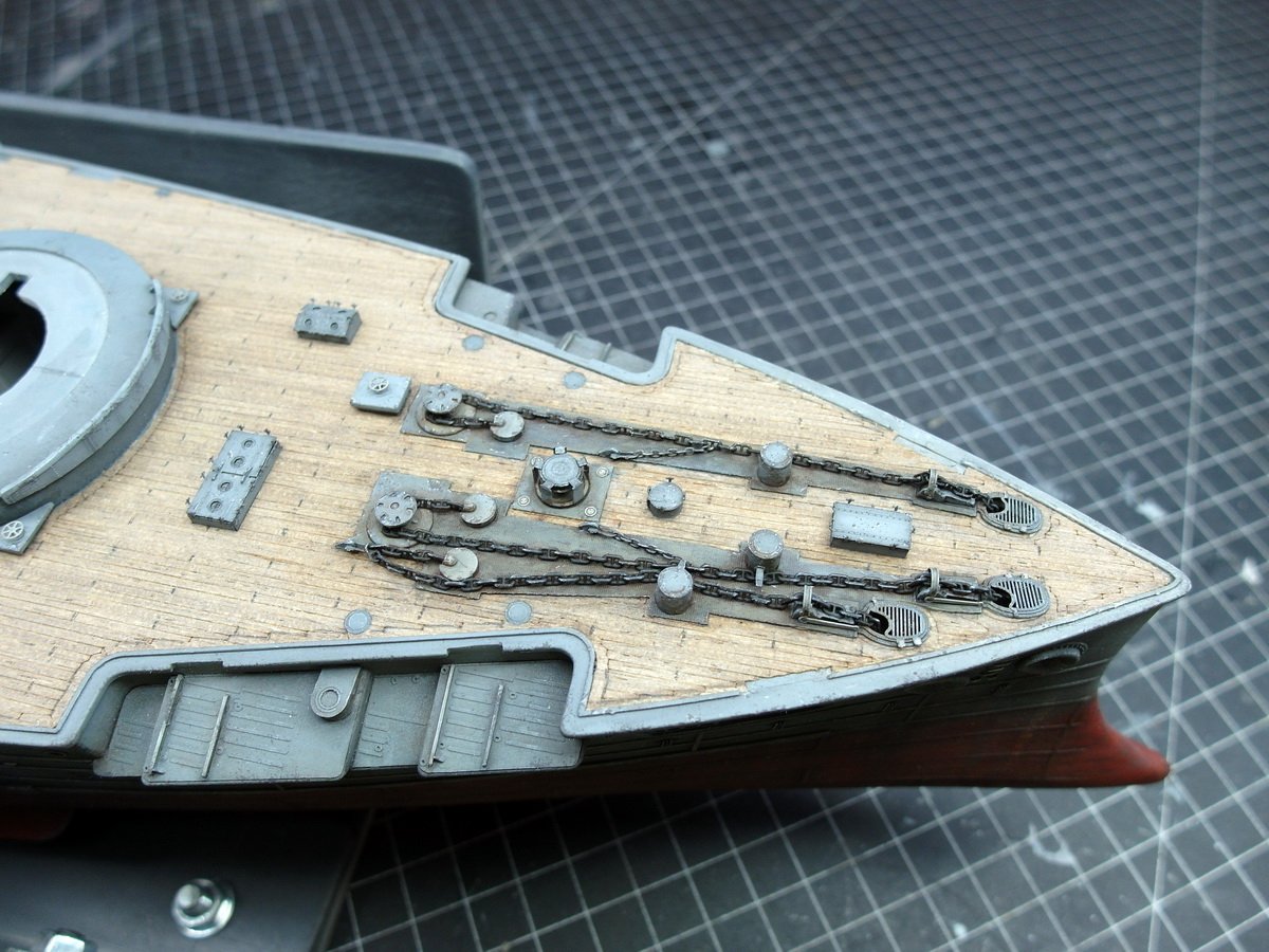

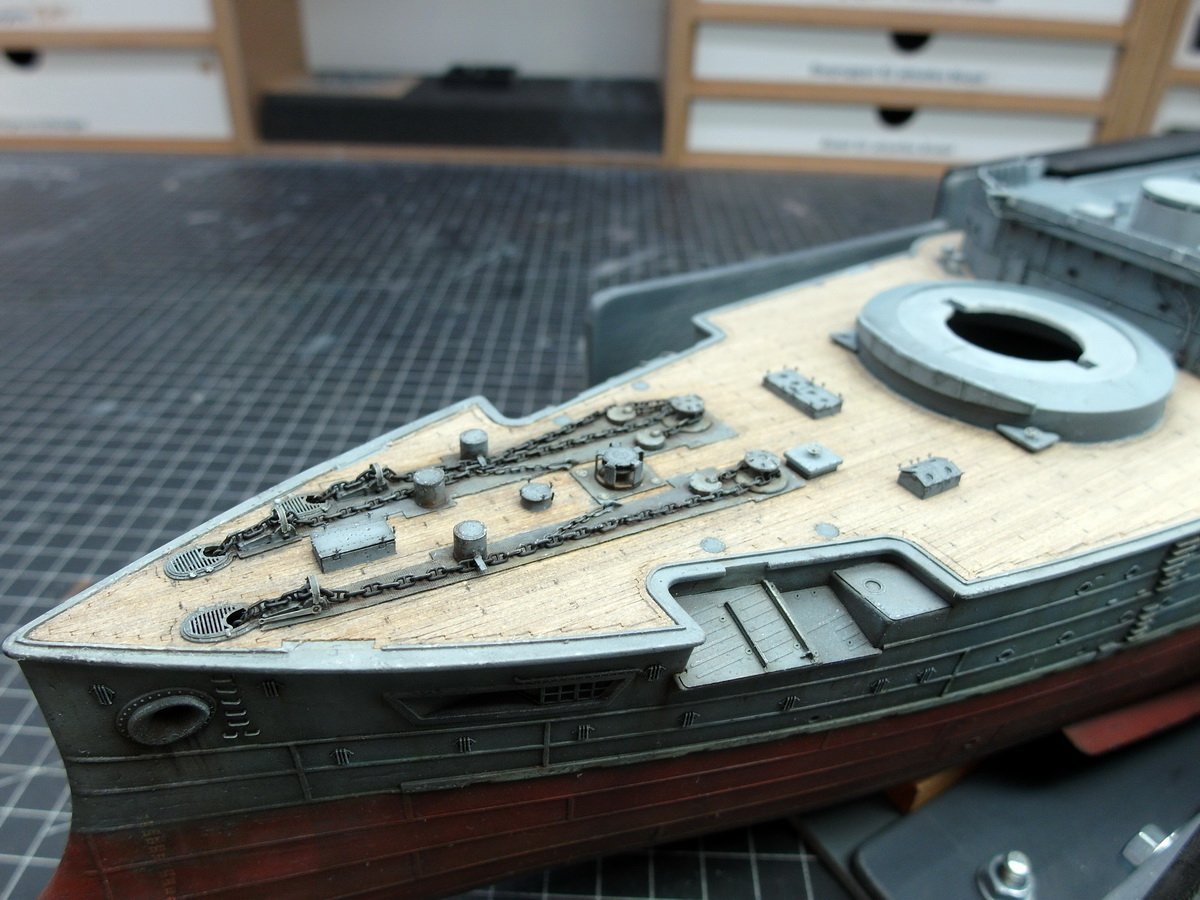

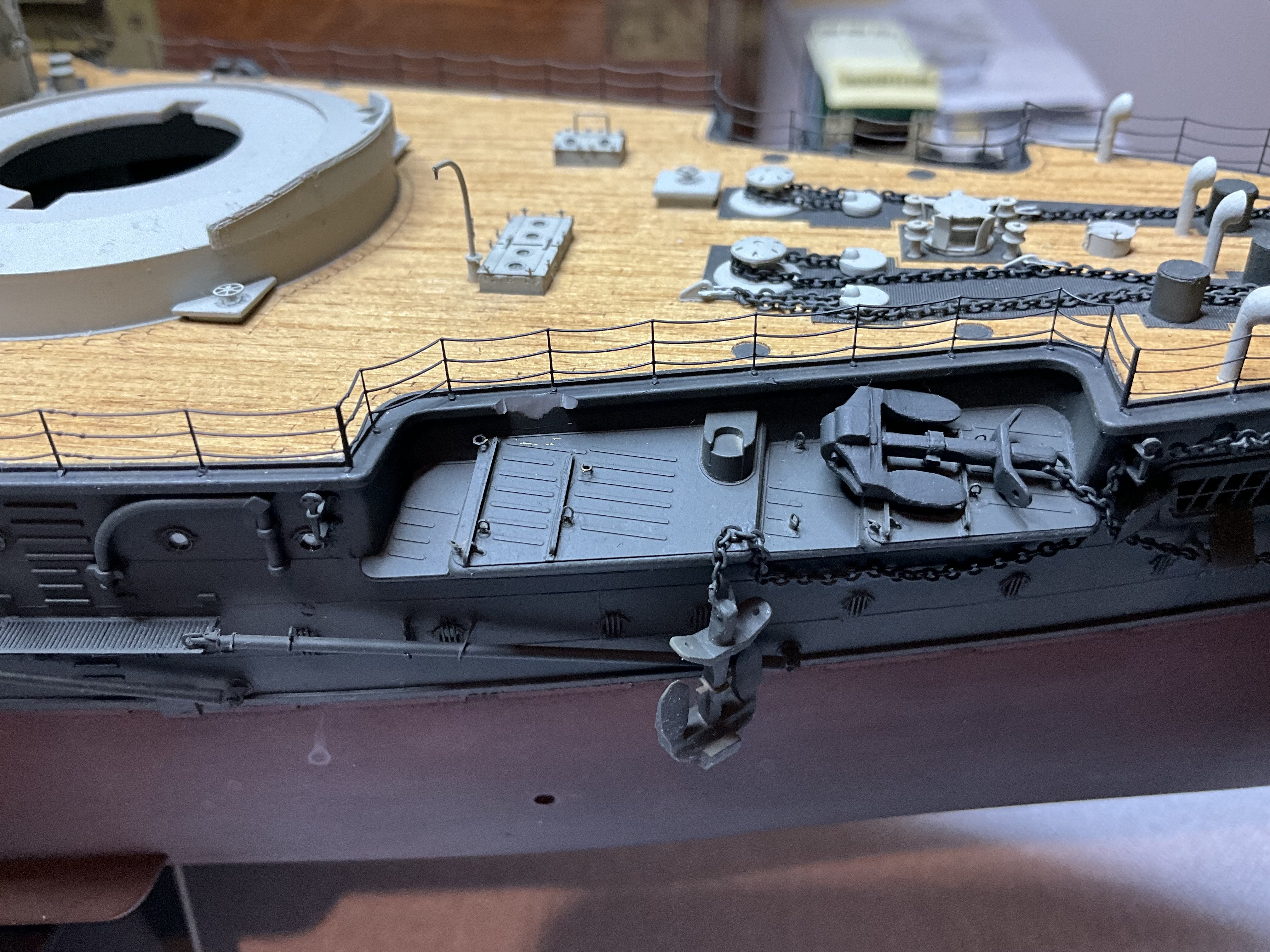

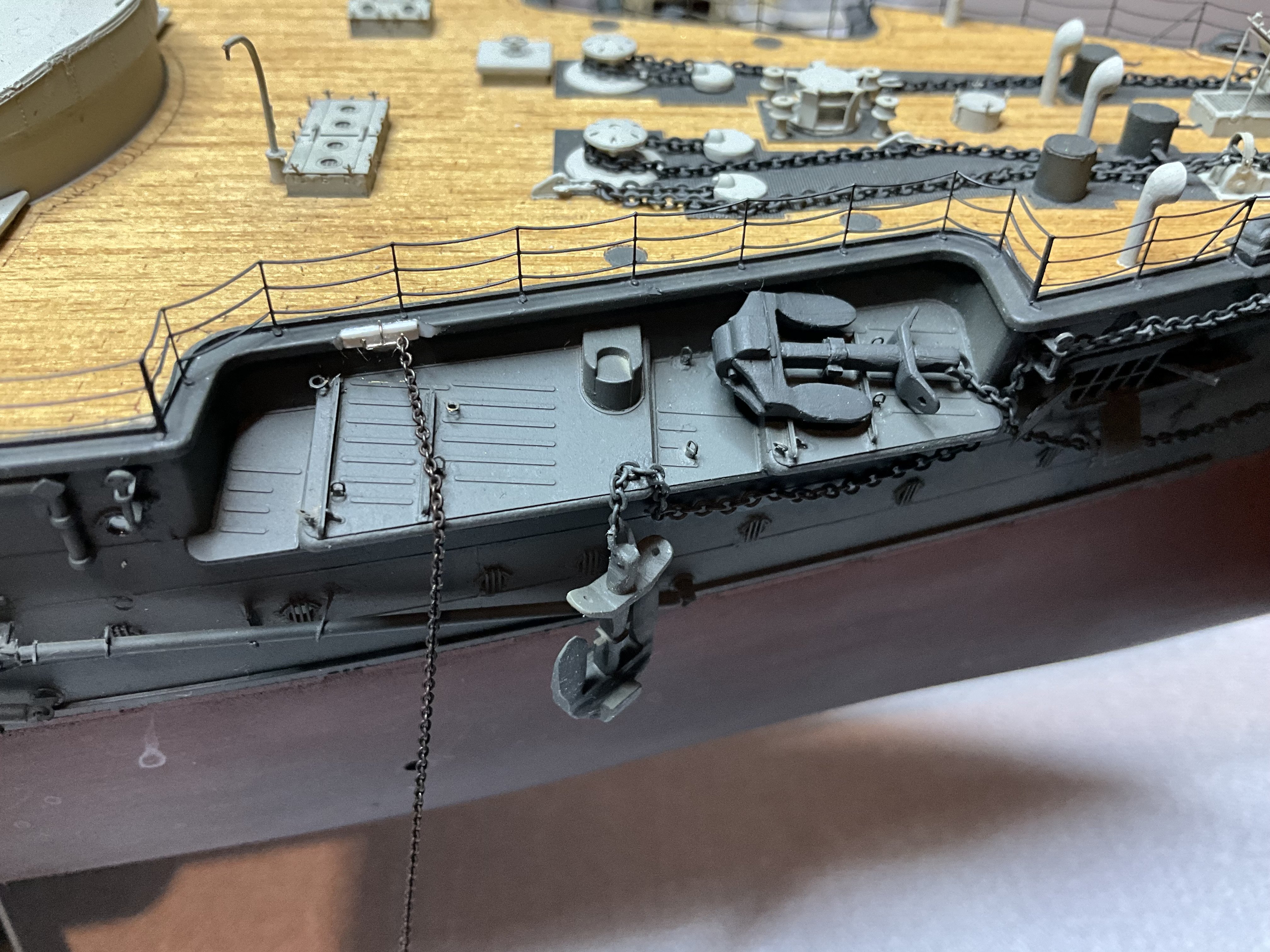

Today we’ll continue without much ado.
I had time over the long weekend to finish the anchor section.
That was fiddly.😵‍💫
In this area, the Pontos set was used exclusively. KA failed to score points here.
Of course, double-link chains had to be purchased again.
It’s disappointing that two very expensive aftermarket kits like KA and Pontos don’t consider it necessary to include proper chains. 👎

See that you came to the same conclusion as myself as how to run the spare anchor chain as there was no information to go on here , l just stared at it for ages before thinking this set up made sense 👍 on the kit supplied anchor chains totally agree, didn’t know you could purchase these chains. Cracking job Jolle 🤛 haven’t been on site for a few weeks, busy finishing of my work shed that l started before retirement since summer weather permits this, looking forward to getting back to my own build soon though. You are right, the forward area at this point on Mikasa is crammed with details, but enjoyable.
I completely agree with you, Jeff.
This model is turning out to be a mysterious adventure. But with a high level of entertainment value.
Yes, the anchor chains really look great. If you need them, I'd be happy to send you the link to where I got them. I also installed them on my Bismarck.

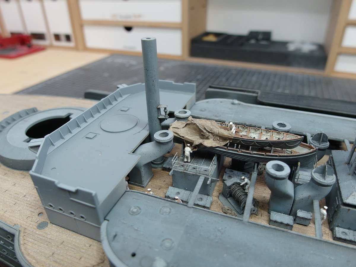

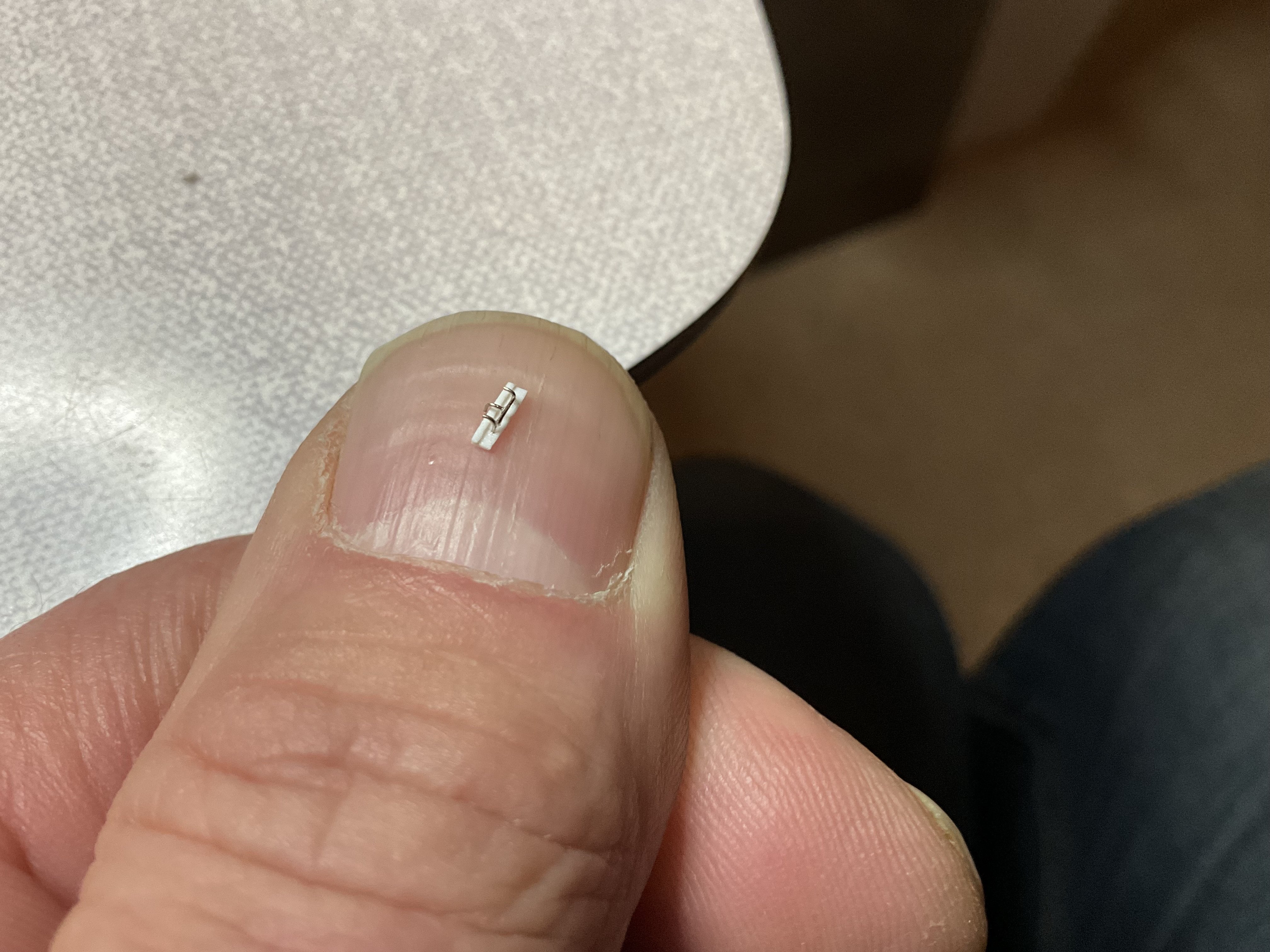

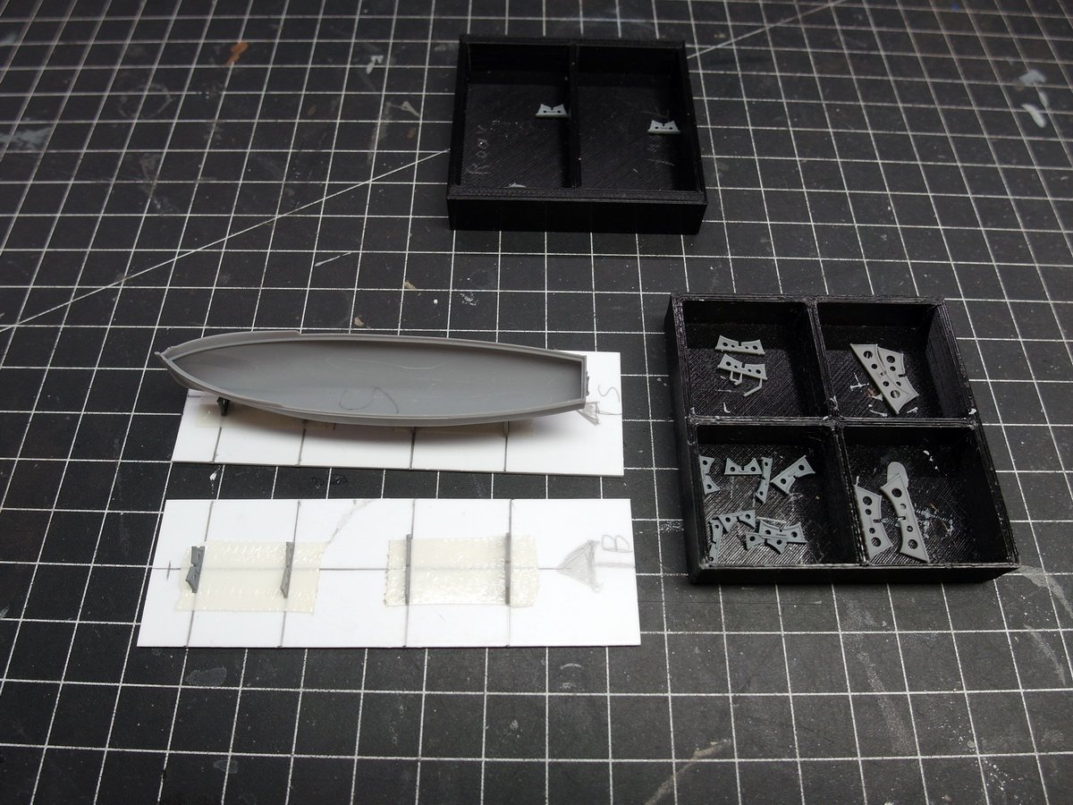

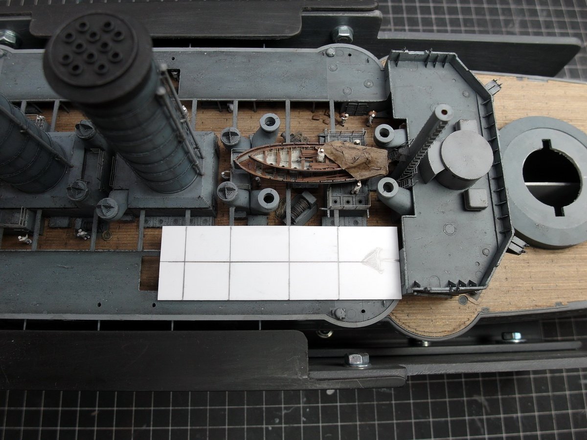

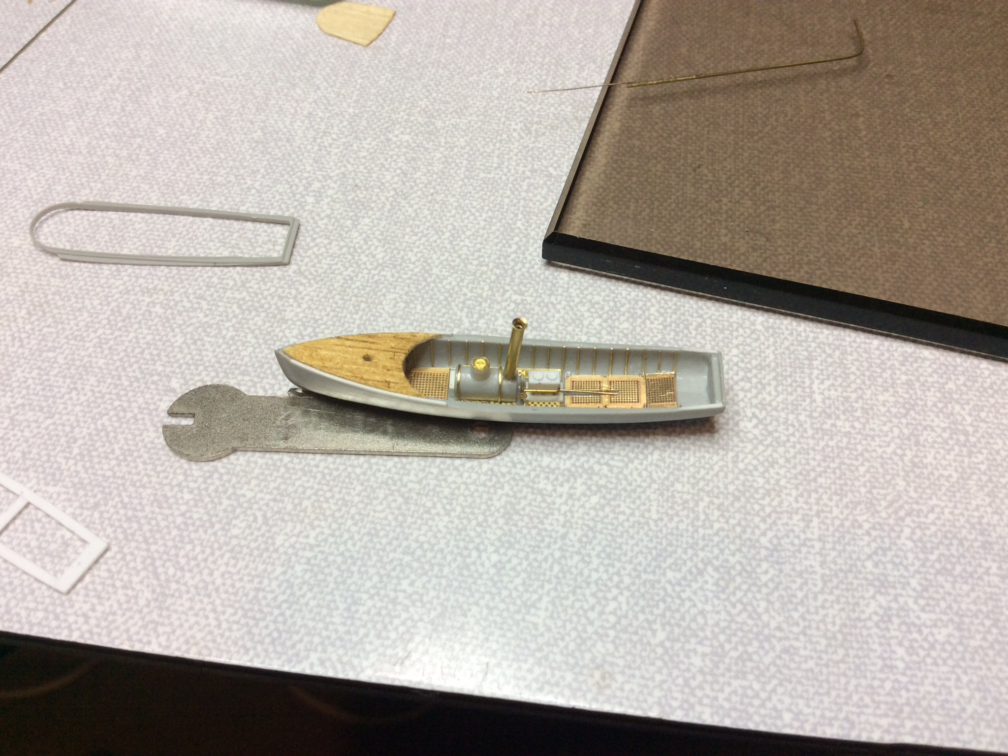

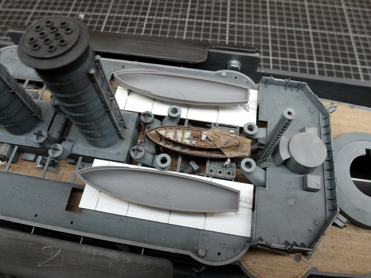

And immediately, I have the next nerve-wracking construction phase ahead of me.
But I was particularly looking forward to this part. I’m starting to incorporate a miniature marvel of 3D printing technology into my model.
The 50-foot steam pinnace. https://forums.kitmaker.net/images/emoji/google/star_struck.png?v=14

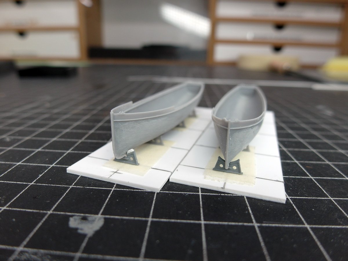

But first, I have to get it into the cradles and onto the struts.
I made a jig for that.
One each for the starboard and port sides. The stripes aren’t exactly evenly spaced on the two sides, and I have to take that into account.
I now glue the cradles onto the gauge and can then align and change them easily without damaging the now quite delicate Mikasa.
For example, the distance to the access to the higher deck is important, as the pinnace’s rudder extends quite far out. And toward the bow, I have to pay attention to the funnel rigging.
I have the same problem with the cradles as I did with the cutter amidships.
They don’t fit where they were originally printed. And besides, only three were planned. But the pinnace rests on four struts, so I need one more cradle. It’s nice that four boats will be hanging from the davits at the stern later, so I can repurpose the cradles.
Then I took out the profiles and adjusted them. It’s better.

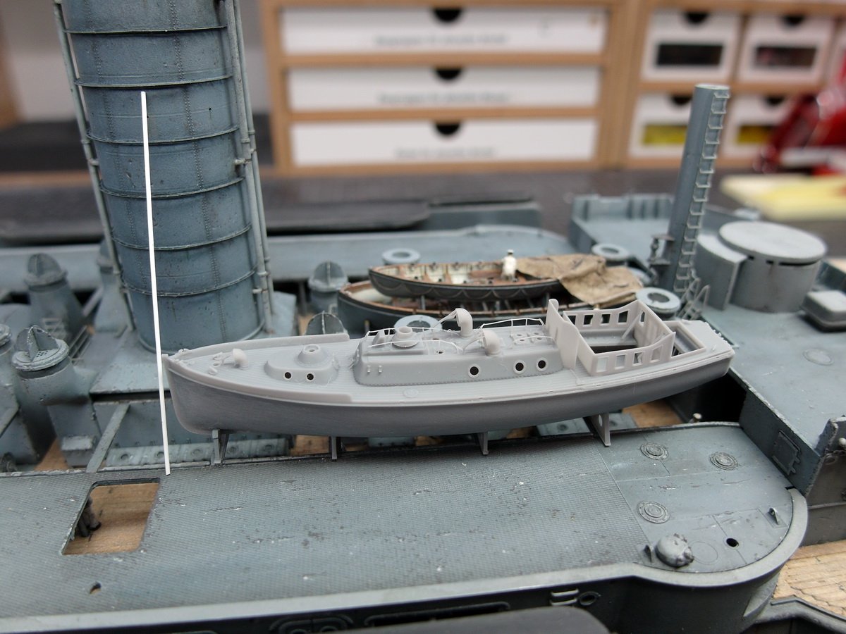

And so the first pinnace could be placed in its cradles and placed on the deck for testing. You can see a faulty print in the hull. This has already been claimed, and I’m getting a new one.
In front of the boat, you can see a thin round rod. This is supposed to simulate the funnel rigging. You really have to think of everything. At least you should try to, so you don’t end up on your backside in the next step. https://forums.kitmaker.net/images/emoji/google/worried.png?v=14

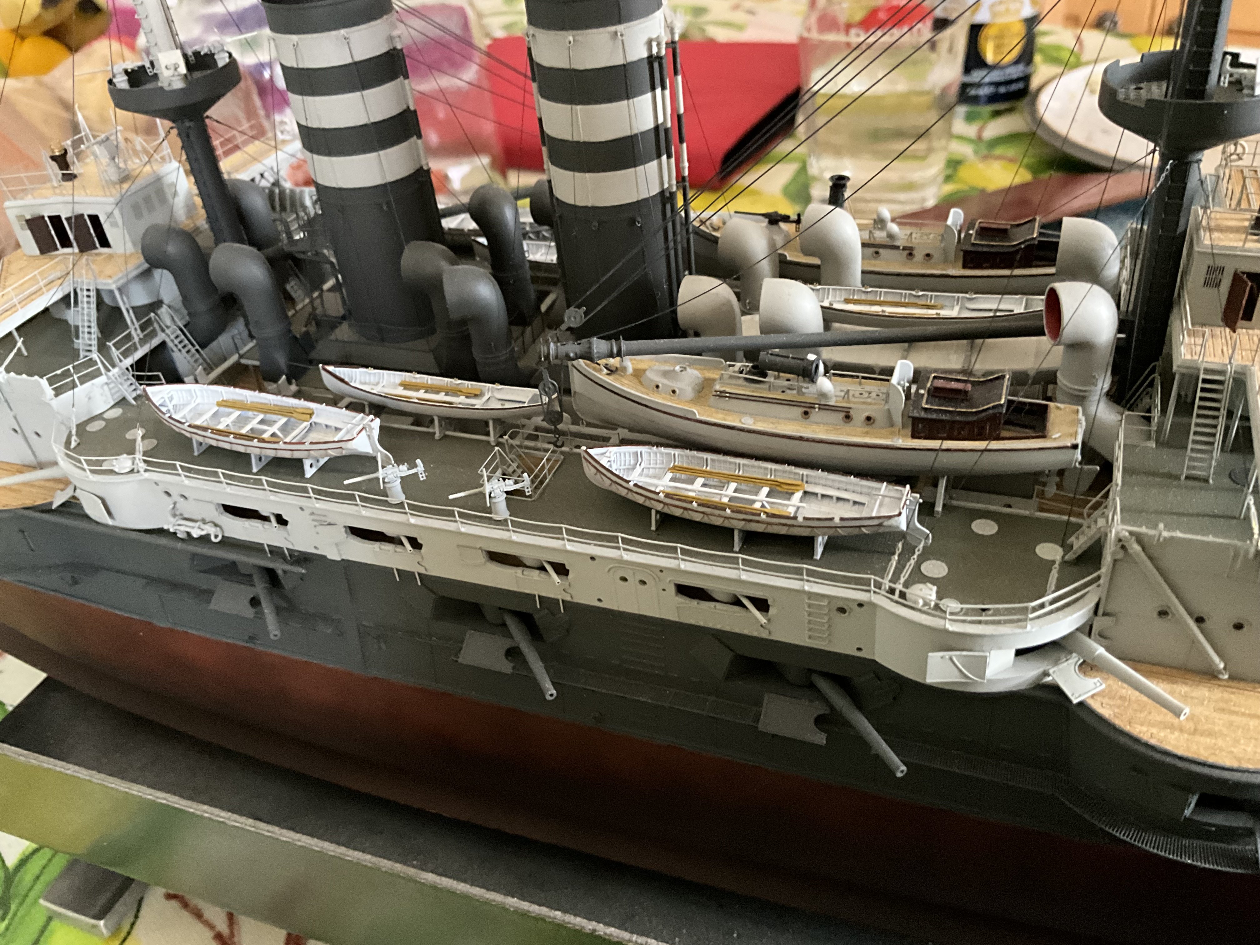

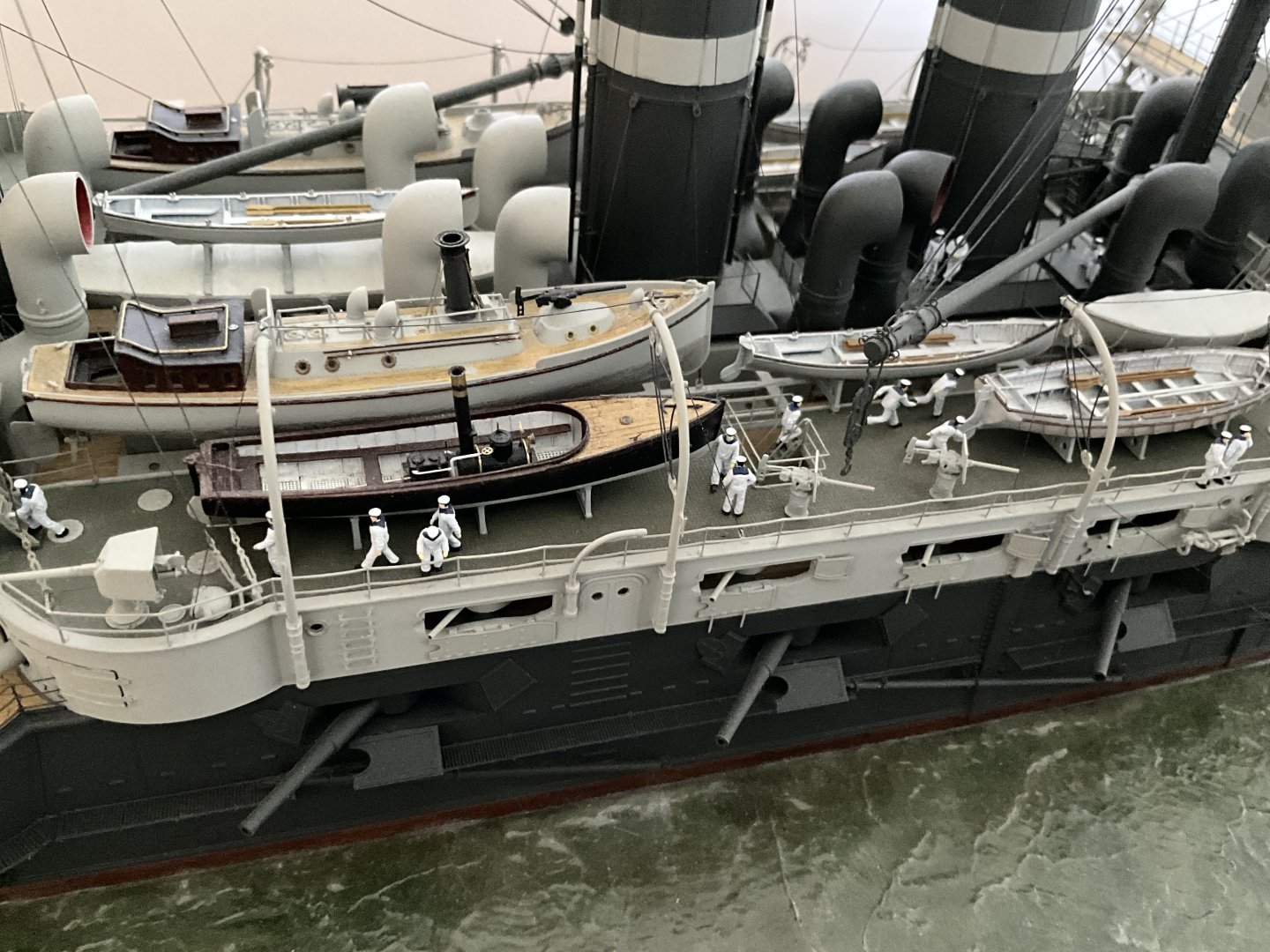

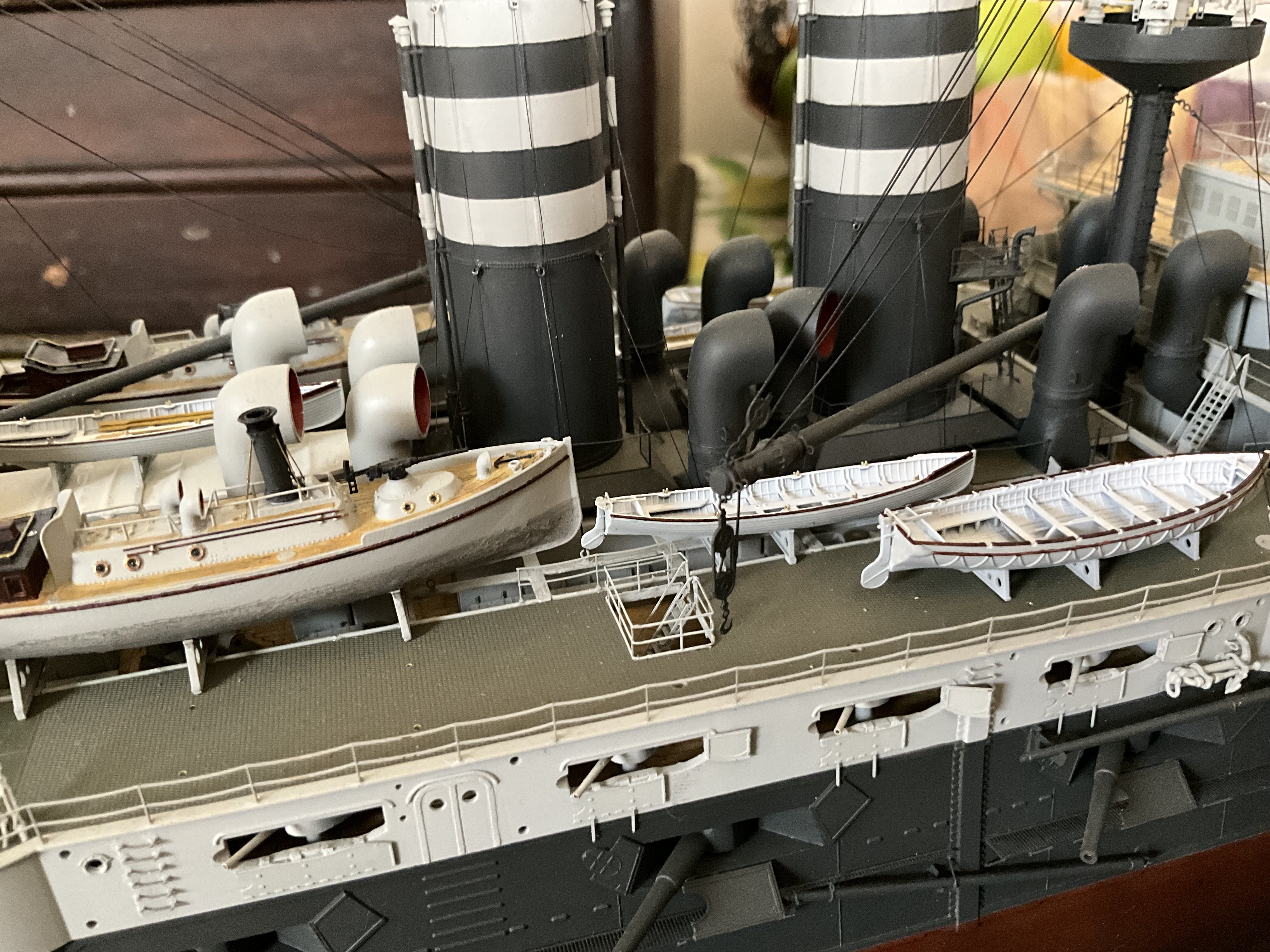

Also agree, happy medium gives the best off both worlds. Watch when you position the boats on this deck Jolle, space is a premium, considering the Micromaster Pinnace is quite a bit shorter than the kit one, l found it a tight squeeze to shoehorn them in, that’s when l had to add extra steelwork supports to support the extra boat cradles, it just goes on forever Jolle 😂, you might want to check out the pinnacle style, l did remove the helm screen on the last one that l made to make it look like it was from another ship, did manage to gently break this of and change the rear cabin, this probably makes it a bit nearer the period for 1905. Shall put up a photo off book l purchased that was a good help for photos and info. Shall also get said info from you on anchor chairs for Bismarck definitely 🤛 Your model is coming on a treat 👍
Ahoy, Jeff.
Oh yes, I've also noticed that space is at a premium on the ship. I don't see any end in sight. But the fun is also the challenge, right?!
Thanks again for the helpful tips.

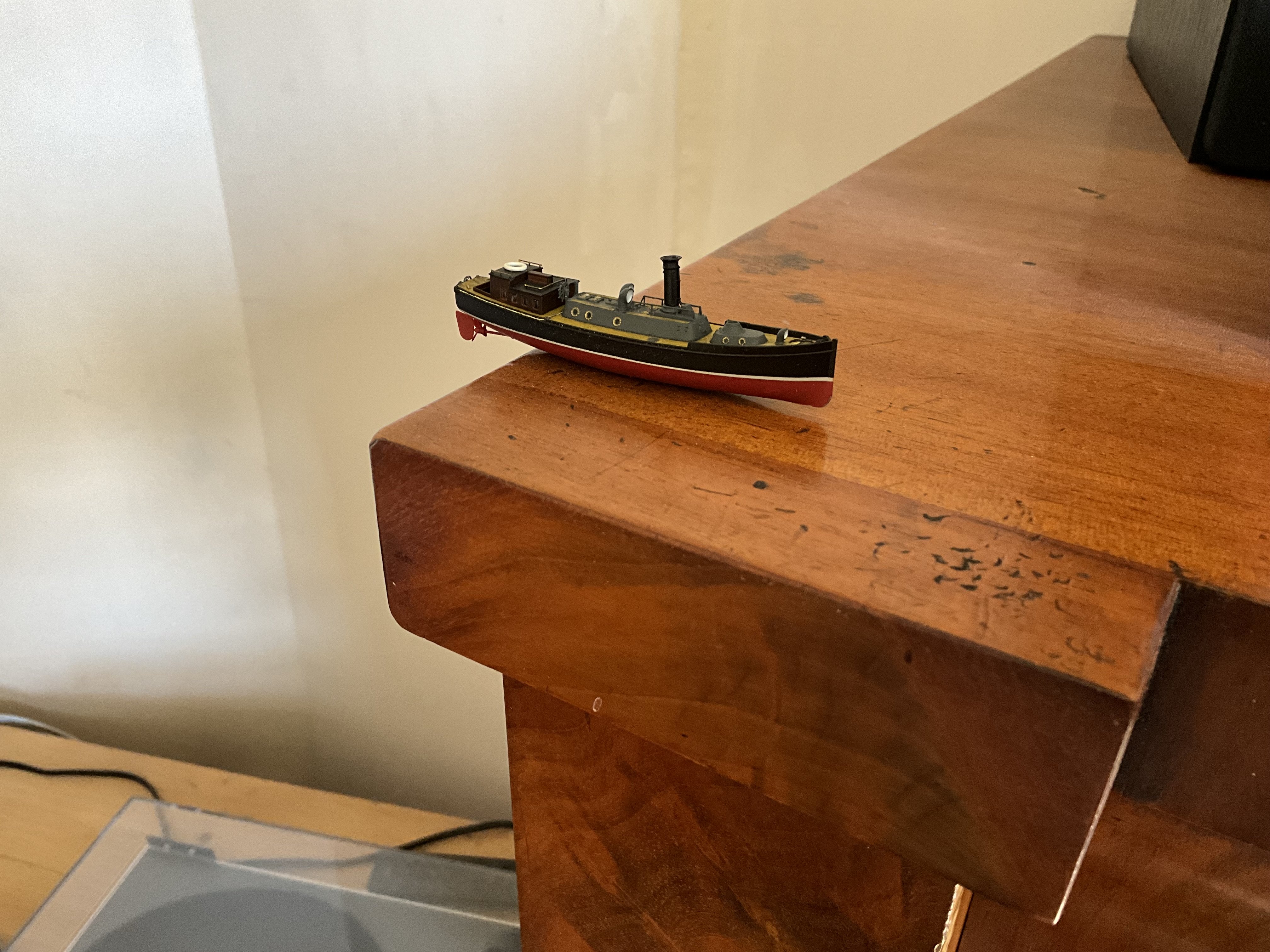

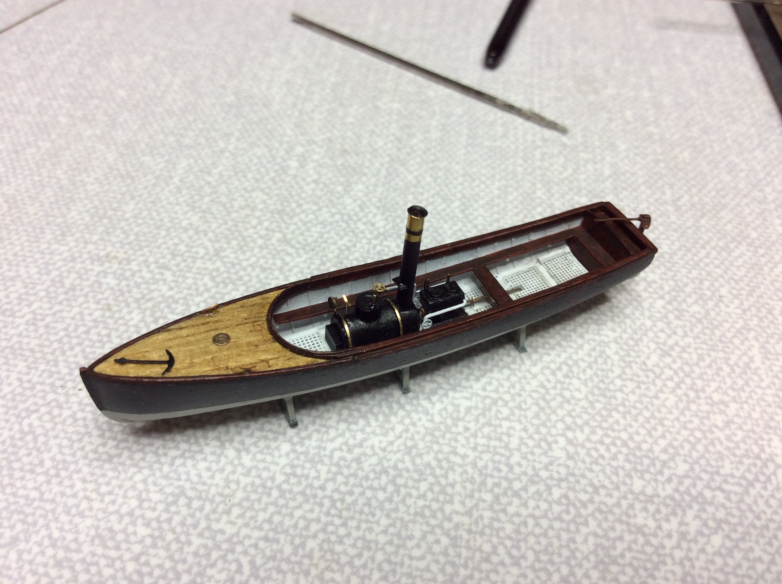

I've also been thinking about the final appearance of the pinnaces. I examined the following two photos, although I don't know if they are the Mikasa's boats.
The fact is that there was no helmet screen, just like there was no cabin.
There was apparently only one tarpaulin.
I'm a little torn about how to proceed. I'm really afraid of destroying the pinnaces when removing the two parts. As you know, they weren't exactly cheap and come from the other side of the world. I really have to think carefully about whether to take that risk or just install the boats as they are.
There's virtually no historical evidence of this ship, including the appearance of the pinnaces. 🤫

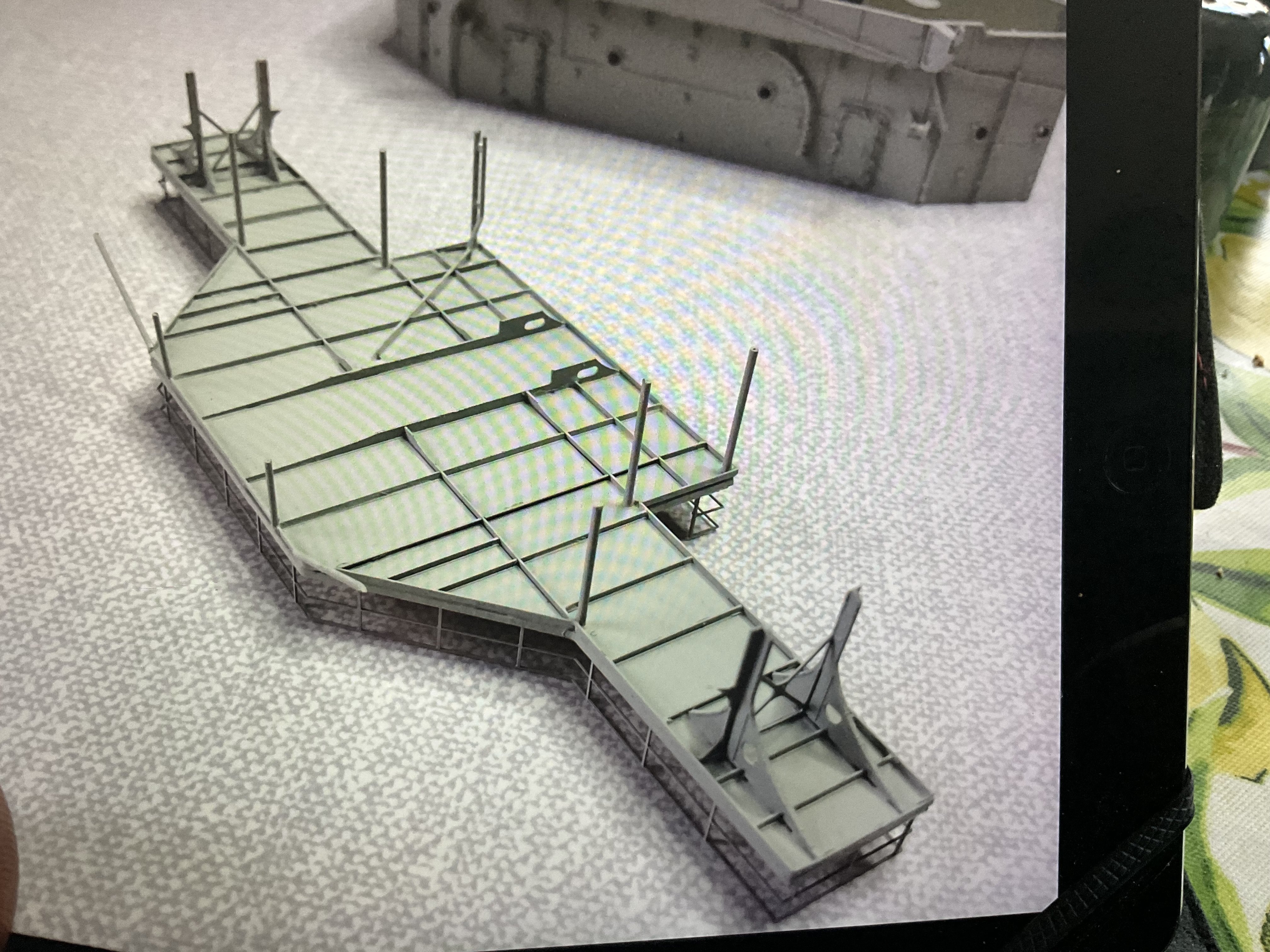

By the time you fit the three boats you’re talking about millimetres to spare, this must be why nobody could get three boats onto original set up from kit, the kit steam  pinnace is much larger than the Micromaster  pinnace but l think it’s the right style, must be 56 ft . As you say you have to work with what you’ve got. Challenge is working it all out 😂 enjoy 🤛

What I don't understand, Jeff, is that you're talking about three pinnaces. Where exactly would the third pinnace have been stand on Deck?

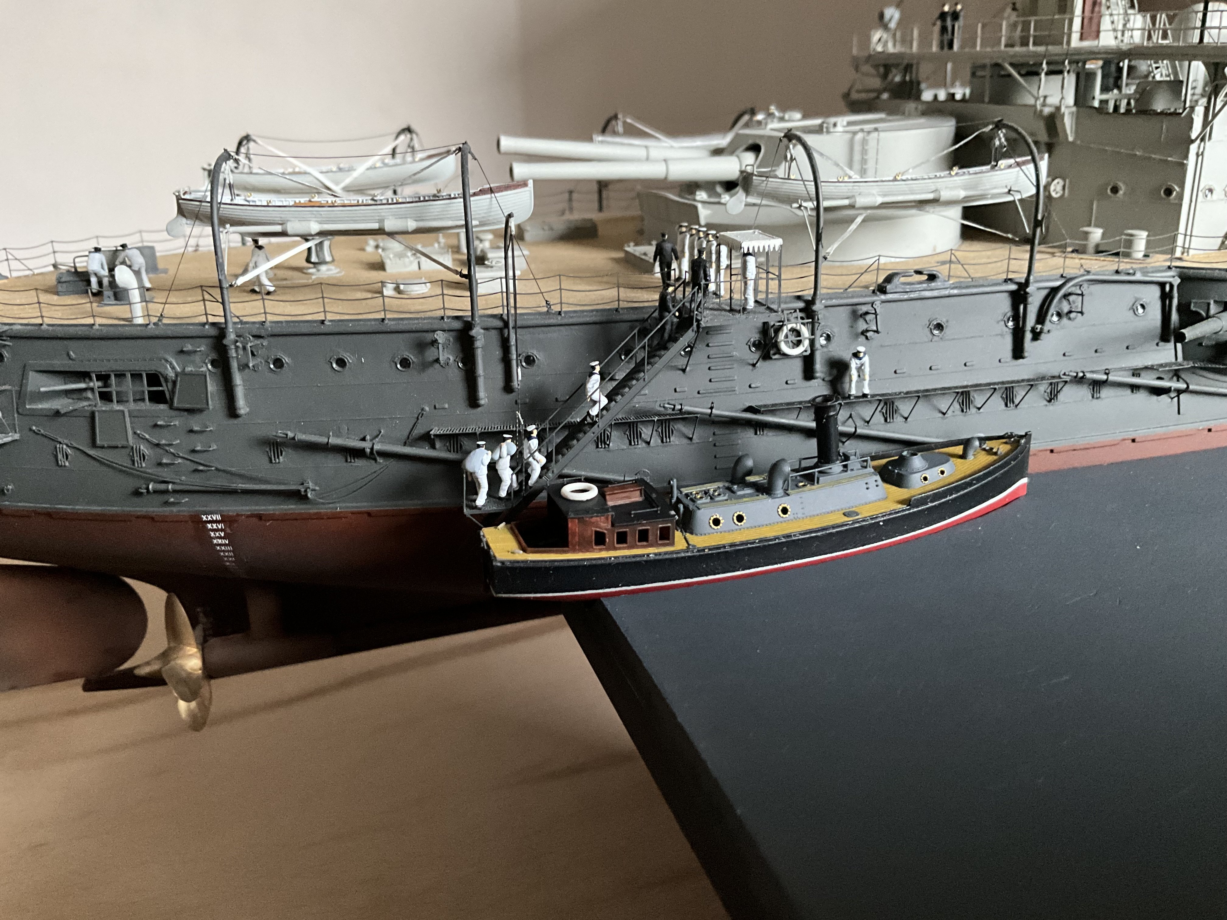

So, for my research on this ship, I'm almost exclusively using what I can find online. I do have a few books about the Mikasa and the IJN, but they're often about their historical background. Strangely, the pictures and technical information about this famous ship are very sparse.
Which, as you say, is a real shame for such a large scale, as there's so much detail that could be included.
I found the following page on the Internet, which helped me figure out how I wanted to display my pinnaces.
Steam Pinnacles, Pickets and Tenders
Among other things, you can see the following two photos which contributed to my decision not to change the cabin.
Here you can see the pinnace with its cabin fully fitted and without a tarpaulin. It's also not as elaborately painted as in the following photo, which reinforced my intention to paint it a warlike gray. It shows the H.M.S. Royal Sovereign.
And so I decided not to make any changes to the Micro Master boats.
I simply didn't feel comfortable removing the splash guard from the rudder and damaging the railing. The manufacturer of the 3D print is located on the other side of the planet, and another Micro Master order for me has been stuck in customs for over three weeks anyway.
I didn't want to take any chances.
First, the basics again. There's a narrow edge that I had to negotiate with the cradles.
So I lined the front part of the cradles with styrene.
Fits quite well.
Then the base colors were applied. As already mentioned, this one also uses the gray of the war paint.
Then a mandatory aging process.
This is the first step.

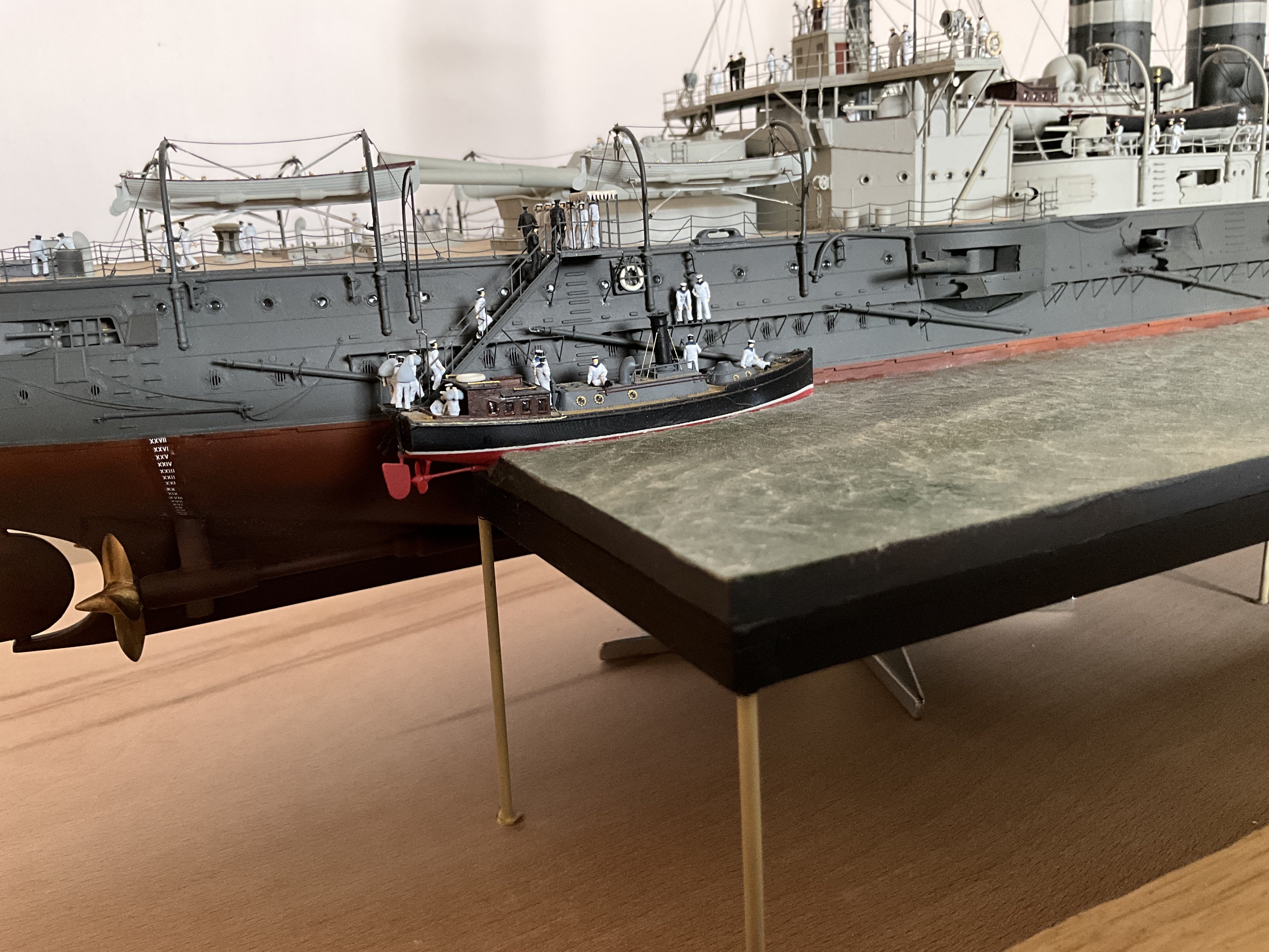

Man, those boats look great.
And put it on the deck to test it.

Aren’t they marvellous these boats from Micro Master Jolle, especially when you compare them to the kit boats 😂 totally different league, even if they are not strictly correct they add so so much more to the finished model. On myself having three pinnace boats , my final take on my display was  Mikasa just arriving in Japan from Britain and taking on more crew, assuming some would  be taken from other new ships from Britain already in Japanese Fleet, hence the other steam pinnace, besides had to have another shot on one of these, just indulged myself here 😂 🤛
