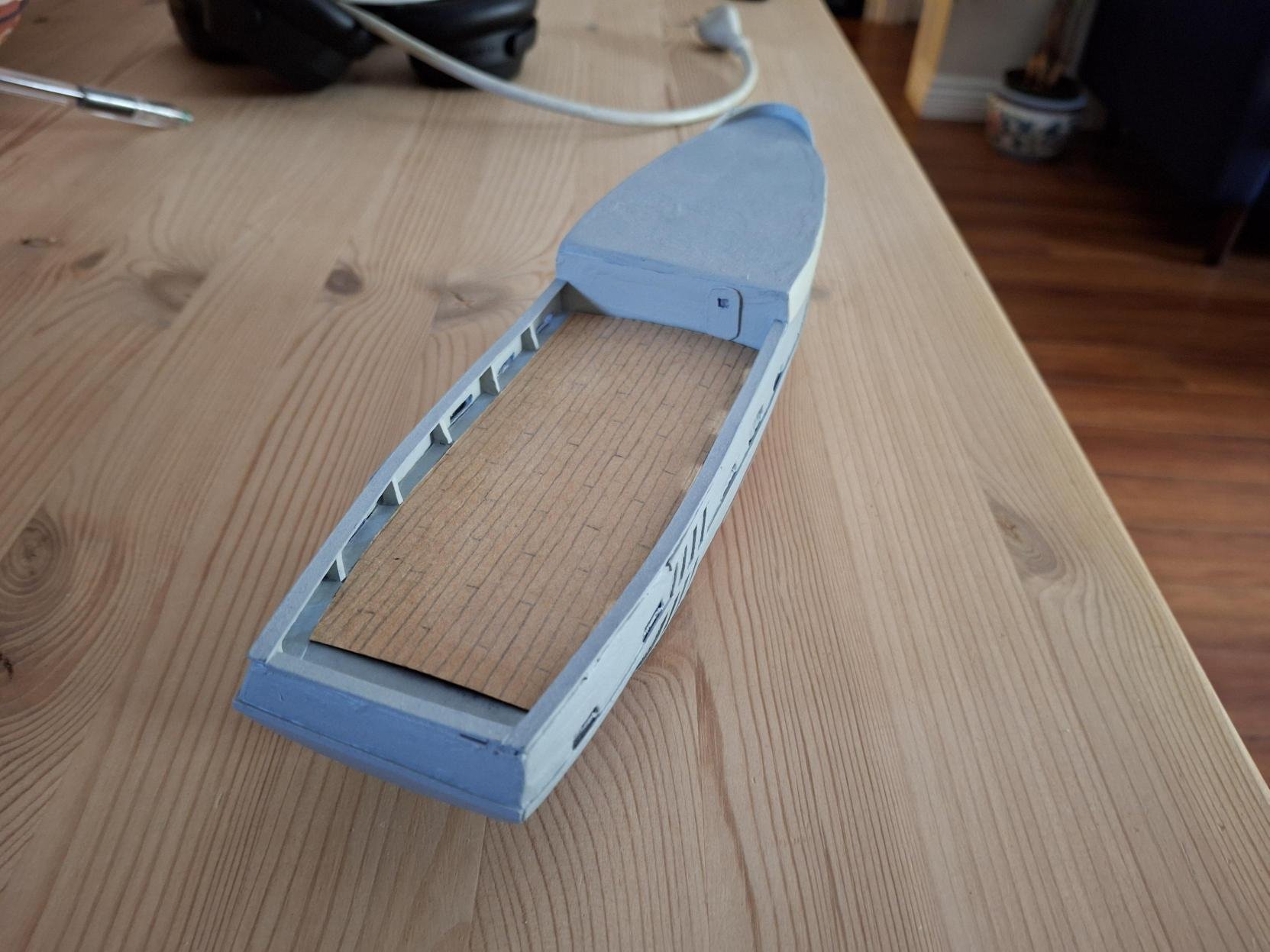

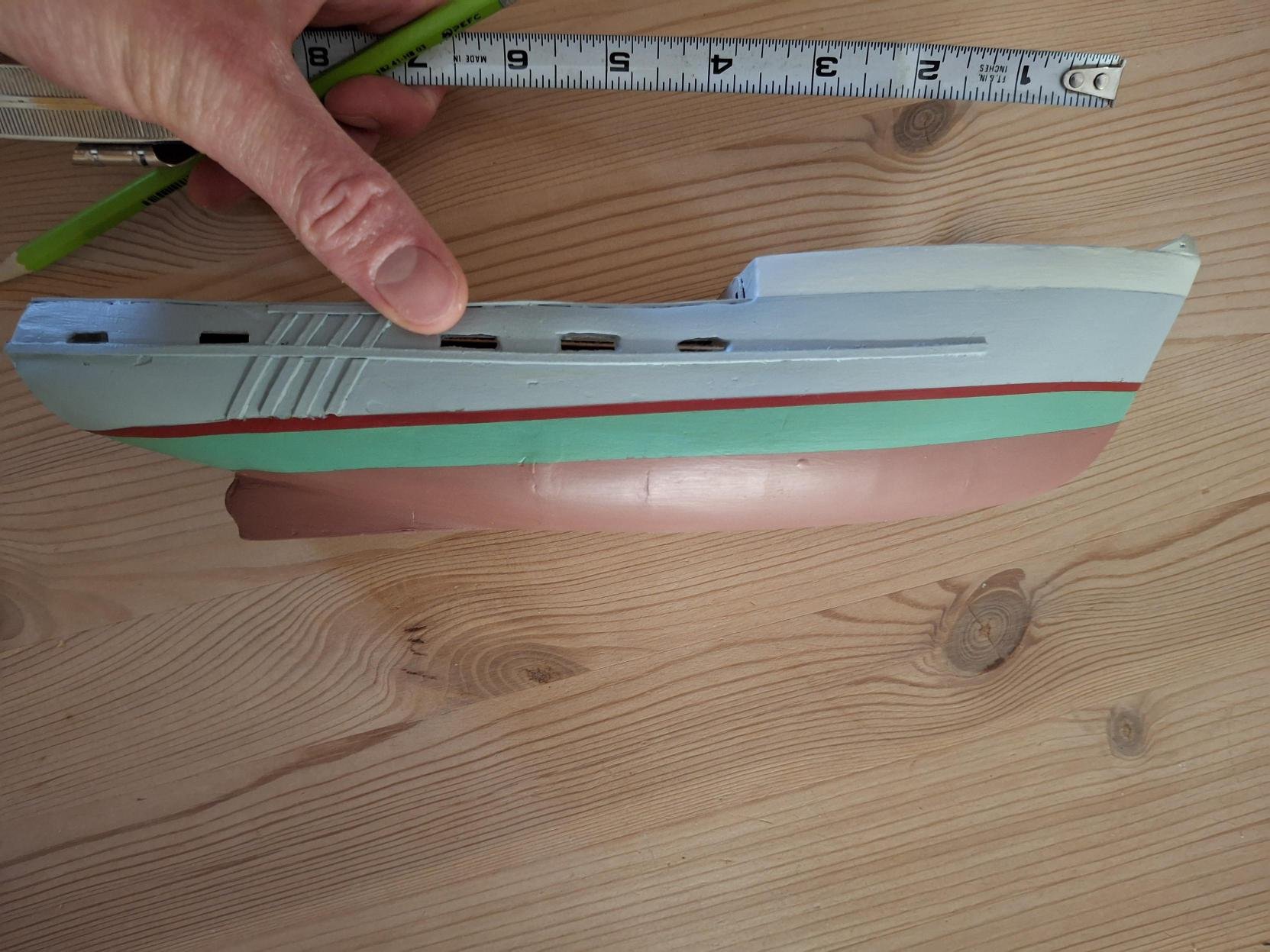

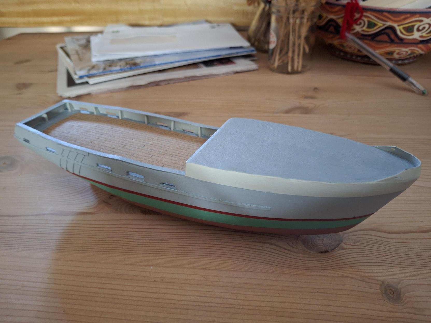

Yes there are! I've put it on hold somewhat while I was building the Cove Isle, but have made some progress on small bit like the rudder and prop. Also got the deck laid out, just deciding how I want to install it: plank by plank or in one big piece. I might try painting it first and see how I like it.
Main point of progress: the paintjob for the hull is complete!
