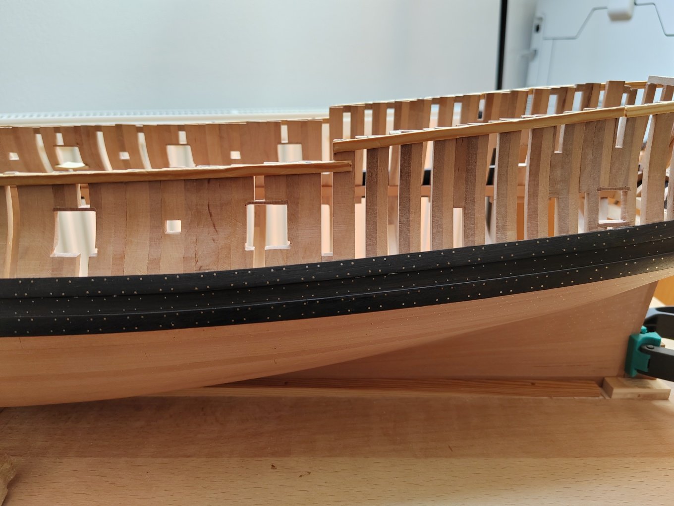

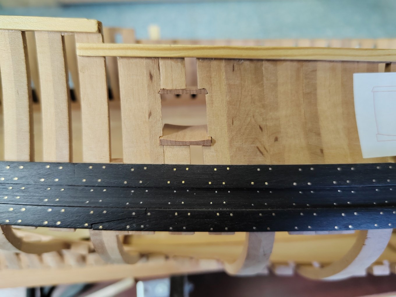

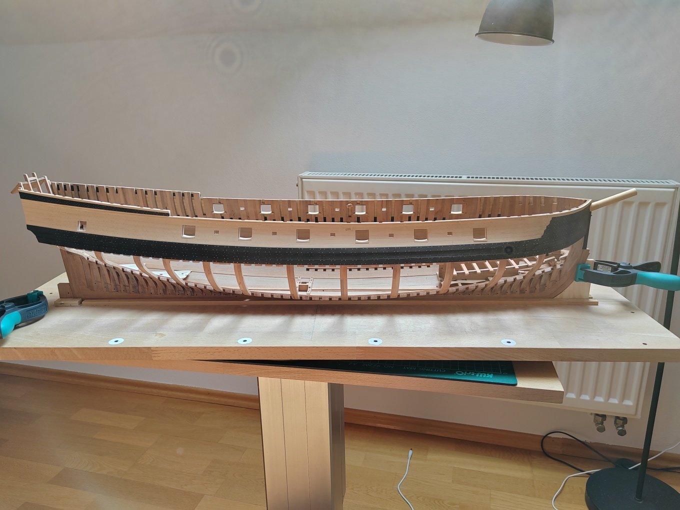

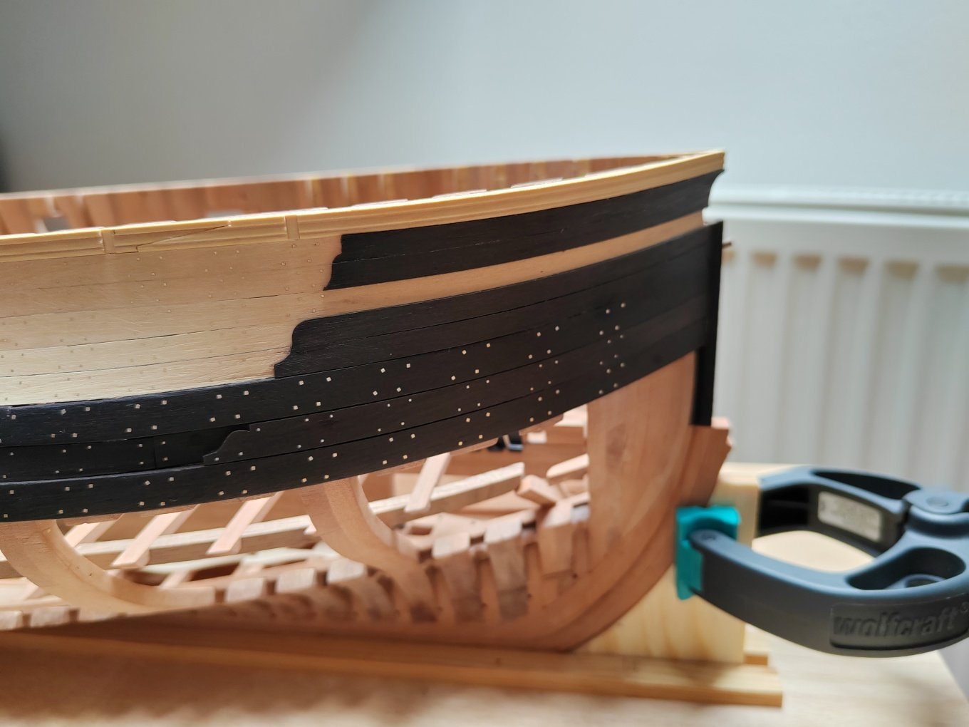

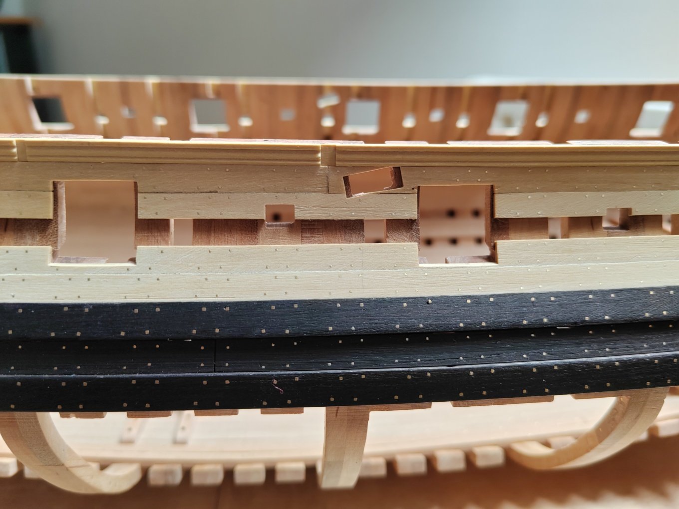

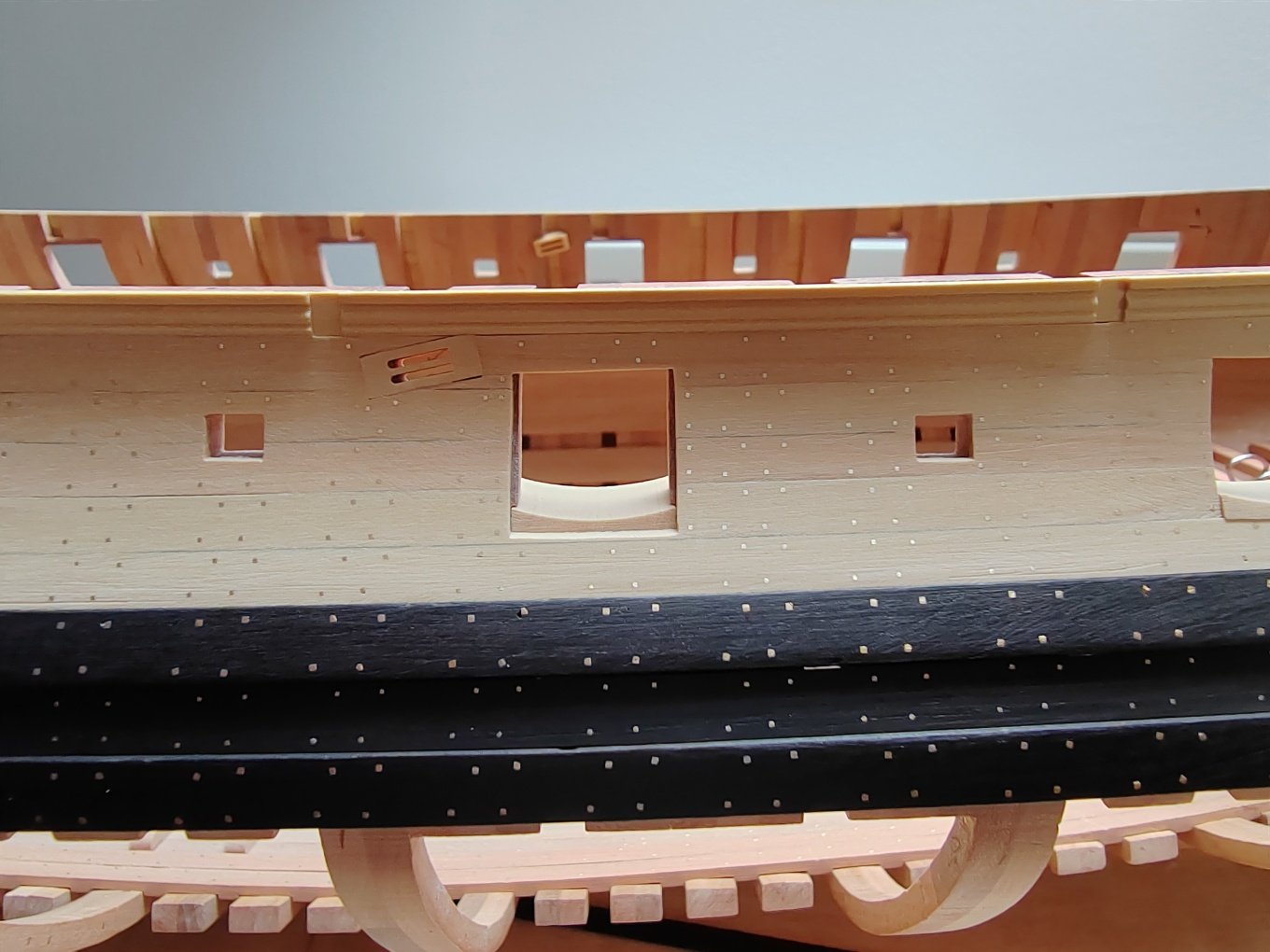

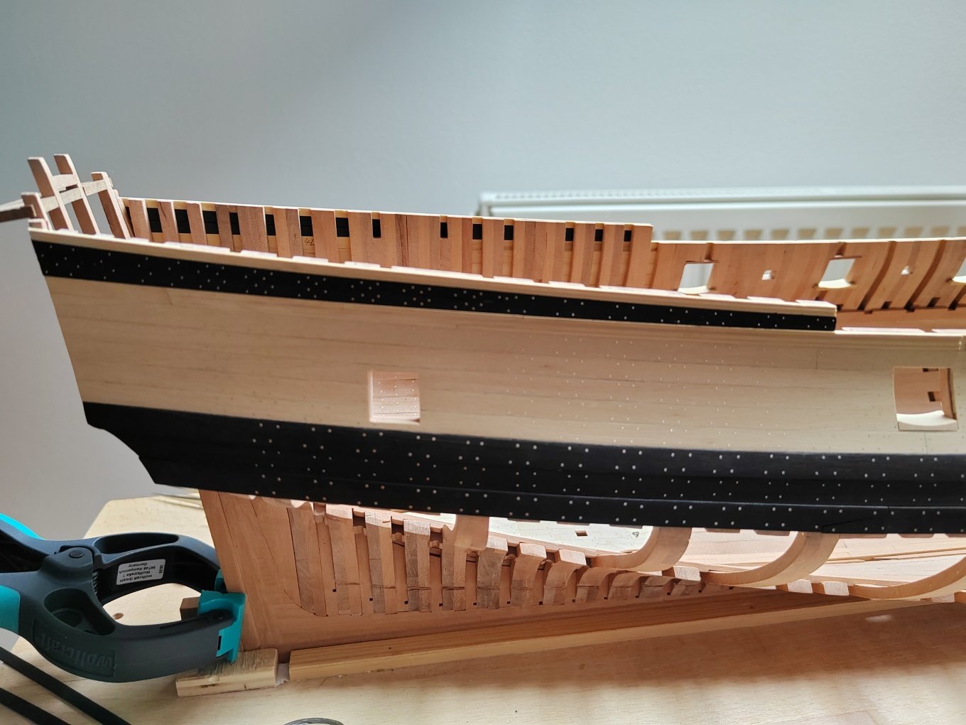

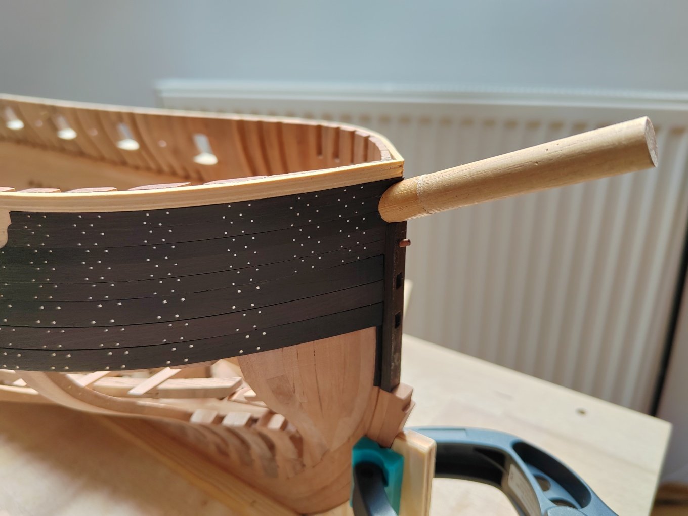

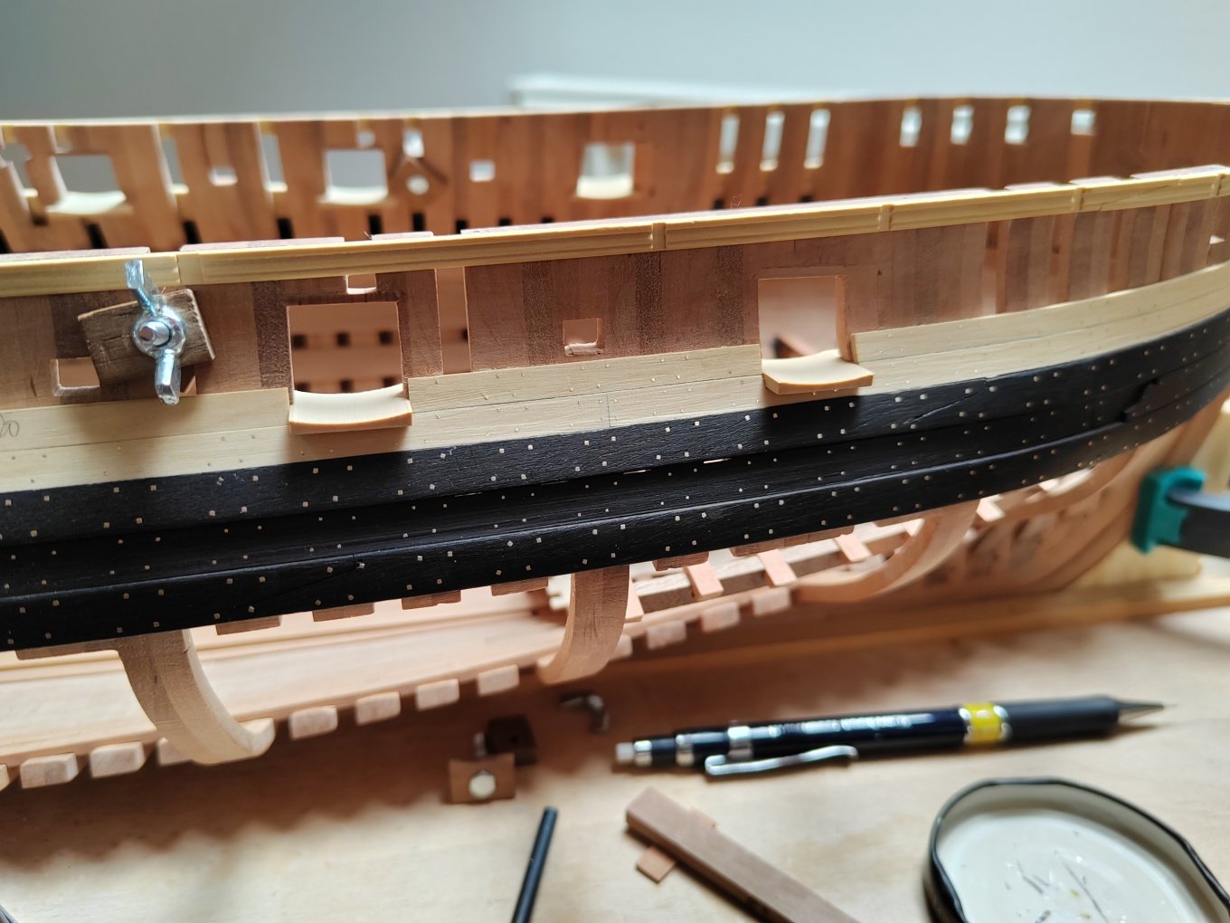

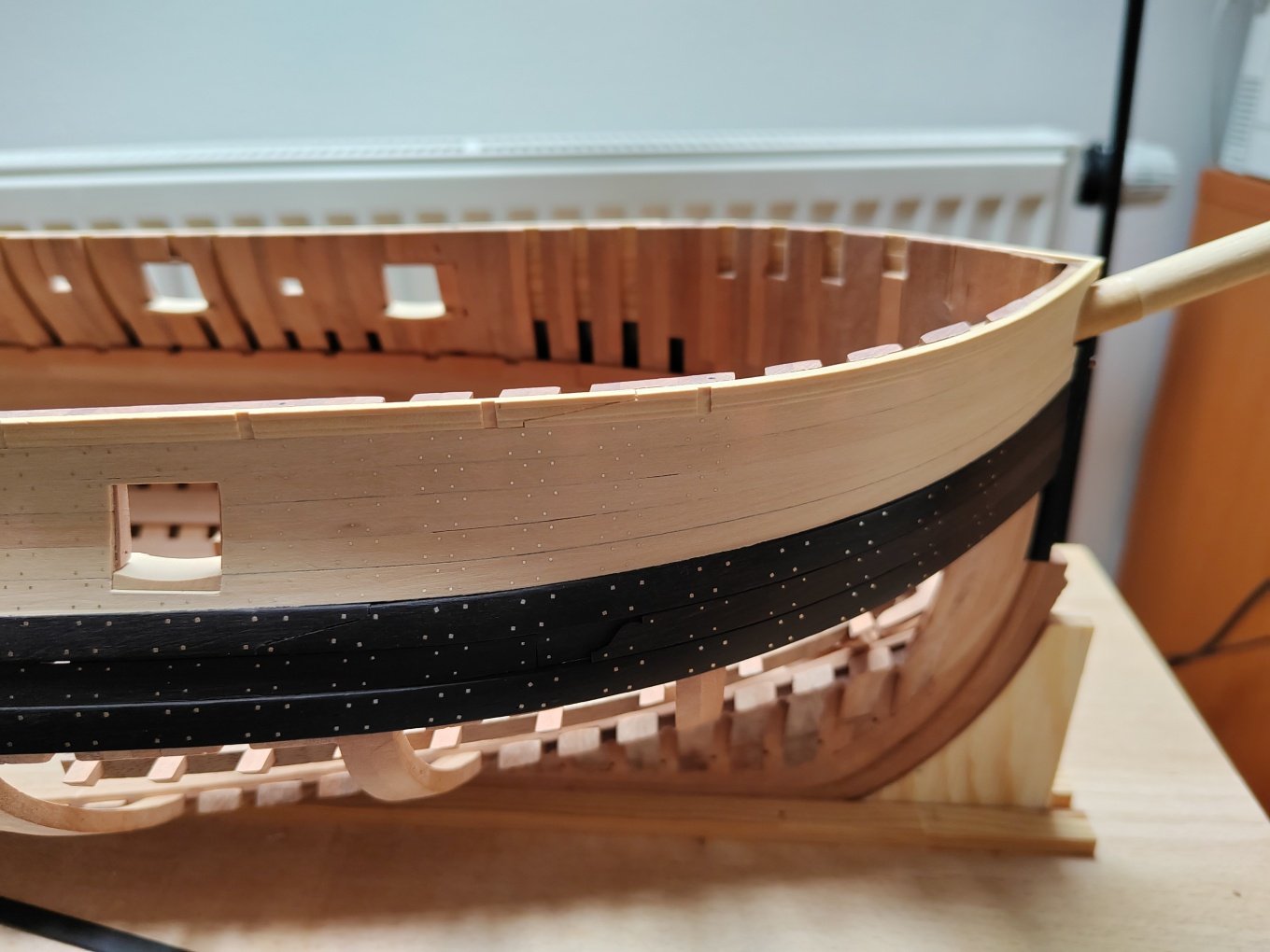

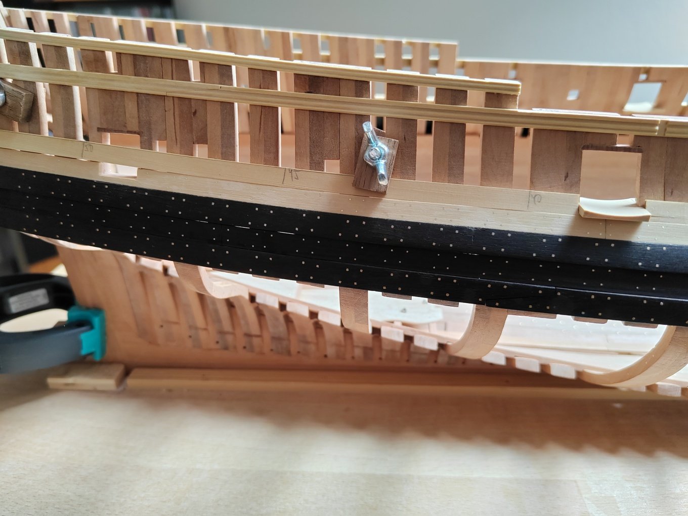

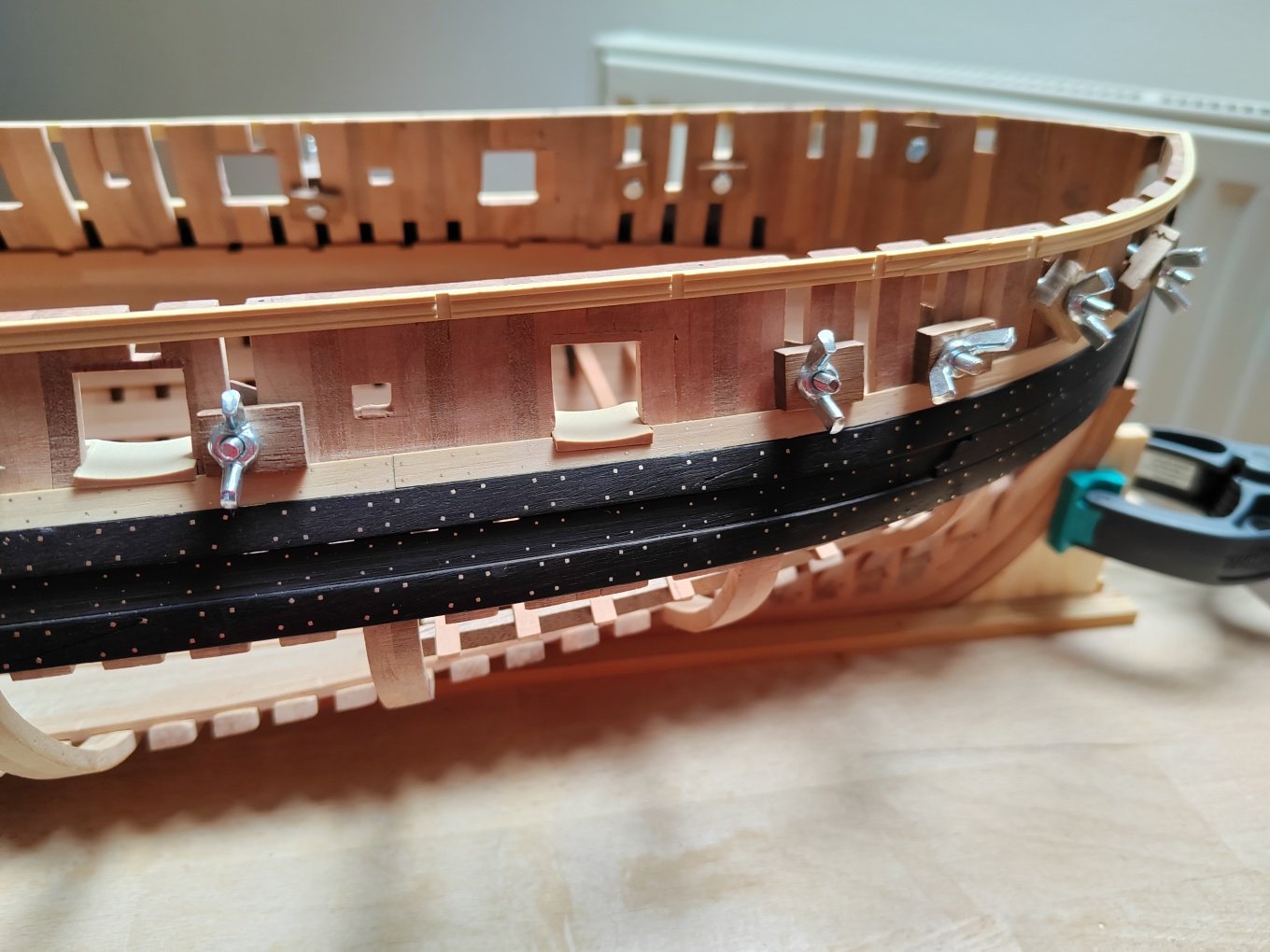

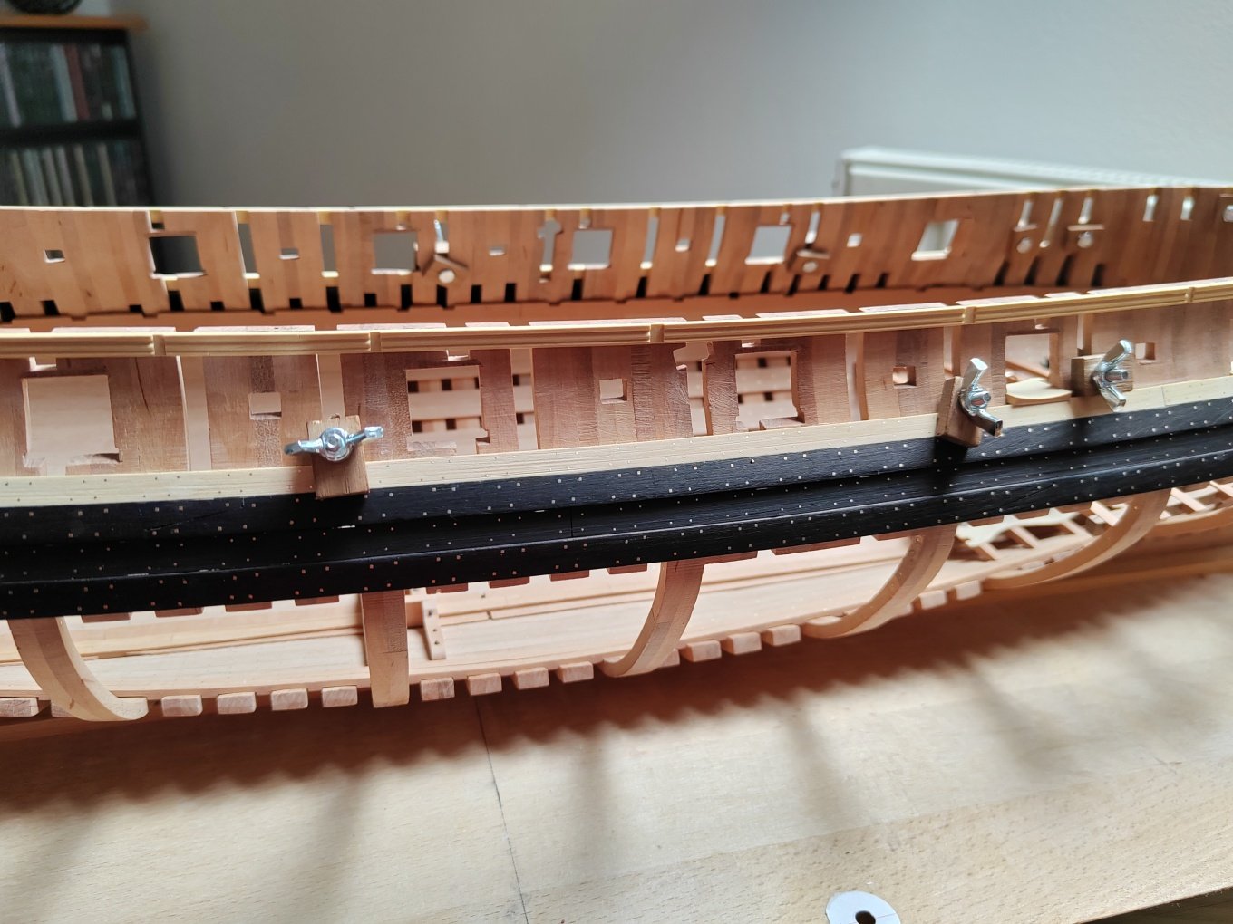

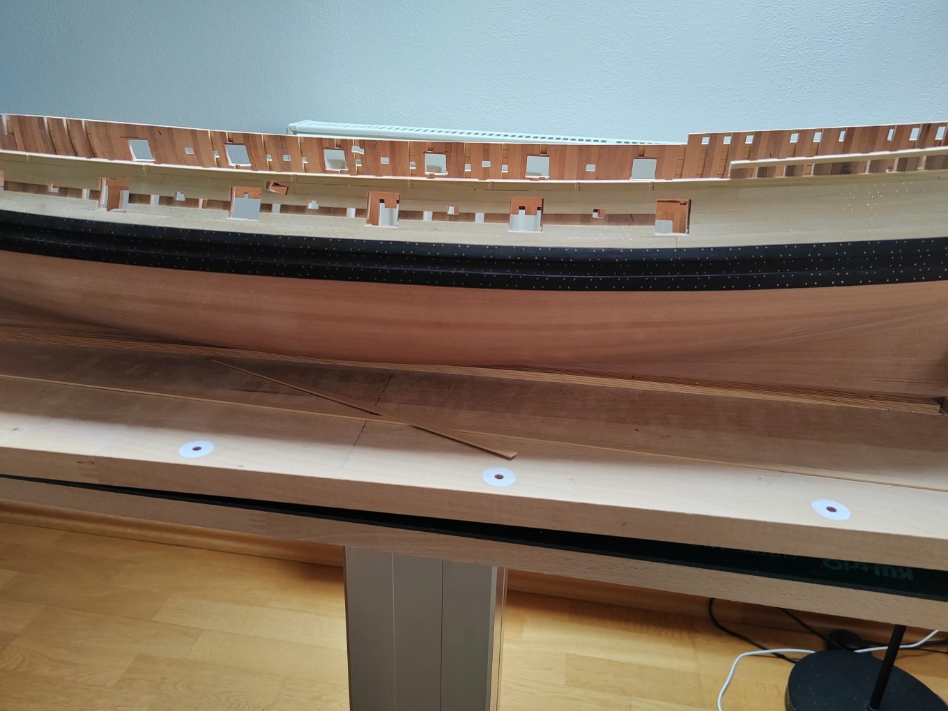

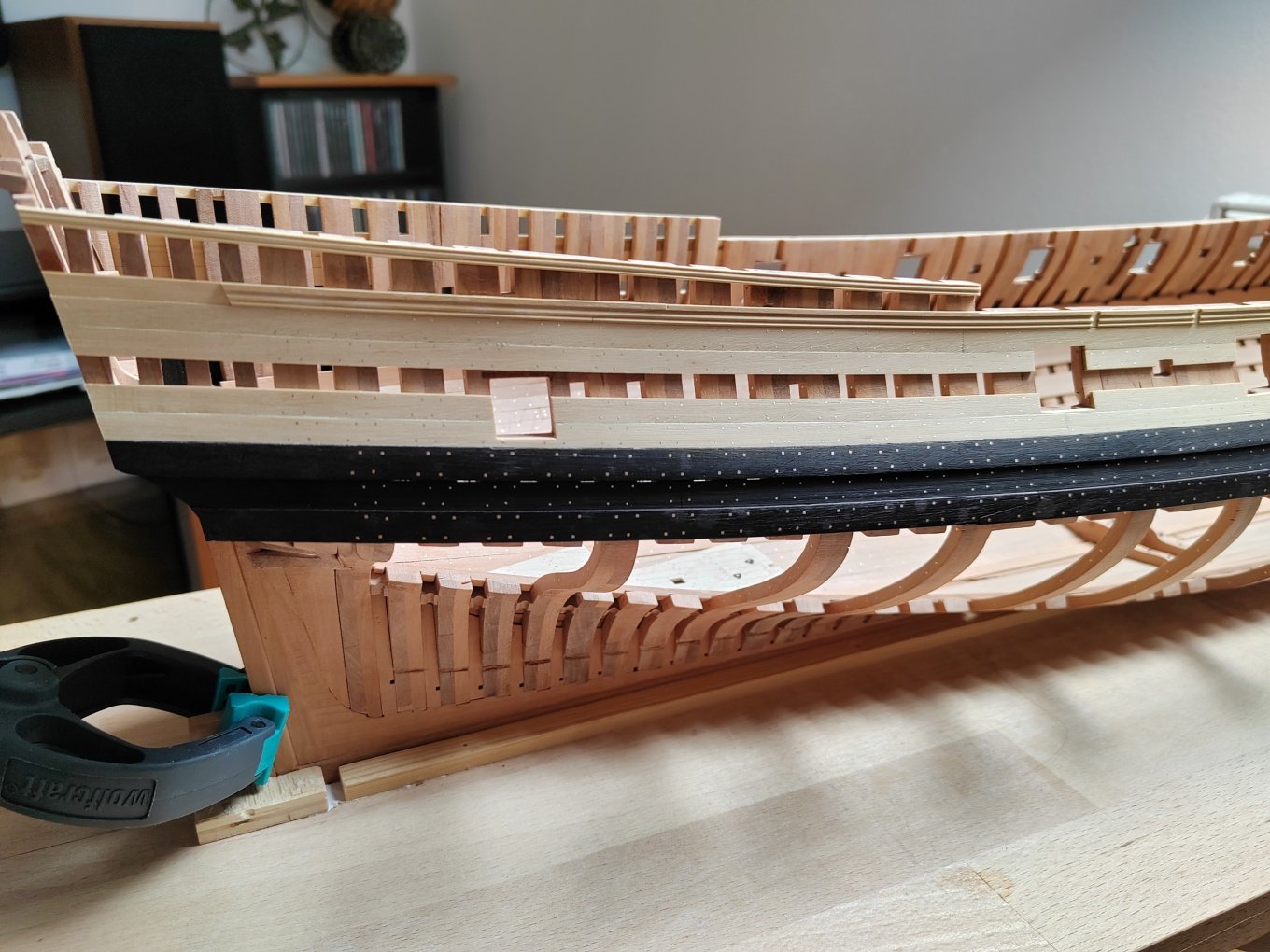

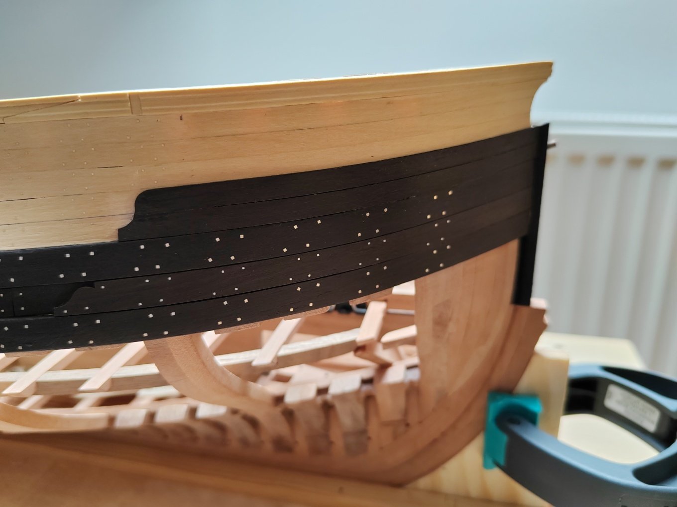

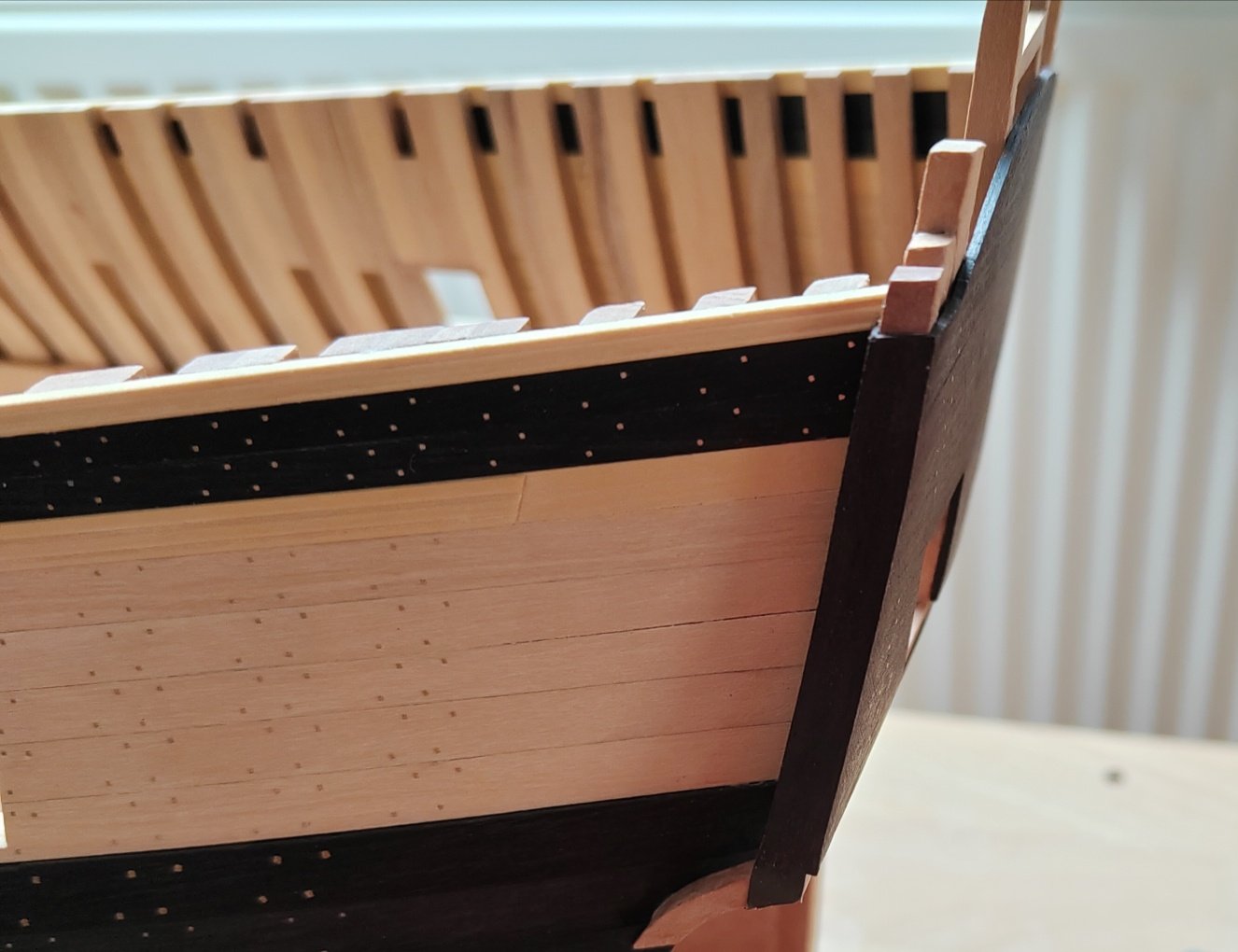

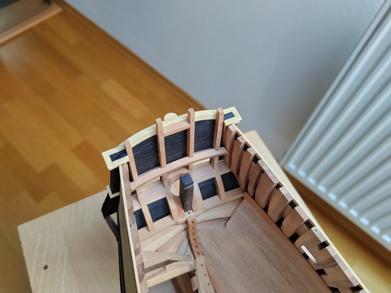

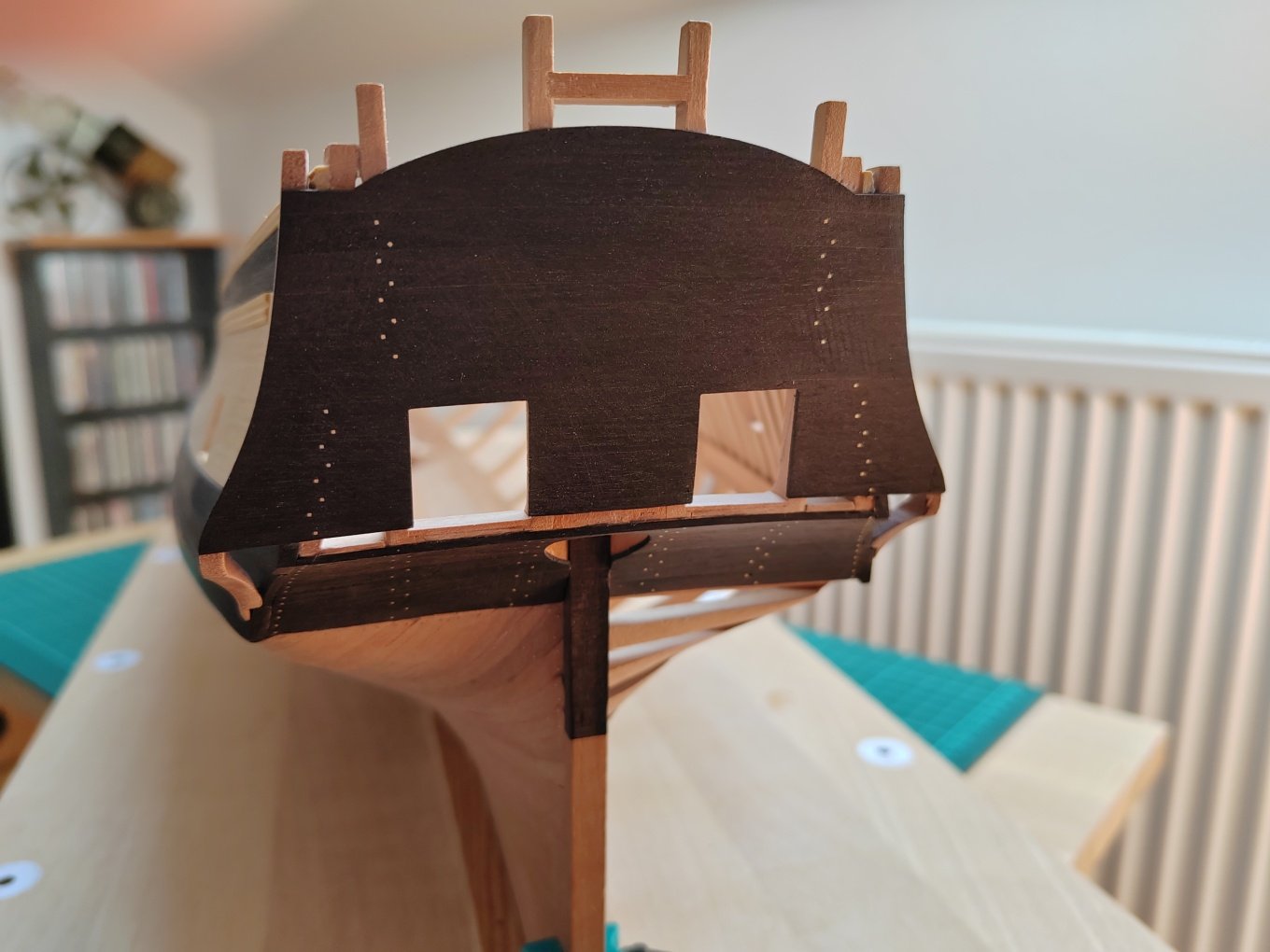

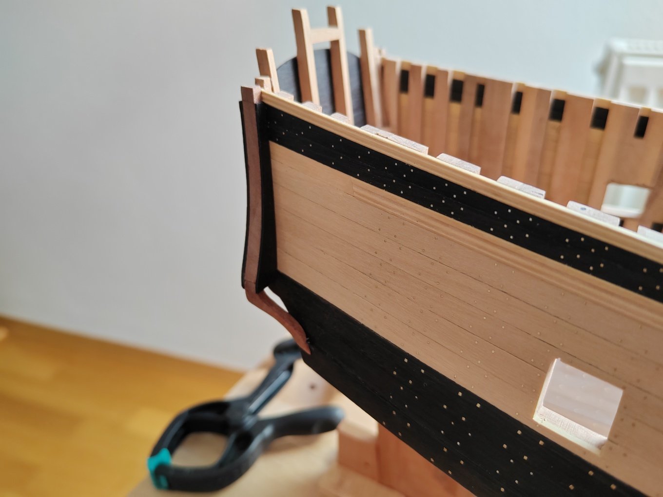

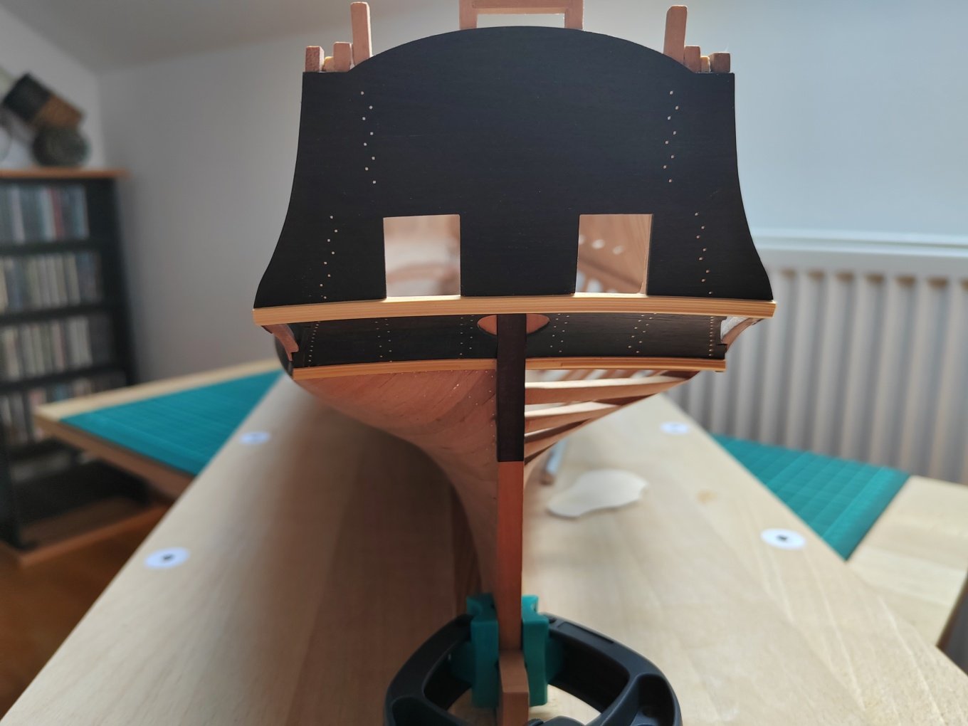

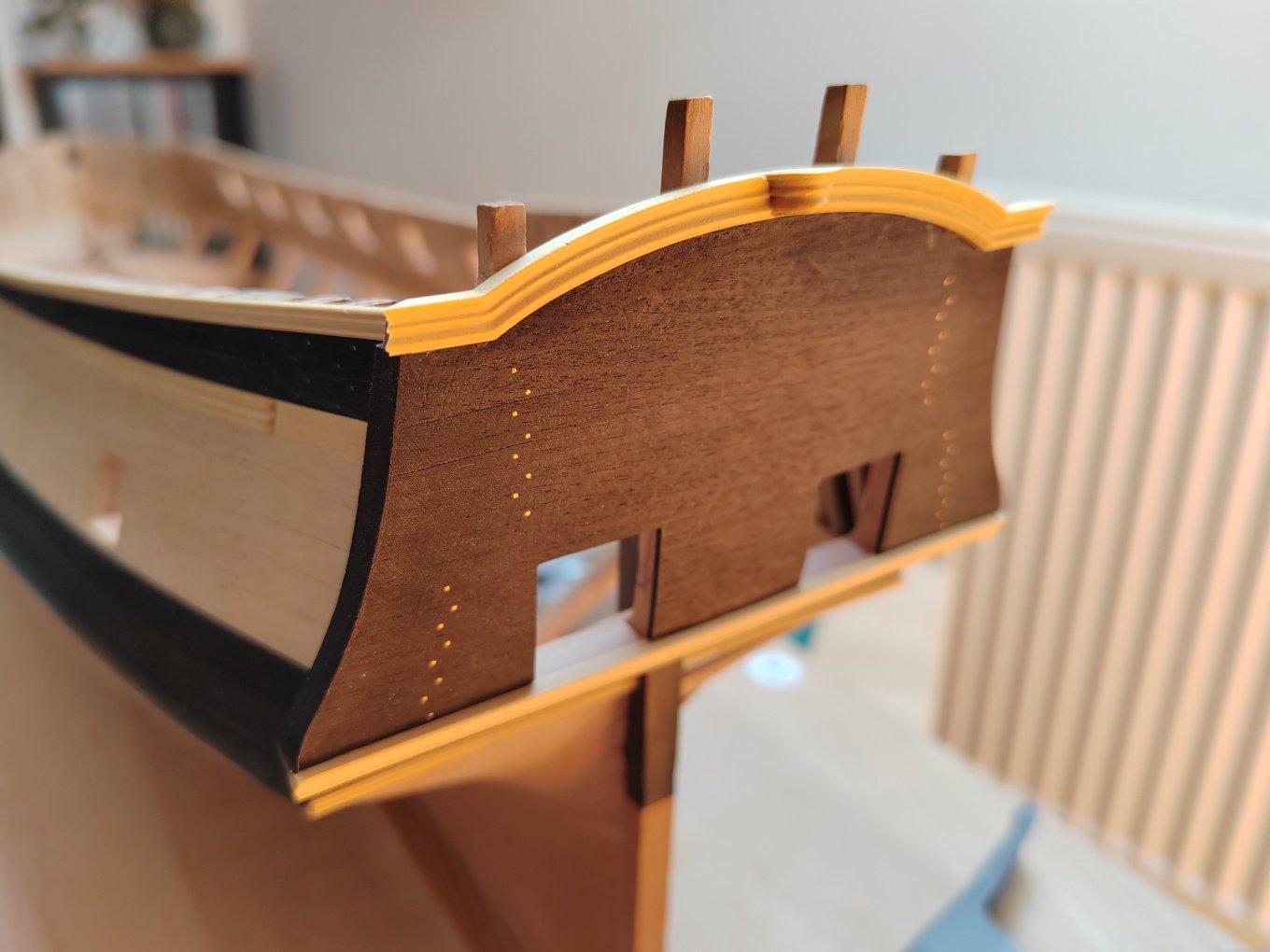

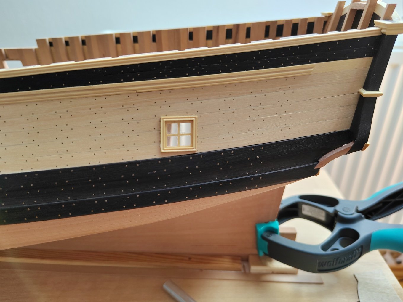

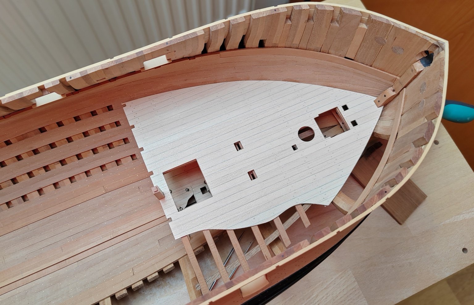

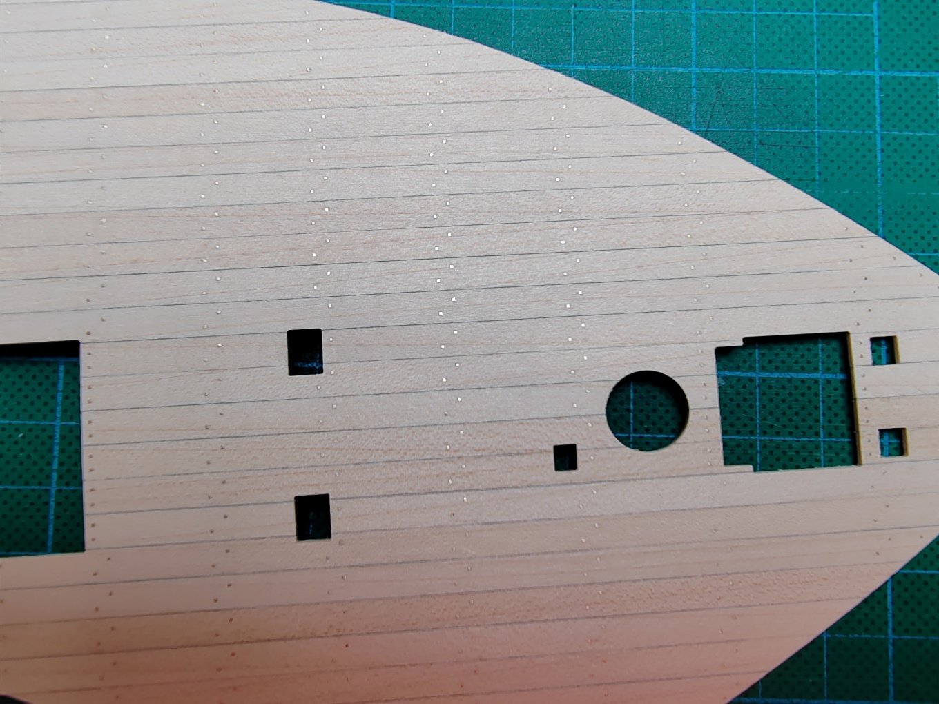

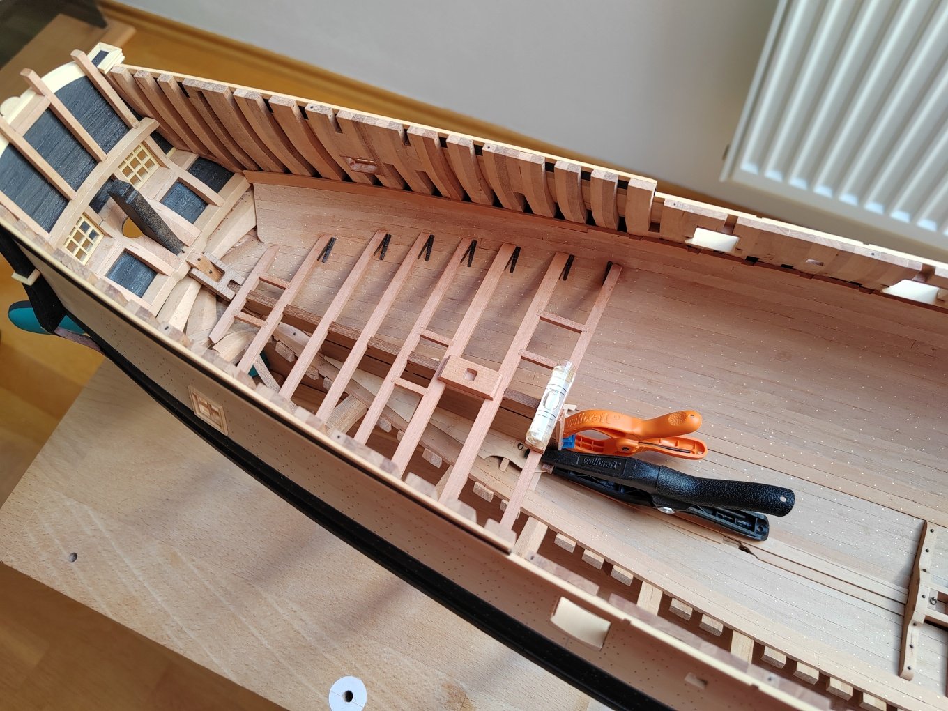

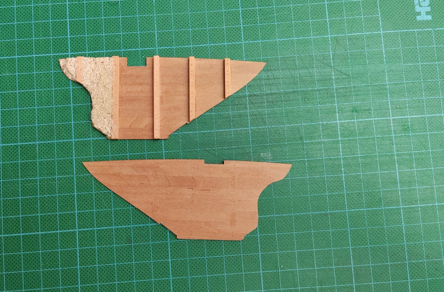

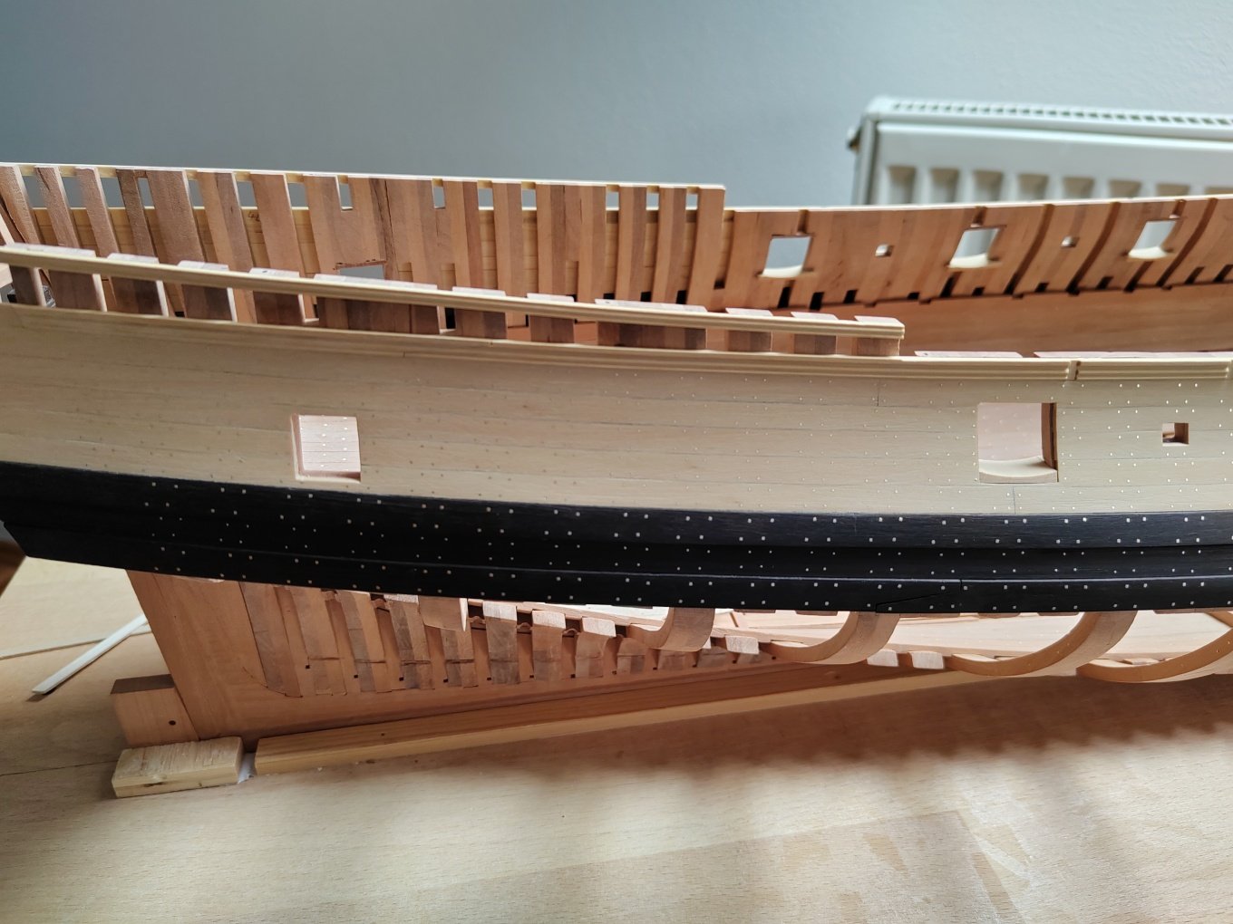

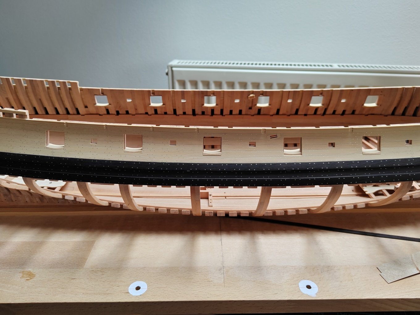

To Chris - I don't like the black caulking between the planks to be too prominent, so the caulking here is created only by blackening the edge of the plank with a pencil so that it is not too prominent. The only exception is the planks on the decks, where the caulking is created with black paper. Here this color contrast makes a bit more sense (at least from my point of view).

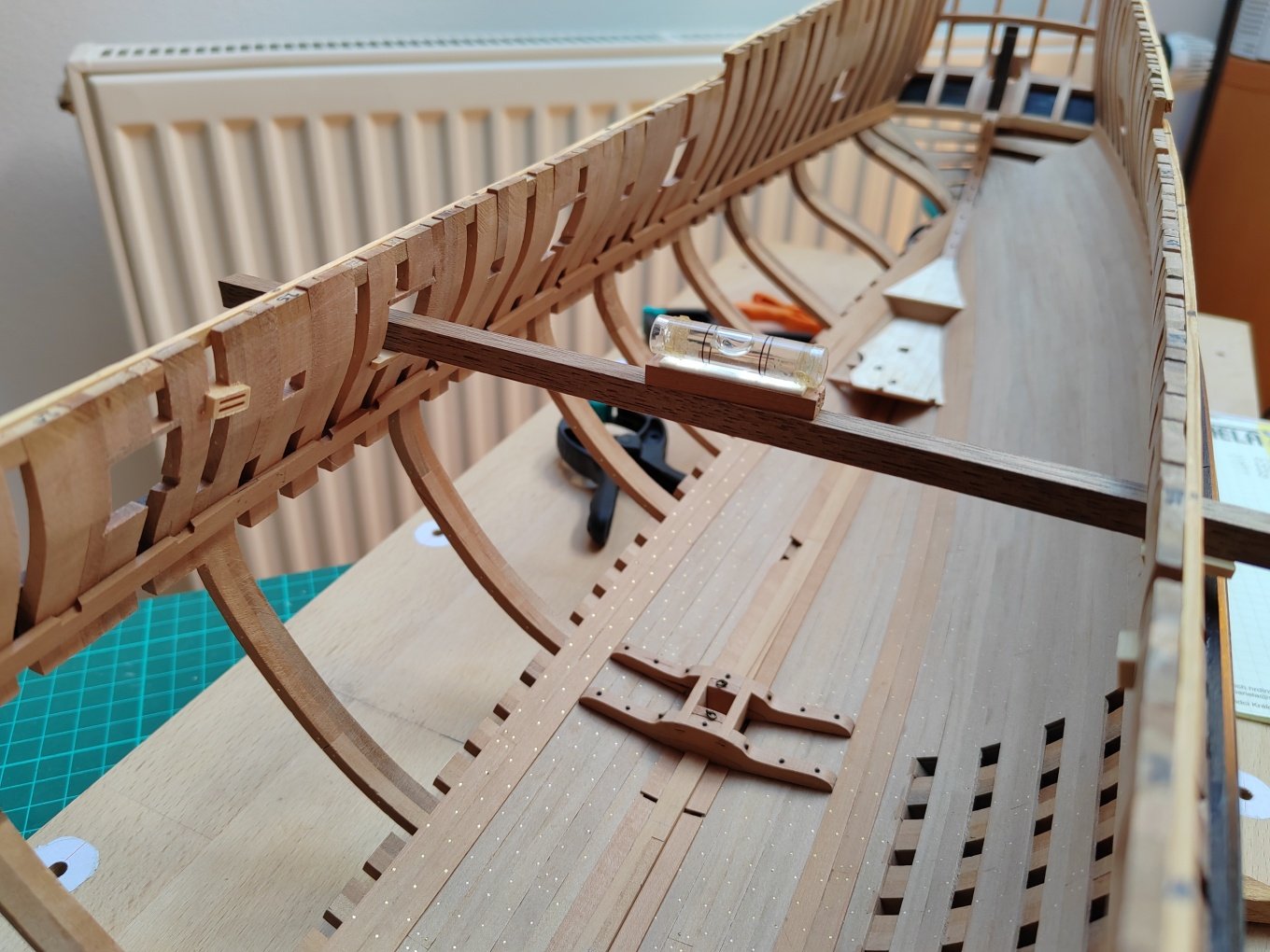

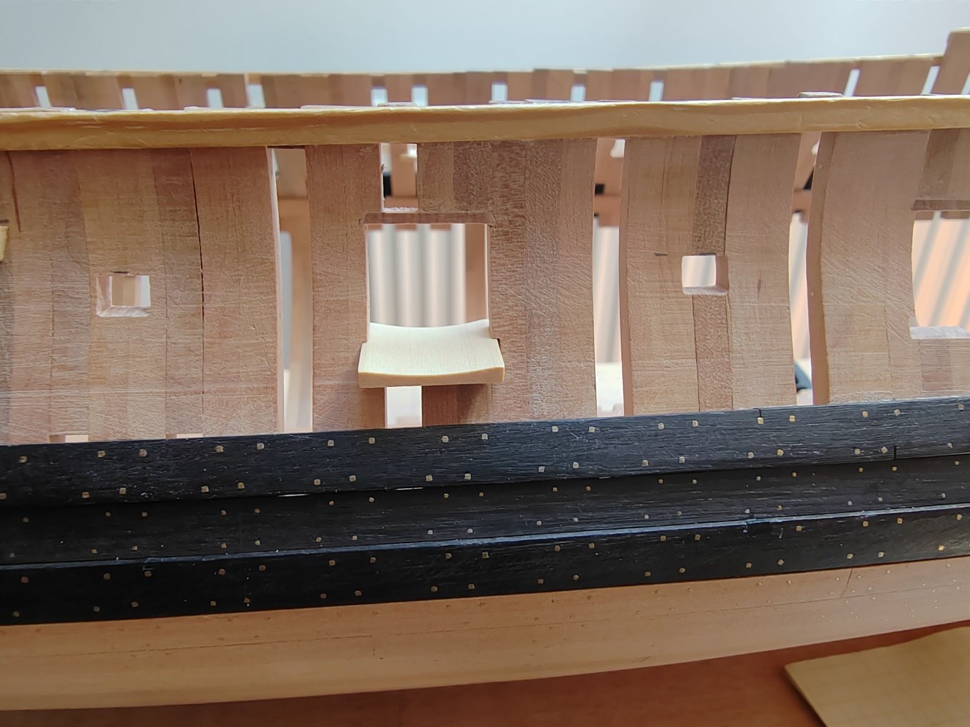

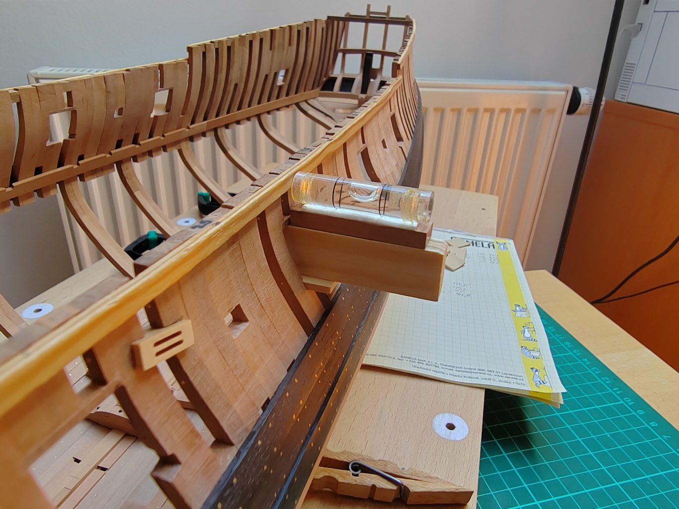

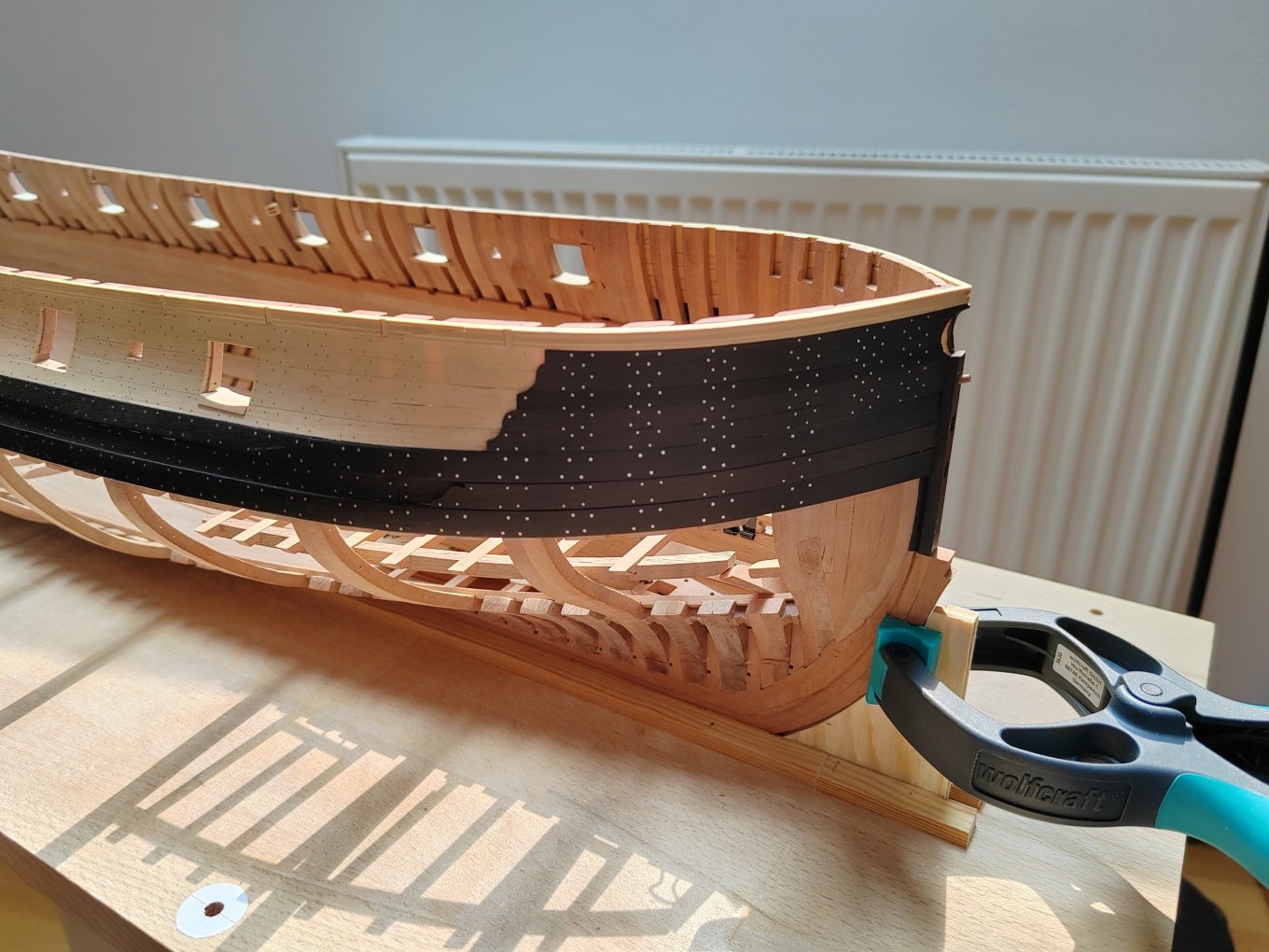

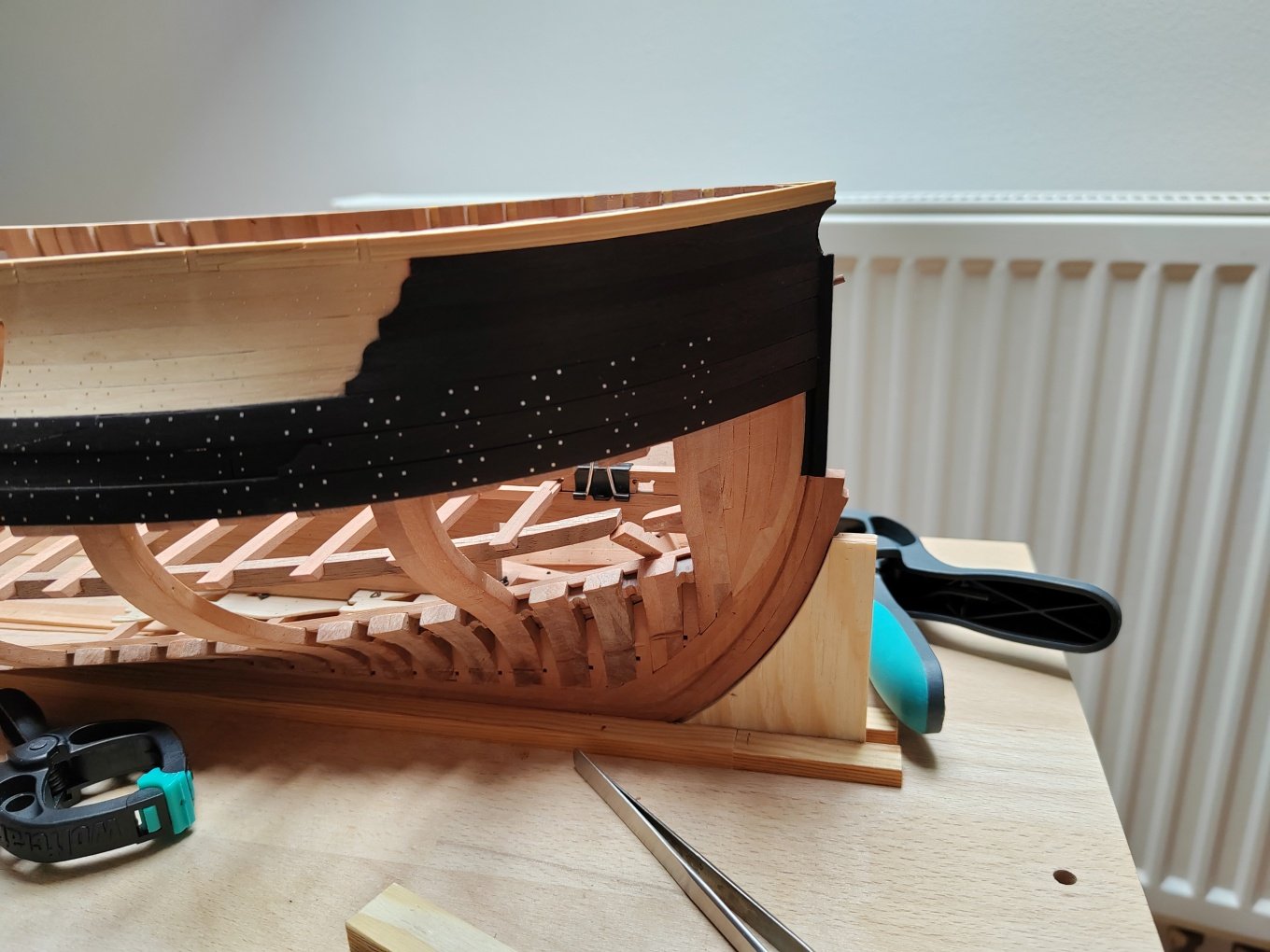

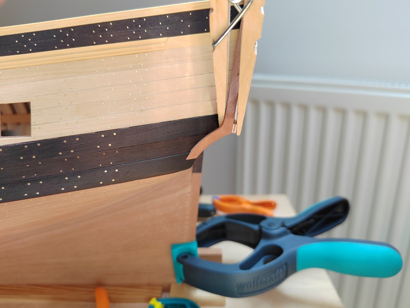

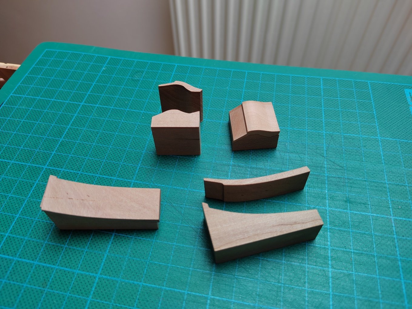

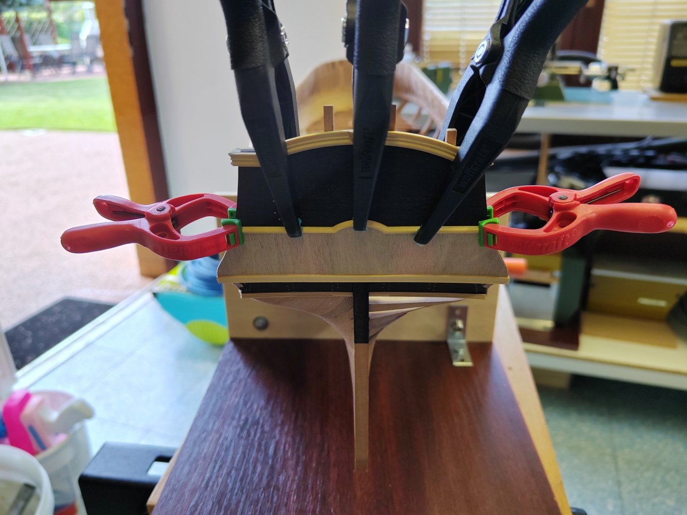

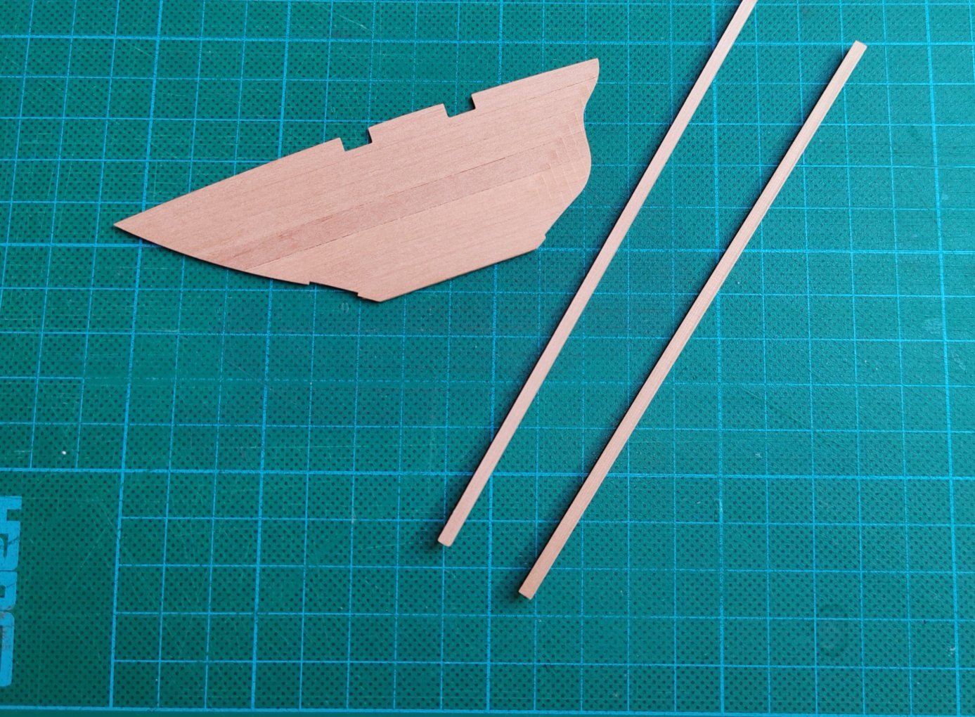

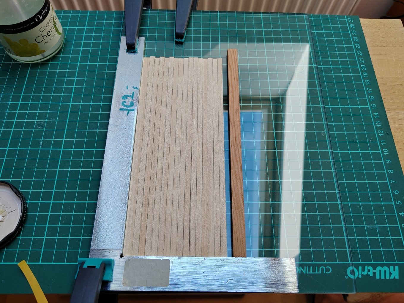

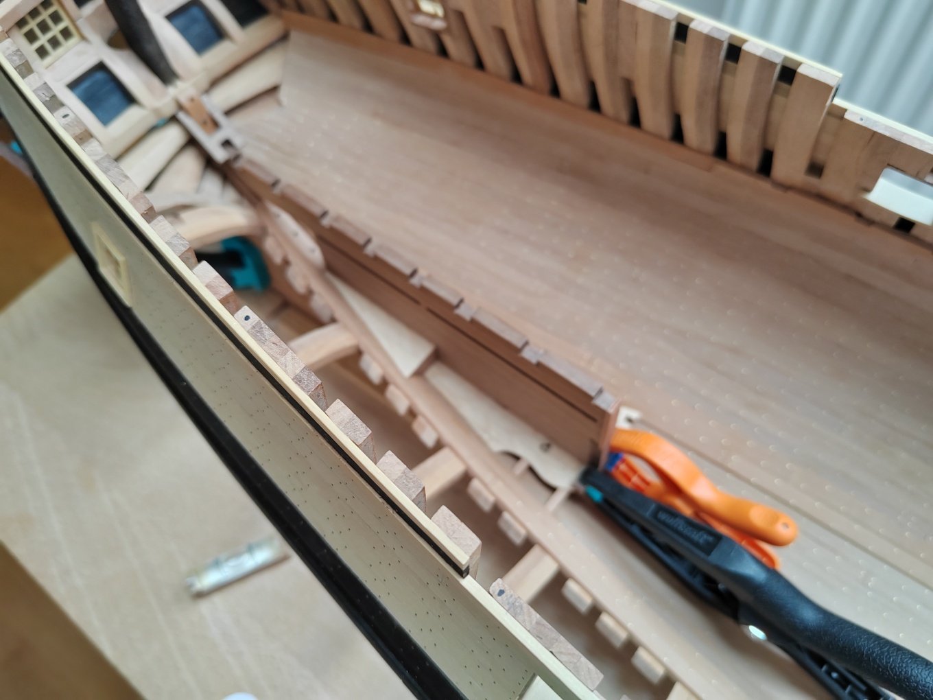

I continue by planing the "thicker" part of the bow.

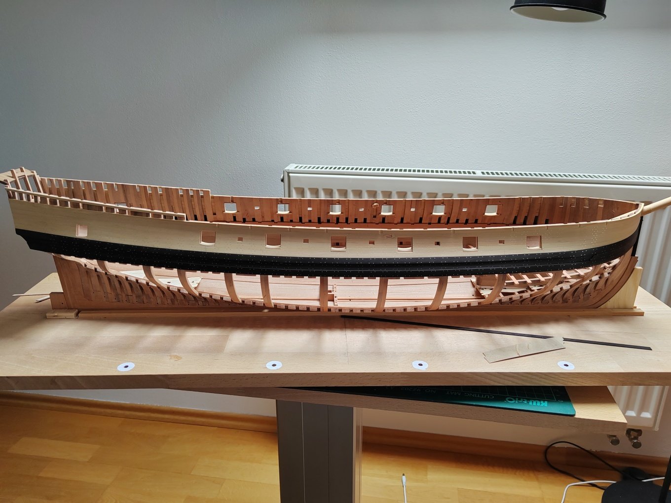

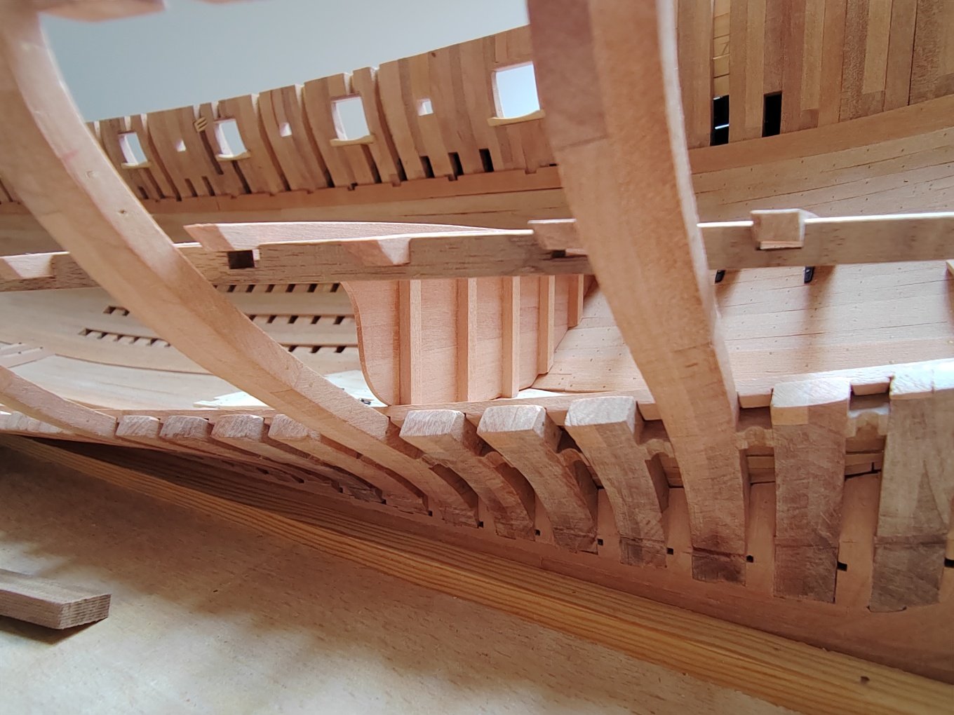

The cutaway port side of the hull in the last photo looks really cool!

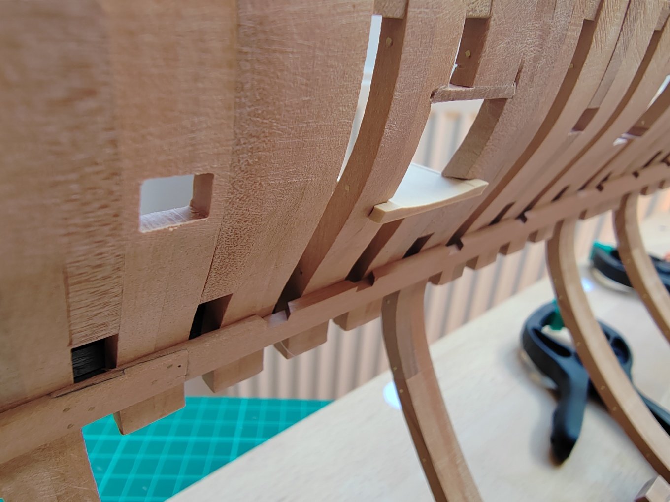

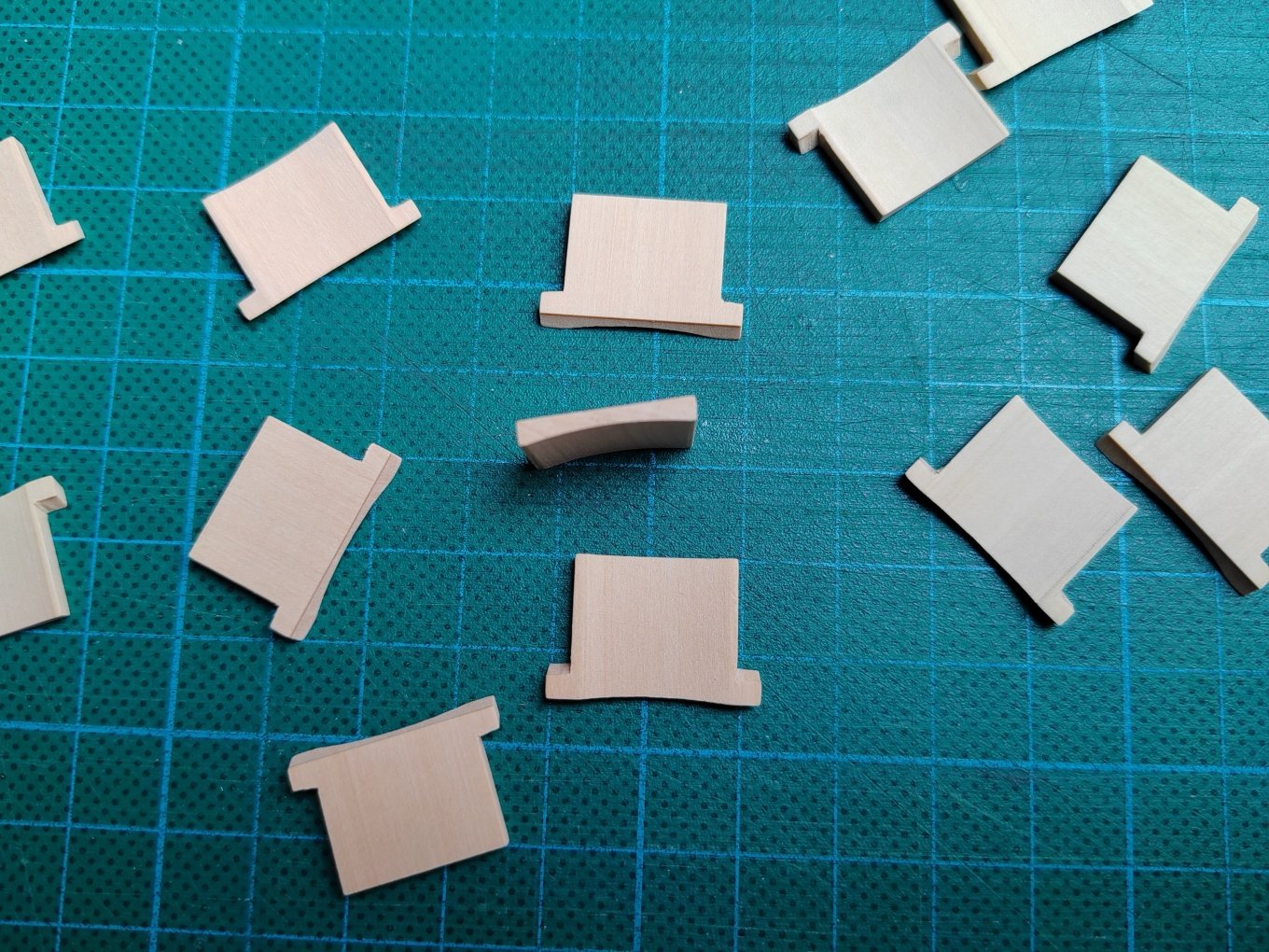

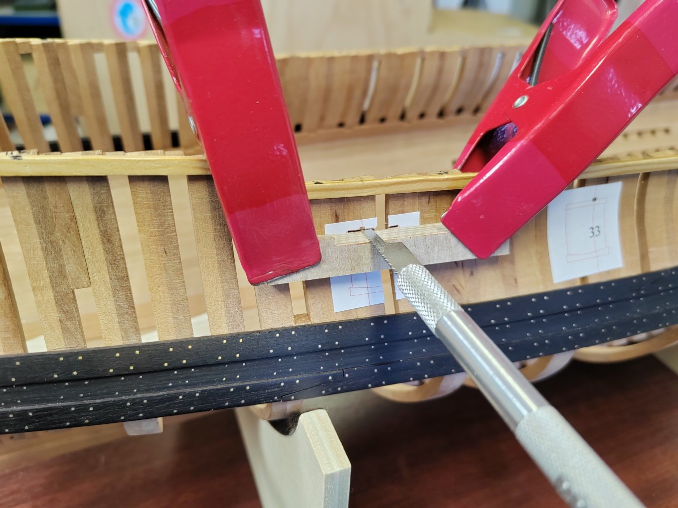

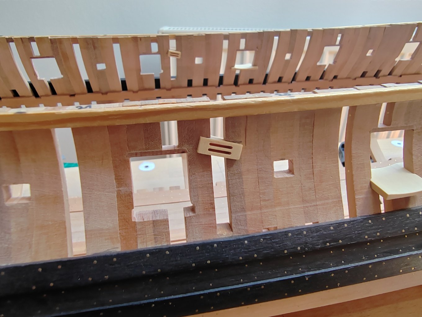

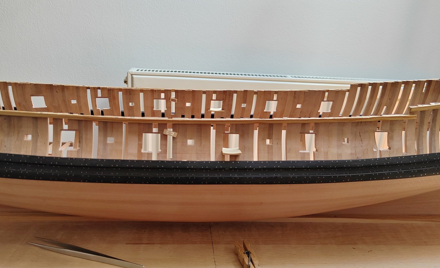

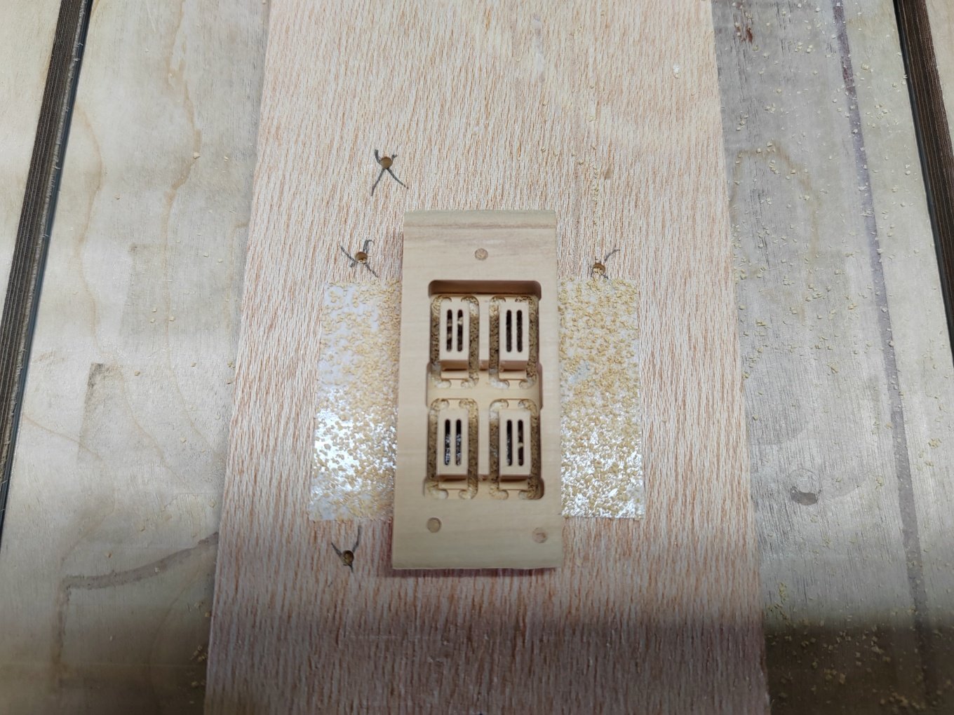

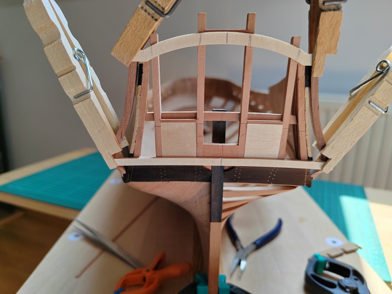

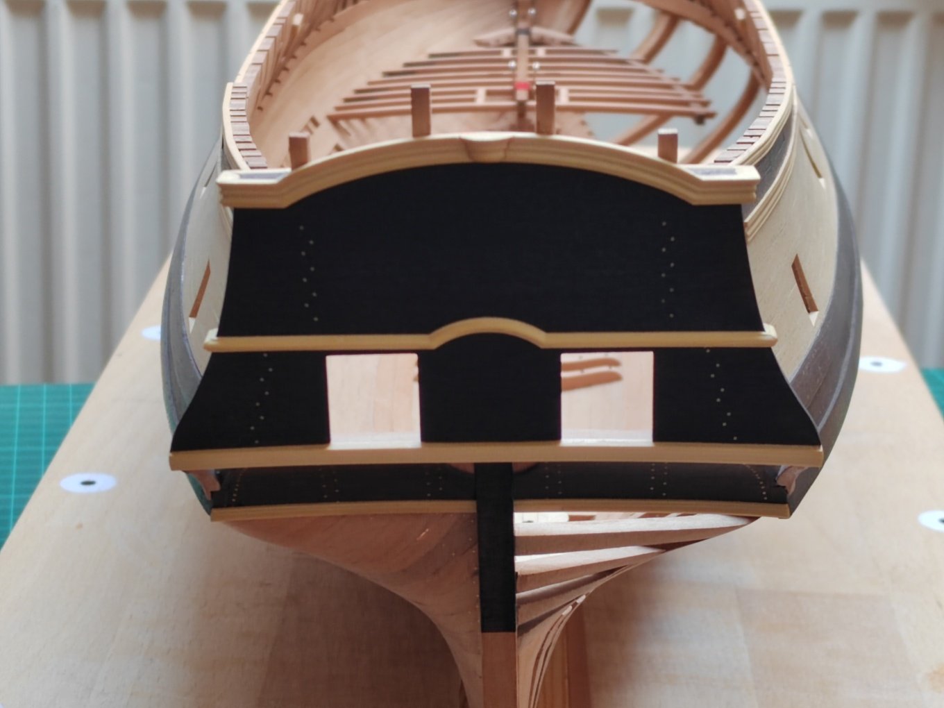

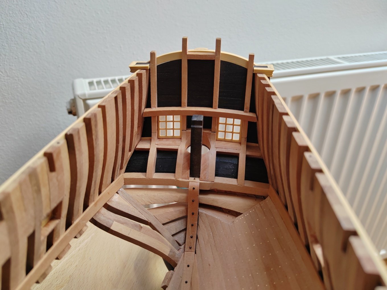

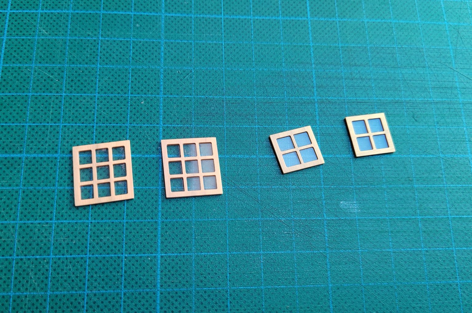

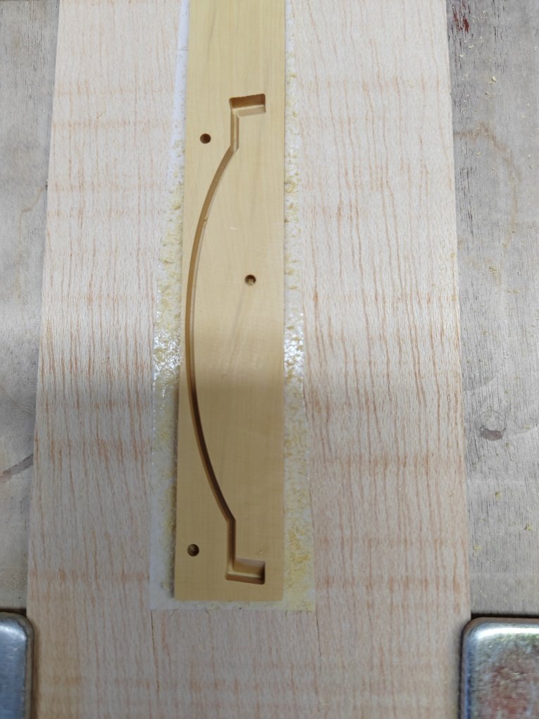

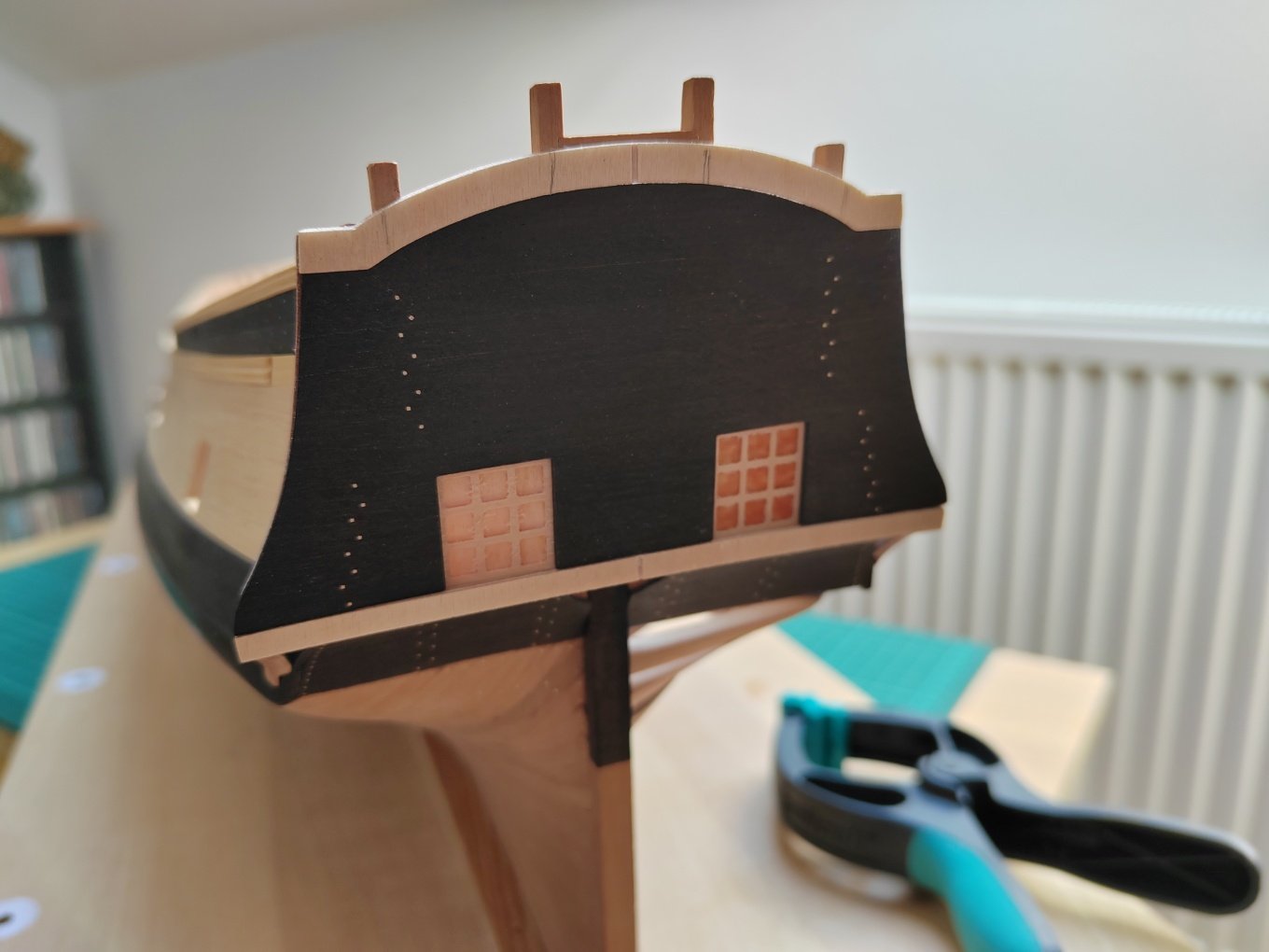

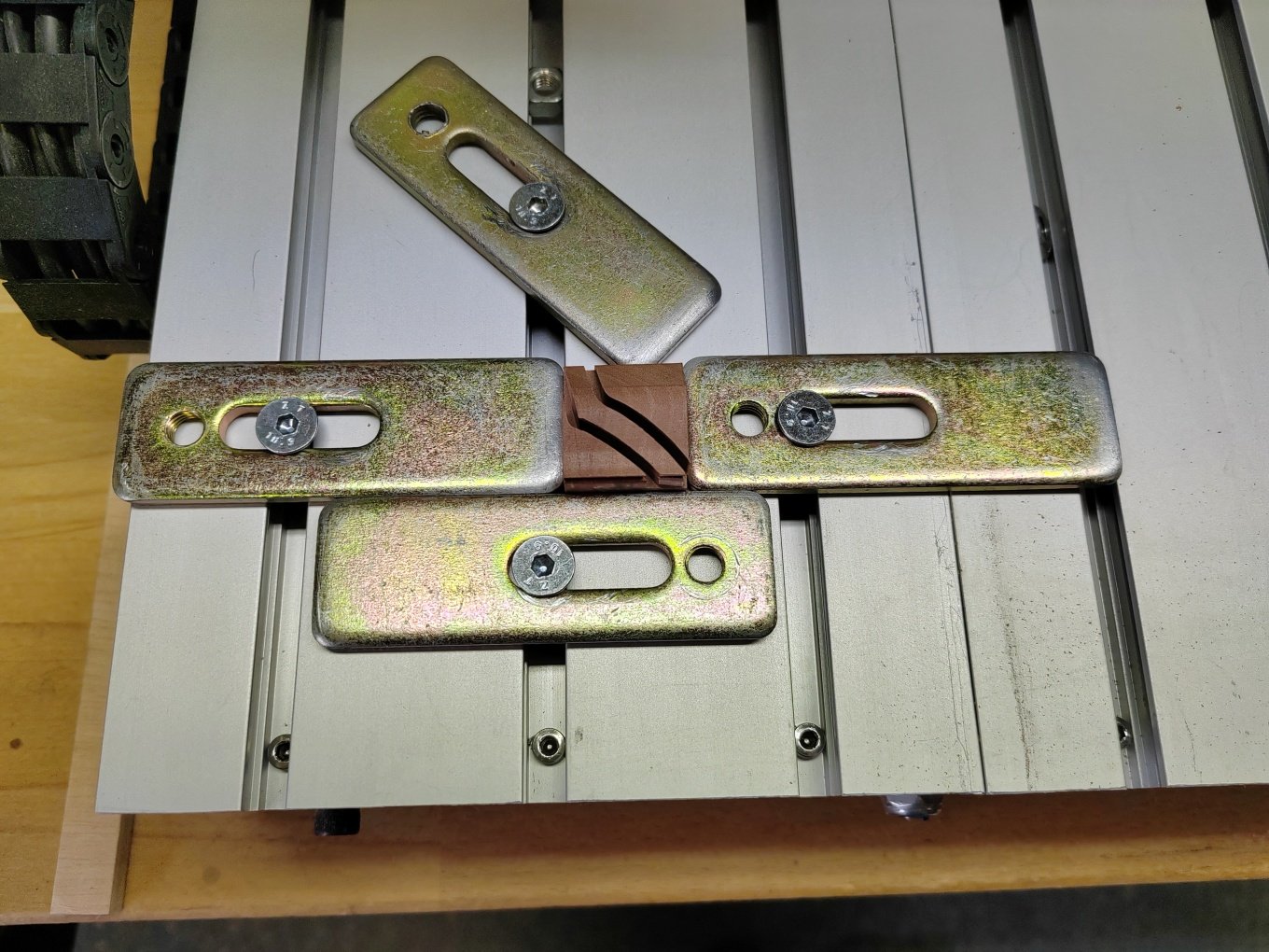

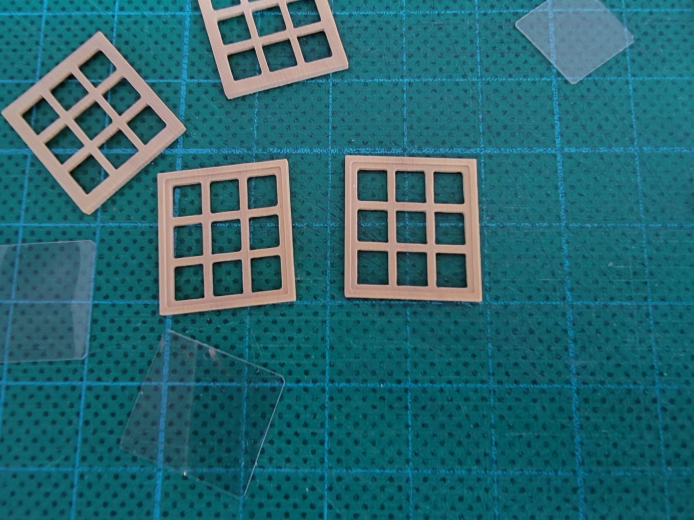

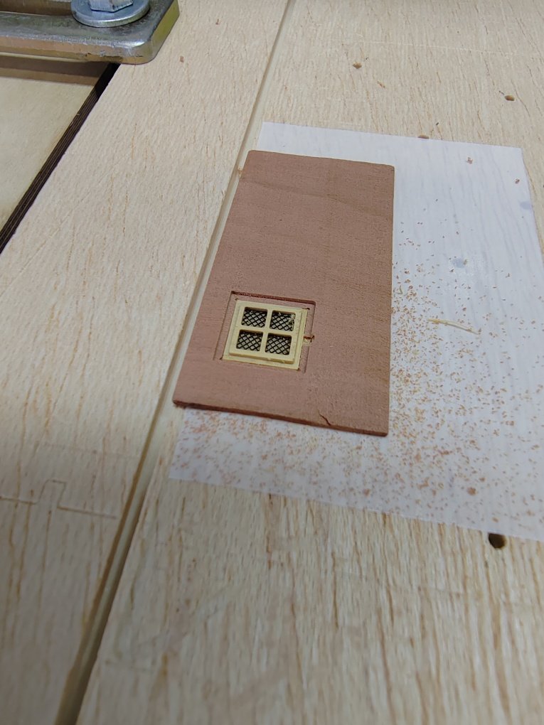

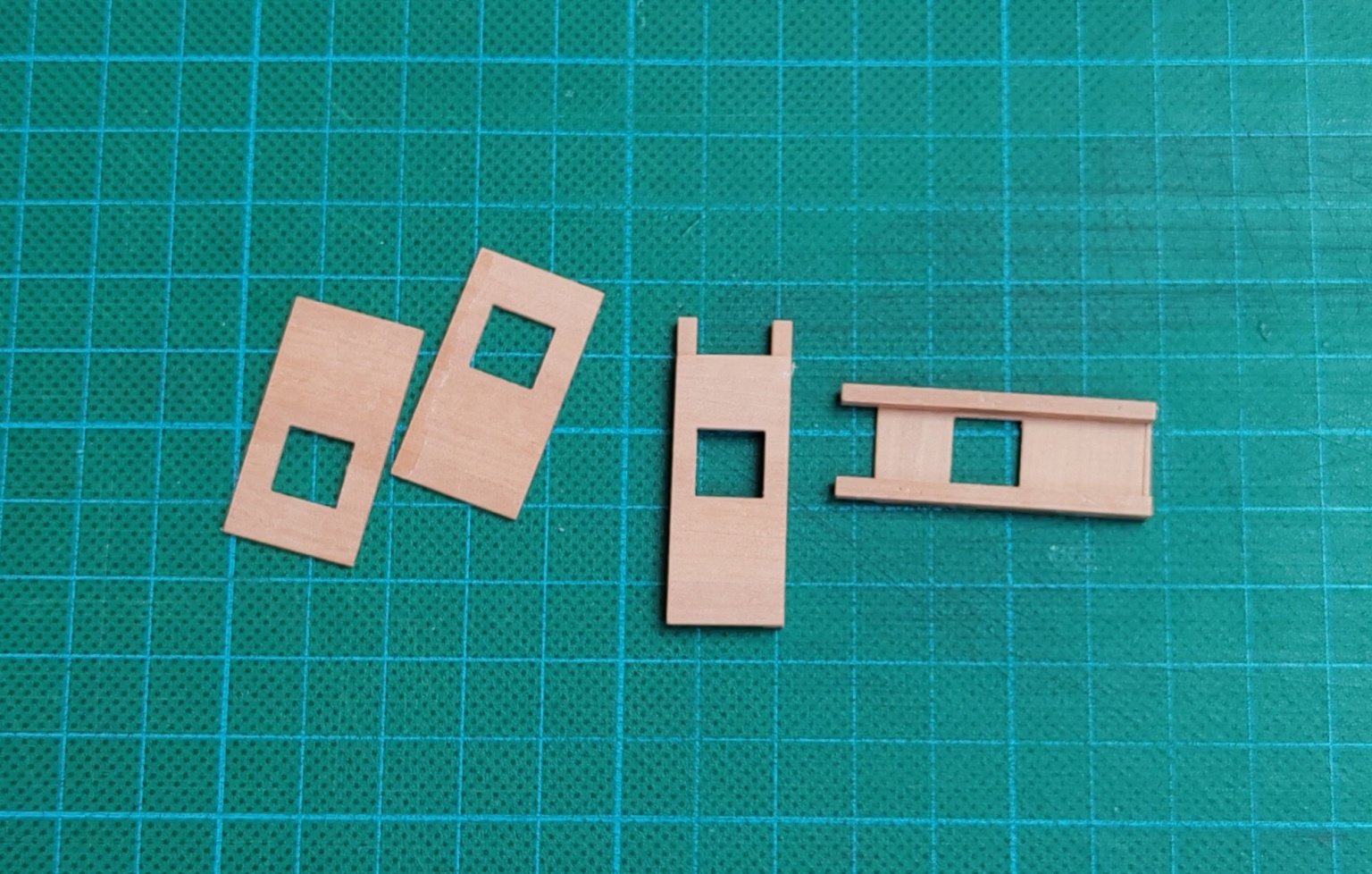

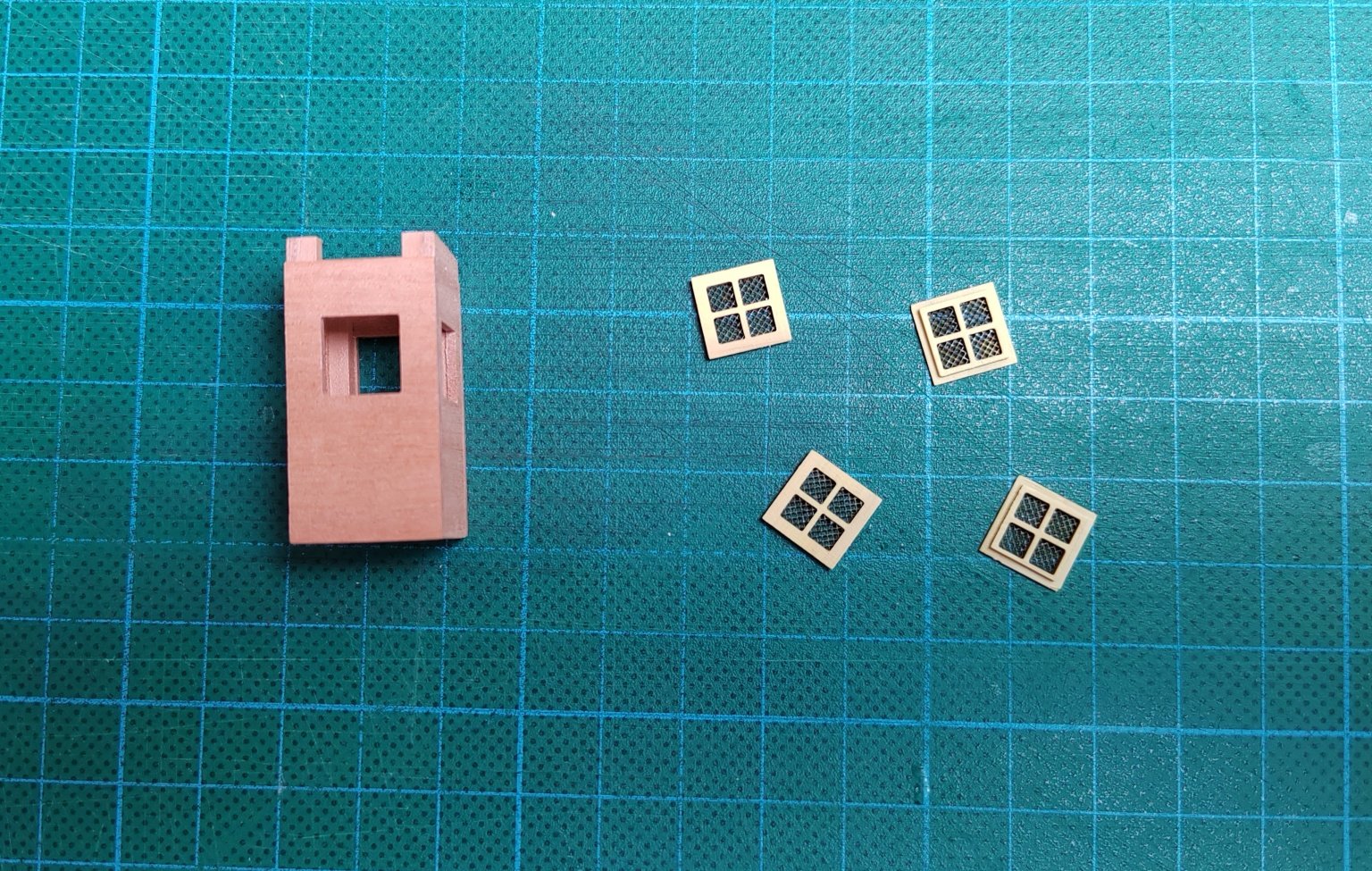

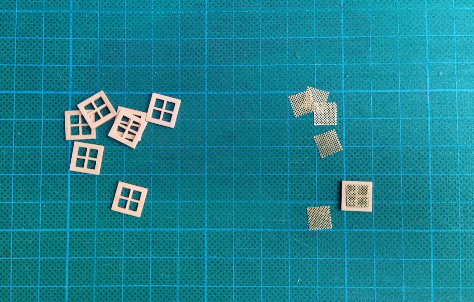

Windows - the last part on the stern, then I will continue on the inside of the hull. I chose the same method as for Le Gross Ventre - a frame made of two halves, in one half a pocket is milled for embedding plastic foil. After gluing, the whole is milled on both sides to the required thickness.
An interesting solution to 'glazed' windows. Any difficulty with static and dust from milling on the plastic?

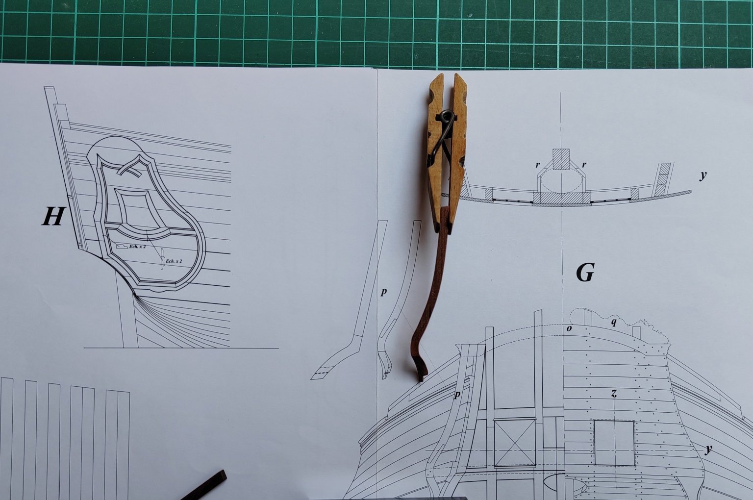

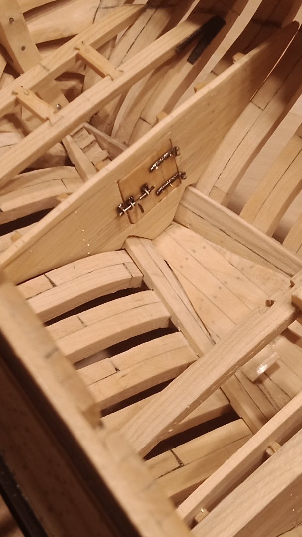

marsalv beautiful work - I have to ask how did you make the metal hinges for the door?  They really look to scale and are so tiny - Mark
5 minutes ago, marsalv said:
Hi Mark,
the metal hinges are made from brass etched parts.
Vladimir
Thanks Vladimir they look very realistic did you etch them yourself or is something that can be bought.  The reason I ask I would be very interested in either learning how to do the process or even better purchase some.
The etchings are made by a Czech company that is professionally engaged in the production of etchings. But the design of the etchings is my own, i.e. the company will make the etchings exactly according to my requirements.

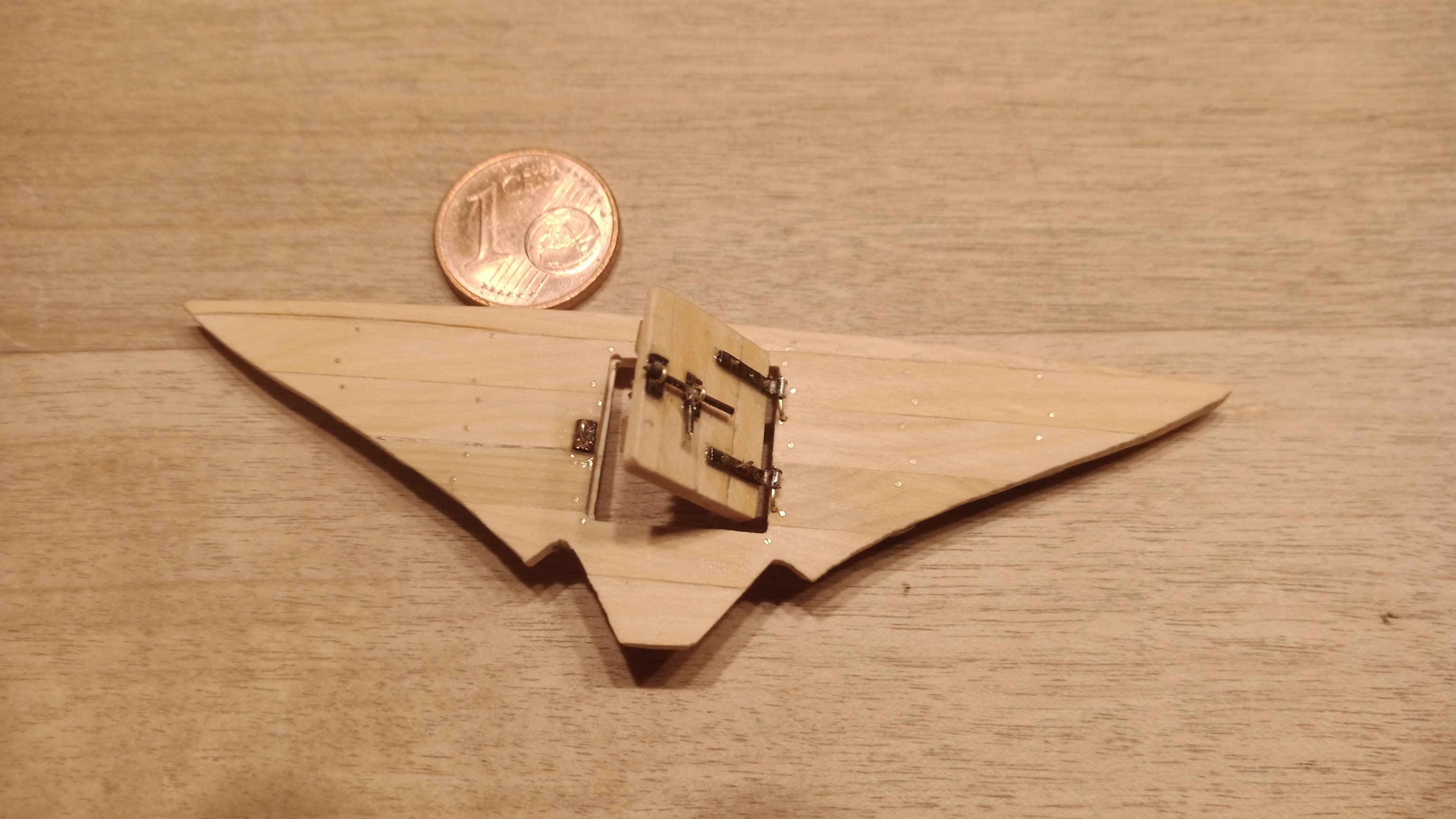

Hello Vladimir
My name is Willi and I'm new here at MSW and this is actually my first post here. One of the reasons I signed up is your report on the construction of l'Amarante.
I'm currently building l'Anémone using the same plans, but only in 1:48 scale and not in the outstanding quality you've shown here. It's a constant inspiration for my own build.
It's precisely this quality that makes it almost seems like a sacrileg for me to point out a possible construction flaw.

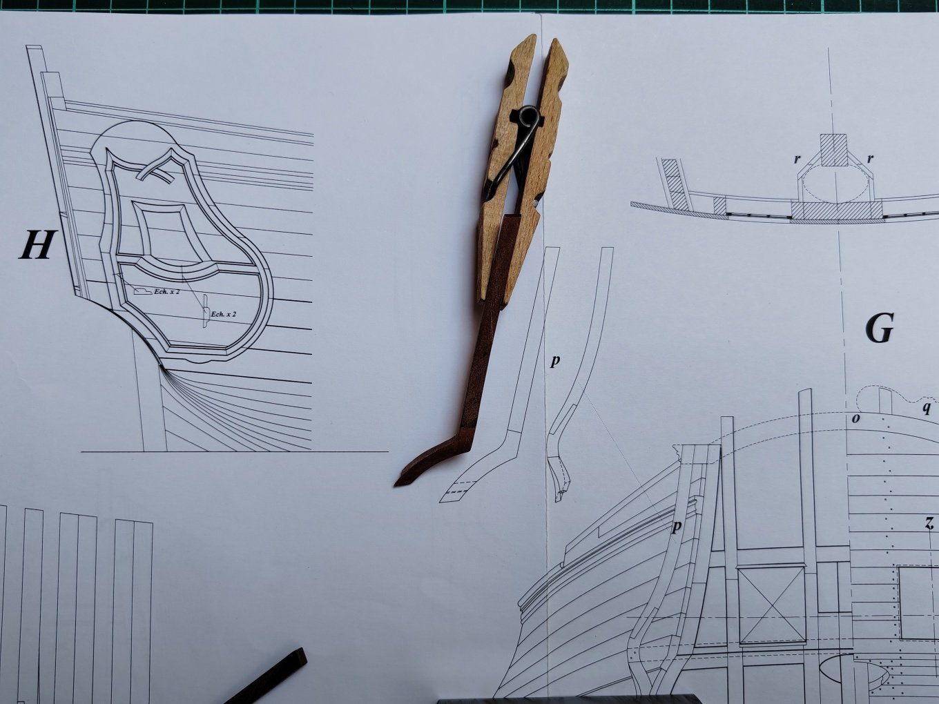

In #112, you show a superbly constructed door with very fine hinges. However, this door can't be opened in this form because its lower part blocks it against the side walls. The lower part would have to be a threshold and thus part of the bulkhead. The door itself only begins where yours reaches its greatest width when viewed from below. I'll try to post a few pictures that hopefully clarify what I mean.
I hope you don't mind my objection, but I didn't want to keep my opinion to myself, because I believe that the perfection you demonstrate is based on the desire to build the model as beautifully and as flawlessly as possible.
Herzliche Grüße
Willi
Edited by Willi
Hi Willi, thanks for your comment. It is quite possible that you are right. But I was based on drawing 16-F. The door is not drawn here, but the bulkhead ends with the door border and the threshold is not drawn here. That is why I chose the solution I presented. Considering the fact that the author of the plans, Mr. Delacroix, is following the construction on the French forum and he had no comments, this is probably not a serious mistake.

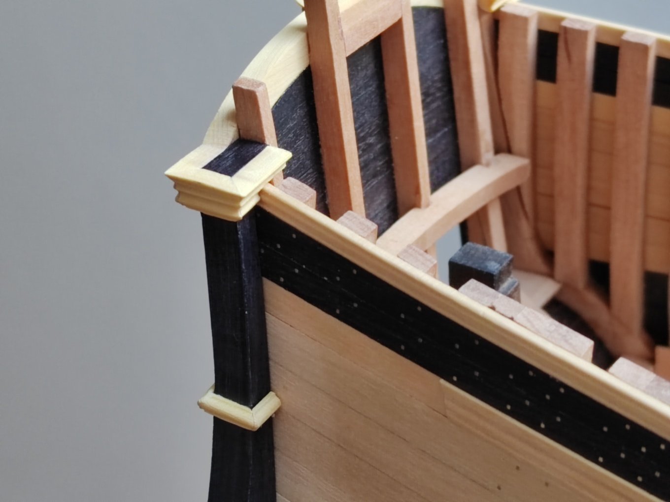

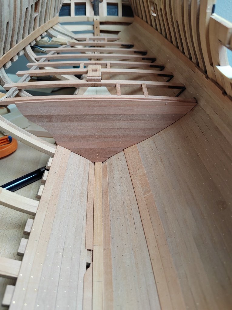

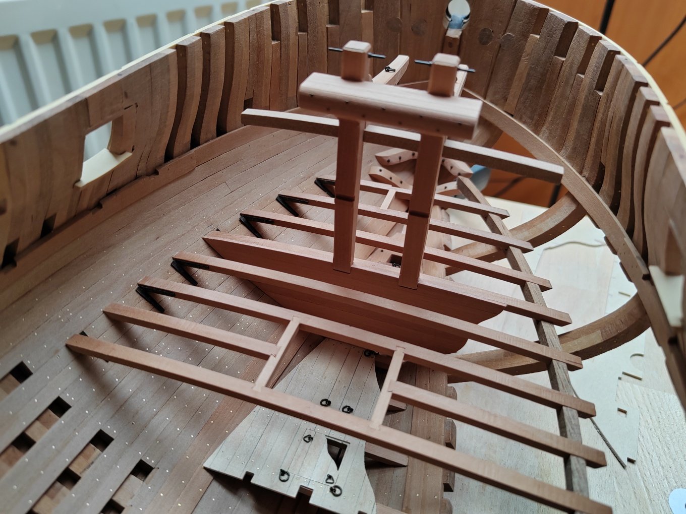

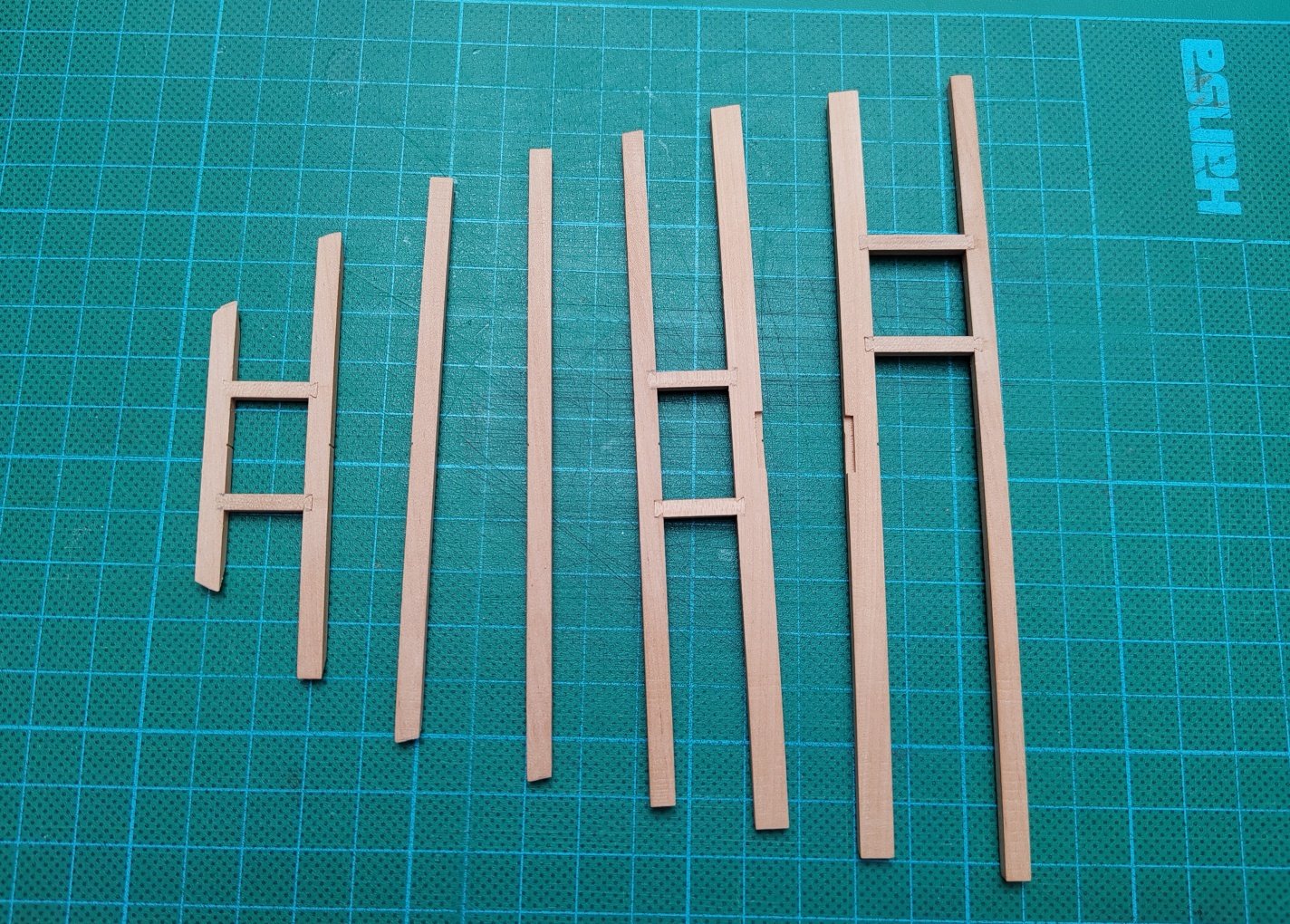

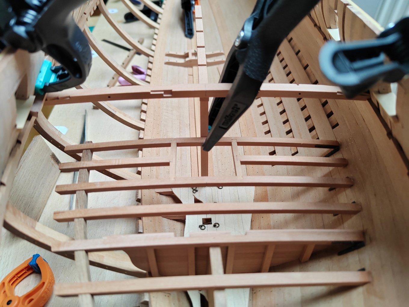

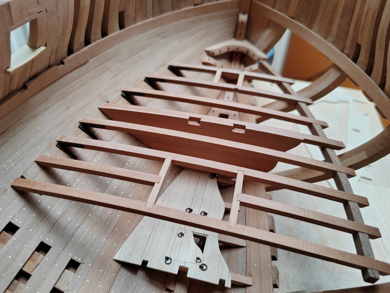

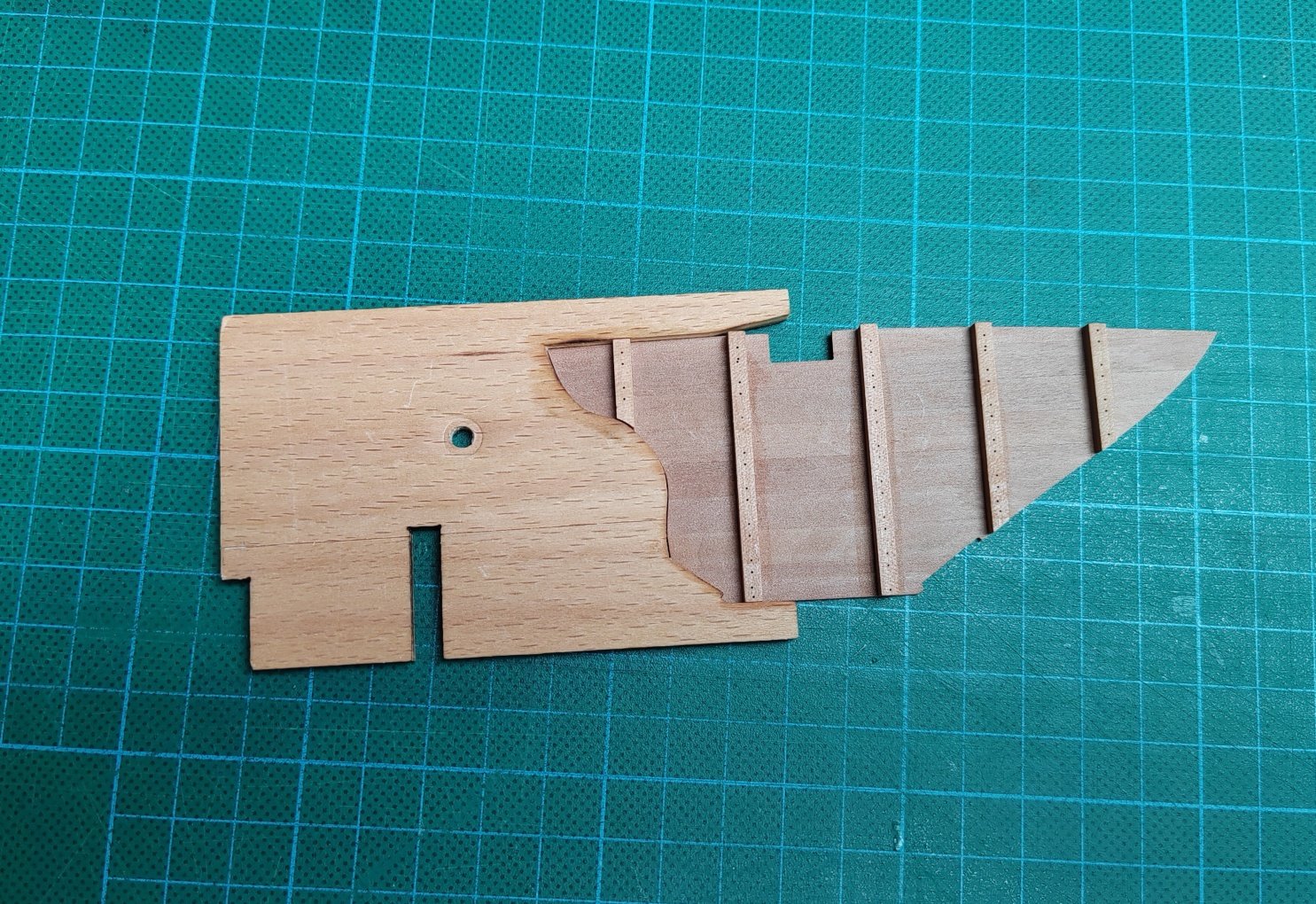

The last parts for the rear space have been made - the light well and the fireproof bulkhead.

Hello Vladimir
Yes, I know Plan 16F; we build our models according to the same plan, as already mentioned.
I don't want to downplay Mr. Delacroix's achievement, but a door that doesn't open can't be right, even if it was designed by a master. Giampierro Ricci didn't notice or correct the mistake either. His model is still wonderful.
But it's your model, so it's your decision. Your model is and remains a true work of art.
Besides, that particular door will be virtually invisible later, so what does it matter?
