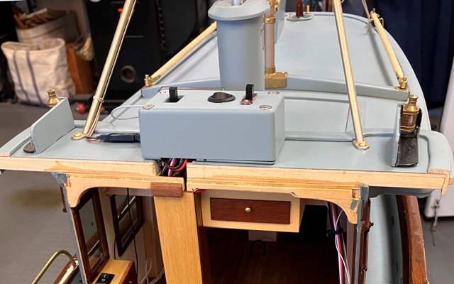

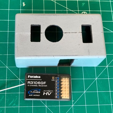

The process of tidying up the wiring of the R/C system proceeded with the modification of a pre-made plastic "project box" to serve as a junction box and as the above-deck location of 3 switches and the receiver. The box was mounted atop the pilothouse directly above the vertical wiring trunk in the cabin. A cover was later built to shroud the switches from the elements.
Octimage1.JPG.9dc12182211cd37685d8c28f78025663.JPGOctimage2.JPG.71de74f42a4cd165cb62d4124cca63b5.JPG

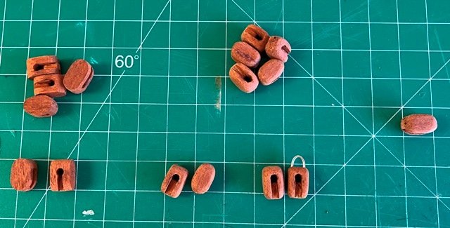

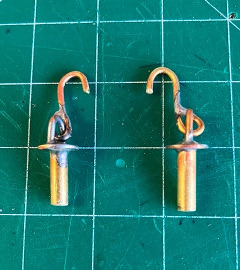

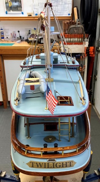

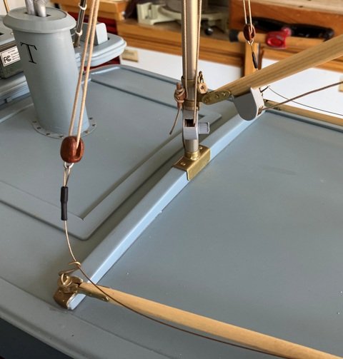

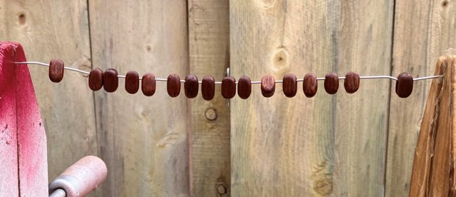

The rigging for the mast and booms required a number of blocks. These were fashioned from a length of 5/16" x 5/16" mahogany and bits of s/s seizing wire were used for bails and beckets.
Octimage3.JPG.e32198da5bd1361066fb2a74dfbb6e83.JPGOctimage4.JPG.02b4e735c163a26f213e3c9f92f44c84.JPG

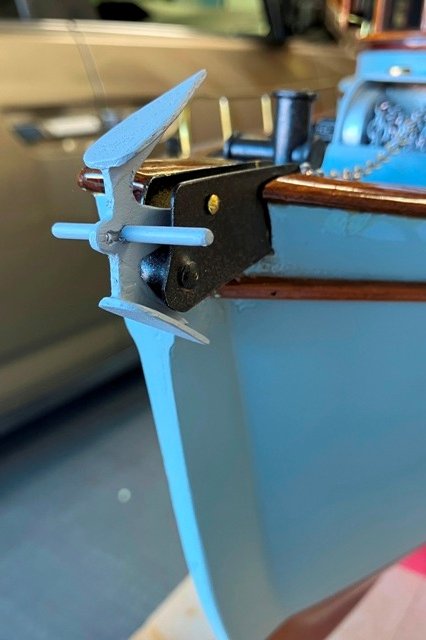

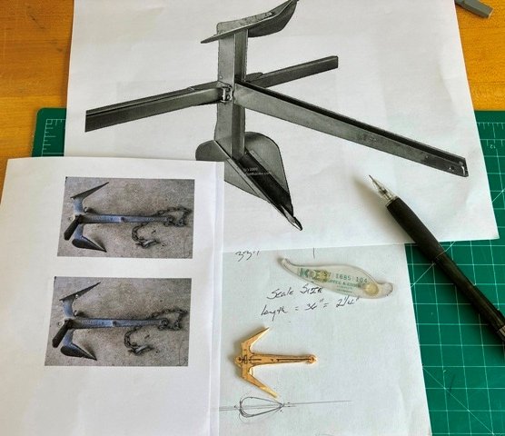

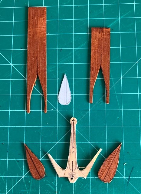

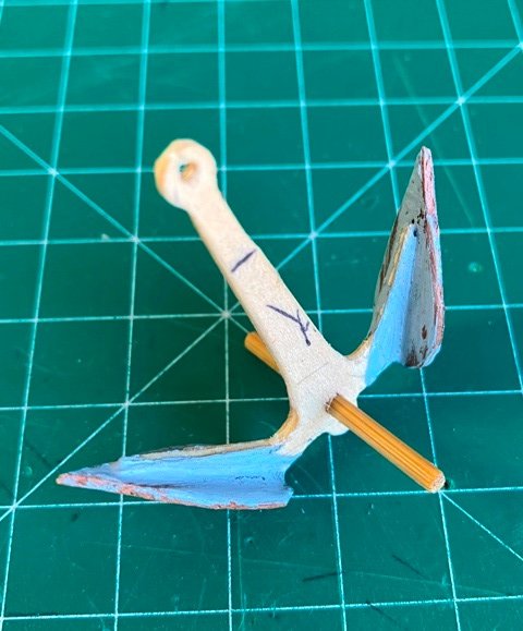

A scale Northill-style non-folding anchor was built up from 1/16" birch ply, with mahogany flukes and a bamboo dowel cross arm. Primer grey imparted the look of a galvanized finish and it was hooked to the anchor chain off the bow.
Octimage5-Copy.JPG.a545c1e24fb81e4af3c55ea14cefe768.JPGOctimage6-Copy.JPG.b51bb7571c08a480c2538c8cff1ff419.JPGOctimage7-Copy.JPG.ec42aafca611e50f9dde47b1bfce14d3.JPGOctimage8-Copy.JPG.ad0c01e840e2812f663c13909f3f4a43.JPG

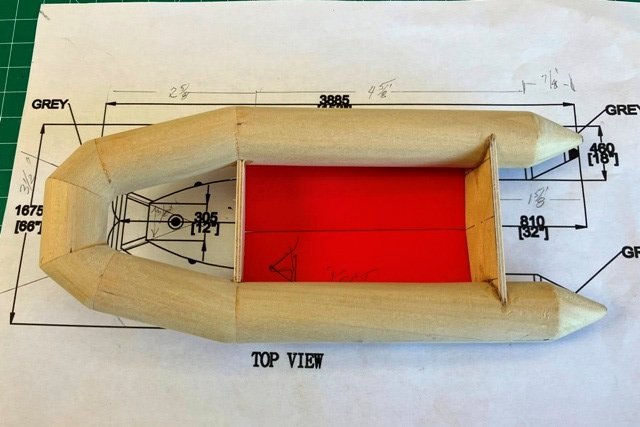

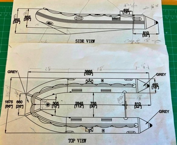

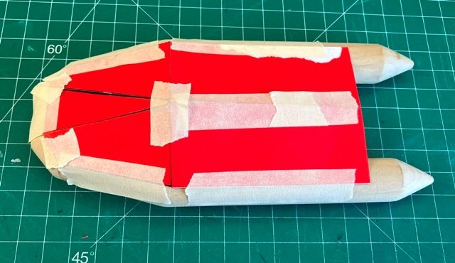

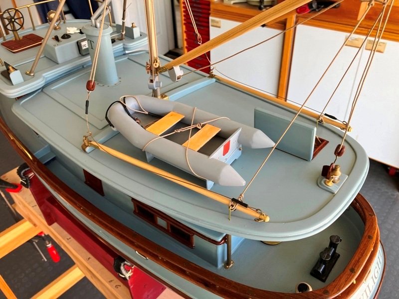

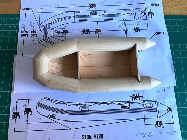

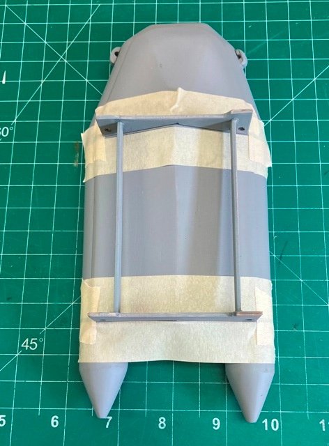

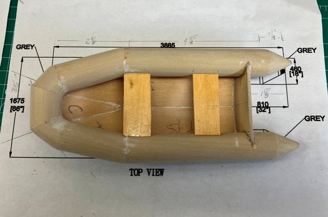

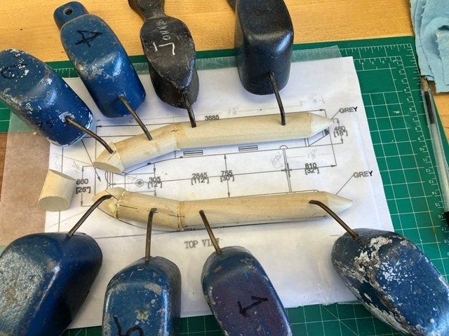

The tender was up next. While we are not normally fans of "rubber-ducky" inflatables, past experience in Northern BC waters had shown that it made some sense for a powerboat.  So an online search turned up suitable scaled drawings of a hard-bottom version.  The "tubes" were cut from 7/8" diameter dowel stock, the bulkheads were cut from 1/8" th. ply and (after patterning the required pieces from card) the bottom was glued together from pieces if 1/16" ply. The thwarts were cut from AYC planking stock.  Once painted, a cradle was constructed to secure the tender atop the main cabin roof and it was lashed down.
Octimage9.JPG.7c90dd1be7aa22f3dca0e4b758e89ef7.JPGOctimage10.JPG.3f6ae5cbda3342edb6f79a1d66de0d29.JPGOctimage11.JPG.3d10be8e8fac3189c34dfd5fcbd87747.JPGOctimage12.JPG.4f6ae3bae8c76f7d552bcf07cd65f469.JPGOctimage13.JPG.6b1f8ad3cd4b9c36ed32031e1b67e7d0.JPGOctimage14.JPG.e7296cd1fcea1e8161d0173e52958426.JPGOctimage15.JPG.34afc7102cae460f326580805385d29b.JPGOctimage16.JPG.31933b6def21d7a4805c482ab4c83143.JPG
Once the blocks were completed, rigging was made up for the mast and booms and a couple of small bits of hardware added to control the boat boom hoist pennants. Simulated electric winches were mounted on the mast and boom.
Octimage17.JPG.81c7d26557eceb0ec385c7043b4c8d73.JPGOctimage18.JPG.4caa047b55020c15f98f330d4d2b40ba.JPG

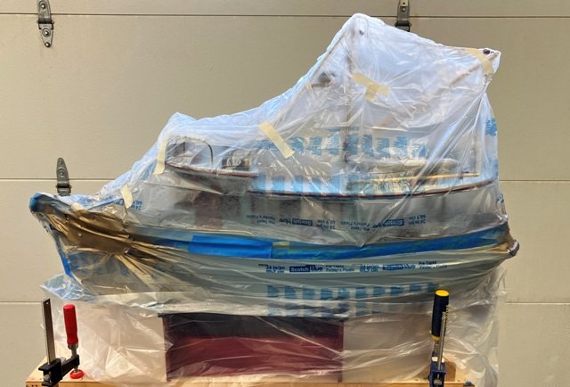

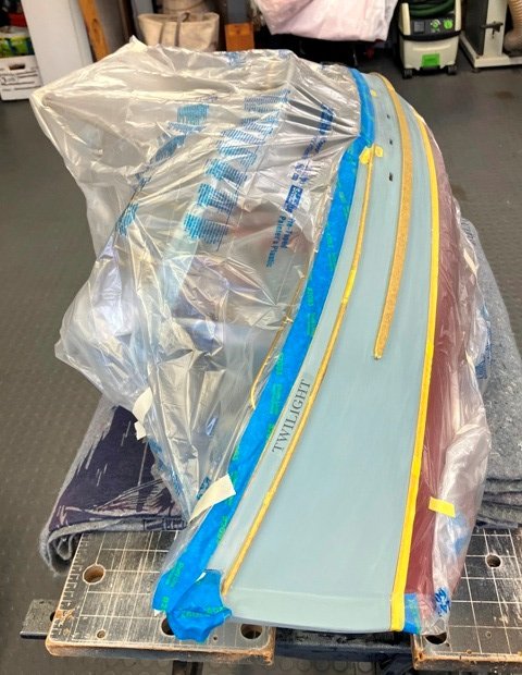

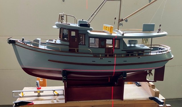

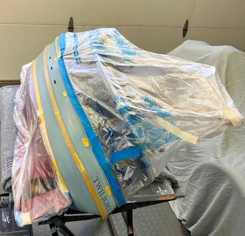

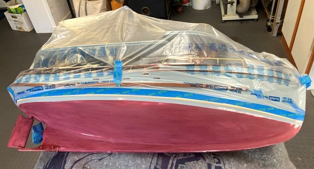

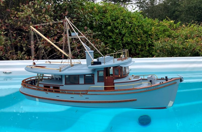

At this point, the topsides was substantially complete, so TWILIGHT was once again toted over to the friends' pool in order to take accurate measurements of her actual loaded waterline location.  When I had first floated the model without the top hamper, she weighed 18.5 lbs.  For the second (more complete) floatation test, she was again weighed and the scale settled at 23.4 lbs.  The latest test demonstrated that the WL should be painted 1/2" above the initial DWL.
The laser level was again utilized to connect the measured points at the bow and stern and a fresh upper line was marked.  Masking tape and film were used to shield the topsides from overspray, the hull was sanded and wiped down prior to giving the bottom a fresh coat of bottom paint.
Octimage21.JPG.f1fc15f78562ca5cd41a1817bf756911.JPGOctimage22.JPG.fc6751b4401679870f3d0c6abca9f183.JPGOctimage23.JPG.f0e7a9afd160b103d5715e3525e02c60.JPG

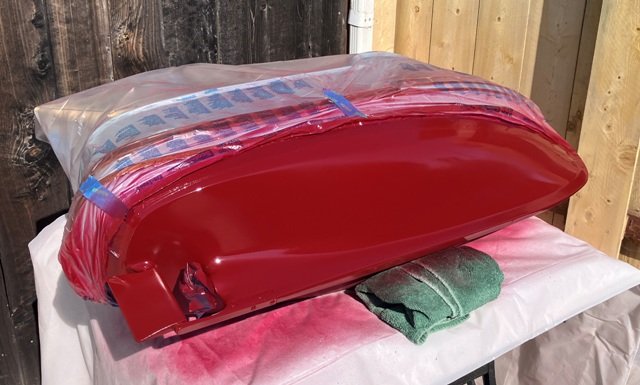

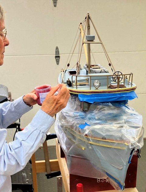

The re-painting of the bottom highlighted the fact that the topsides of the hull also needed some attention to remove scratches, fingerprints and varnish/epoxy drips. Lots of additional taping and sanding were required in preparation. Once this portion had been painted, Vicky's steadier hands were again brought into play to paint the trim color on the cabin top beadings.  And to complete the saga of taping, I masked around the portions of the topsides where a fresh set of TWILIGHT's name decals were to be applied over gold painted "badges".  The application of the decals followed and when they were dry, a couple of light coats of clear flat acrylic were sprayed on to help seal them from the water.
Octimage27.JPG.ae18e6f753b28adefad3cd3fb30c2c21.JPGOctimage28.JPG.f1694e91678d5db3f122fadf8bc87cc9.JPGOctimage29.JPG.170997e9afc85b691267e476833d7e6f.JPGOctimage30.JPG.9371a5498c1f63711bfb548b412b4a57.JPG
Finally, the layers of the cocoons were stripped away.
Octimage31.JPG.73b044c8989f87ae0dcfccd0bf7ea24d.JPGOctimage32.JPG.227f6ab86c55dd42f41a014b3d942a35.JPG

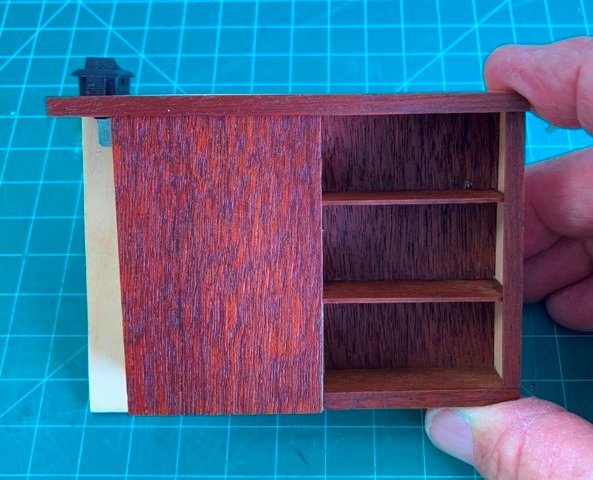

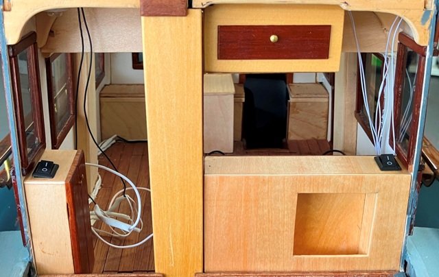

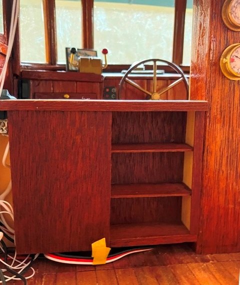

To finish up mounting R/C switches, I built a small double-sided cabinet to fit between between the pilothouse and the main cabin. The forward face into the pilot house contains a wet foulie locker while the aft face of the cabinet incorporated bookshelves and that final switch, which controls the running lights, occupies a corner of the top.
Octimage24.JPG.3e5e254416a372e5cf46e34a27fcf4d2.JPGOctimage25a.JPG.8b70bc7b8204ff0664e5aaf66ed2a147.JPGOctimage26.JPG.55f43efe9fbe2d0988d337b79f45b5b2.JPG

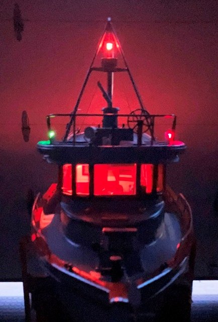

One evening, the interior lighting and the running lights were tested. (My camera had difficulties focussing with this level of light - my apologies!)
Just imagine that it is the view looking aft on a slightly foggy night  😉 .

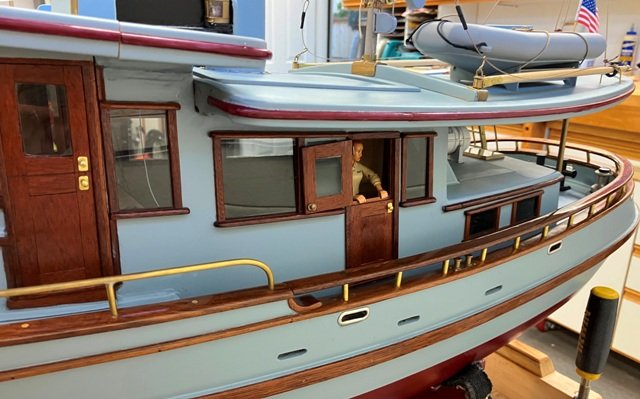

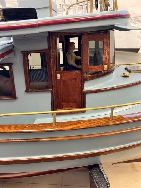

Scale crew members arrived to be experimented with for placement locations.
Octimage33.JPG.1195bc02d48e4f54b8a25f6f710b3d4b.JPGOctimage35.JPG.10f3d069f330f657eb312ed5de32ba86.JPGOctimage34.JPG.97b4a5aeb6caf8b1502bfe6043bc9366.JPG

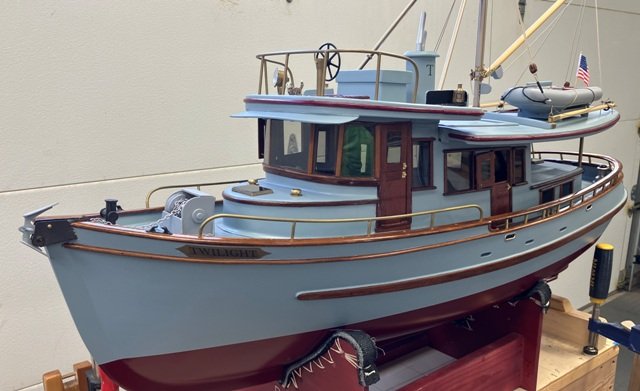

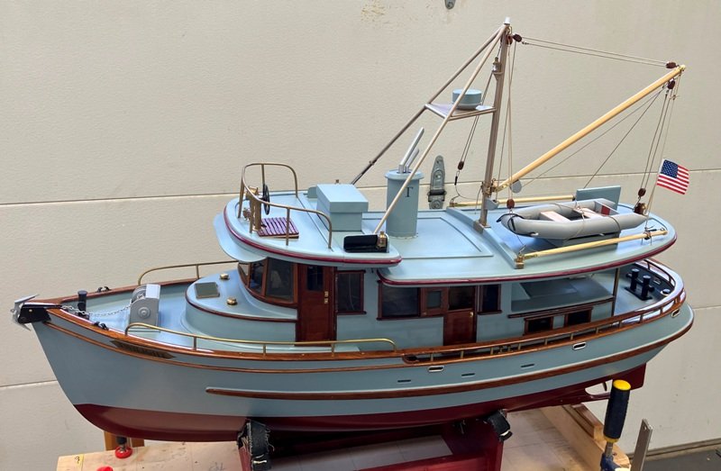

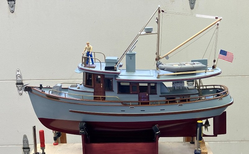

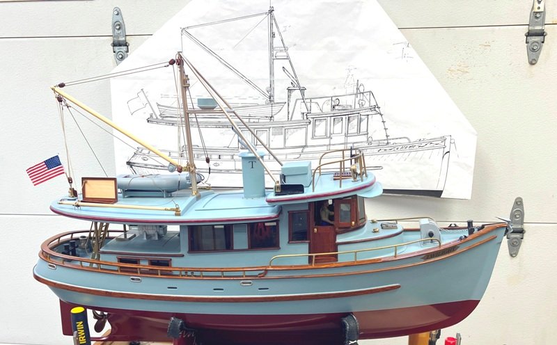

And to finish this update, here is a photo, taken a couple of days ago, with TWILIGHT posed in front of the initial Profile drawing of some years back.
We are awaiting a calm break in the weather to put the model in the salt chuck for some sea trials. Assuming all goes well, she will then return to the boat shop to permit the fitting of the main cabin joinery.
Thanks again for your welcome support,
Cheers,  Craig

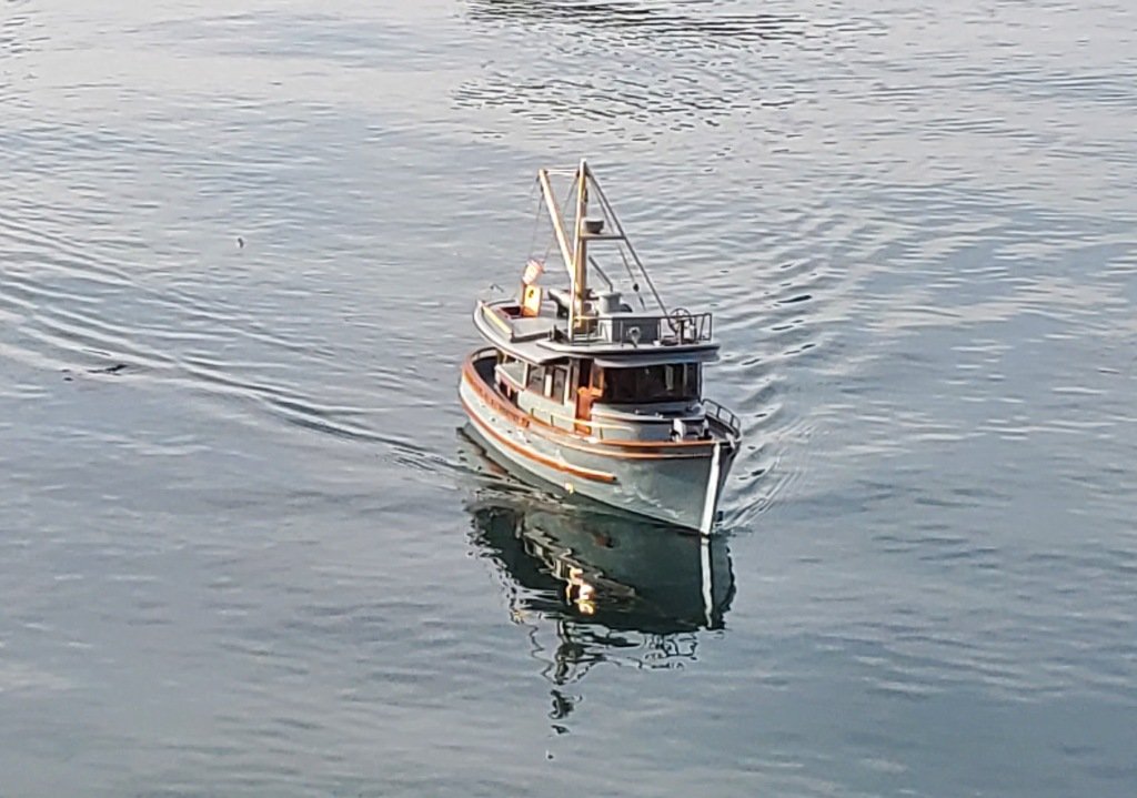

So, the initial "sea trial" in late October was an "interesting" learning experience.
TWILIGHT was placed in the water from a local kayak launch ramp after we had first launched Vicky in her canoe to be the "rescue" craft in case of need.
When I gave the throttle control on the transmitter a slight nudge to the first detent of forward, TWILIGHT's stern suddenly dropped down in a swirl of bubbles, the bow popped way up, the sudden torque from the prop heeled her over to port and she shot forward, wildly swerving to starboard.  This little displacement trawler yacht was trying to emulate PT-109 😲
I jerked the throttle back to neutral while trying to straighten out her course and she coasted to a wobbly stop.  Obviously, something was not right and so, I tried to nurse her back around to head to the launch ramp.  However the pulses of power, brief as they were, set up a surging oscillation, rolling the model from side to side.  I was "behind the curve" with the rudder actions and TWILIGHT ended up broaching to port onto her beam ends and began down-flooding.  By the time Vicky could get to TWILIGHT and grab the cabin top, she was awash.  TWILIGHT did not sink and was able to be brought to shore to be emptied out with a minimum of exterior damage.
The electronics were, unsurprisingly, "toast" and all had to be discarded. It took a number of days to dry out TWILIGHT and I spent some time this discussing the odd throttle behavior with Nick Scalone, of Harbor Models. Ultimately, we were able to focus upon my failure at that time to re-calibrate the transmitter to the electronic speed control unit which governs how much juice to feed the motor. This left the ESC in a default mode and it went instantly to full throttle.  (The joys of electric motors.)  New replacement components were ordered, installed and, most-importantly, repeatedly bench-tested.

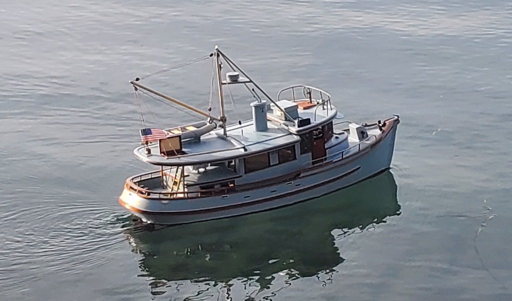

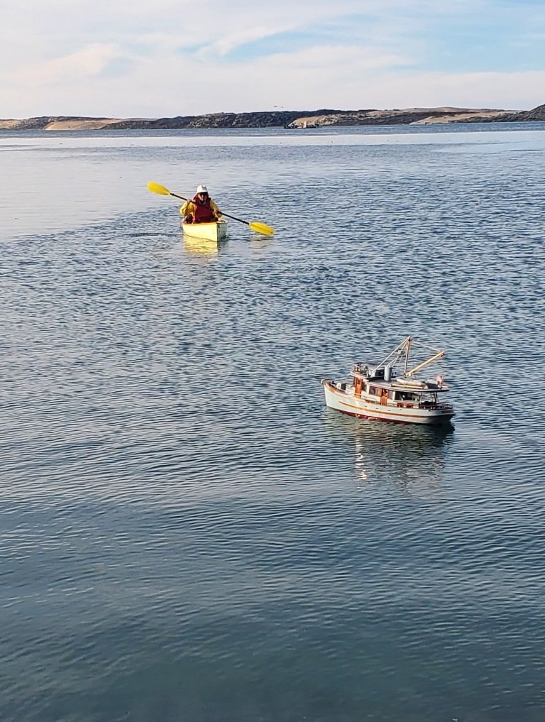

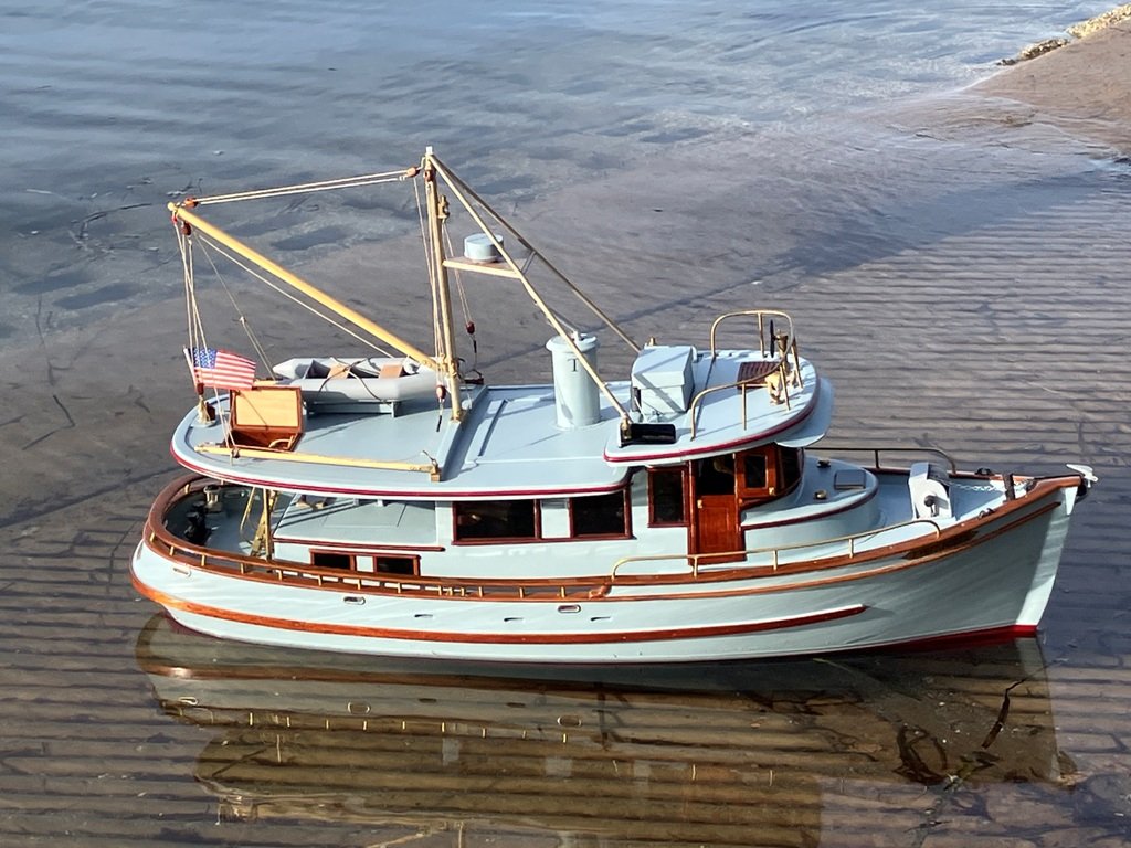

On December 3rd, everything came back together (boat, tides, weather and our schedules) to permit Sea Trial #2.
Once again, we launched Vicky in her canoe, did one more pre-launch systems check and then placed TWILIGHT in the water. This time, things went much better.
(Photos courtesy of Larry Bender)
SeaTrial2image6.jpg.457f490b9ae937fcbb9dcfd3fef3ab9b.jpgSeaTrial2image5.jpg.f0177a76b6e62a59e0ce6995febcad42.jpgSeaTrial2image2.jpg.720f6dc477df0312d6c20de99afb15e4.jpgSeaTrial2image3.jpg.b3a815437b356b371ebe682e08681850.jpgIMG_2032.JPG.c23810d2fe7563e5b4309ae30c186574.JPG
Though the sea trial was shortened by a strengthening wind, I was able to verify TWILIGHT's basic running gear capabilities (and limitations) through a series of maneuvers.  While she is nearly complete topsides, I plan to build out the main cabin joinery modules this winter.  The future may also involve removing (2) of the (4) 12 vdc sealed lead batteries and utilizing that weight savings to place a couple of small streamlined lead ballast "pancakes" alongside the keel on the exterior of the hull to provide additional stability when turning.  We'll see whether that comes to pass and, if so, whether it turns out to be useful.
I must relate that I am truly looking forward to returning to the model shop to make sawdust again after these weeks of wiring and tweaking electrical widgets.

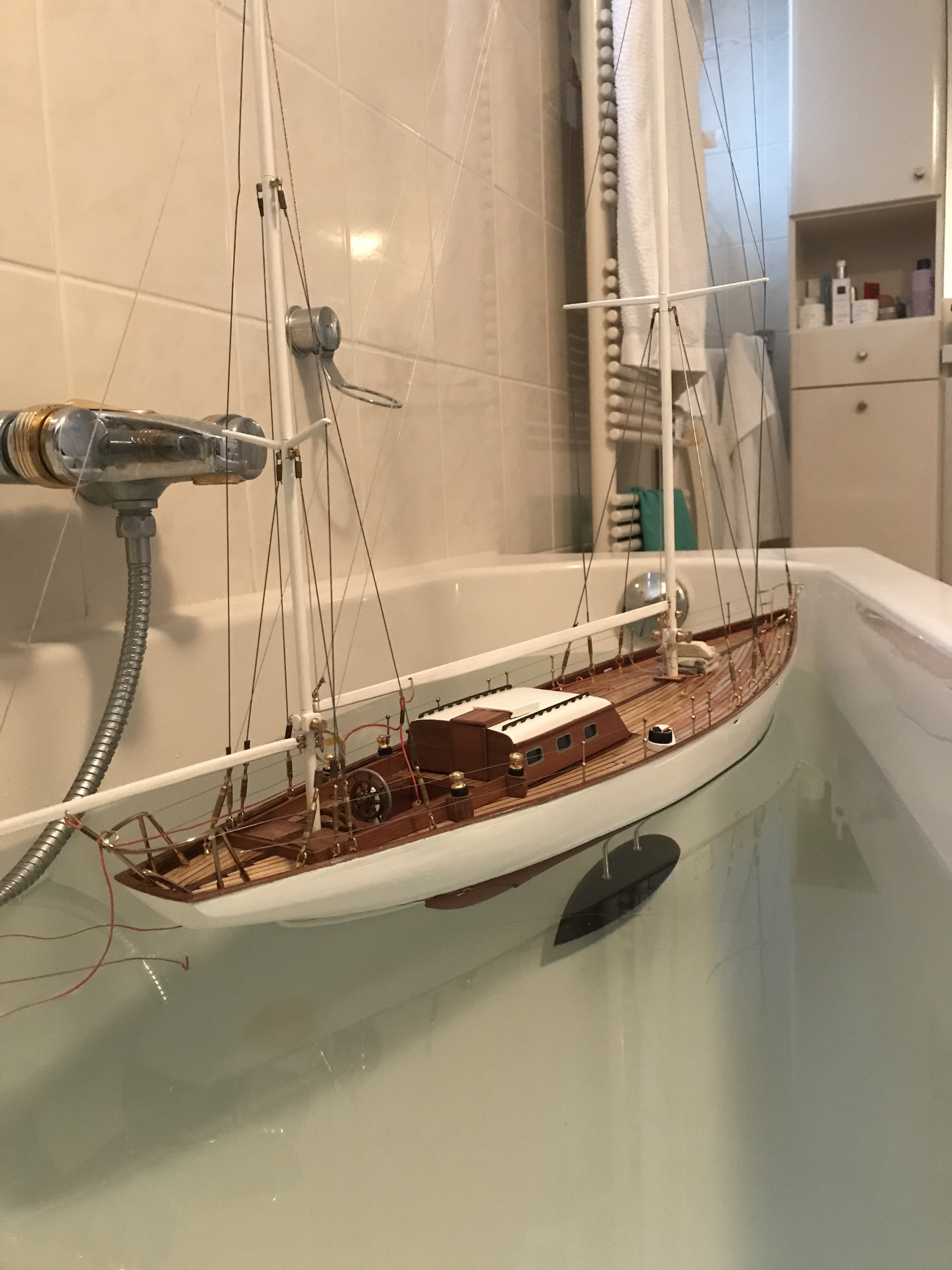

1 minute ago, FreekS said:
That’s brave to test in the sea! The boat looks beautiful but also potentially a bit top heavy and possibly sensitive to wind. Getting as much ballast deep in the boat would be the right strategy!
Hi, Freeks
You are right and especially so when a vessel is down-sized into a model, giving up much stability that would have been quite adequate if full-sized.
Thank you for the thoughts
That’s what I had when I built Corsaro II, which is a stationary model converted to RC. Like many I added a lead bulb under the keel. It’s screwed into some M4 nuts in the keel and can be removed easily when not sailing. Might be an alternate way for Twilight.
