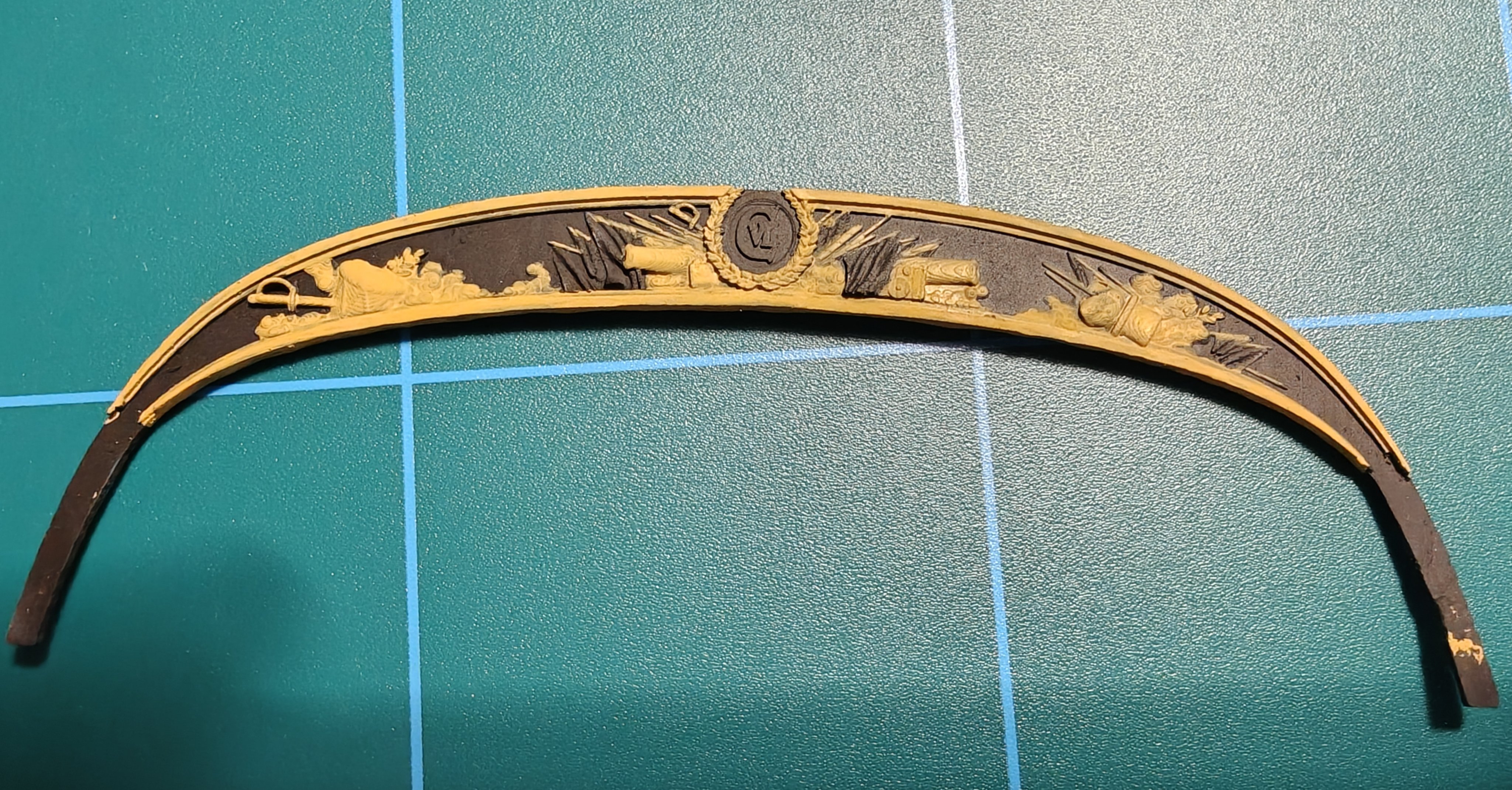

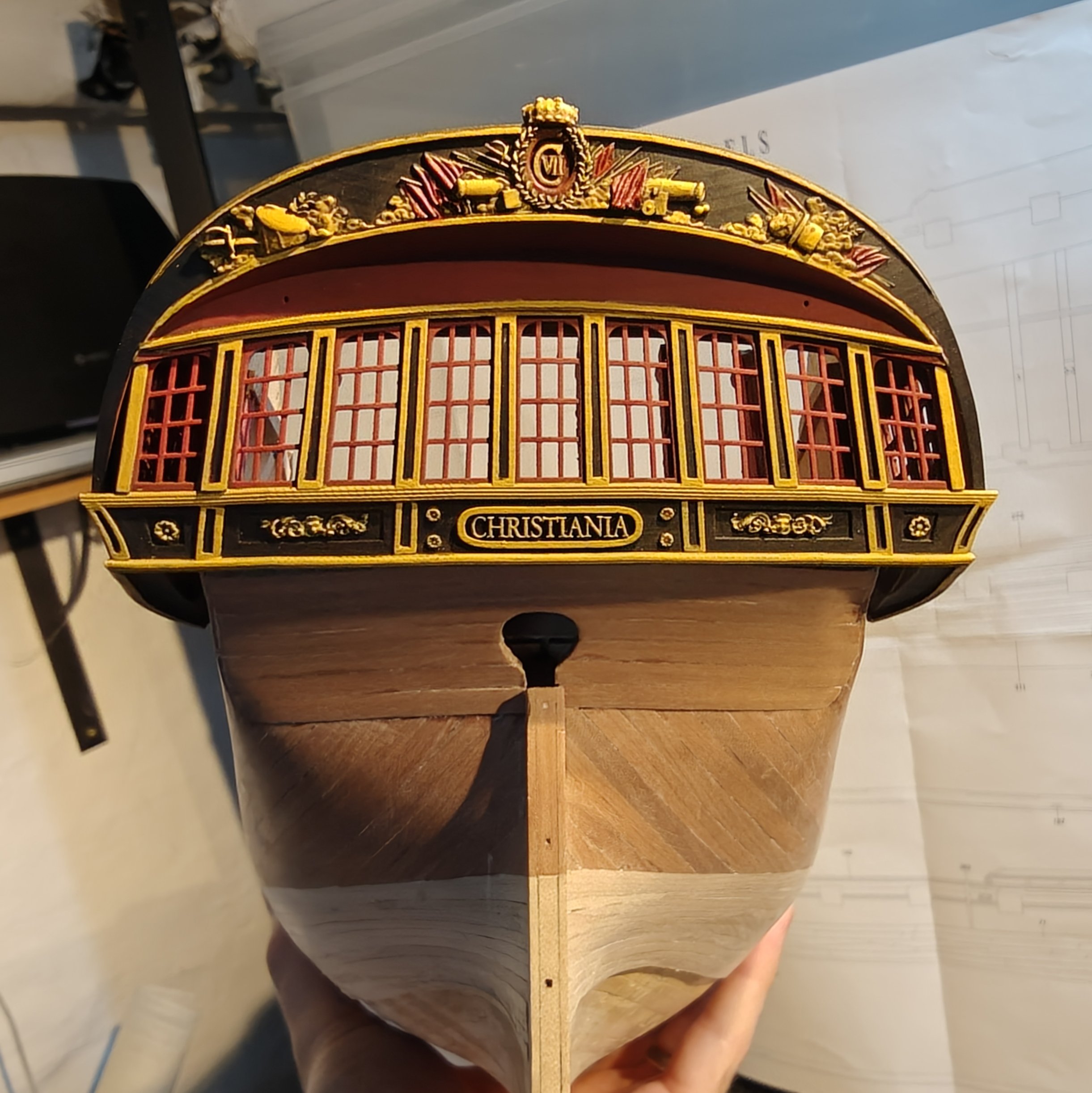

Log entry 25 - stern colour tests
While planking snails on, I have been trying a few options for the stern decorations on some mis-prints (I had a few, as I had a hole in the release film on my printer...).
The upper test uses non-metalics and I started with a medium brown, followed by yellow ocre with a few beige highlights. The second is using Vallejo Liquid Gold with a brown shade. I would do highlights as well jere, but decided at this point that I will be going the non metallic route.
Now for a few observations:
- I am woefully out of practice when it comes to painting miniatures. I did this for many, many years and while I never achieved mastery, I was a solid painter. Not so anymore!
- I really need new brushes. I don't have a detail brush that will keep a point or let the paint flow smoothly (I hope this is a big part of my bad performance here). Order placed.
- I need to start with a lighter tone of brown/yellow and use more colours in between. I have gotten away with this combo before, but on small parts.
- these were quick tests, just around an hour of work. I will spend more time on the final piece.
- on a side note, the liquid metal paints from Vallejo absolutely destroys brushes and while coverage and finish is great, it cannot be applied to fine details (like the tiny poles on my friese) as it is super runny!
I am still waiting for new brushes, but I tried again with lighter colours on another scrap piece:
Better, but still not satisfied. It looks fine from a distance and the macro shots reveal all the nasty stuff, but I would still like to do a little better than this. And I have only base coated the red flags for now. I would like the white cross of the Danish flag on the big one on the right, but I am not sure I can make it work.
Let's see what new paints and more time will do.
BR
TJM
Edited by TJM
TJM, to me this looks really good! Again, we are our own worst critics.
What doesn't look good to you may not even be noticed by another.
Respectfully
Thank you for that, I really appreciate it. And yes I know we are all our own worst critics, but I just know I could do better once 😄.
Edited by TJM
Great job.
I like the top one the best. It just needs a bit more, it feels like it has the most depth. The issue is the mid tones need to be brighter so you need to extend what you have for highlights down over more of the surface and go for even higher values on the highlights.
In general it is better to make too much contrast as opposed to too little. You can smooth it all together with a thin glaze of your mid-tone once you are done if you think you went too bright. If you do this be careful that you don't let it pool in the recesses. It will have the consistency of a wash, but you don't want to use it like one.
Glazing over the transitions using the darker colour pulling from light to dark will also help with smoothing out the transitions if you are concerned about them.
Edited by Thukydides
7 minutes ago, Thukydides said:
Great job.
Thank you!
I remember all of these techniques when you mention them, but I am so rusty! So thanks for the great description here.
I am at least encouraged to try again and really try my best, keeping these points in mind - I think the postman has delivered my new brushes today, so....

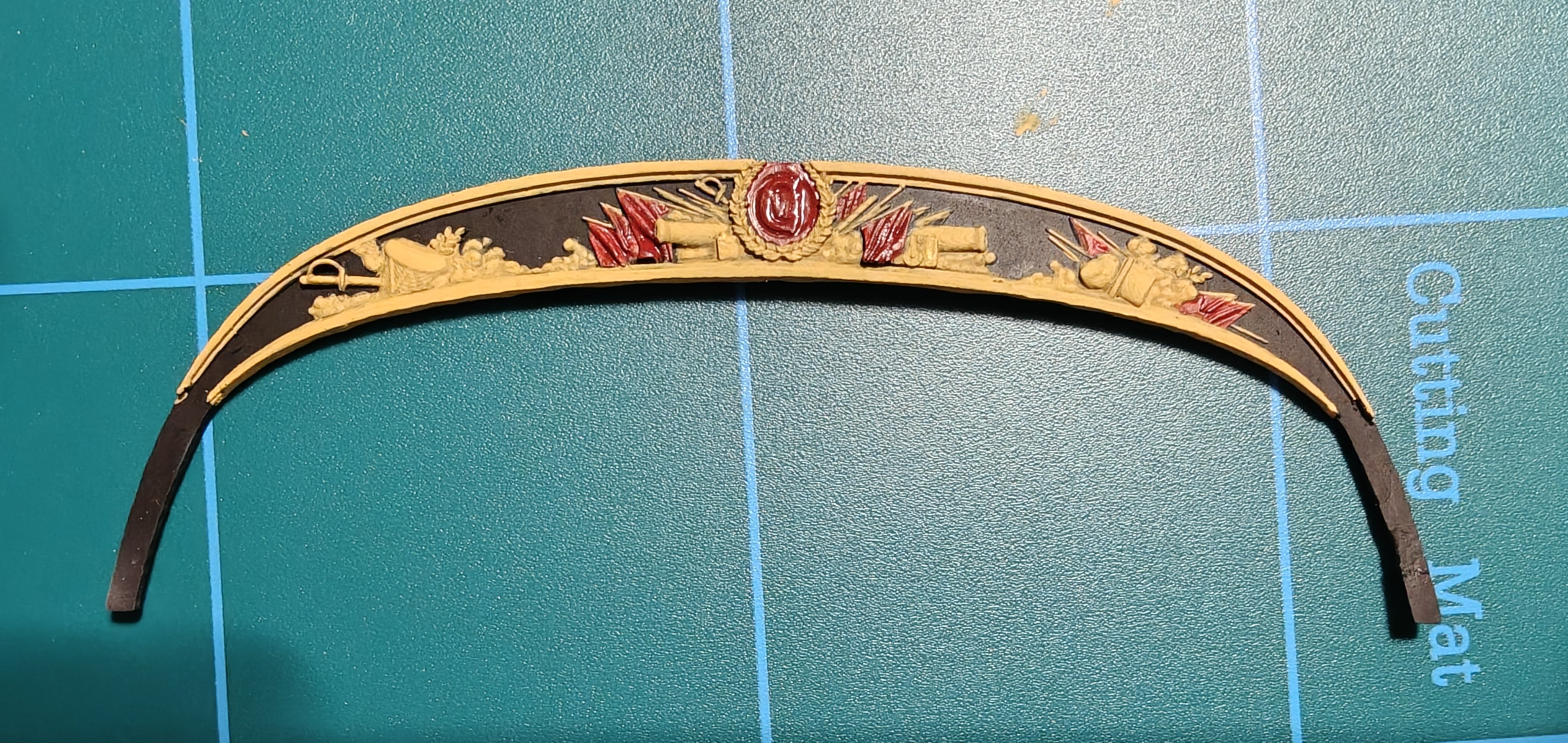

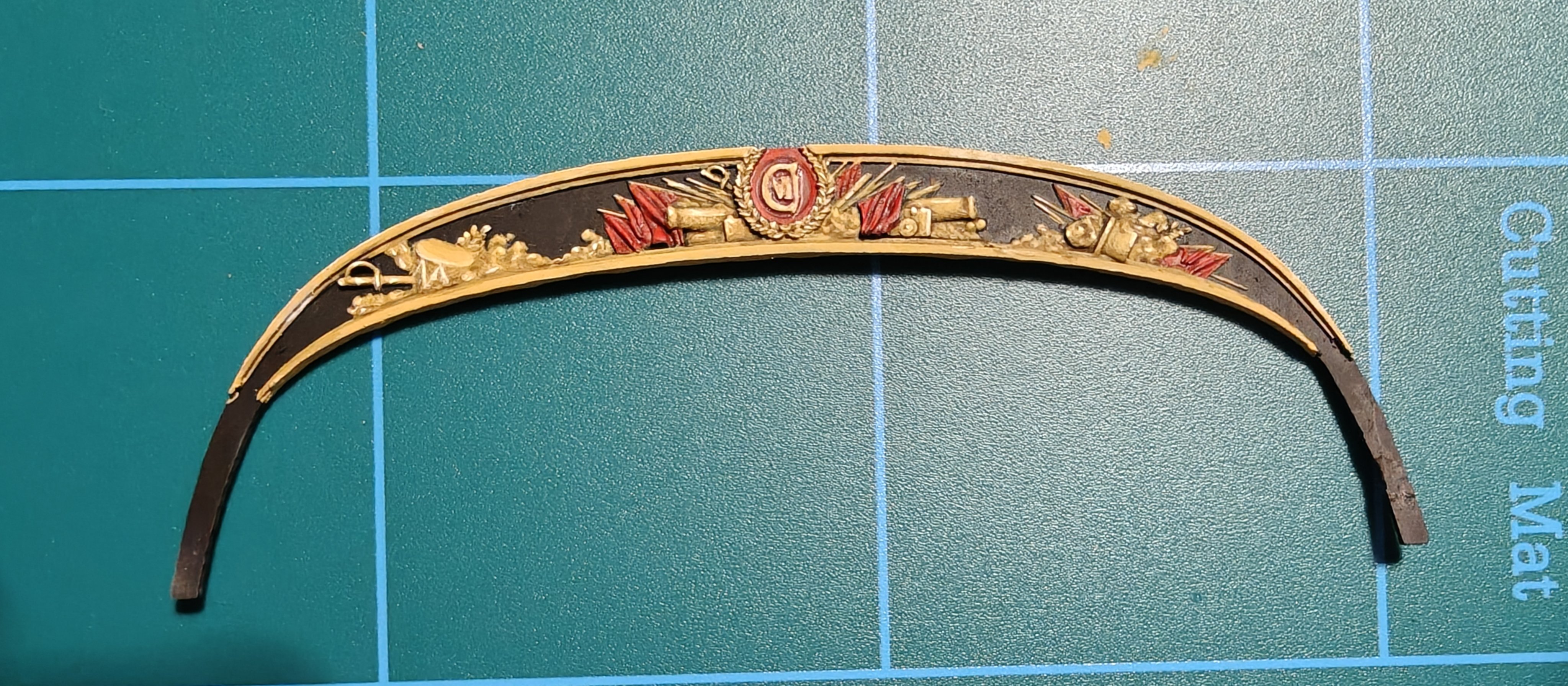

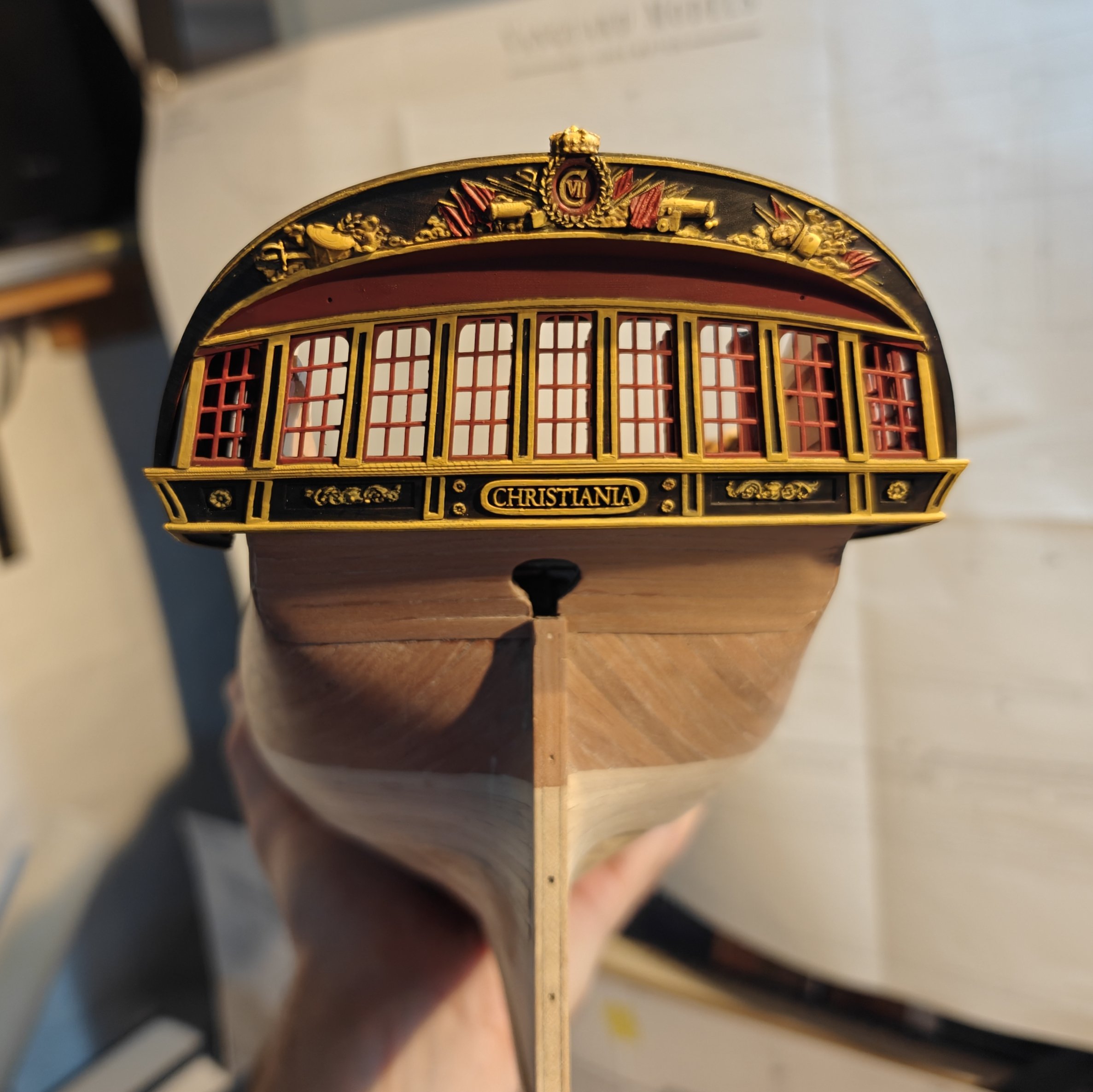

I have tried again with my new brushes and a few new paints and a wet pallette to keep the paints thin and flowing.
These are the steps I took:
1. Base coat yellow areas with a light brown:
2. main colour layer with yellow ochre.
3. Bace colour on the red areas:
4: wash all areas with brown wash.
5: go over with main yellow colour again.
6. Dark red wash on red areas
7. Highlights with a yellow/beige mix and a light red
8. final highlights with beige:
I am ok with this result and from normal viewing distance it looks totally fine.
A little unhappy about the monogram details though.
I am considering re-printing this but with the z-axis scaled to 150% or so. It should make it much easier to paint when the relief is not as shallow and it may still be ok in terms of overall thickness. It is very thin as it is.
But I would probably be ok with this one if it is the best I can get 🙂.
BR
TJM
I think that looks much better than your previous versions. Great jobQ
If you would like some suggestions to make it really pop, I would still go up a little higher in value on the highest highlights of the red. Maybe mix a bit of orange in with your red to get that highest highlight.
On the gold I would use pure white or maybe white with a little yellow in it and try and pick out the upper edges of the monogram and any sharp upper edge points such as the tips of the cannons. This would be really small dots/lines, but it will push that contrast just that bit higher.

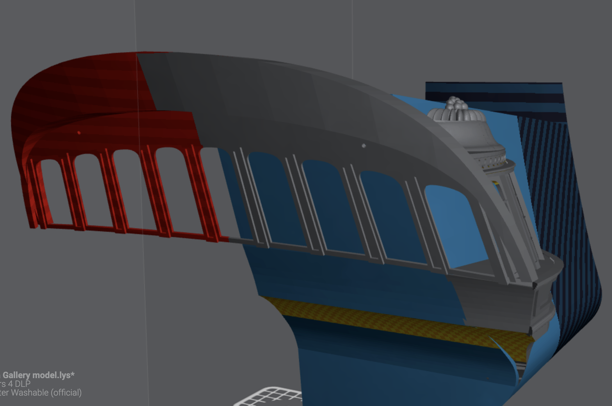

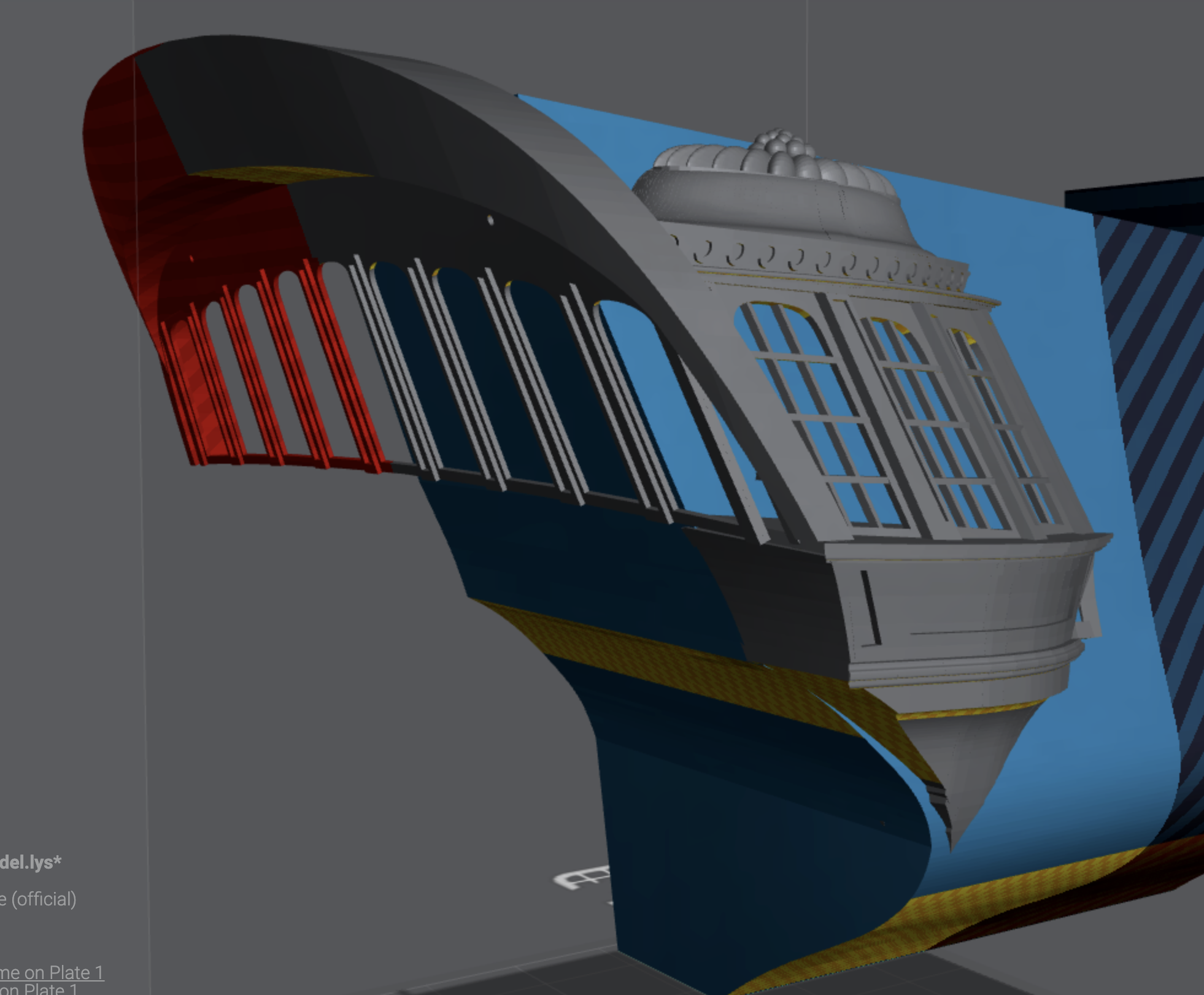

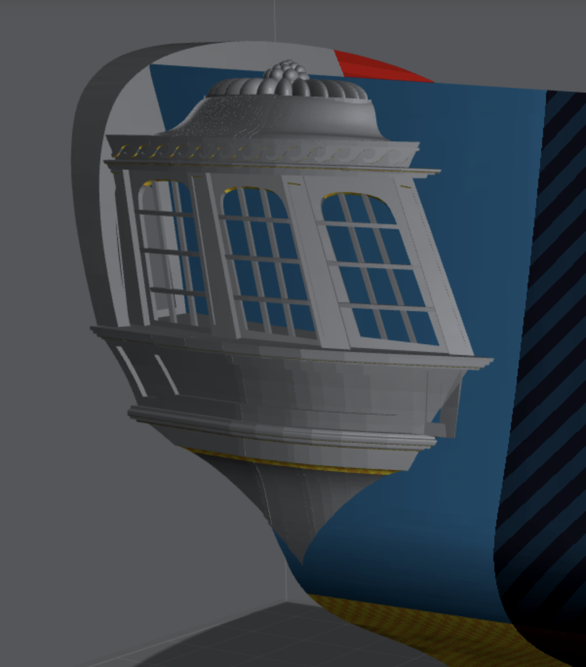

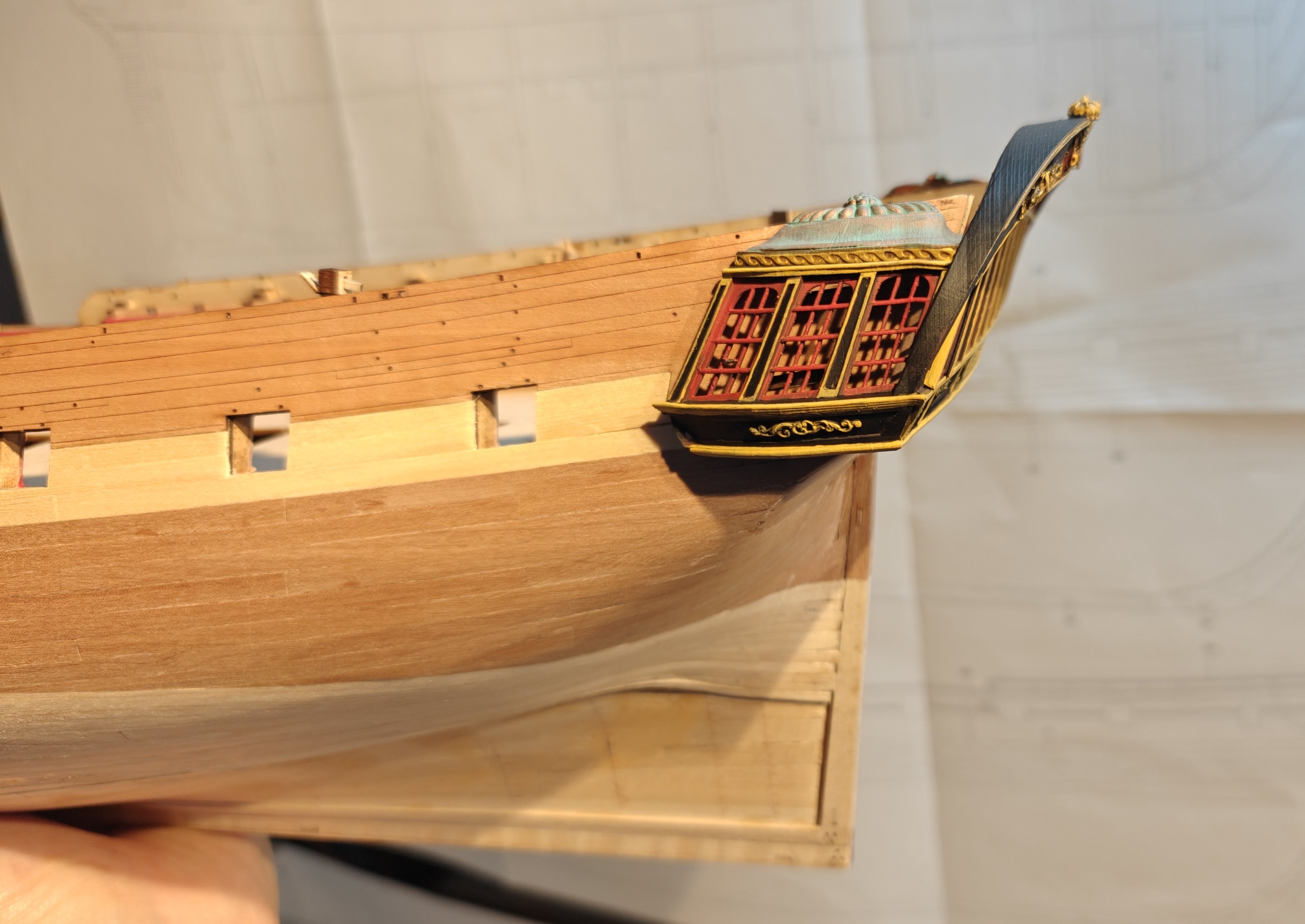

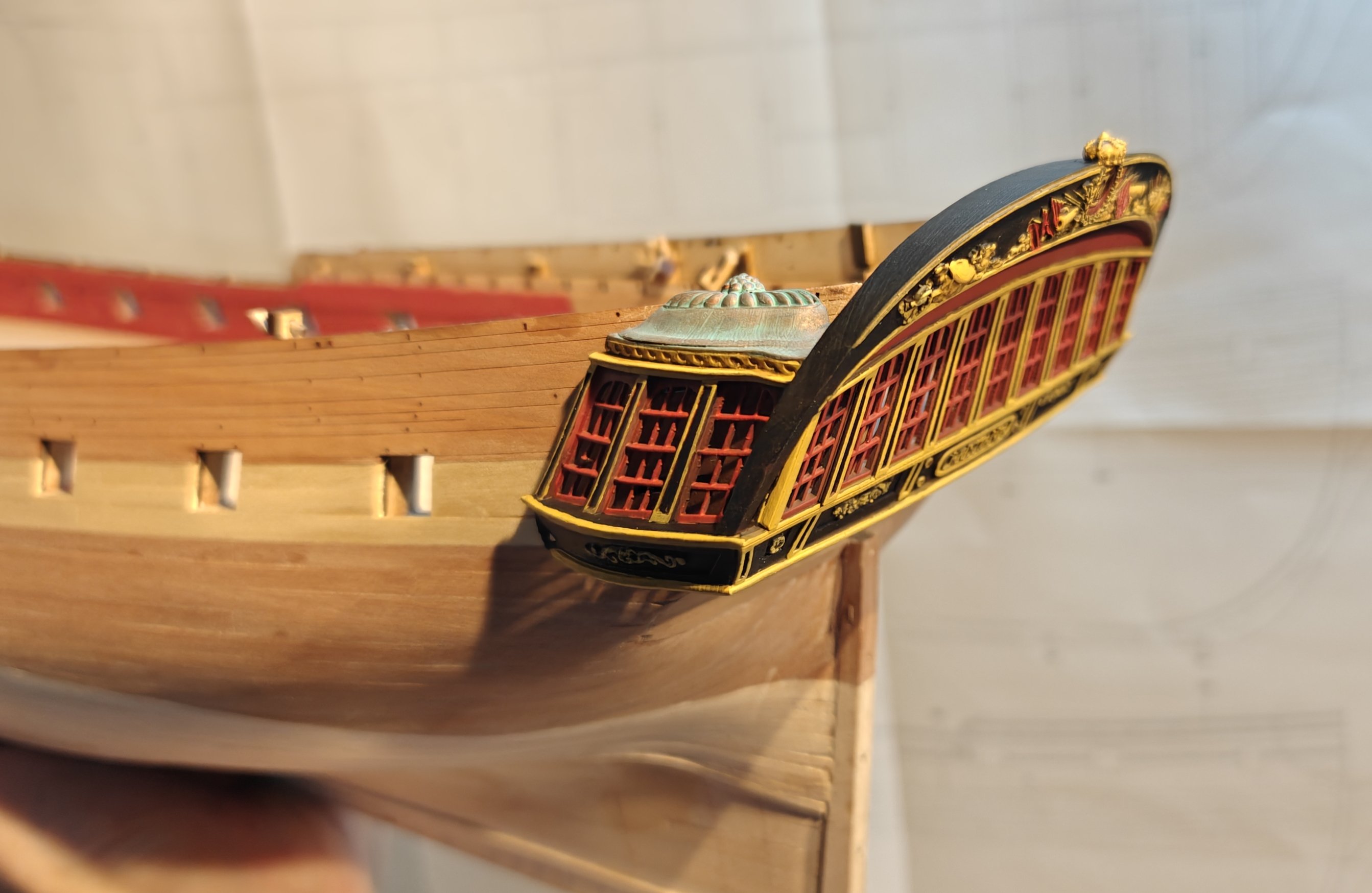

Log entry 26 - trying to model the side galleries
Hi everyone,
It has been quiet in this log for a good long while now - I have been on summer holydays, and after, I have been doing garden projects and working a bit on my Elben project.
But even though planking is going painfully slow, I am working on other parts of this build as well. One of them is the stern decorations and side aglleries. I had originally though I would just make up modified parts for the side galleries, but the more I though about it, getting close to the drawings seemed to me a difficult task. I therefore decided to try to model the whole side gallerie in 3D, hoping I will be able to 3D print the whole thing.
I have no prior skills in this area, and I am not ready to start learning to actually model in a 3D CAD program, so I have been using some workarounds:

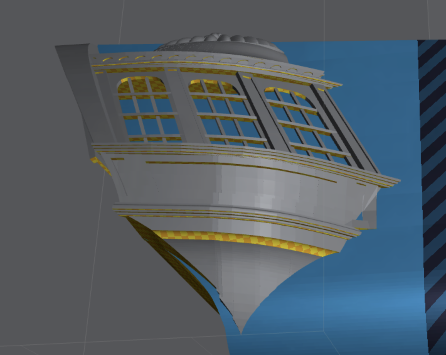

I am drawing simple parts based on the original scalled drawings in QCAD. Then I load these into Onscape and extrude them to a resonably close thickness (I can modify this later, so it does not need to be procise). Then I import into the slicing software I use for the 3D printer and build everything in there. This is surely a bad way of doung it, but the interface in the slicer is super simple and at the same time offers full flexibility when it comes to positioning and scaling parts - I just can't make any more advanced modifications to the individual parts, except for straight cuts!
I am not done yet, but this is the current state of things:
Here are the original drawing I am trying to approximate:
I am happy with the overall shape, except for the very lowest portion of the side gallery - it is a very dificult geometry, and I just can't get it wide at the bottom. I may end up just deviating a bit from the drawings in this area. I have tried many multiple times and it just ends up looking bad. I would rather have a deviation from the original that looks good, than something cunky and ugly!
I am still in the process of adding ornaments and I just started the modelling of the stern face. I am not sure I will 3D print the rear windows, but I would be nice to have the window frames match the side galleries, so maybe I will give it a shot.
The friese is blank here - as you can see in the posts above, I have modelled the friese, but in a flat version. I figured a way to get the correct, thick 3D shape and I think I will import my other friese file and transfer the design to the curved surface. I will then re-print it to get a much better final shape of that piece. No matter what, I will print the stern friese and/or windows seperately from the two side galleries.
I think I will do an export and make a test print before moving much further, just to see if this is a viable approach at all - it is a time sink to do this, so I want to make sure it is worth it!
BR
TJM

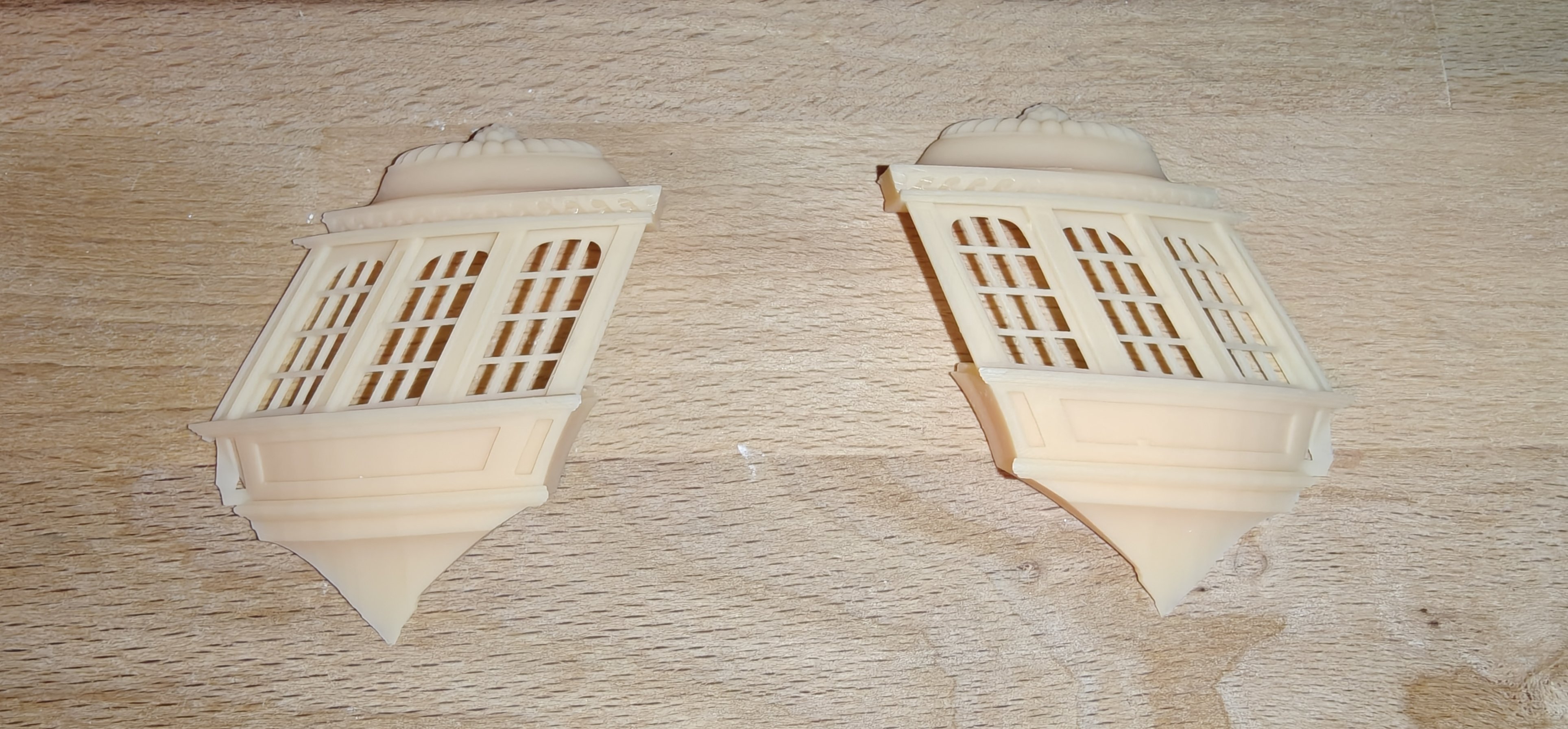

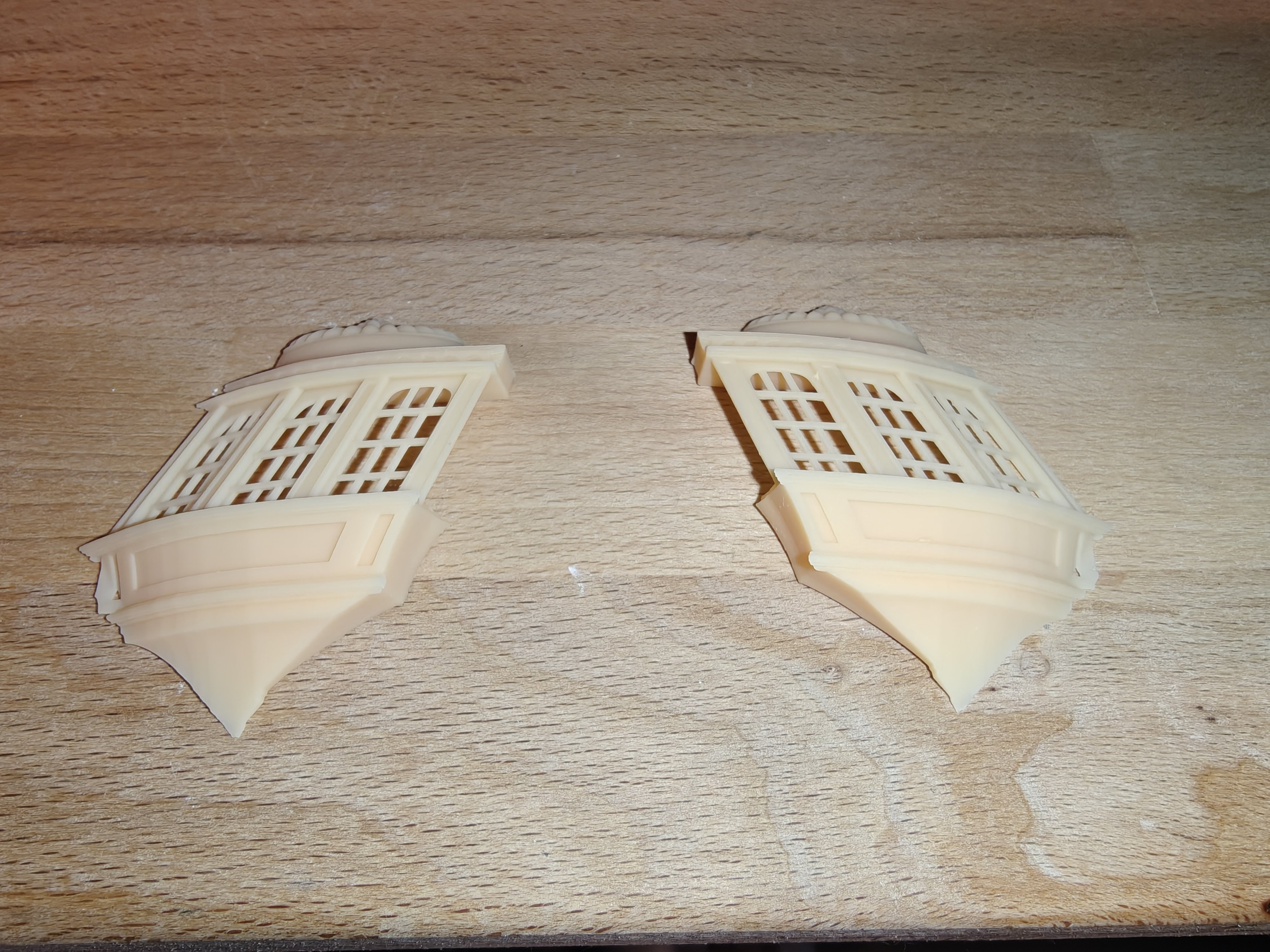

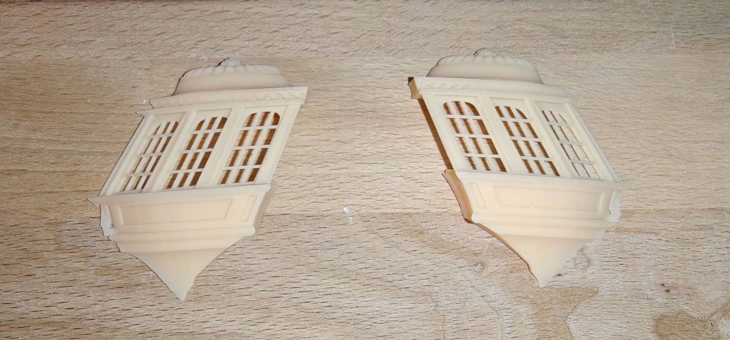

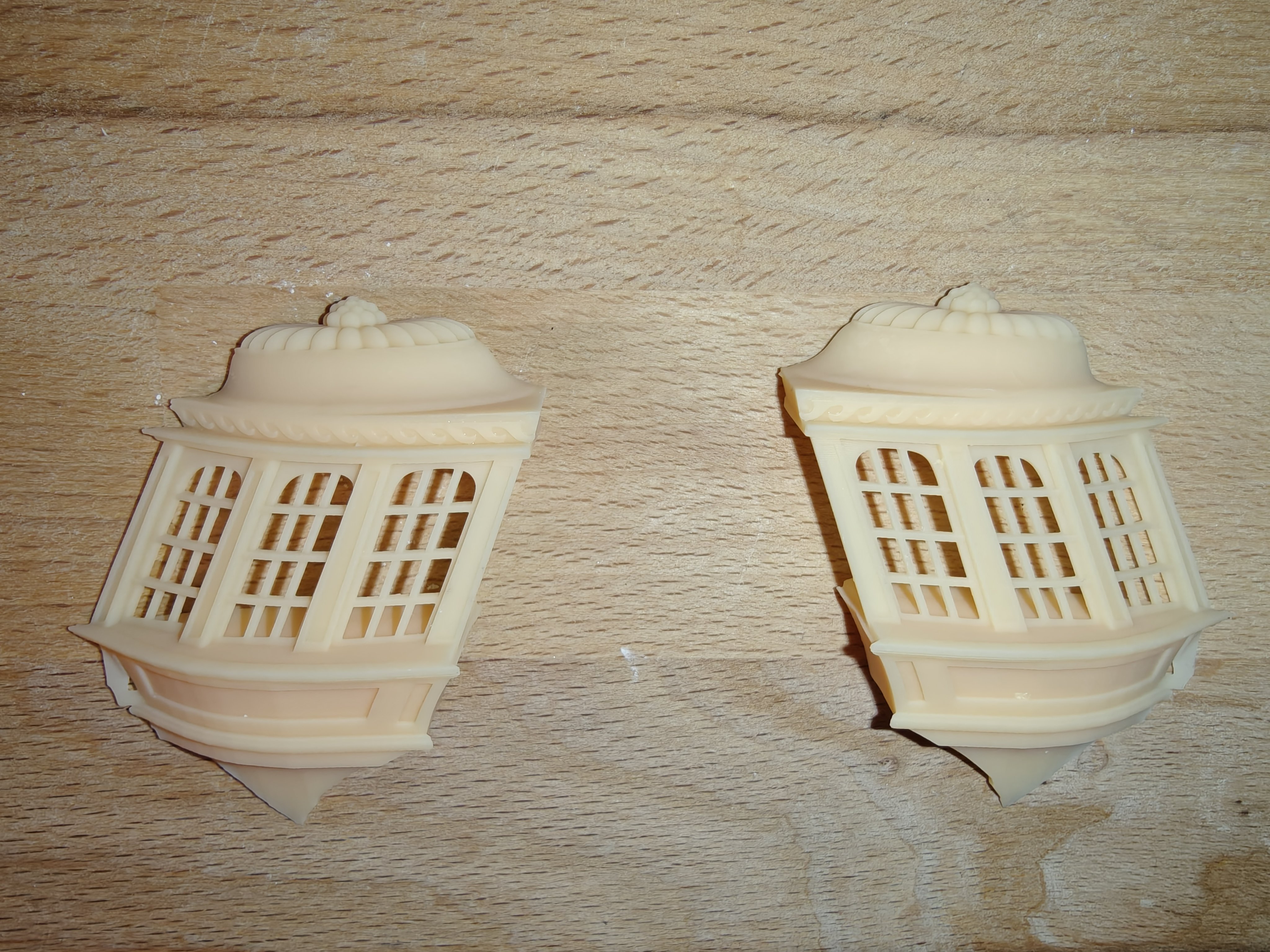

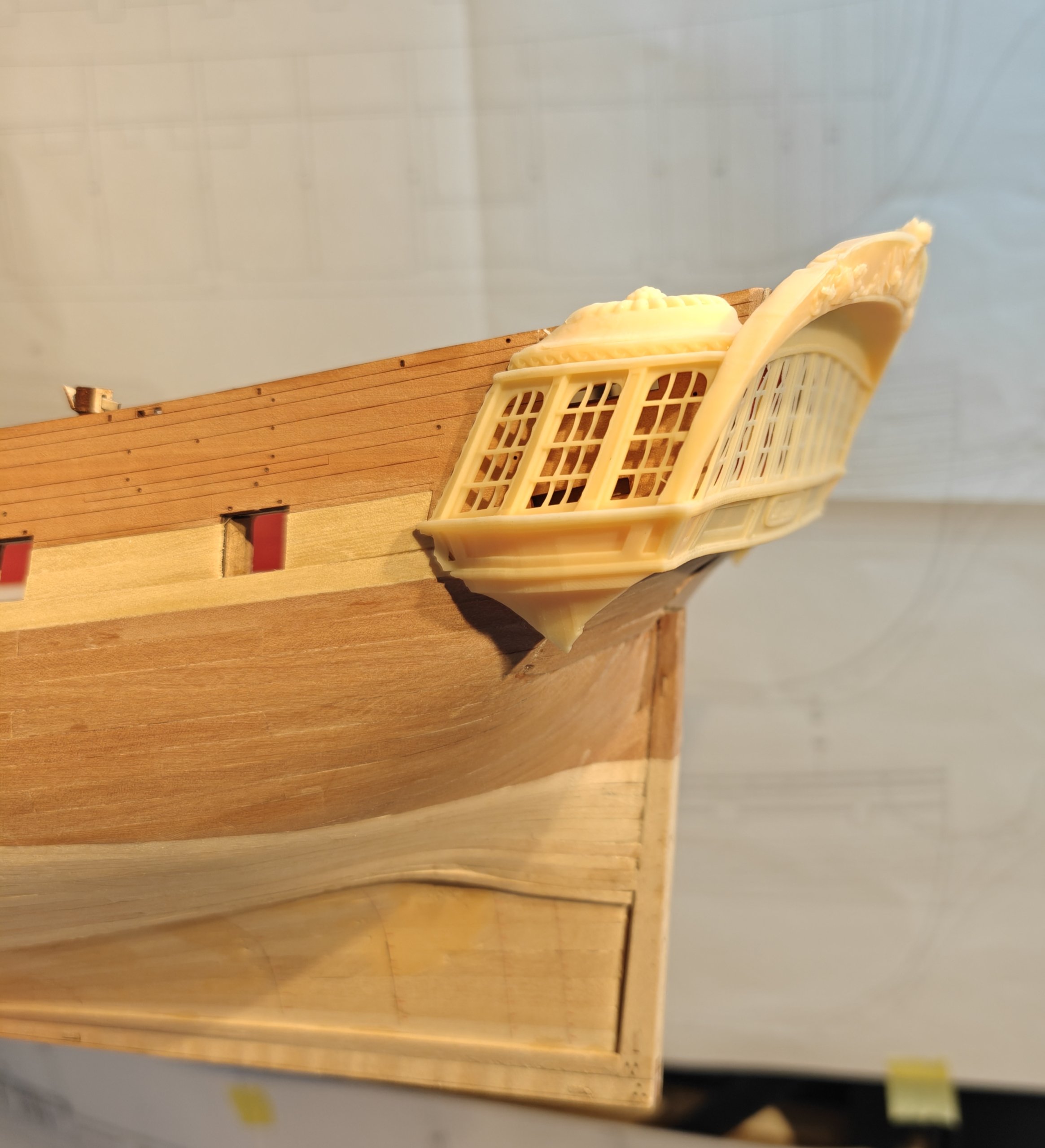

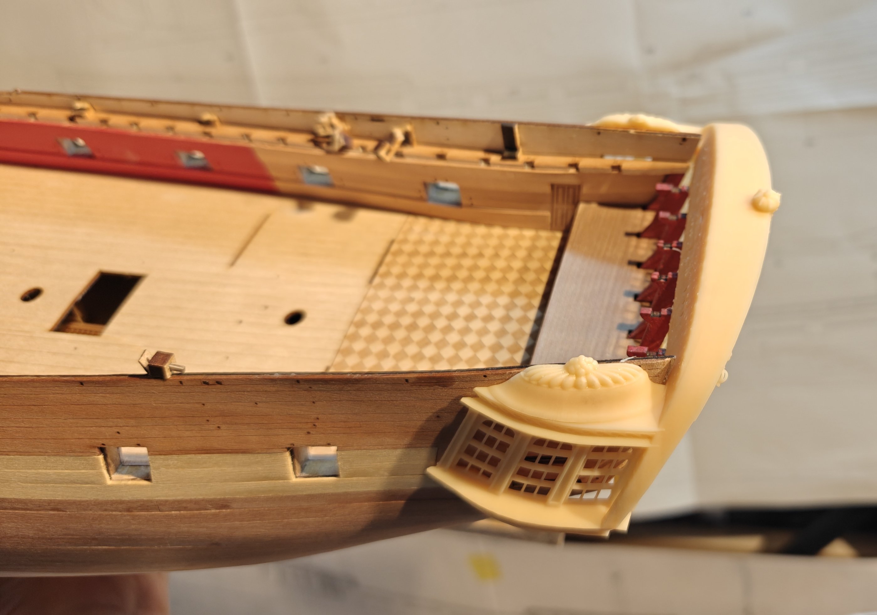

Alright, even though the 3D model has a few rough spots, I hoped that the tiny scale and the antialiasing used in the slicer on export would work in my favor.
And I am very happy to report that it did!
The finish looks really great and all the details pop. The prints cane out basically perfect.
So I am very encouraged by this. Now, the fit for my Christiania is not quite good enough. I am not sure exactly what has happened, but the lower part and the top are both a bit too tall. The window portion seems to fit fine. So I will be scaling some parts of the model a bit and trying again to get a better fit. It wil likely not be perfect, so a bit of filler will be needed, but that is ok. Stay tuned for more experiments soon...

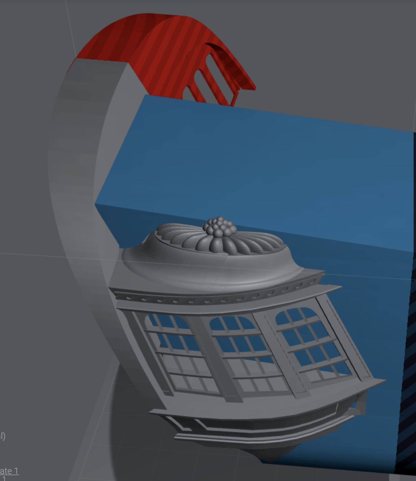

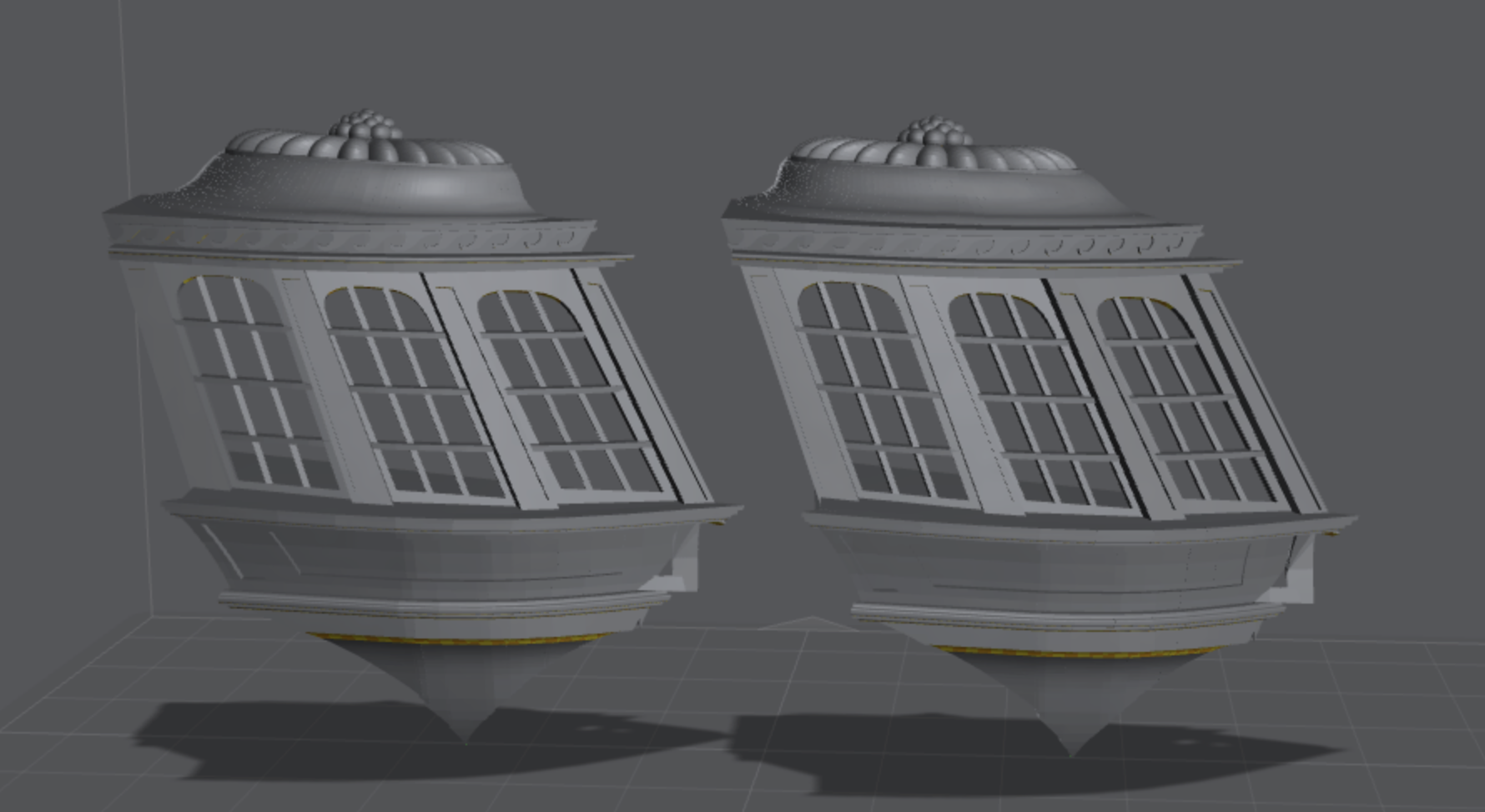

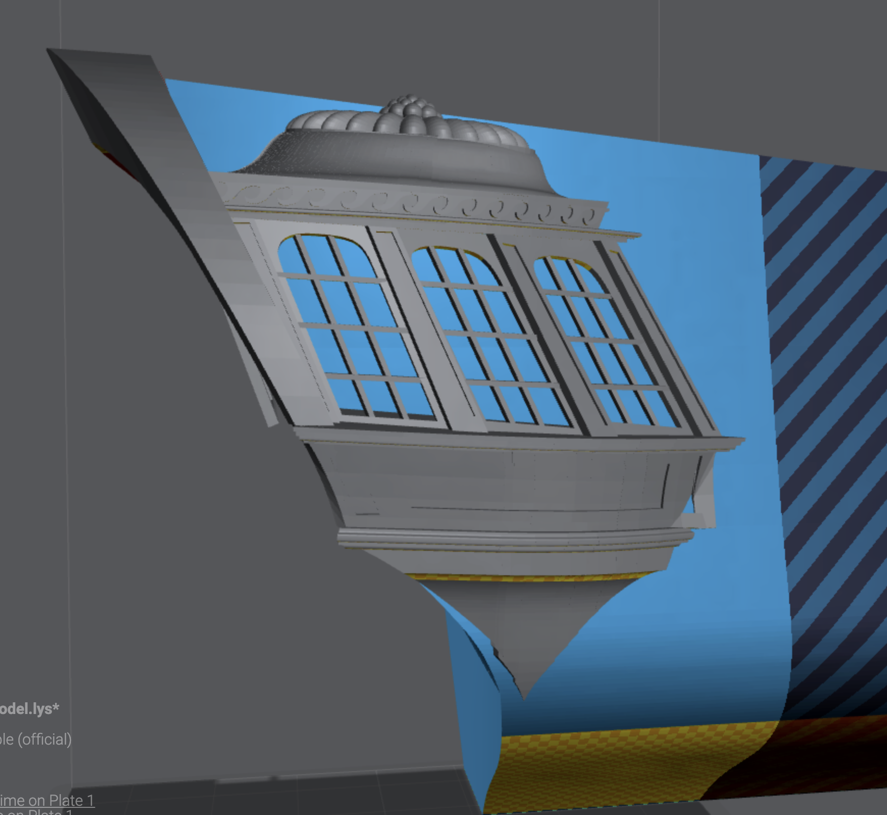

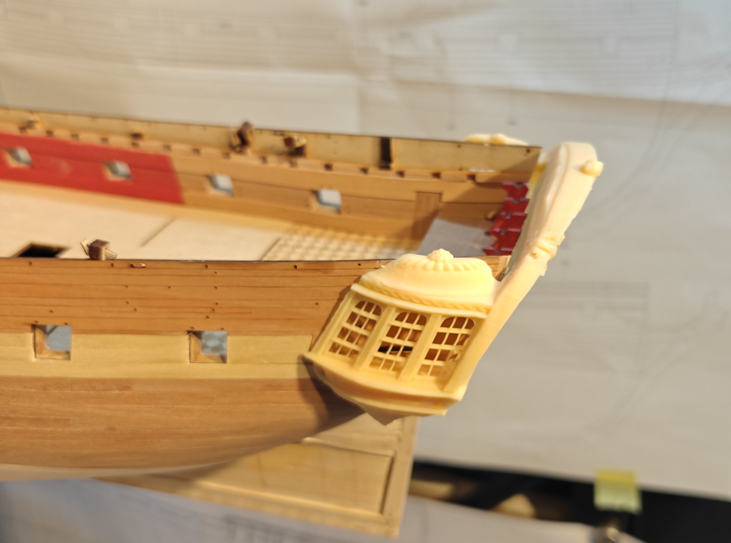

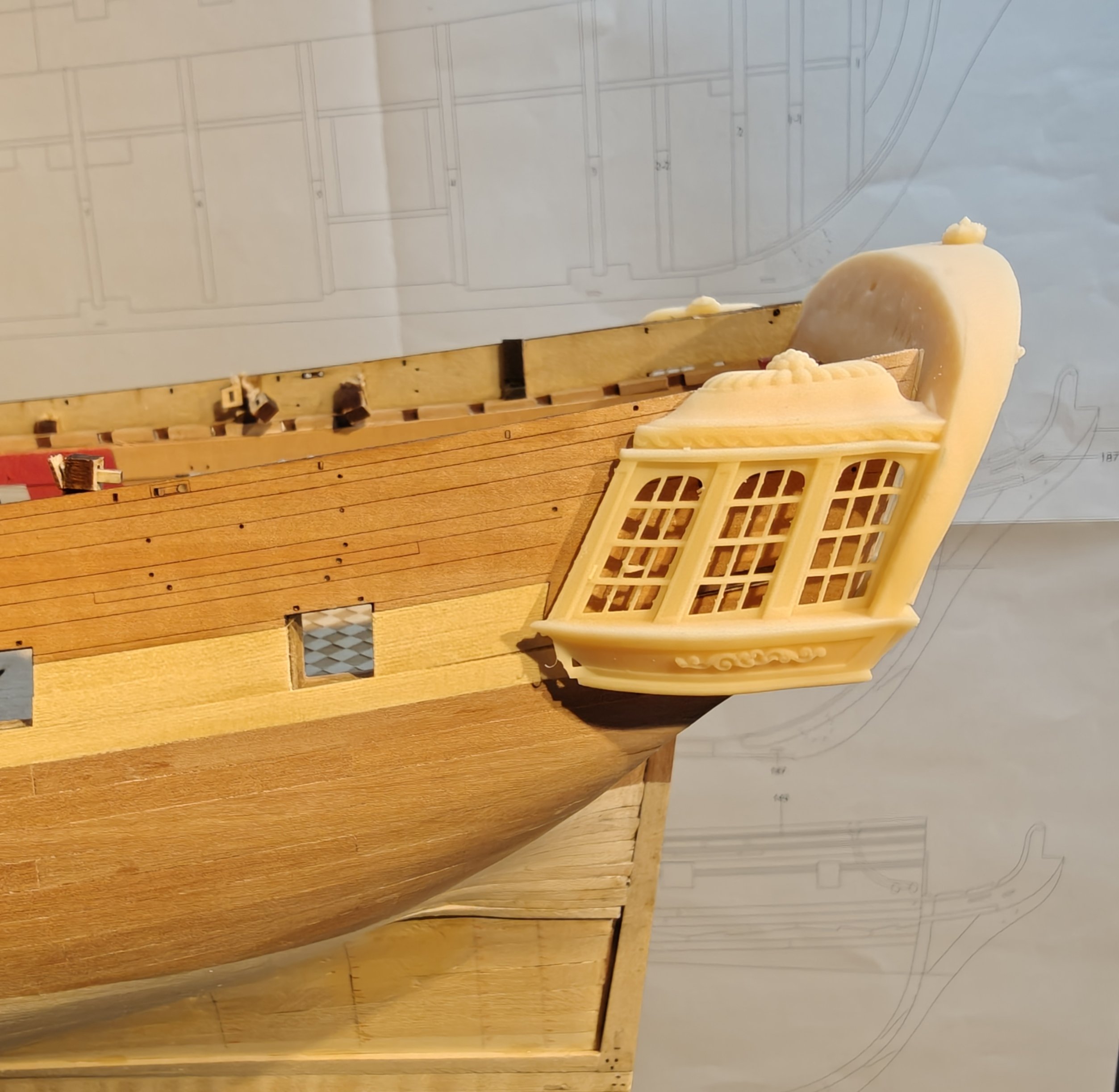

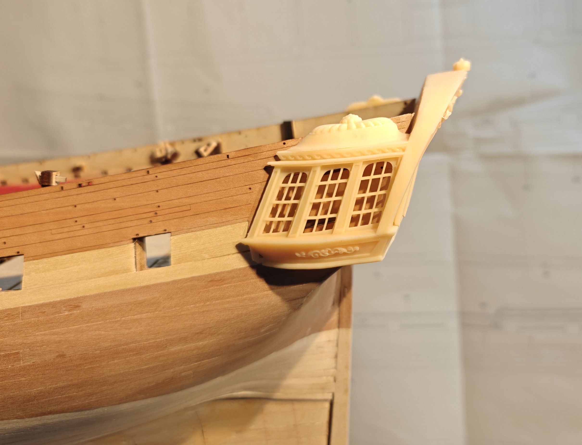

1 hour ago, Beckmann said:
Hi TJM,
Somehow the QG leans backward and the roof leans forward, shouldn't both lean backward?
But beautifully done anyway,
Matthias
Hi Matthias,
I see what you mean! Dome of it is due to the perspective, especially in the last image, and som of it is due to the way I made the roof. The thing is, the QG area is largest at the rear, so I have stretched the shape in that end to cover more of the area. Snd conversely, I need it to be compressed in the forward end, to make it fit the shallow roof there. Unfortunately that gives an impression of leaning forward a bit, from some angles. I am contemplating if there is anything I can do a bout this - perhaps there is. My problem is that I cannot stretch just the top part backwards with the simple tools I use, but I will see if I can find a workaround.
Thanks for pointing it out to me!
BR
TJM
Ok, I made a quick edit of the roof and here is a comparison: the previous version on the left, the new one on the right:
The new one looks much more natural, with the lean towards the stern.
Thank a lot for pointing this out Matthias! In the end, the change took just a few minutes to do, so very much worth it!
This version is also a bit re-scaled (the comparisson on the left is as well) compared to the print I made, so I will try this one and see if the fit with the hull is better now.

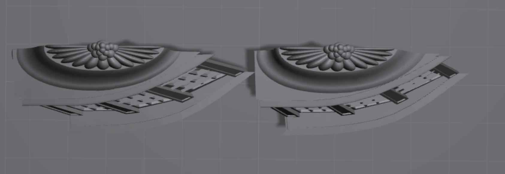

Log Entry 27 - modelling the stern friese
I am still working on the fit of the quarter galleries, but as I decided to remodel the friese in actual 3D (not just a raised relief/projection), I have been working on that.
I am very happy with the overall shape and together with the galleries, it is really shaping up now. There are still some rough spots at some of the joints between parts, and I think I will print the stern and side galleries seperately, and then some of the ornaments are still missing (tiny lion heads I and som garlands, flowers, etc. )
It will take some more (probably rather difficult) work to get it to the final shape - I may print a test version at some point to se how the fit is.
I find it very satisfying to see the whole thing in 3D, but I also find that the dimentional accuracy of the resin printing is not super good for large parts, both due to uncertainty in the z-axis (layer thickness) but even more the warping flat parts. Over such large pieces, you quickly more a milimeter or more from the target and that makes it very difficult to fit onto the model in a prcise way. So I think I basically have to iterate with a buch of trials, which is quite tedieous with the resin printing process!
We'll see how it turns out in the end 🙂

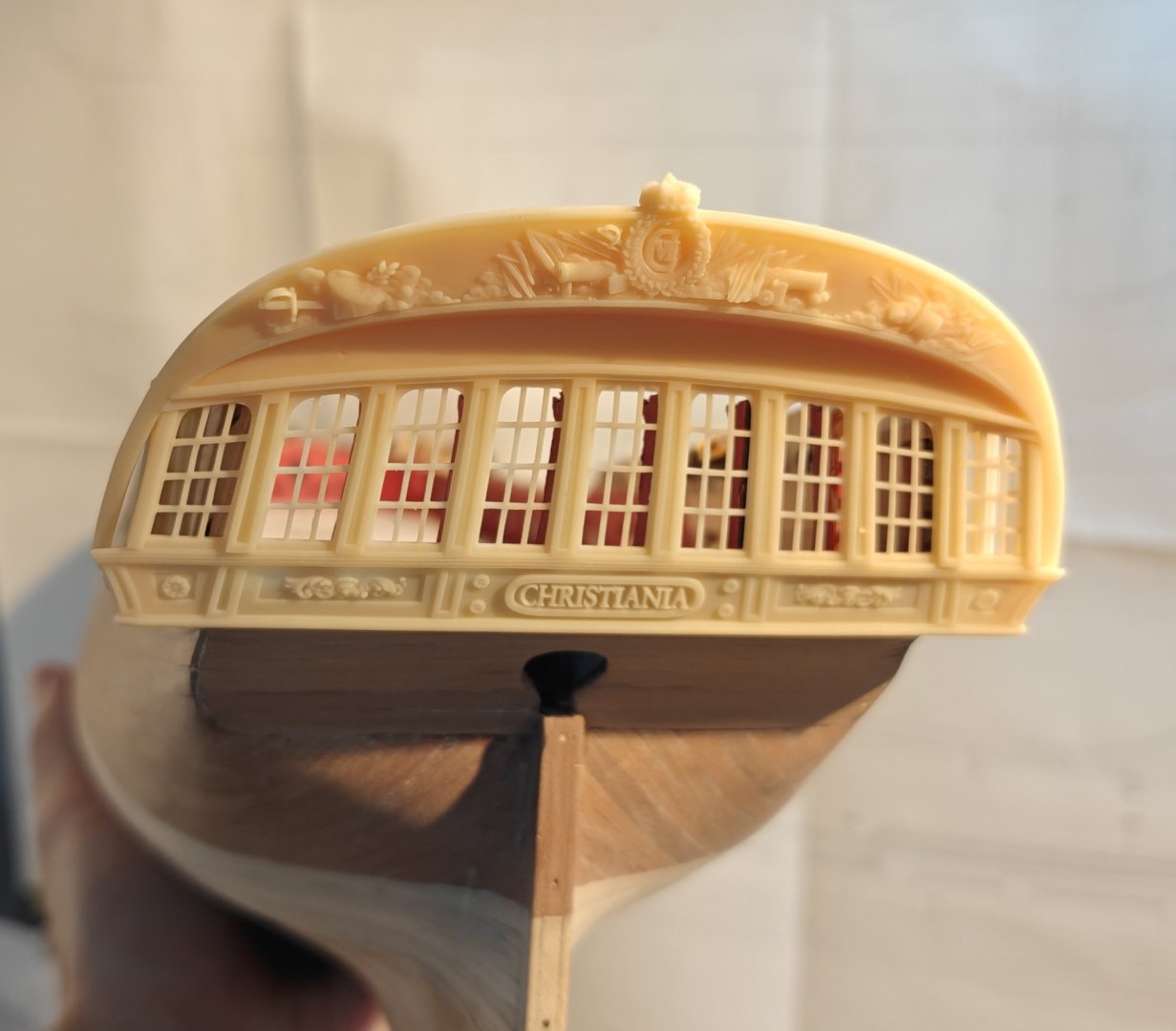

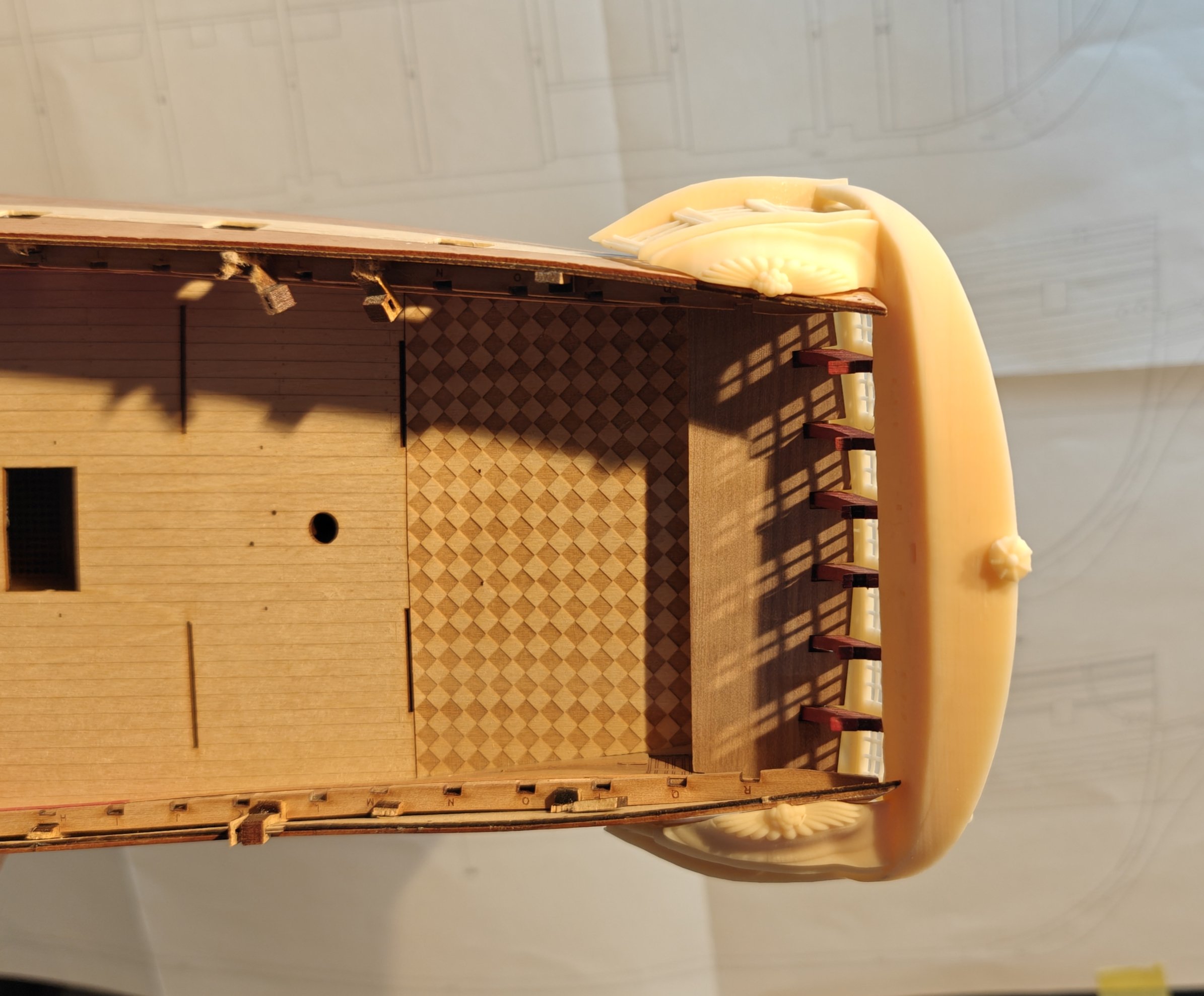

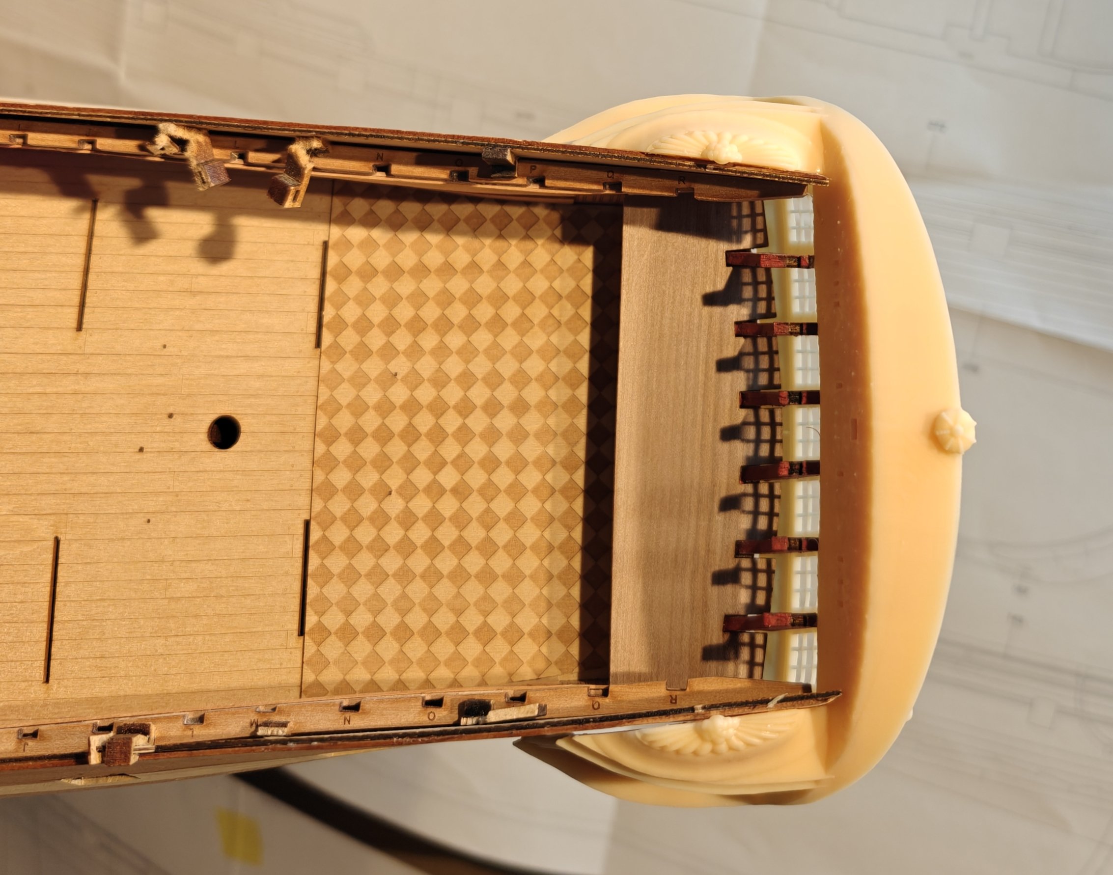

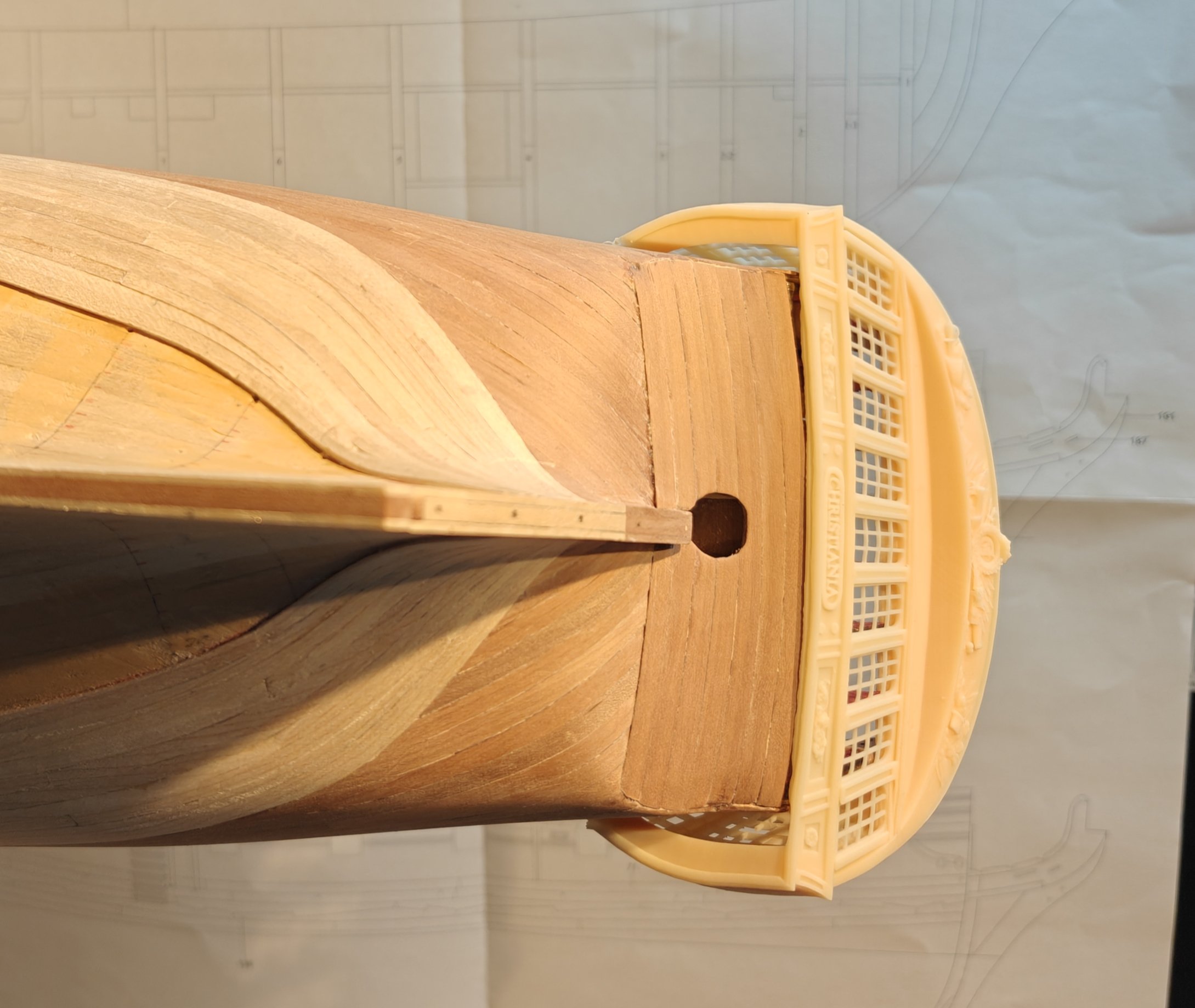

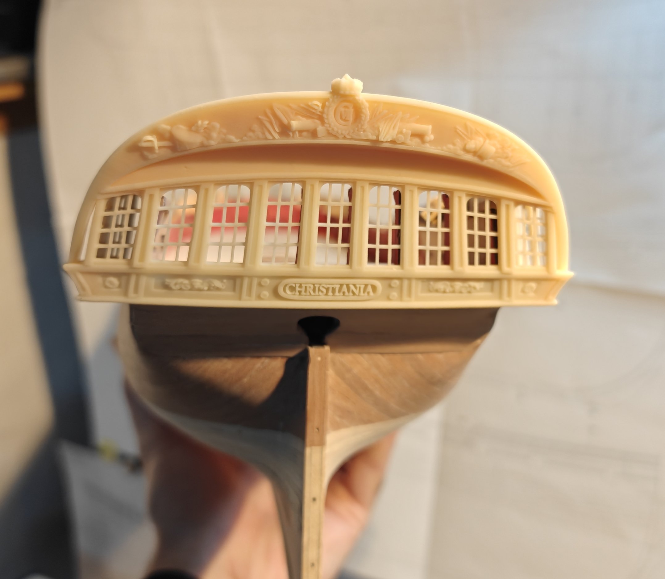

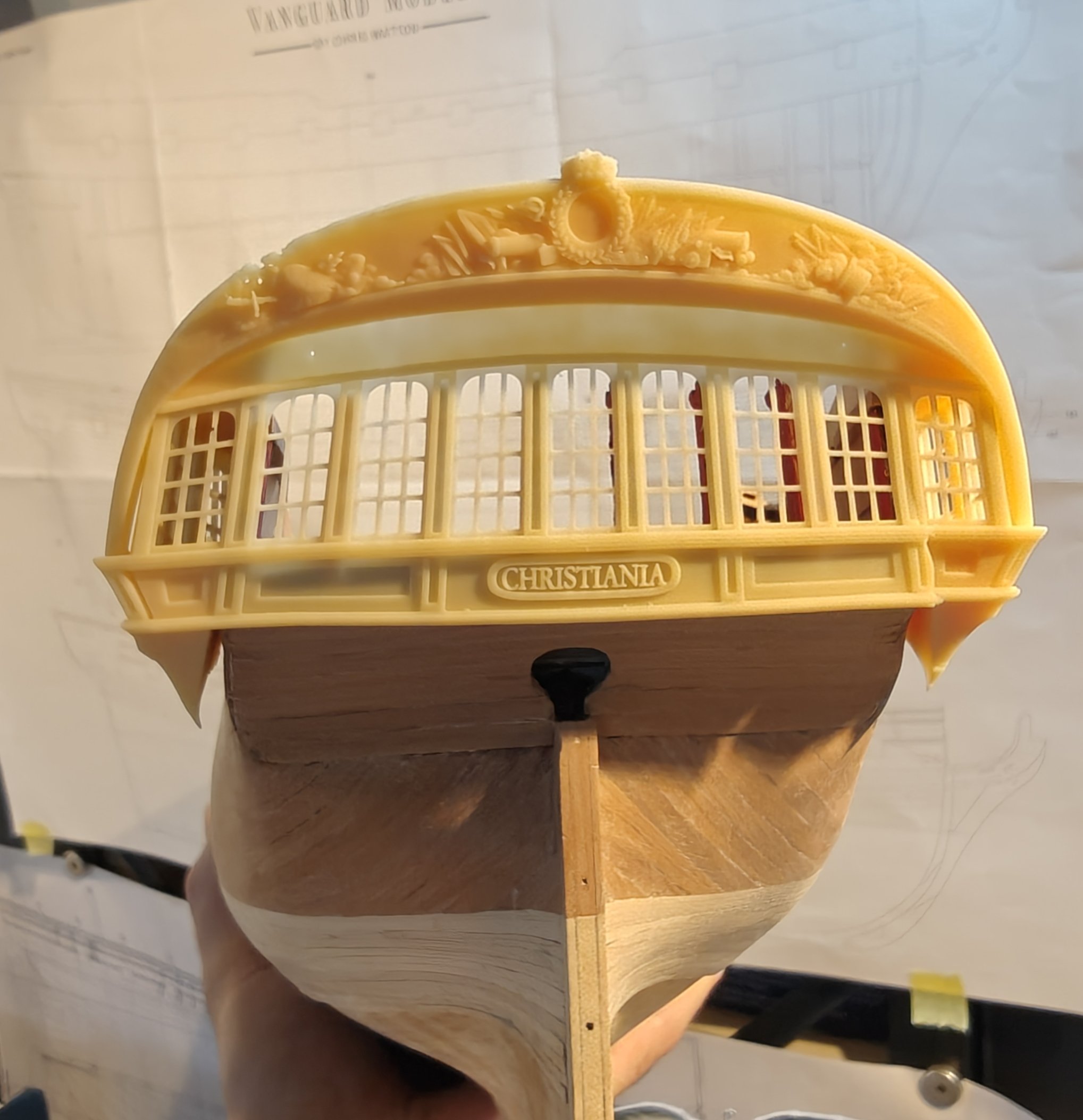

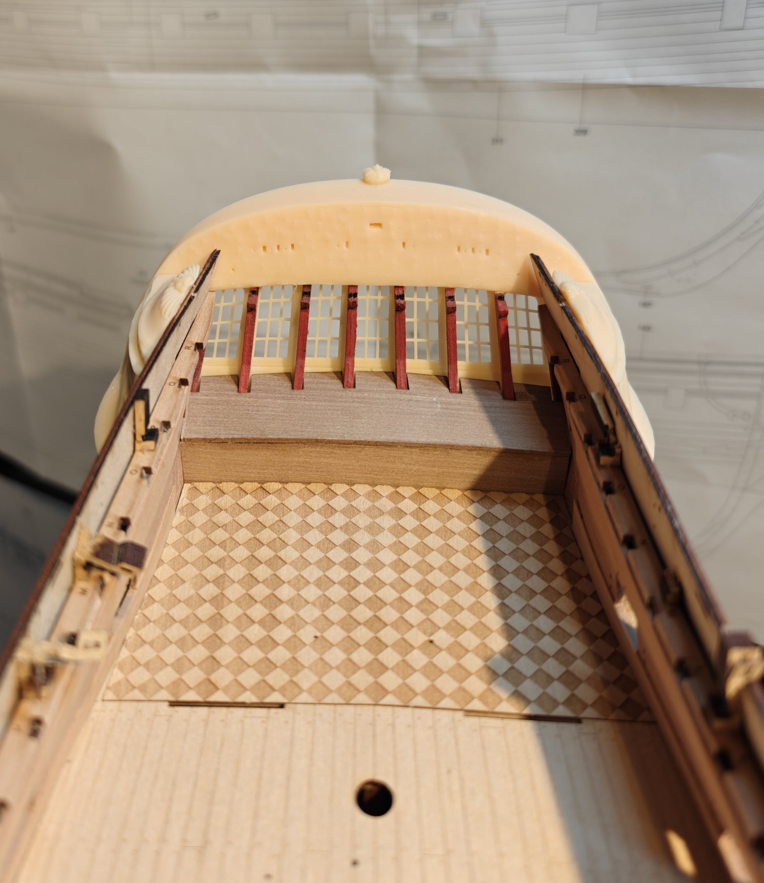

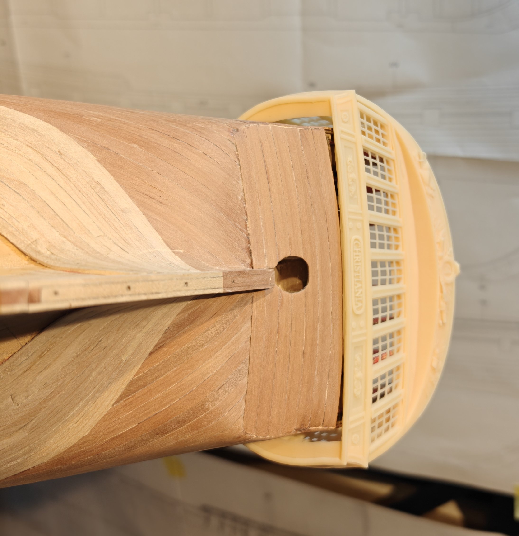

Log entry 29 - test print of stern

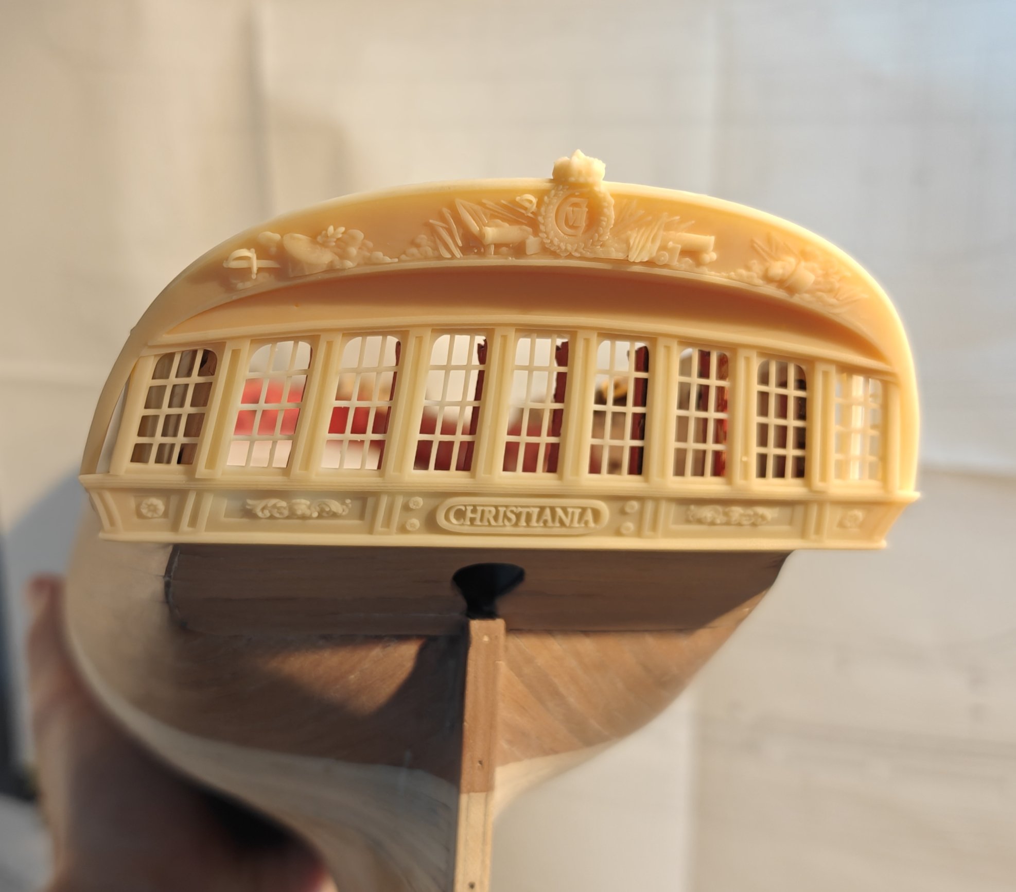

I have tried to make a model of the stern that include everything in one part: windows, friese, side galleries, etc.
I have a bit of issue with the print itself - I think I need to change the release film on the resin vat as I may have a tiny leak with a bit of cured resin underneath that blocks the light.
Here is what it looks like:
Overall, I am very excited to see this as it really shows what the stern will look like eventually, and I am very happy with how the different parts look.
But... The fit is absolutely terrible 😅.
Especially around the lower parts of the galleries. And the curvature of the rear window panel is also causing issues as the model is not a great fit there either.
What I will try do do is this: re-model the rear window panel with a curvature and remove the lower parts of the galleries and make these separately or in wood to insure a tight fit.
It will probably take a few more iterations to get it good enough, but I think I will get there eventually.
BR
TJM

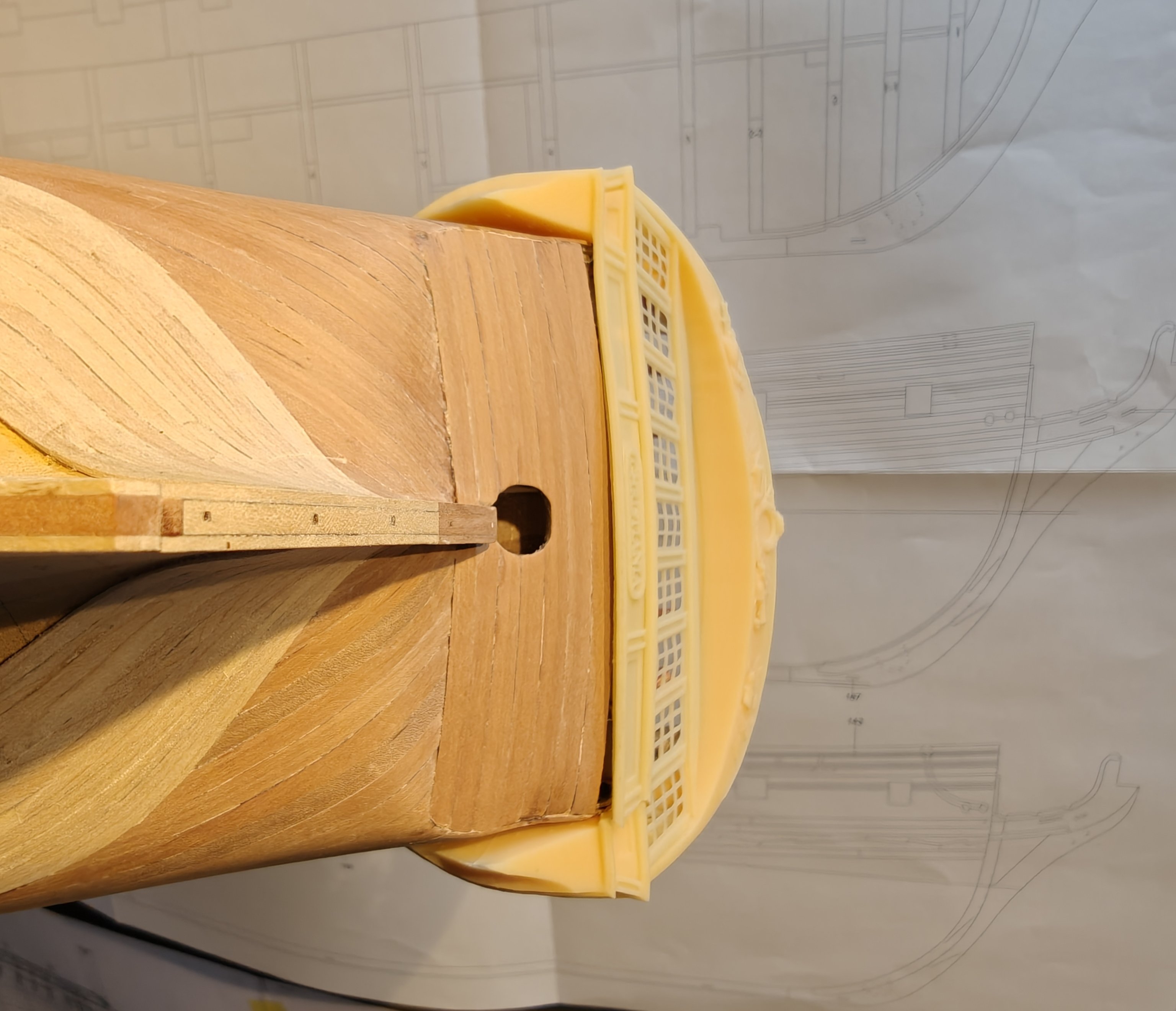

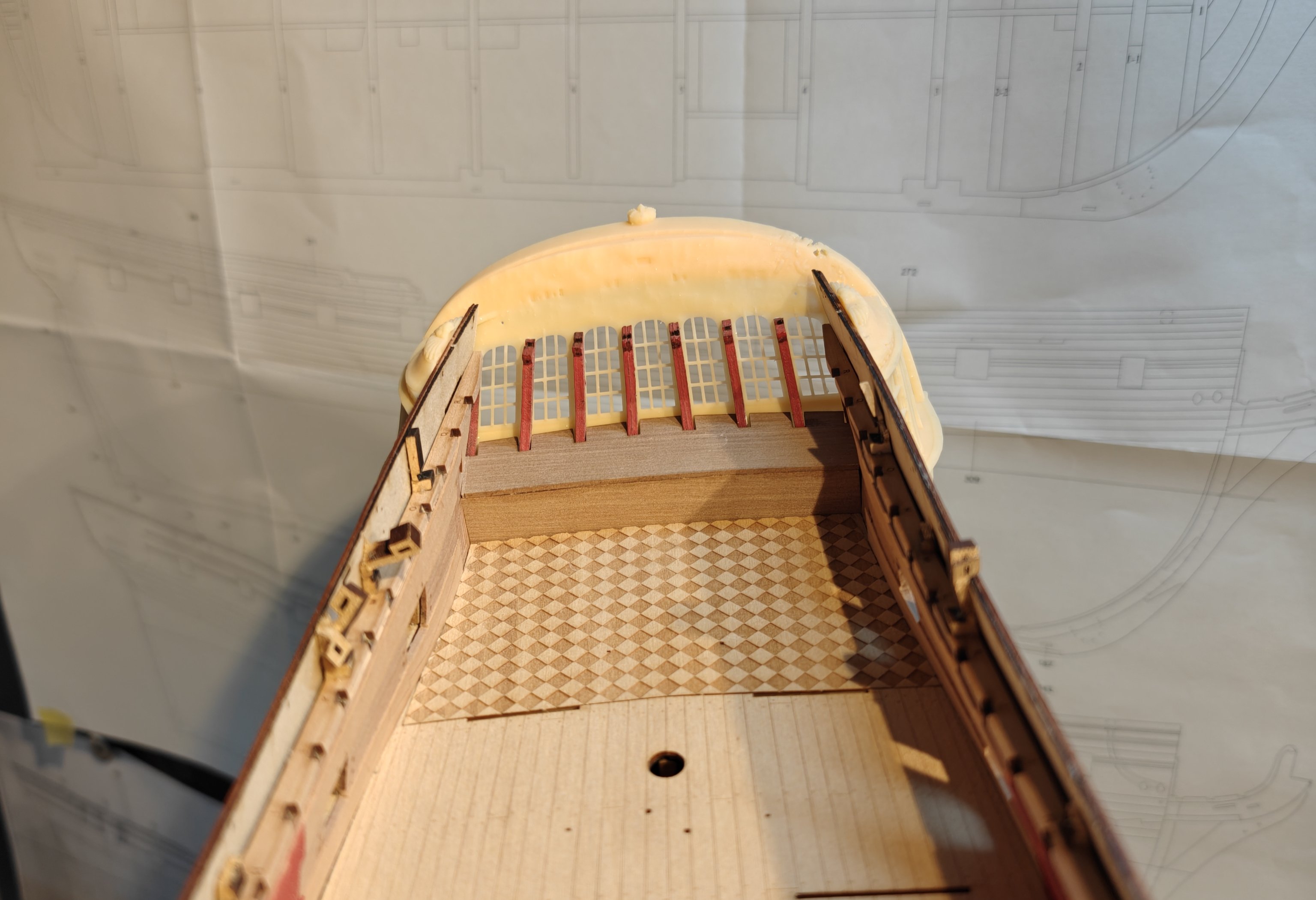

I made the adjustments but it is really hard to see on the photos.
The whole window section is now curving and I took the opportunity to add lower stern decorations. These are made with Meshy.ai, see the recent discussion on the 3D modelling sub-forum, and will be the first aI generated elements I use.
The fit is much better, but there are still room for improvement.
I also have a weird bend at the top of the side galleries, symmetrical on both sides. This is a printing issue, but I am not sure what happened. Something shifted or there is a lack of supports that make the model sag or compress. I also have a lot of support residues on the side galleries, a result from trying to support the bars to prevent bending during printing.
But i changed the release film on the resin vat and am getting crisp prints across the build plate again, so that is nice!
I have to look into the printing technicalities and also make another small adjustment to the angle of the side galleries to improve the fit further. But it is getting closer 🙂.
Log entry 30 - final(?) stern version and a colour test
After a few quite some iterations, I now have a fit that I am happy with. And I like the design.
With an additional plank added below the stern and the lower parts of the side galleries made from wood (that will be a small challenge as well), I think this will be good.
I made a colour test from the last version (the one that didn't fit as well as this newest one), as the only things I am 100% settled on is that the windows will be red and the friese and ornaments will be yellow ochre.
So I did not aim for a super neat paint job here and have used mostly flat colours with minimal shadows and highlights. This is just to evaluate the colour palette:
I am resonably happy. Or, I should say, I like this colour scheme, but I am a bit apprehensive about the prospect of actually trying to make a super neat paint job. It is extremely difficult! And even though I am out of training, I have been doing miniature painting for over 25 years and this is really some of the most difficult I have tried. The print is so crisp and nice and I feel I butcher all that lovely detail with globs of paint! Organic shapes are much easier to paint than flat surfaces or straight lines!
This test took me at least 4-5 hours to paint, and I will have to go much slower, with more, thinner layers for the final version.
I am considering if I should try a contrast paint method, basically a wash method, to get the basics colours in and then do a single pass of main colour and highlights for the yellow. I could perhaps also mask off and airbrush the red in after the initial wash. Or I could airbrush it all yellow, mask off and do the red and then add the black after. Hmmm, I will think about this while I continue with the planking ....
