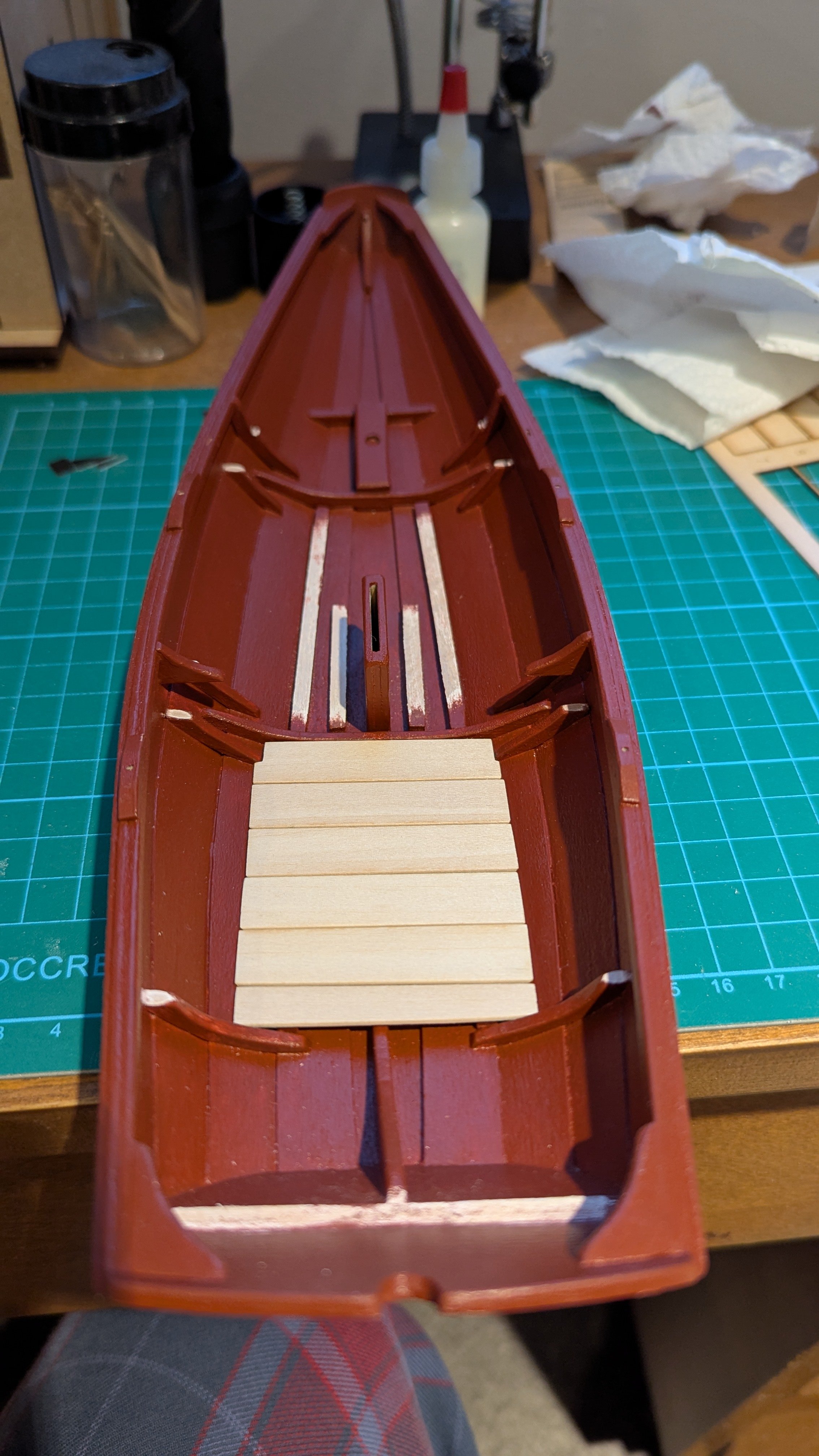

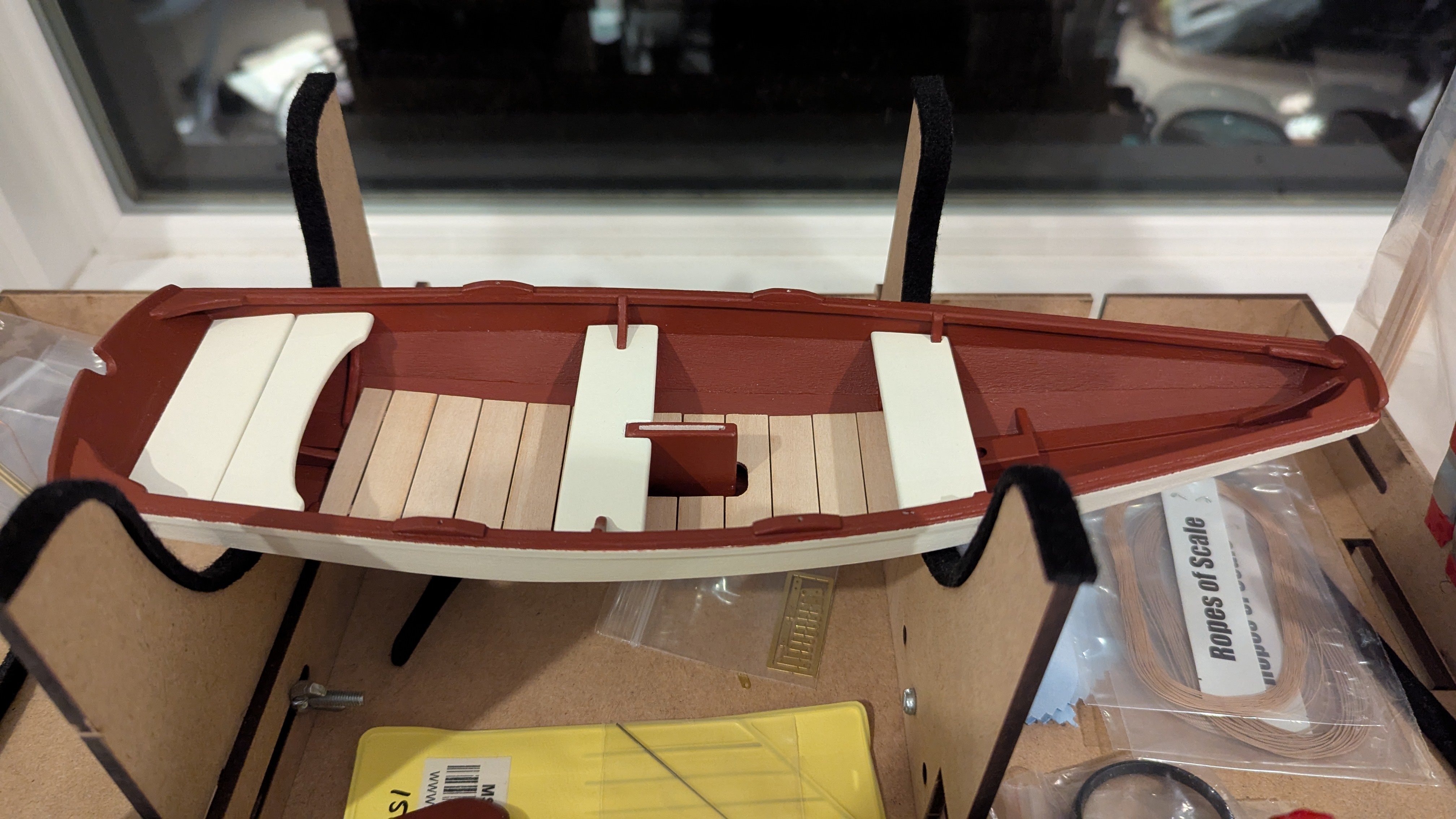

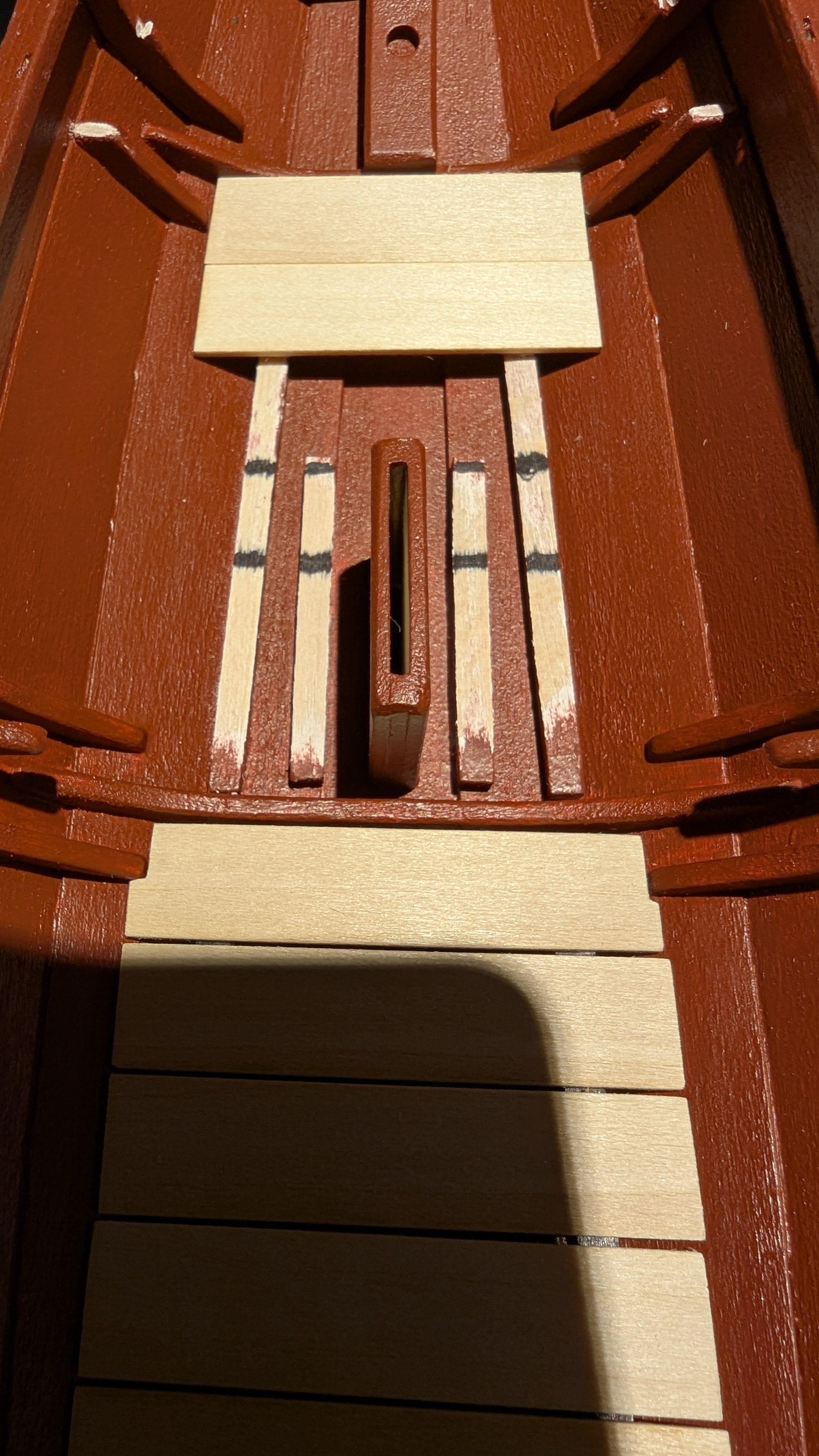

Log # 12 - Floor board, thwarts and stern sheets
With the wife getting sick, and isolating in the room I also work on my boat, I was playing single parent for a week and a half, but back to the pram this week. Made some decent progress.

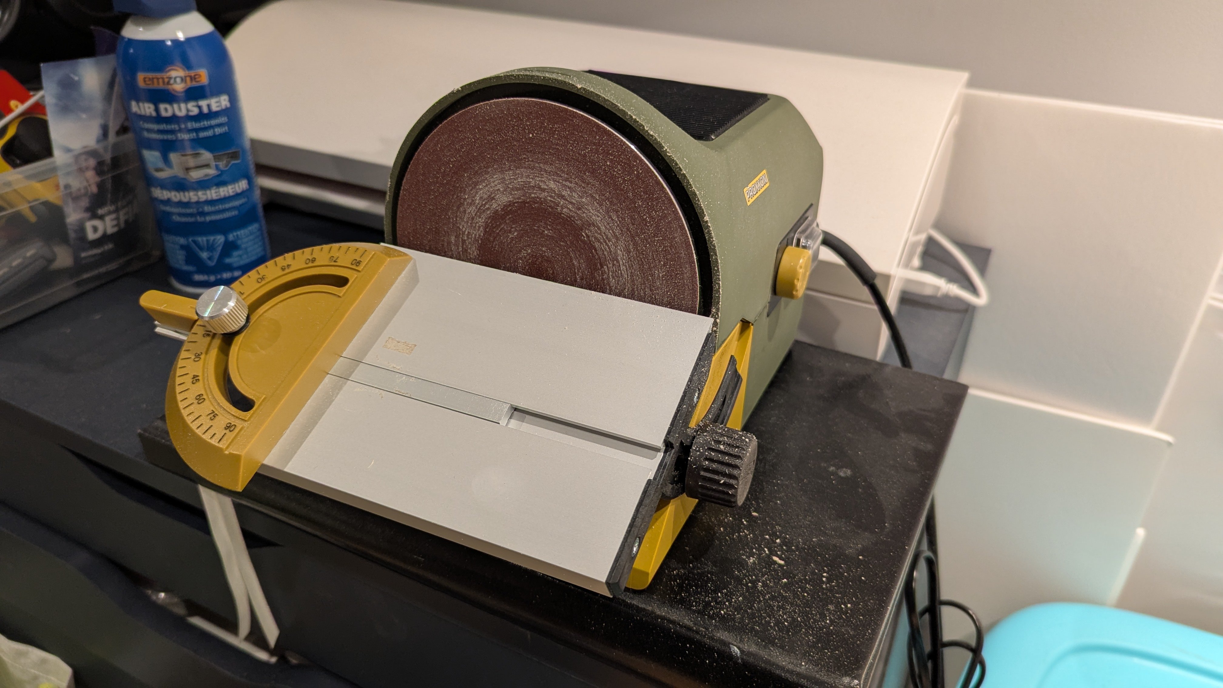

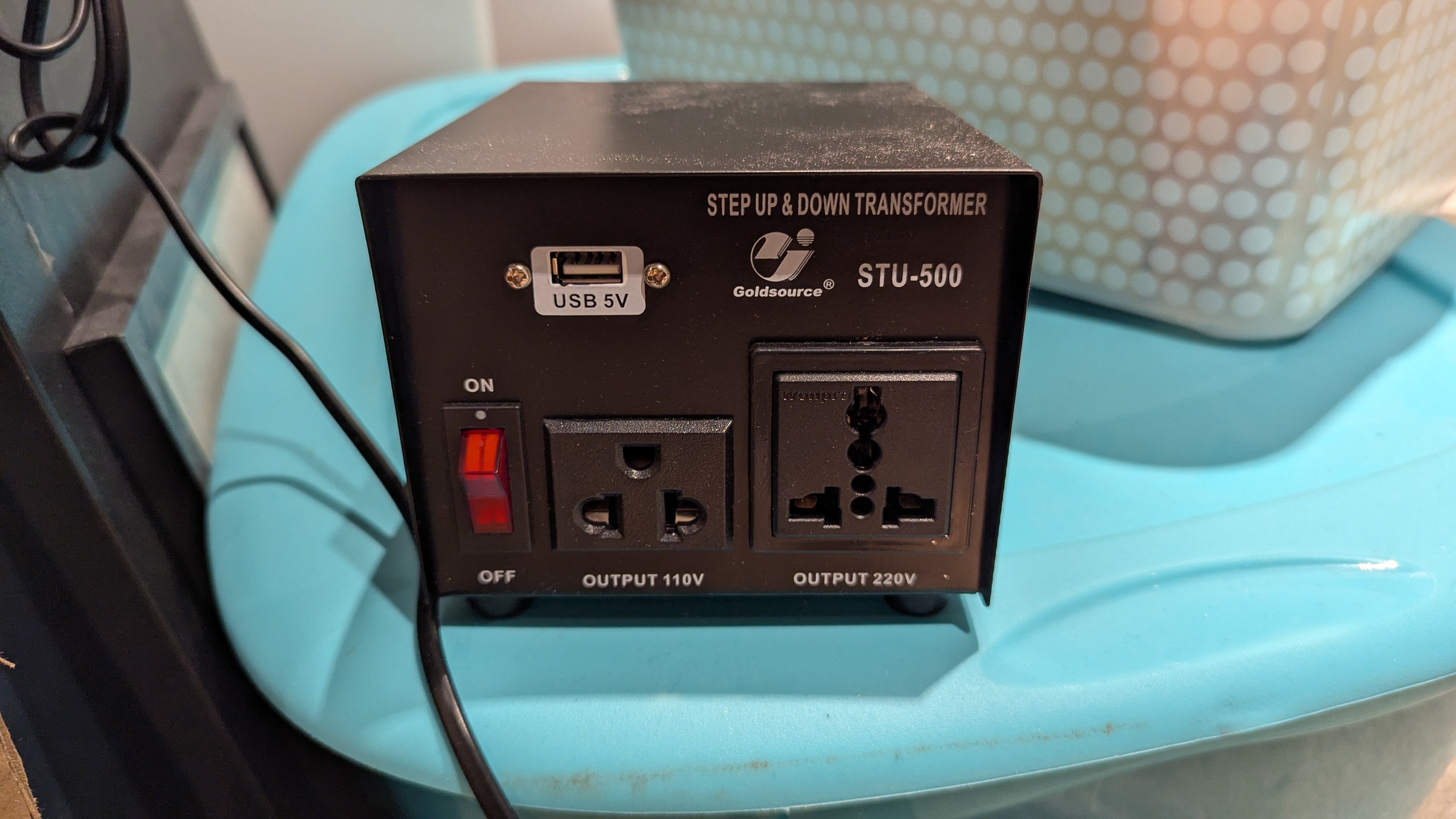

First off, I picked up a disc sander months ago for black Friday. Stupid me found a great deal in the UK and ordered it. Oh yeah, they don't use the same outlets as North America, forgot that tiny detail! I ended up keeping it and getting a transformer. Finally got to give it a proper go this week and I'm in love. It takes the char off in a split second, bevels precisely at any angle. It was great while working the floor boards. Just have to be careful not to take too much off, it goes through those little pieces like butter.
The transformer works great. I thought I was going to have to send it back, but this was a lifesaver.

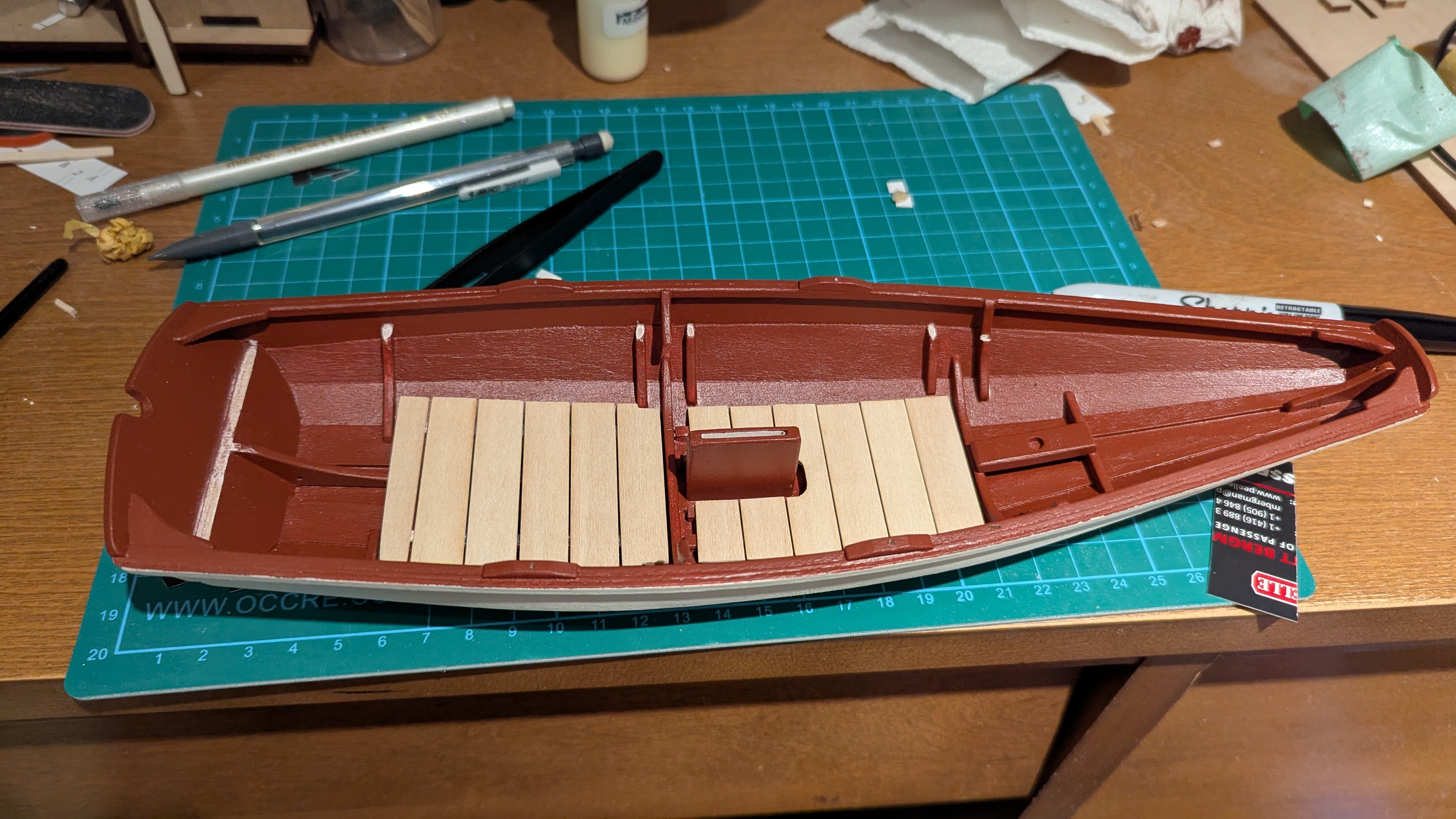

I realized that since I sanded down the supports, there would be light wood between the board. I marked out where they seems would be and darkened them with a fine point sharpie
My only regret is painted the thwarts. I like the look of the bare wood and matching the floor boards much better. The only reason I painted them was because it looks like they were painted in the instructions. At least it doesn't look bad, and they match the outer hull anyways. I also touched up a few small spots and put another coat on the center board, filed down the inside of the case a bit more to make room for all the paint. It's a bit on the tight side, but should work nicely.

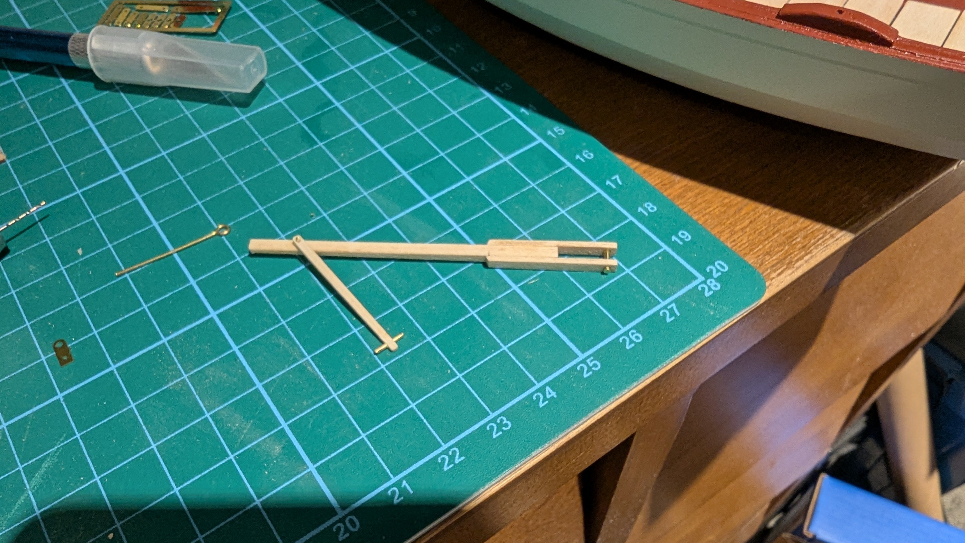

Had some surprise free time today to work on the tiller. Instructions call for 3 pieces of 1/16" brass to complete it. So okay, tiller first, I nervously broached (a word?) out the hold I drilled to fit the 1/16" brass rod, then I look at the tiller extension. NO WAY a 1/16" hole will go through the extension, it's overall width is 1/16"
So now I've got a way oversized hole in my tiller for the extension. I'll need to find a work around for this, but there are far to many of these stupid errors in the instructions. Especially for a beginner kit that had been around for this many years, it's very frustrating they haven't corrected these yet. :angry:
Should have some time tonight to get the tiller glued together, and figure out what I'm going to do with this oversized attachment point.

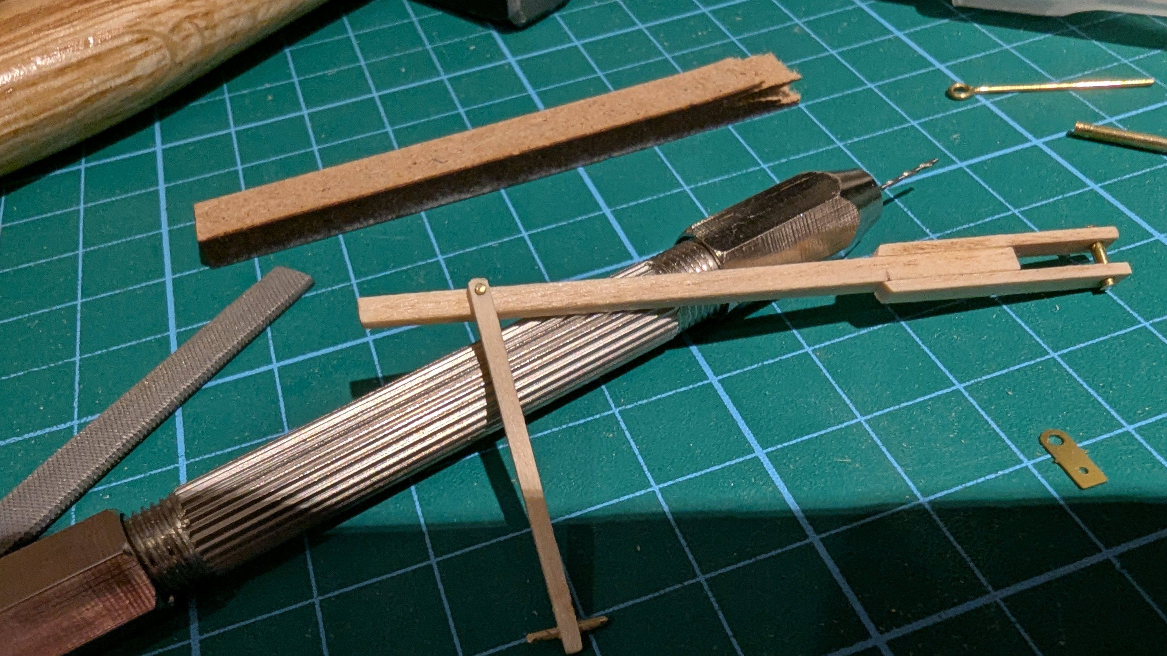

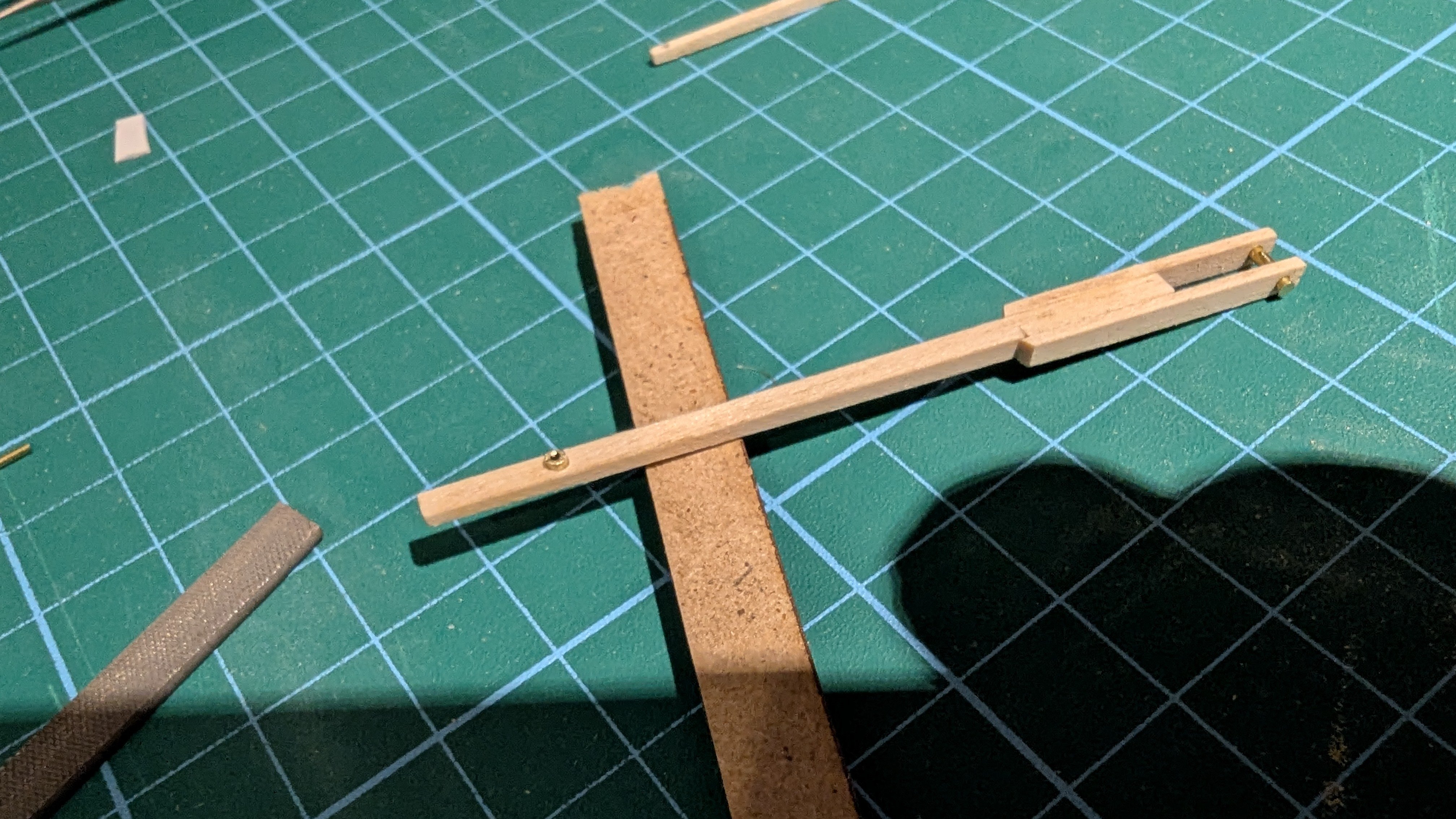

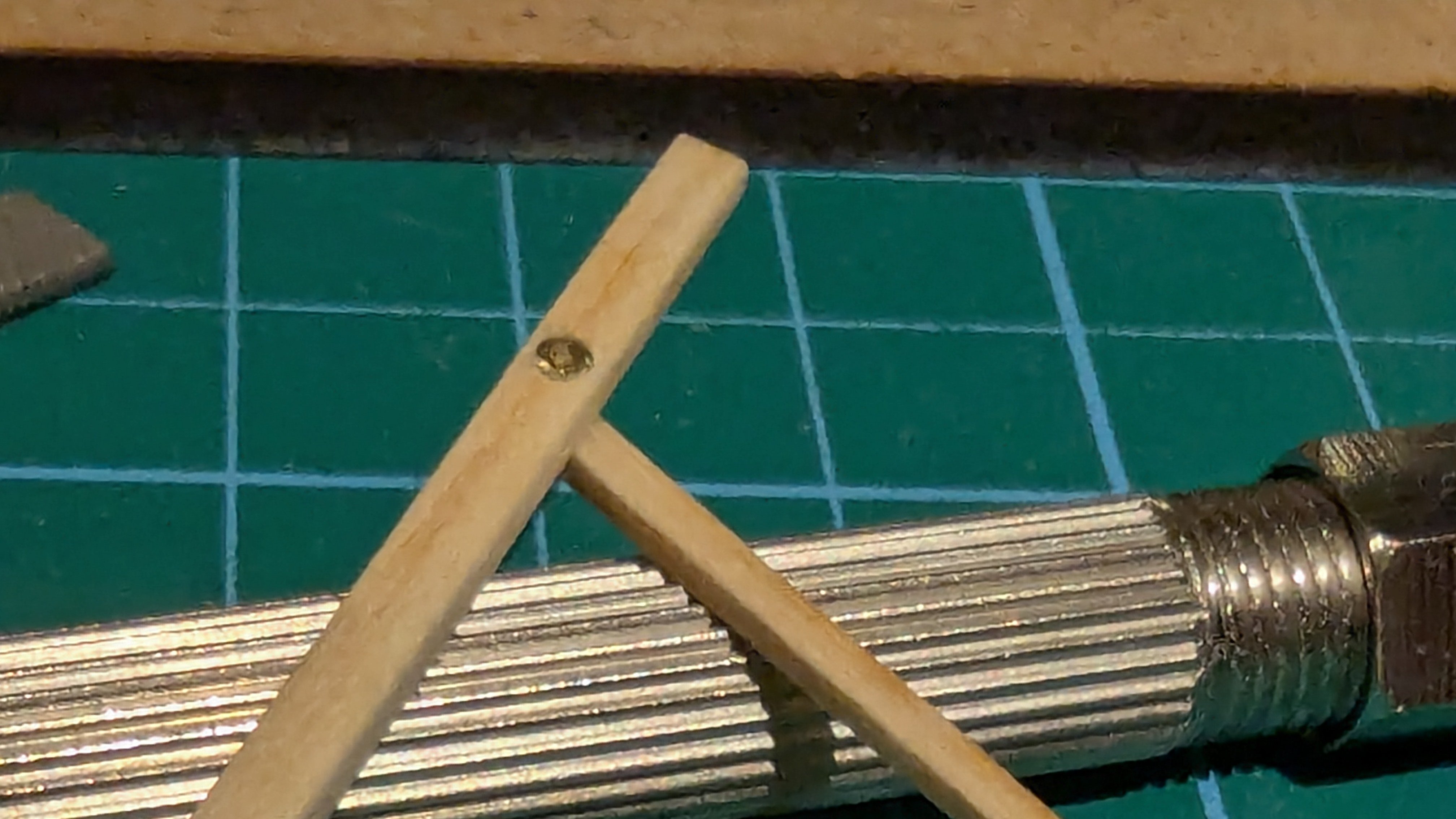

Messed up the tiller earlier today, so had to do an emergency disassembly. I glued the side pieces on the top and bottom, not the sides - oops.
Got that fixed up tonight. Managed to cut the brass down and 'rivet' it. However, I definitely have too much brass sticking out. I would like it to be tighter to the wood, but I'm leaving it for now. One piece stated bending slightly so I stopped. The tiller extension is so fragile I didn't want to get too excited as I'd risk breaking it completely and being in a far worse spot.
I cut the brass with a razer saw which was a little cumbersome, but worked well enough. I stole my wife's jewelry saw, but I think the blade was too large for this work.
I used one of my smallest bits to start each hold and used a broach to open them up to the needed size. I'm glad David recommends the broaches and I bought some early on - they were a life saver here.

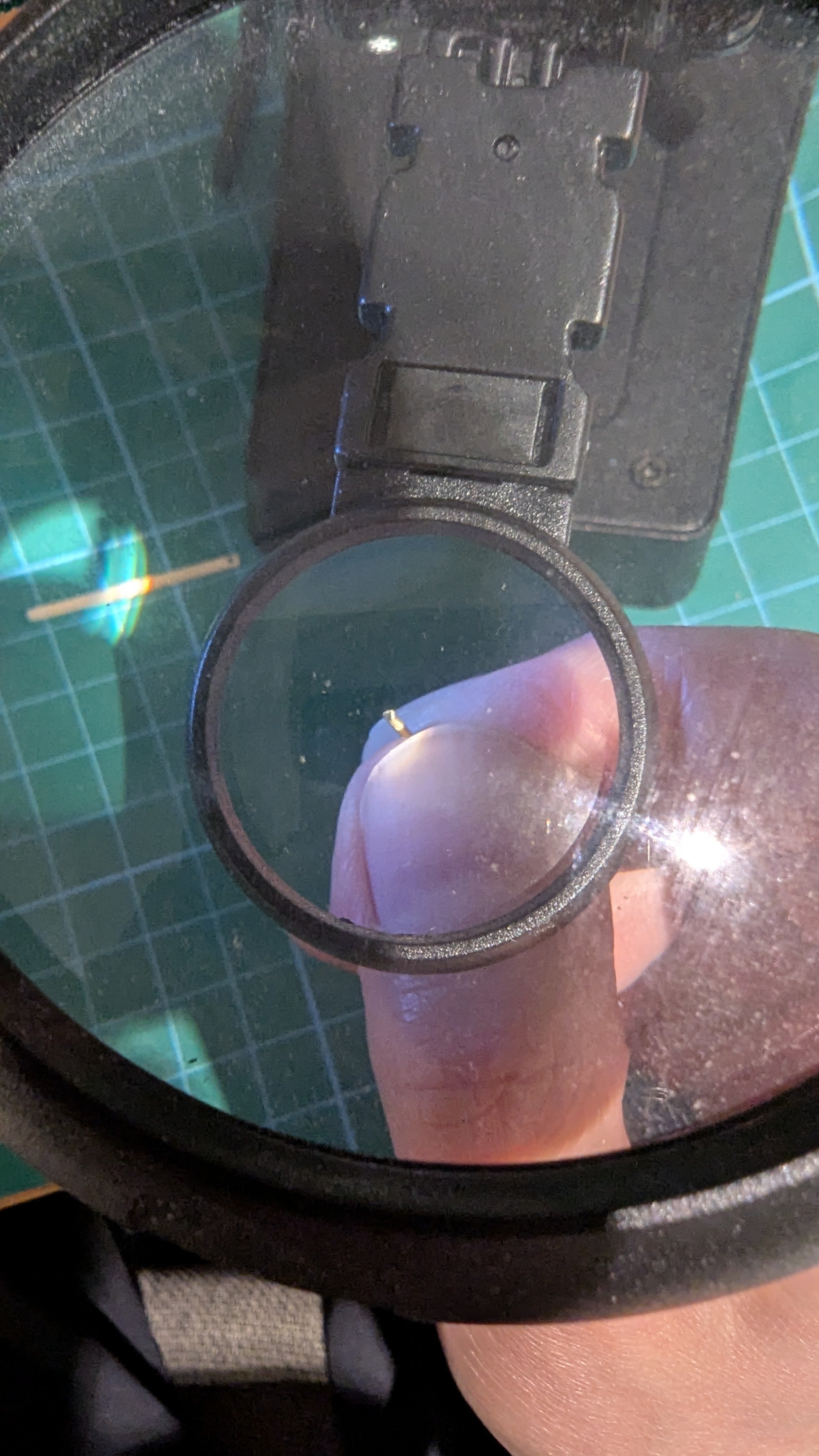

I fixed the problem mentioned in the earlier post by fitting a small piece of 1/16" tube into the oversized hole. The 1/32" rod fits perfectly inside and clears the hold in the extension.
1/16" tube cut and fitted - though a touch long
1/16" tube with 1/32" rod in the middle
Top side:
I may attempt to cut or file back the excess brass that attaches the extension, but I'm leaving it as is for now.

How did you get the brass through the tiller extension? I have no clue how that could be done!
Trevor
Very carefully and with sweaty palms!
Marked out where it needed to go and scored it a bit with a mechanical pencil. I used a #72 bit (0.025"), positioned it as center as possible with a magnifying glass, drilled through, then used a broach to slowly open it up to 1/32" (0.03125). I thought I was going to break it many times, but surprisingly I didn't need to use the spare. I ended up being slightly off center, but made sure when drilling I was looking down the length of the tiller to make sure I wasn't veering off either direction.
Before fitting the brass I filed the ends slightly so it wouldn't catch on any sharp edges and then just kind of twisted it into position. I touched the sides of the hole with diluted pva after the brass was in place.
I'm not surprised that many haven't gotten this to work, this is incredibly small work!
Have you tried yet, or in the thinking and planning stage?
