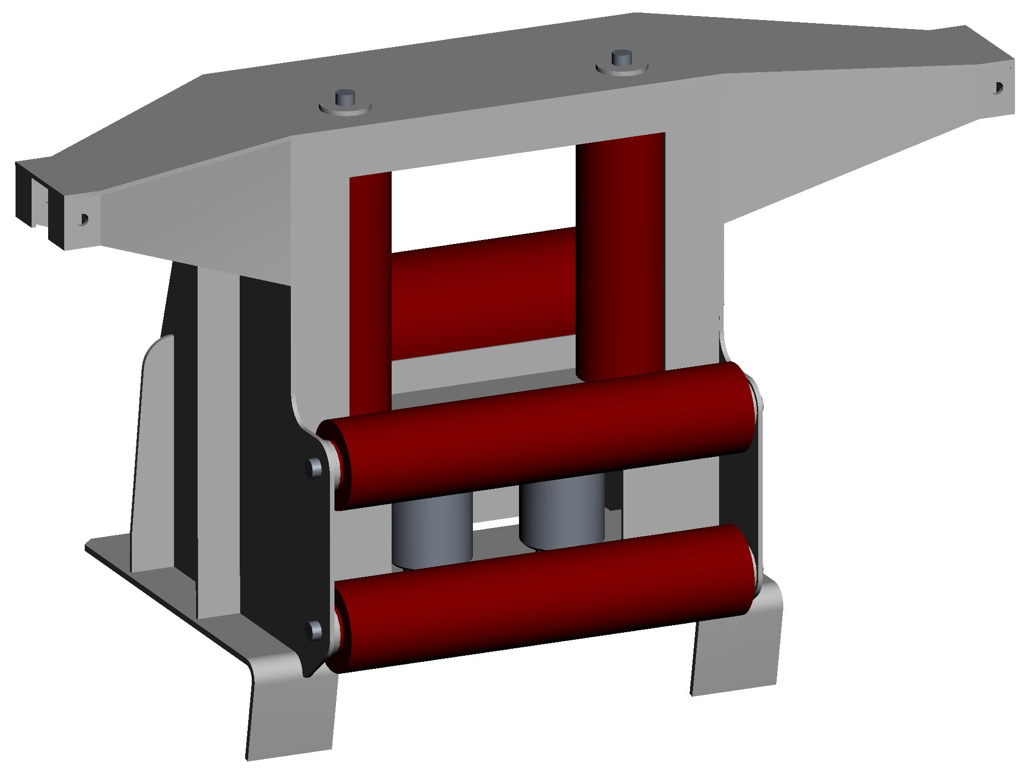

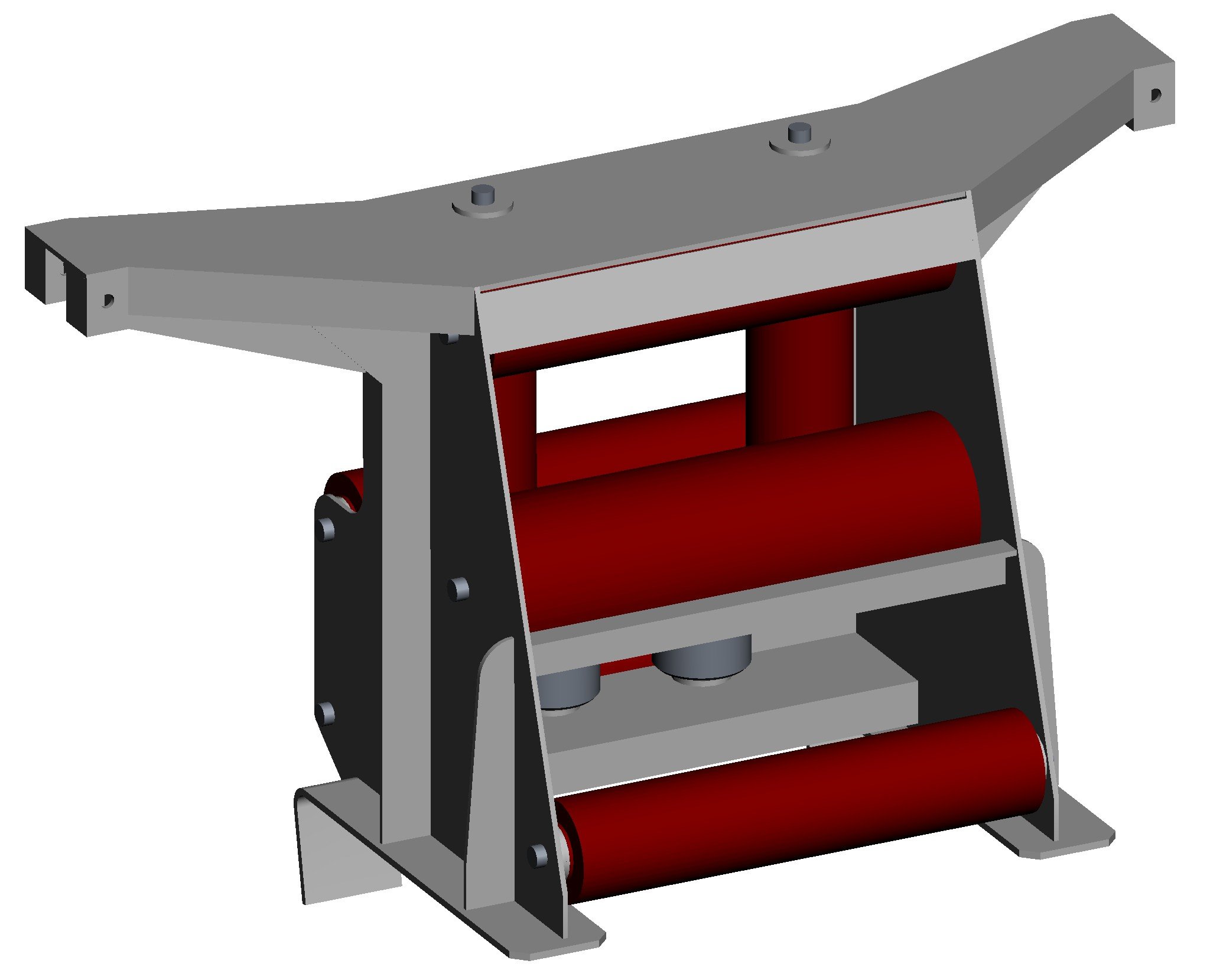

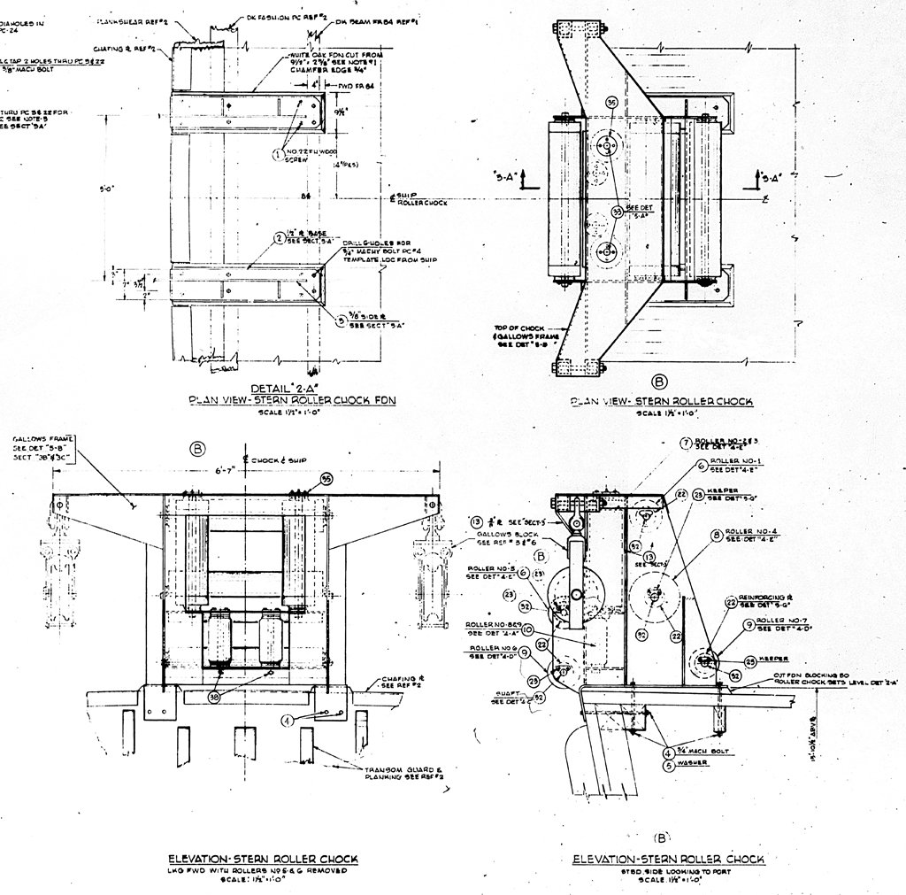

This is part of the blueprint for the stern roller chock. All of the minesweeping cables pass through the rollers or blocks attached to the "arms" of the top piece.
This is just a small part of a large blueprint that gives the dimensions of all individual parts and a complete parts list. From this I made a CAD drawing of the assembly, and from it I can make 2D scale drawings of all the parts. I will make the pieces from 0.010 and 0.015 inch (0.25 mm and 0.4 mm) brass and solder them together.
Sternrollerchock1.thumb.jpg.a3dde4fcf8349a11ca3a6fa55c38d28f.jpgSternrollerchock2.thumb.jpg.328fd0e520d9300f85832504e83a96d8.jpg

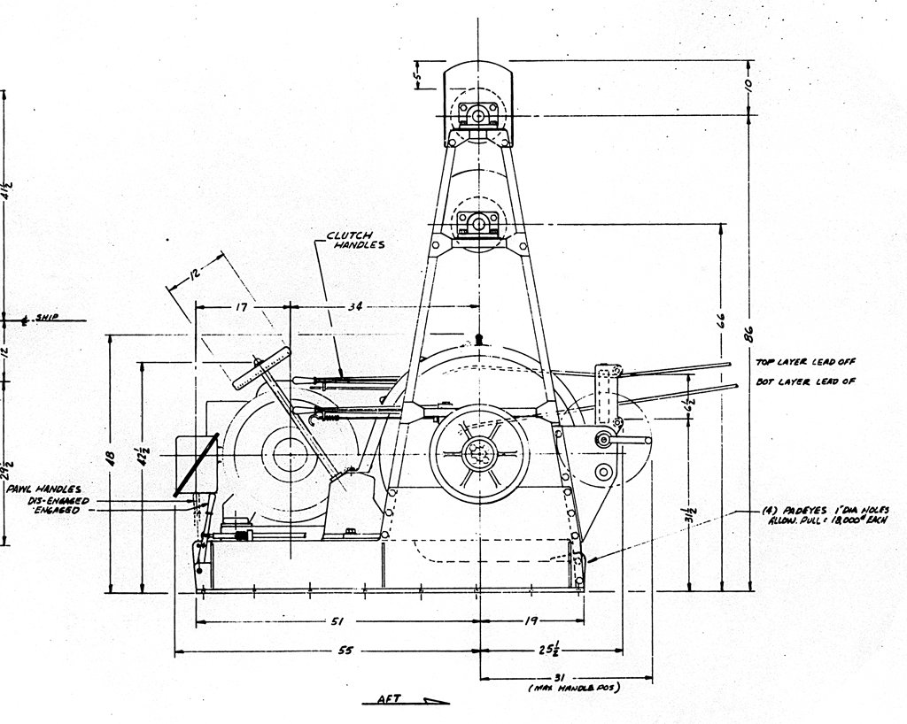

Some of the assemblies are more challenging. Here is a side drawing of the minesweeping winch (for towed sweeps to clear moored mines).
I have top and end drawings as well. However, these drawings only give dimensions for the entire assembly, to be used for planning the mounting arrangement on the deck. No detailed and dimensioned drawings of individual parts are given, and there is no parts list. So I have to do a lot of measuring and calculating to guess the dimensions of all the parts not shown. I do have some photos, but they don't show many parts of the assembly.

Thanks. The plans are pretty good, but a large number of dimensions are not given and have to be determined by careful measurements from printed drawings and scaling compared to dimensions shown on the drawings. But that's a LOT better than "photoguestimatiion" using measurements from photos!
But I did run into a problem. One blueprint shows the winch control stand at the forward port corner of the winch. Another shows it on the fore side of the winch between the left two brake wheels (white in the images). These images show the two different positions for the control stand. The  three white brake wheels are on the forward side of the winch, and the cables from the winch streamed out from the aft side.
Minesweepingwinch3.jpg.d0e7056213ad4b58edbfaa4512224bd0.jpgMinesweepingwinch7.thumb.jpg.ec9067b8c2f8b8a5b5a8f3a31107342e.jpg
If the control stand was at the port corner it would be directly in line with the port gypsy head, and that would interfere with using the gypsy to pull on ropes and cables.
None of the photos I have show the control stand clearly, but one that I took while we were streaming minesweep gear does show the white knob on the control stand handle to the right of the port side white brake wheel. So it appears the stand was in front of the winch and not at the port forward corner. But I am not certain where it was. And the photo may show the stand rotated around the vertical 180 degrees from the position shown here, with the handle on the inboard side. But that would put the stand right in front of the brake wheel, making it hard to reach! I will probably put it in the front, with the final position determined by what looks best.
The control stand regulated the motor speed. The motor drove a series of step down gears in the long gear box with the rounded corners. The gear box turned the main shaft with the two gypsy heads on the ends for winching ropes and cables, etc. Each cable reel had a brake band around the outside of one side of the spool (inside a protective cover). The brake wheels (white) tightened and loosened the brake bands. Each reel also had a clutch that rotated with the main shaft. To engage the reel the long horizontal handle beside the brake wheel was pulled to the side, pressing the rotating clutch disk against a clutch plate on the side of the reel. The vertical "pawl handle" below the brake wheel was pushed forward to engage a locking pawl against teeth on one side of the reel to lock it in place.

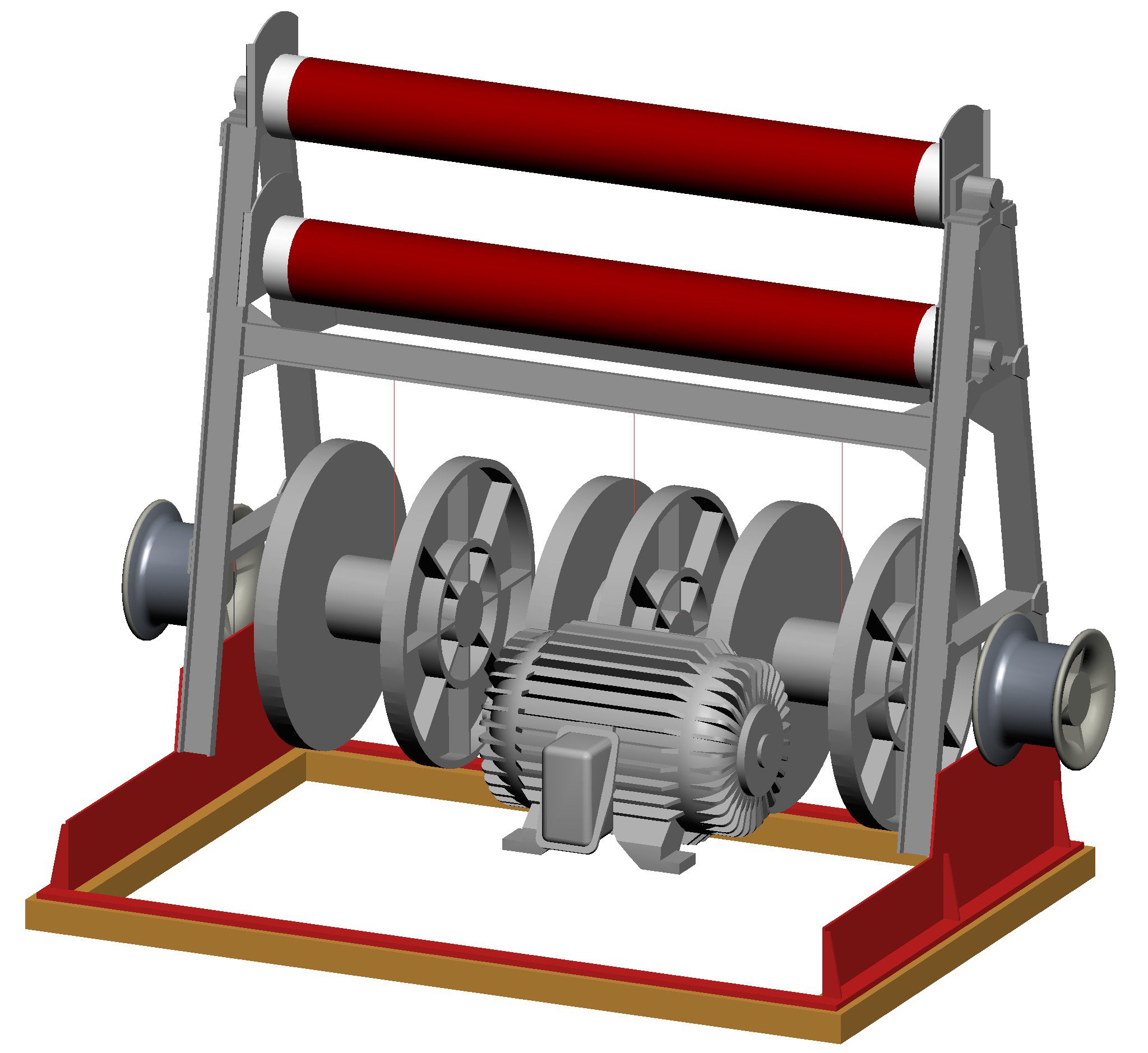

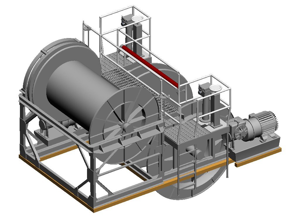

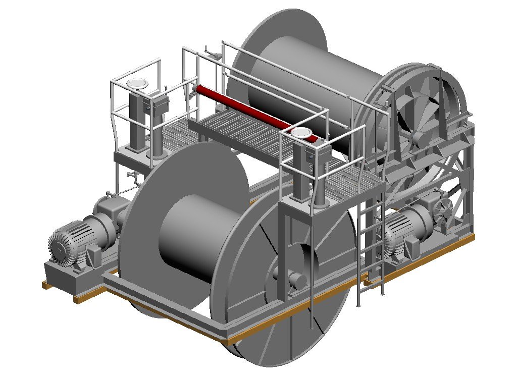

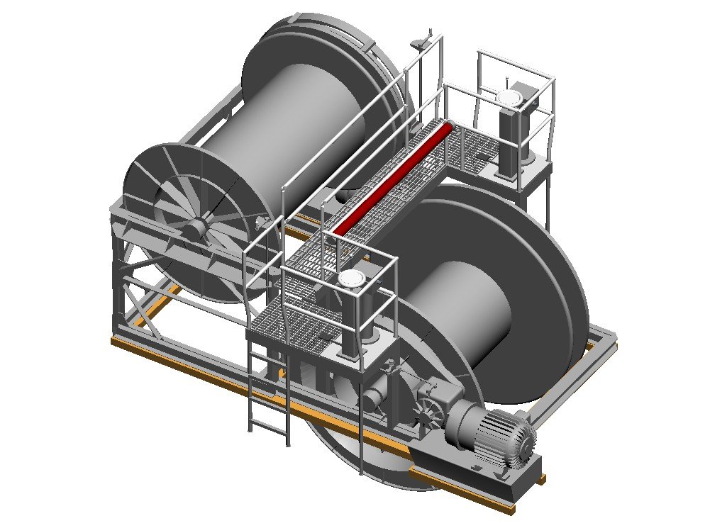

Two winches were combined in one framework. The upper winch was for the towing and power cable for the acoustic minesweeping device. The larger and lower winch was for the magtail - the magnetic minesweeping cables. They had similar controls and motors. The gearbox was the same for both winches but the motors were slightly different in size and power, but manufactured by the same company so they look alike.
Magtailandacousticwinch1.jpg.29d664c41da2233e753de275b8dcec99.jpgMagtailandacousticwinch2.jpg.046067644c41bc8f34ebdba8e905bd1b.jpg
Magtailandacousticwinch3.jpg.6f8c956ba1573d87933352a3800b0e48.jpgMagtailandacousticwinch4.jpg.51efbac53fd3981ae616aa8b54bfa45b.jpg

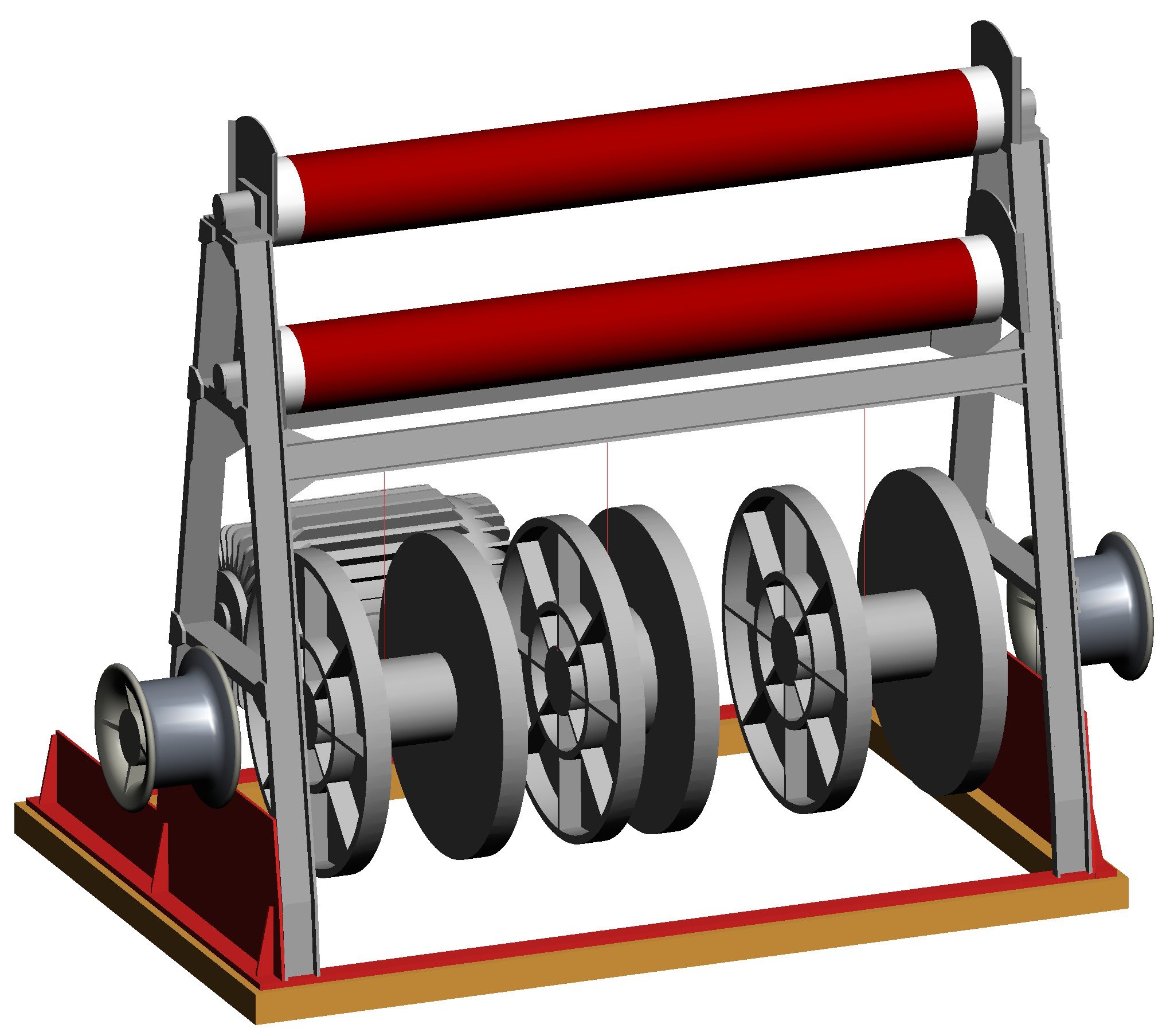

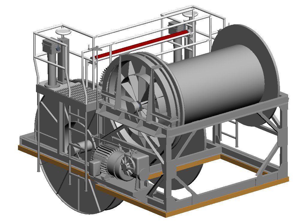

I think this will be the most complex assembly on the model. It will be 4.29 inches (109 mm) long (fore to aft), 3.375 inches (85.7 mm) wide and 2.33 inches (59.7 mm) high. This thing was difficult to model because the four blueprint drawings that show all or part of it give different dimensions! And the dimensions for most parts aren't shown, so it was necessary to measure and scale everything. Worse still, a lot of the framework pieces aren't shown (or are faint outlines) so there was a lot of guesswork and successive approximation until everything fit in pretty good agreement.
There were some parts shown in the drawings that simply wouldn't work. For example, there was a cross brace for the framework that would pass through the sides of the cable reels! I have been working on this drawing for 12 days trying to sort out these things. It may not be perfect (there are some parts of the mechanism I won't try to model) but it will be good enough for this model.
Magtailandacousticwinch5.jpg.4cc7578dbf8b25491fb9575410e8e7ec.jpgThese 3D CAD drawings serve two purposes. First, they force me to try to understand how the things were built, and determine some reasonable dimensions.

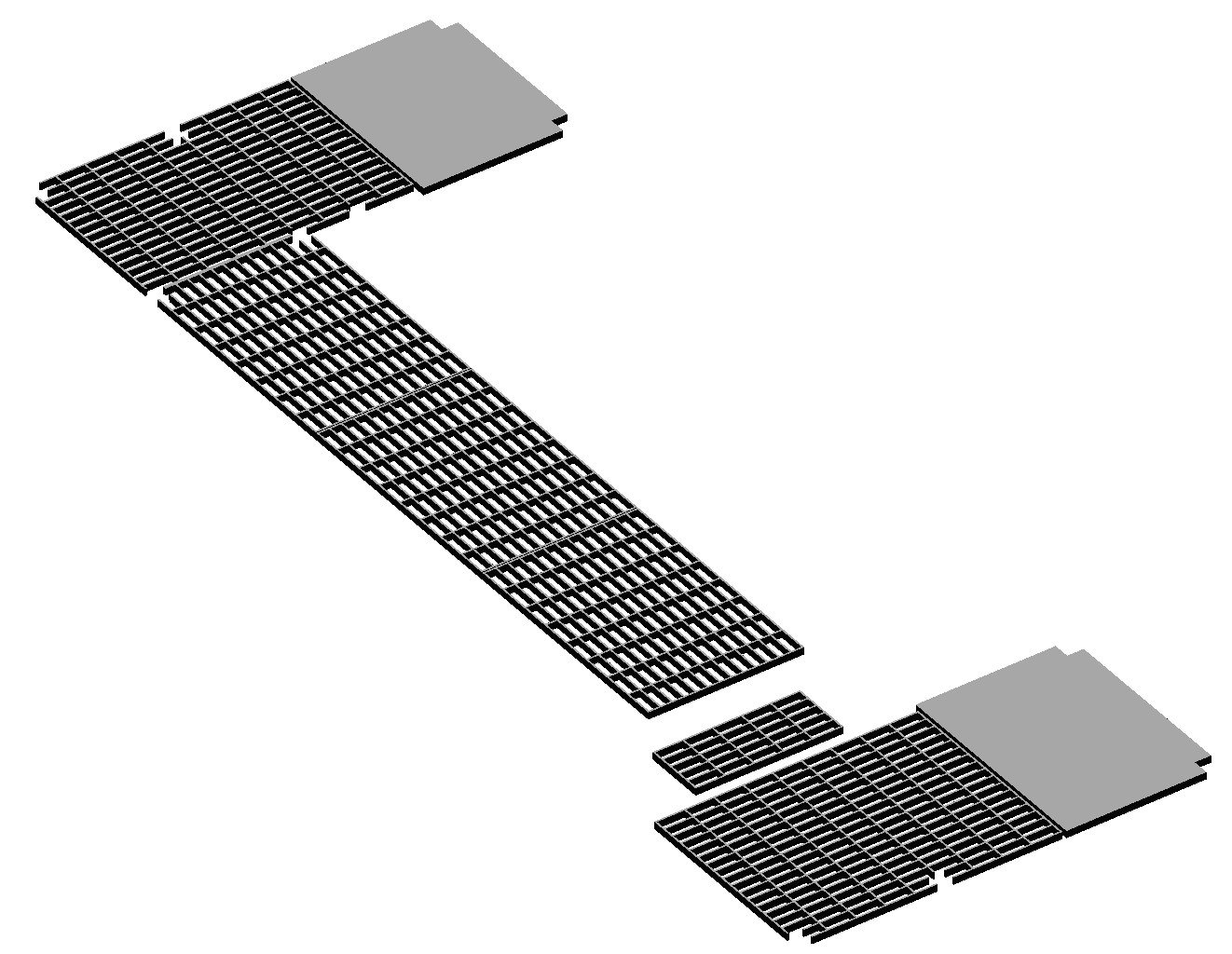

But the other purpose is to find parts that should be made by photo etch. I am preparing drawings to send to a photo etch manufacturer (I don't want to mess with doing it myself - that can be pretty frustrating).
This is an example of some photo etch pieces from this winch assembly - the deck gratings. I can probably 3D print them - I have done some very small screens and such. But the 3D print material is brittle and these will be thin (0.020 inch or 0.5 mm) and very fragile. They will be more likely to survive handling if they are photoetched brass or stainless steel.
I may use 3D printing for the motors and gearboxes. Although the motors were slightly different sizes (about 3% difference) I will probably make them all the same size.
Most of the framework will be made of brass pieces soldered together.

I agree, those CAD drawings are very good, Phil. In case I missed it, are these models going to be 3D or resin printed?
Superb 3D modeling of that double winch, Phil.
That's very practical and sort of a virtual rehearsal in making sure it's all going to fit together.

I have a resin 3D printer, but I haven't used it in quite a while. A few years ago I experimented with a bunch of things for a 1:96 scale model of the USS Oklahoma City CLG-5 and got very nice results with details on very small pieces. But the resin is just too brittle and the small parts can't be handled.
I may print some of the more complicated pieces that would be difficult to make by hand - like the winch motors and gear boxes. But I prefer to make things out of brass where possible. Some things like the deck gratings and wheels on the scuttles will be photo etch.

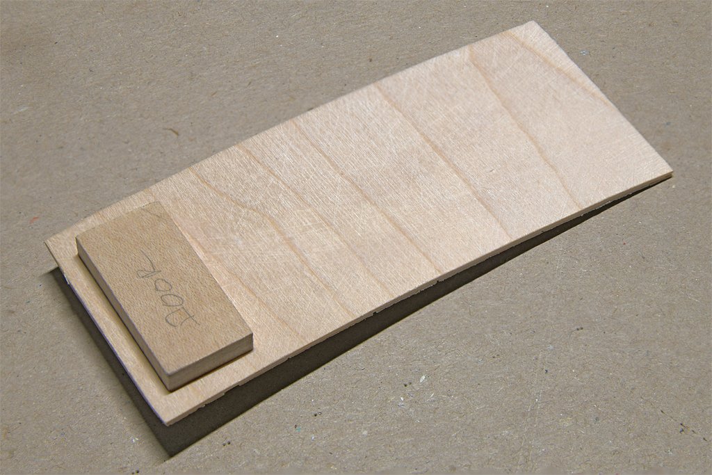

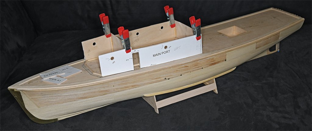

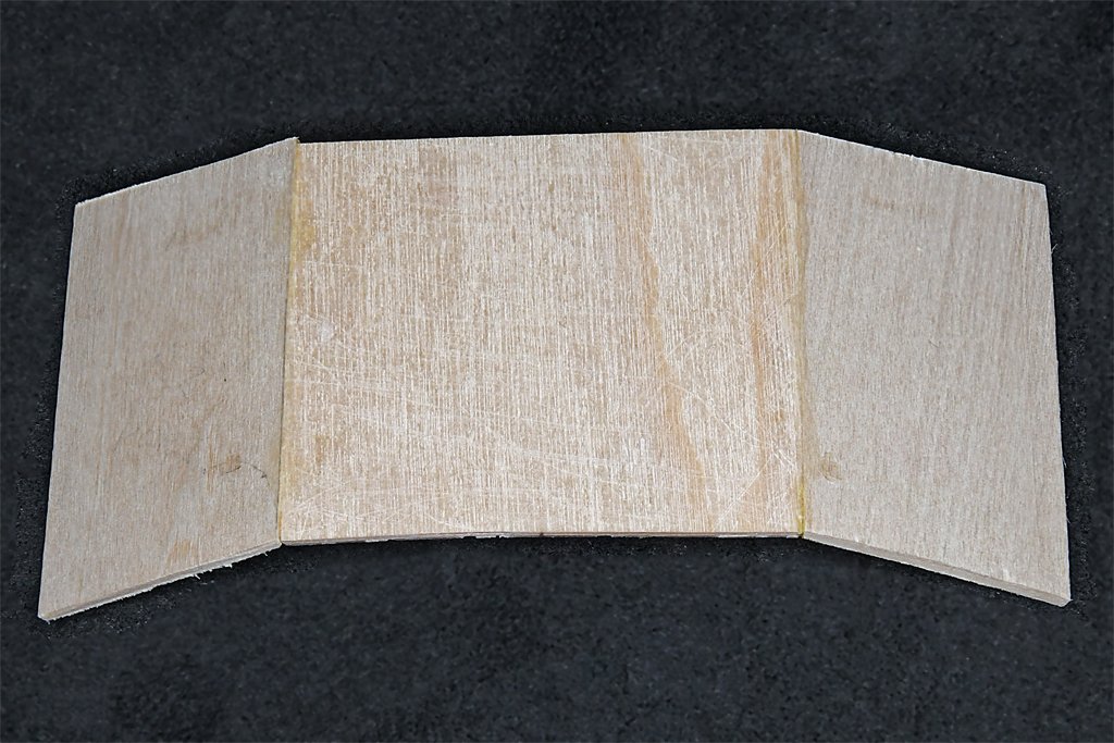

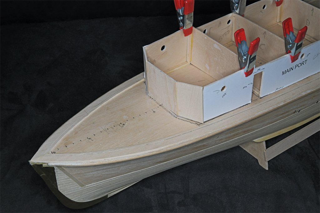

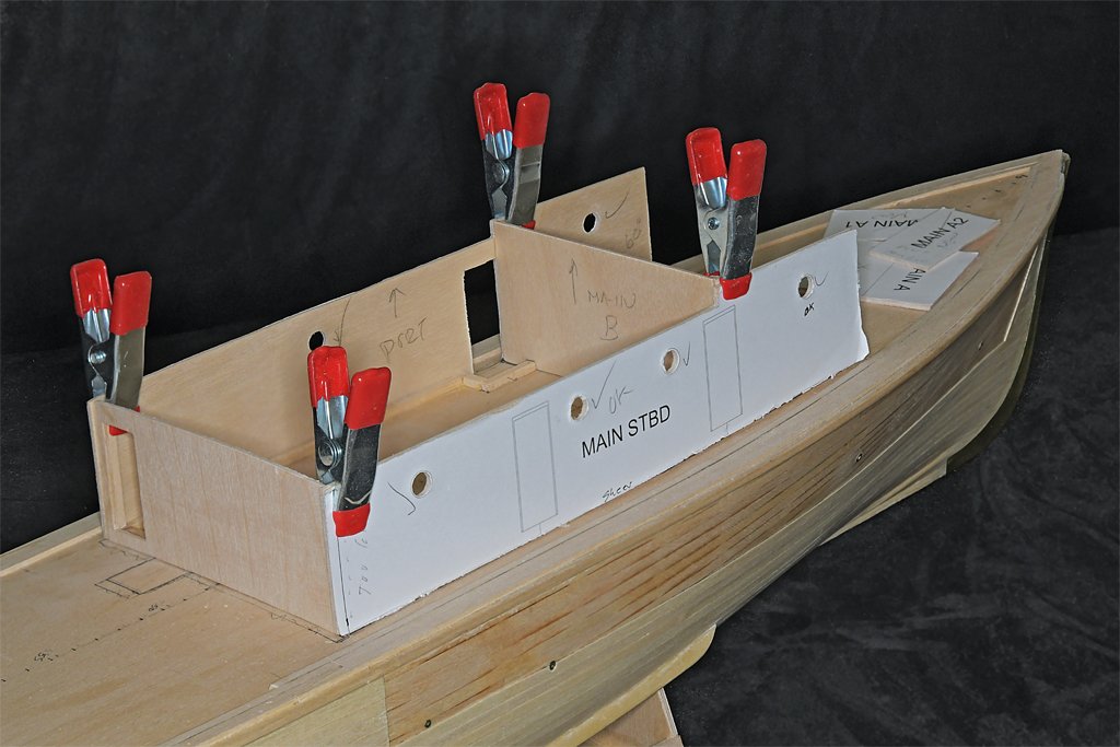

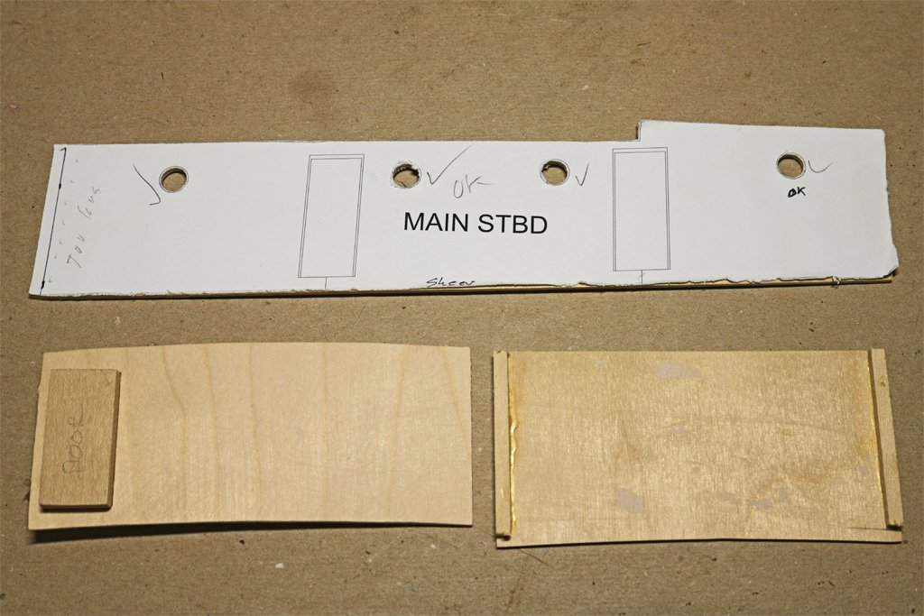

I have made a little progress on the physical model. Most of my time has been spent on planning the build sequence. The deck planking will go down first before the deck house and deck furniture is placed. But I wanted to get the main deck deckhouse pieces glued together before proceeding with the deck planks. That way I can be working on the superstructure off the hull while I am waiting for the planking glue to set.
The front pieces of the superstructure fit together at angles so I had to bevel the edges. The sides also come together with the front pieces at an angle. Setting up the disk sander to the proper angles took some trial and experiment. I also need to cut openings for doors and air ports in the pieces before they are assembled.
Doorsandairports.jpg.9012519e27864b9d4fa970e3e6fd4d8d.jpgDoortemplatetool.jpg.c9208b455942e71a3894a5698f73f979.jpg
I made a wooden block "template" for cutting the door openings. This will ensure that all the door openings are the same size. I am also gluing some of the 1/8 inch (3.1 mm) square framing strips in the corners where pieces come together..
Deckhouse2.jpg.79b3a2e2d57ac2dc65af3d8ed5c122ce.jpgDeckhouse3.jpg.eec10eadd05bd8fa34fbb35c7aee9401.jpg
After the holes are cut and the pieces are trimmed to fit I remove the paper pattern and scrape/sand any remaining glue to prepare the surfaces for painting.

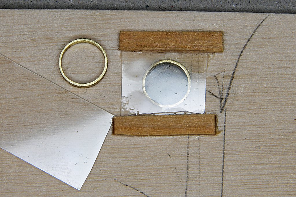

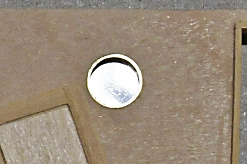

I am planning to make the 12" air ports with some brass tubing with 1/4 inch (6.35 mm) inside diameter. I want to make the window with 1/4 inch acrylic rod. The outer surface will be polished and the inner surface will be painted with the ubiquitous Navy interior (puke) green.
Like the mahogany trim on doors, windows and railings, I will need only a small bit of acrylic rod (~1.5 inch/38 mm). But the smallest piece I have found so far is a 6 foot (2 meter) 1/4 inch rod from McMaster-Carr. It costs only about US$2.50, but the shipping costs will be much more! I will continue looking around. Maybe a machinist friend will have a scrap piece.

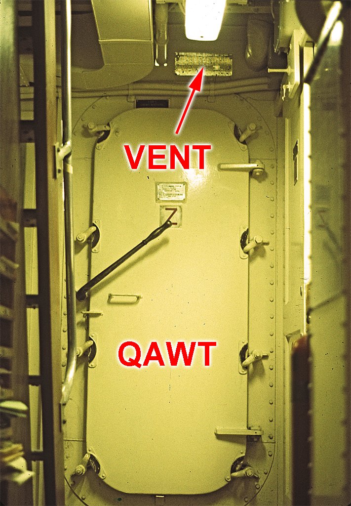

QAWTdoor.jpg.2ac87798a75b4d9c963ee4ecdadd3d2a.jpgWork on the deckhouse brought back some memories from the Cape.  The ship had one Quick-Acting Water Tight (QAWT) door. It was inside the superstructure on the main deck at the forward end of the mess deck. It opened into a companionway and ladder that led down to the crew's berthing compartment in the bow.
It was called "quick-acting" because all eight of the "dogs" that clamped the door tight against the water tight seal were operated with a single lever, and not individually as on ordinary water tight doors.
I thought this was peculiar for two reasons. First, all the other doors on the ship, including exterior doors, were wooden and non-watertight. For this door to serve a watertight function the main deck would have to be flooded, and that would only happen if the ship was on the way to the bottom.
The other odd thing was that QAWT doors were installed in watertight bulkheads to prevent water from flowing from one part of the ship to another. But there was a screen vent over the door in this "watertight" bulkhead. It reminded me of the joke about something being as useful as a screen door on a submarine.
For me this door symbolized the Cape. It was almost useless. I say almost, because if the ship was sinking it might delay the flow of water into the crew's berthing compartment below deck, and that might give the men time to escape through a scuttle on the main deck at the bow.

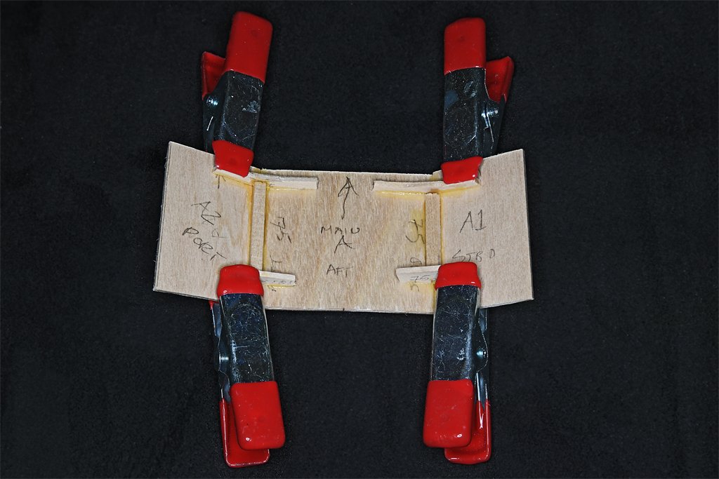

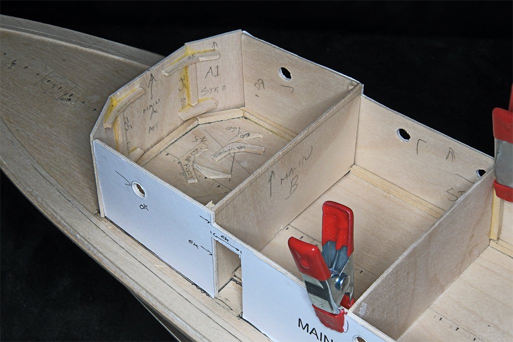

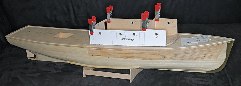

I have a bit more progress to report. The forward bulkhead of the deck house is the key to the entire assembly. The three pieces join at 150 degree angles so they must be beveled 75 degrees on the sides where they join. In addition, they have to conform to the camber of the deck, they are vertical relative to the water line, and the deck has a significant sheer. There are no "square" corners or 90 degree angles, so there is plenty of opportunity to screw up!
Forwarddeckhousebulkhead1.jpg.0fb24644bca1a4ccd9594ba1a883e8ae.jpgI worried about this a lot, trying to figure out the shape of the two side pieces. I modeled it in 2D CAD, based on the deck camber. But the first two side pieces didn't come close to fitting! Then I did it in 3D CAD, taking into account the angles of the parts, and came up with what you see here.
These pieces have to be assembled first. Then the rest of the deckhouse will be added to them - again at some odd angles. The house sides join the outer two front pieces at 120 degree angles, so the parts must be beveled 60 degrees on the joining edges.
I used interior support pieces angled at 150 degrees to glue the pieces together. Then additional 1/8 x 1/8 inch (3.2 x 3.2 mm) pieces were glued to the inside of the joints for additional strength.
Forwarddeckhousebulkhead3.jpg.60e0b319908d17af7e7fedd1ea9208bc.jpgForwarddeckhousebulkhead2.jpg.85eeef65ecd6a027d05ba2dfffe5464e.jpg
I guess I did get it right because the pieces seem to come together correctly. At this point the outer front pieces are oversized and will have to be trimmed back and beveled appropriately. Only the front three pieces are glued together. Everything else is just clamped in place. There is a lot more work to do on the house sides before they can be glued to the front and interior bulkheads.

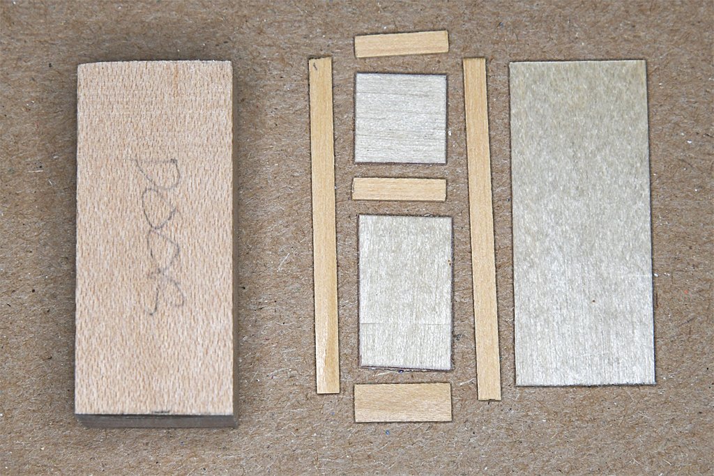

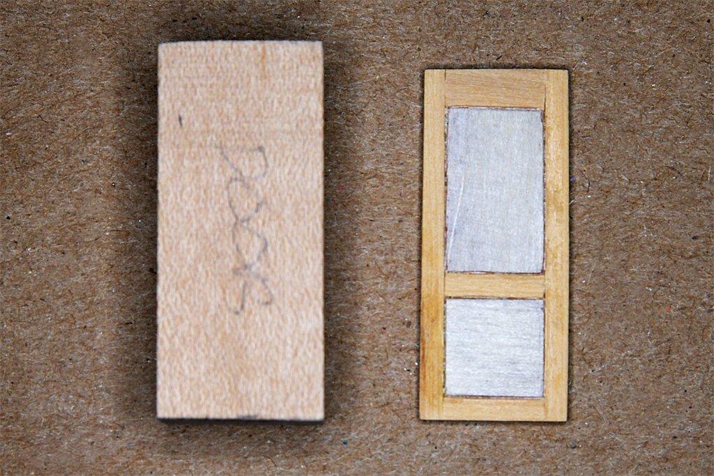

There are seven "weathertight" doors (not watertight) on the exterior of the superstructure, Three at the main deck level and four on the O1 level. The doors were made like the doors in houses in the 1950s. They had two center panels that had "V" shaped grooves all around. I want to try to replicate this.
Here is a "door kit."
Door1.jpg.c9f948802659a306fa08b189c3eb1b40.jpgDoor2.jpg.94581a4222fc652c1ba244db24e8ec8d.jpg
The side and top parts are 3/32 x 1/32 inch (2.4  x 0.8 mm) boxwood, the bottom piece is 5/32 x 1/32 (4 x 0.8 mm) boxwood, and the center panels are 1/32 inch plywood. The 1/32 inch plywood panel at the right is the finished door size. The other parts are glued to it to create a 1/16 inch (1.6 mm) thick door, as shown on the right. The block at the left is the template for cutting the door openings. The doors are a bit smaller, and will have 1/32 inch frames all around.
There is a problem here. In my rush to assemble the door I put the wider 5/32 inch bottom part at the top! Well, it is a prototype, and Murphy had a hand assembling it. Reminds me of the topsail schooner build where I go in a hurry and switched the pintles and gudgeons for the rudder! How embarrassing!

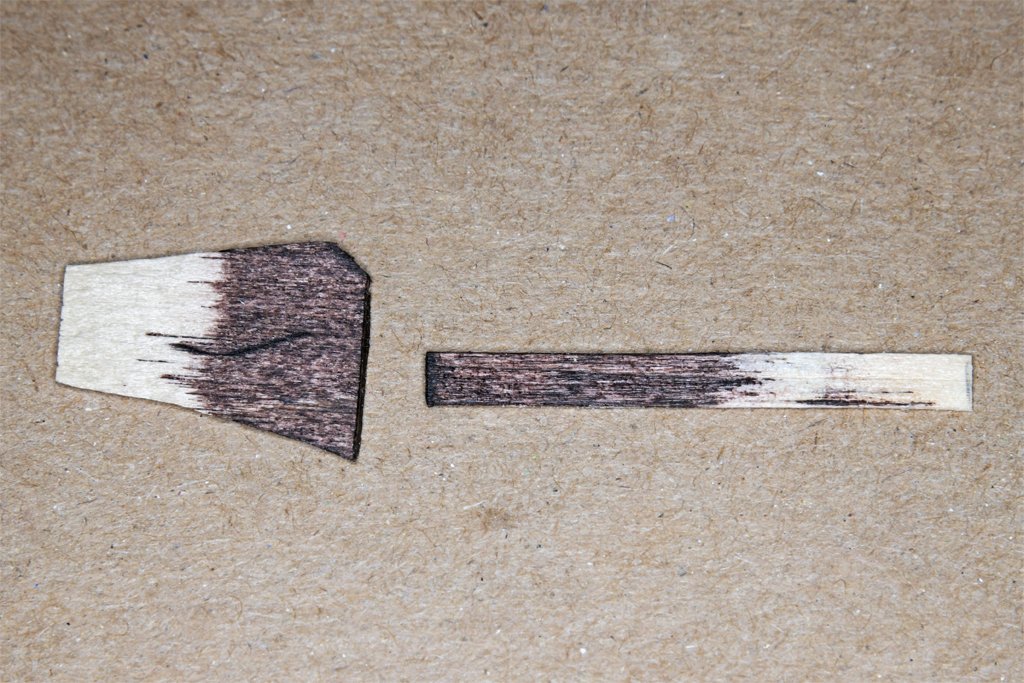

The doors were all painted gray on the outside. But inside they were varnished mahogany. The two doors to the pilot house will be open, as shown in this rather grainy photo. The grooves around the center panels were painted white.
I want to replicate this in the model. The windows and window frames were also mahogany, as were the frames for the windshield, railings around the bridge and on the bulwarks, and a lot of the interior of the pilot house.
I will be experimenting with pear wood to try to get the nice red mahogany color. But if that fails I will just paint the doors with "mahogany" paint.
Here are pieces of the boxwood and plywood used in the prototype that have been stained with Minwax premium oil penetrating stain. This is "Red Mahogany 225."
Looks more like brown mud! I have tried to use this stuff before and this is the best results I have had. Blotchy and streaked. Awful!
This is why I said I may just paint the wood.

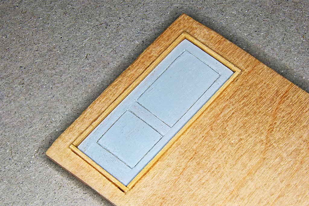

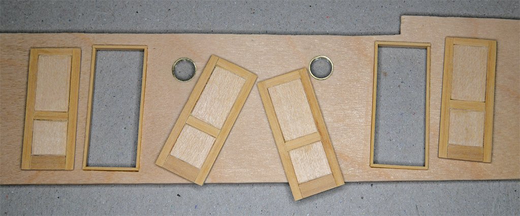

Here is a bit more progress on things that must be done before the deck house parts are assembled. I have cut out the door and air port openings on the deck house sides. Then I stripped off the paper templates, sanded the wood smooth and applied a coating of acrylic sealer. And I made all the weathertight doors except the mahogany doors for the pilot house.
This is the prototype door positioned in the after deckhouse bulkhead - with the panels removed and installed correctly! I am using Titebond Original wood glue, and it can be loosened with heat. I used my plank bending/sail making/quilting iron tool as a debonding heater to loosen the glue.
The door frames are 1/32 x 3/32 inch (0.8 x 2.4 mm) boxwood strips glued into the opening in the 1/16 inch (1.6 mm) thick plywood bulkhead. Technically the bottom sill should be 0.0026 inches (0.066 mm) thicker than the side and top sills, but with my tools I have no way to produce this.
The grooves in the door stand out nicely! The finished door will have a brass door knob made from a small brass nail.
I made the air ports with a 1/16 inch (1.6 mm) long piece of 0.28 inch (7.1 mm) outside diameter brass tubing. The inside diameter is 0.25 inch (6.4 mm), or 12 inches (305 mm) at 1:48 scale. These were sawn off the end of the tube a bit longer than needed. Then they were pushed into a hole in a piece of 1/16 inch thick  plywood and filed down until they were as long as the thickness of the plywood. It would have been easier and quicker with a lathe!
Airport1.jpg.290639745a04a547665041a792ece130.jpgAirport2.jpg.50c2da063b9a8a13beb55d641879b36a.jpg
I glued squares of 0.005 inch (0.127 mm) thick clear styrene on the inside of the bulkhead, with additional scrap wood pieces to hold them in place. I have considered adding an additional 3D printed piece on the inside of the air port that is shaped like the metal inside cover and painted the typical US Navy interior puke green. Whether I actually do that remains to be seen. But if I do they really won't be seen at this scale, so why bother?
Edited by Dr PR

A bit more progress on the doors and deckhouse.
These are the pilot house doors. The door on the left is partially assembled. It is 1/32 (0.0325) inch (0.8 mm) thick pear wood strips and panels glued onto a 1/32 inch thick plywood backing. This is the rough door before sanding and staining.
I knew I couldn't create uniform width grooves for the white trim, so I took a hint from small craft builders who needed white grout between planks. I used some 0.020 inch (0.5 mm) white styrene strips.
The window is a 0.005 inch (0.13 mm) thick piece of acrylic sandwiched between two thin (>0.015 inch/0.38 mm) rings cut from a 0.28 inch (7.1 mm) diameter brass tube. The inside diameter is 0.25 inch (6.4 mm) or 12 inches at 1:48 scale.
The door on the right is finished with Varathane wood stain, in the "Gunstock" color. The pear stains nicely and I like the resulting reddish "varnished mahogany" color.
I have been wondering how to get a good mahogany color and this stain works well. All of the door and window trim around the pilot house was mahogany. While rummaging through my wood stash I found a bag of 3.75 x 0.093 x 0.045 inch (95 x 2.4 x 1.1 mm) HO scale railroad ties that appear to be real mahogany! I remember buying these in the 1970s to be used as hull planks for a scratch built ship's boat. These "ties" are a good size for the door and window trim, and the window frames.
I was working on the doors while the glue set on the deck house assembly.
This assembly is tricky because there are no right angles. The deck house is narrower at the front than at the rear, so the sides aren't parallel. The deck has significant sheer forward but the bulkheads should be vertical perpendicular to the water line. The attachment of the forward angled bulkheads to the side pieces is critical for getting all the other pieces right.
Deckhouse3.jpg.8ae7aee8811384ebacea50091b12628d.jpgDeckhouse4.jpg.7aff753751eaae72fd120bd9fa937b18.jpg
I added a lot of interior bracing to make it strong enough to hold up to handling  The first attempt to put it together came out too wide, and it didn't fit the house outline framing glued to the subdeck. I had to disassemble the port side and reshape the pieces to fit correctly. I am using Titebond Original wood glue and it can be softened with water and heat. So I soaked the joints and heated them with a hair dryer. It came apart "reluctantly!"
The interior bulkheads are just clamped in place at this point. They set the angles where the front and side pieces join.
